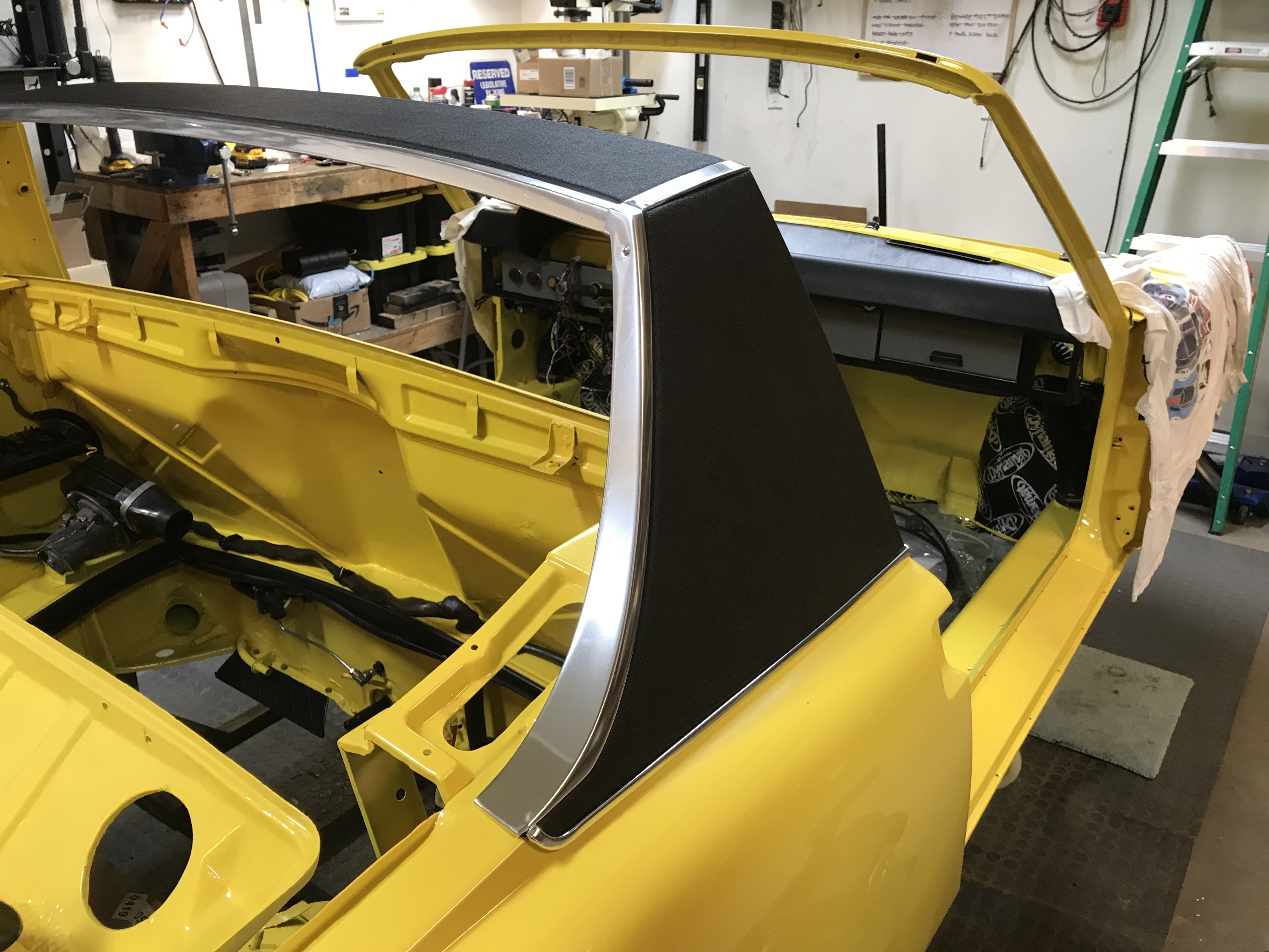

Right side done.

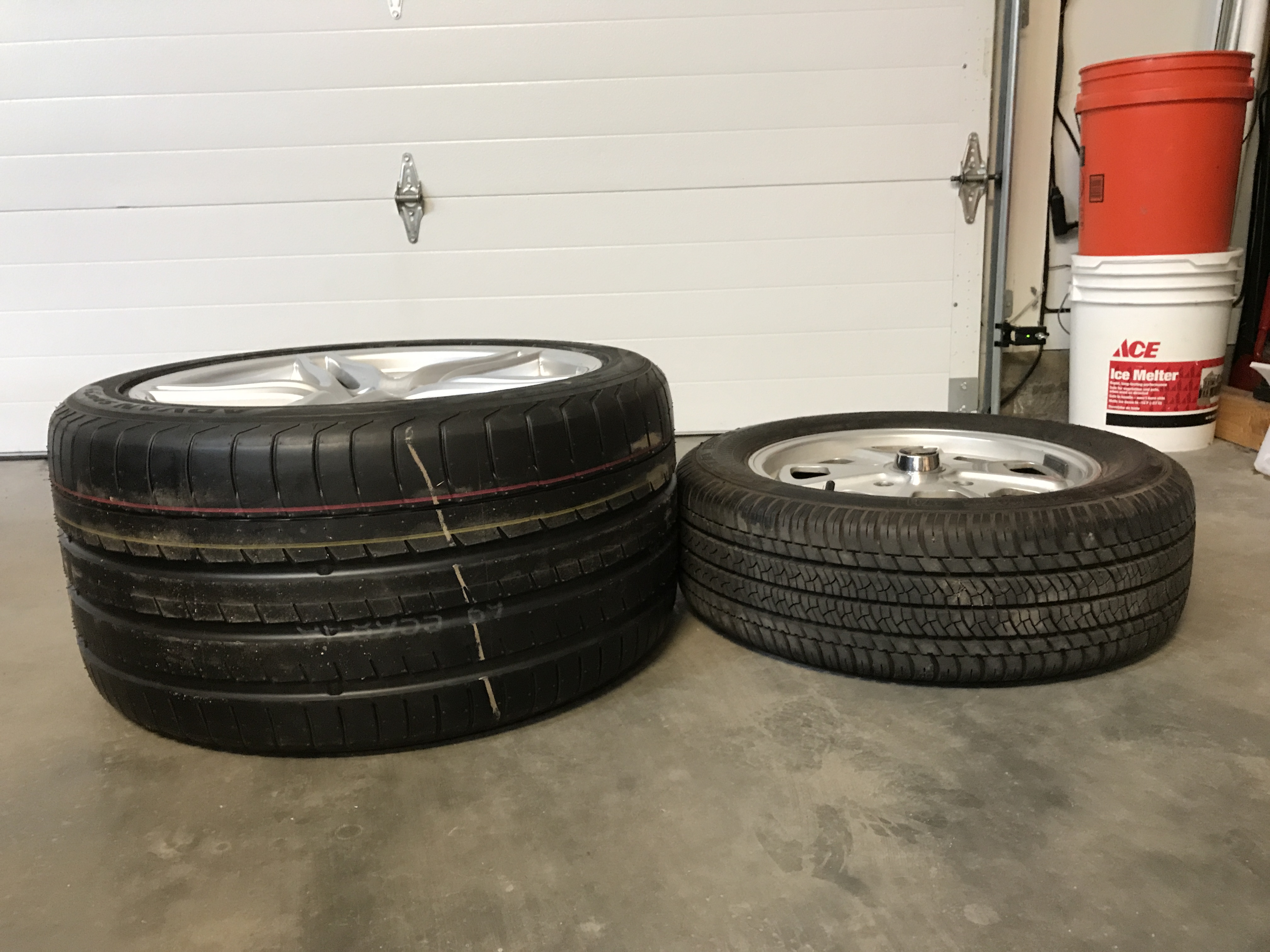

I was also changing tires on my 2017 911 today, and could not help comparing to the 914 tires. Note that my C2 has the smallest rear tires of all 911s for that year.

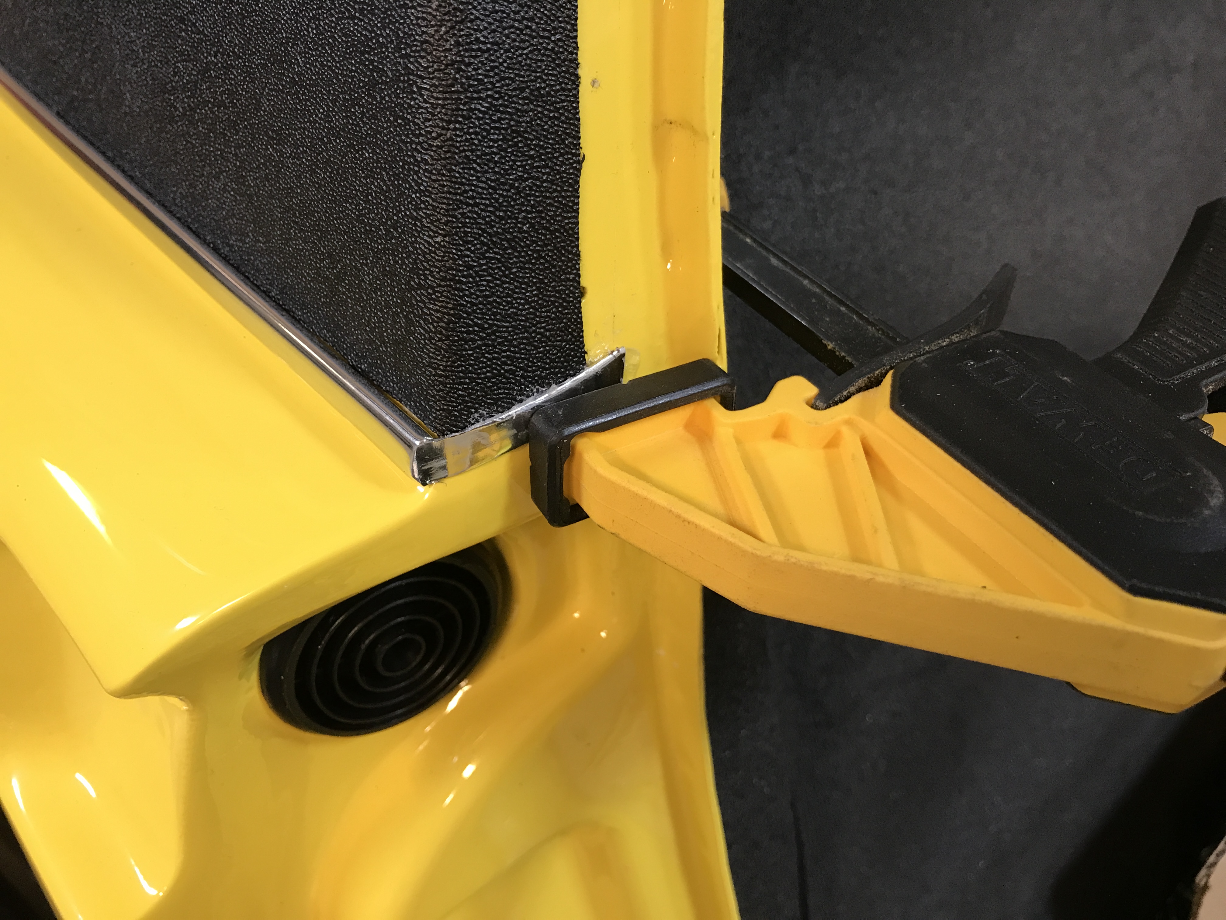

One more sail trim detail--some glue for the forward end of the lower trim strip.

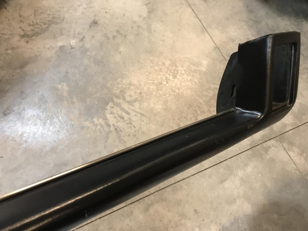

While I was feeling sticky, I needed to reglue the end of the chrome trim strip on the lower dash bolster.

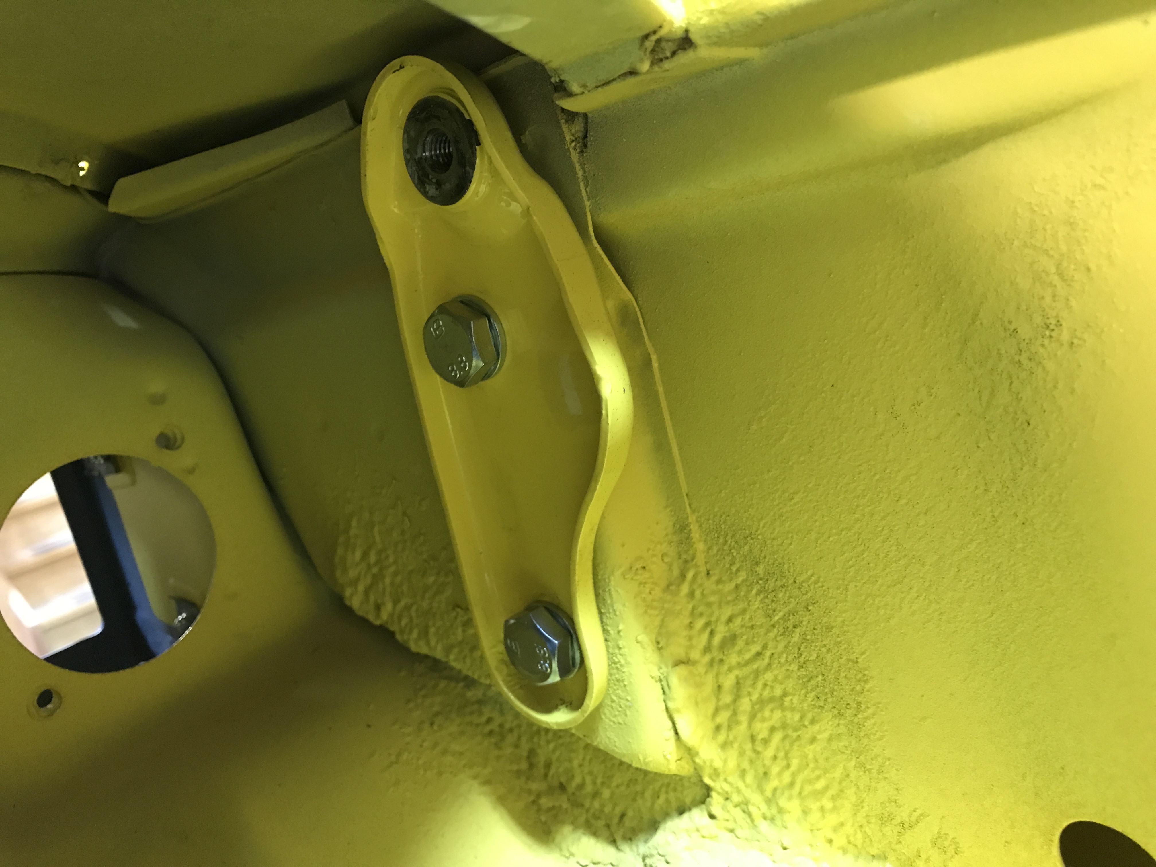

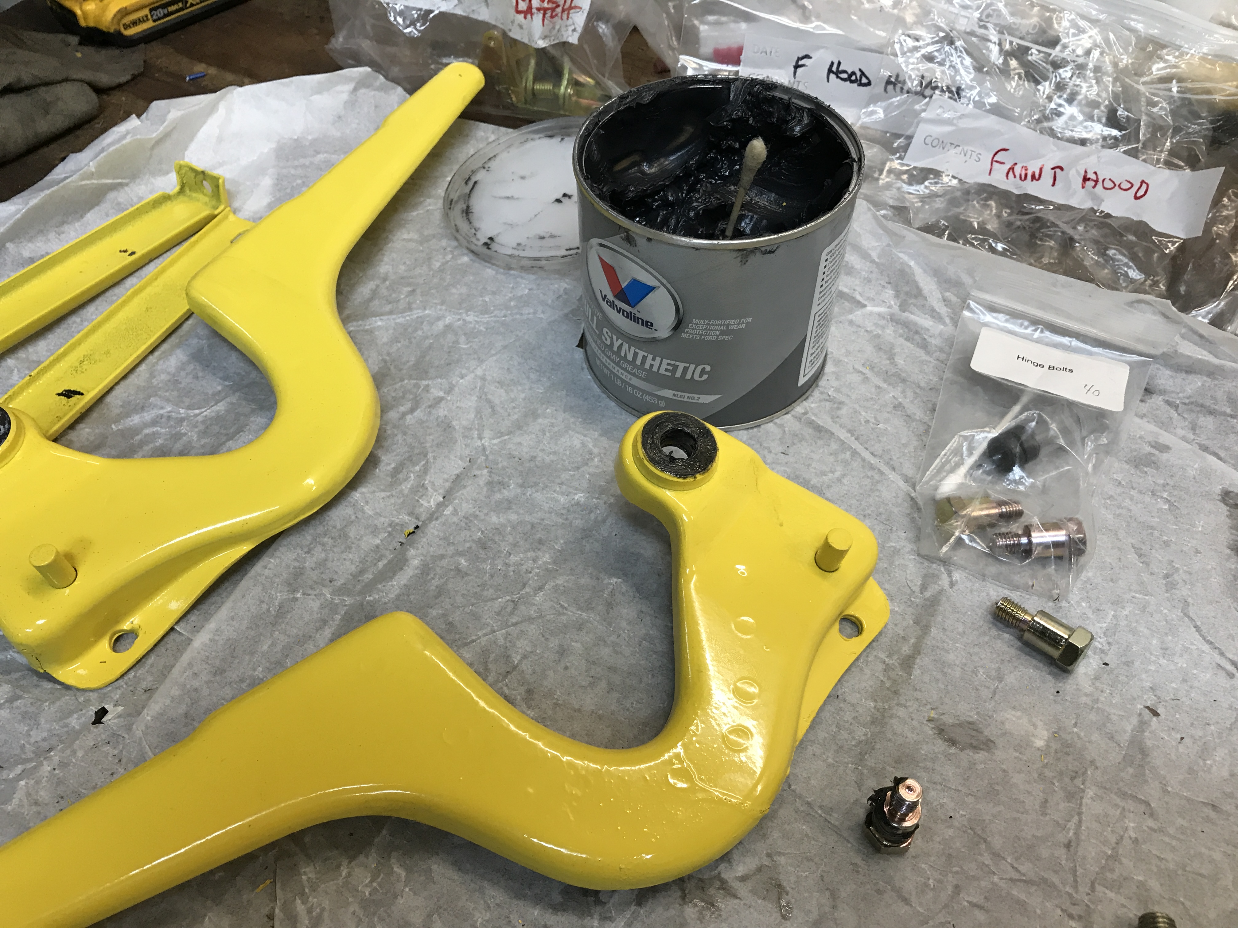

And I got out the front and rear lid hinge brackets, to test the fit of new hardware.
bkrantz
post Mar 26 2021, 08:34 PM
Post #2526
Posts: 8,531
Joined: 3-August 19
From: SW Colorado
Member No.: 23,343
In the front, I installed the pivot plates. I will wait to install the lid bracket until I get the dash vents and hoses done.

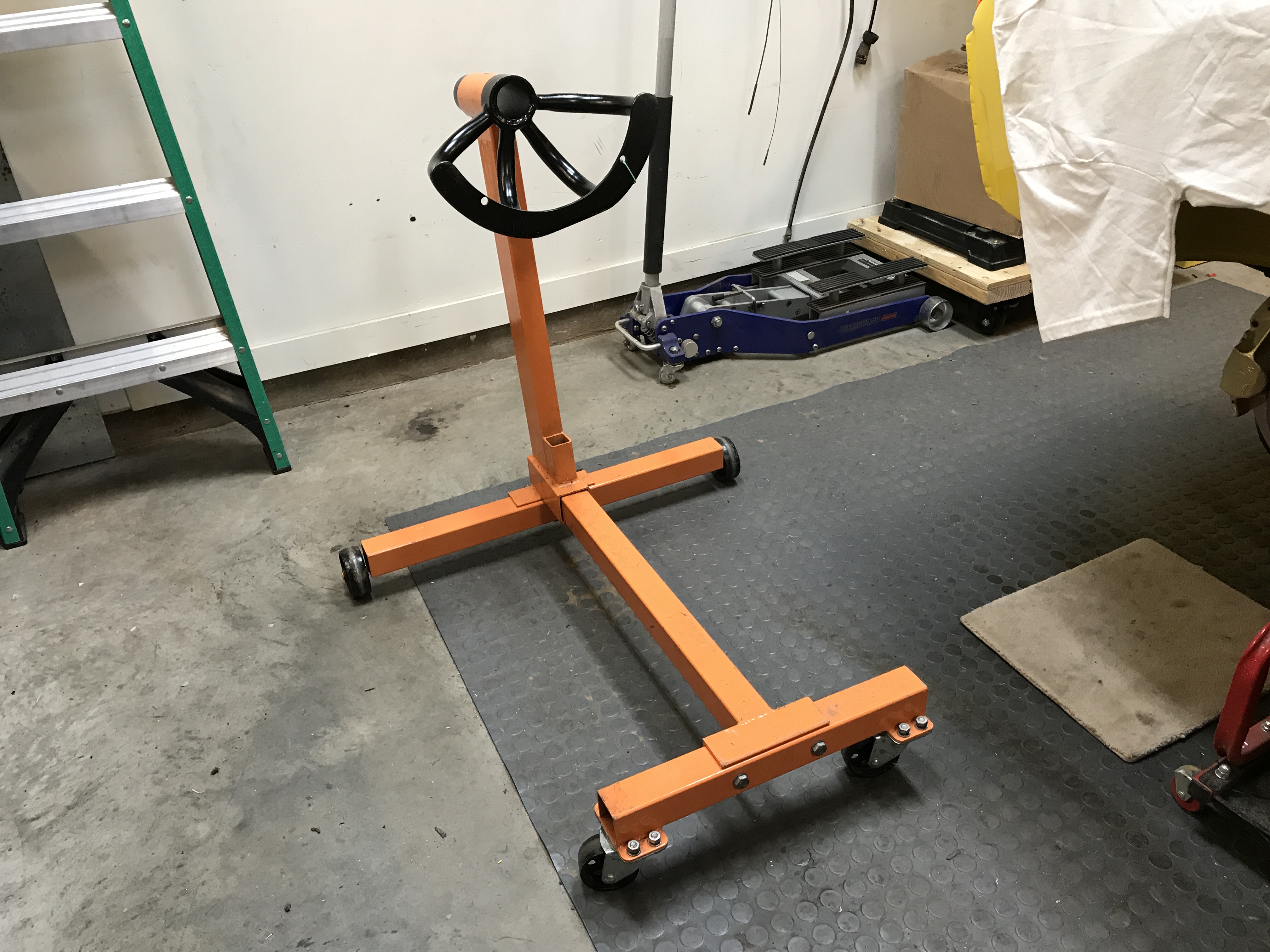

While I wait for some more orders to arrive I re-arranged my work space a bit, and got the stand out. Time to start some engine work. Soon.

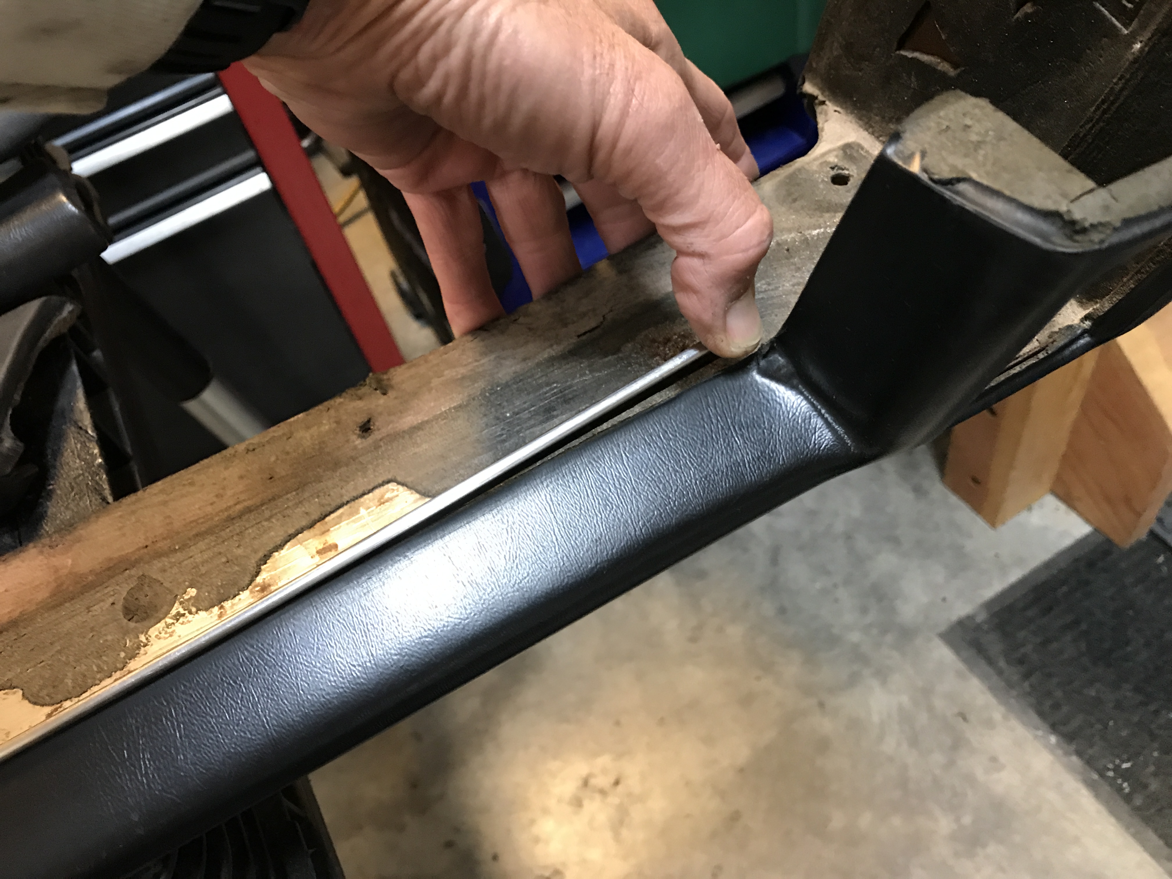

Successful gluing of targa bolster. Cracks are still visible but the padded vinyl is flat.

And the chrome trim strip is now glued to the dash bolster.

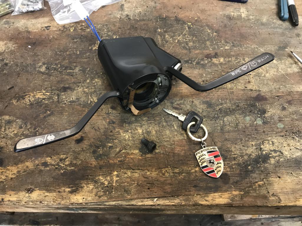

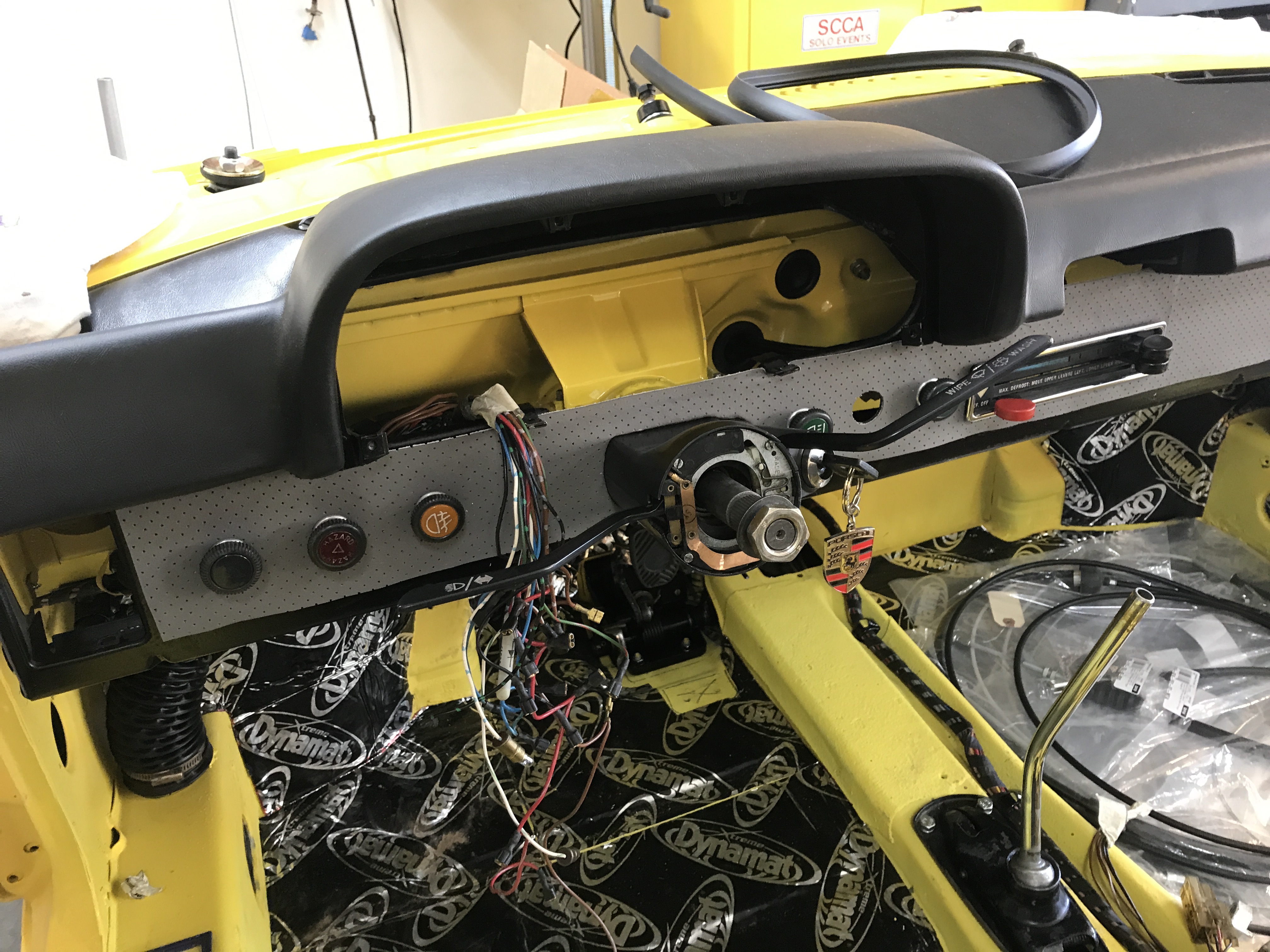

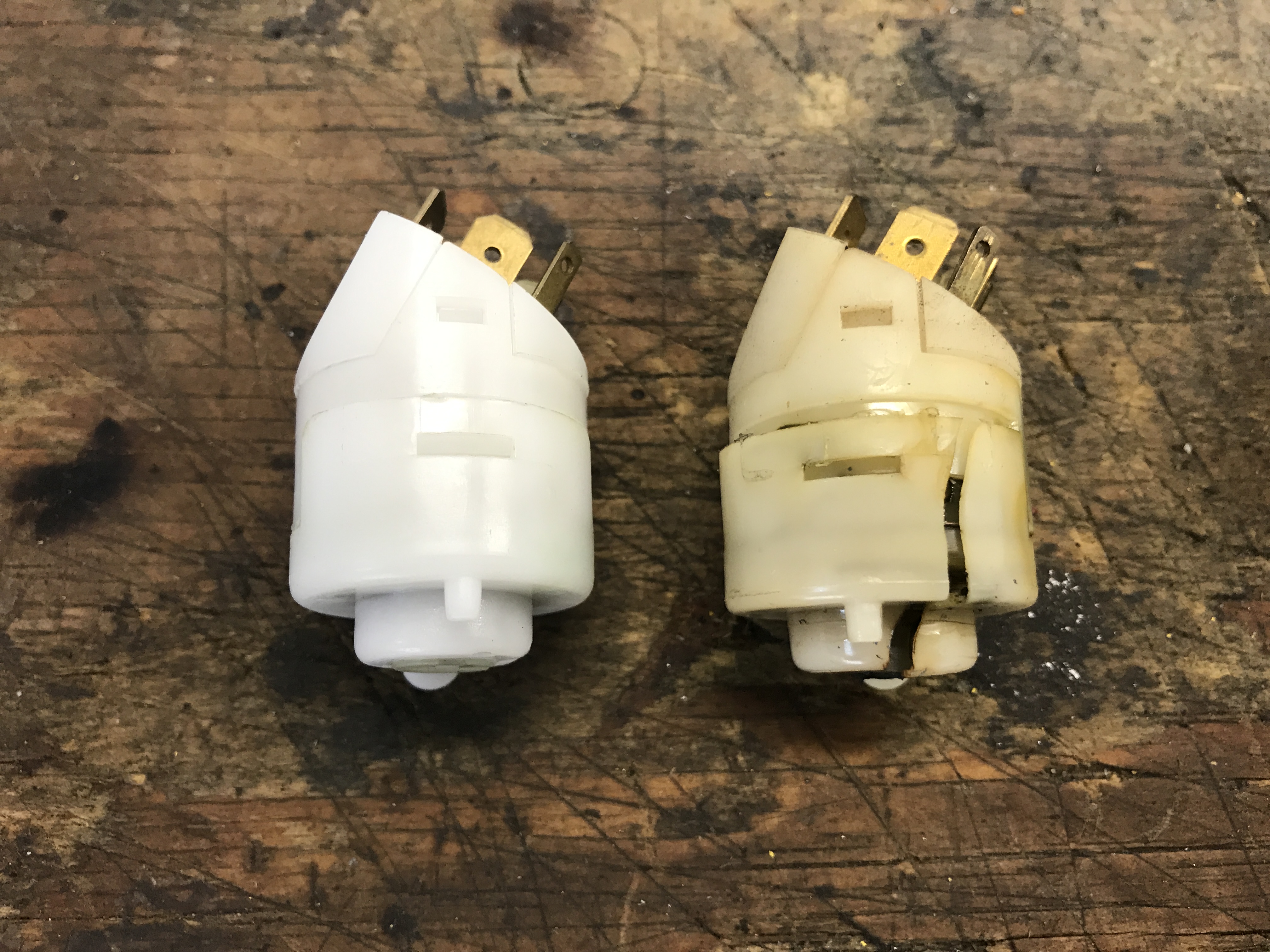

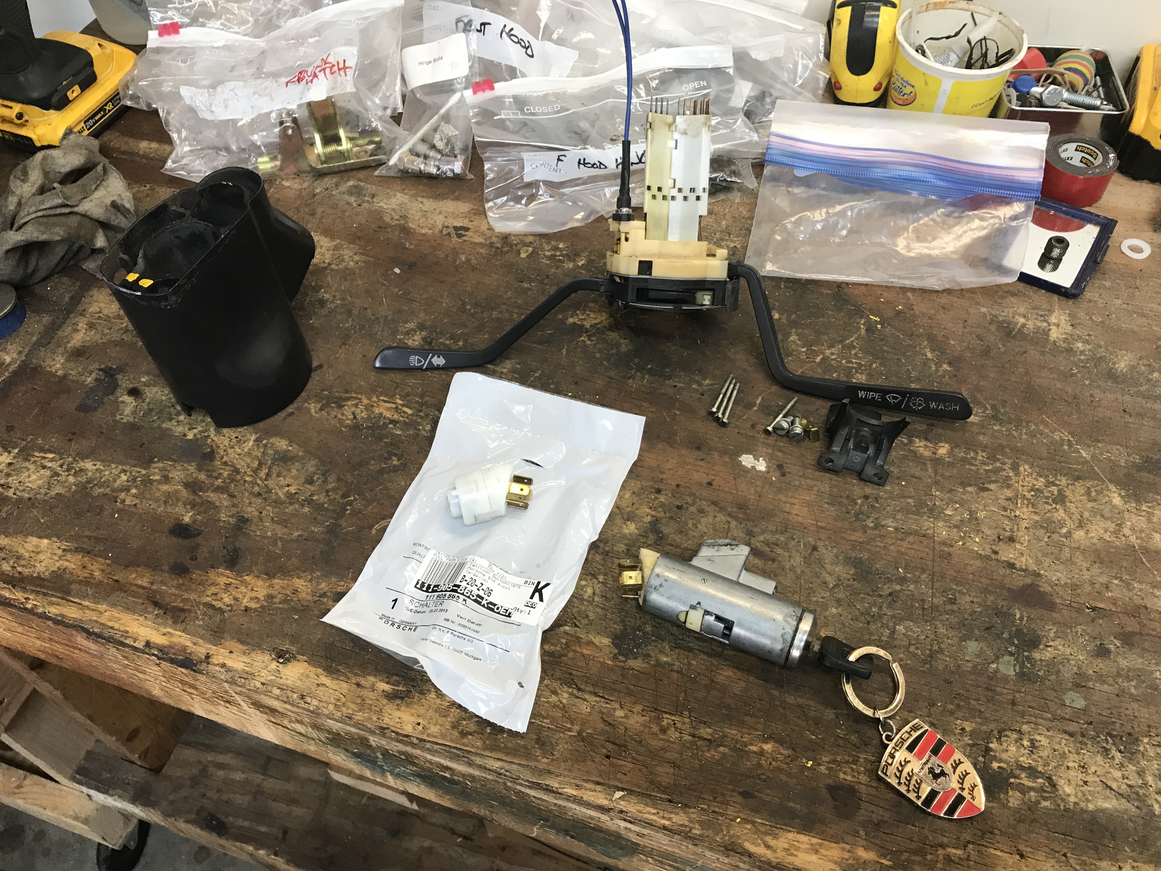

Time for the steering column. The PO had an auxiliary relay for the starter, so I suspect something in the ignition circuit is bad.
bkrantz
post Mar 27 2021, 07:14 PM
Post #2531
Posts: 8,531
Joined: 3-August 19
From: SW Colorado
Member No.: 23,343

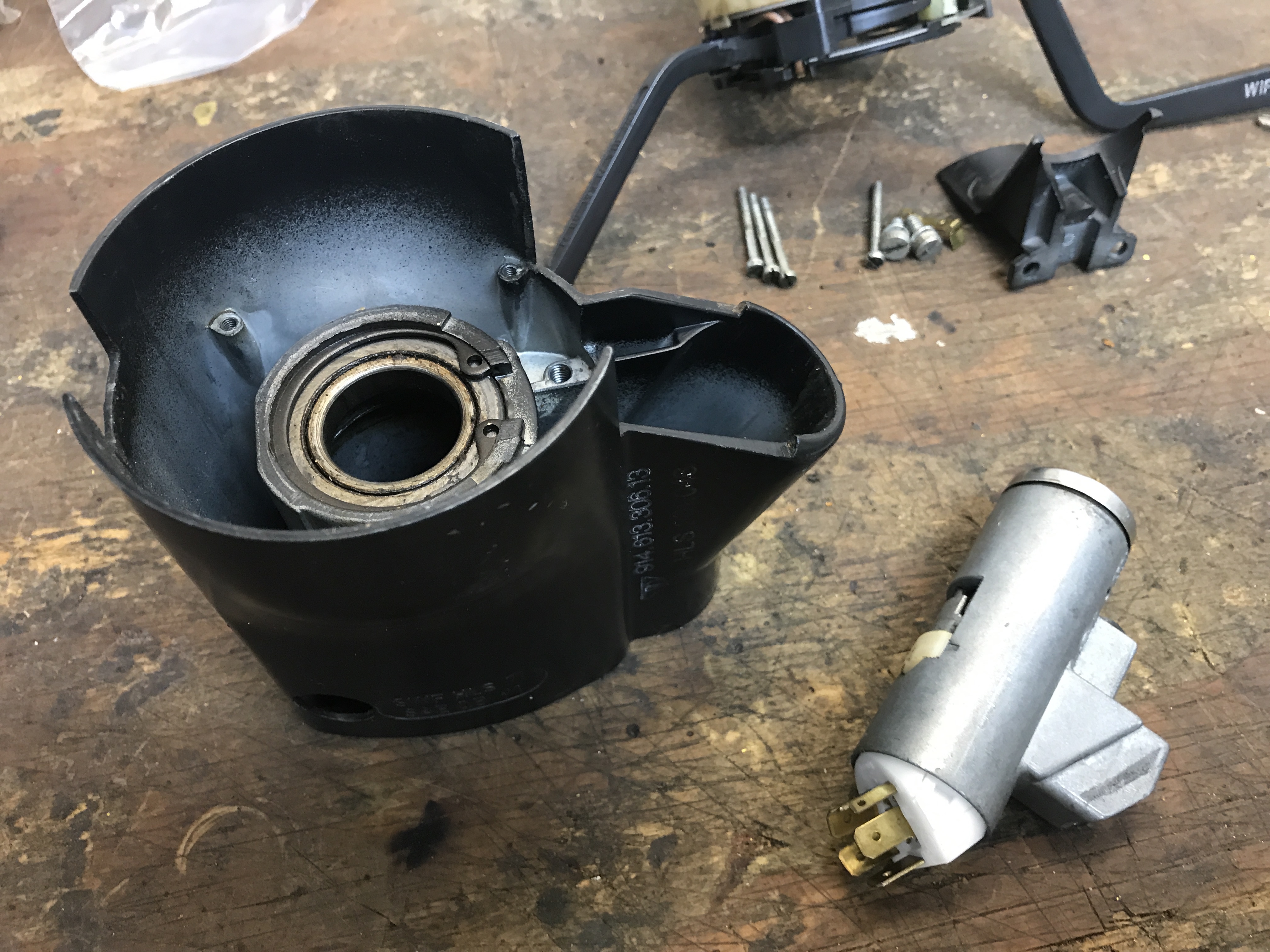

Here's one problem: the original switch has cracked.
bkrantz
post Mar 27 2021, 07:15 PM
Post #2532
Posts: 8,531
Joined: 3-August 19
From: SW Colorado
Member No.: 23,343
New switch installed.

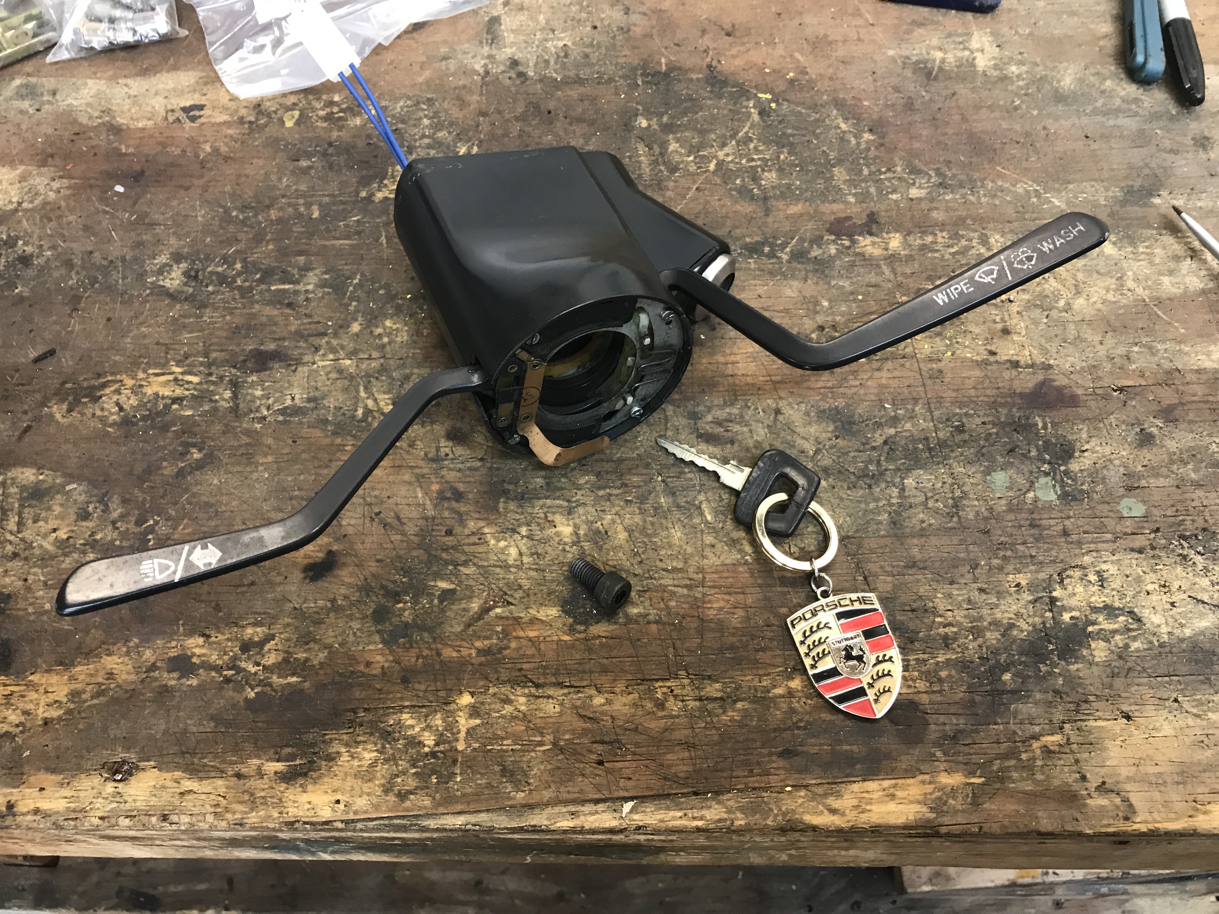

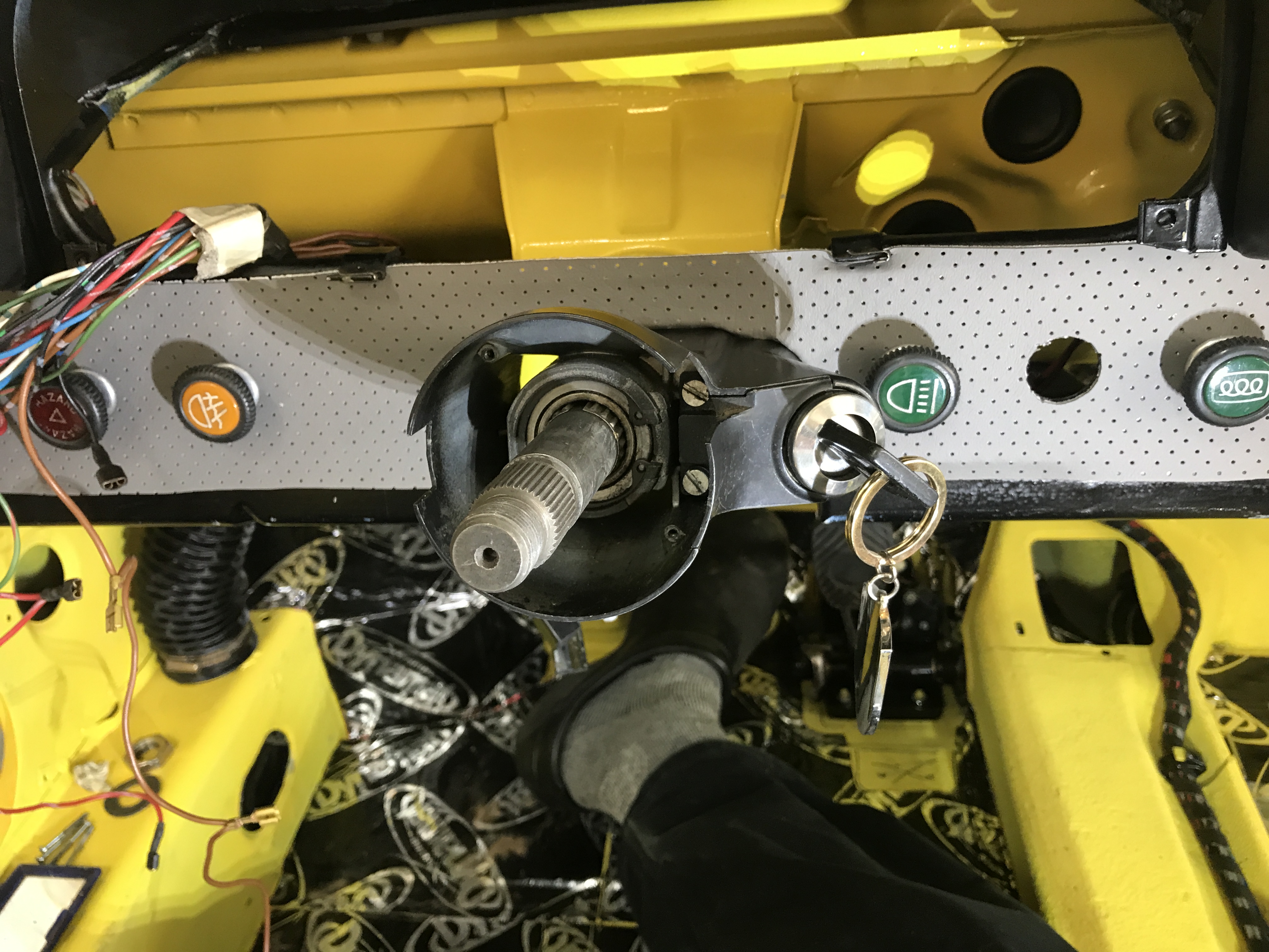

I first put the column together on the bench.
bkrantz
post Mar 27 2021, 07:17 PM
Post #2534
Posts: 8,531
Joined: 3-August 19
From: SW Colorado
Member No.: 23,343

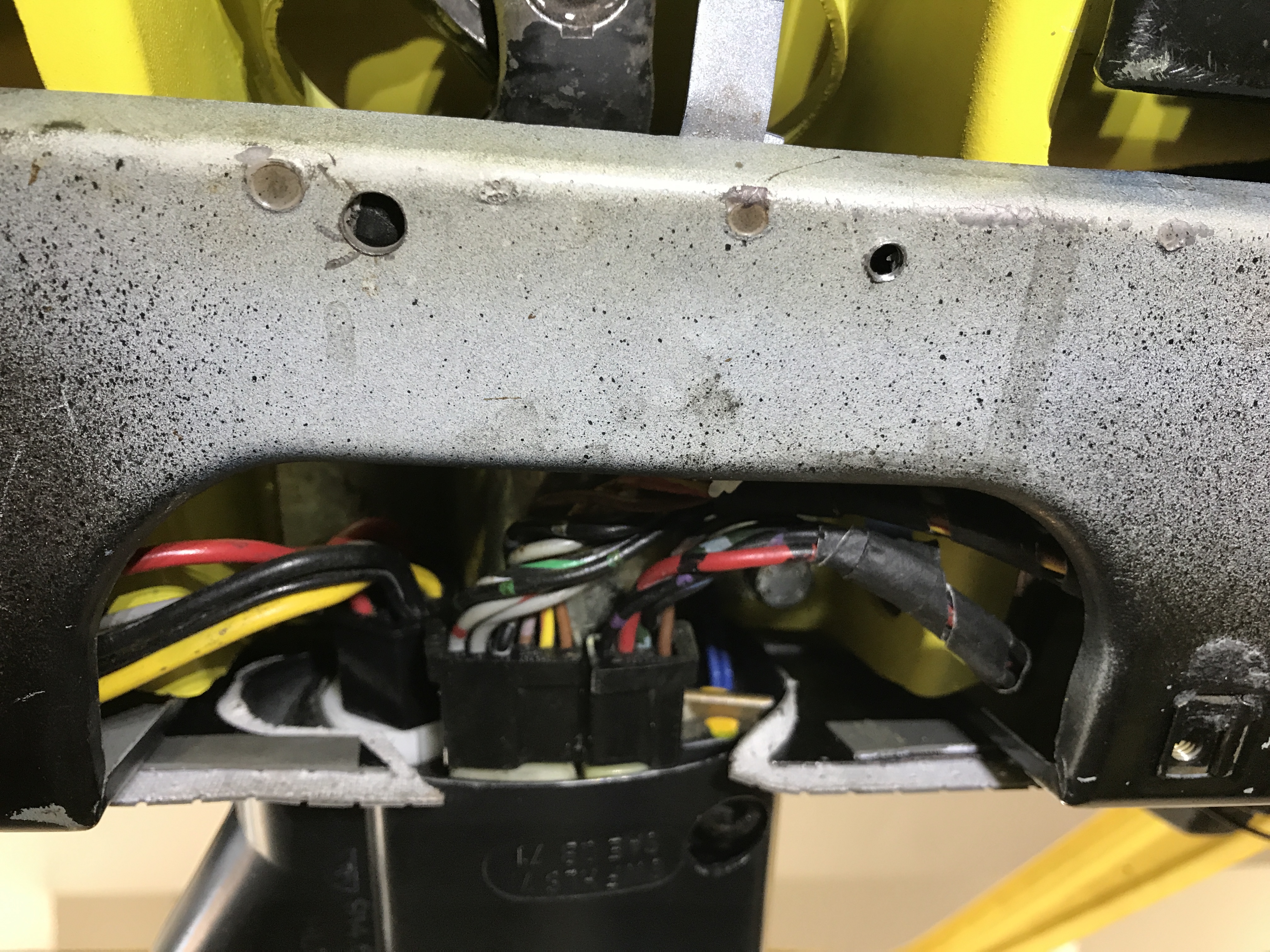

And tried to install this, including plugging in the connectors, but I had trouble getting the cables under the dash to cooperate.

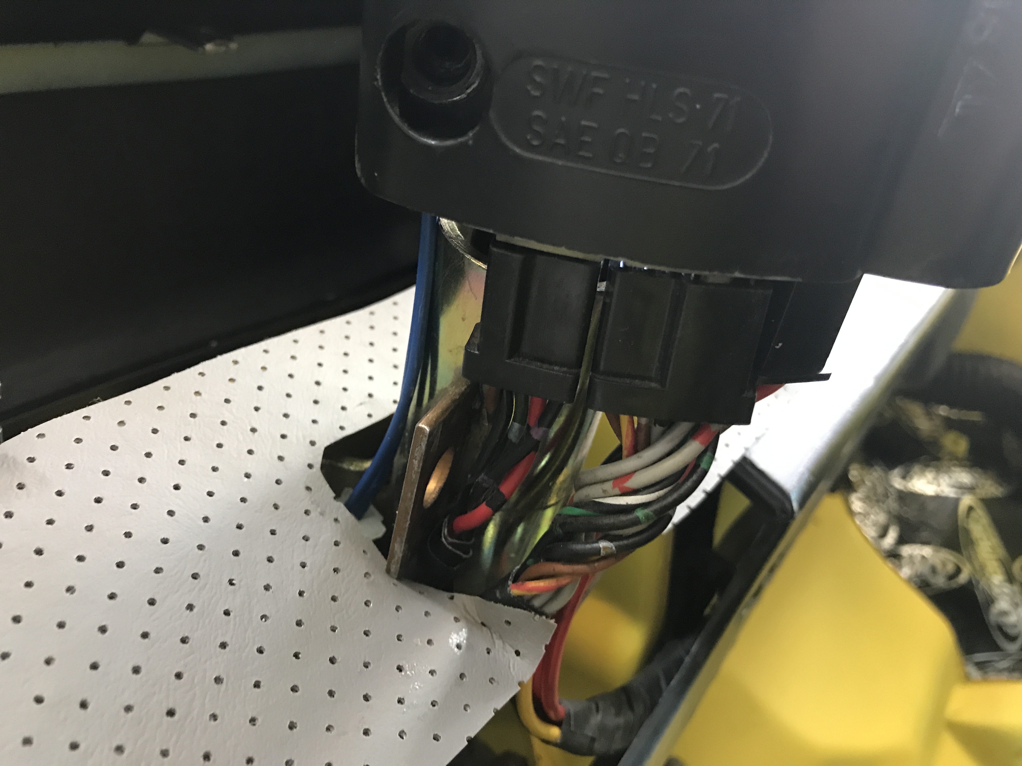

Instead, I pulled out the switch module, and installed the column housing with the ignition switch.
bkrantz
post Mar 27 2021, 07:22 PM
Post #2536
Posts: 8,531
Joined: 3-August 19
From: SW Colorado
Member No.: 23,343
And then the switch module, including the plugs (after arranging the cables under the dash a bit).
bkrantz
post Mar 27 2021, 07:23 PM
Post #2537
Posts: 8,531
Joined: 3-August 19
From: SW Colorado
Member No.: 23,343
Steering column in!

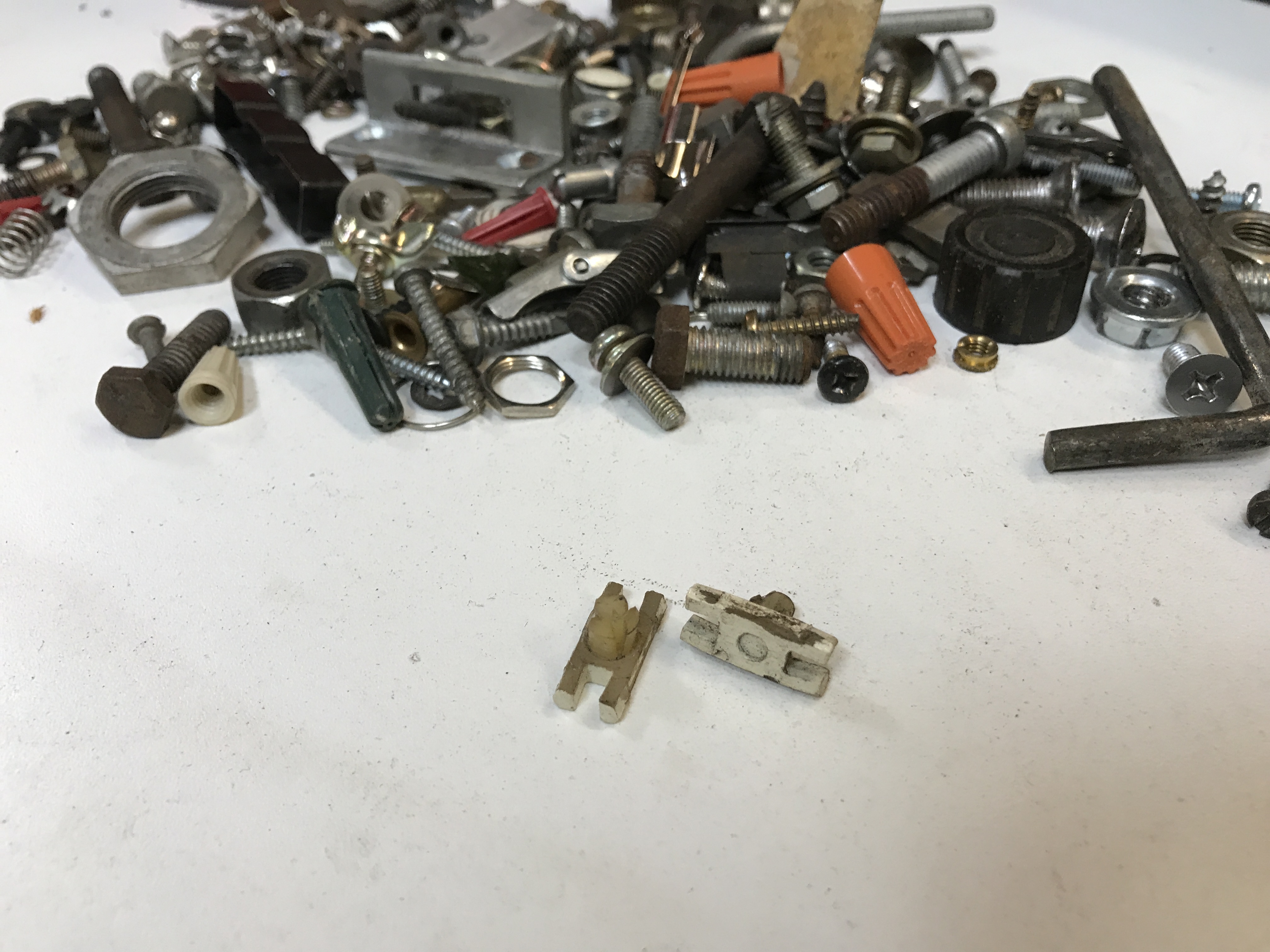

I was digging through my big can of old nuts and bolts and stuff, and found these. From my previous episode of 914 madness almost 30 years ago.
