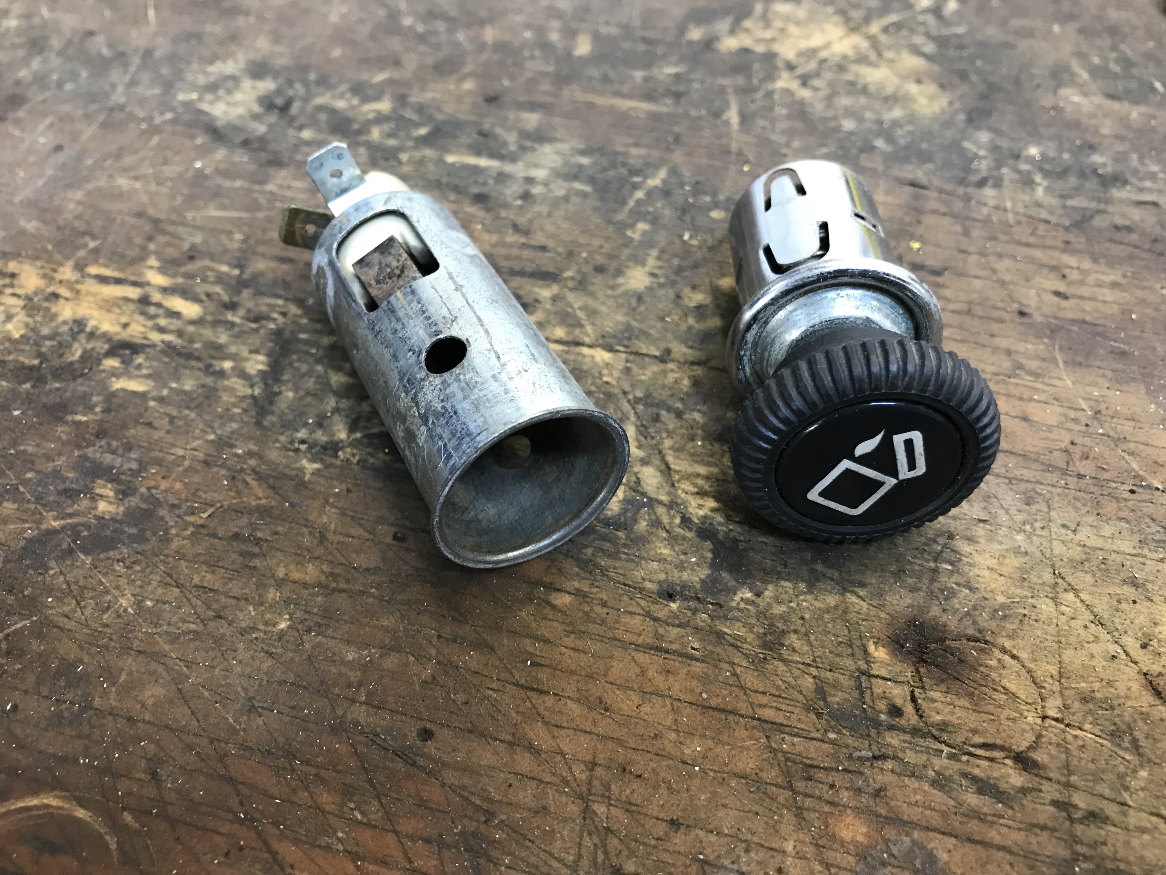

Back home again, and back to work on the 914. A few things arrived while I was gone, including a cigarette lighter to replace the one I can't find.

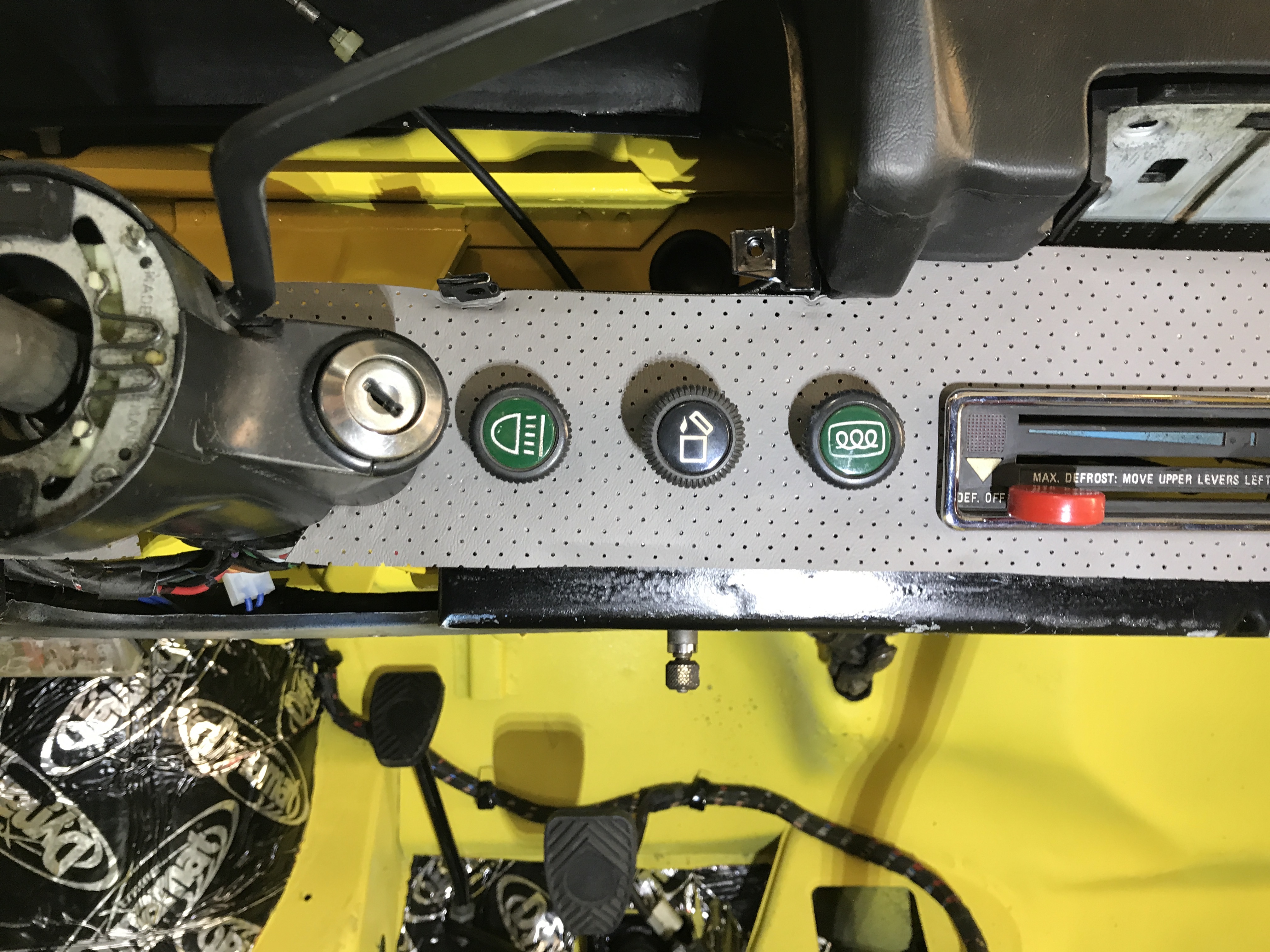

After installation, I have a full set of dash knobs.

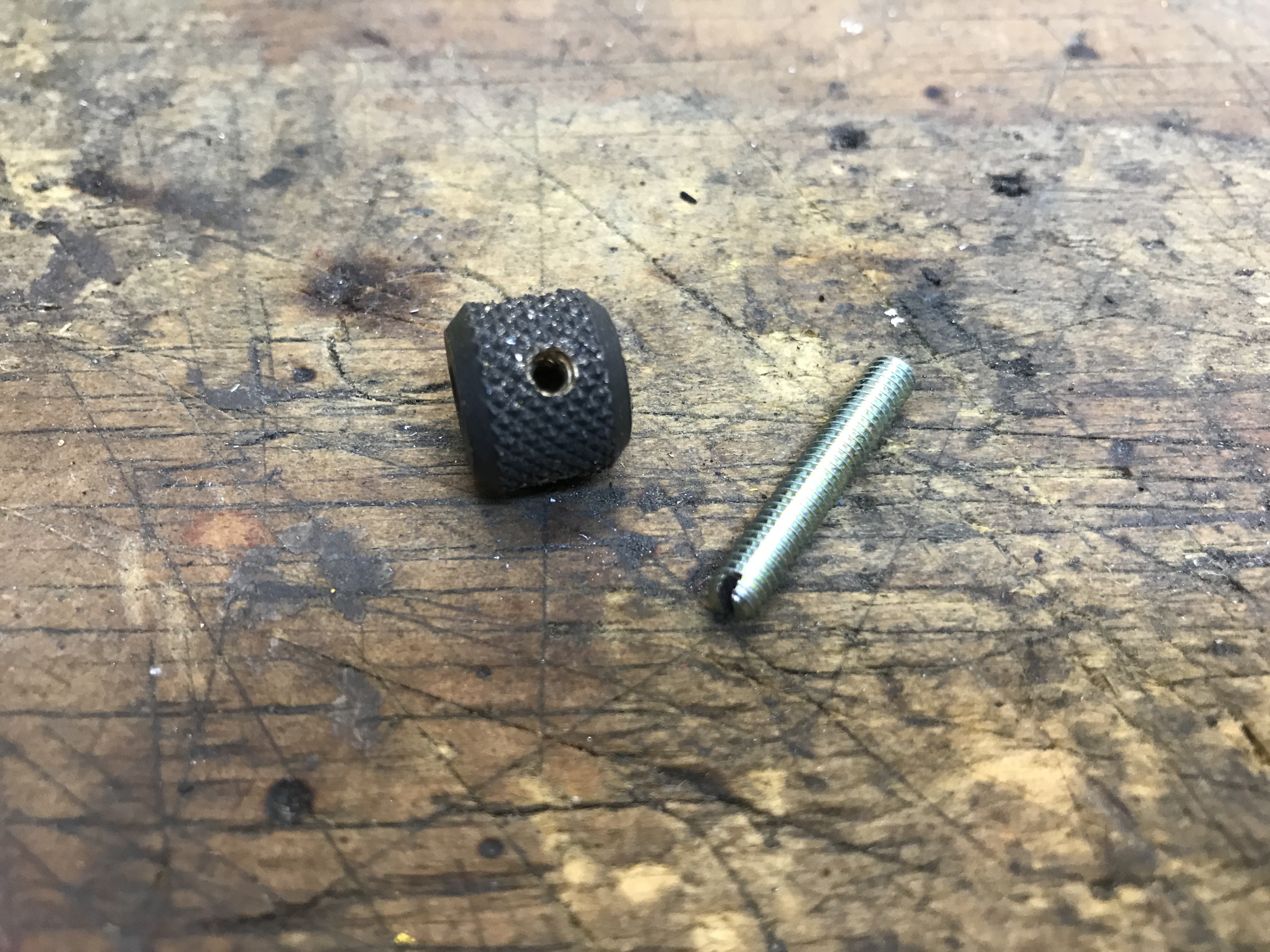

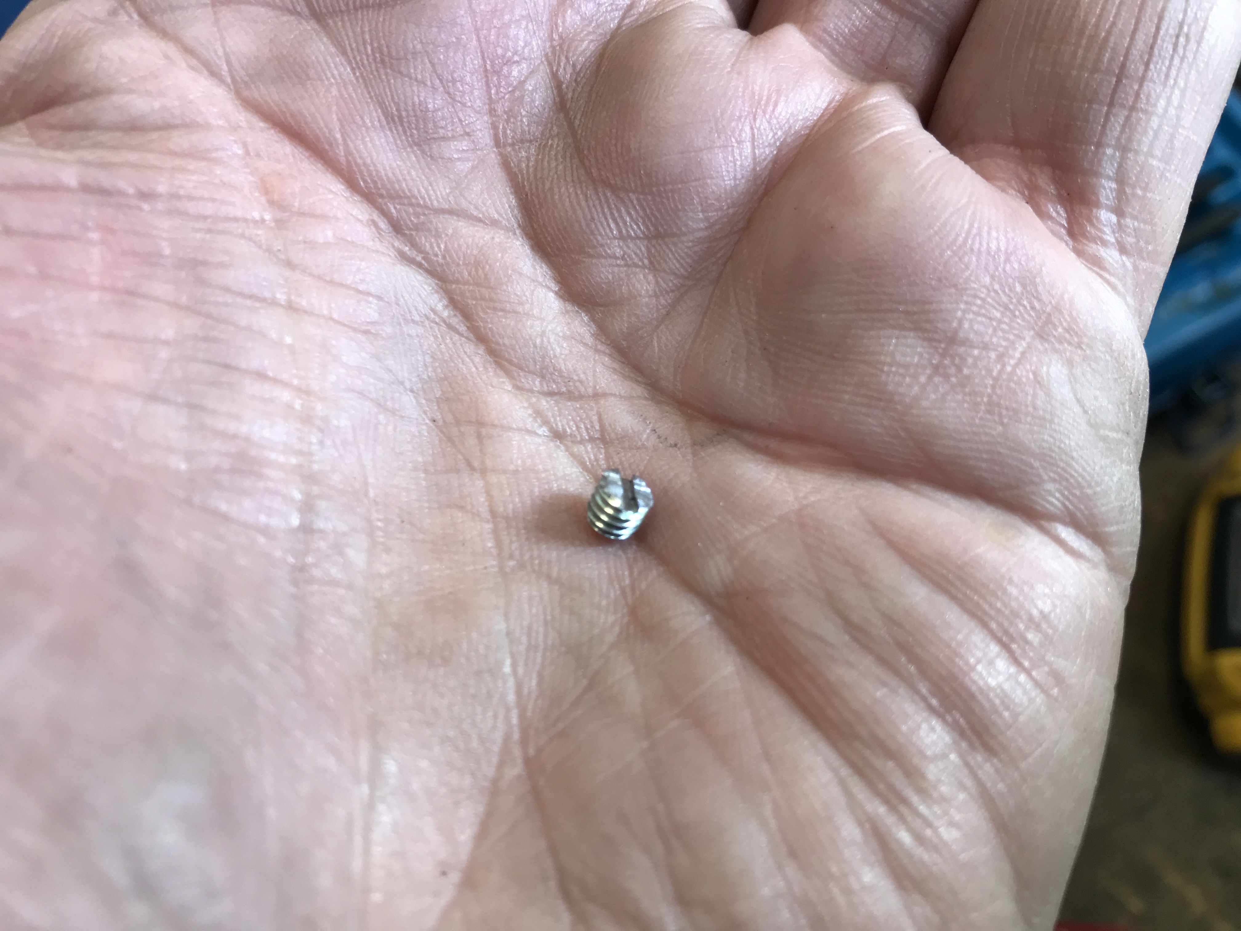

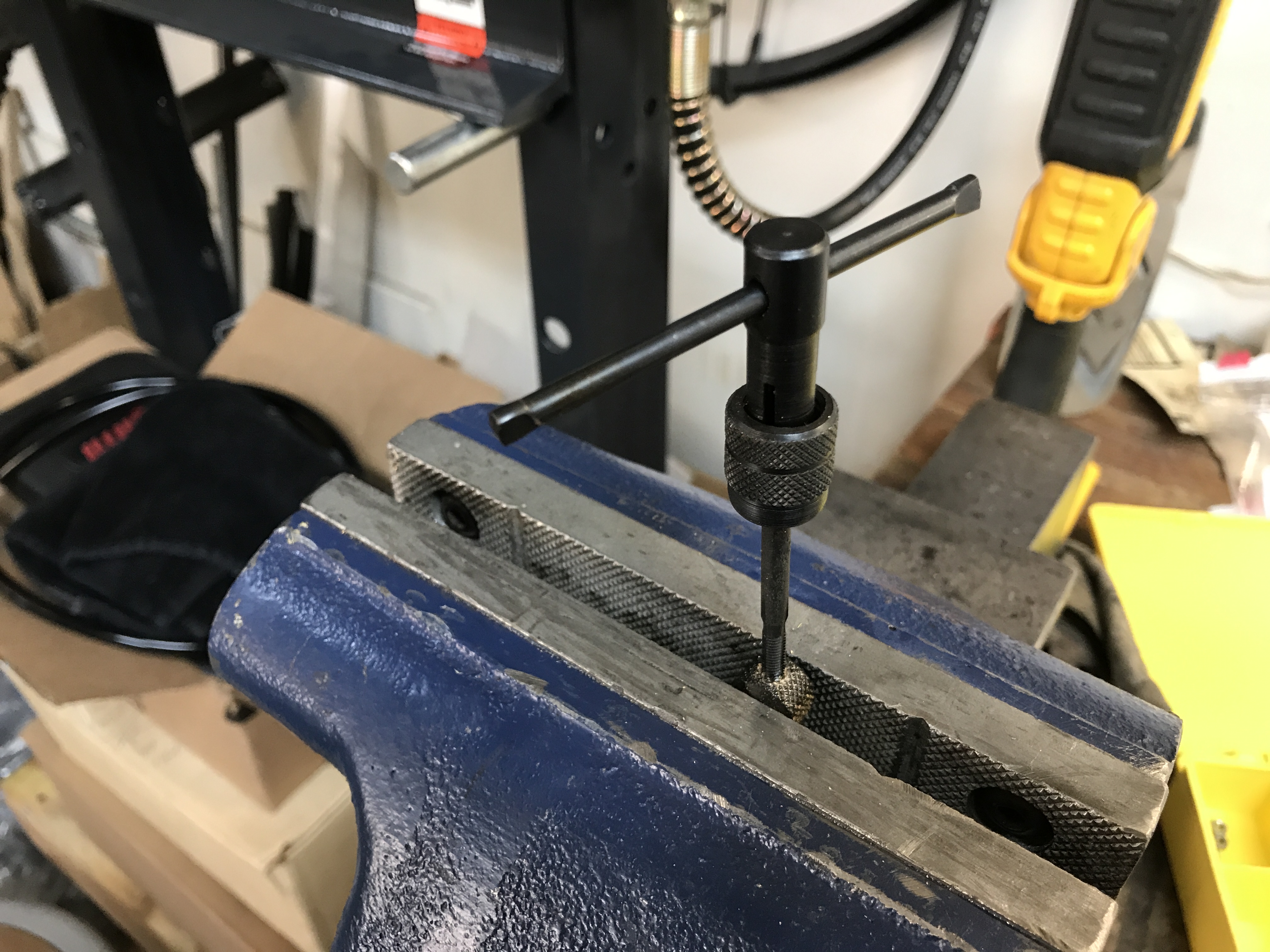

I also made a new set screw for the odometer reset knob. The original hole in the know was stripped out. I had a length of M4 stud with a screw groove in one end.
bkrantz
post Apr 9 2021, 07:29 PM
Post #2544
Posts: 8,531
Joined: 3-August 19
From: SW Colorado
Member No.: 23,343
Stud cut down to a minimal length.
bkrantz
post Apr 9 2021, 07:30 PM
Post #2545
Posts: 8,531
Joined: 3-August 19
From: SW Colorado
Member No.: 23,343
I drilled a larger hole in the knob and got out my metric taps.
bkrantz
Post #2546
Posts: 8,531
Joined: 3-August 19
From: SW Colorado
Member No.: 23,343
Test fit on a spare cable.

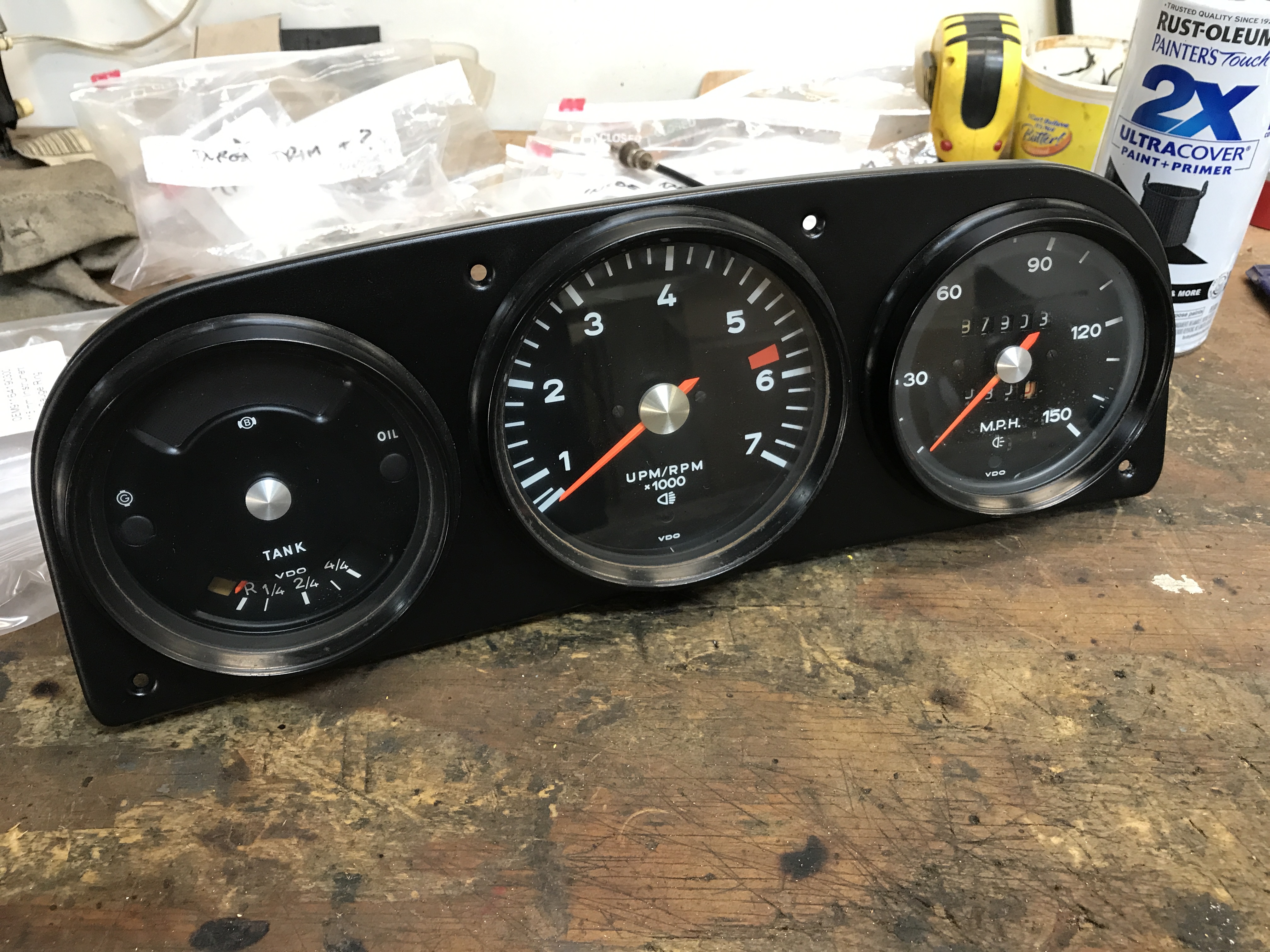

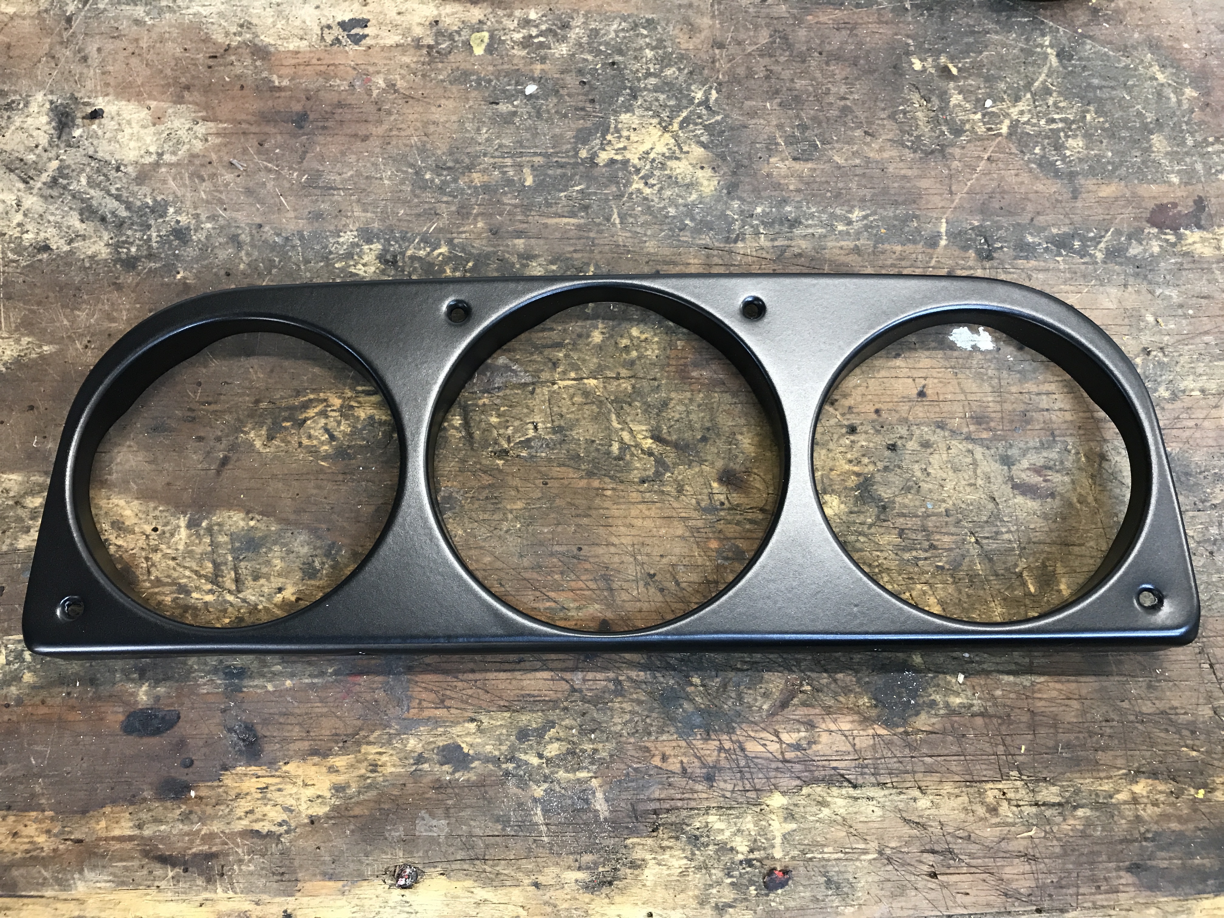

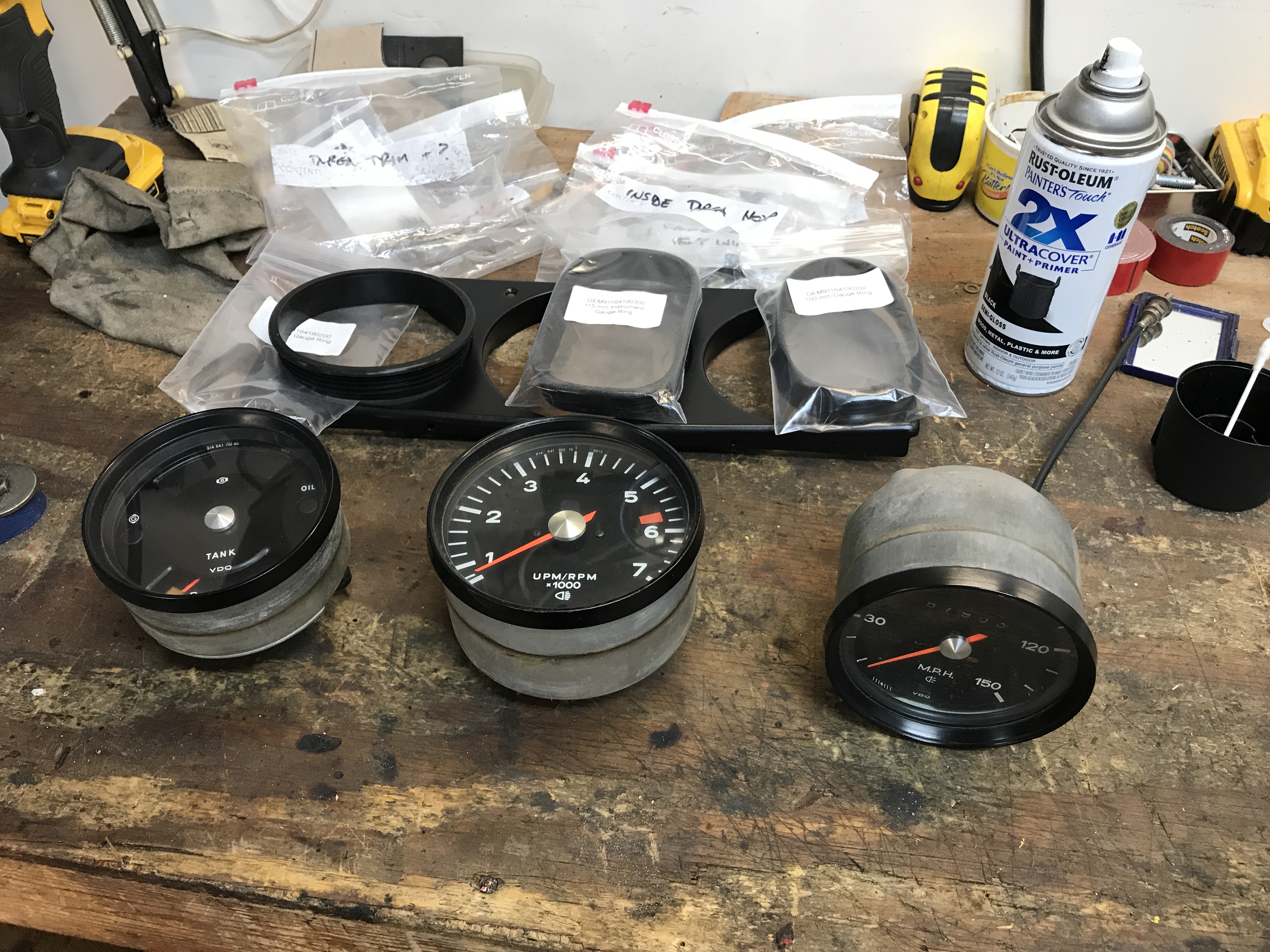

Next up: installing the gauges and connecting the last bits of wiring harness. Here is the gauge panel, with satin black powder coating.
bkrantz
post Apr 9 2021, 07:33 PM
Post #2548
Posts: 8,531
Joined: 3-August 19
From: SW Colorado
Member No.: 23,343
Here are the gauges I cleaned up months ago, and new ring gaskets.

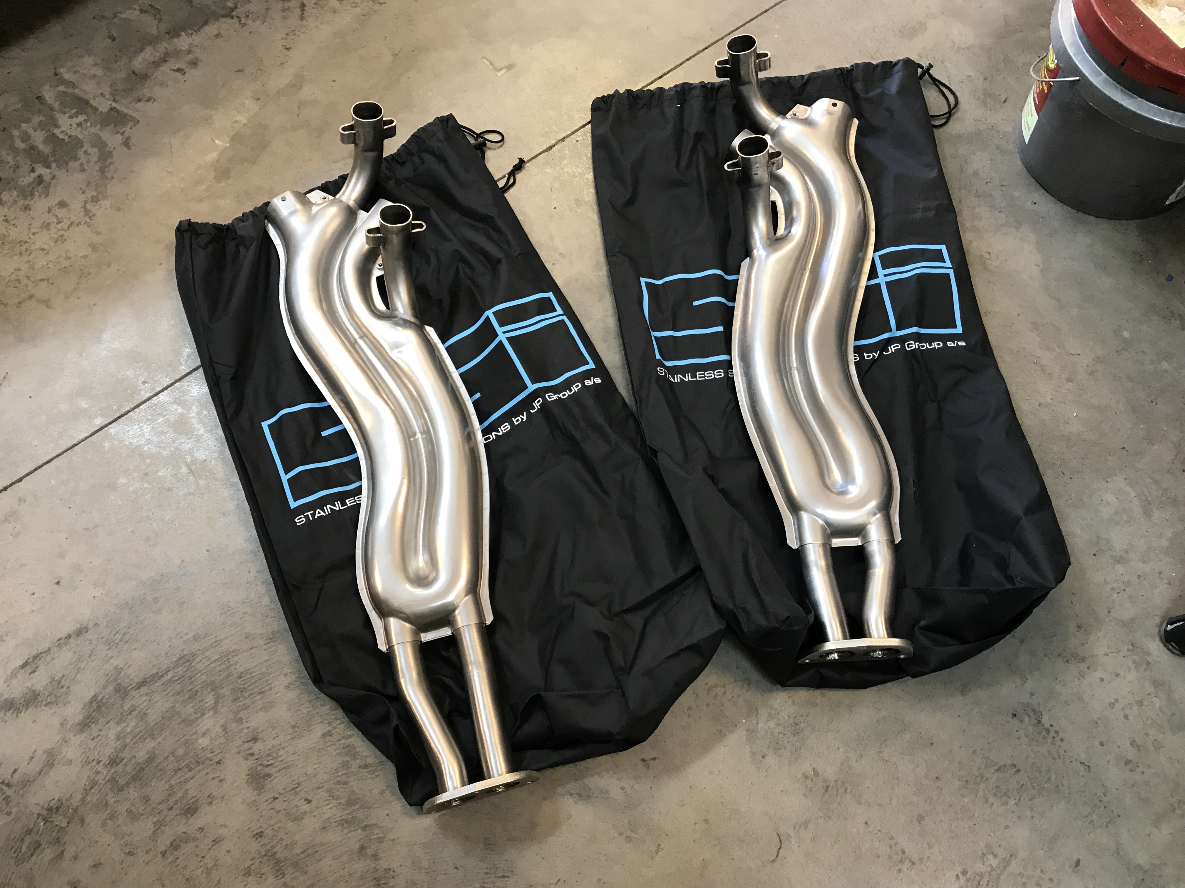

With shiny new SS heat exchangers, each in its own fancy bag.
raynekat
post Apr 9 2021, 08:47 PM
Post #2552
Posts: 2,170
Joined: 30-December 14
From: Coeur d'Alene, Idaho
Member No.: 18,263
Those bags make great pillow cases. You and what wifey will love them.

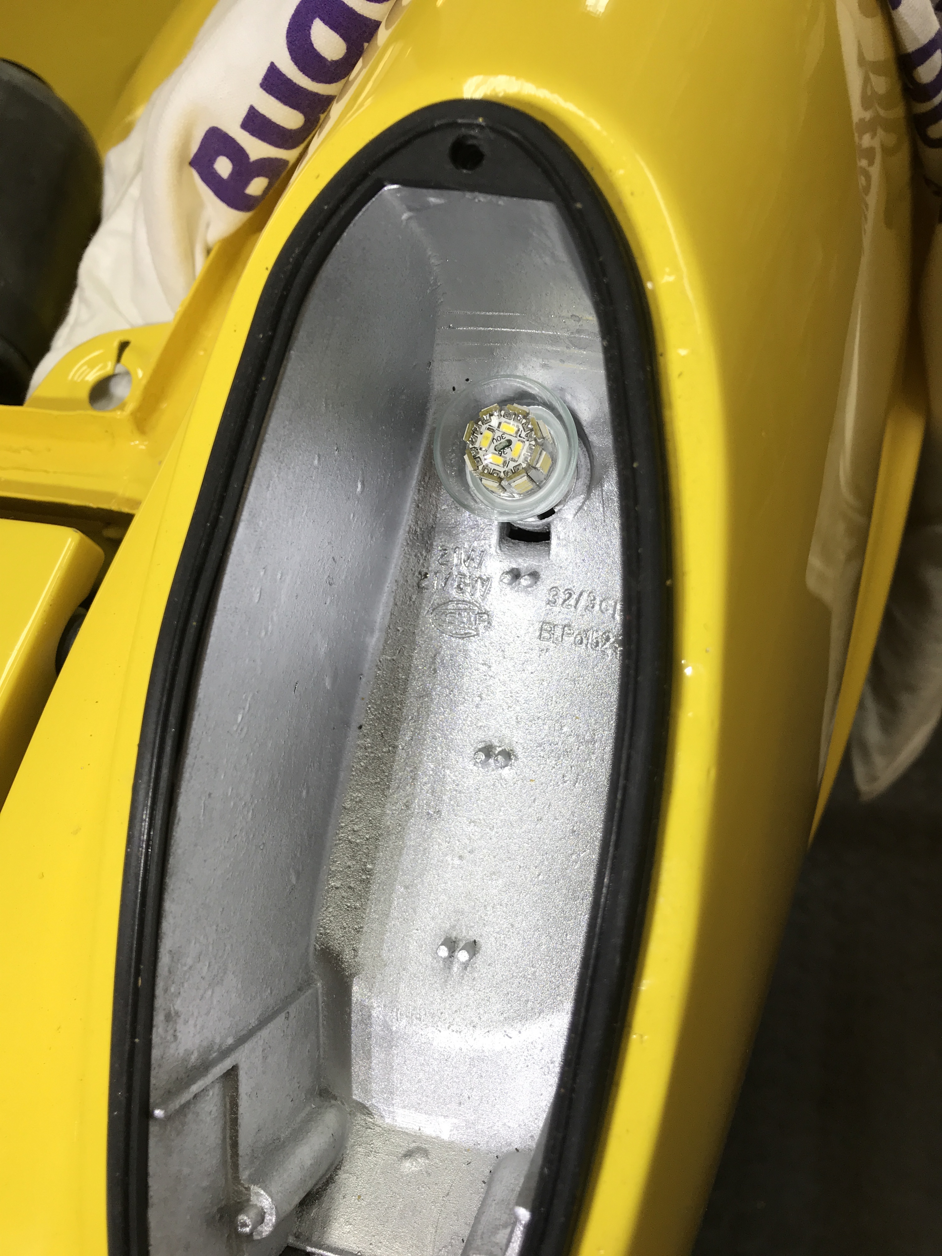

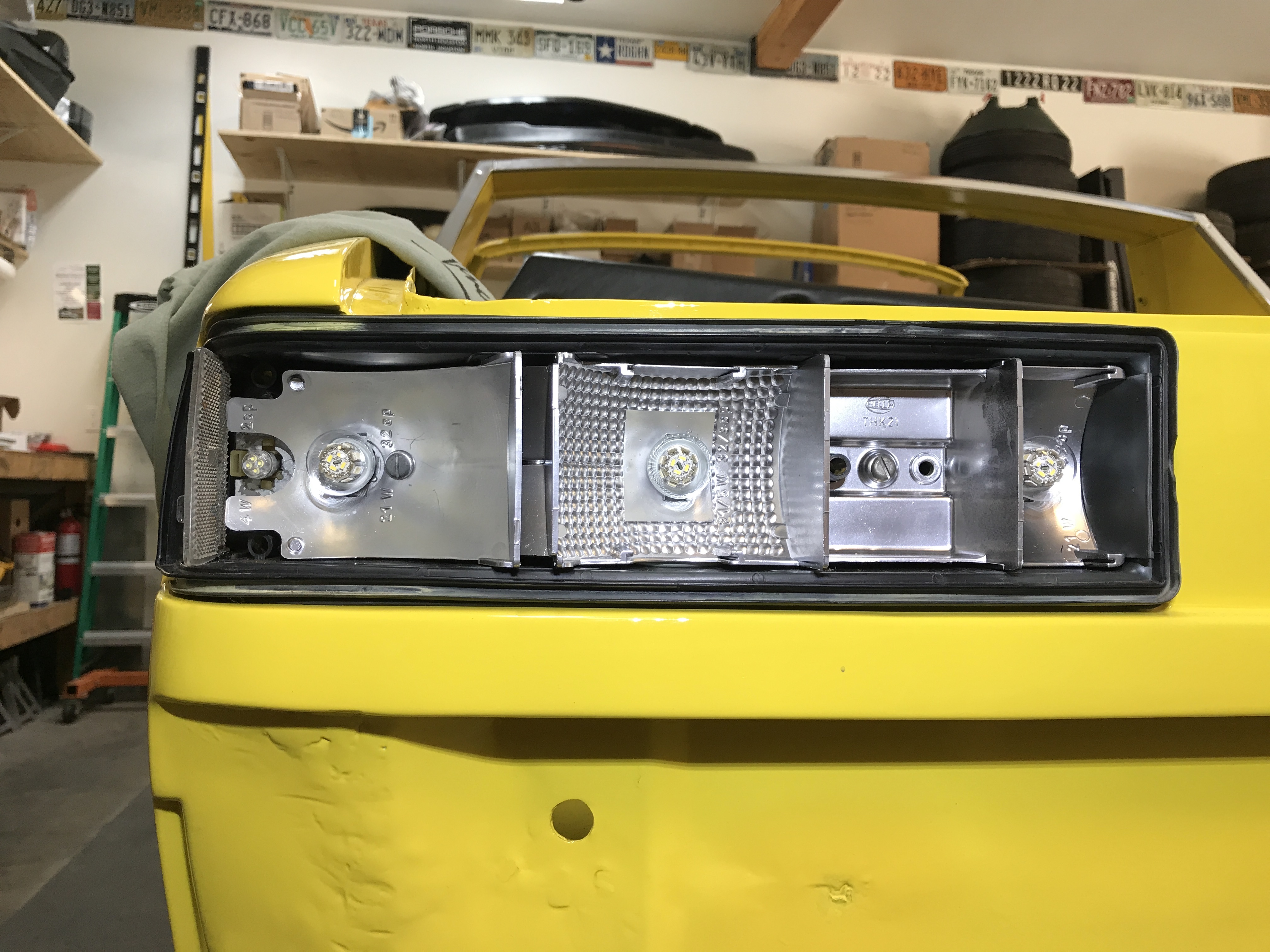

More new stuff: LED light bulbs. I plan to replace all possible original bulbs. I did order the wrong bulbs for the instruments, so have to try again (and wait).
bkrantz
post Apr 10 2021, 07:49 PM
Post #2556
Posts: 8,531
Joined: 3-August 19
From: SW Colorado
Member No.: 23,343
1157 equivalent in the front indicators.
bkrantz
post Apr 10 2021, 07:50 PM
Post #2557
Posts: 8,531
Joined: 3-August 19
From: SW Colorado
Member No.: 23,343
1156, 1157, and 3893 equivalents in the rear lights.

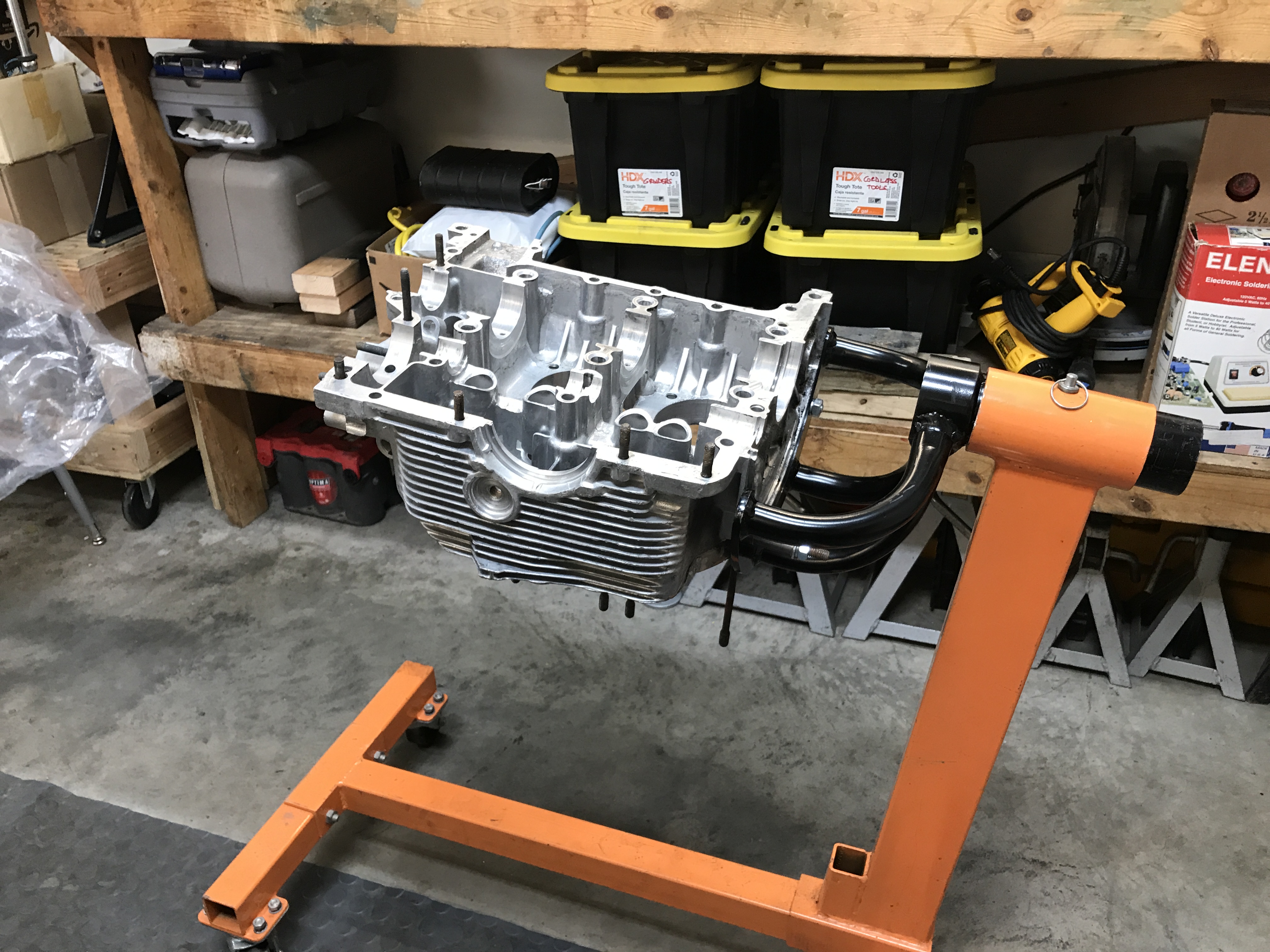

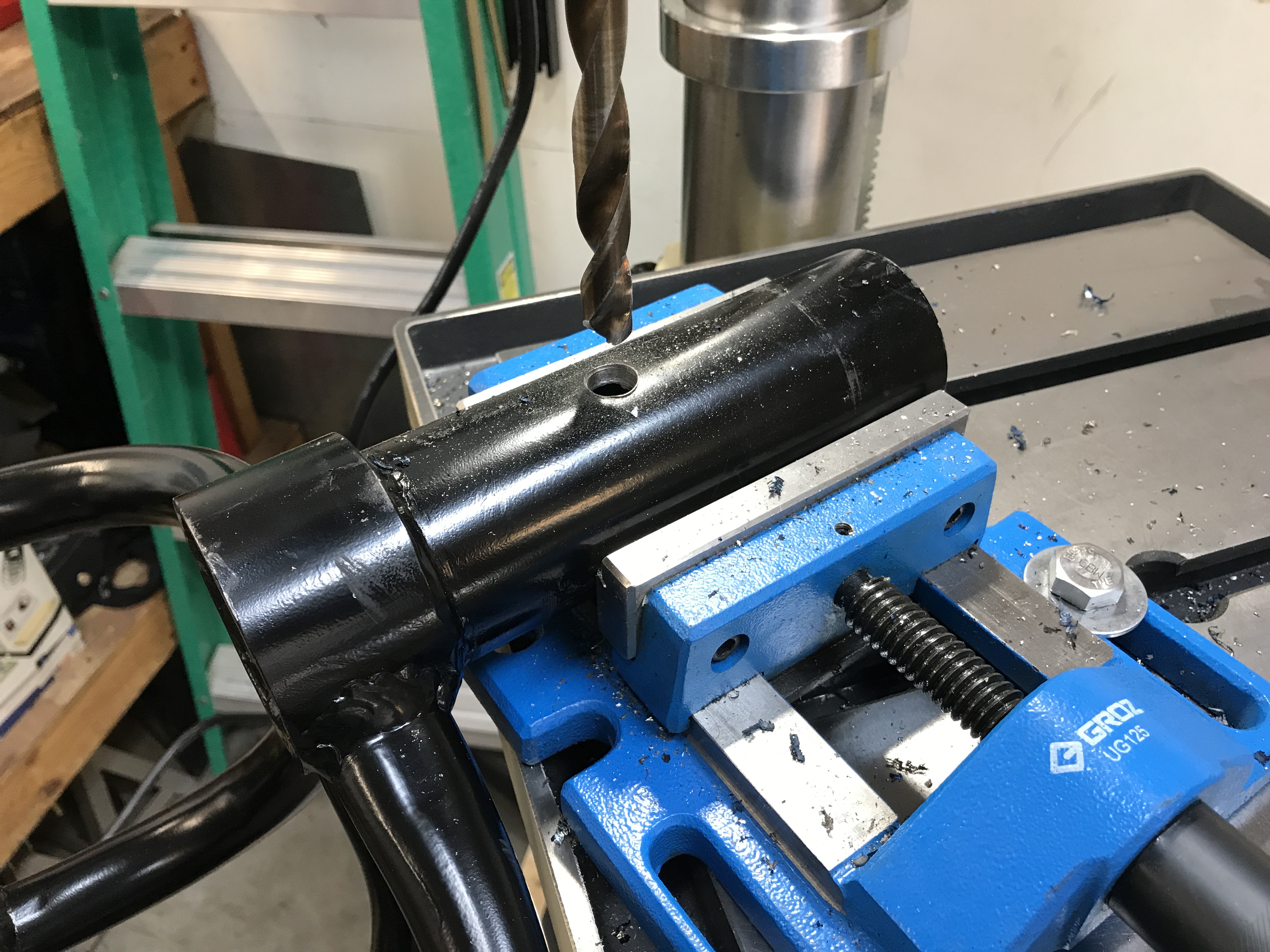

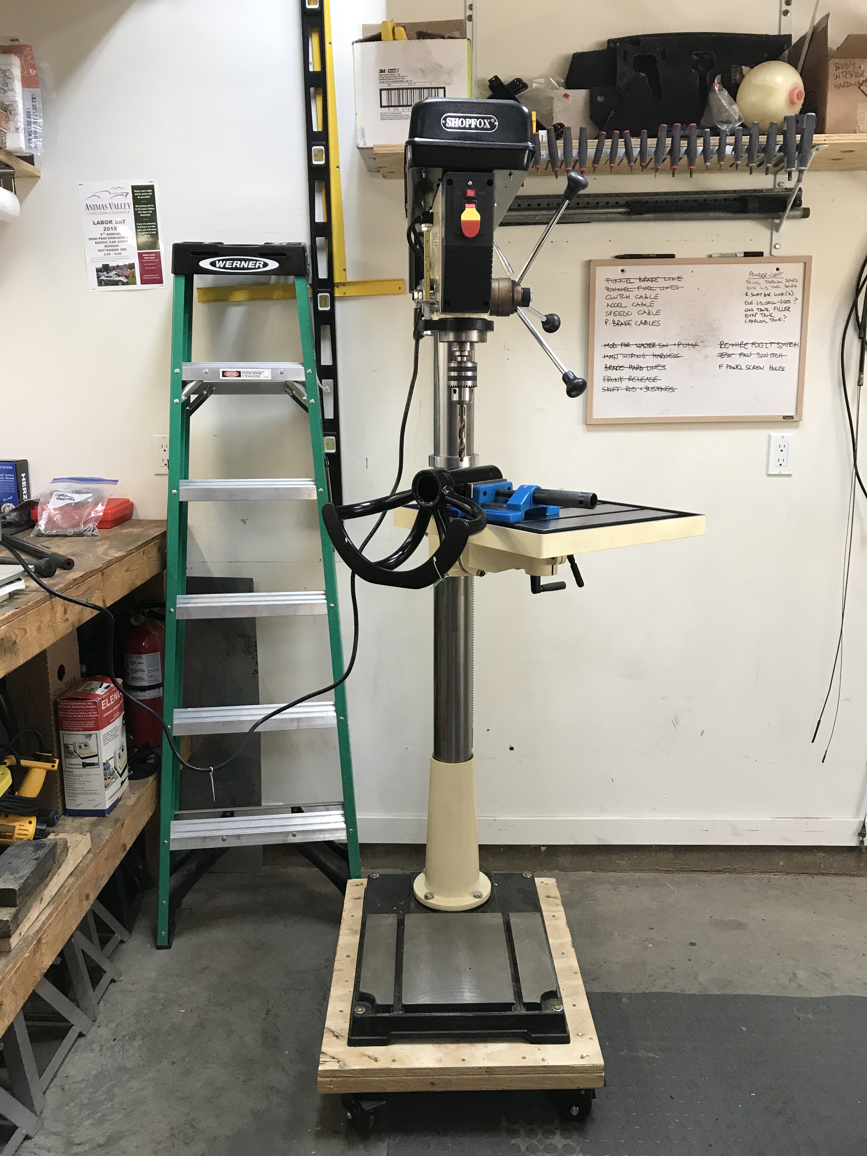

Time to get going on the motor. First, I needed holes in my new Type 4 yoke. A good job for my big drill press.
bkrantz
post Apr 10 2021, 07:55 PM
Post #2559
Posts: 8,531
Joined: 3-August 19
From: SW Colorado
Member No.: 23,343
This is the heftiest job I have tried so far with the press--not any problem at all.
bkrantz
post Apr 10 2021, 07:57 PM
Post #2560
Posts: 8,531
Joined: 3-August 19
From: SW Colorado
Member No.: 23,343
Right case half mounted. Here we go.
