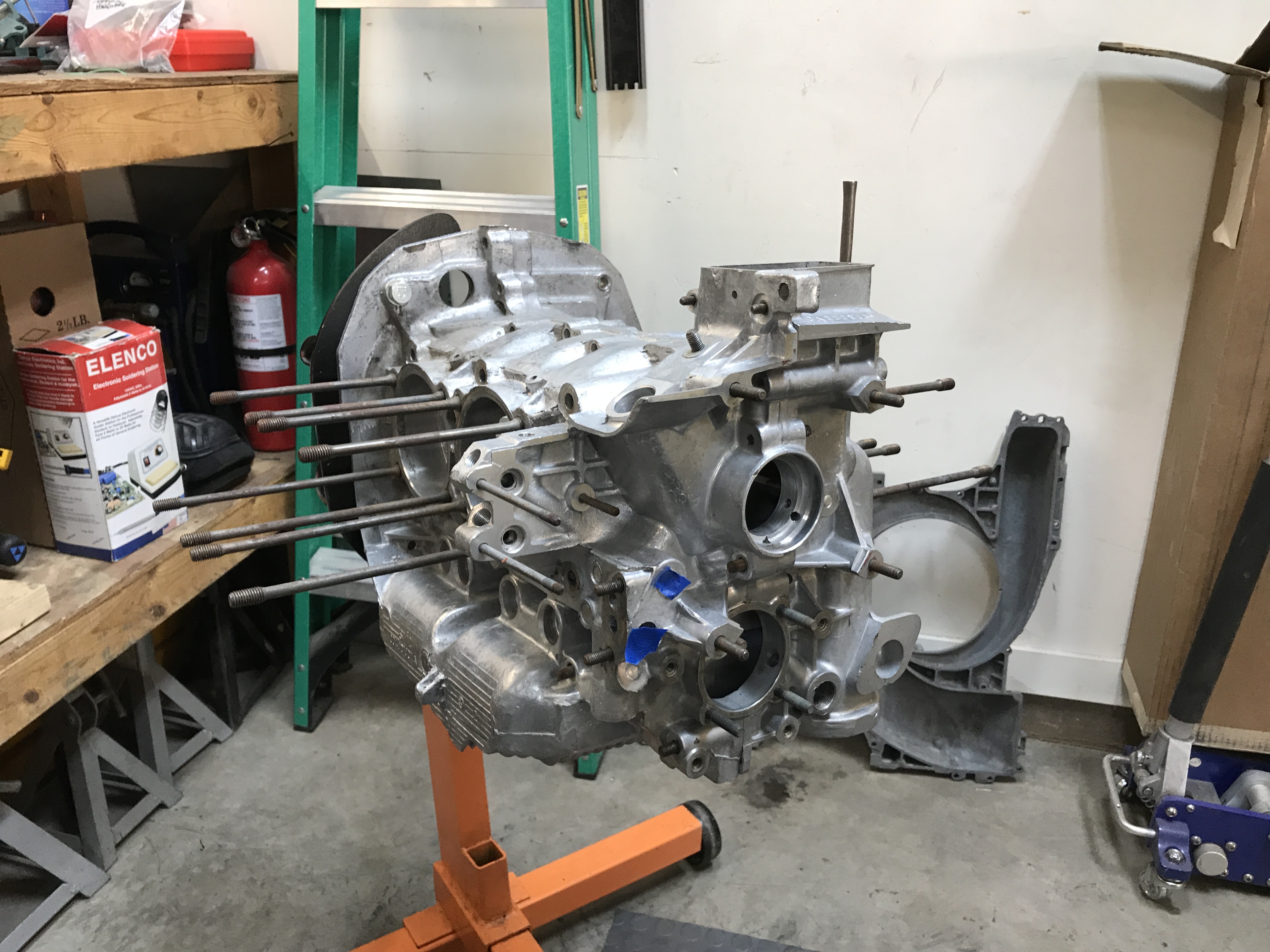

Not much 914 time today. I had some office work to do and then swapped the snow tires off my wife's car.
I did clean the left side of the case and "stuck" them together on the stand.
bkrantz
post Apr 11 2021, 06:57 PM
Post #2566
Posts: 8,531
Joined: 3-August 19
From: SW Colorado
Member No.: 23,343

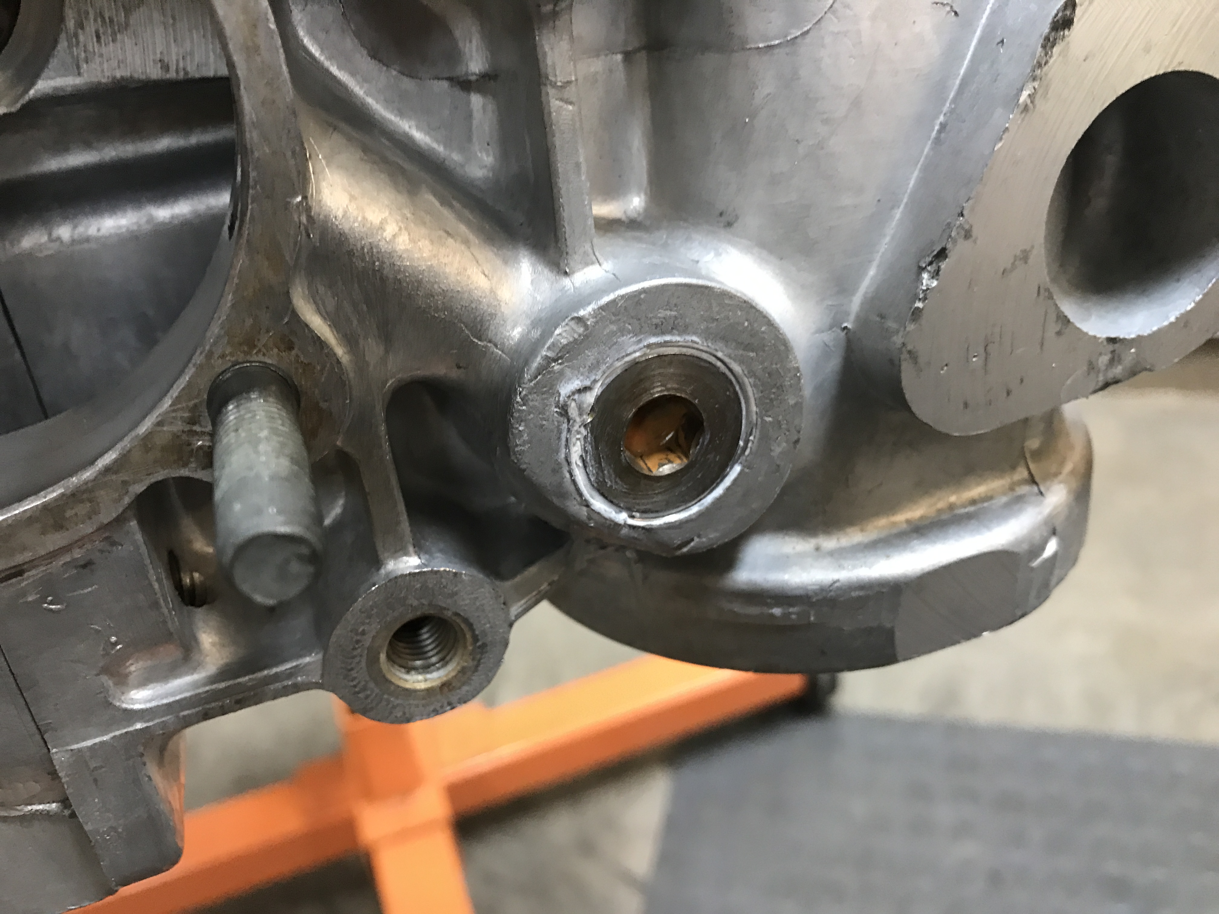

I did remove the stock plug on the front left side, to make sure this gets sealed with the other new plugs.

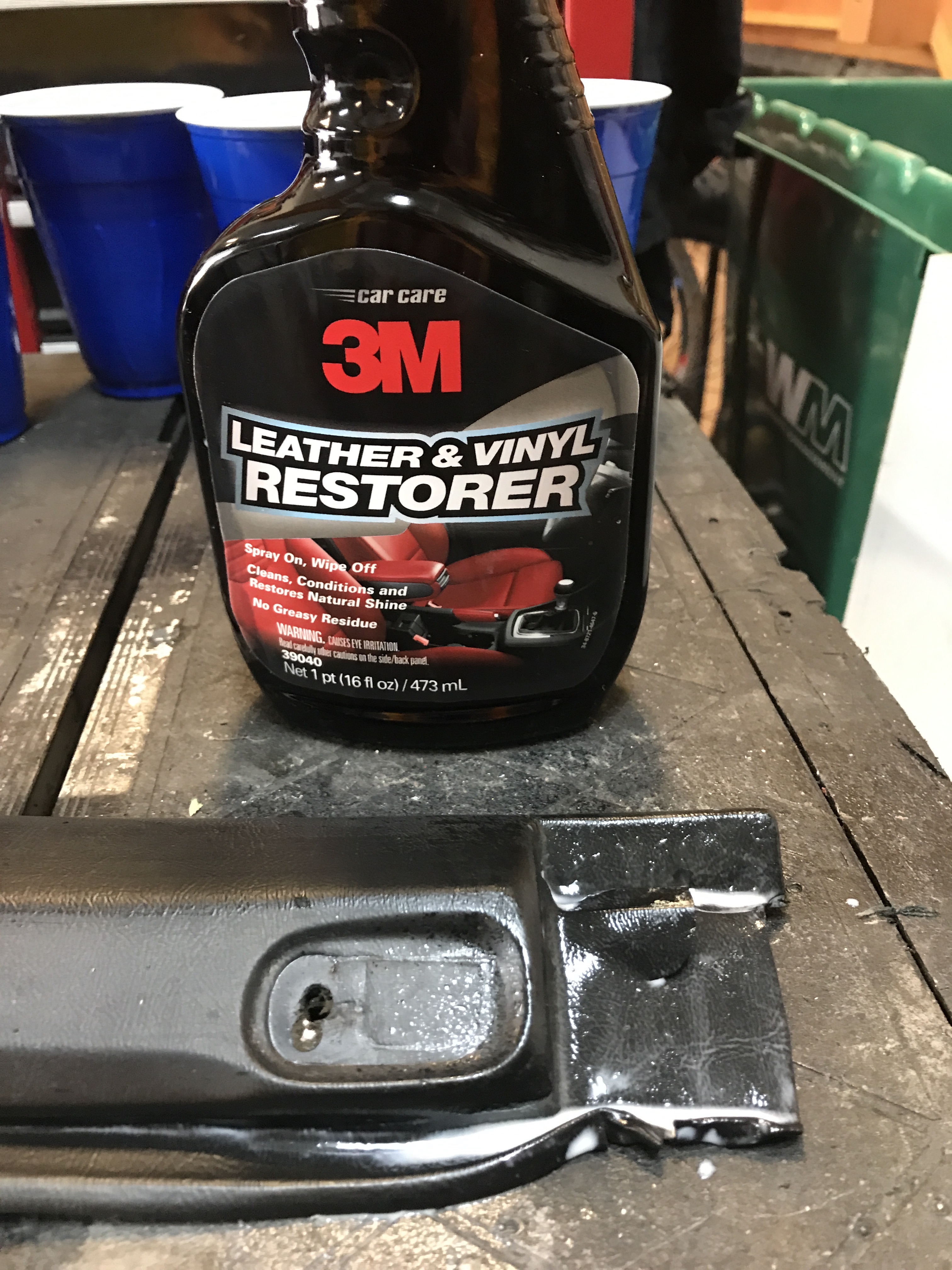

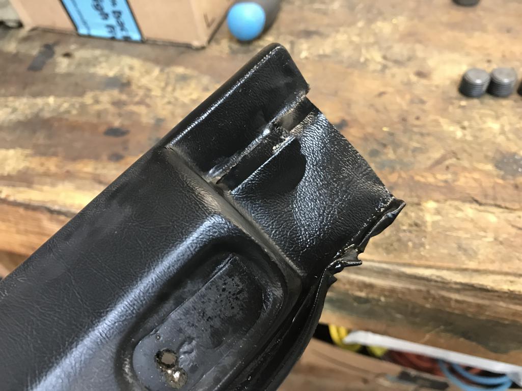

I started an experiment with restoring interior trim vinyl. I plan to apply various amounts of different materials, starting with commercial vinyl treatments. The first to arrive was 3M Leather & Vinyl Restorer.
bkrantz
post Apr 14 2021, 07:03 PM
Post #2568
Posts: 8,531
Joined: 3-August 19
From: SW Colorado
Member No.: 23,343
After a couple of applications over 24 hours--not much change in the plastic softness, just a shiny finish. I will try something else.

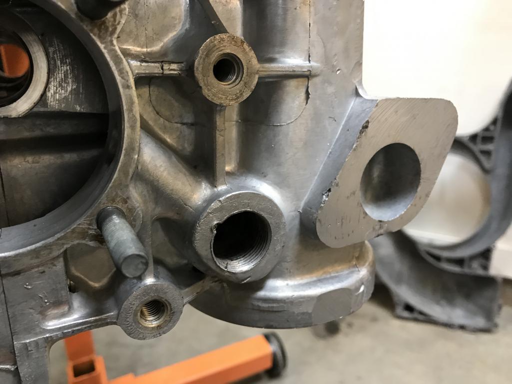

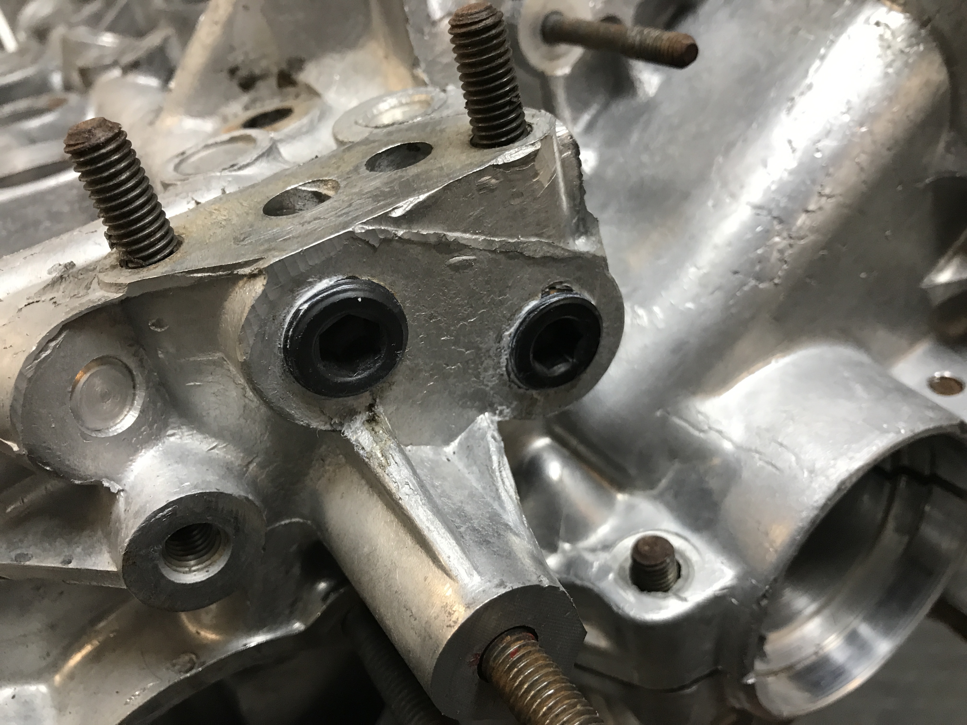

On the the engine case plugs. This is the stock plug for the front left.
bkrantz
post Apr 14 2021, 07:05 PM
Post #2570
Posts: 8,531
Joined: 3-August 19
From: SW Colorado
Member No.: 23,343
Installed.

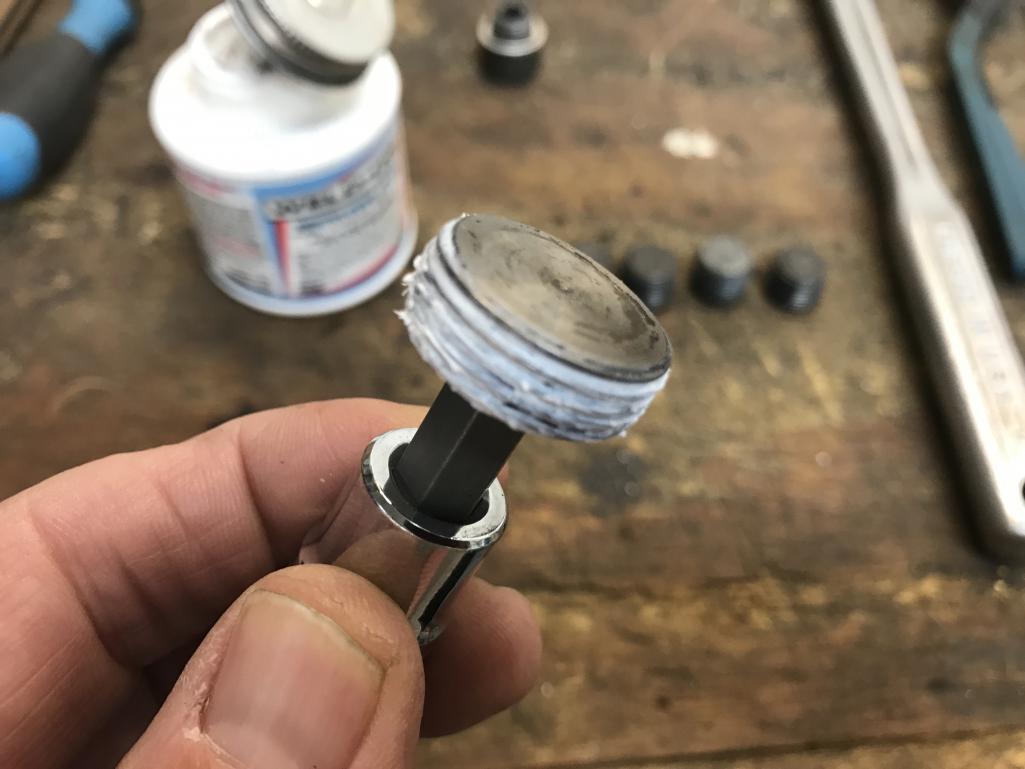

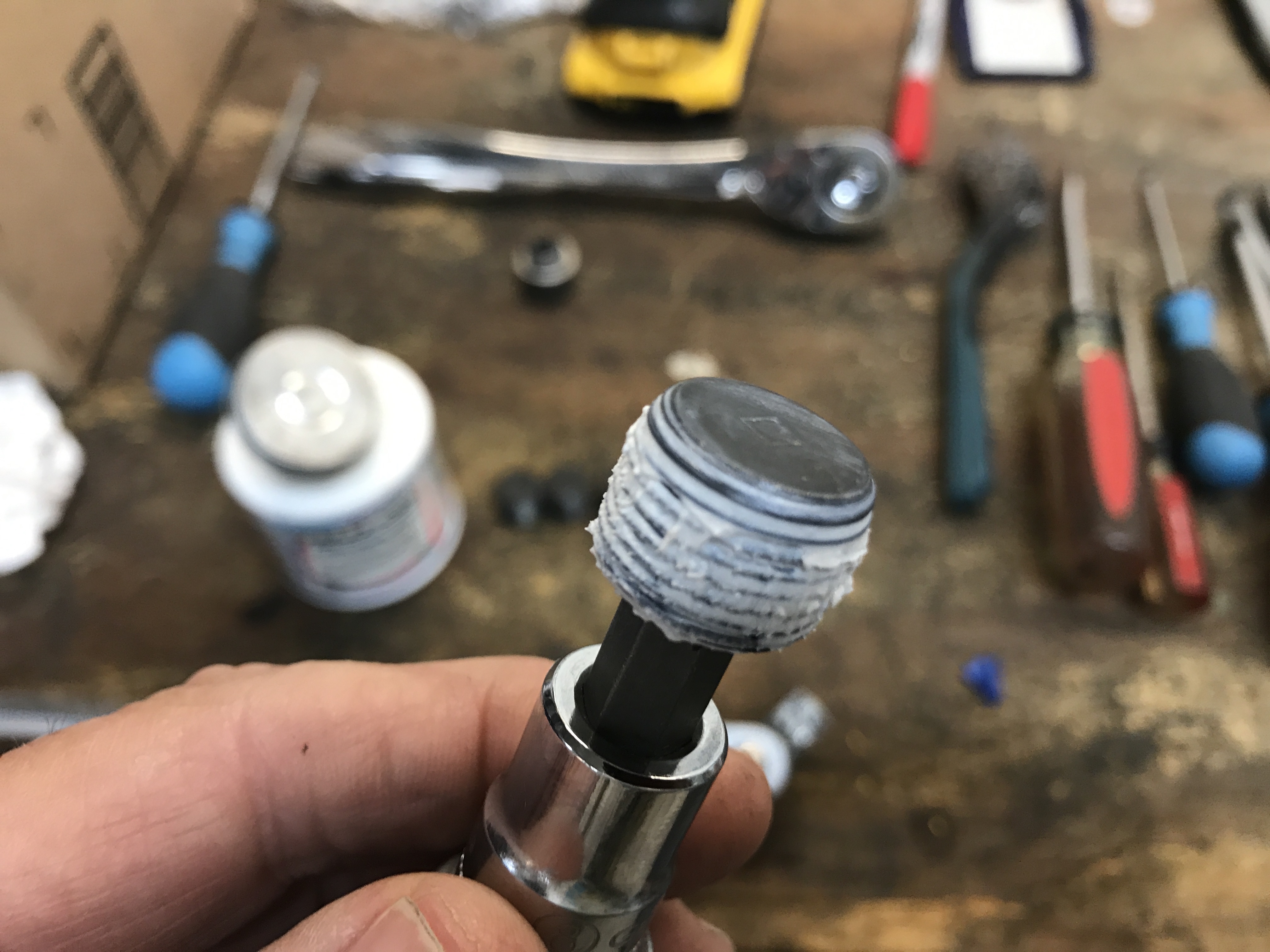

One of the new plugs with sealant.
bkrantz
post Apr 14 2021, 07:07 PM
Post #2572
Posts: 8,531
Joined: 3-August 19
From: SW Colorado
Member No.: 23,343

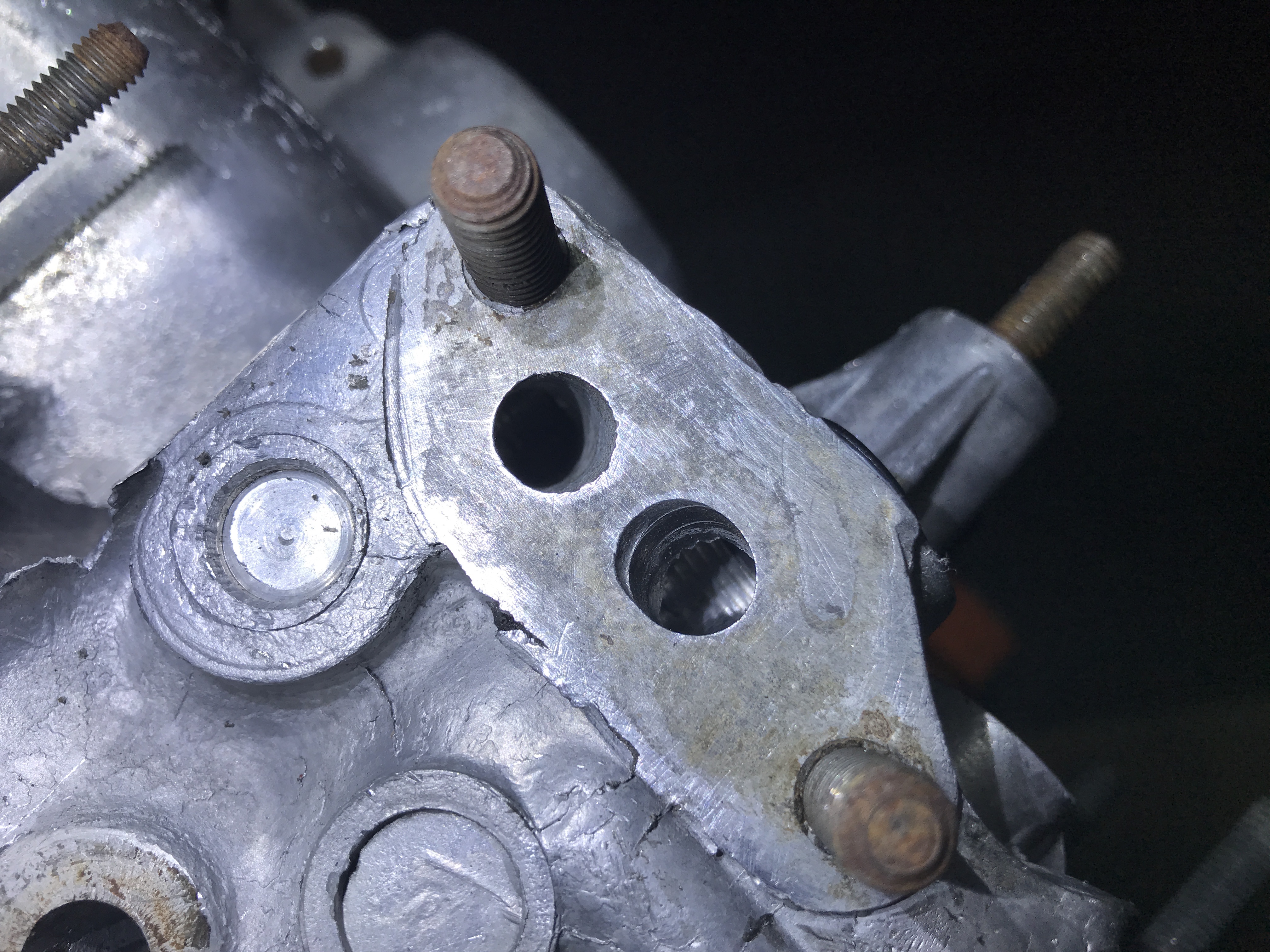

Two plugs installed on the front right.
bkrantz
post Apr 14 2021, 07:08 PM
Post #2573
Posts: 8,531
Joined: 3-August 19
From: SW Colorado
Member No.: 23,343

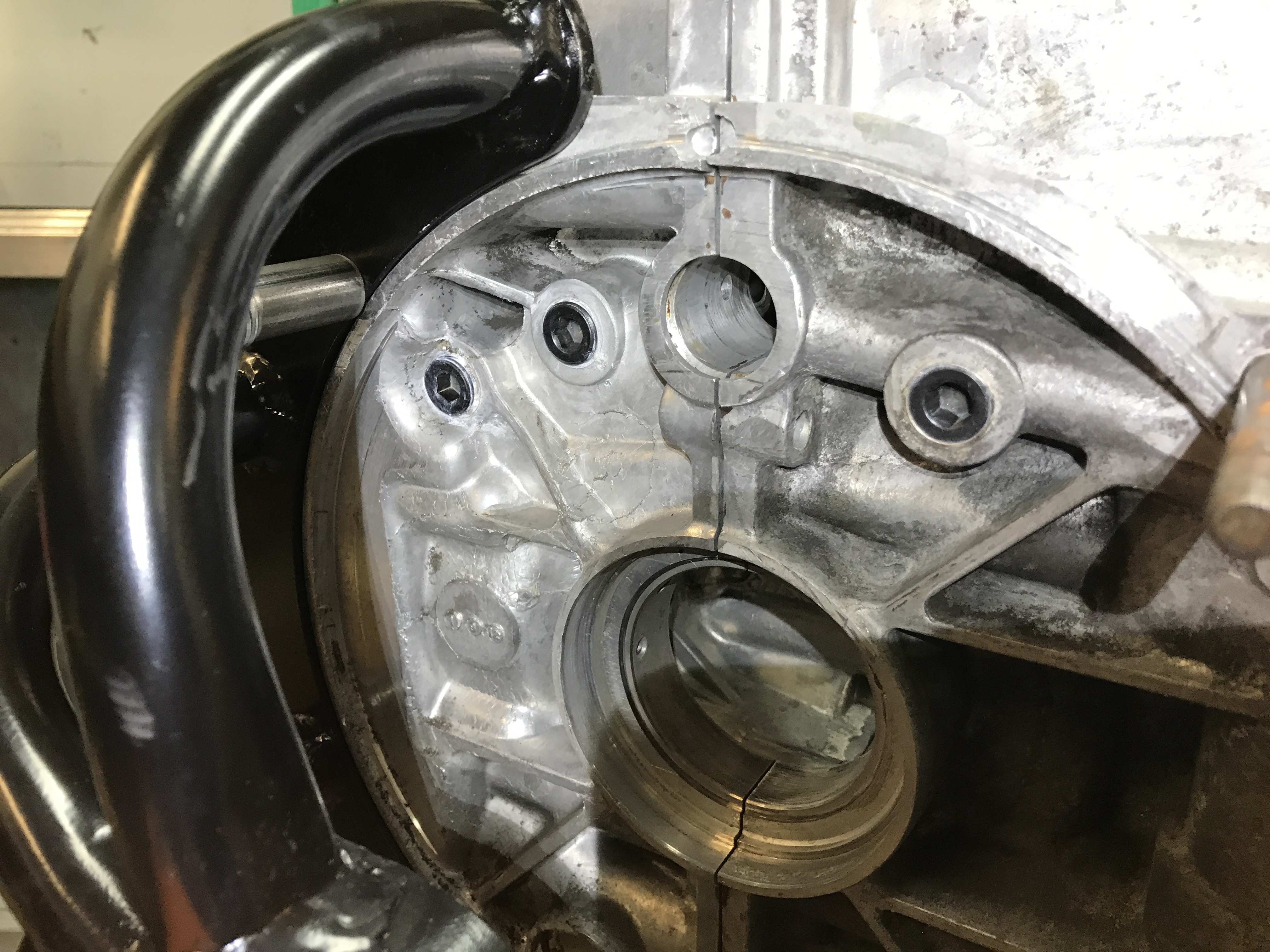

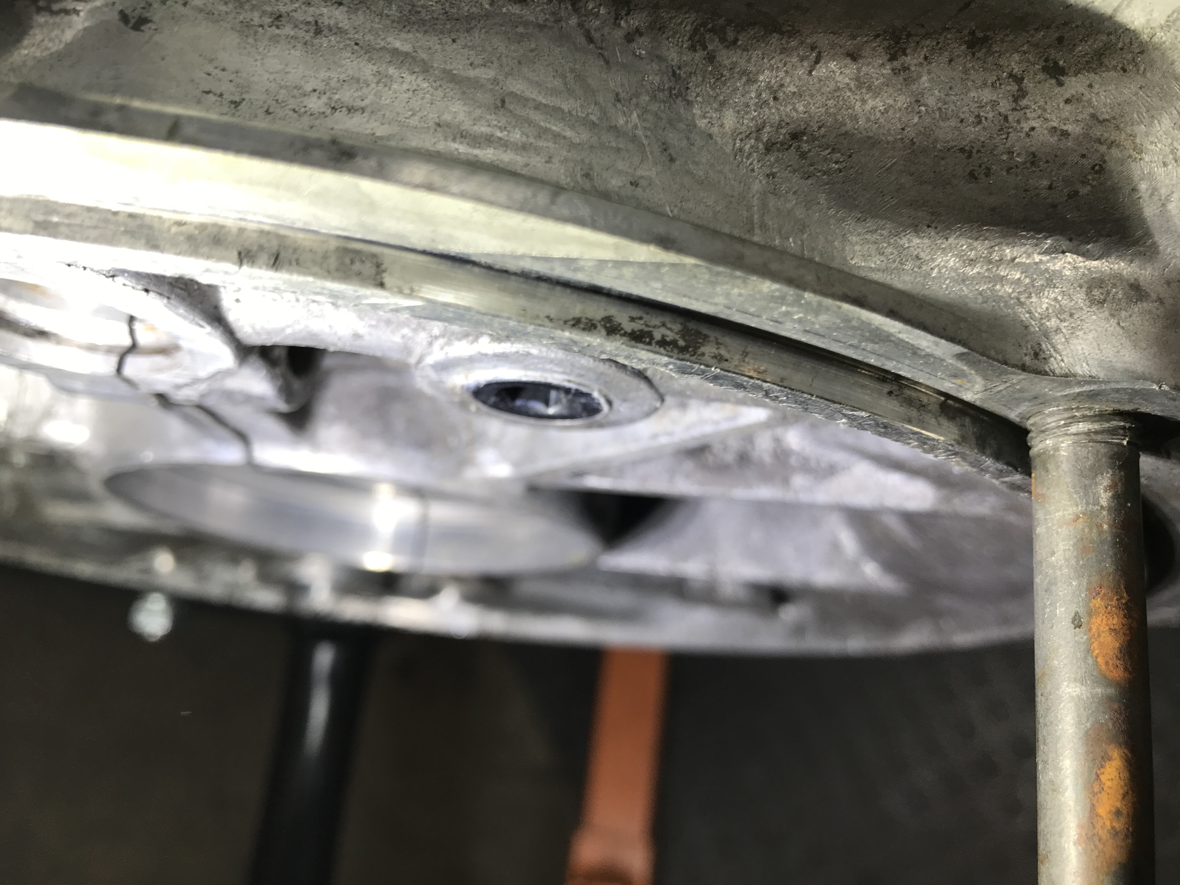

Confirmed that the plugs do not block the internal galleries.
bkrantz
post Apr 14 2021, 07:09 PM
Post #2574
Posts: 8,531
Joined: 3-August 19
From: SW Colorado
Member No.: 23,343
Three plugs on the rear.

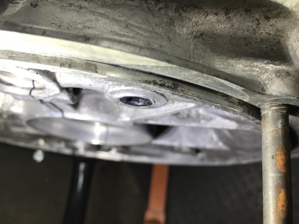

Made sure the plug on the right side is flush with the casting surface, so no interference with the flywheel.

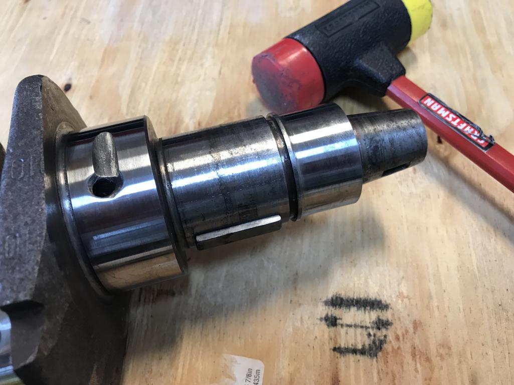

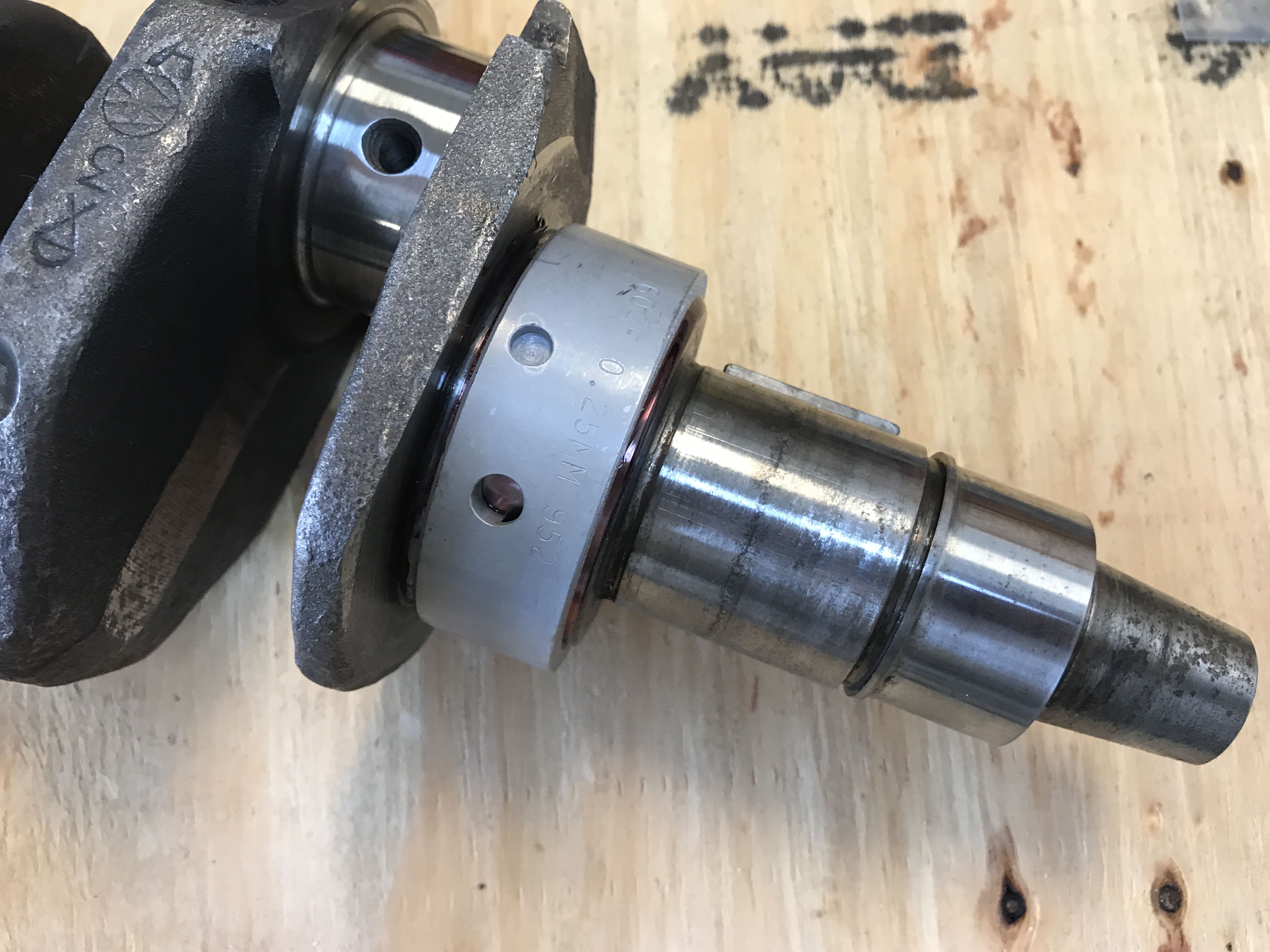

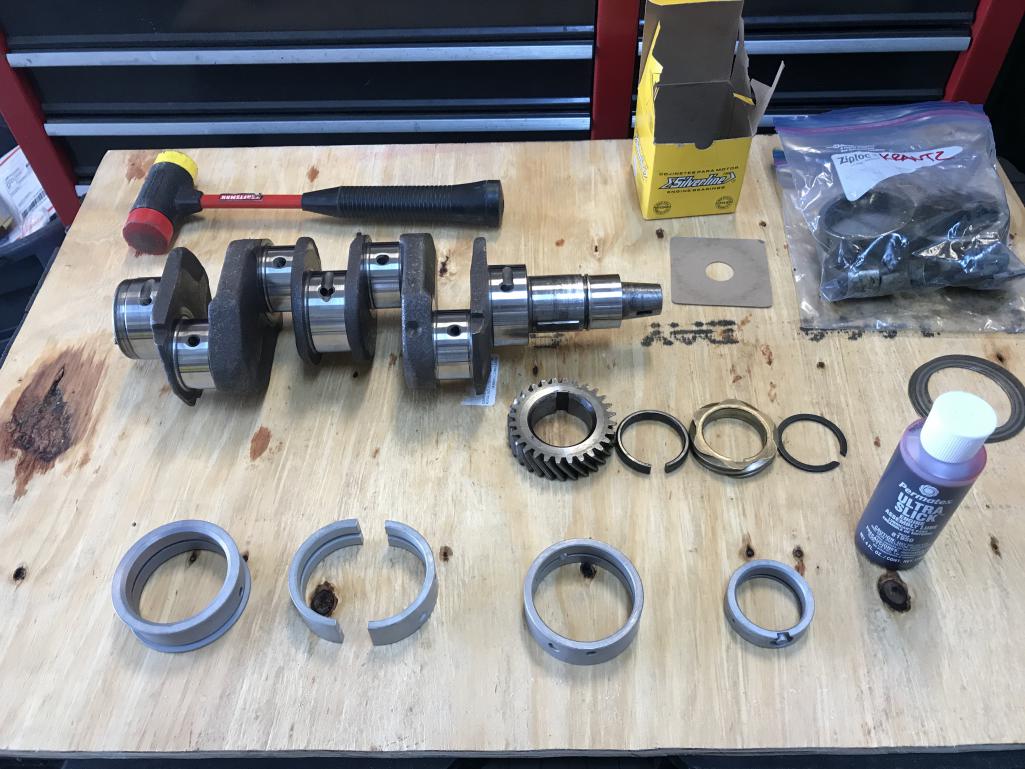

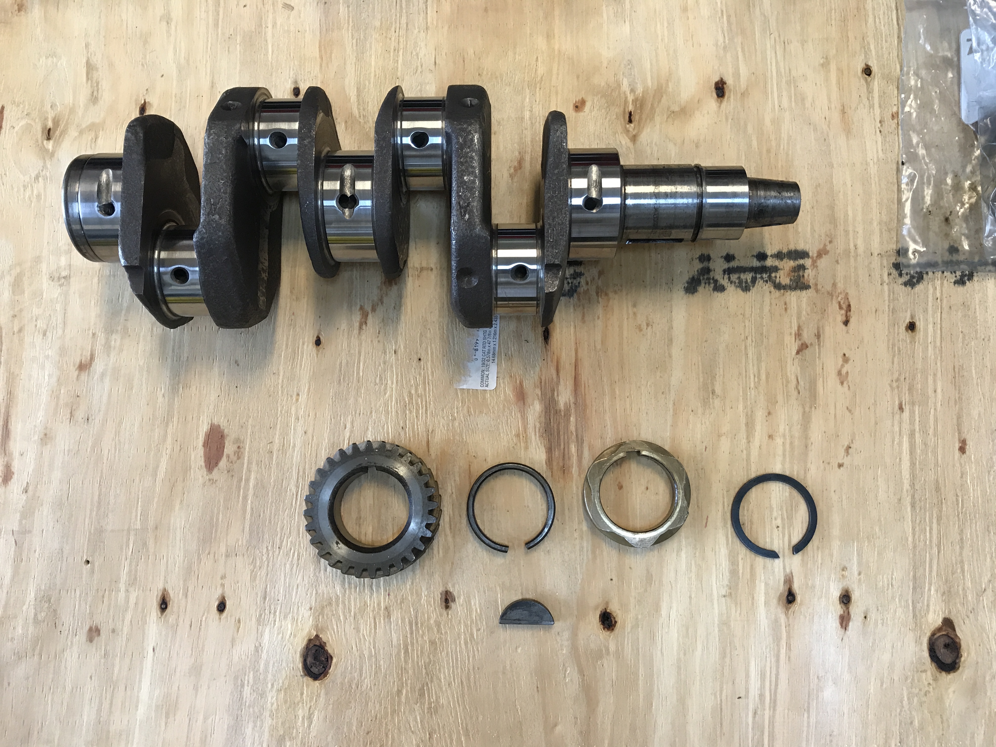

Time to start engine assembly. Here's the polished crank plus the components for the front end.
bkrantz
post Apr 14 2021, 07:13 PM
Post #2577
Posts: 8,531
Joined: 3-August 19
From: SW Colorado
Member No.: 23,343
Woodruff key installed.

I broke open the new main bearing set.
bkrantz
post Apr 14 2021, 07:15 PM
Post #2579
Posts: 8,531
Joined: 3-August 19
From: SW Colorado
Member No.: 23,343

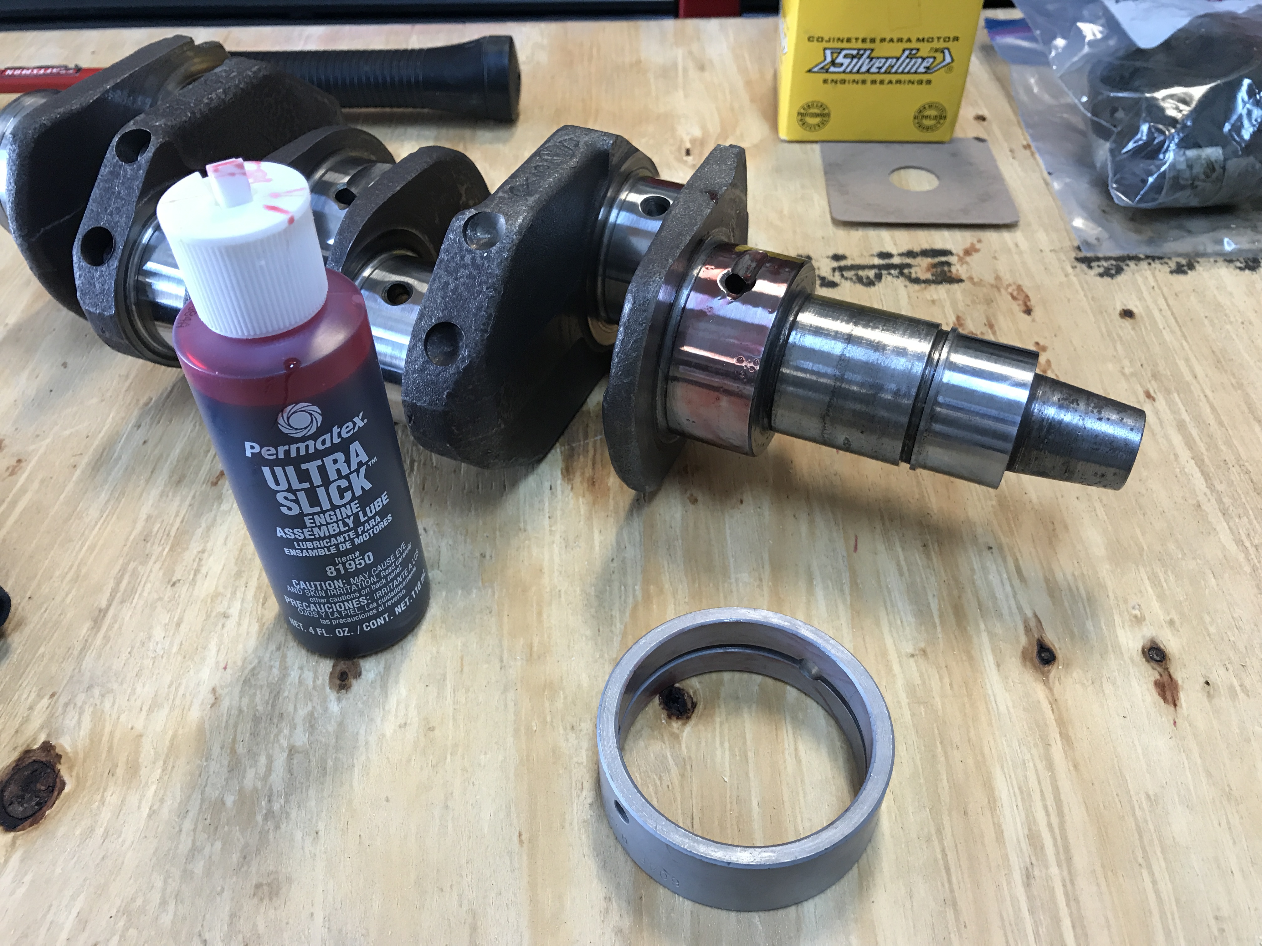

First squirt of assembly lube on bearing #3.
