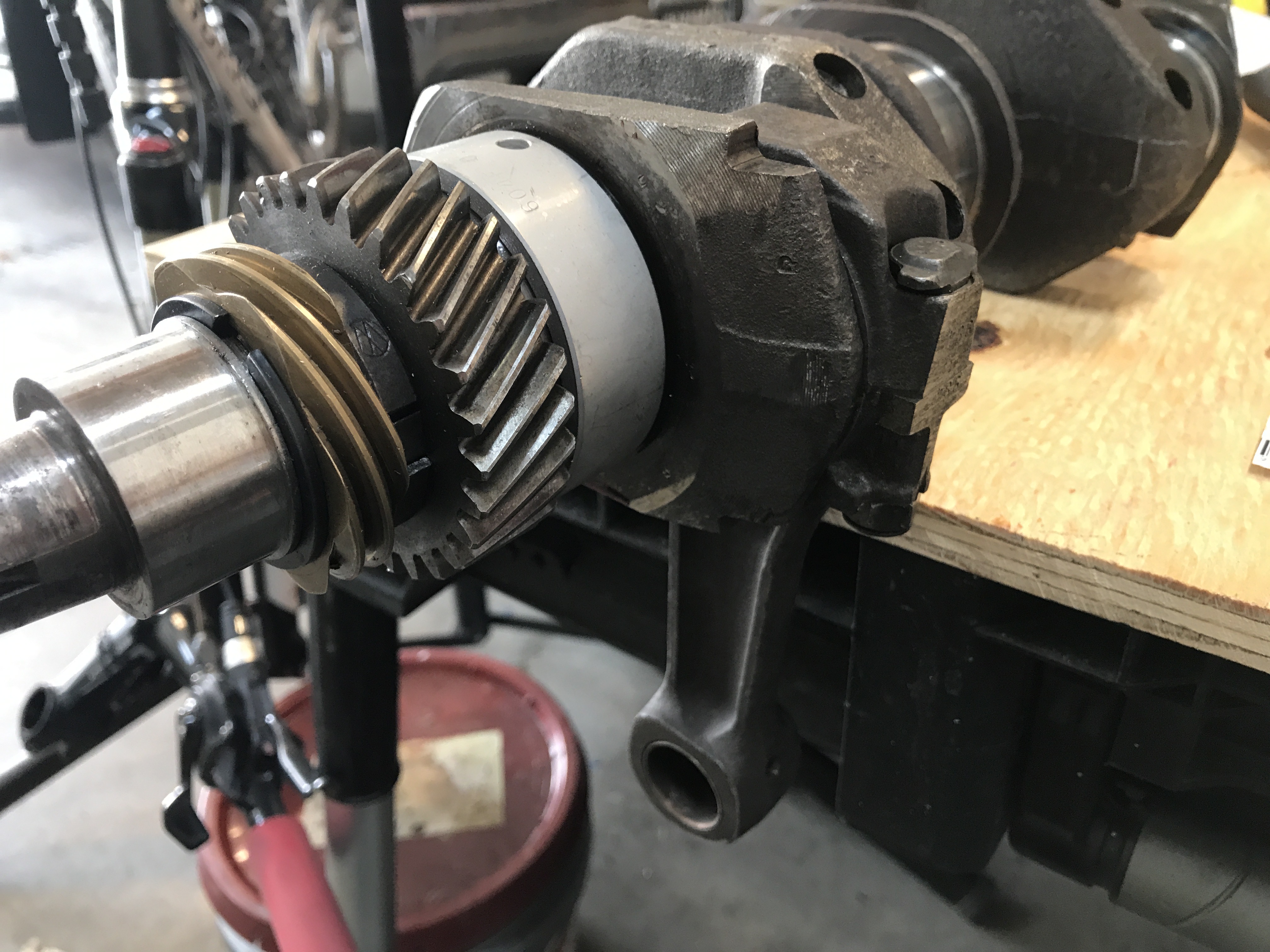

After heating, both gears and the intervening spacer went on easily.

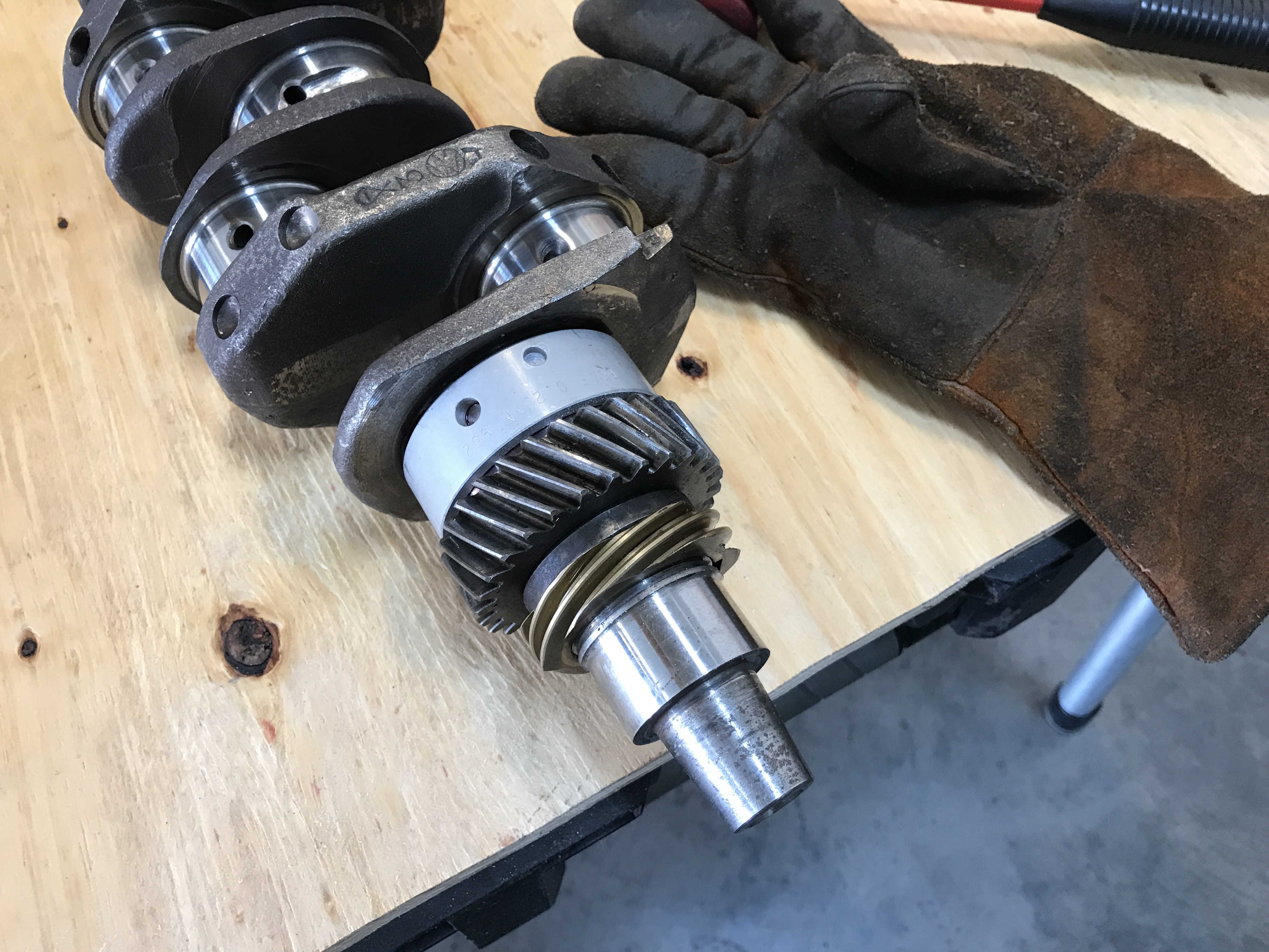

And then the circlip--front of the crank done.

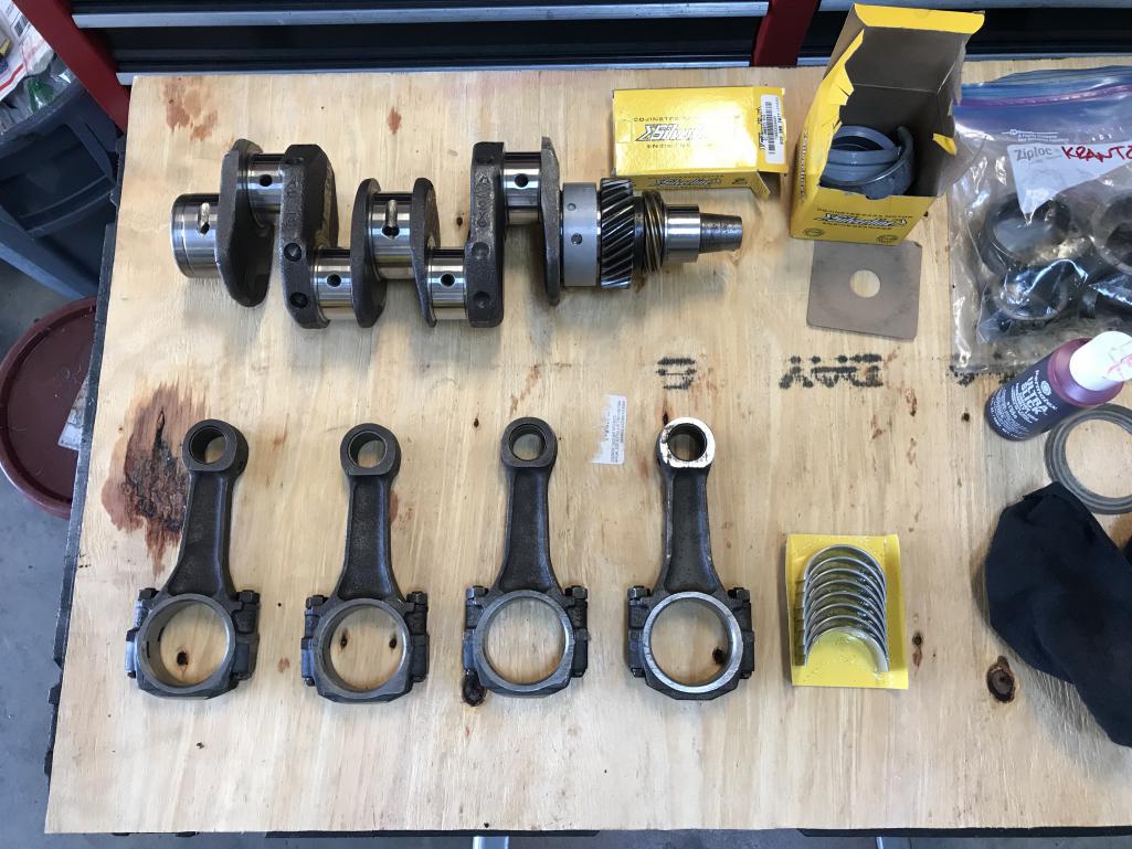

I then got the rods out. Bearing clearance check coming soon.

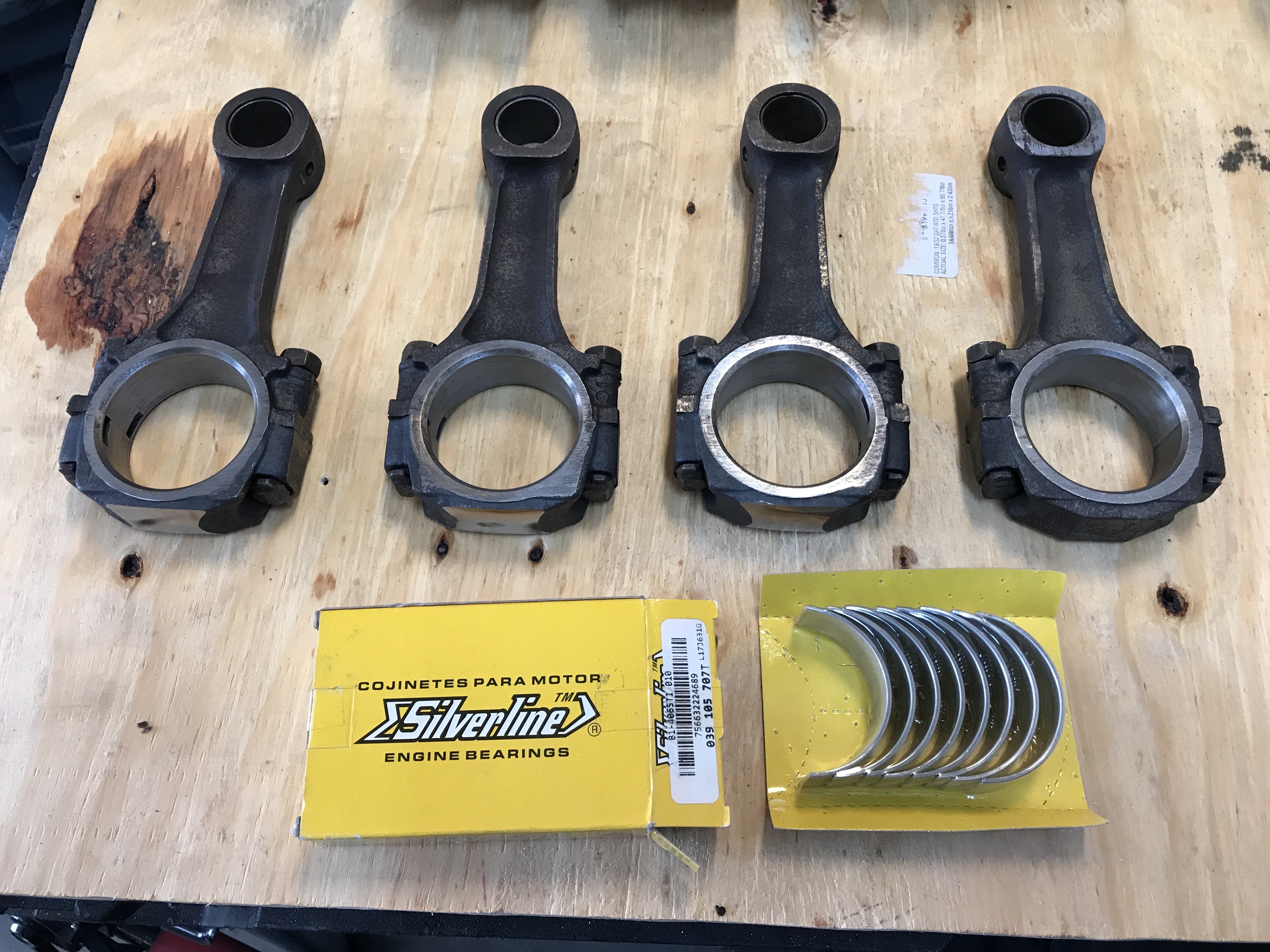

Back again--and back on engine work.
Today I started checking the rod bearings. These are 0.25mm under-sized, since the crank had a previous grind done. The crank was polished and the rods were checked and balanced at PE.
bkrantz
post Apr 21 2021, 08:32 PM

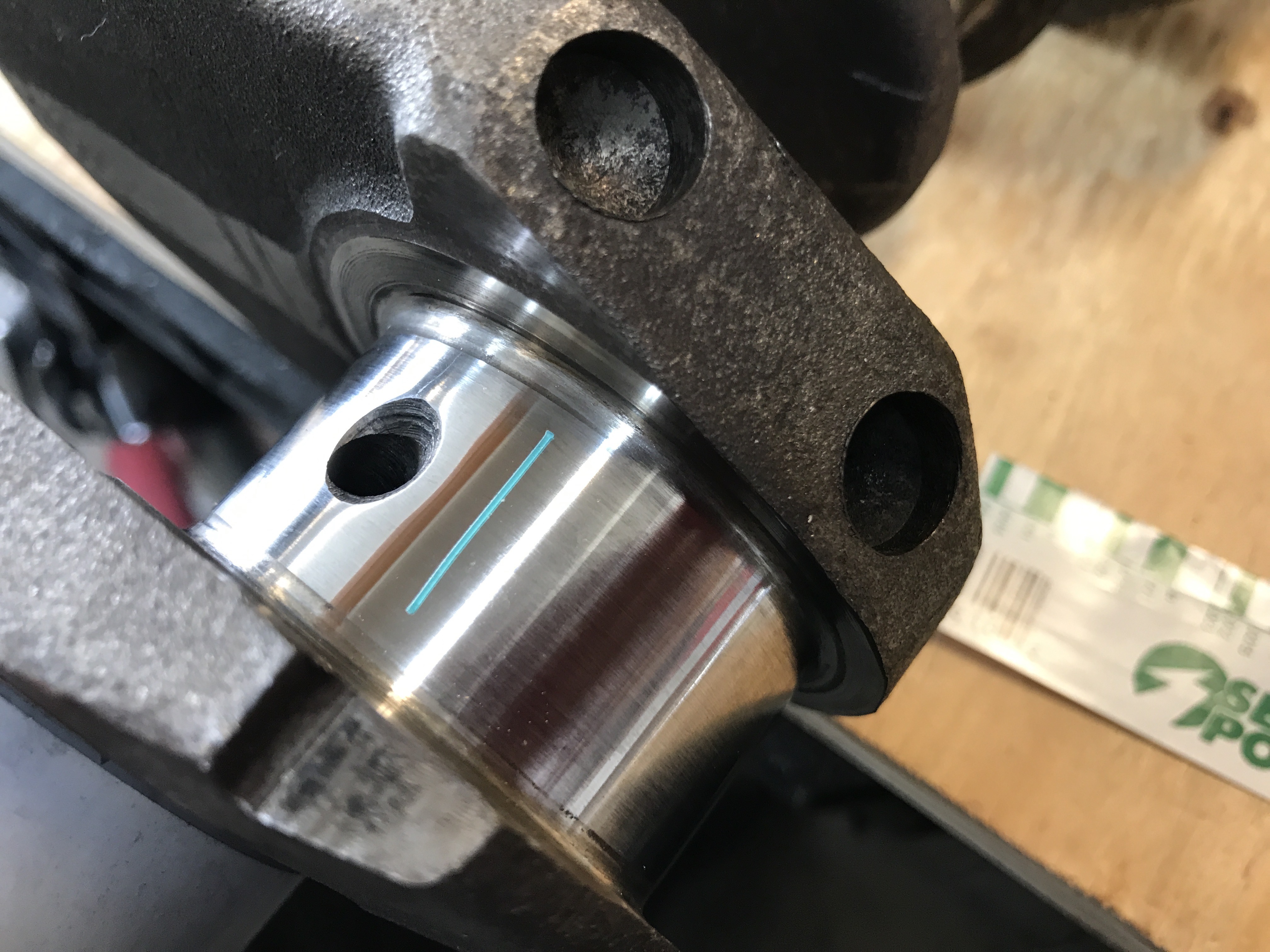

bkrantz
post Apr 21 2021, 08:34 PM
Post #2596
Posts: 8,531
Joined: 3-August 19
From: SW Colorado
Member No.: 23,343
Bearing shells in place.

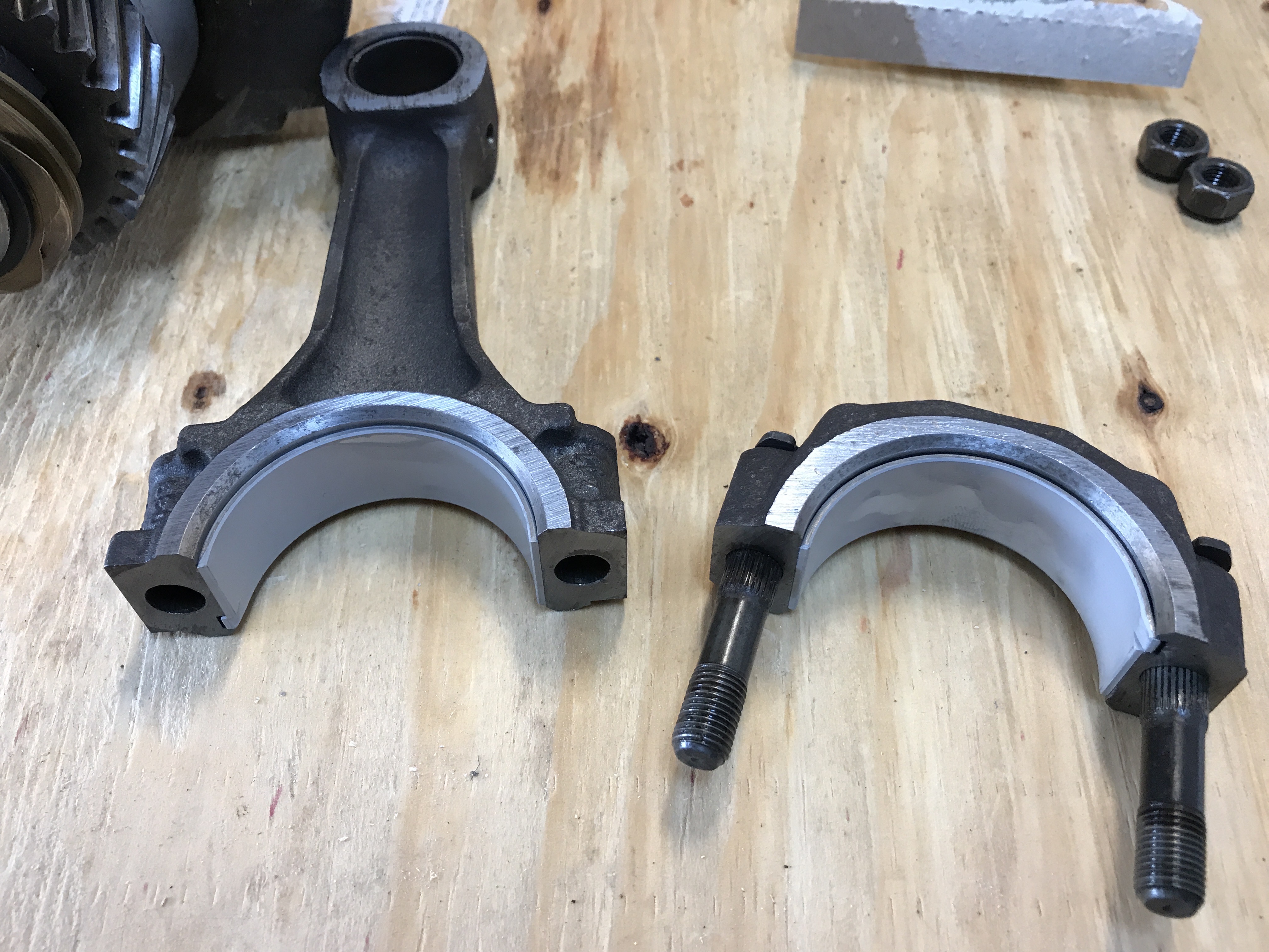

bkrantz
post Apr 21 2021, 08:35 PM
Post #2597
Posts: 8,531
Joined: 3-August 19
From: SW Colorado
Member No.: 23,343
Rod installed and torqued.

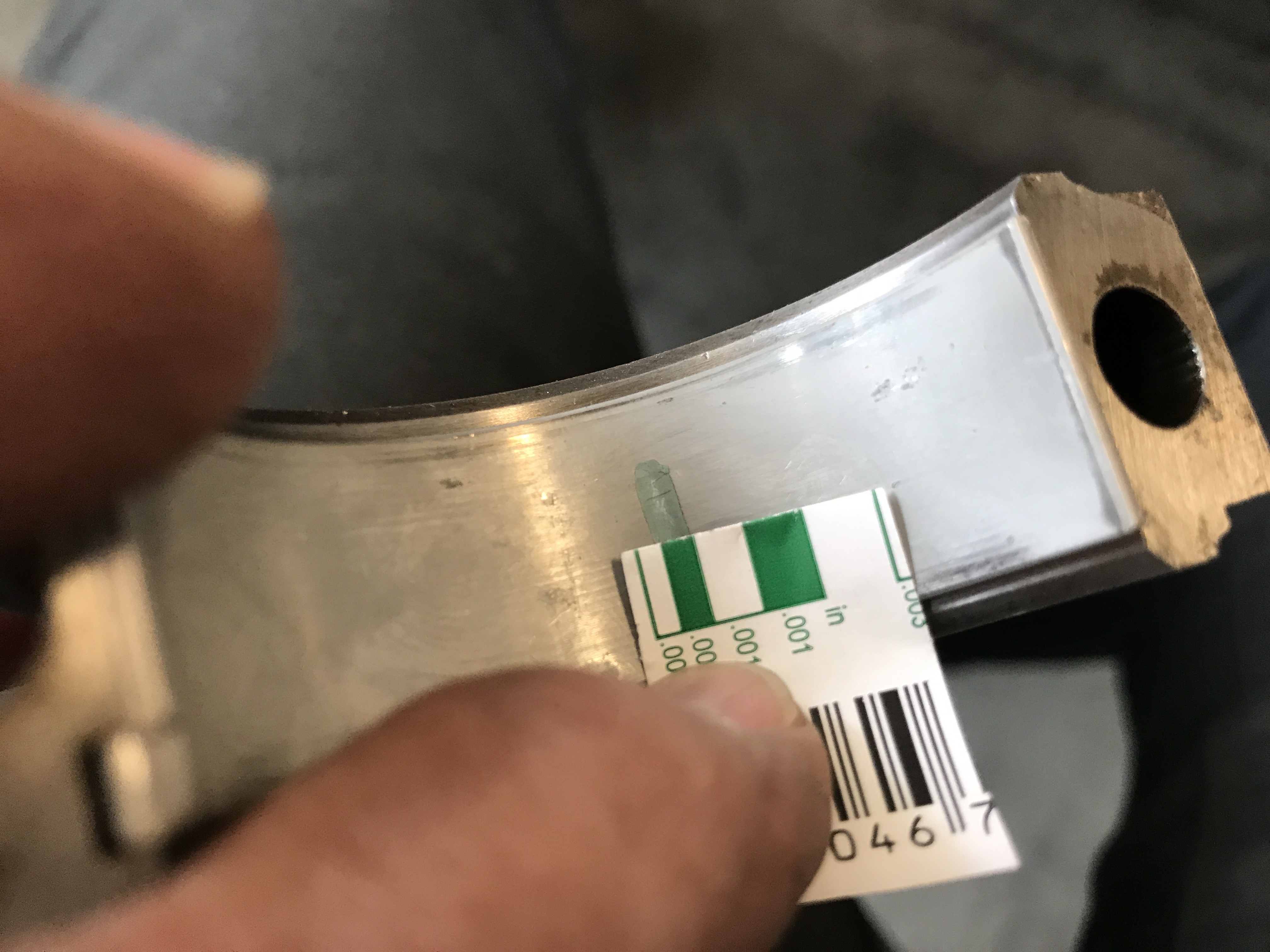

bkrantz
post Apr 21 2021, 08:39 PM
Post #2598
Posts: 8,531
Joined: 3-August 19
From: SW Colorado
Member No.: 23,343
Then removed. This one looks like 0.0018 inch, within the range (0.0008 to 0.0028).

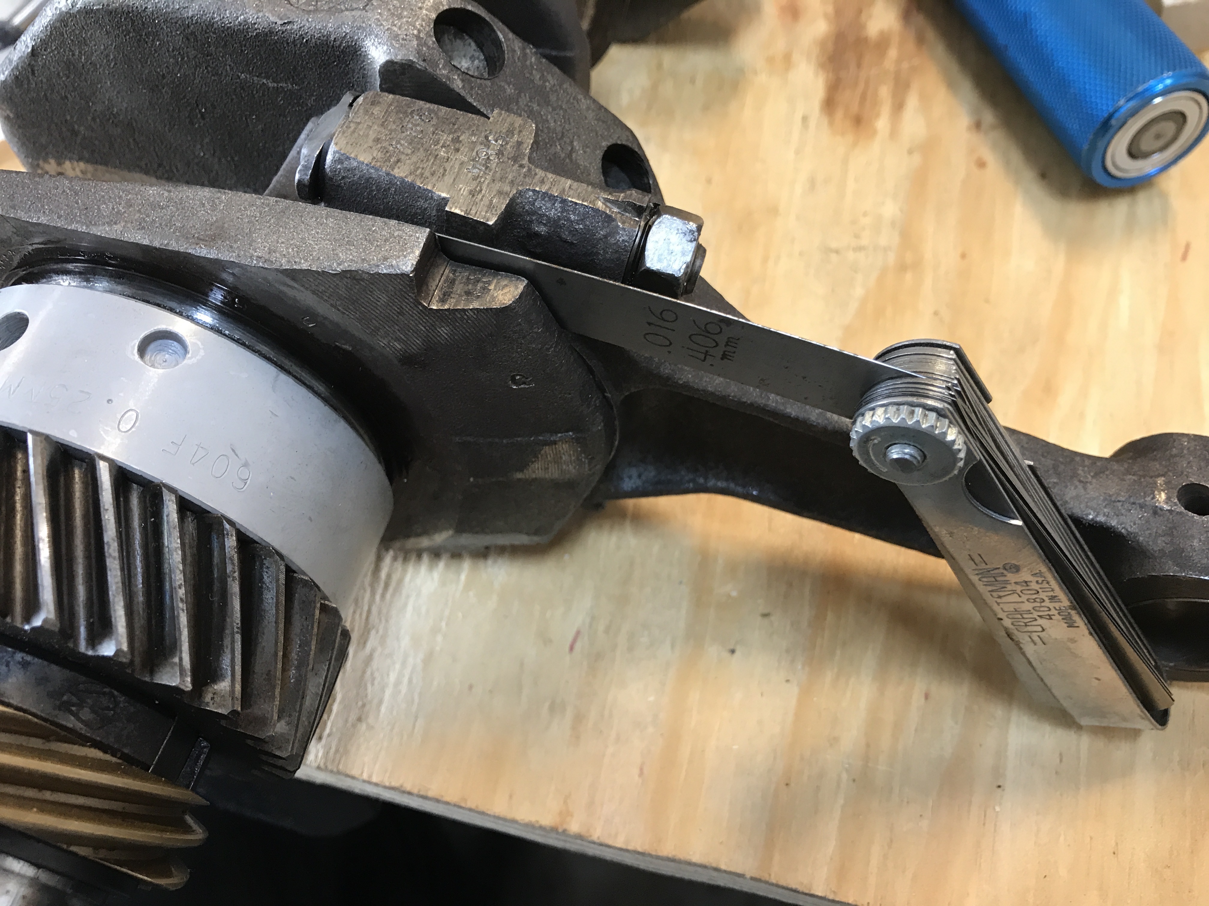

While the rod was still on the crank, I checked the side clearance, and got 0.016 inch, just within the 0.004 to 0.0016 spec.
