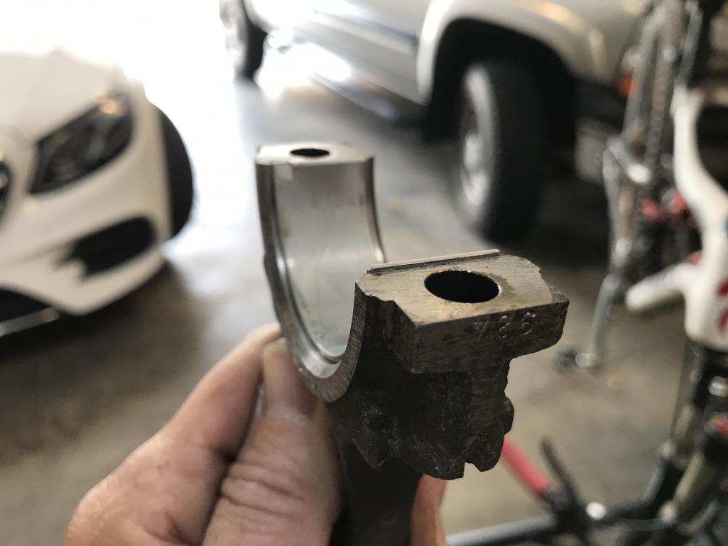

Member No.: 23,343

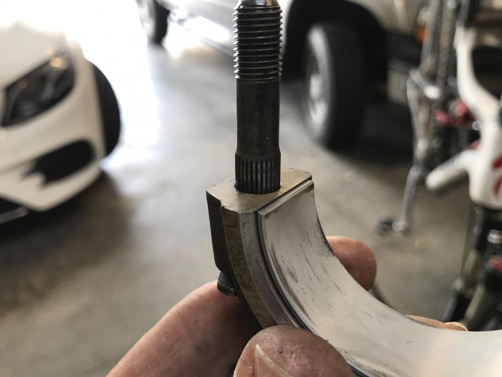

One thing I noticed is that the bearing shells do no sit evenly. On the rod half, the bearing protrudes just a bit.
bkrantz
post Apr 21 2021, 08:45 PM
Post #2602
Posts: 8,531
Joined: 3-August 19
From: SW Colorado
Member No.: 23,343
On the cap side, the bearing is just a little short.

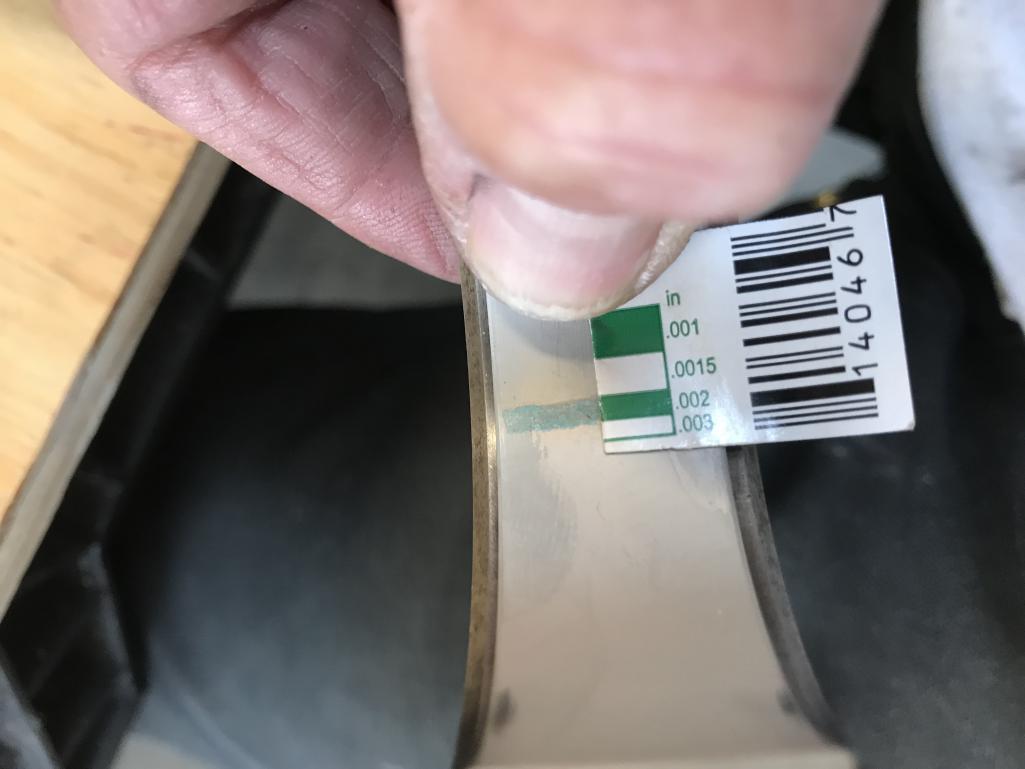

Member No.: 23,343

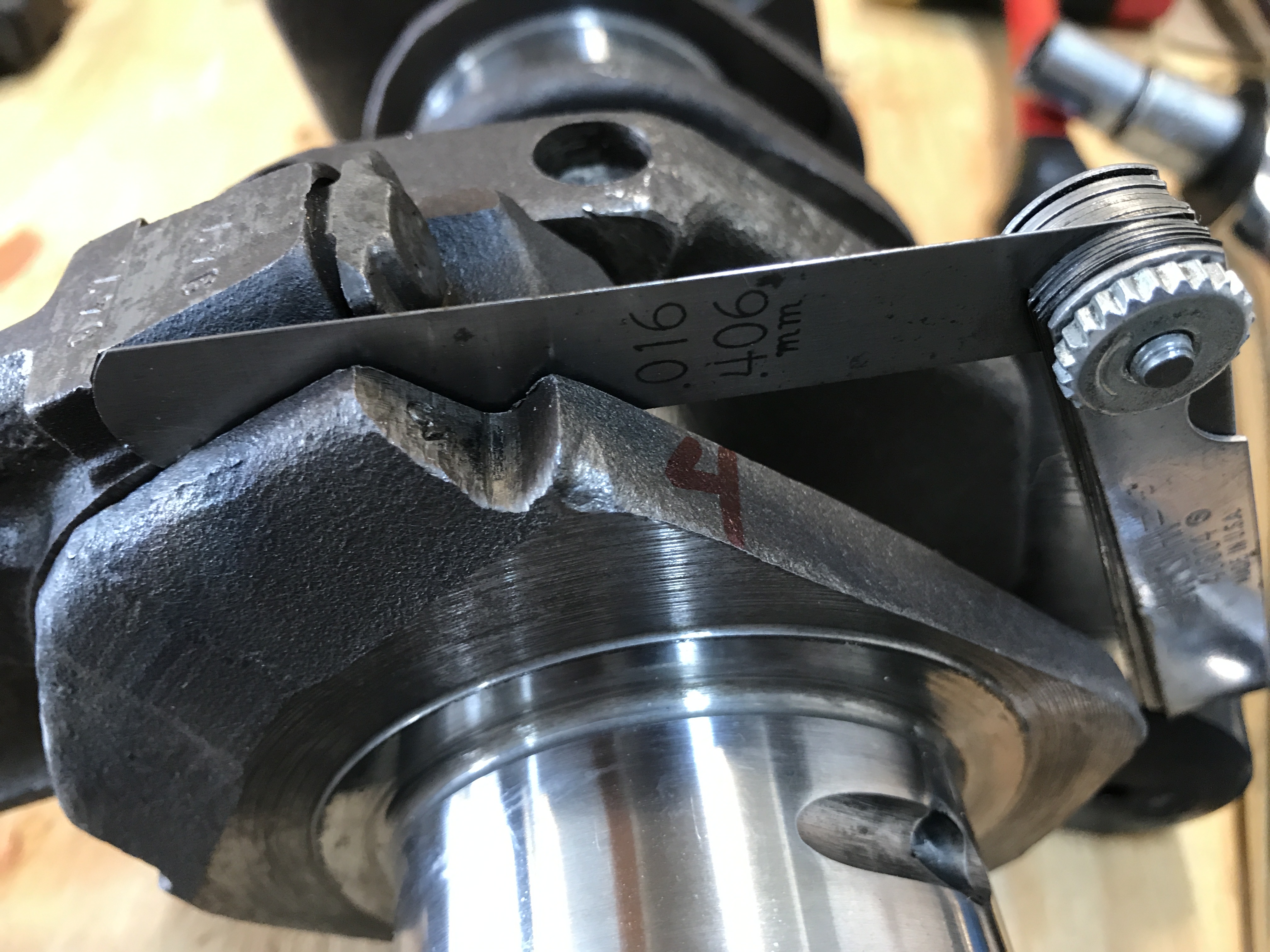

I finished checking the other rod bearing. All pretty consistent, with about 0.0018 inch bearing clearance.
bkrantz
post Apr 22 2021, 07:53 PM
Post #2604
Posts: 8,531
Joined: 3-August 19
From: SW Colorado
Member No.: 23,343
And about 0.016 inch side clearance.

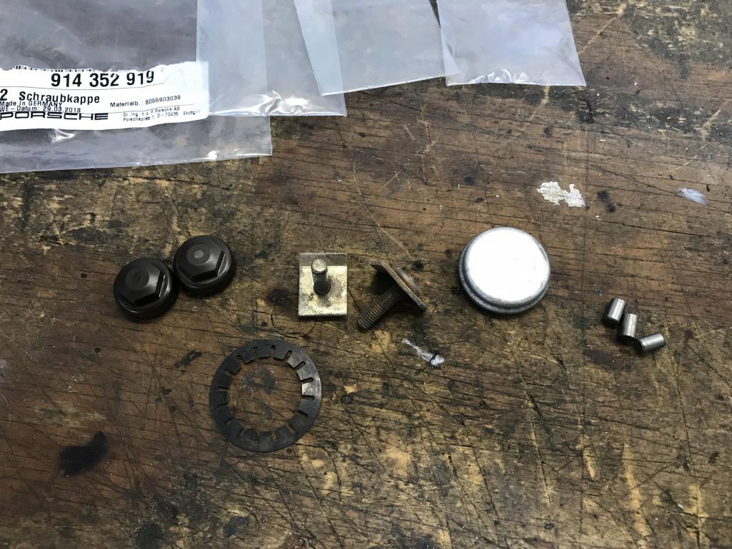

I got a small box of misc parts from AA. Just part of the endless list of stuff missing, gone missing, or otherwise necessary.
bkrantz
post Apr 23 2021, 07:06 PM
Post #2606
Posts: 8,531
Joined: 3-August 19
From: SW Colorado
Member No.: 23,343
I am probably excessive if not OCD, but I am happy to have the covers for the rear caliper outer adjusters.
bkrantz
post Apr 23 2021, 07:07 PM
Post #2607
Posts: 8,531
Joined: 3-August 19
From: SW Colorado

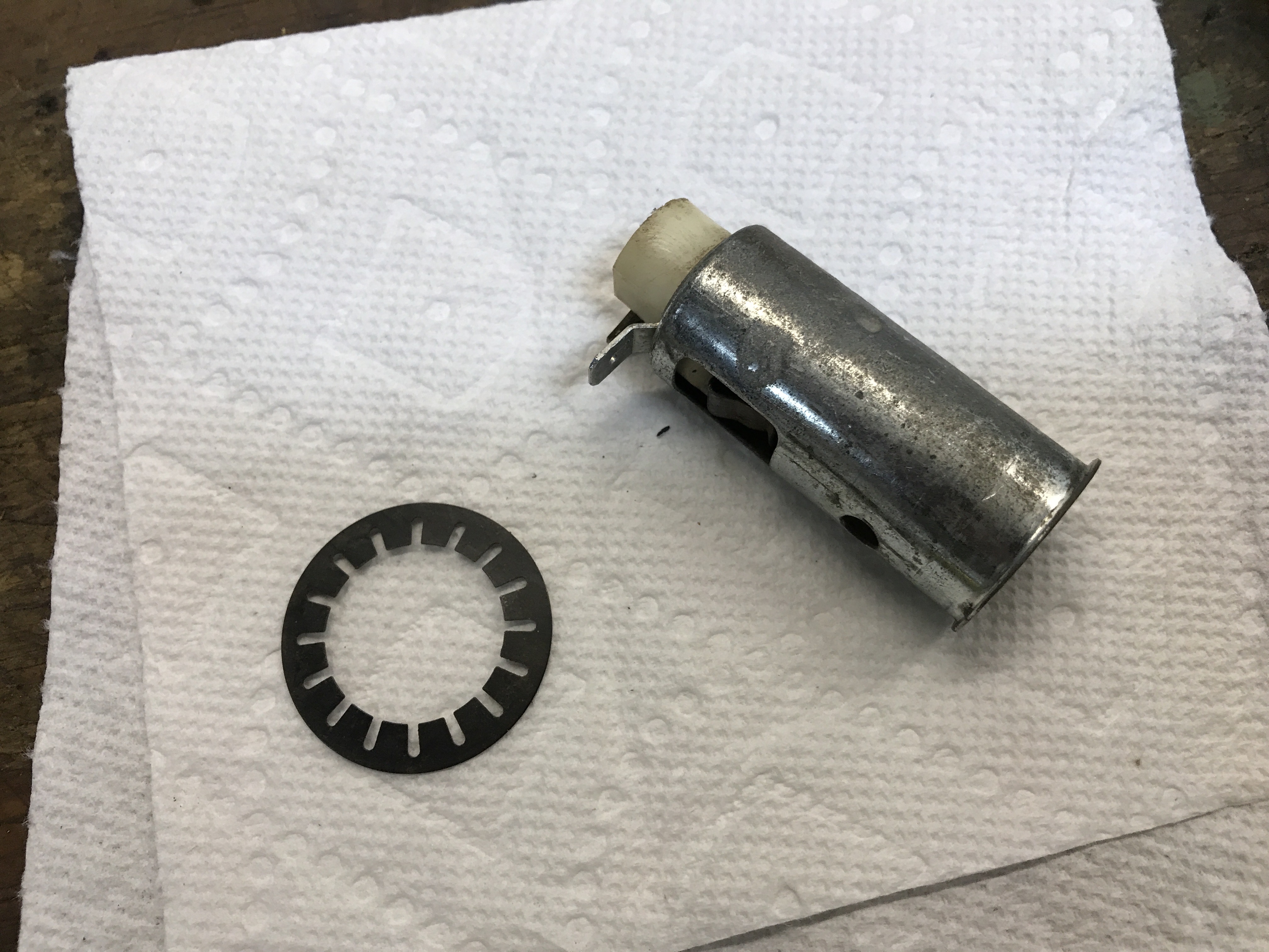

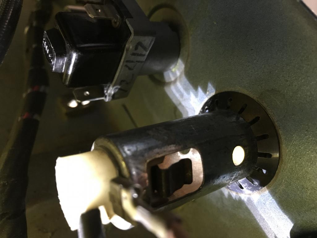

Member No.: 23,343
And happy to find the retainer for the cigarette lighter socket.
bkrantz
post Apr 23 2021, 07:08 PM
Post #2608
Posts: 8,531
Joined: 3-August 19
From: SW Colorado
Member No.: 23,343
I had used a hose clamp as a temporary fix, but this is better.
bkrantz
post Apr 23 2021, 07:09 PM
Post #2609
Posts: 8,531
Joined: 3-August 19
From: SW Colorado
Member No.: 23,343
Ready to light 'en up. (at least once I connect a battery)

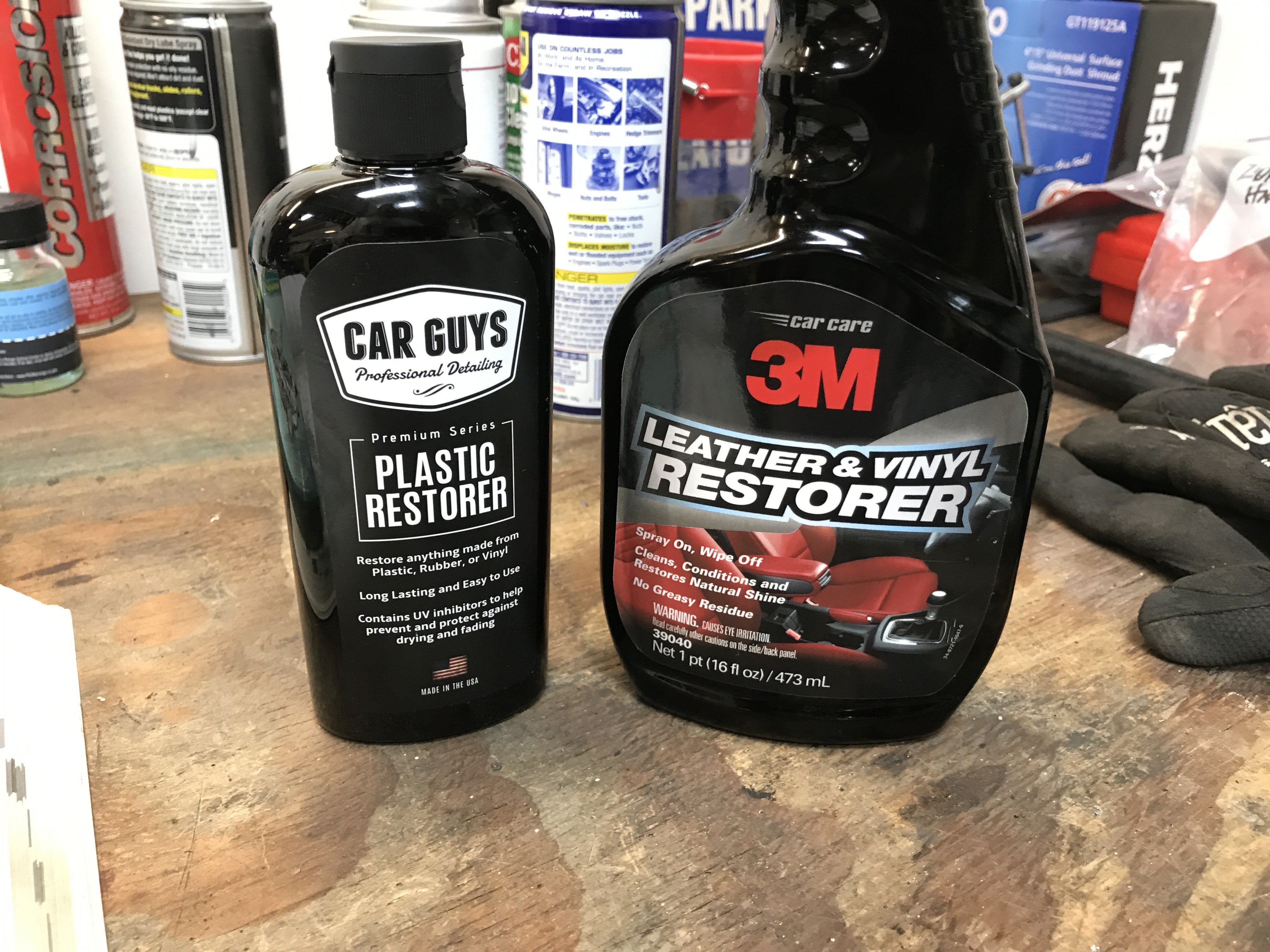

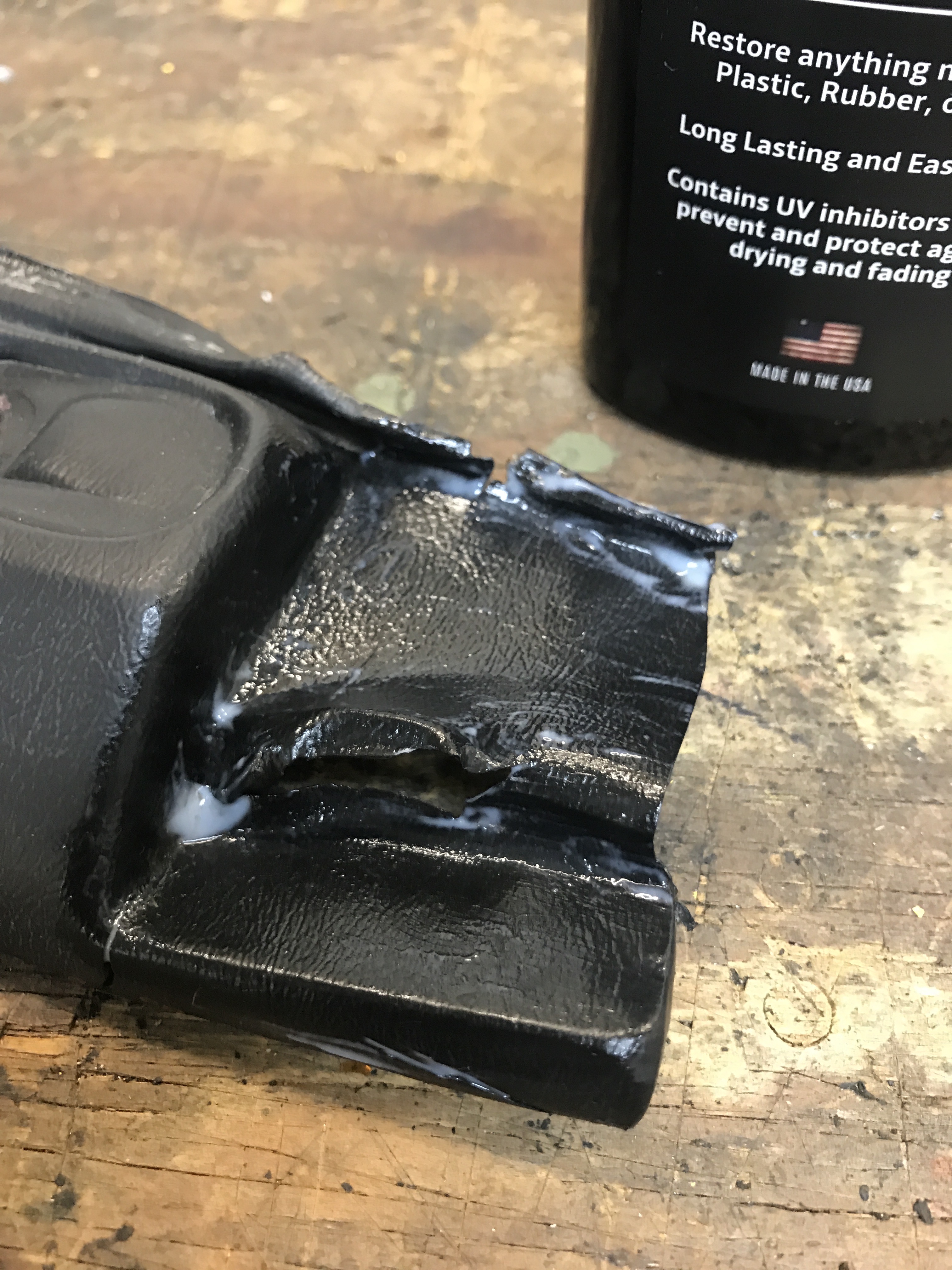

Back to restoring vinyl parts. So far I have tried both of these products, that both use the "restore" word.
bkrantz
post Apr 23 2021, 07:16 PM
Post #2613
Posts: 8,531
Joined: 3-August 19
From: SW Colorado
Member No.: 23,343
I have tried double applications, and overnight soaking, but can't see any real improvement in how brittle the old vinyl feels.
bkrantz
post Apr 24 2021, 08:09 PM
Post #2614
Posts: 8,531
Joined: 3-August 19
From: SW Colorado
Member No.: 23,343
Until I find a magic vinyl restoring potion, I will go ahead with what I have. I used the 3M stuff, but it left a high shine.
bkrantz
post Apr 24 2021, 08:10 PM
Post #2615
Posts: 8,531
Joined: 3-August 19
From: SW Colorado
Member No.: 23,343
To cut the shine, I used some 303 cleaner.
bkrantz
Post #2616
Posts: 8,531
Joined: 3-August 19
From: SW Colorado
Member No.: 23,343
Still a bit shiny, but better.
iankarr
post Apr 24 2021, 08:12 PM
Post #2617
Posts: 2,580
Joined: 22-May 15
From: Heber City, UT
Member No.: 18,749
I've heard that rubbing mineral oil into vinyl and leting it seep in can soften things up. Haven't tried it though...

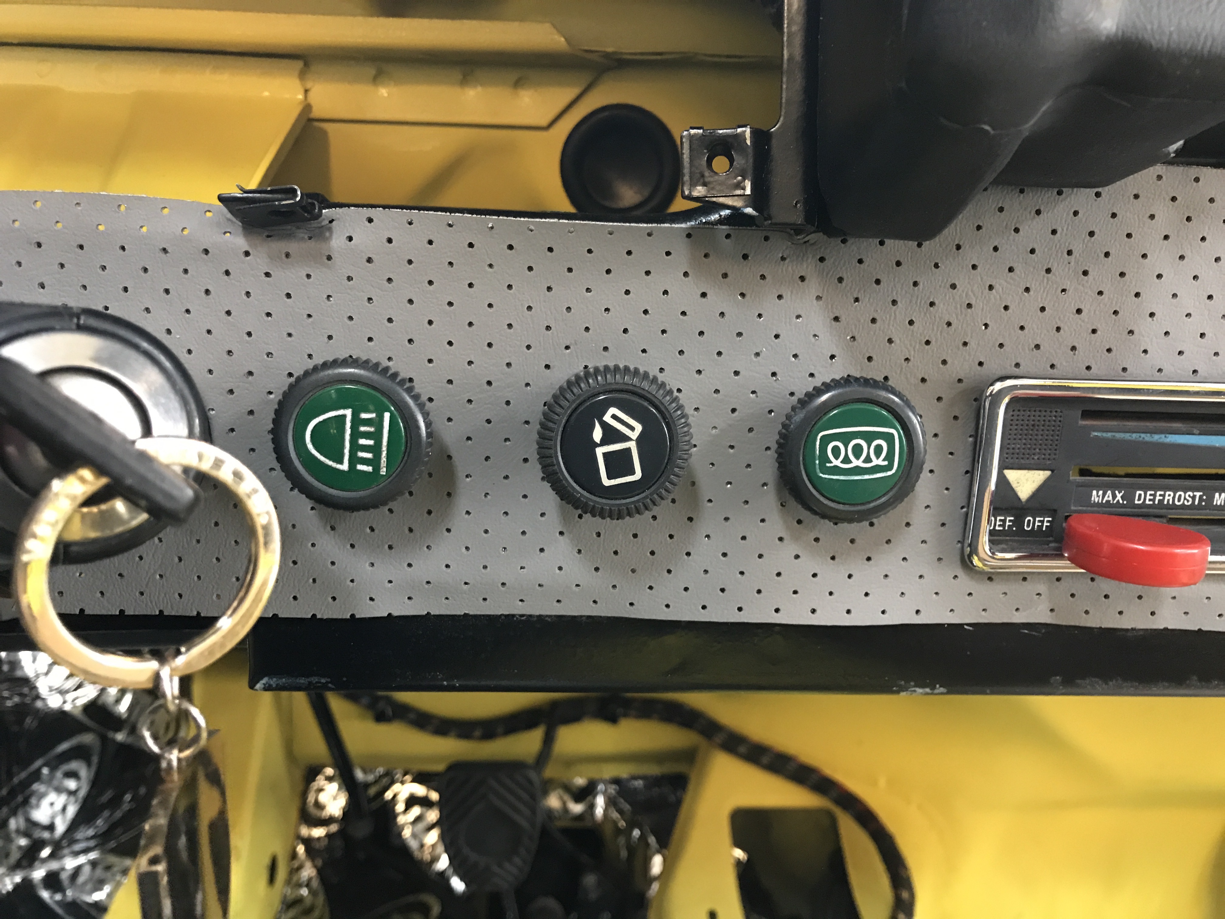

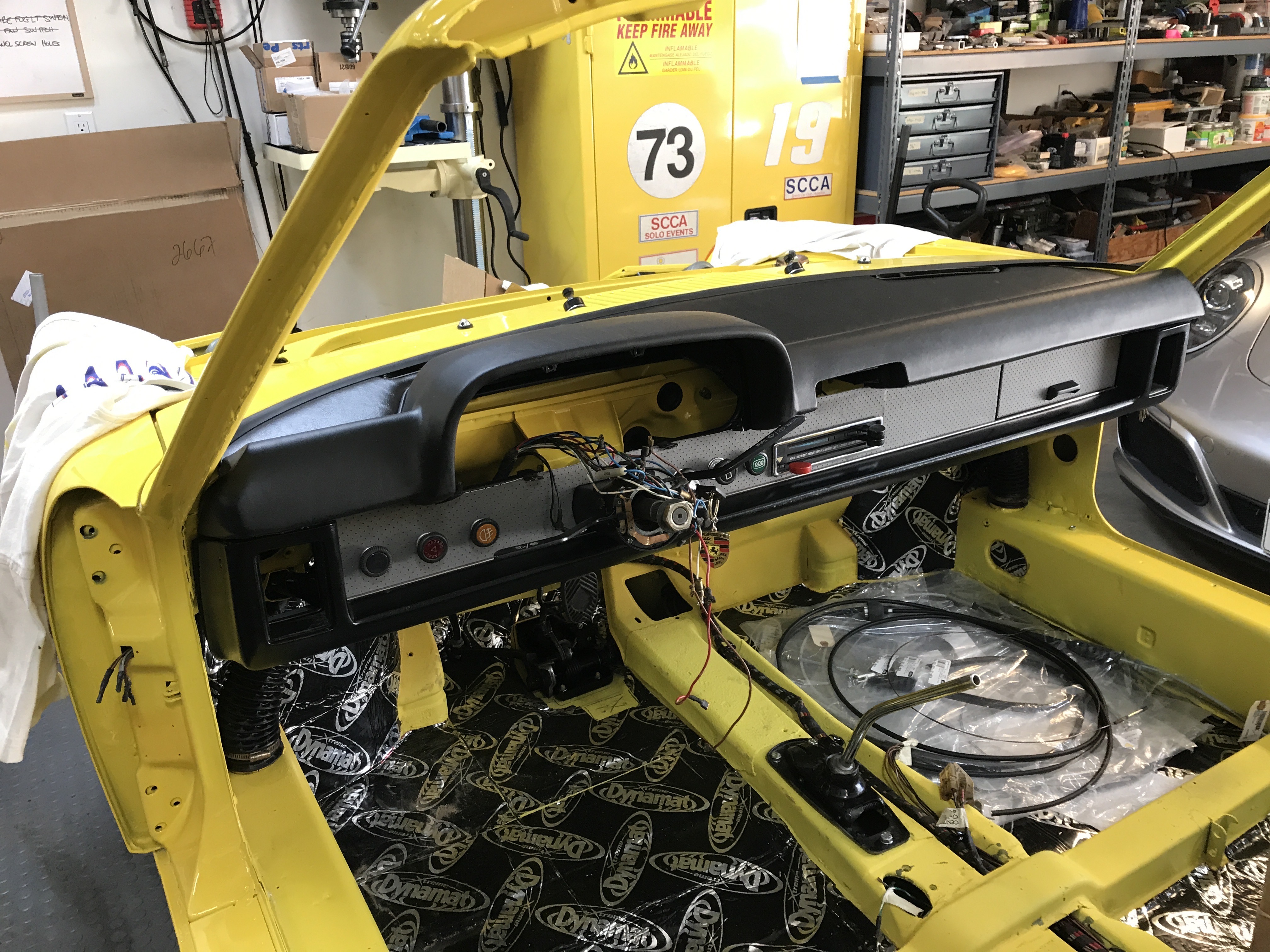

Member No.: 23,343

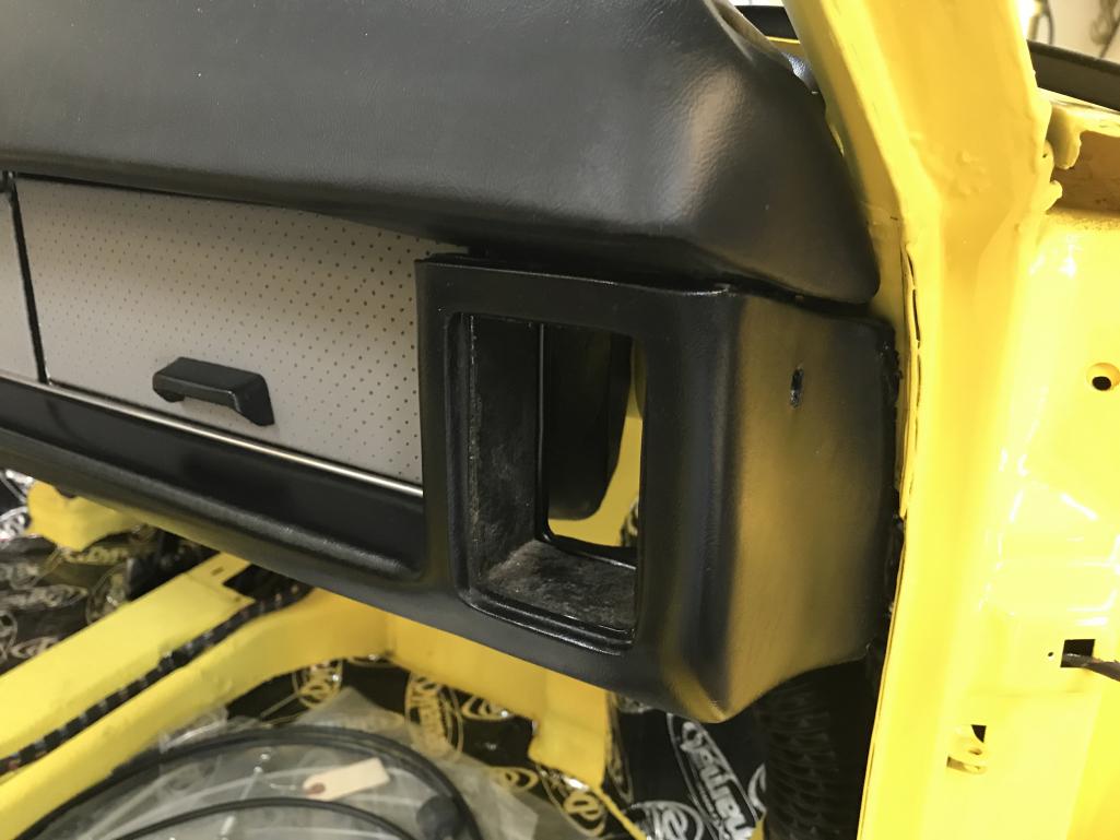

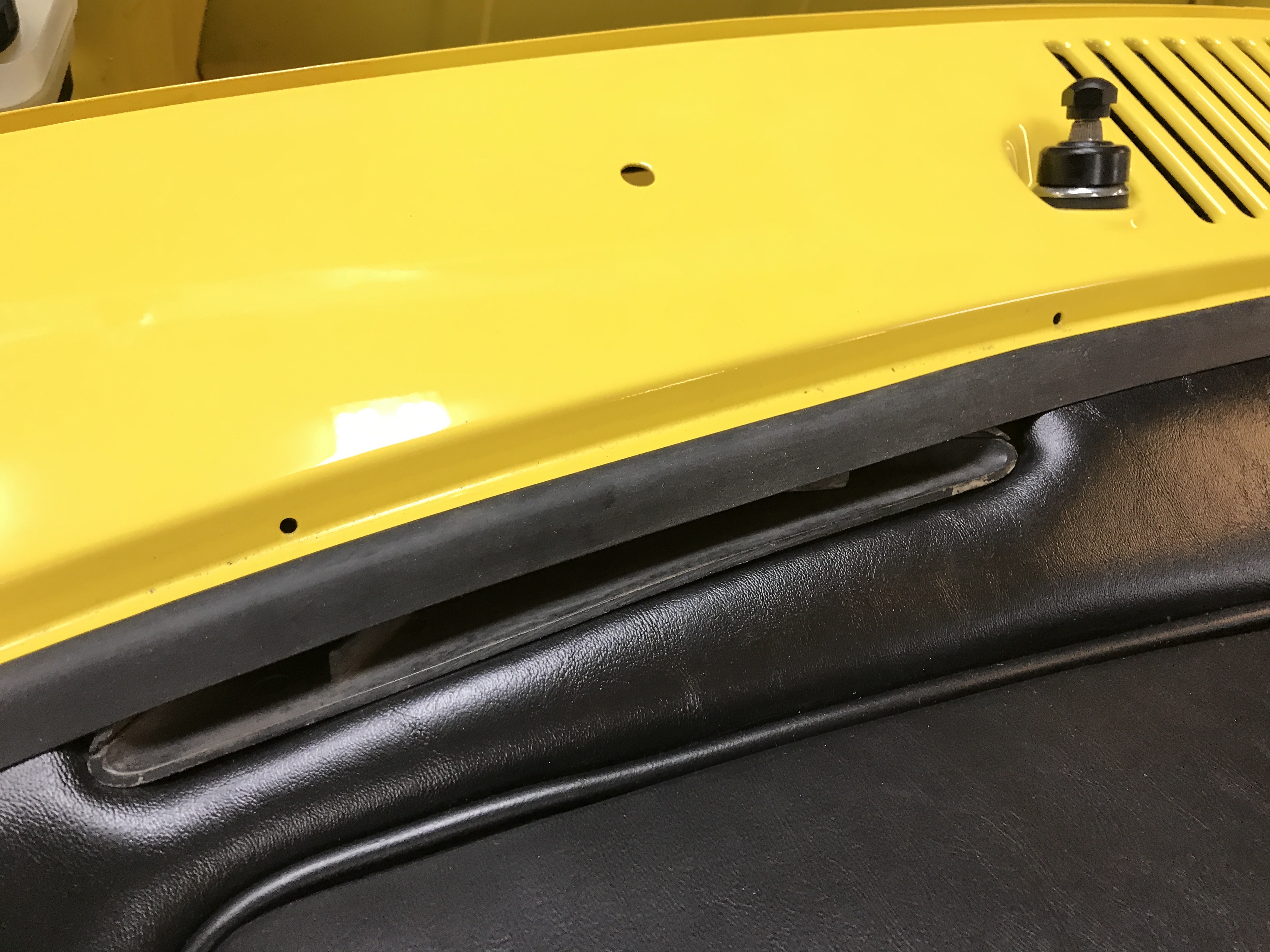

Lower dash pad installed (for now). Looks more complete, and I like the contrast of the gray perf vinyl center.
bkrantz
post Apr 24 2021, 08:14 PM
Post #2619
Posts: 8,531
Joined: 3-August 19
From: SW Colorado
Member No.: 23,343
But the fit with the top pad is a bit sloppy on the ends.

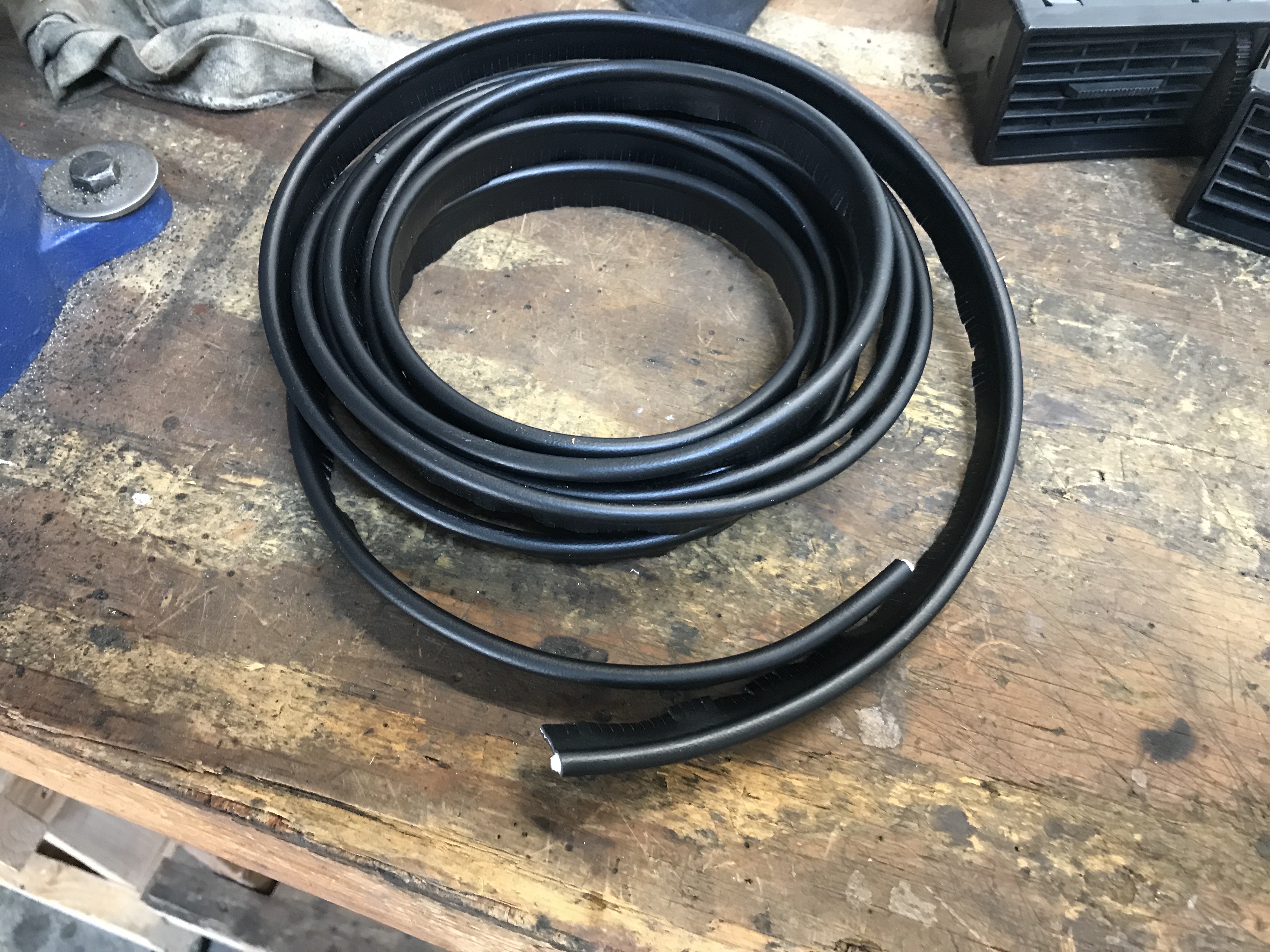

Time for more welting?
