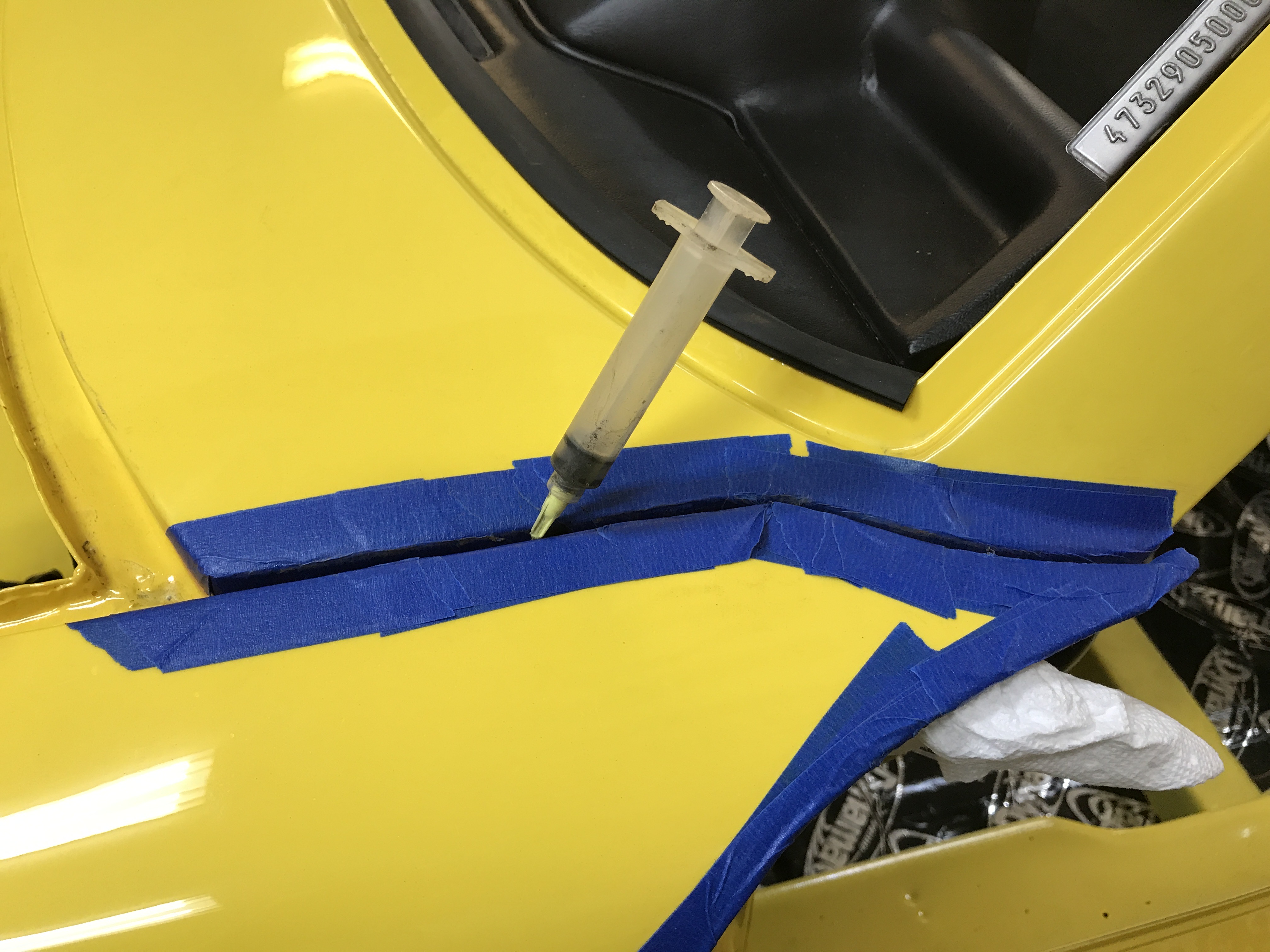

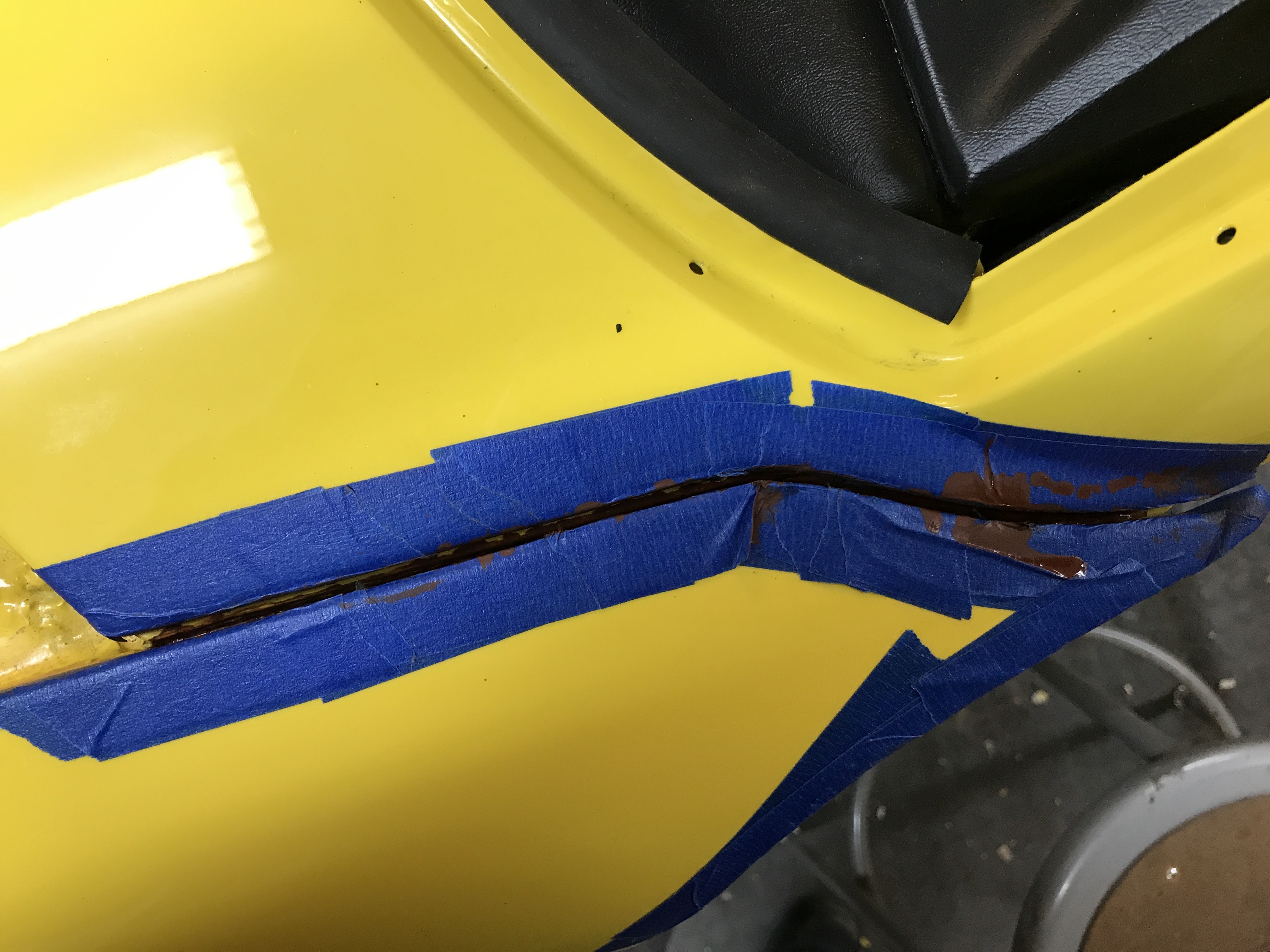

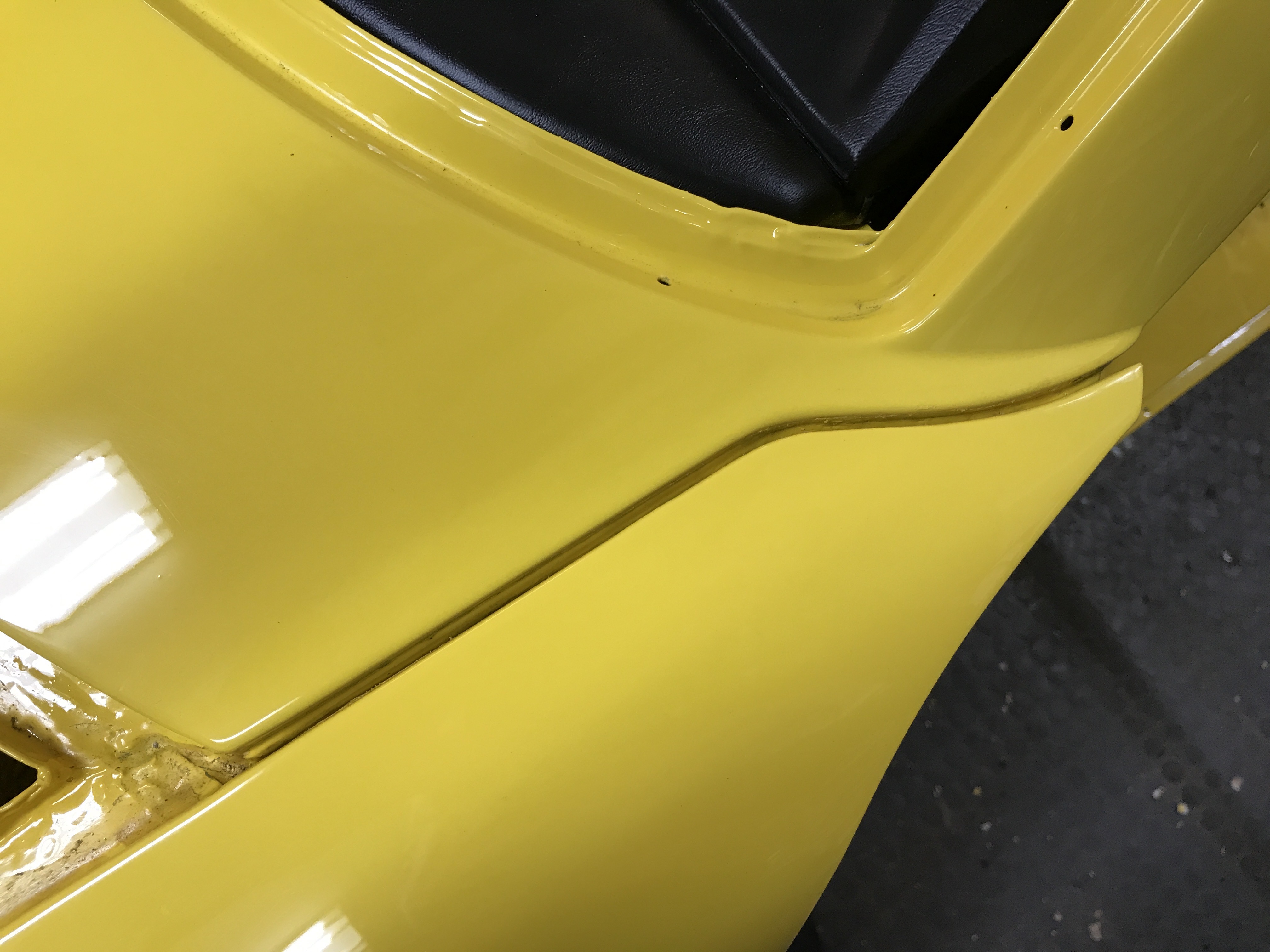

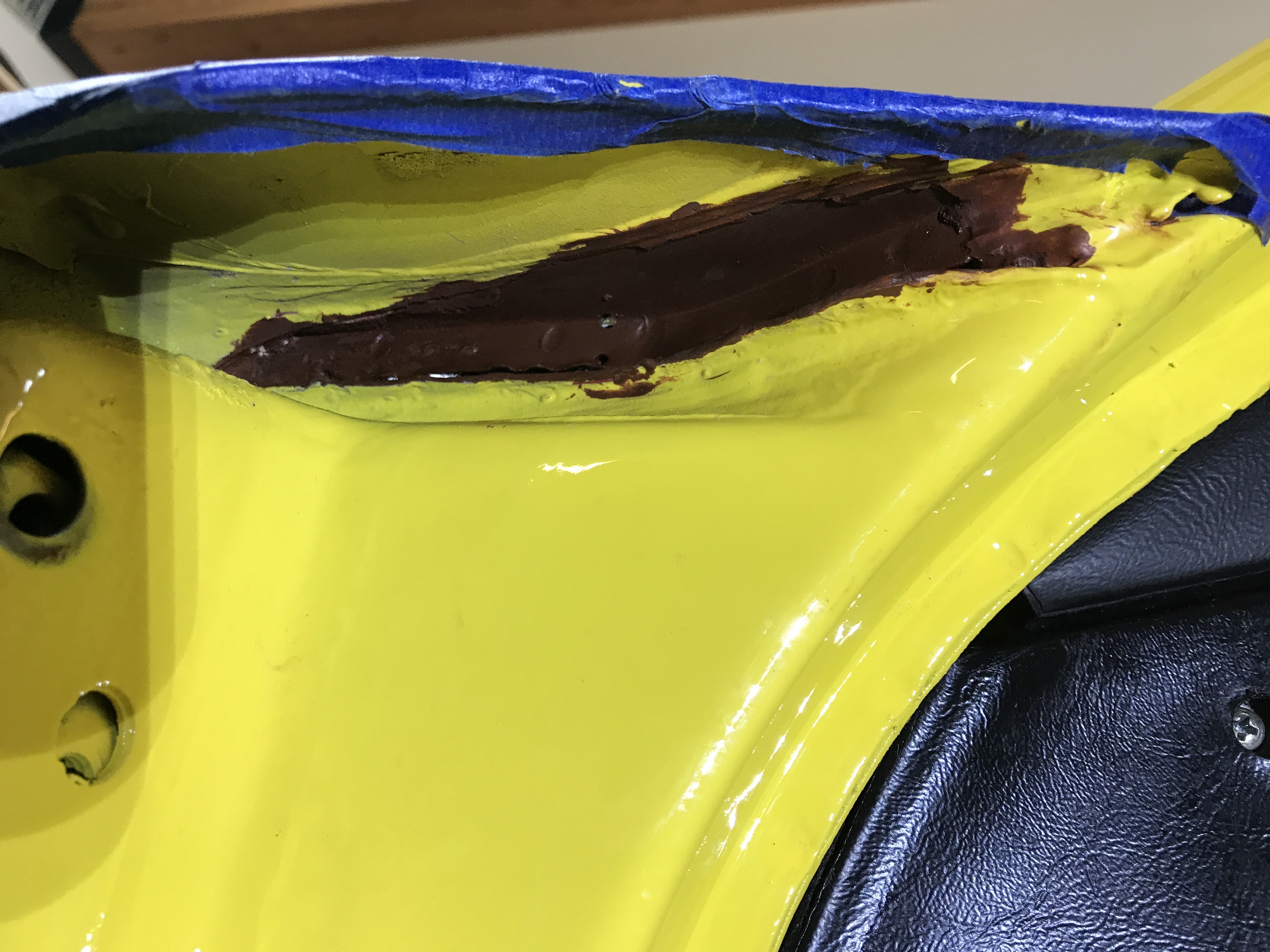

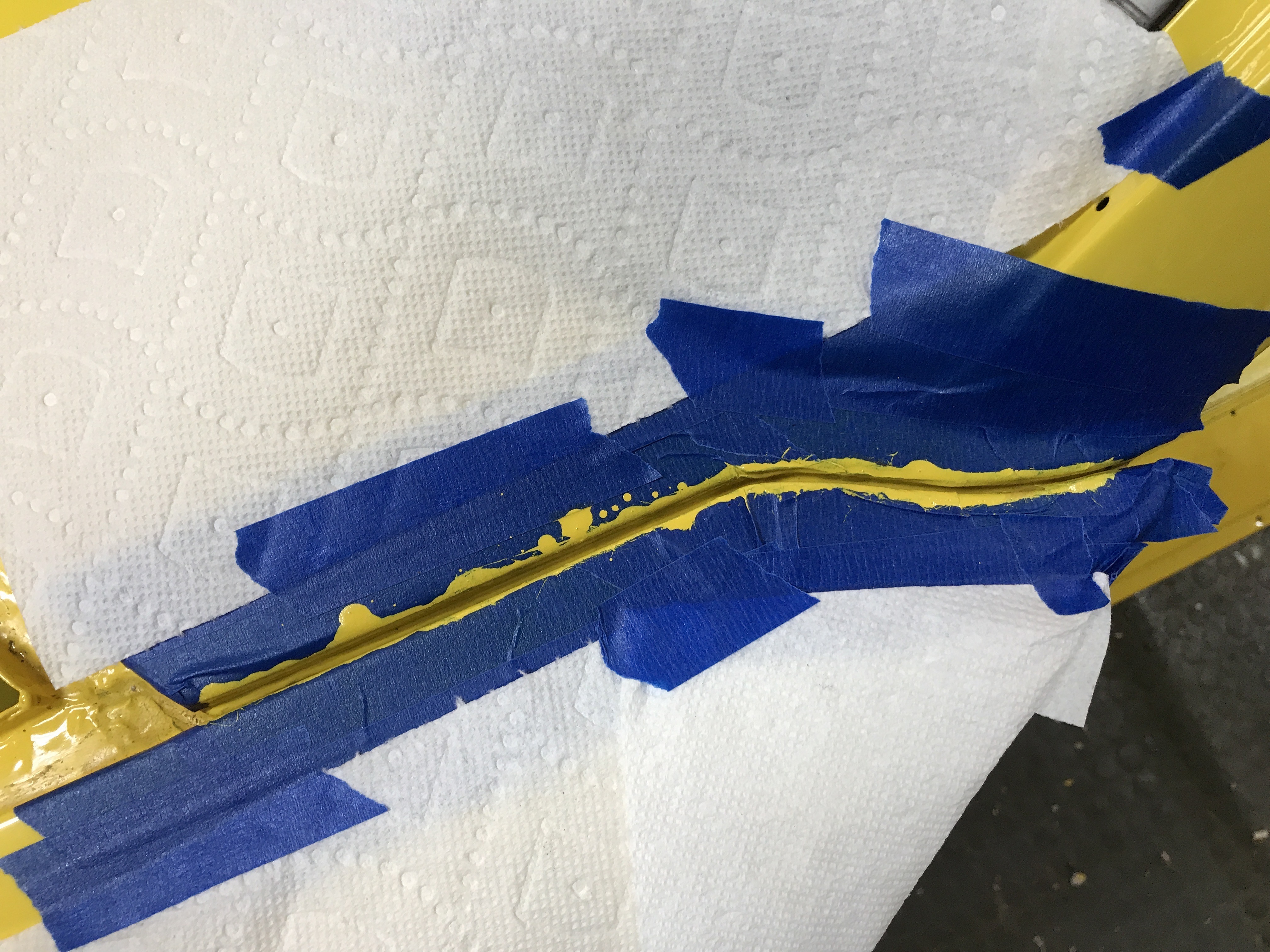

And then treated the seam from above and below a few times. I will think about other treatment and paint tomorrow.

I applied a healthy dose of primer, from above.

And below.

Then a first coat of yellow.

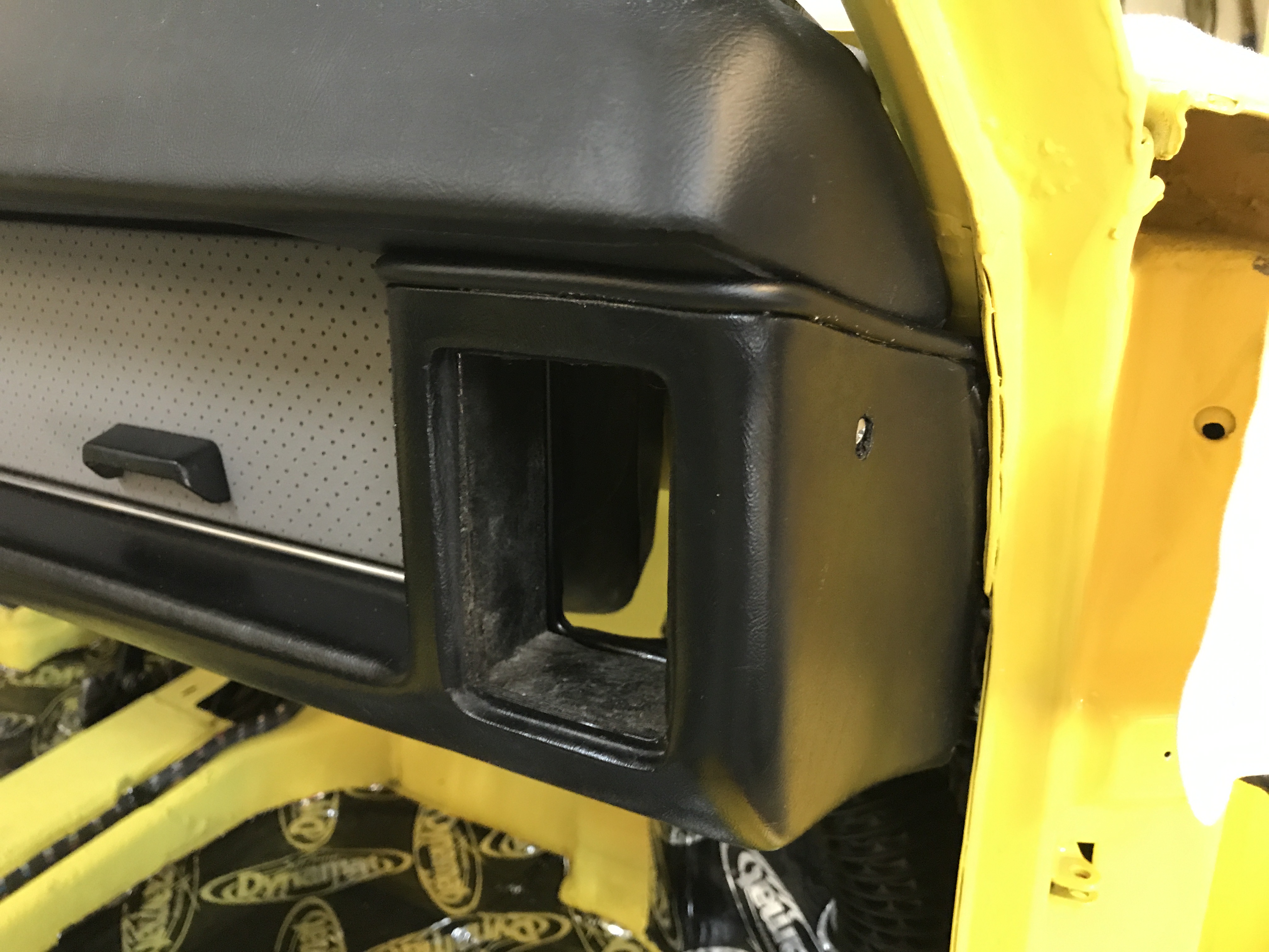

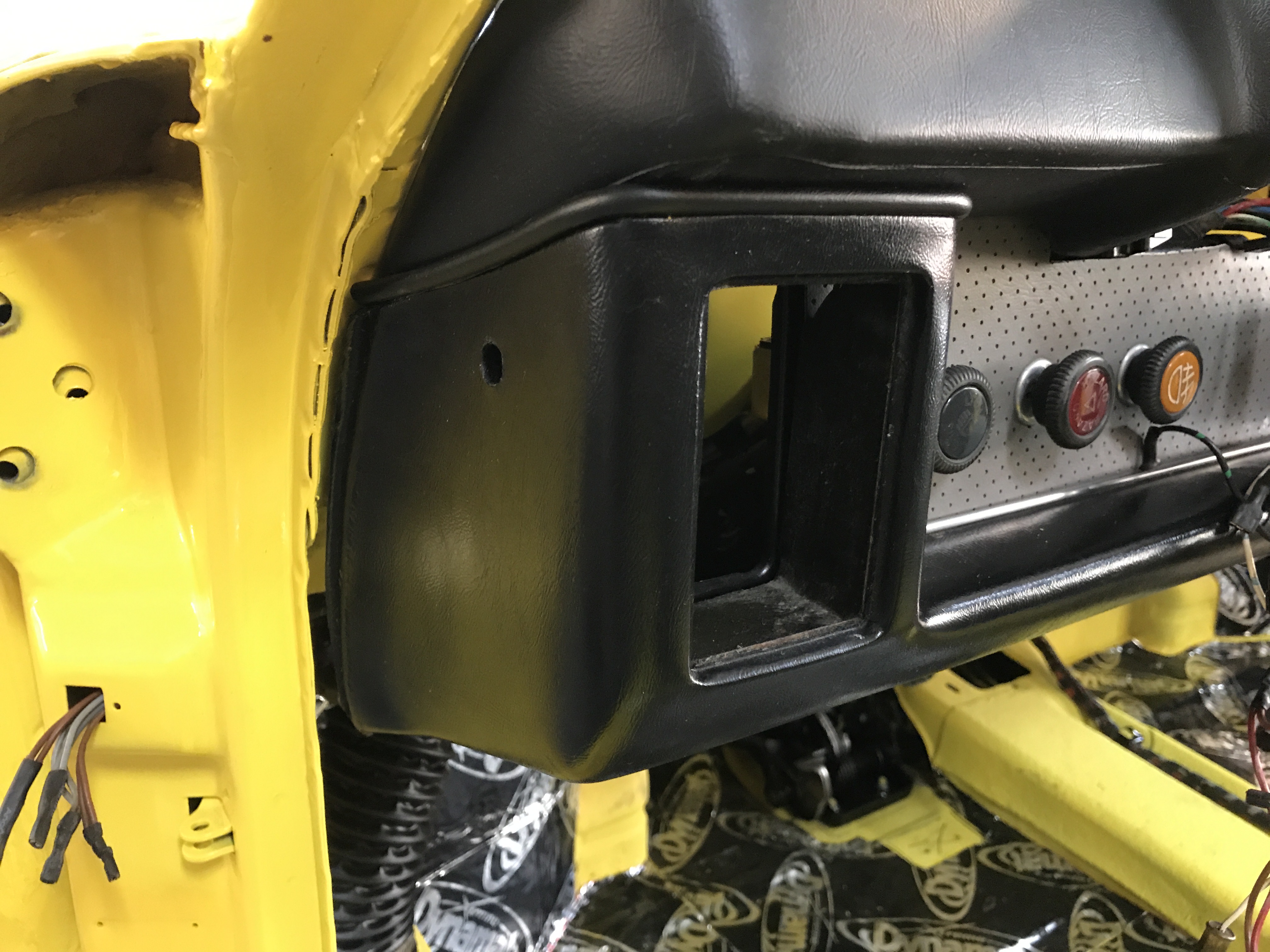

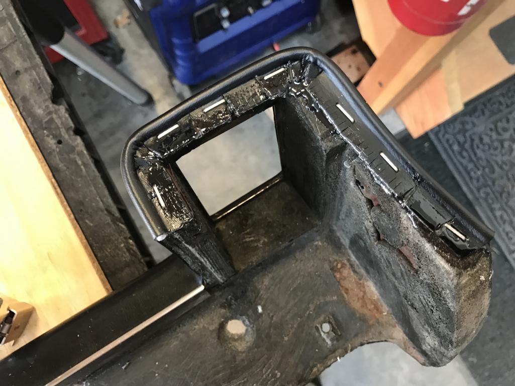

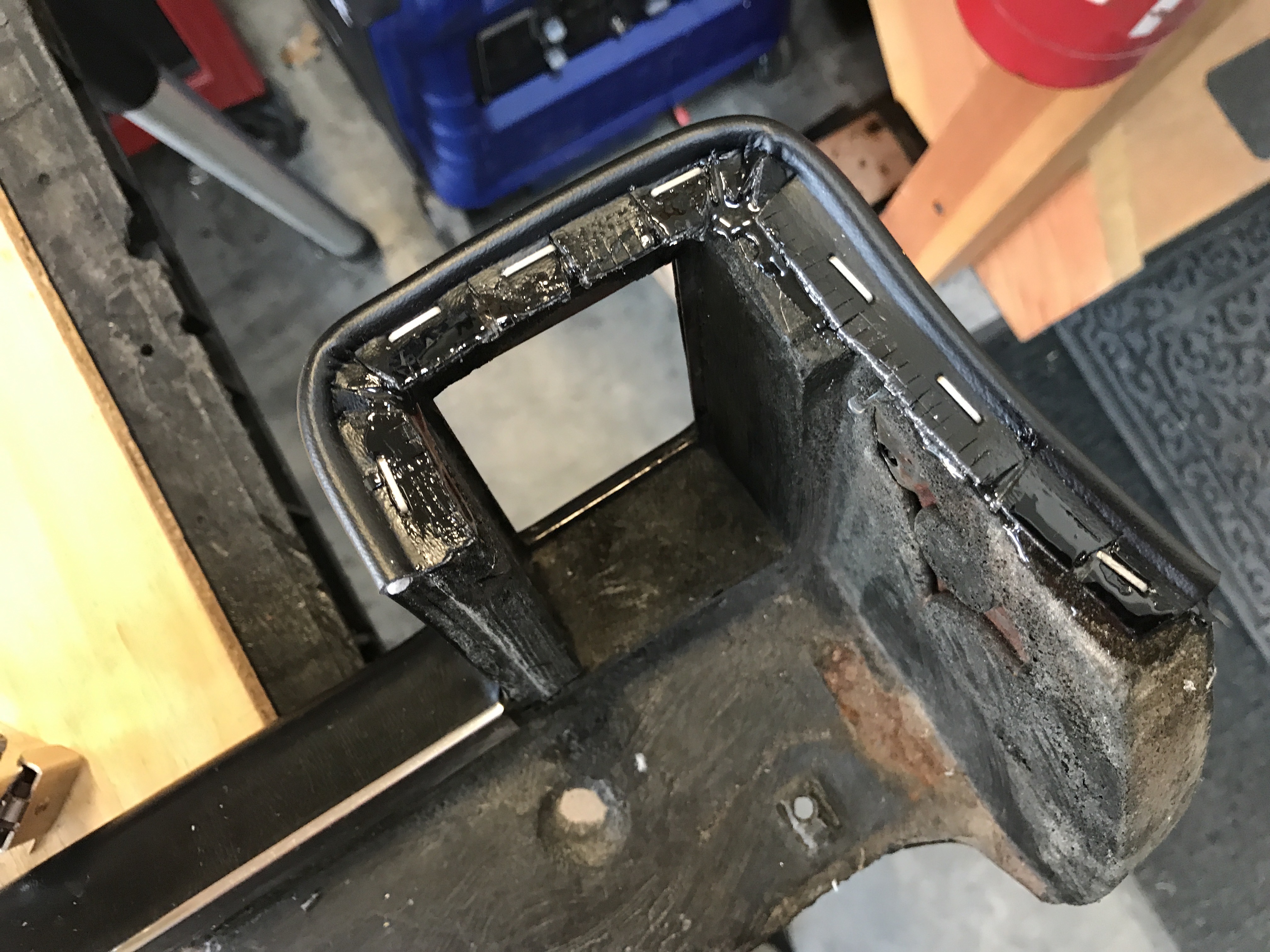

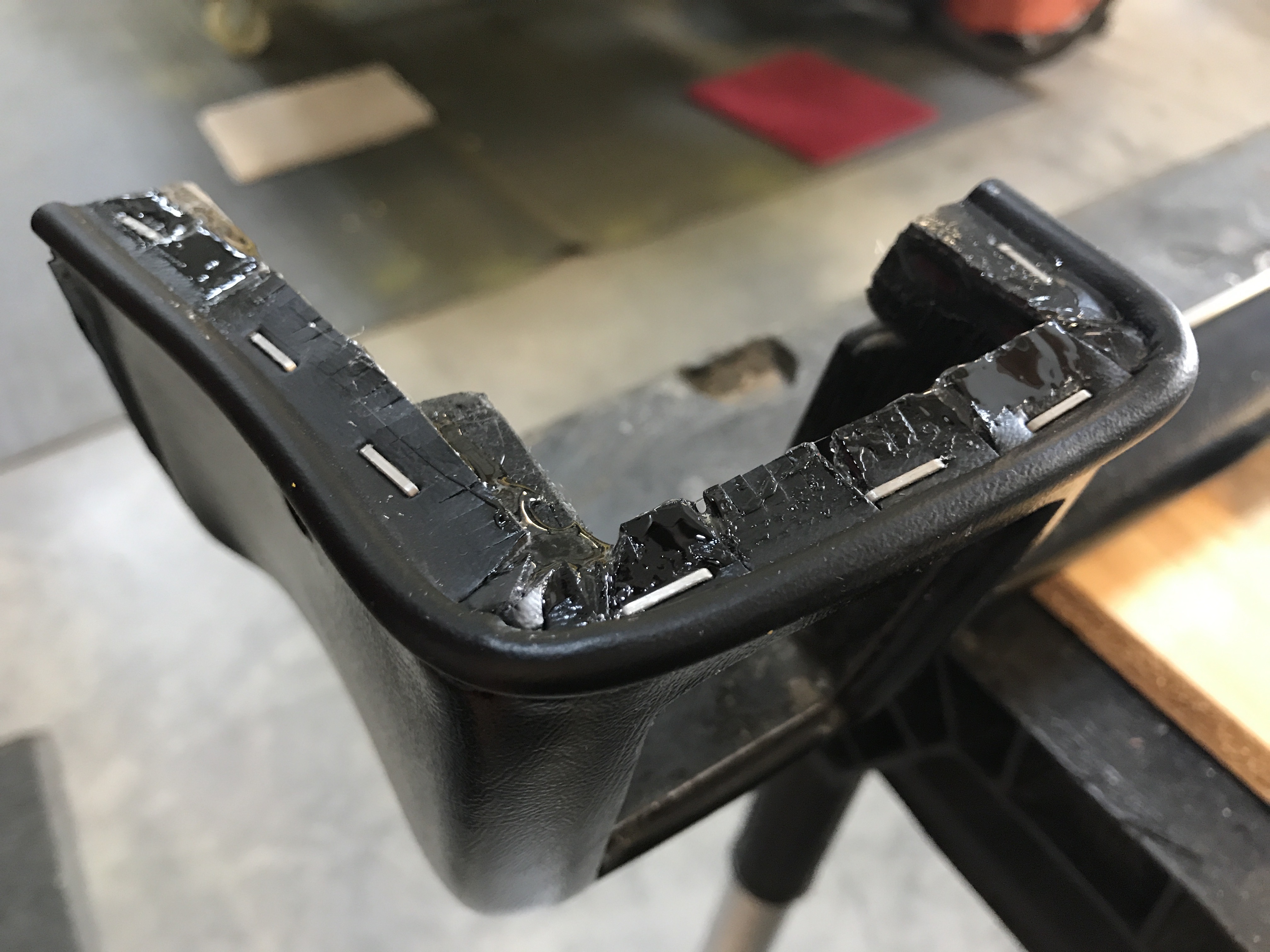

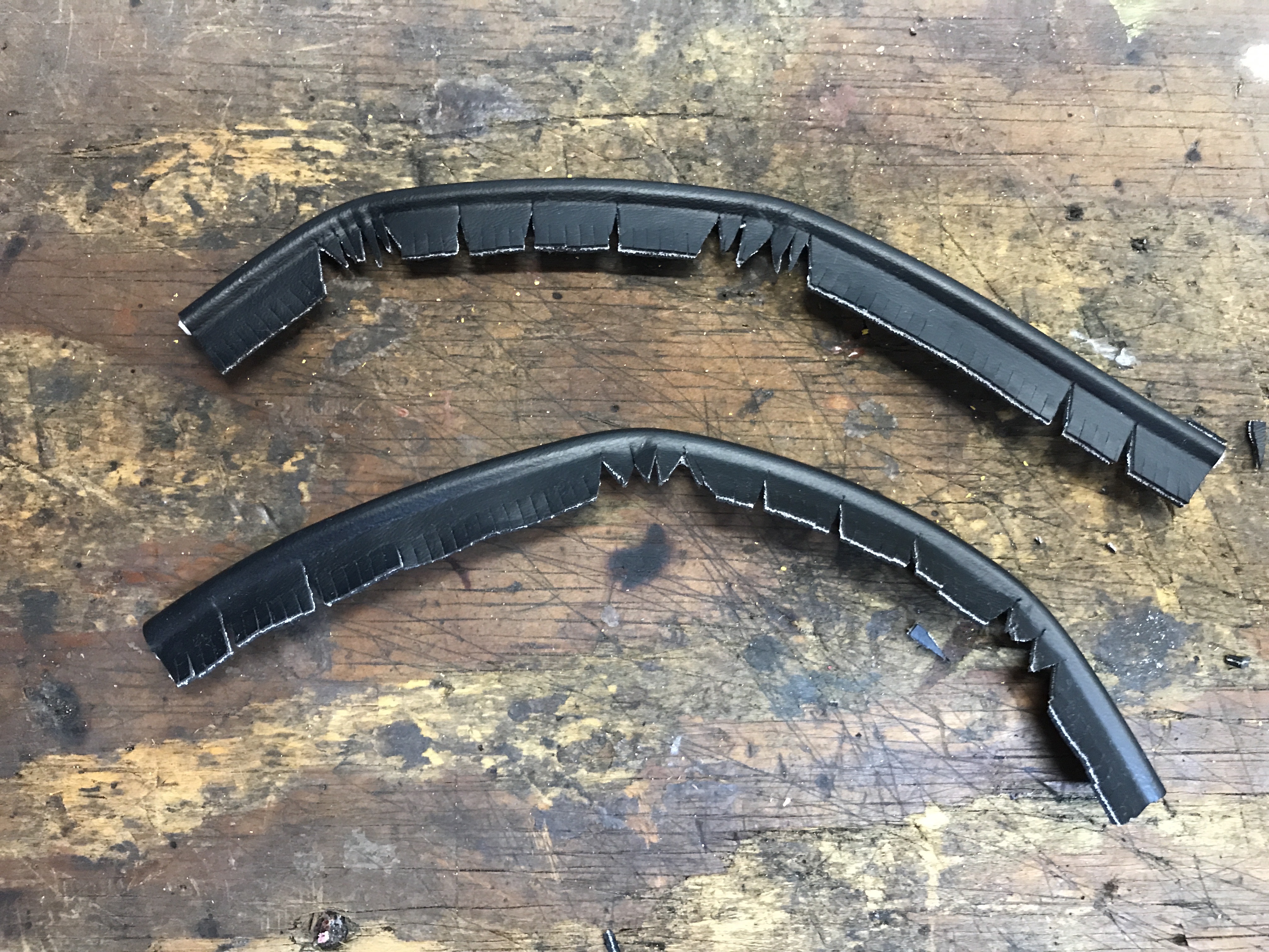

Going back to last week, when I mounted the lower dash pad (knee pad) I was unhappy with the gaps at the tops of the side sections. I pulled the pad off, and then got out the same welting material I used to fill the gap I had around the instrument cowl part of the upper dash pad. I cut 2 sections and made some V-cuts to make bending around the corners easier.
bkrantz
post Apr 28 2021, 08:08 PM
Post #2648
Posts: 8,531
Joined: 3-August 19
From: SW Colorado
Member No.: 23,343
I mounted these with all-purpose adhesive and 3/8 inch staples.

Left side.

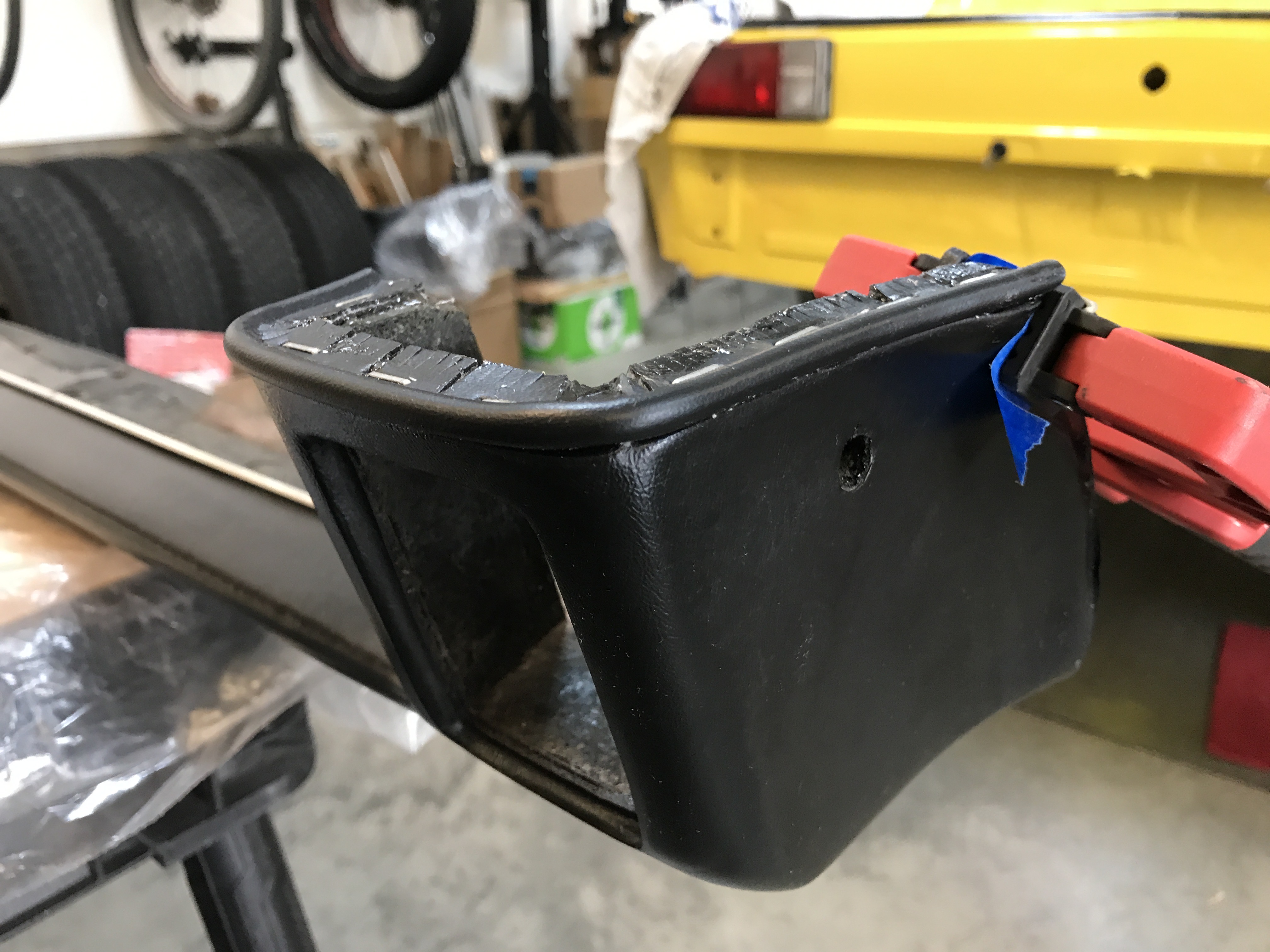

Right side. I also glued a small break in the corner of the side panel.

i think every 914 i have looked into hs a gao between that lower bolster and the upper. This looks like a simple way to fill that in without permanently modifying it.
where did you source the welting?
bkrantz
post Apr 29 2021, 08:31 PM
Post #2652
Posts: 8,531
Joined: 3-August 19
From: SW Colorado
Member No.: 23,343
QUOTE(DRPHIL914 @ Apr 29 2021, 12:53 PM) *
I bought this stuff:
https://www.amazon.com/gp/product/B07TSQPKC...=UTF8&psc=1
The internal piping is a bit stiff but it works.

Here's the lower dash pad with welting installed, on the left side.
bkrantz
post Apr 29 2021, 08:34 PM
Post #2654
Posts: 8,531
Joined: 3-August 19
From: SW Colorado
Member No.: 23,343
And the right side. No gap to look at now.

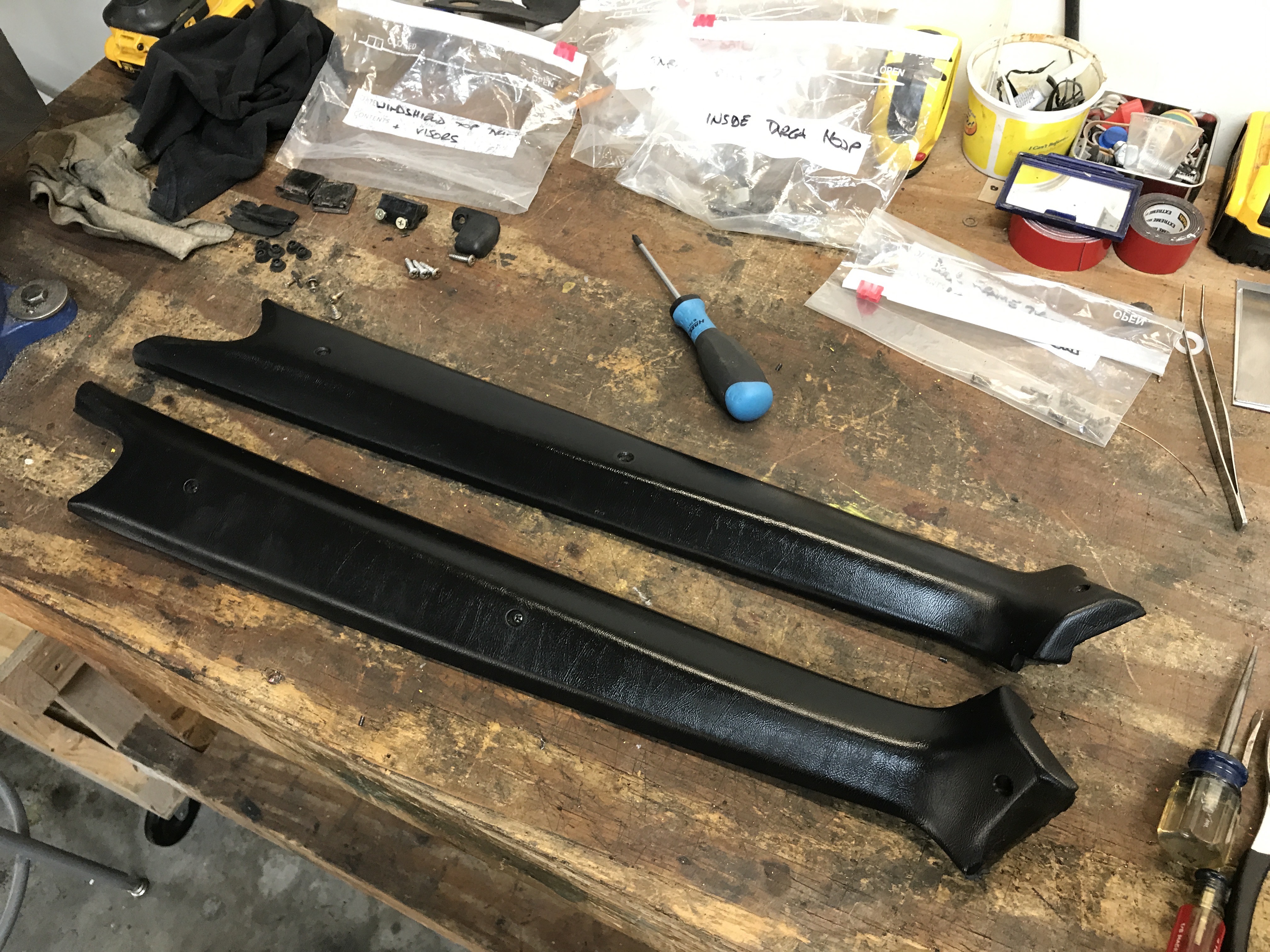

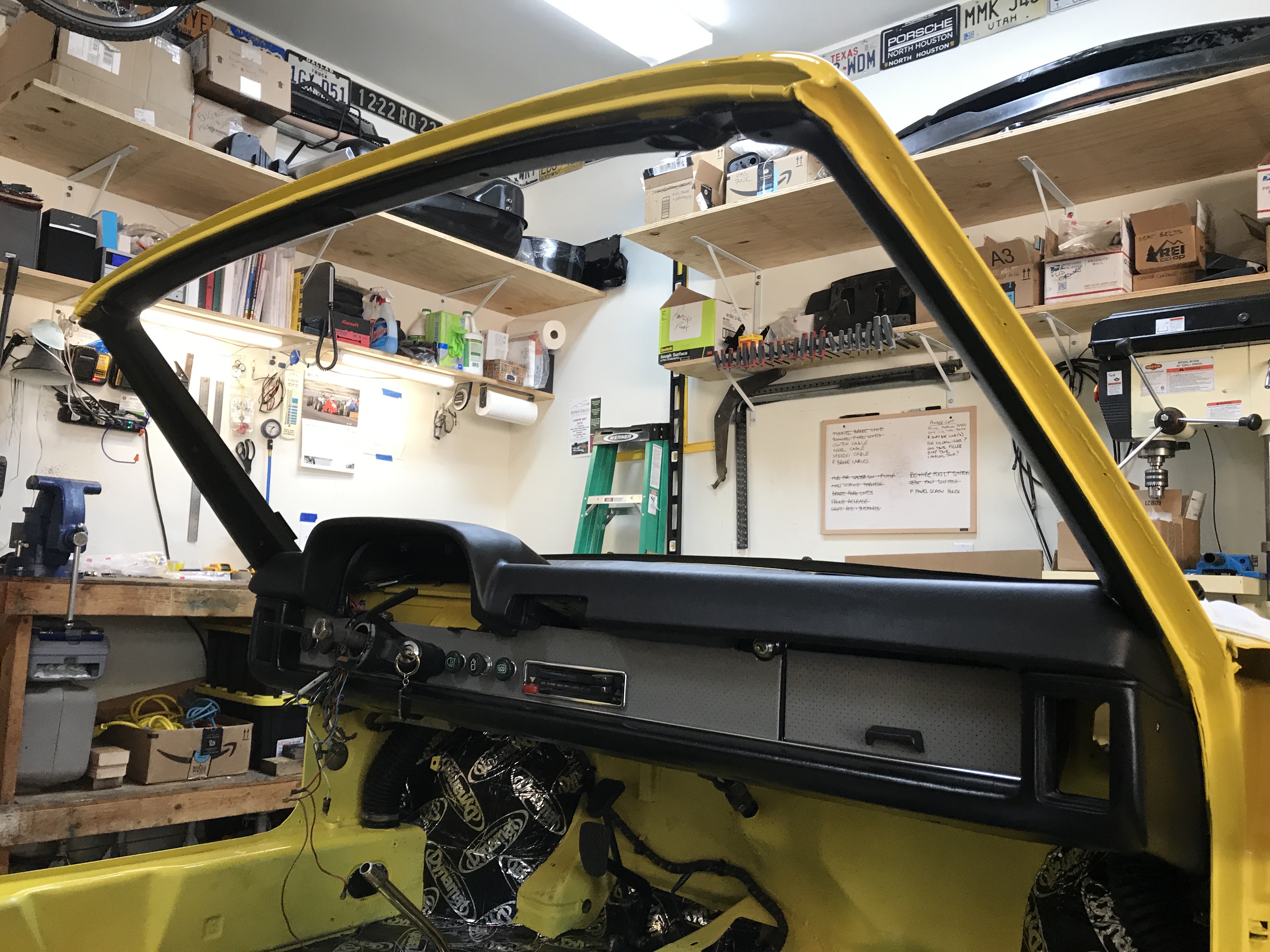

While in the mode for interior parts, I got out the inner A-pillar pads.
bkrantz
post Apr 29 2021, 08:37 PM
Post #2656
Posts: 8,531
Joined: 3-August 19
From: SW Colorado
Member No.: 23,343
And installed these, along with the frame top section.
bkrantz

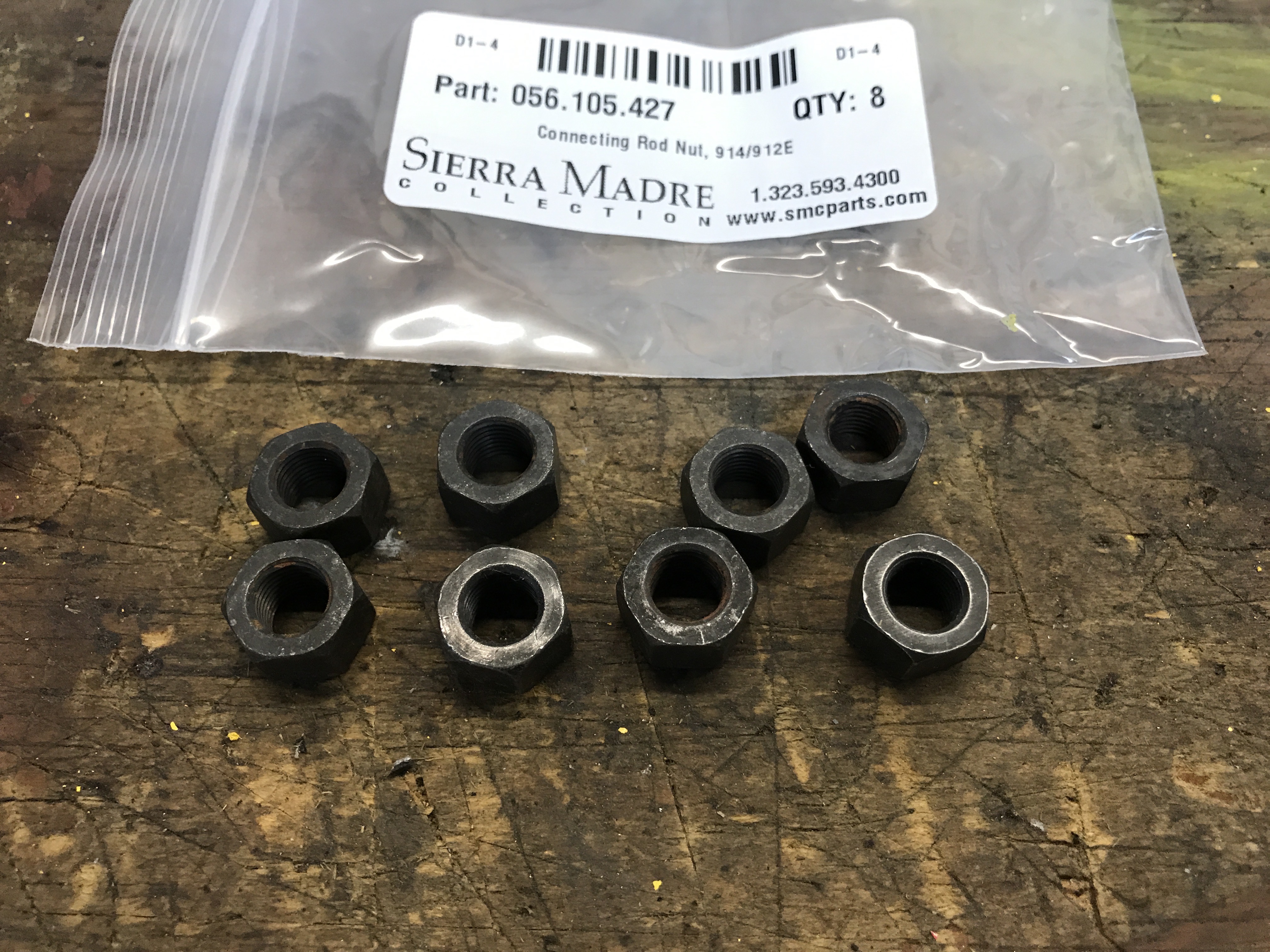

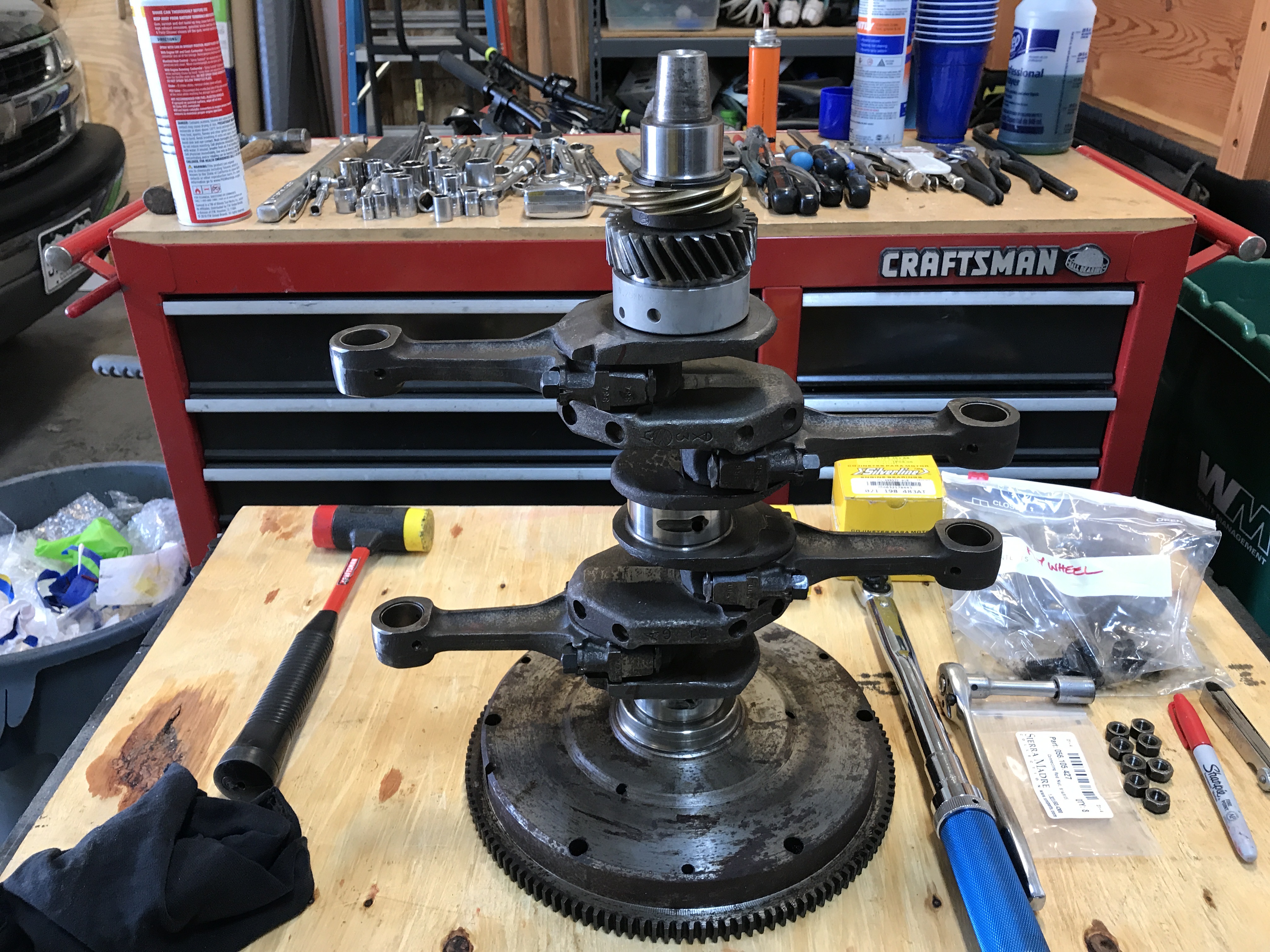

I also got new con rod nuts.
bkrantz
post Apr 29 2021, 08:40 PM
Post #2658
Posts: 8,531
Joined: 3-August 19
From: SW Colorado
Member No.: 23,343
So I could finally get back to engine work, and mount the rods on the crank.

And I had time to finish the paint in the fender joint.
