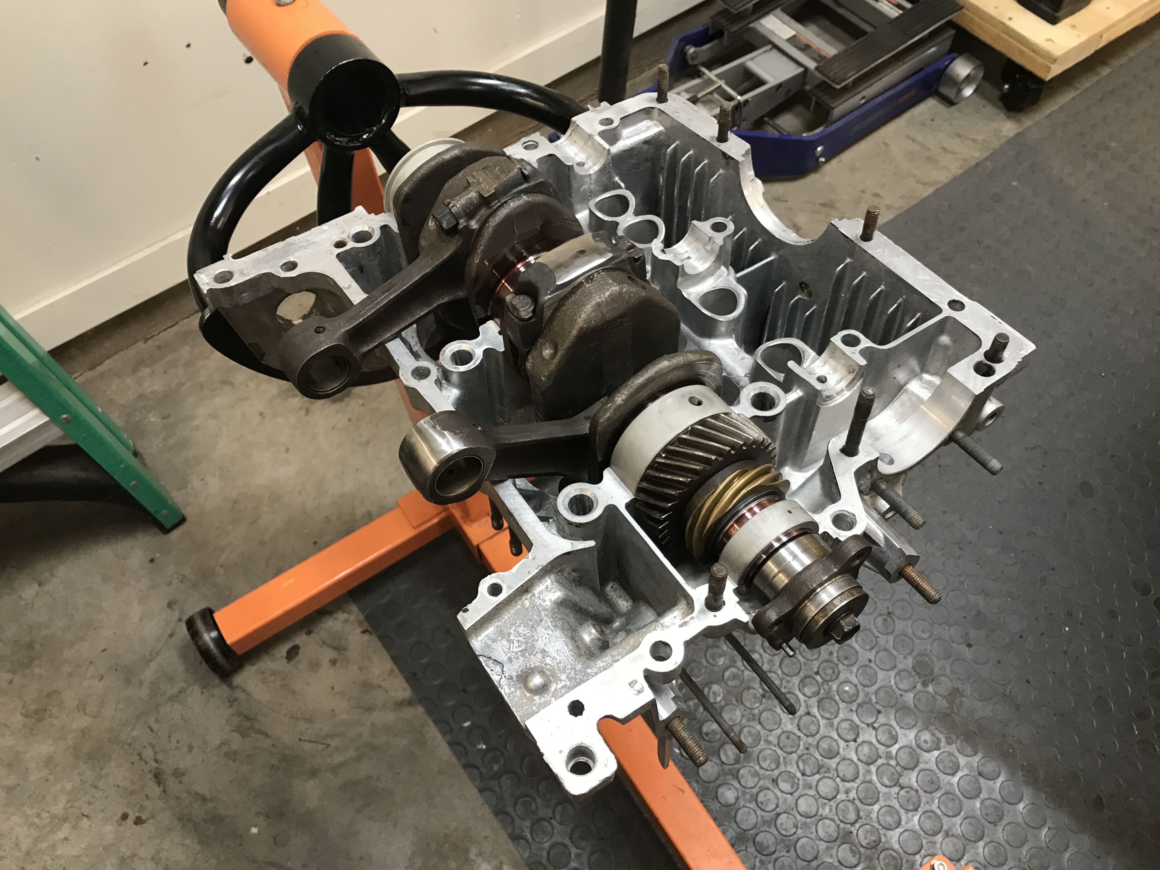

QUOTE(bkrantz @ Apr 29 2021, 10:40 PM) *
So I could finally get back to engine work, and mount the rods on the crank.
Great idea for a crank stand...

bkrantz
post Apr 30 2021, 07:03 PM
Post #2663
Posts: 8,531
Joined: 3-August 19
From: SW Colorado
Member No.: 23,343
QUOTE(iankarr @ Apr 29 2021, 11:38 PM) *
Not my idea, but it works!

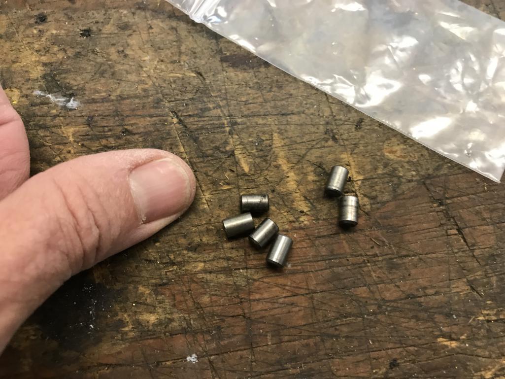

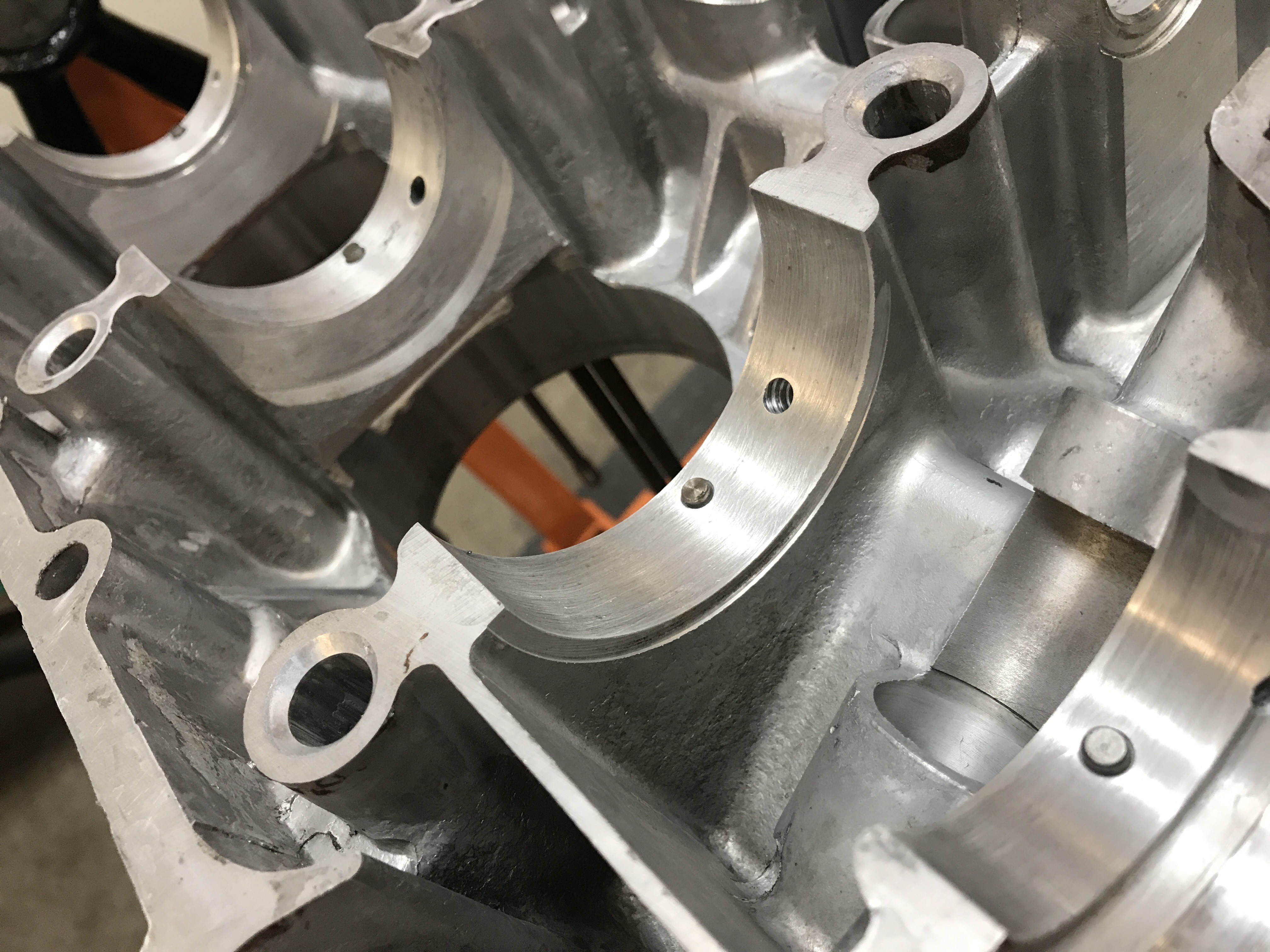

More engine work, starting with the bearing locator pins.
bkrantz
post Apr 30 2021, 07:08 PM
Post #2665
Posts: 8,531
Joined: 3-August 19
From: SW Colorado
Member No.: 23,343

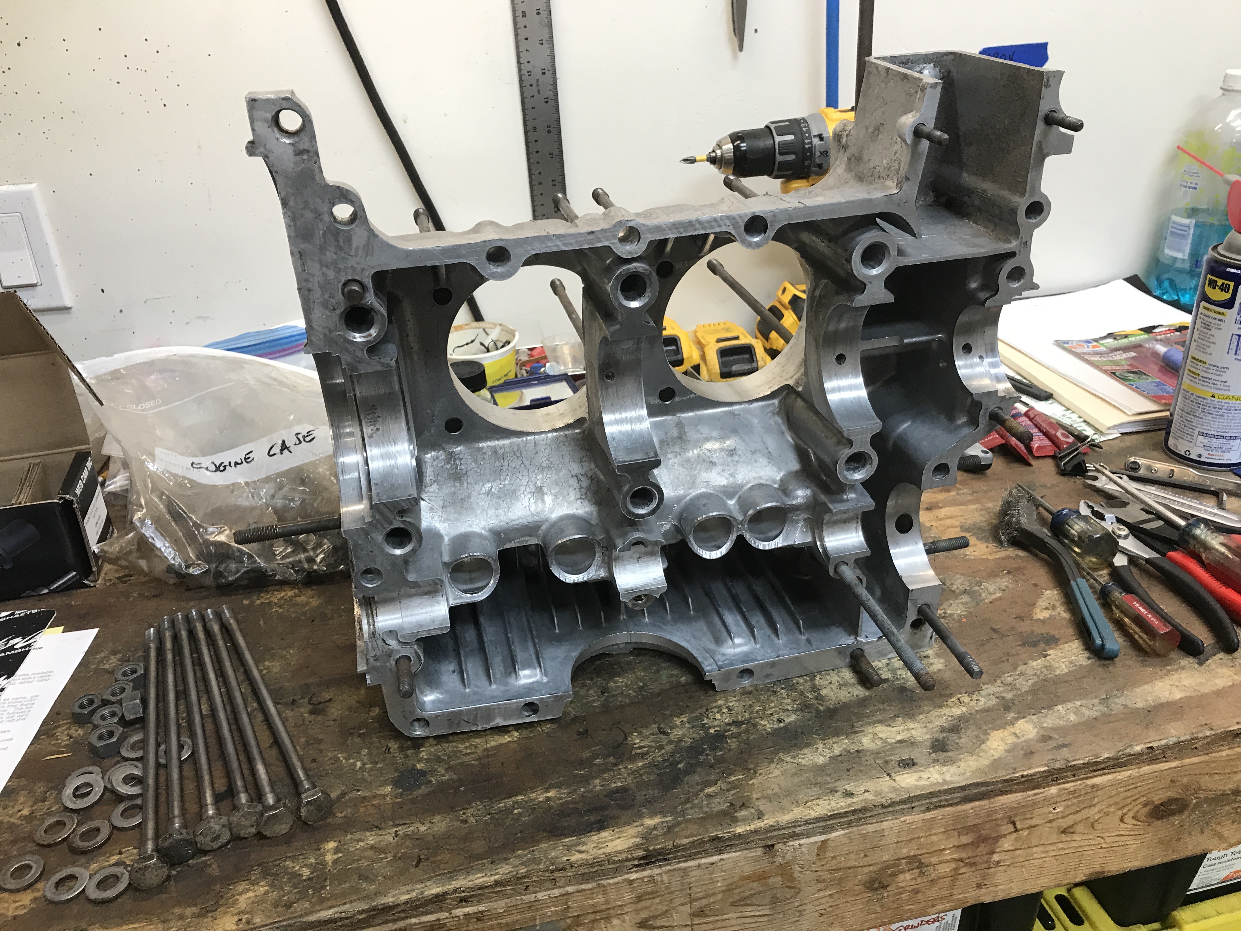

4 pins in the saddles on the right case half.
bkrantz
post Apr 30 2021, 07:09 PM
Post #2666
Posts: 8,531
Joined: 3-August 19
From: SW Colorado
Member No.: 23,343

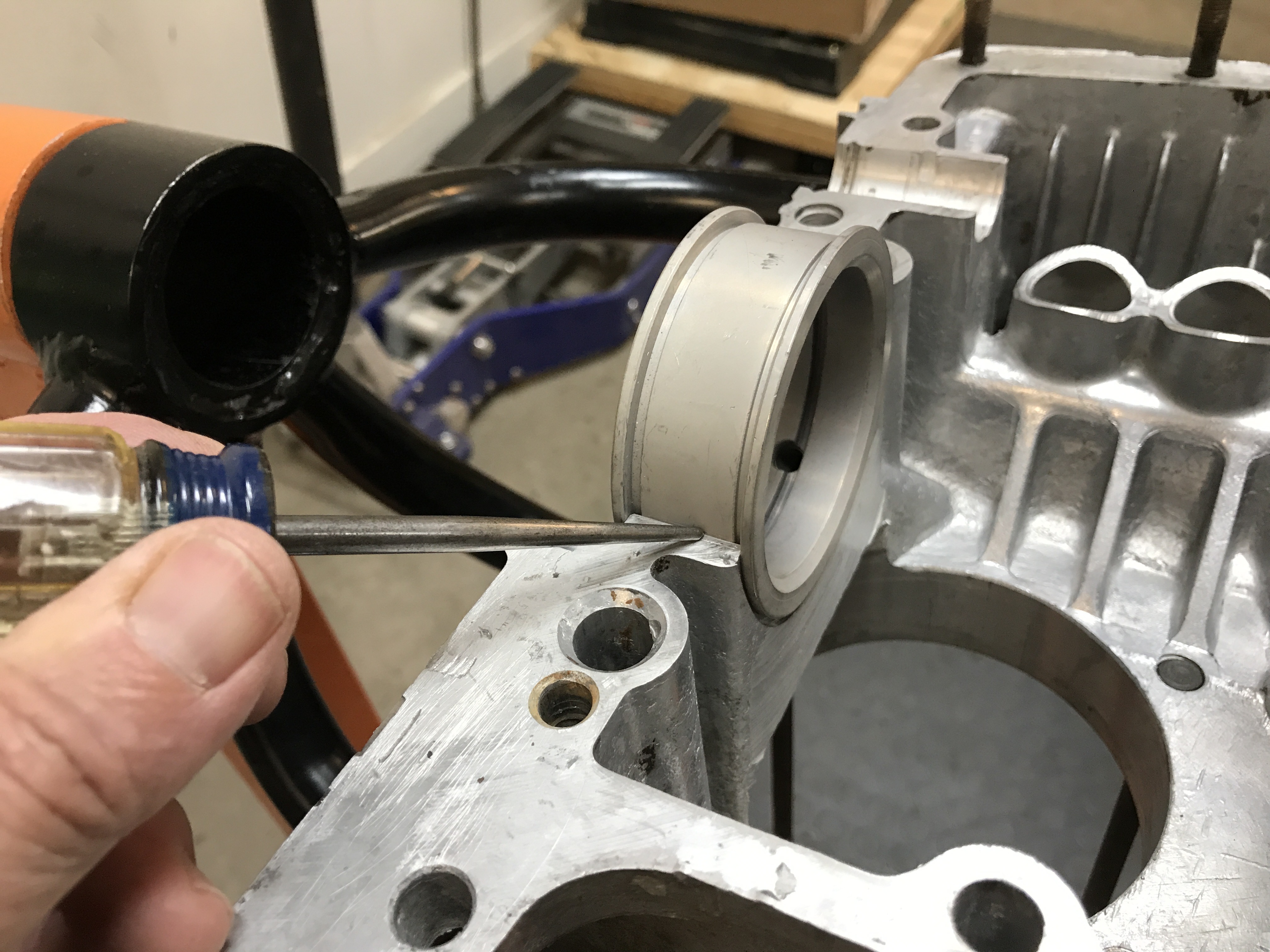

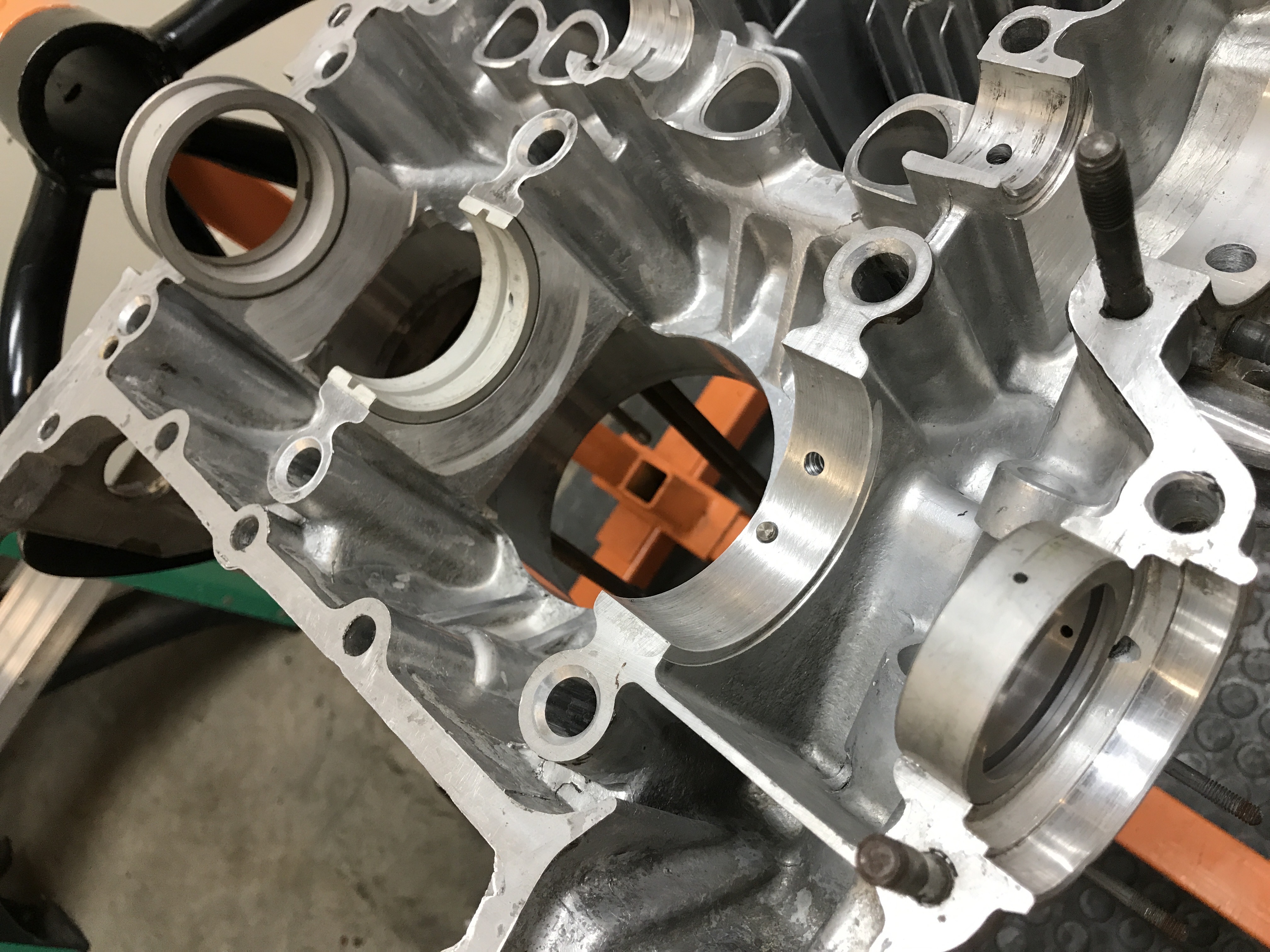

And then test-fit the bearings.
bkrantz
post Apr 30 2021, 07:10 PM
Post #2667
Posts: 8,531
Joined: 3-August 19
From: SW Colorado
Member No.: 23,343

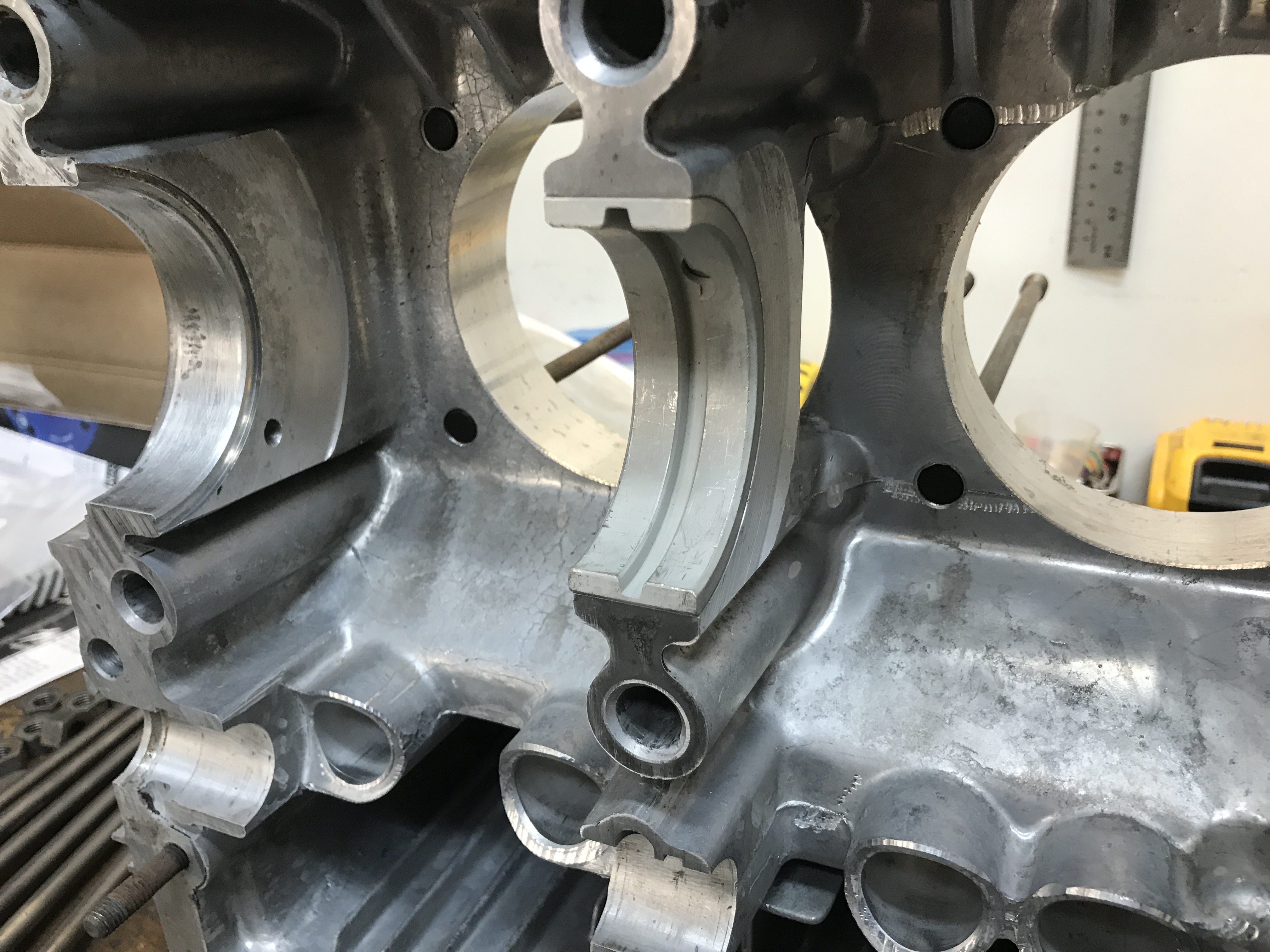

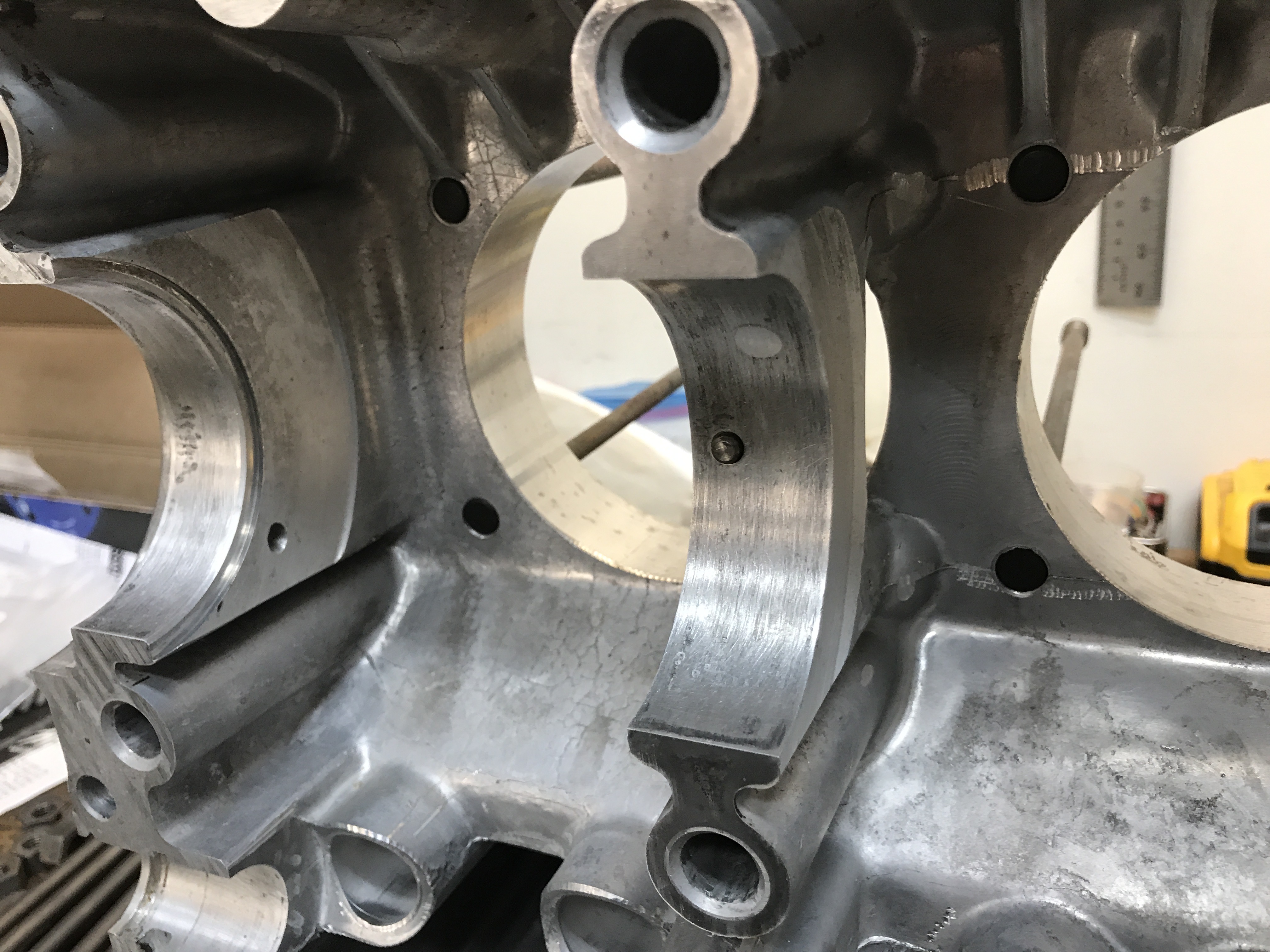

While in place, I scribed the bearings to help get them aligned when installing the crank.
bkrantz
post Apr 30 2021, 07:11 PM
Post #2668
Posts: 8,531
Joined: 3-August 19
From: SW Colorado
Member No.: 23,343
Scribe marks on bearings 1 and 4.

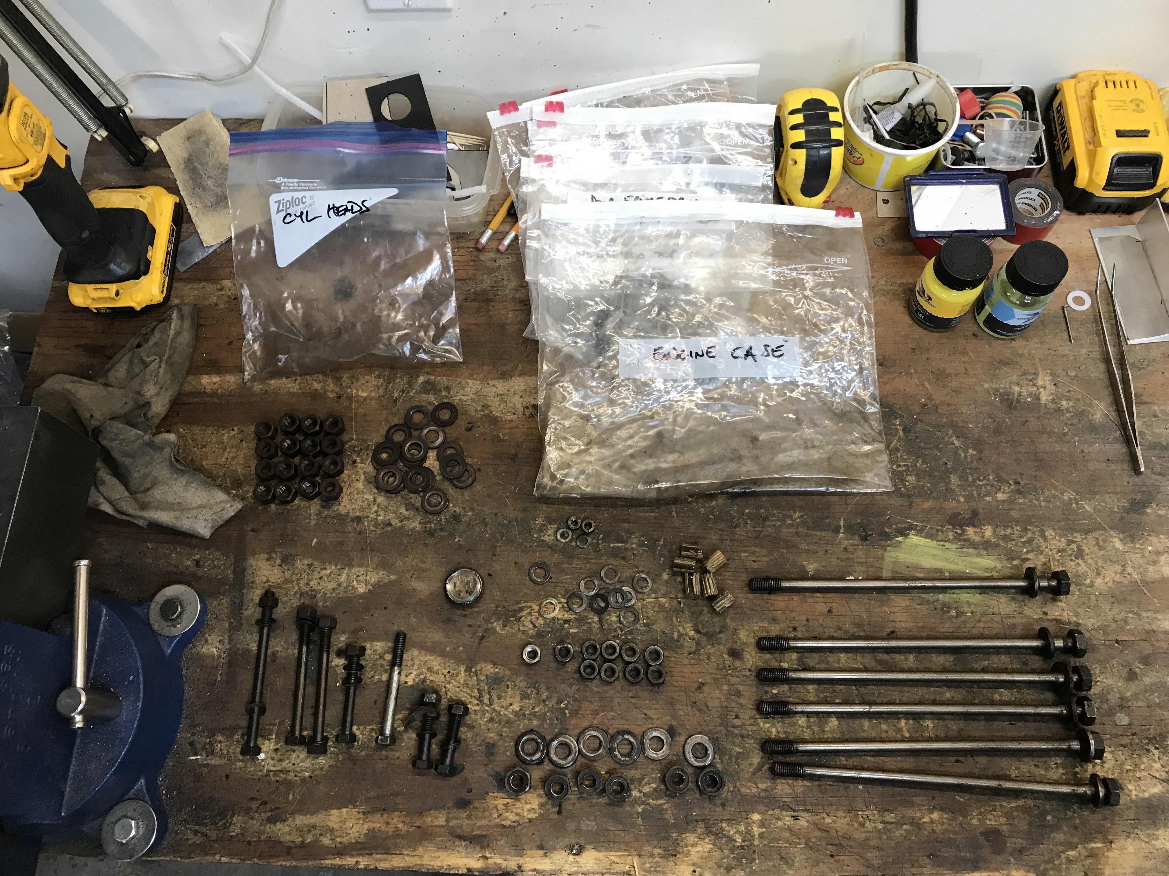

I then got out the bags of hardware for the engine case and heads. Time to get busy cleaning and inspecting.

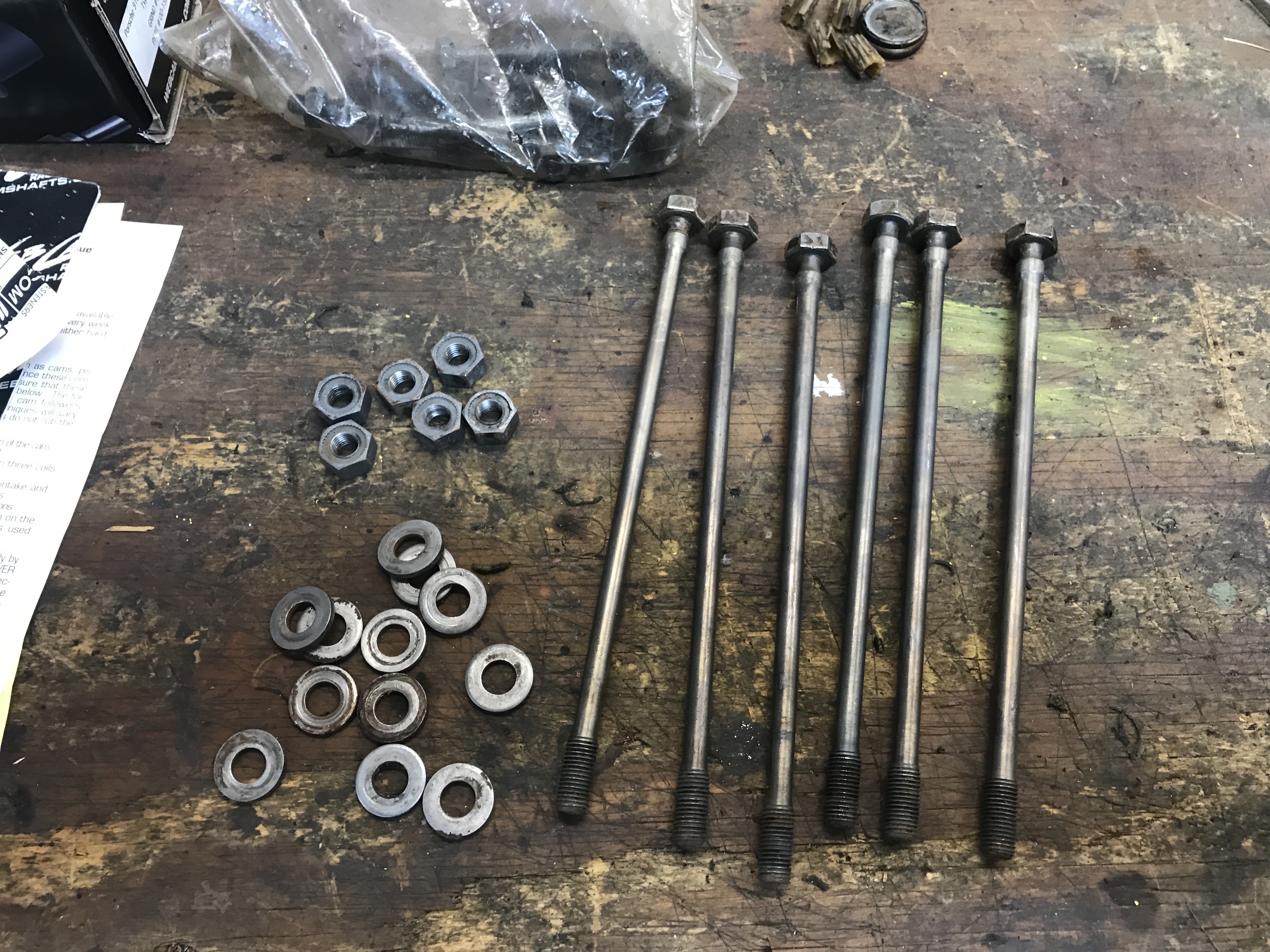

Member No.: 23,343
Engine case bolts after cleaning and de-rusting.
bkrantz

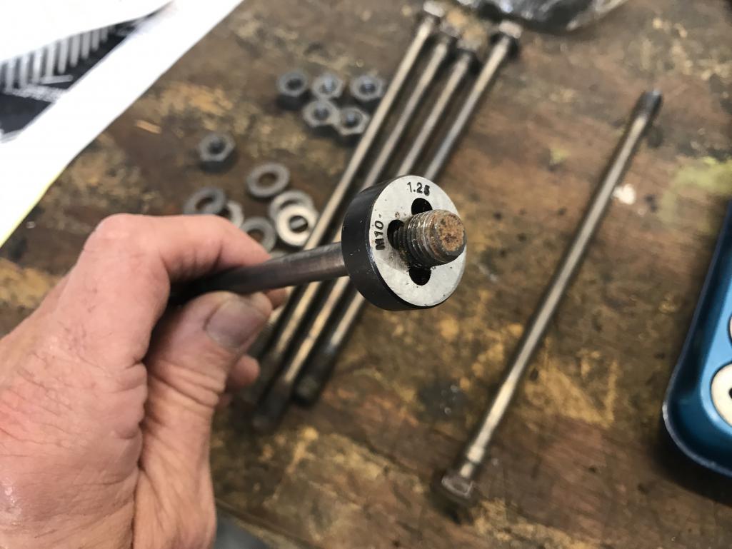

Member No.: 23,343
I chased the threads with a die. Still some crud on the bolt ends.

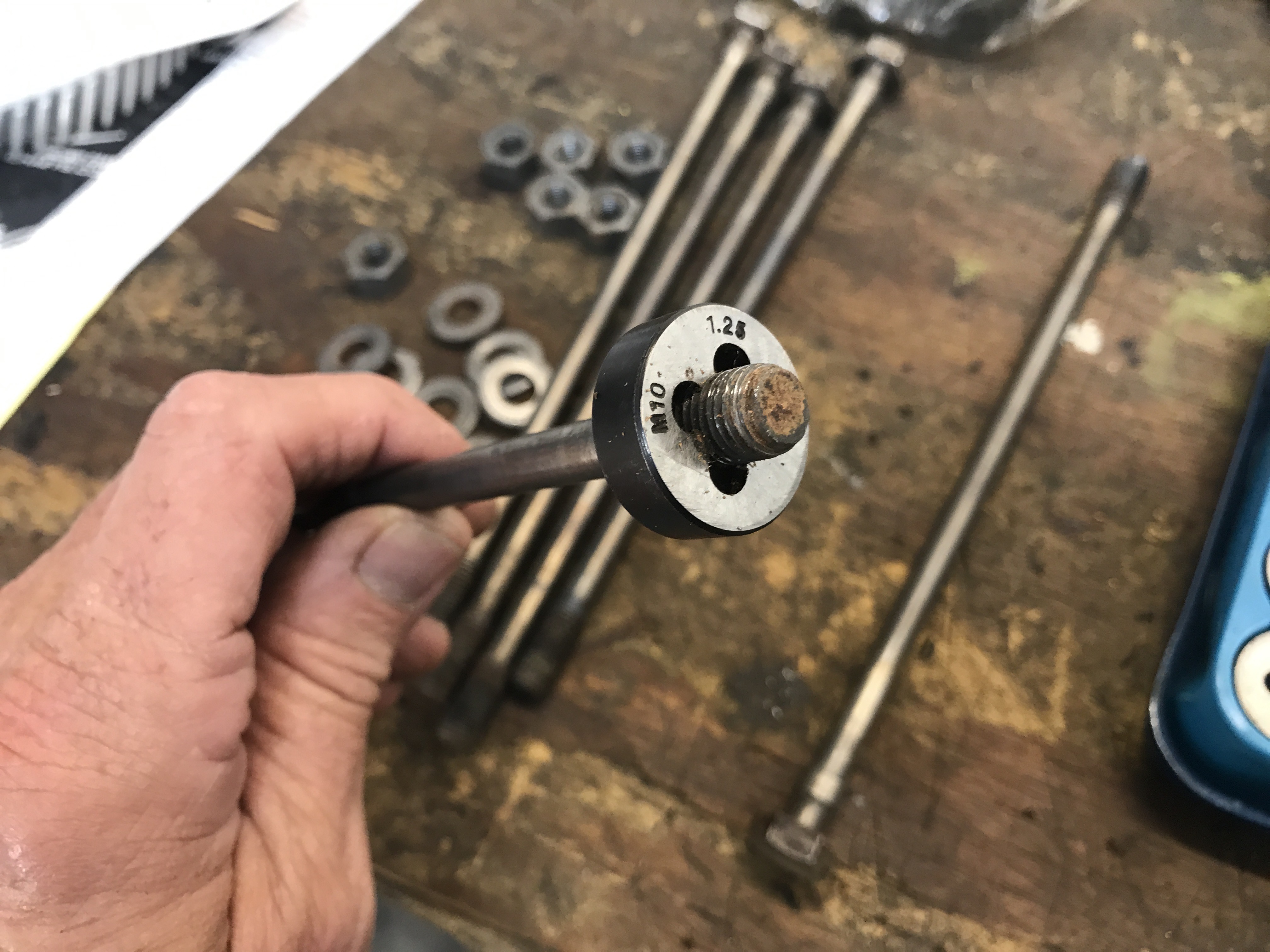

bkrantz
post May 1 2021, 08:08 PM
Post #2672
Posts: 8,531
Joined: 3-August 19
From: SW Colorado
Member No.: 23,343

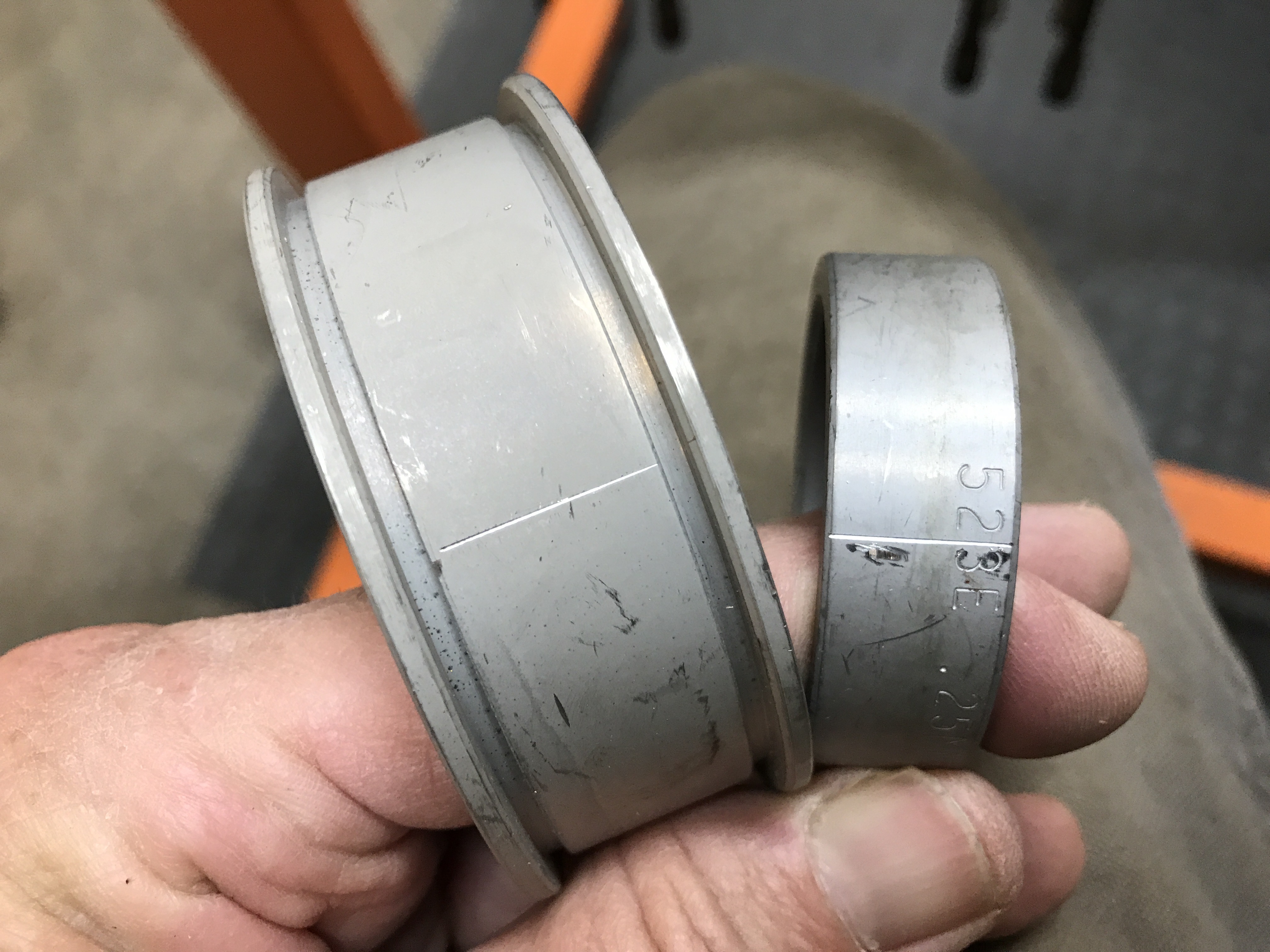

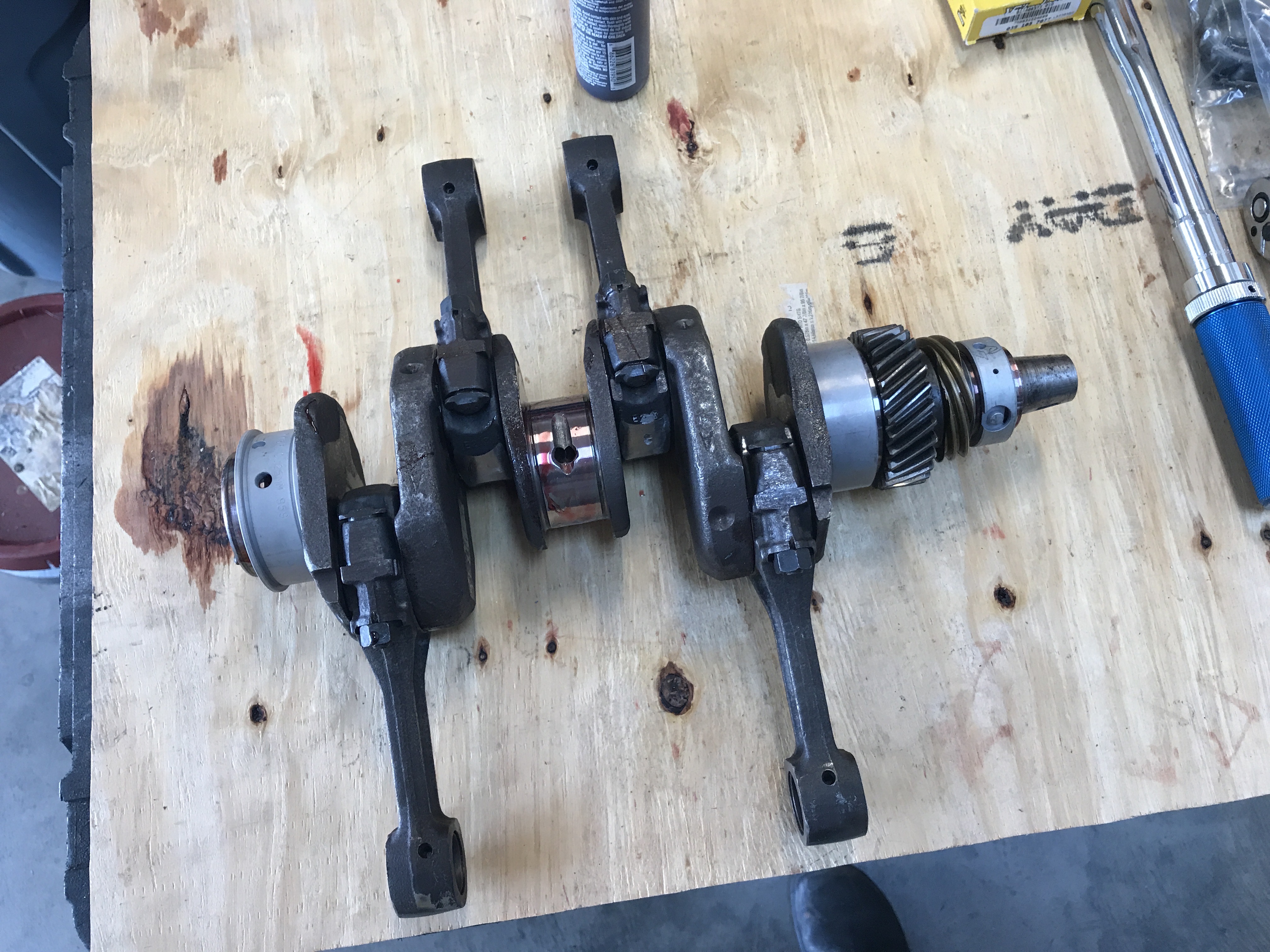

After watching Ian's videos, I decided to test fit the crank in the case.
Here's the crank the numbers 1 and 4 bearings lubed and installed.

Member No.: 23,343

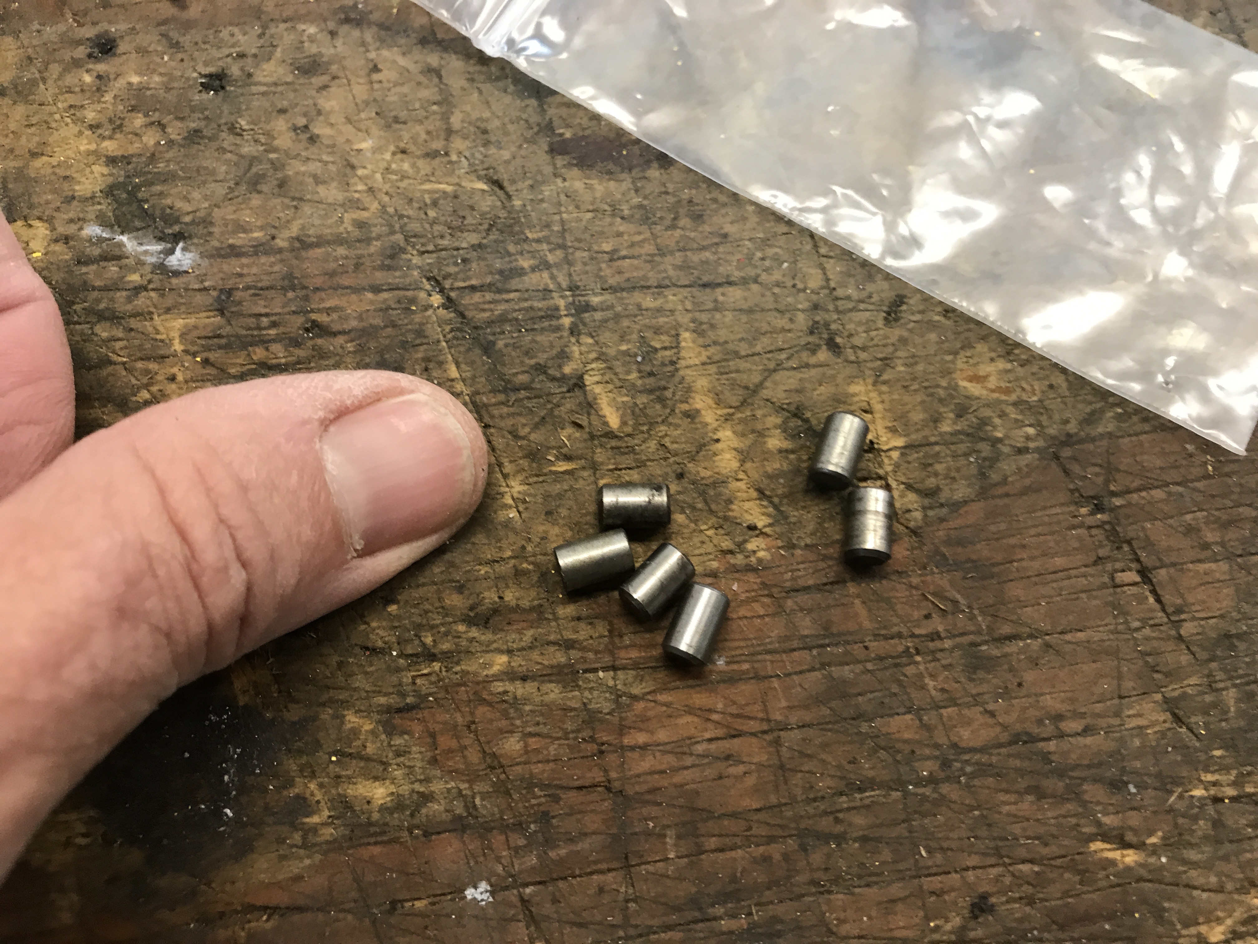

The 5th locator pin in the number 2 bearing saddle.
bkrantz
post May 1 2021, 08:11 PM
Post #2675
Posts: 8,531
Joined: 3-August 19
From: SW Colorado
Member No.: 23,343
And the number 2 bearing half.

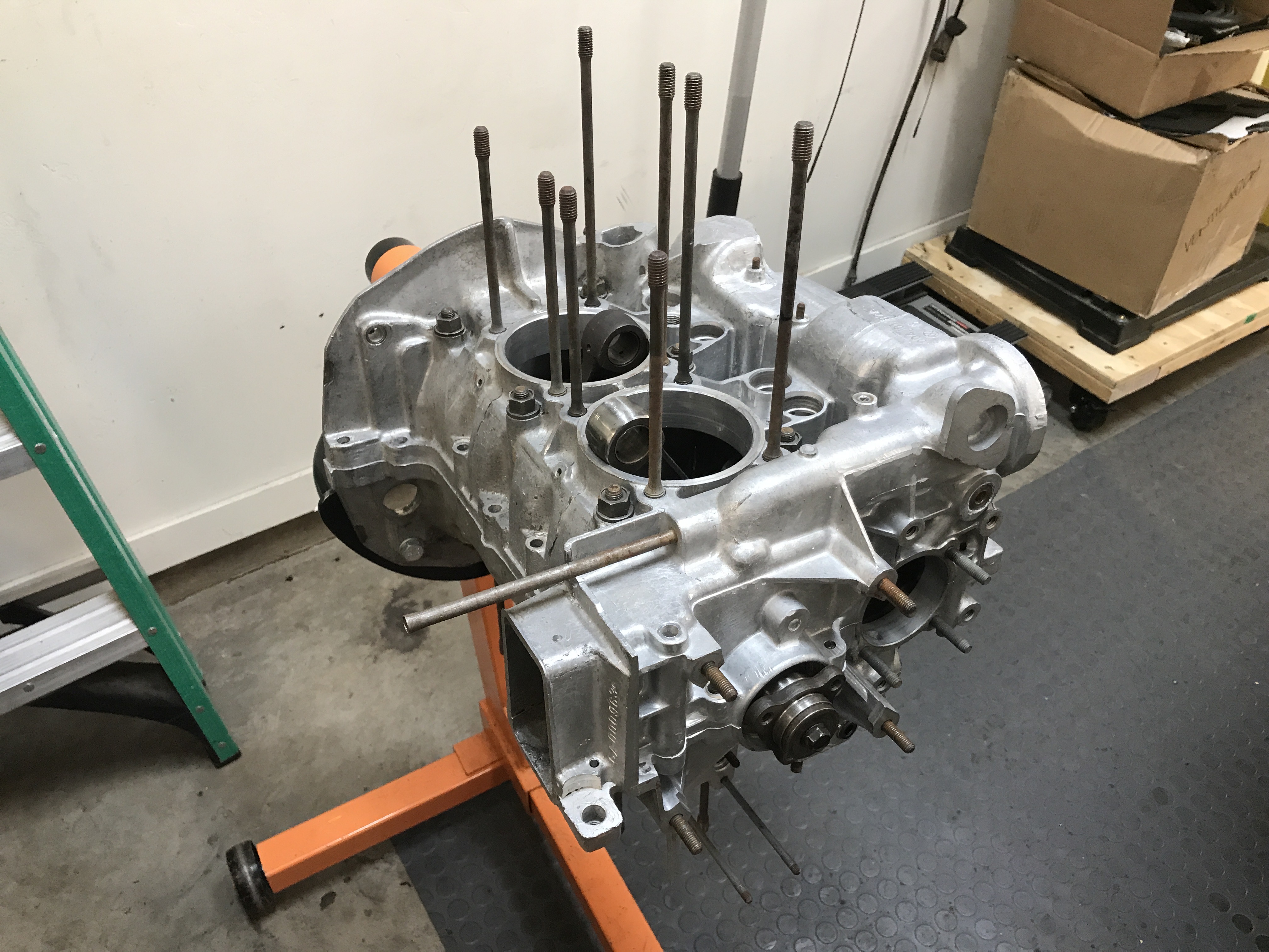

Crank laid into the right case half. No cam installed for this test.
bkrantz
post May 1 2021, 08:14 PM
Post #2677
Posts: 8,531
Joined: 3-August 19
From: SW Colorado
Member No.: 23,343
Left case half installed, and the case through-bolts moderately tightened.
And...the crank spins smoothly. Now I can put it together for real.

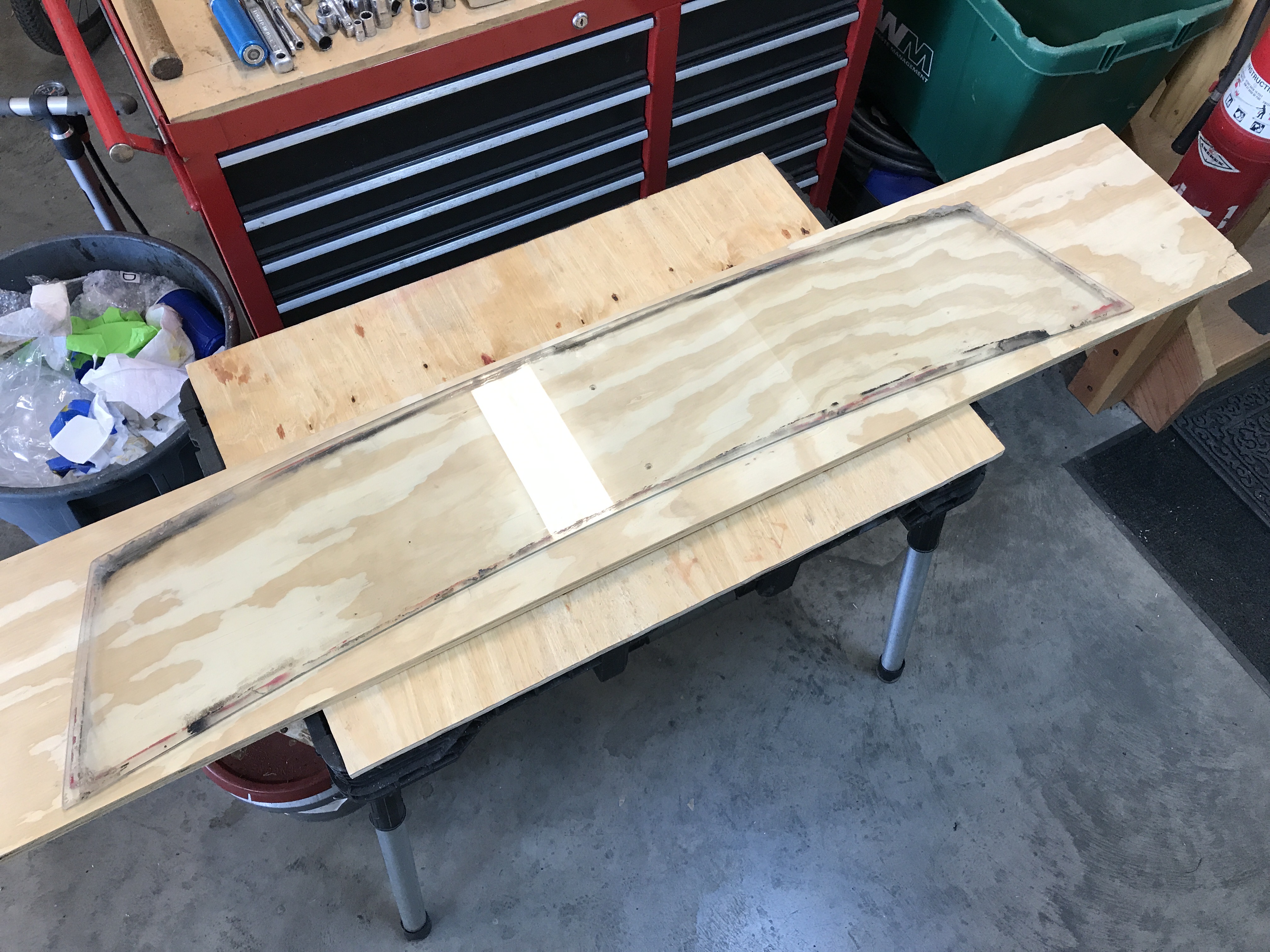

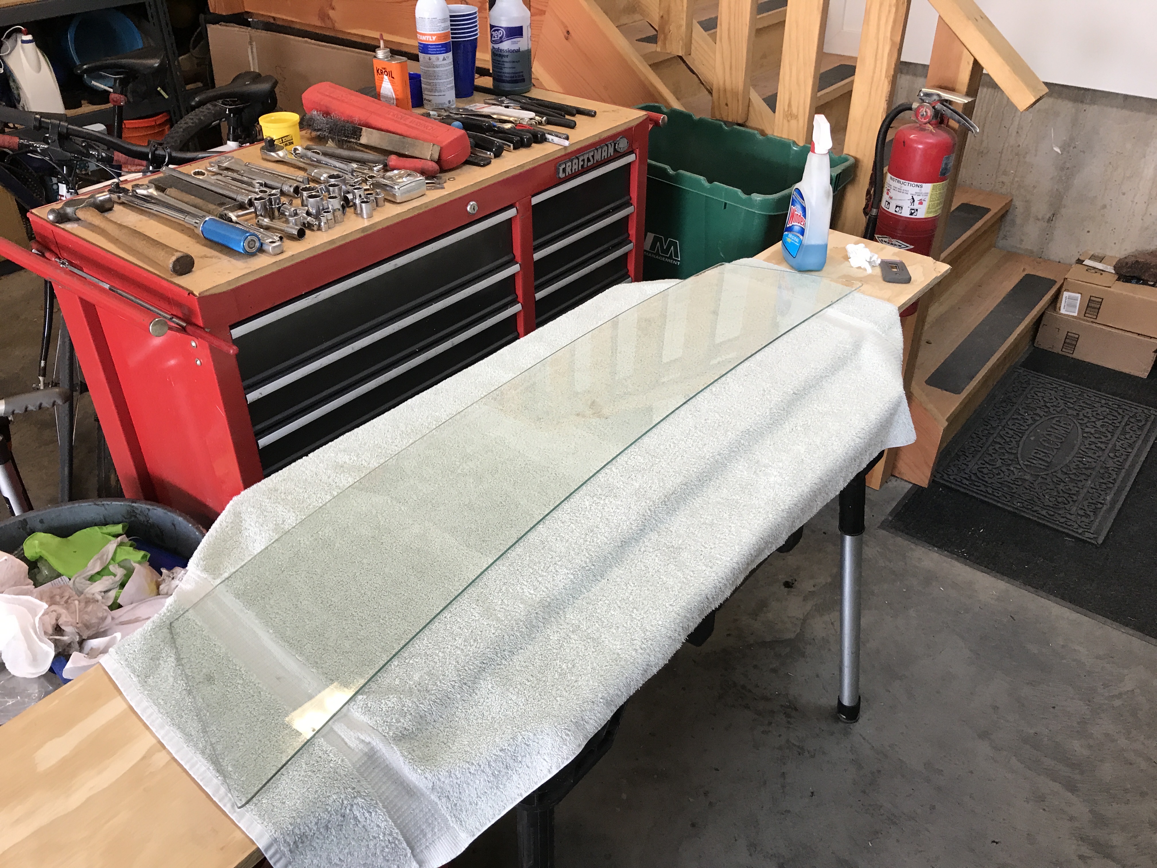

I decided to get the rear window ready to install, so I can get on to more interior stuff.
Another milestone, since this is the first piece of glass I pulled out of storage. But the rear window looks pretty gunky.
bkrantz
post May 2 2021, 08:21 PM
Post #2679
Posts: 8,531
Joined: 3-August 19
From: SW Colorado

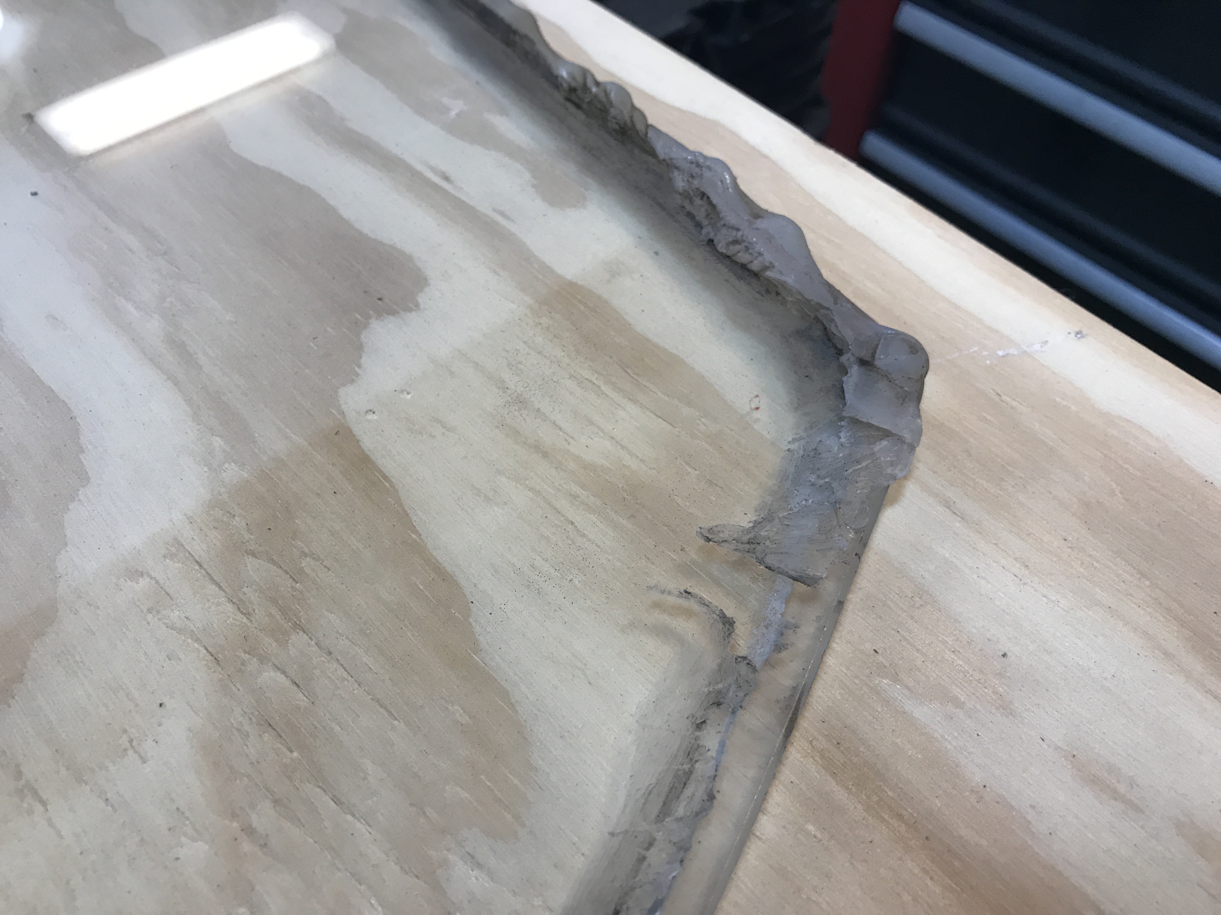

Member No.: 23,343
The PO sure believed in silicone. This is from the inside! The outside had a good portion of overspray.
bkrantz
post May 2 2021, 08:24 PM
Post #2680
Posts: 8,531
Joined: 3-August 19
From: SW Colorado
Member No.: 23,343
After scraping, solvent, and windex, the window looks pretty good and ready to install.
