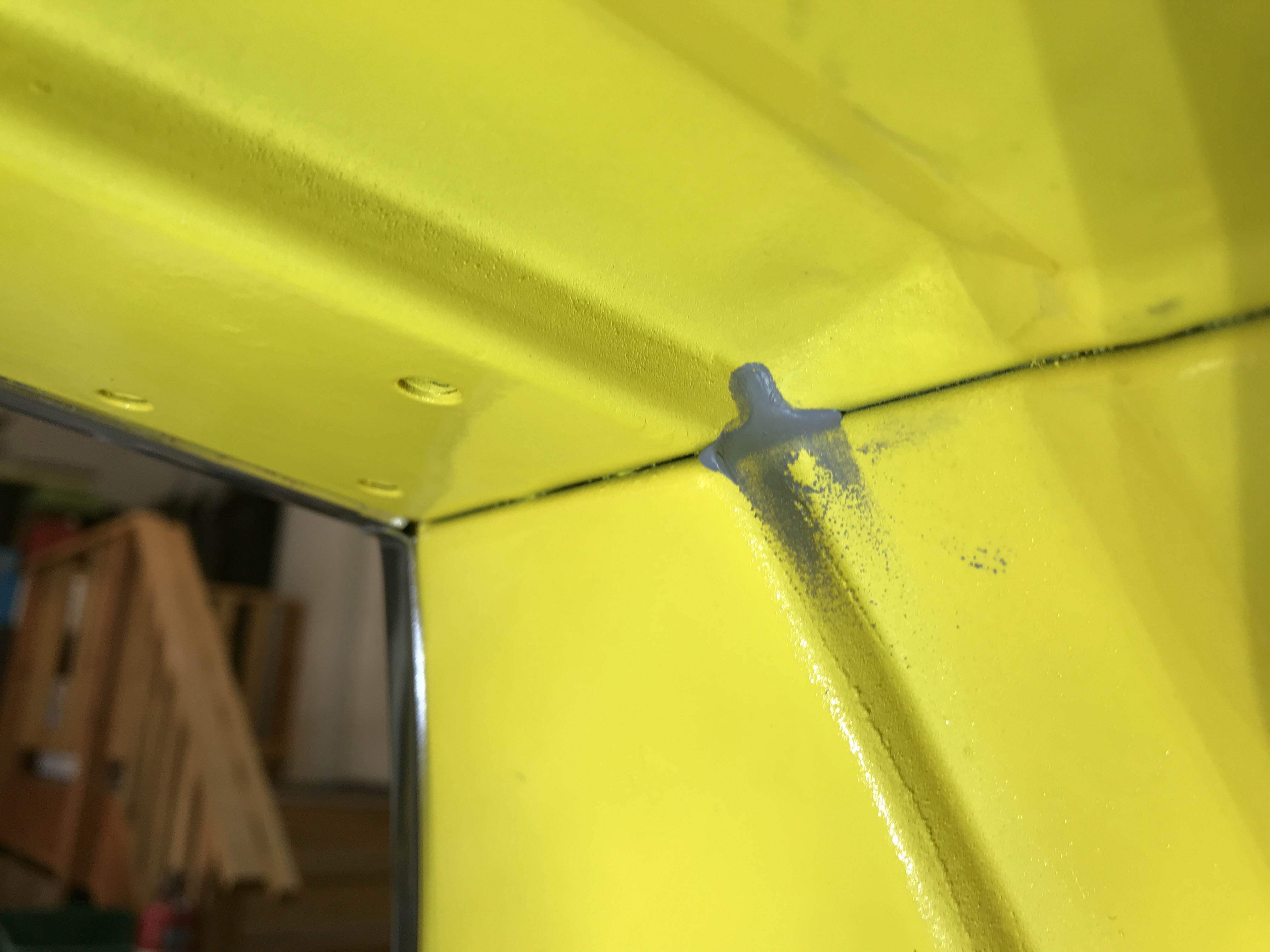

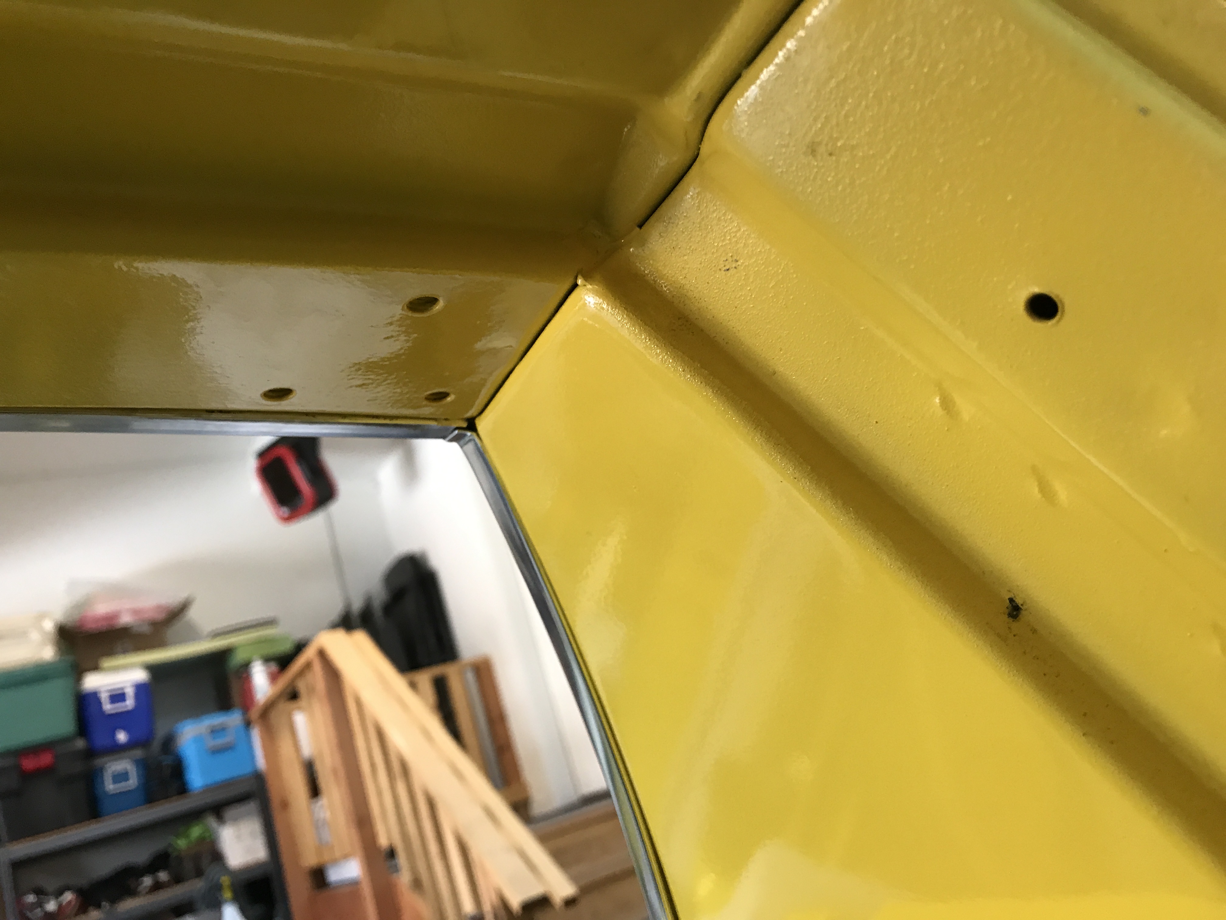

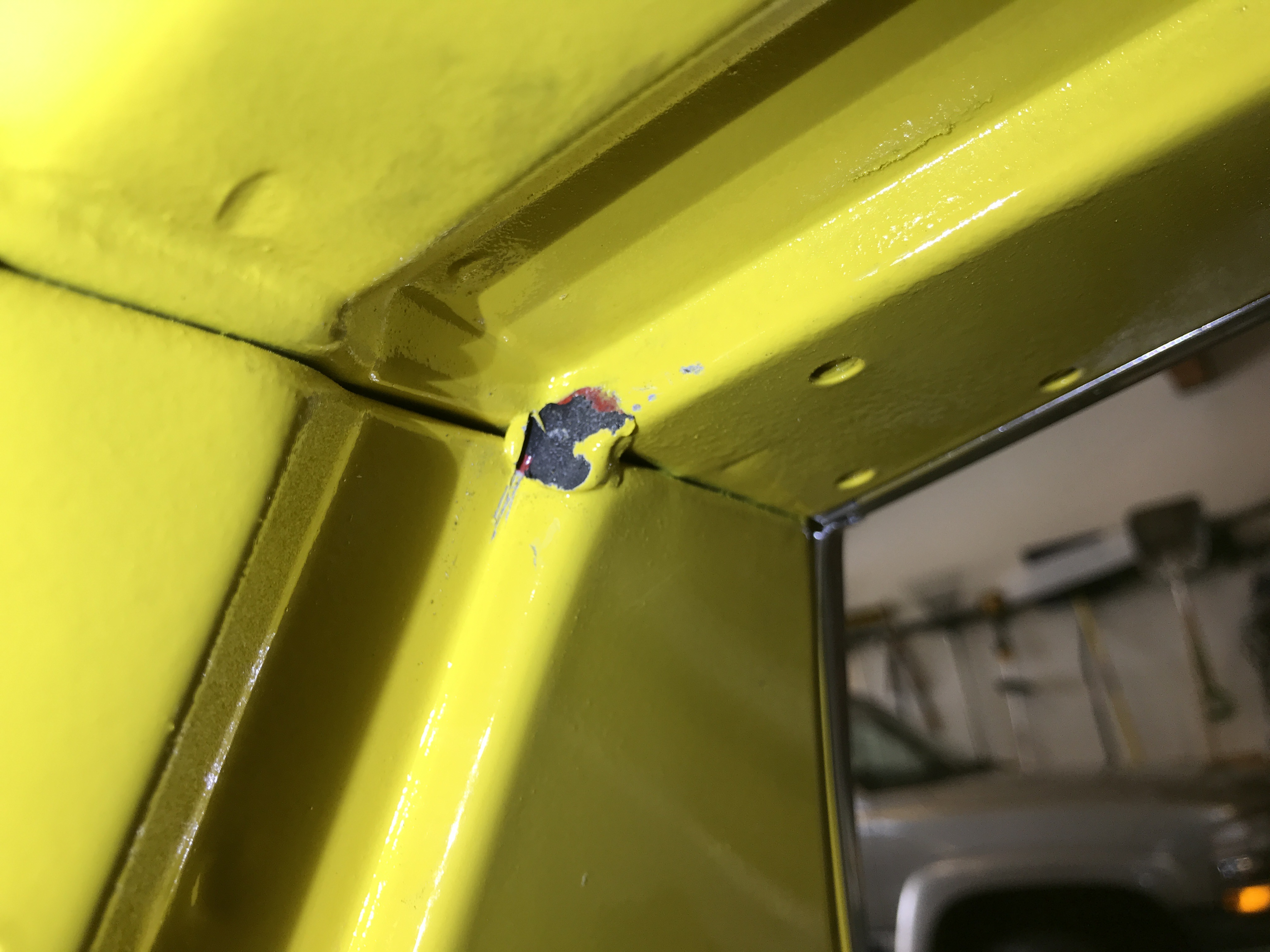

But before installing the glass, I needed to prep the targa frame. At some of the corners, the original sealant plugs were present but not even with the metal channels. I shaved these down.
bkrantz
post May 2 2021, 08:27 PM
Post #2682
Posts: 8,531
Joined: 3-August 19
From: SW Colorado
Member No.: 23,343

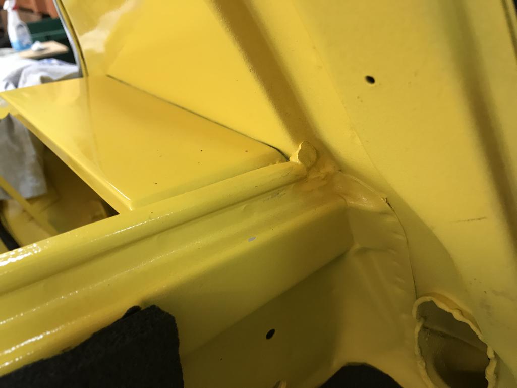

The upper left corner had no sealant.
bkrantz
post May 2 2021, 08:29 PM
Post #2683
Posts: 8,531
Joined: 3-August 19
From: SW Colorado
Member No.: 23,343
So I got out the 3M body sealant and touched up all four corners.
bkrantz
post May 2 2021, 08:30 PM
Post #2684
Posts: 8,531
Joined: 3-August 19
From: SW Colorado
Member No.: 23,343

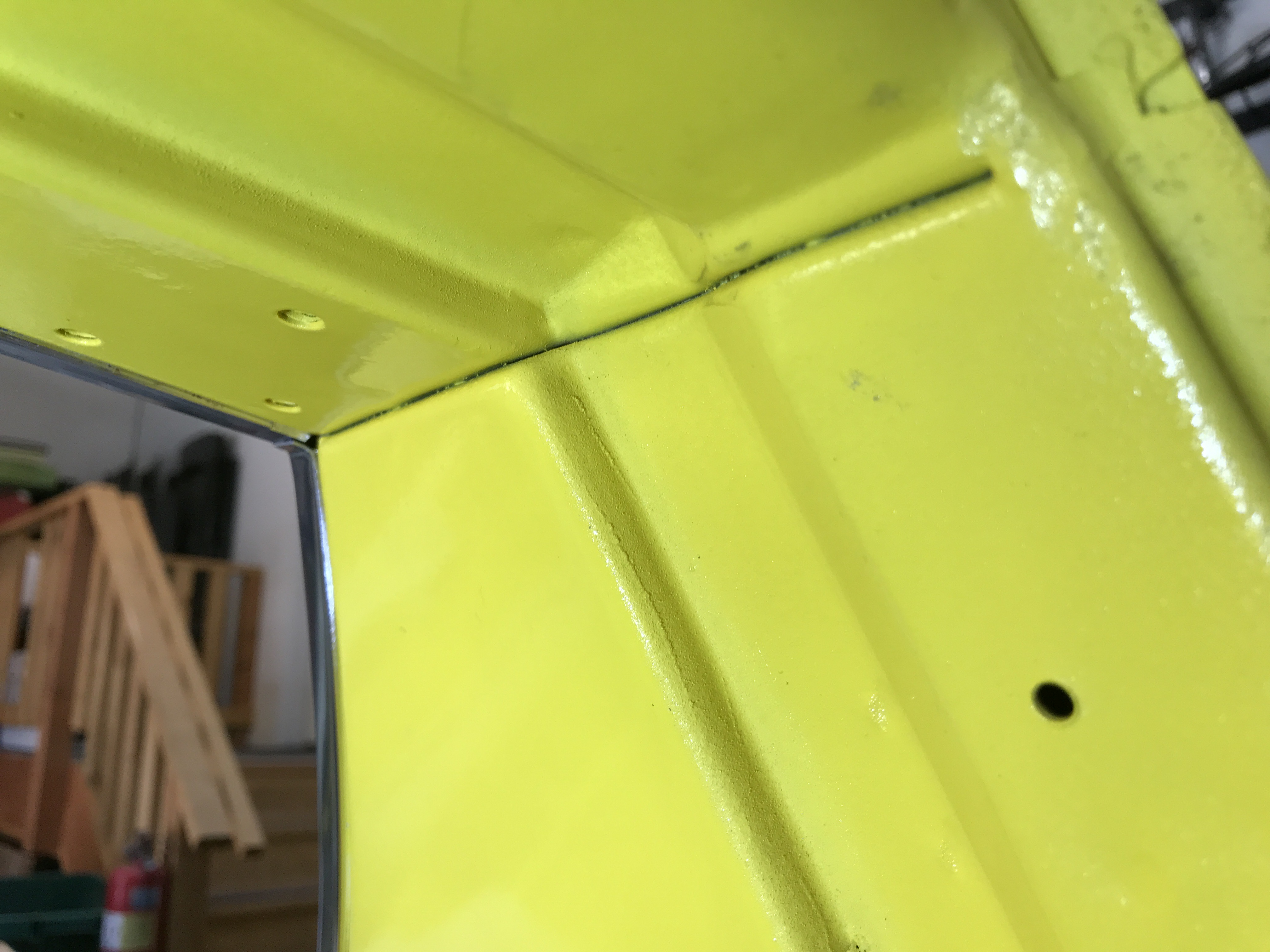

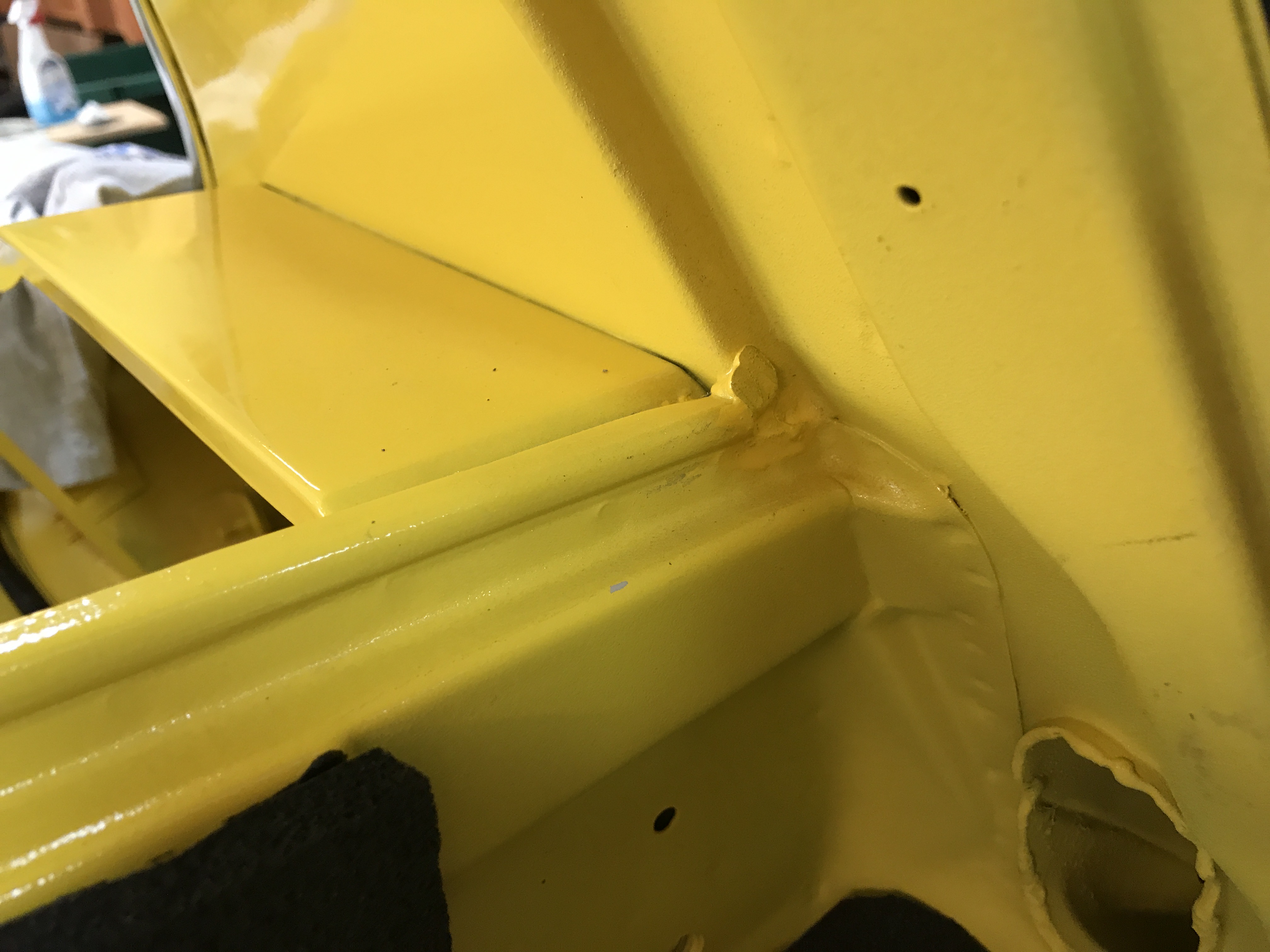

Late in the day, I touched up the corners with paint. Upper left.
bkrantz
post May 2 2021, 08:31 PM
Post #2685
Posts: 8,531
Joined: 3-August 19
From: SW Colorado
Member No.: 23,343
Lower left.

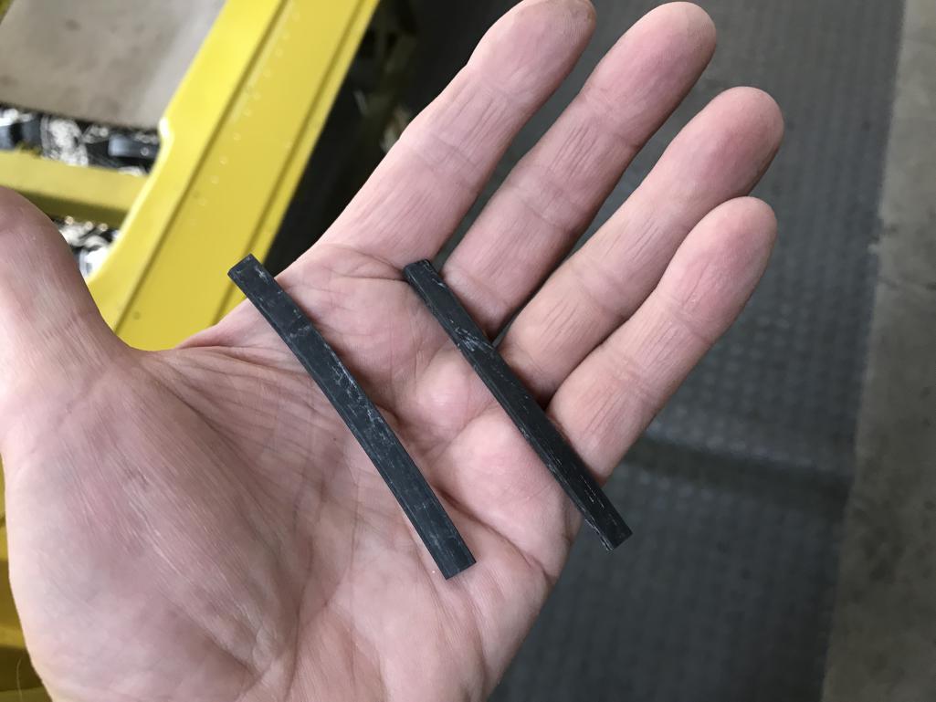

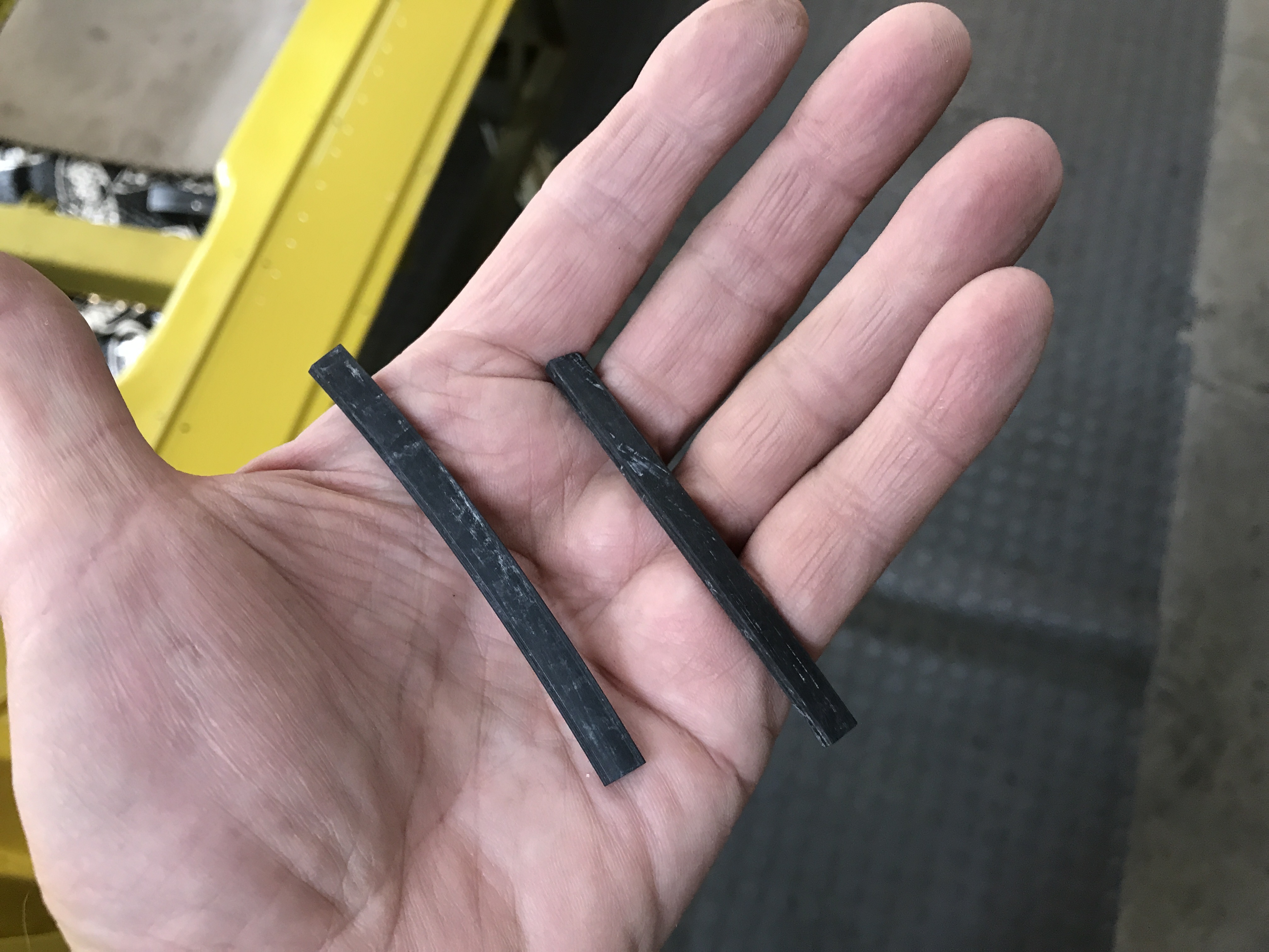

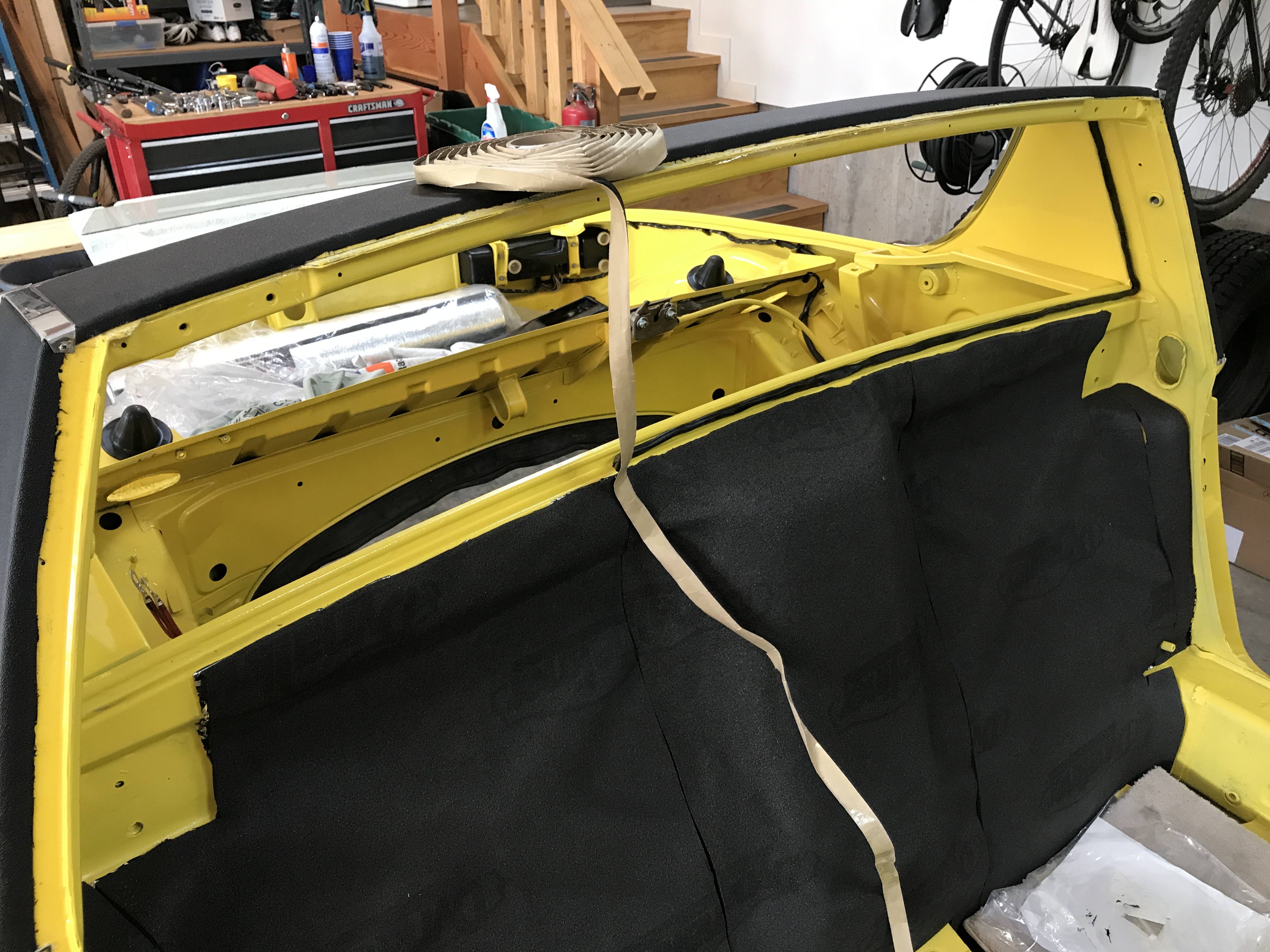

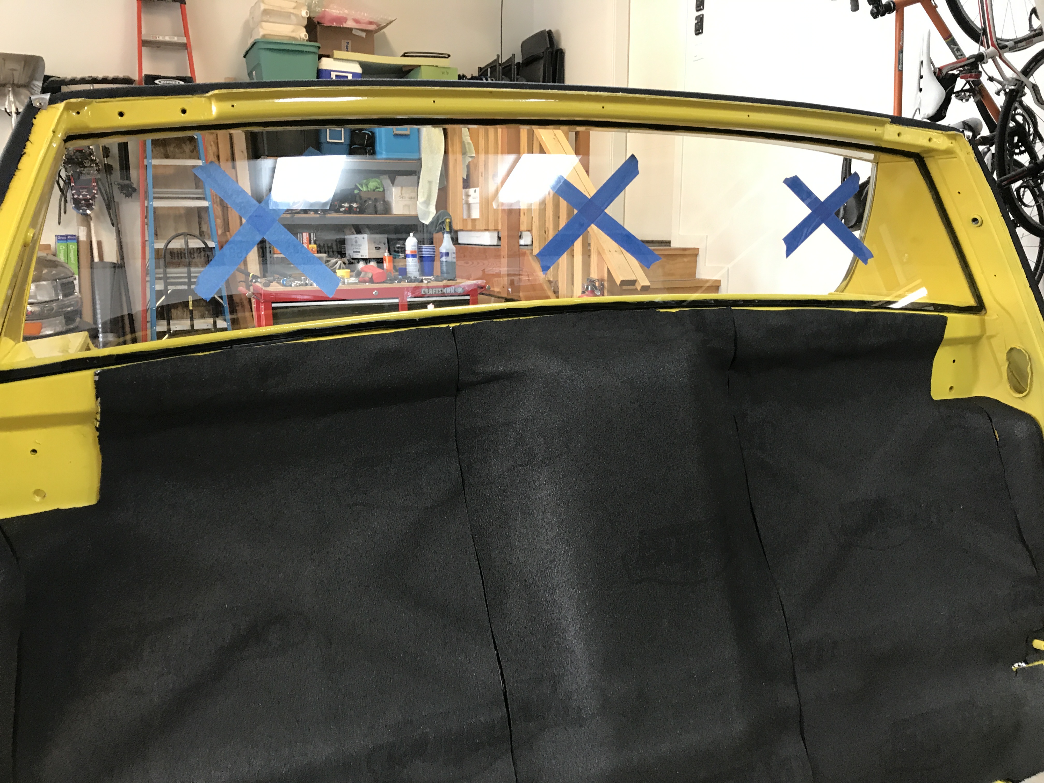

I got busy with the rear window installation. Found the rubber spacers.
bkrantz
post May 3 2021, 07:00 PM
Post #2690
Posts: 8,531
Joined: 3-August 19
From: SW Colorado
Member No.: 23,343

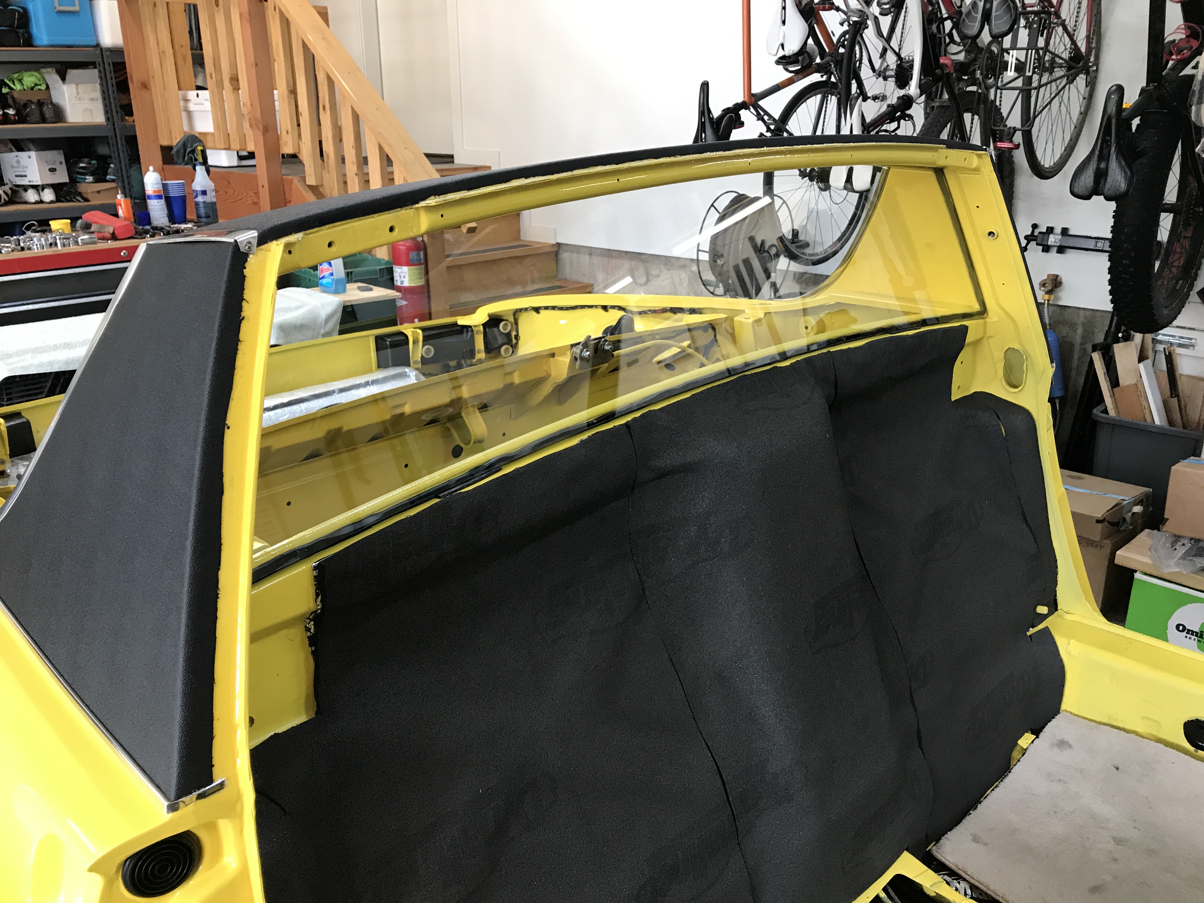

I then ran the butyl strip all the way around, starting from the upper left corner.
NOTE!!! After I got done, I realized that I should have checked the lower edge (top of firewall) for straightness. Mine has some high and low (actually forward and rear) spots that made it impossible to seat the glass evenly.
bkrantz
post May 3 2021, 07:05 PM
Post #2691
Posts: 8,531
Joined: 3-August 19
From: SW Colorado
Member No.: 23,343
Glass installed, and starting the process of squeezing the glass against the butyl.
bkrantz
post May 3 2021, 07:06 PM
Post #2692
Posts: 8,531
Joined: 3-August 19
From: SW Colorado
Member No.: 23,343

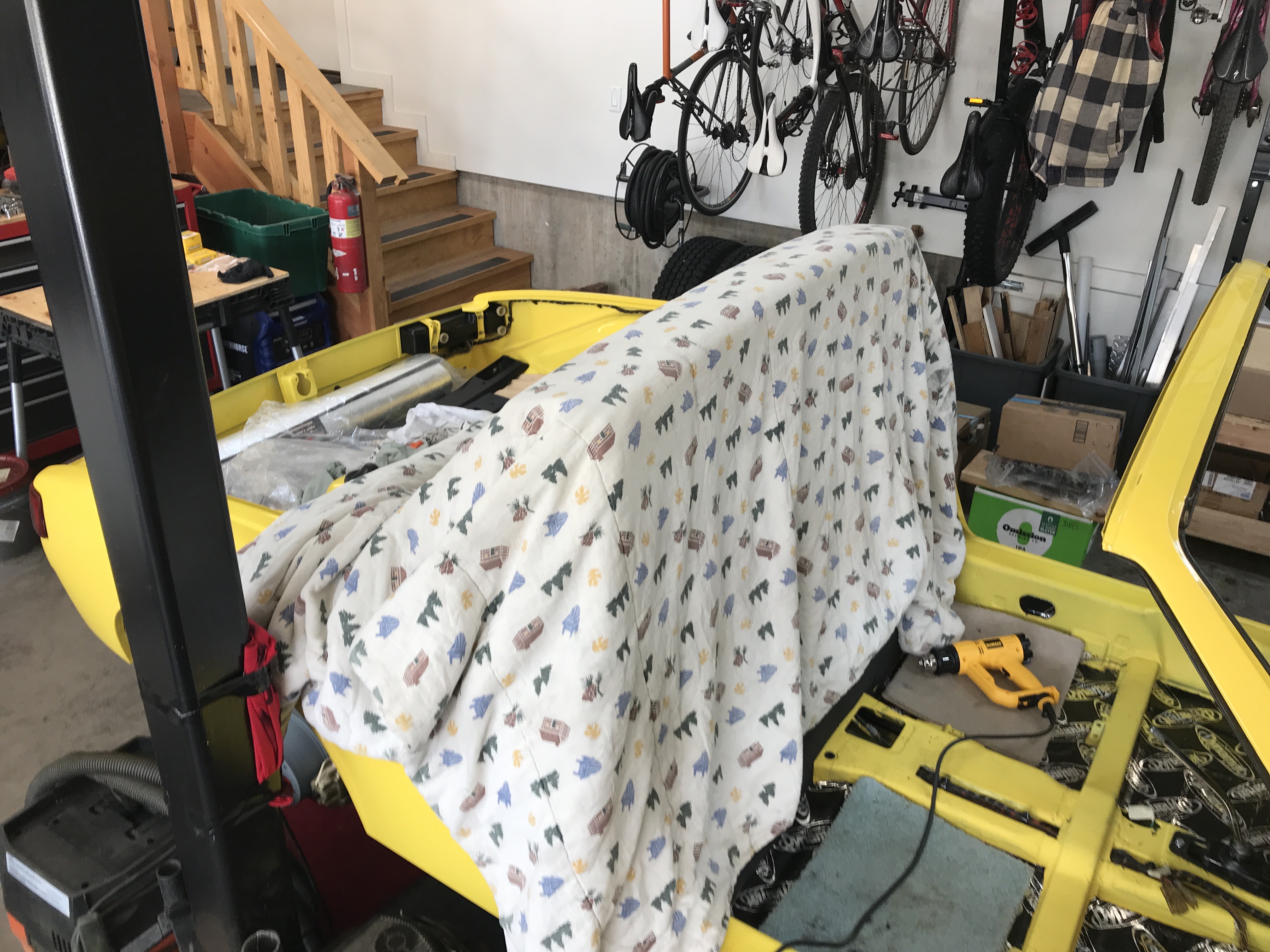

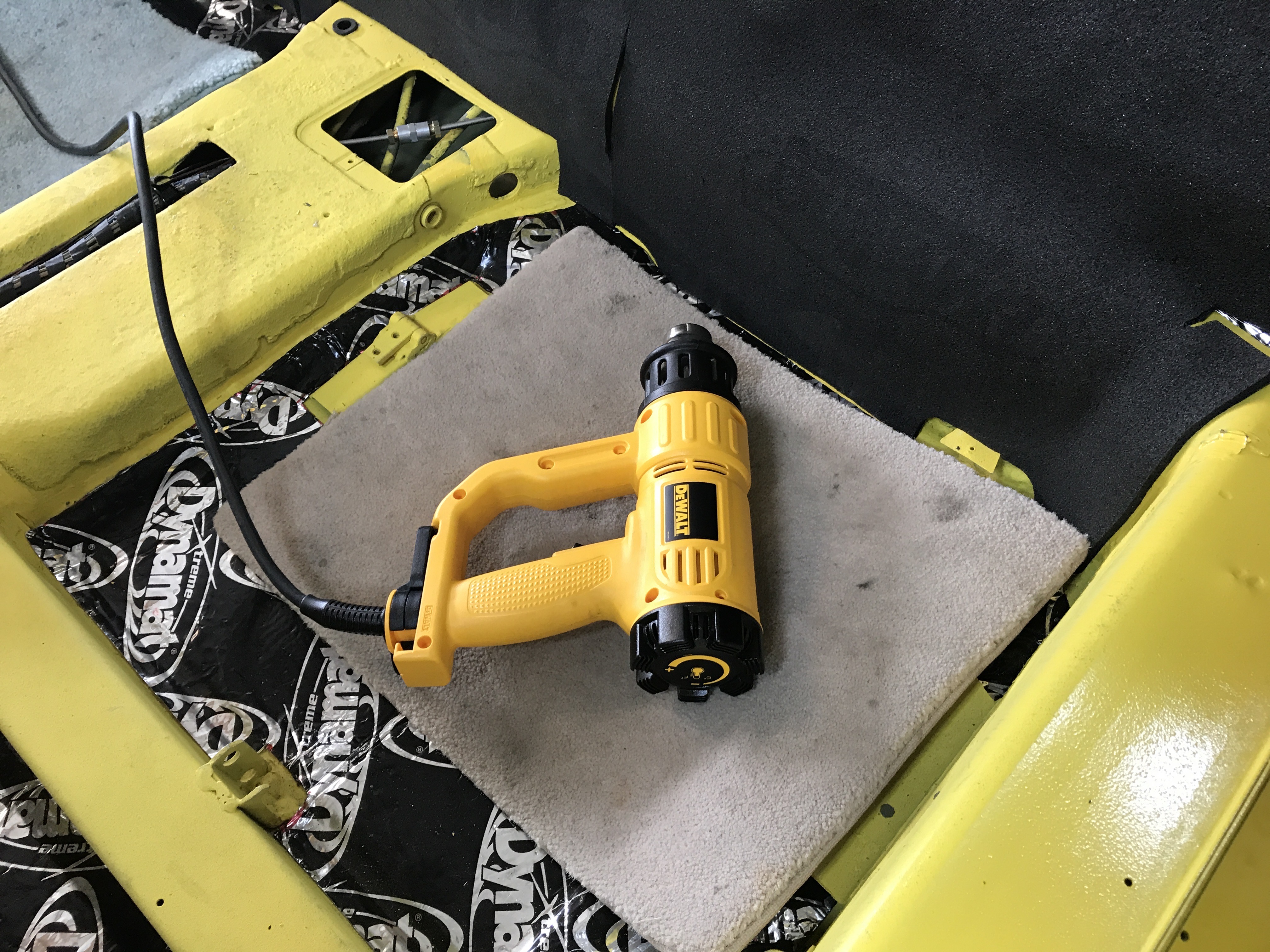

Since my garage was about 55F this morning, I tried warming things up with my heat gun, but that was not enough--without cranking the heat up and risking something bad.
bkrantz
post May 3 2021, 07:08 PM
Post #2693
Posts: 8,531
Joined: 3-August 19
From: SW Colorado
Member No.: 23,343
So instead, I put a portable heater in under the engine compartment and a blanket over the targa bar. I gave it a couple of hours to warm up.
bkrantz
post May 3 2021, 07:11 PM
Post #2694
Posts: 8,531
Joined: 3-August 19
From: SW Colorado
Member No.: 23,343
After that, I was able to squeeze the butyl more and get a better looking seal all around, but I may try for more.
Meanwhile, I added some blue tape to remind me that the glass is there. Otherwise, after more than a year without glass, I might forget and try to put something through the space.

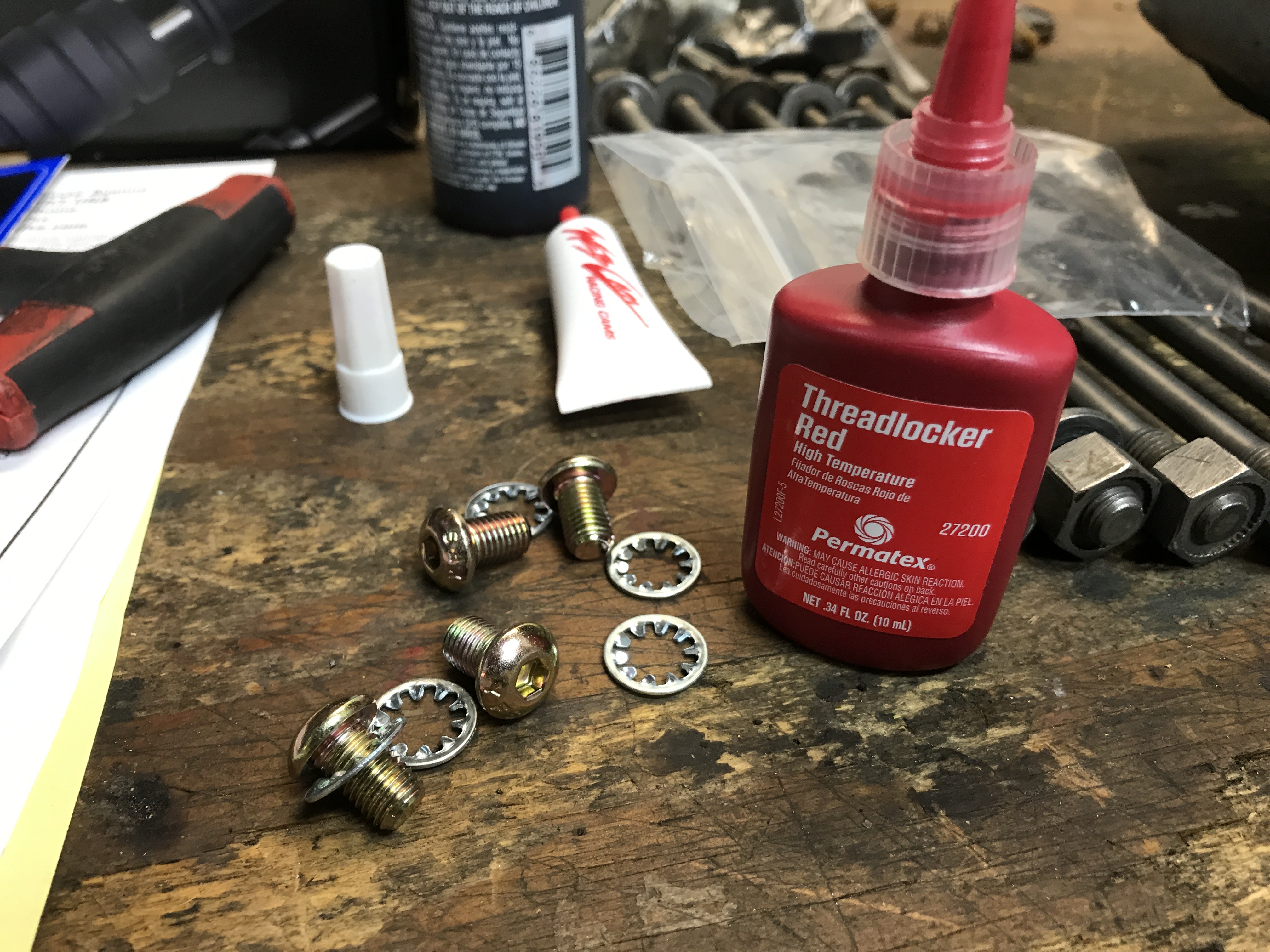

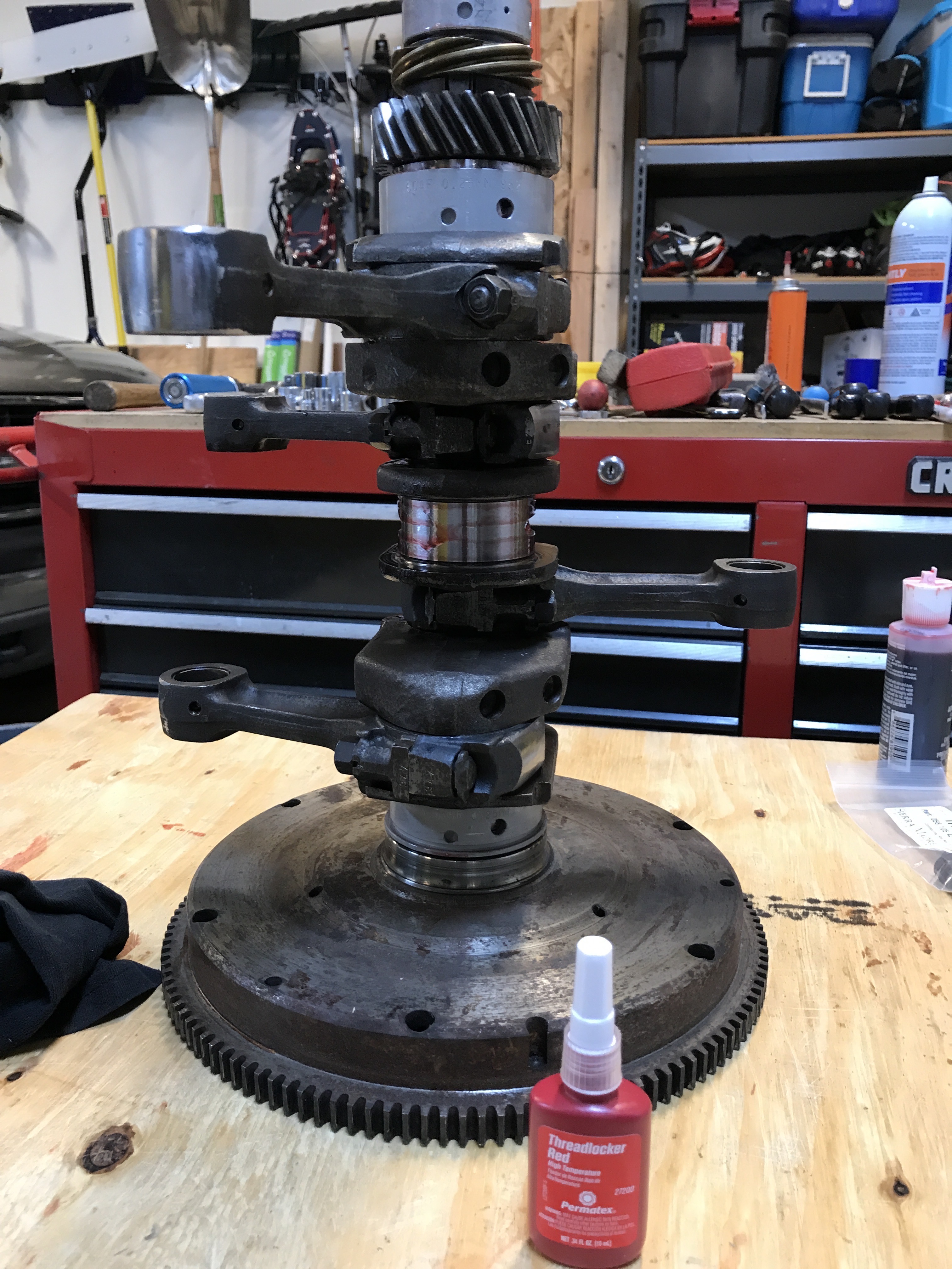

While out today, I picked up some high-temp red thread locker.
bkrantz
post May 3 2021, 07:13 PM
Post #2696
Posts: 8,531
Joined: 3-August 19
From: SW Colorado
Member No.: 23,343
That let me re-install and torque the con rod cap nuts.

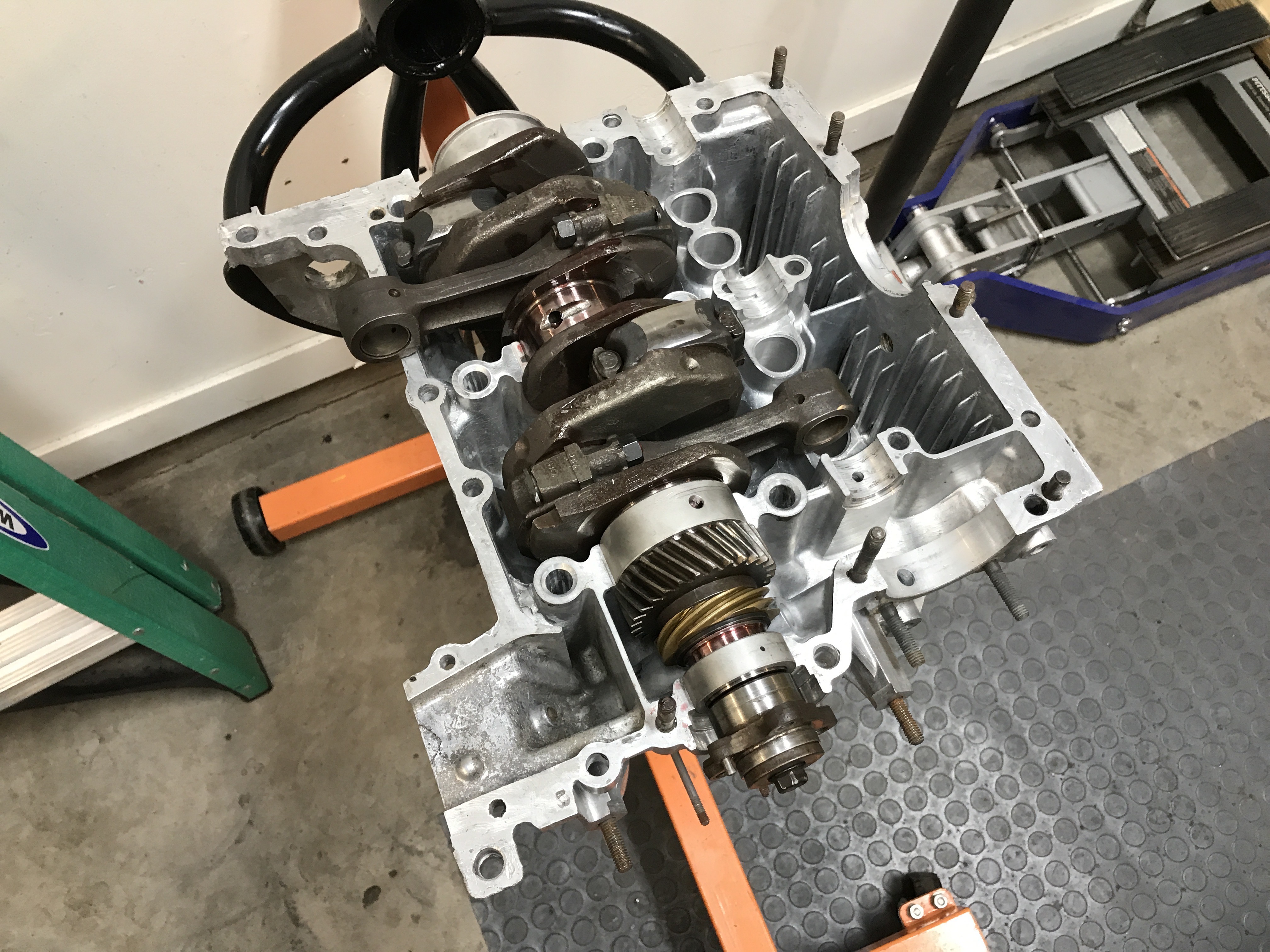

I then installed the crank into the right side case again--maybe this time for good.

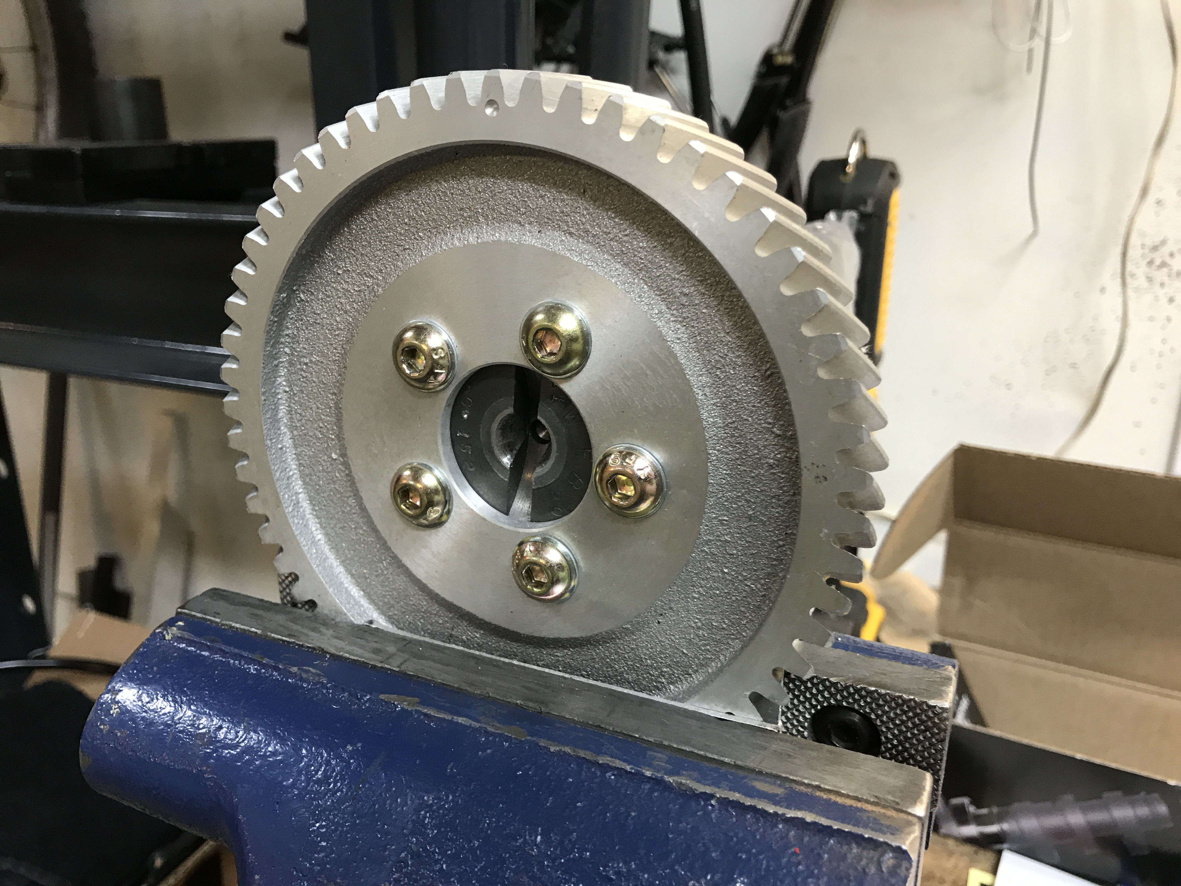

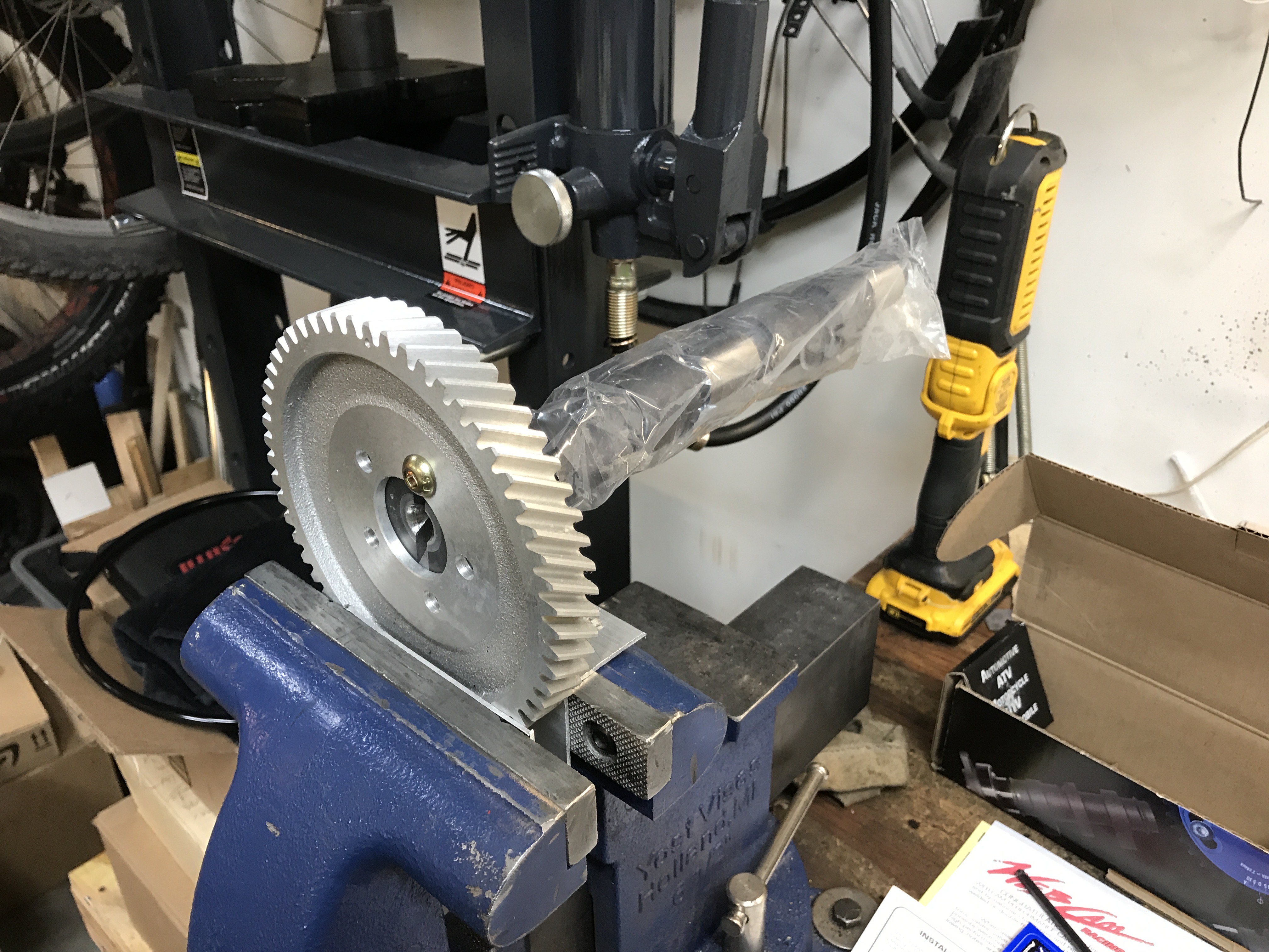

Time to get the cam ready. This is a Web Cam grind #86 (00-152), a moderate street cam which should work in my 2056 with injection.
Step one: index the cam on the gear and bolt them together.
(And yes, I have soft aluminum between the vise jaws and the gear.)
bkrantz
post May 3 2021, 07:23 PM
Post #2699
Posts: 8,531
Joined: 3-August 19
From: SW Colorado
Member No.: 23,343
More high-temp red Loctite.
bkrantz
Post #2700
Posts: 8,531
Joined: 3-August 19
From: SW Colorado
Member No.: 23,343
Bolted and torqued.
