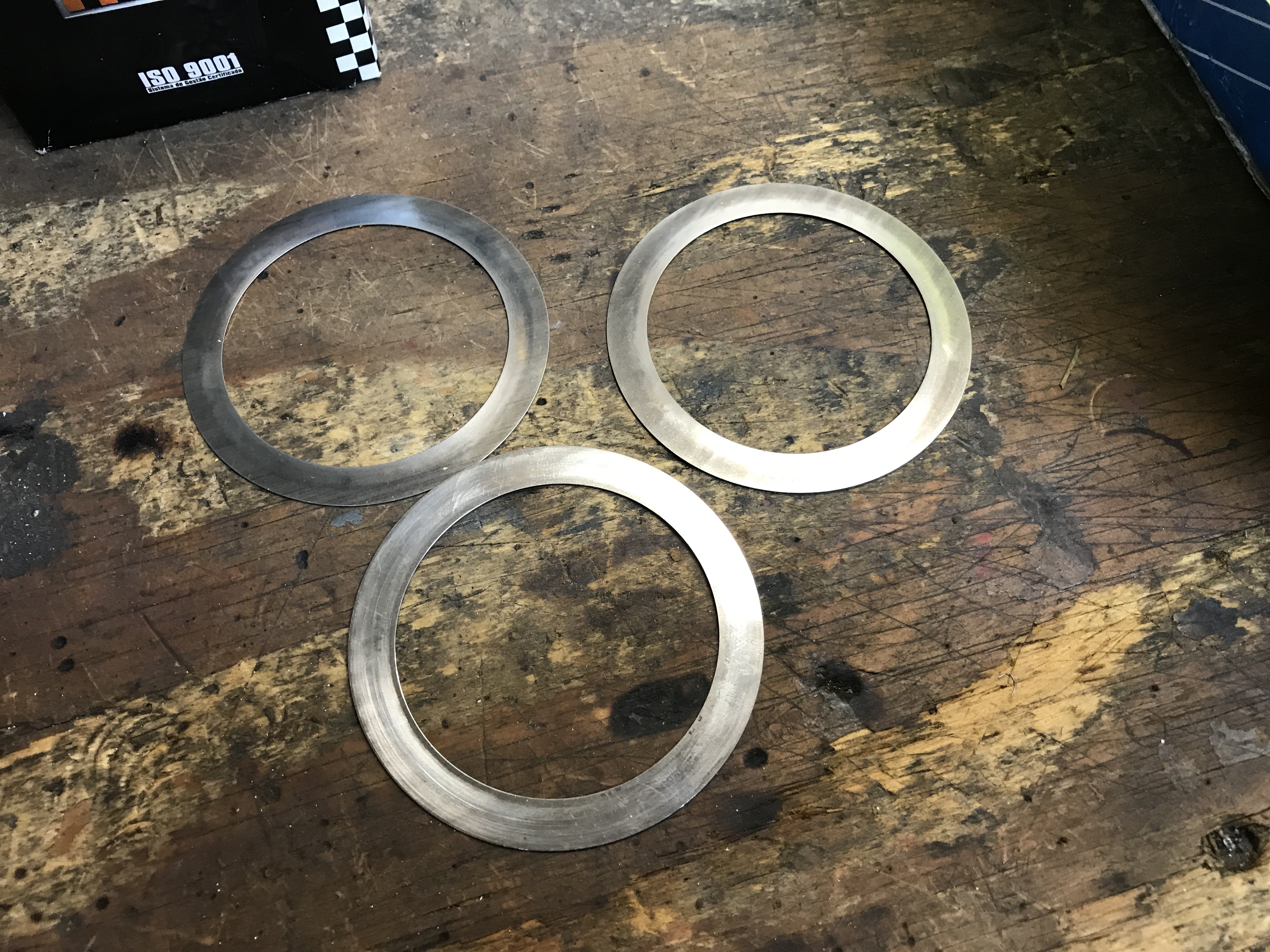

I have the 3 shims from the tear down.

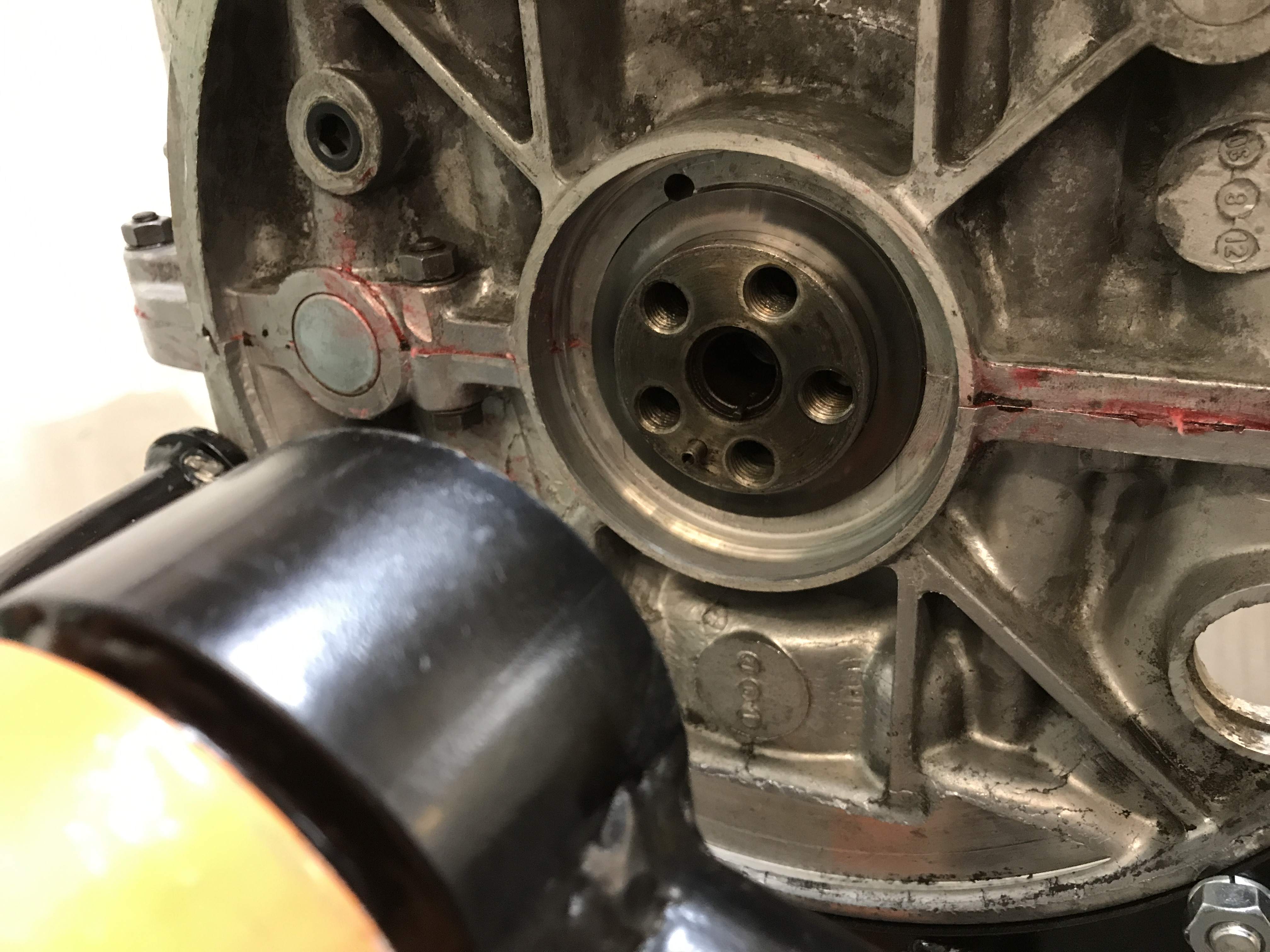

I installed 2 shims on the end of the crank.

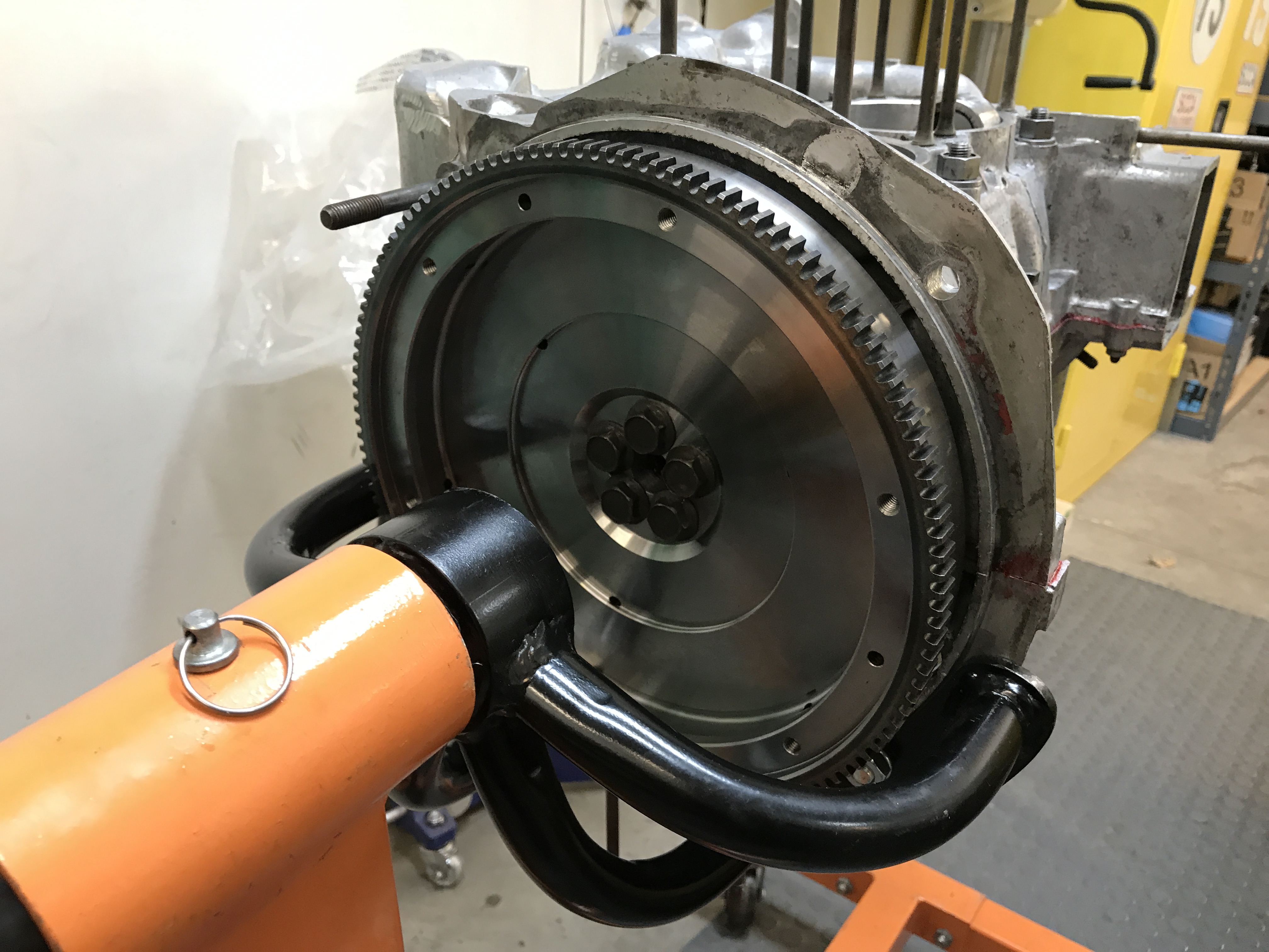

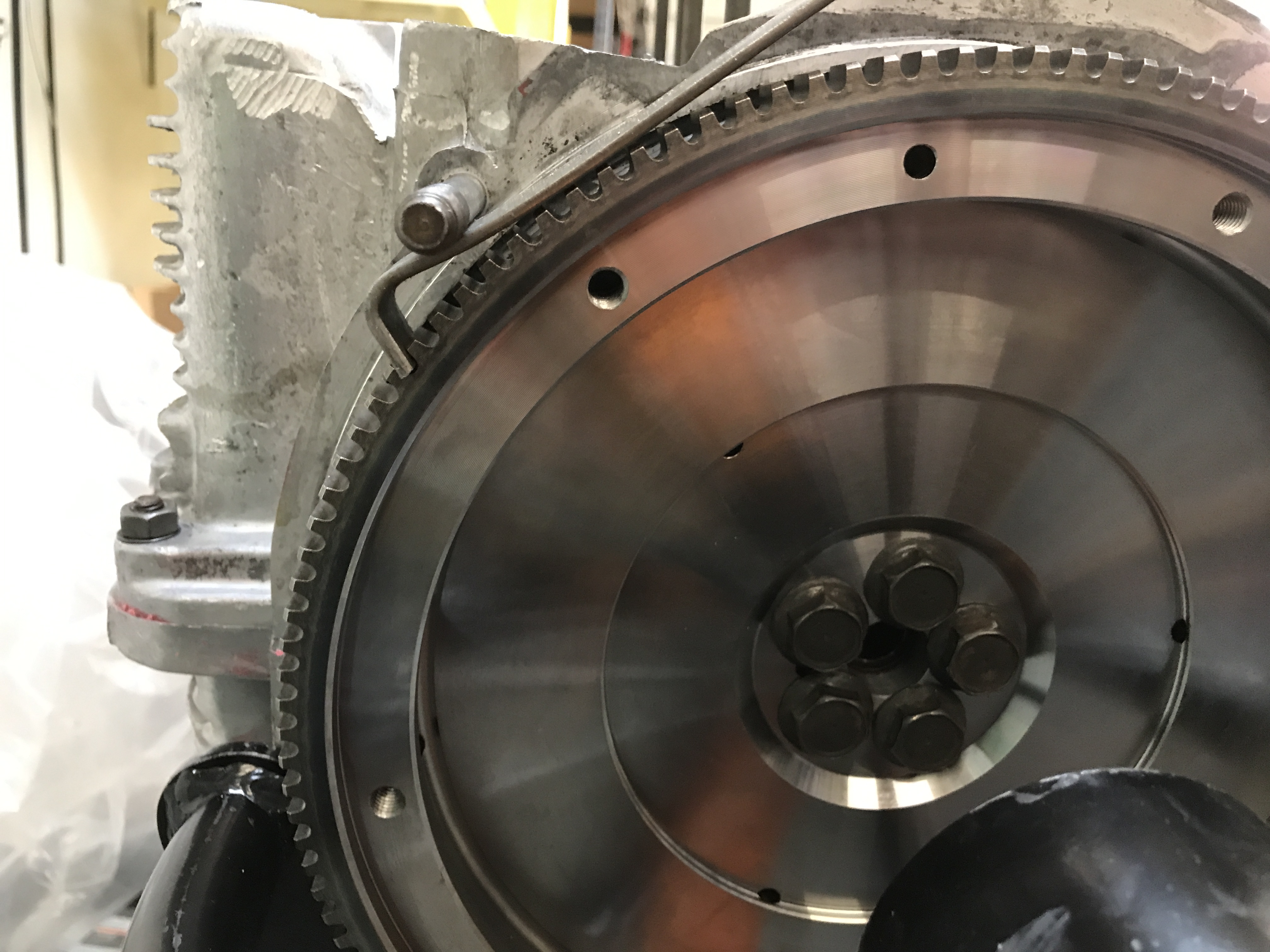

And then the new flywheel with the old bolts.
bkrantz
post May 15 2021, 07:49 PM
Post #2784
Posts: 8,800
Joined: 3-August 19
From: SW Colorado
Member No.: 23,343
When I went to tighten the flywheel bolts I remembered a tool I made 30 years ago, and dug around in the tool chest for this.
bkrantz
post May 15 2021, 07:50 PM
Post #2785
Posts: 8,800
Joined: 3-August 19
From: SW Colorado
Member No.: 23,343
It still works.
bkrantz
post May 15 2021, 07:52 PM
Post #2786
Posts: 8,800
Joined: 3-August 19
From: SW Colorado
Member No.: 23,343

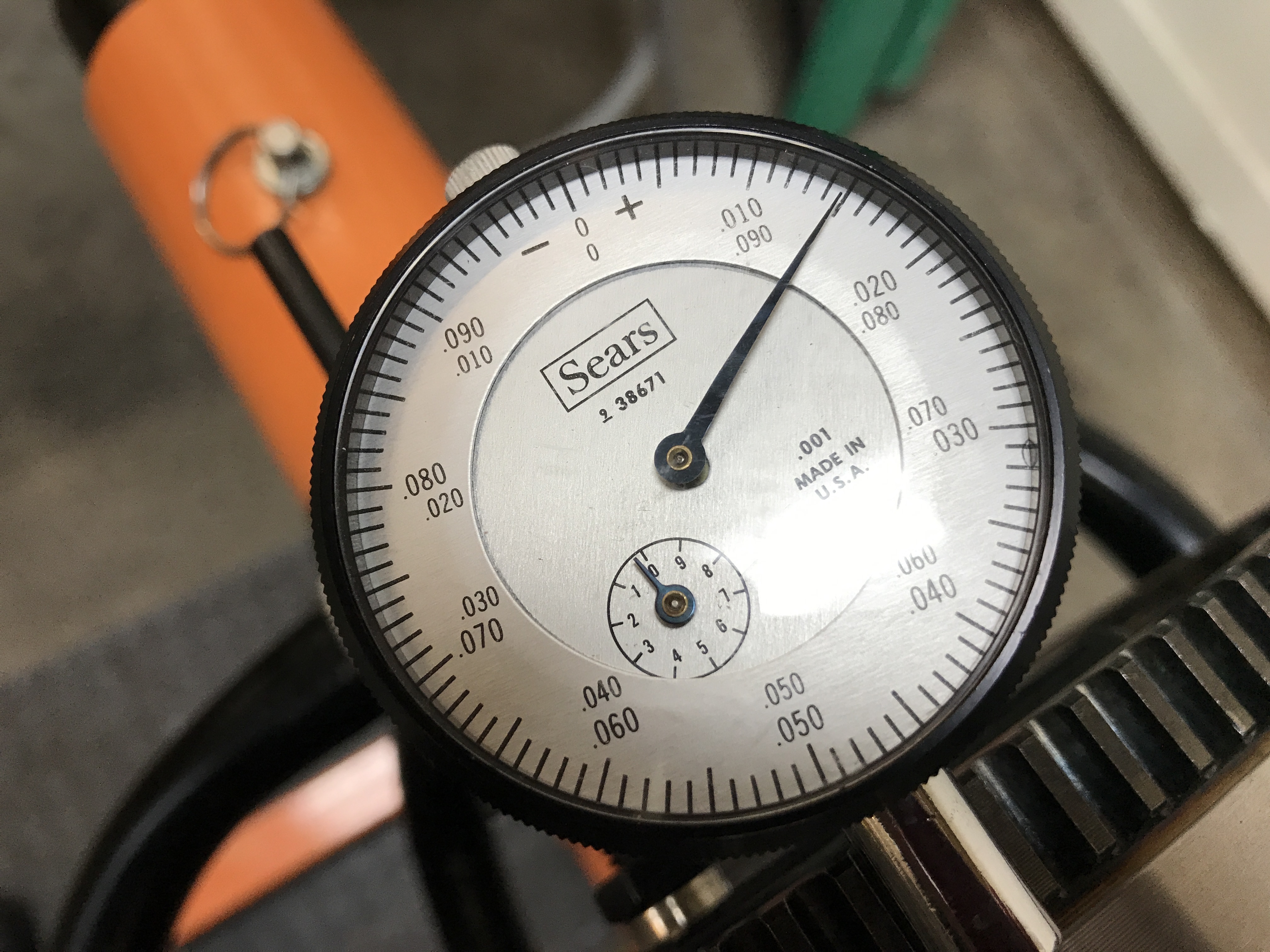

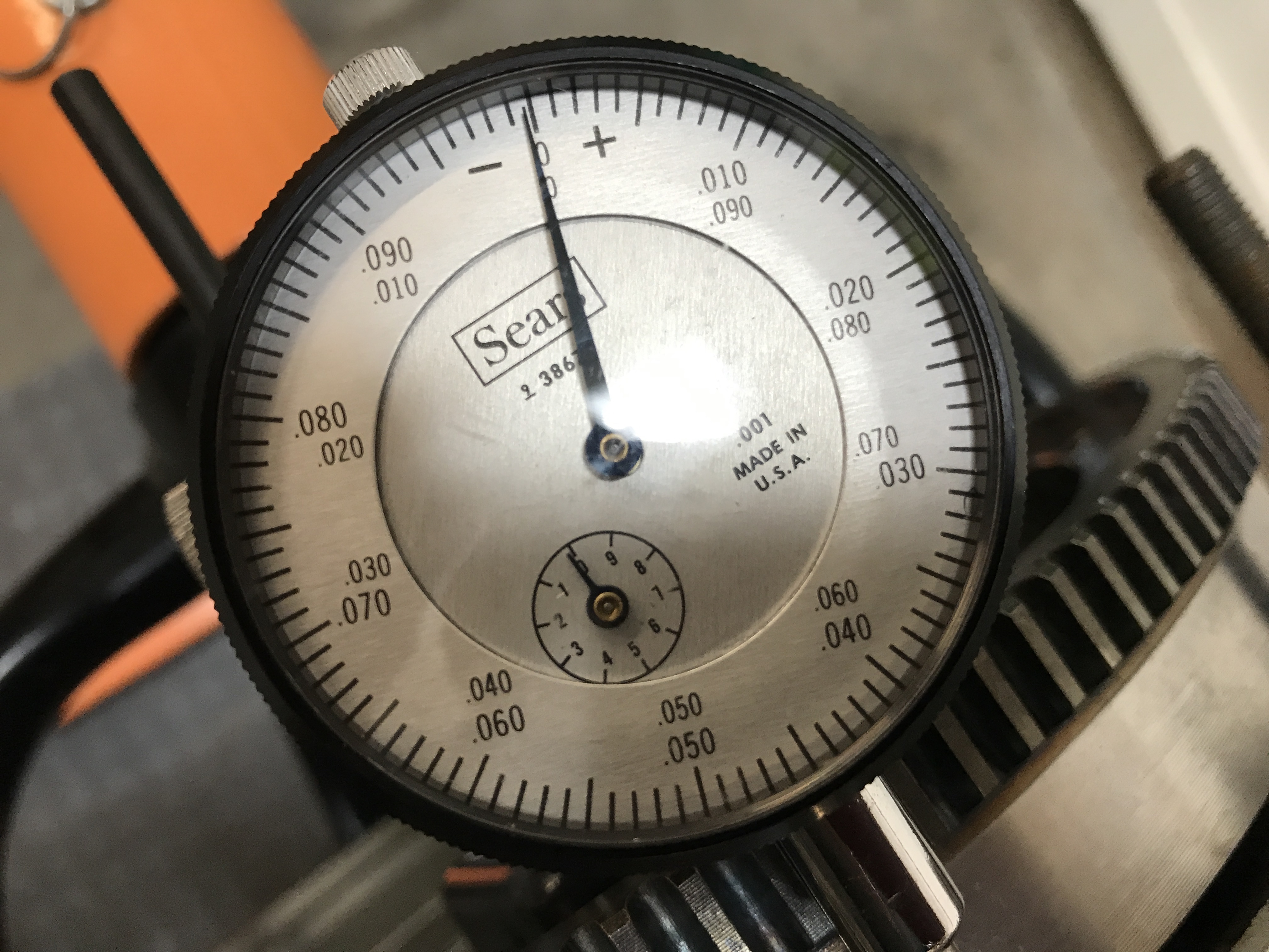

With the bolts tight, I made sure the crank had some axial play. Then I mounted my dial gauge and zeroed it.
bkrantz
post May 15 2021, 07:54 PM
Post #2787
Posts: 8,800
Joined: 3-August 19
From: SW Colorado
Member No.: 23,343
And then shifted the crank. I repeated this about a dozen times, and got a consistent axial play of 0.015".
bkrantz
post May 15 2021, 07:57 PM
Post #2788
Posts: 8,800
Joined: 3-August 19
From: SW Colorado
Member No.: 23,343

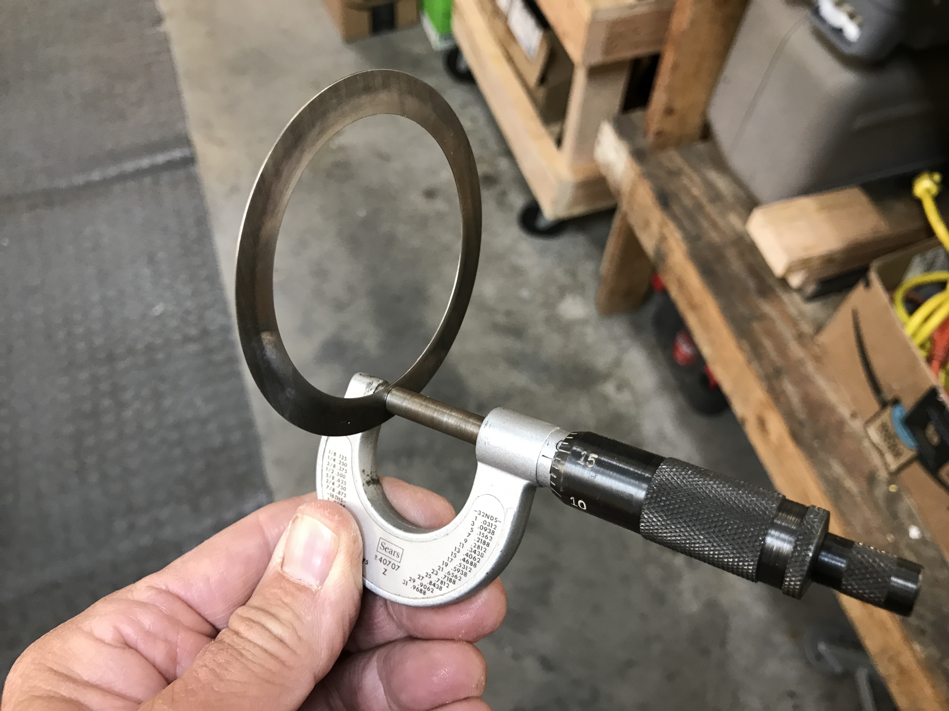

For the desired play of .004", I need a third shim .011".
But the shim I have measures .0135". Time to order a new shim.

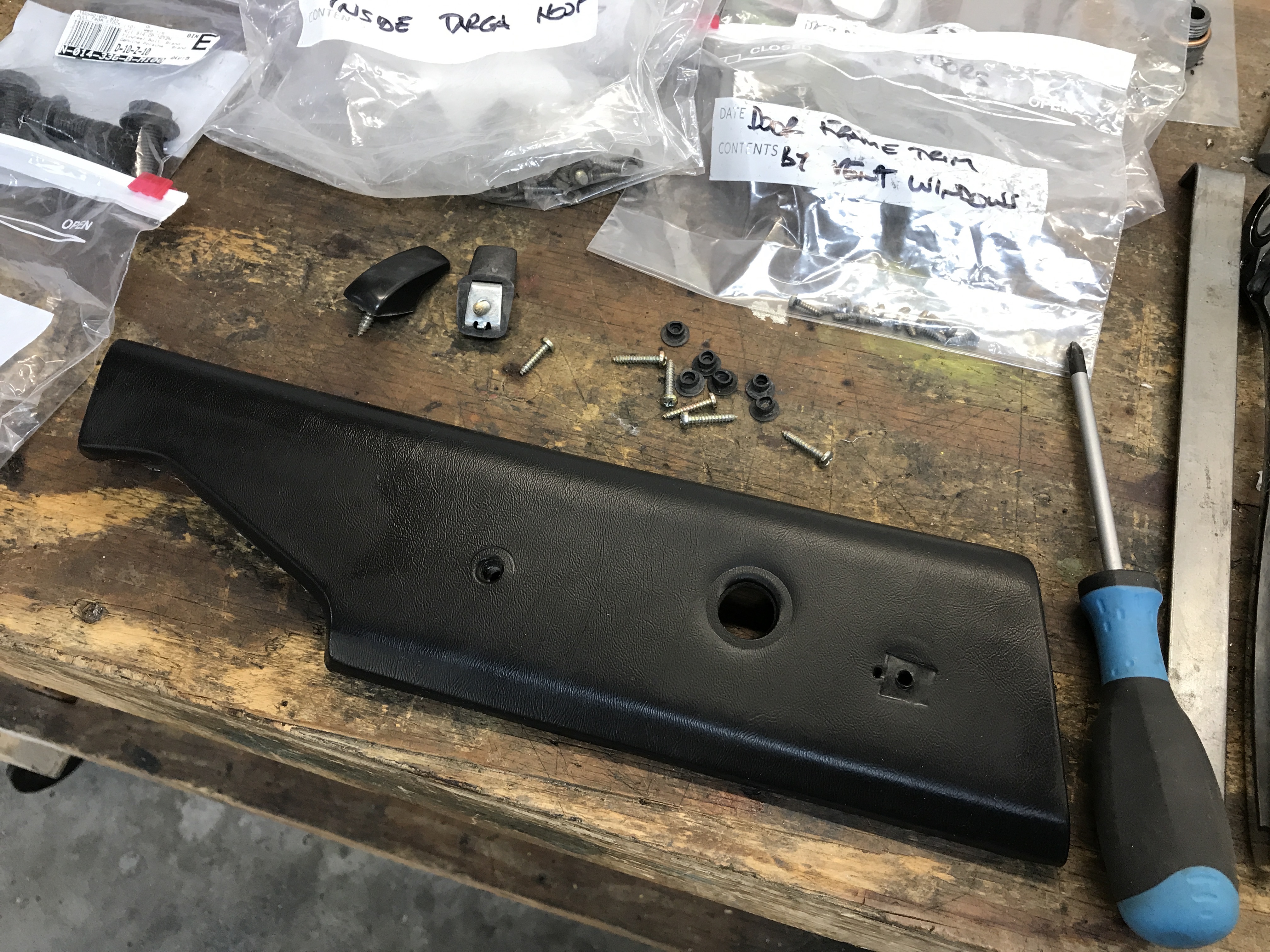

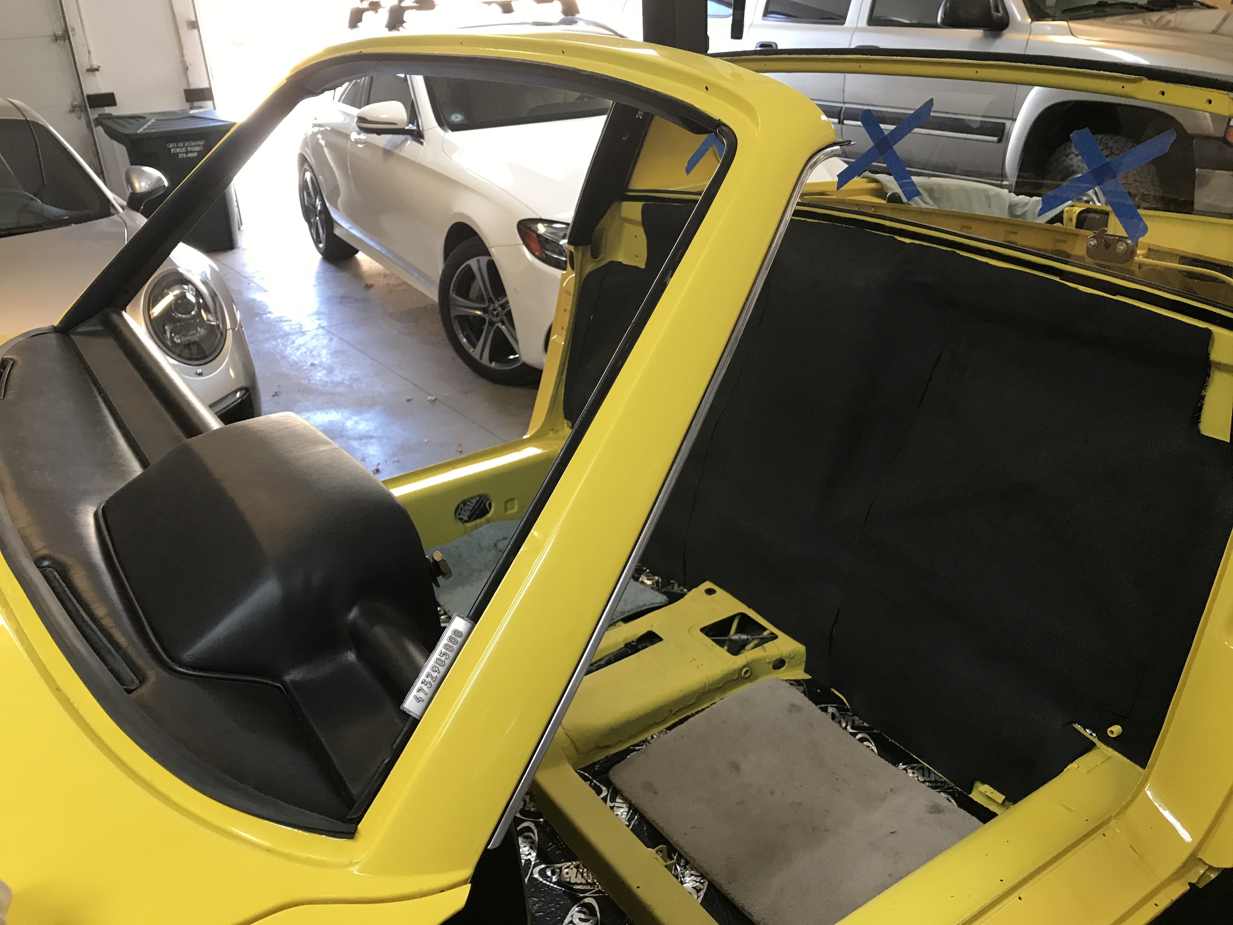

Meanwhile, back to working on the body trim. I got out the targa inside pads and hardware.
bkrantz
post May 15 2021, 08:02 PM
Post #2790
Posts: 8,800
Joined: 3-August 19
From: SW Colorado
Member No.: 23,343
And got these installed so I can mount the aluminum channels for the rubber trim.

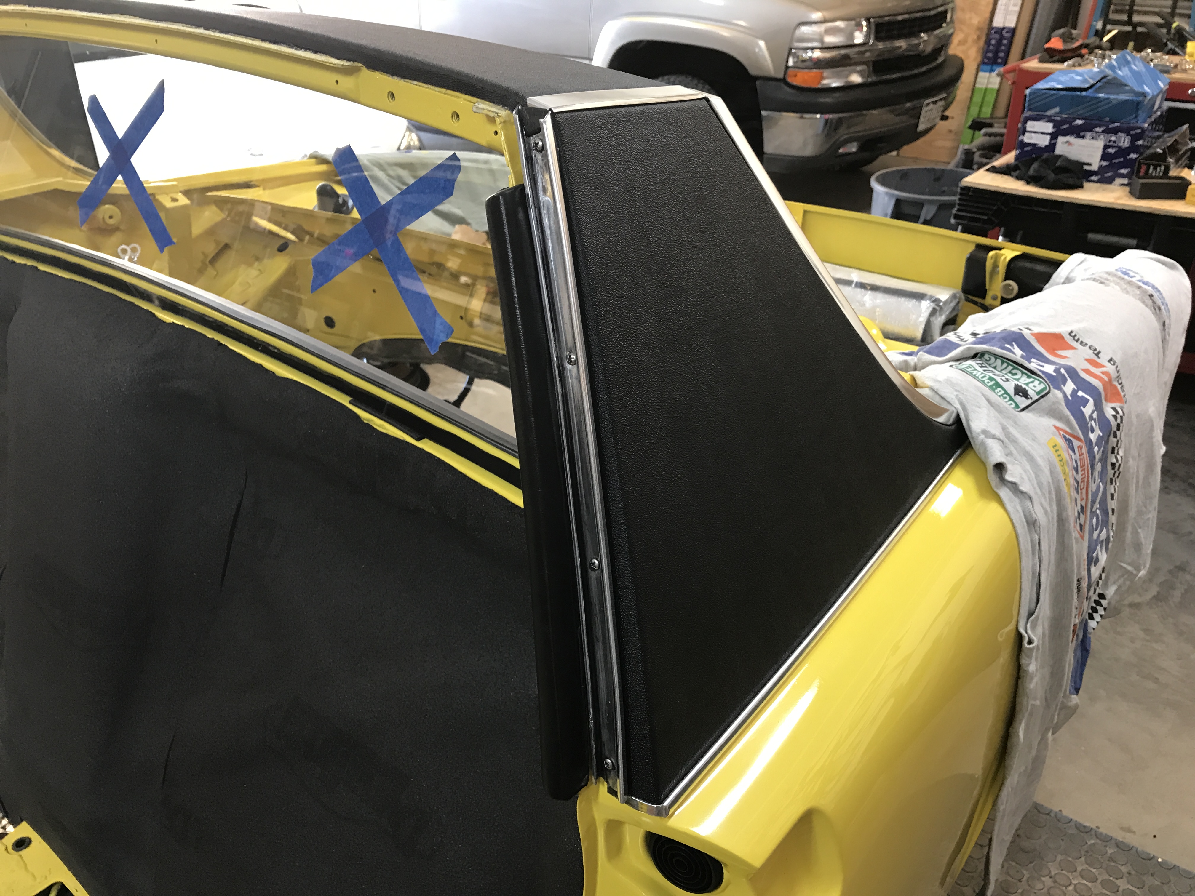

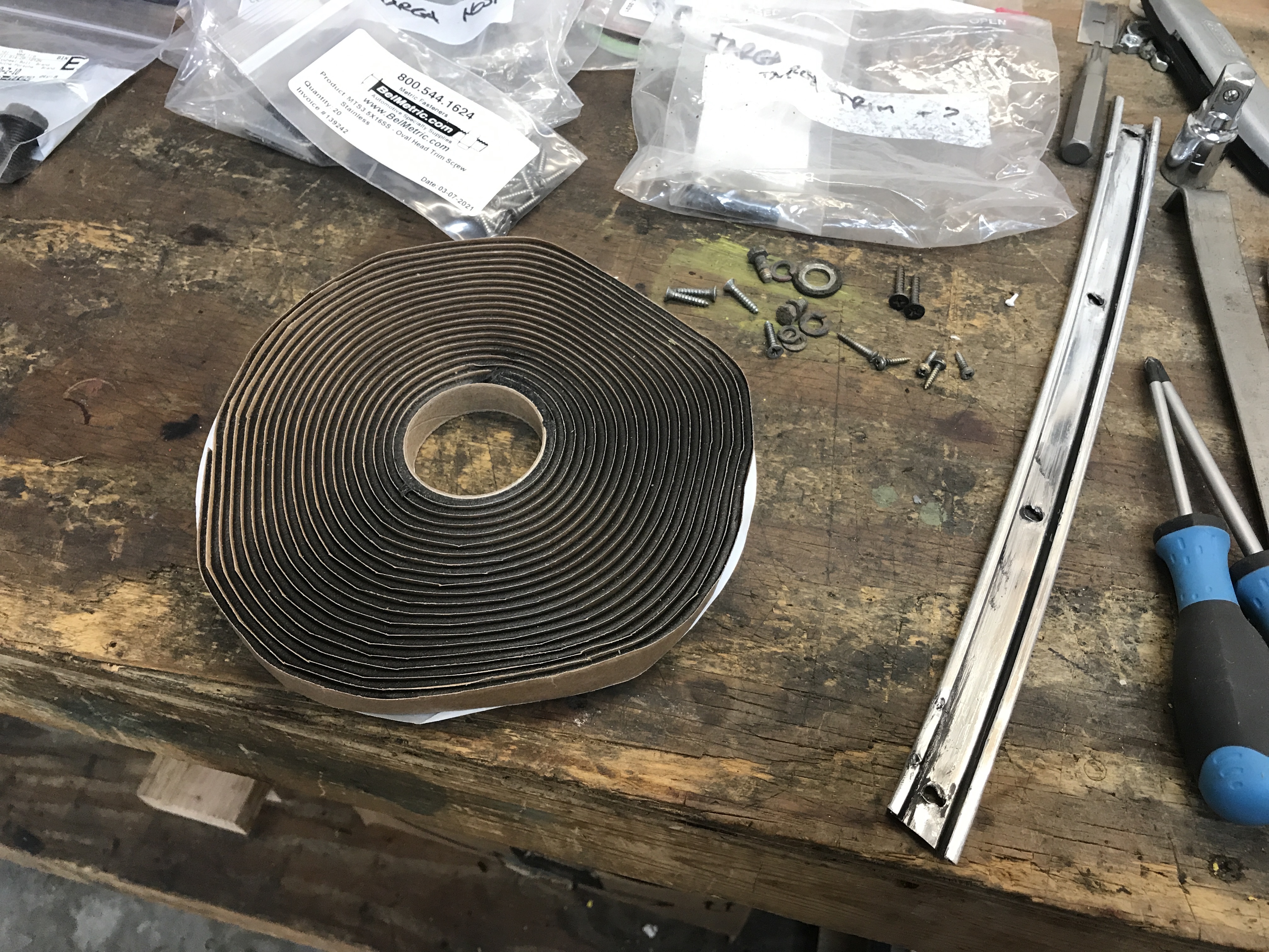

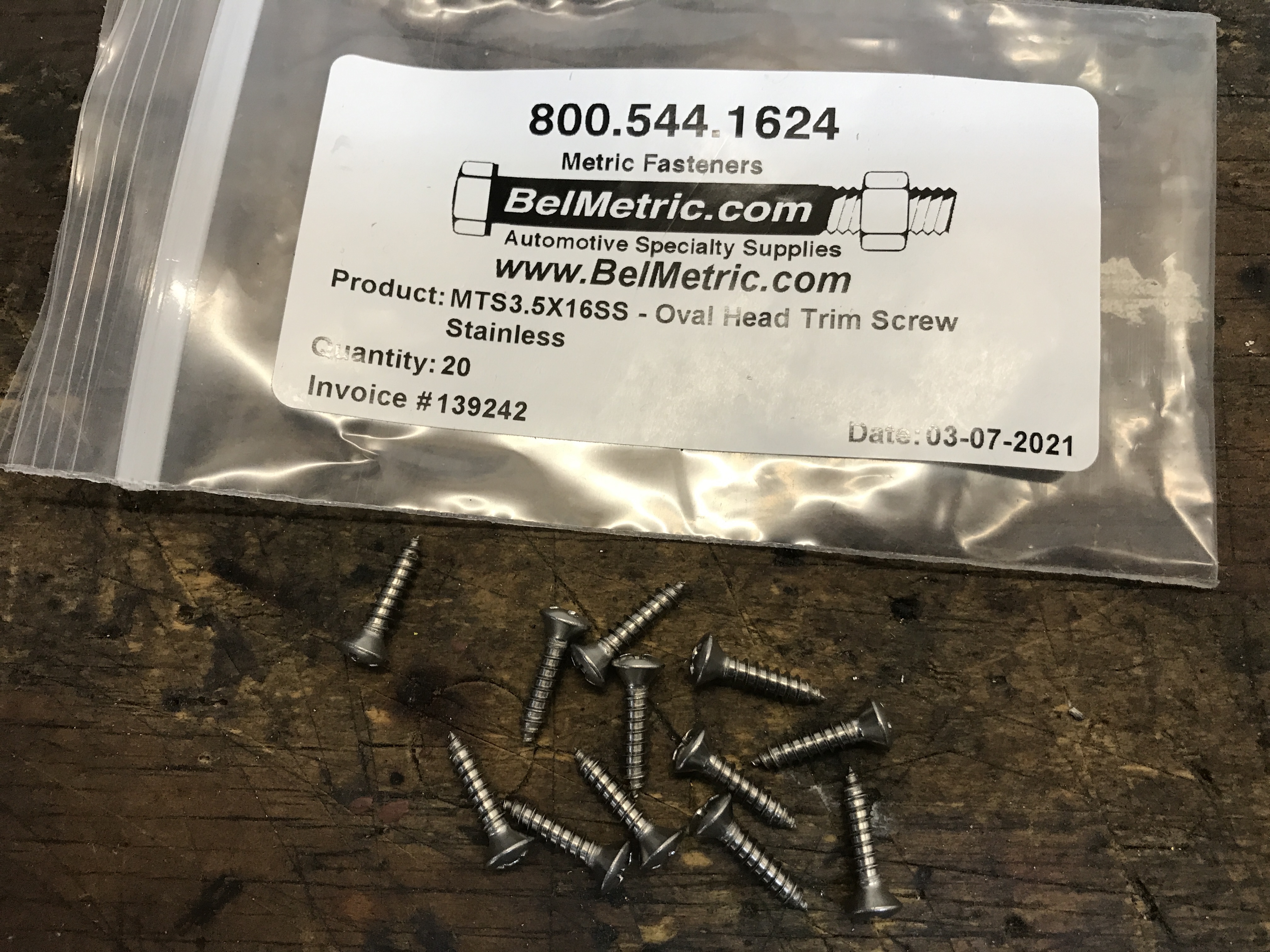

Here's the thin butyl strip material I found, 1/8 x 1/2", and one of the aluminum trim strips that goes on the leading edge of the targa sail.
bkrantz
post May 16 2021, 07:36 PM
Post #2792
Posts: 8,800
Joined: 3-August 19
From: SW Colorado
Member No.: 23,343

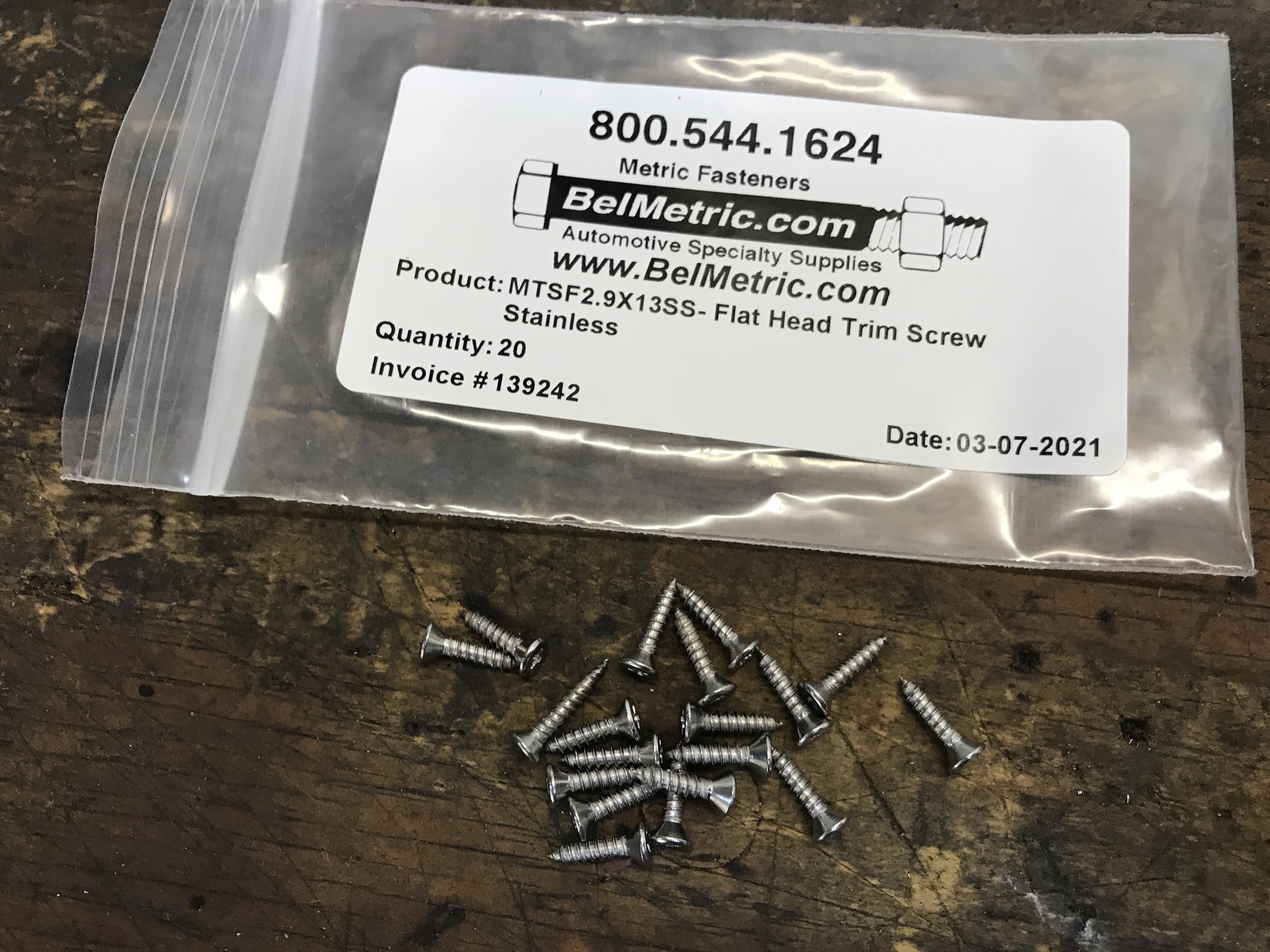

New stainless screws.

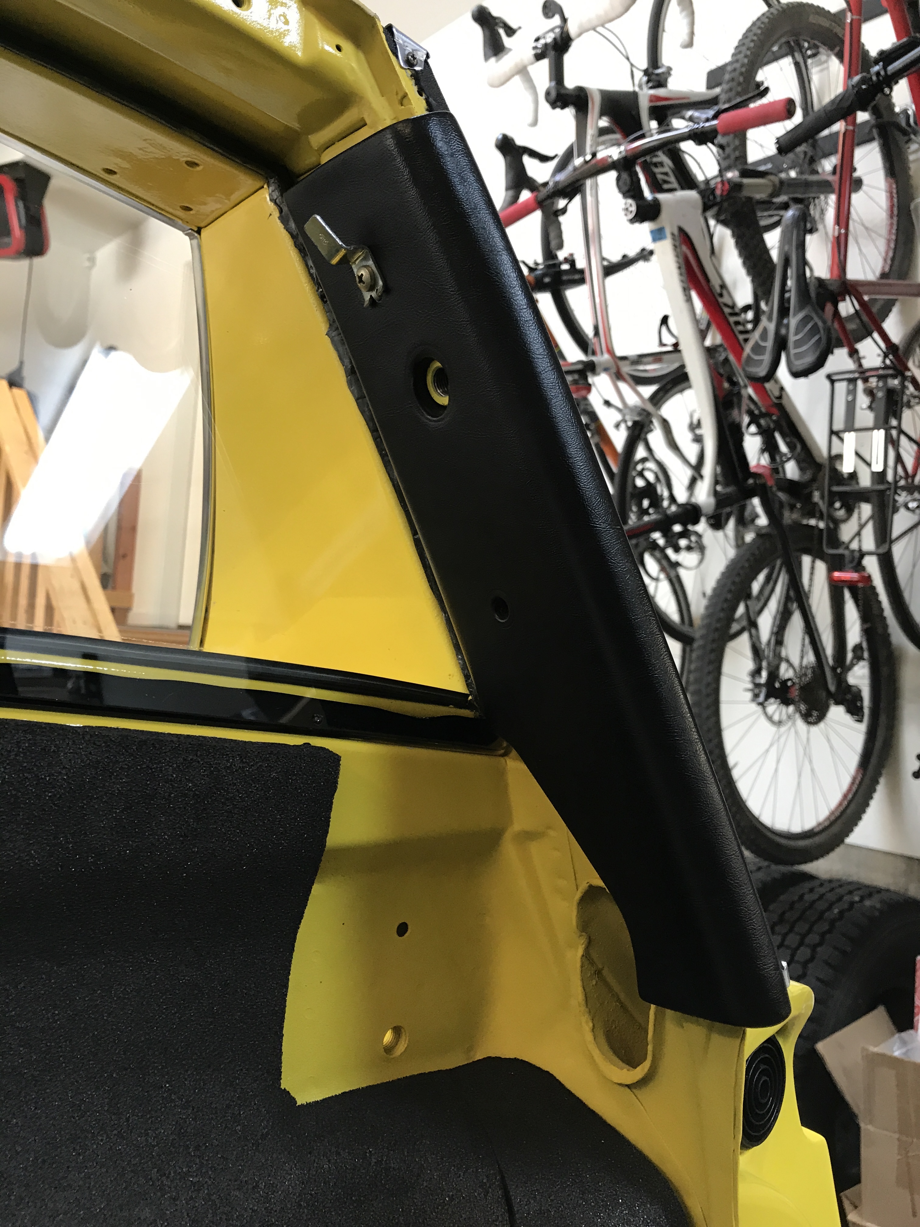

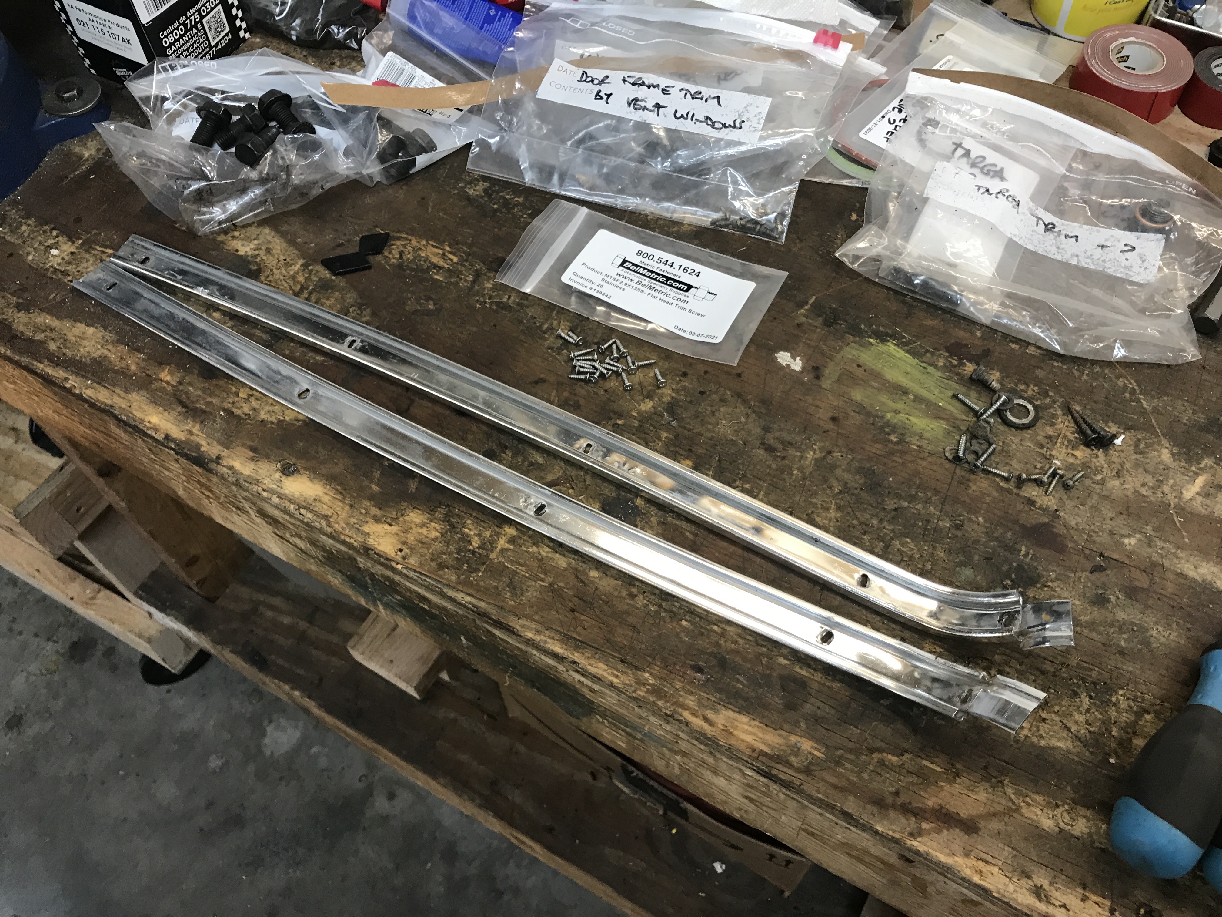

While in the trim mood, I got out the strips that go on the A-pillars.
bkrantz
post May 16 2021, 07:39 PM
Post #2795
Posts: 8,800
Joined: 3-August 19
From: SW Colorado
Member No.: 23,343
More new stainless screws.
bkrantz
post May 16 2021, 07:40 PM
Post #2796
Posts: 8,800
Joined: 3-August 19
From: SW Colorado
Member No.: 23,343
Trim installed with butyl.

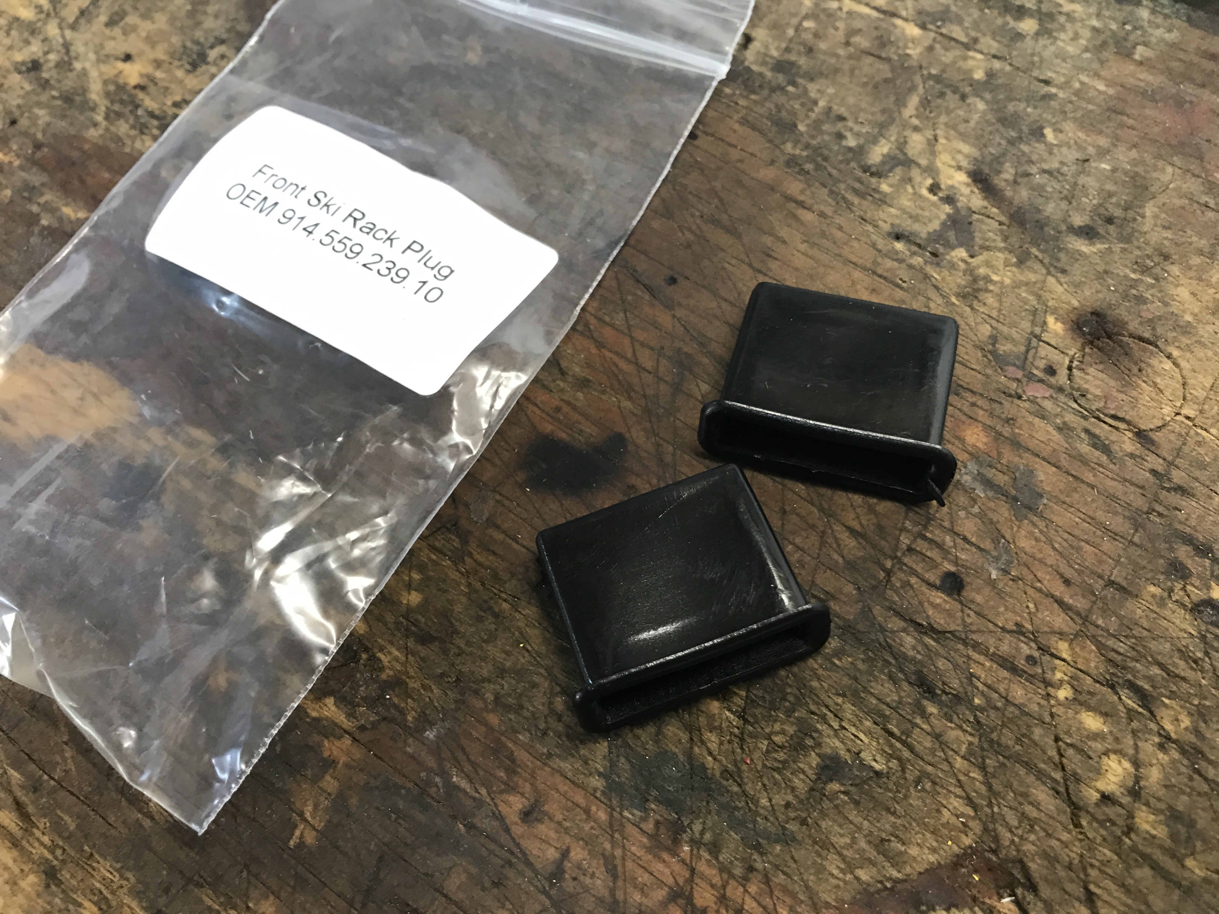

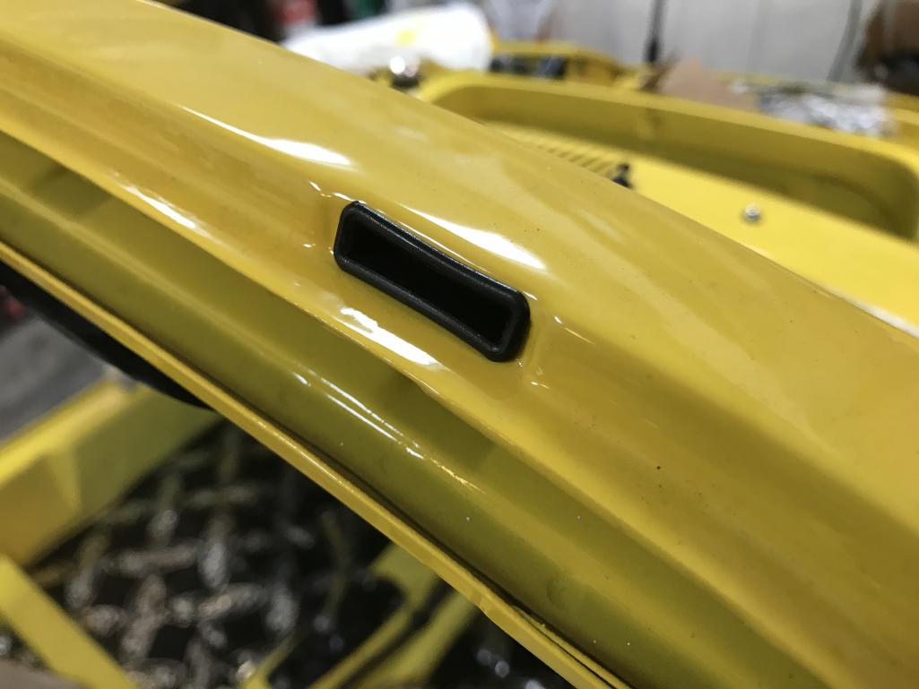

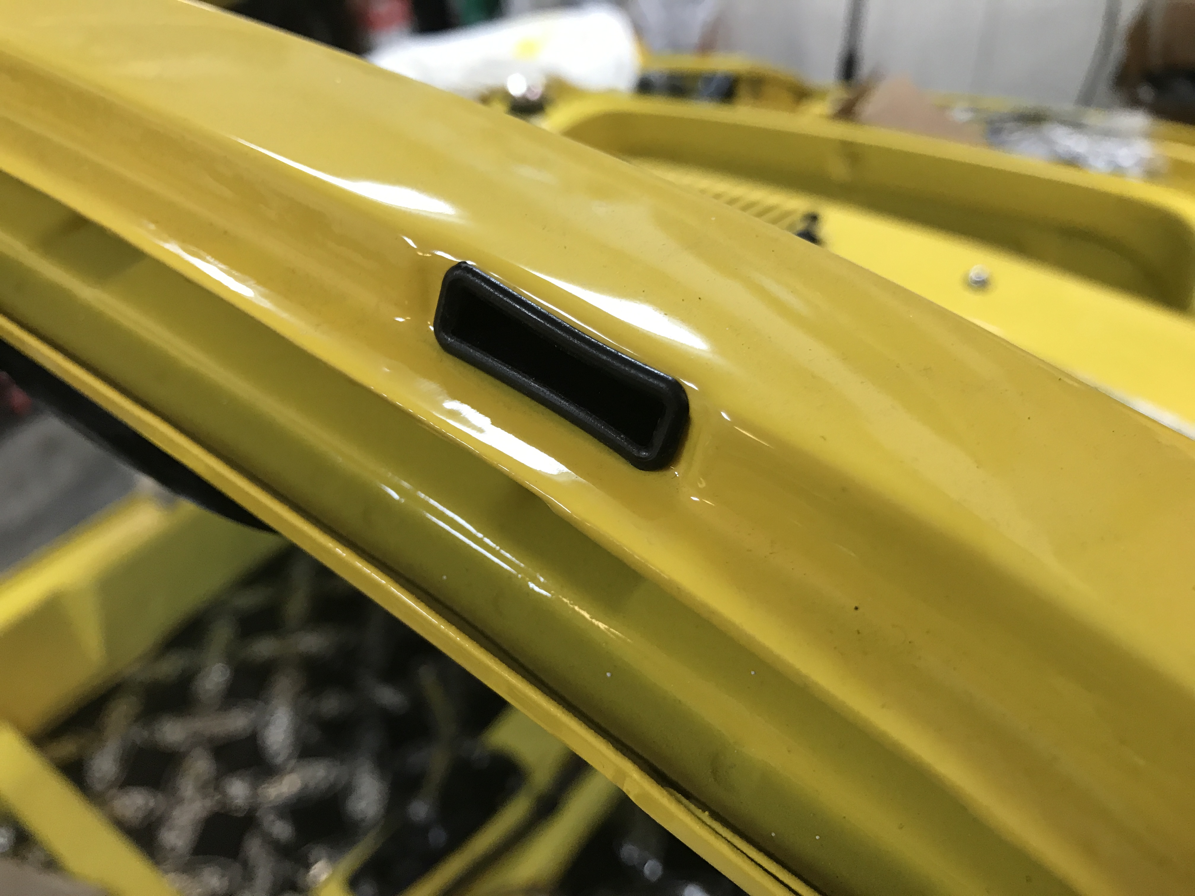

One last detail today: new ski rack tab receivers.
bkrantz
post May 16 2021, 07:42 PM
Post #2798
Posts: 8,800
Joined: 3-August 19
From: SW Colorado
Member No.: 23,343
Installed in the windshield frame top.
bkrantz

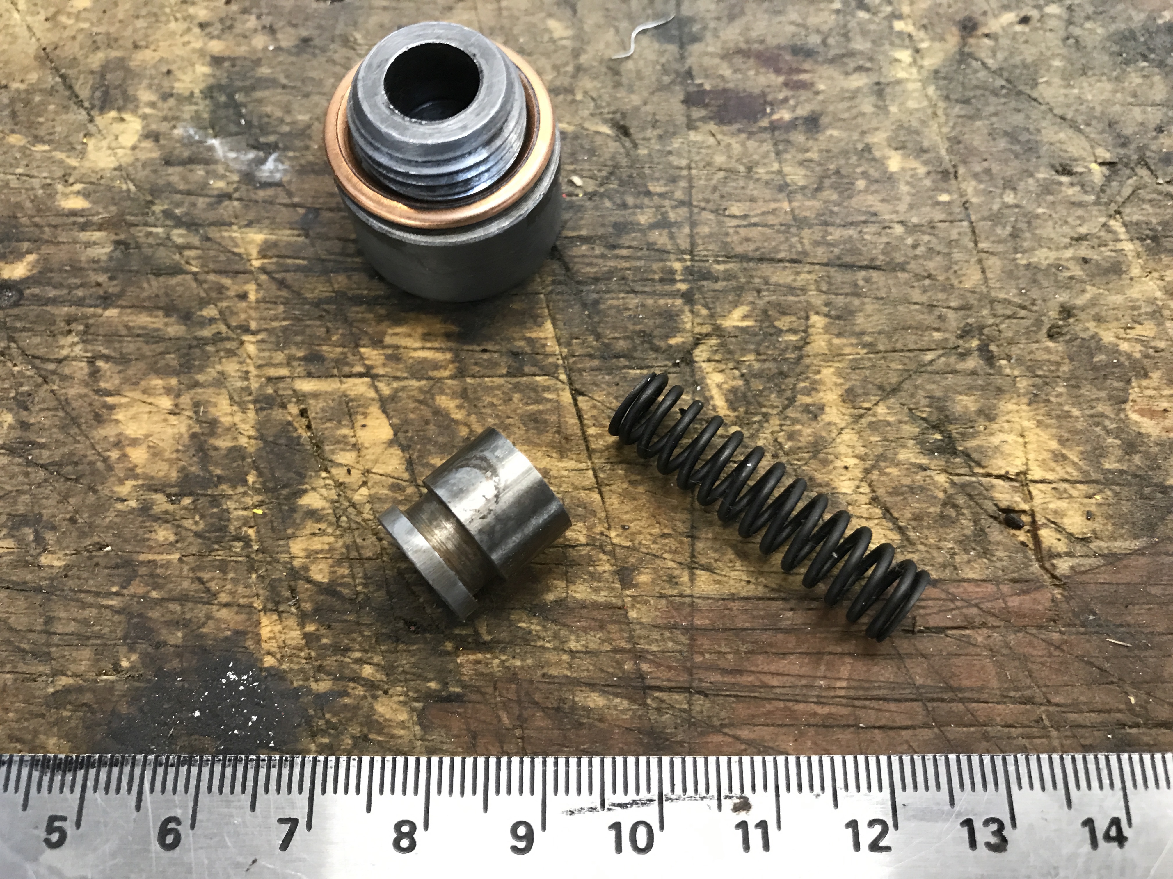

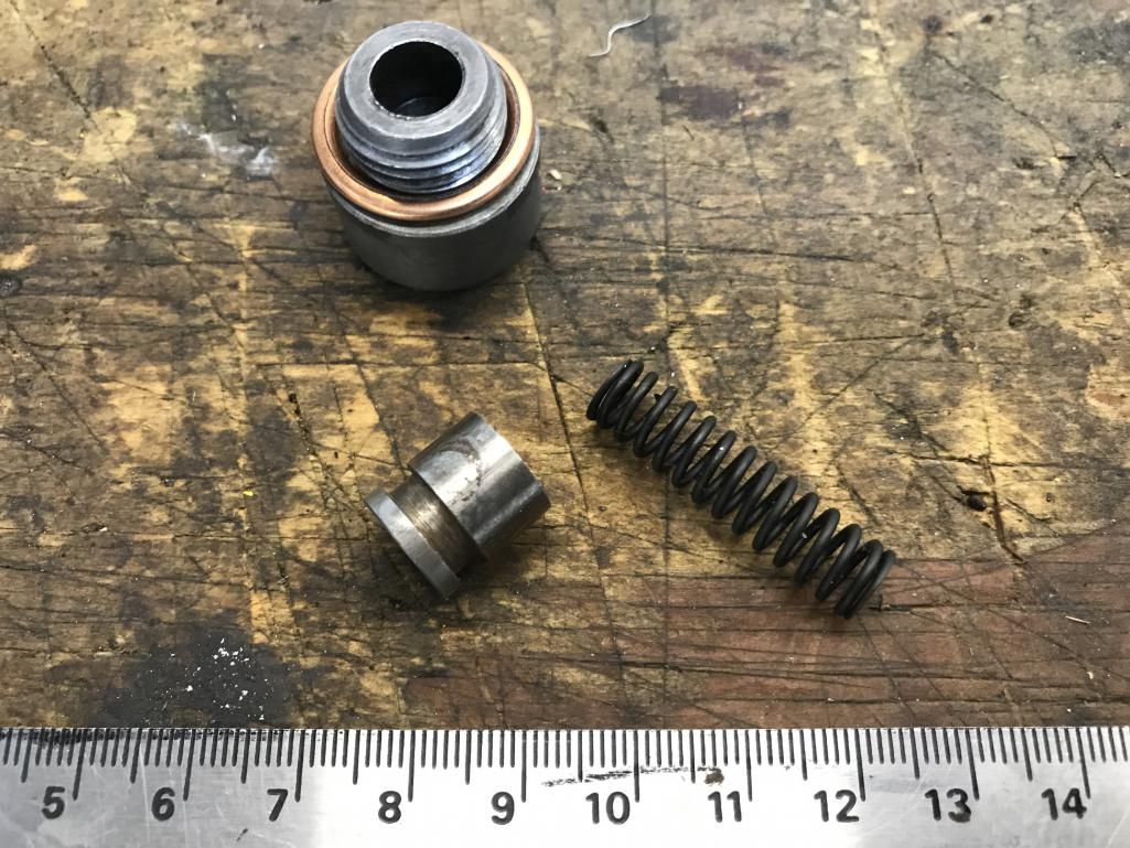

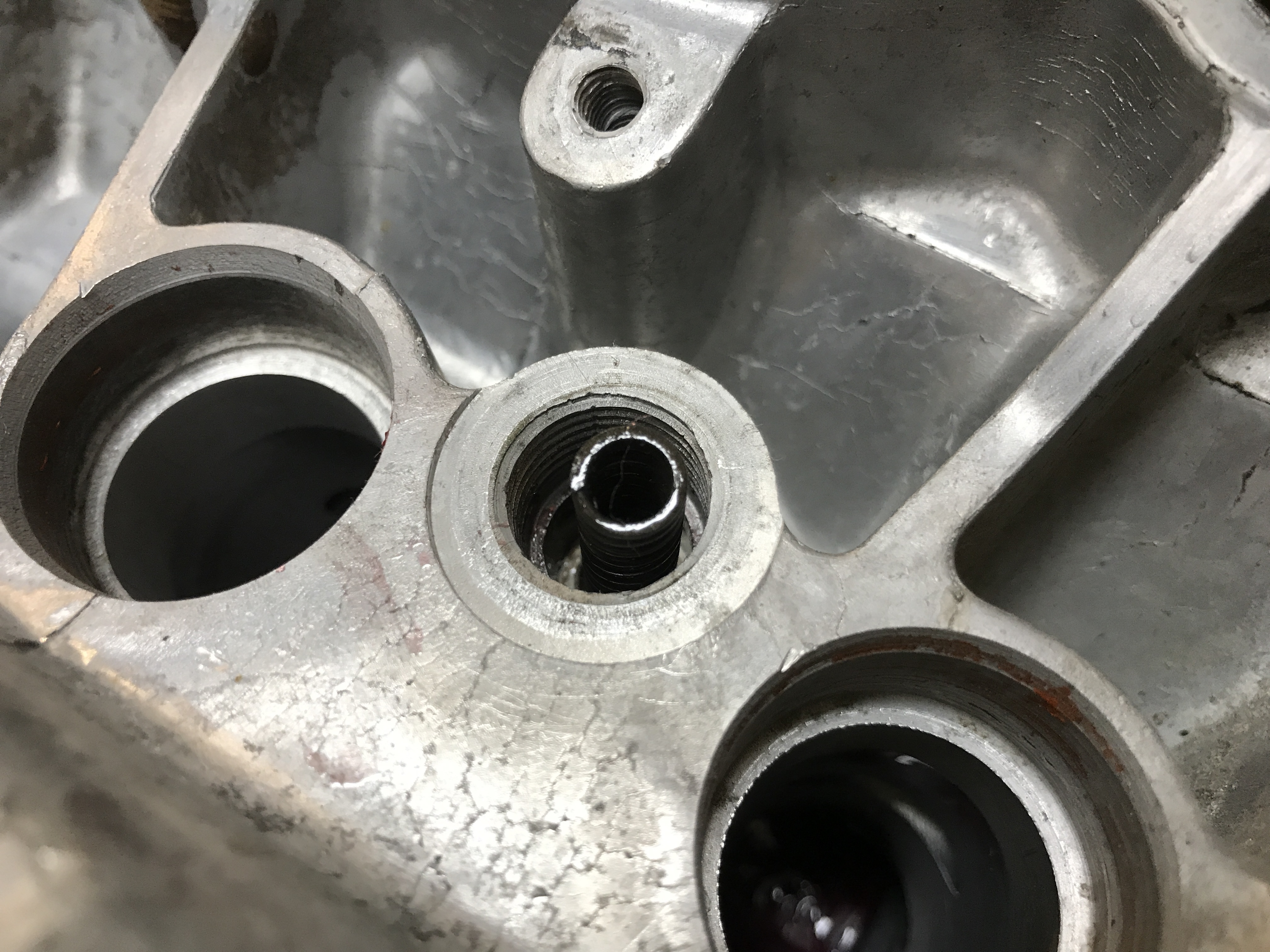

I got a long day in the garage today, starting with a few more bits on the engine case.
Thanks to pilothyer, I have a replacement for the missing small oil pressure relief valve.
bkrantz
post May 23 2021, 07:17 PM
Post #2800
Posts: 8,800
Joined: 3-August 19
From: SW Colorado
Member No.: 23,343
A light smear of assembly lube, and I put the piston and spring into the cylinder in the left case half.
