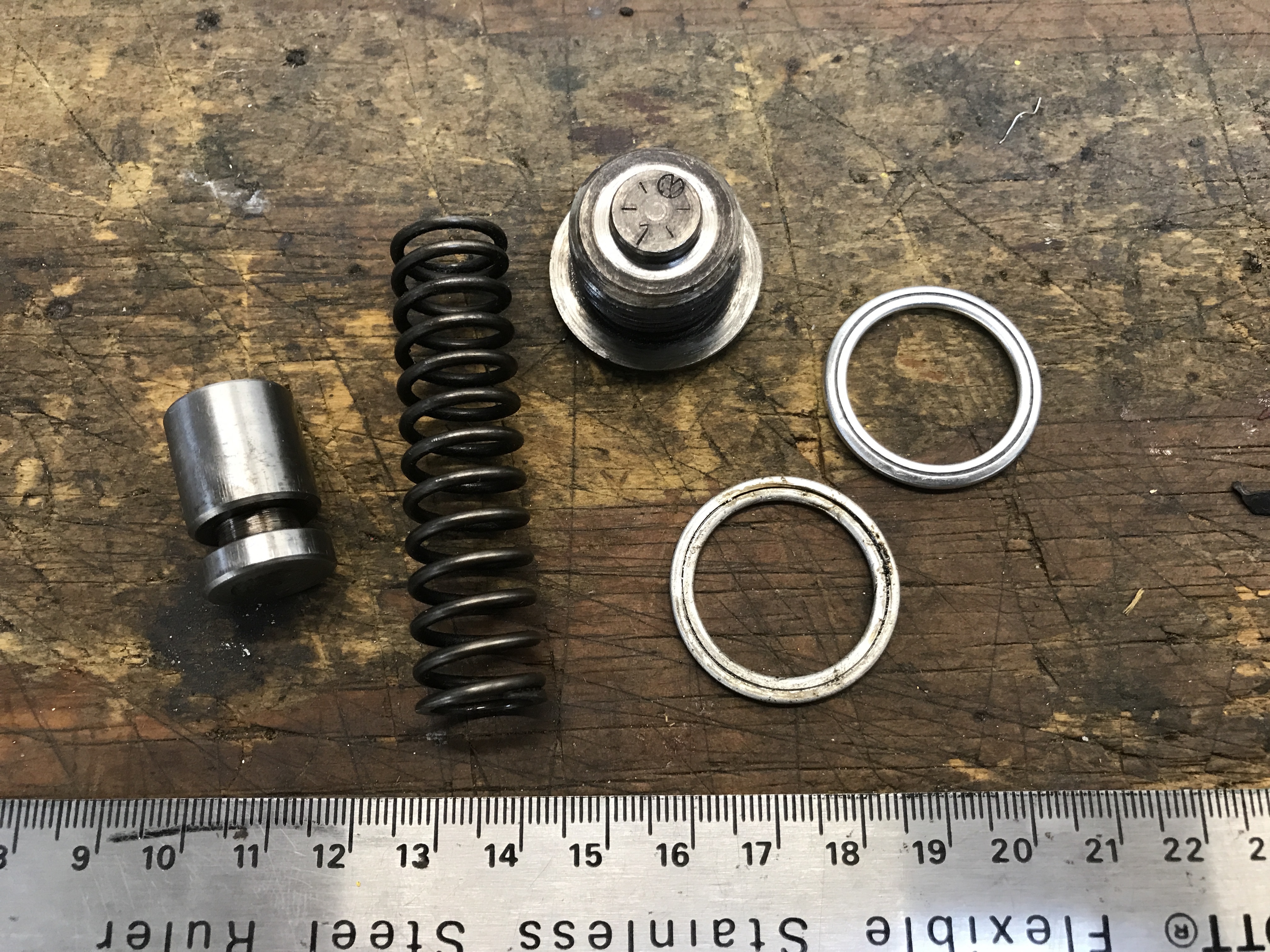

Followed by the retaining screw cap with a new crush washer.
post May 23 2021, 07:19 PM
Post #2802
Posts: 8,800

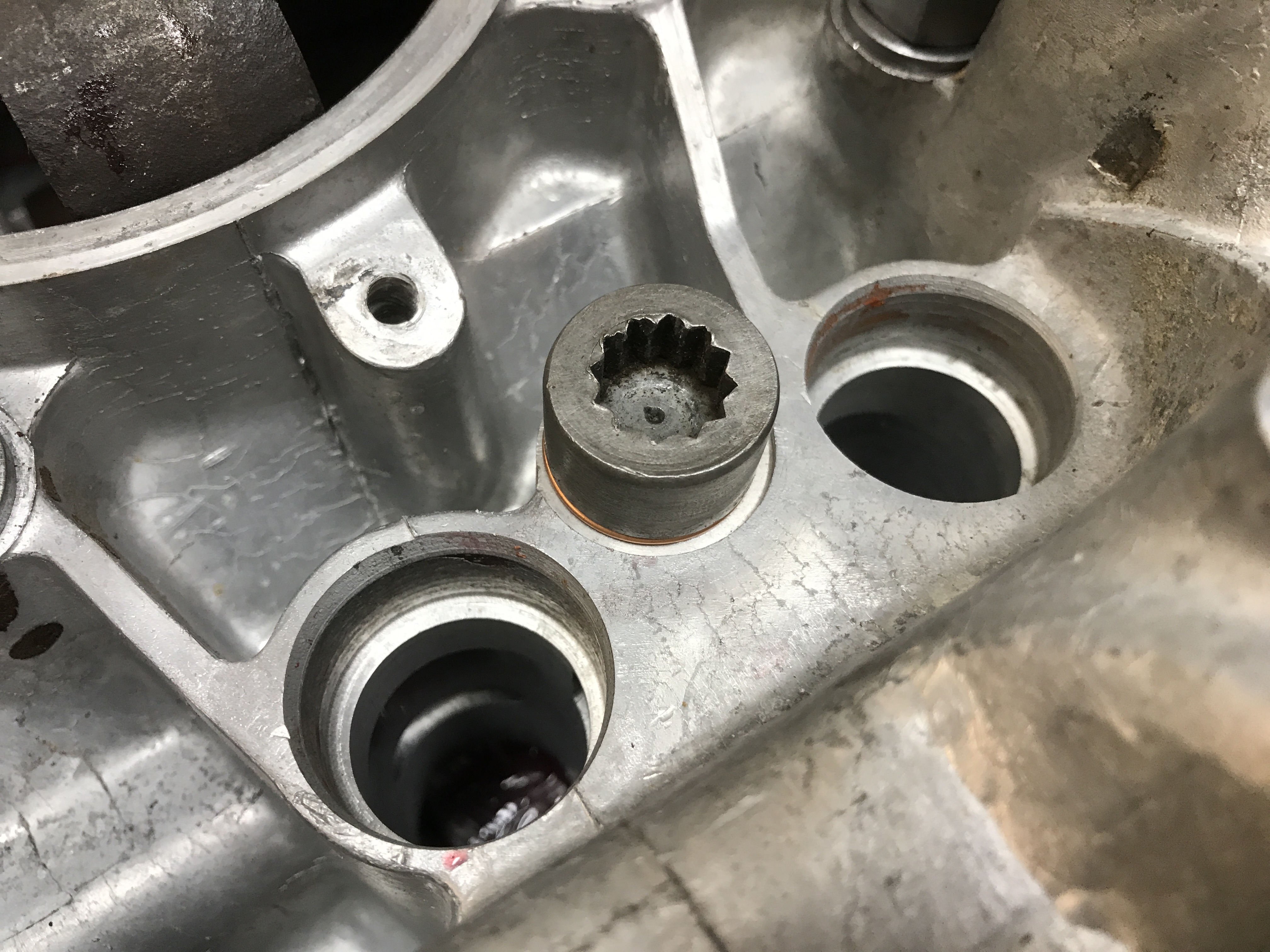

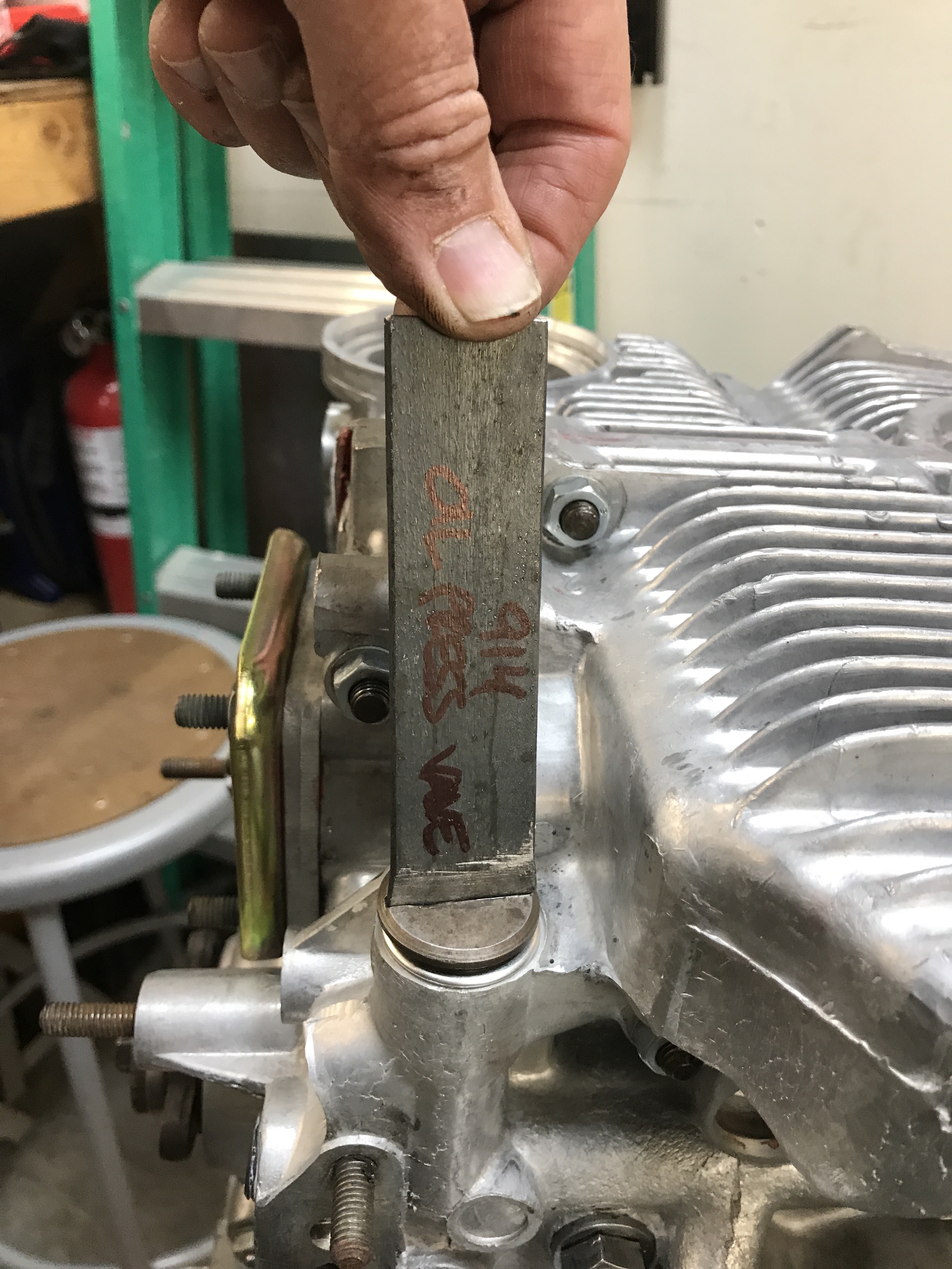

Then I got out the large diameter pressure relief valve that goes in the right case half.
post May 23 2021, 07:21 PM
Post #2803
Posts: 8,800
I also found the tool I made to fit the bit slot on the retaining cap, and screwed it in.
post May 23 2021, 07:22 PM
Post #2804
Posts: 8,800

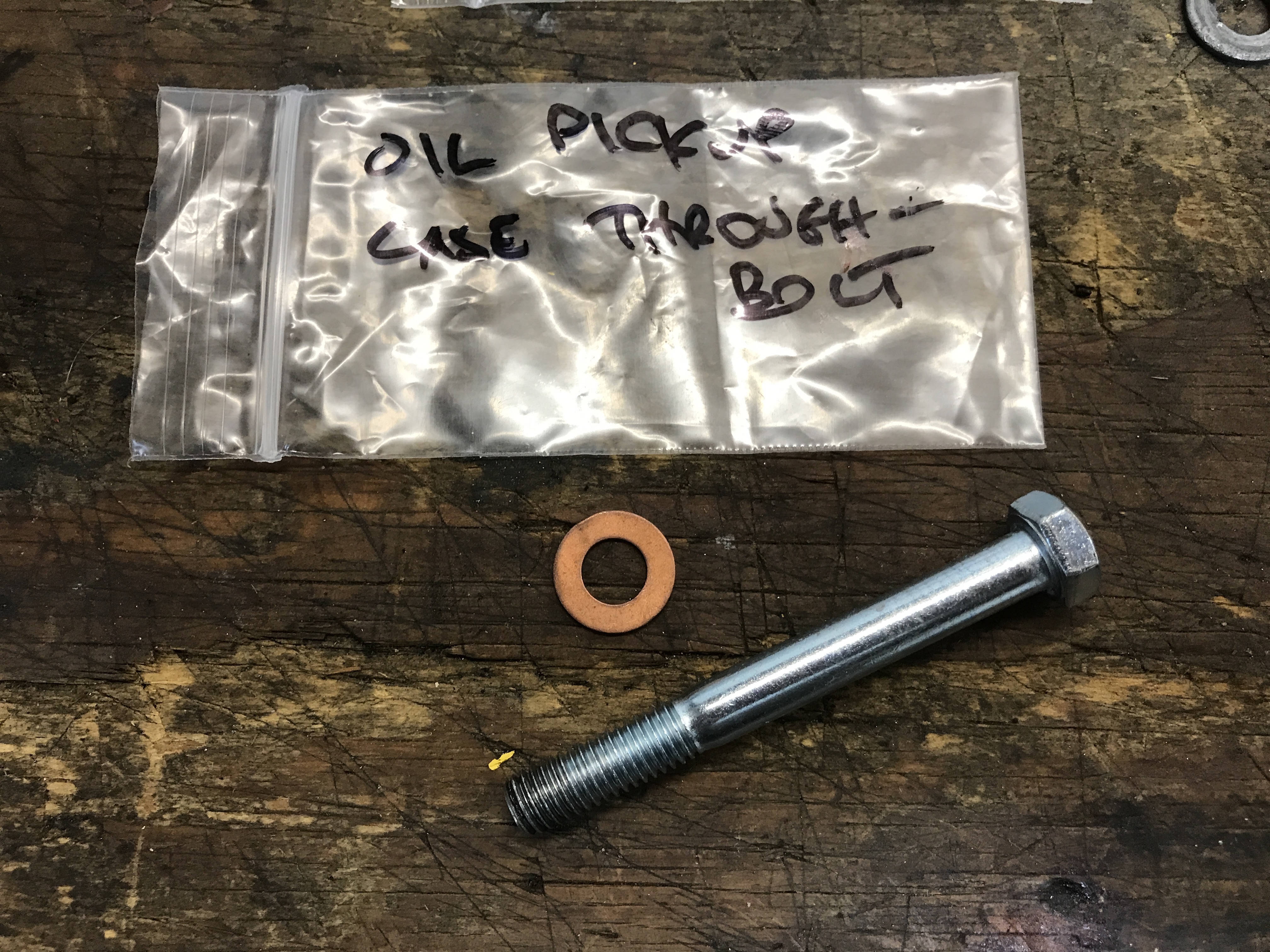

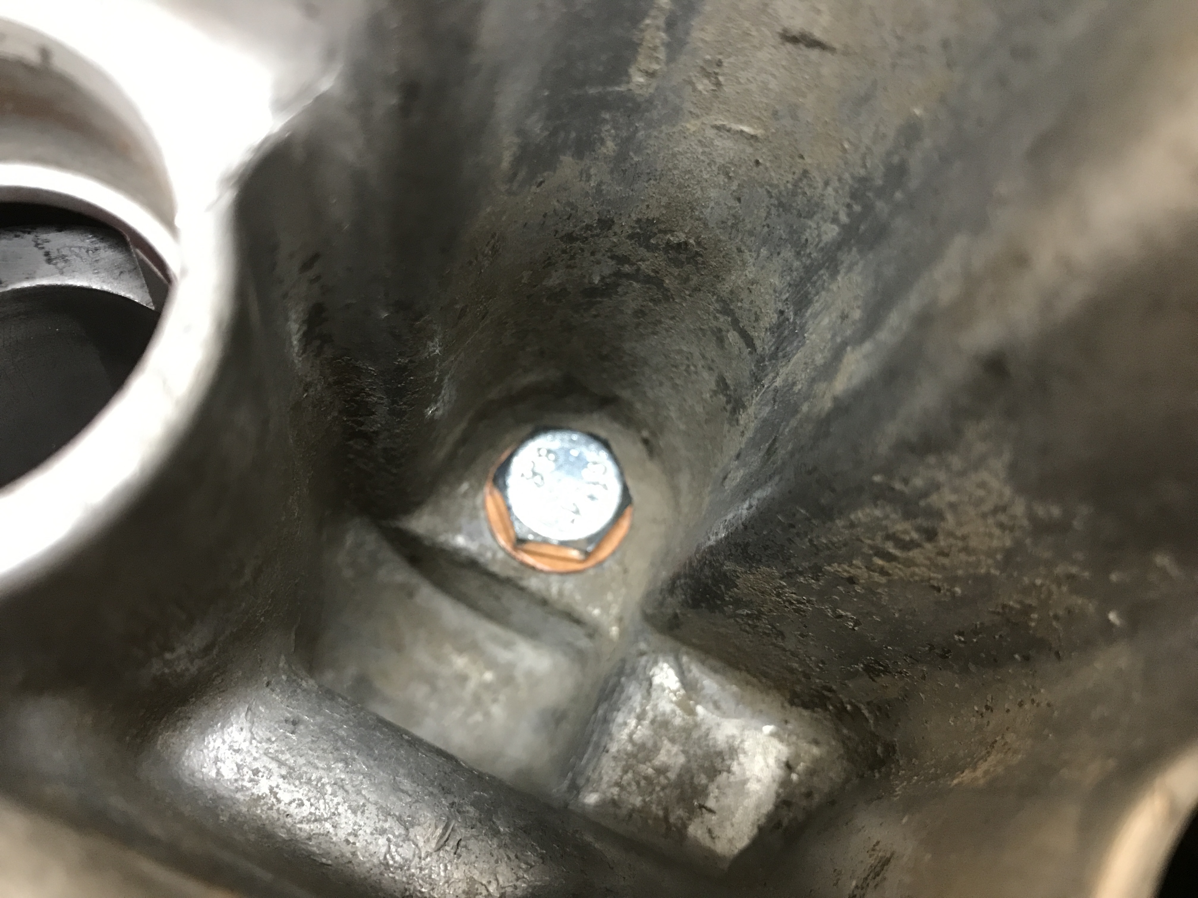

With a new case bolt for the oil pick-up and strainer retainer, I found the copper seal washer.
post May 23 2021, 07:24 PM
Post #2805
Posts: 8,800
Done.

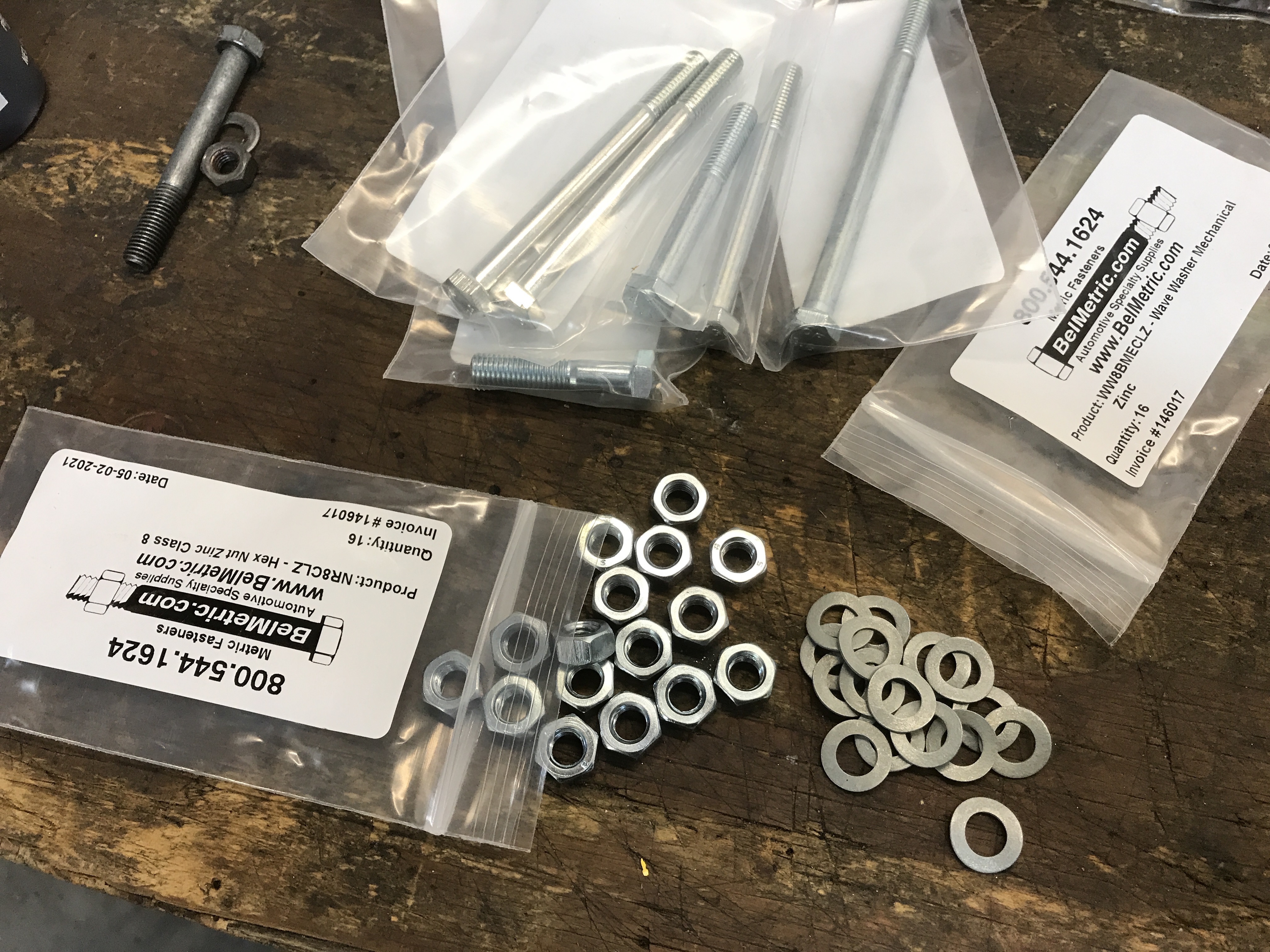

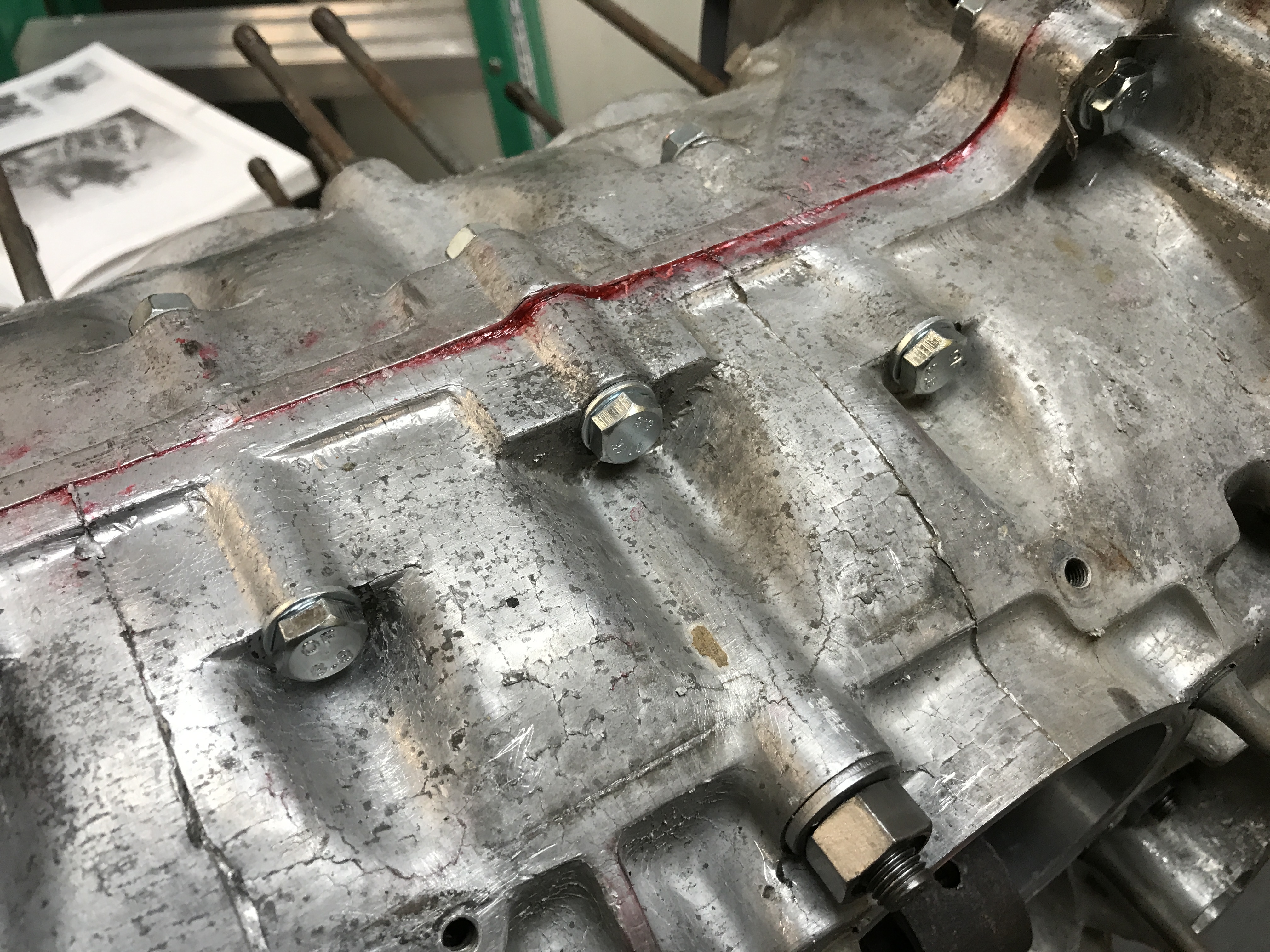

Along with that bolt, I got shiny new hardware for all the case fasteners.
post May 23 2021, 07:26 PM
Post #2807
Posts: 8,800
A bit of bling for the engine case.

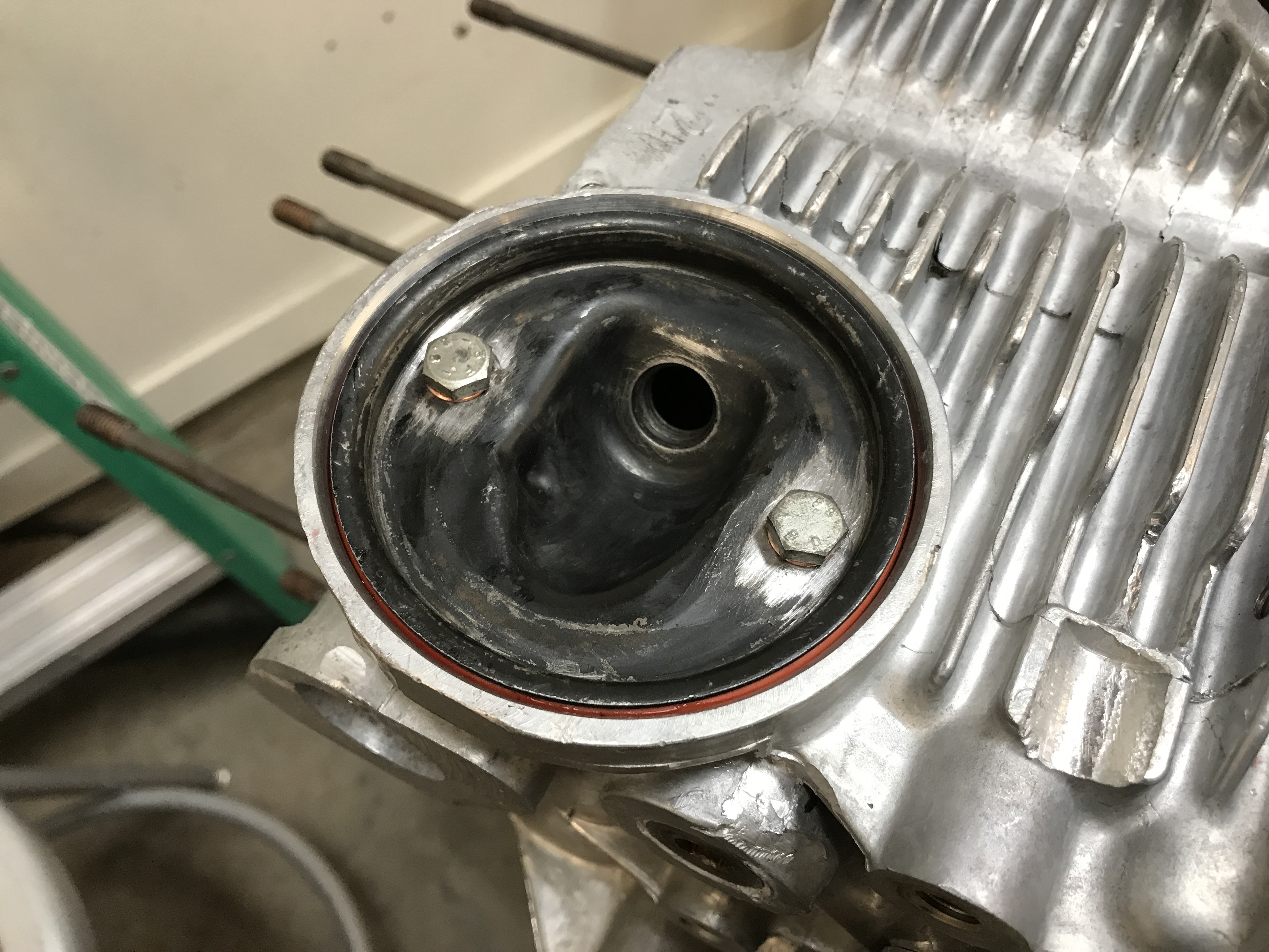

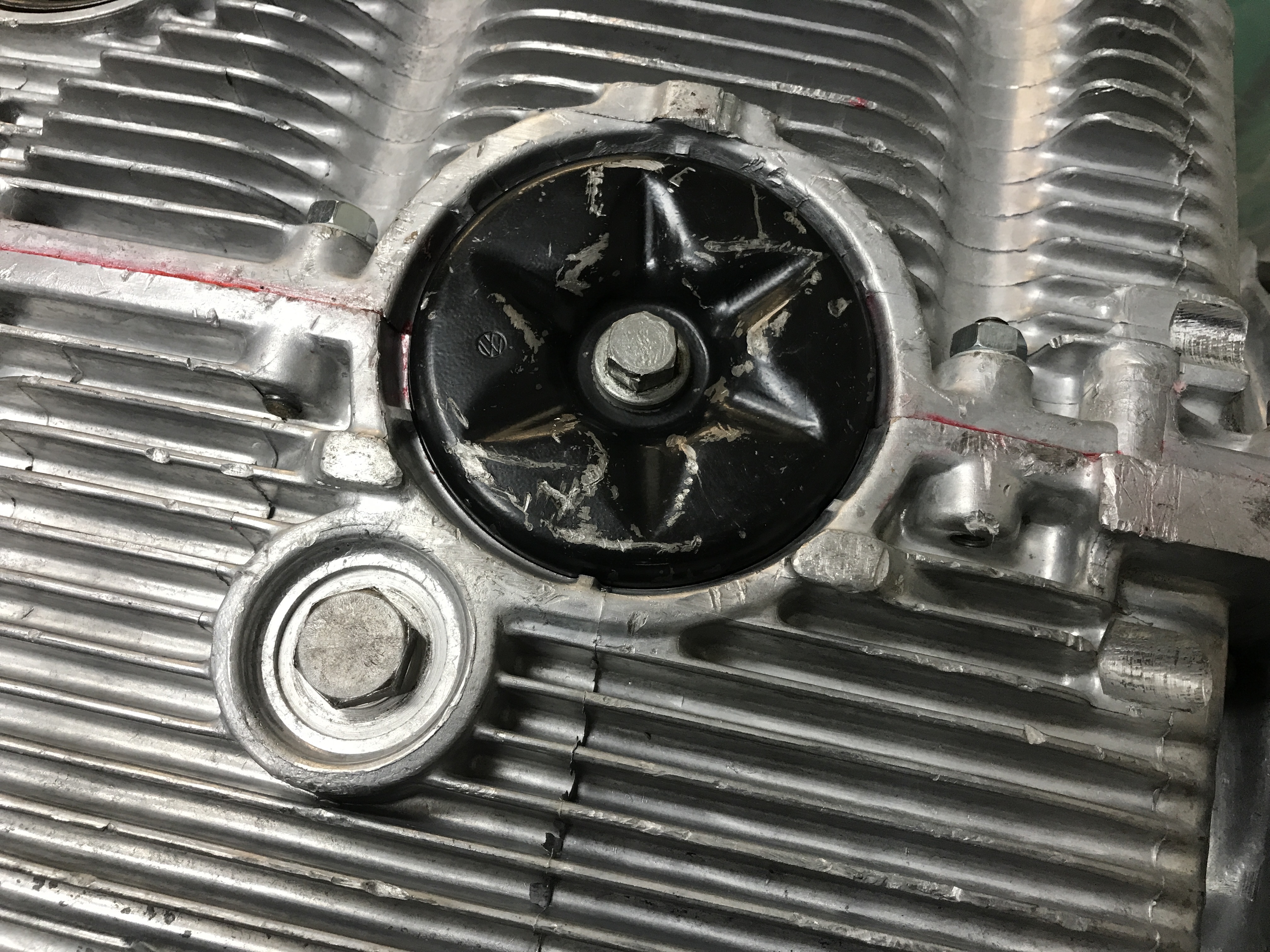

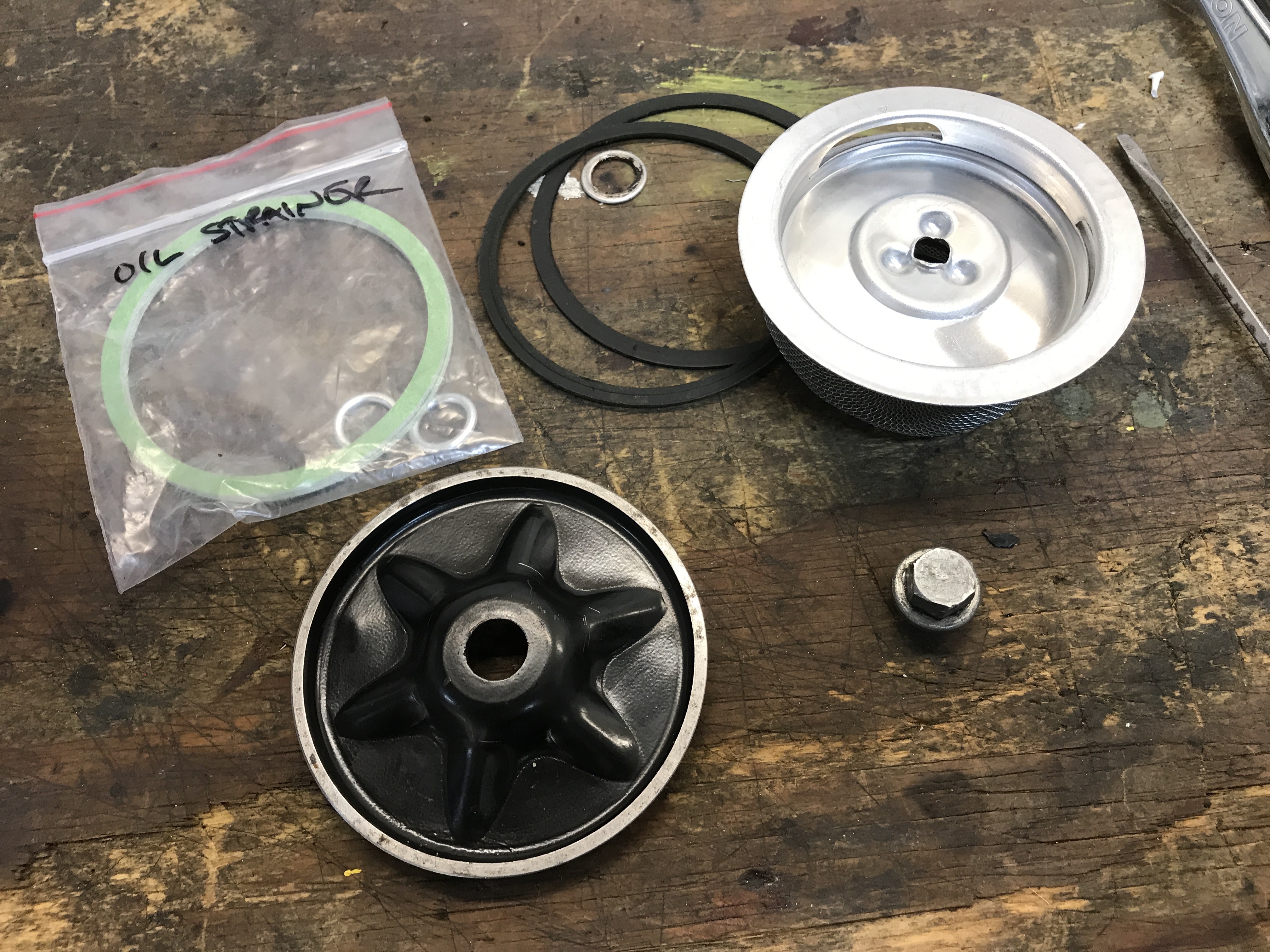

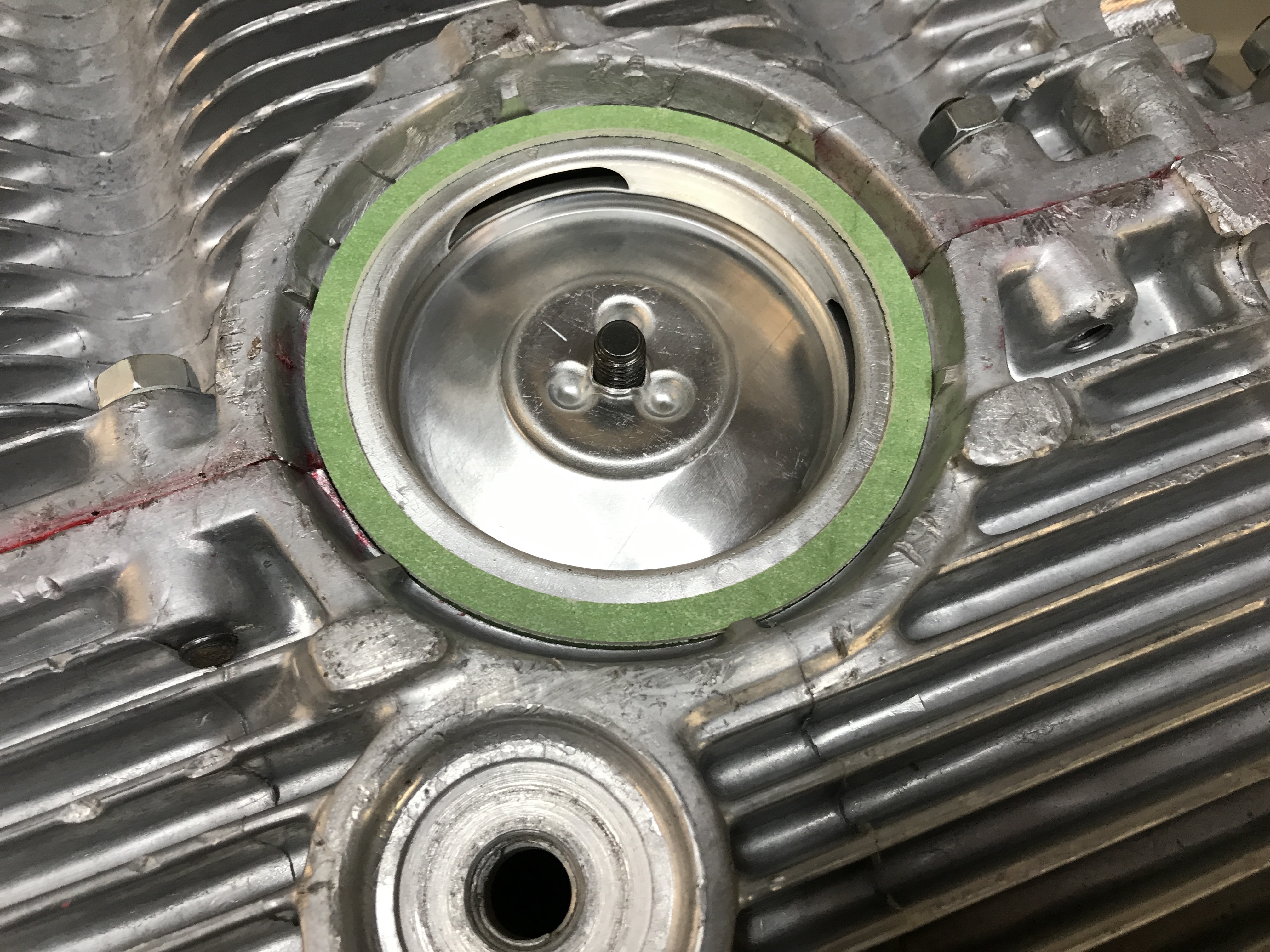

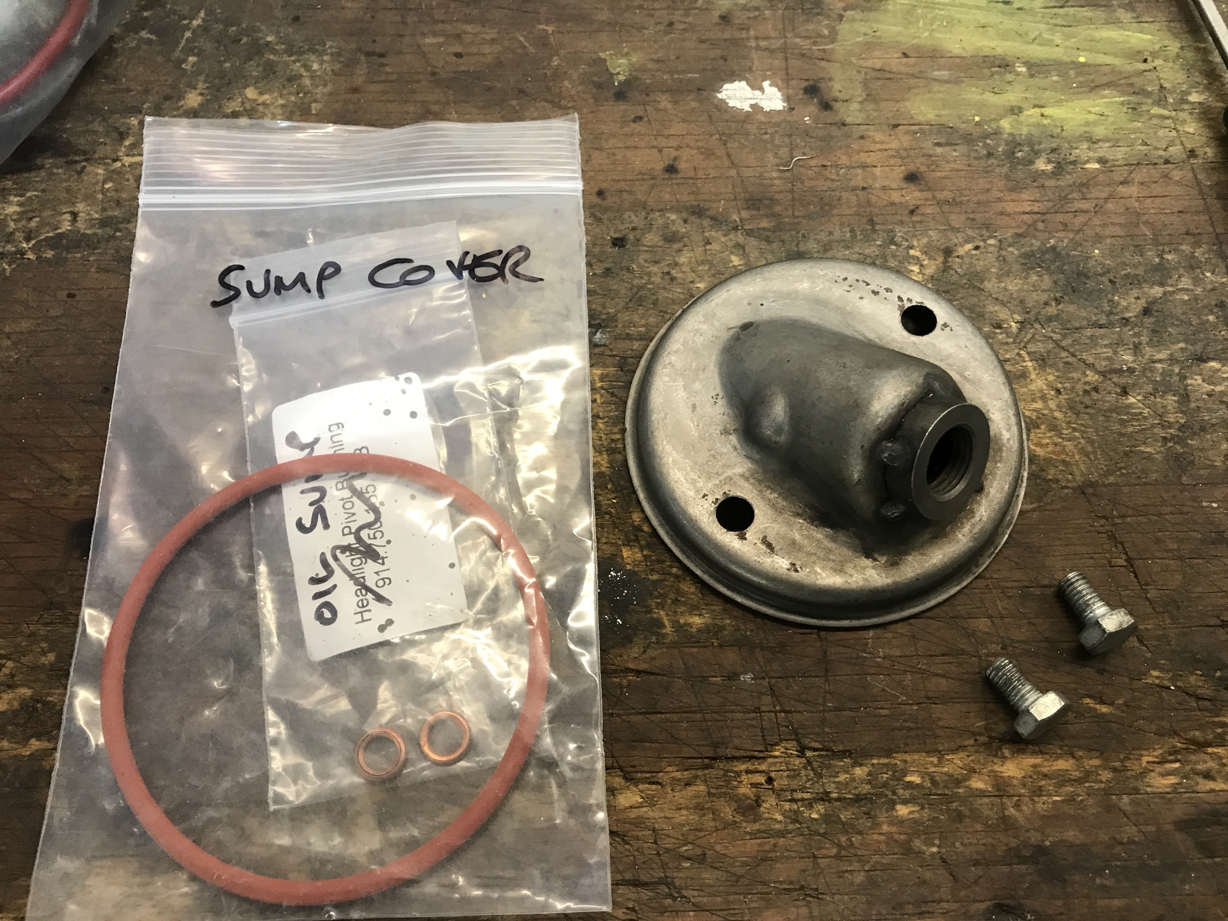

Then the oil strainer.
post May 23 2021, 07:28 PM
Post #2809
Posts: 8,800
Strainer basket with a gasket above and below.
post May 23 2021, 07:35 PM
Post #2810
Posts: 8,800
Strainer cover, retaining nut, and drain plug, all with new crush washers.
post May 23 2021, 07:36 PM
Post #2811
Posts: 8,800
Then the taco plate, for the oil temp sensor.
post May 23 2021, 07:37 PM
Post #2812
Posts: 8,800
Installed (without cover for now).

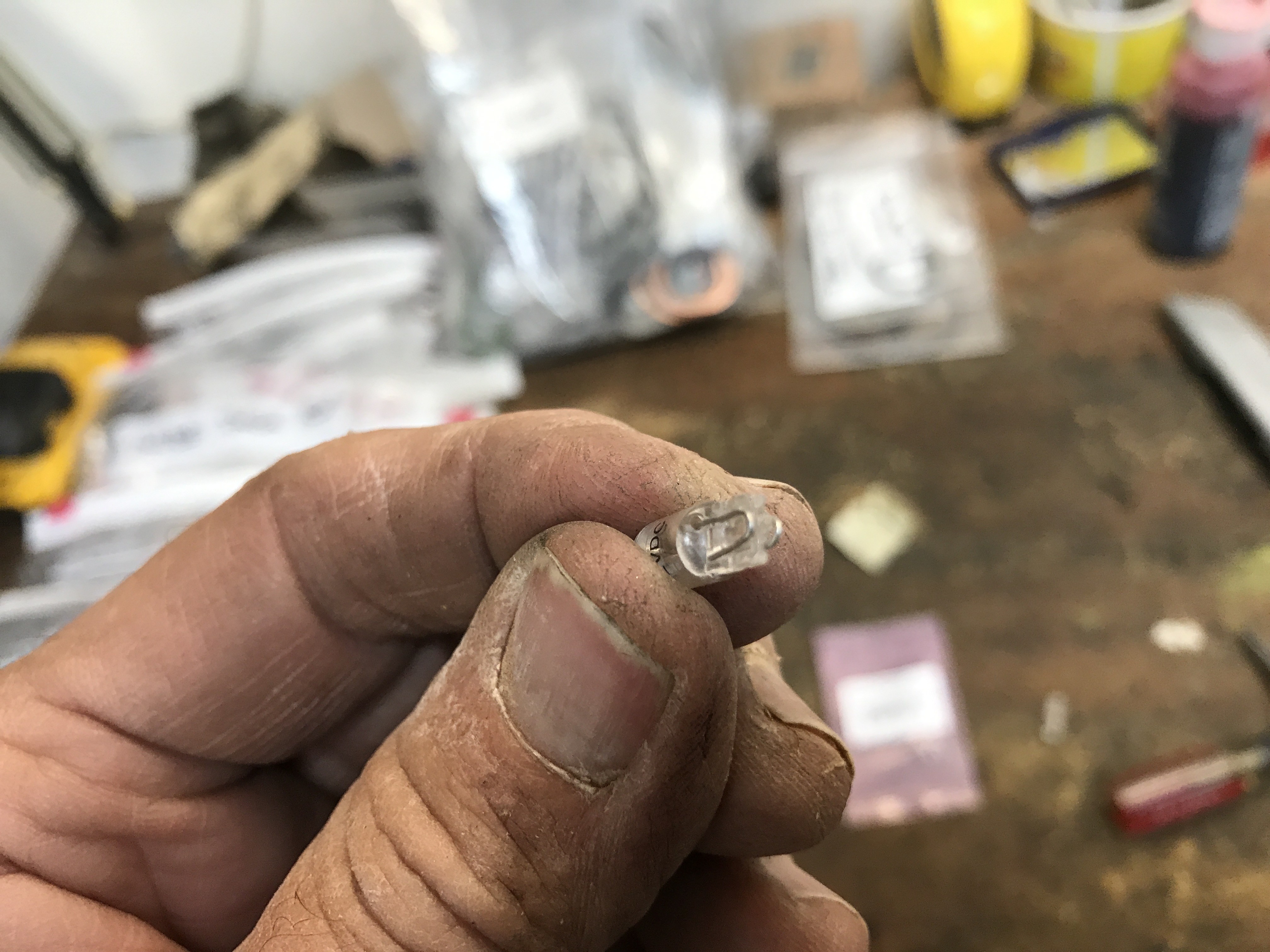

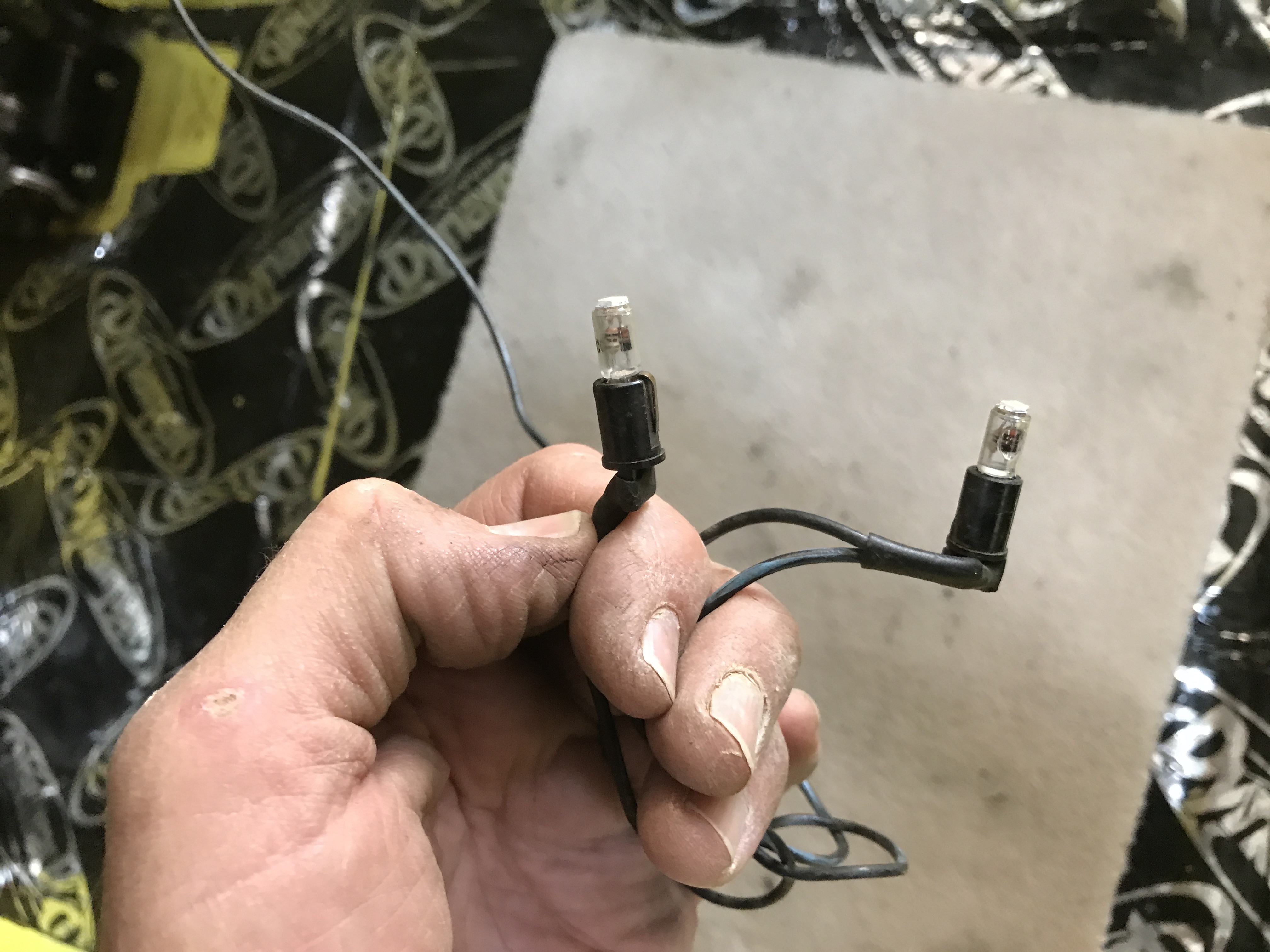

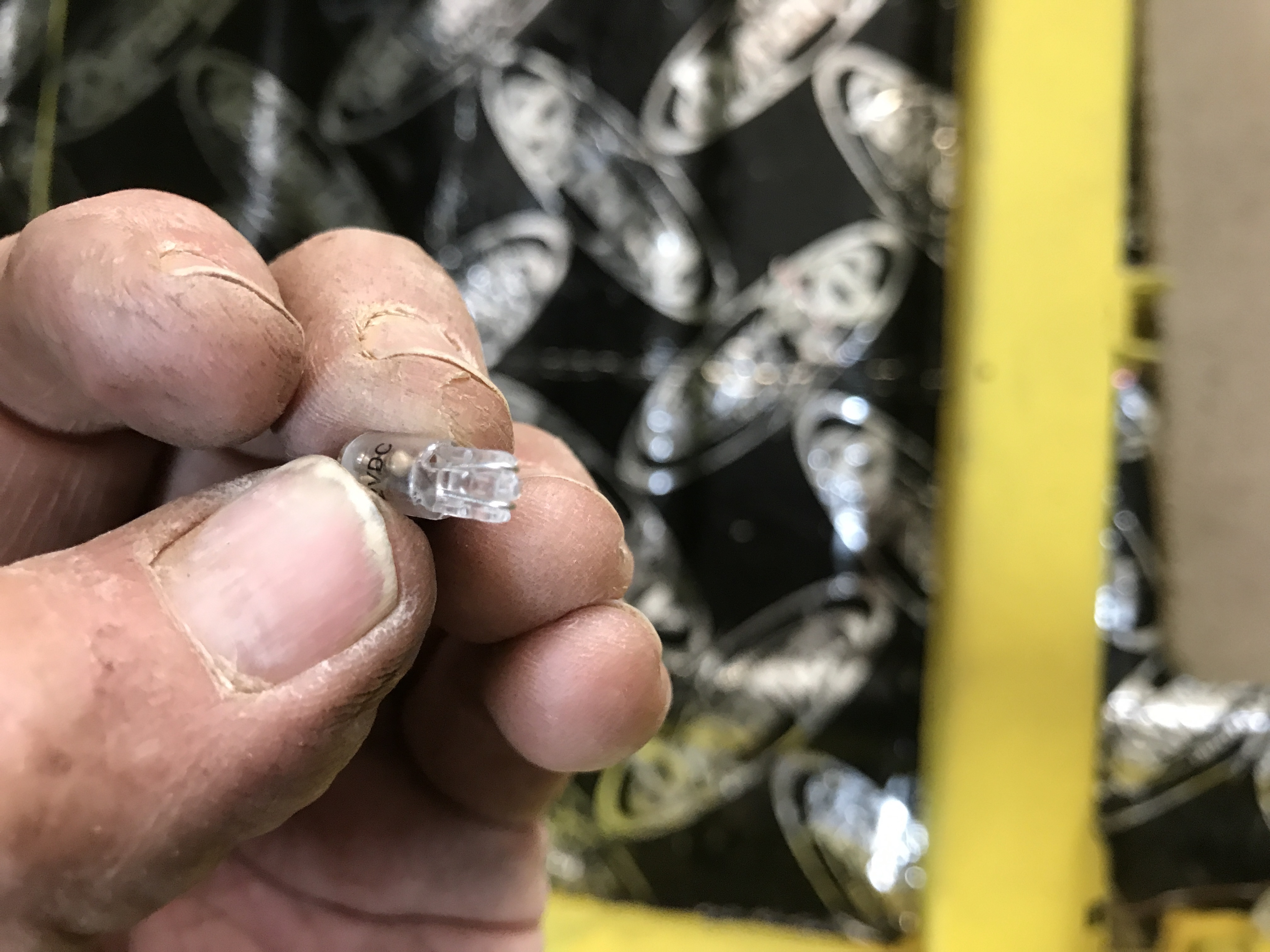

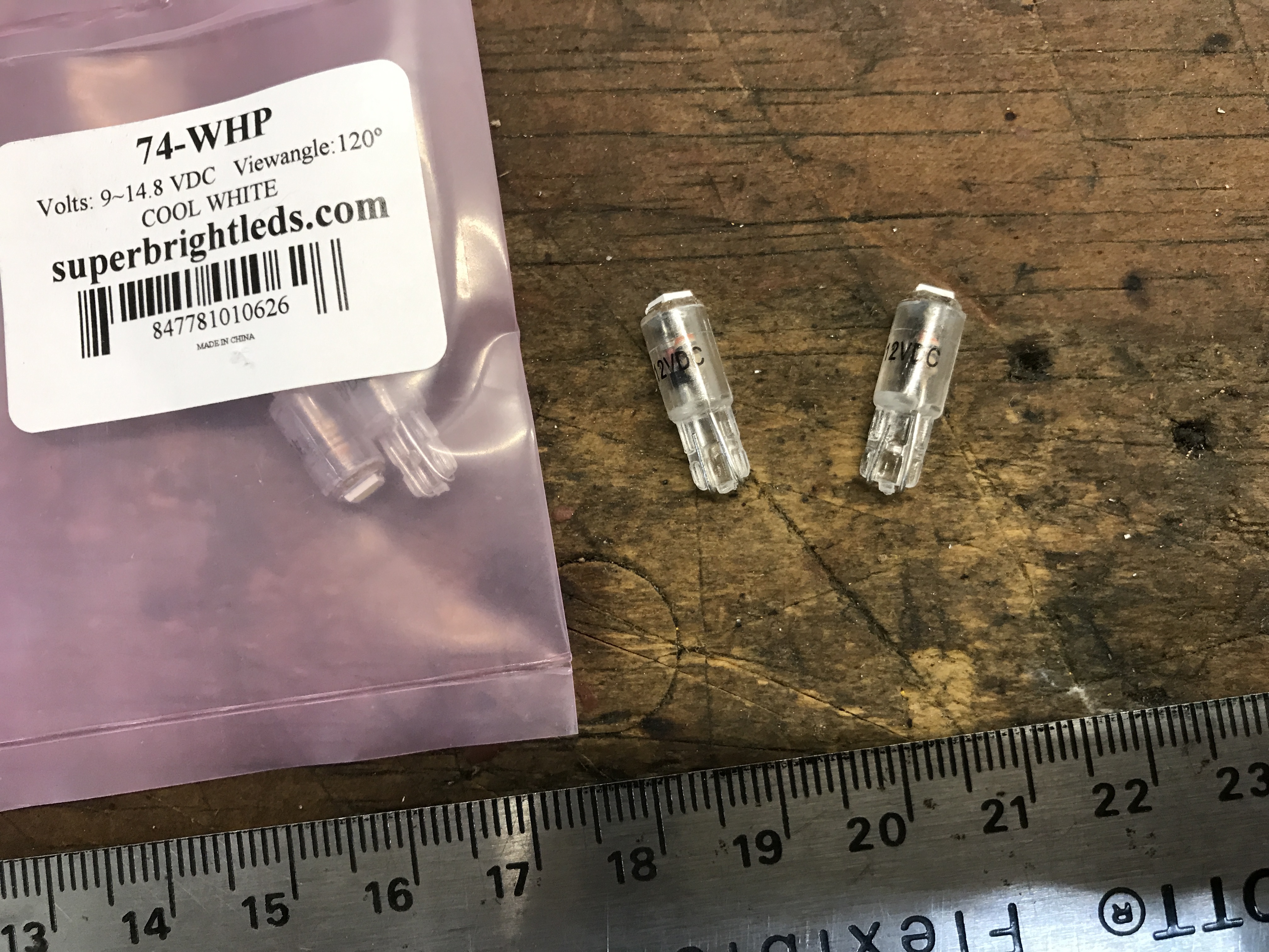

I also got the tiny LED bulbs for the indicator lights in the ventilation controls.
post May 23 2021, 07:40 PM
Post #2814
Posts: 8,800

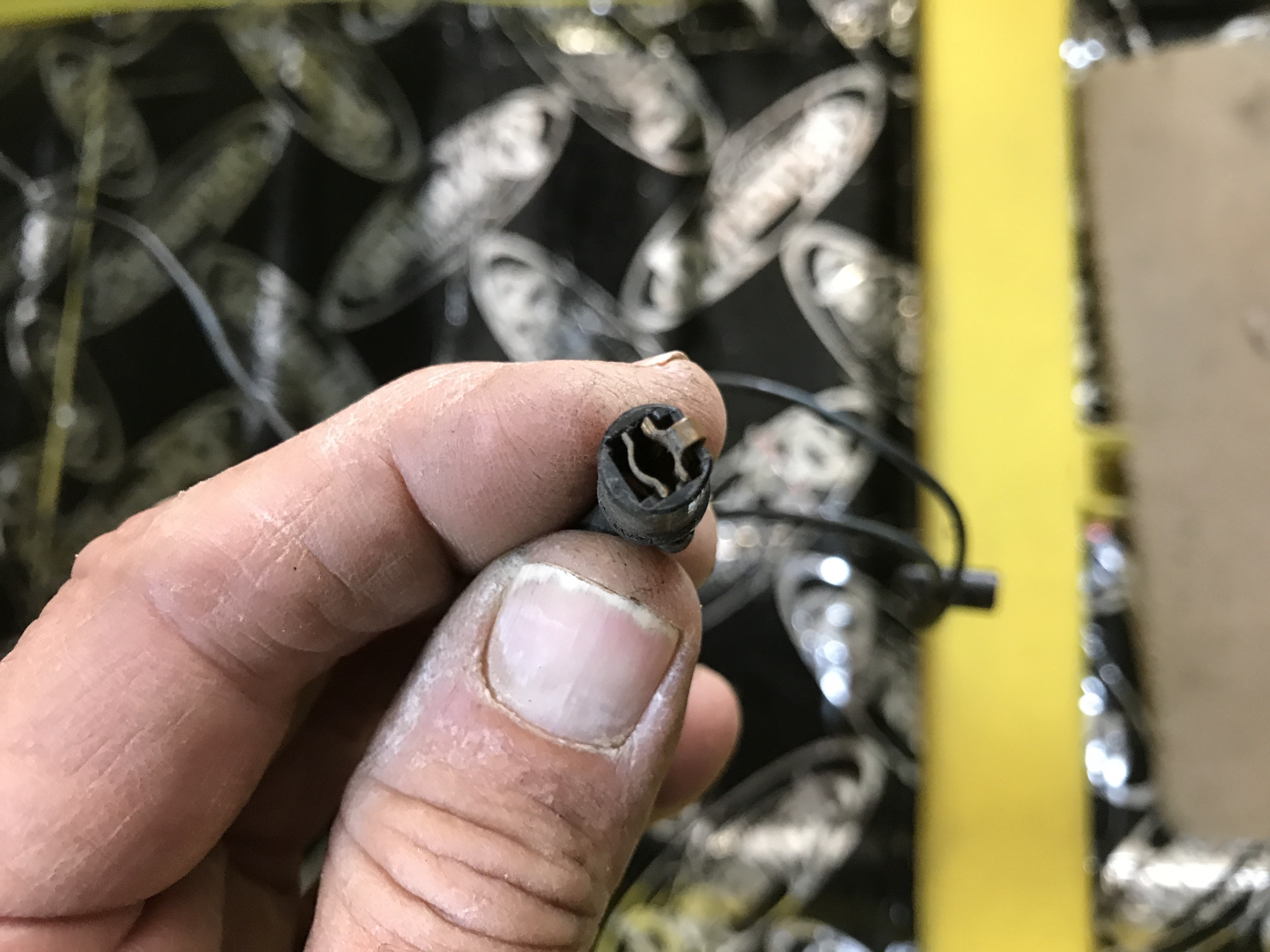

But these have positive and negative leads that bend over from one side of the tab to the other.
post May 23 2021, 07:42 PM
Post #2815
Posts: 8,800
But the sockets have negative and positive leads on either side of the tab.
post May 23 2021, 07:44 PM
Post #2816
Posts: 8,800
So I re-bent the leads on the bulb to keep each polarity on one side of the tab.
Post #2817
Posts: 8,800
With that mod, I inserted bulbs into the 2 sockets.
post May 23 2021, 07:45 PM
Post #2818
Posts: 8,800
And put those into the left and right side of the ventilation controller.

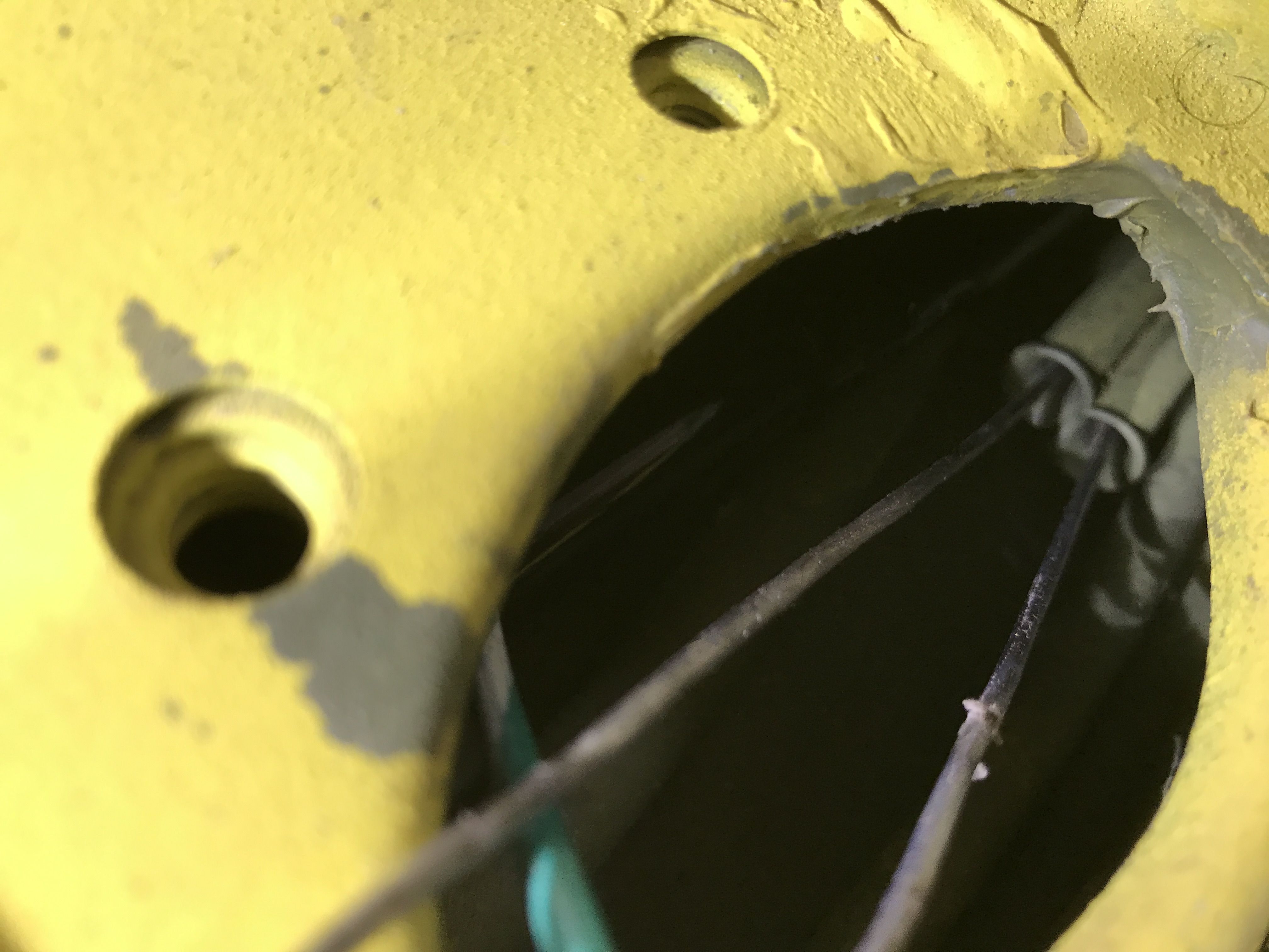

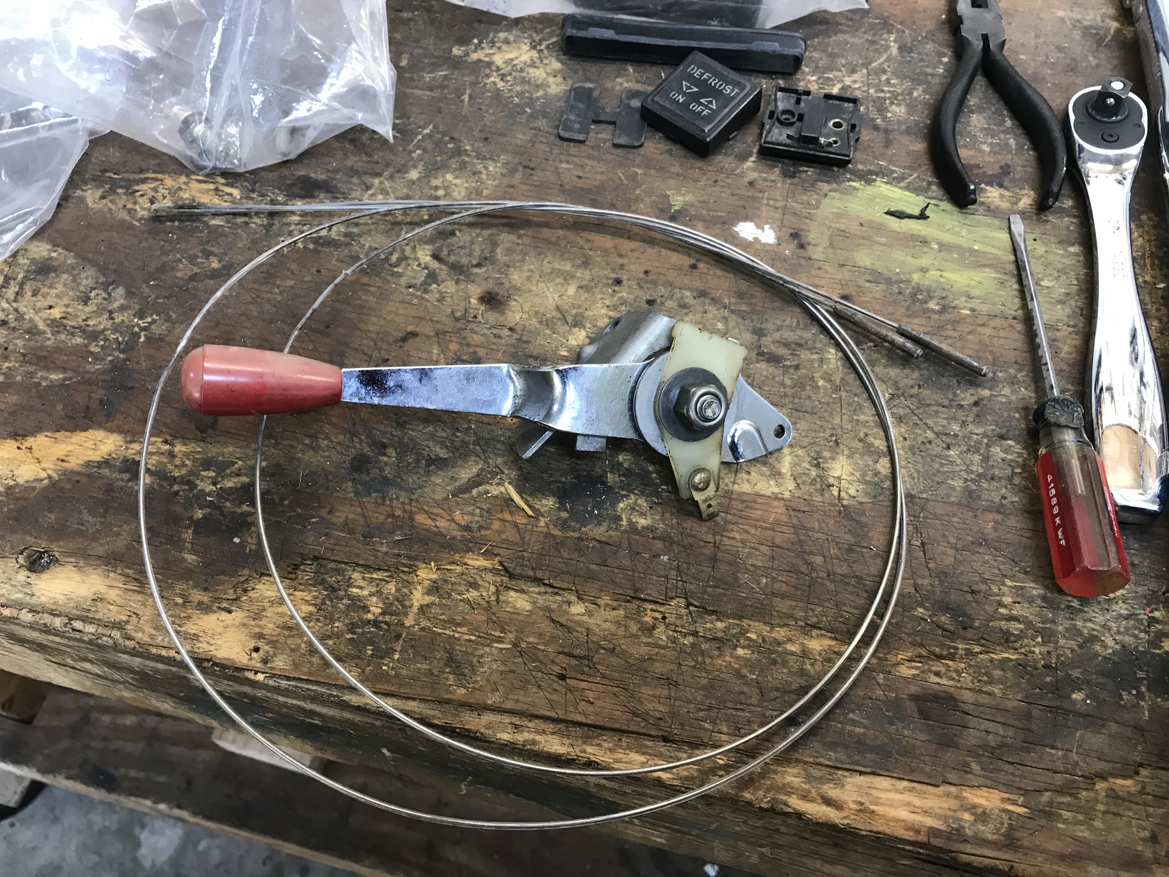

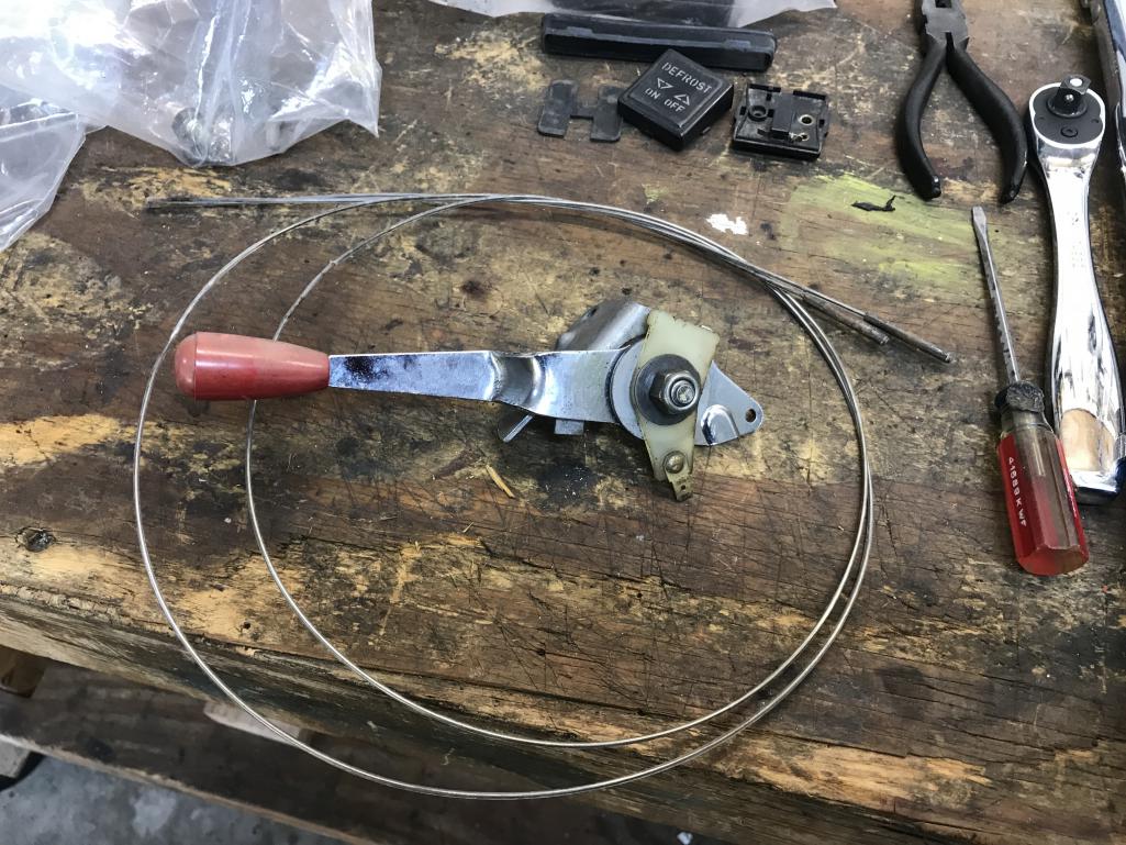

Next, I got out the heat control lever and cable. I rebuilt the lever months ago (but now the knob looks a little shabby).
post May 23 2021, 07:49 PM
Post #2820
Posts: 8,800
I fed the cable ends into the tubes in the tunnel, with the longer cable going into the right side tube.
