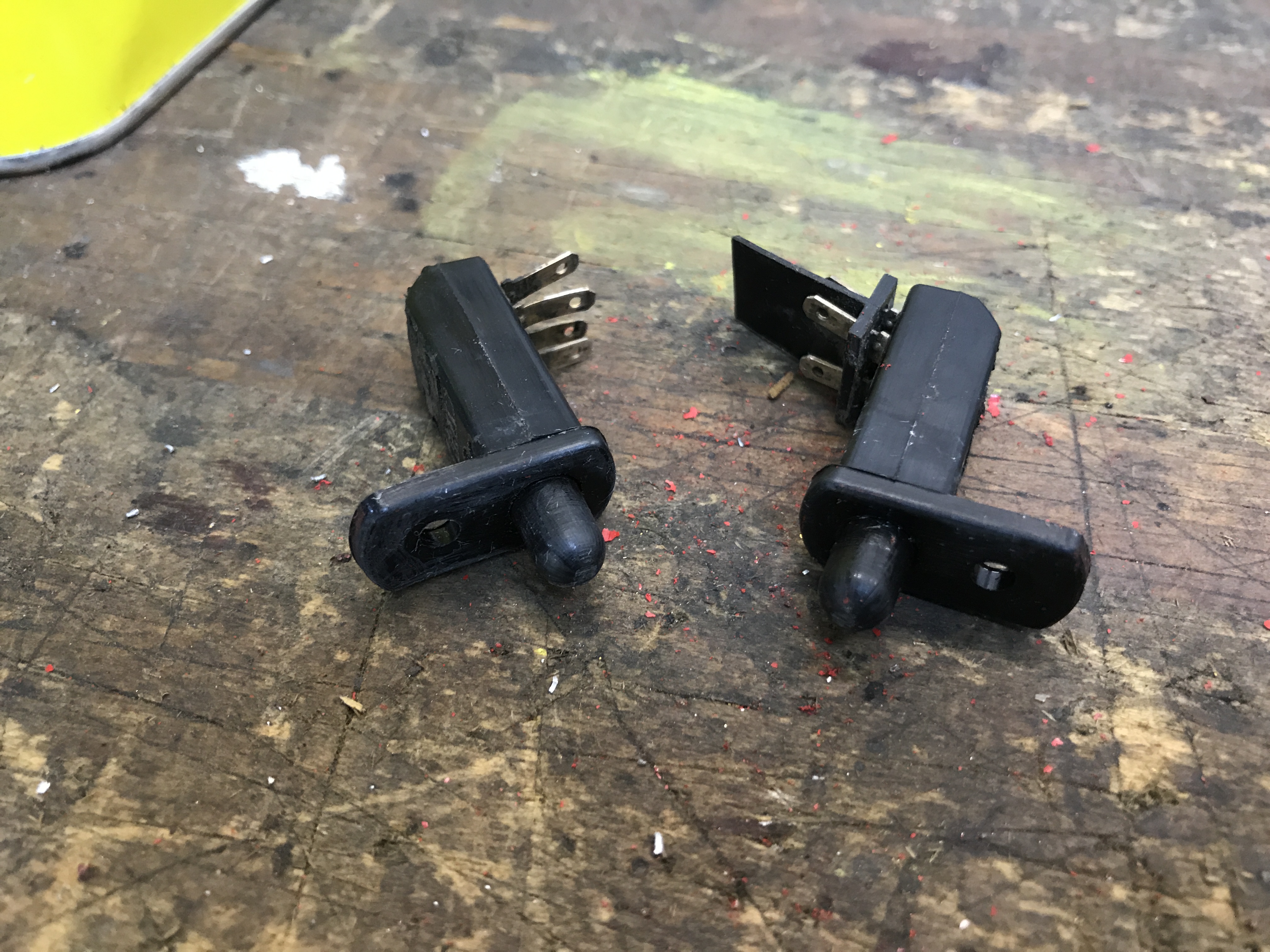

More electrical bits today. I got out and cleaned red overspray from the door switches.

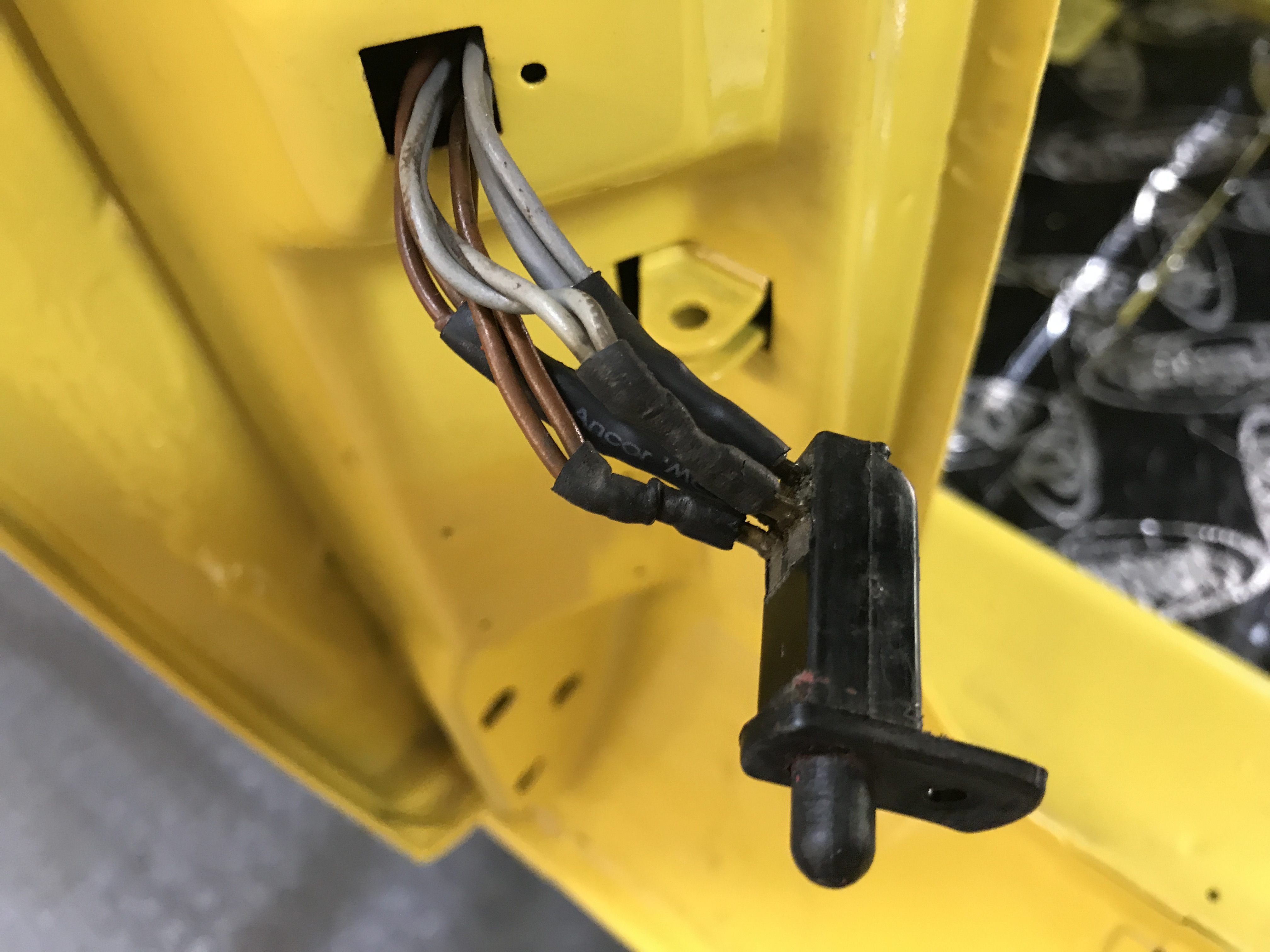

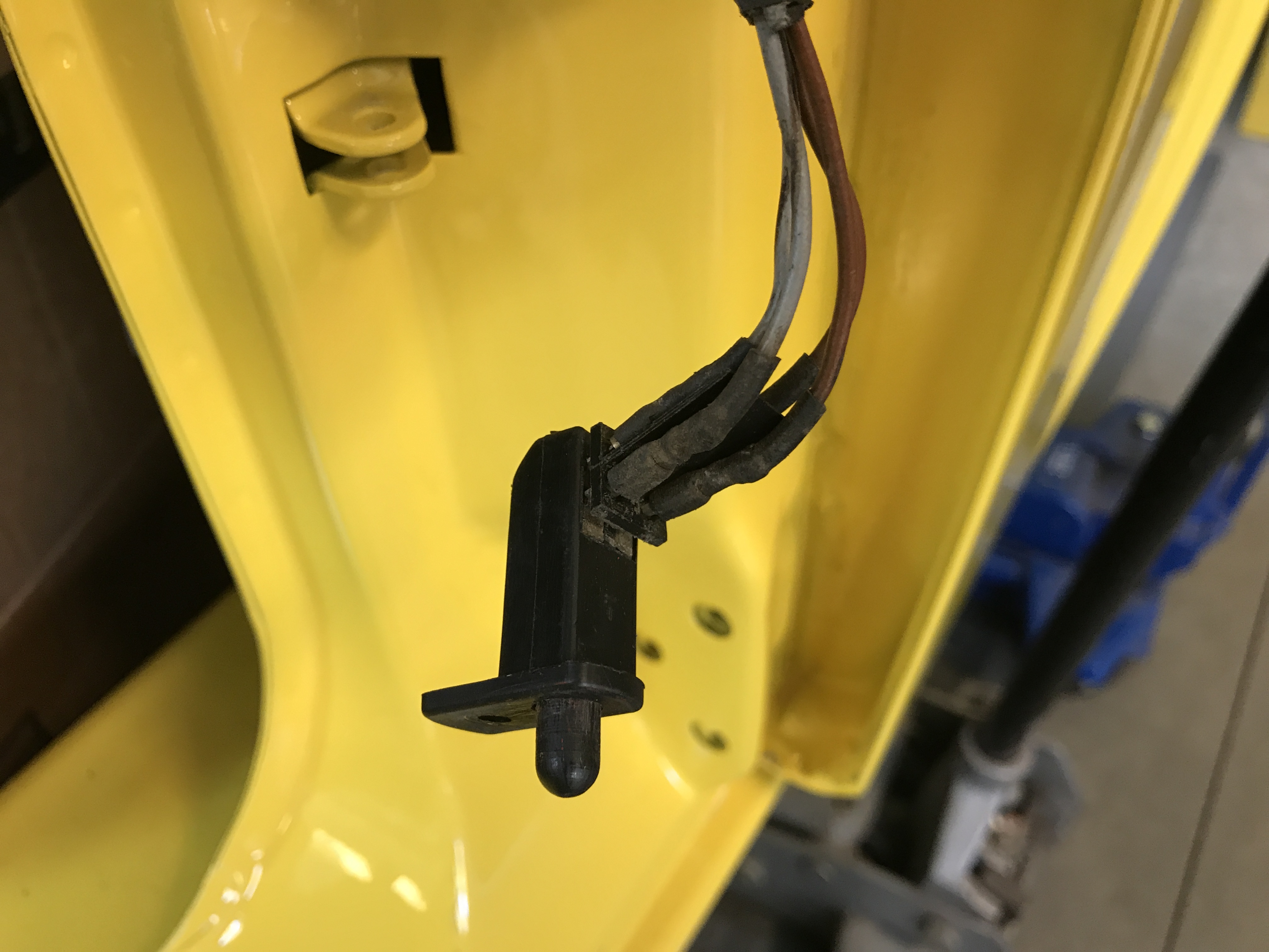

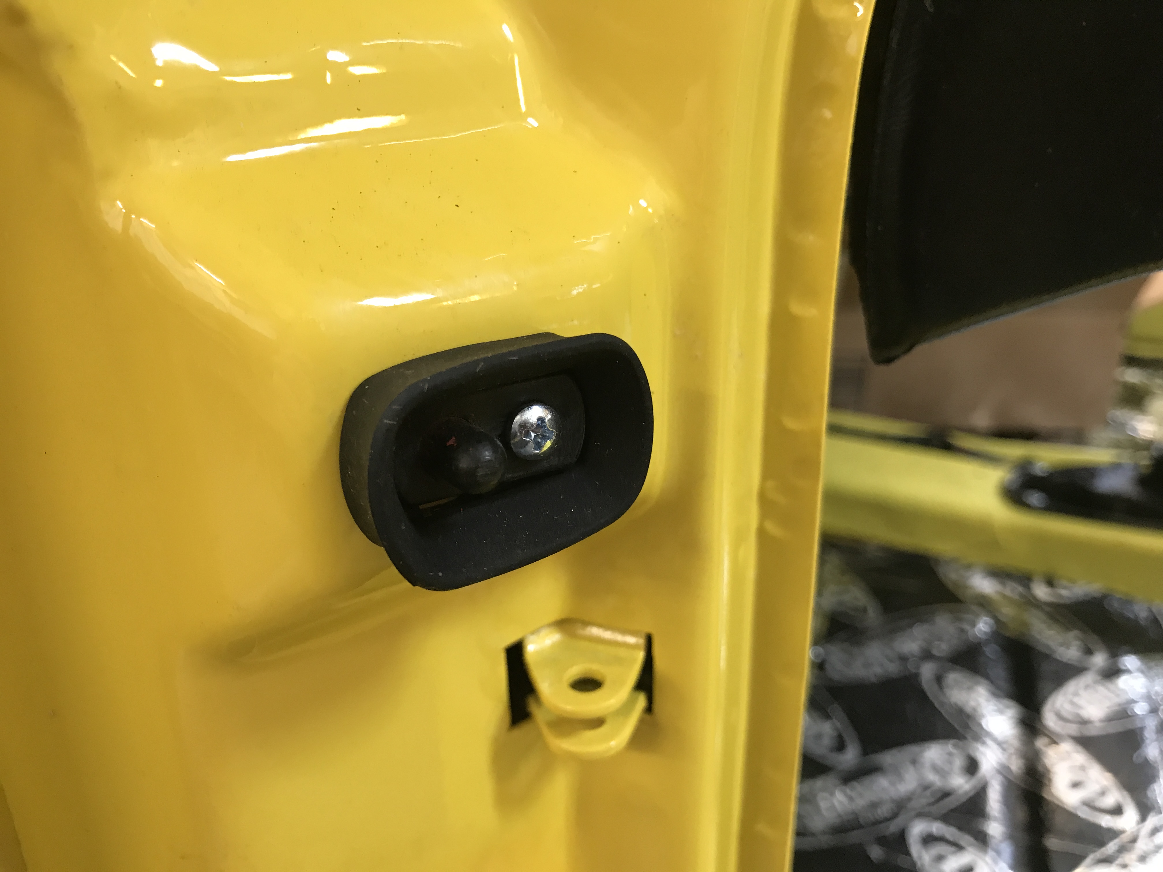

Posts: 8,800
And connected the leads. Left side.
post May 25 2021, 06:52 PM
Post #2843
Posts: 8,800
And right.
post May 25 2021, 06:53 PM
Post #2844
Posts: 8,800

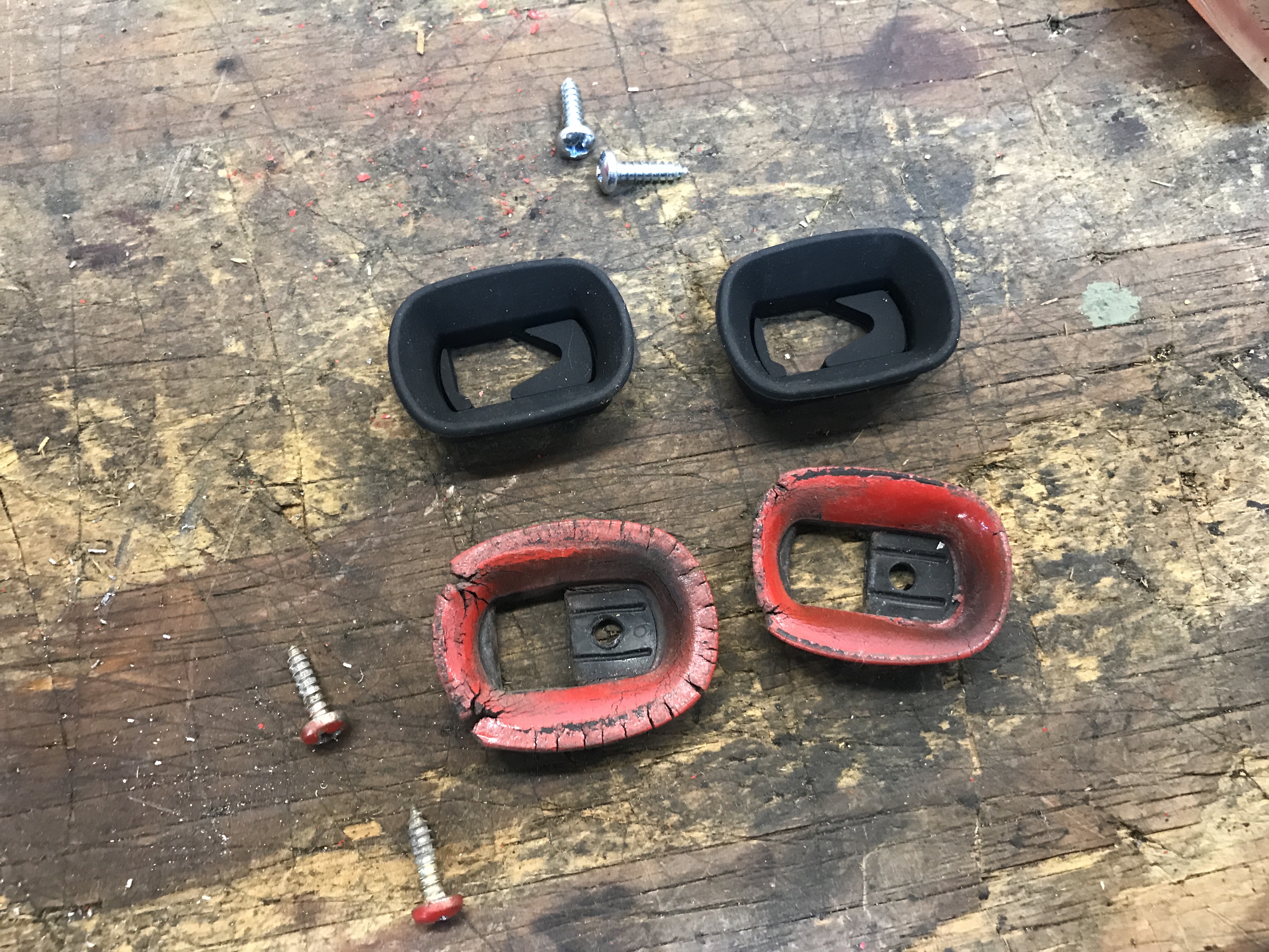

Some new rubber boots and screws.

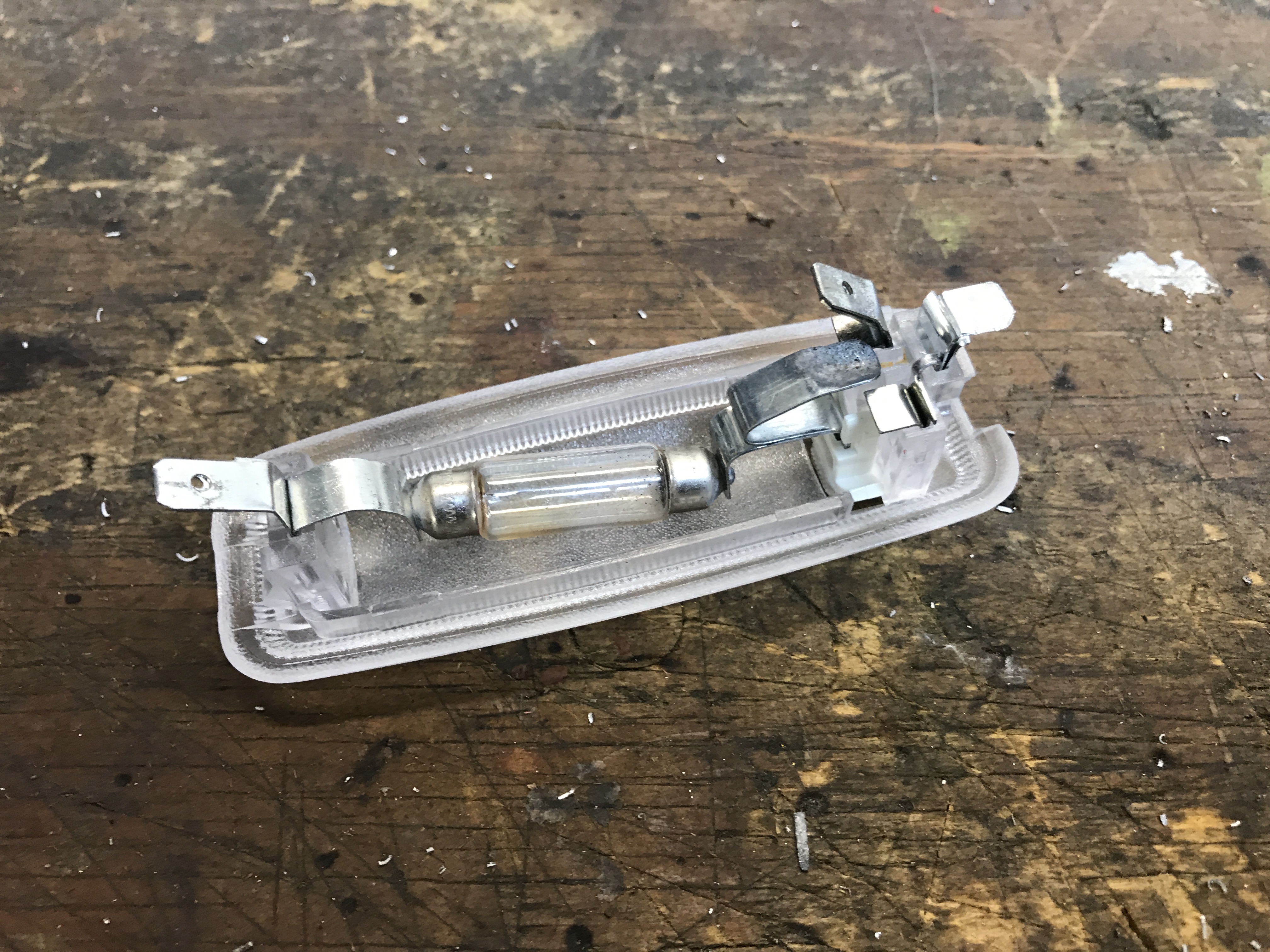

Posts: 8,800

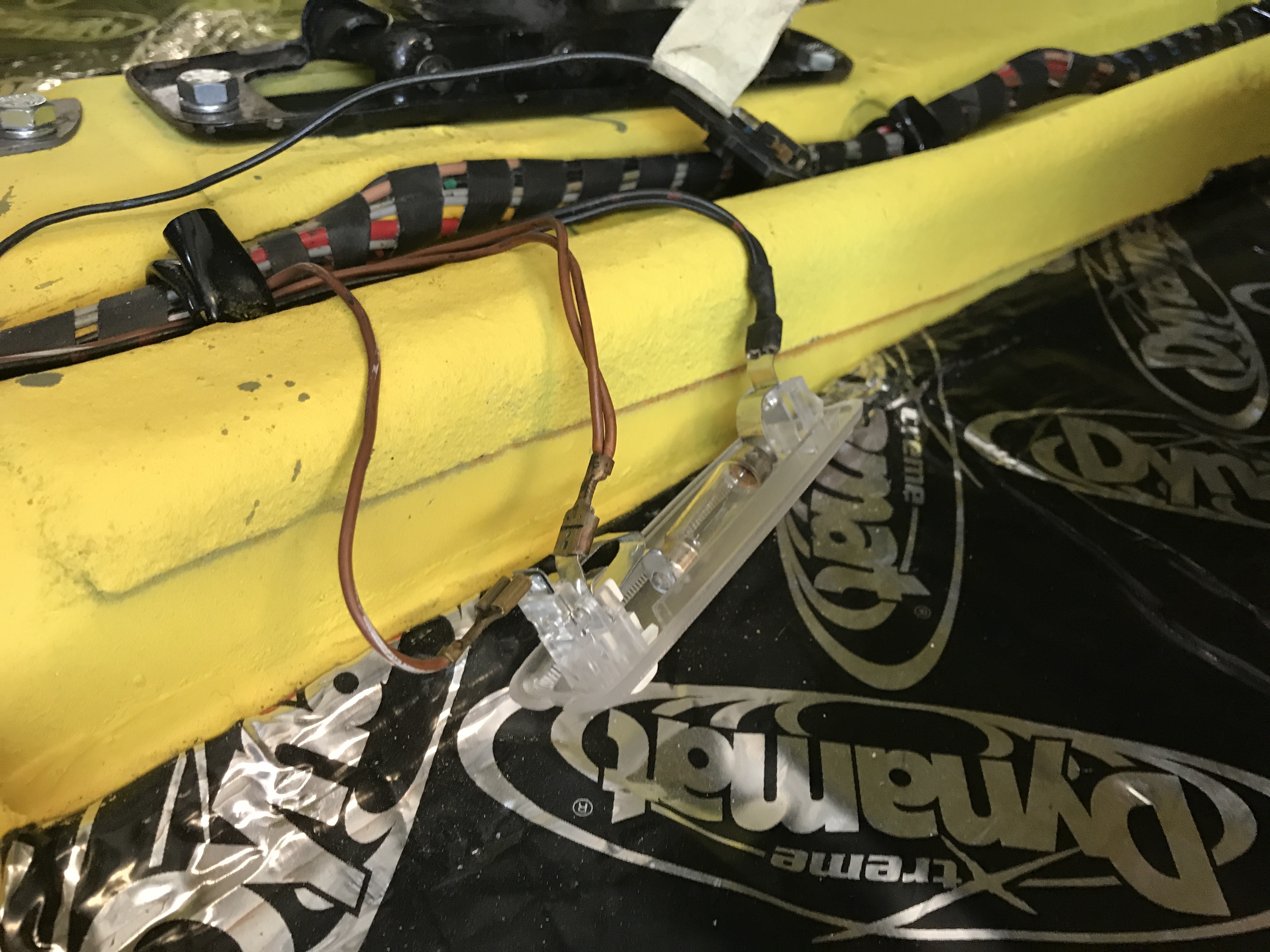

I re-engineered the interior light a bit.
post May 25 2021, 06:57 PM
Post #2847
Posts: 8,800
And connected the existing leads. Note that I have re-routed these towards the front. I plan to add extensions that will reach the dash.
post May 25 2021, 06:58 PM
Post #2848

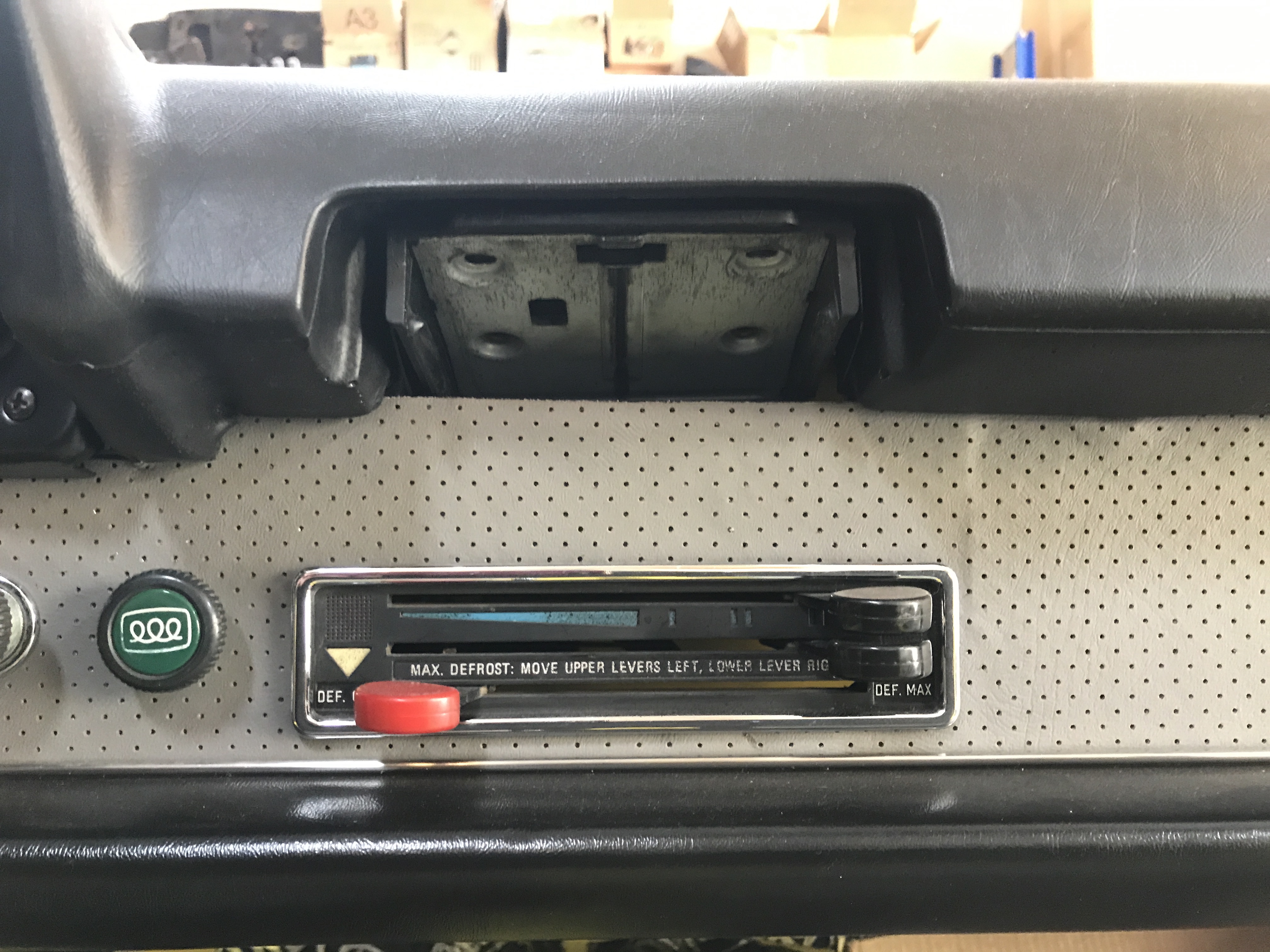

Posts: 8,800
I plan to make a filler for the ash tray slot, and mount the interior light there.

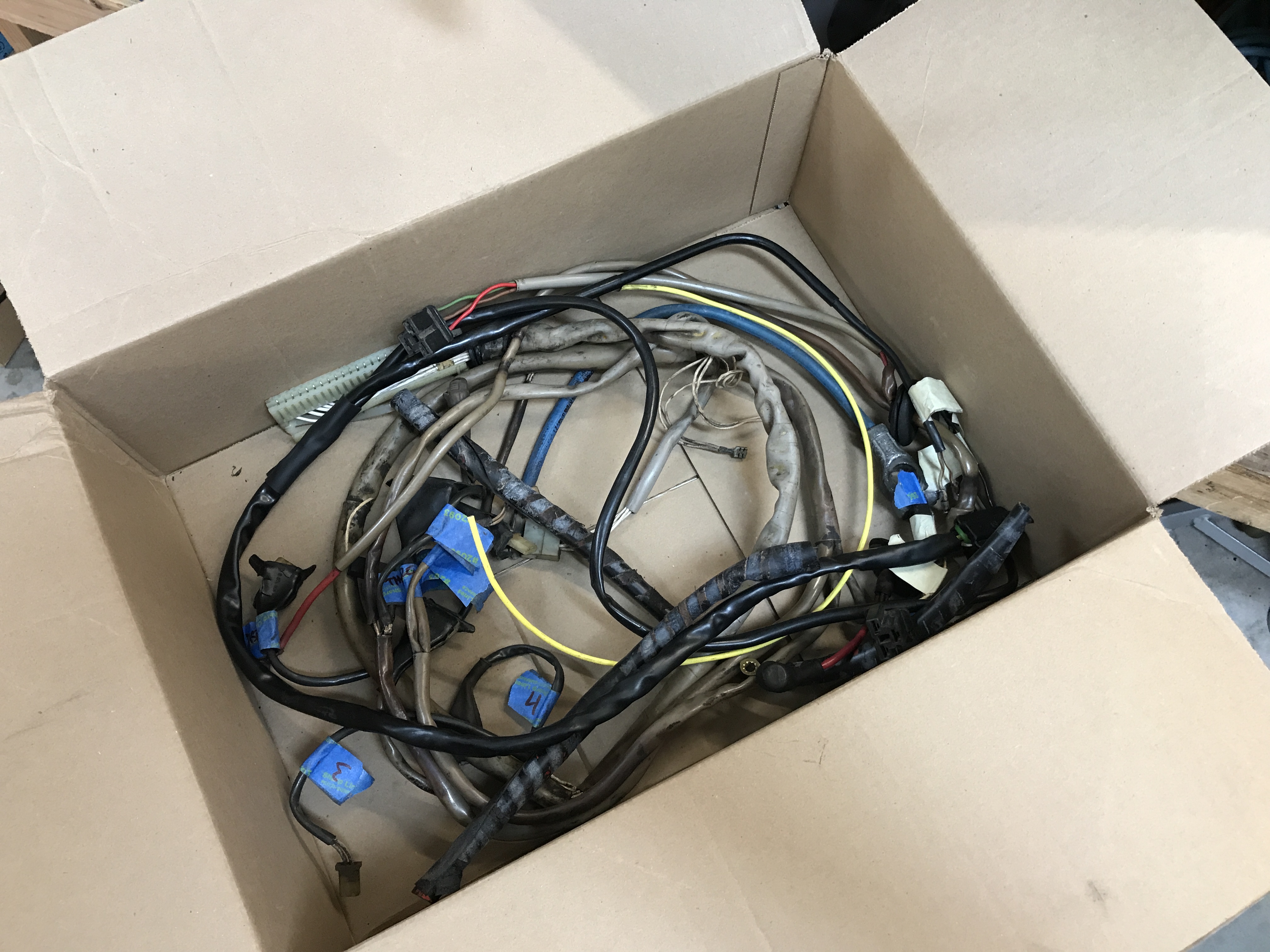

I opened the box with the rest of the wiring harnesses.

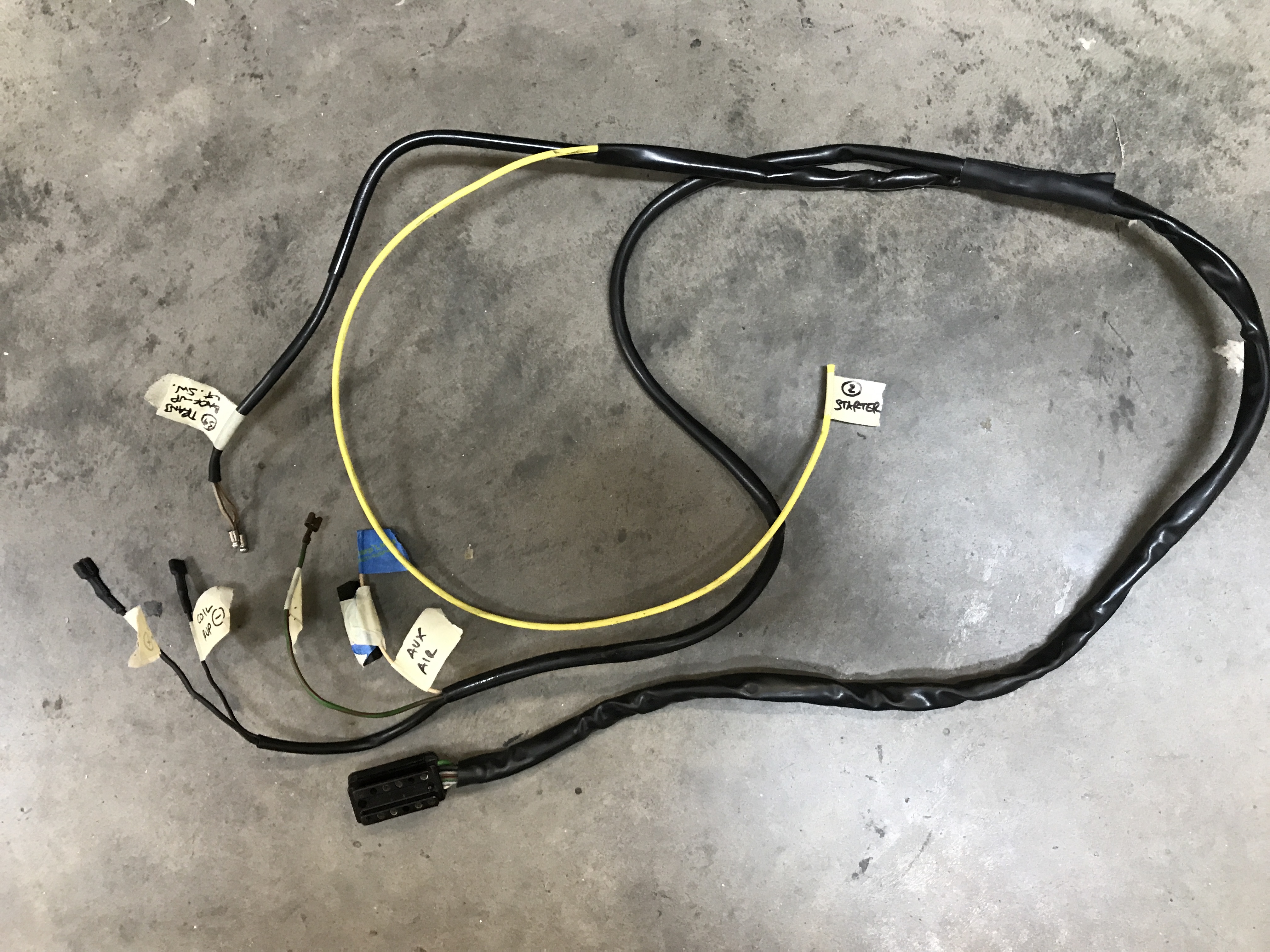

post May 25 2021, 07:01 PM
Post #2850

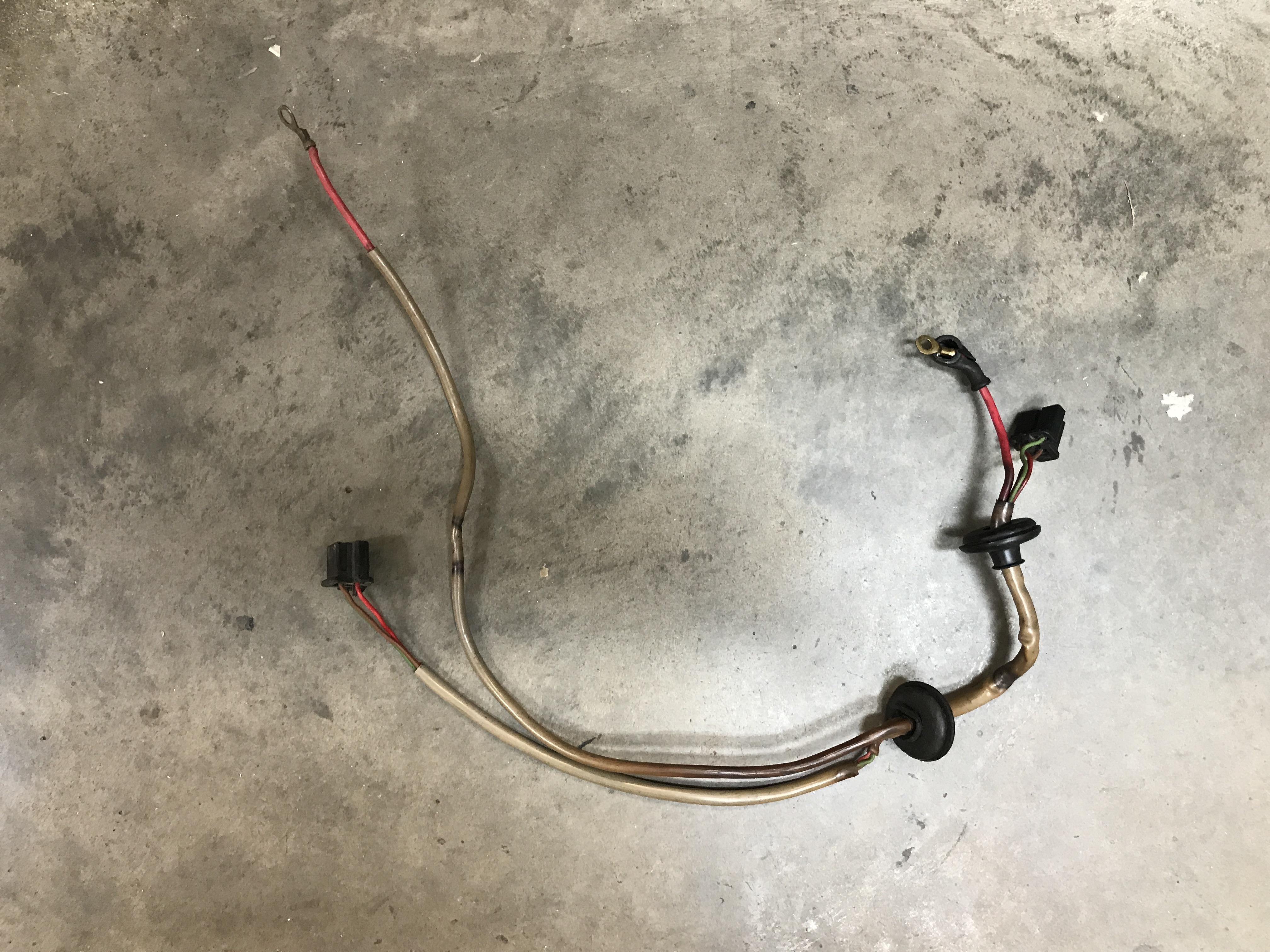

Posts: 8,800
The good(-ish), the harness for the starter, coil, and some other things.
post May 25 2021, 07:02 PM
Post #2851

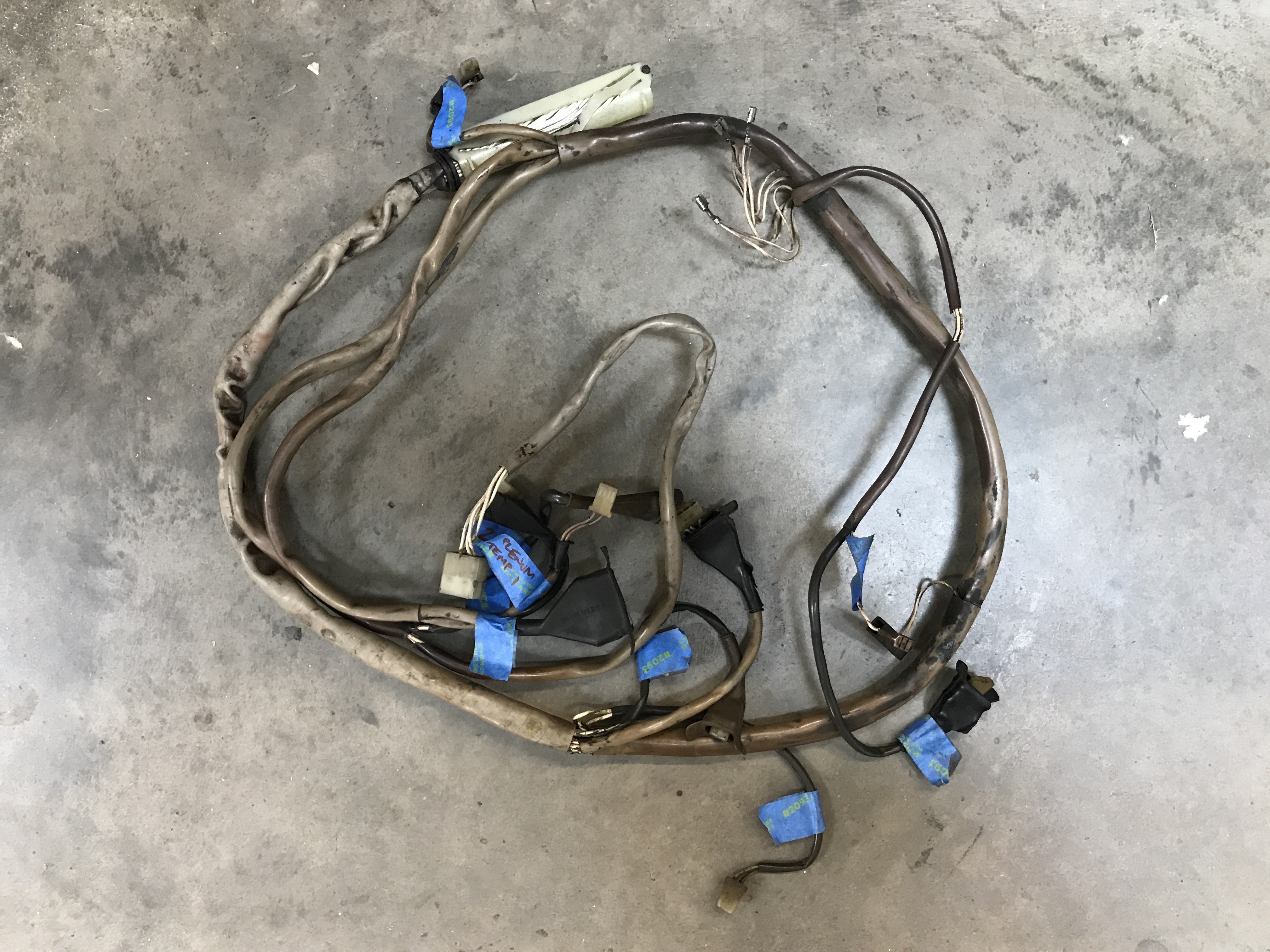

Posts: 8,800
The bad. The harness for the alternator. Intact, but kinda crusty.
post May 25 2021, 07:03 PM
Post #2852
Posts: 8,800
And the ugly. The stock EFI harness. Fortunately, the new Dub Shop EFI will replace all of this.

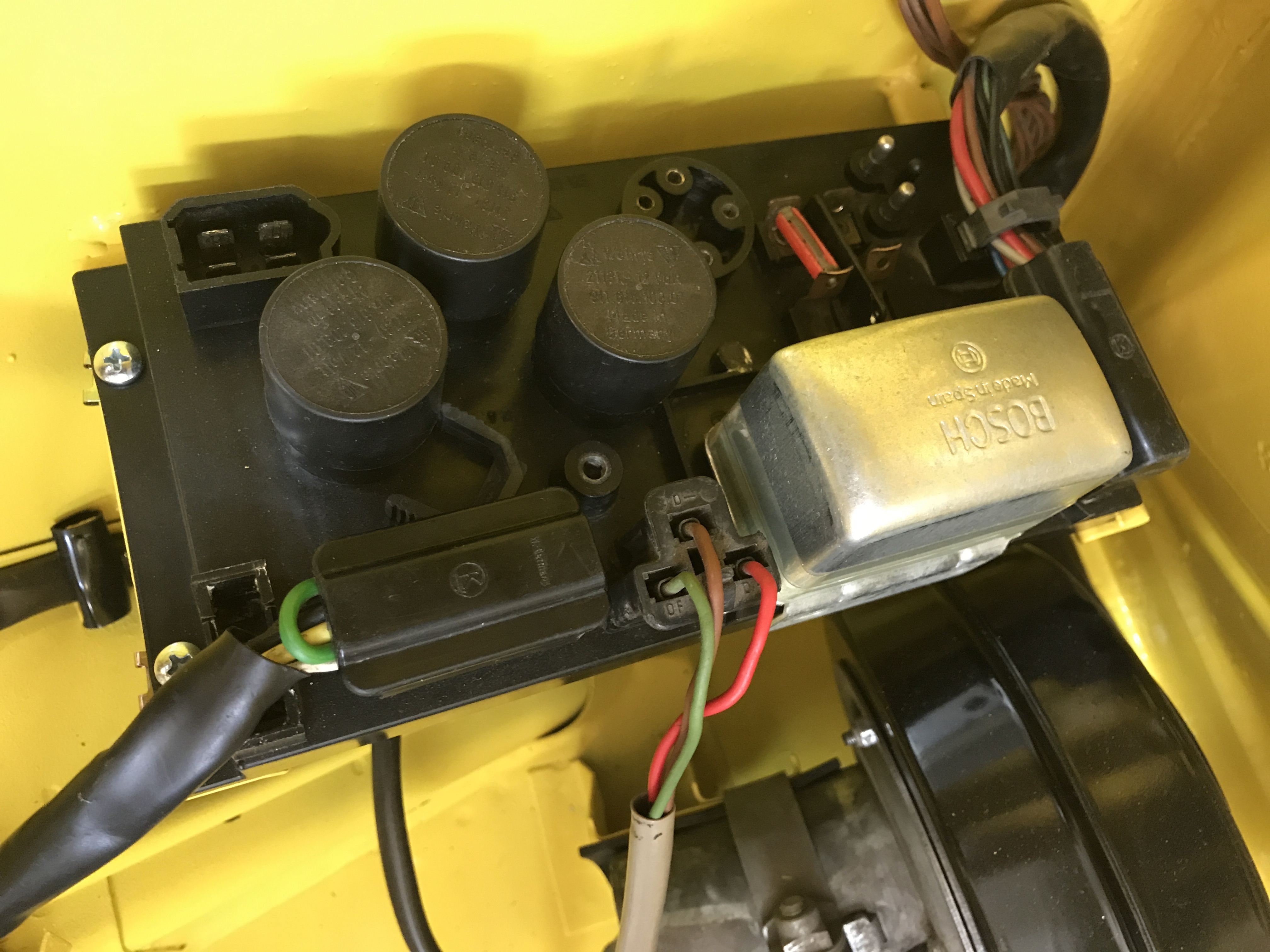

I plugged the connectors into the relay board, and replaced the original relays and fuse.
Getting closer to my electrical system test.
Wow! You still have the retaining clips for your harnesses. Mine are missing and I can't bring myself to pay $20 each for NOS.
I had one. When I posted a WTB on 914 World, somebody (sorry I can't recall who) volunteered one more.
