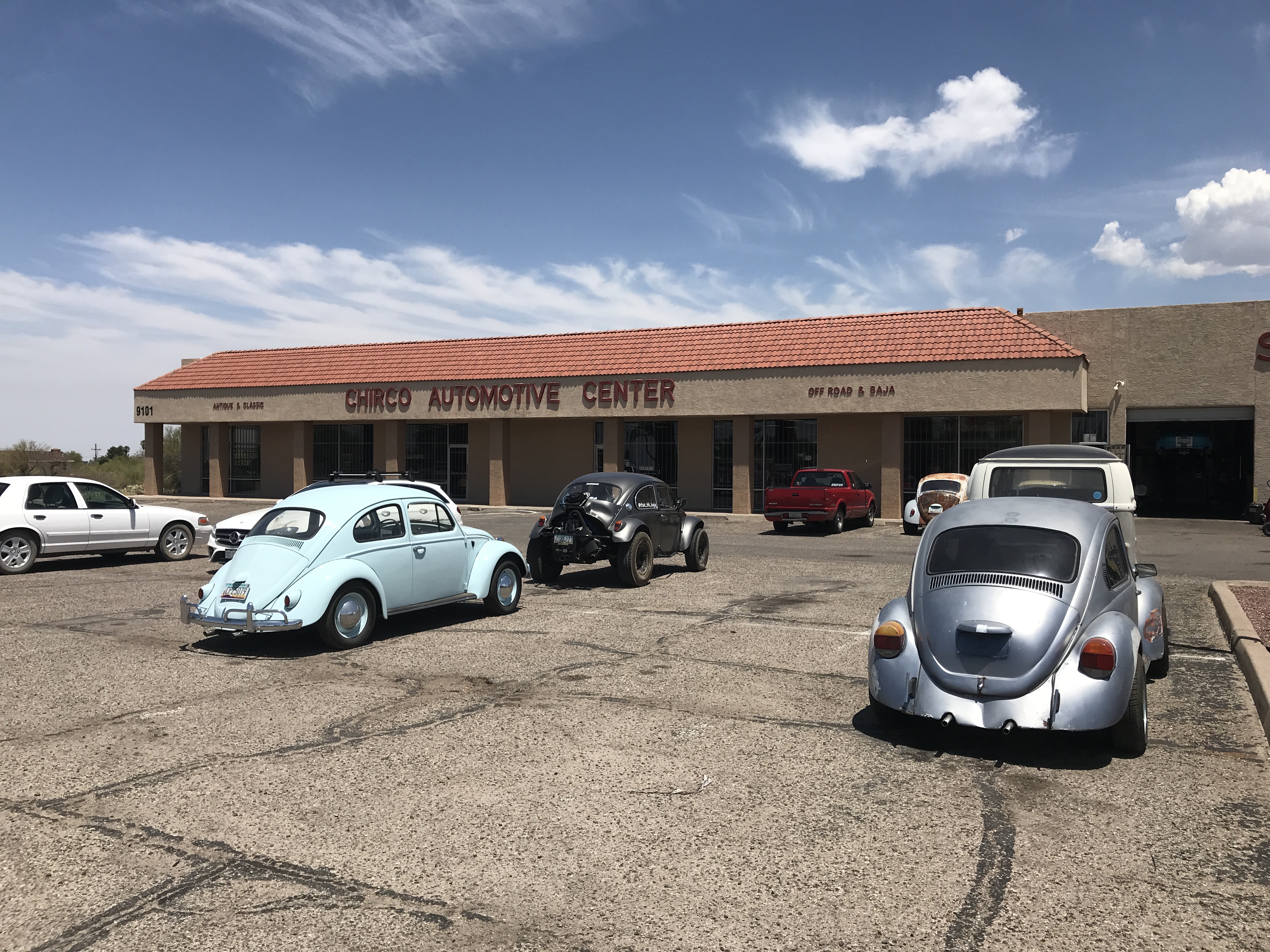

The outsource saga continues. I brought my cylinder heads to Tucson, and in between helping my son move, called around for trouble-shooting shops. That led first to Chirco, VW air-cooled specialists. They sent me to an old school machine shop. The plan now is for Chirco to take the heads apart, then the machine shop will weld up the bad stud holes and crack and redrill the holed (and heat treat the heads), and then Chirco will reassemble the heads.

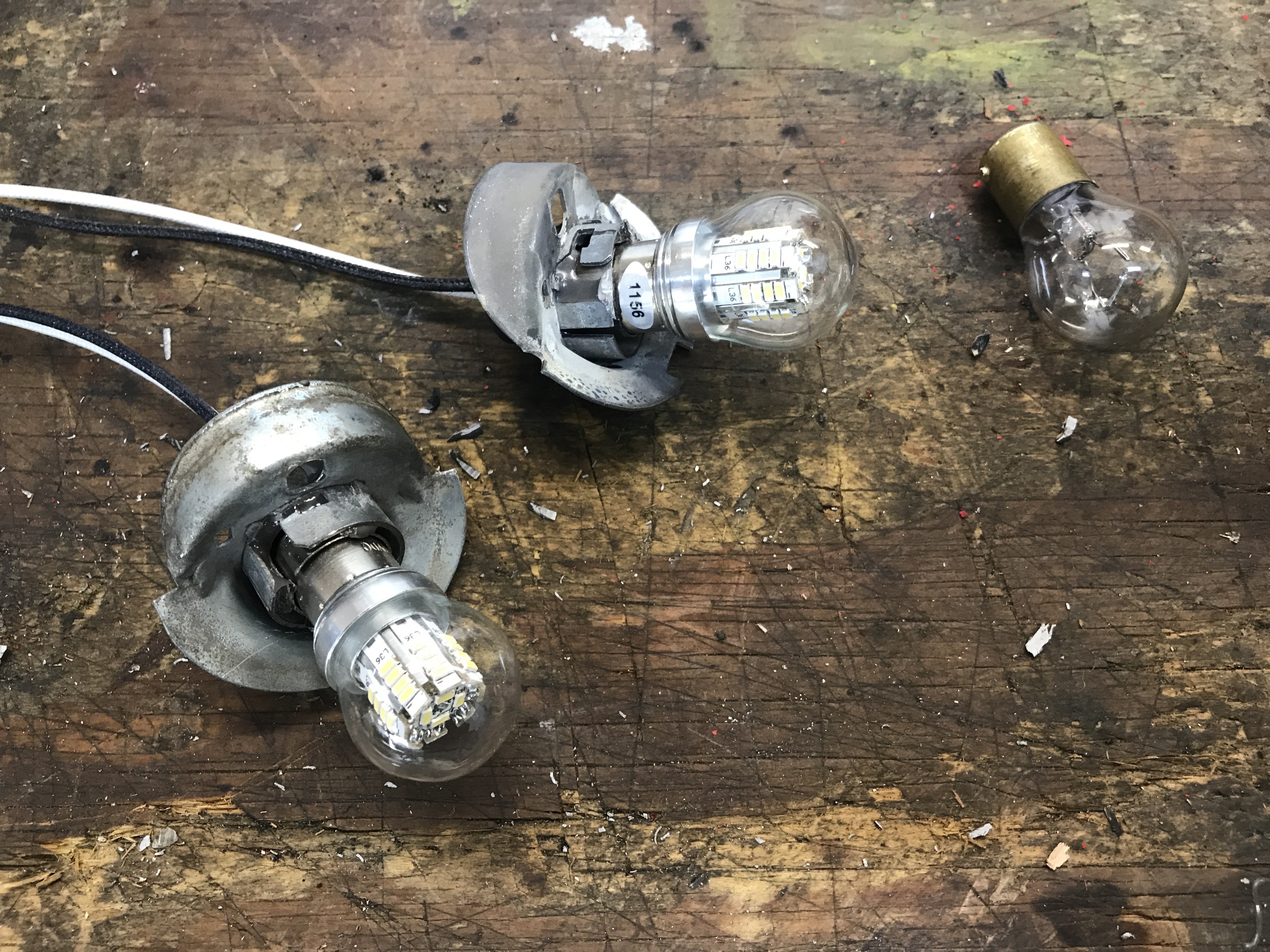

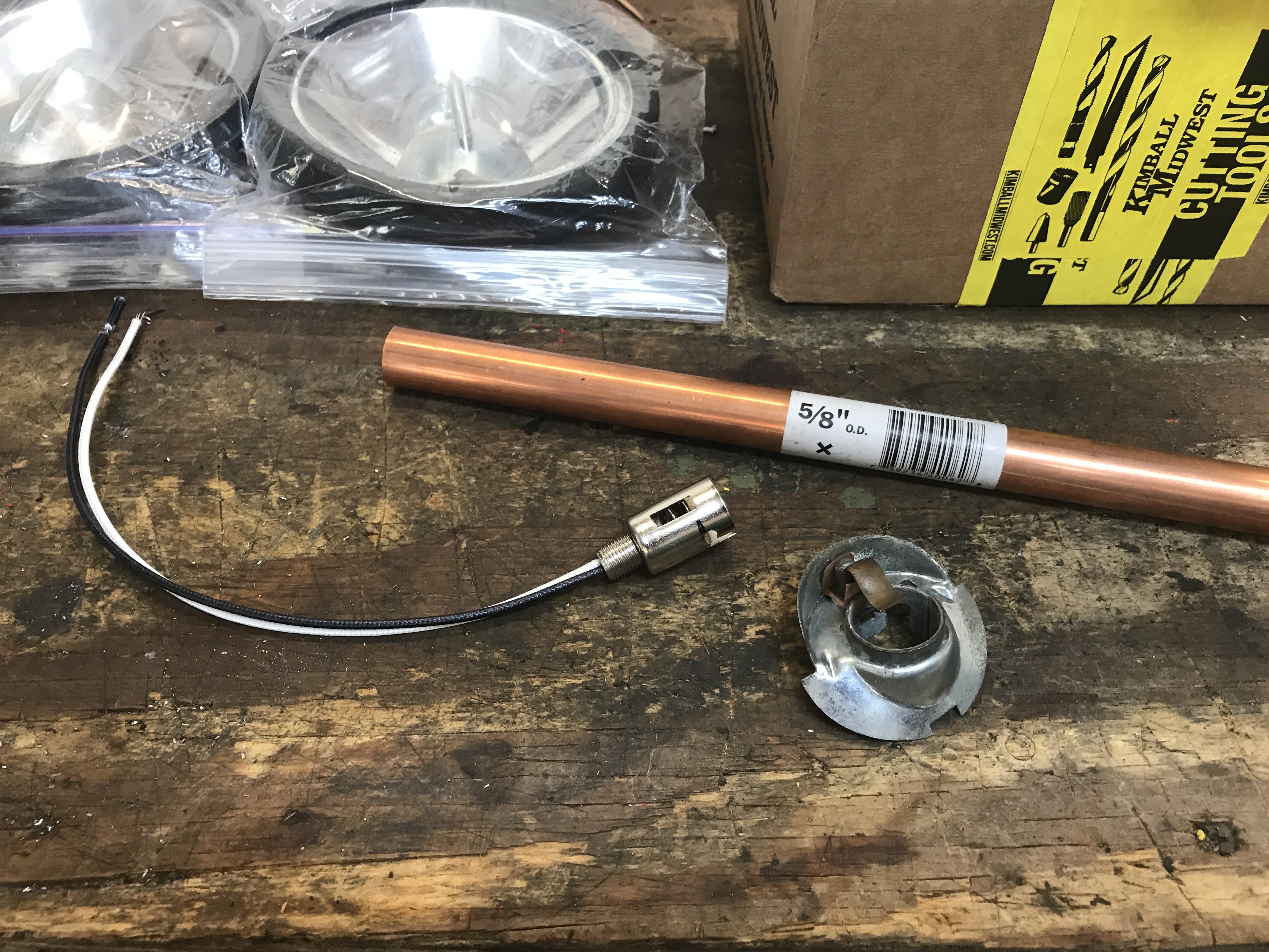

I have a plan to convert the fog lights to LED, but have not found a bulb that will fit the over-size socket. Instead, I want to insert a standard socket inside the larger one.

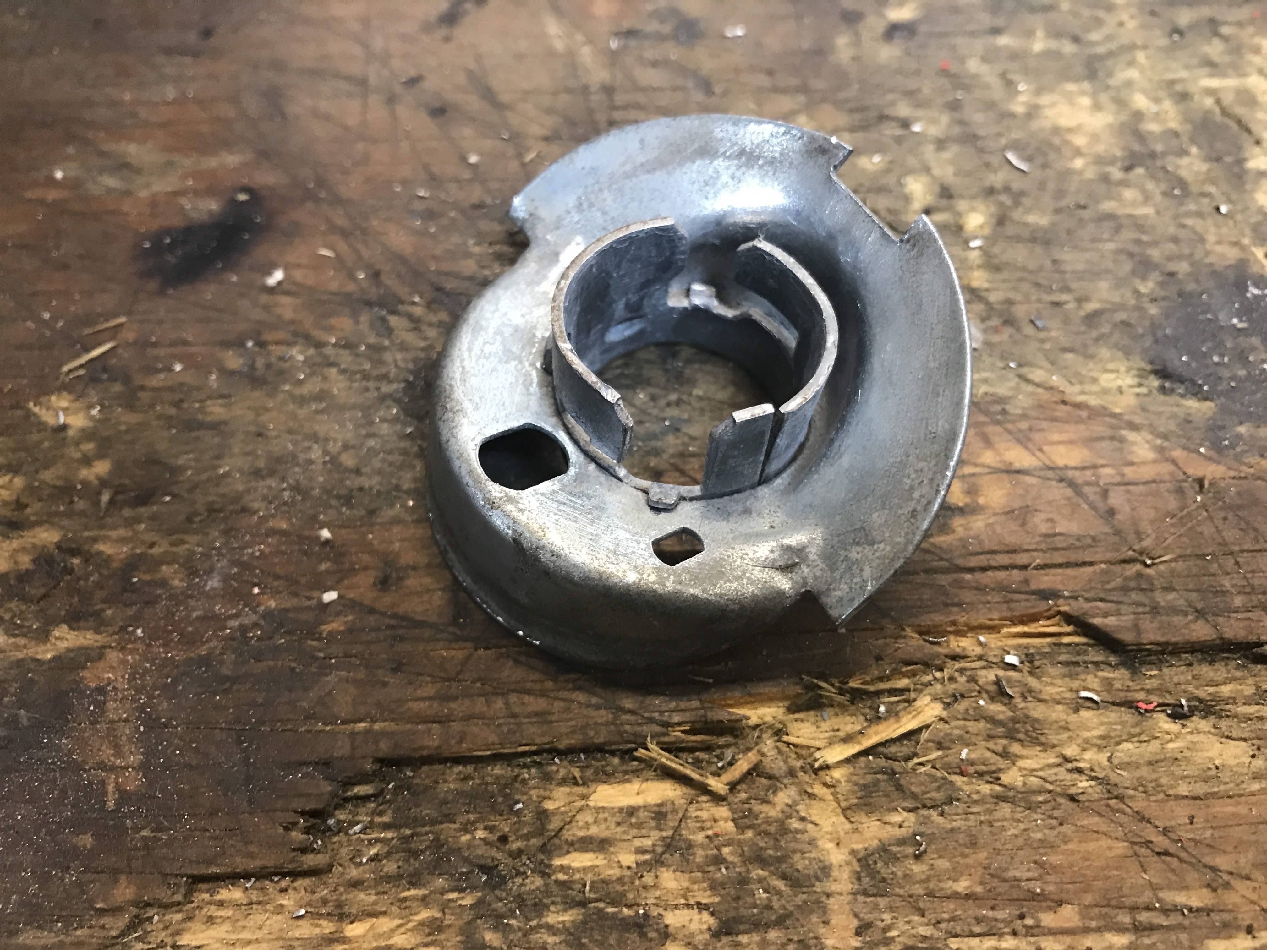

Here's the old base, with the positive tab removed.

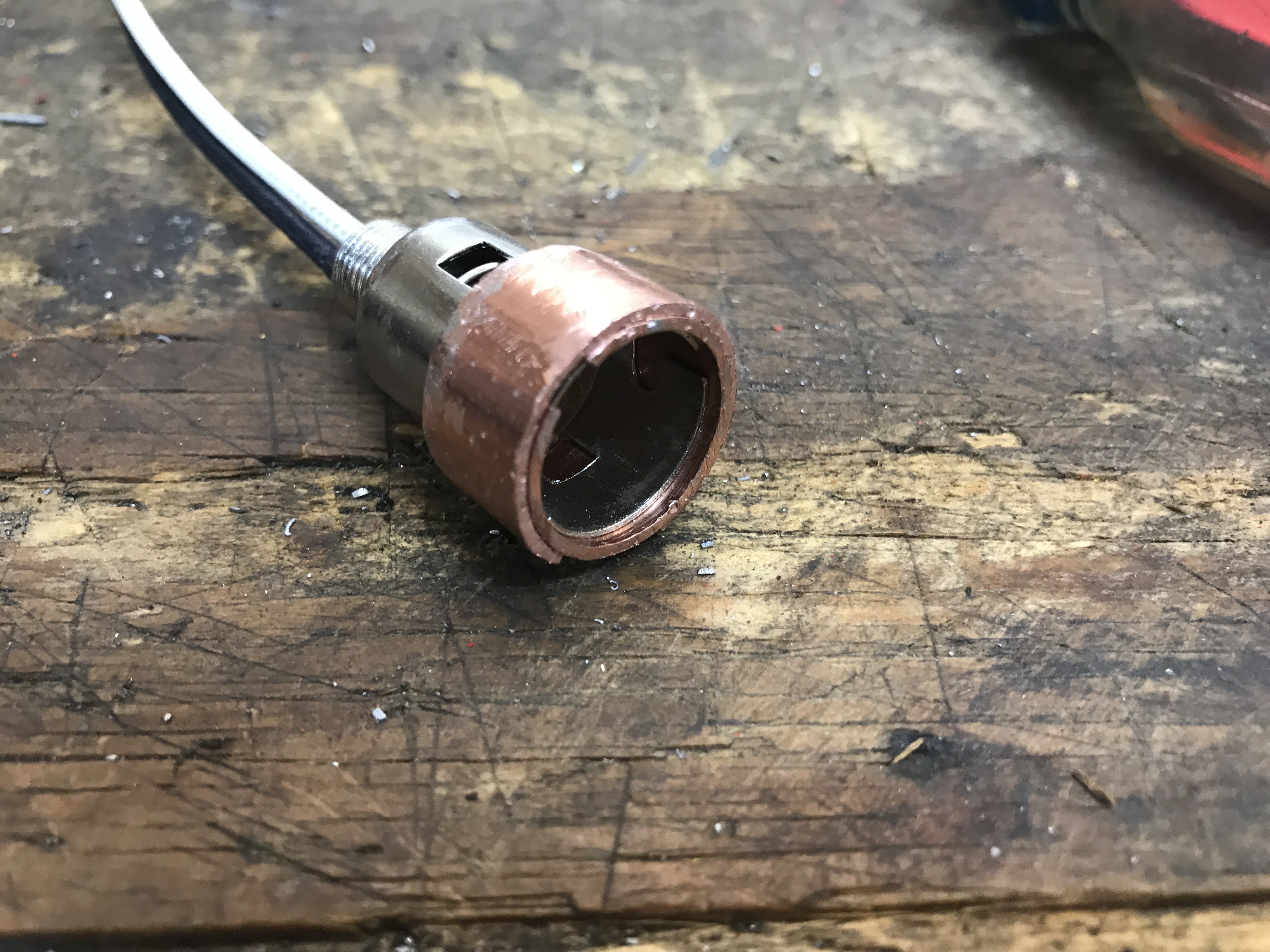

And here's my first attempt, with a collar around the new small socket made from copper pipe--double layer.

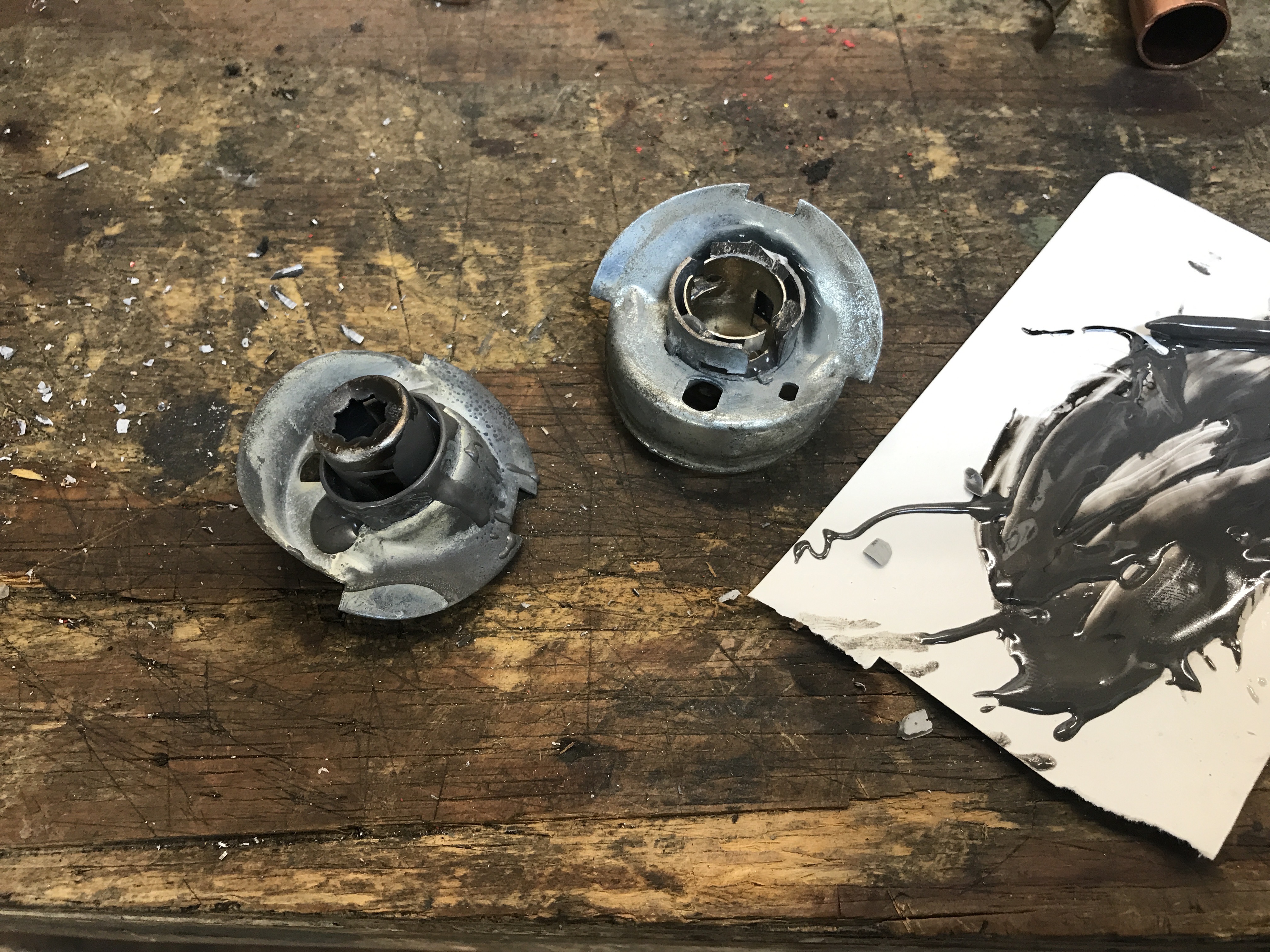

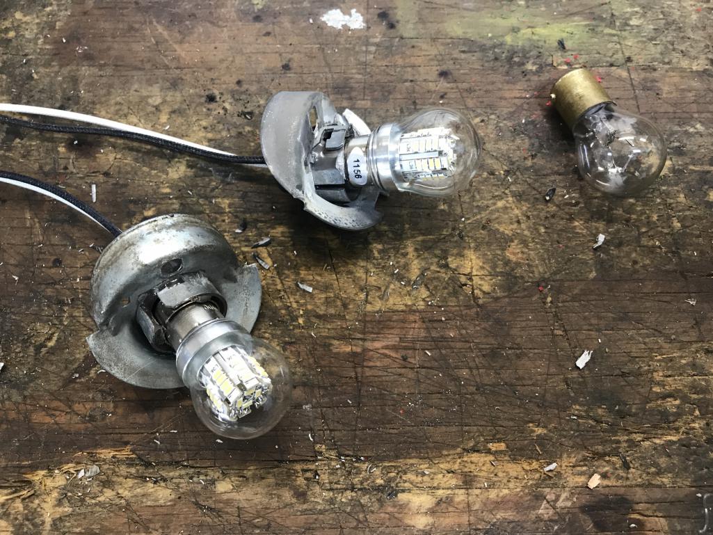

Second attempt, after I could not get the copper pipe filler to fit: good old JB weld. Now I have 2 fittings with the correct socket for an 1156 type bayonet bulb.
bkrantz
post Jun 5 2021, 07:13 PM
Post #2866
Posts: 8,800
Joined: 3-August 19
From: SW Colorado
Member No.: 23,343

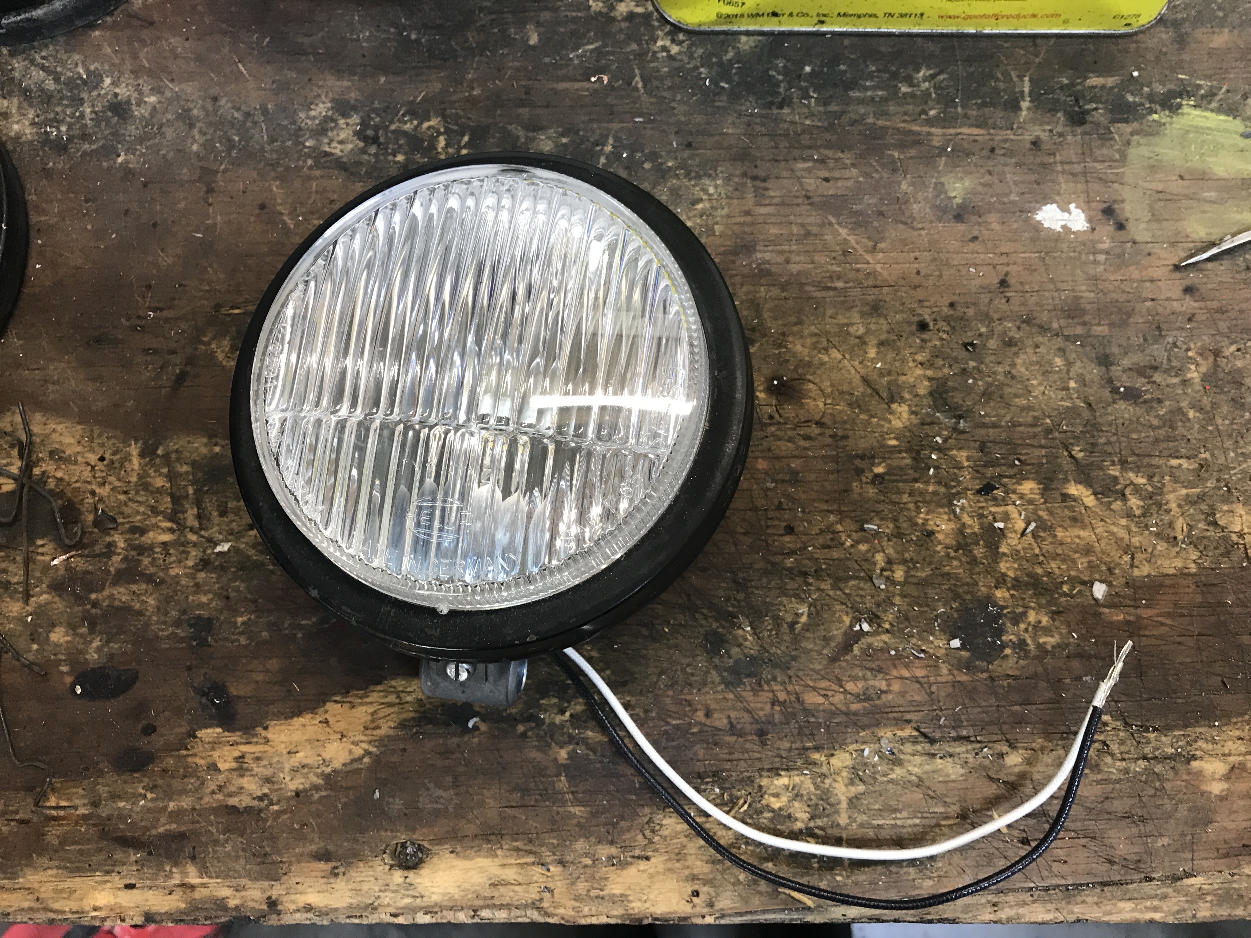

Sockets complete, with new LED bulbs. If these are not bright enough or have the proper beam pattern, I will look for others.

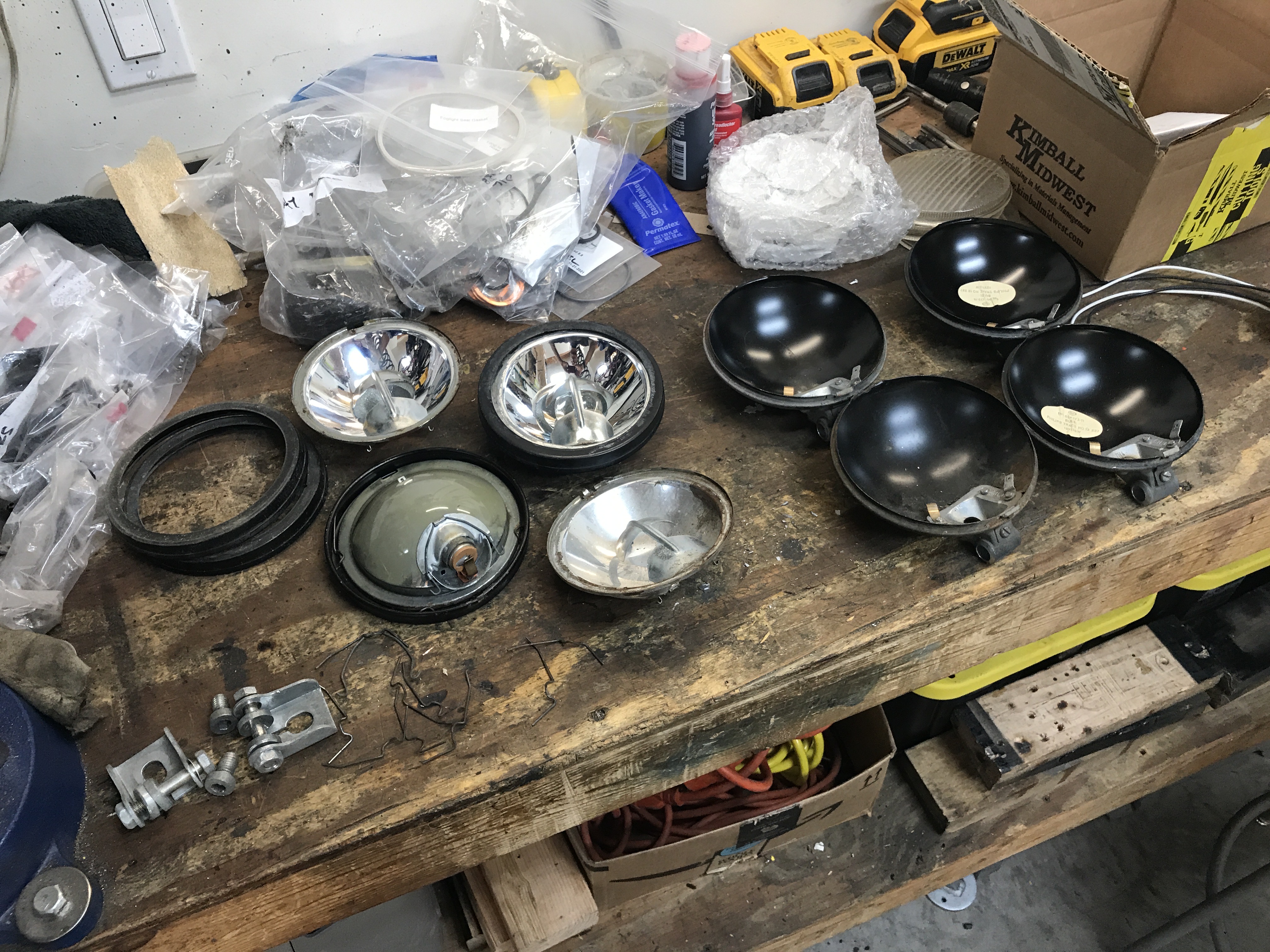

Now to sort through and select the best parts from 2 pairs of lights.

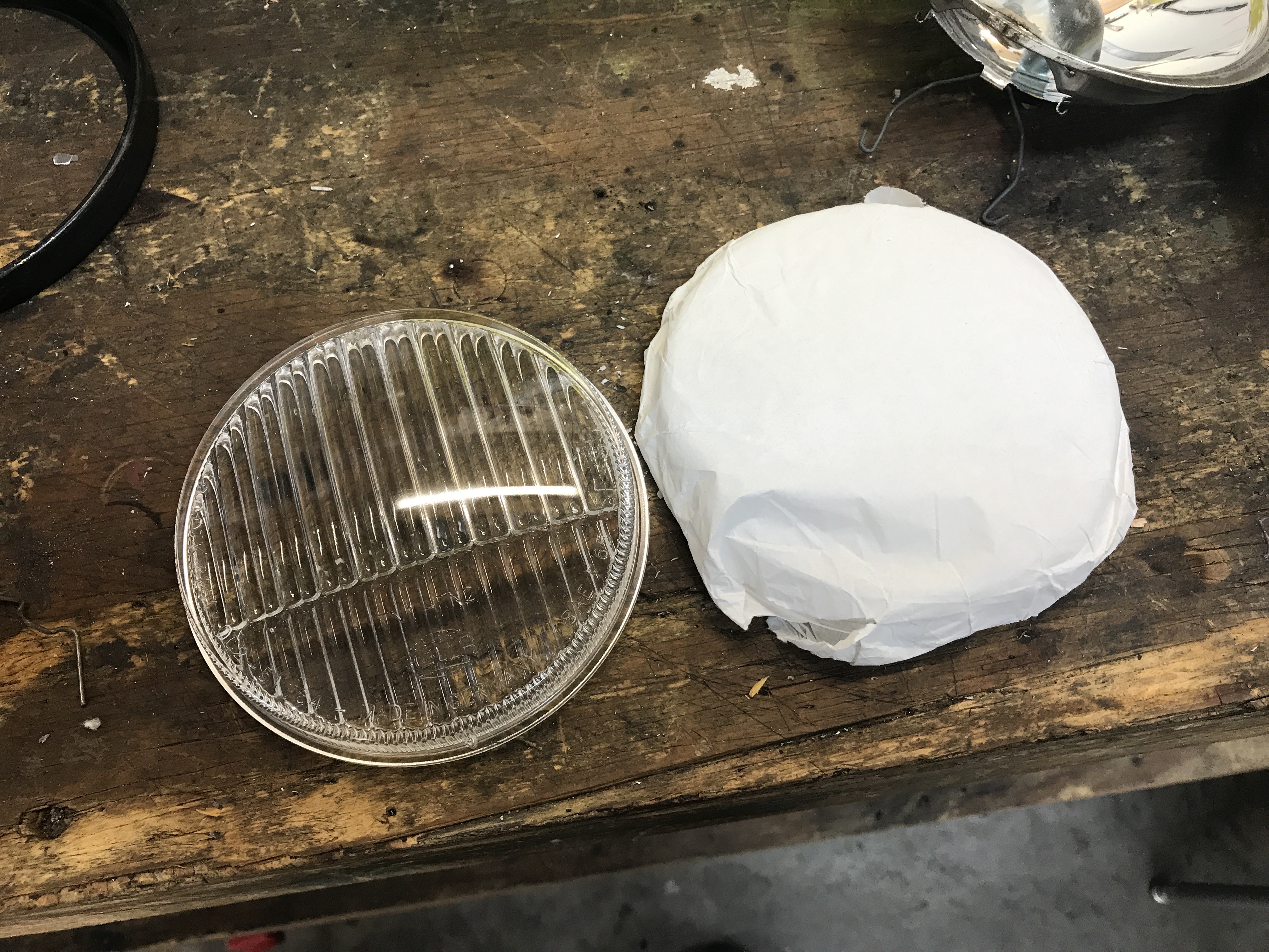

Plus new lenses.
bkrantz
post Jun 5 2021, 07:16 PM
Post #2869
Posts: 8,800
Joined: 3-August 19
From: SW Colorado
Member No.: 23,343

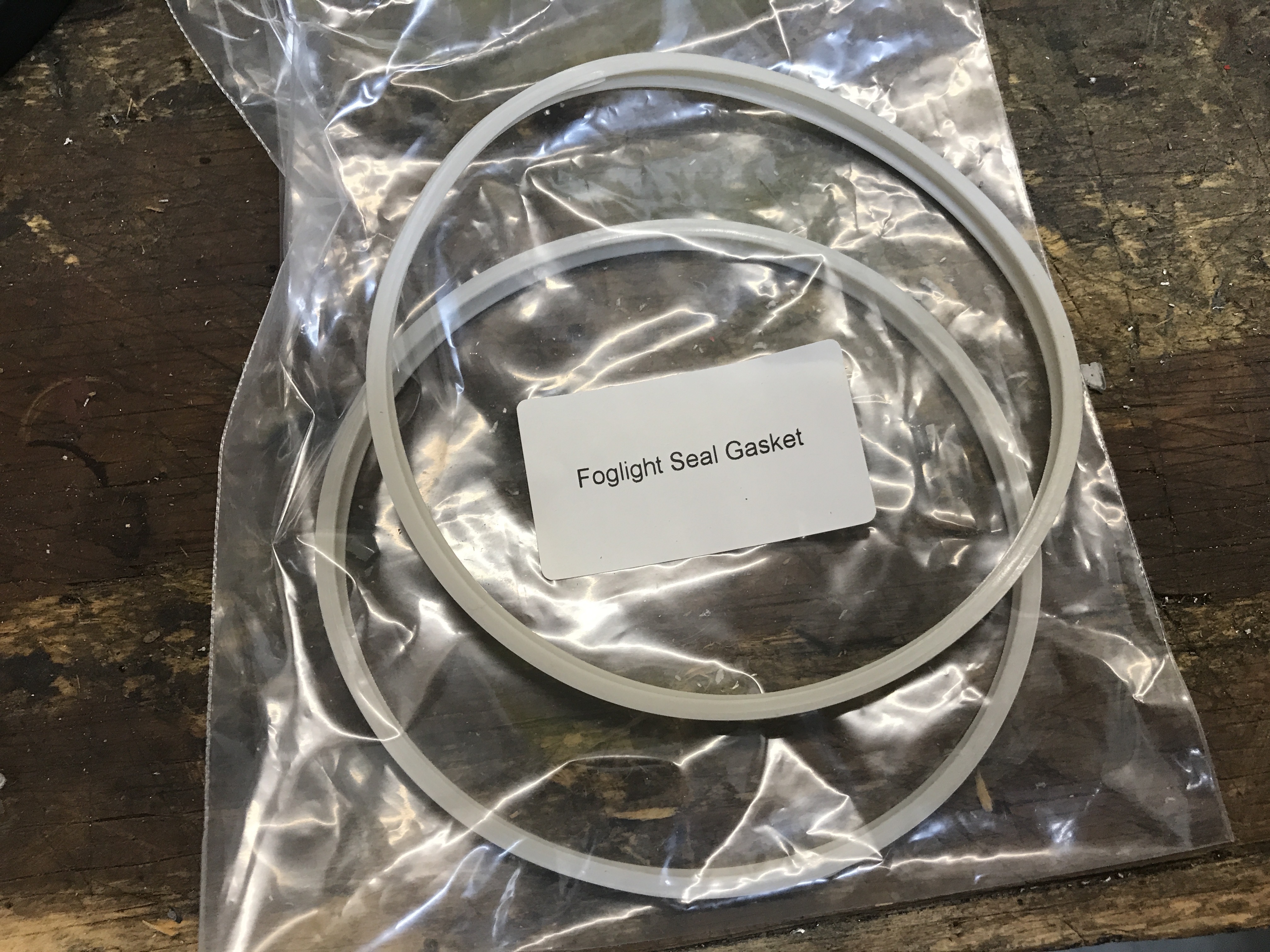

And new gaskets.

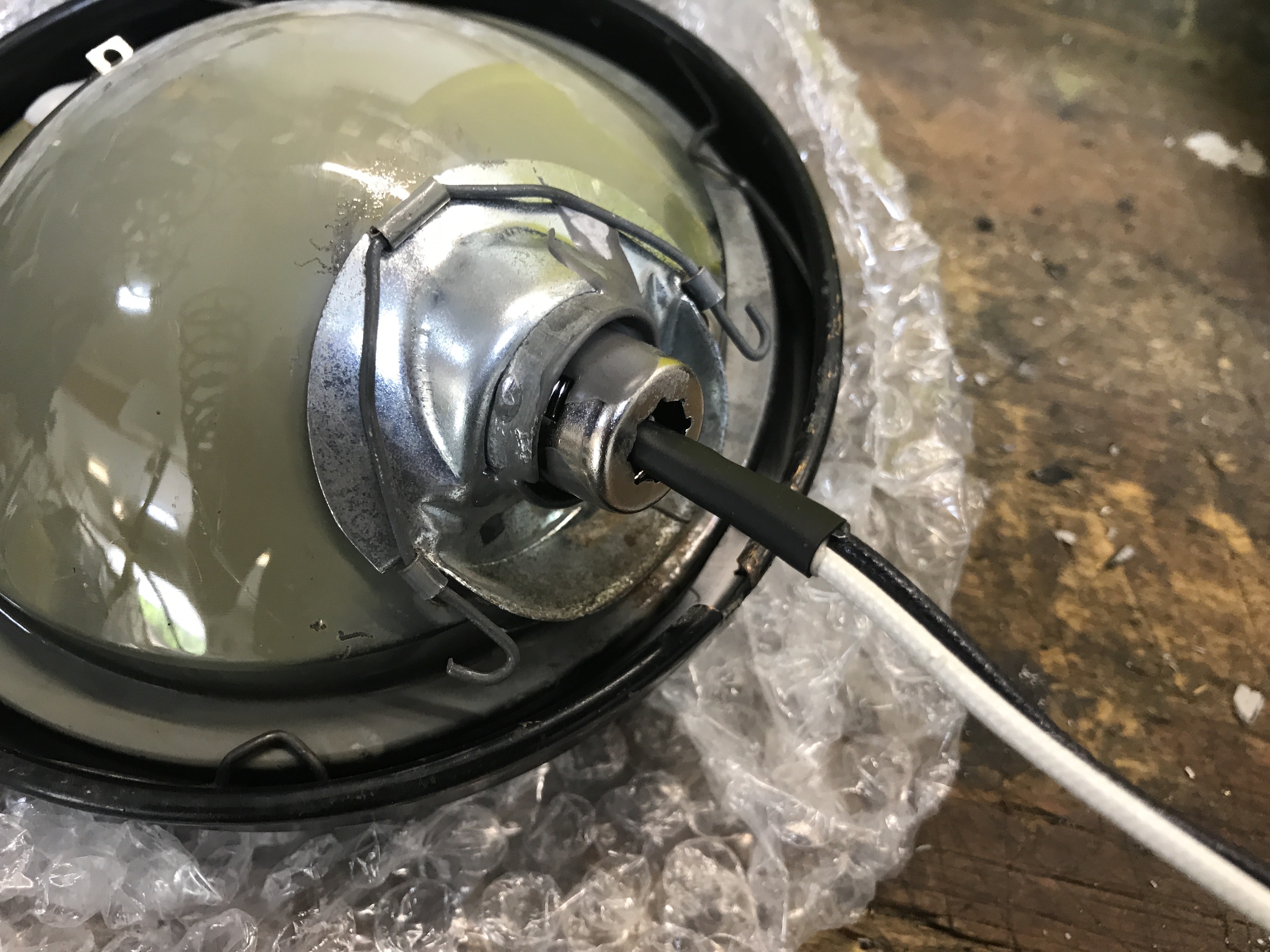

Modified bulb holder installed.
bkrantz
post Jun 5 2021, 07:18 PM
Post #2871
Posts: 8,800
Joined: 3-August 19
From: SW Colorado
Member No.: 23,343

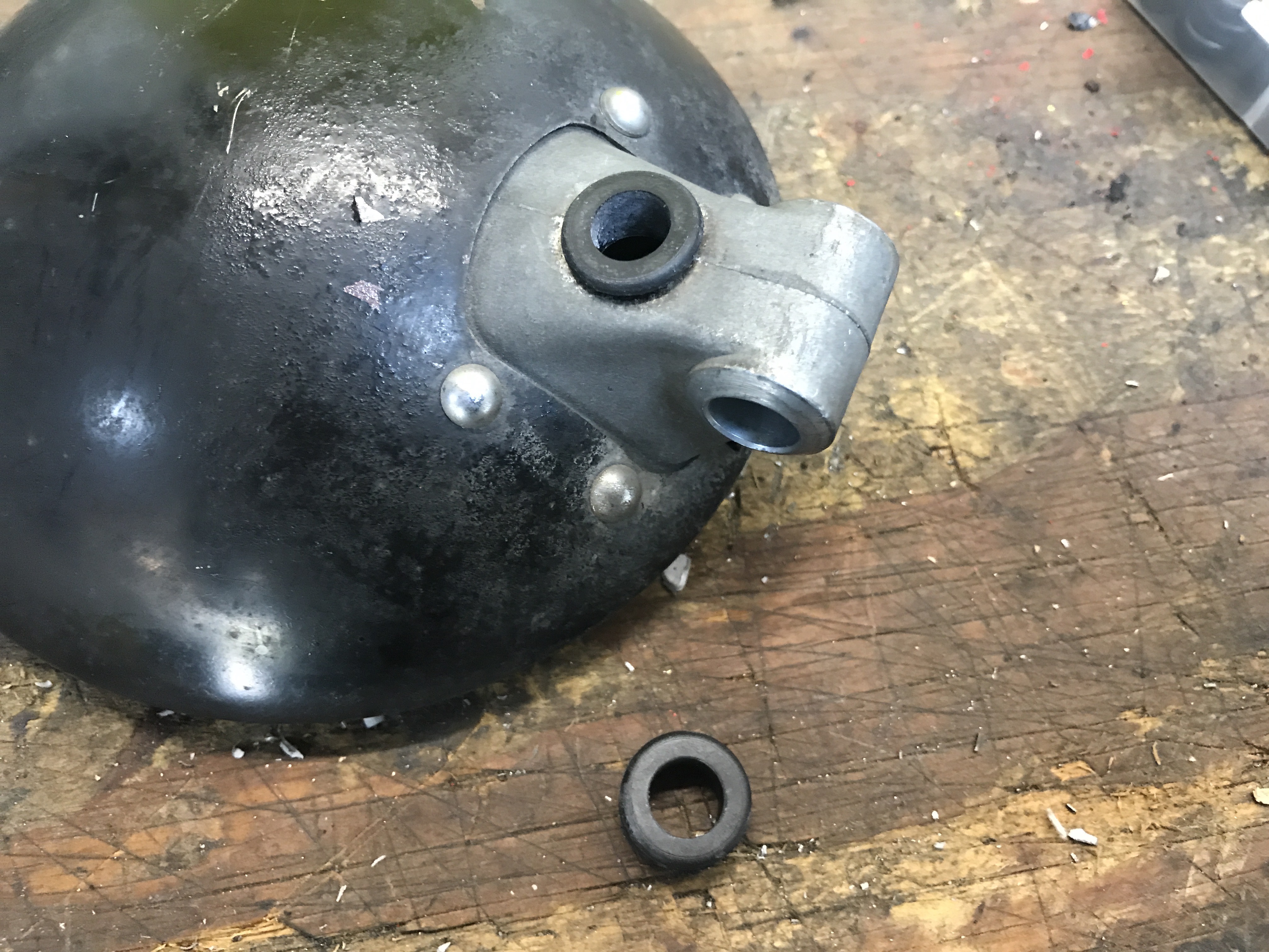

Rubber grommet in housing.

One complete light.

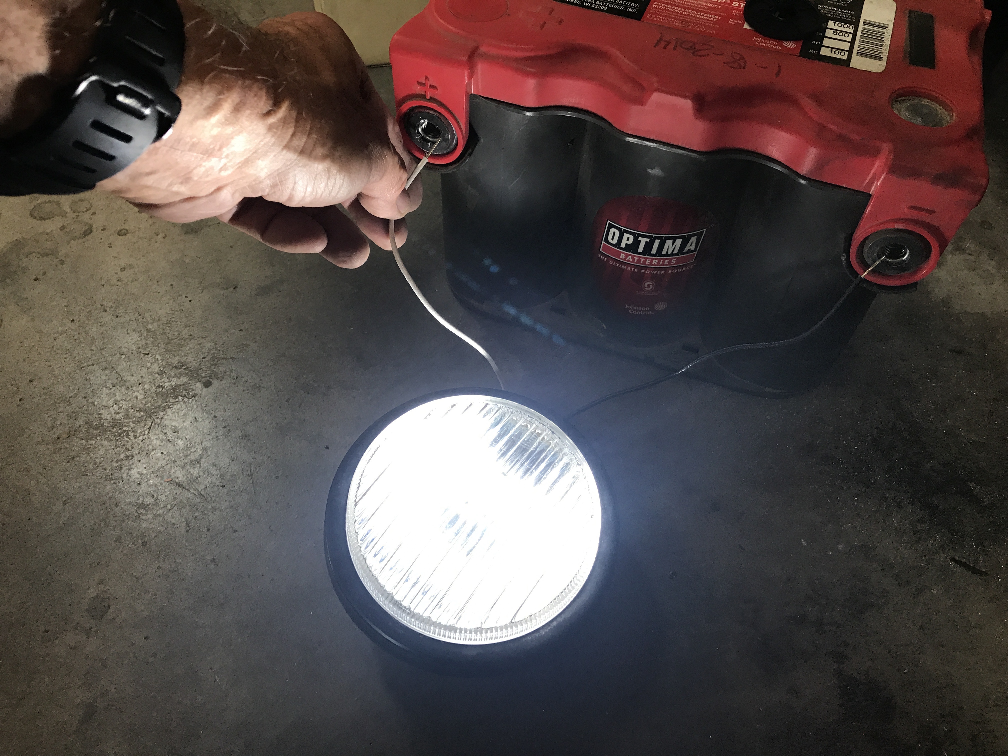

And it works!

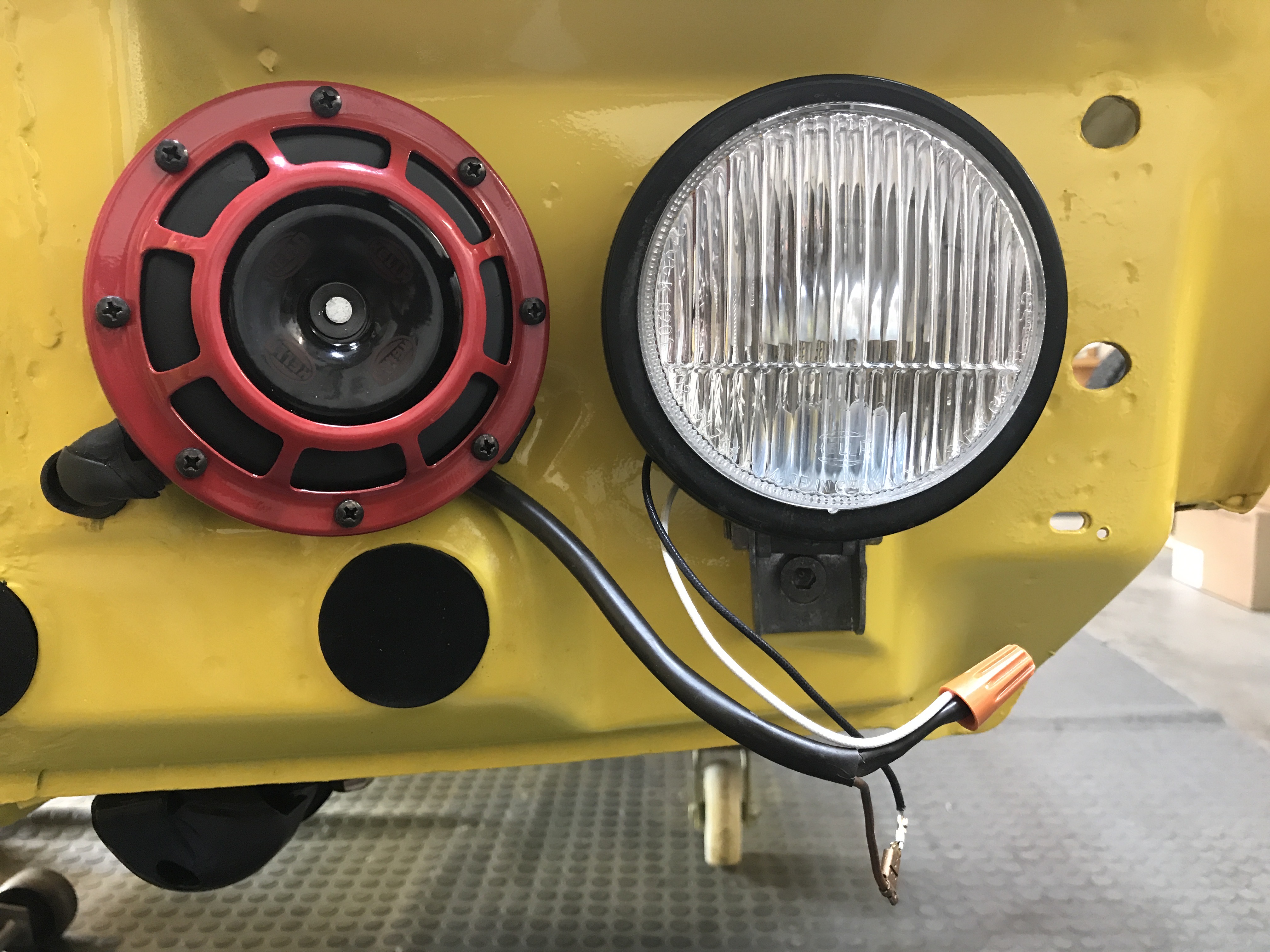

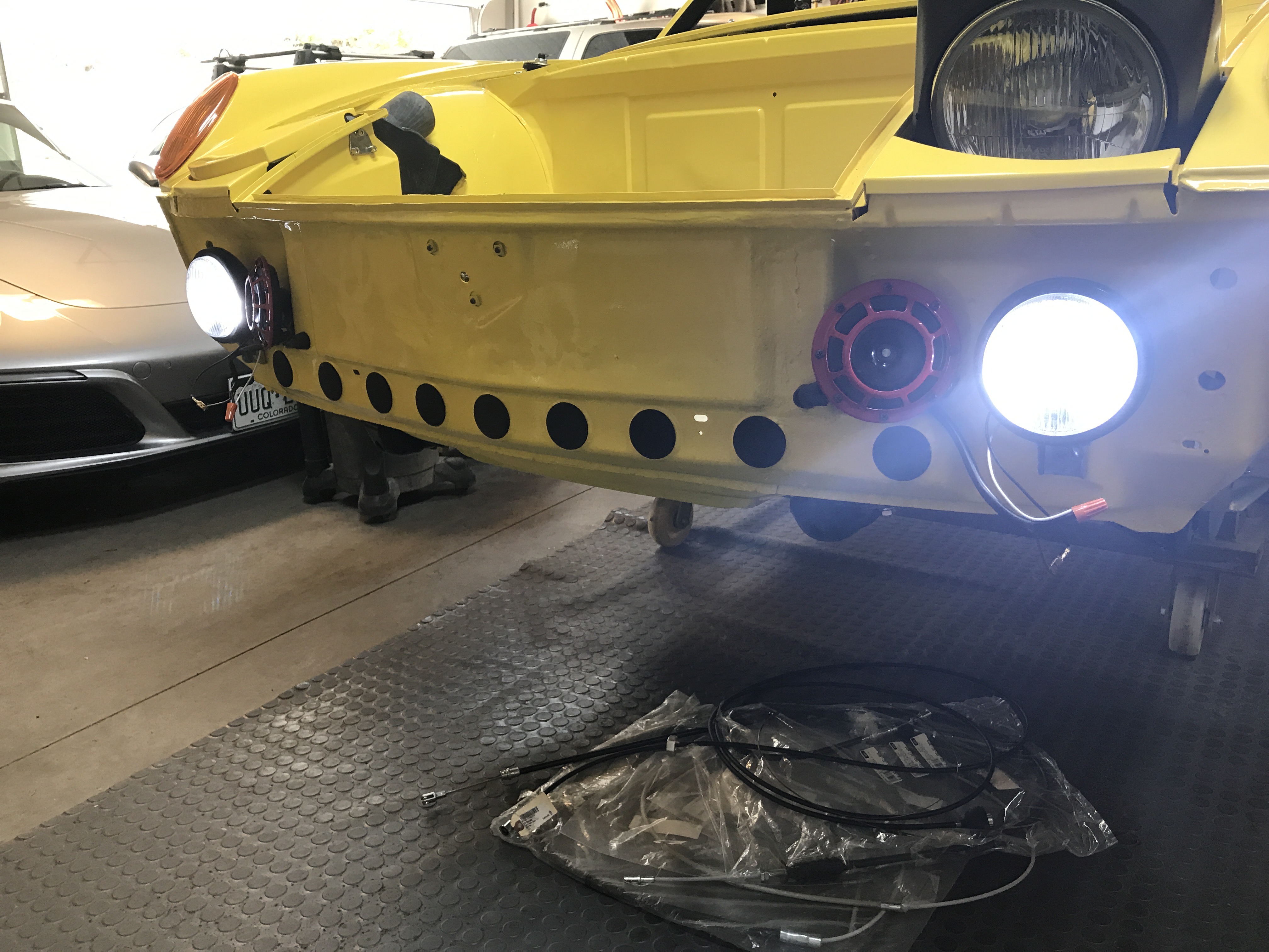

And installed for testing. Ignore the temporary electrical connections.

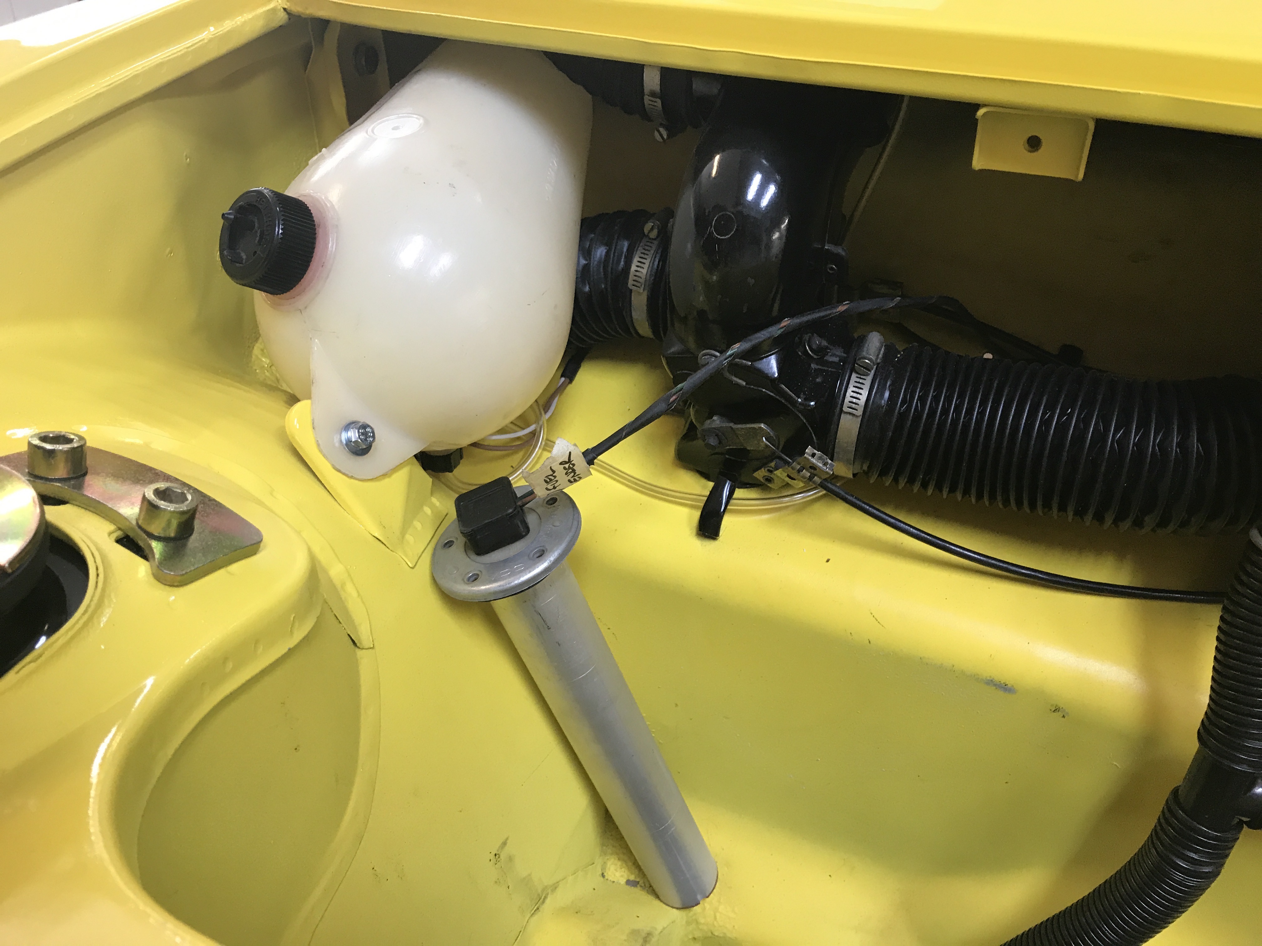

With the fog lights installed, it was almost time for the car electrical test. I tried to temporarily install all the remaining components, like the gas tank lever sender.

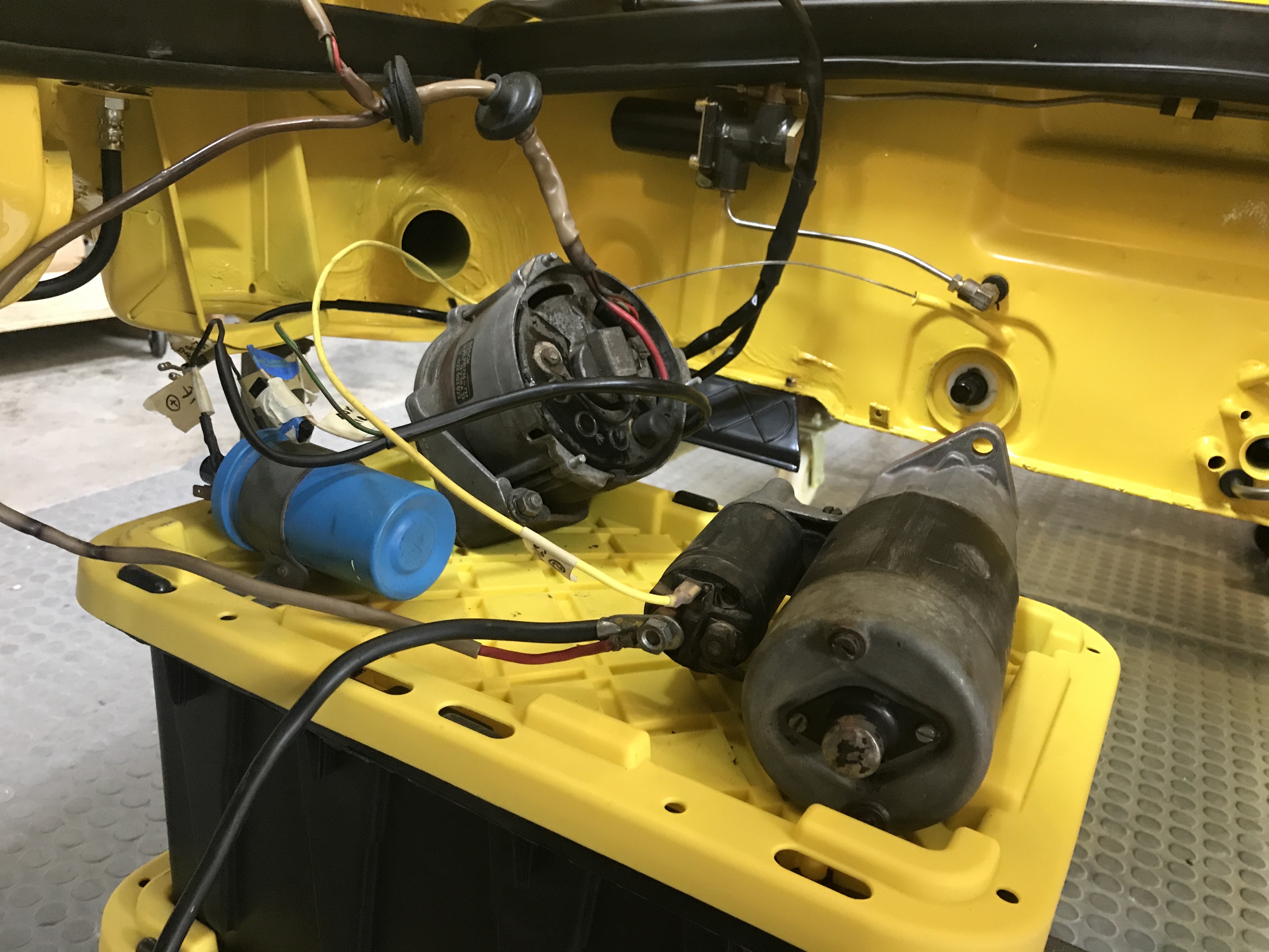

And some engine components: coil, alternator, starter.

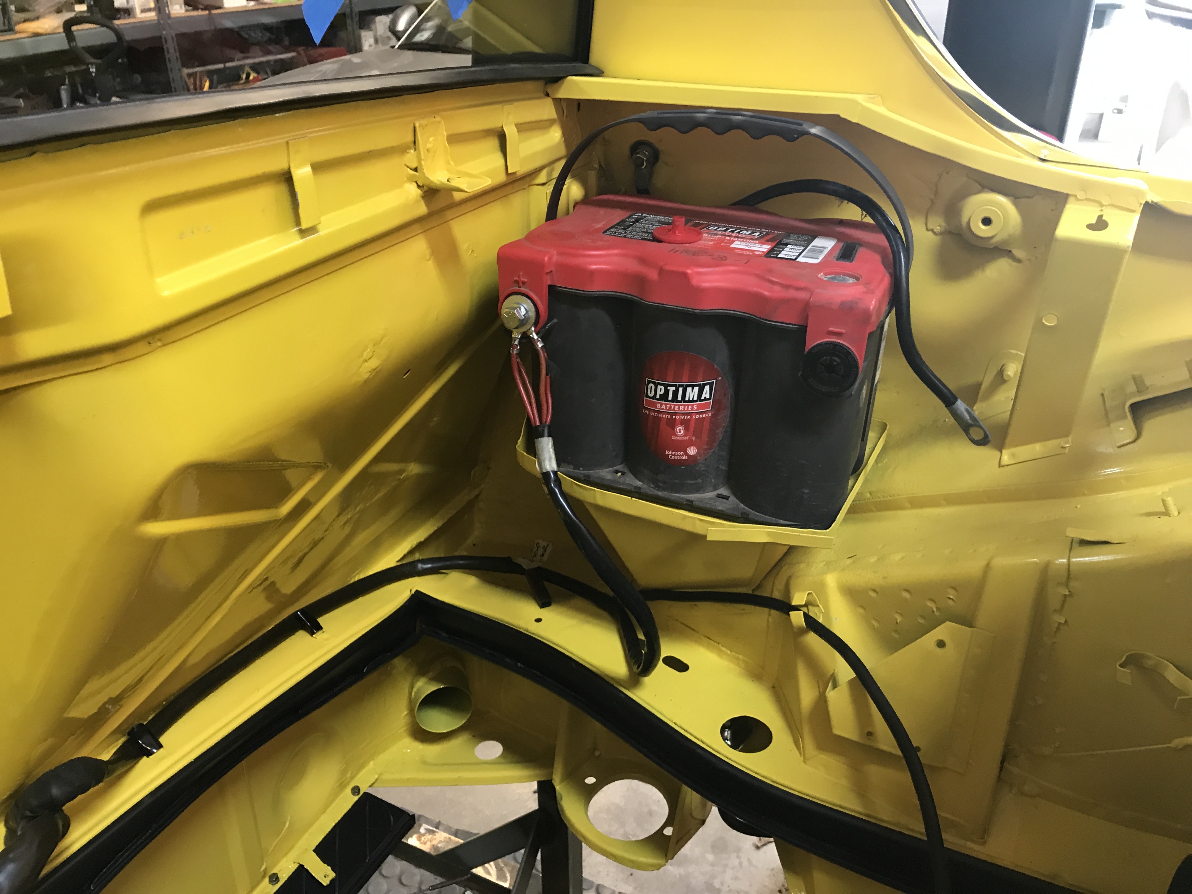

Time to connect a battery.

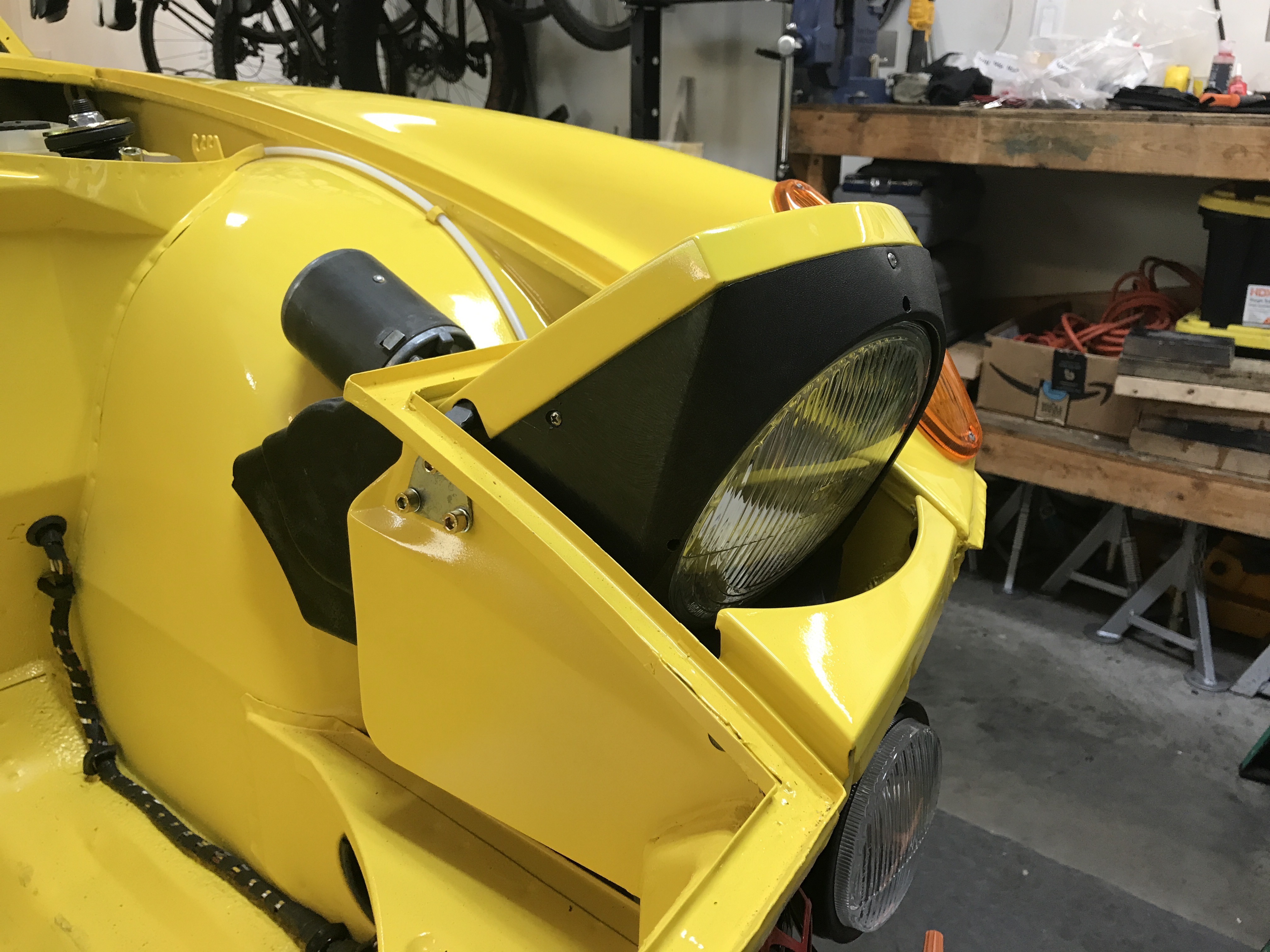

As soon as I connected both battery leads, the headlights cycled and stopped--but not in proper closed positions. No surprise since I installed the motors and linkage randomly.
