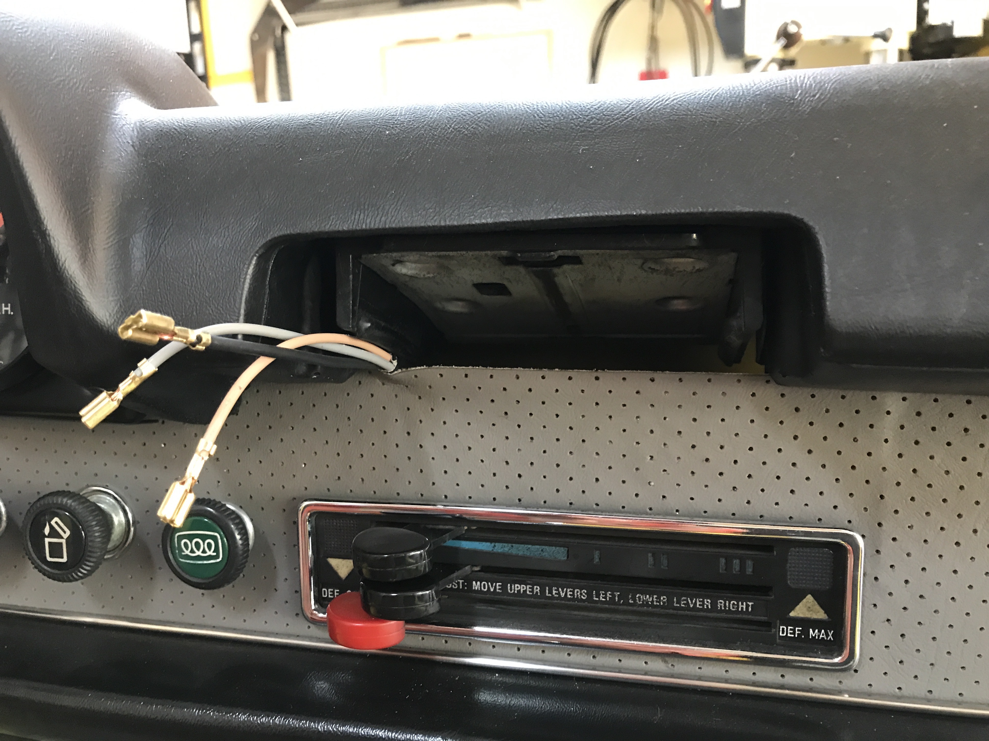

Ending up by the ashtray slot.

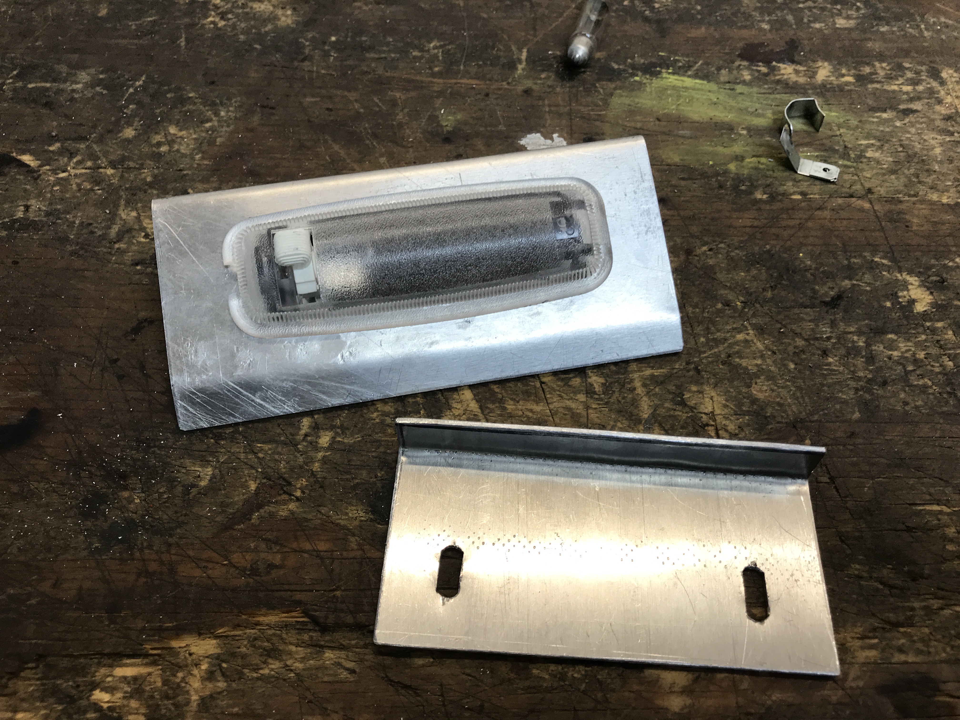

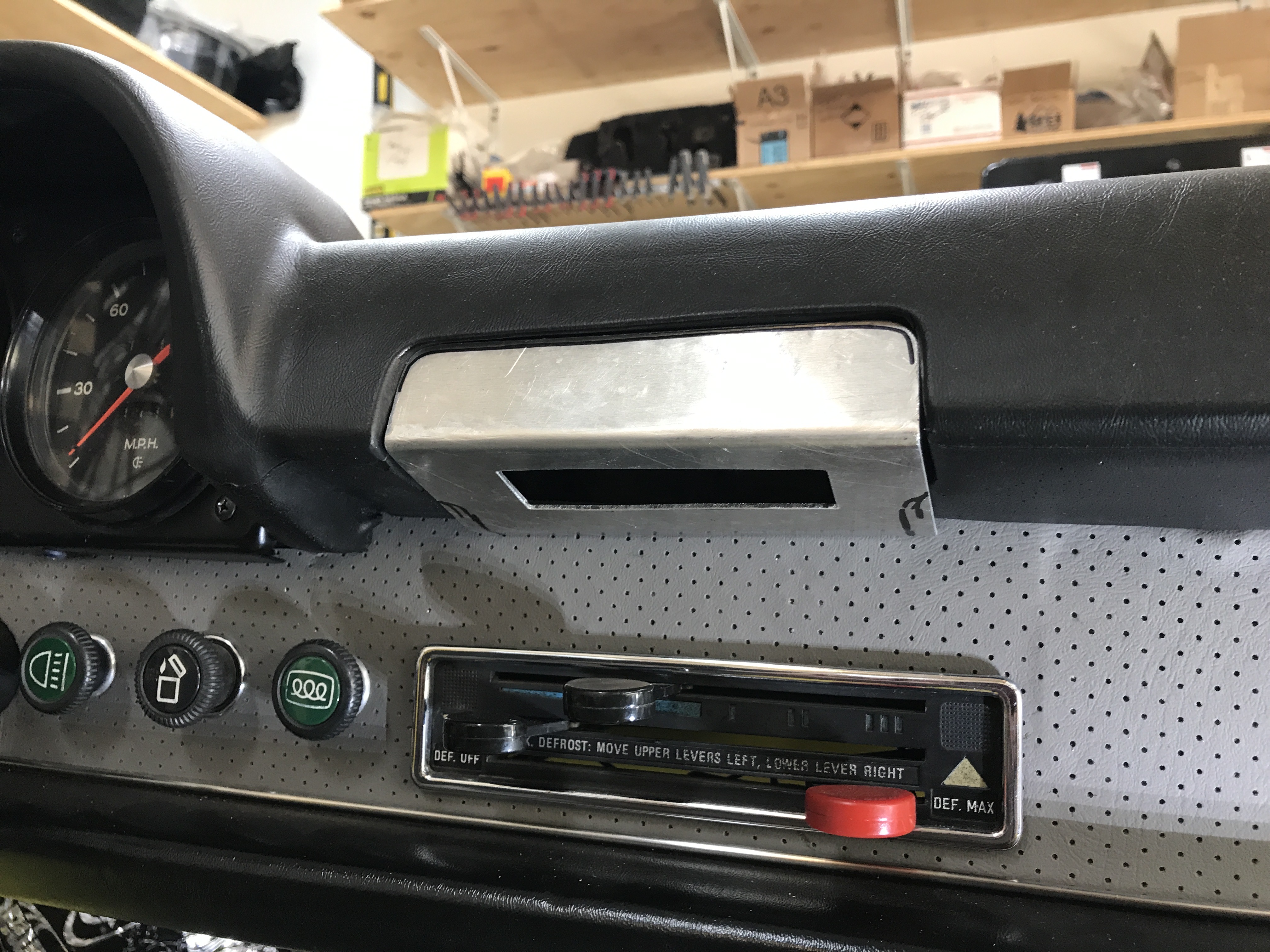

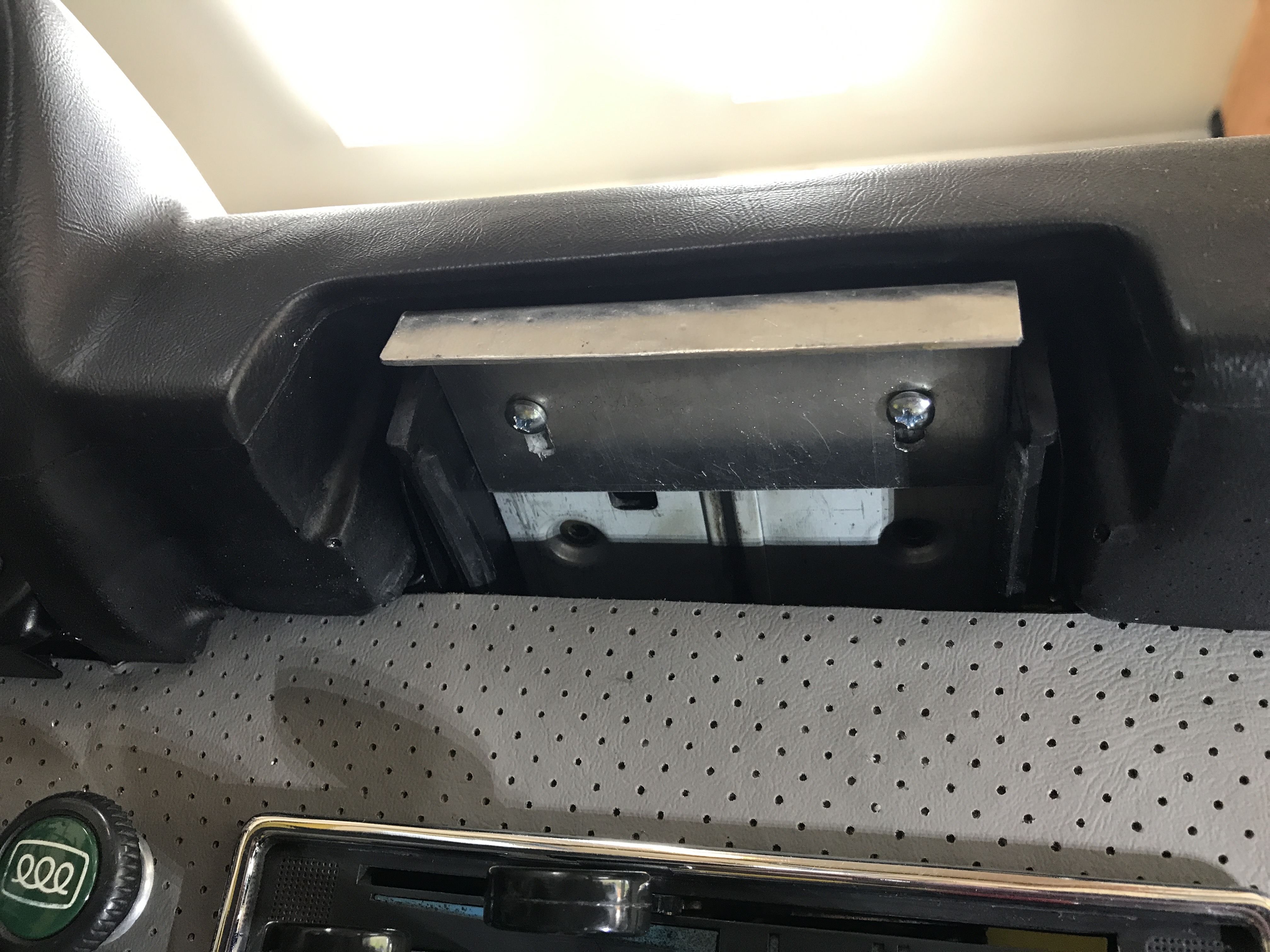

Here's the new interior light ash-tray fitting in aluminum. The second piece will attach the lamp holder to the underside of the original ash tray slide.

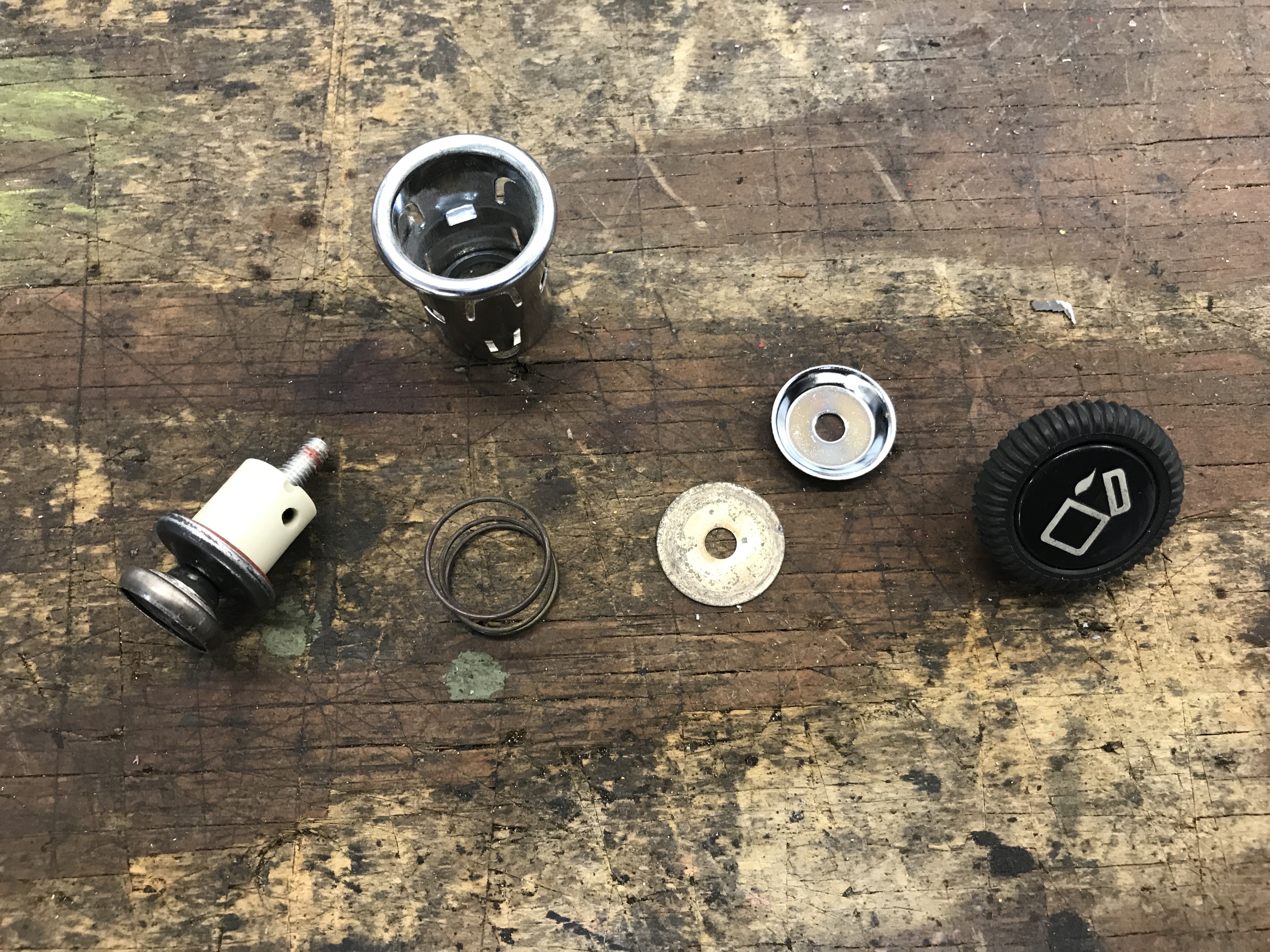

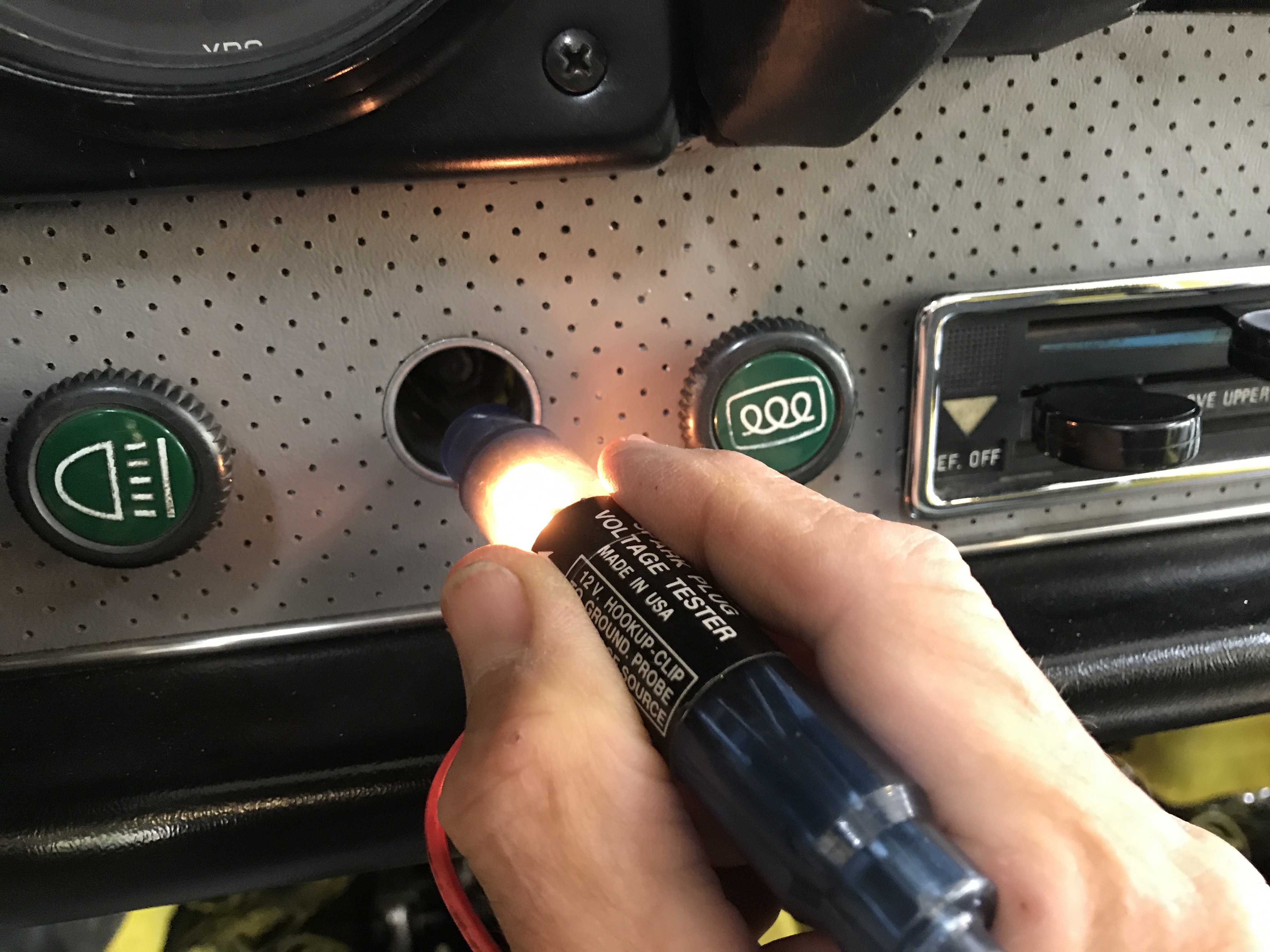

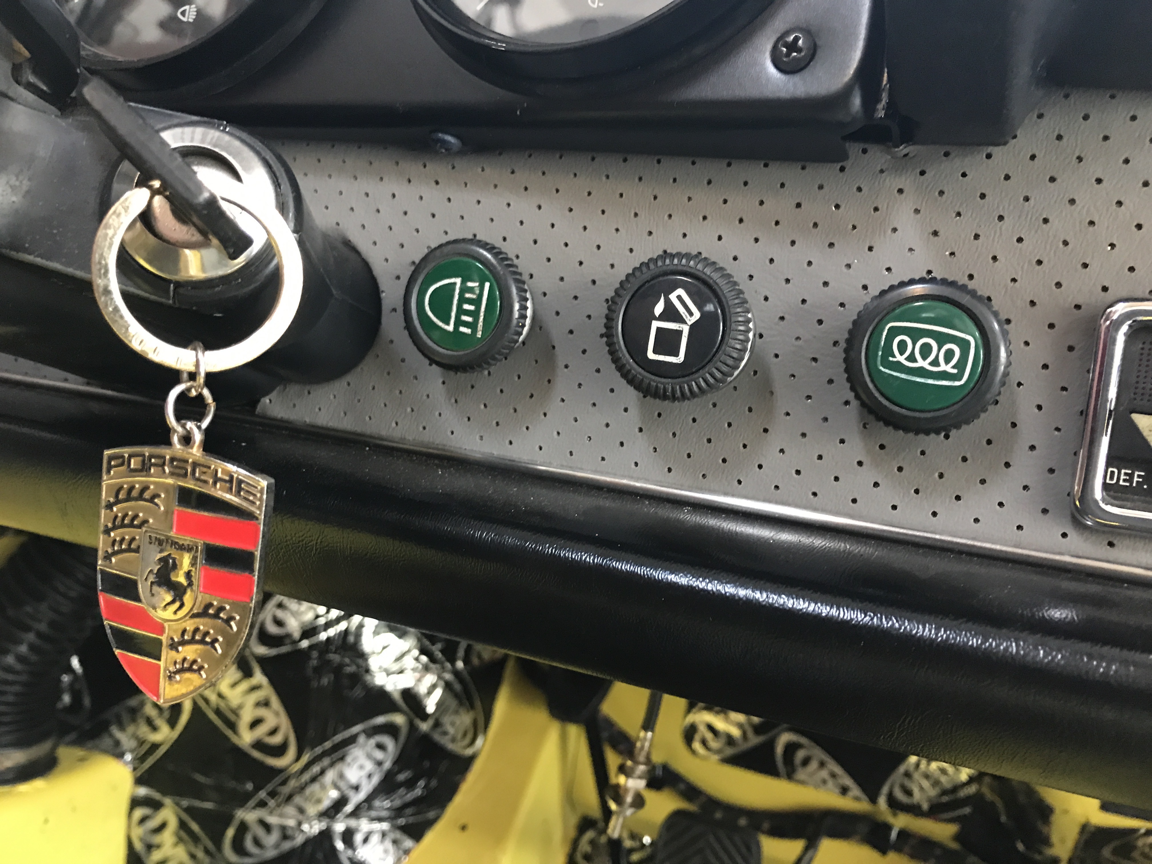

More electrical testing. I could not get any voltage from contact in the cig lighter, and so pulled it out.

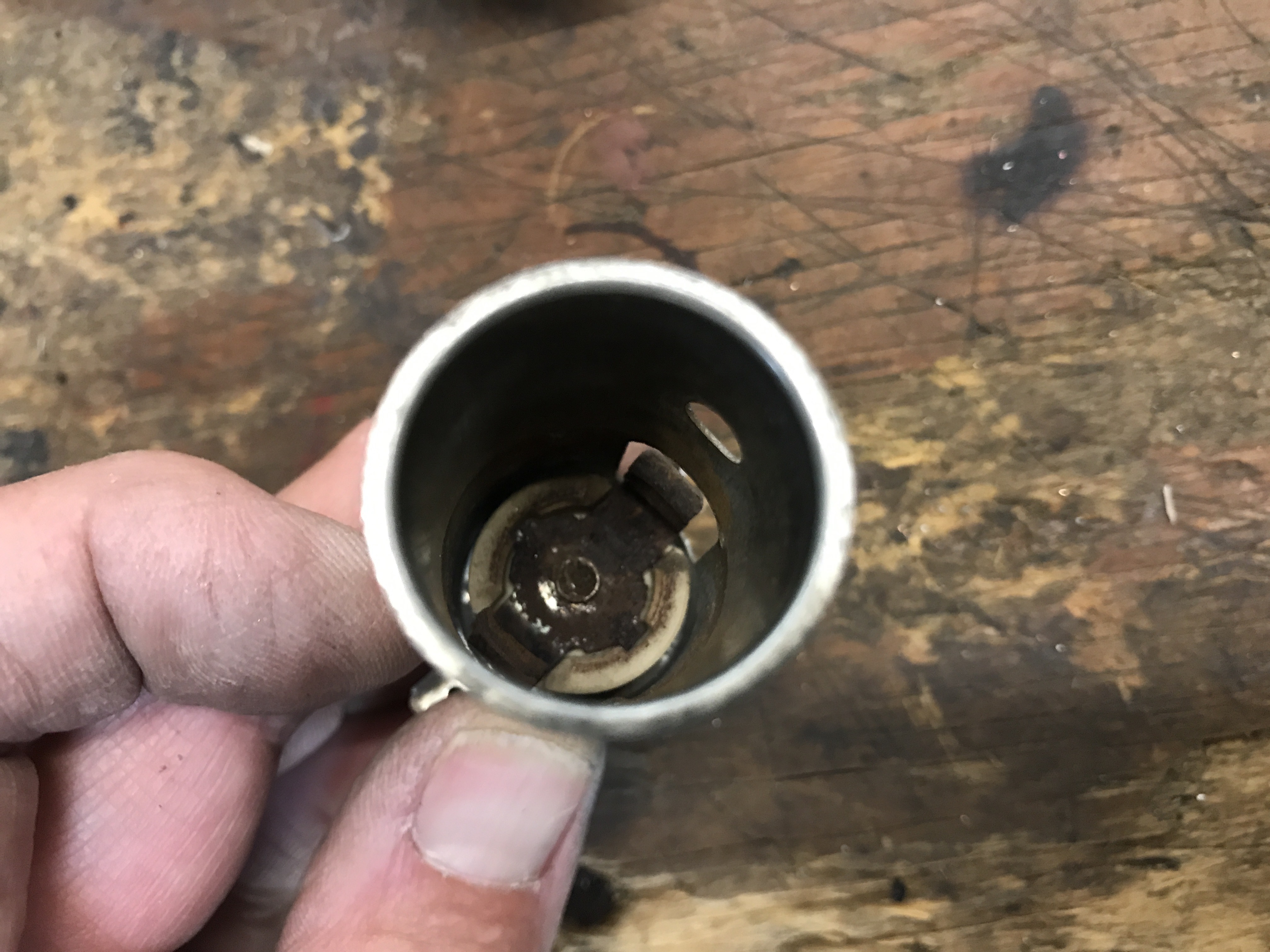

I guess I had "temporarily" installed it without checking or cleaning it. Pretty nasty inside.

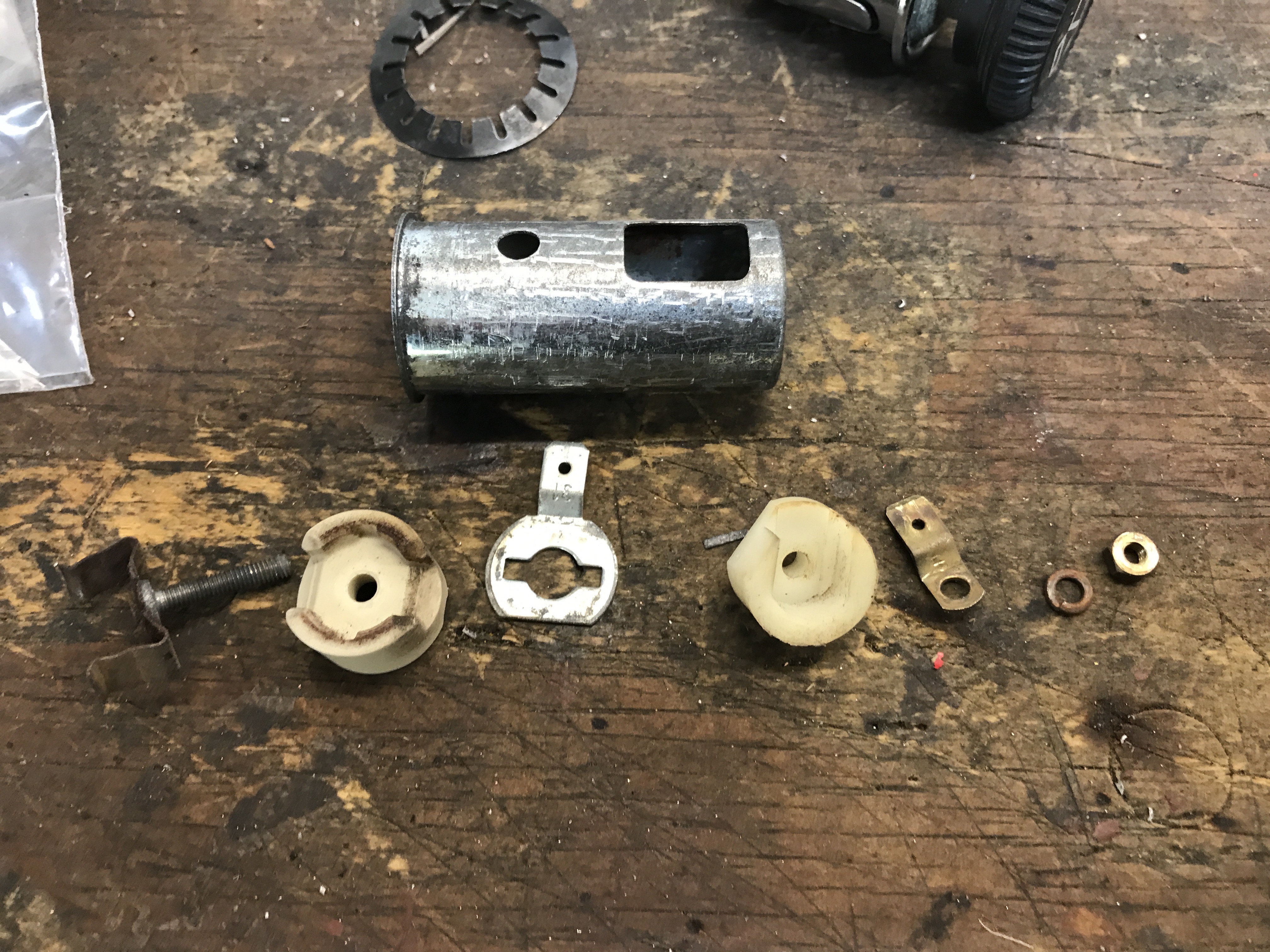

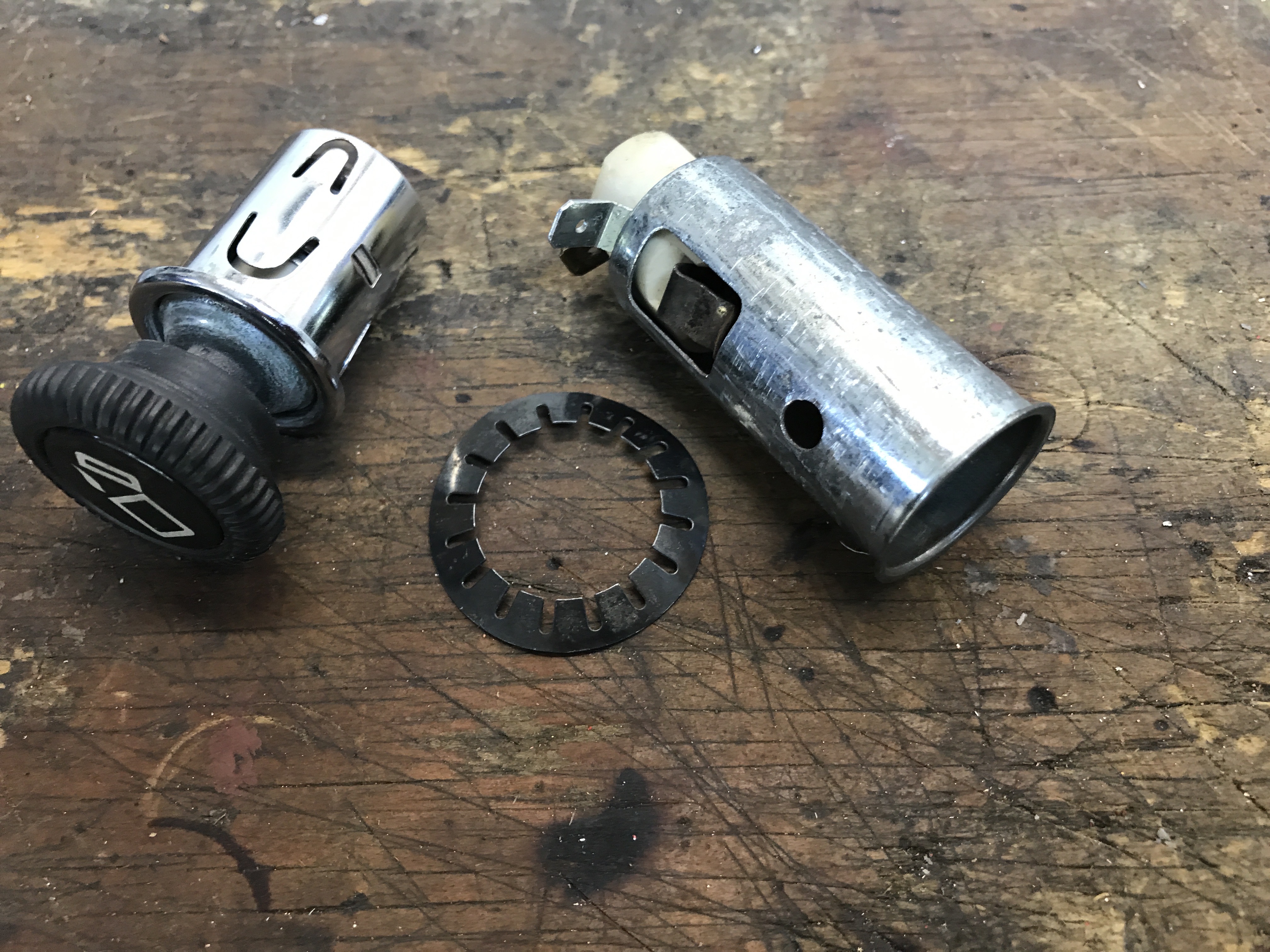

And here it is all apart. Time to let the contact plate soak in Evaporust.

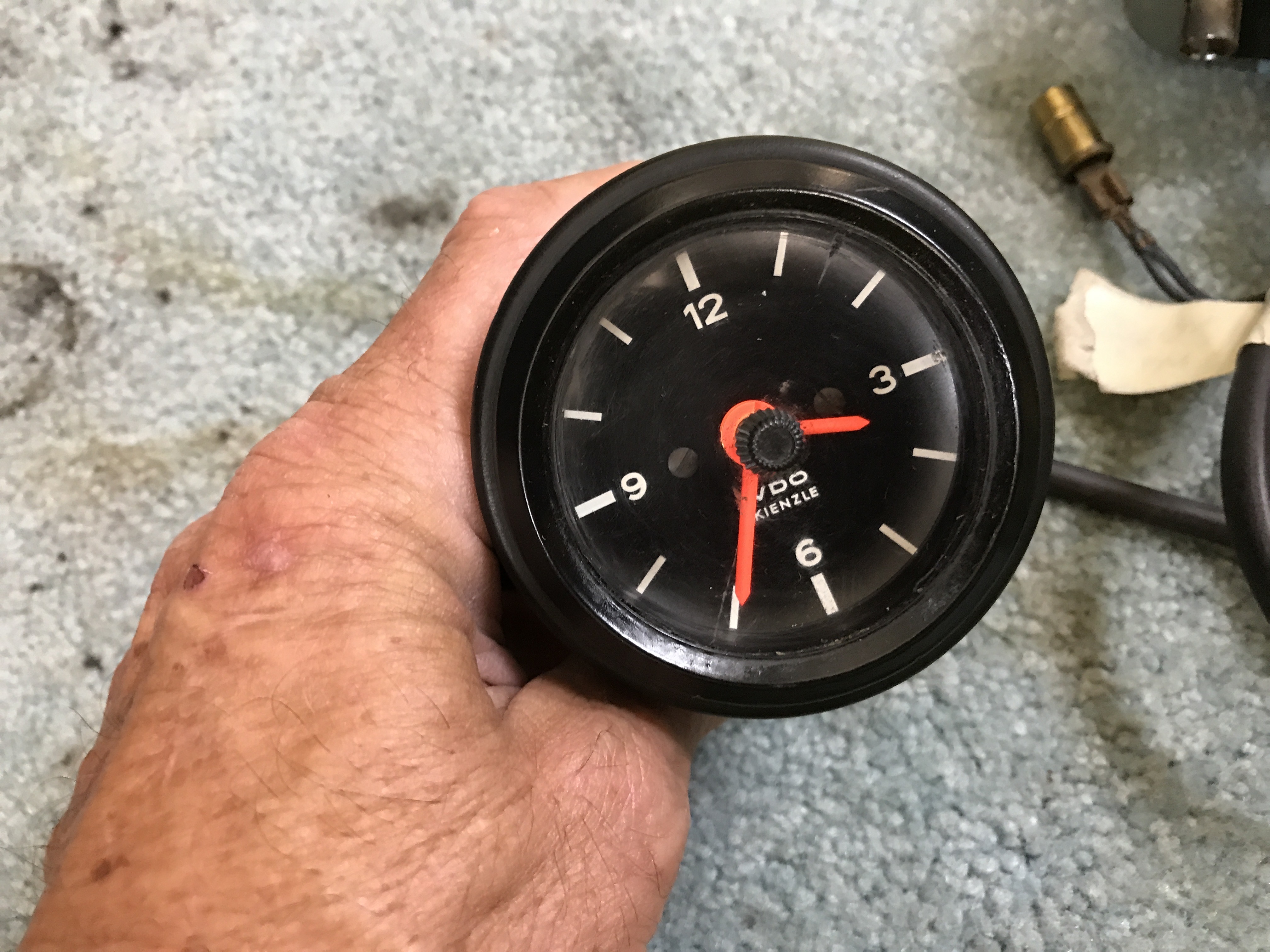

One mark in the loss category, at least for now: my clock stopped working.

Clock follow-up: when I connected the battery today, at first the clock did not run. Later it started ticking. So, I have a part-time clock?

Back to the cig lighter, I pulled the lighter section apart, and cleaned the components.
bkrantz
post Jun 10 2021, 07:29 PM
Post #2931
Posts: 8,800
Joined: 3-August 19
From: SW Colorado
Member No.: 23,343
With all the rust and crud gone, I re-installed the lighter socket and tested the power--success!

Now I have a functional cig lighter. I never expect to light any cigs, but it might be handy as a power outlet.

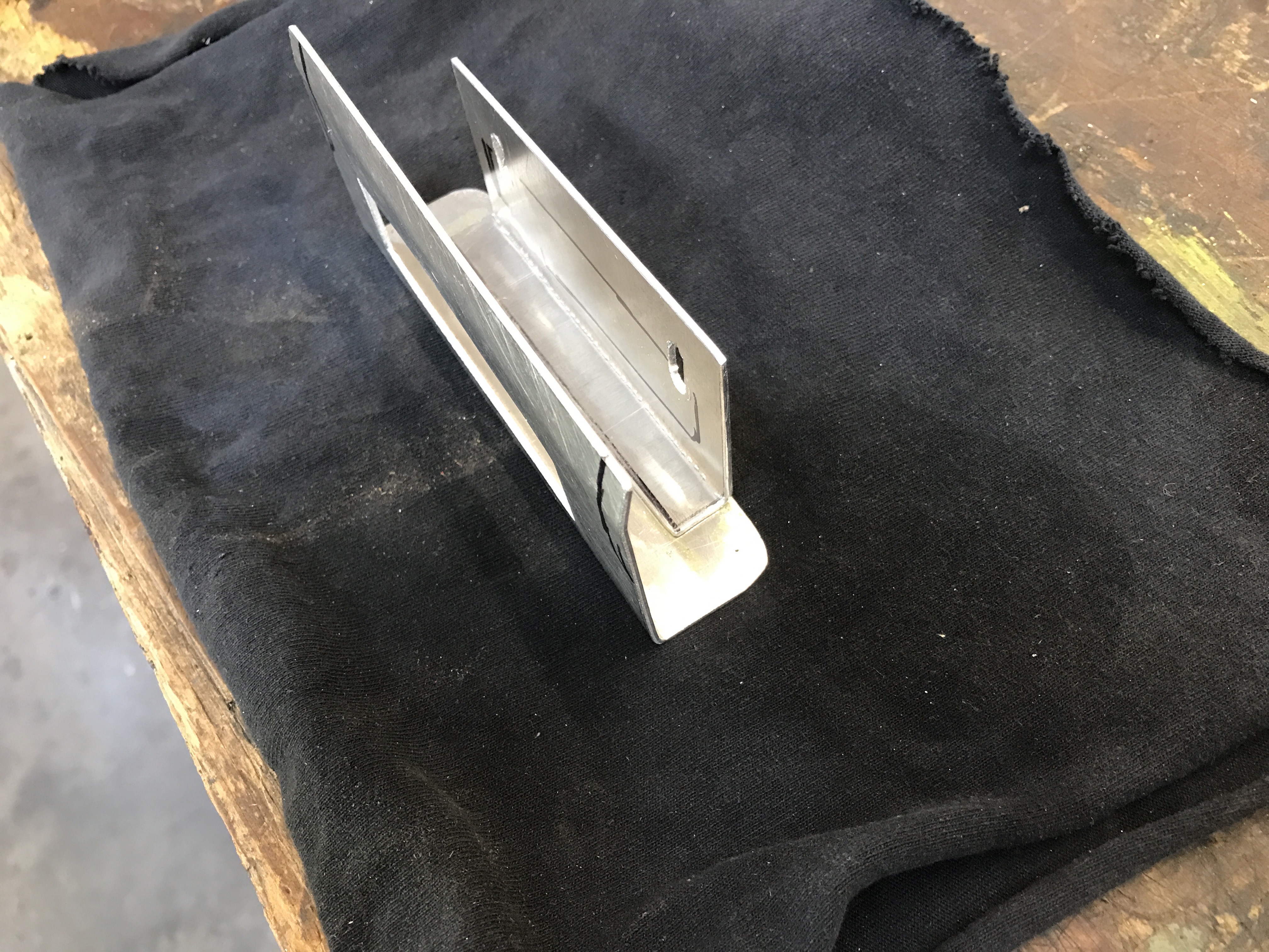

And then back to my new interior light holder. Here is the internal bracket piece, screwed into the underside of the slide.

One more temp fitting.
bkrantz
post Jun 10 2021, 07:33 PM
Post #2935
Posts: 8,800
Joined: 3-August 19
From: SW Colorado
Member No.: 23,343

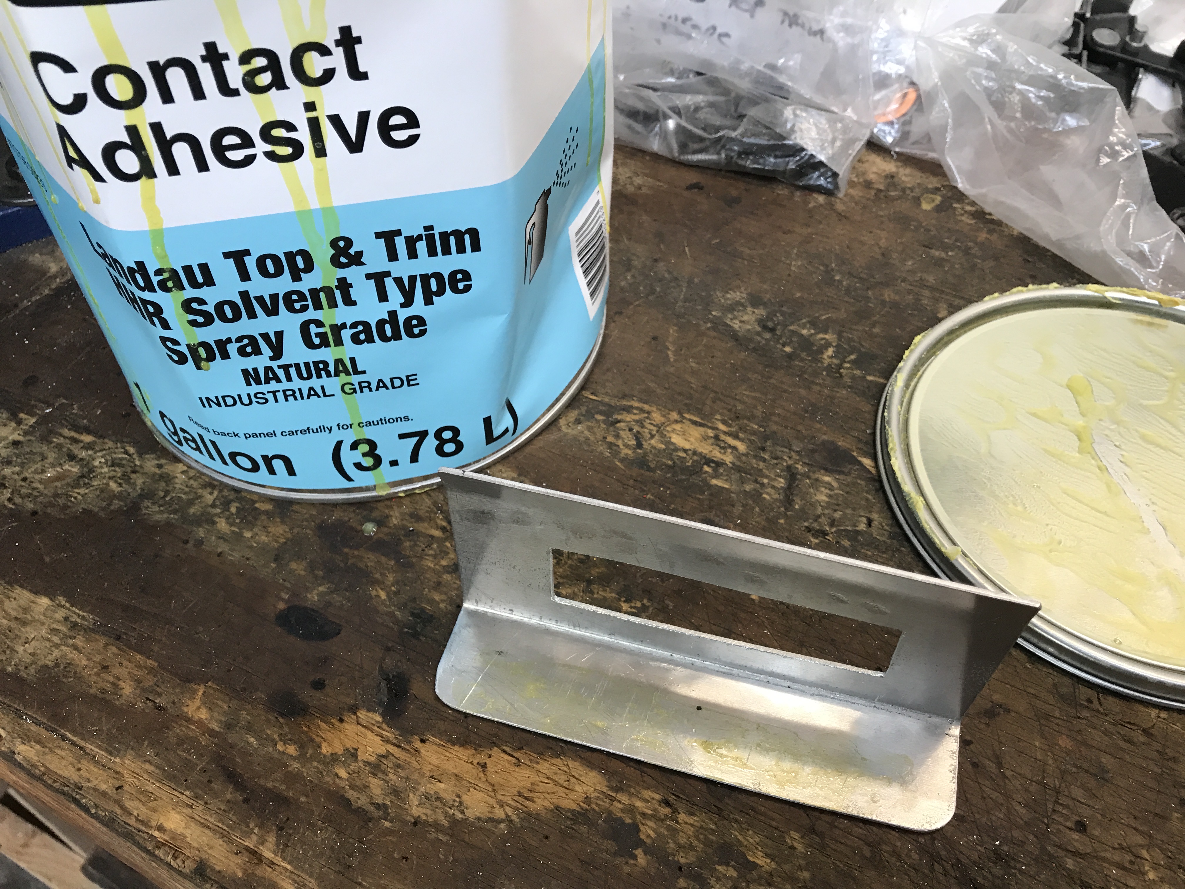

To get the two pieces to stick in the right position temporarily, I got out my gallon of contact cement.
bkrantz
post Jun 10 2021, 07:34 PM
Post #2936
Posts: 8,800
Joined: 3-August 19
From: SW Colorado
Member No.: 23,343
Here are the two pieces stuck together.

Final test fit. I think this will work, but it looks kinda plain.

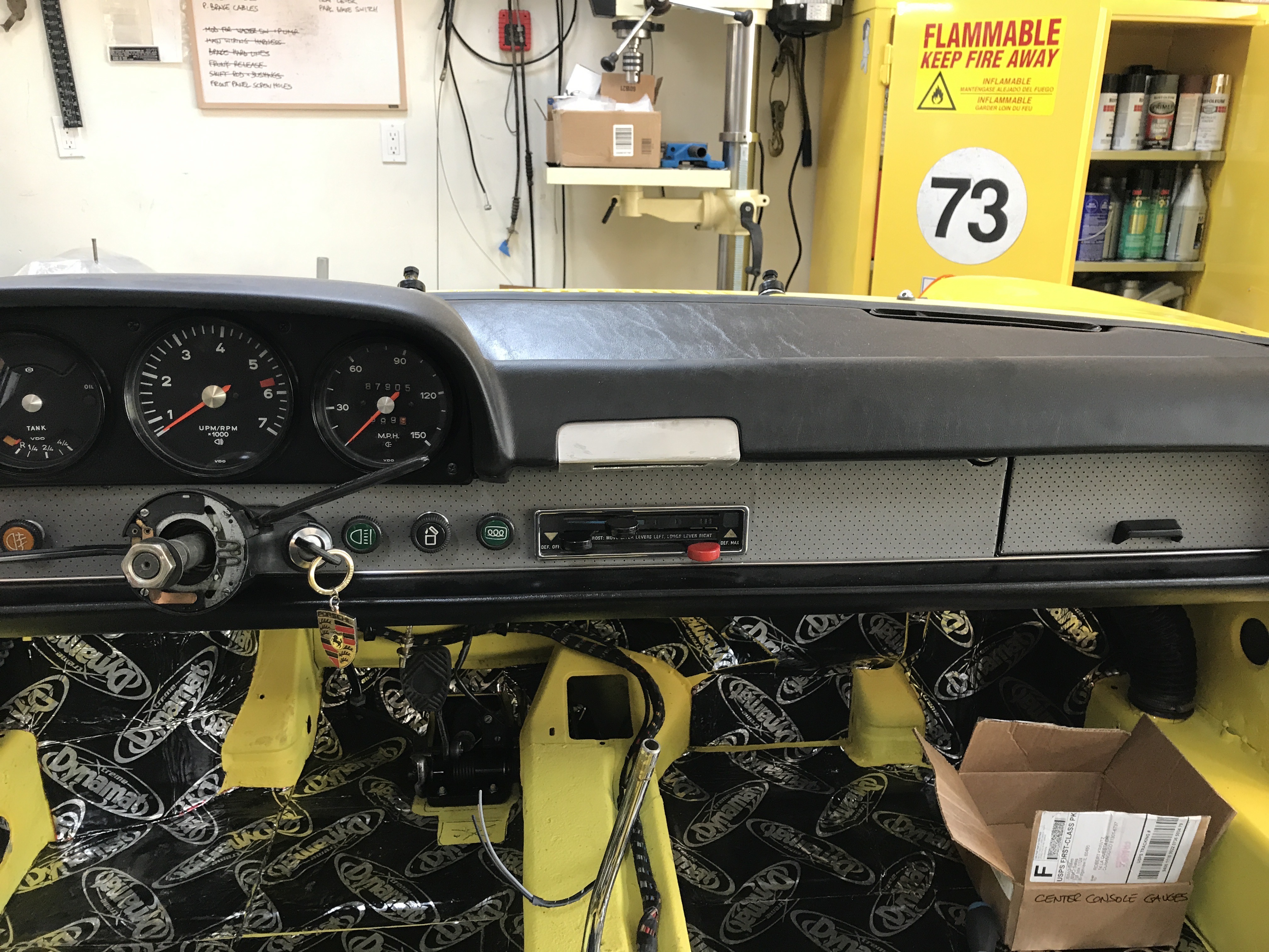

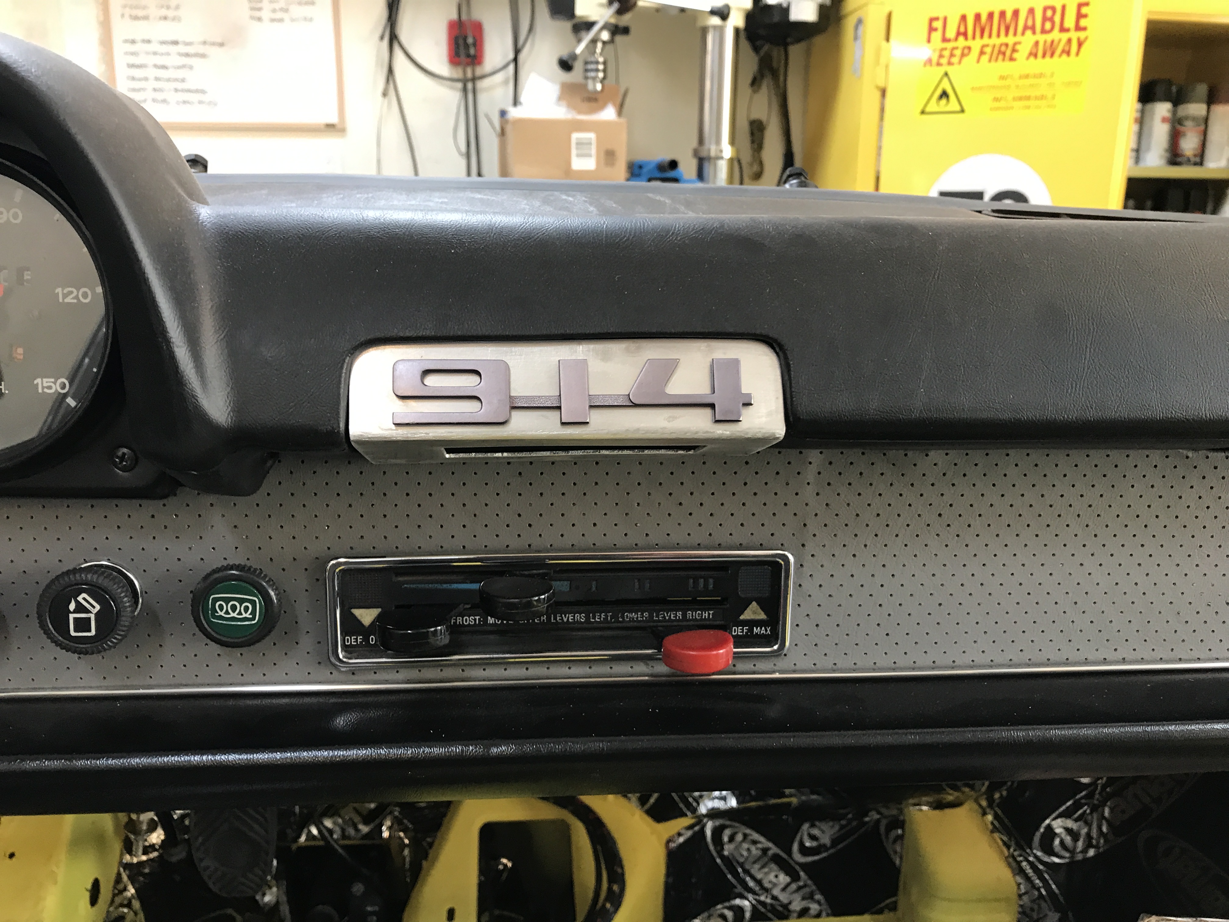

I found something that fits--what do you guys think? I would use a black logo over brushed aluminum.

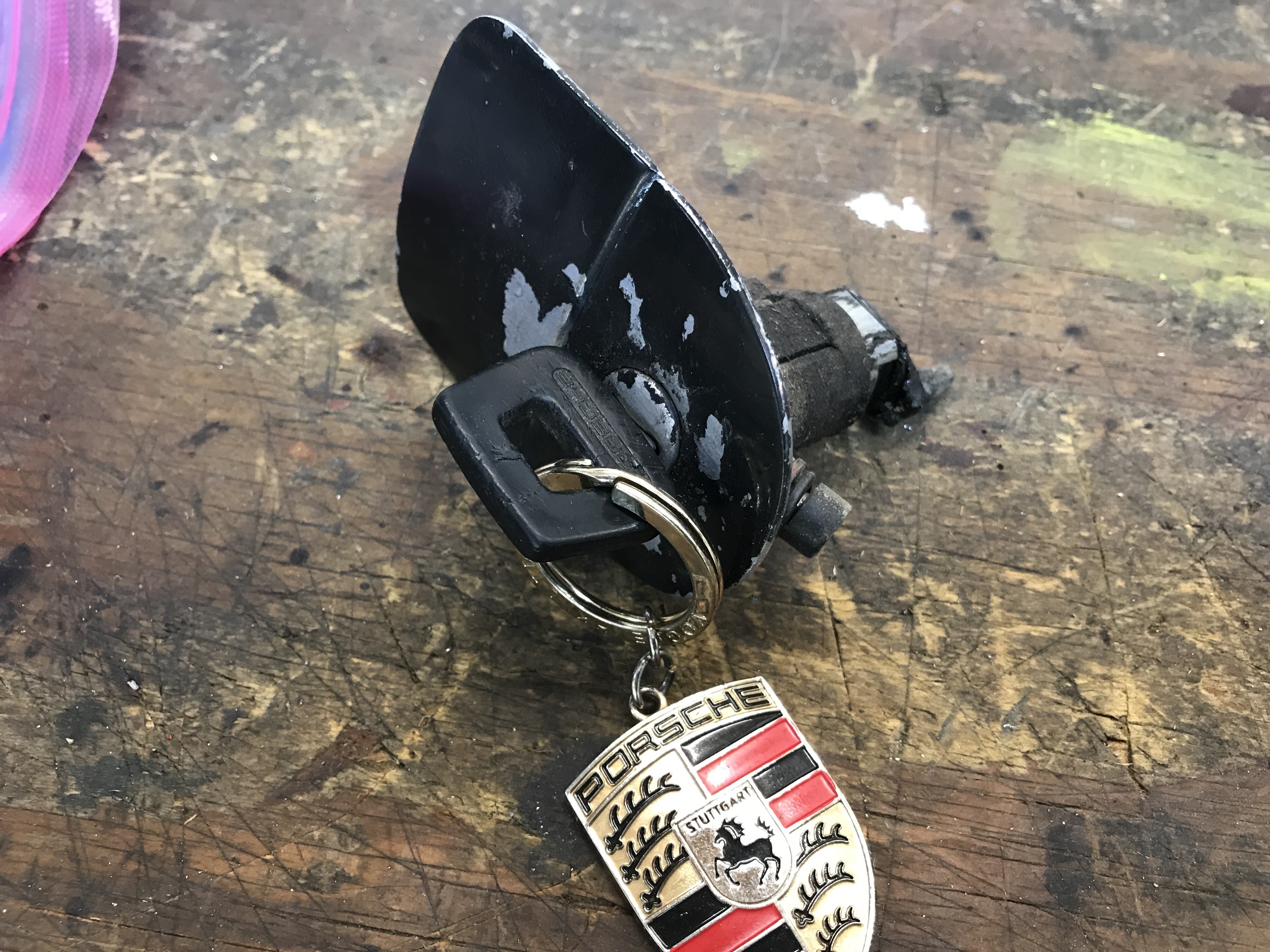

Moving along my shelf of parts, I checked the key in the door latches I removed way back in the beginning. I have 2 keys. The more warn key opens one door lock, but only the less warn key opens the other. Both keys work in the ignition.

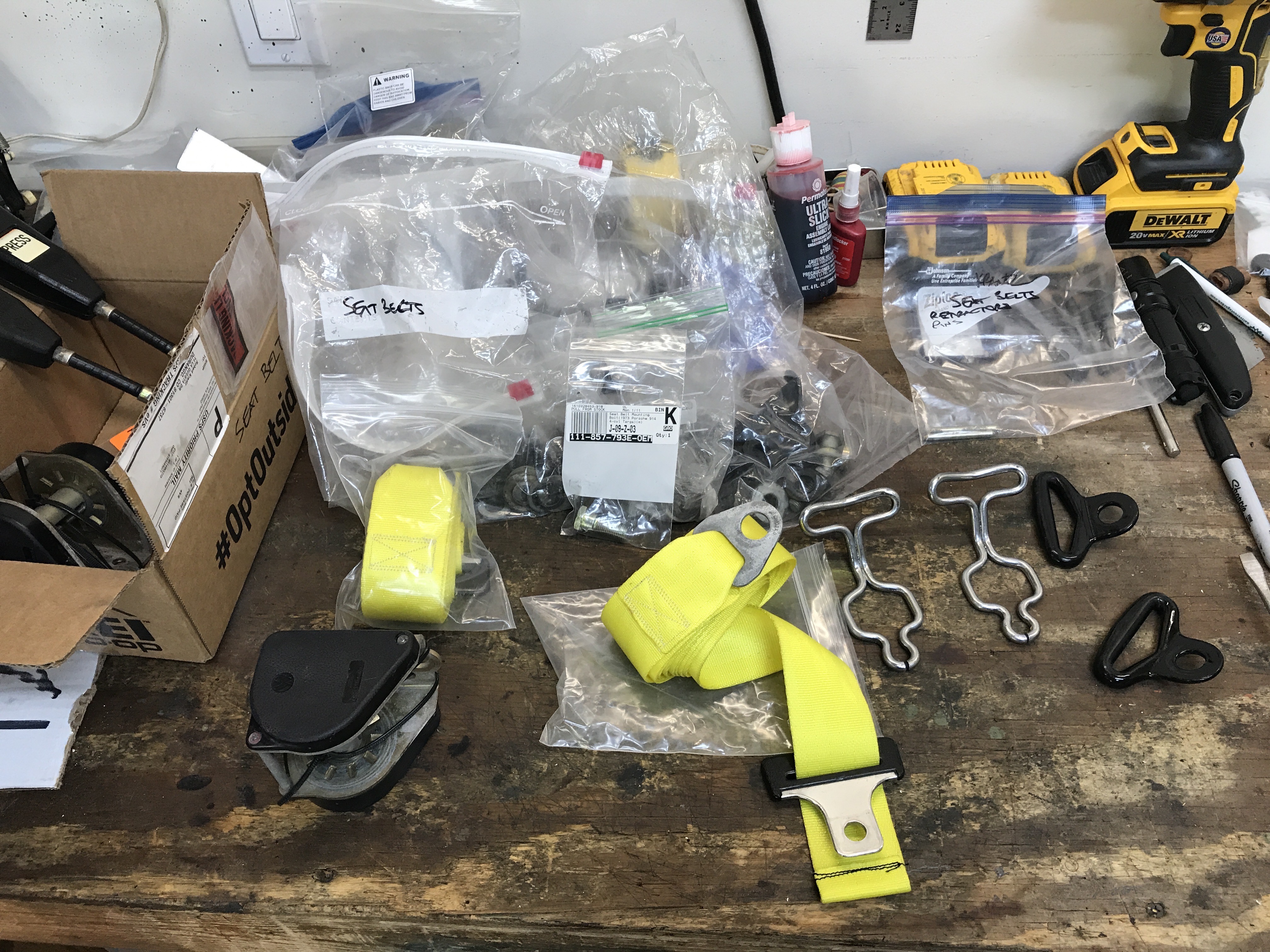

Next on the shelf was the box of seat belt parts. I had the original webbing replaced, and with a little color for the interior.
