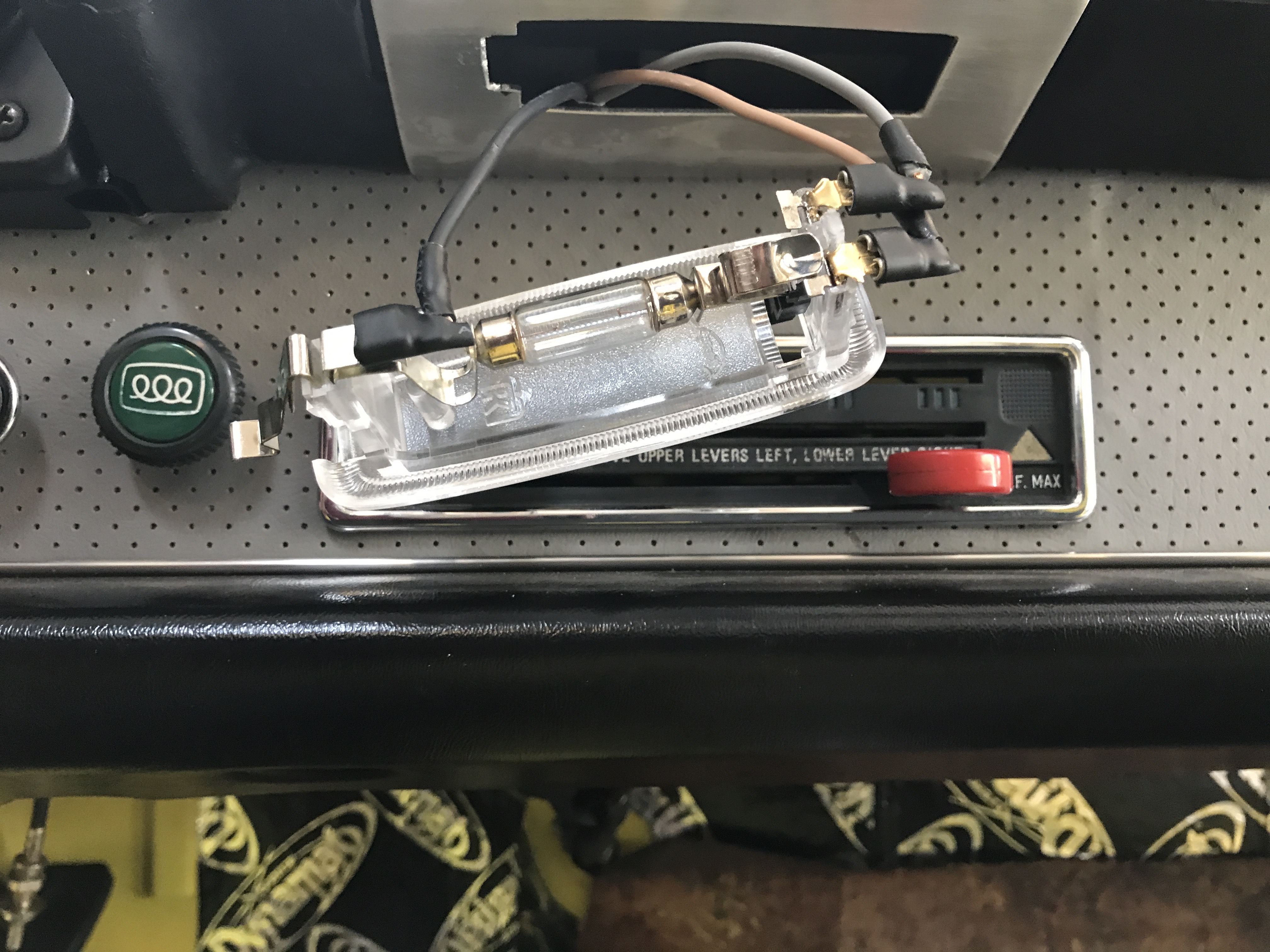

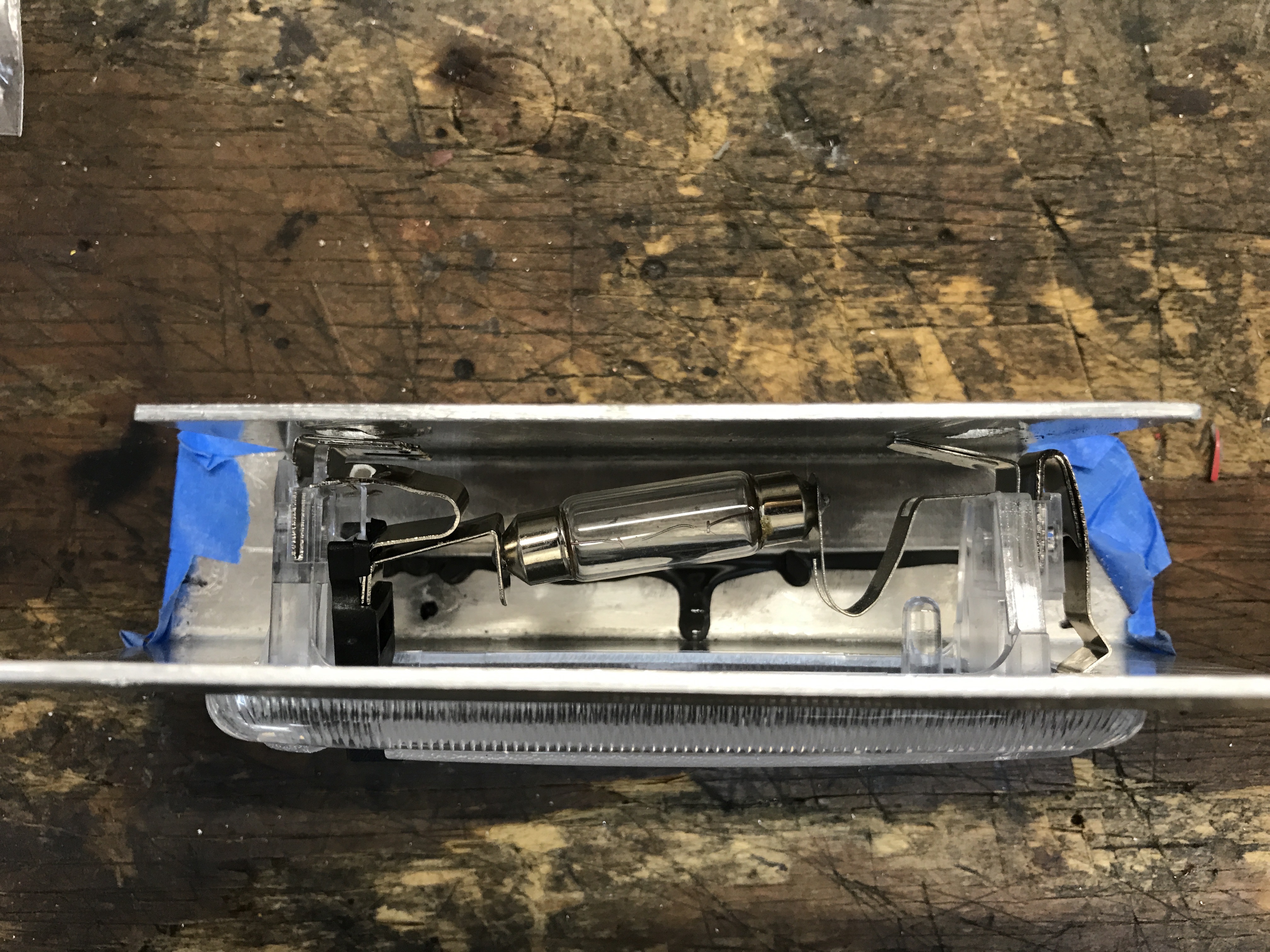

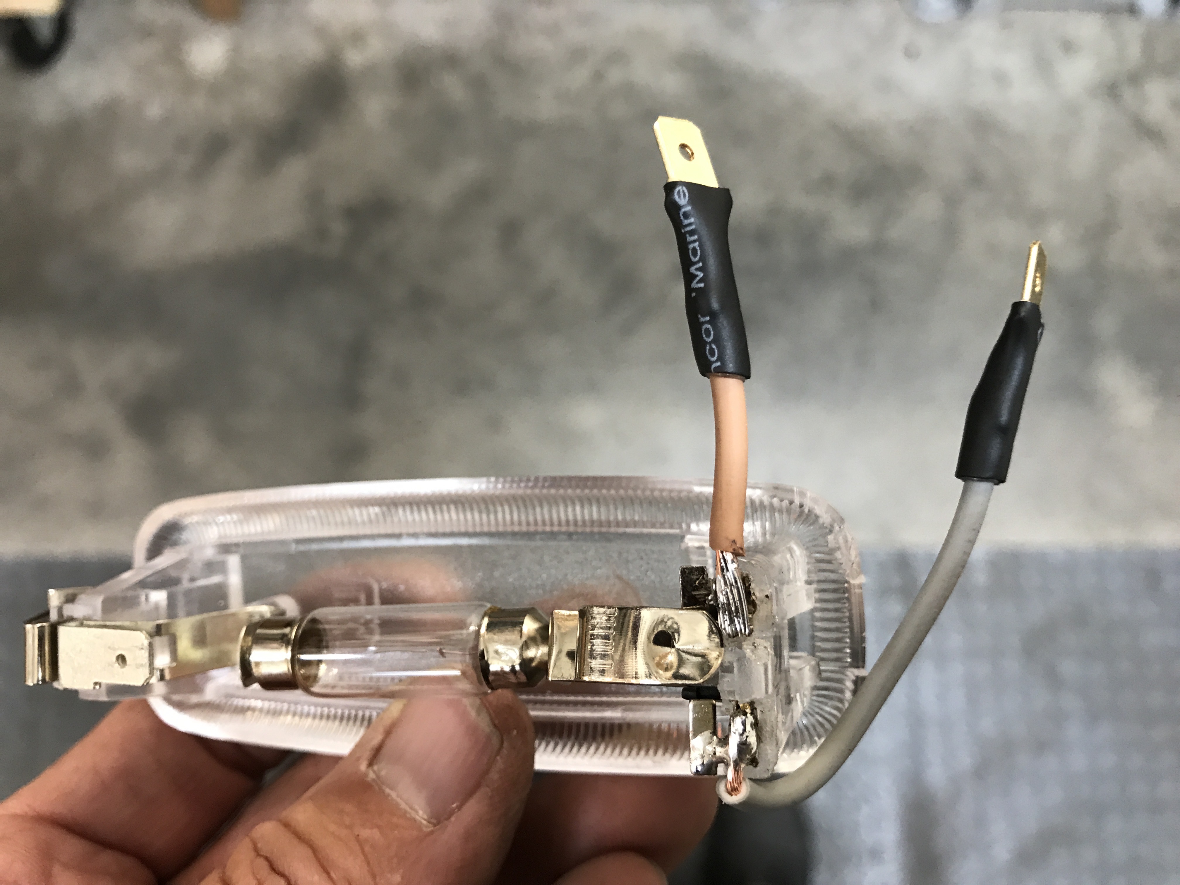

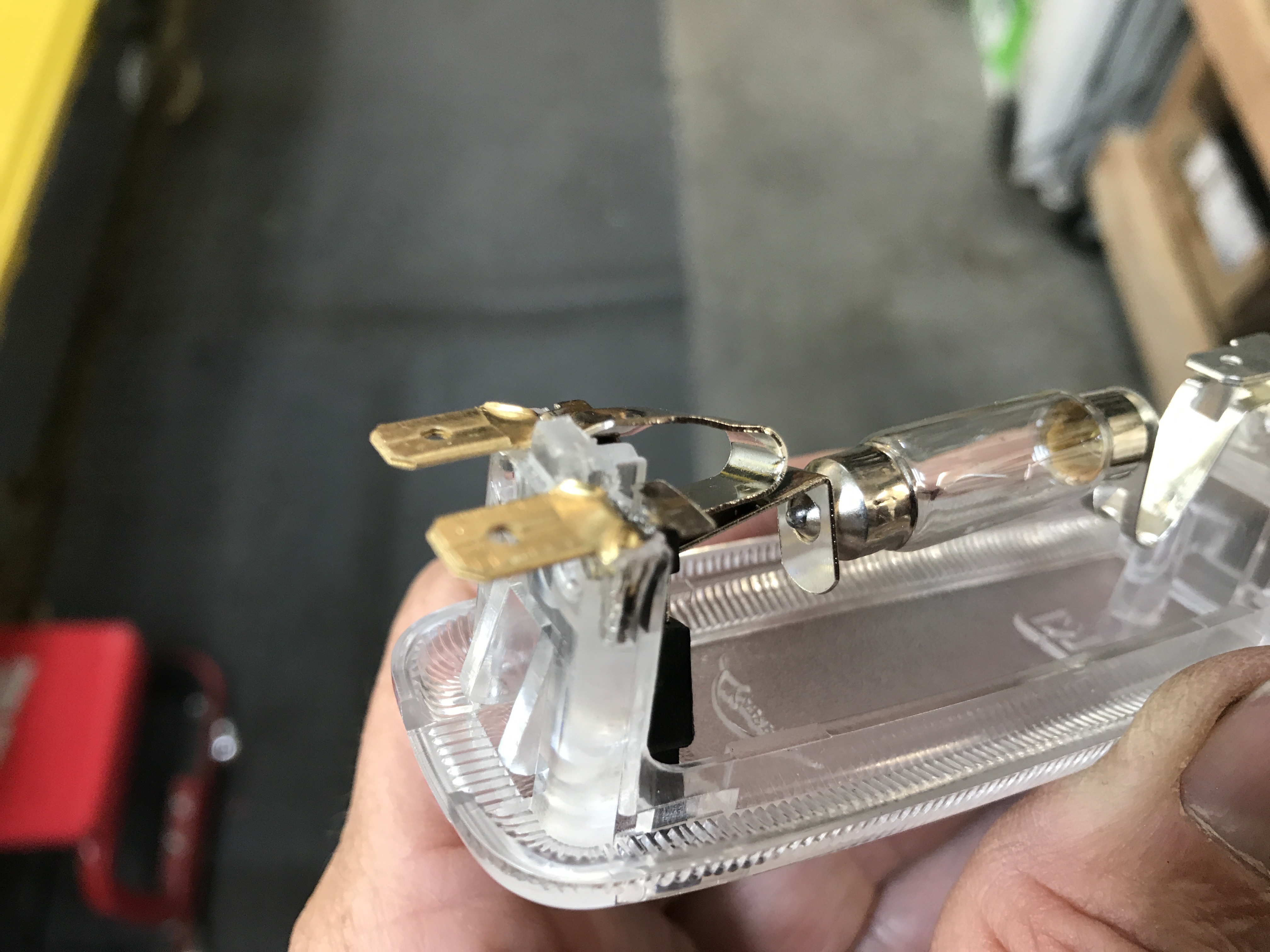

First problem: not enough clearance for the electrical tabs and connectors.
bkrantz
post Jun 12 2021, 07:43 PM
Post #2962
Posts: 8,800
Joined: 3-August 19
From: SW Colorado
Member No.: 23,343
Second problem: when I tried to bend the steel tabs, they broke off. So I soldered on some new tabs.
bkrantz
post Jun 12 2021, 07:45 PM
Post #2963
Posts: 8,800
Joined: 3-August 19
From: SW Colorado
Member No.: 23,343
Third problem: even with flag connectors, there was not enough clearance on the end inside.
bkrantz
post Jun 12 2021, 07:47 PM
Post #2964
Posts: 8,800
Joined: 3-August 19
From: SW Colorado
Member No.: 23,343
Fourth problem: when I tried to bend the soldered tabs, one broke off.
Final(?) solution: I replaced the tabs with short leads.
bkrantz
post Jun 12 2021, 07:48 PM
Post #2965
Posts: 8,800
Joined: 3-August 19
From: SW Colorado
Member No.: 23,343

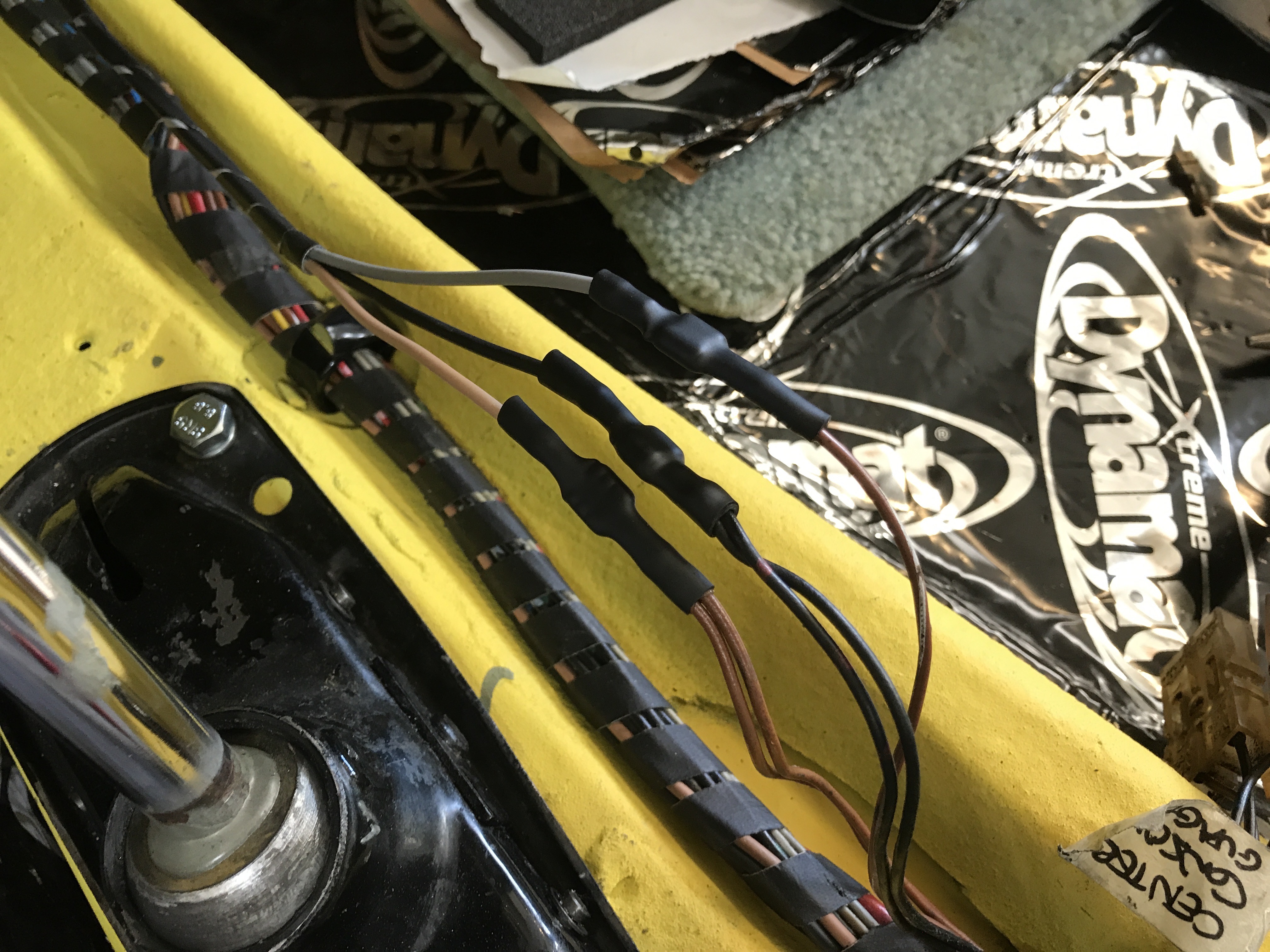

Connections made up, joining the extension wires with the original leads that used to go up to the center of the back panel.
bkrantz
post Jun 12 2021, 07:50 PM
Post #2966
Posts: 8,800
Joined: 3-August 19
From: SW Colorado
Member No.: 23,343
And...it works. I need to check how the light functions in the dark, and I plan to replace the stock bulb with LED.

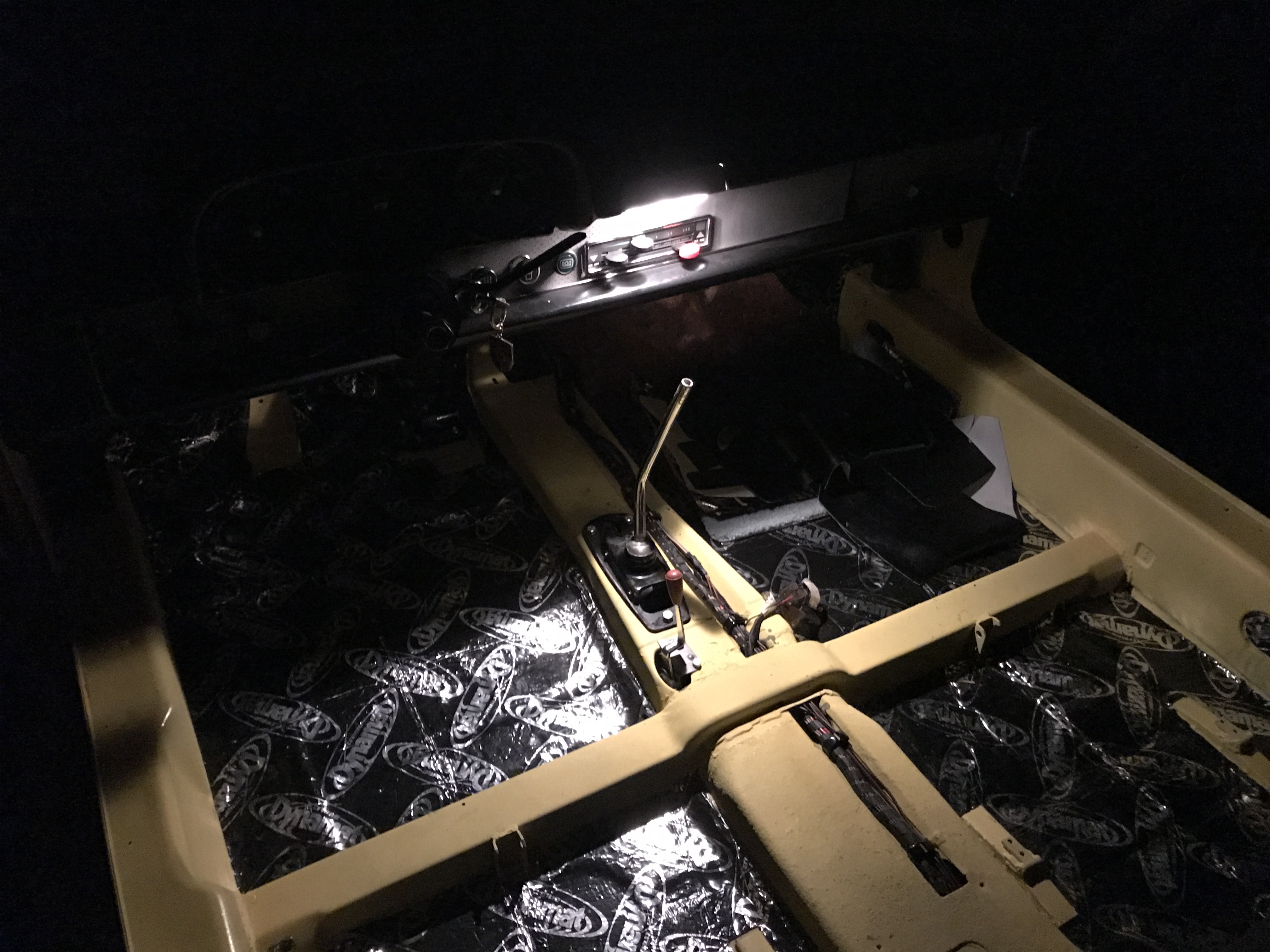

Test in the dark, with the original incandescent bulb.

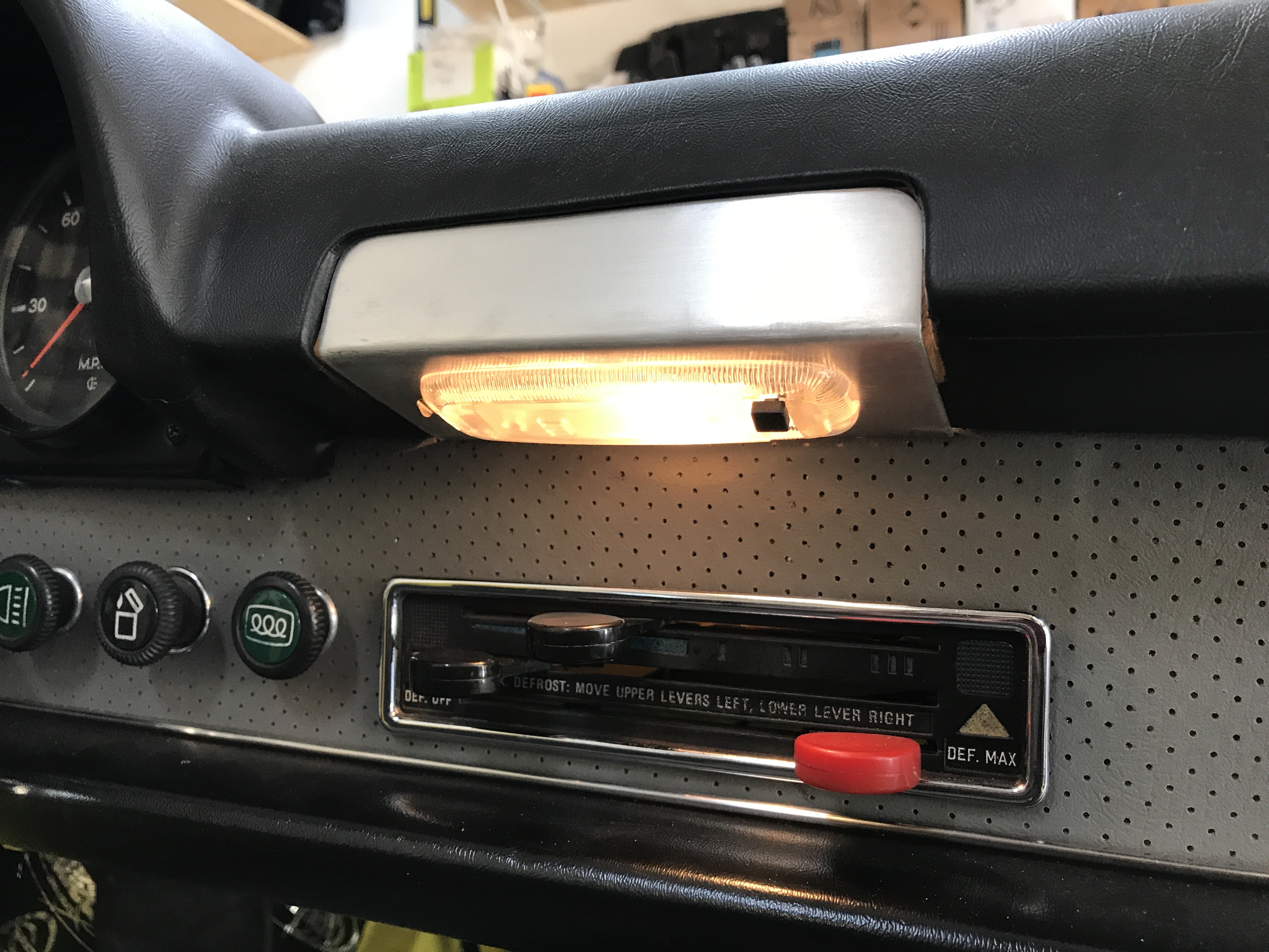

bkrantz

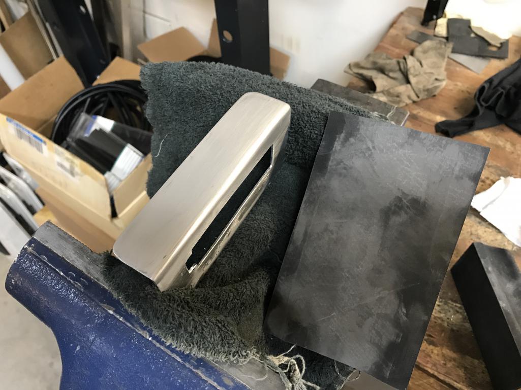

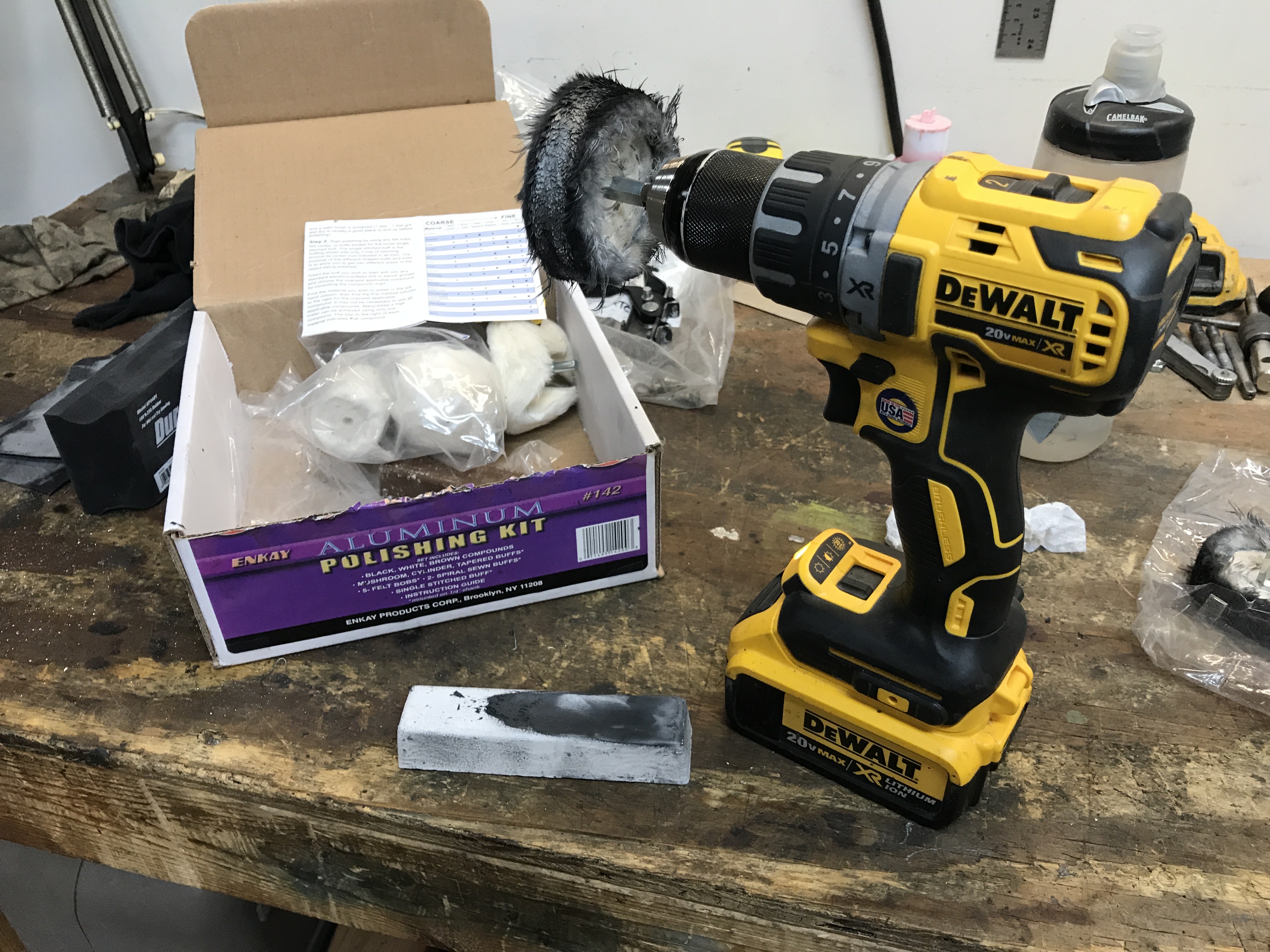

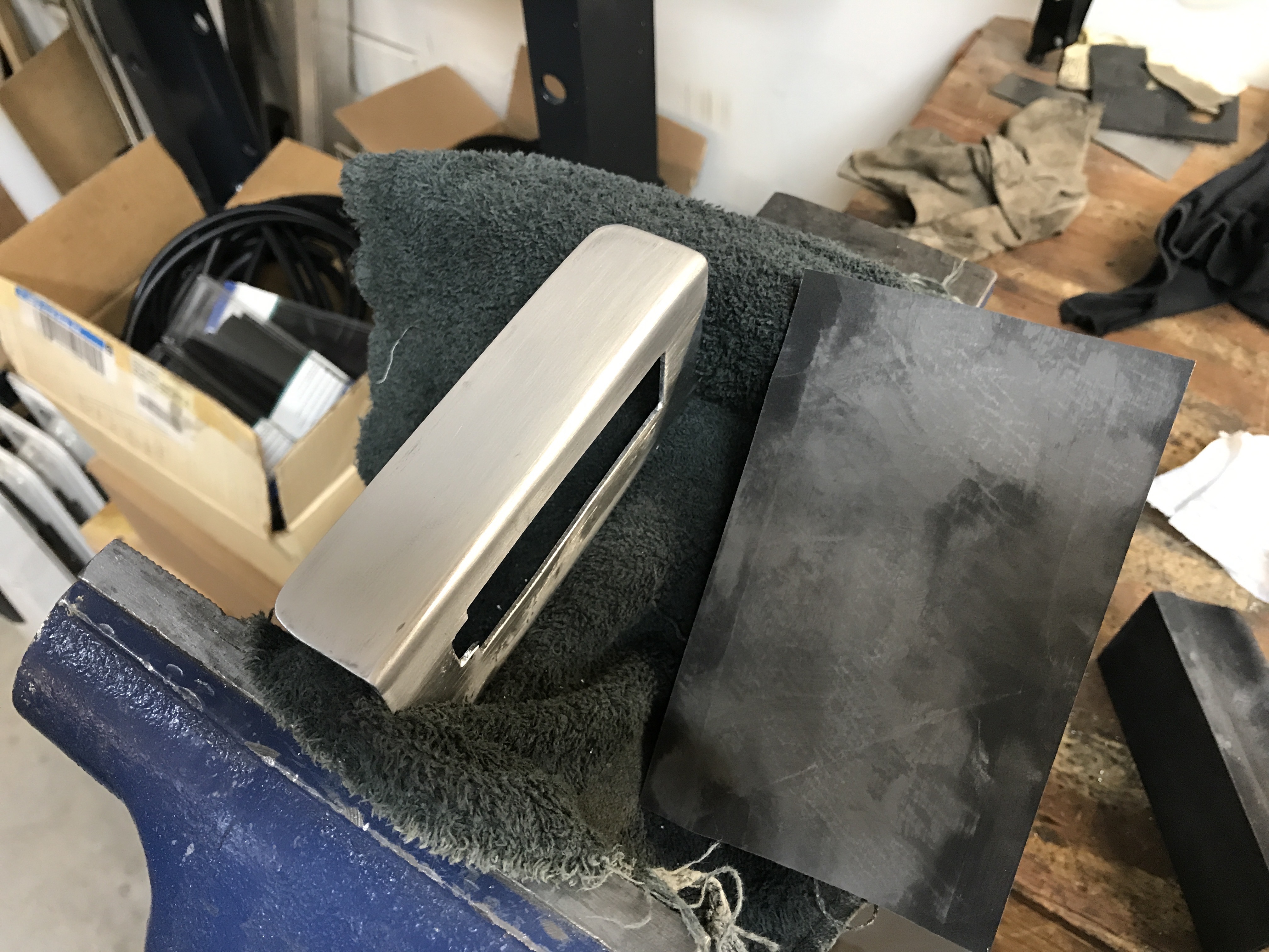

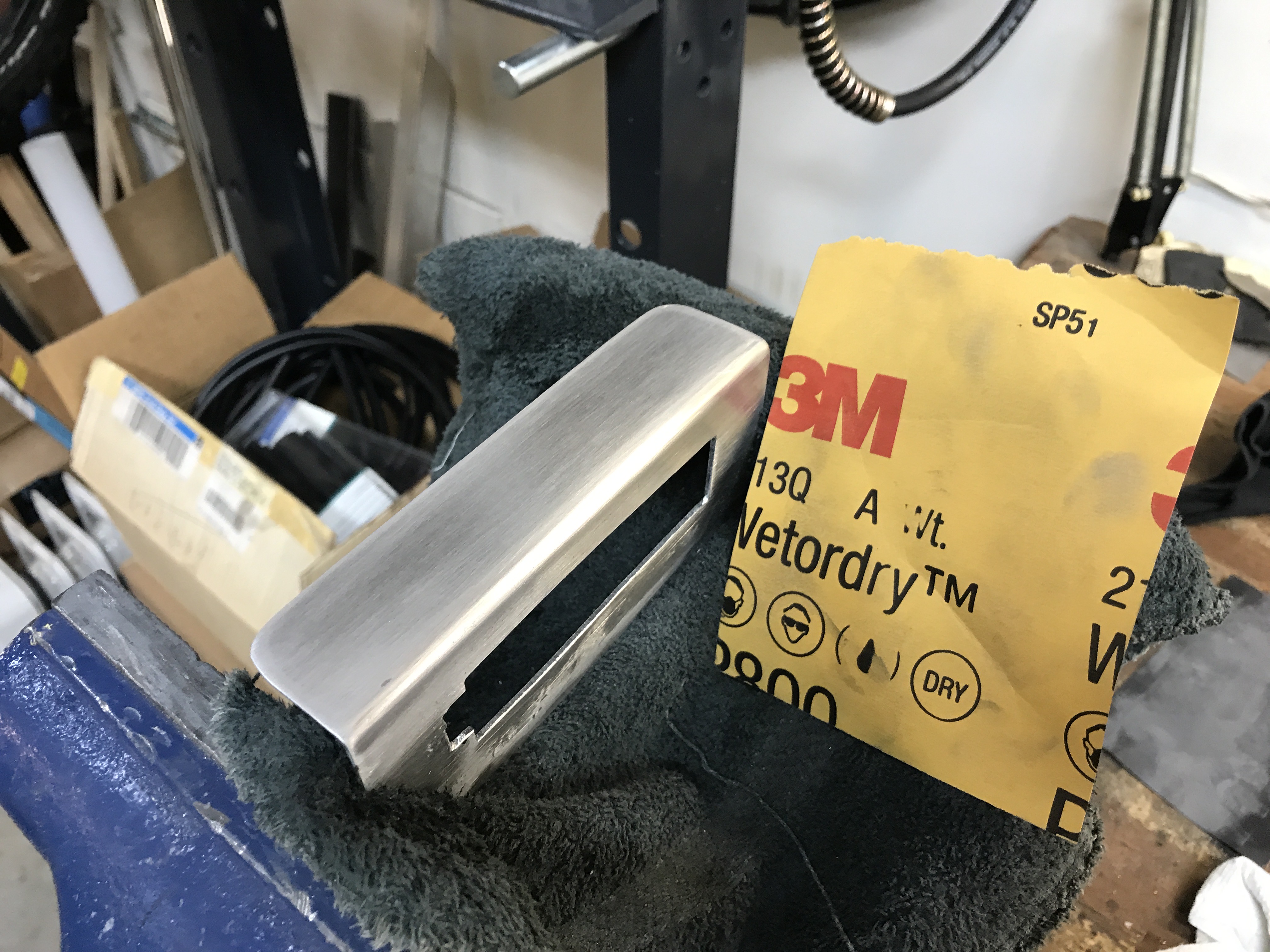

I took the light out one more time to adjust the fit, and decided to see what it would look like polished. First some 600 grit.
bkrantz
post Jun 13 2021, 07:15 PM
Post #2971
Posts: 8,800
Joined: 3-August 19
From: SW Colorado
Member No.: 23,343
Then 800 grit.
bkrantz
Post #2972
Posts: 8,800
Joined: 3-August 19
From: SW Colorado
Member No.: 23,343
Then black polish compound.
bkrantz
post Jun 13 2021, 07:16 PM
Post #2973
Posts: 8,800
Joined: 3-August 19
From: SW Colorado
Member No.: 23,343
Then white polishing compound.
bkrantz
post Jun 13 2021, 07:17 PM
Post #2974
Posts: 8,800
Joined: 3-August 19
From: SW Colorado
Member No.: 23,343

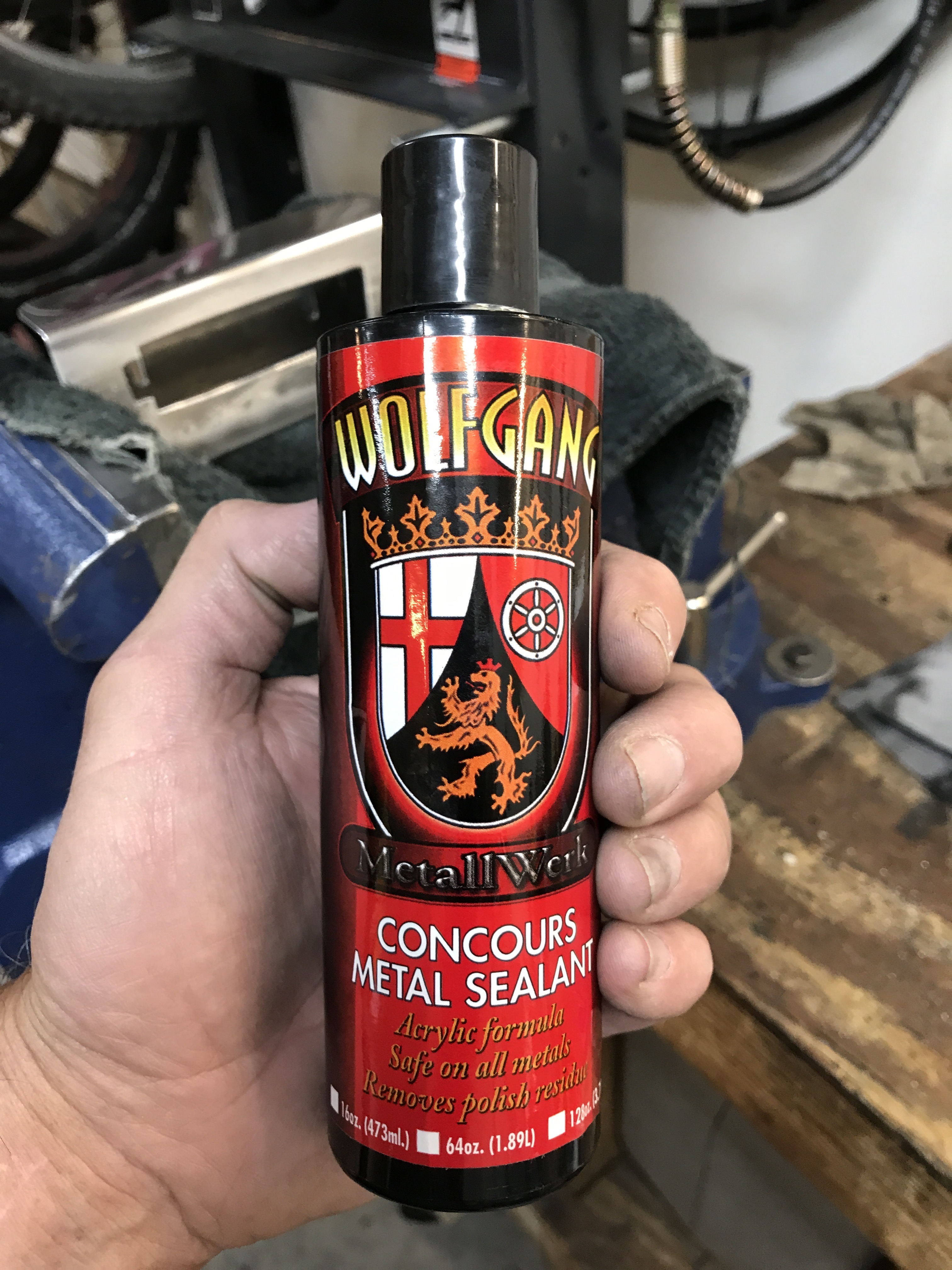

Finally, sealant.
bkrantz
Post #2975
Posts: 8,800
Joined: 3-August 19
From: SW Colorado
Member No.: 23,343

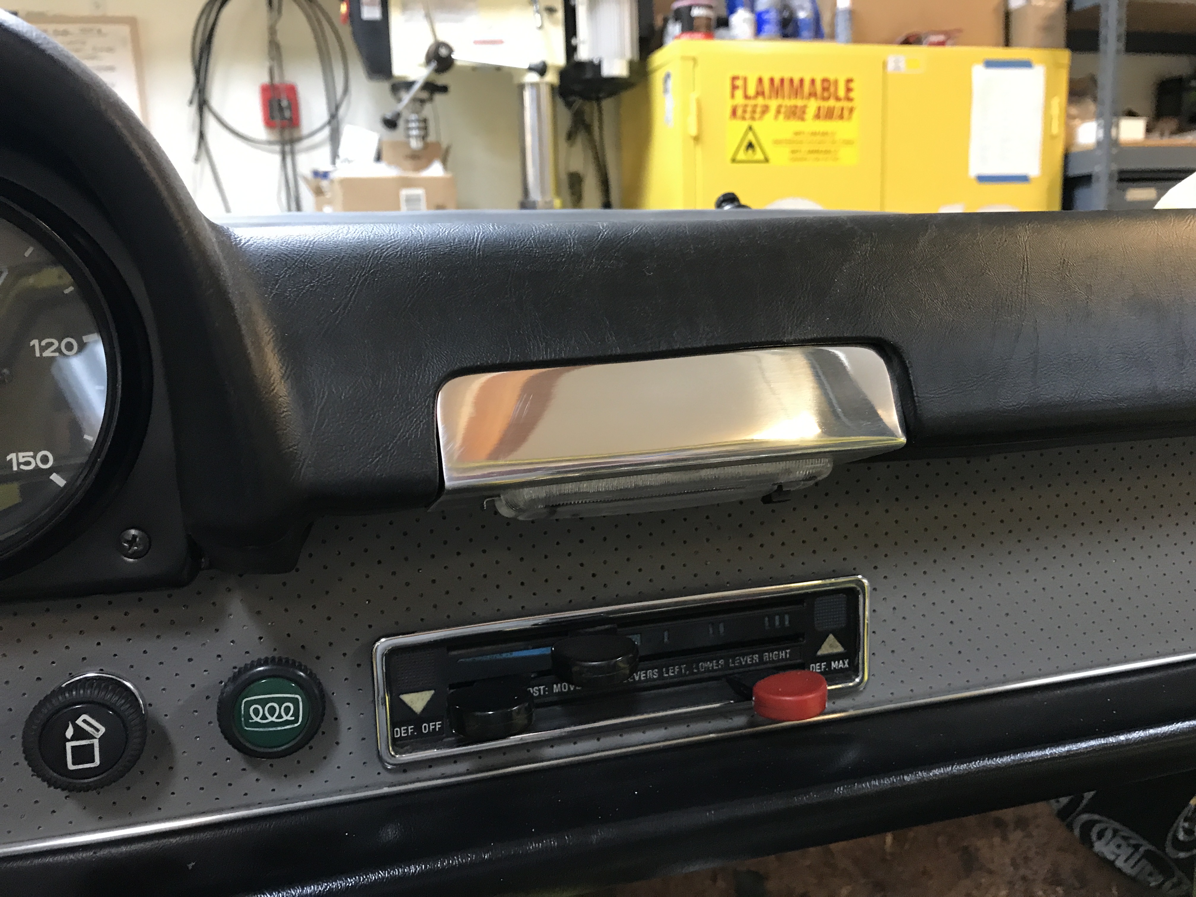

Here's the results. Comments?

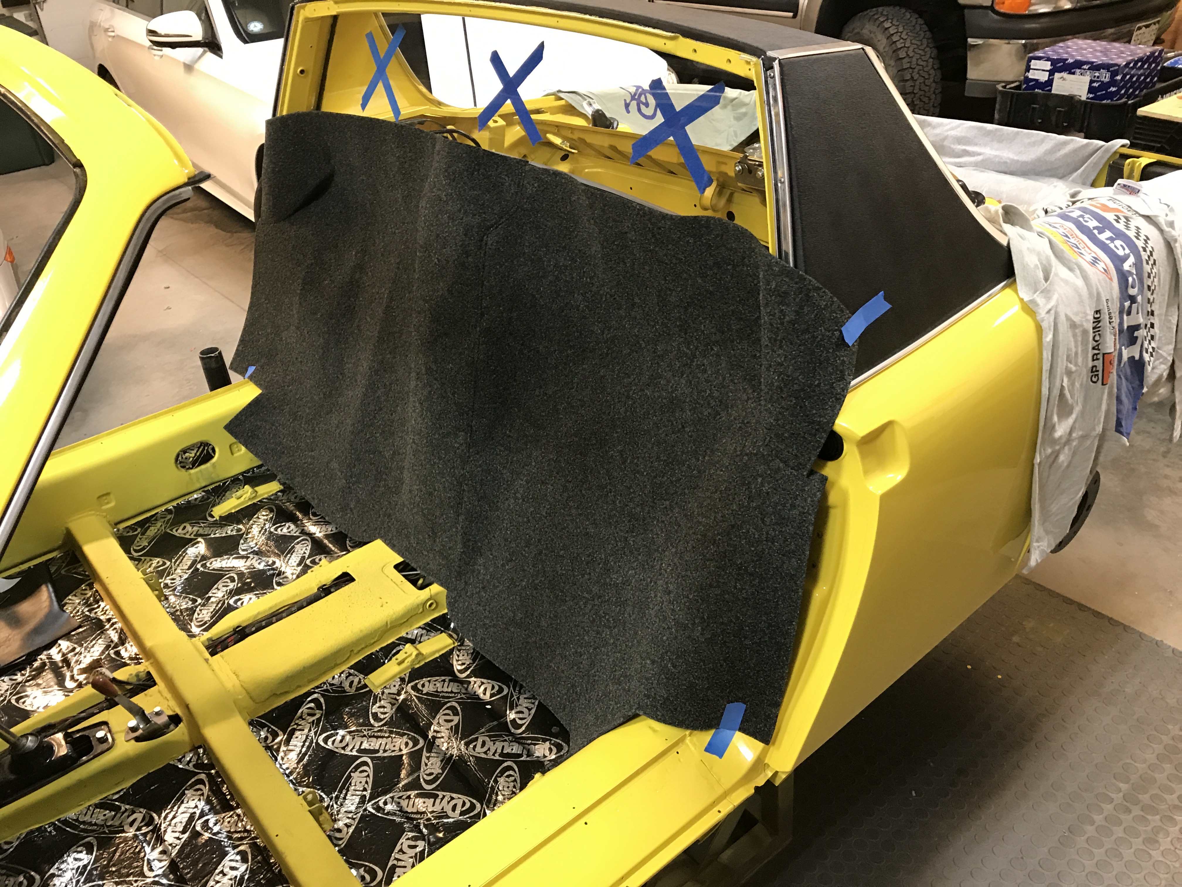

A first test fit of the custom rear bulkhead cover, sourced from rennspd on eBay. Looks pretty good.
bkrantz
post Jun 13 2021, 07:23 PM
Post #2977
Posts: 8,800
Joined: 3-August 19
From: SW Colorado
Member No.: 23,343

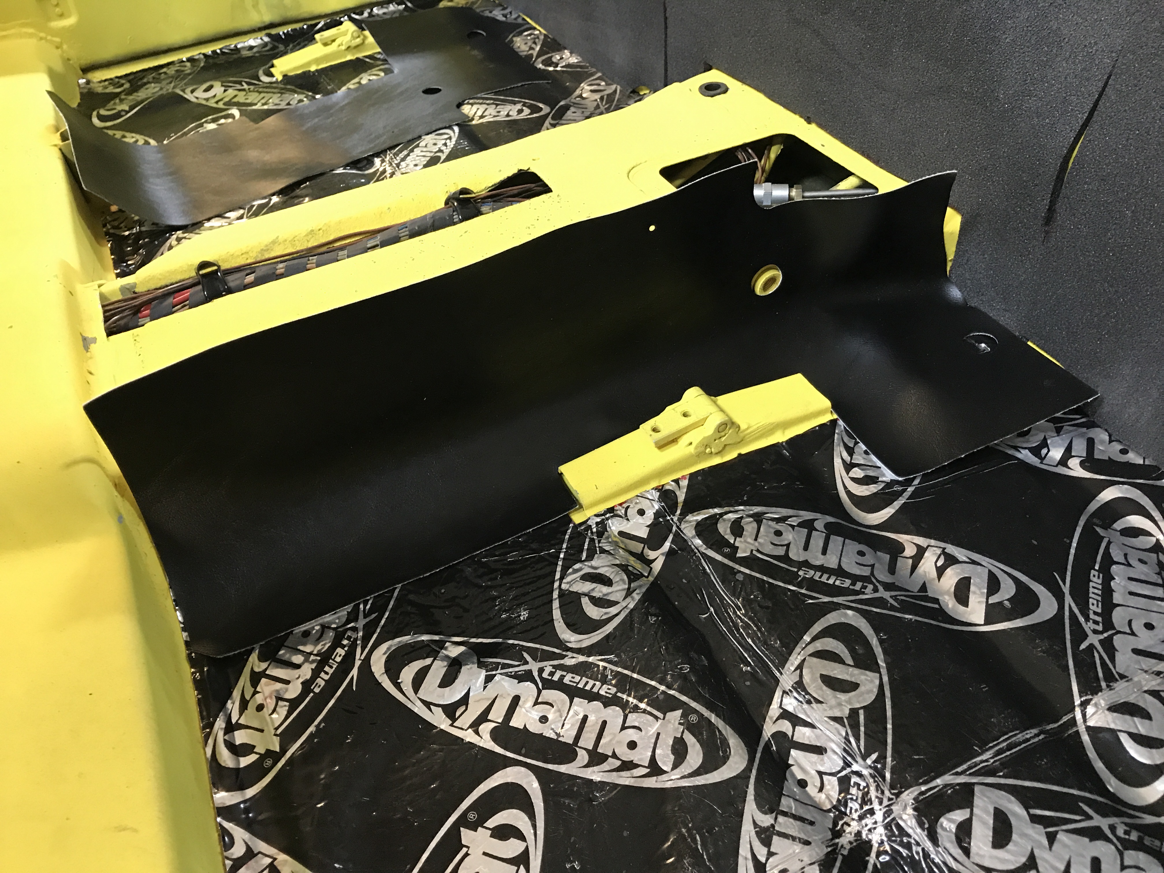

But first, time to install the interior vinyl pieces.
bkrantz
Post #2978
Posts: 8,800
Joined: 3-August 19
From: SW Colorado
Member No.: 23,343
Test fitting the left side tunnel cover.

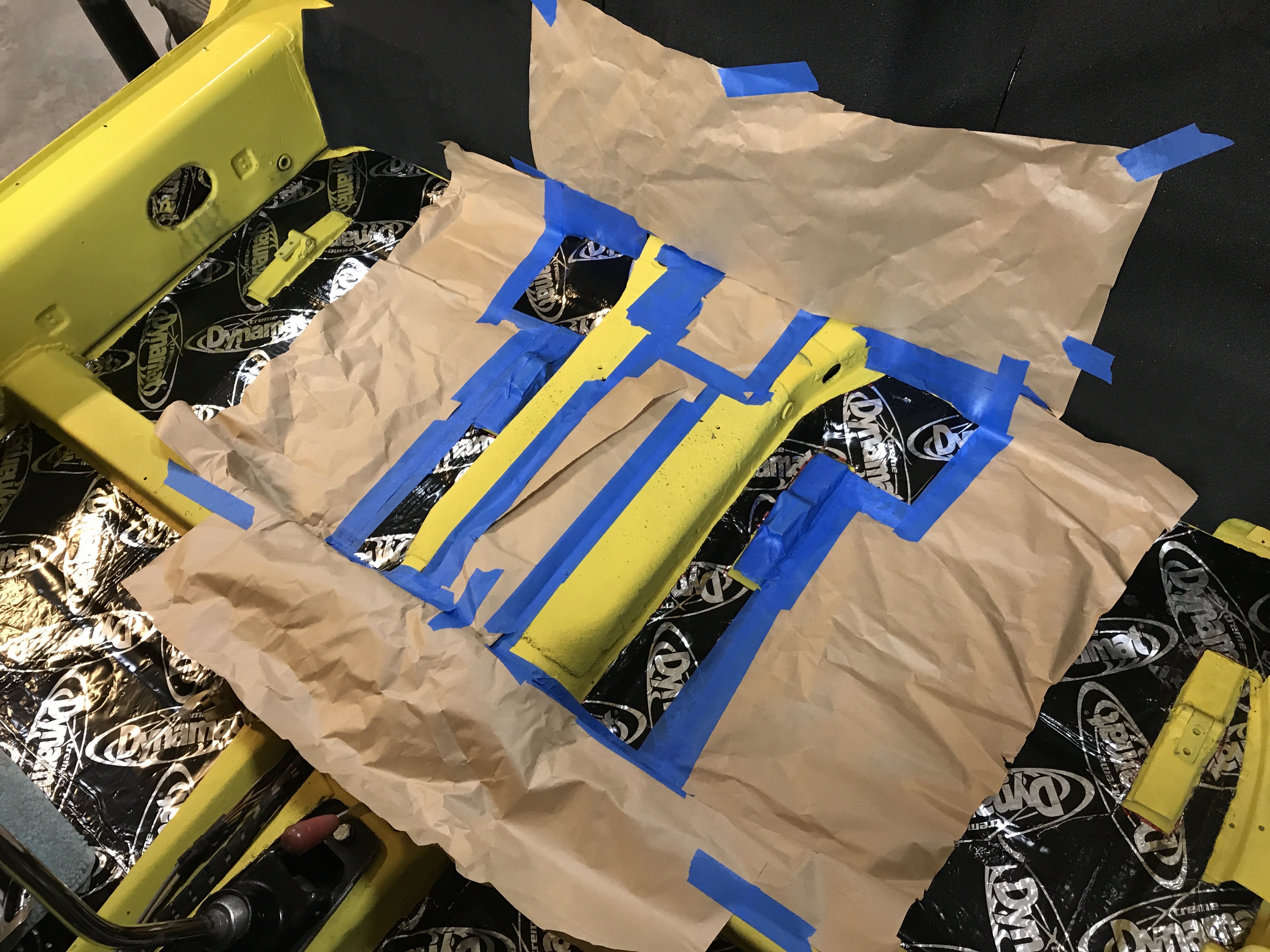

From: SW Colorado
Member No.: 23,343
Then masking off for adhesive spray.
bkrantz
post Jun 13 2021, 07:25 PM
Post #2980
Posts: 8,800
Joined: 3-August 19
From: SW Colorado
Member No.: 23,343
I used more of this, same as I used on the targa vinyl.
