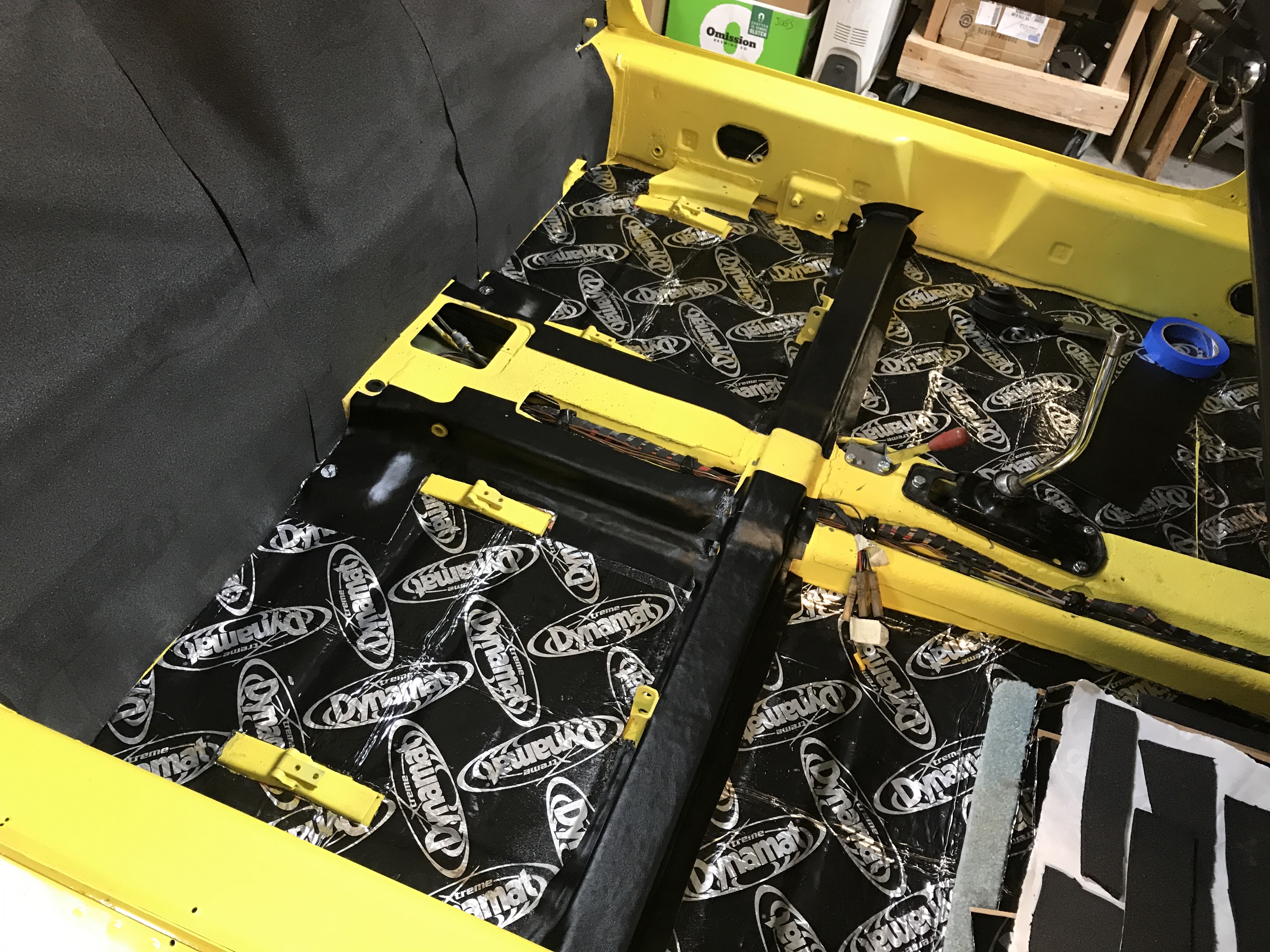

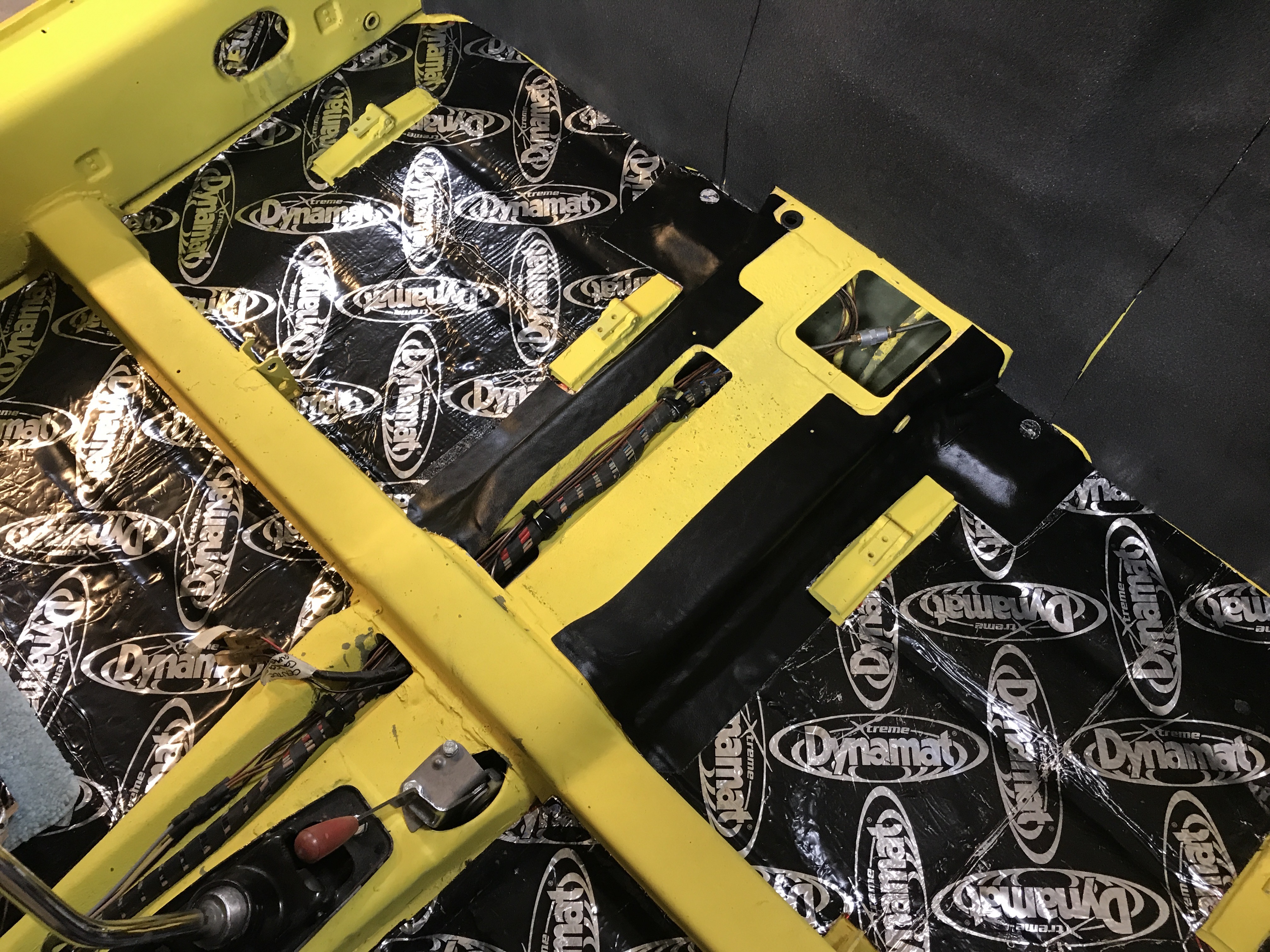

Tunnel side cover pieces in place.
bkrantz
post Jun 13 2021, 07:28 PM
Post #2982
Posts: 8,800
Joined: 3-August 19
From: SW Colorado
Member No.: 23,343
And then the cross member cover pieces.
I will probably not use the other vinyl pieces that go behind and next to the seat belt retractors, since the custom perlon panel covers those areas.

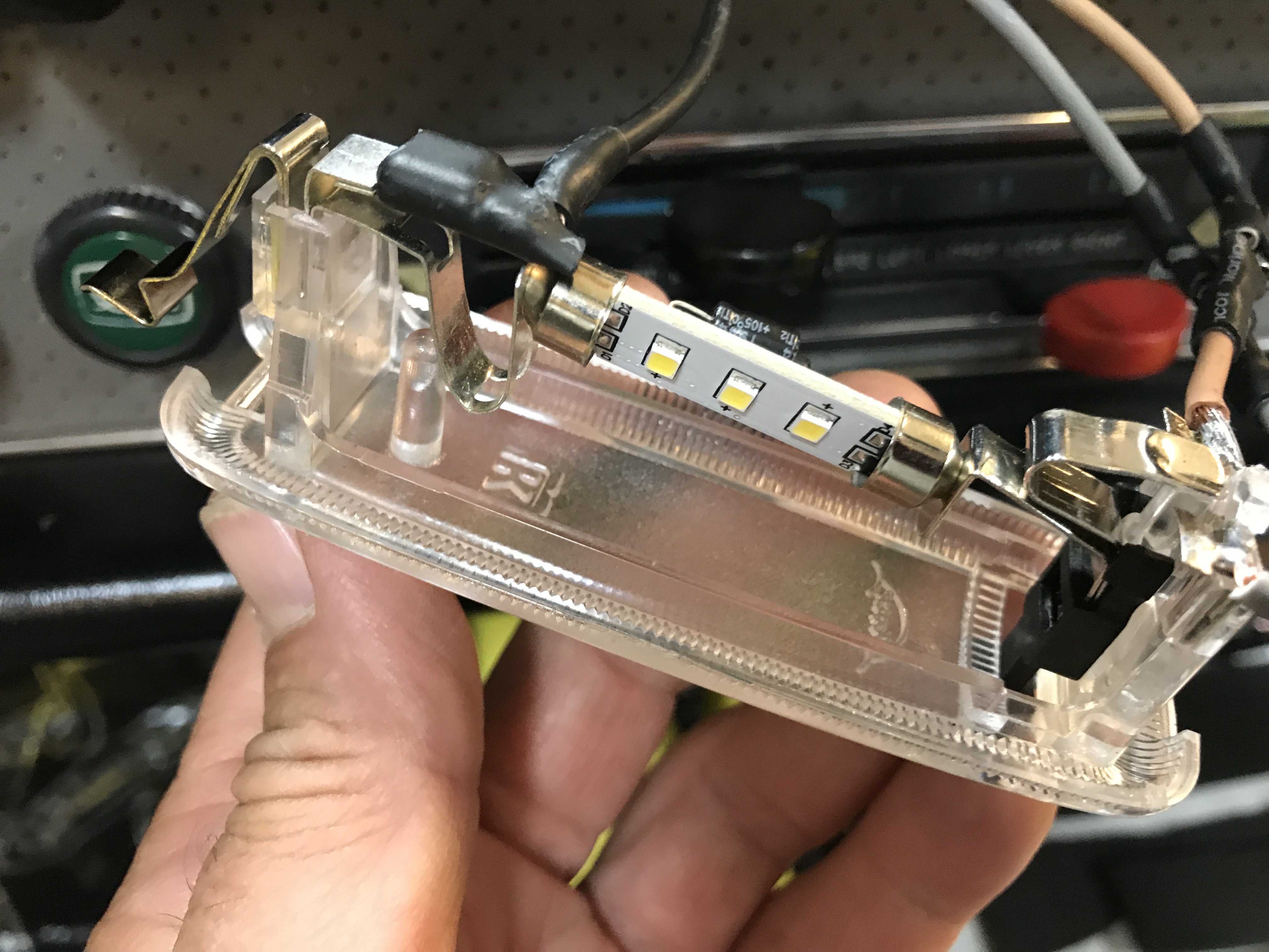

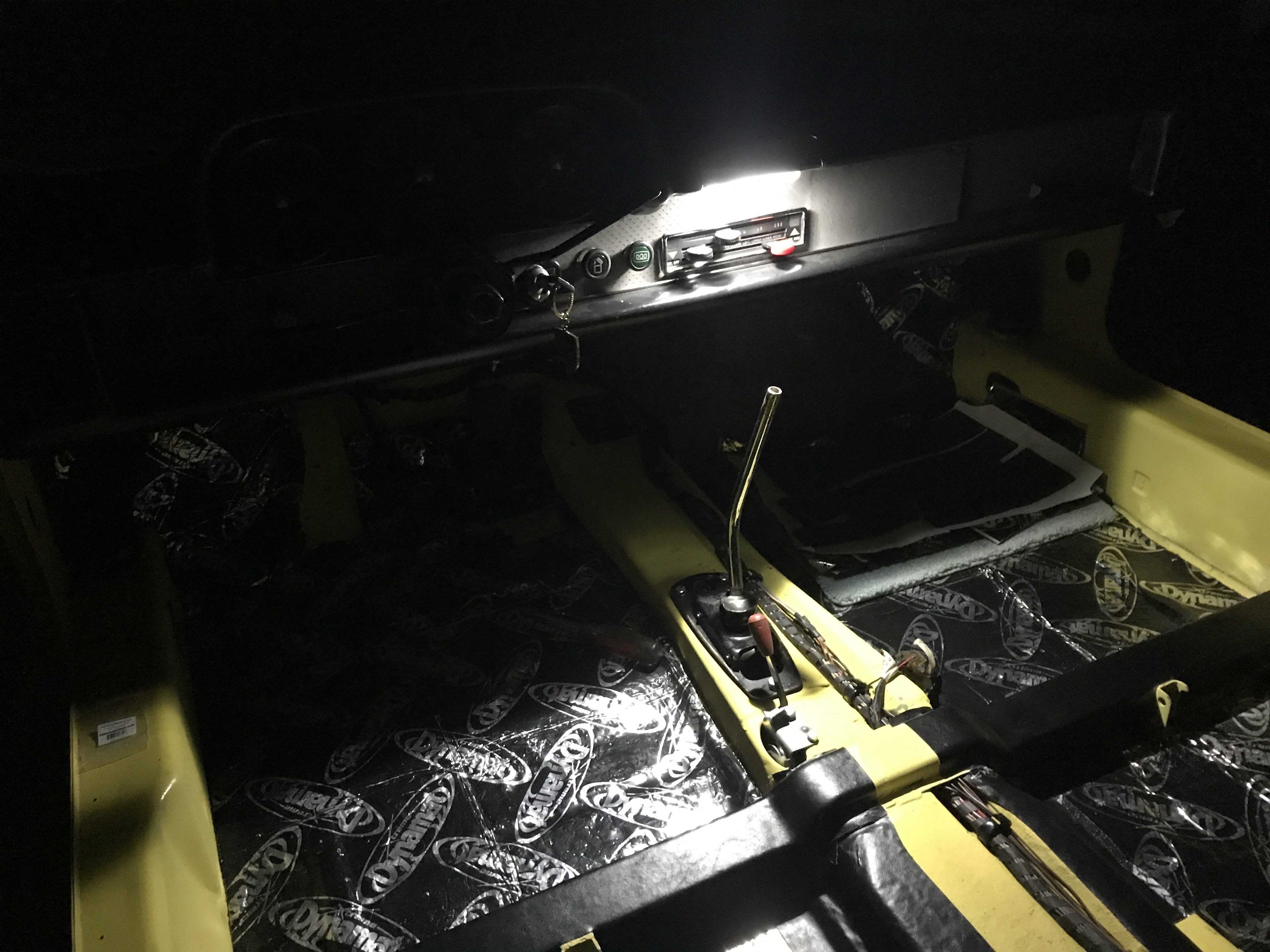

Yet another update on the ash tray light. I got the LED bulb today.
bkrantz
post Jun 14 2021, 07:14 PM
Post #2987
Posts: 8,800
Joined: 3-August 19
From: SW Colorado
Member No.: 23,343
Much whiter and brighter.

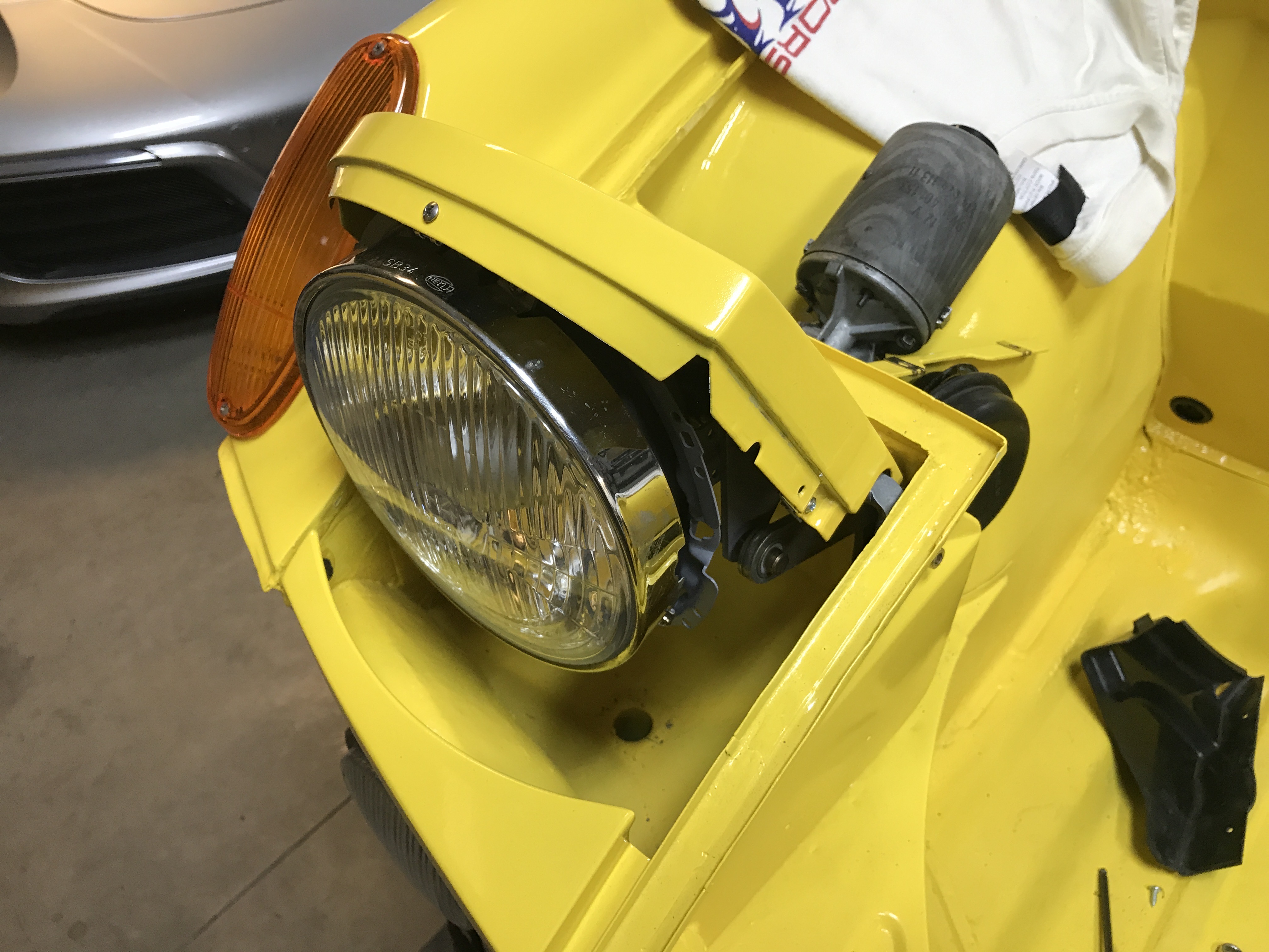

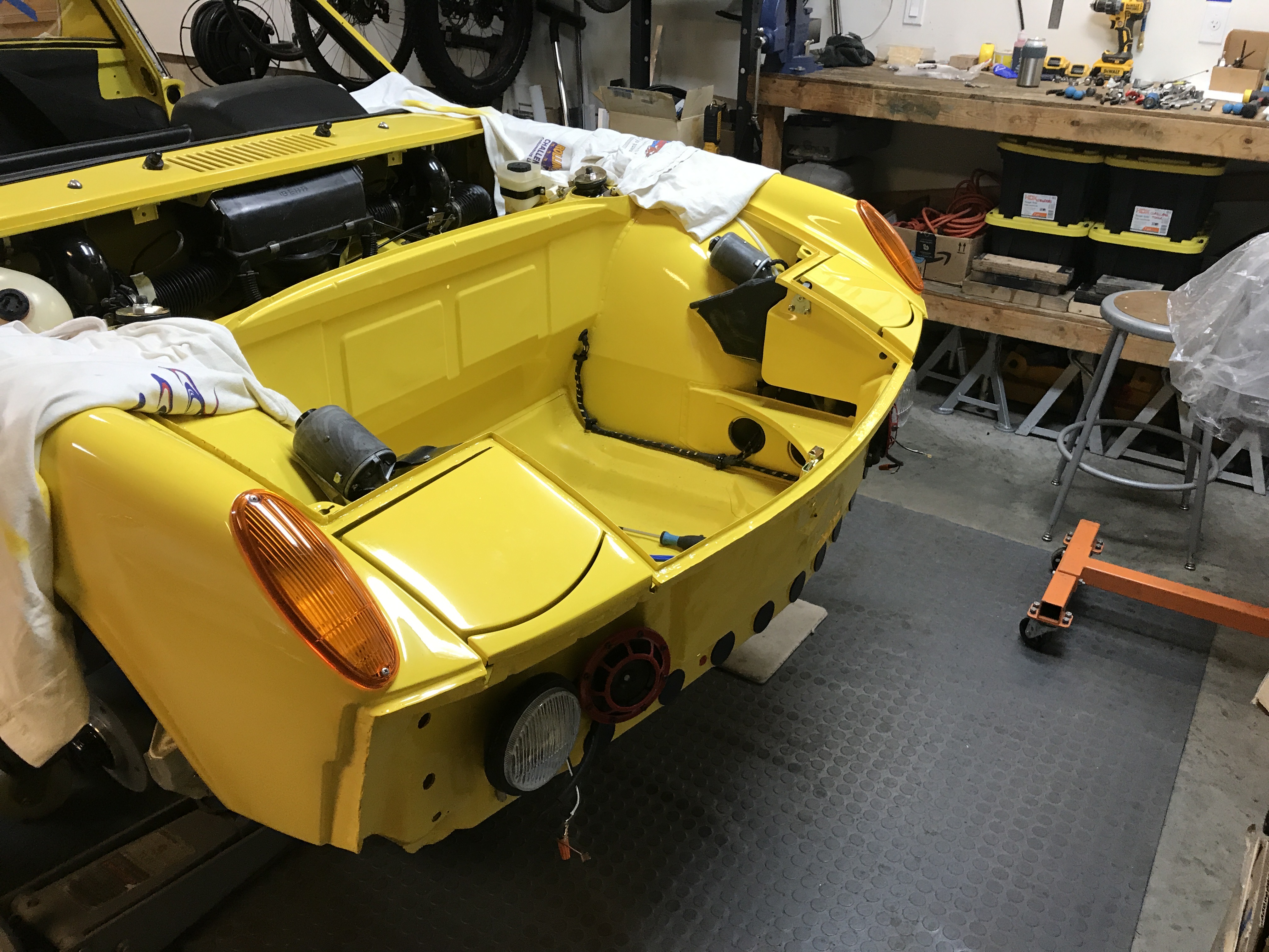

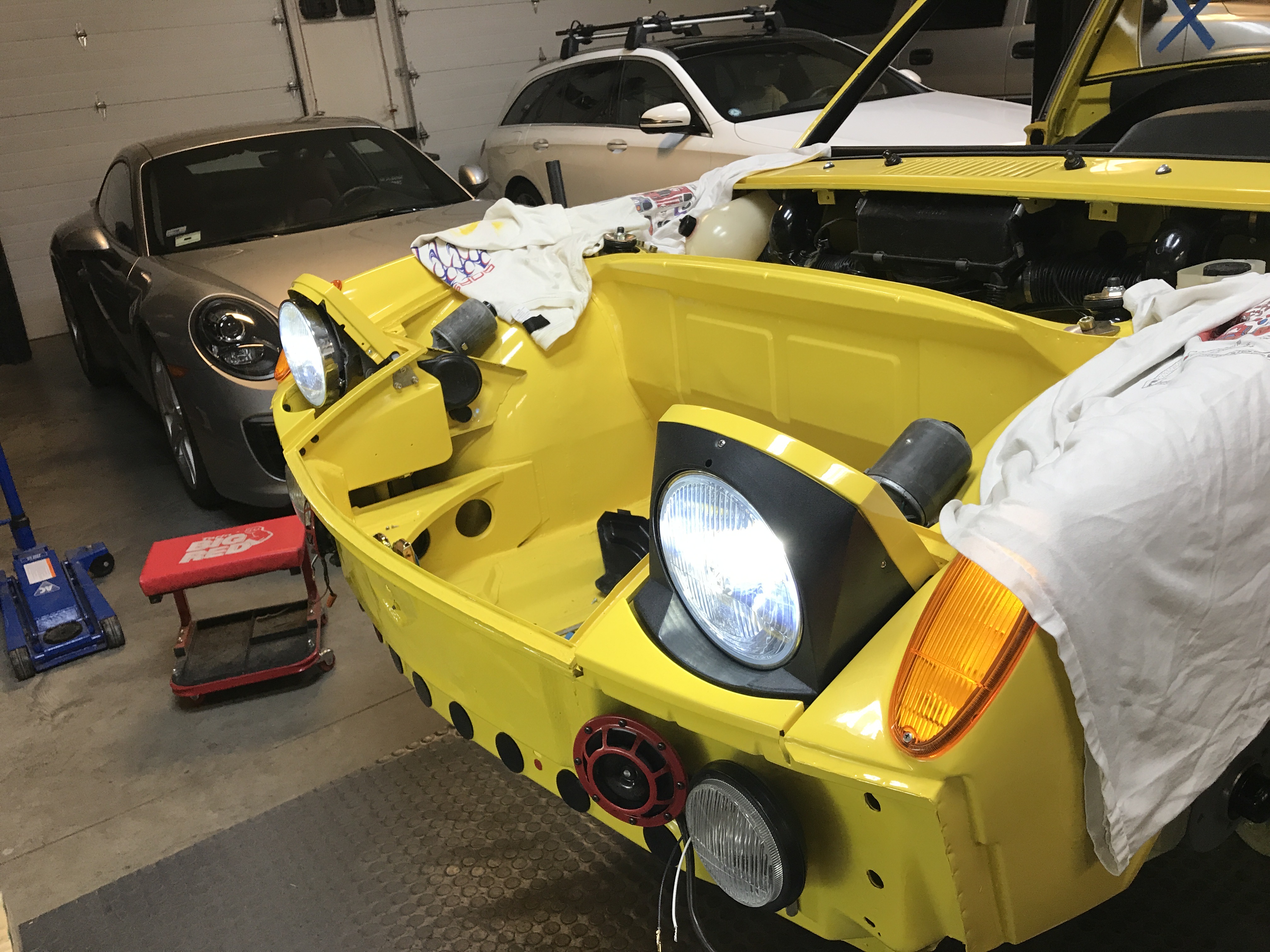

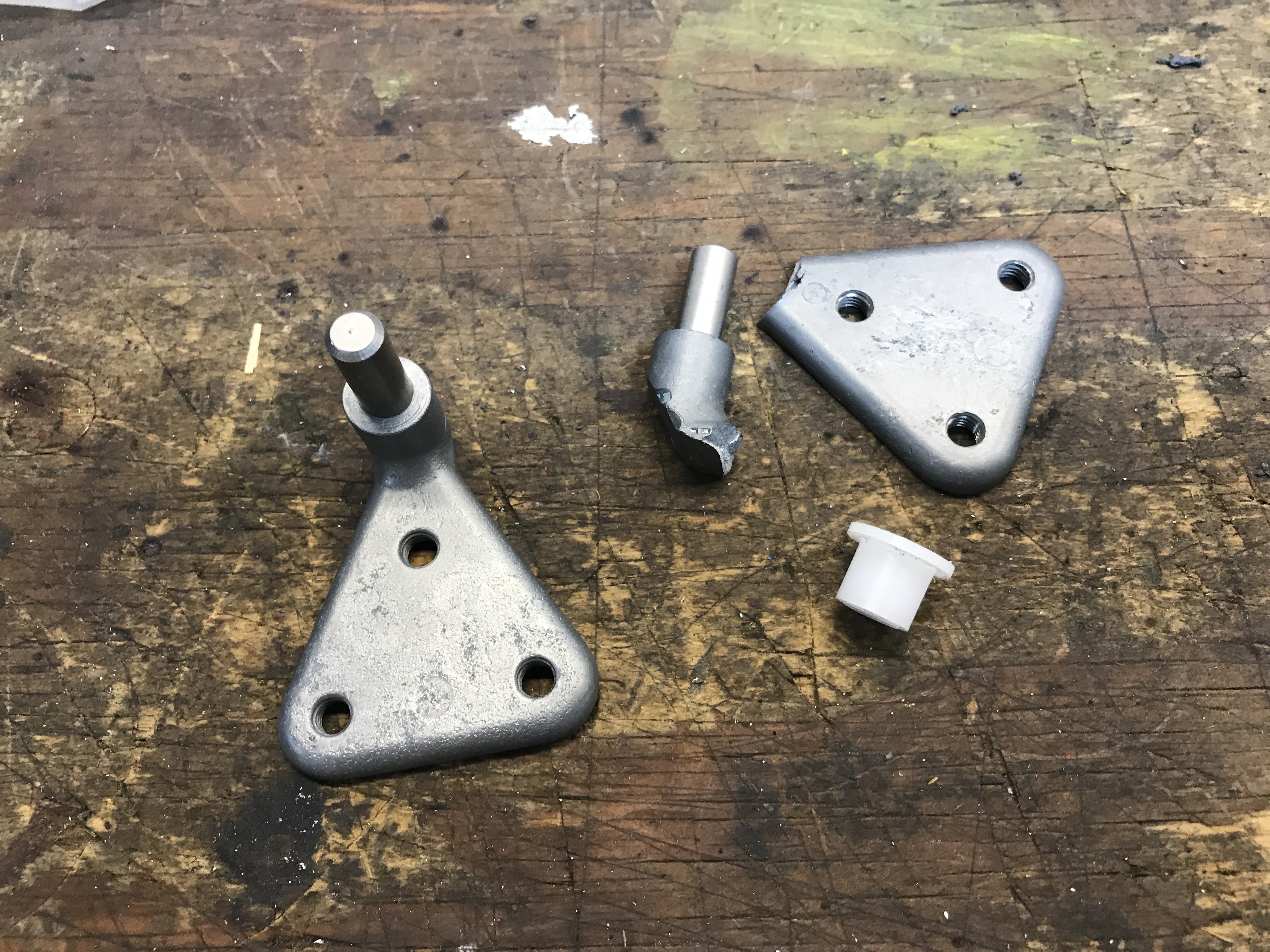

I also got the replacement headlight pivot, same as the one I broke when it shifted and the motor drive made the lid bind up.
bkrantz
post Jun 14 2021, 07:16 PM
Post #2989
Posts: 8,800
Joined: 3-August 19
From: SW Colorado
Member No.: 23,343
Got the pivot installed.
bkrantz
post Jun 14 2021, 07:17 PM
Post #2990
Posts: 8,800
Joined: 3-August 19
From: SW Colorado
Member No.: 23,343
Yay, both headlights now go up.
bkrantz
post Jun 14 2021, 07:18 PM
Post #2991
Posts: 8,800
Joined: 3-August 19
From: SW Colorado
Member No.: 23,343
And down.

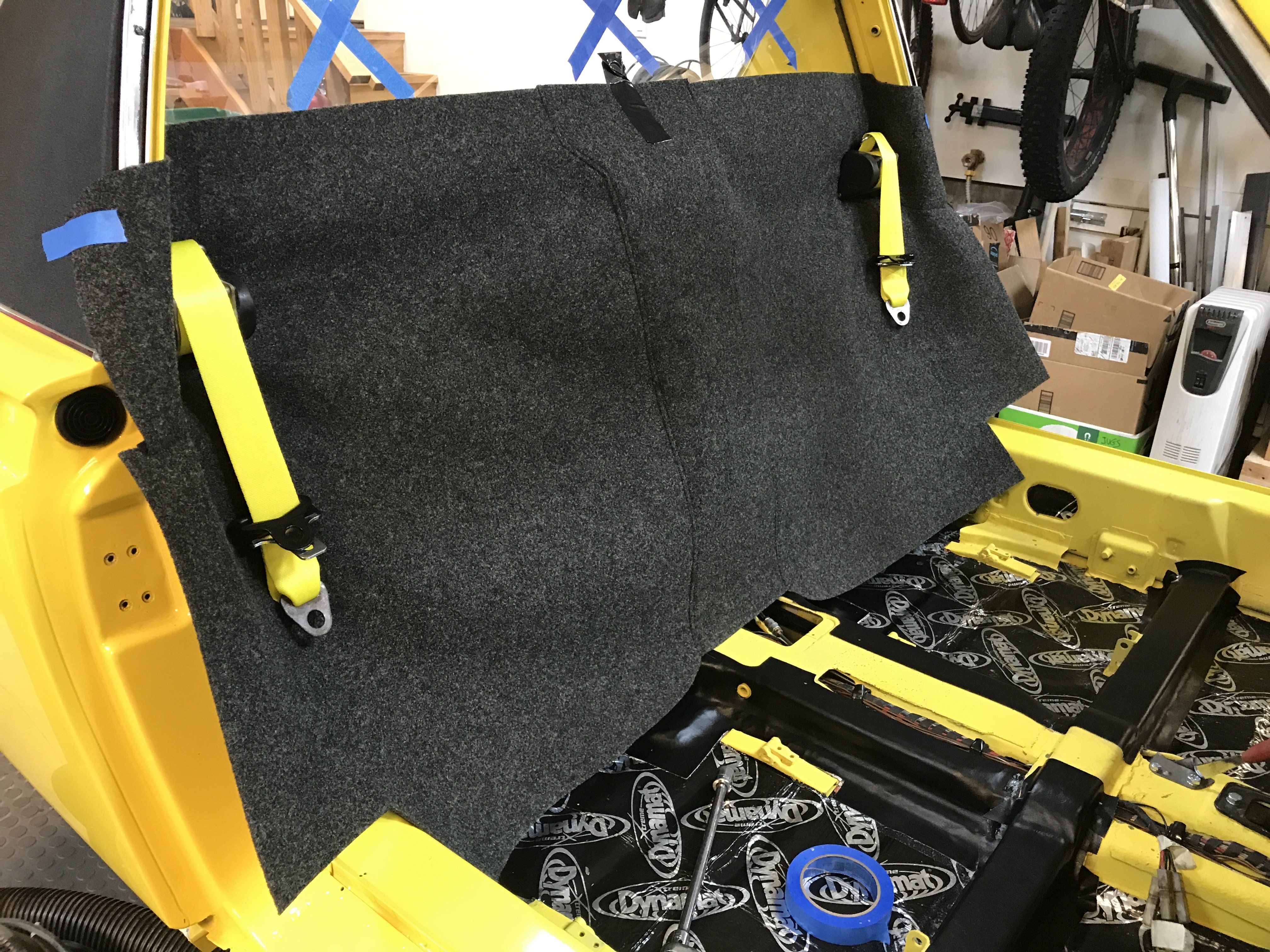

I also started fitting the perlon bulkhead cover.
bkrantz
post Jun 14 2021, 07:26 PM
Post #2993
Posts: 8,800
Joined: 3-August 19
From: SW Colorado
Member No.: 23,343

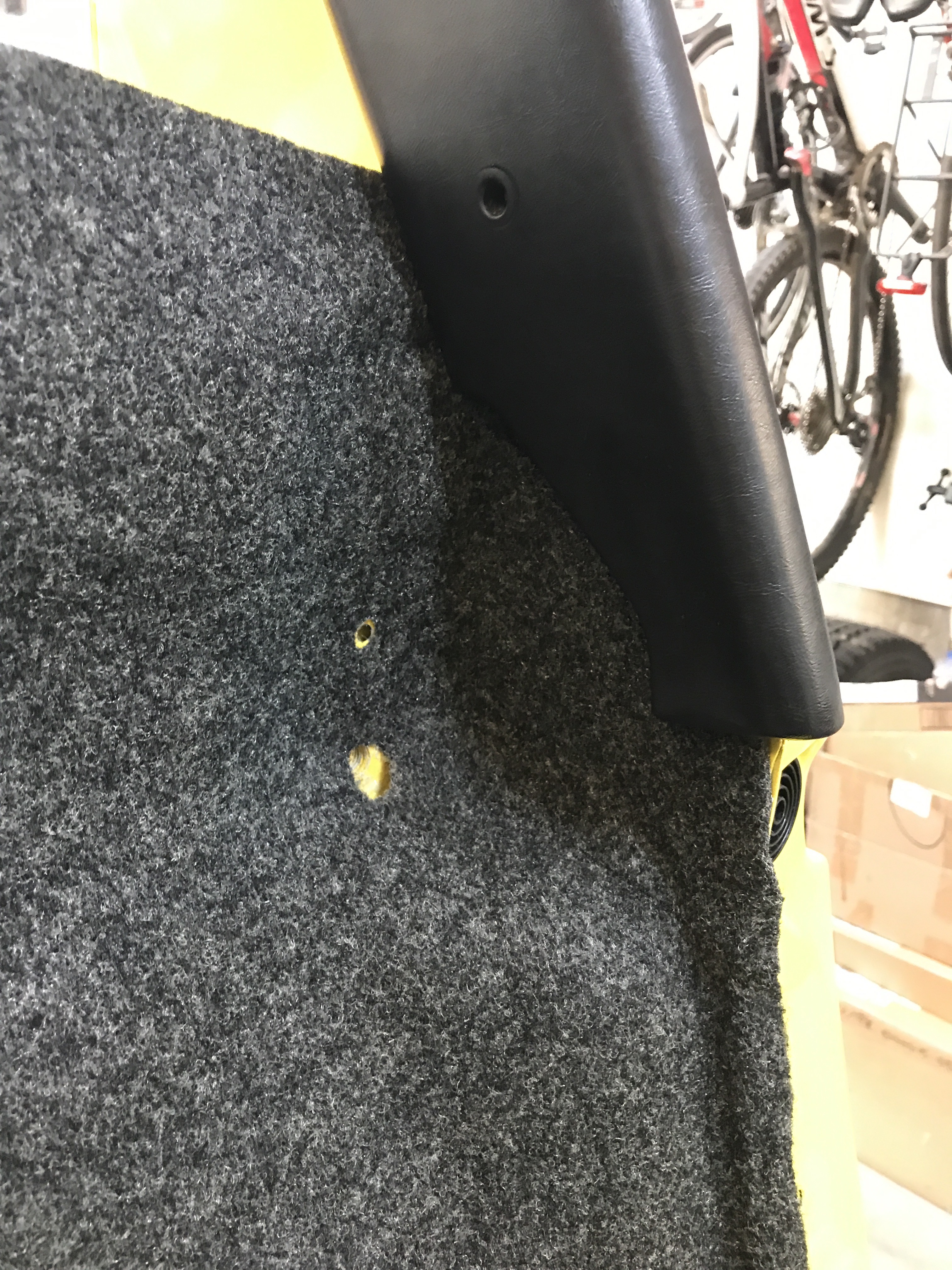

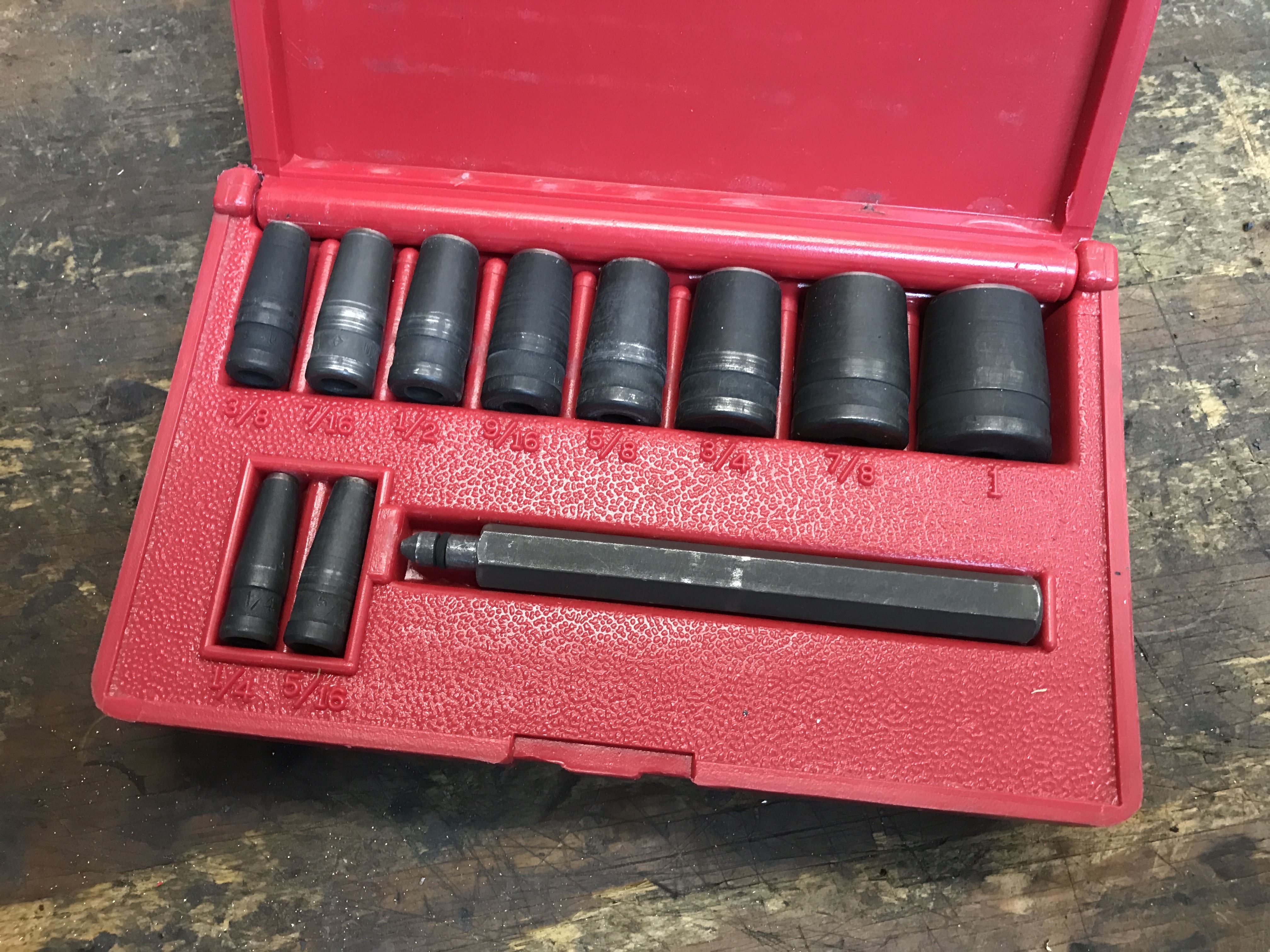

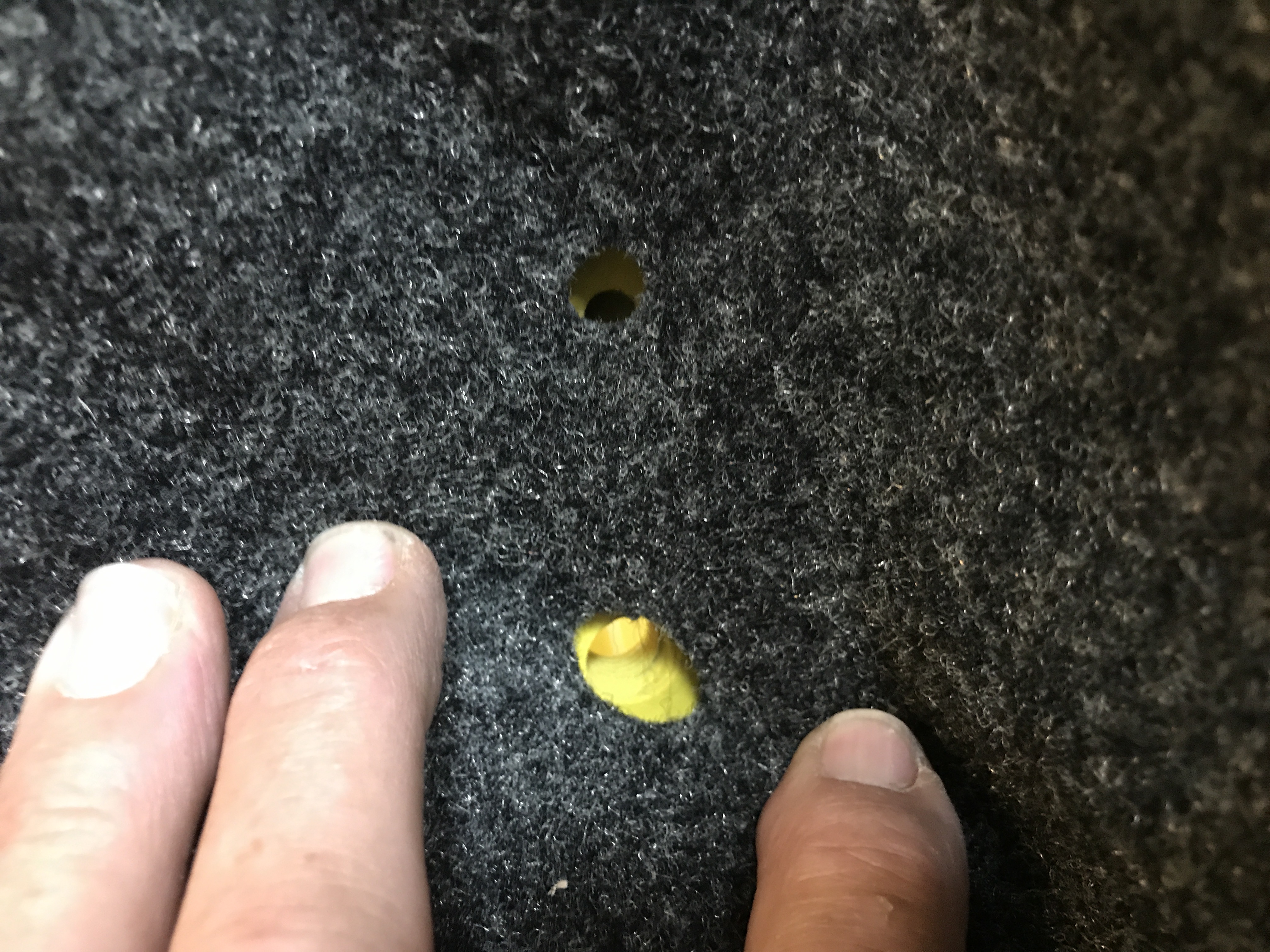

To mount the seat belt reels I needed some holes, and got out my trusty punch kit.
bkrantz
post Jun 14 2021, 07:27 PM
Post #2994
Posts: 8,800
Joined: 3-August 19
From: SW Colorado
Member No.: 23,343
Two different size holes, for the reel pin and the bolt.
bkrantz
post Jun 14 2021, 07:30 PM
Post #2995
Posts: 8,800
Joined: 3-August 19
From: SW Colorado
Member No.: 23,343

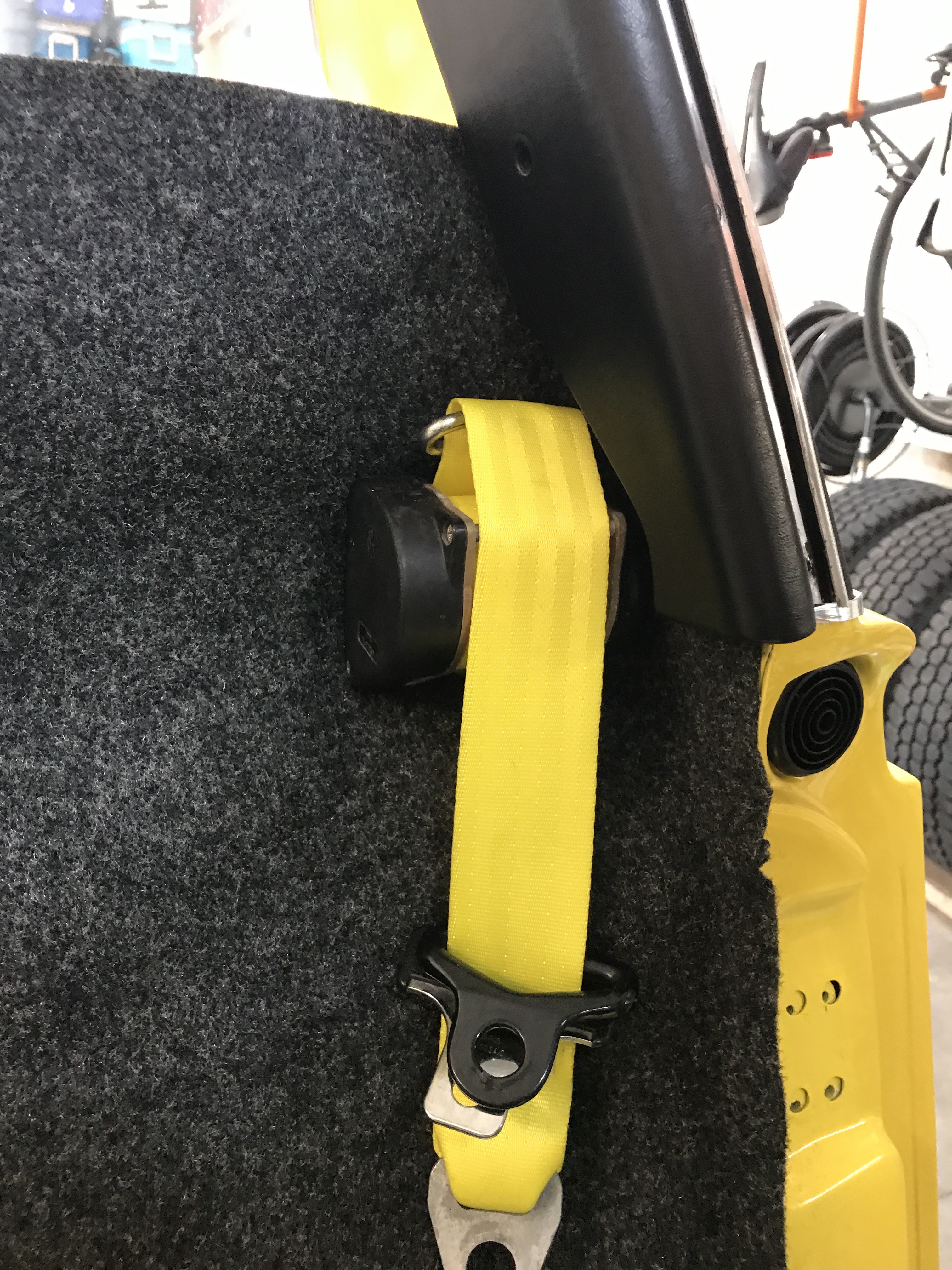

Both reels belted in place. The fit looks pretty good, maybe a bit high. And it will take some stretching to get it properly mounted.

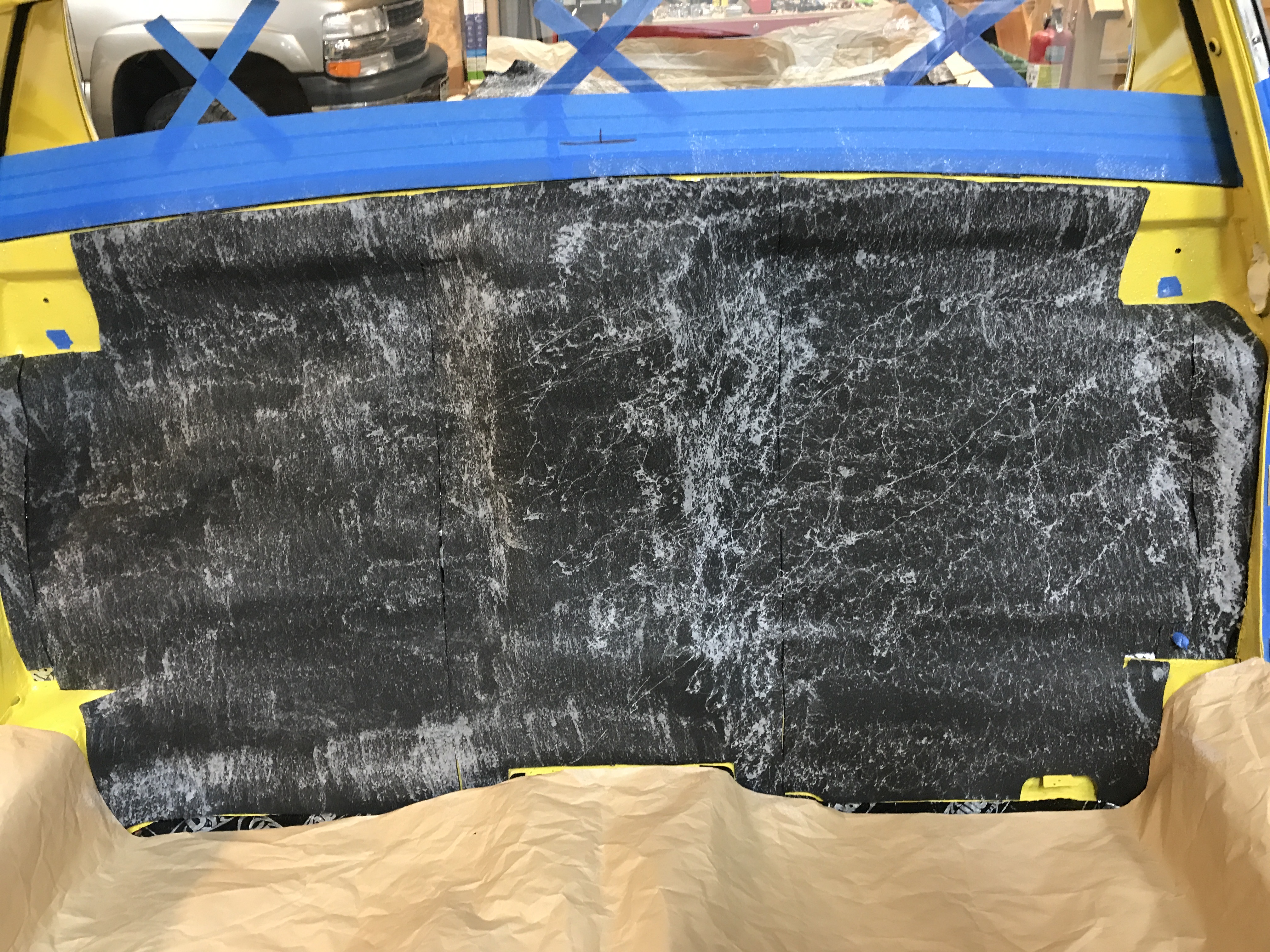

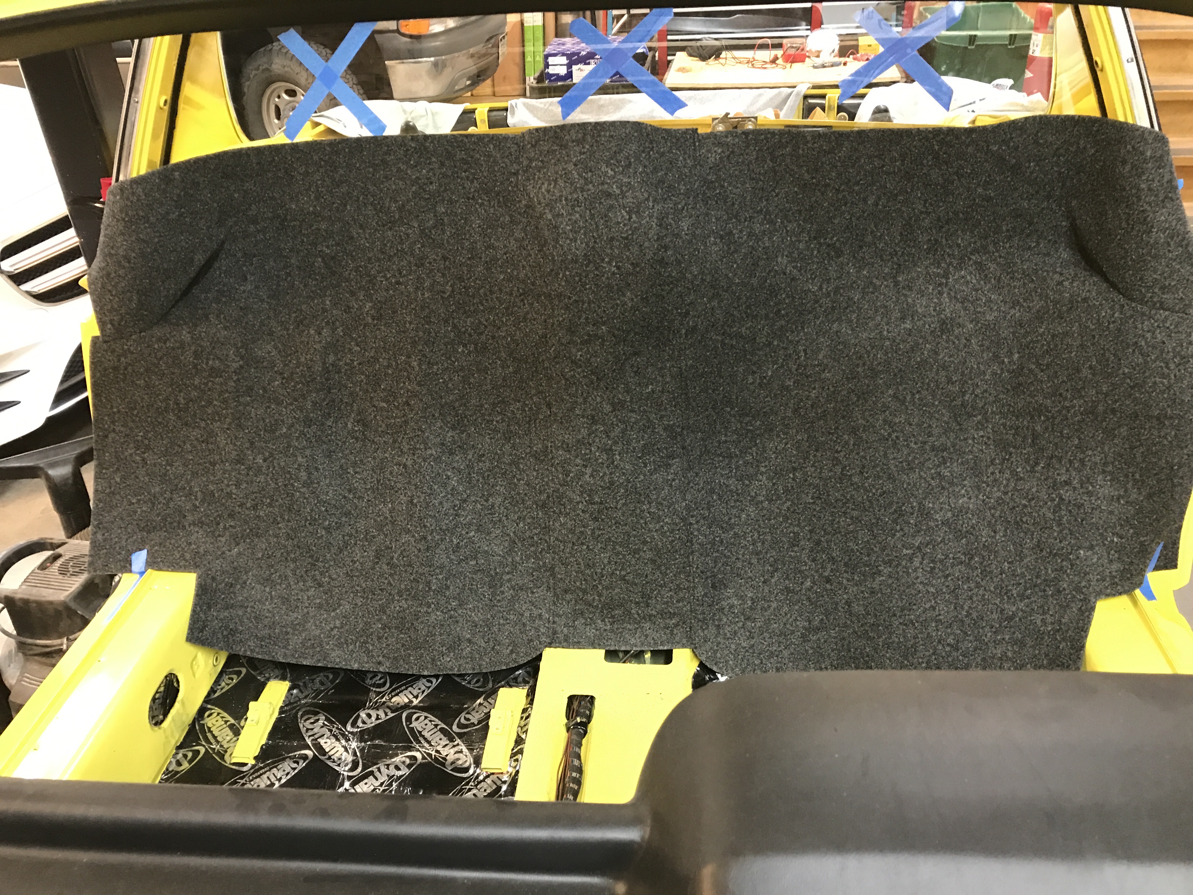

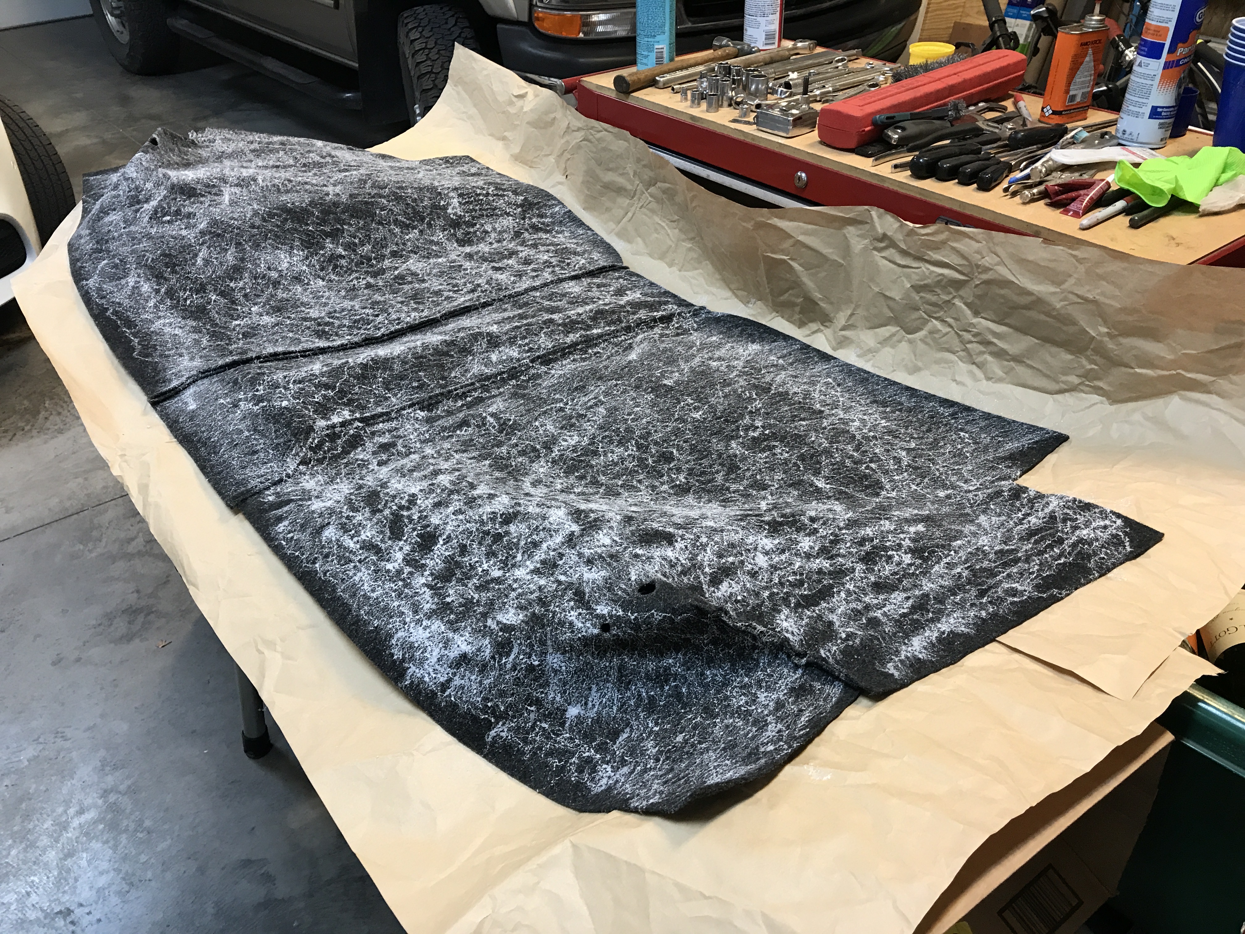

Today, I mounted the custom cover, starting with masking off and spraying adhesive. Note: it took a second coat to get good stick.
bkrantz
post Jun 15 2021, 06:56 PM
Post #2997
Posts: 8,800
Joined: 3-August 19
From: SW Colorado
Member No.: 23,343
Also two coats on the back of the perlon.
bkrantz
post Jun 15 2021, 06:58 PM
Post #2998
Posts: 8,800
Joined: 3-August 19
From: SW Colorado
Member No.: 23,343

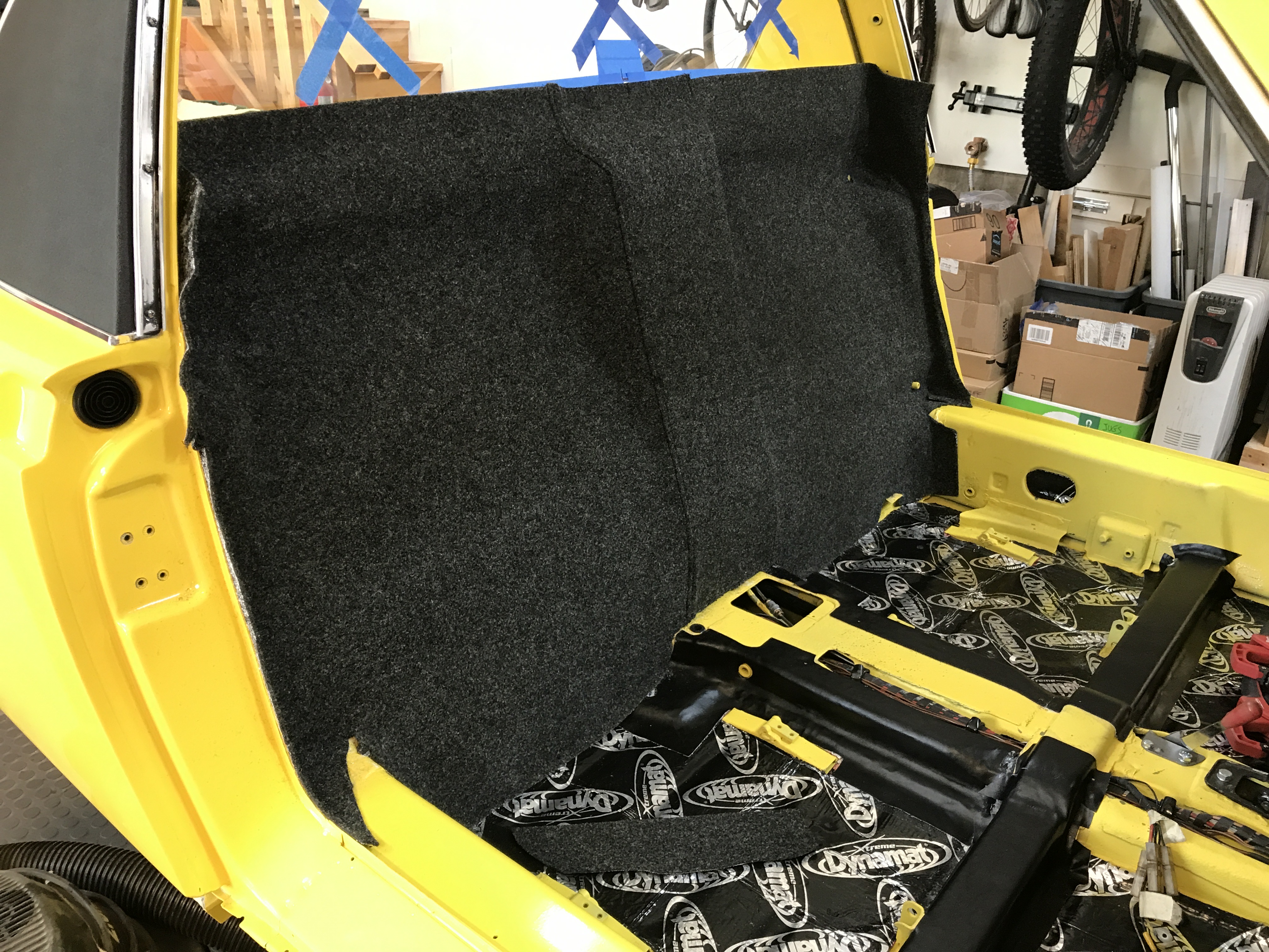

Here's the cover, glued on.
bkrantz
post Jun 15 2021, 07:00 PM
Post #2999
Posts: 8,800
Joined: 3-August 19
From: SW Colorado
Member No.: 23,343
The perlon covers the inside of the B-pillar, including the vent to the door jamb. I think the material is breathable enough so I will not cut an opening and then look for a grill.
bkrantz
post Jun 15 2021, 07:01 PM
Post #3000
Posts: 8,800
Joined: 3-August 19
From: SW Colorado
Member No.: 23,343
Seat belt reel in place.
