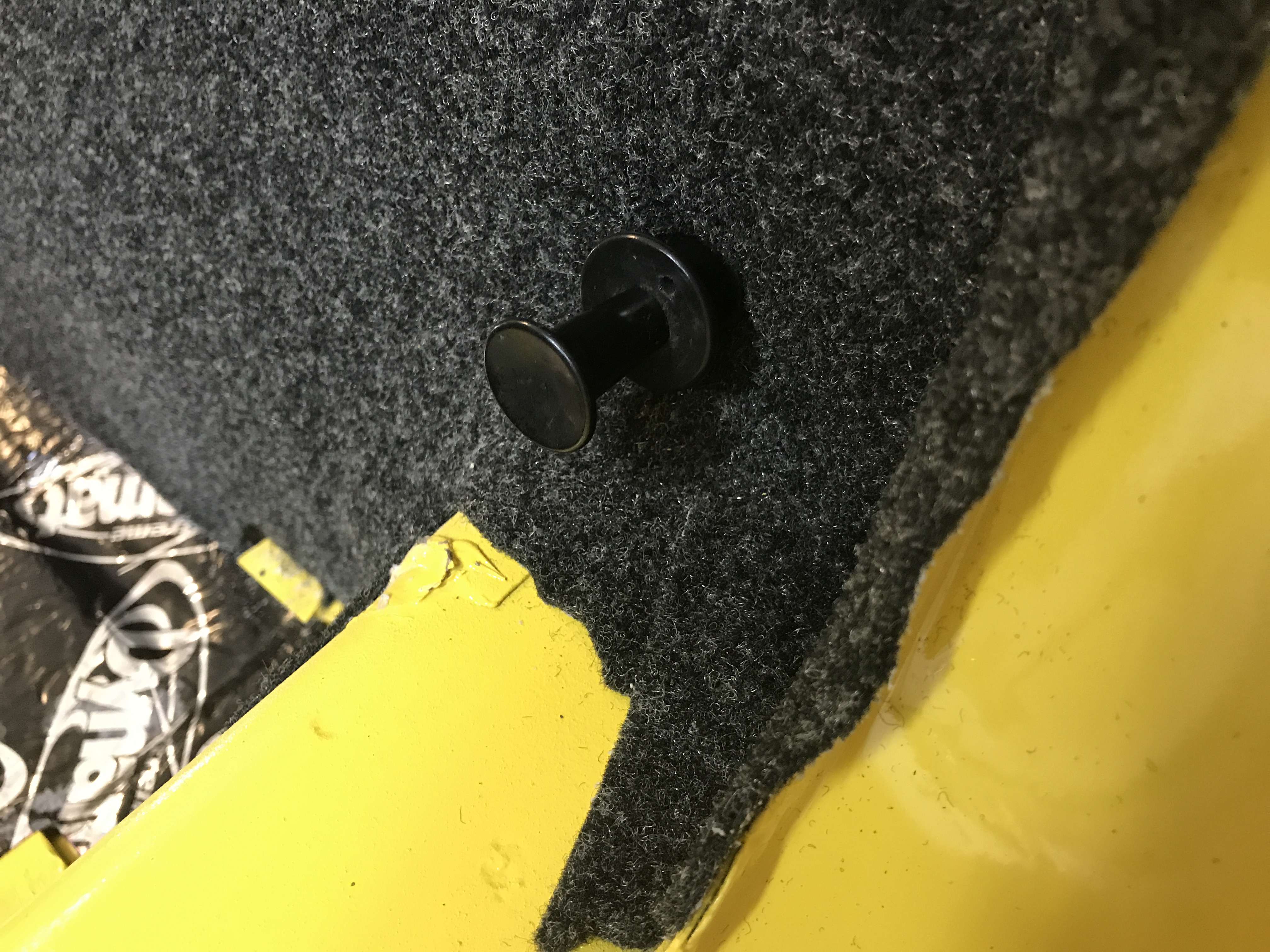

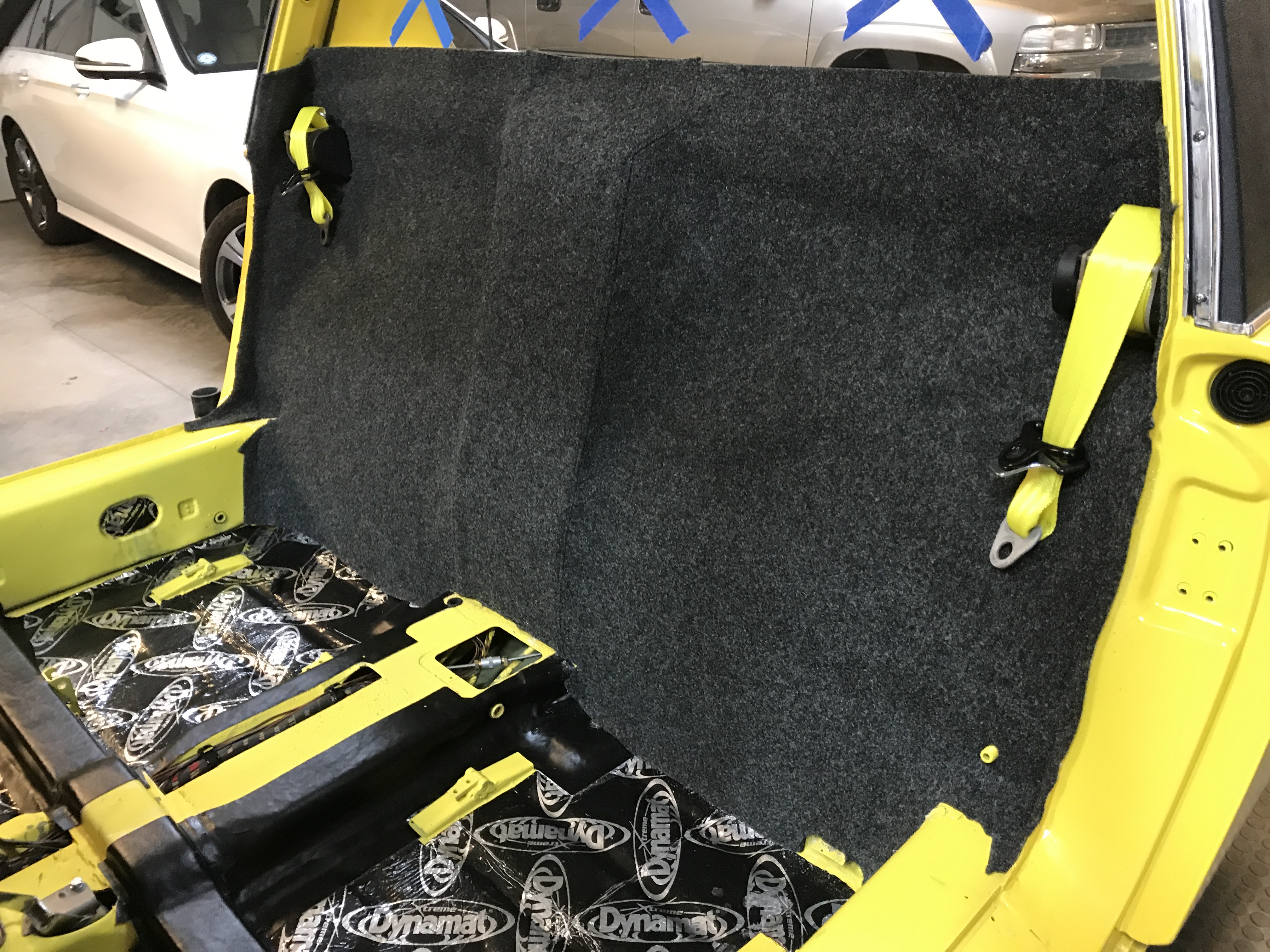

Here's the overall look. I like it.
I will finish the top edge. My first idea is a plastic U-channel, on order.

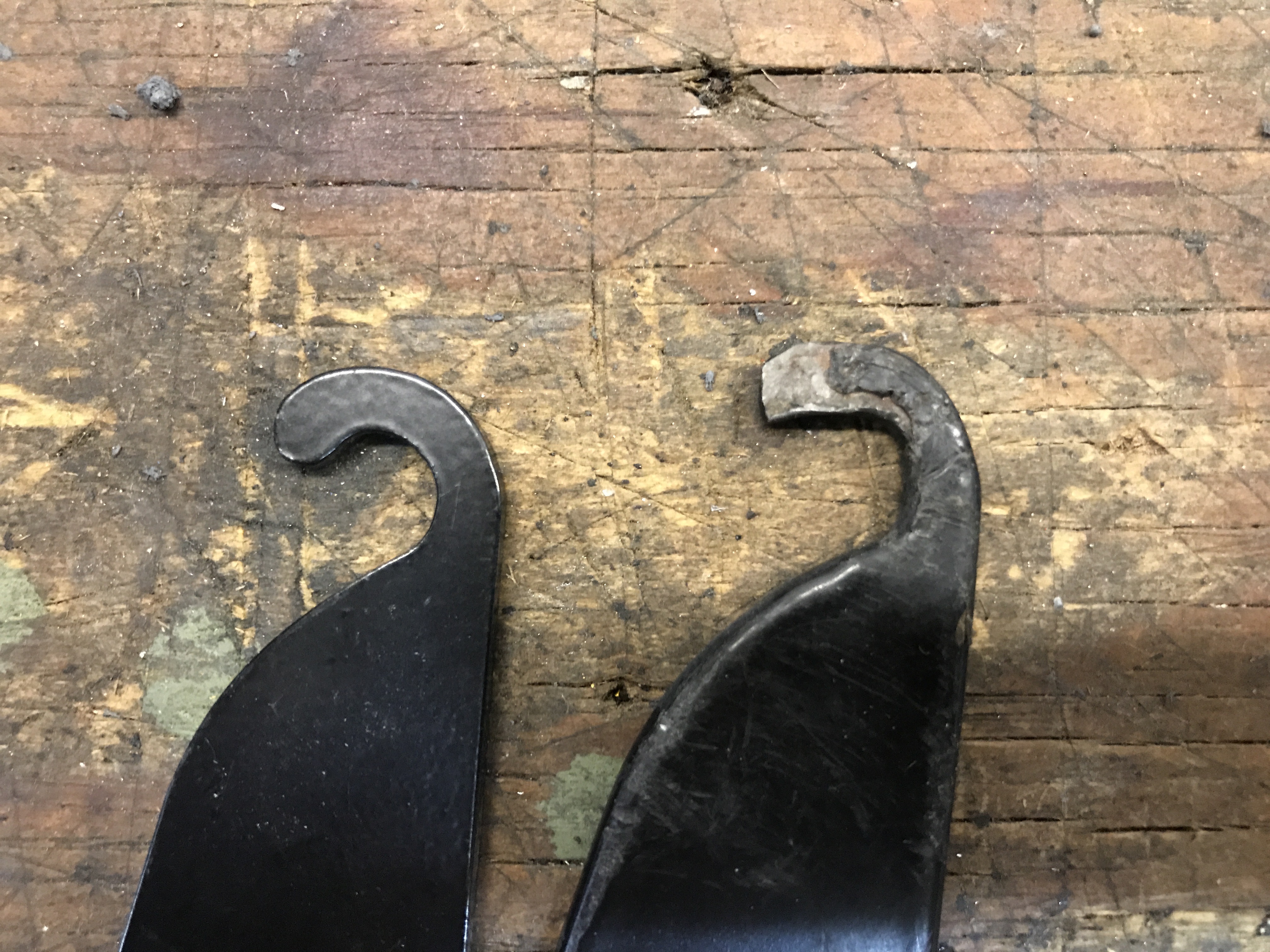

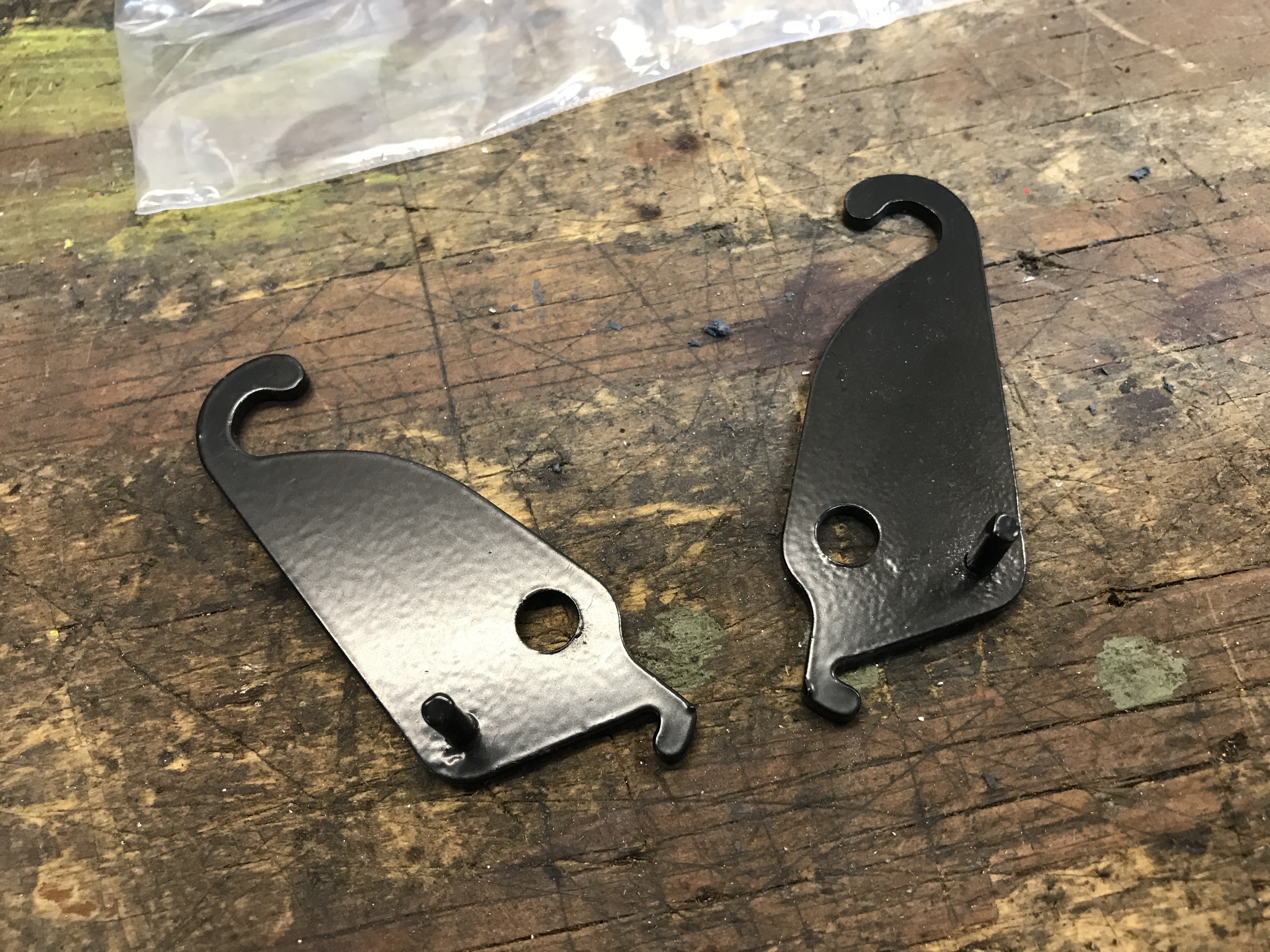

I also got replacement targa latch hooks, from AA.
bkrantz
post Jun 15 2021, 07:05 PM
Post #3003
Posts: 8,800
Joined: 3-August 19
From: SW Colorado
Member No.: 23,343
Compared to the worn original.

QUOTE(bkrantz @ Jun 15 2021, 06:02 PM) *
That does look good Bob.
Likely should have done something this on my build.
Were my aftermarket GTS Classic seats fit into the cutouts in the factory firewall upholstery piece, they rub and squeak like crazy.
This setup would have nixed that.
Nice!
Yeah and those new targa latch hooks look immensely better.
Sometimes parts on these old cars are irretrievably worn out.
bkrantz
post Jun 16 2021, 06:50 PM
Post #3005
Posts: 8,800
Joined: 3-August 19
From: SW Colorado
Member No.: 23,343
QUOTE(raynekat @ Jun 16 2021, 04:35 PM) *
Nice!
Thanks, Doug. I think the perlon cover makes the interior look a bit bigger and more modern--and less of a sea of black vinyl.

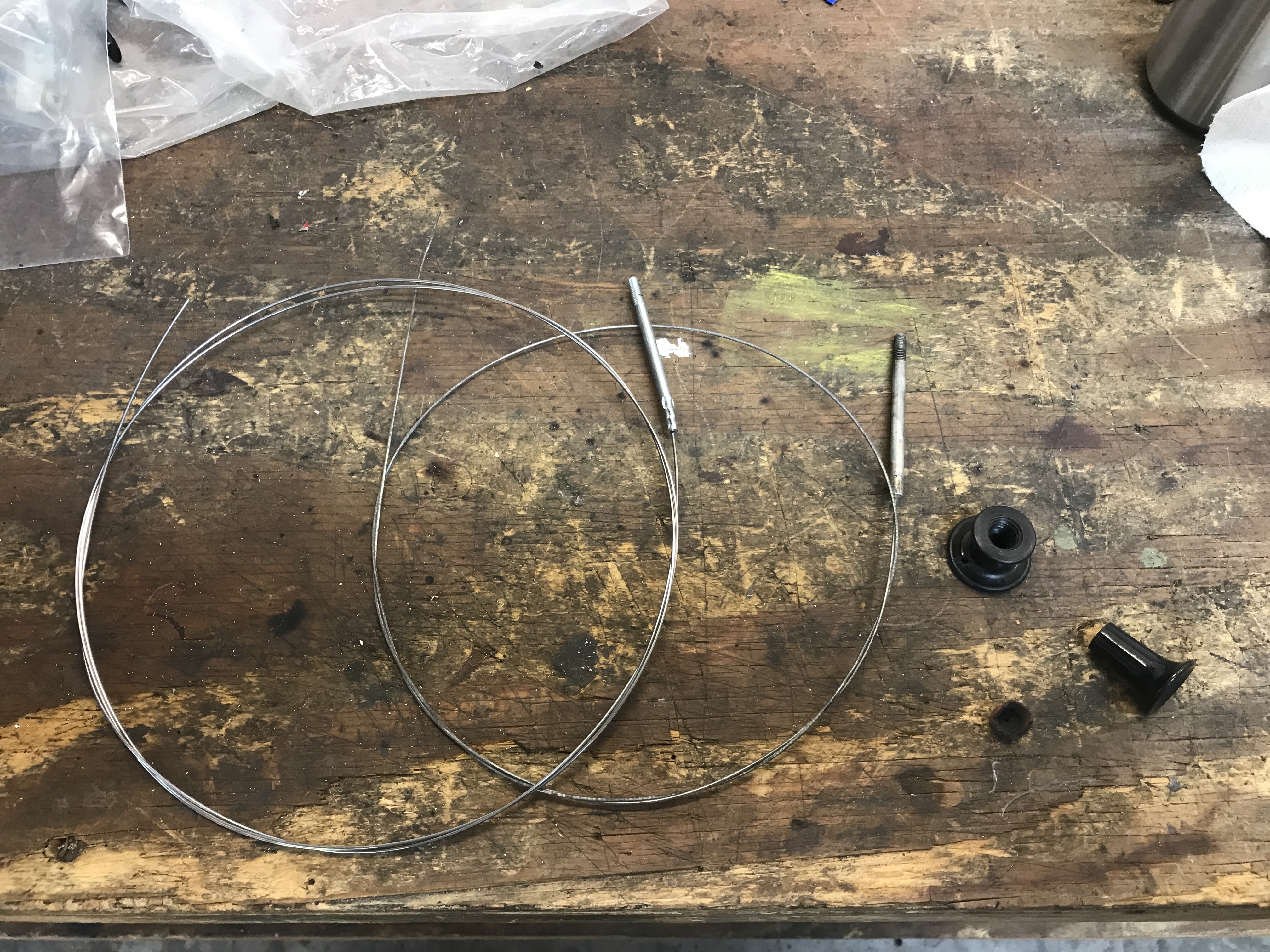

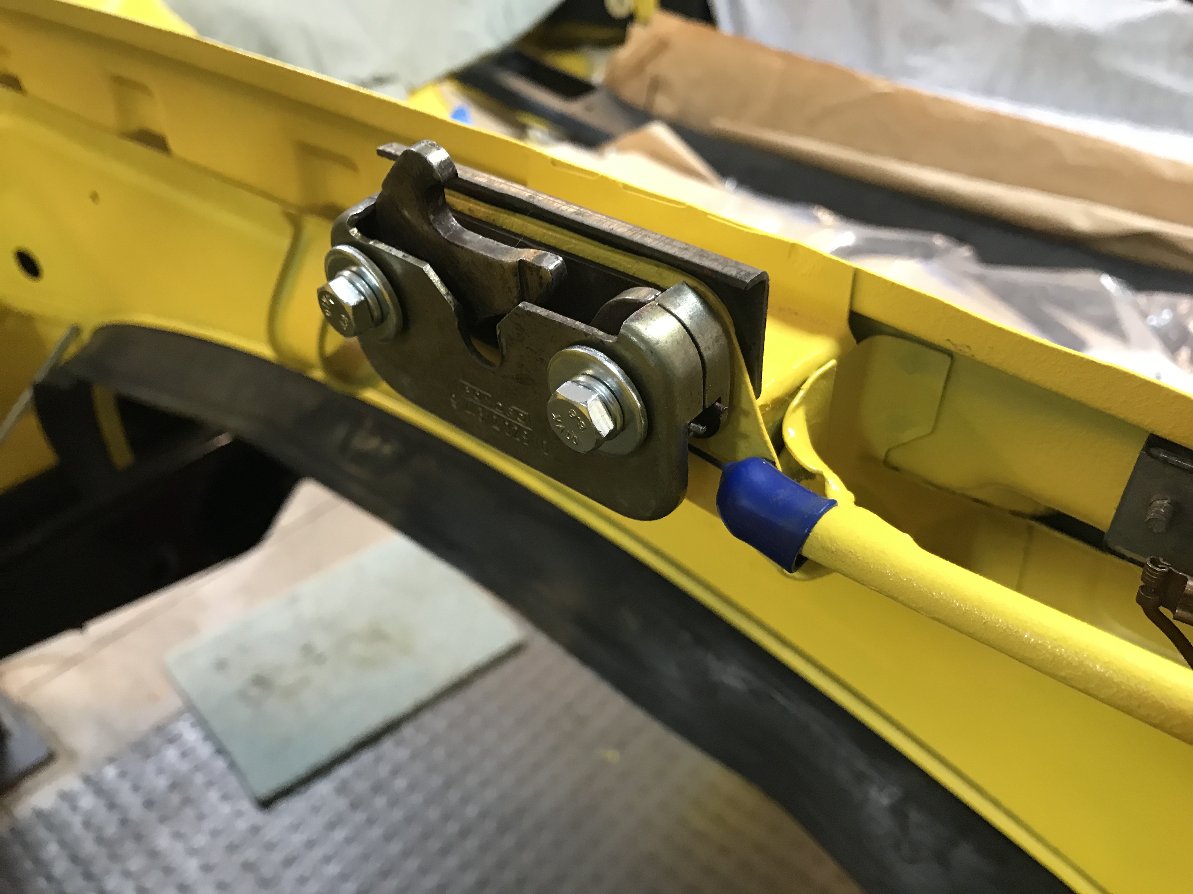

With the perlon cover in place, I got out the engine lid cable.
bkrantz
post Jun 16 2021, 06:59 PM
Post #3007
Posts: 8,800
Joined: 3-August 19
From: SW Colorado
Member No.: 23,343
Connected to the latch, with a home-made substitute to cover the open tube.

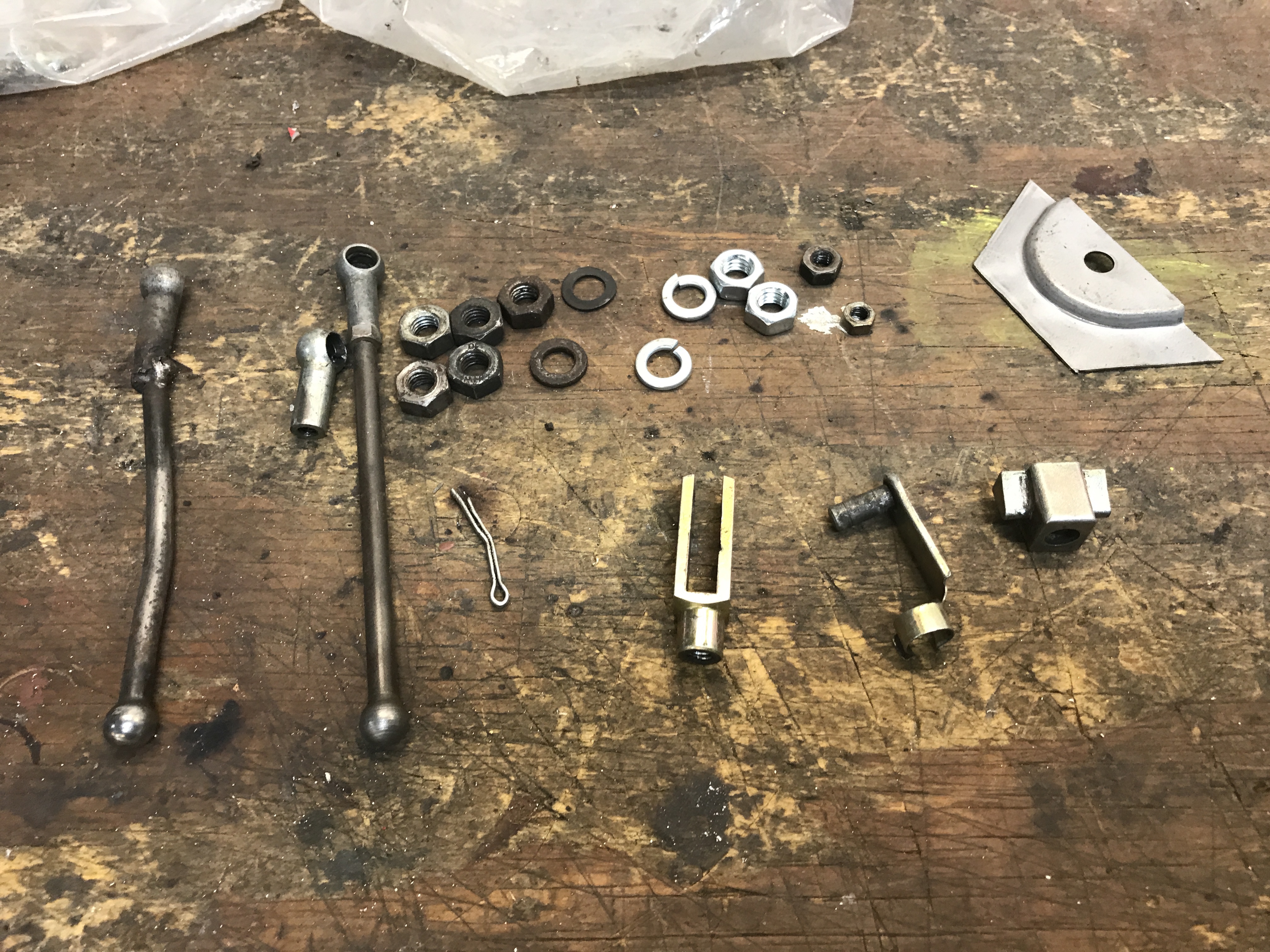

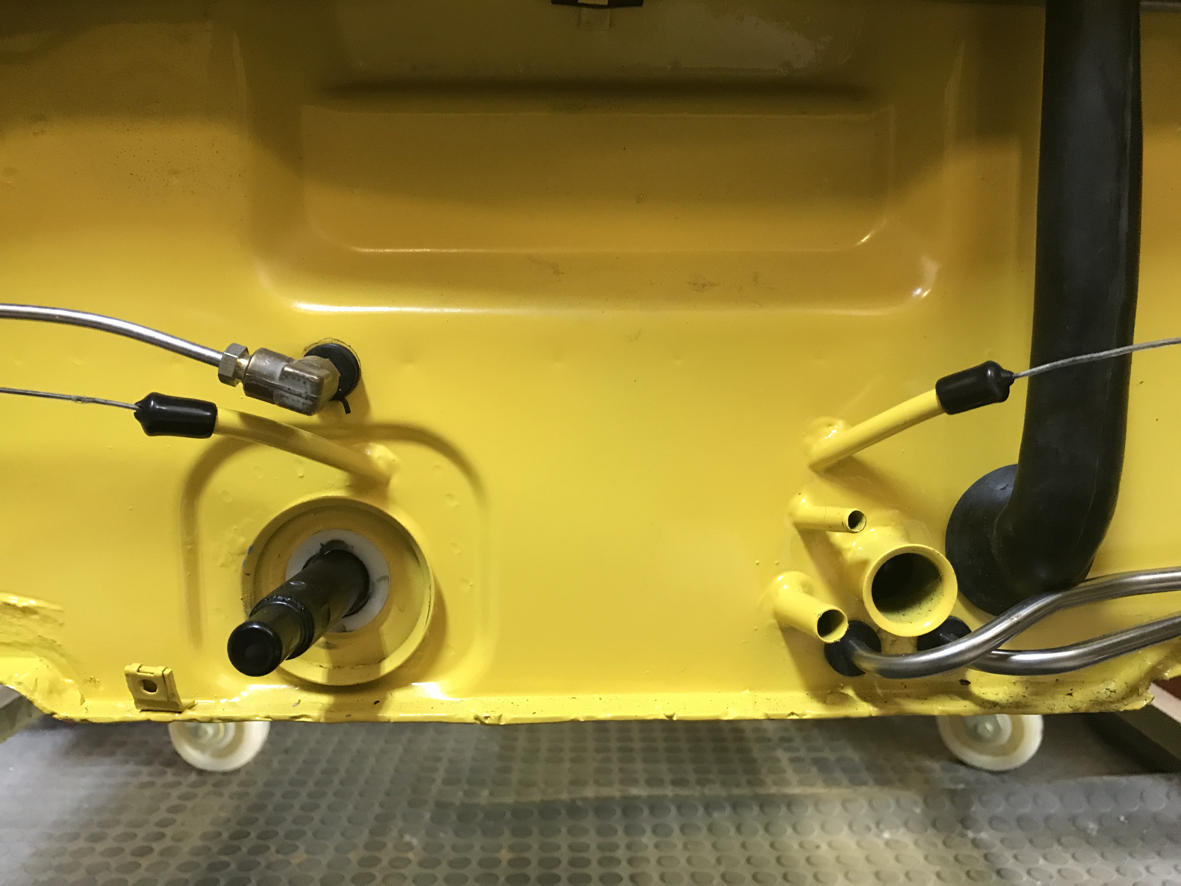

Before installing carpet, I wanted to finish everything else inside, including the control cables. So I got out the bag of hardware. The wobbly connecting rod is the one I took off the car, the other is a replacement.
bkrantz
post Jun 16 2021, 07:11 PM
Post #3011
Posts: 8,800
Joined: 3-August 19
From: SW Colorado
Member No.: 23,343

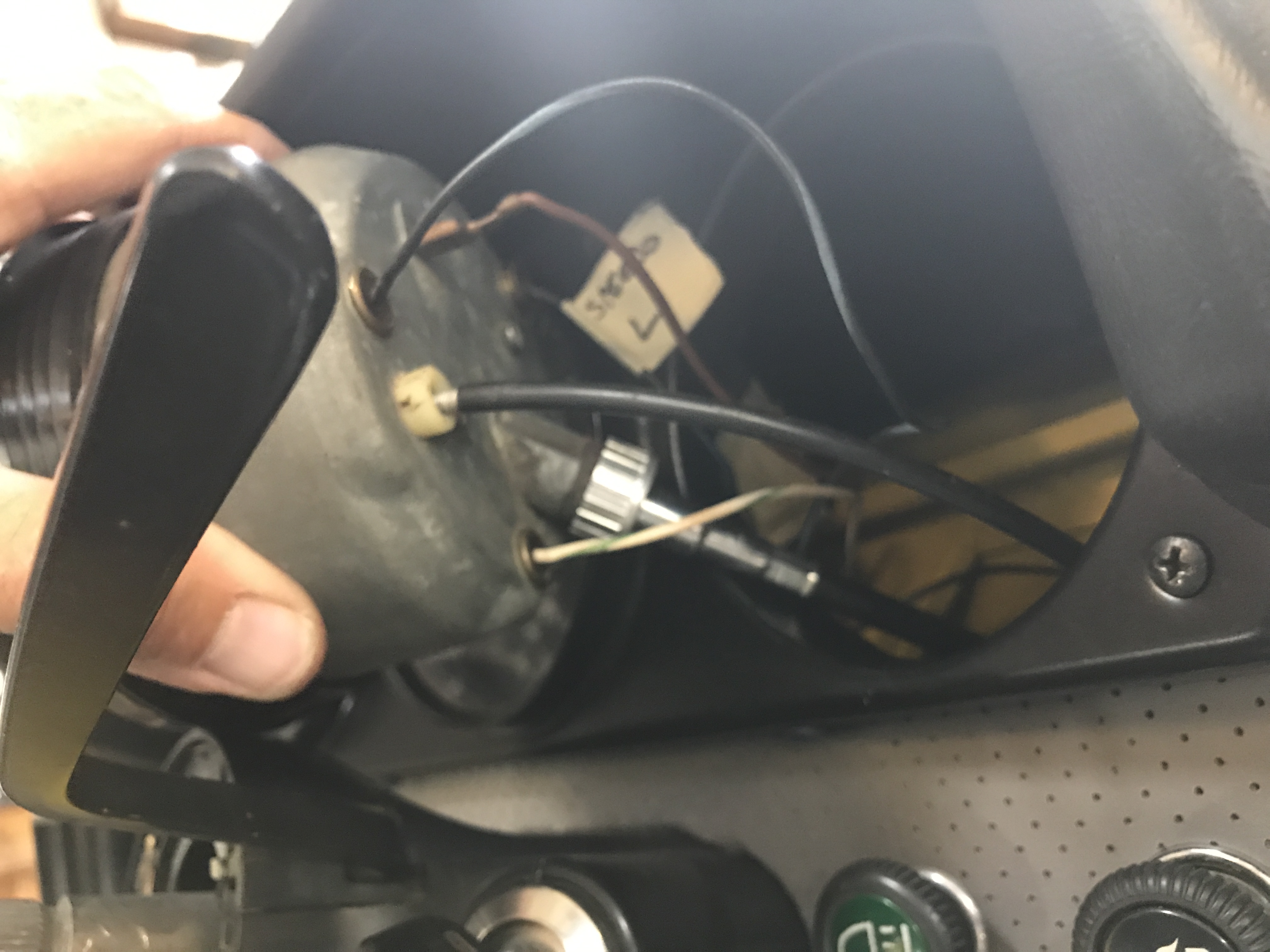

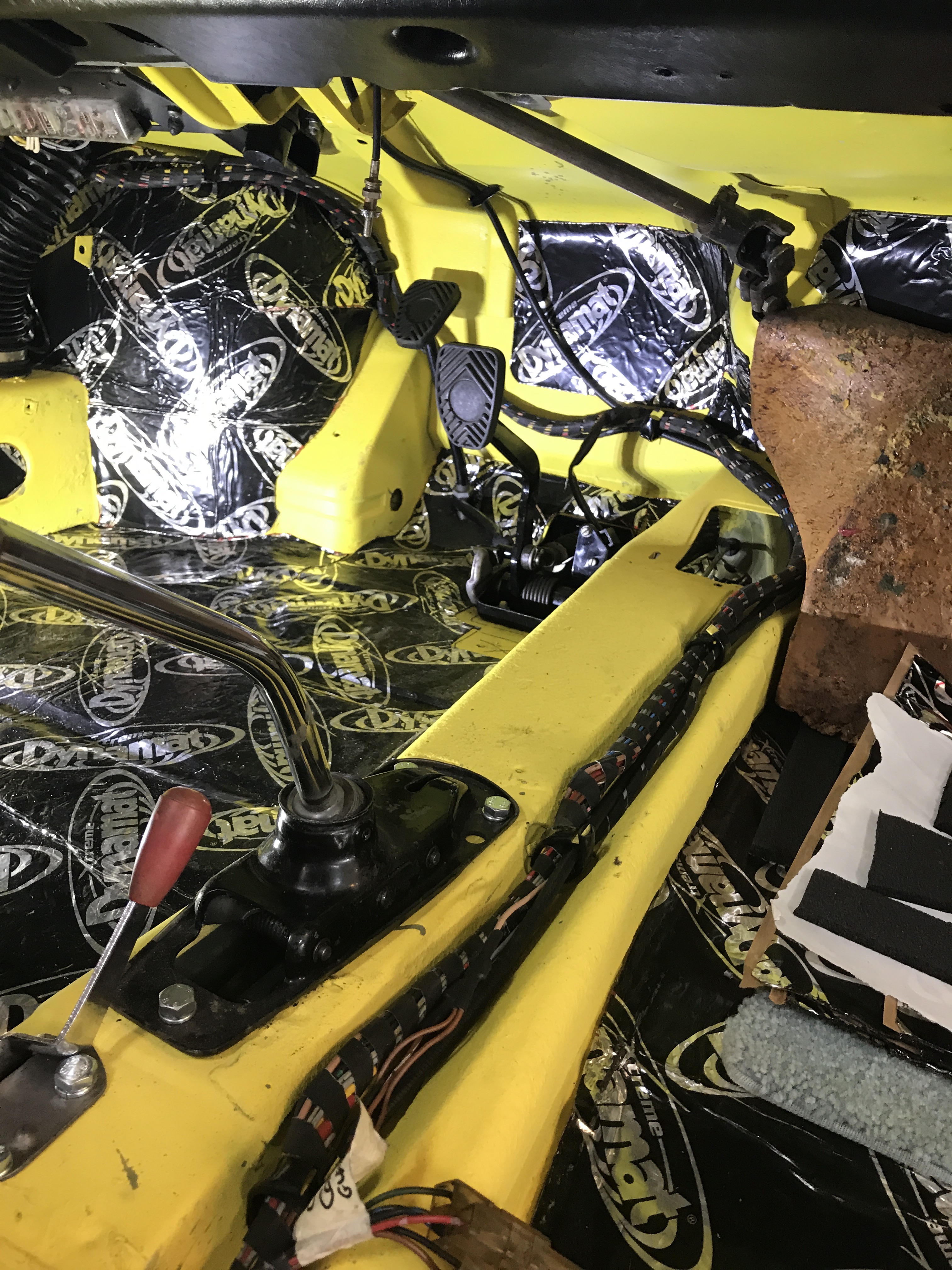

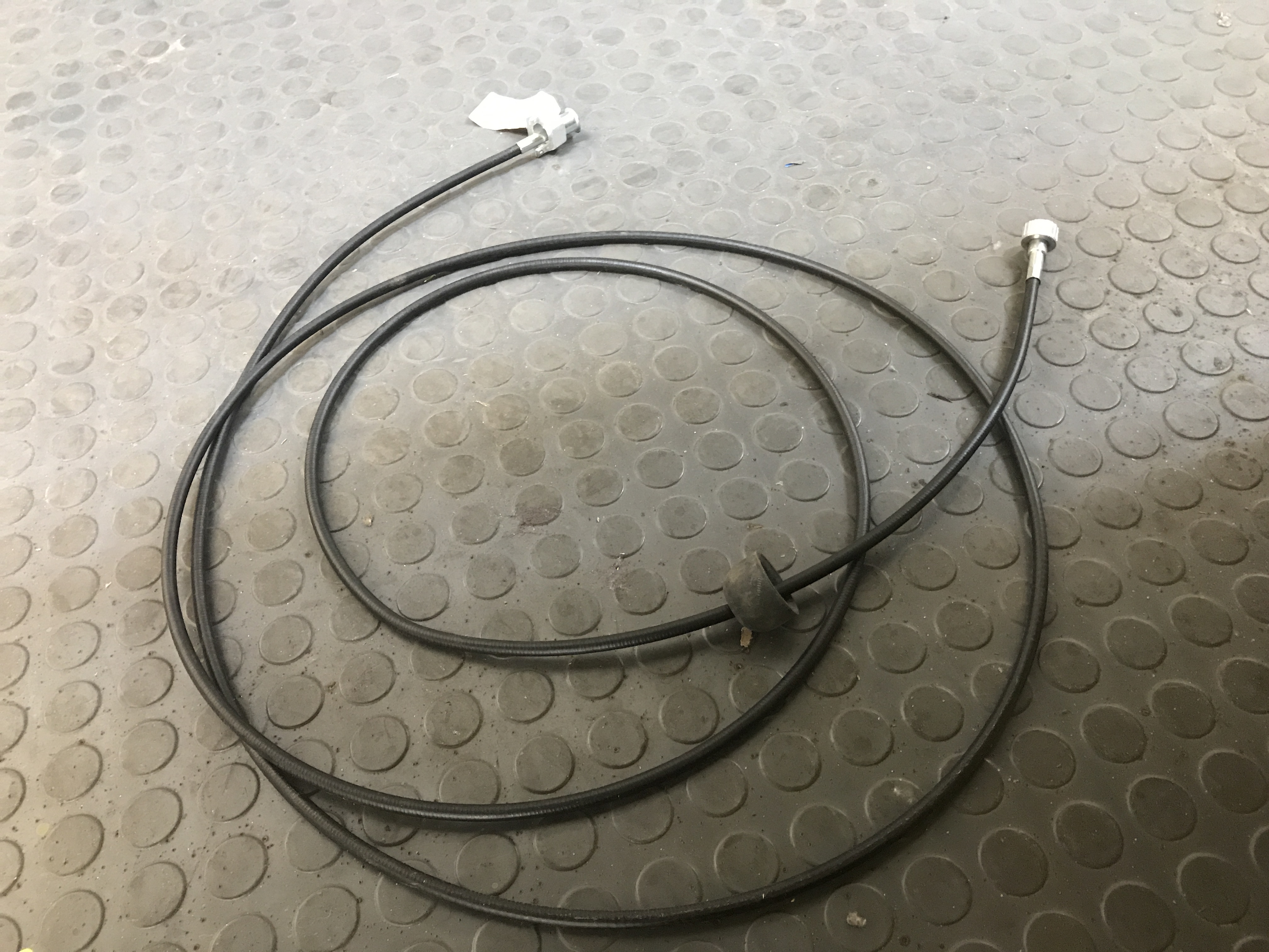

I started with the speedometer cable.
bkrantz
post Jun 16 2021, 07:12 PM
Post #3012
Posts: 8,800
Joined: 3-August 19
From: SW Colorado
Member No.: 23,343

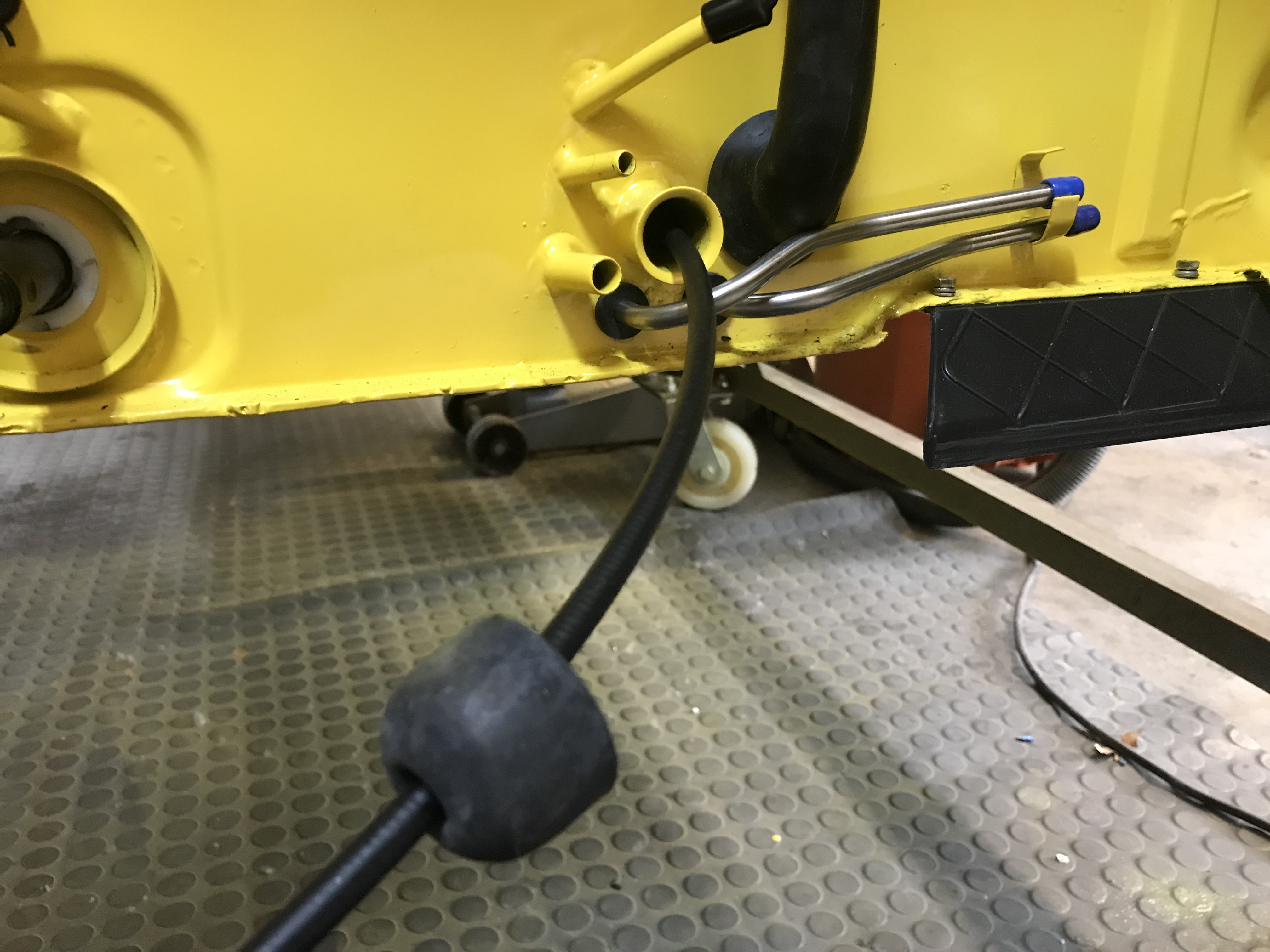

I started feeding it from the engine side.
bkrantz
post Jun 16 2021, 07:14 PM
Post #3013
Posts: 8,800
Joined: 3-August 19
From: SW Colorado
Member No.: 23,343

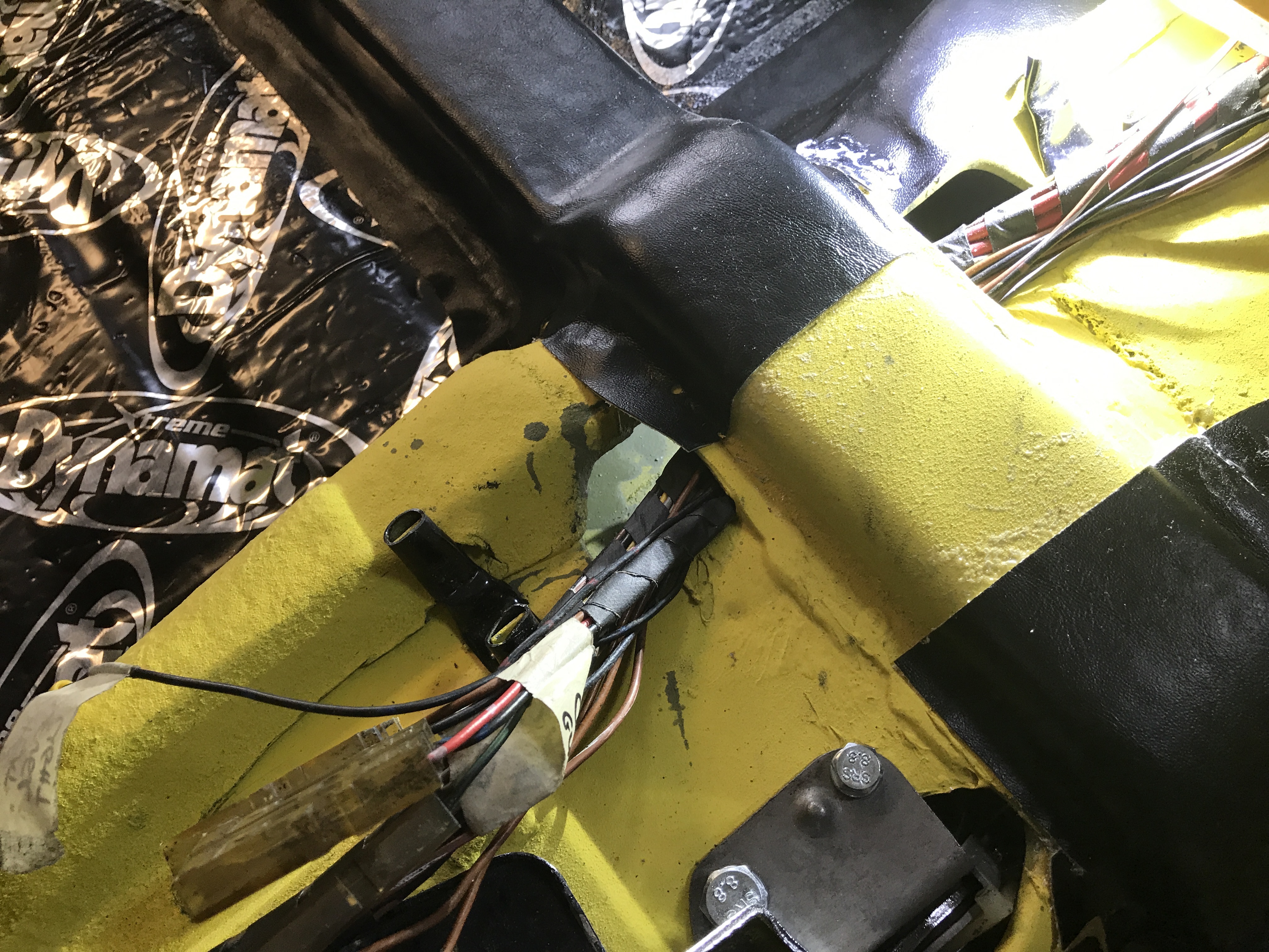

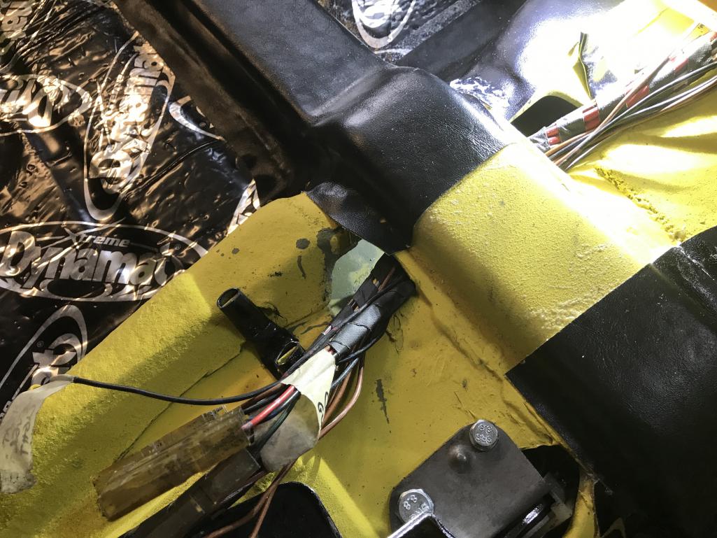

And then I made space so I could route it the "official" way: in the tunnel aft of the cross member, and then up along side the wiring harness.

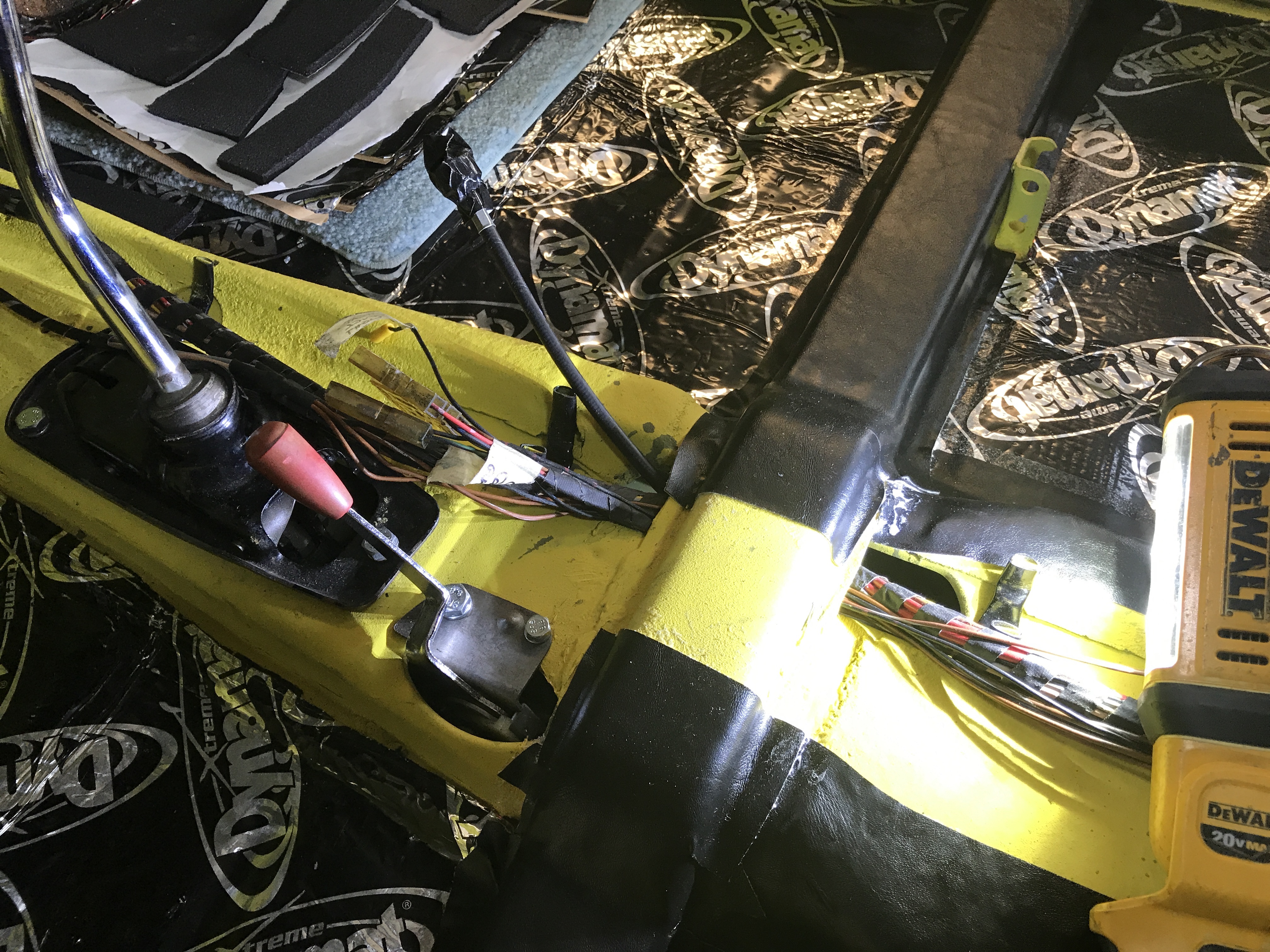

bkrantz
post Jun 16 2021, 07:15 PM
Post #3014
Posts: 8,800
Joined: 3-August 19
From: SW Colorado
Member No.: 23,343
Cable emerging!
bkrantz
post Jun 16 2021, 07:16 PM
Post #3015
Posts: 8,800
Joined: 3-August 19
From: SW Colorado
Member No.: 23,343
And up to the speedometer.

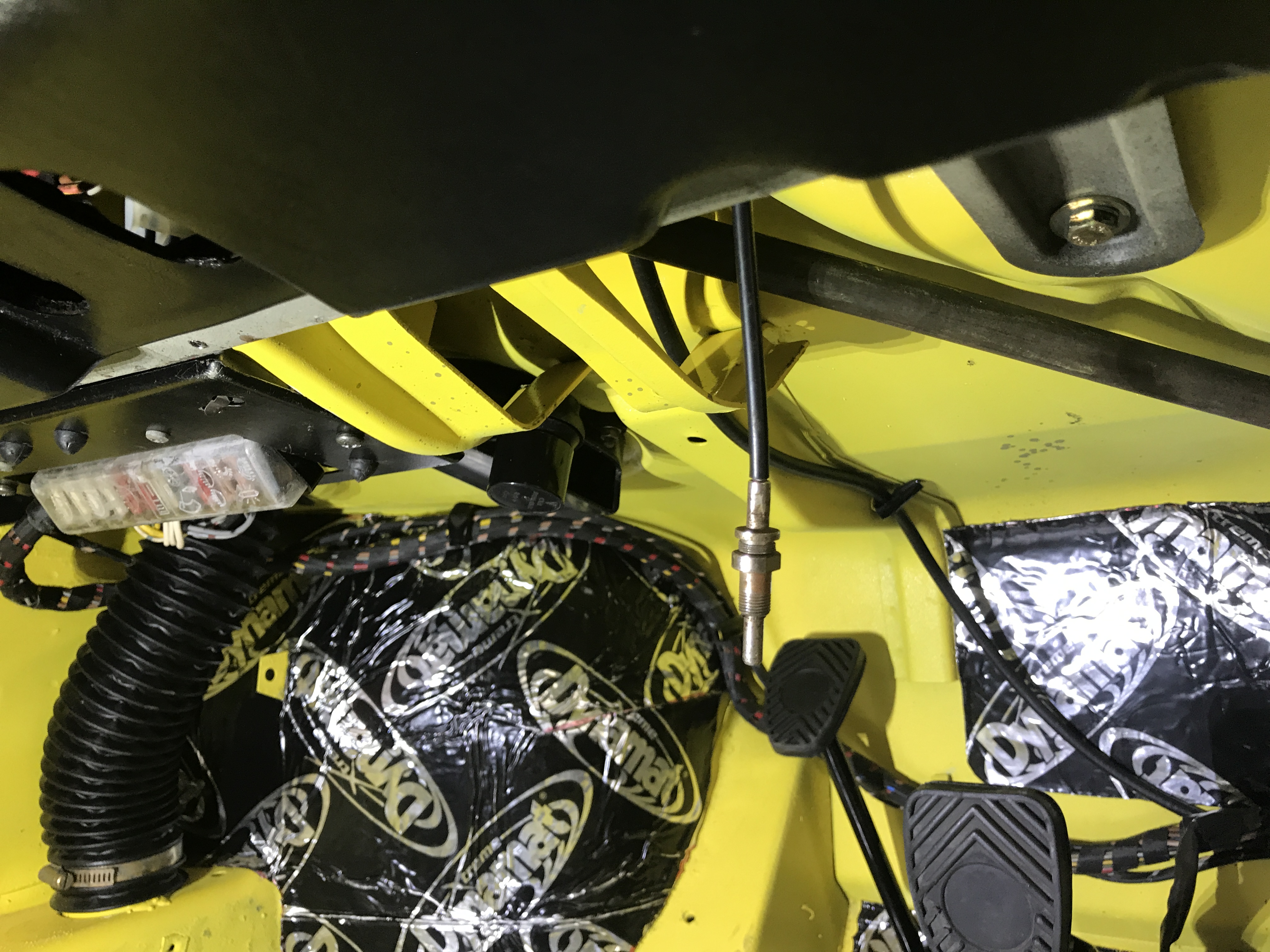

bkrantz
post Jun 16 2021, 07:17 PM
Post #3016
Posts: 8,800
Joined: 3-August 19
From: SW Colorado
Member No.: 23,343
I think I got the cable laid out correctly.

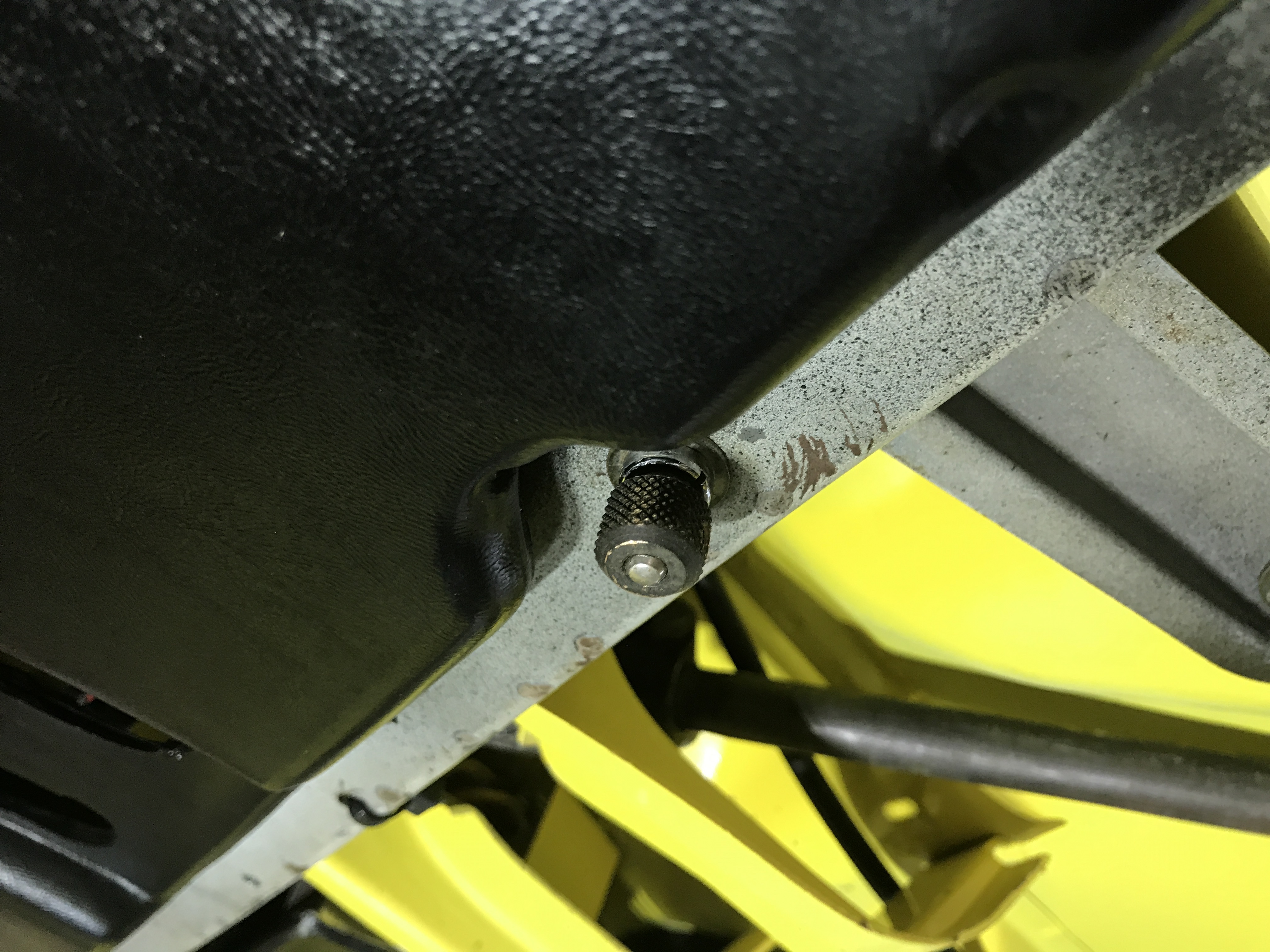

And then I mounted the odometer reset cable.
bkrantz
post Jun 16 2021, 07:18 PM
Post #3018
Posts: 8,800
Joined: 3-August 19
From: SW Colorado
Member No.: 23,343
Done, with the little knob mounted.

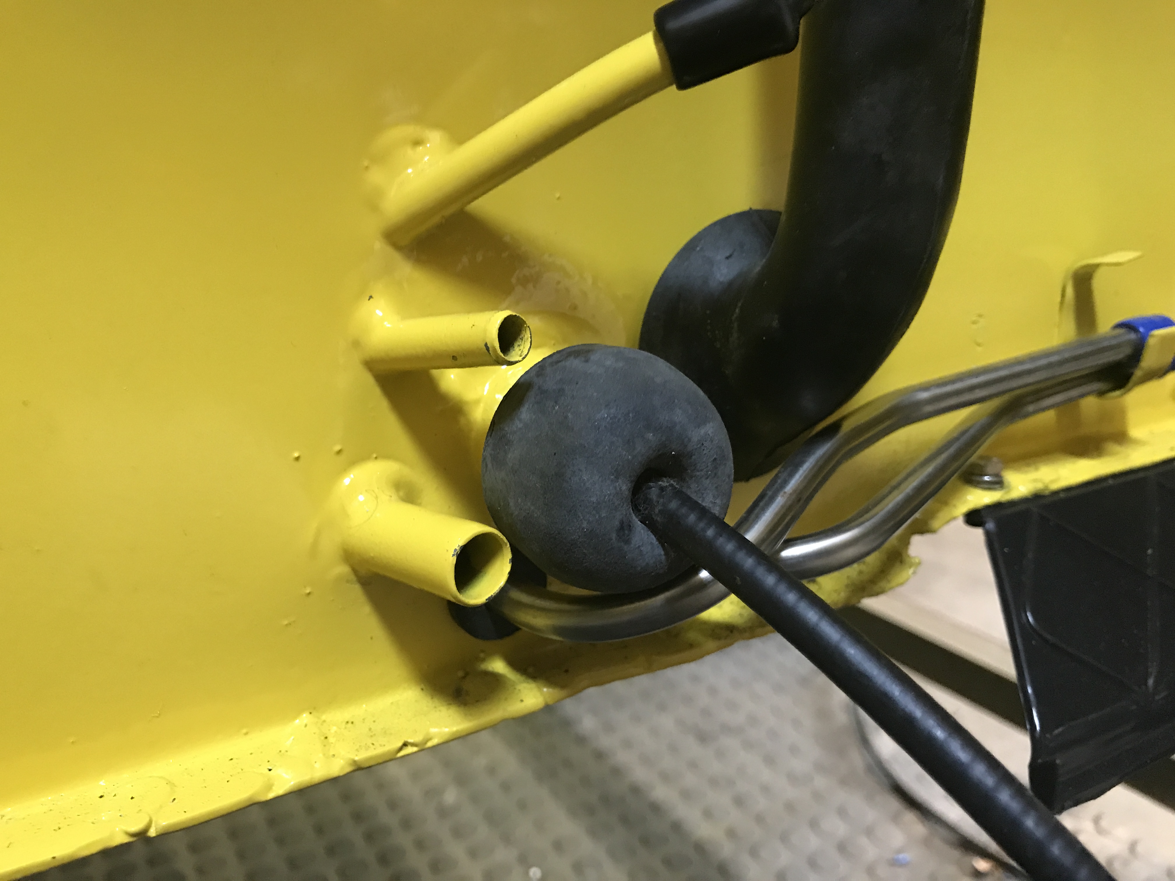

And sealed up at the firewall.

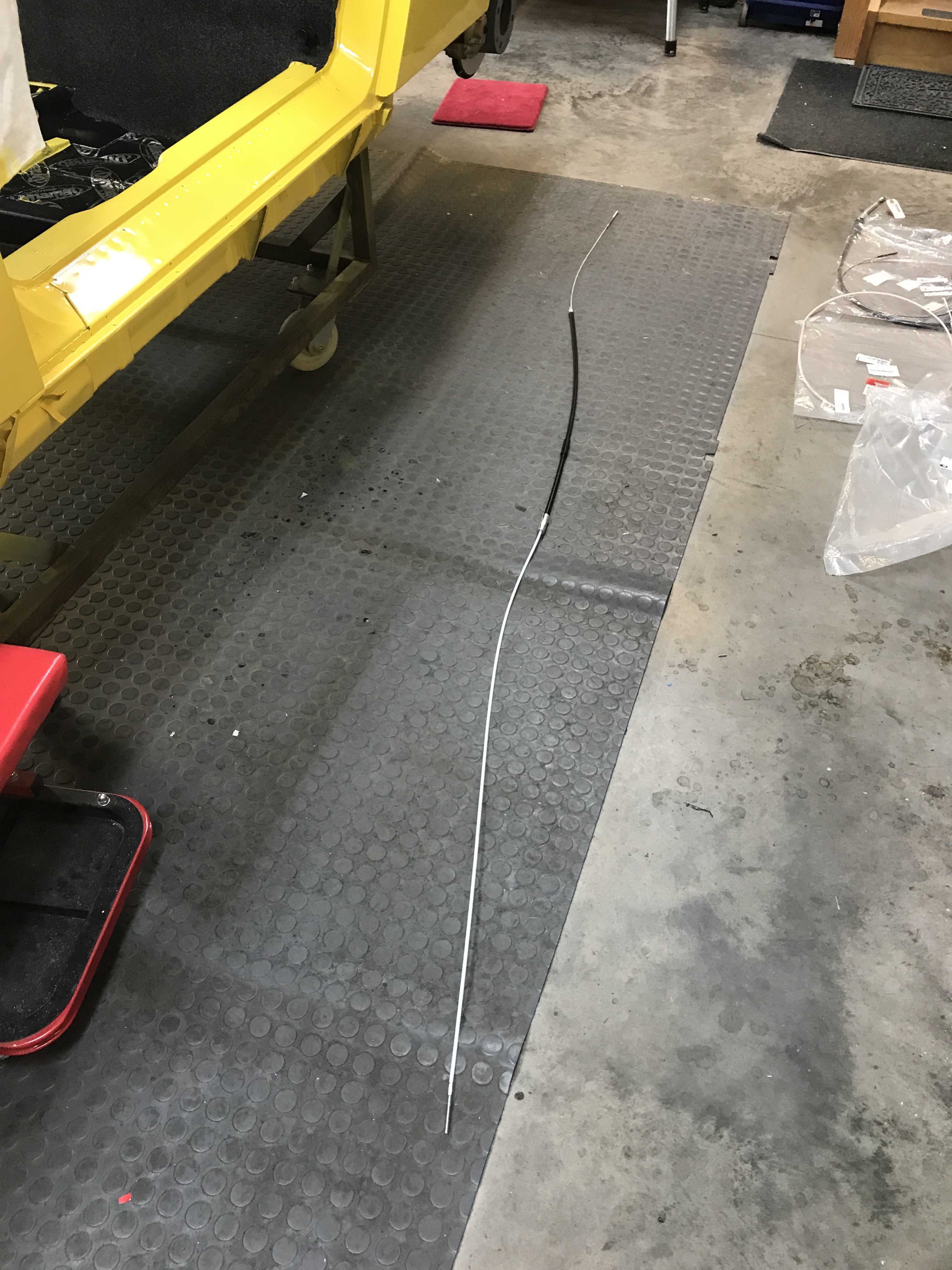

Next, the clutch cable. I bought the genuine Porsche part.
