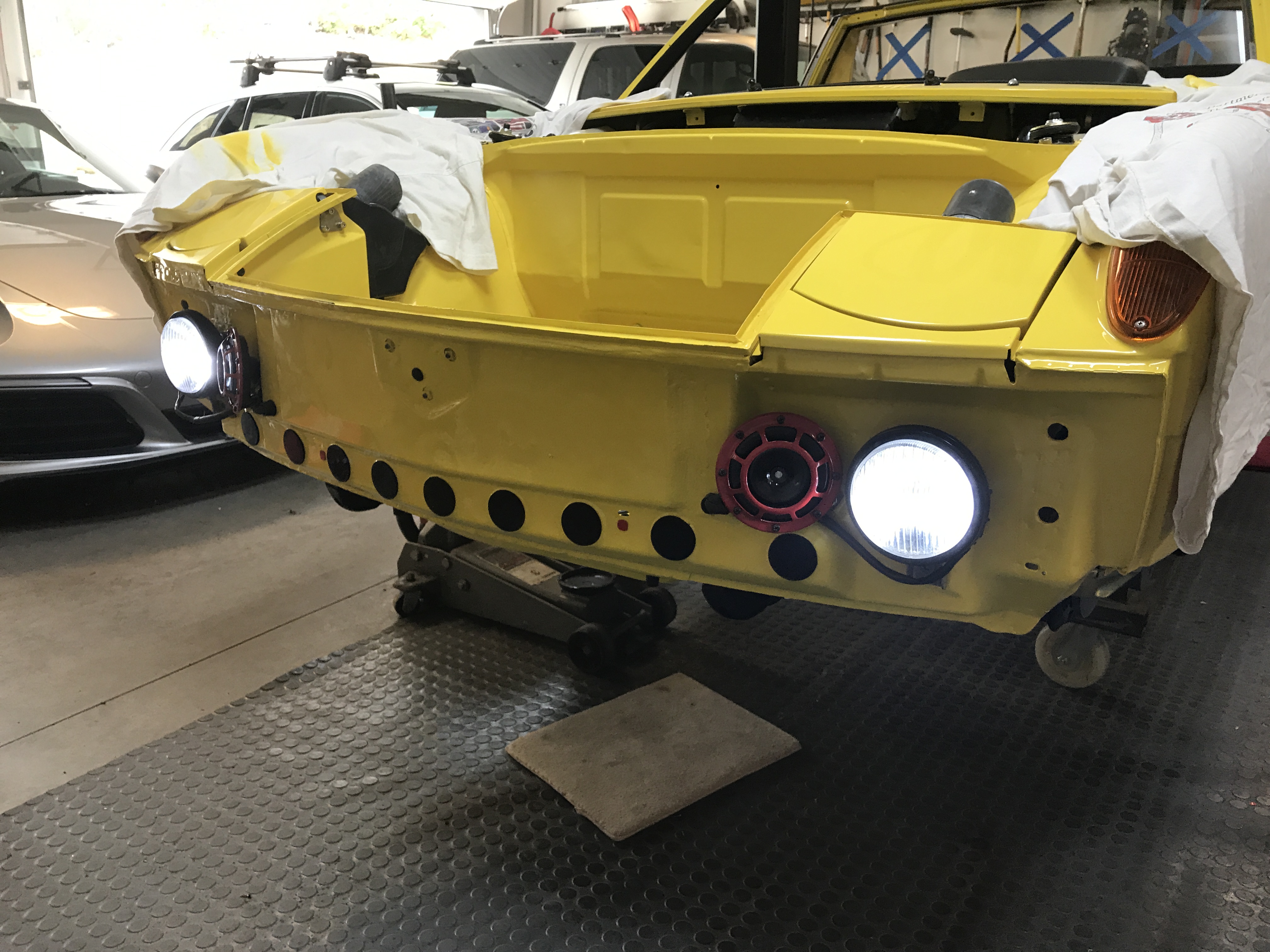

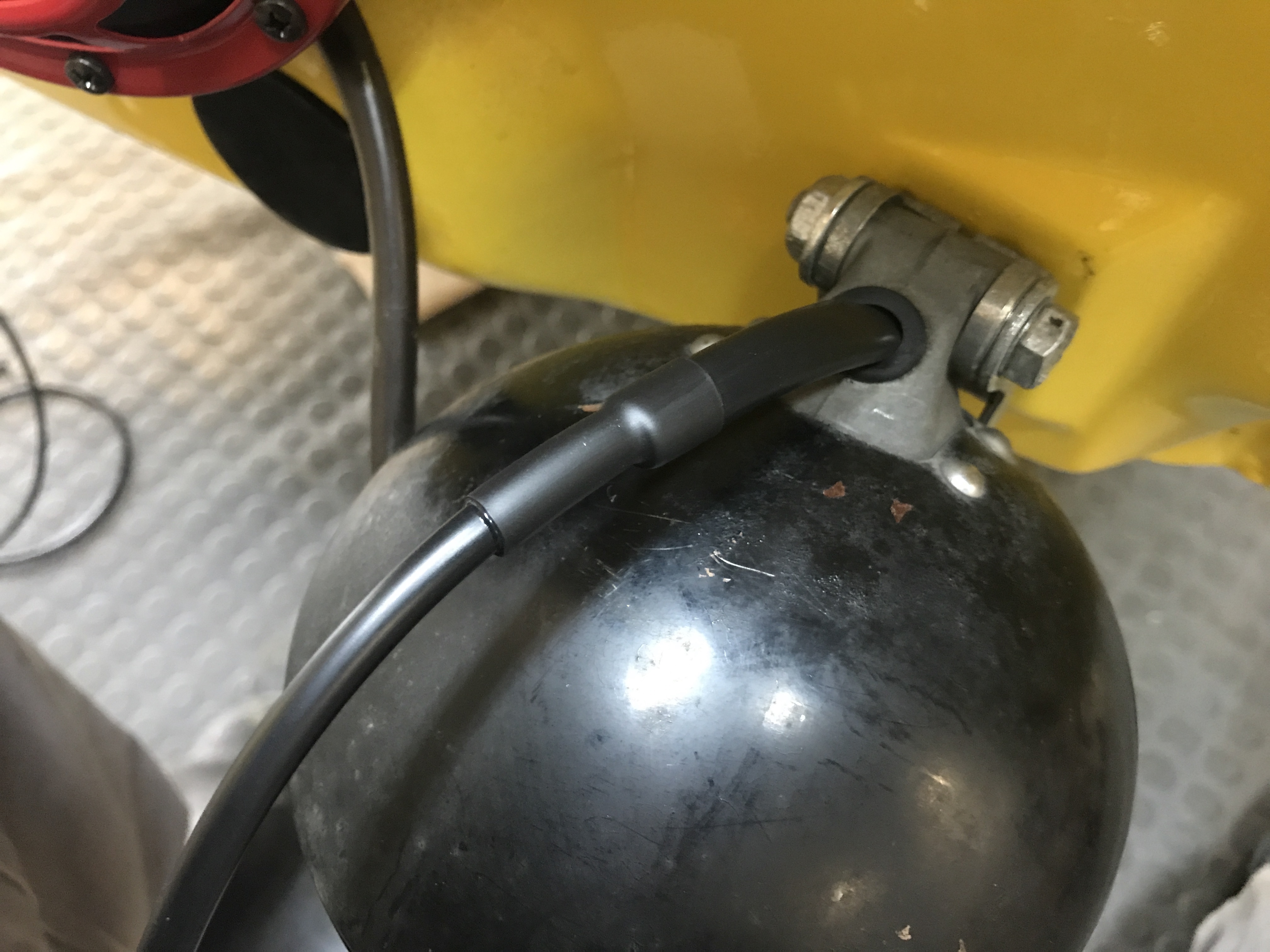

I then make an effort to seal all the leads with a combination of standard tubing and heat-shrink stuff.
bkrantz
post Jun 17 2021, 07:09 PM
Post #3042
Posts: 8,800
Joined: 3-August 19
From: SW Colorado
Member No.: 23,343
The fog lights still work!

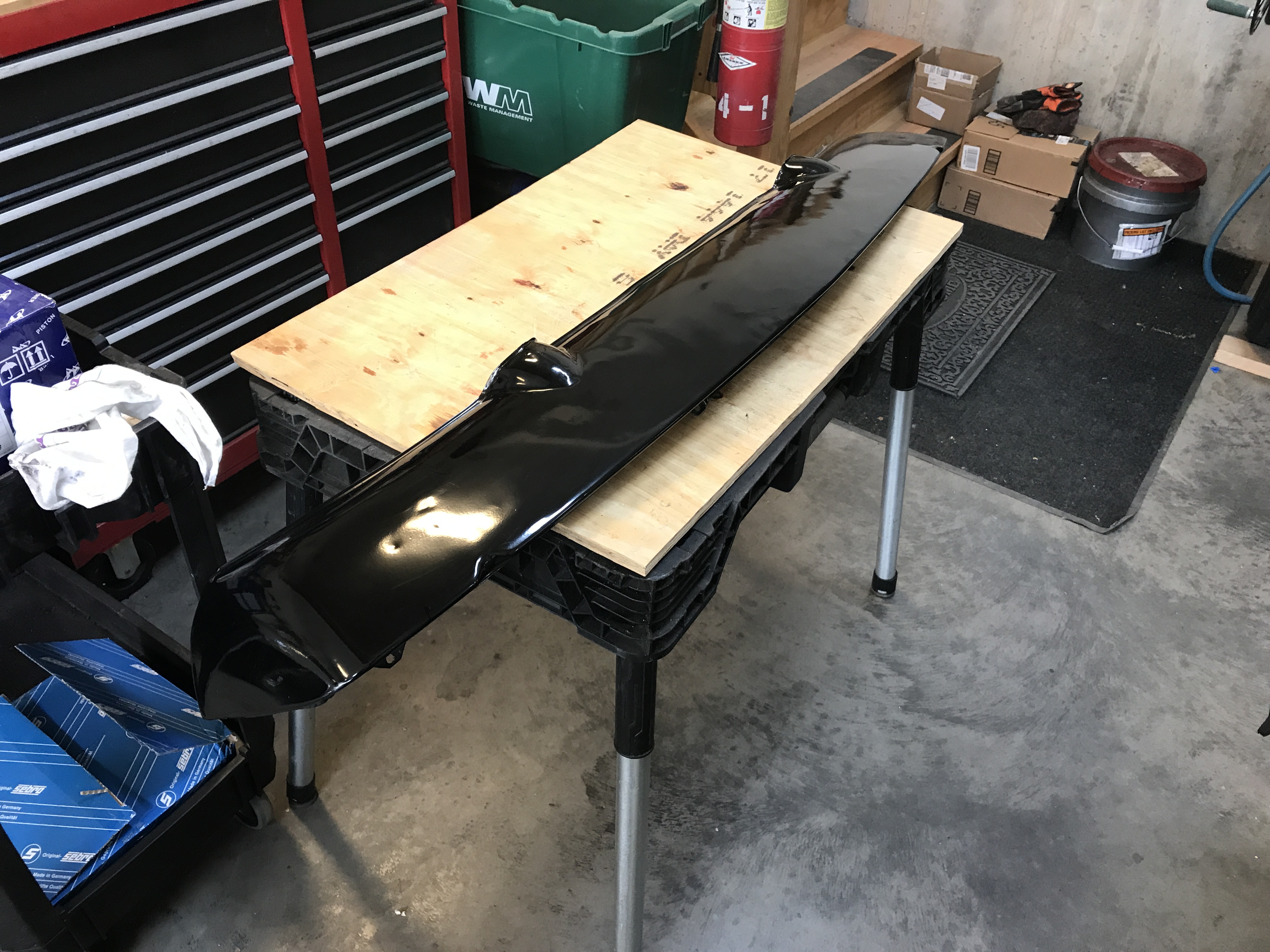

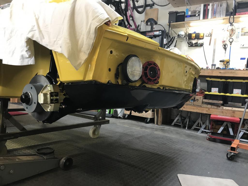

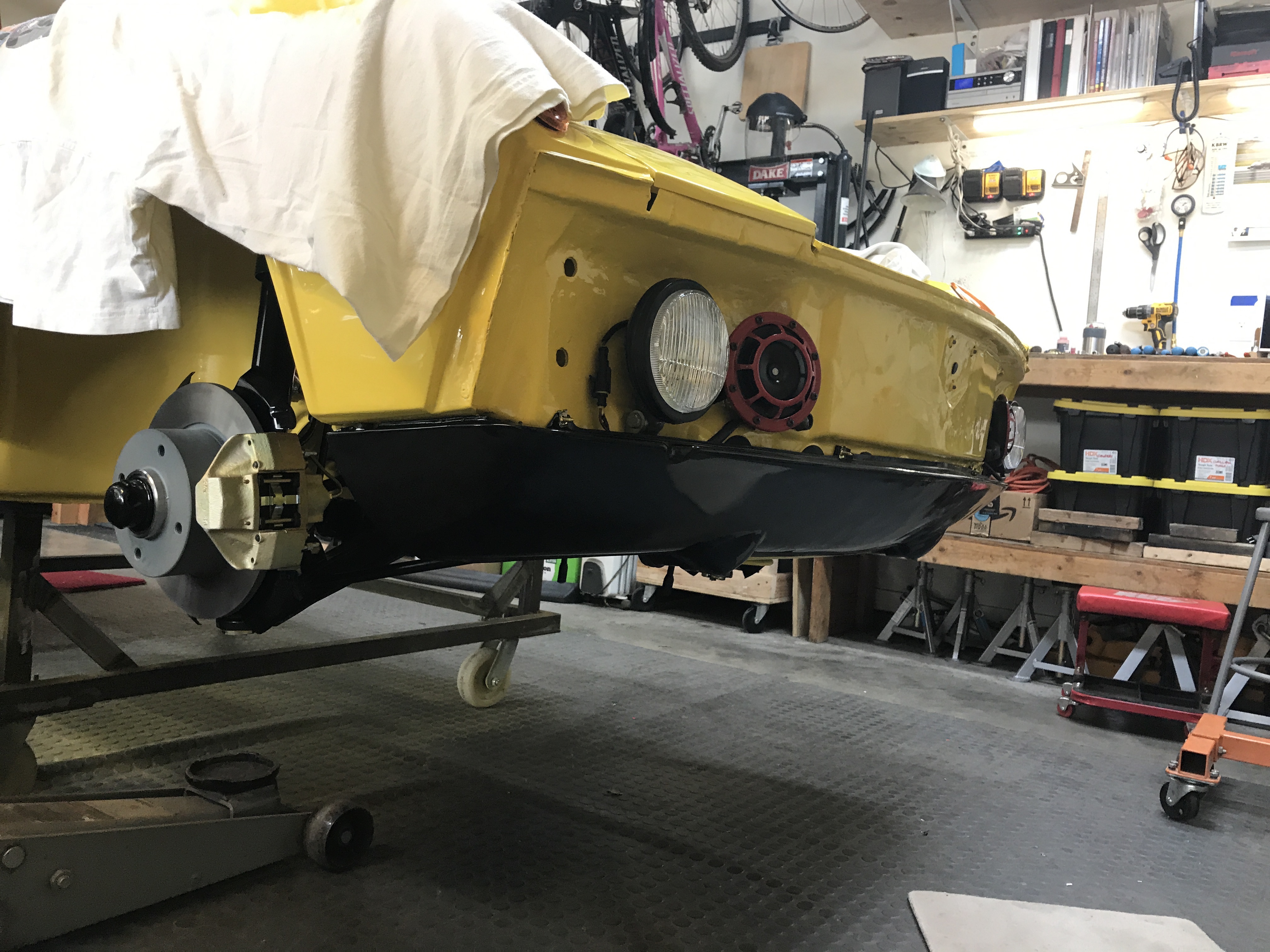

With the lights done, I can get going on completing the front. I got out my lower valence, a bit lumpy but its powder-coated and should resist chips.

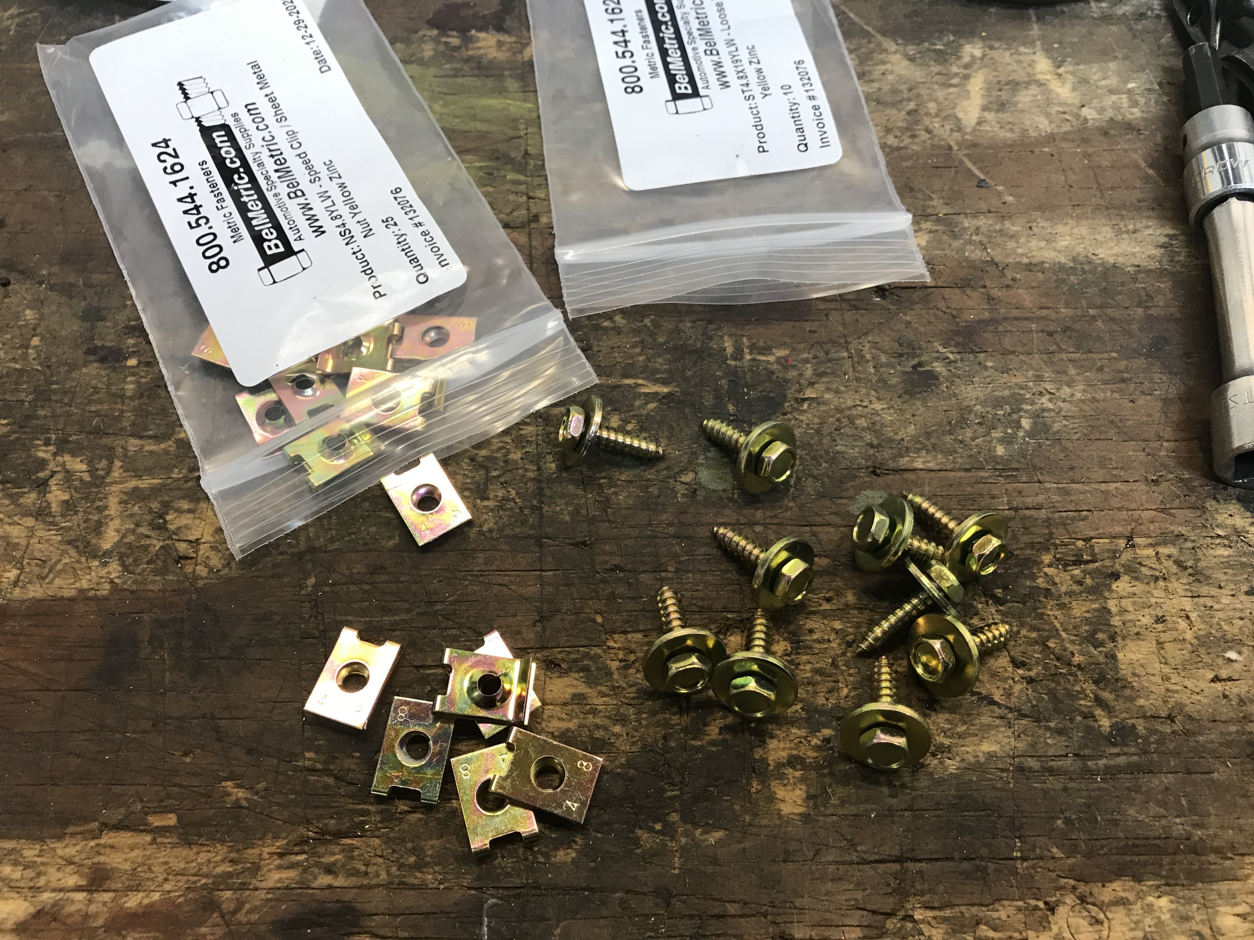

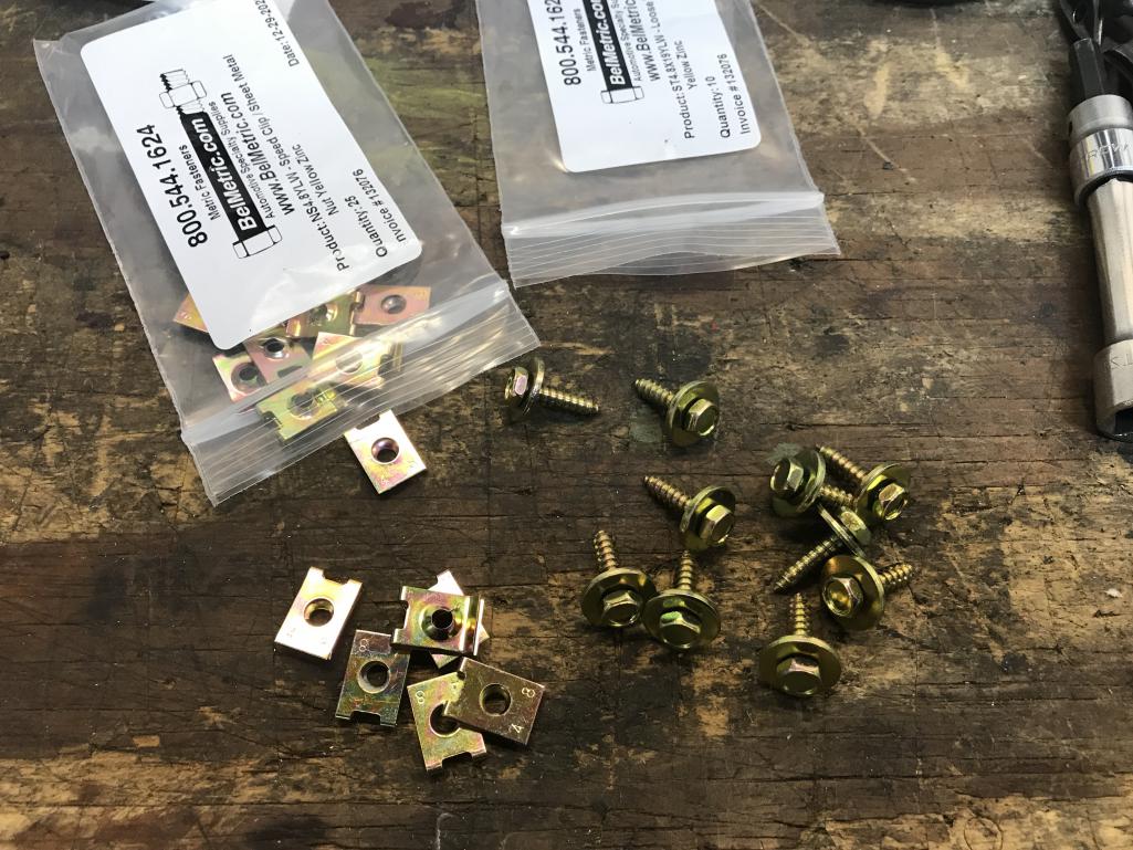

Some new hardware.

After some minor twisting, I got the valence mounted. That included some home-made spacers for the side bolts, between the valence and the lower fender edges.

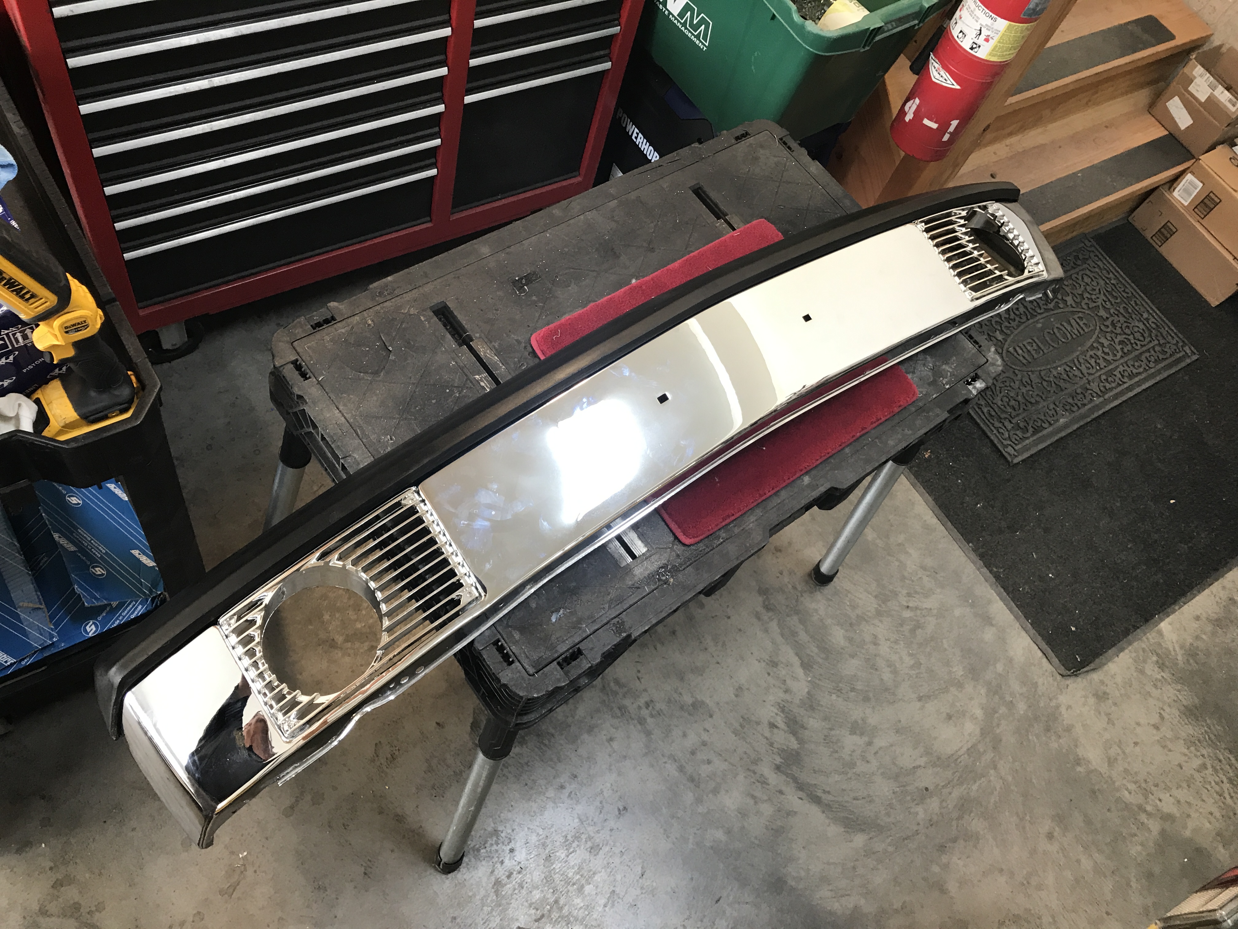

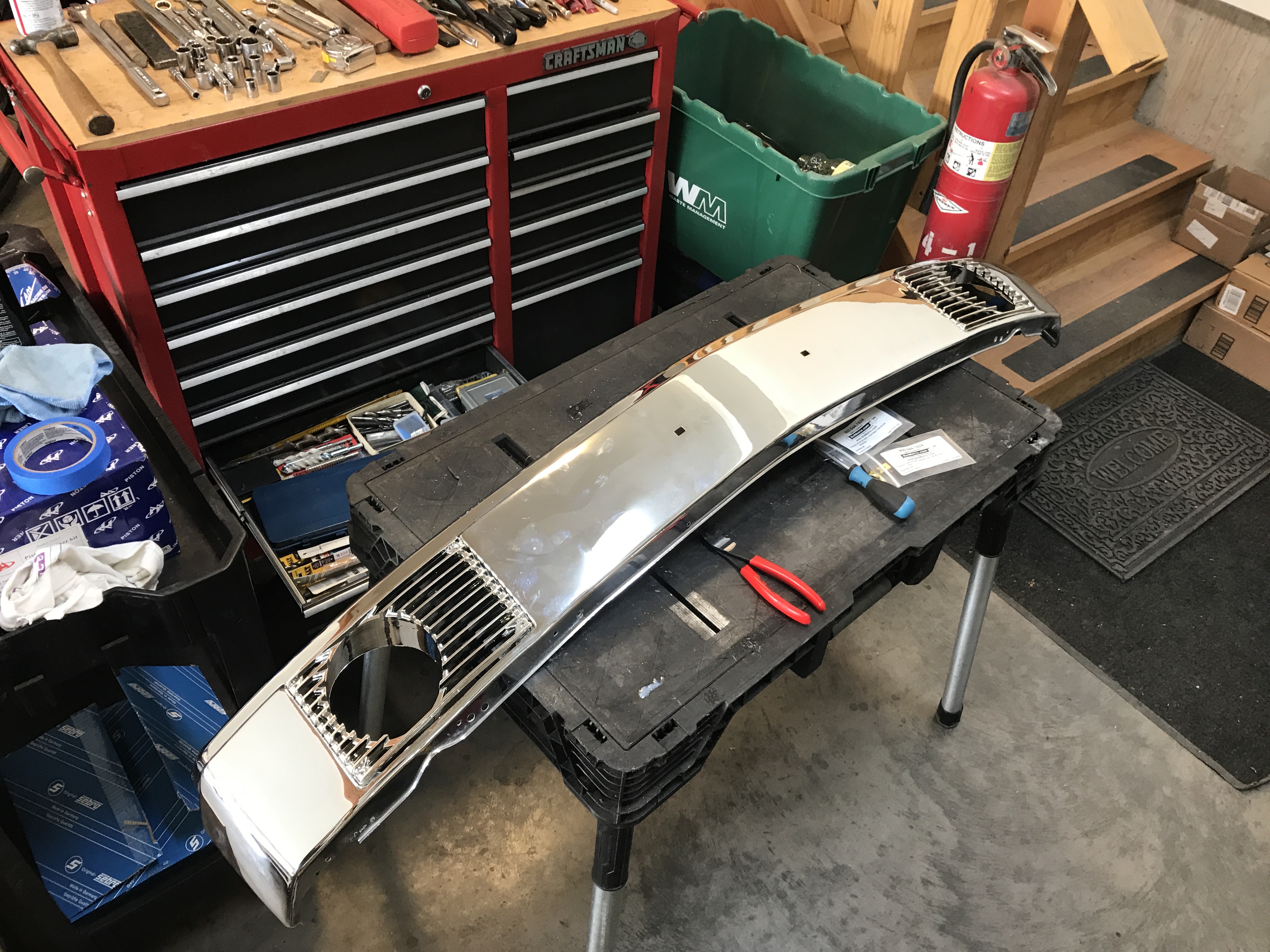

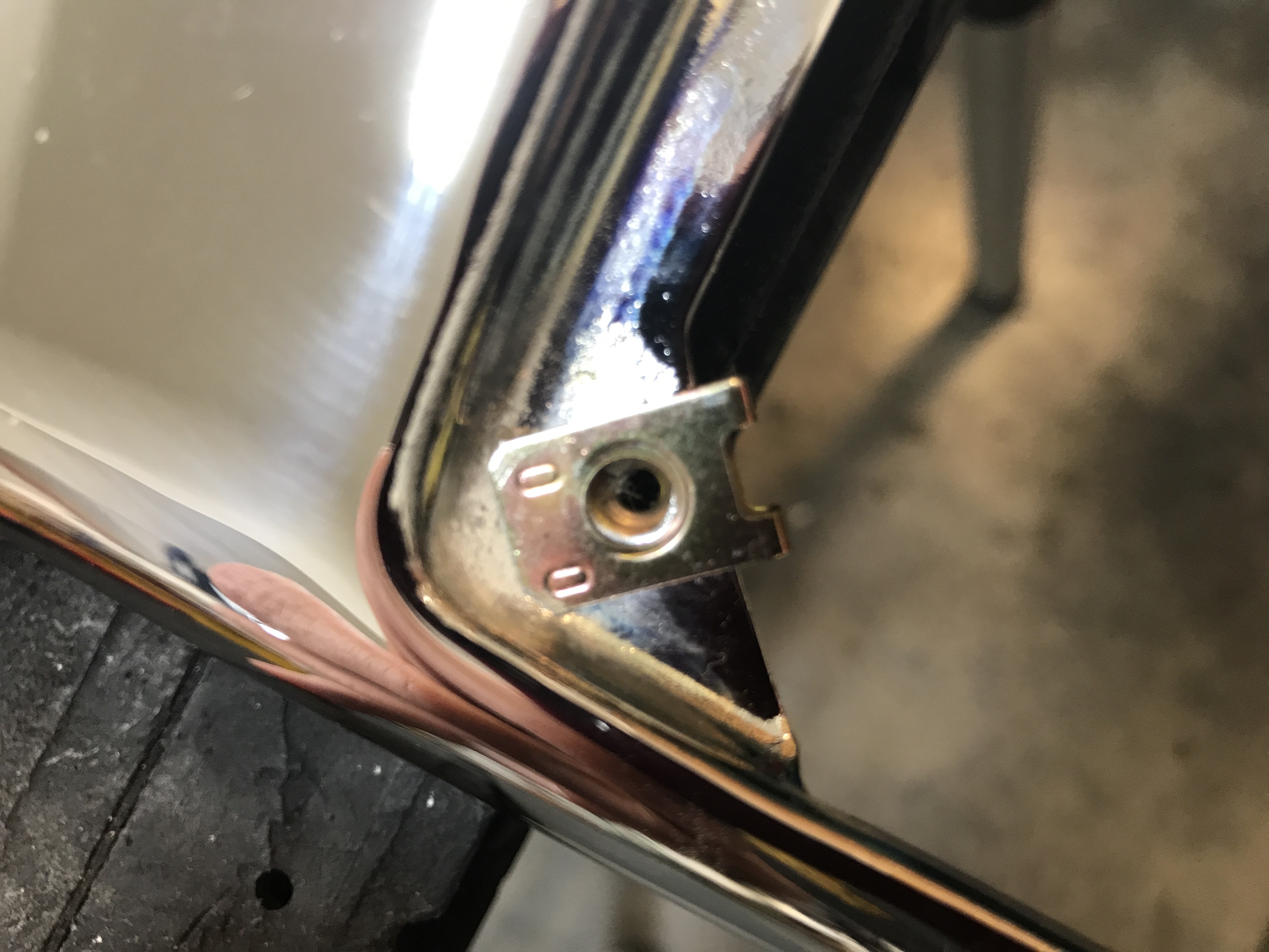

Today was bumper day. I had these re-chromed in Tucson last year. Lots of hand smudges.

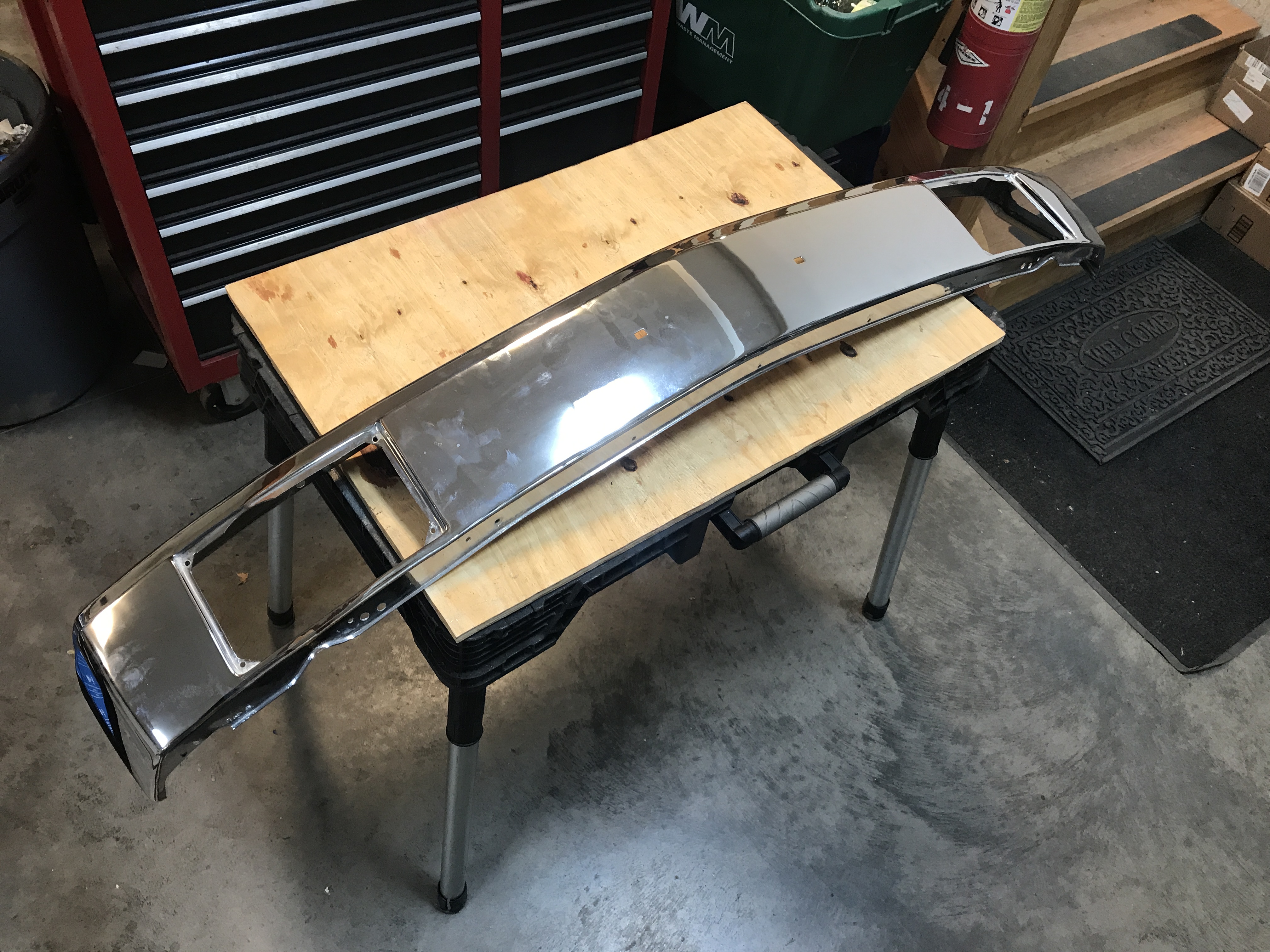

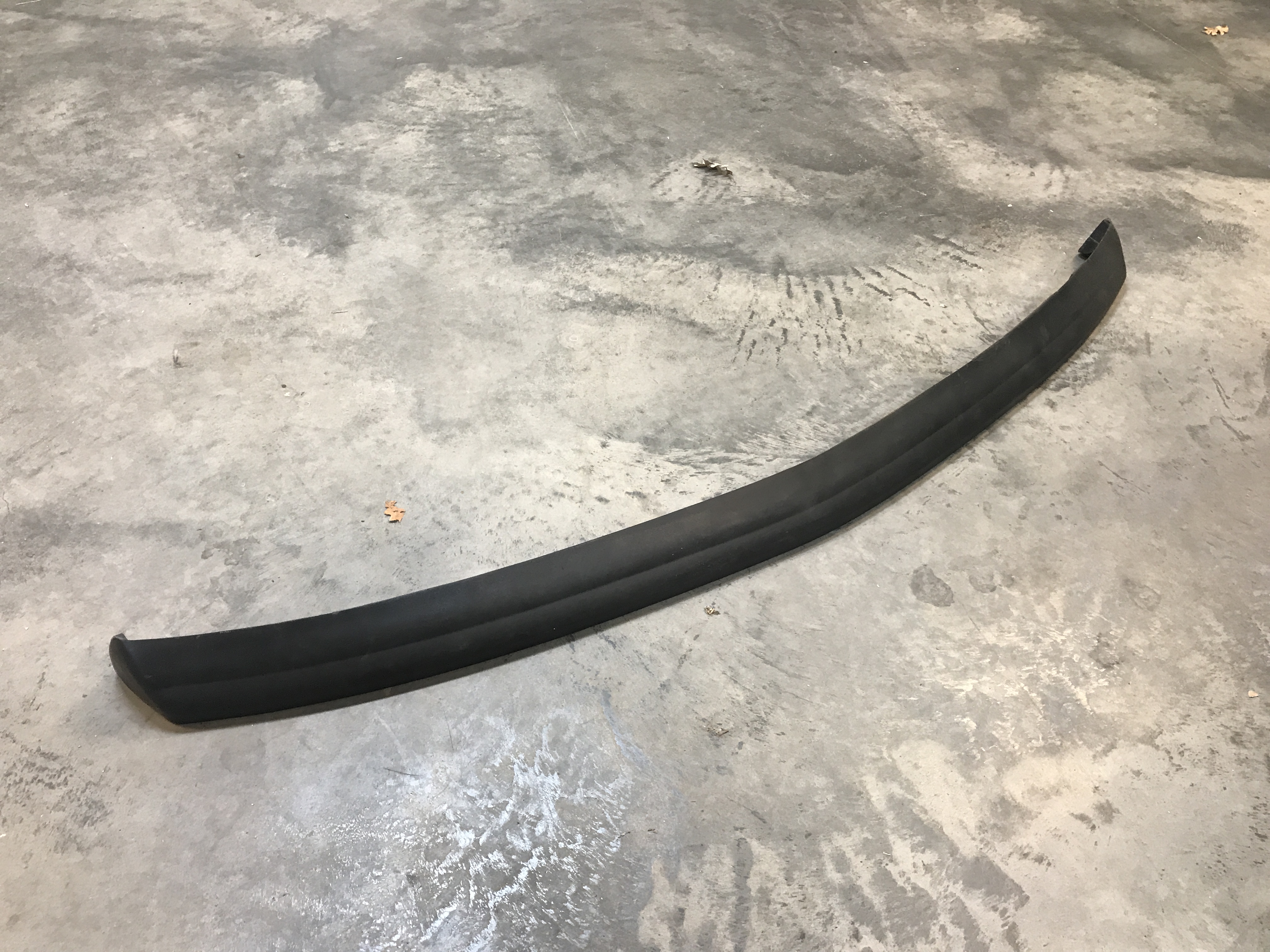

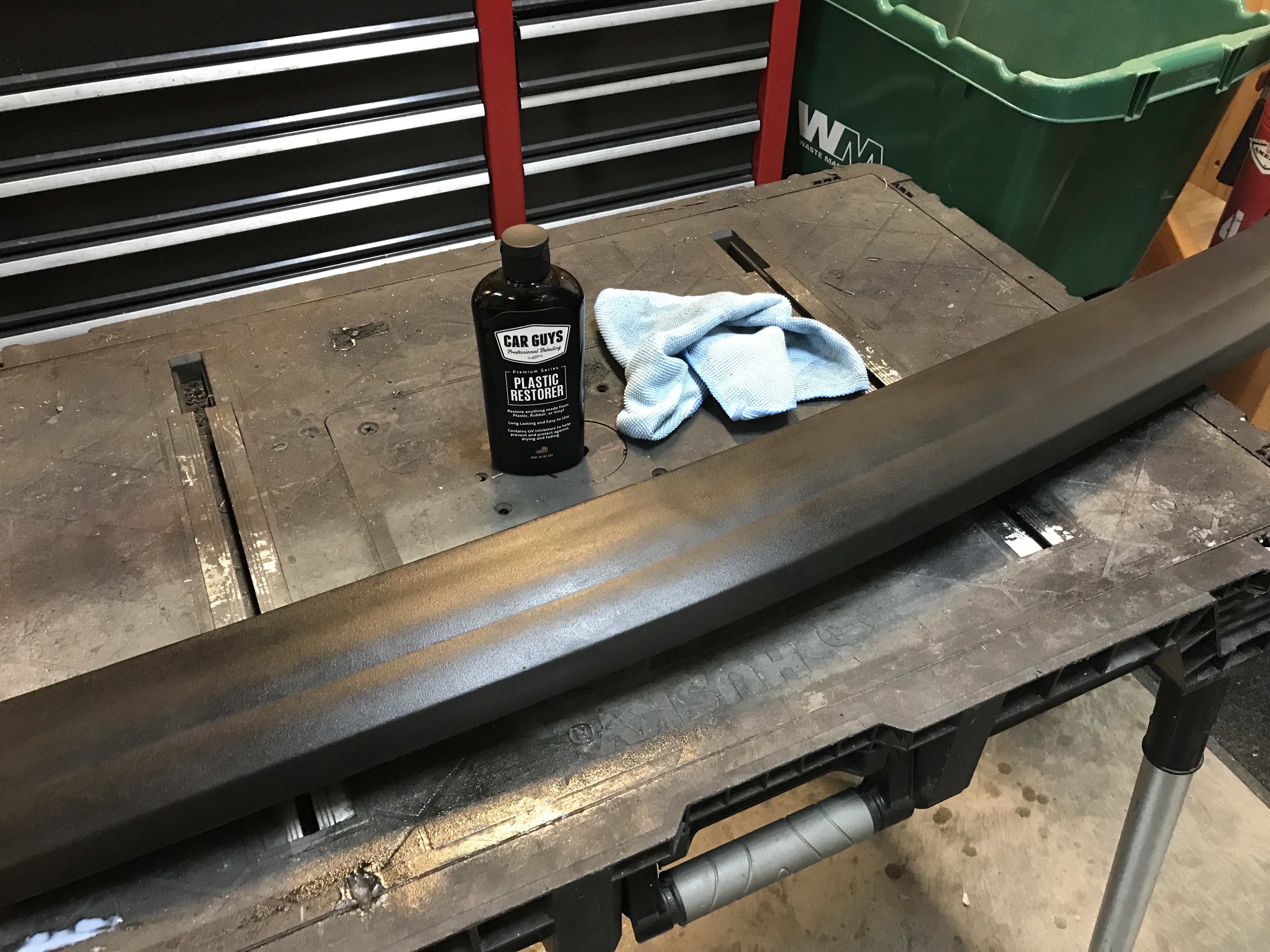

Here's the front bumper top I took off the car, one of the few parts I found that is actually in good condition.
bkrantz
post Jun 18 2021, 07:07 PM
Post #3050
Posts: 8,800
Joined: 3-August 19
From: SW Colorado
Member No.: 23,343
I cleaned it with Simple Green, and then gave it a rubber treatment.

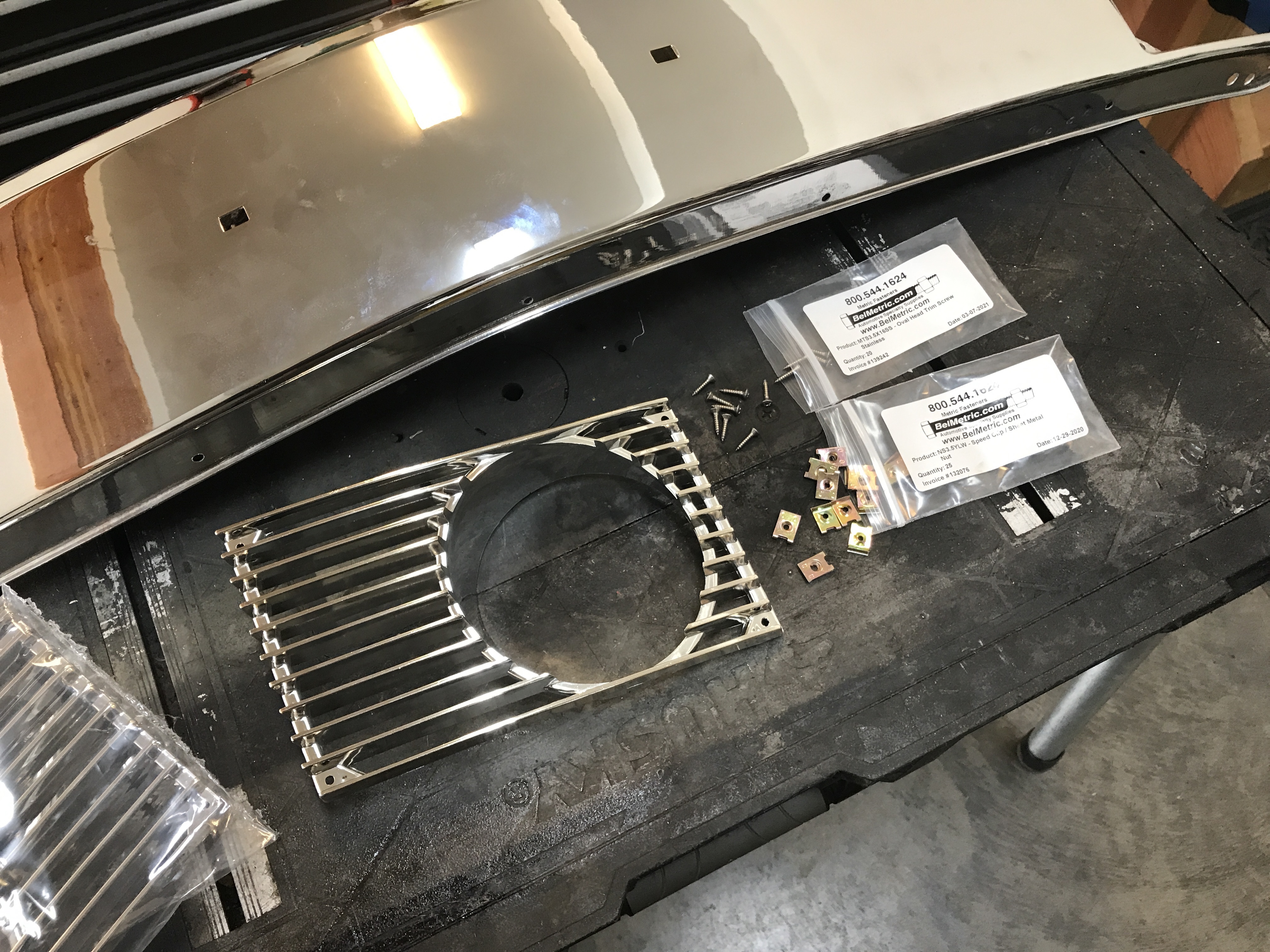

To check the fog light positions, I mounted the grills in the bumper. New repro grills from 914 Rubber.

To make the speed nuts fit better, I trimmed the corners off the front plates.

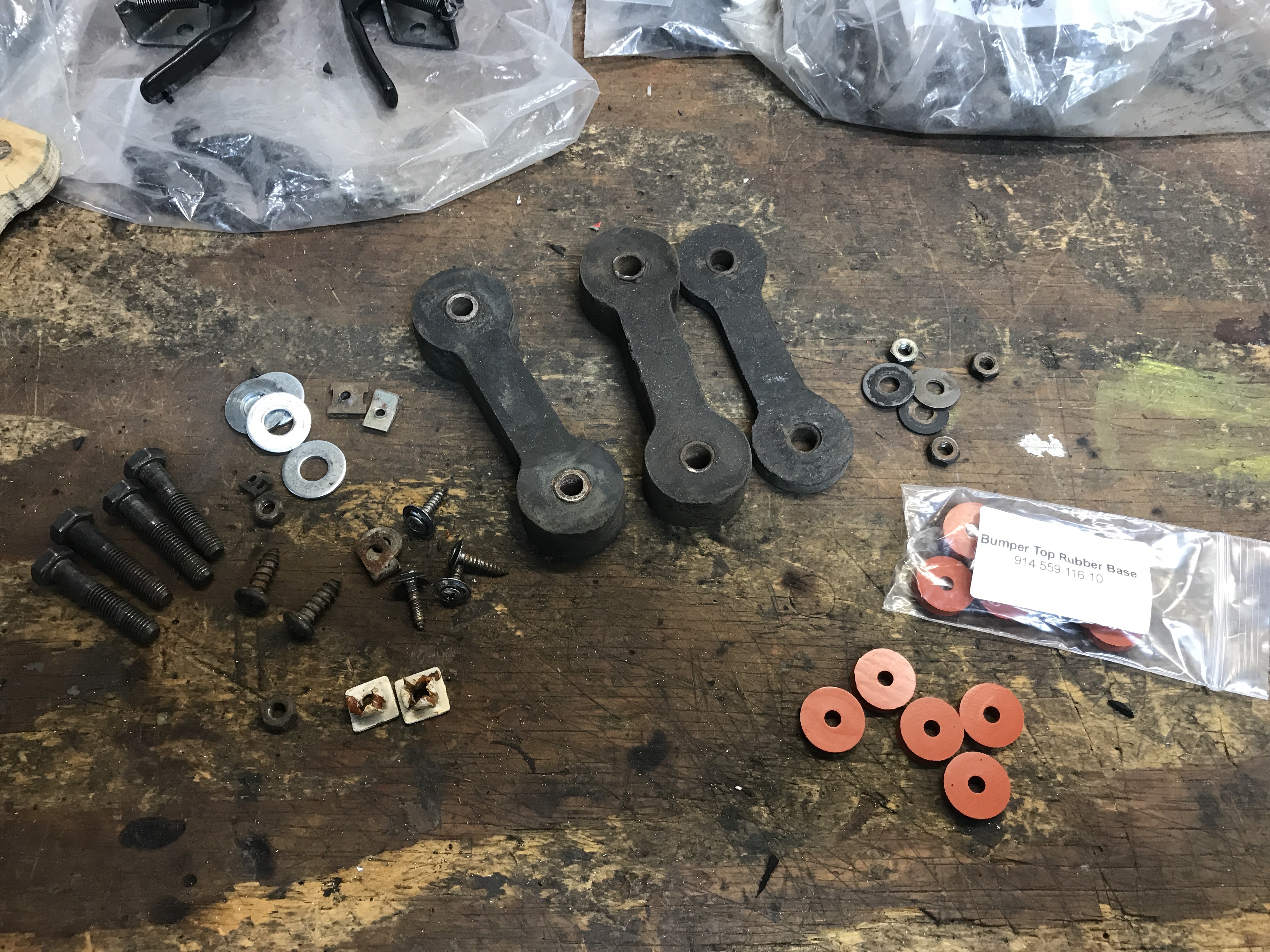

Here's all the hardware, old and new.

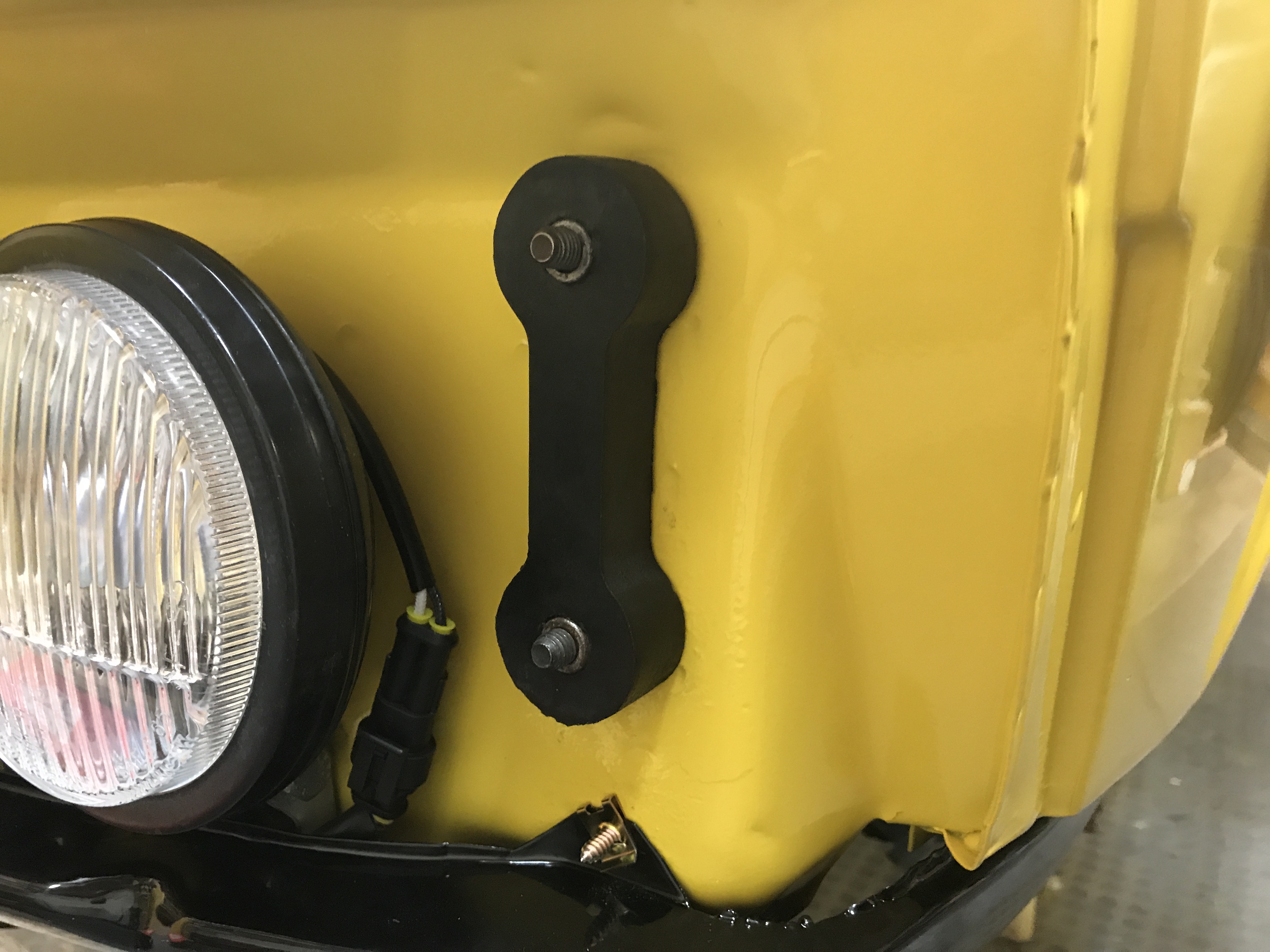

Bumper bolts and spacers ready.

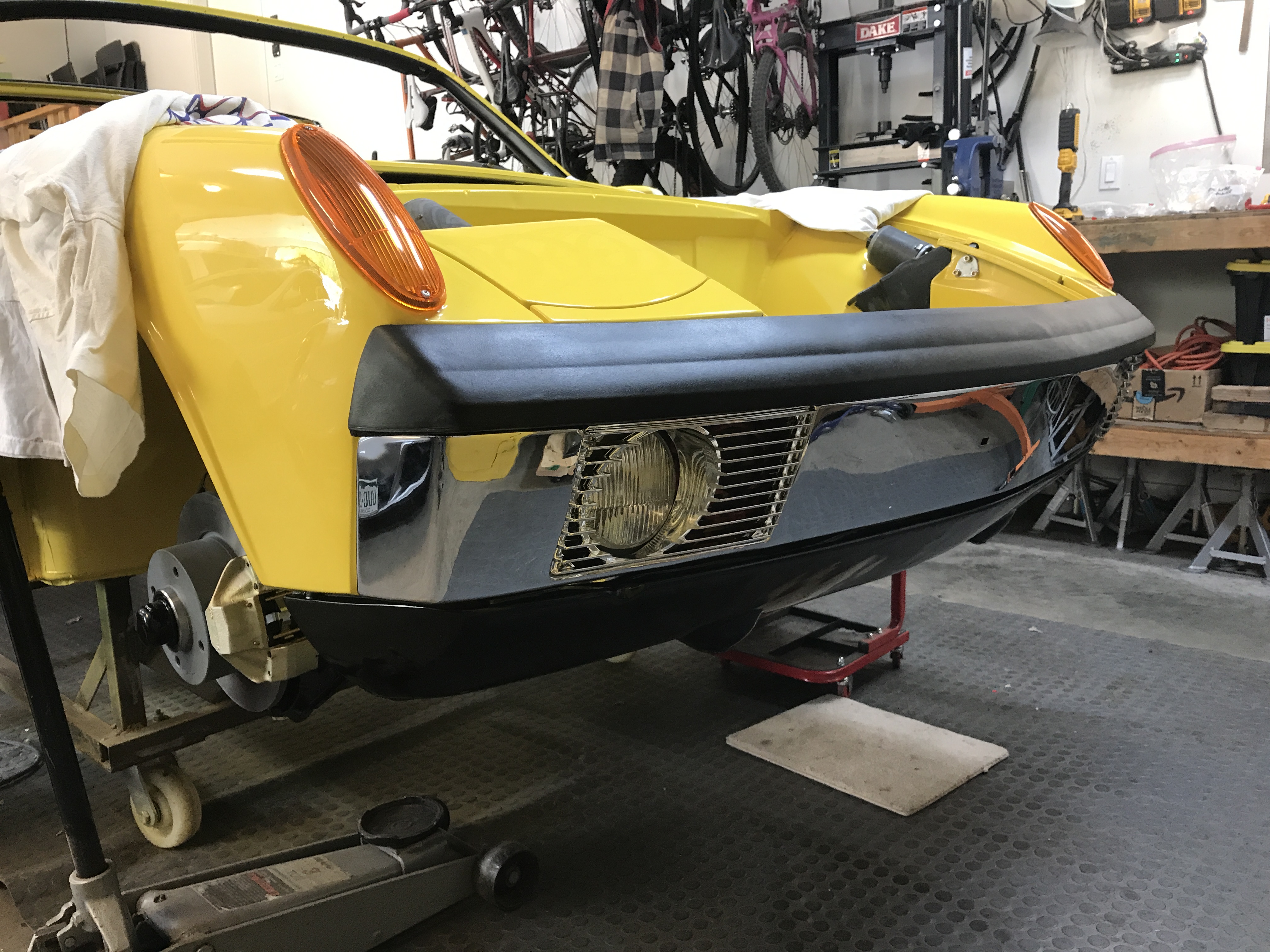

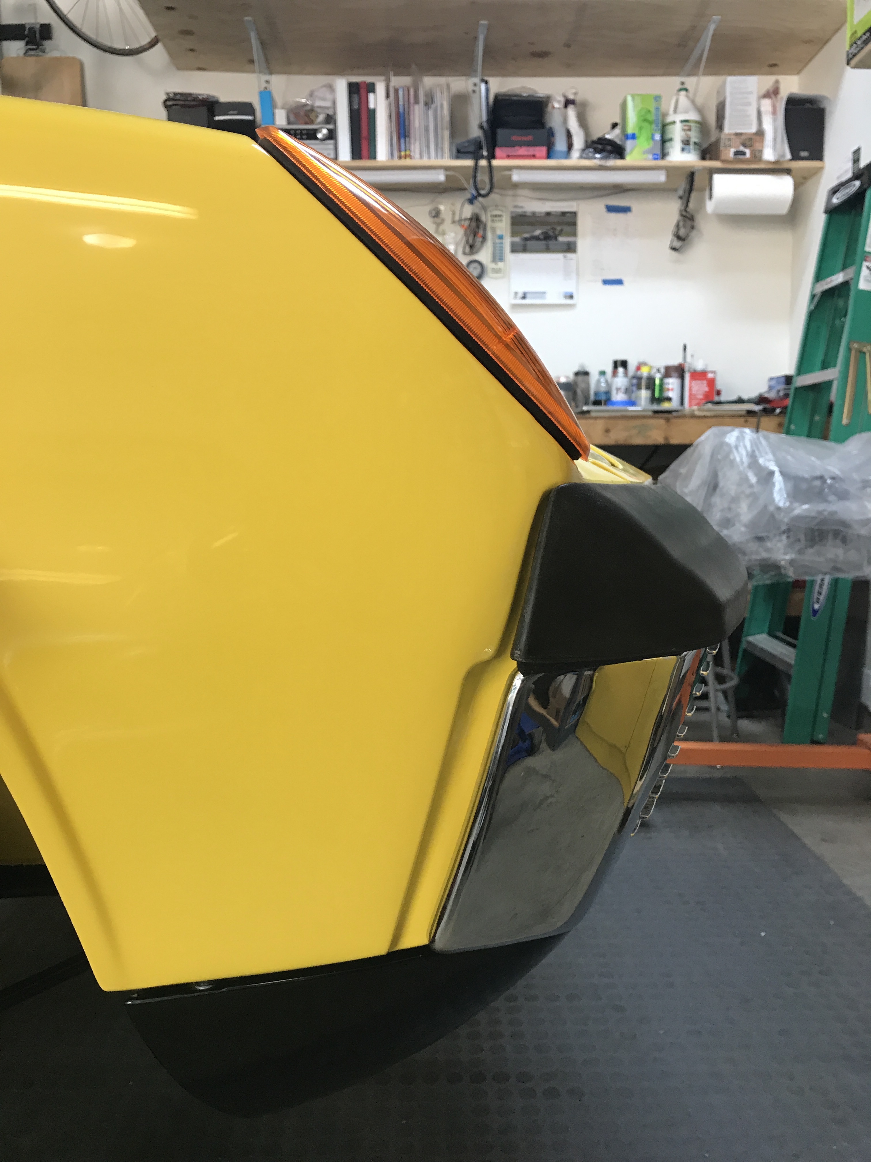

Here's the bumper bolted in place.

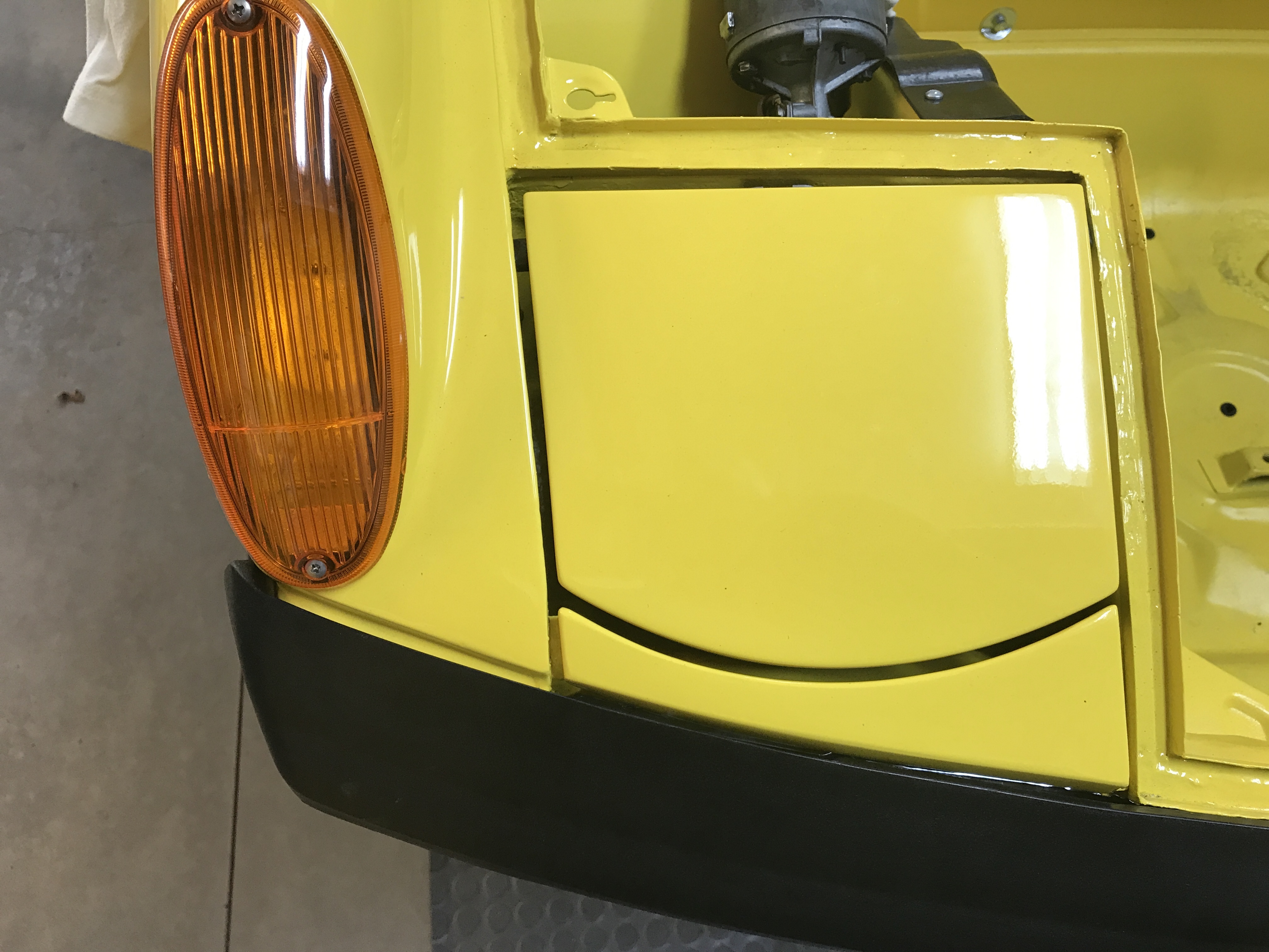

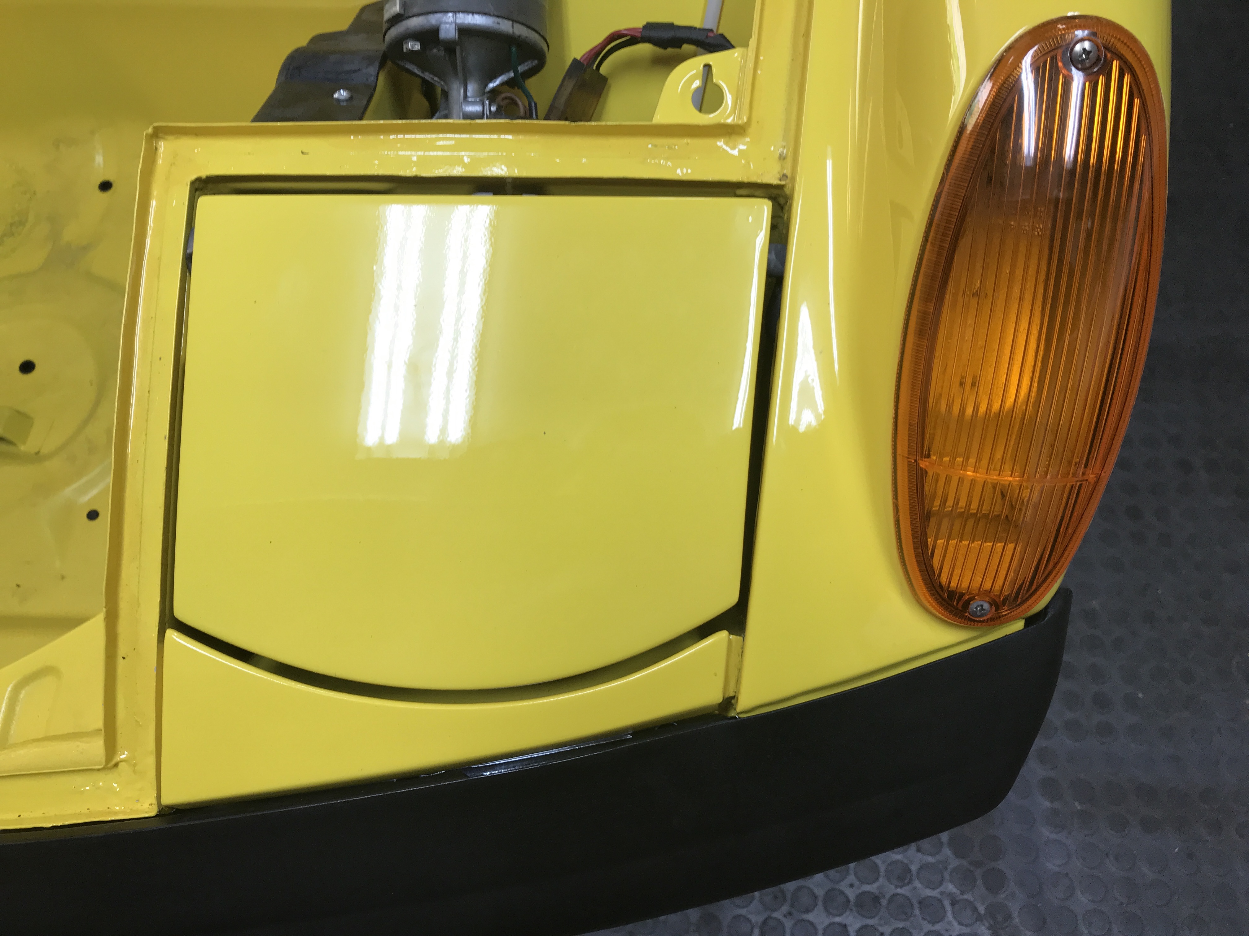

The fit looks pretty good, which makes me happy since the right side is where I pulled the outer fender, spliced in part of the inner fender and headlight box, and reconstructed the front panel.

Top view, left side.

And top view, right side. I might shave a few mm off the rubber spacer to draw the bumper in just a bit.
