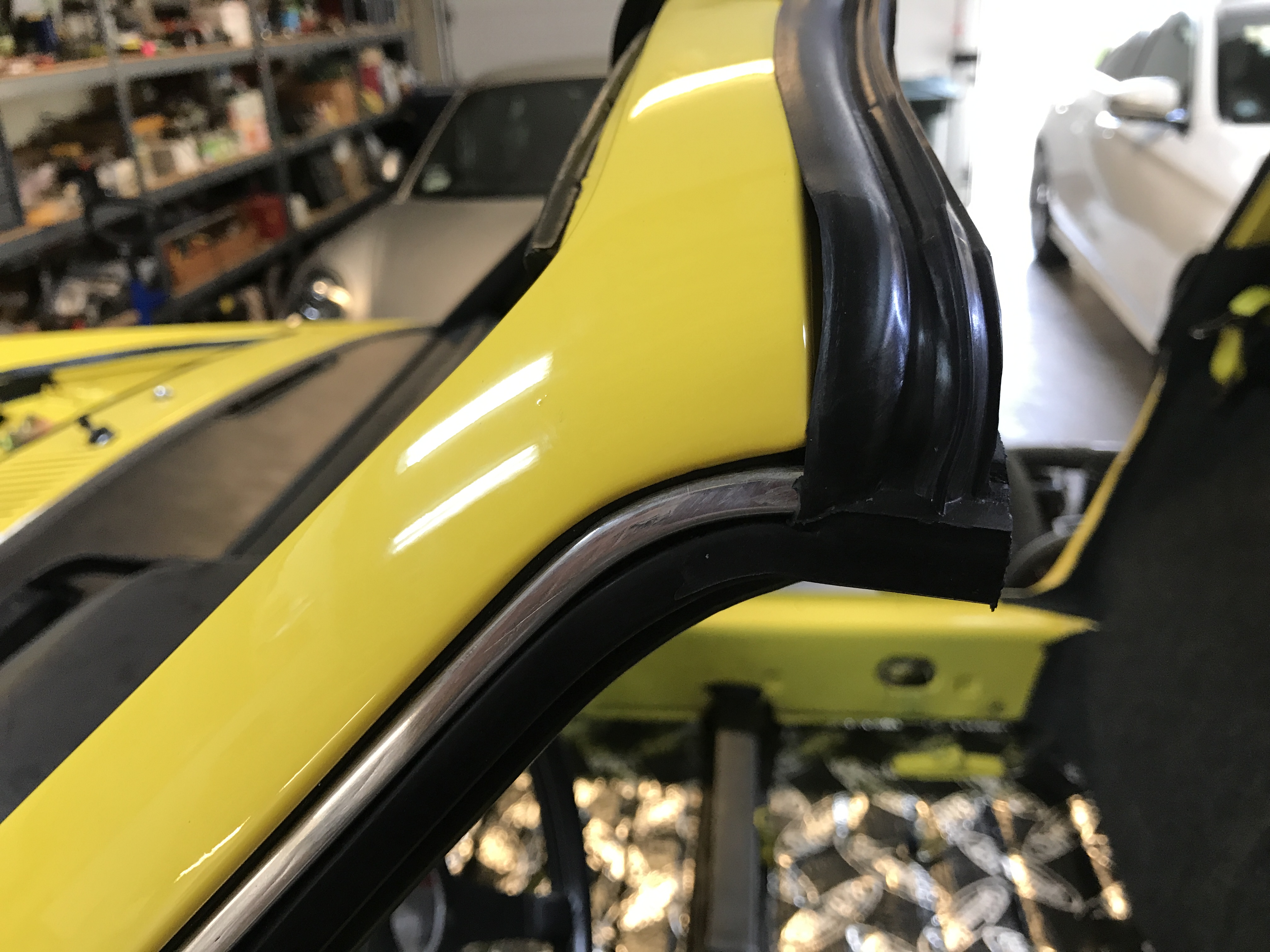

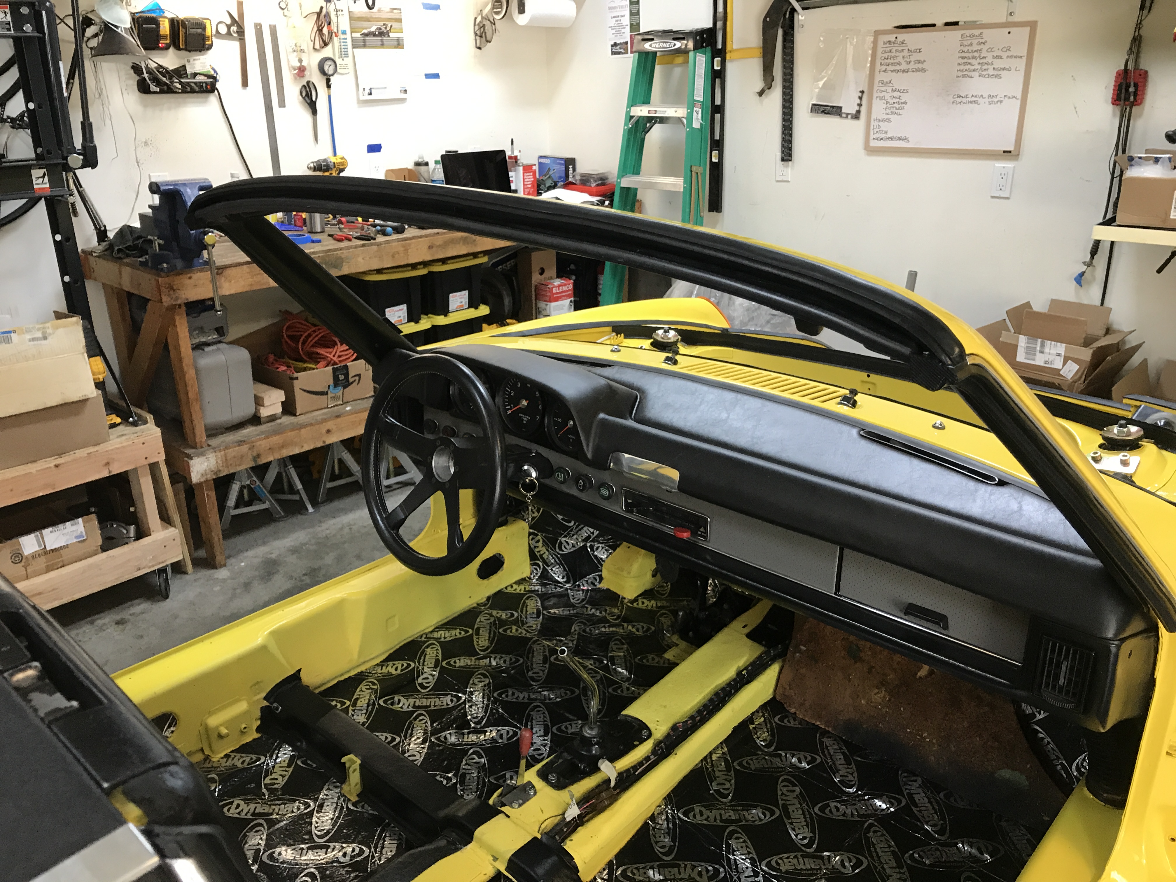

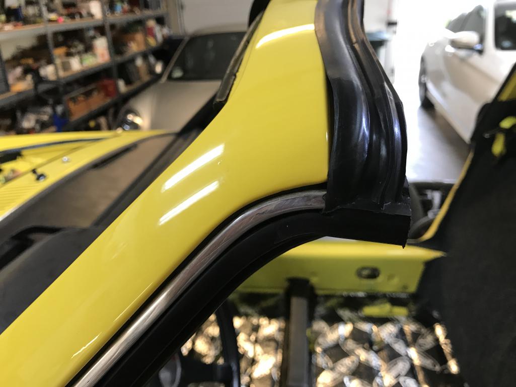

After making a small cut so the trim piece can seat properly. The bulge along the top curve will get fixed later.
post Jun 20 2021, 07:02 PM
Post #3102
Posts: 8,800

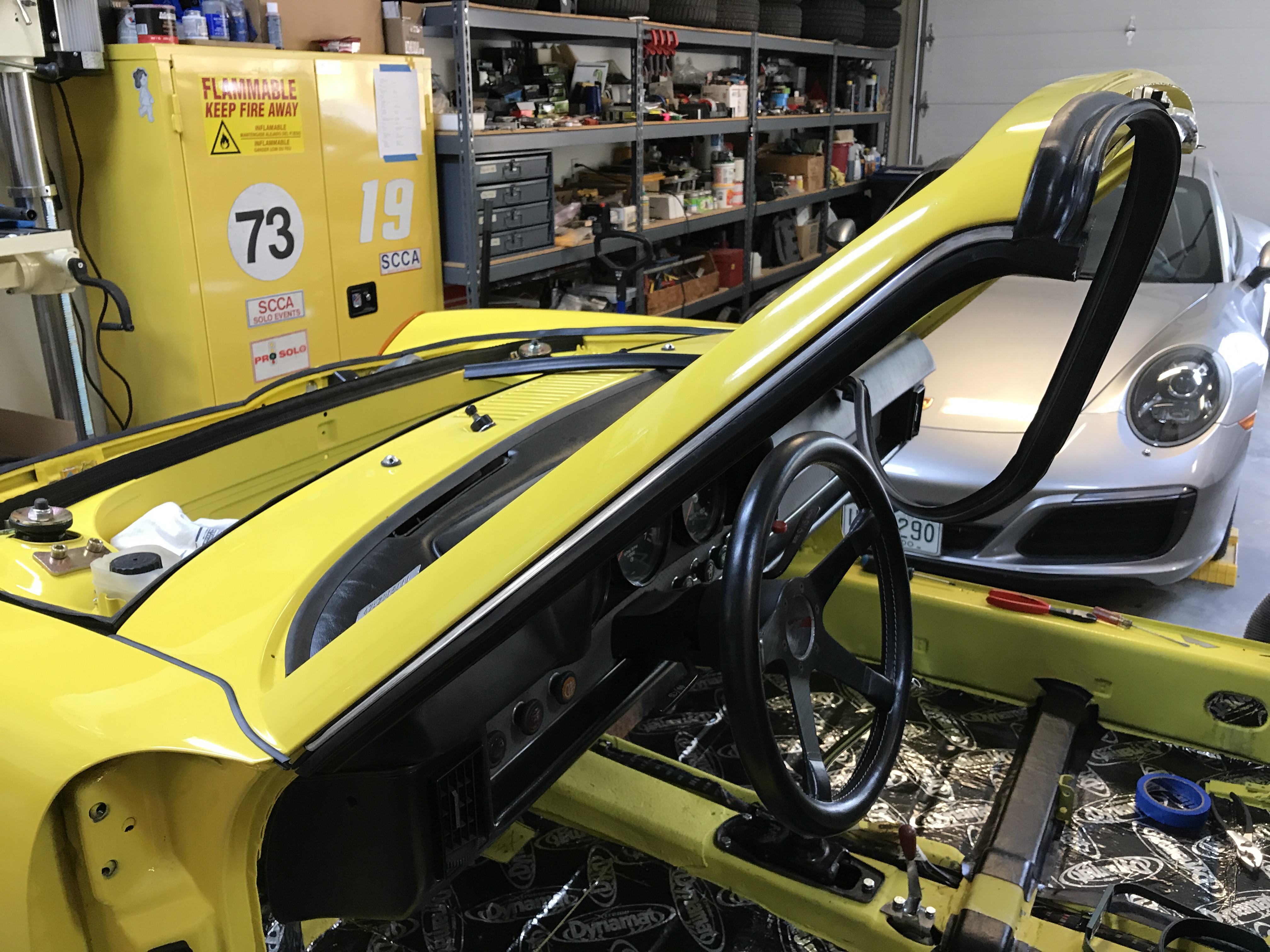

And then after about an hour of pushing and prying and squeezing, I had the left side done.
Post #3103
Posts: 8,800
And another half-hour for the right side.
post Jun 20 2021, 07:03 PM
Post #3104
Posts: 8,800

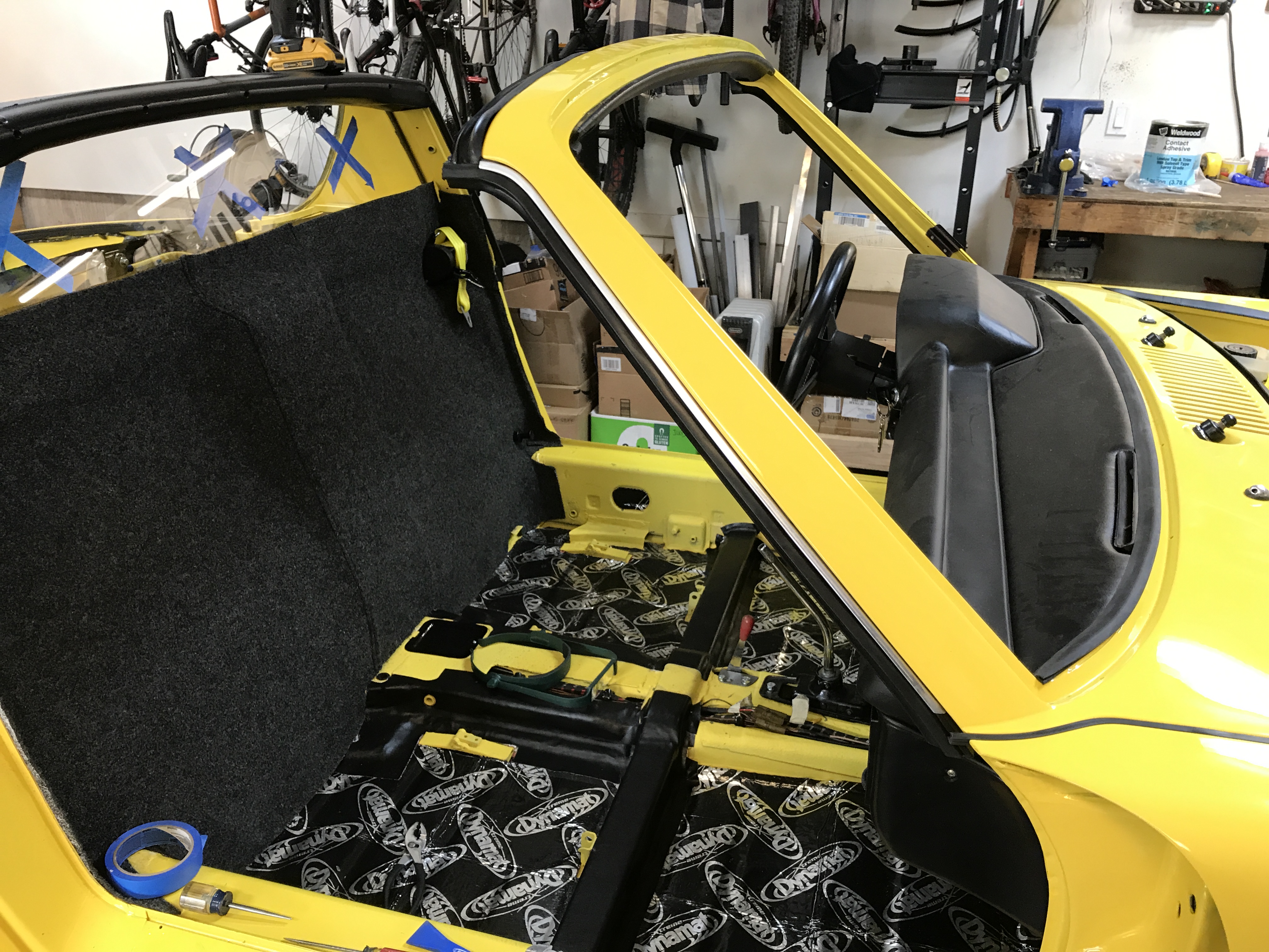

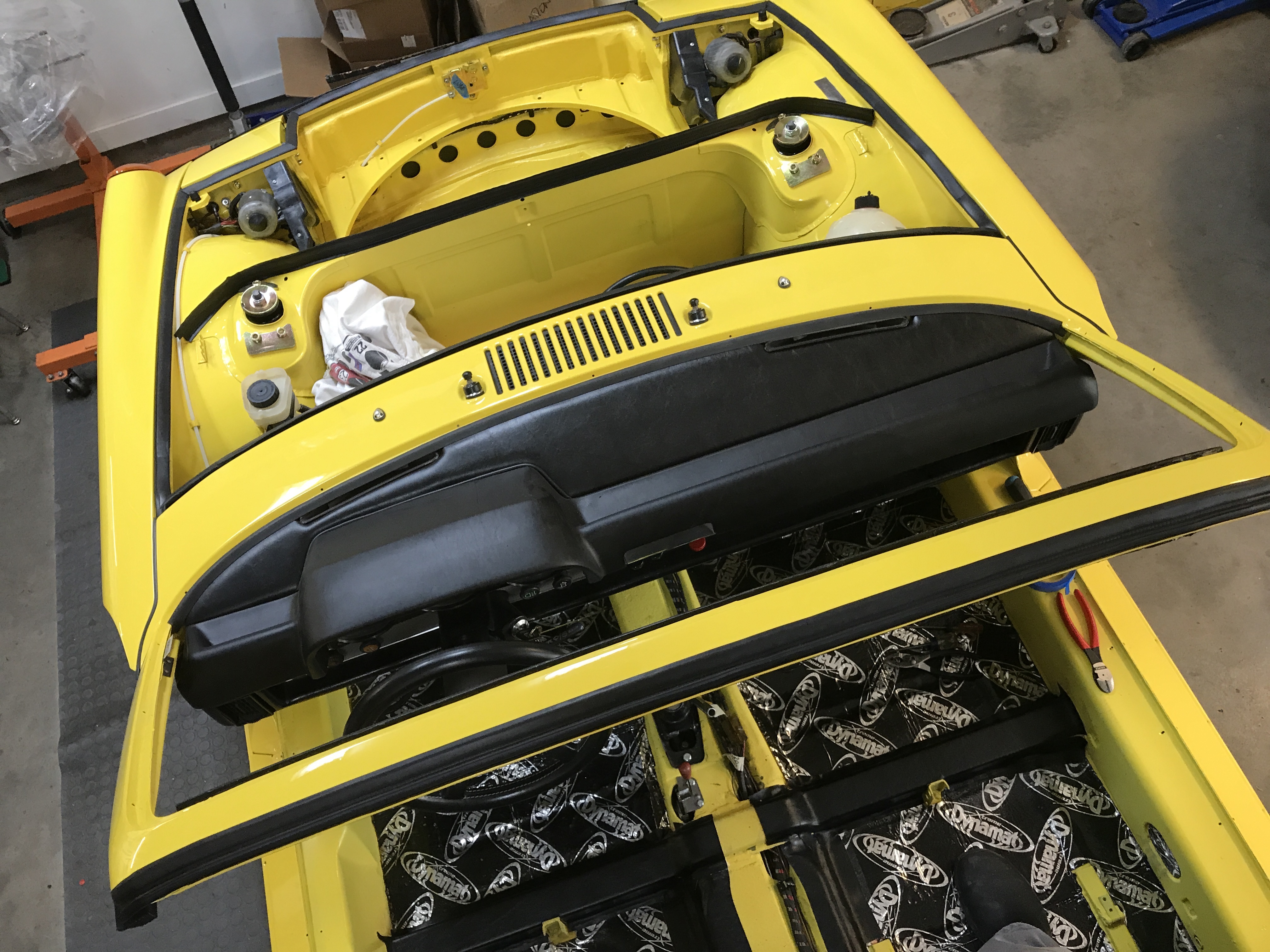

And then 5 minutes to get the top seated.
post Jun 20 2021, 07:05 PM
Post #3105
Posts: 8,800

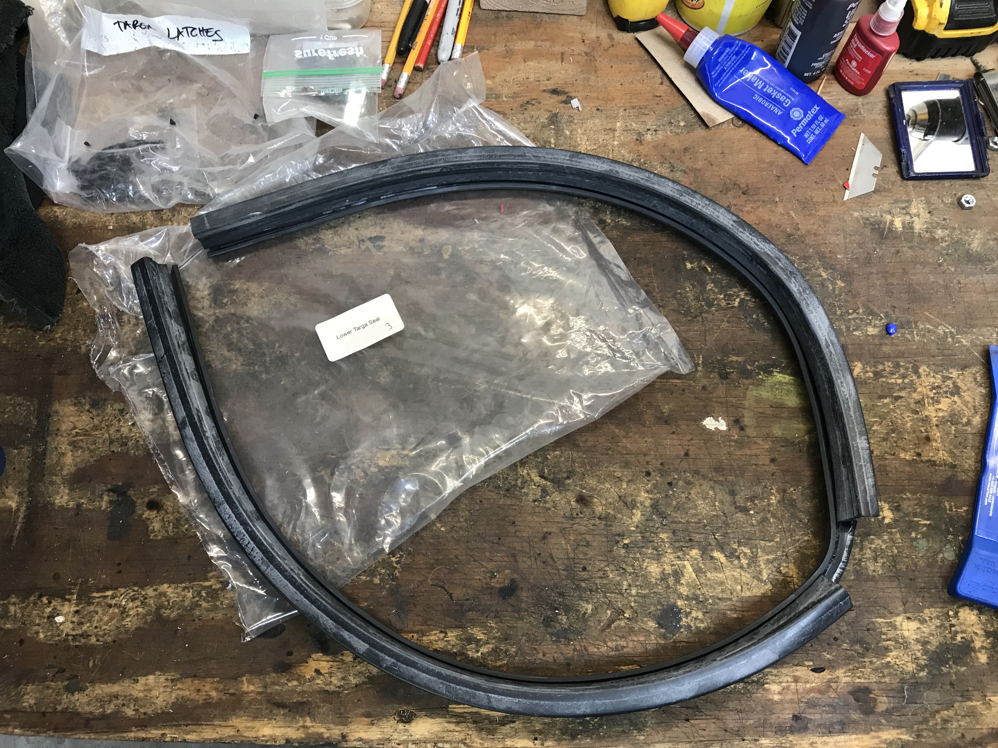

And then time for the lower strip.
post Jun 20 2021, 07:06 PM
Post #3106
Posts: 8,800
That was a pretty easy install, with some care to trim the ends at the correct angle.

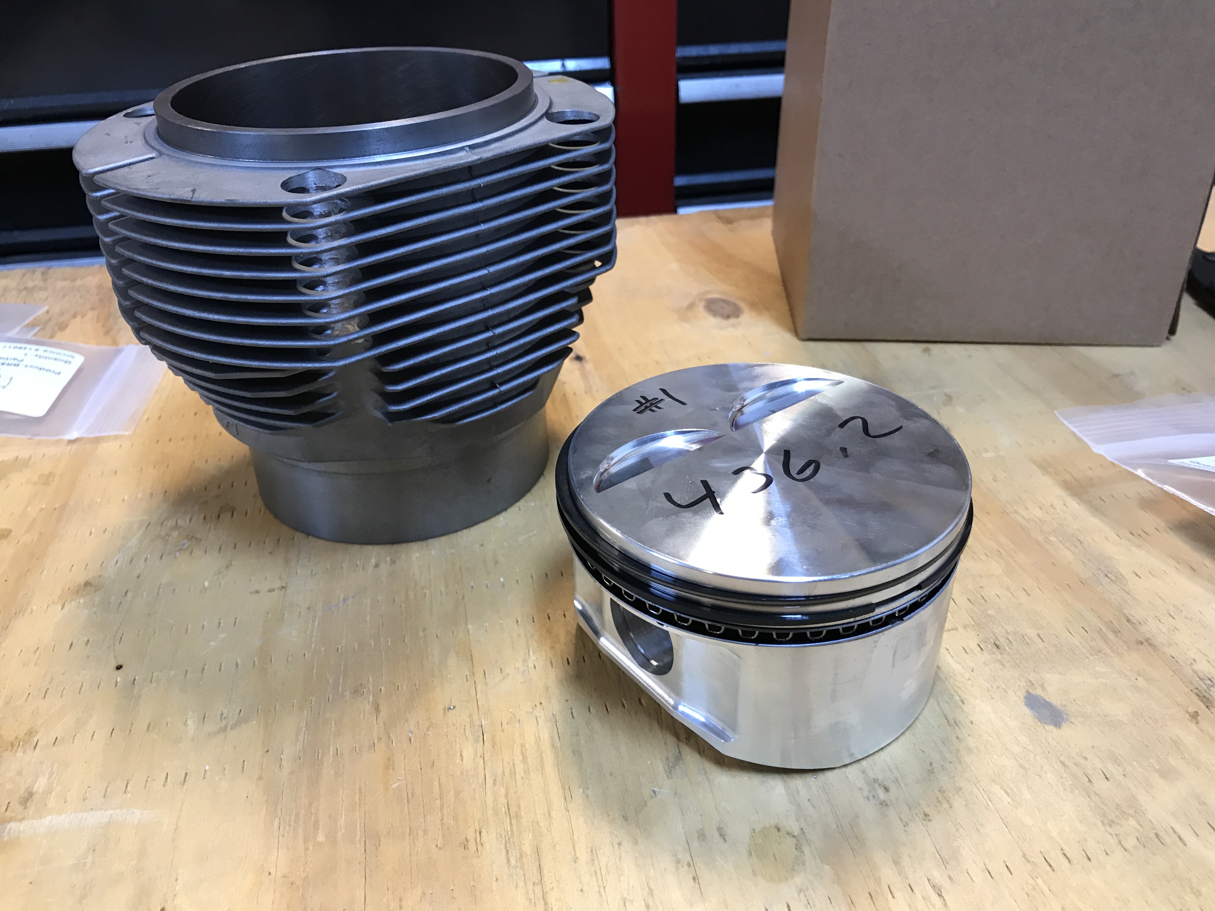

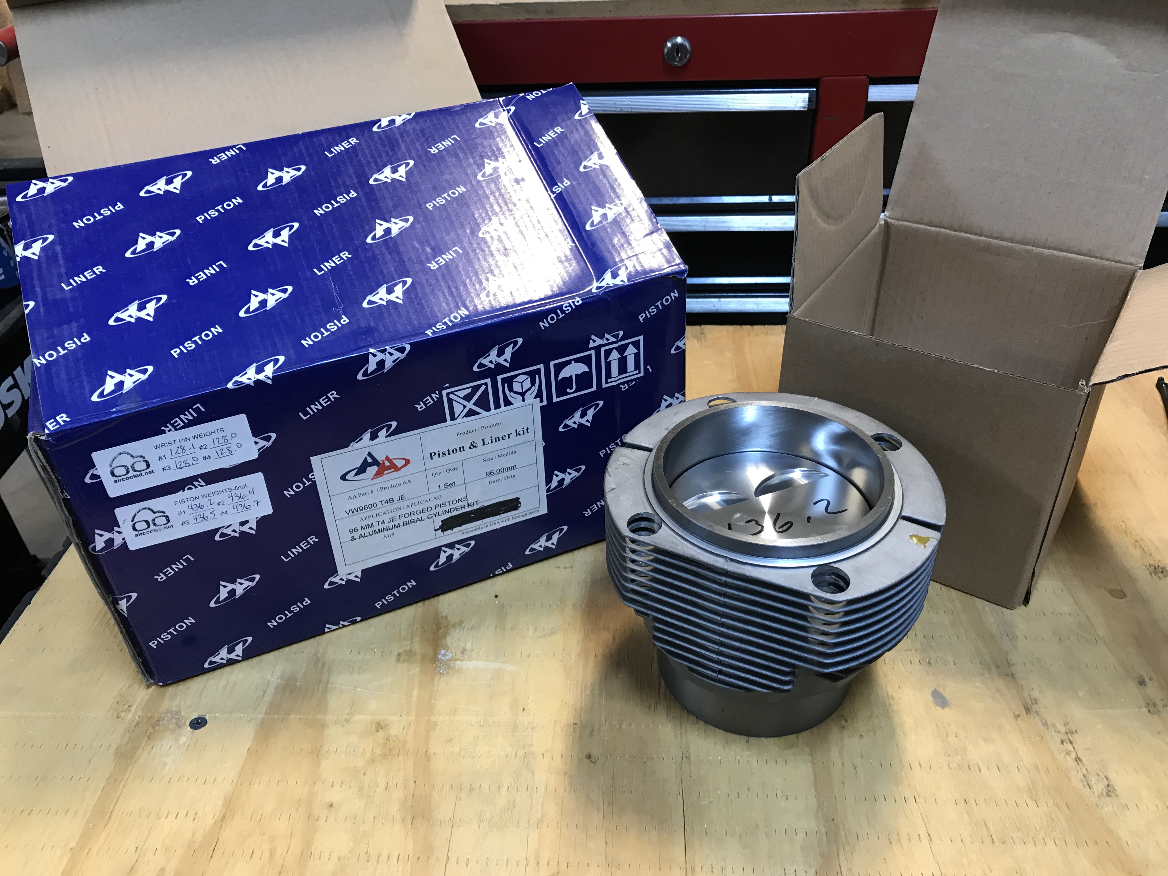

I decided to get back to some engine work, hoping to have my heads by the end of next week.
Today was ring gap day, so I opened the set of P&C from Aircooled.net, with 96 mm JE pistons and biral cylinders. I had them balance the pistons and pins.

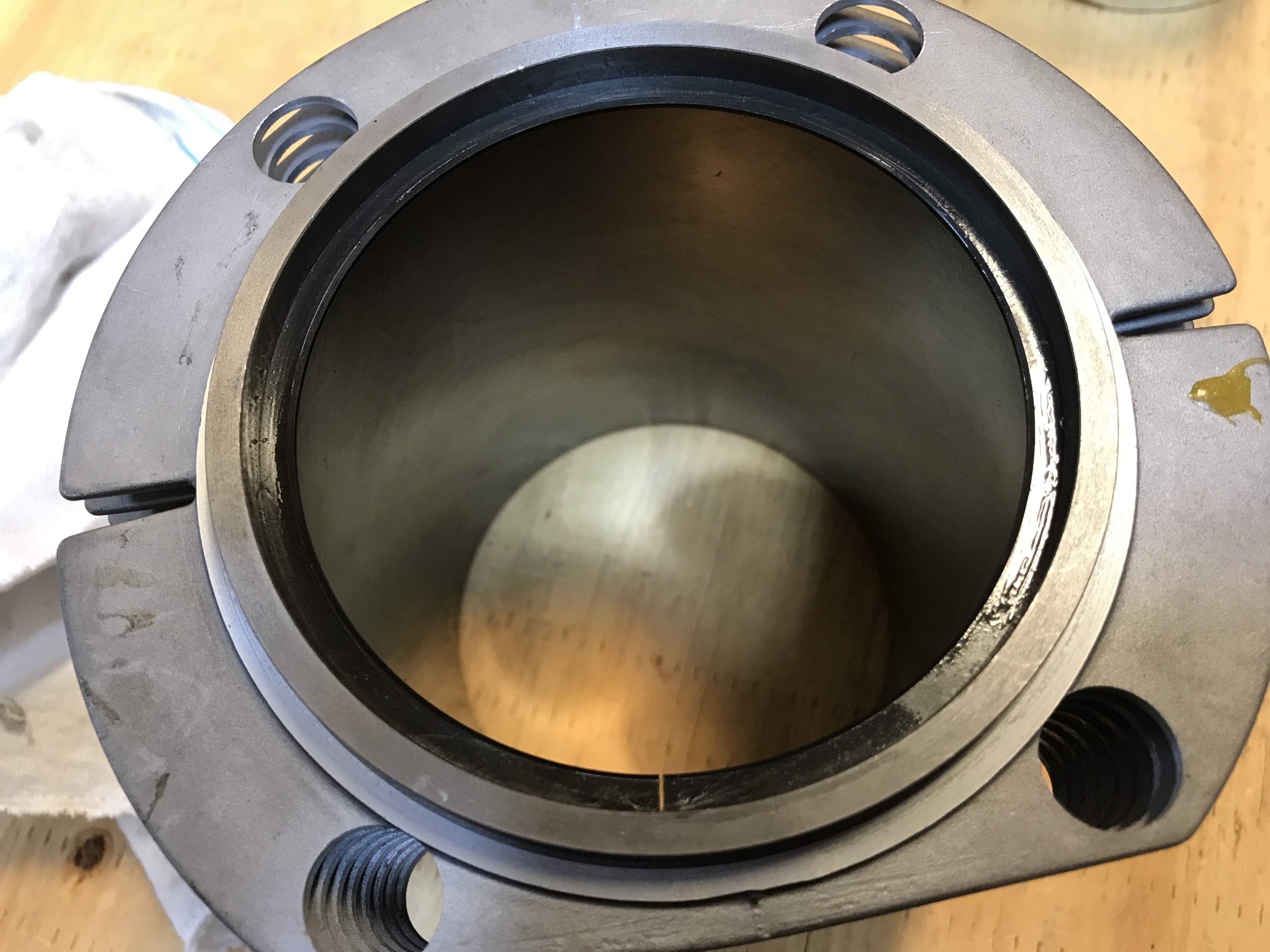

I removed the compression rings from each piston in turn.
post Jun 21 2021, 07:11 PM
Post #3109
Posts: 8,800
I measured the ring gaps in the cylinders. All were within spec.

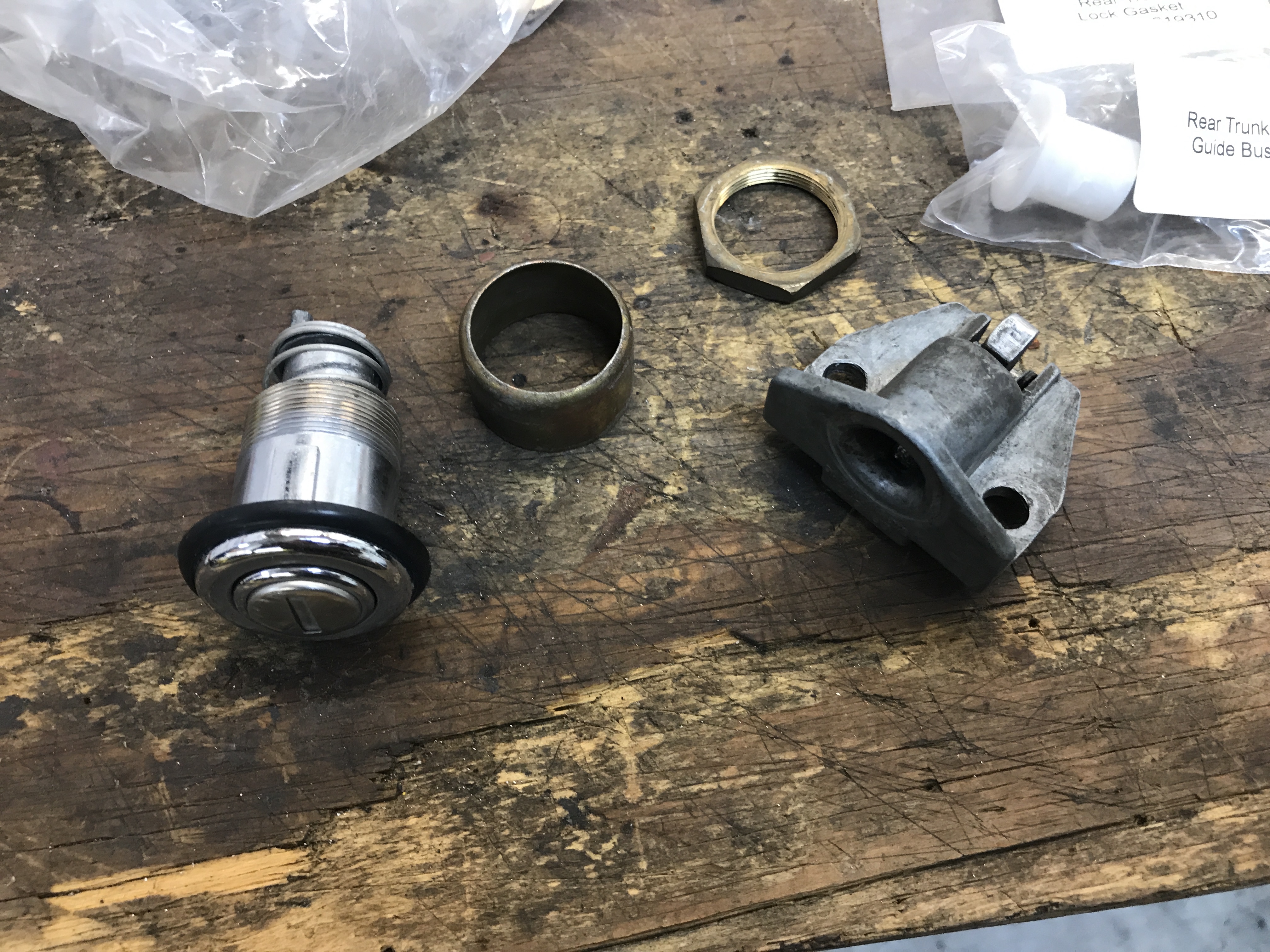

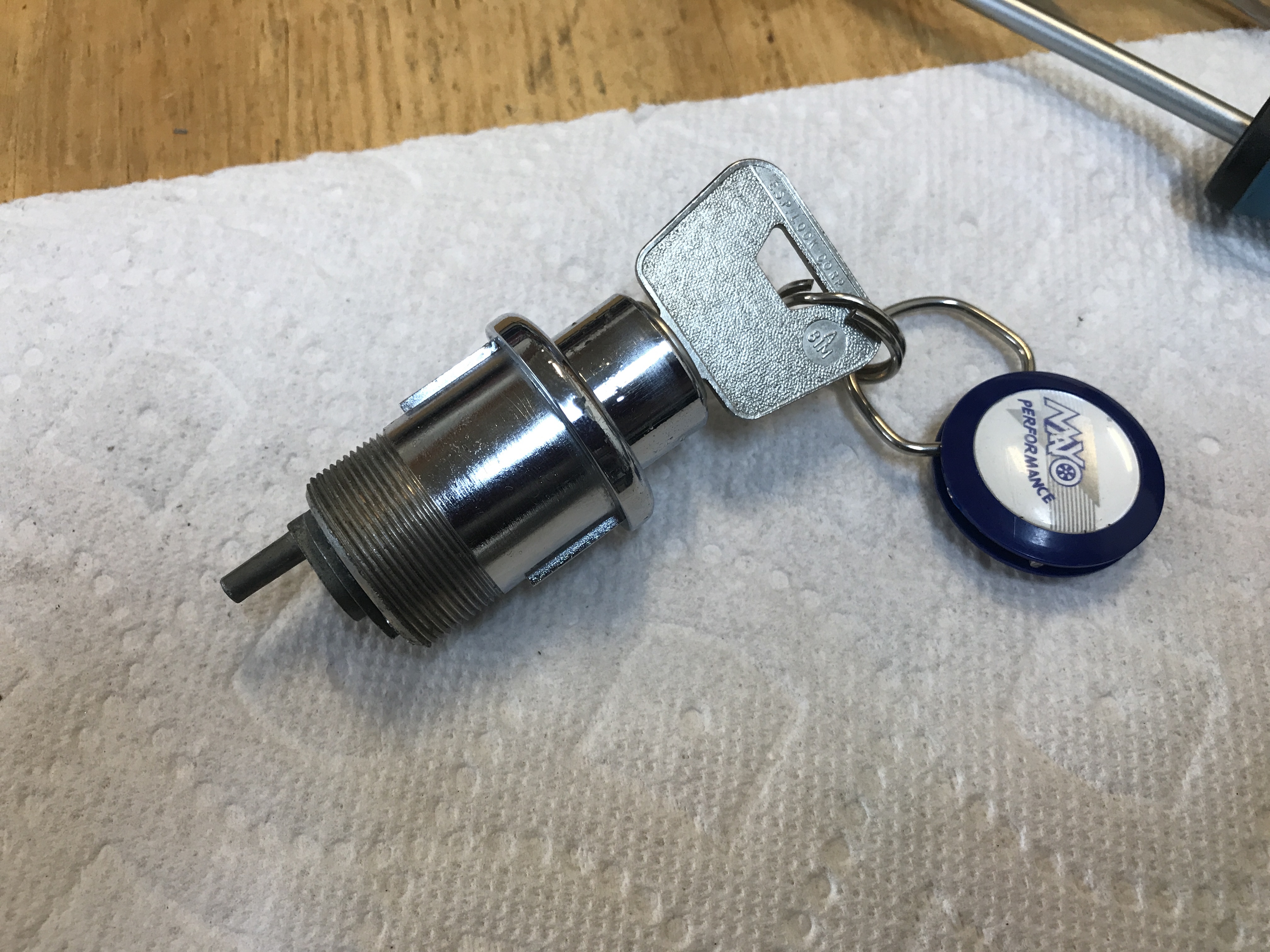

Another diversion today: I got out the trunk lock. This is a used replacement, since the car came with a non-functional electric lock release.
post Jun 22 2021, 07:24 PM
Post #3115
Posts: 8,800

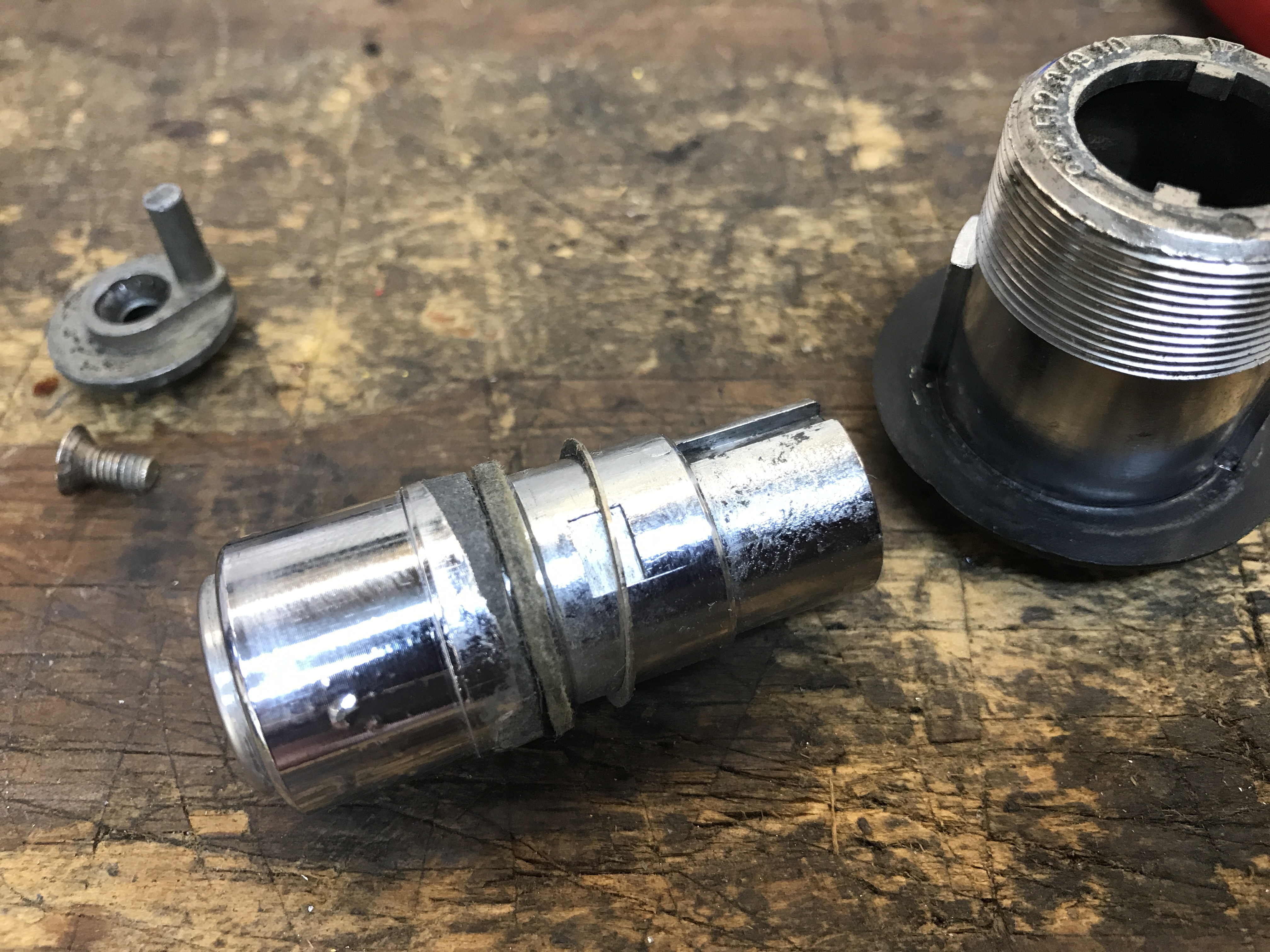

But that means re-keying the lock to match the rest of the car. Here is the lock partly disassembled.
post Jun 22 2021, 07:27 PM
Post #3116
Posts: 8,800

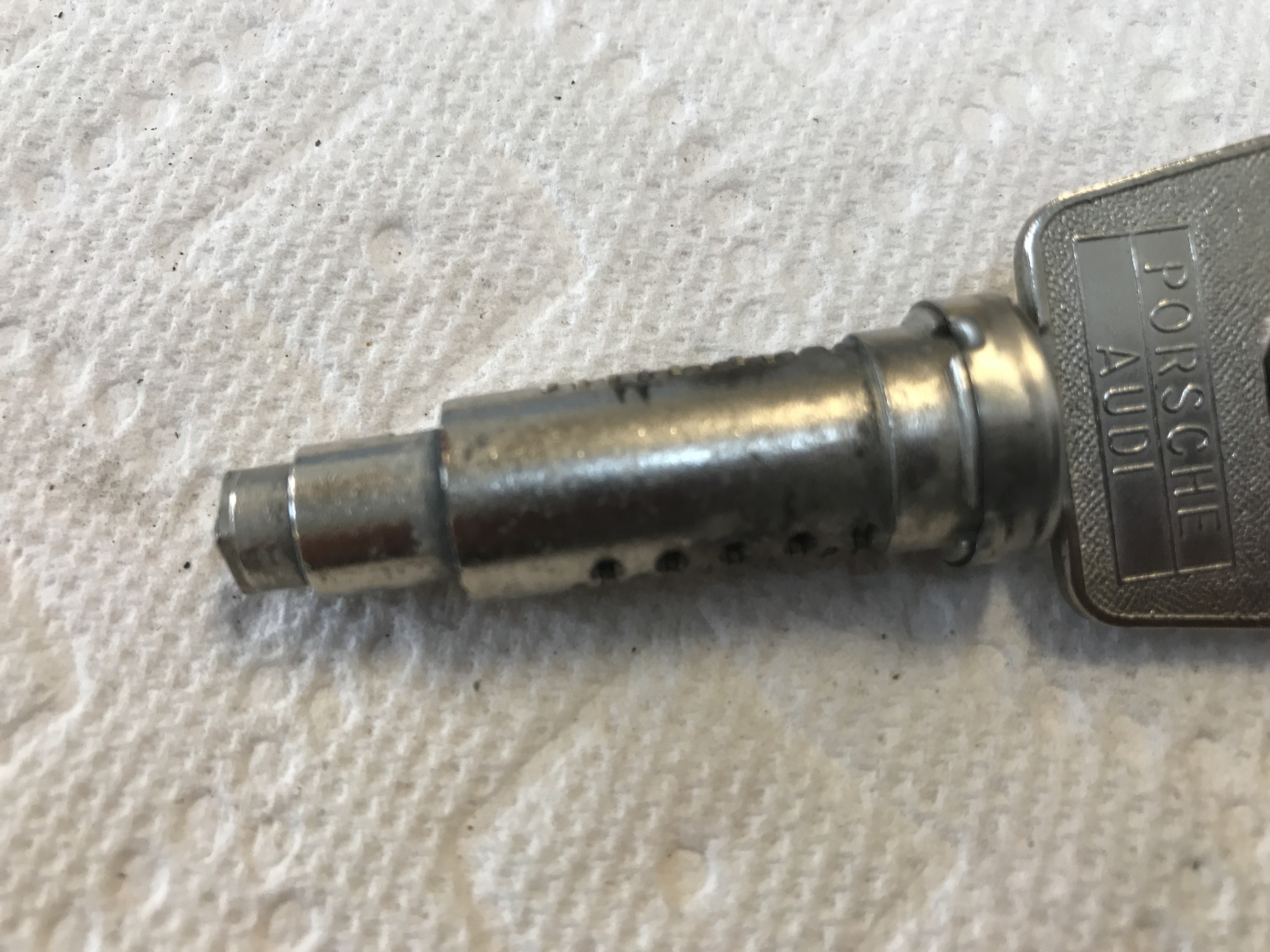

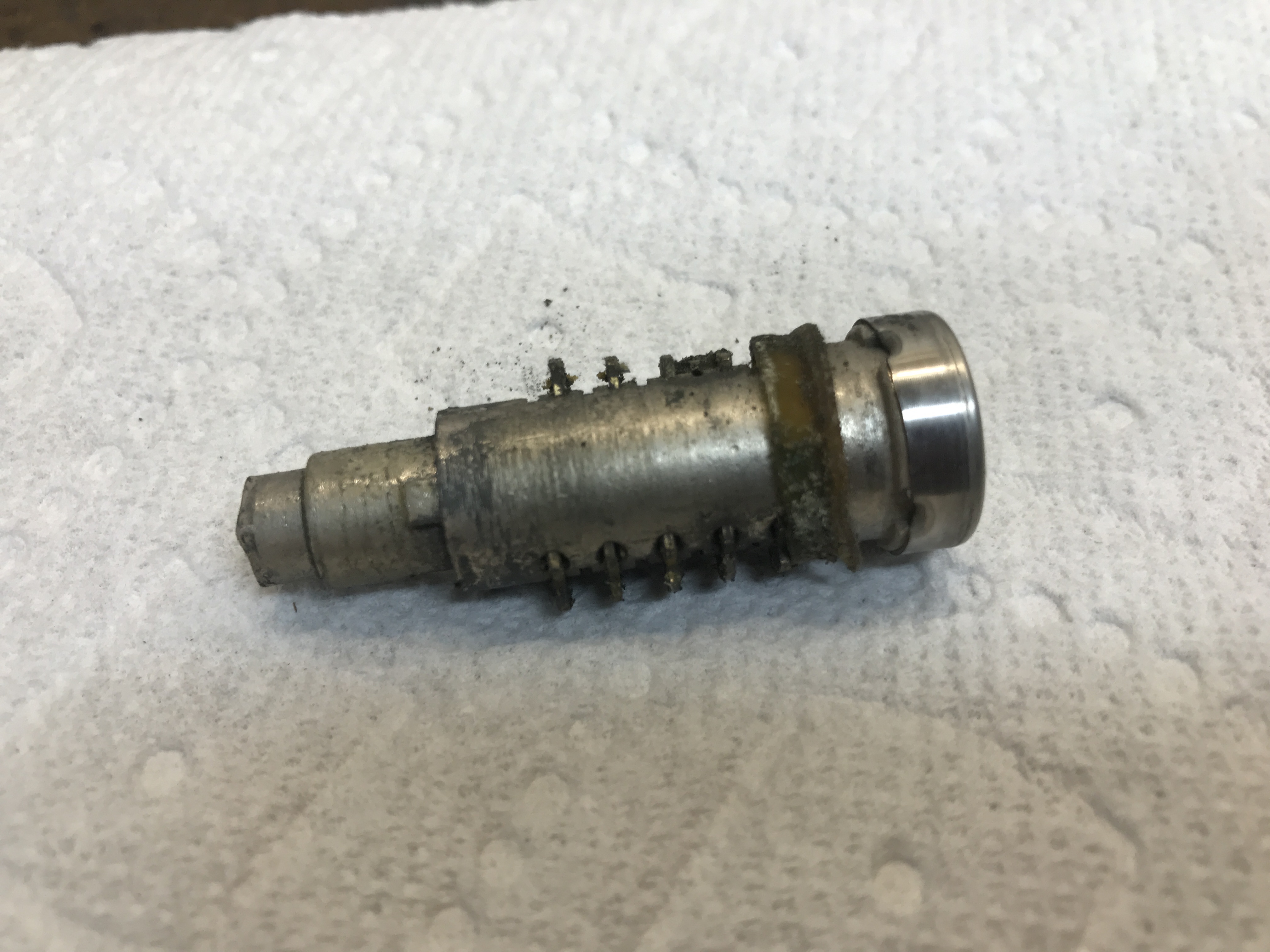

And the cylinder with all the original pins. I did not get a shot of the misalignment with the key installed, but most pins were too high or low.
post Jun 22 2021, 07:29 PM
Post #3117
Posts: 8,800
After some pin swapping, and just a bit of filing, I got the alignment looking good.
post Jun 22 2021, 07:30 PM
Post #3118
Posts: 8,800

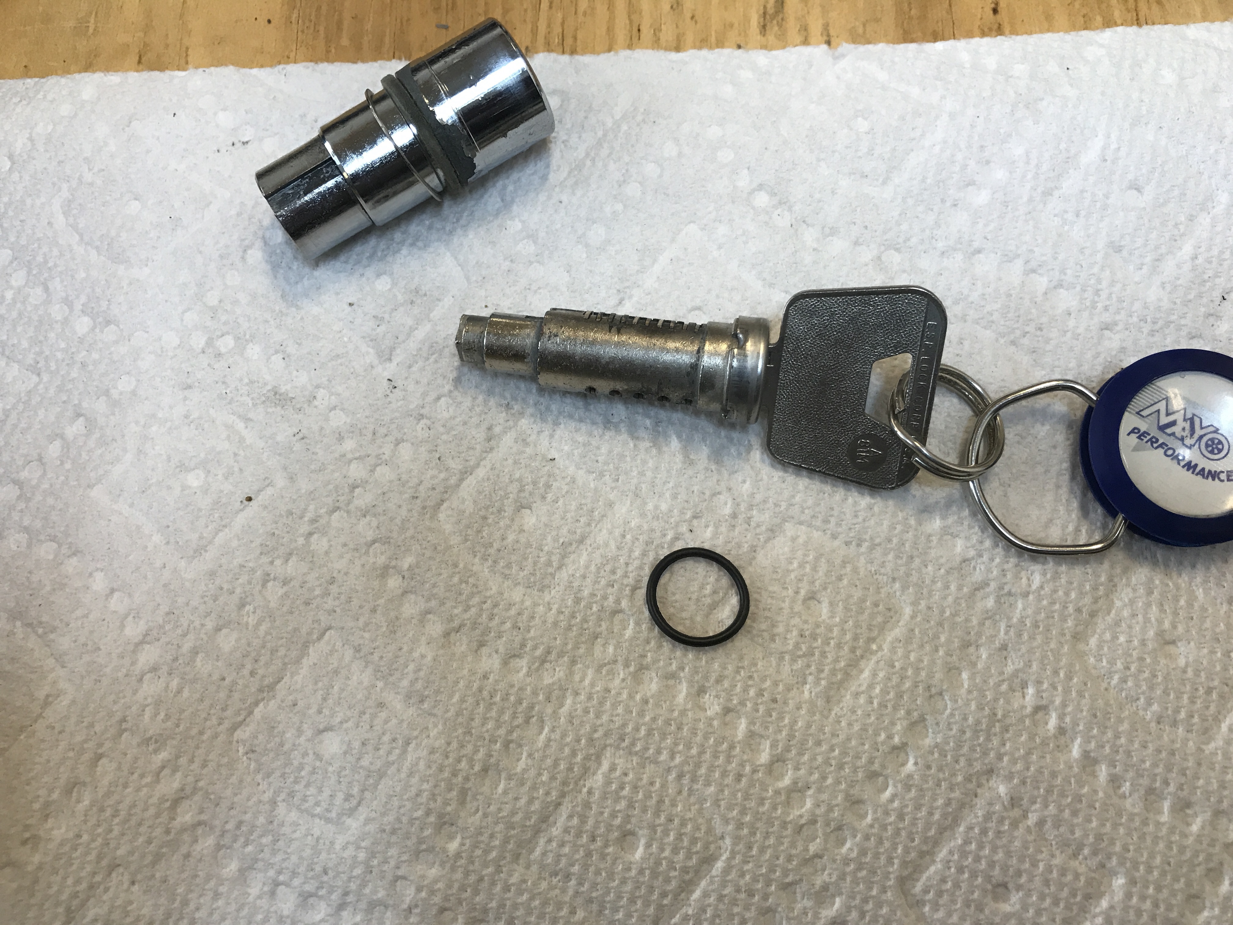

I substituted an O-ring for the original bushing.
post Jun 22 2021, 07:34 PM
Post #3119
Posts: 8,800
And then got the lock itself back together. (Yes, that is a vintage key ring from the shop of my old friend Ed Mayo, in Texas. It came with the car.)

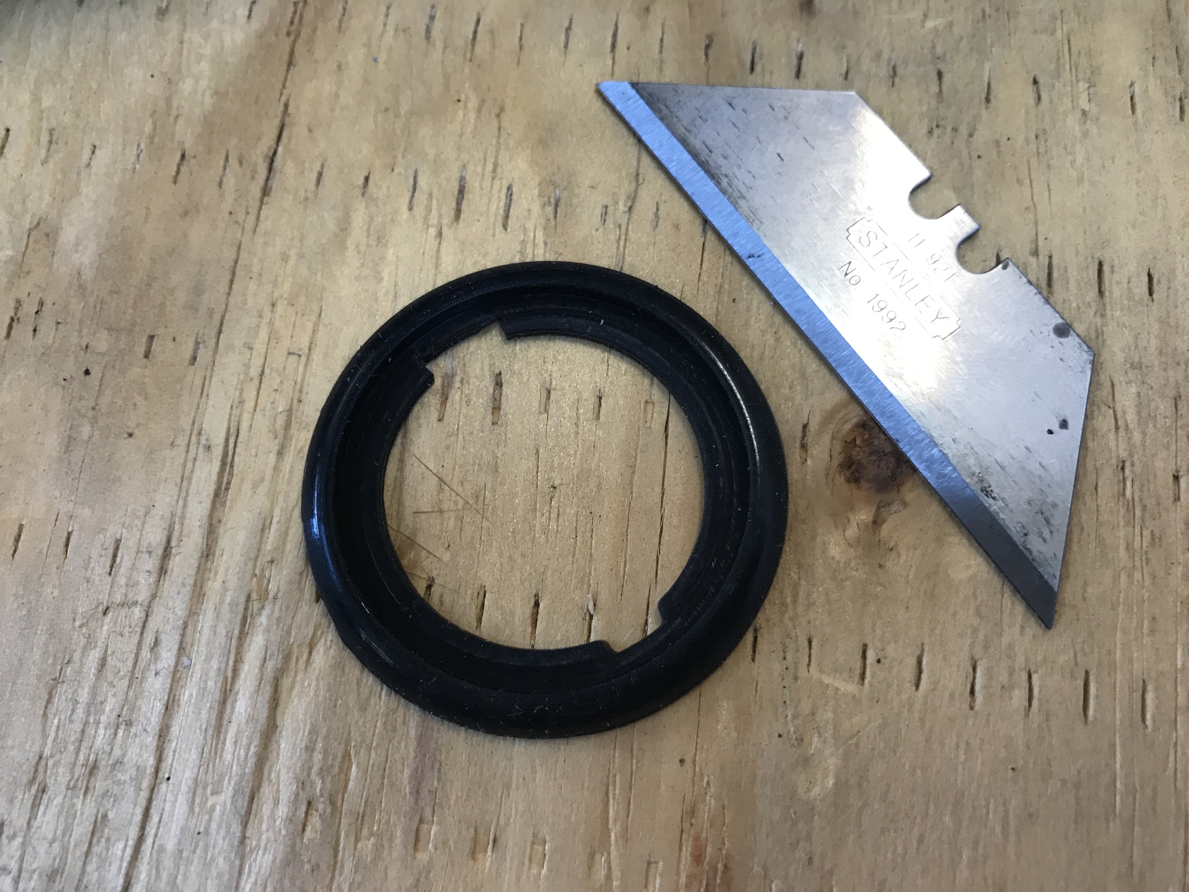

The new rubber gasket from 914Rubber needed one notch enlarged.
