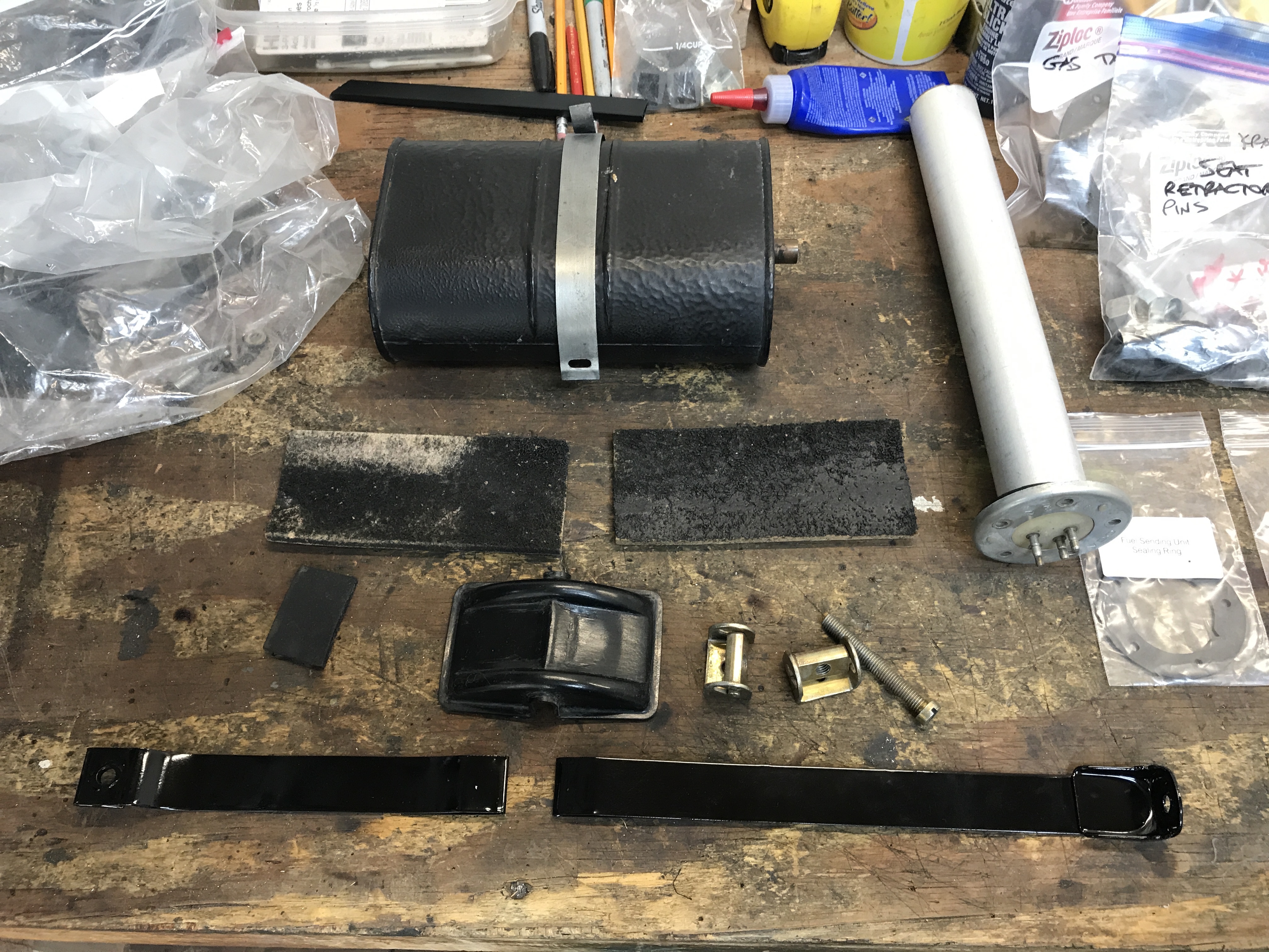

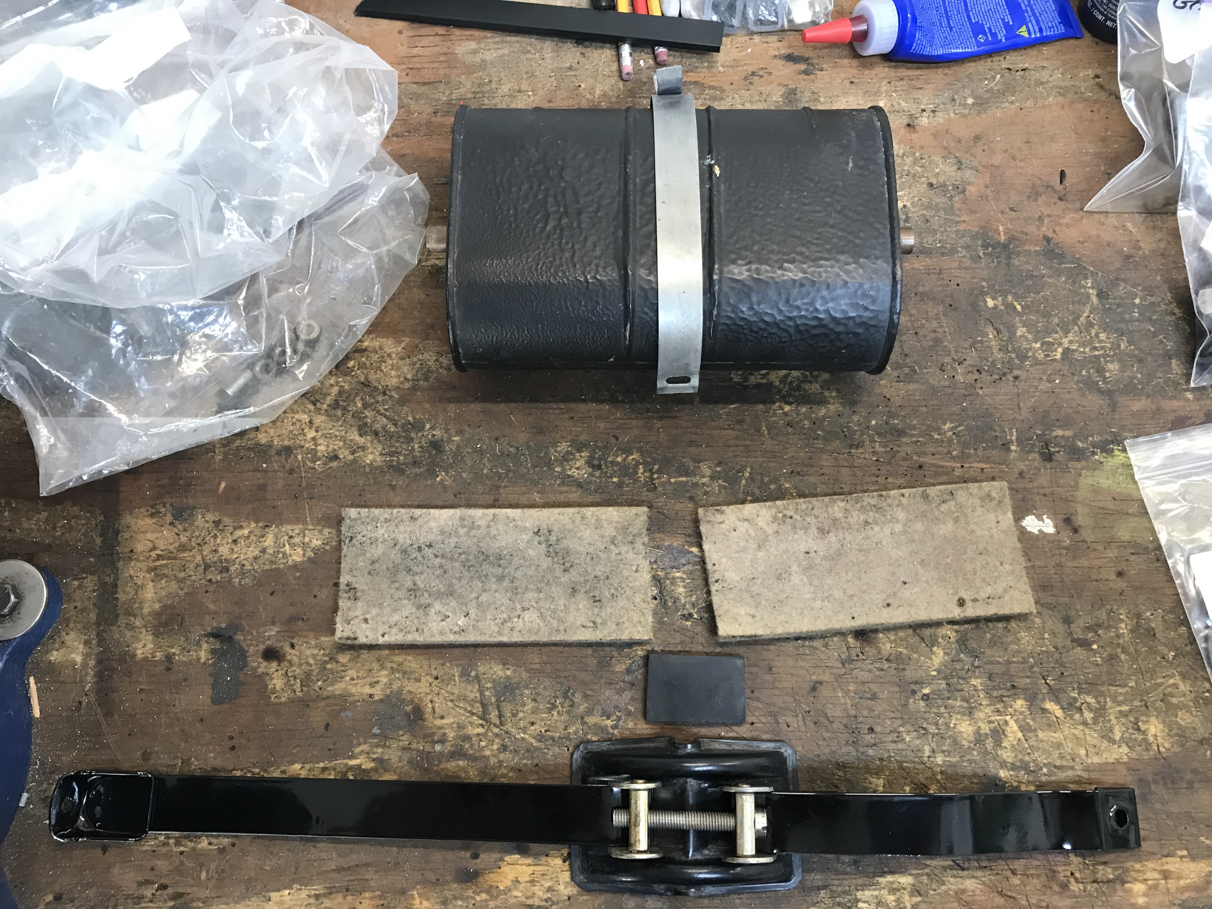

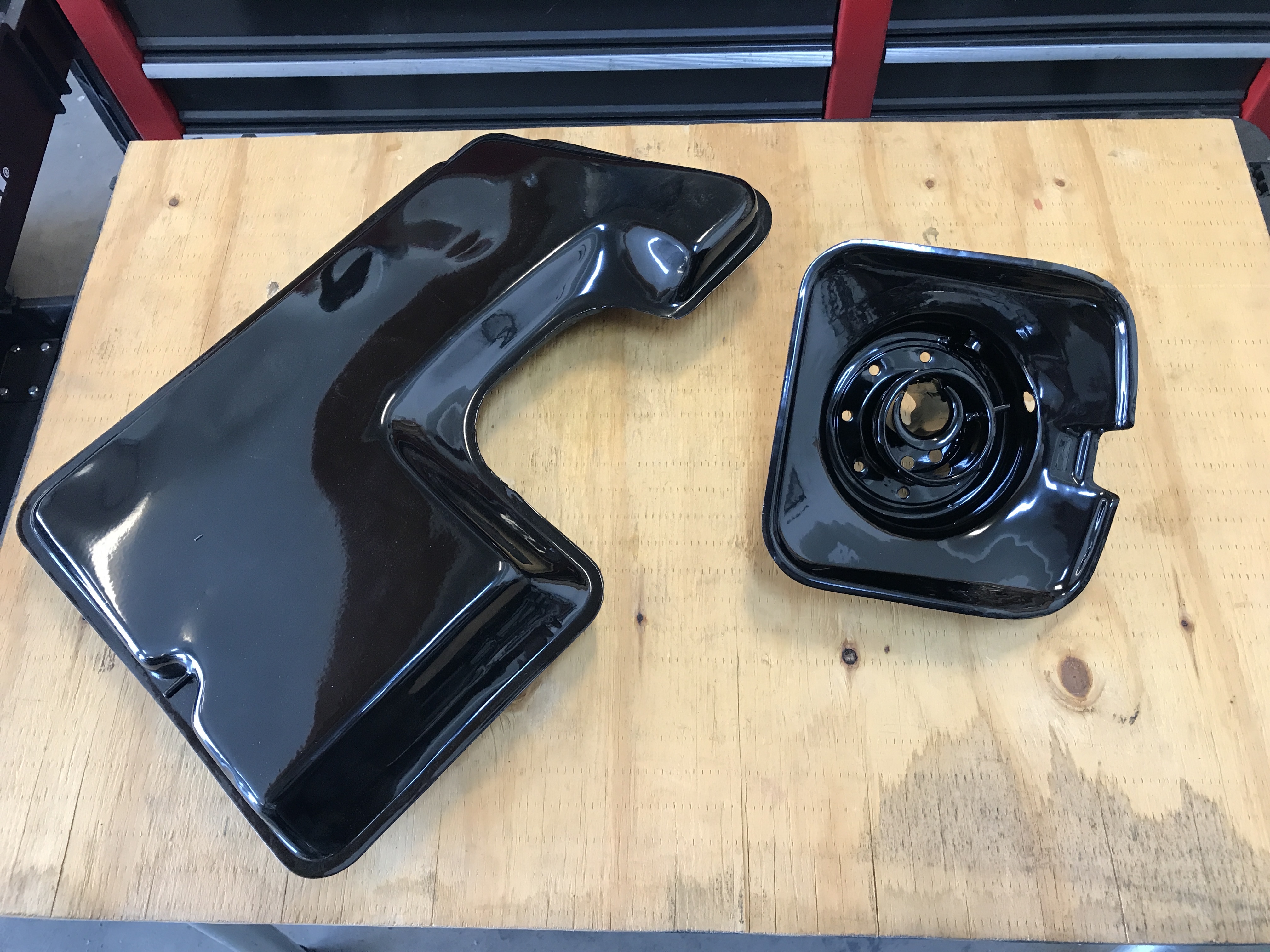

Here's all the stuff that goes on the tank. Some of this needs prep.
bkrantz
post Jun 26 2021, 07:30 PM
Post #3182
Posts: 8,800
Joined: 3-August 19
From: SW Colorado
Member No.: 23,343
I cleaned paint and undercoating from the felt pads. If I use these, I will try soaking them in some kinds of water-repellant lube. The retaining band sections were powder-coated.

Also powder-coated: the filler neck and expansion tank.

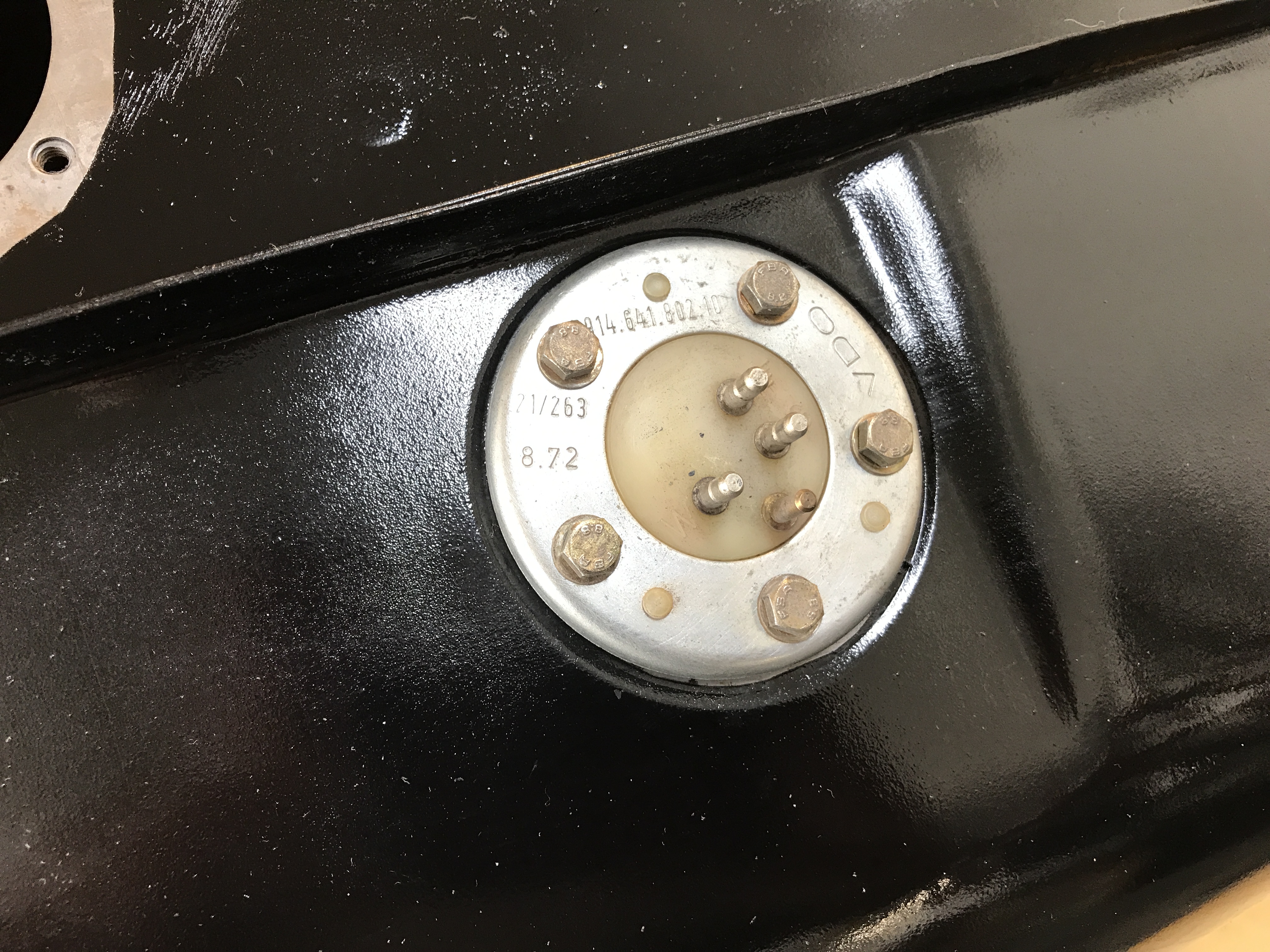

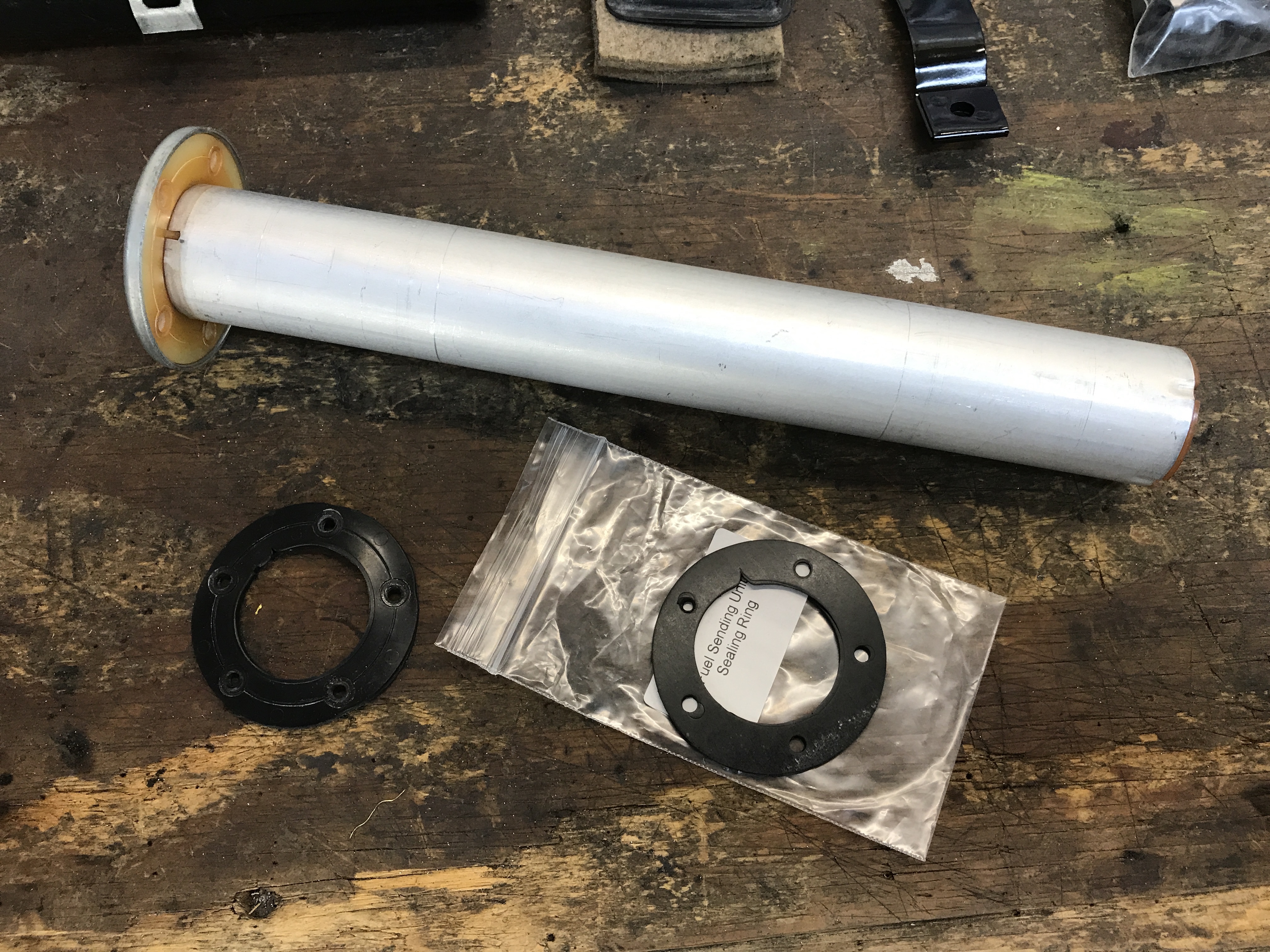

Member No.: 23,343
New gasket for the fuel lever sender.
bkrantz
post Jun 26 2021, 07:34 PM
Post #3186
Posts: 8,800
Joined: 3-August 19
From: SW Colorado
Member No.: 23,343
Sender installed. The bolt spacing is not even, so it goes in only one way.

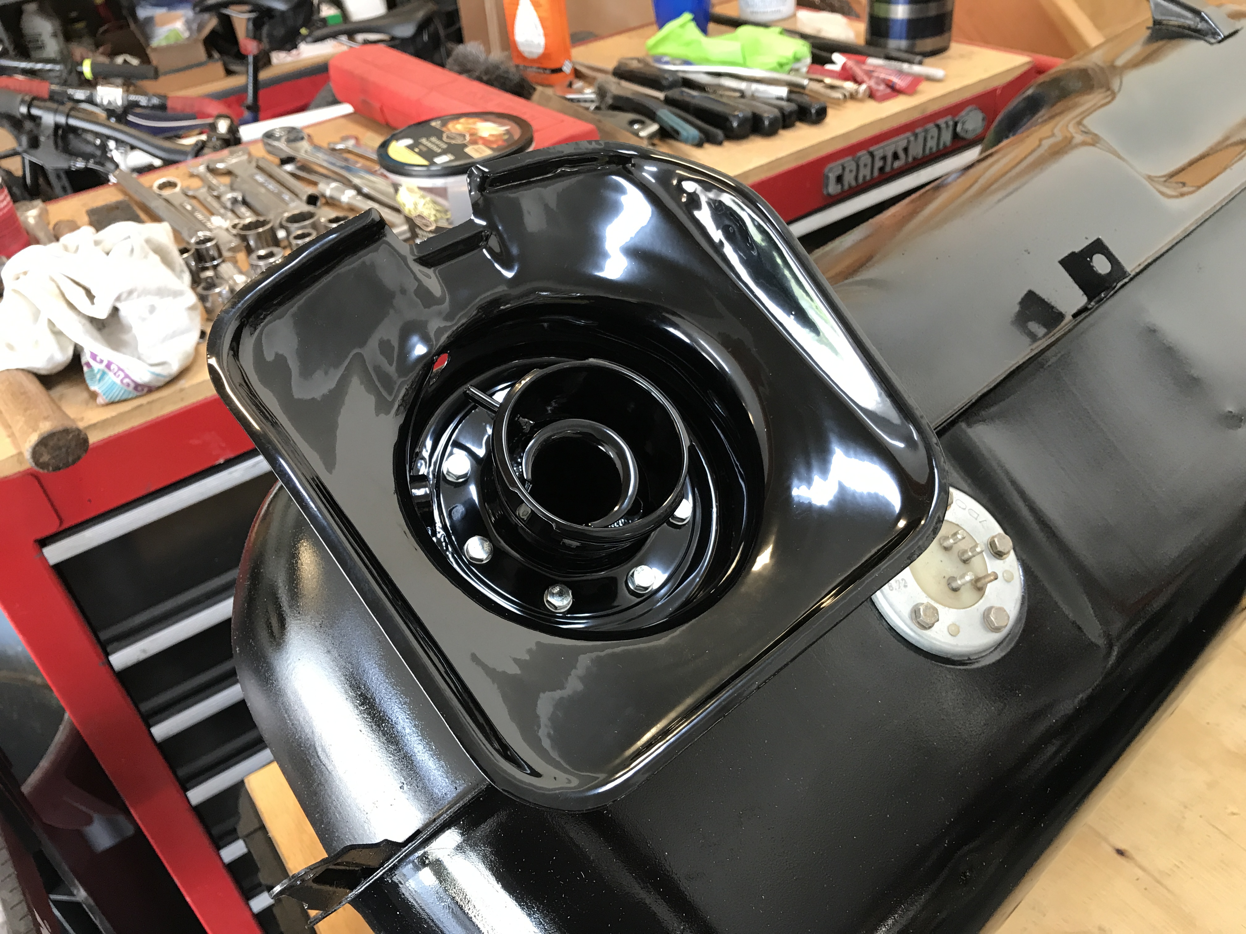

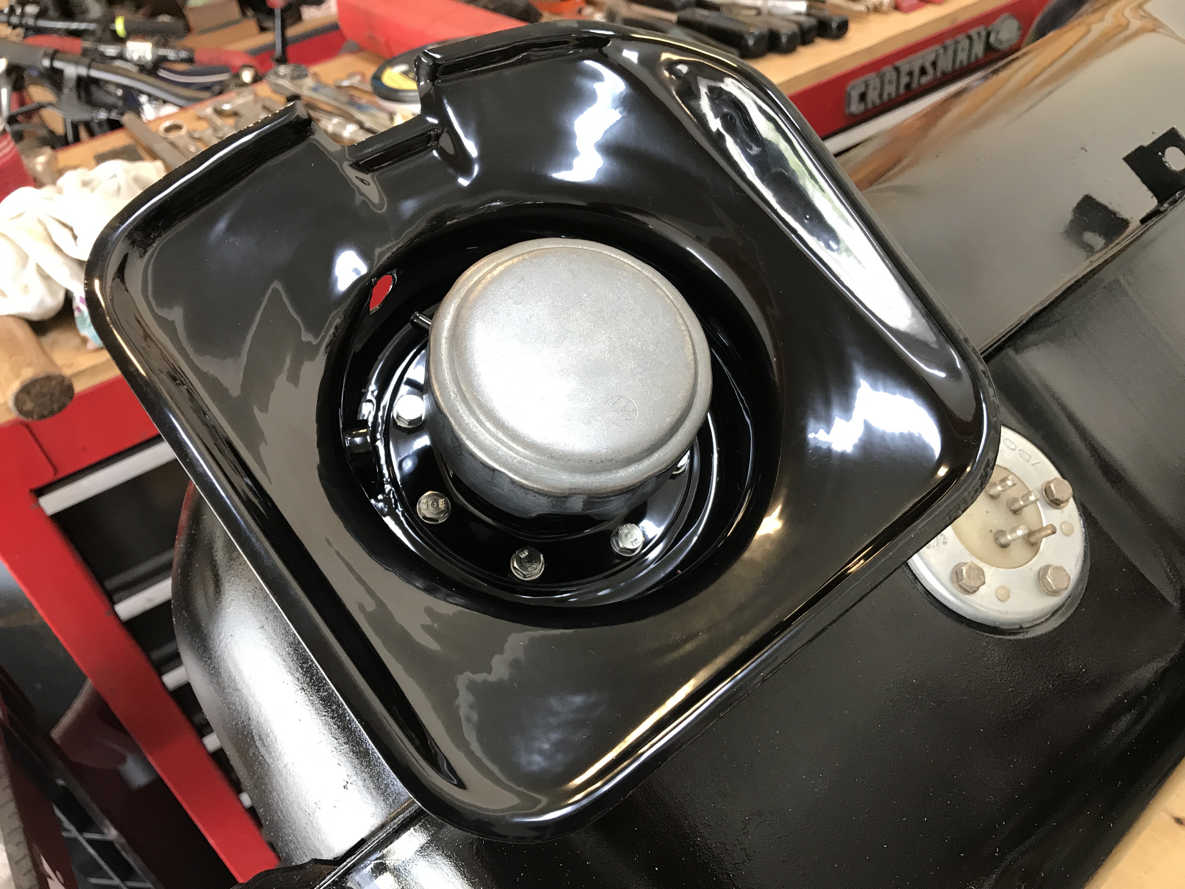

Filler neck, with another new gasket.

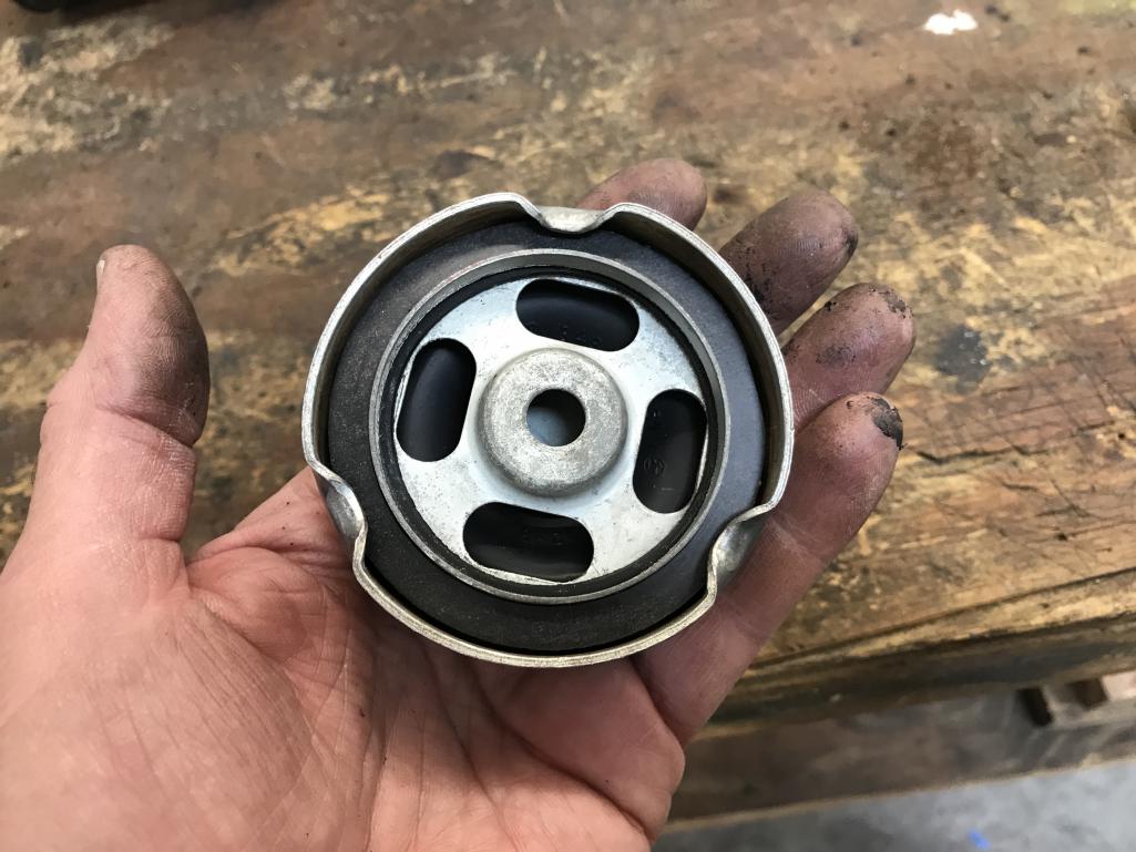

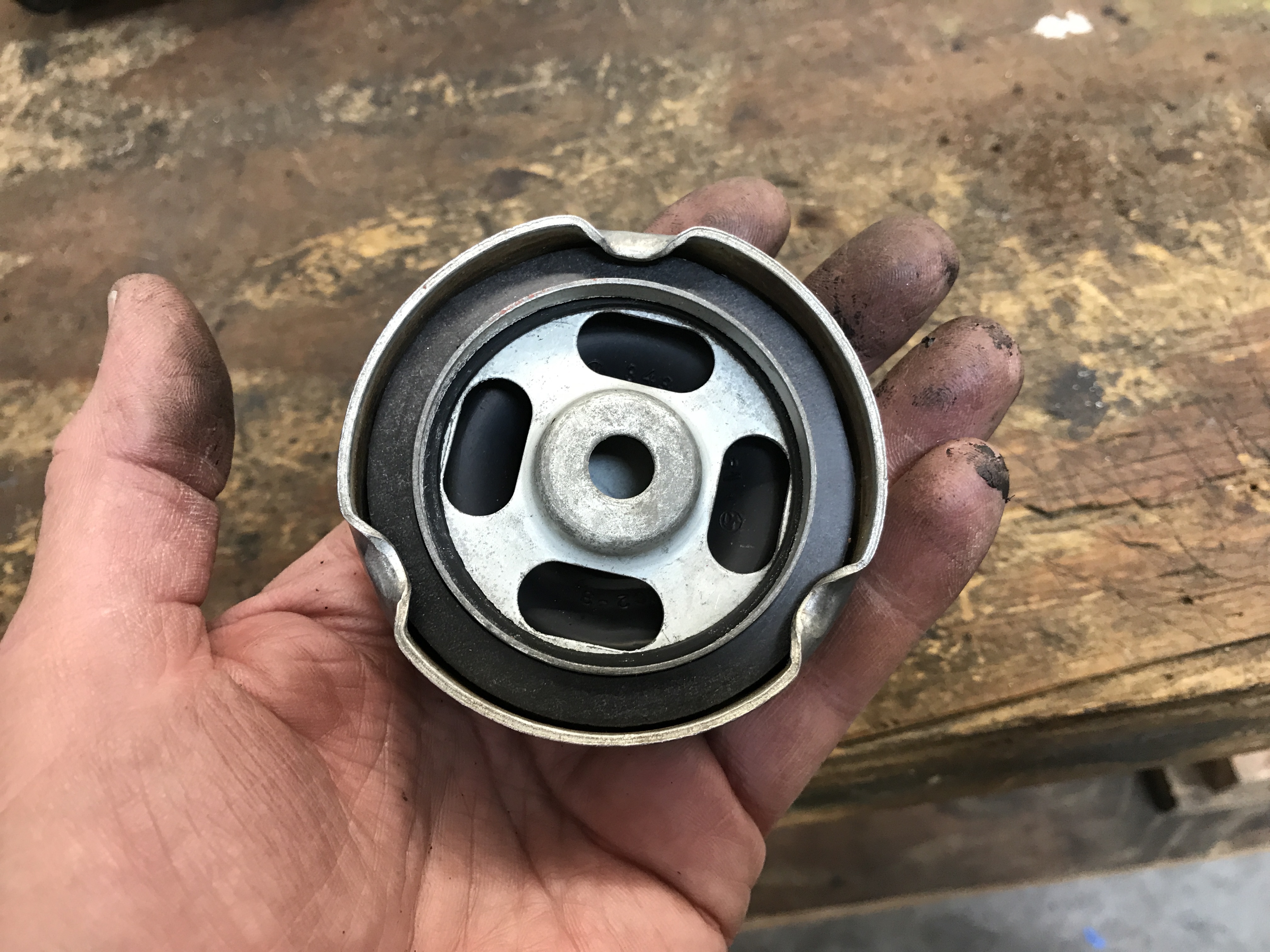

I replaced the gasket in the cap a while ago.
bkrantz
post Jun 26 2021, 07:36 PM
Post #3189
Posts: 8,800
Joined: 3-August 19
From: SW Colorado
Member No.: 23,343
Cap in place.

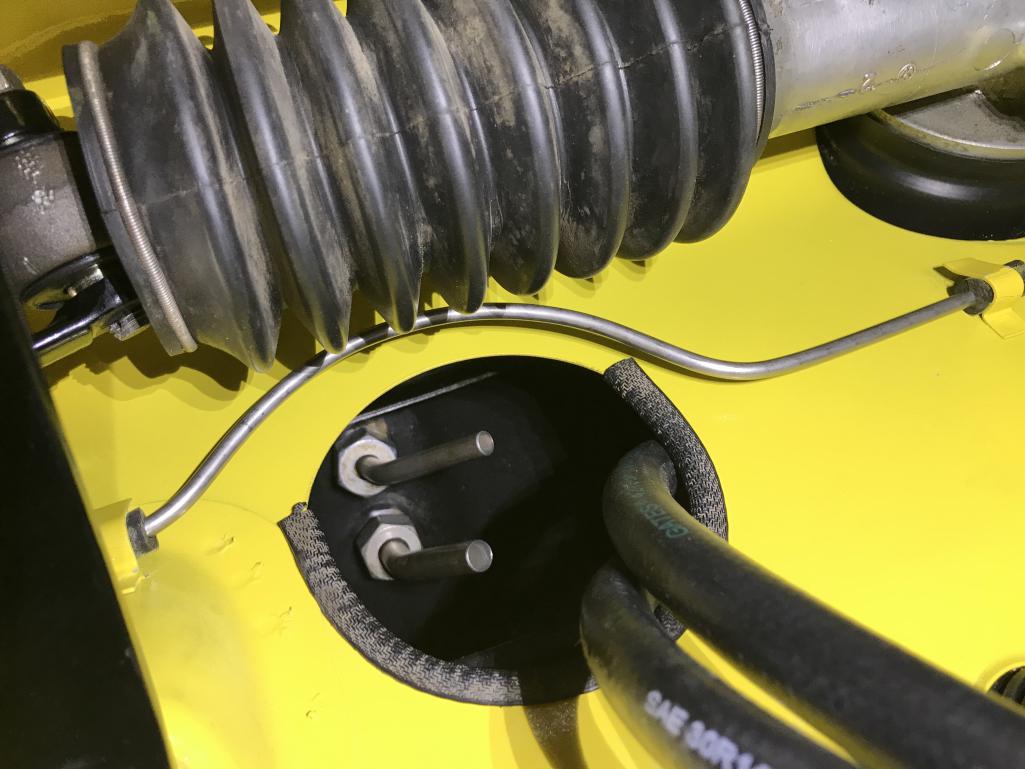

Member No.: 23,343

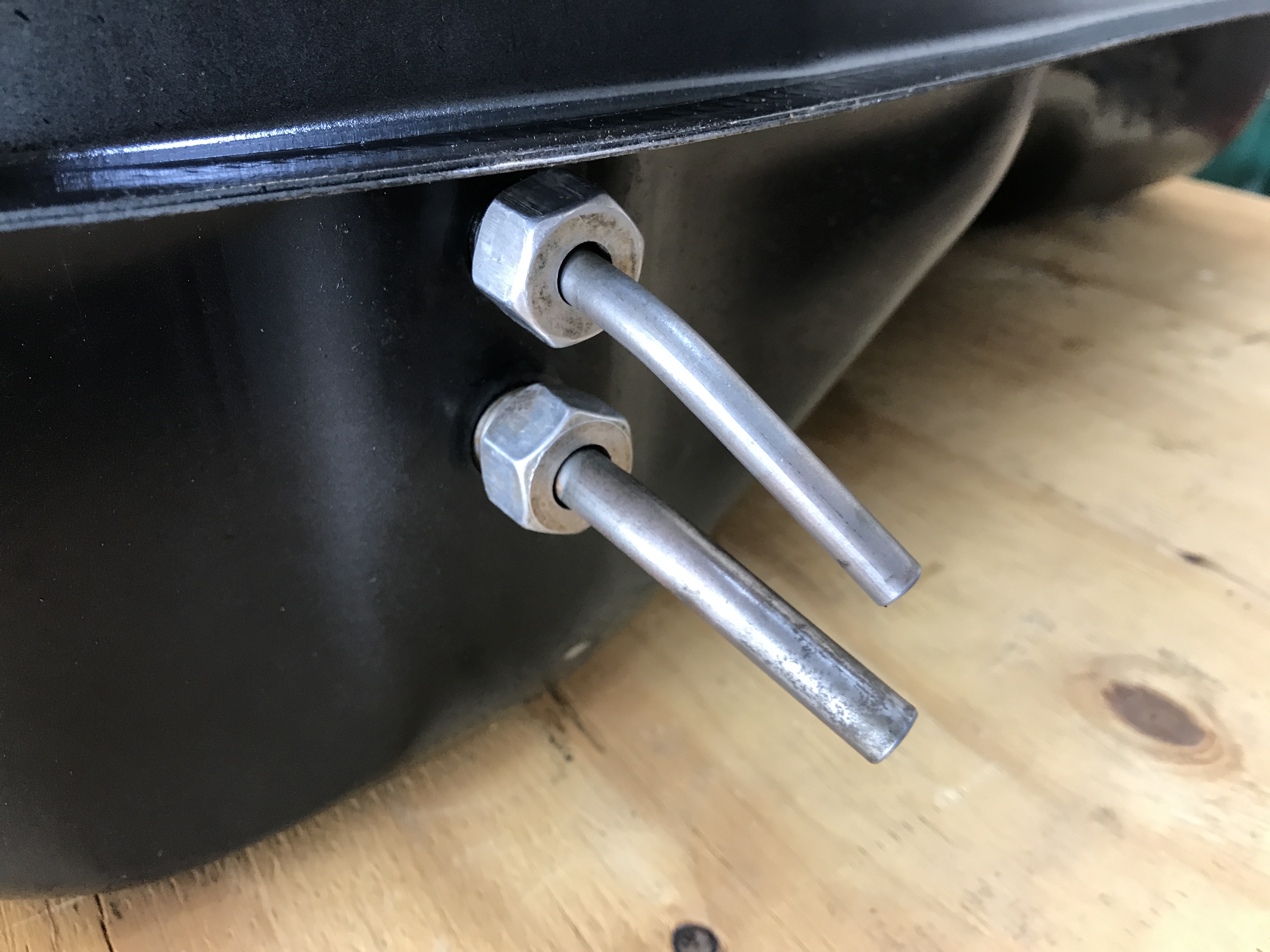

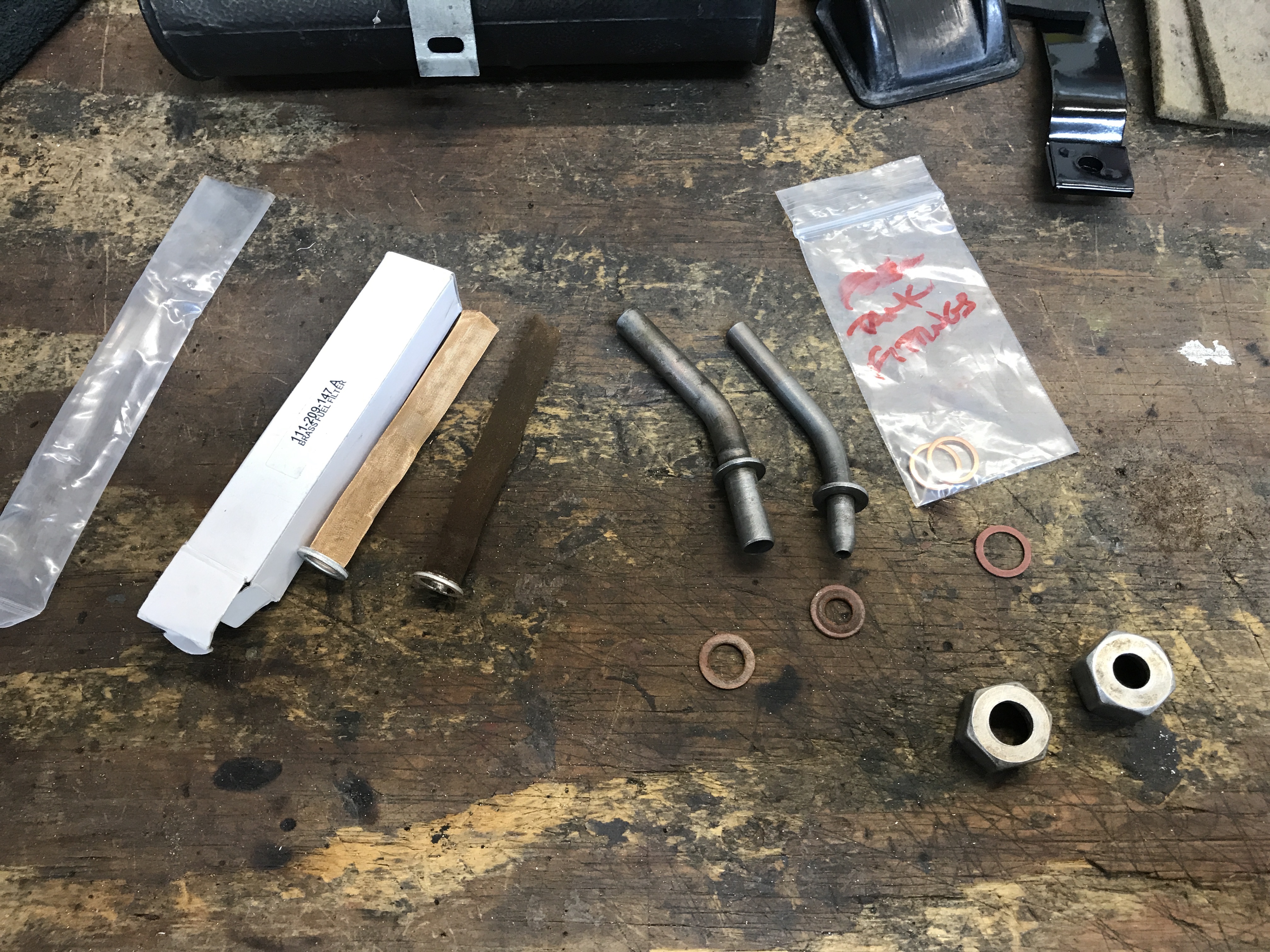

Lower tank connections and hardware, including a new screen and copper gaskets.
bkrantz
post Jun 26 2021, 07:40 PM
Post #3191
Posts: 8,800
Joined: 3-August 19
From: SW Colorado
Member No.: 23,343
Fittings in place, but loose for now.

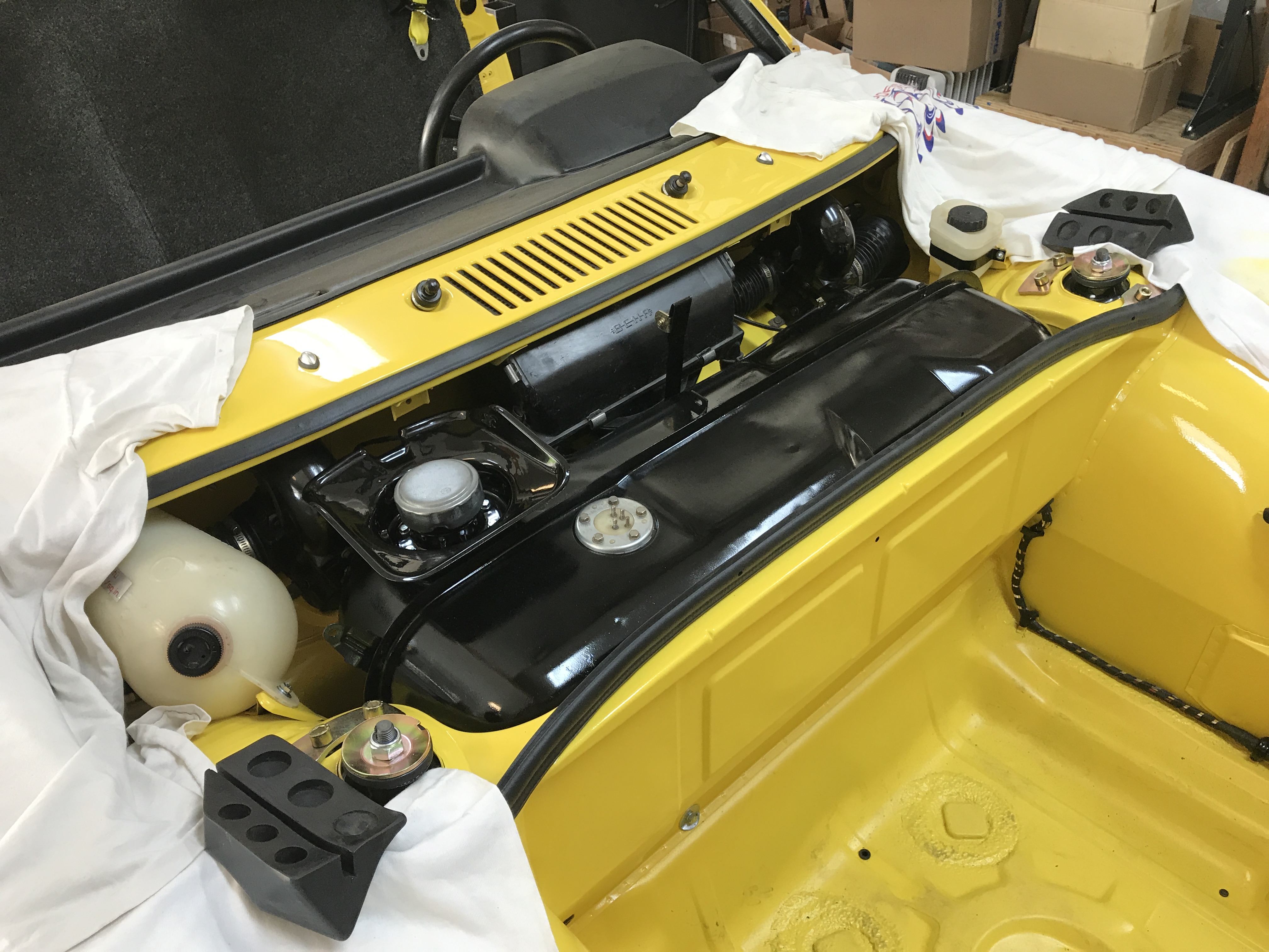

I dropped the tank in, but can't install it yet since I took the cowl braces back to the paint shop.

Member No.: 23,343

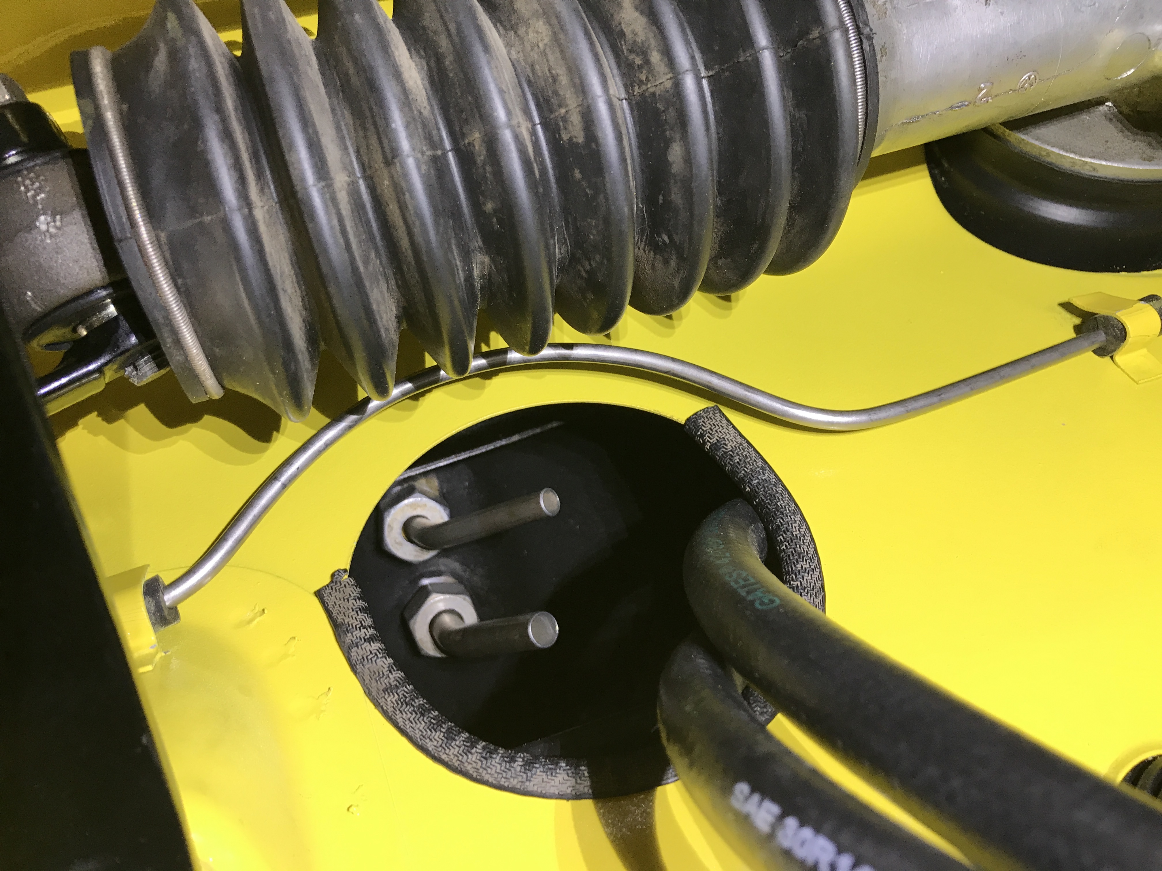

View from the underneath.
bkrantz
post Jun 26 2021, 07:47 PM
Post #3194
Posts: 8,800
Joined: 3-August 19
From: SW Colorado
Member No.: 23,343

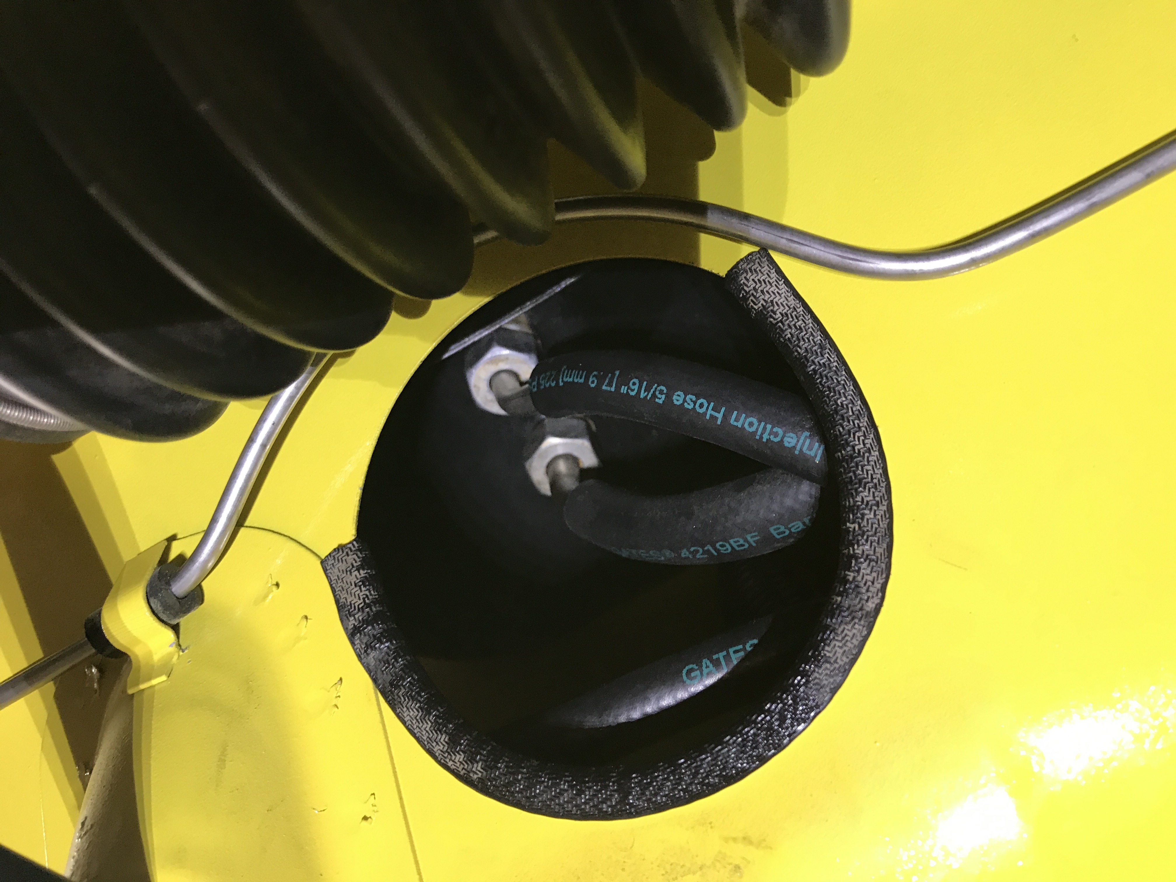

I progressively trimmed the fuel lines, and got them slipped on to the tank fittings. No clamps yet.

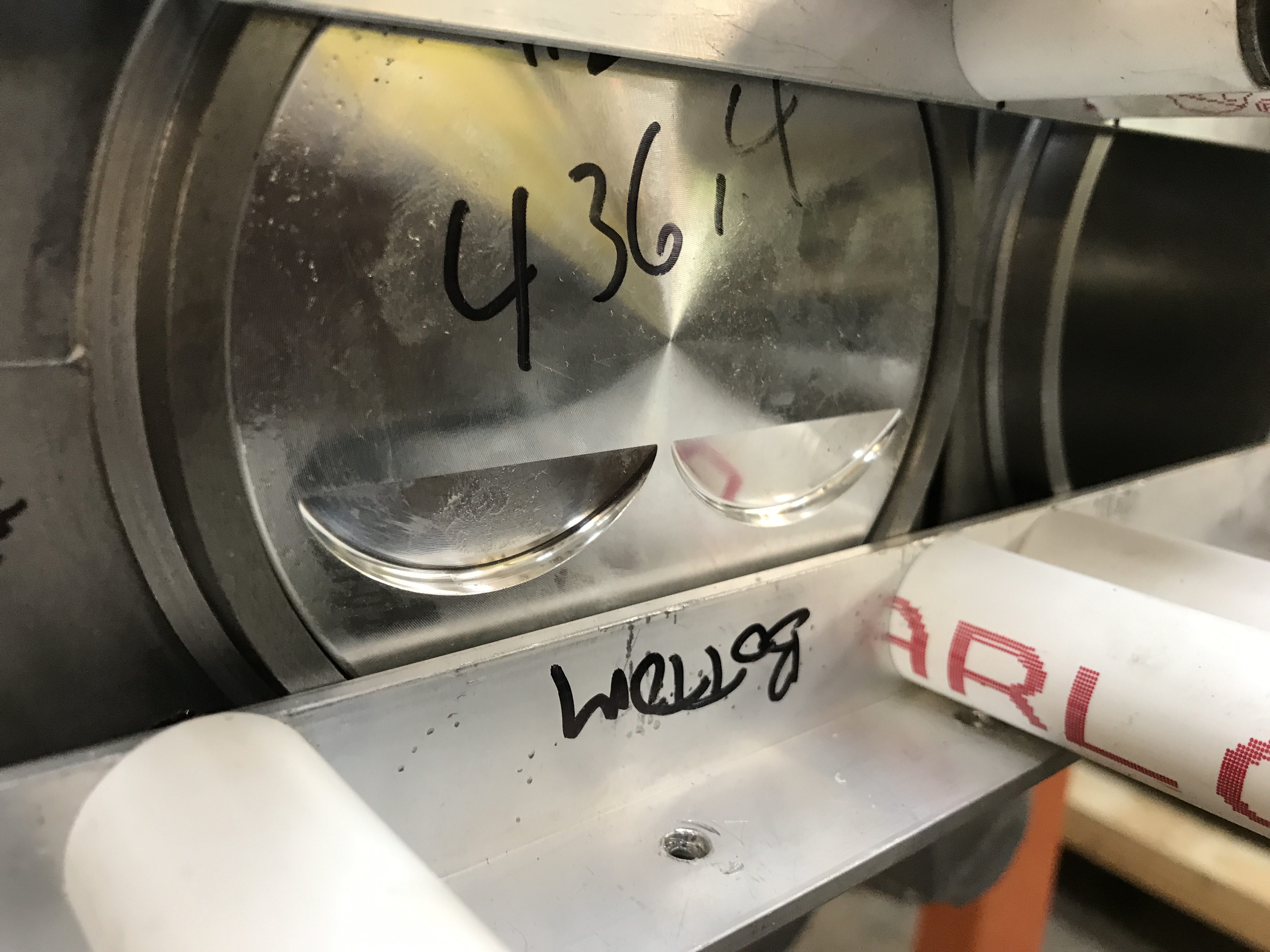

Back to engine work today, lots of time but not many photos.

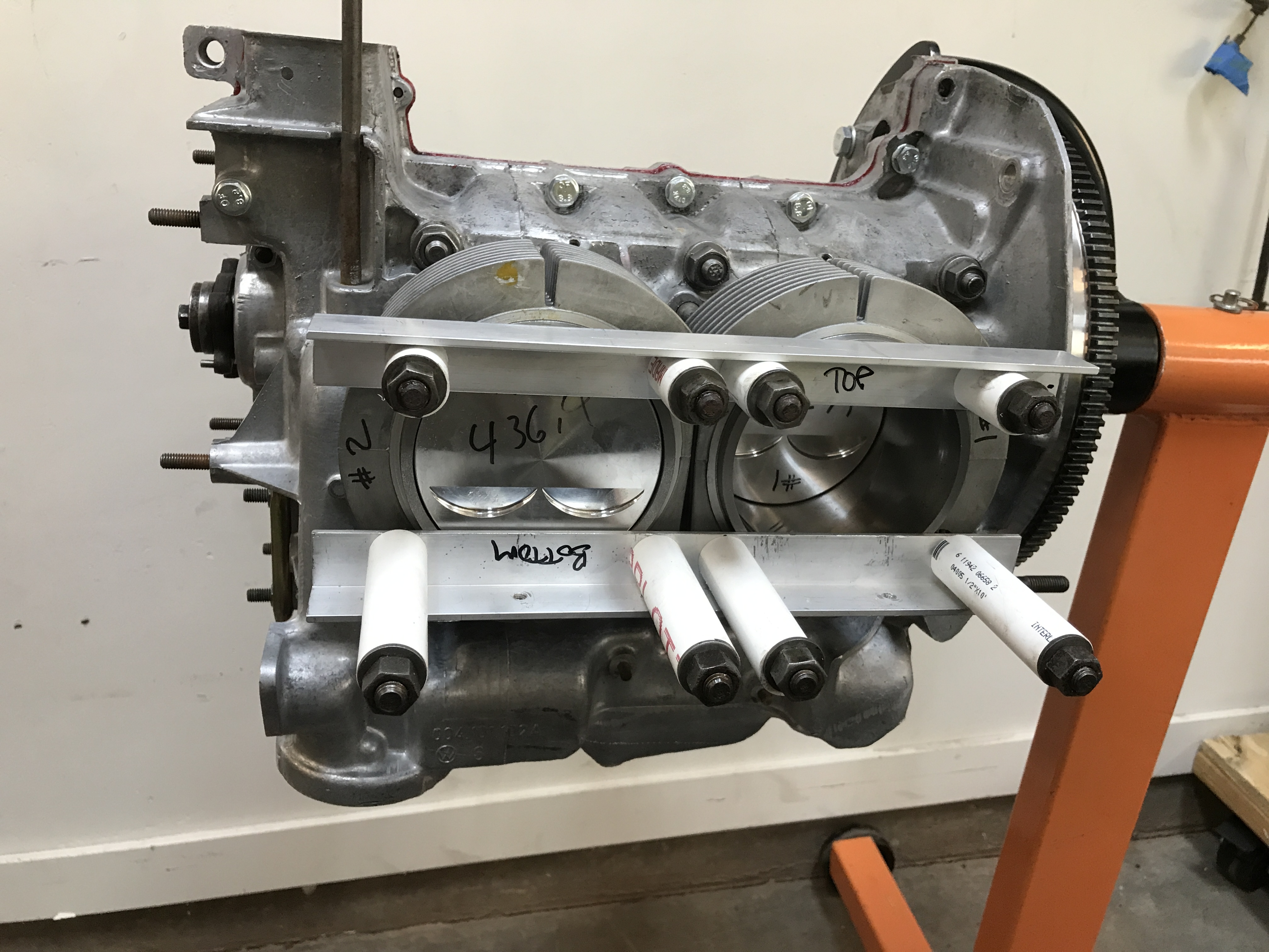

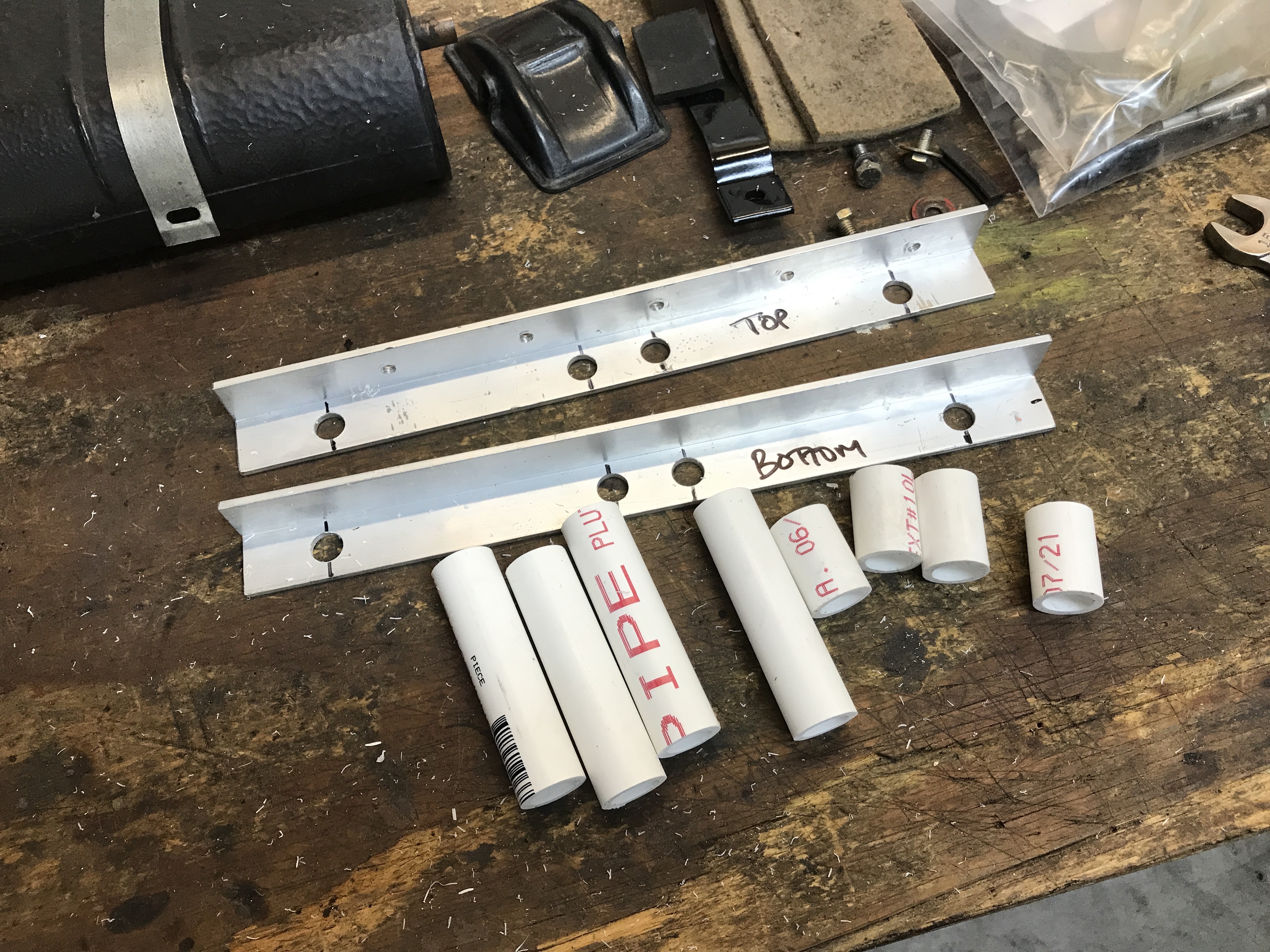

I made retaining bars to hold the cylinders in place, in prep for measuring the deck height. I made the bars from aluminum angle, so no less chance of marring the cylinder seating surface. And I made spacers from PVC pipe.
bkrantz
post Jun 27 2021, 06:36 PM
Post #3196
Posts: 8,800
Joined: 3-August 19
From: SW Colorado
Member No.: 23,343

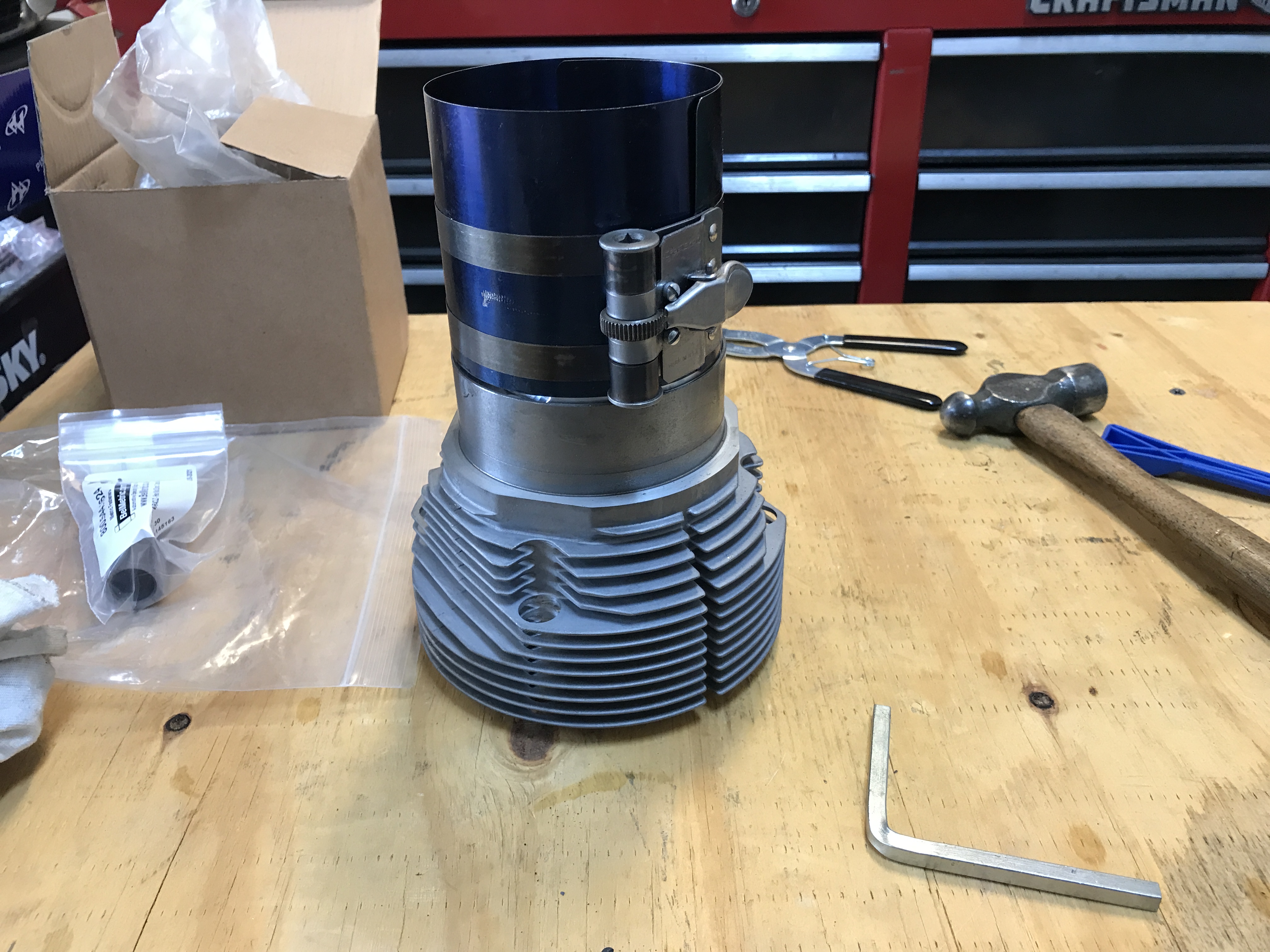

Before mounting the cylinders I had to re-install the pistons, and got out my ring compressor.
bkrantz
post Jun 27 2021, 06:38 PM
Post #3197
Posts: 8,800
Joined: 3-August 19
From: SW Colorado
Member No.: 23,343
P&C numbers 1 and 2 mounted for measurement, no cylinder base gasket.
bkrantz
post Jun 27 2021, 06:39 PM
Post #3198
Posts: 8,800
Joined: 3-August 19
From: SW Colorado
Member No.: 23,343
A quick look at number 2 at TDC. I will do some measuring tomorrow.

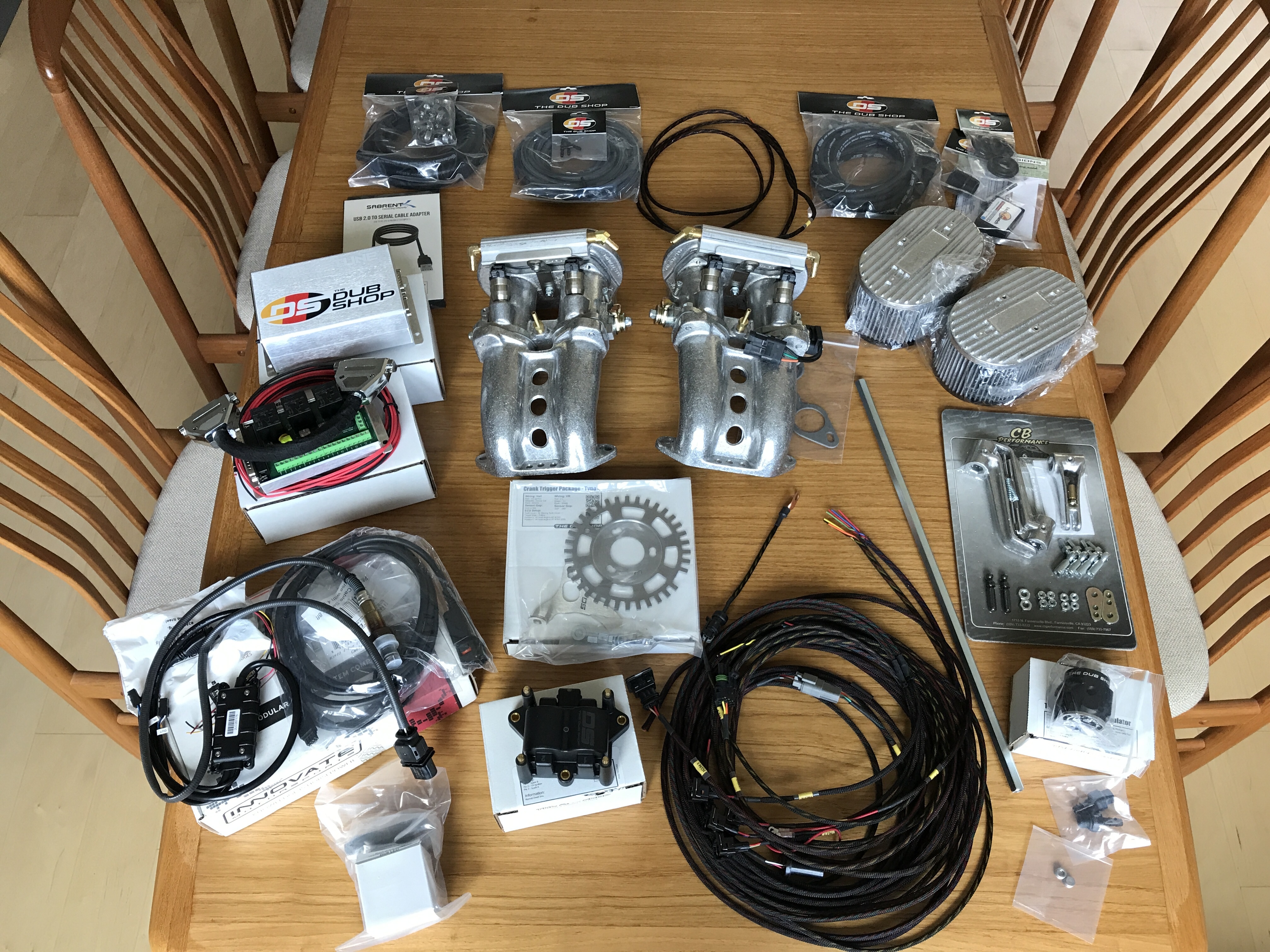

This arrived today, from Mario at the Dub Shop: complete EFI and ignition system.
