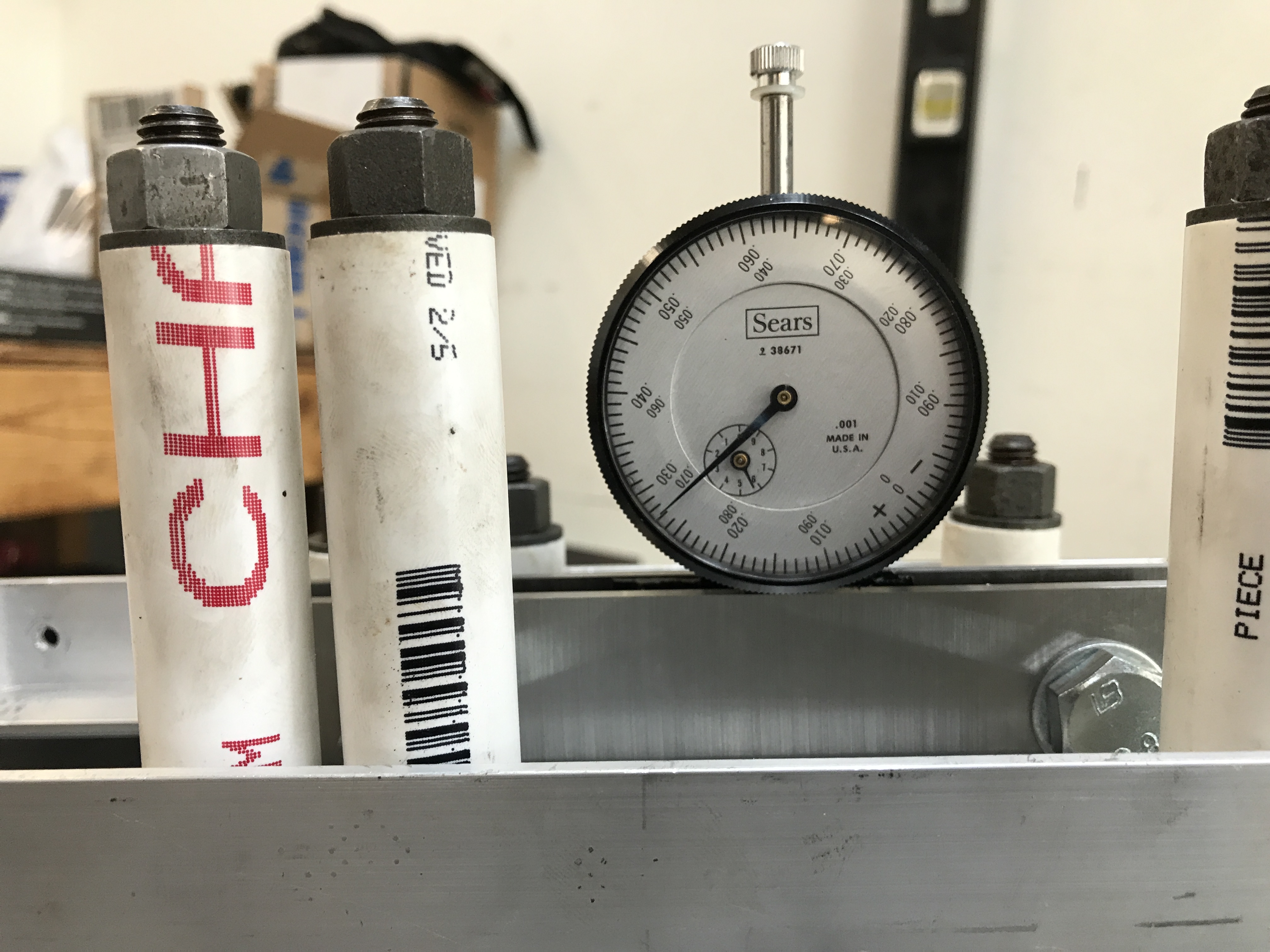

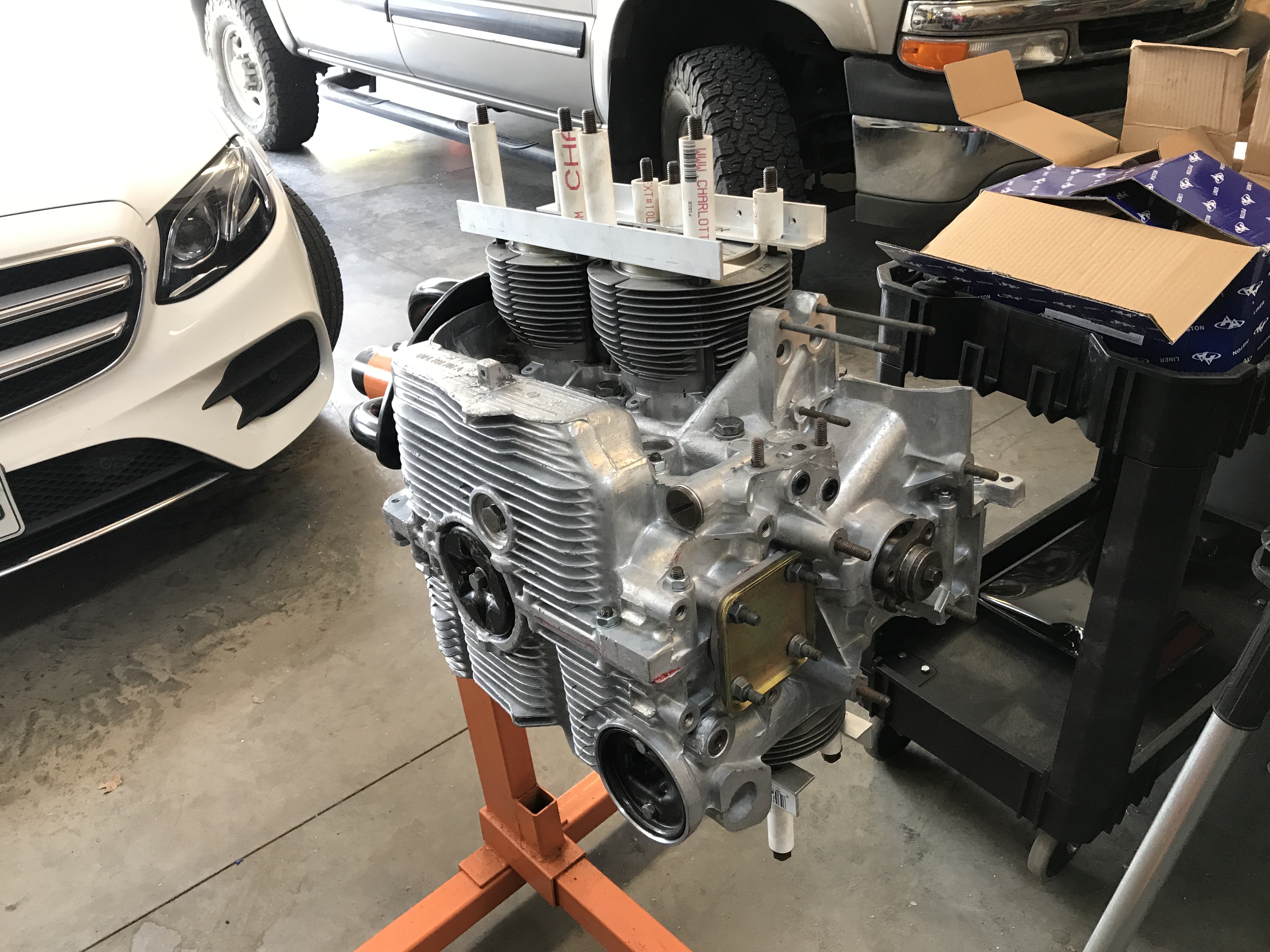

I cobbled up a way to use my dial gauge to measure deck height. Here is #3, measuring .066". Again, my preliminary target is about .040".

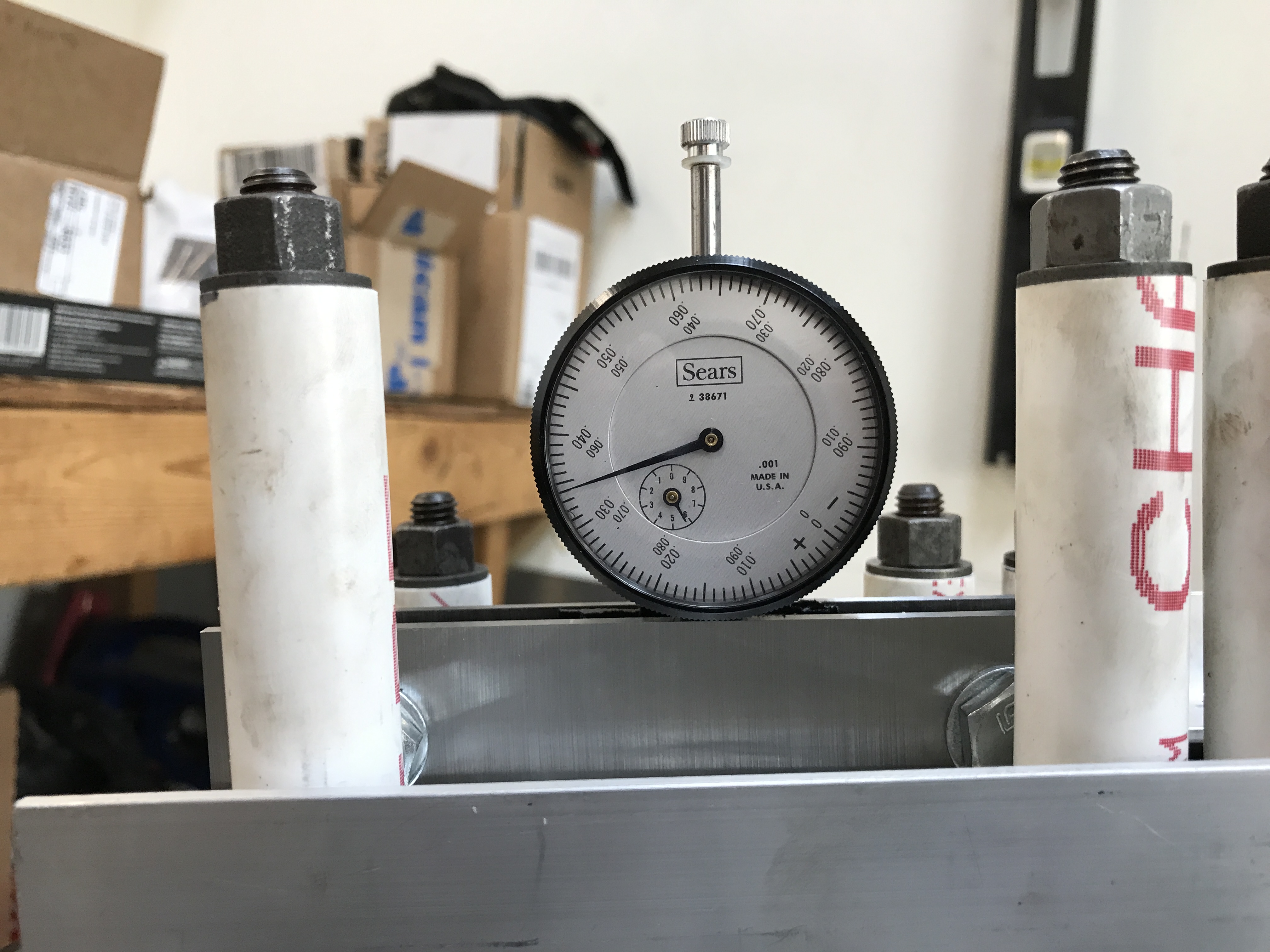

And #4, measuring .073". The other two were in that range.
Soooo....I decided that I need to get the case decked, and to tear it all apart. So much for the weeks I have spent getting it all together. (IMG:style_emoticons/default/headbang.gif)

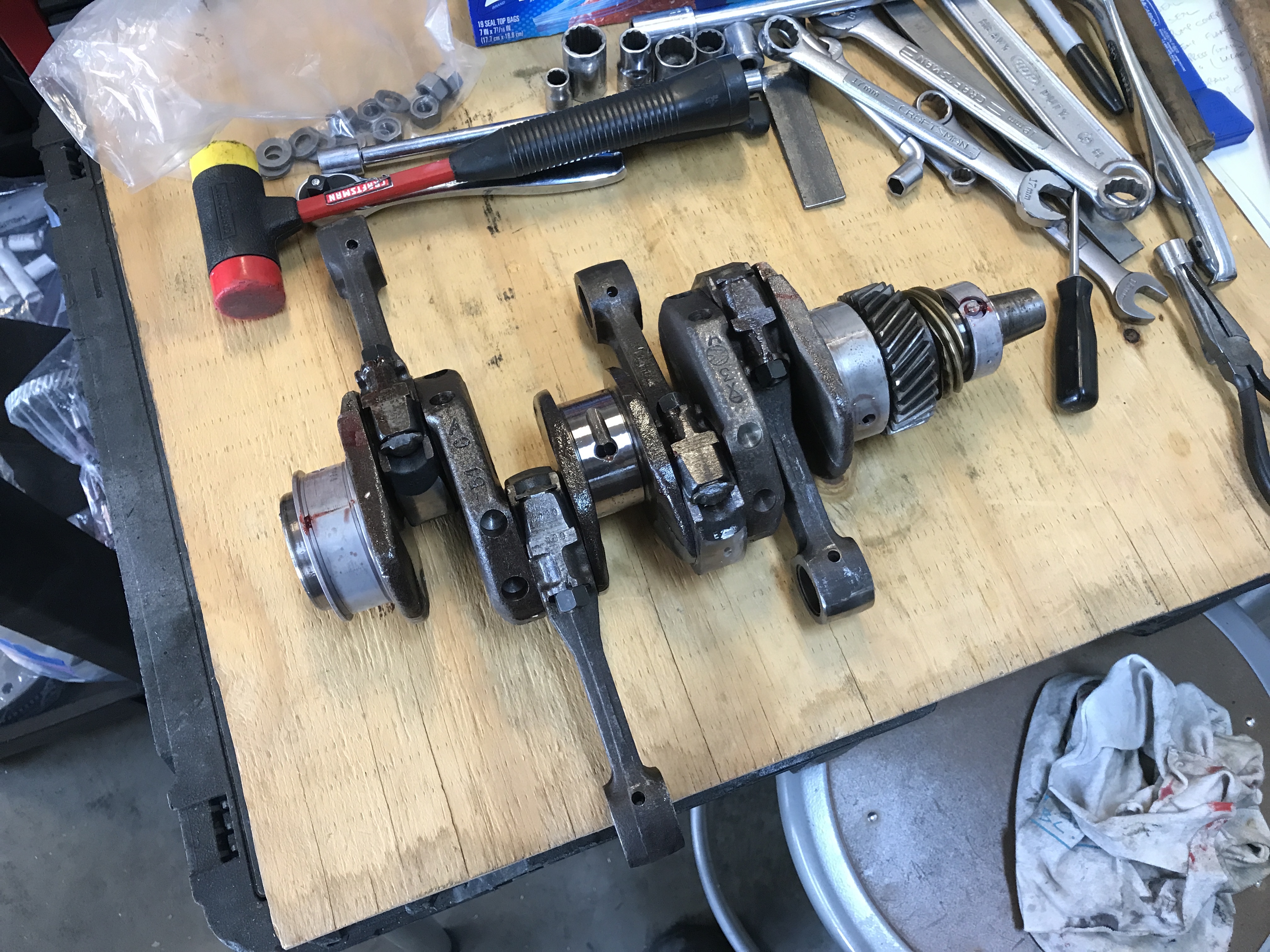

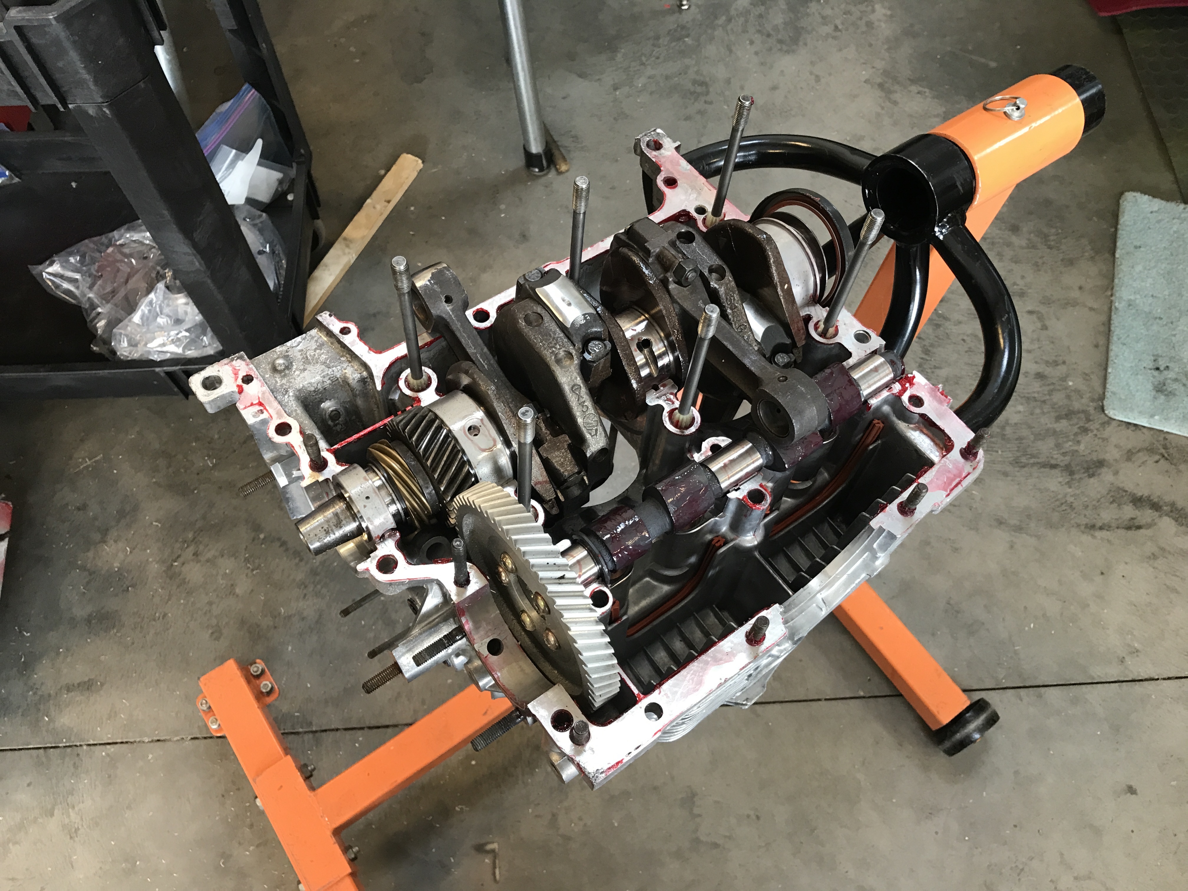

Cam and crank out.

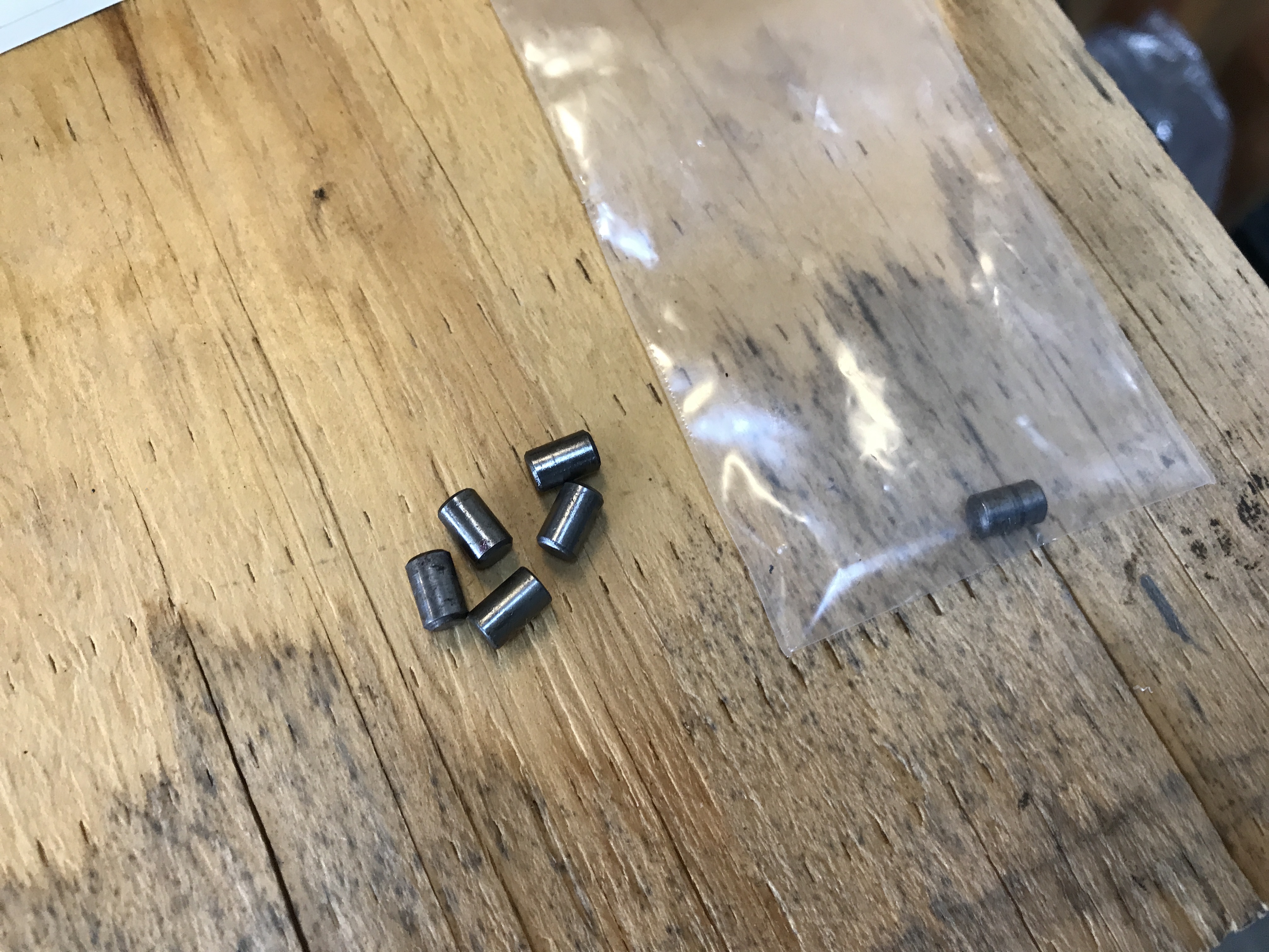

Bearings out, bagged, and keeping track of all the pins.

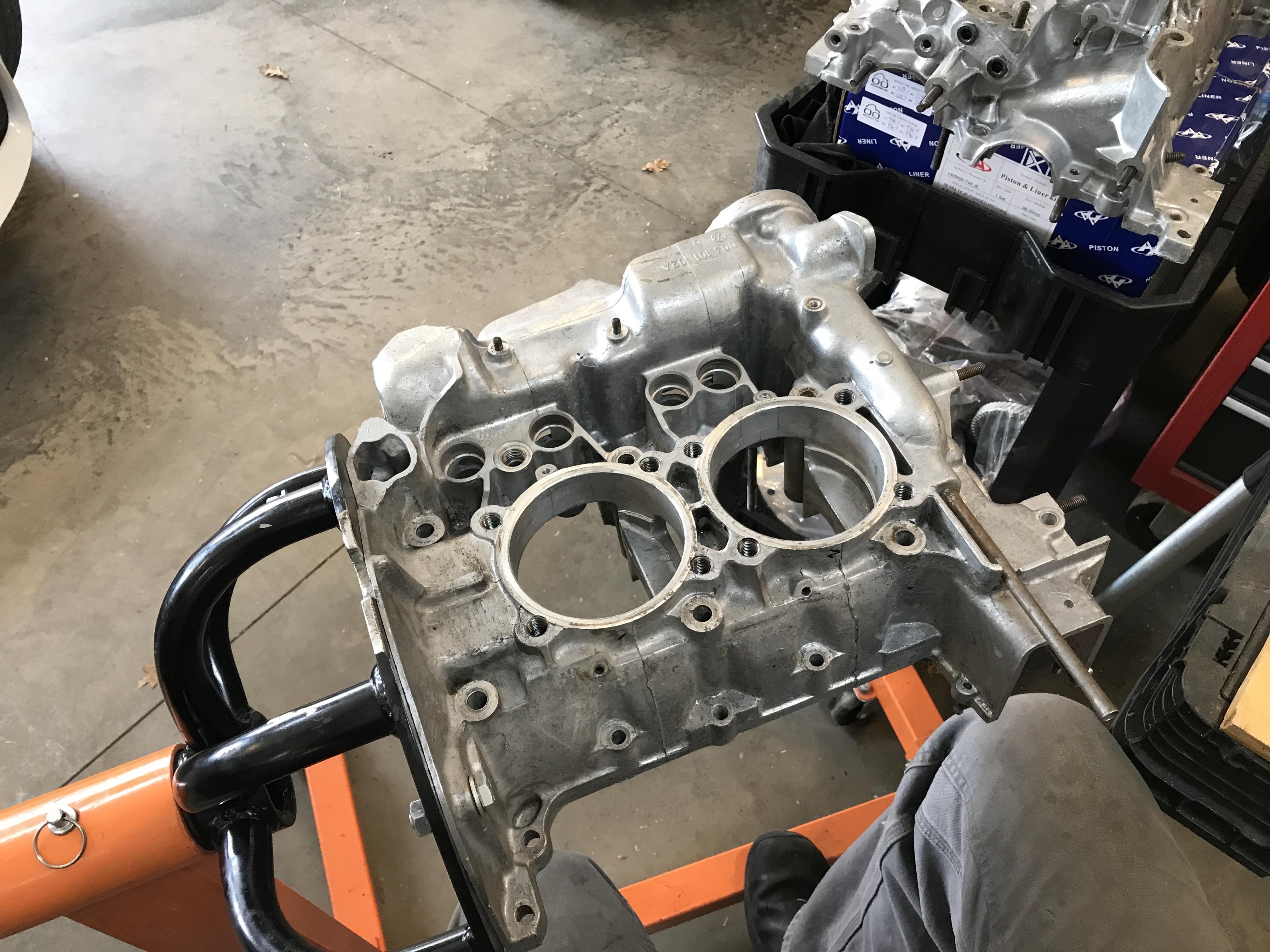

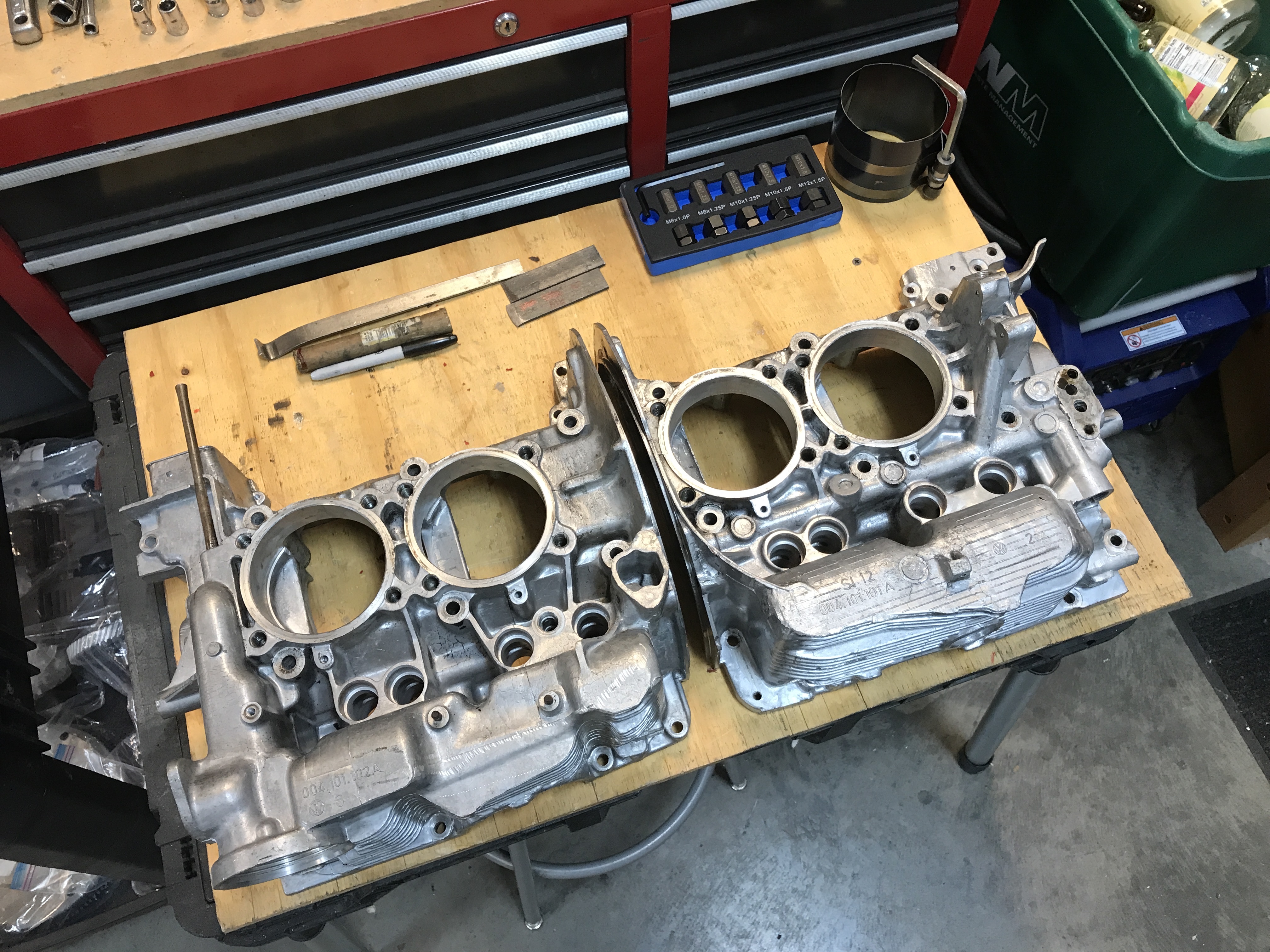

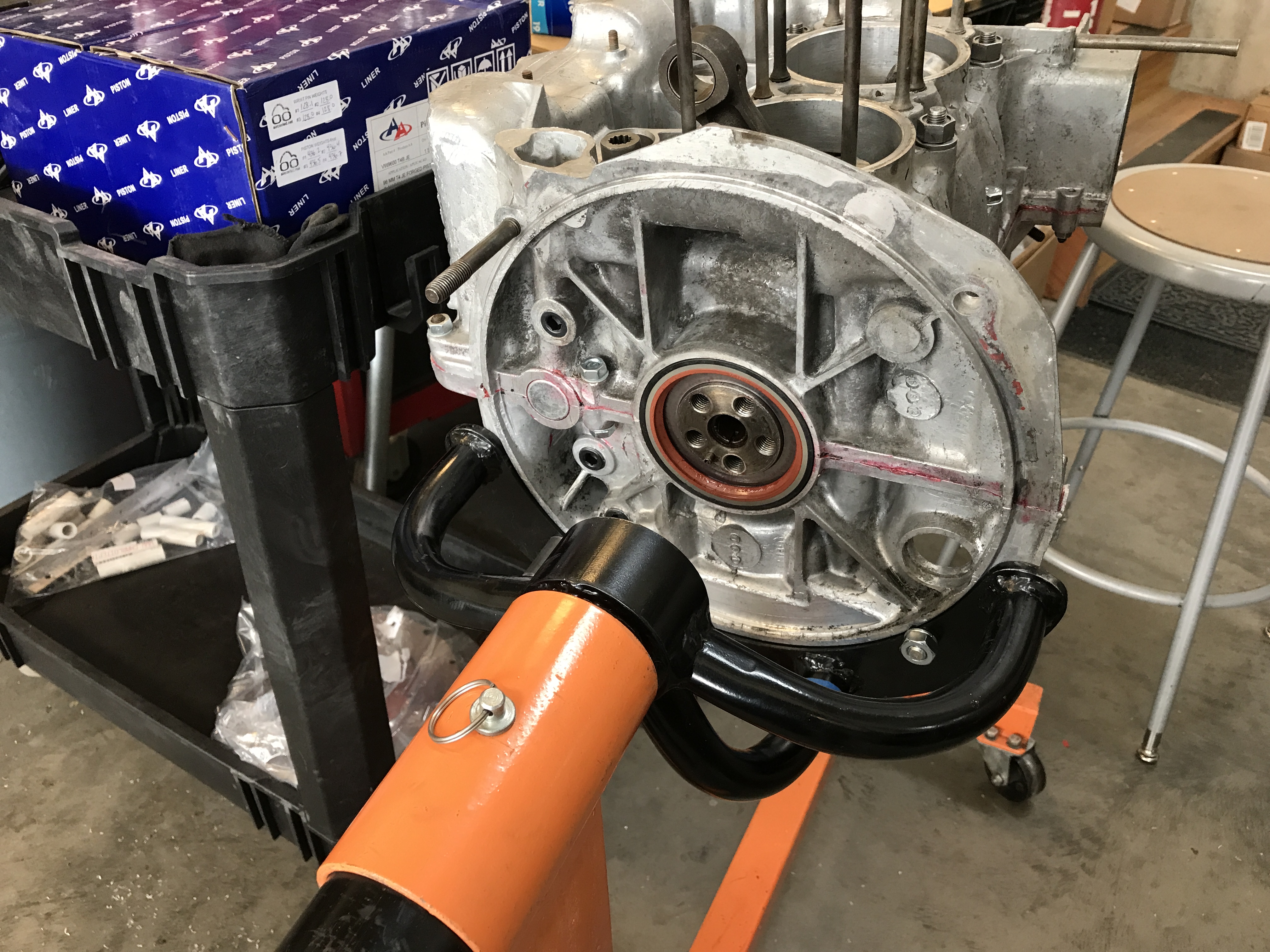

Empty case, right half.

After a visit to the parts washer, I got most of the sealant and assembly lube off.
(having trouble with filespace--I guess I can add the photos later)

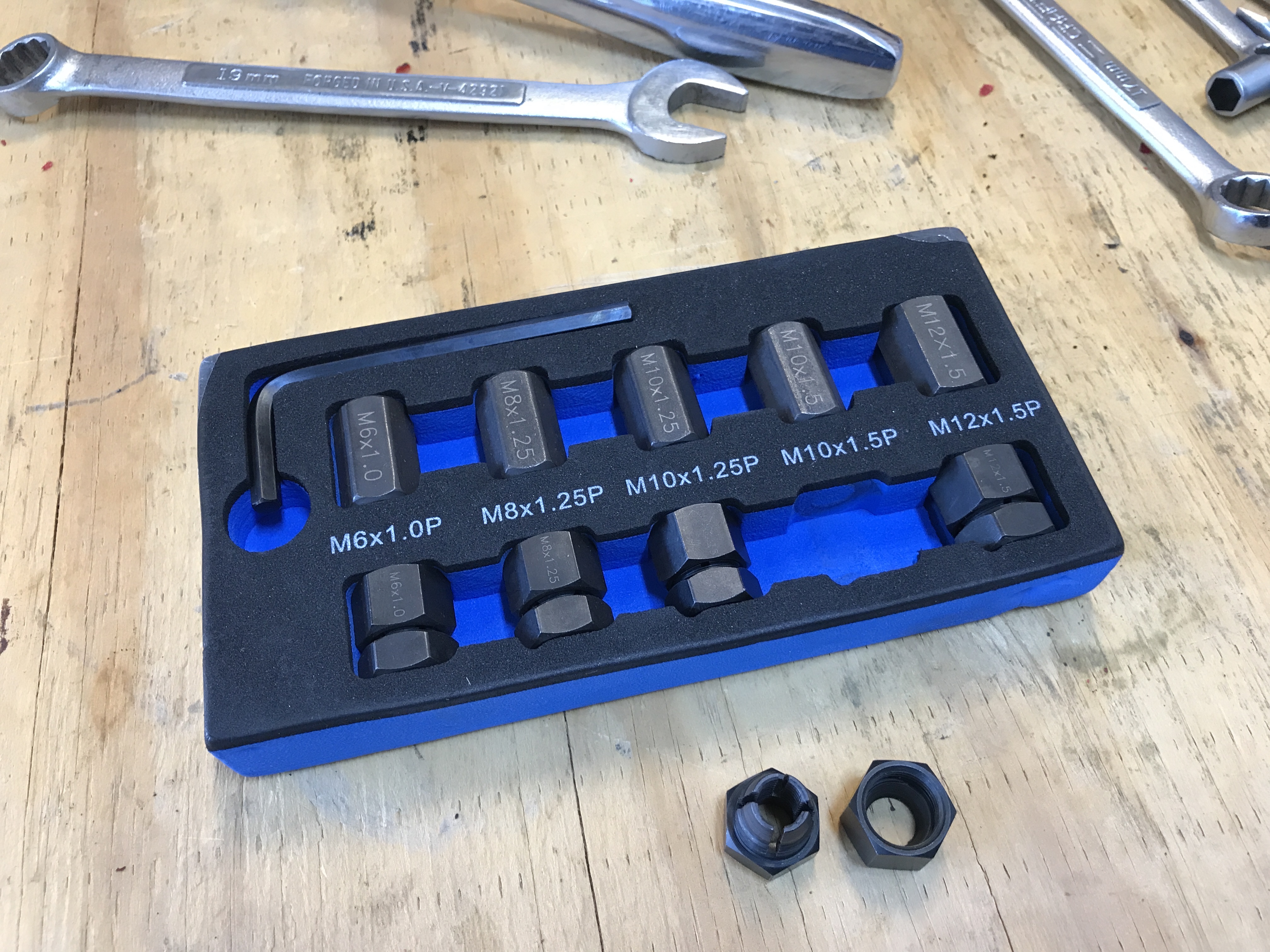

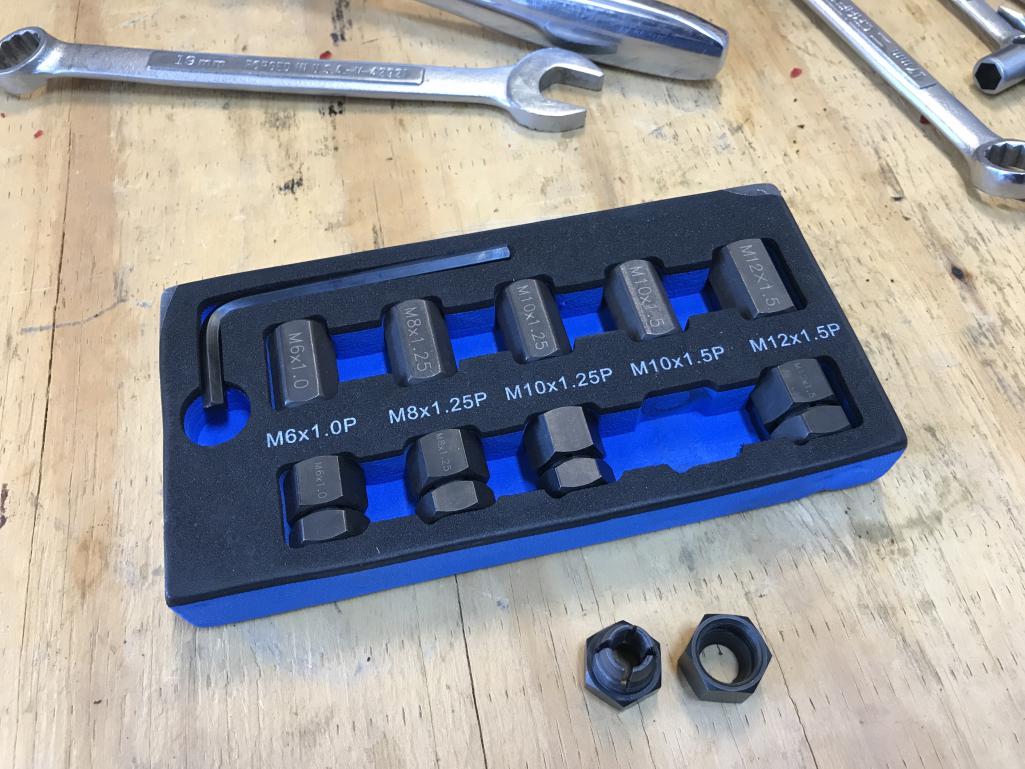

Then I got to use my new stud remover tools.

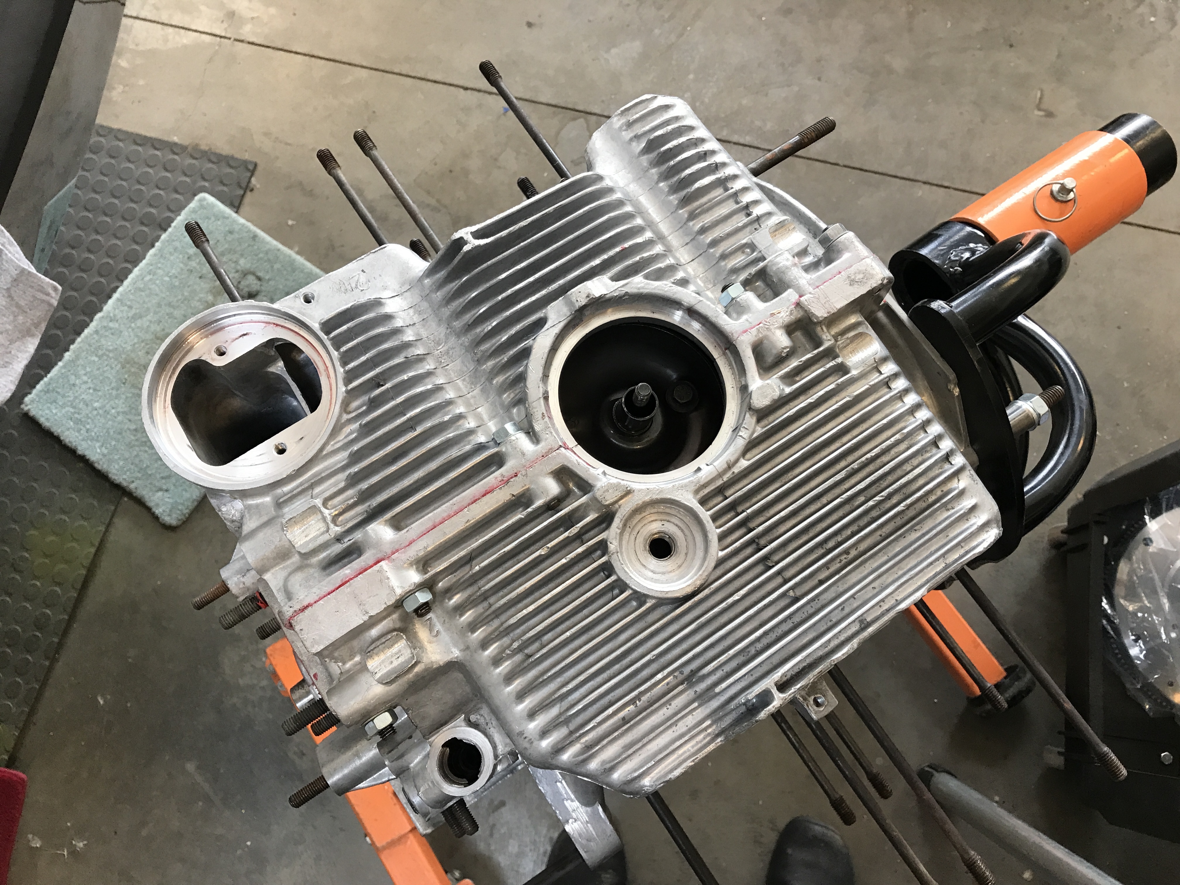

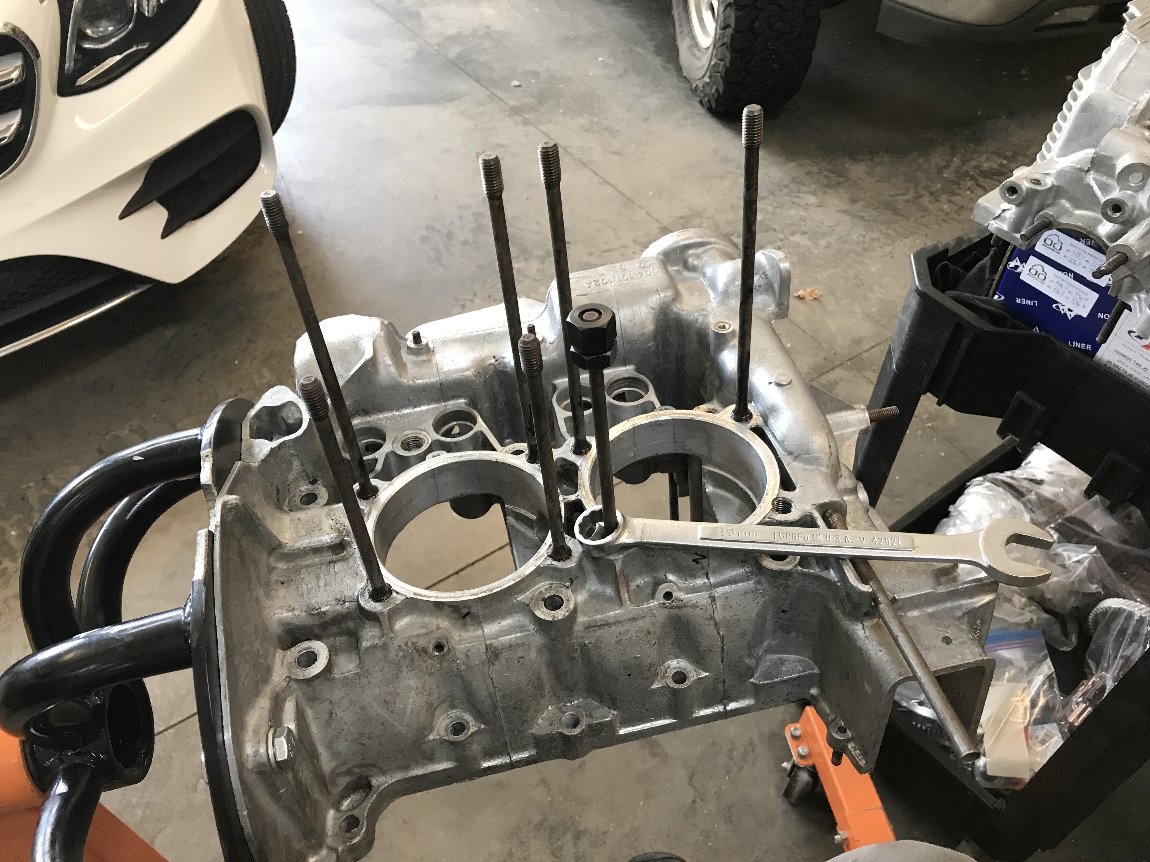

Removing the main cylinder retaining studs.
bkrantz
post Jul 1 2021, 09:20 PM
Post #3233
Posts: 8,800
Joined: 3-August 19
From: SW Colorado
Member No.: 23,343
Cylinder studs out.

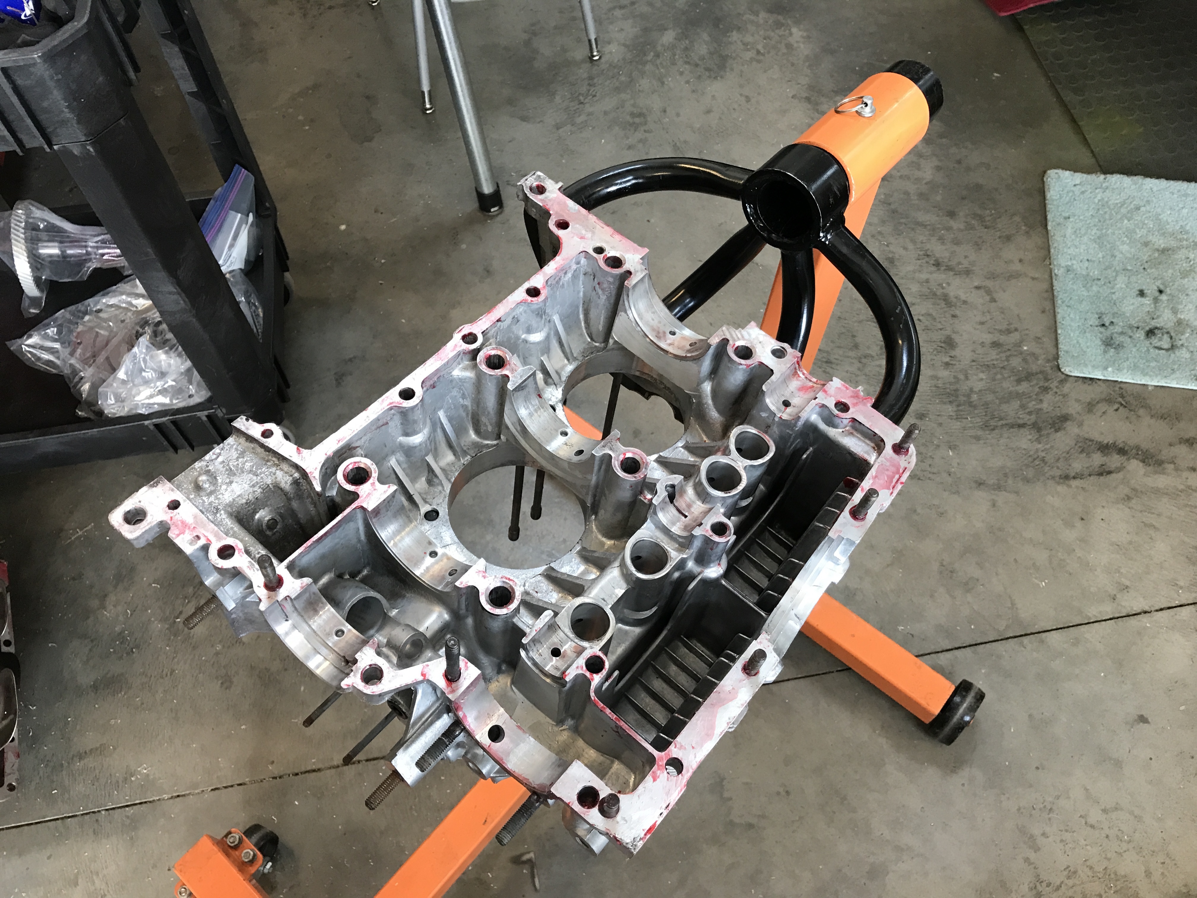

I then removed all the other studs, external and internal. The case halves are completely stripped, except for the two locating pins and the oil dipstick tube.

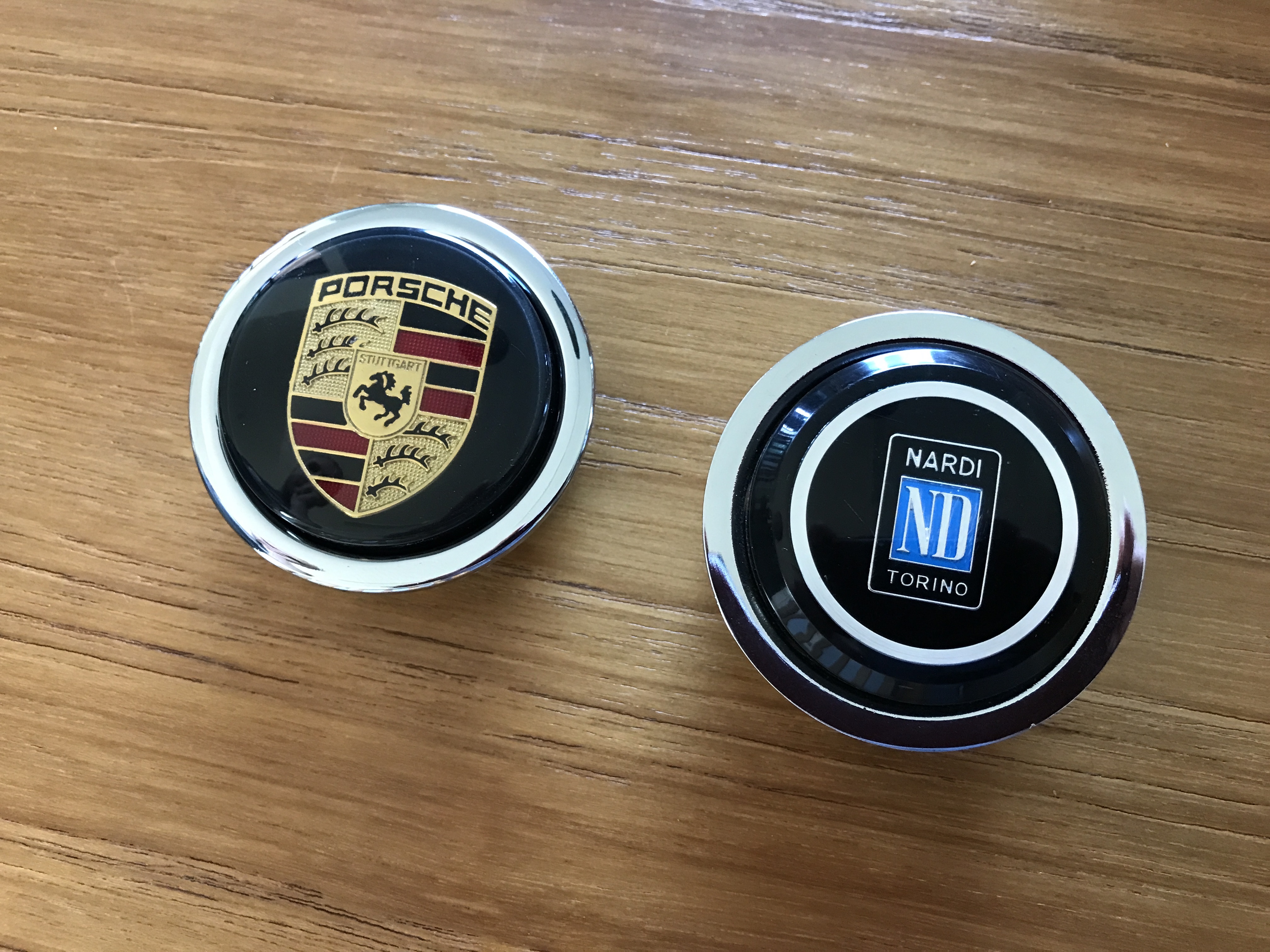

Got a new horn button. I would rather that my Nardi steering wheel (yeah, I know, heresy) have a Porsche crest and not a Nardi logo). Besides, it will be the only crest on the car.
