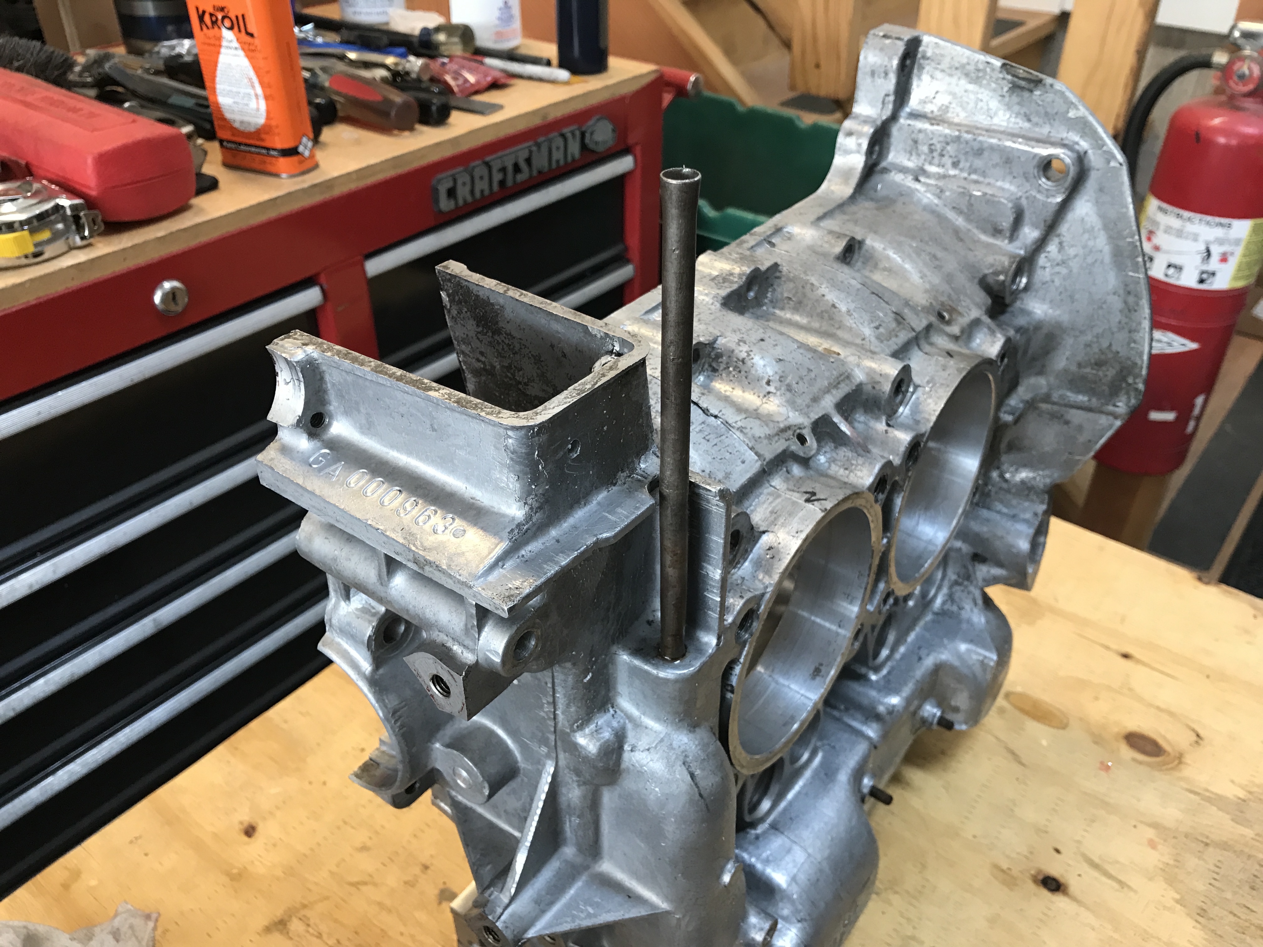

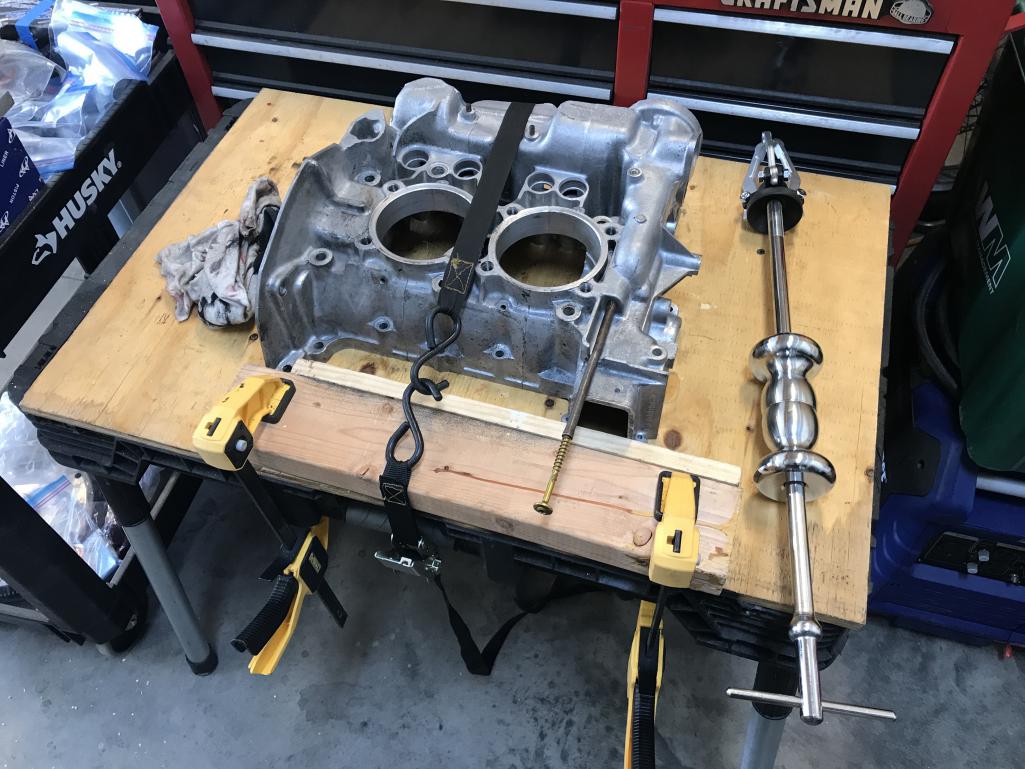

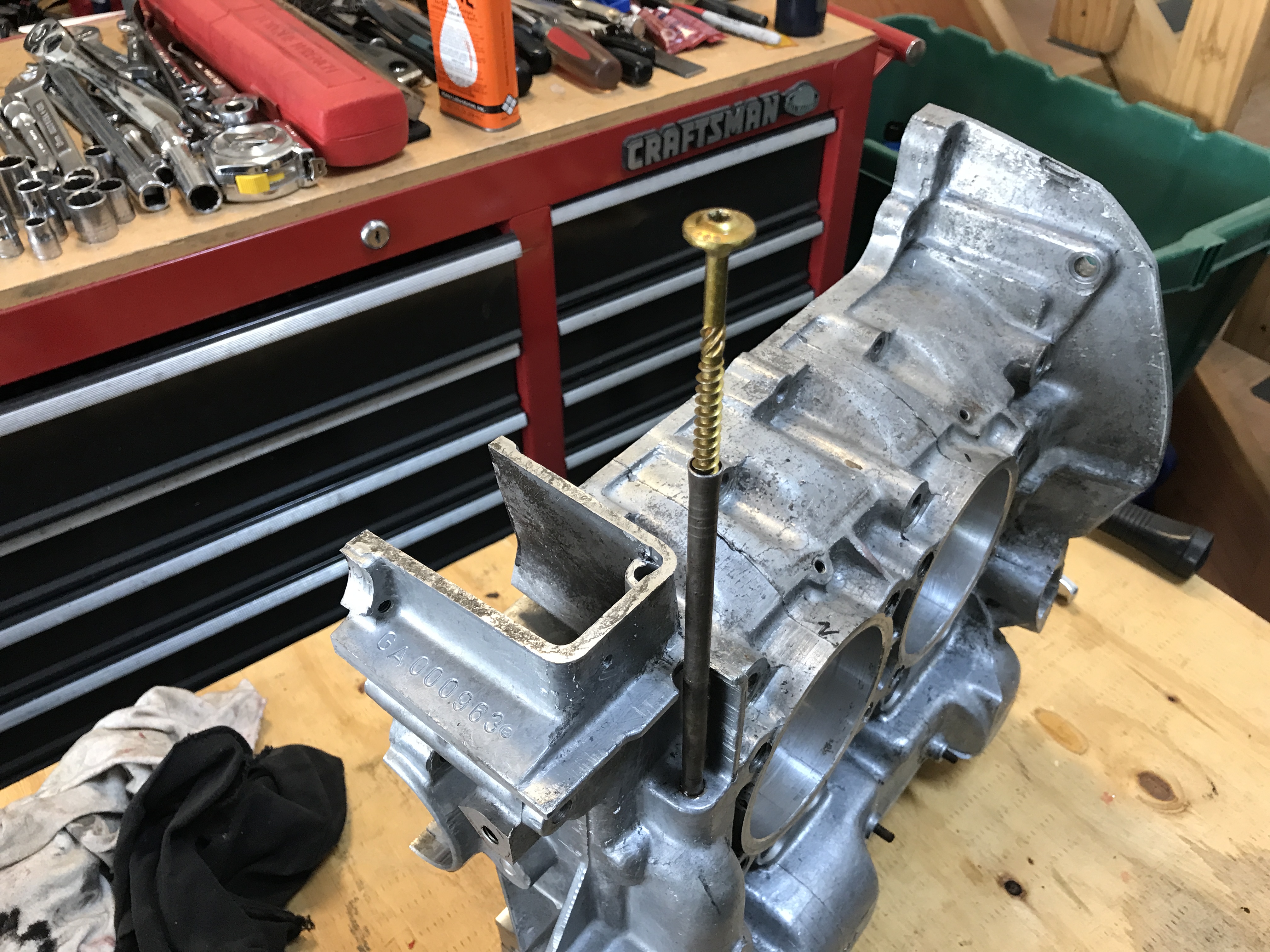

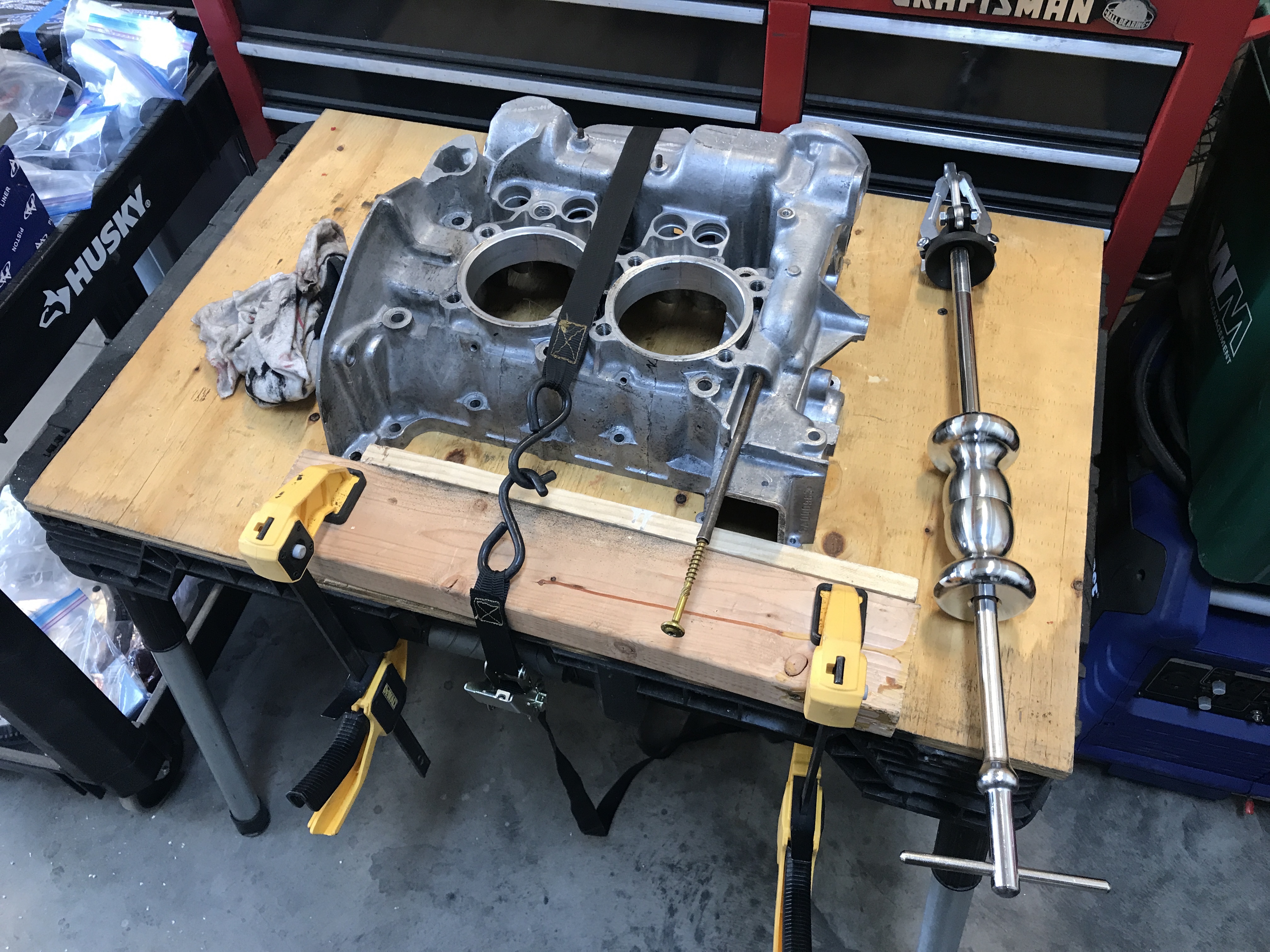

Last bit of case prep for the machine shop: removing the oil dipstick tube. I measured the exposed tube length at least 3 times (and wrote it down somewhere).
I know some people have tapped it out from the inside, but I decided to try pulling it.
post Jul 4 2021, 08:41 PM
Post #3242

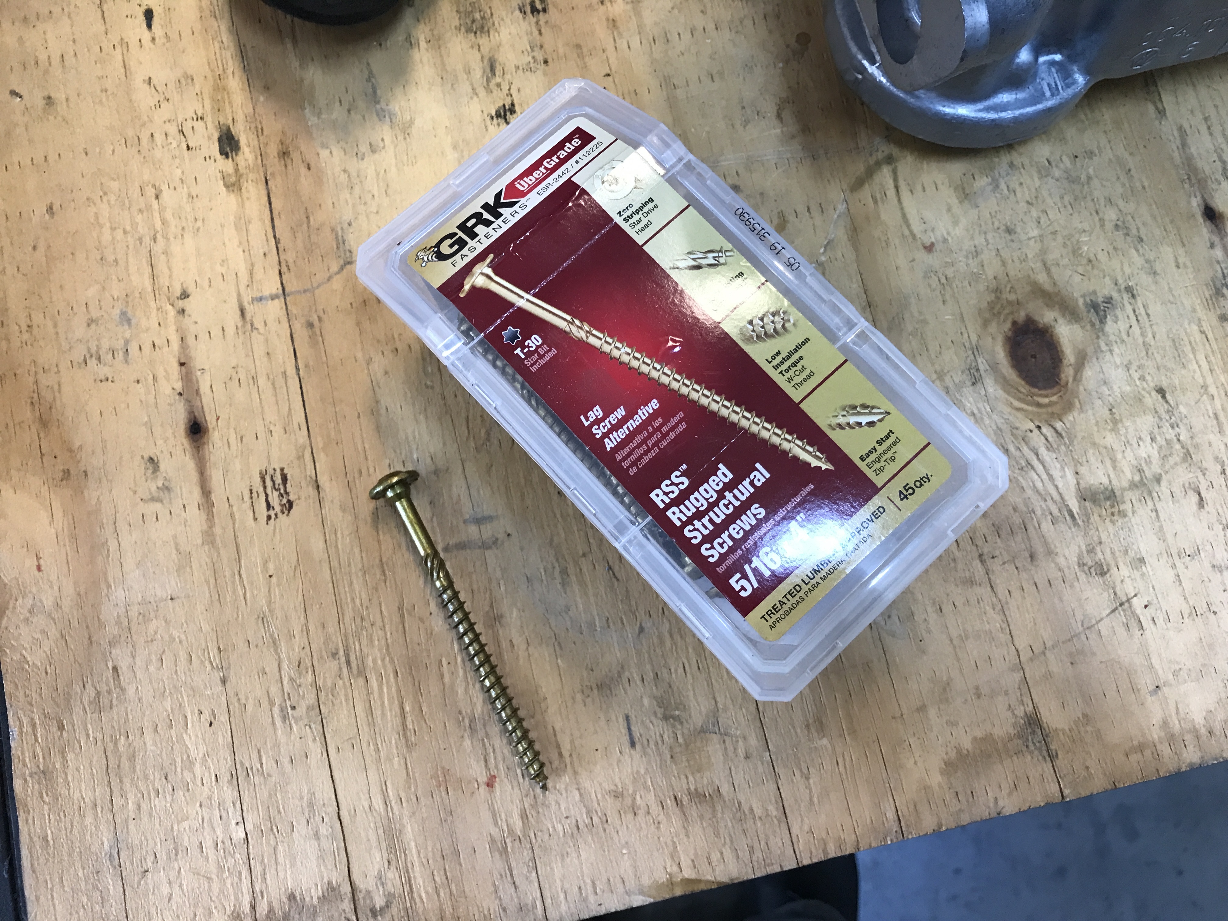

Posts: 8,800

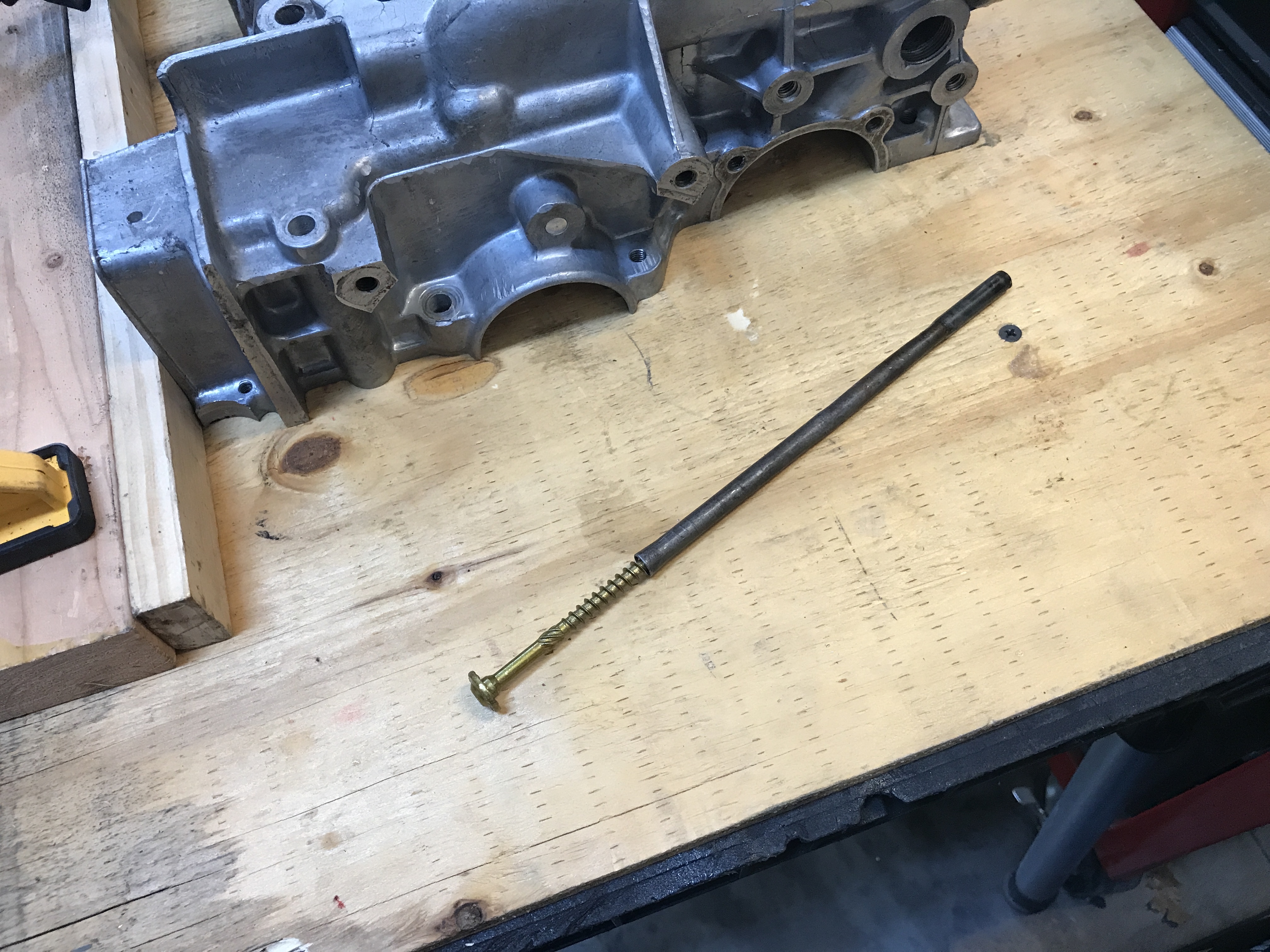

This was the best in my shop fit for an internal screw, a 5/16" structural fastener.
post Jul 4 2021, 08:43 PM
Post #3243
Posts: 8,800
Screw in place, with just a bit of resistance while twisting.
post Jul 4 2021, 08:44 PM
Post #3244
Posts: 8,800
Ready to pull.
post Jul 4 2021, 08:47 PM
Post #3245
Posts: 8,800
It took about 3 moderate whacks with the puller, and the tube came out. BTW, I did squirt some Kroil at the tube base about 48 hours ago.

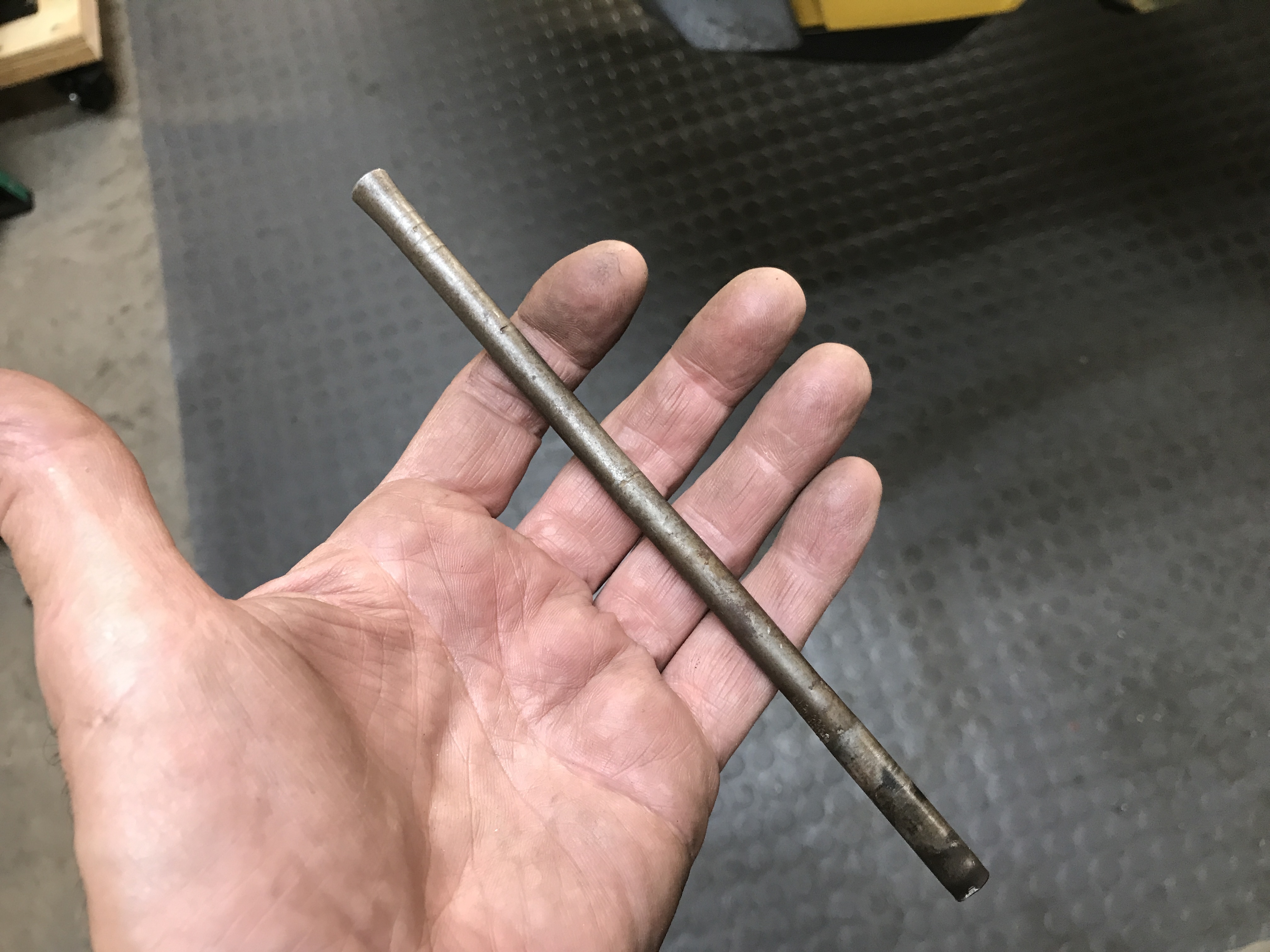

post Jul 4 2021, 08:48 PM
Post #3246
Posts: 8,800
The tube could be used again, but looks a bit lumpy. I will see about making a replacement.
post Jul 4 2021, 08:50 PM

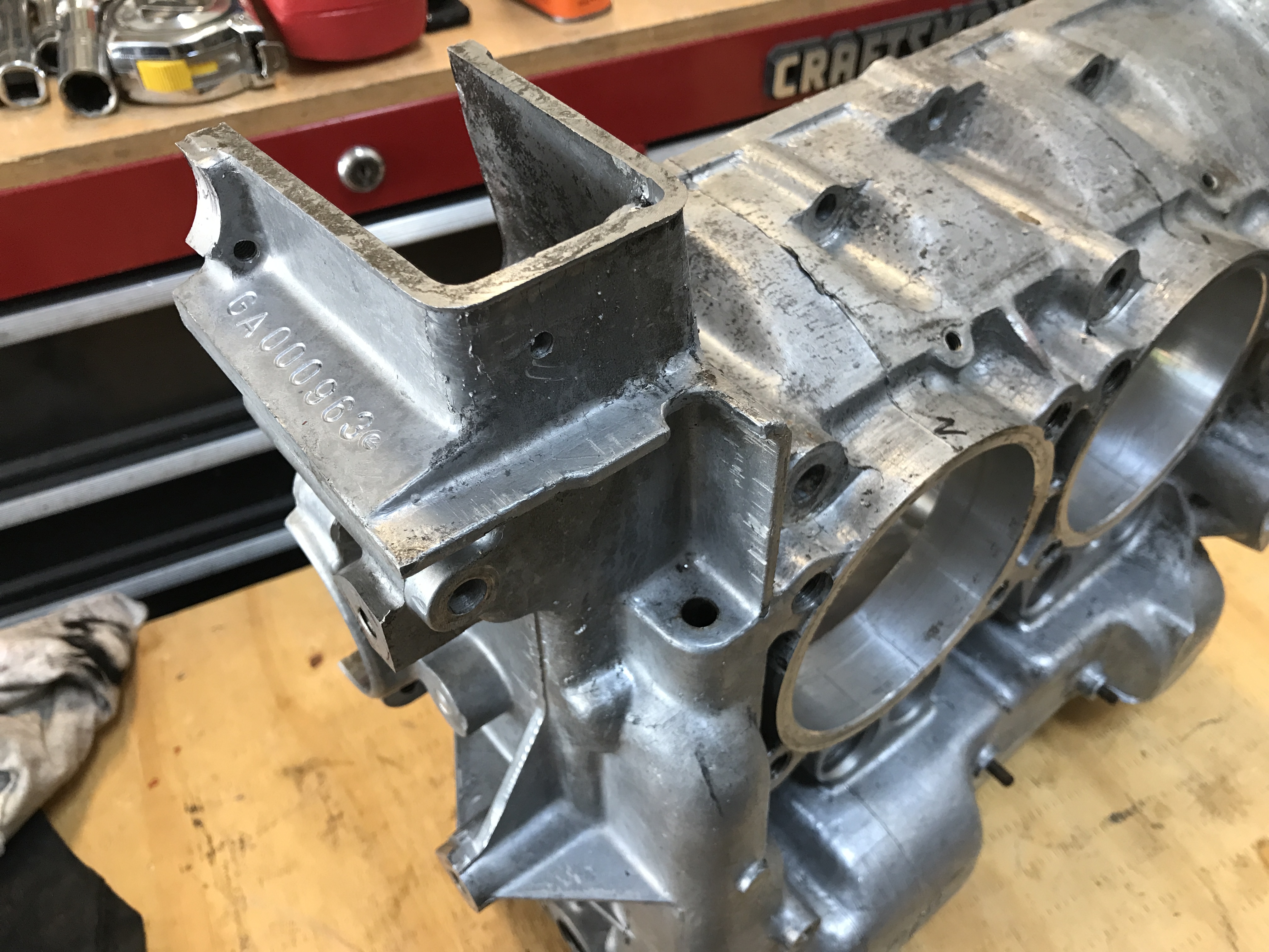

Posts: 8,800
The case is essentially fully stripped of hardware, and ready for machine work.

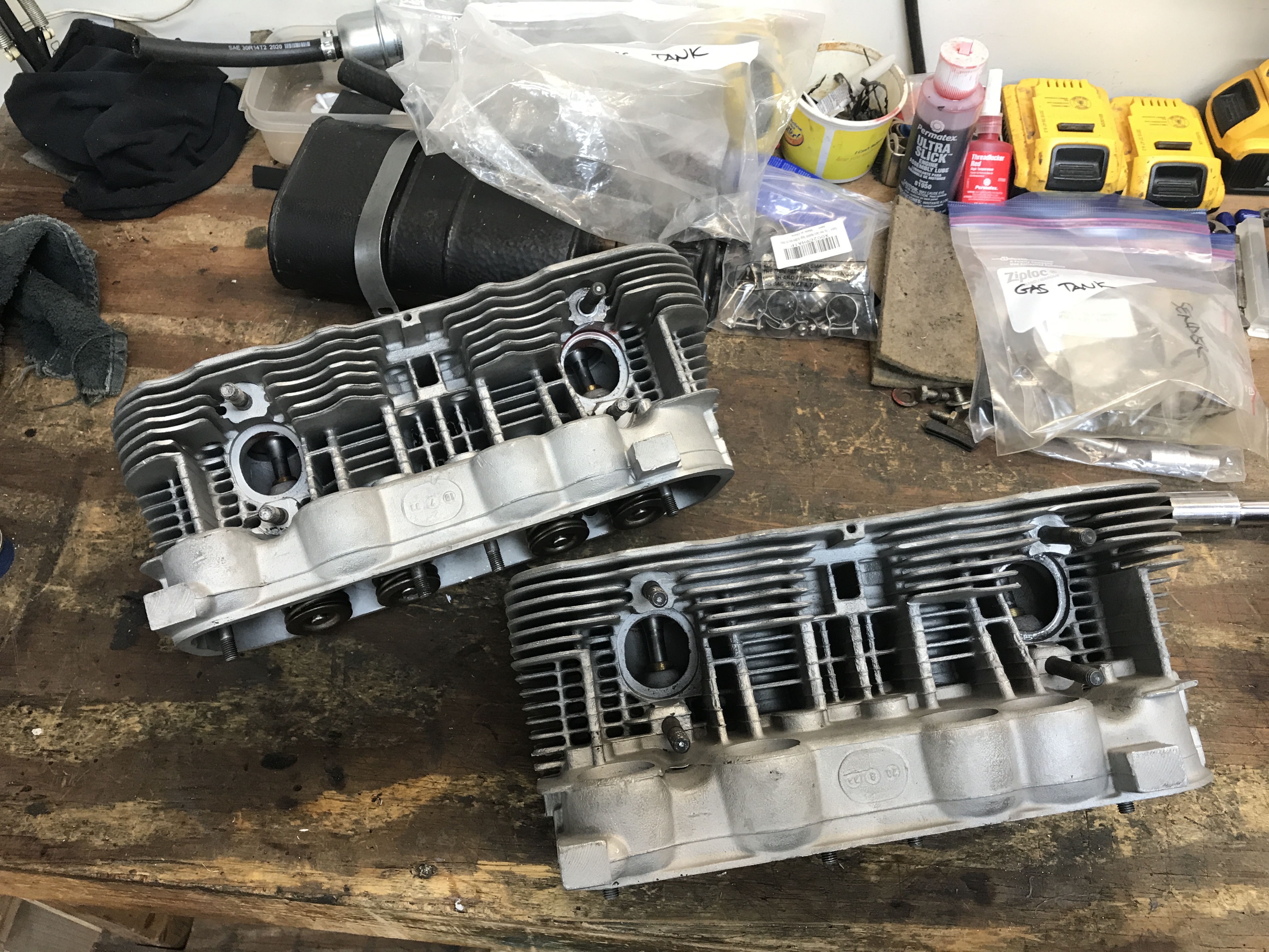

Posts: 8,800

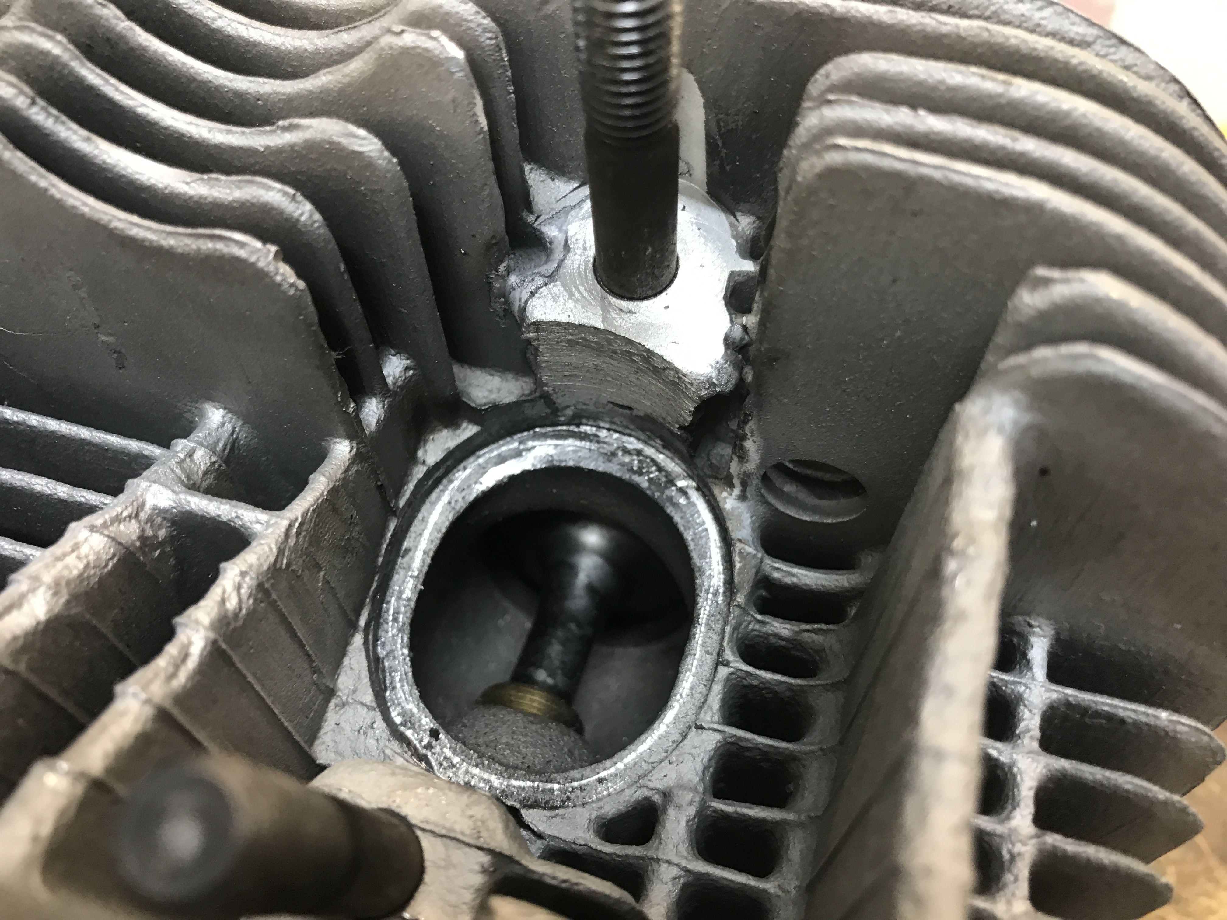

Speaking of machine work, I have both heads with all exhaust studs now pointing in the right direction.
post Jul 4 2021, 08:54 PM
Post #3249
Posts: 8,800
This is where the shop welded in new aluminum and drilled and tapped a new stud hole. I still need to clean up the exhaust gasket surface a bit.

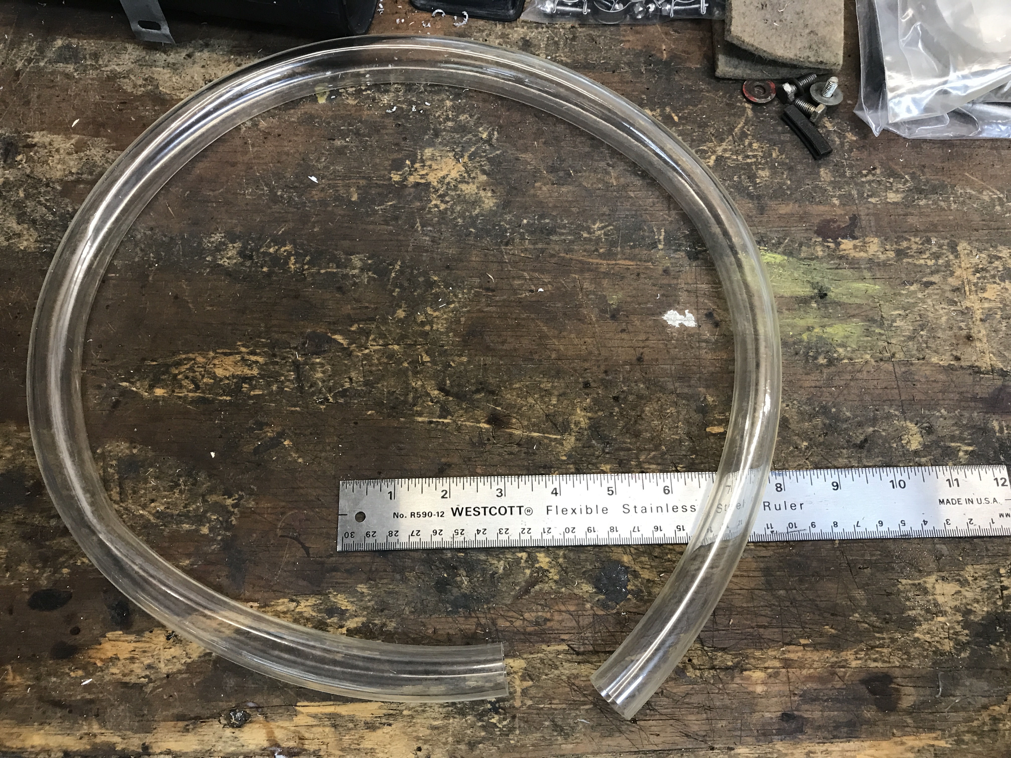

Posts: 8,800
New clear tubing for the gas filler overflow, 19 mm ID, 24 mm OD.

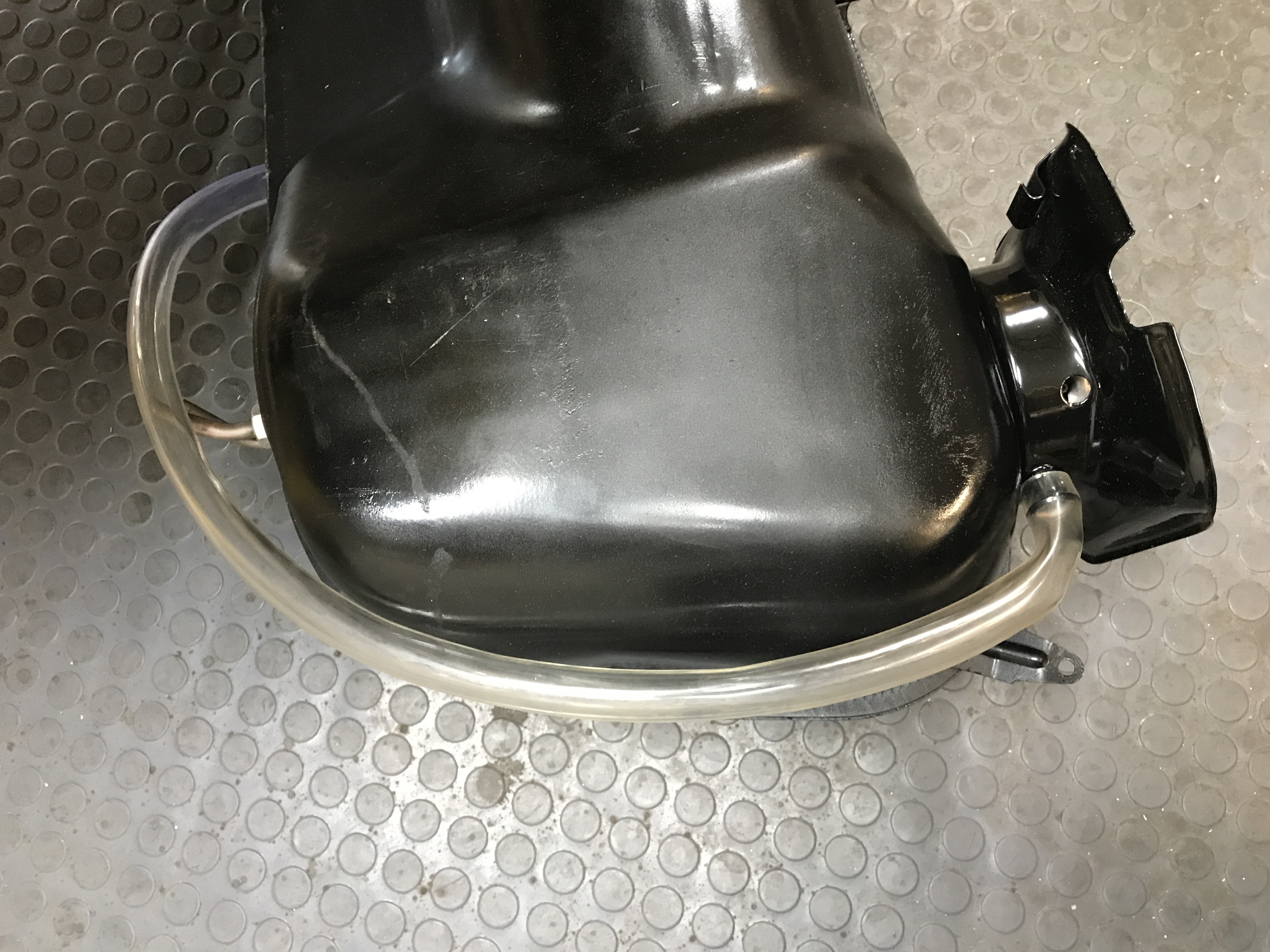

post Jul 4 2021, 08:57 PM
Post #3251
Posts: 8,800
I used a bit of heat to try to make a more defined bend just below the overflow fitting.
post Jul 4 2021, 08:59 PM
Post #3252
Posts: 8,800
I have not checked the latest list in a while. Looks like slow progress.

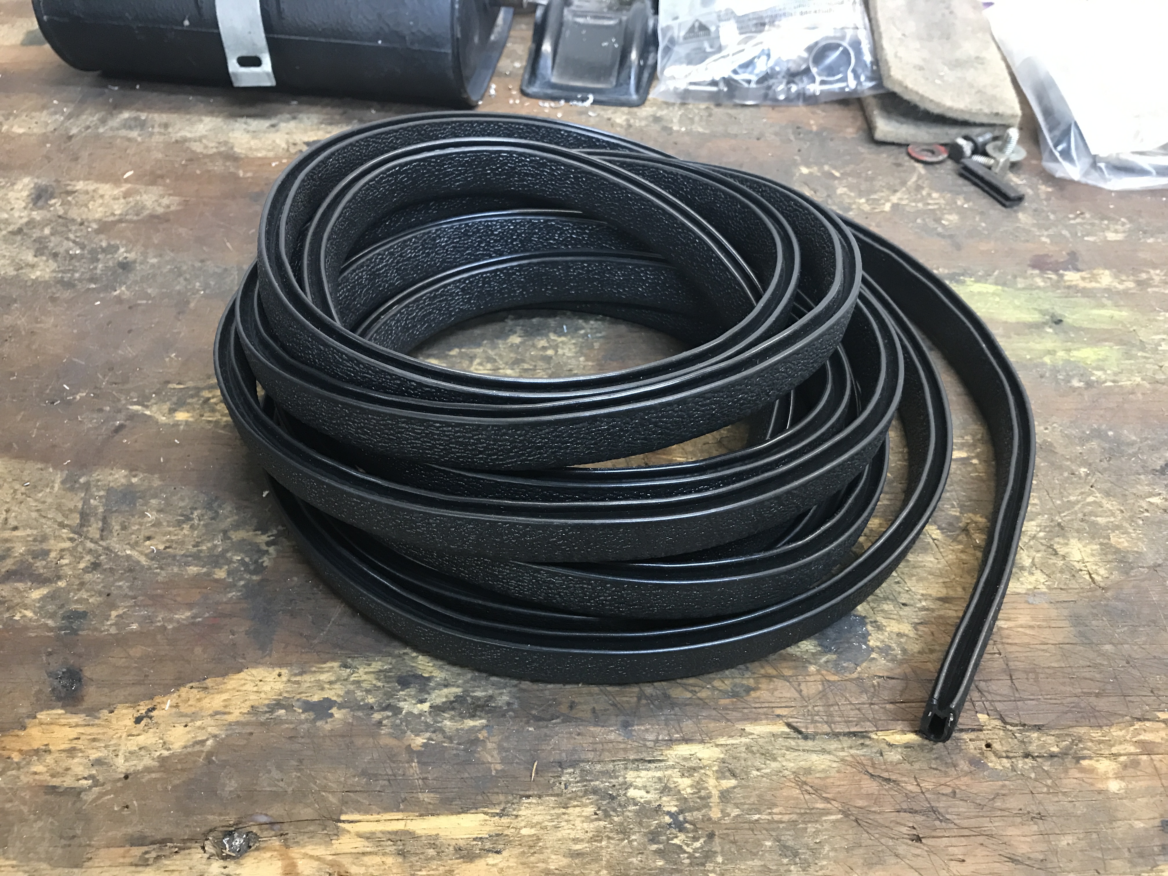

Posts: 8,800

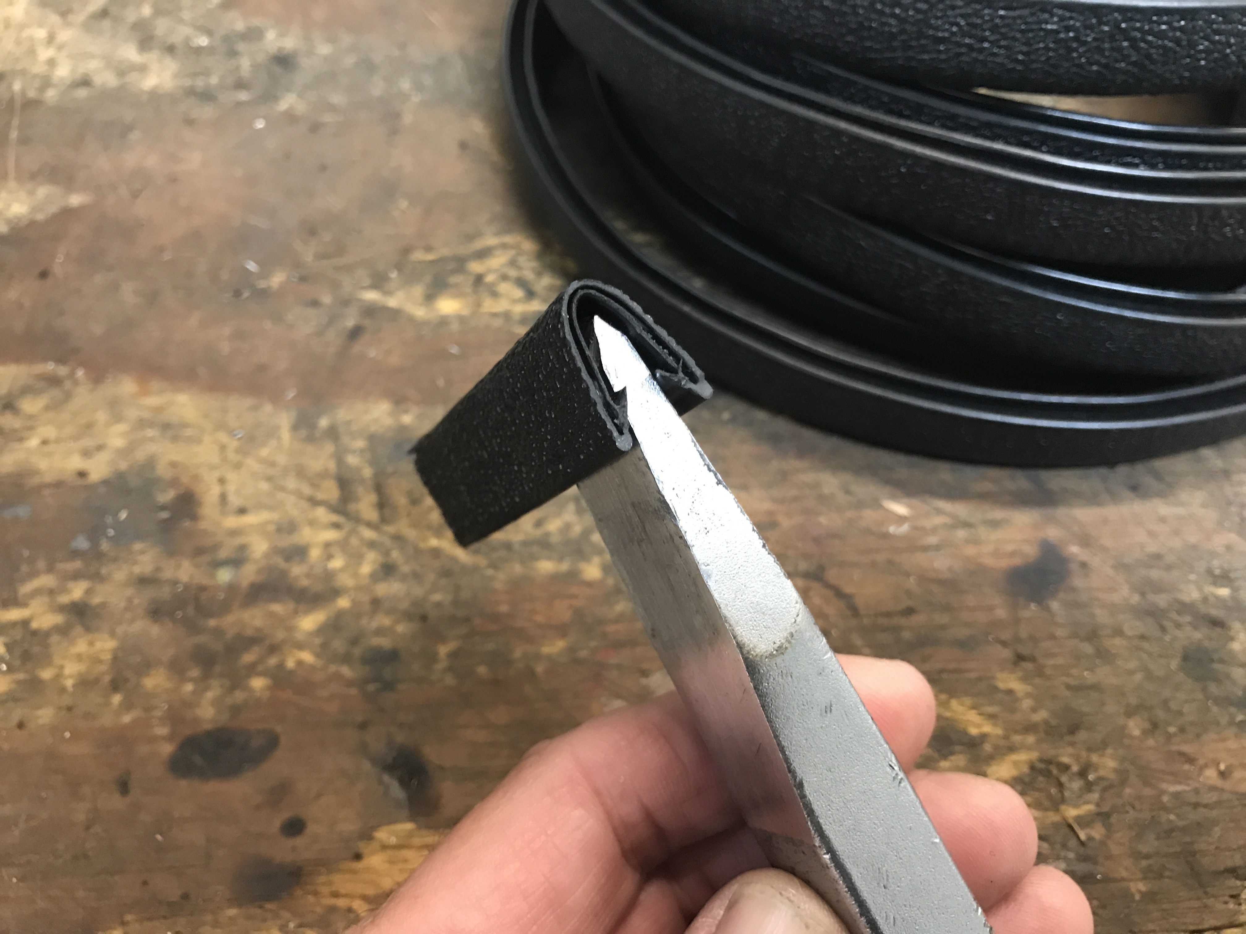

Back to soft stuff. This is PVC edge trim (from J&J Auto Fabrics).

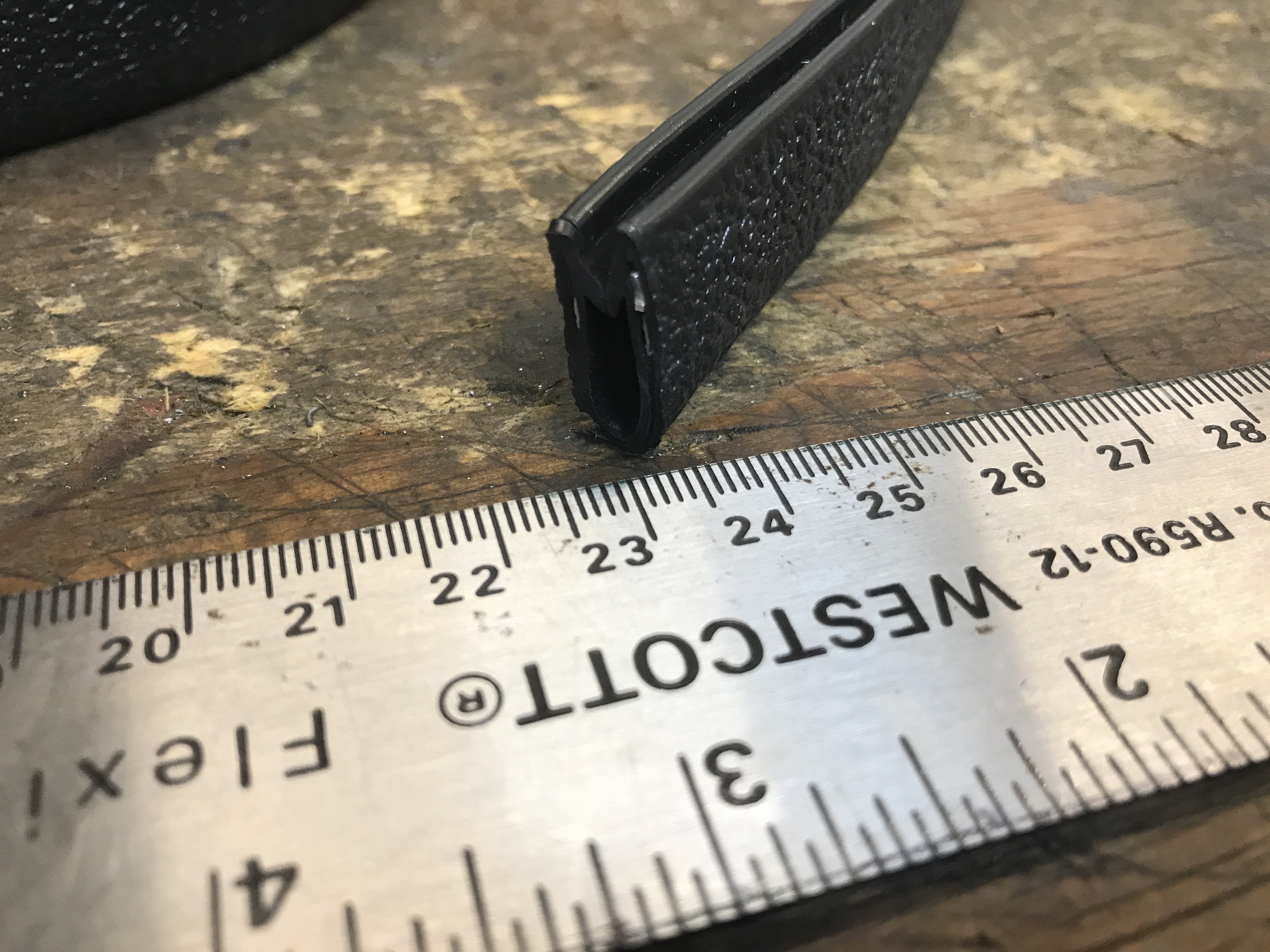

post Jul 5 2021, 07:41 PM
Post #3254

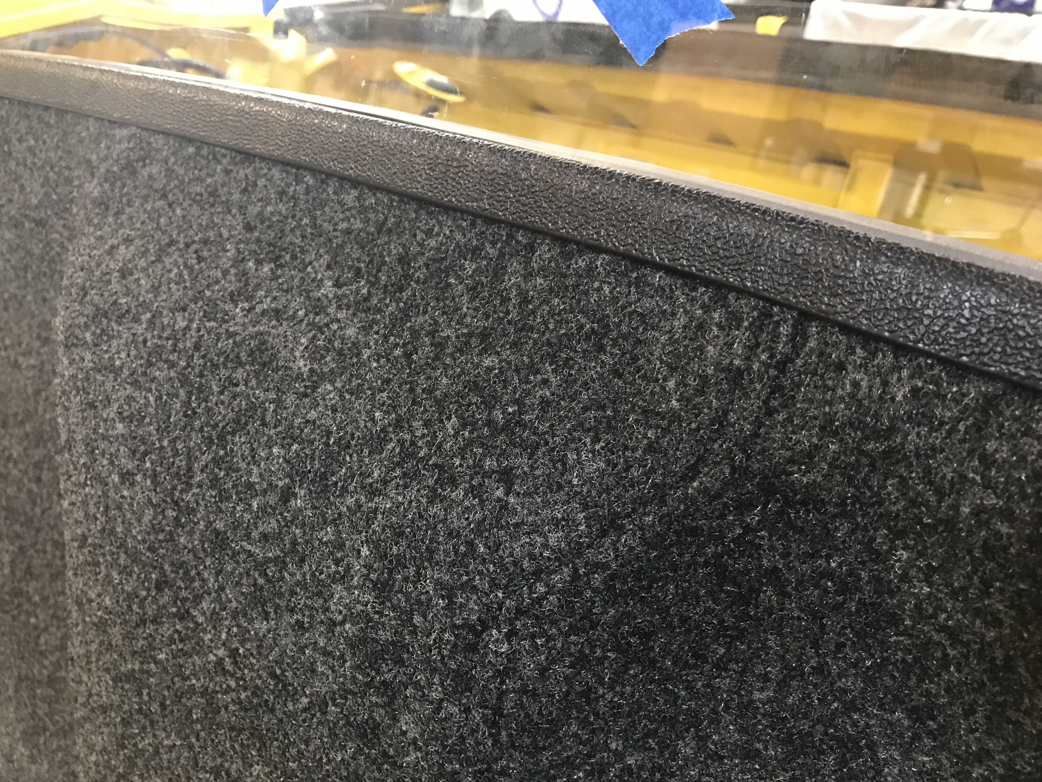

Posts: 8,800
This edge measures 1/8 x 3/4".
post Jul 5 2021, 07:43 PM
Post #3255
Posts: 8,800
I spread the opening to make it possible to insert the soft perlon panel cut edge.

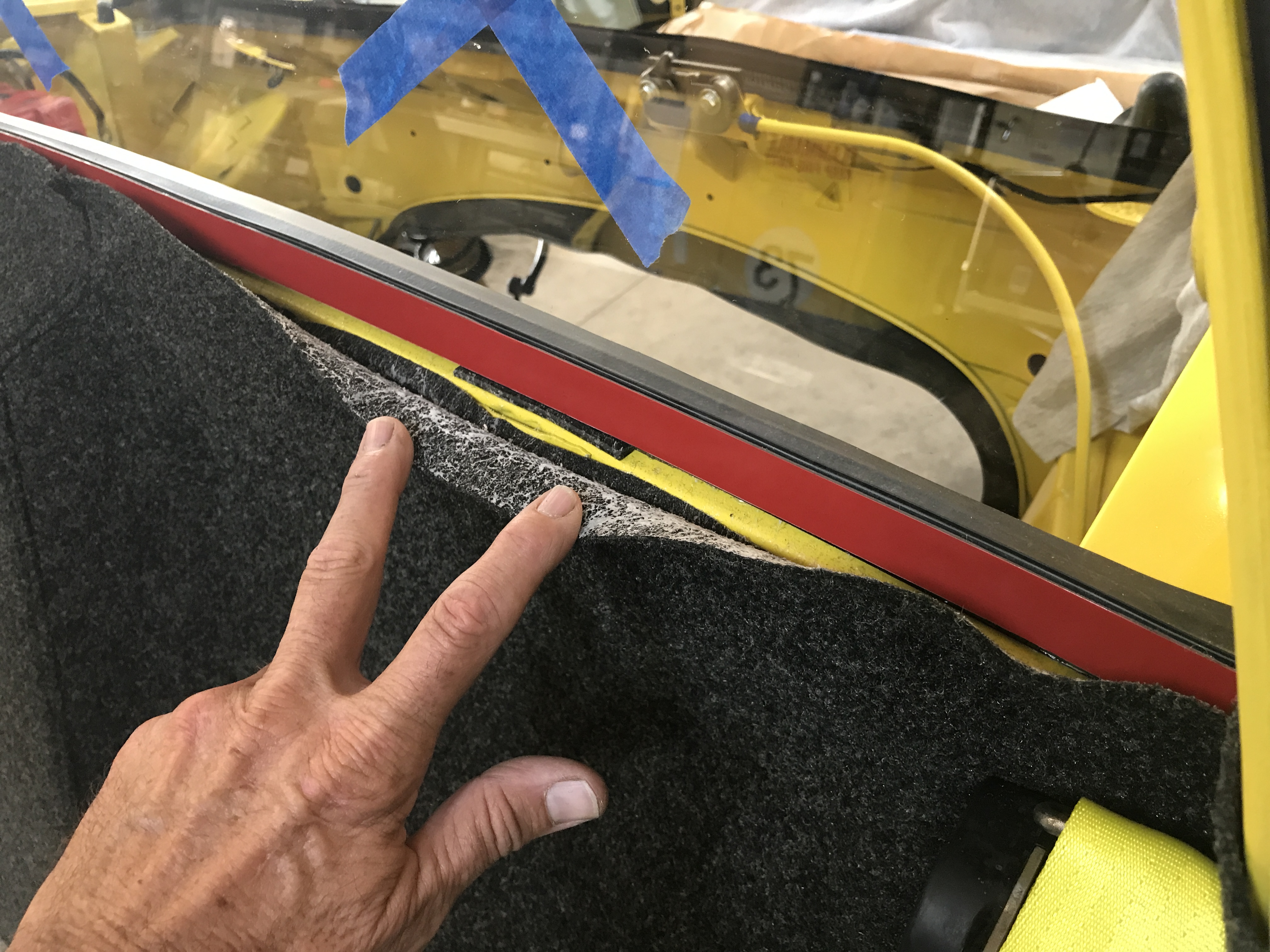

Posts: 8,800

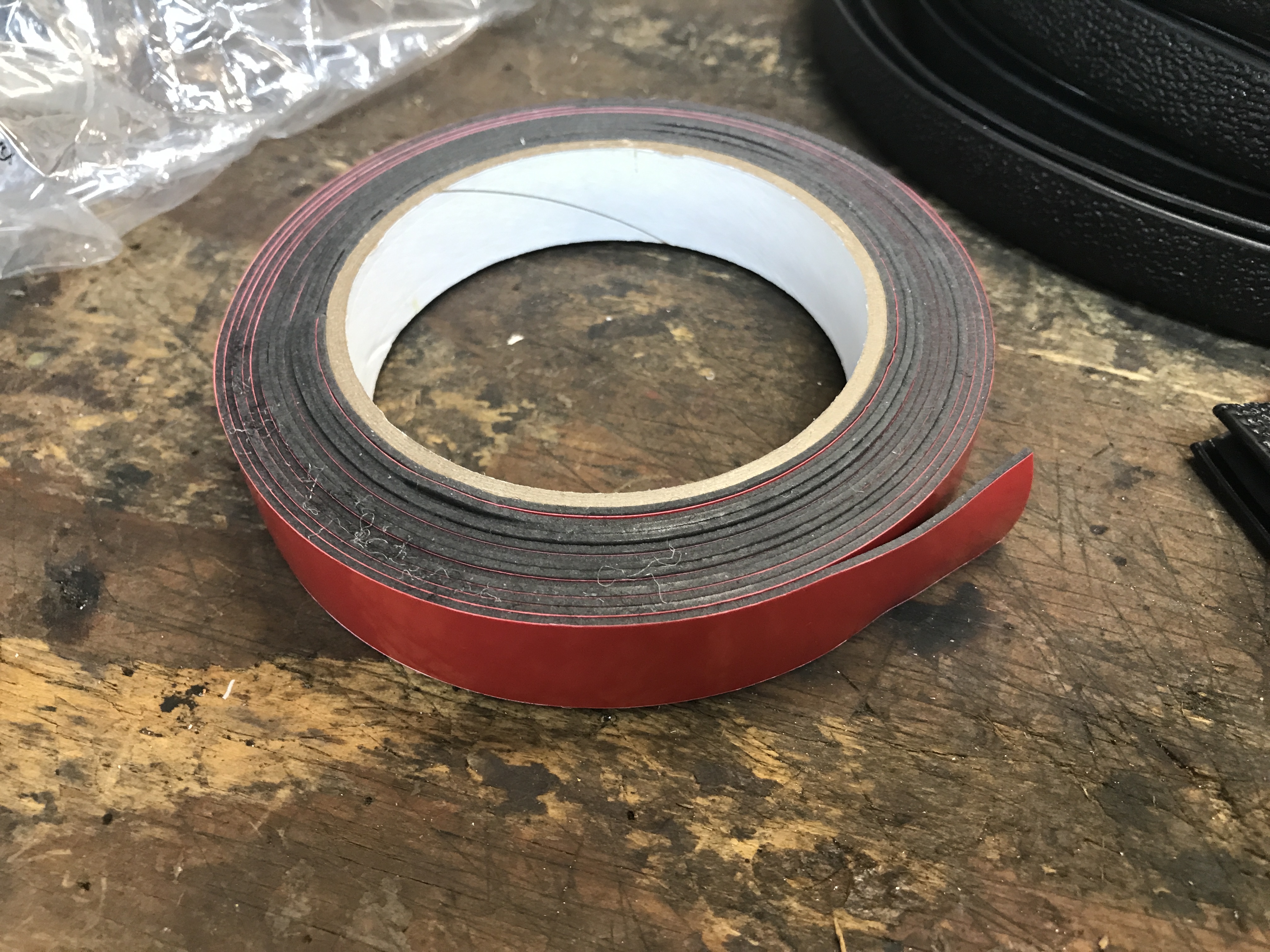

The other ingredient: 3/4" 3M adhesive tape.
post Jul 5 2021, 07:45 PM
Post #3257

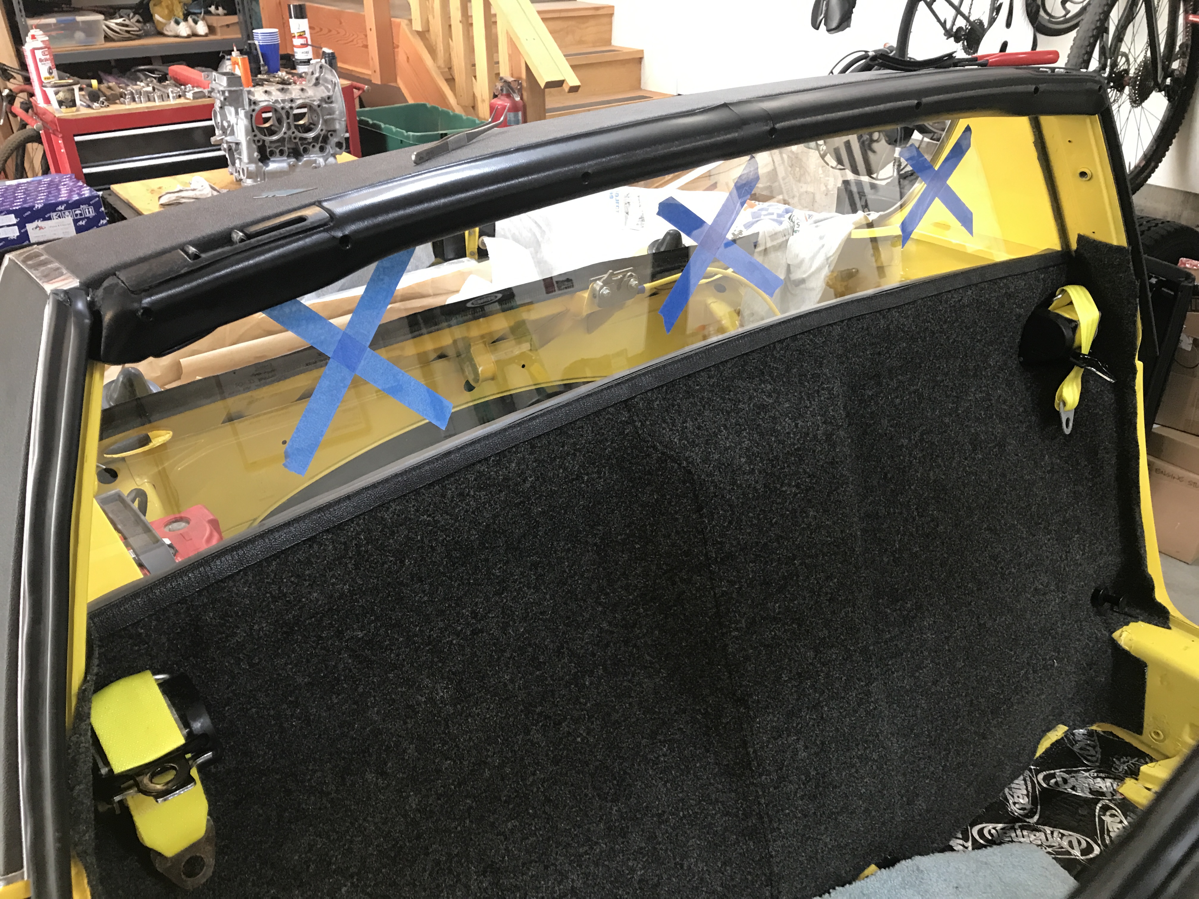

Posts: 8,800

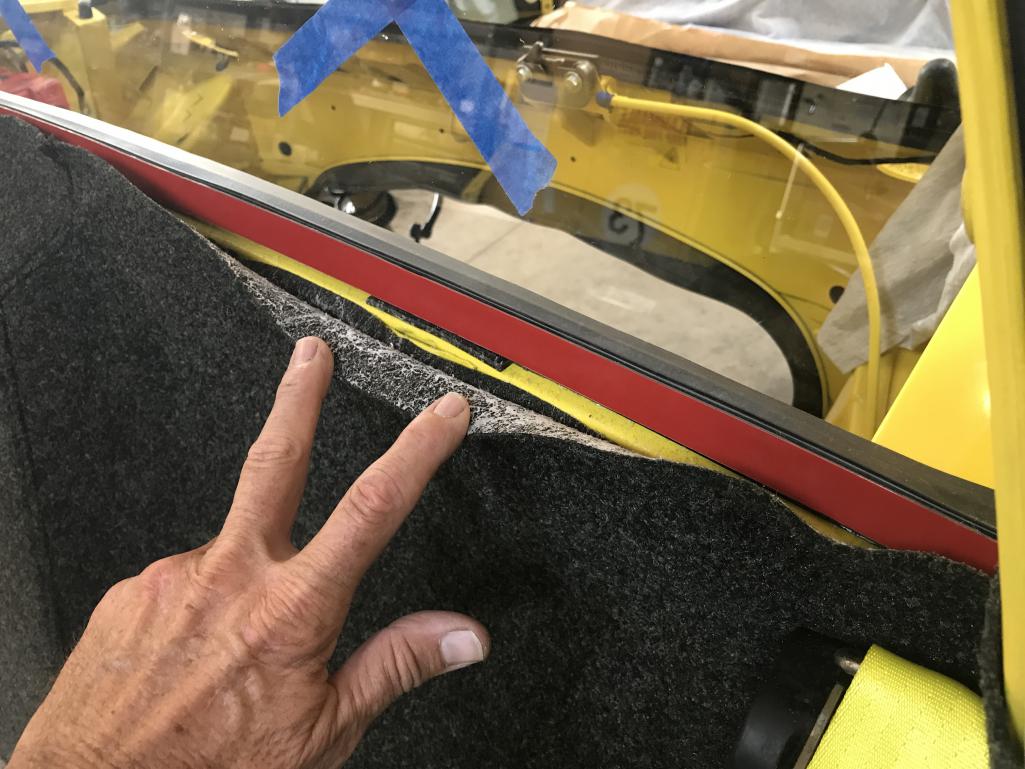

Step 1: run the 3M tape along the lower edge of the glass.
post Jul 5 2021, 07:47 PM
Post #3258
Posts: 8,800
Step 2: Get the PVC edging on the perlon cut edge, and try to make it even (not shown).
Step 3: Pull the covering off the tape and stick the edging in place.
post Jul 5 2021, 07:48 PM
Post #3259
Posts: 8,800
I like it.
post Jul 5 2021, 07:49 PM
Post #3260
Posts: 8,800

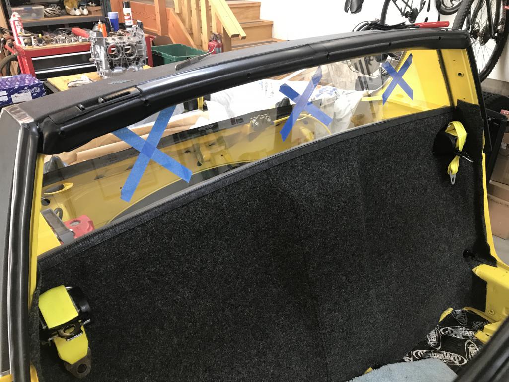

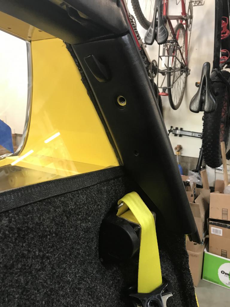

With the edge in place, I could install the side targa pads.
