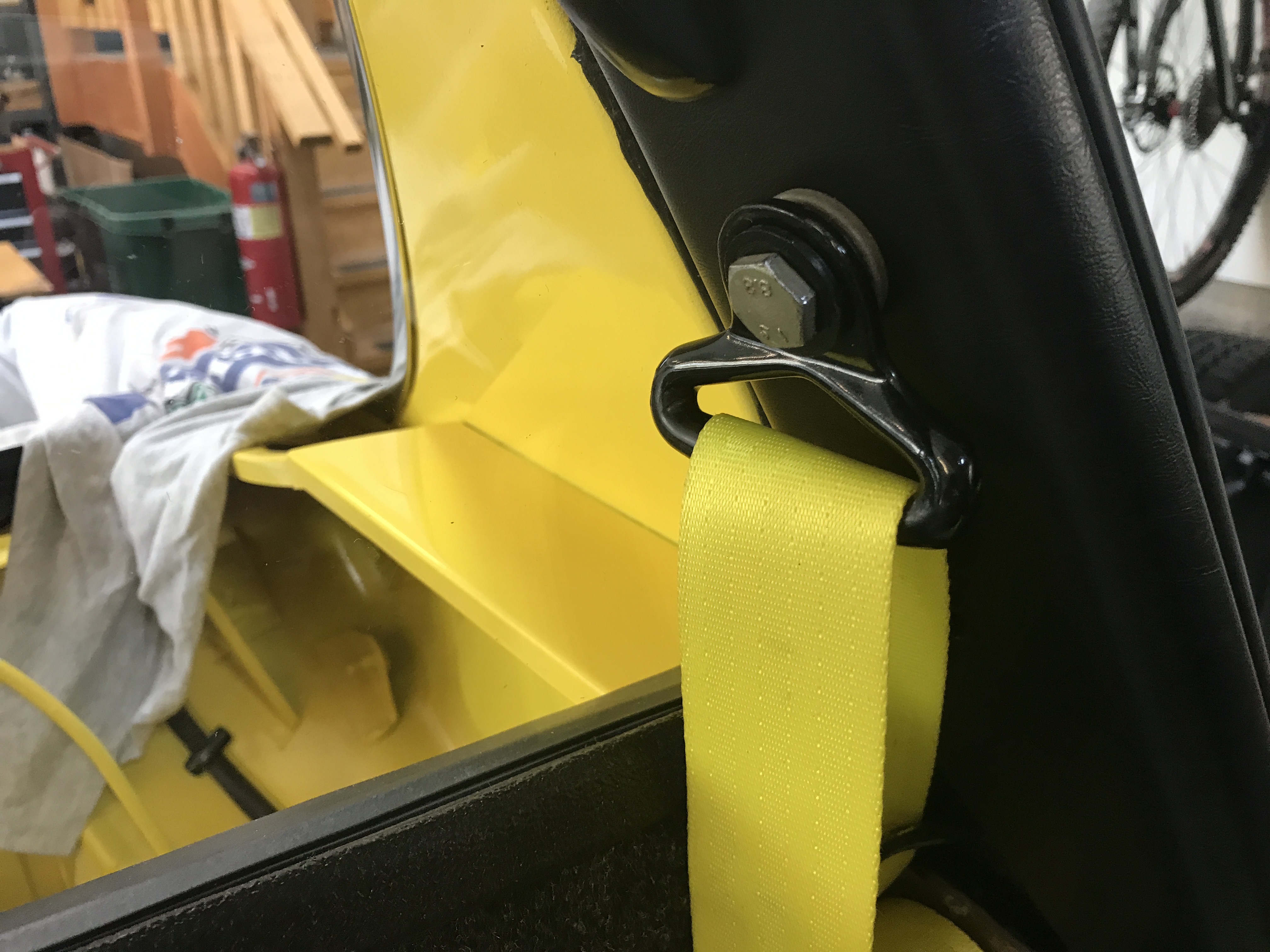

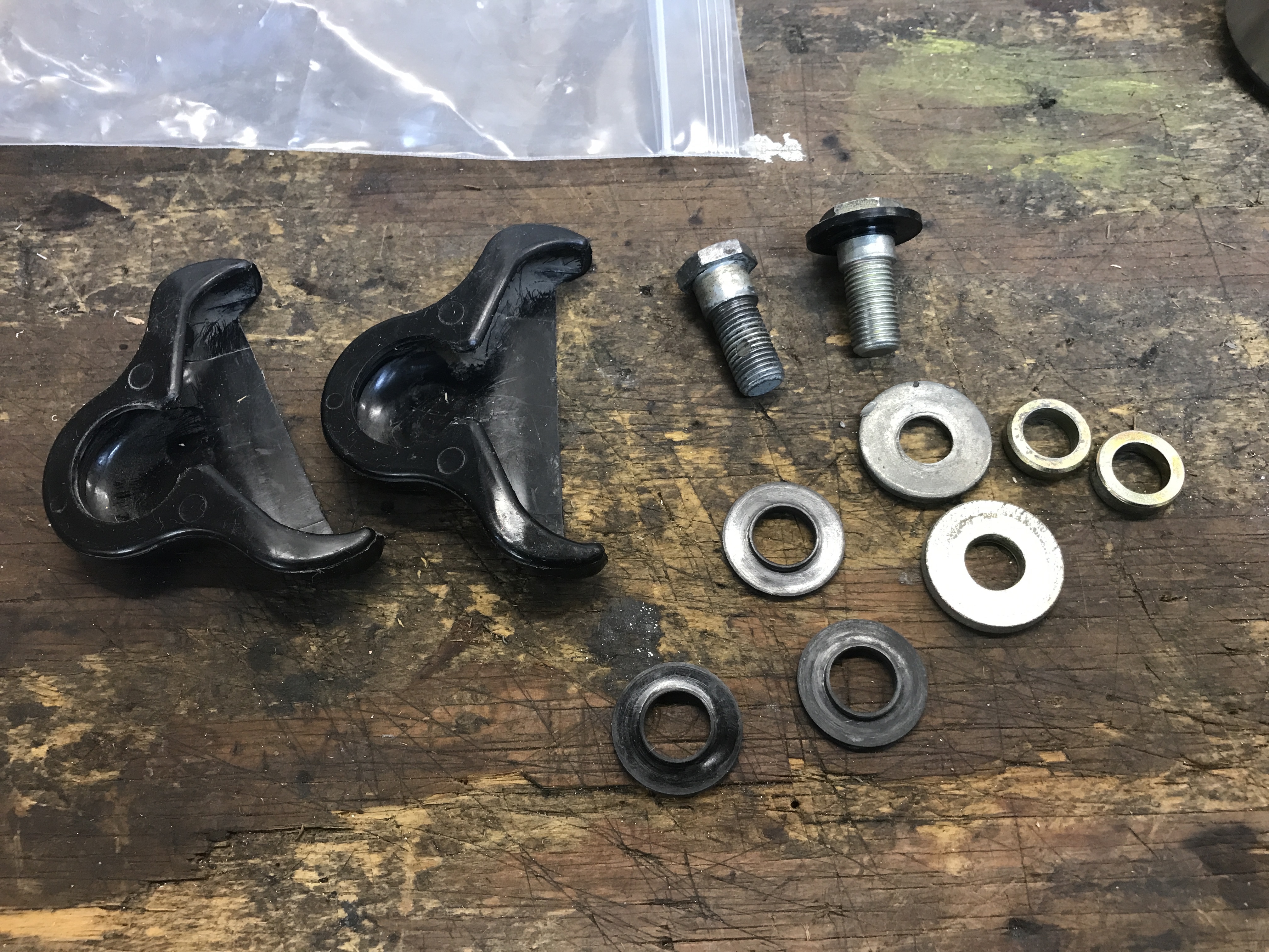

Then I got out the seat belt hardware. This is the kit for mounting the shoulder yokes.
bkrantz
post Jul 5 2021, 08:00 PM
Post #3262
Posts: 8,800
Joined: 3-August 19
From: SW Colorado
Member No.: 23,343

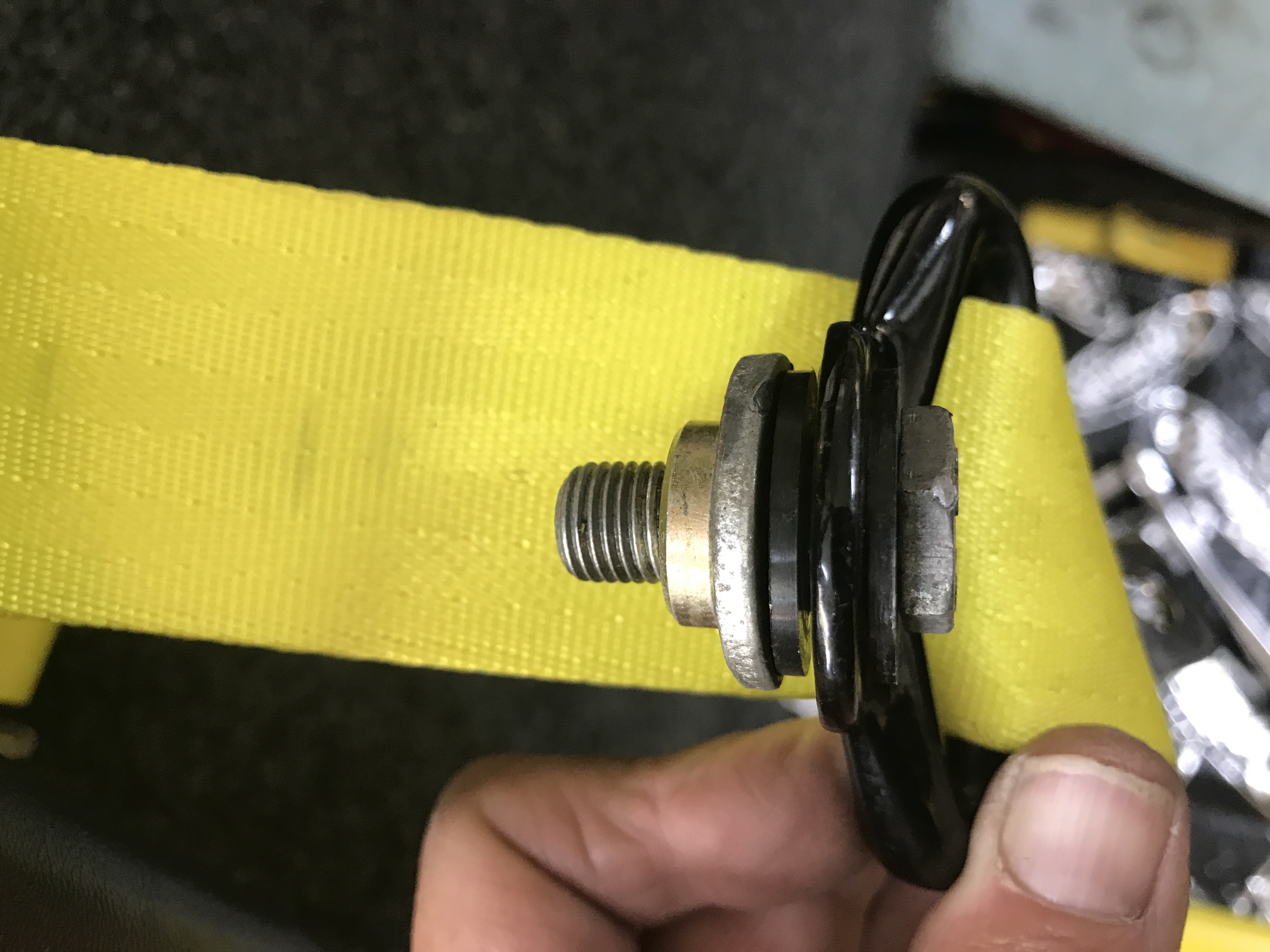

Here's the order: bolt-plastic washer-yoke-plastic washer-large metal washer-metal spacer.
bkrantz
post Jul 5 2021, 08:02 PM
Post #3263
Posts: 8,800
Joined: 3-August 19
From: SW Colorado
Member No.: 23,343
Yoke mounted on the left side.
bkrantz
post Jul 5 2021, 08:03 PM
Post #3264
Posts: 8,800
Joined: 3-August 19
From: SW Colorado
Member No.: 23,343

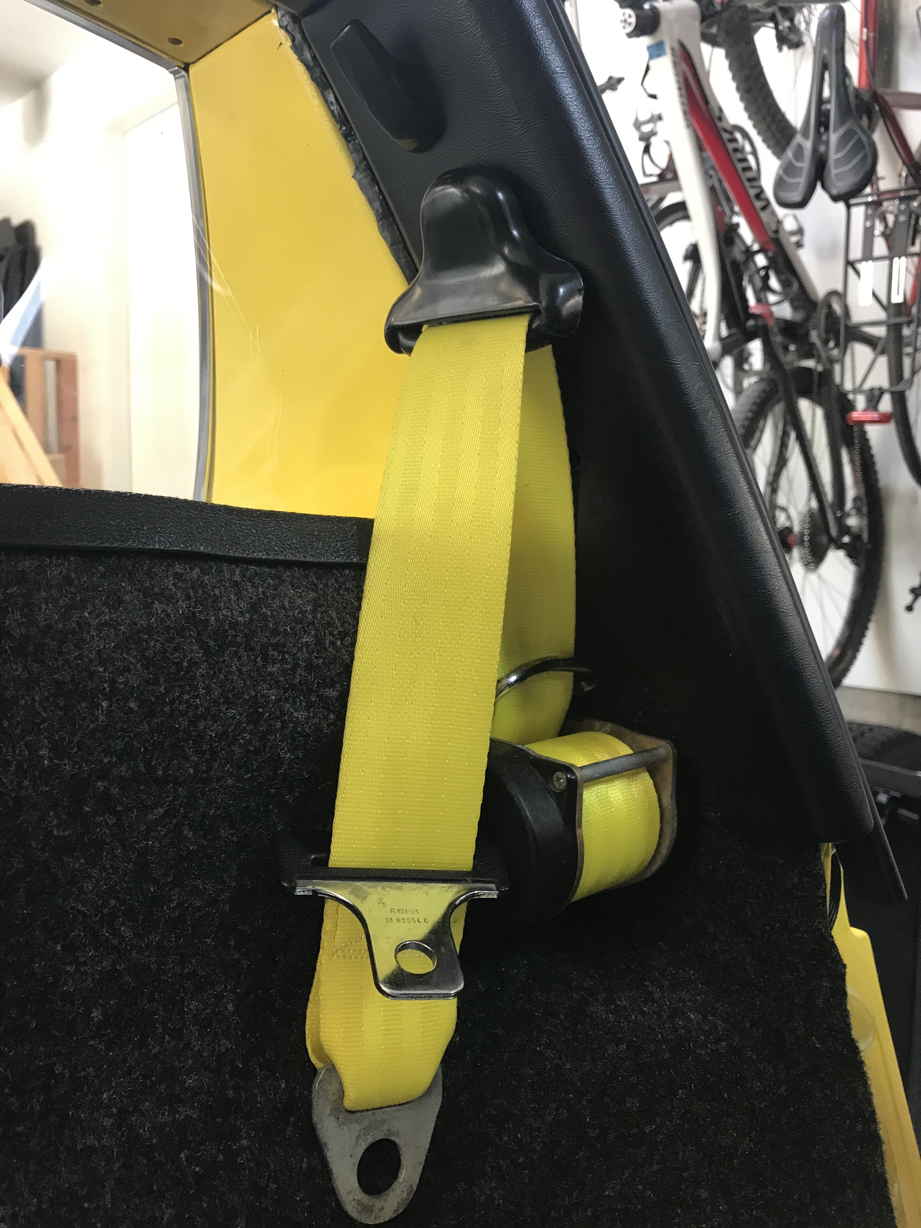

And the plastic cover.

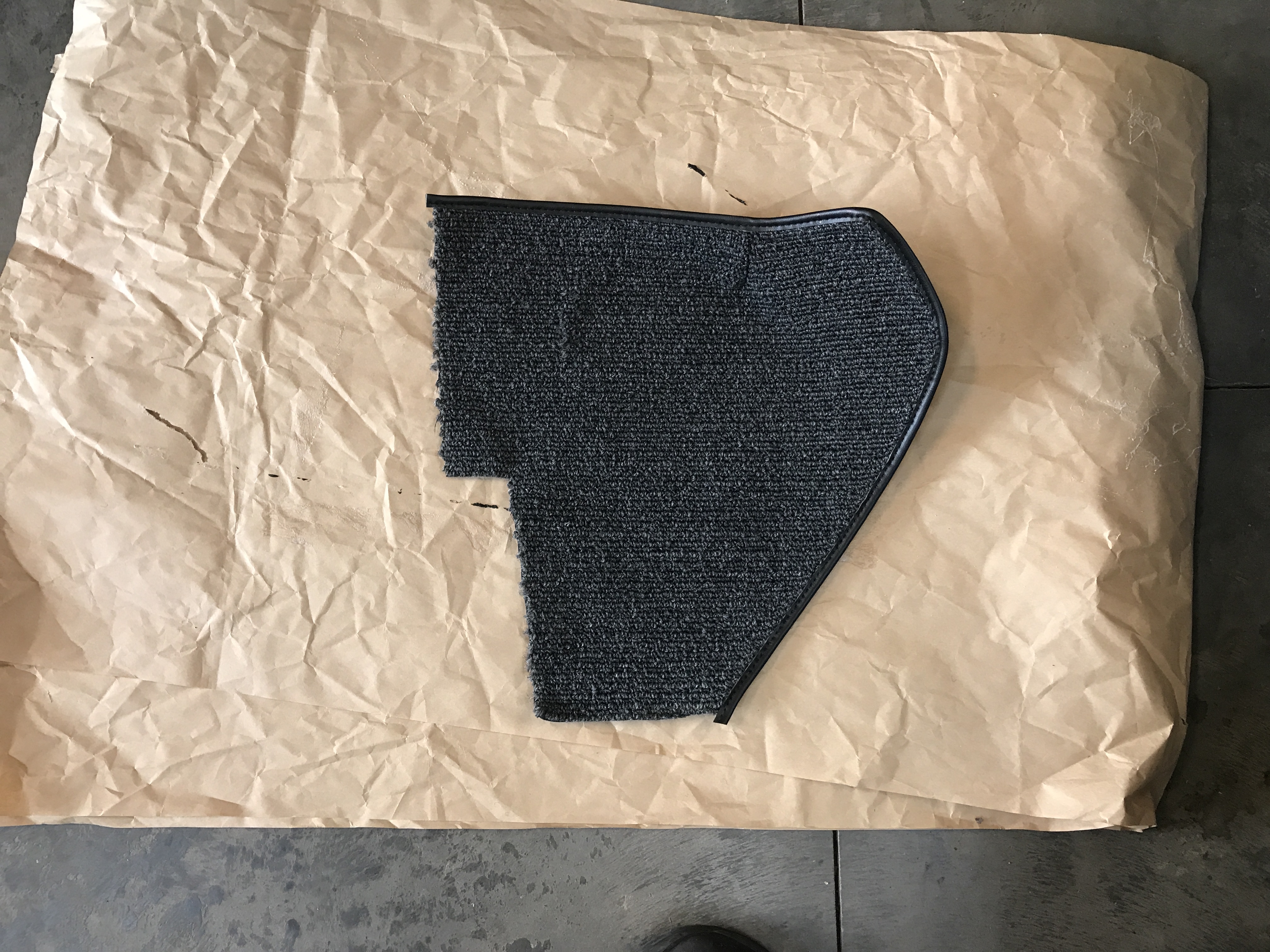

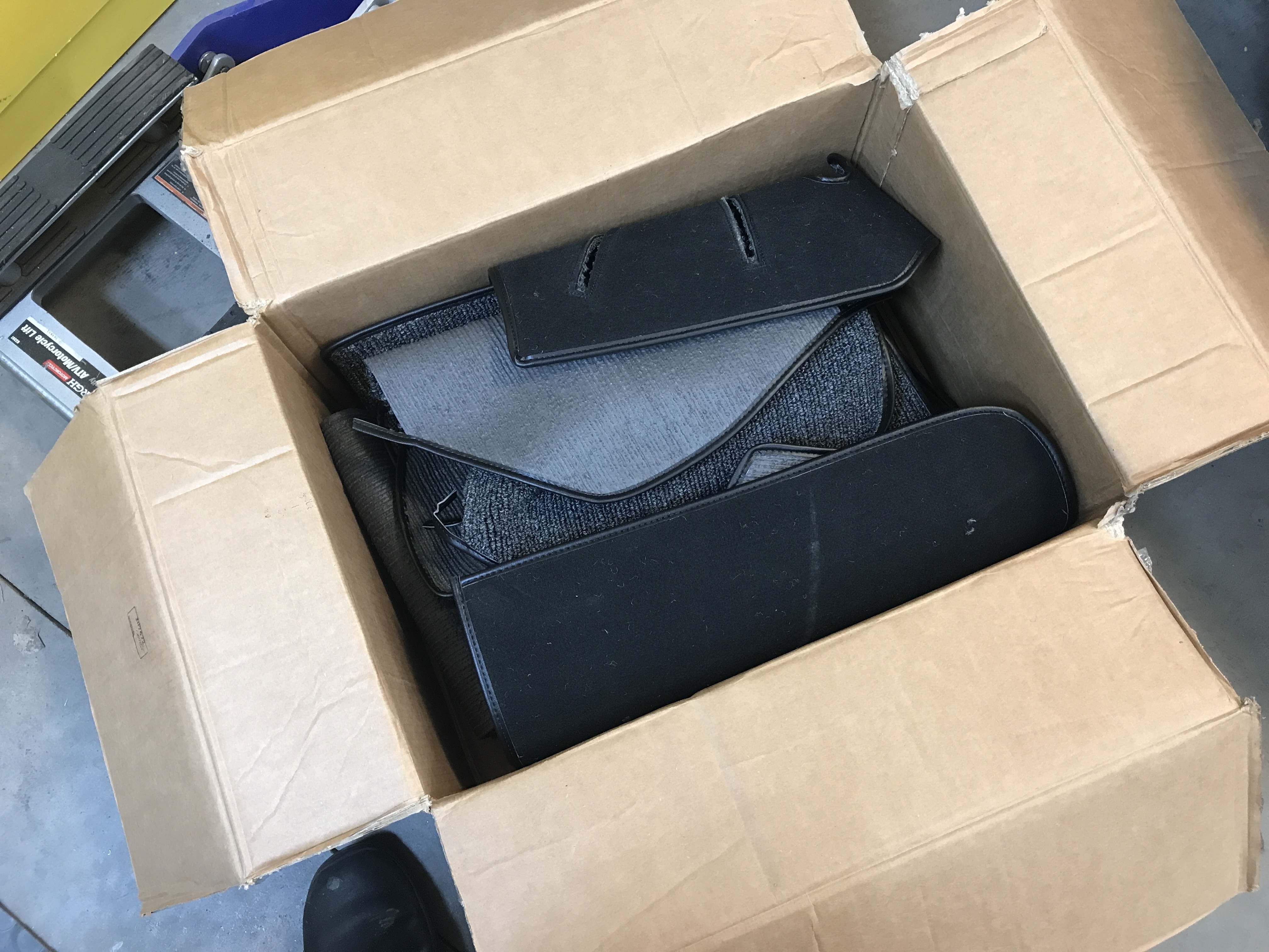

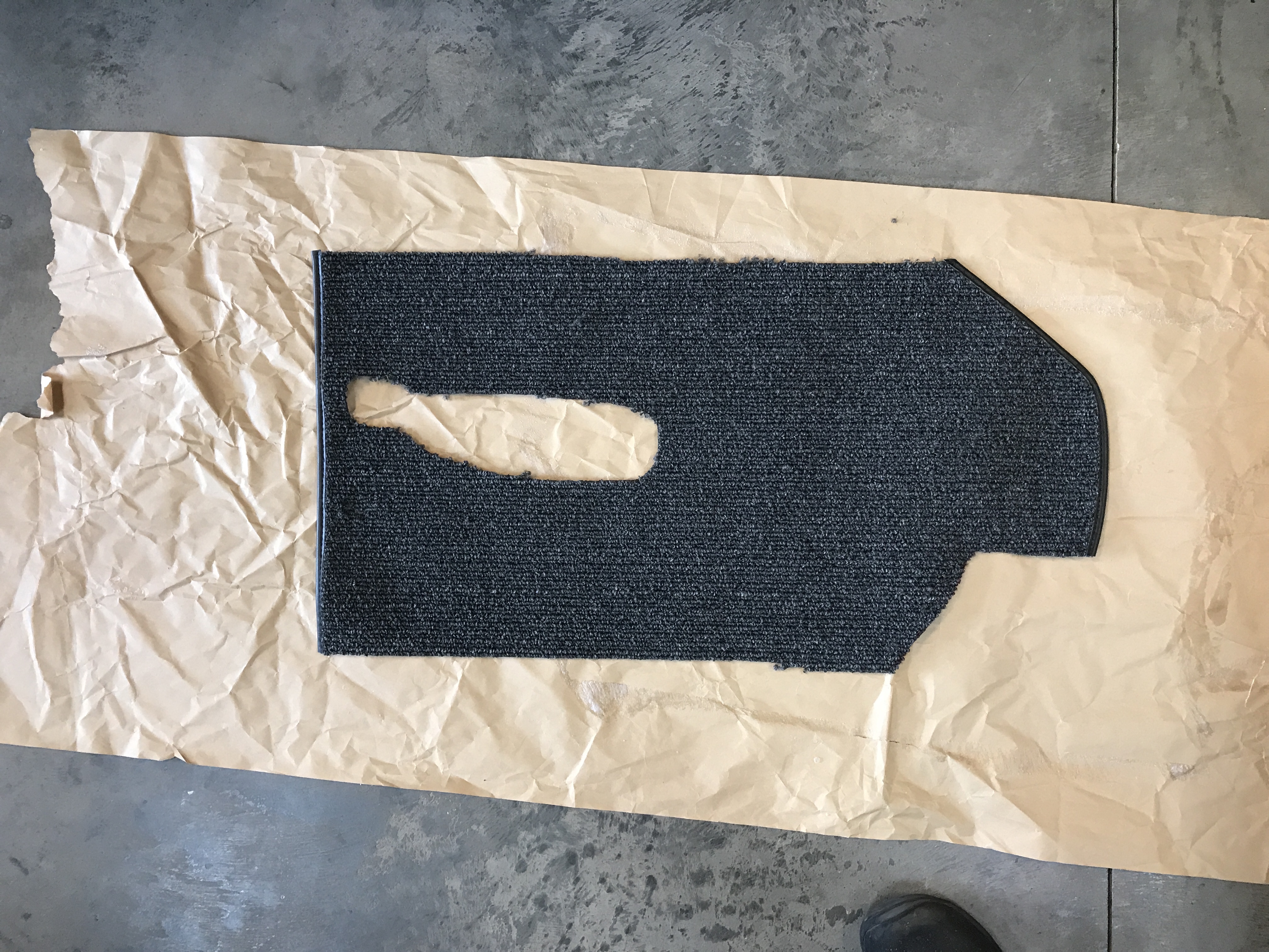

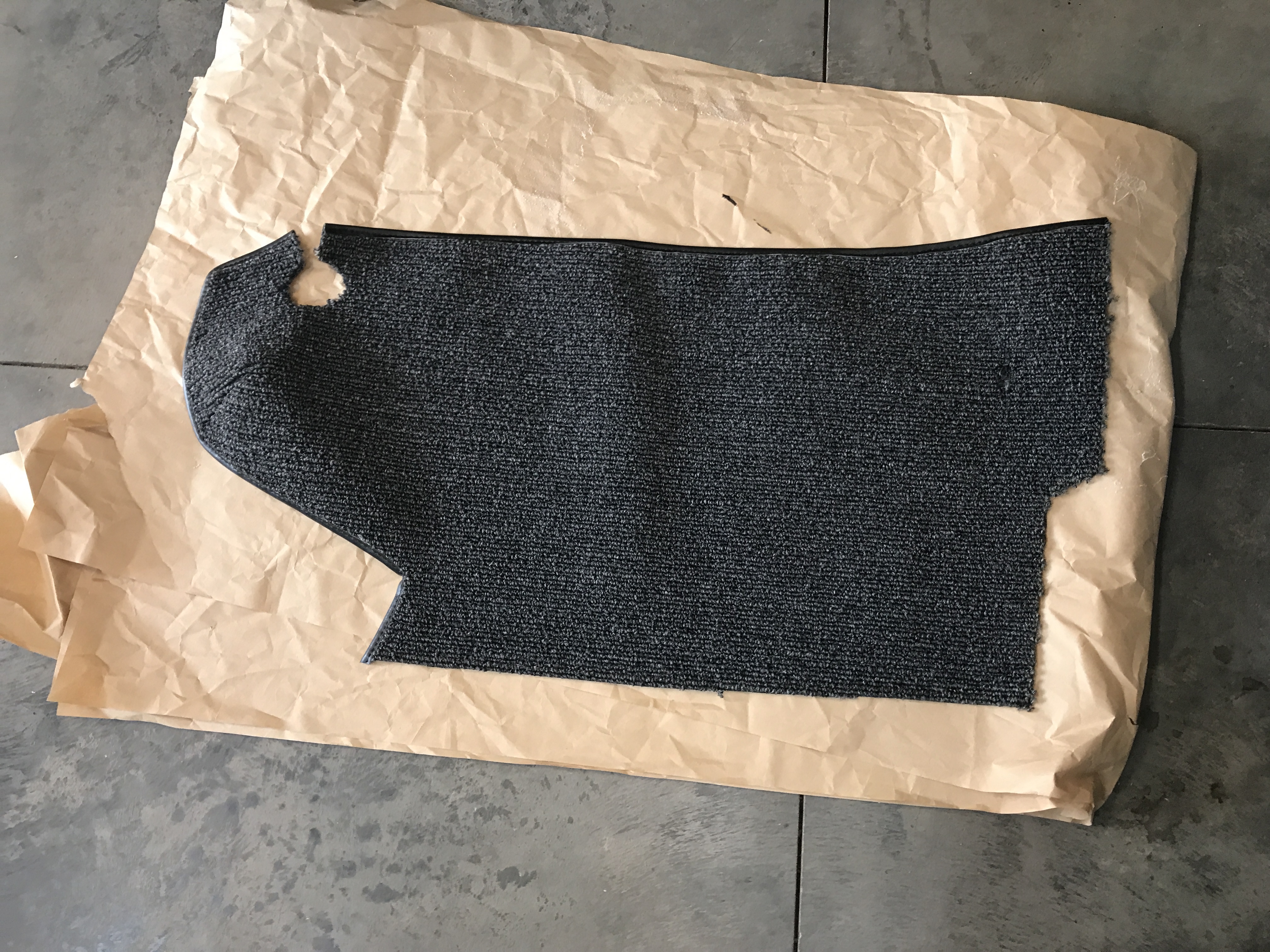

Now that the back panel is done, I can start on the carpet set. This one is from Performance 900 Porsche interiors.

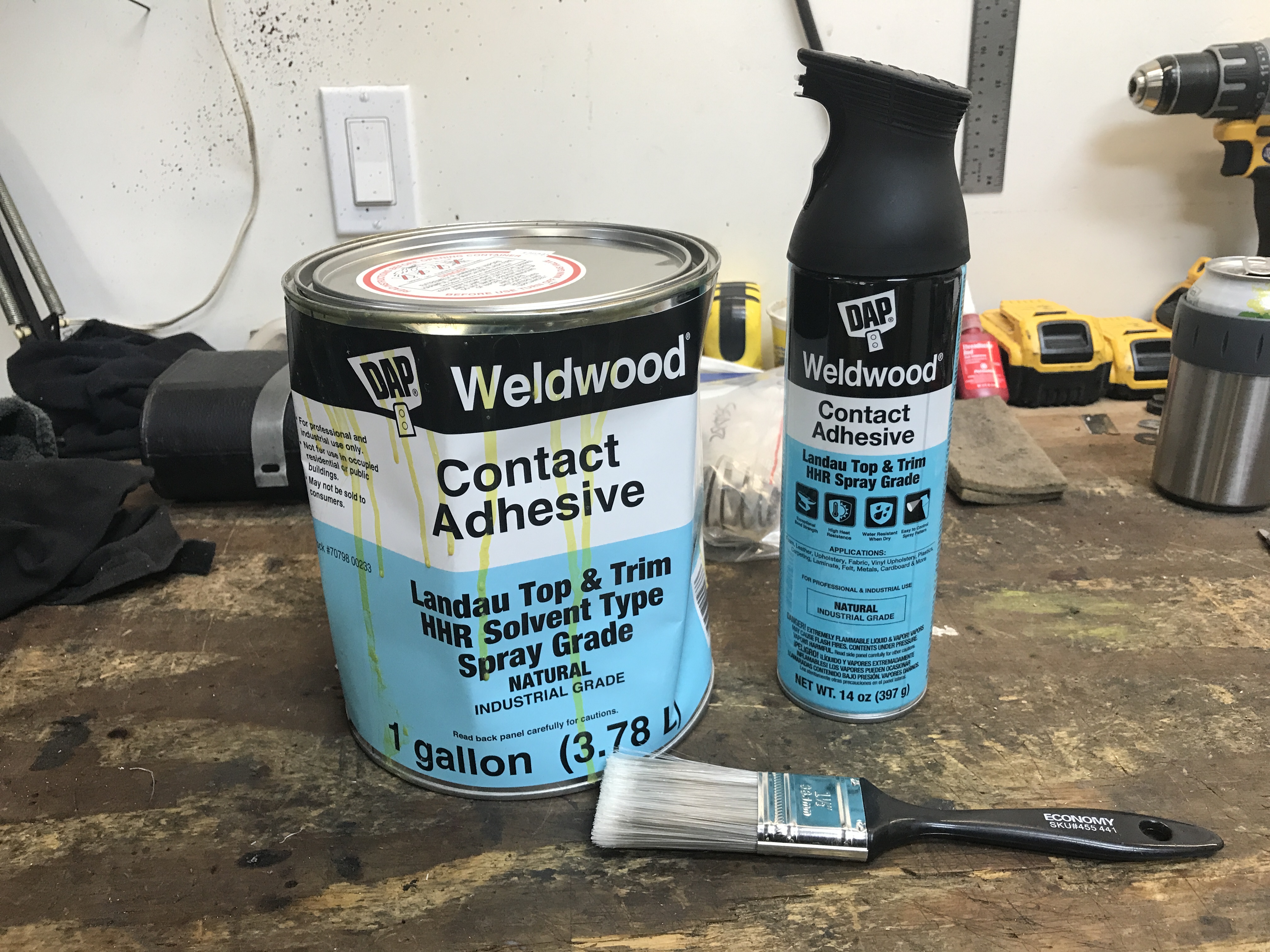

Carpet day1.
I got out my contact adhesive. Brush-on for the car interior, and spray-on for the back side of the carpet.

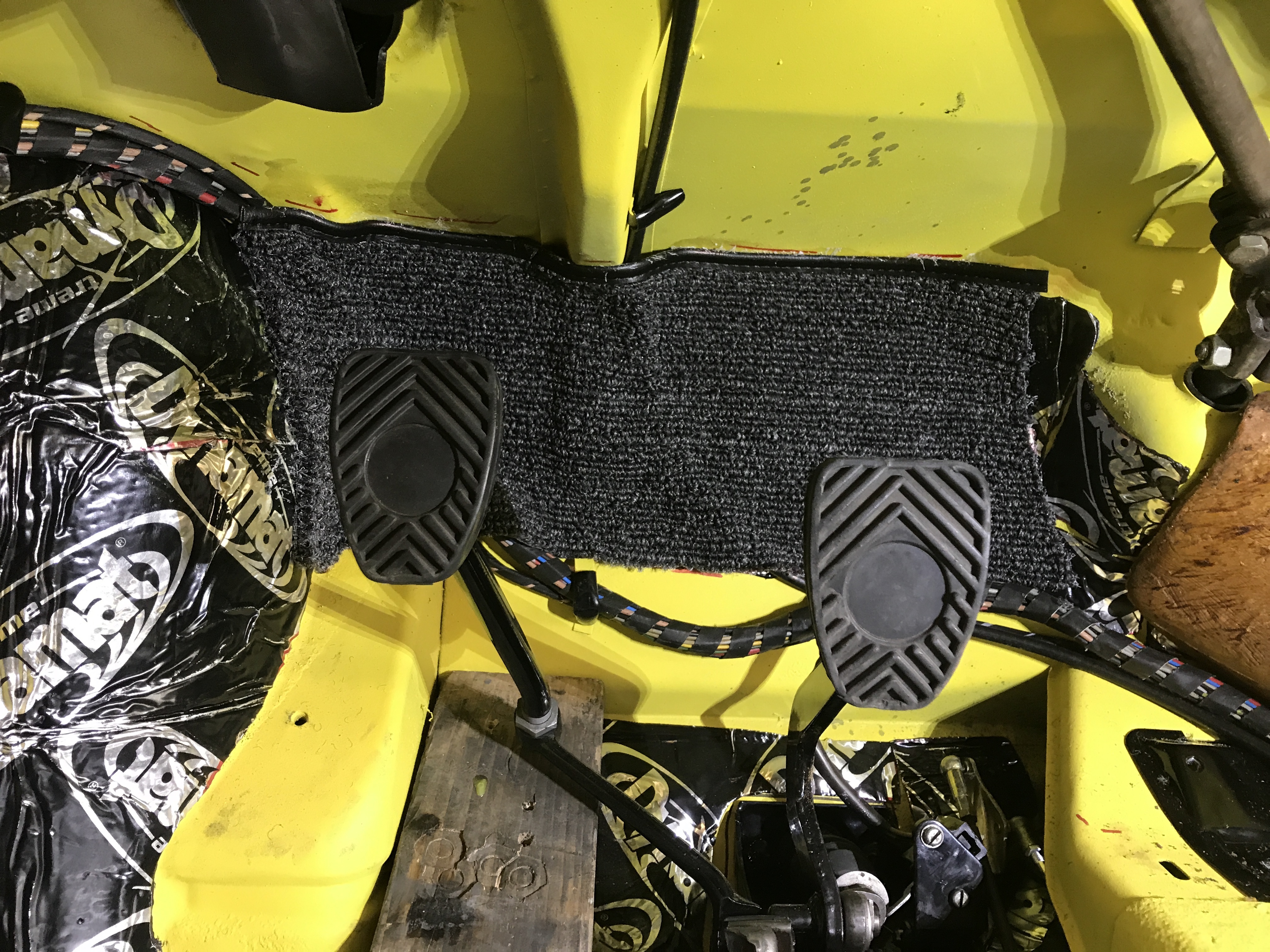

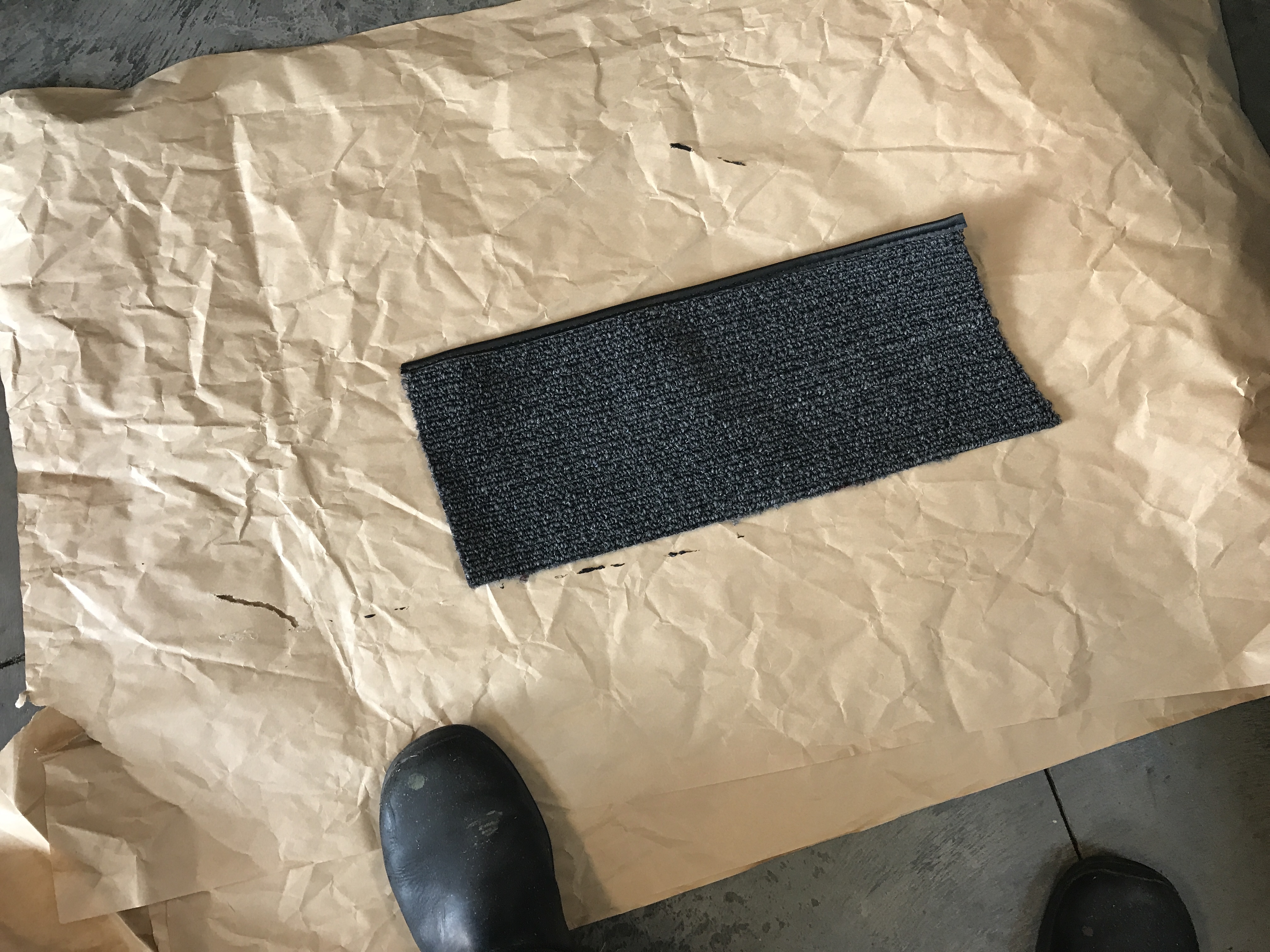

First piece: the small section that goes above the pedals.

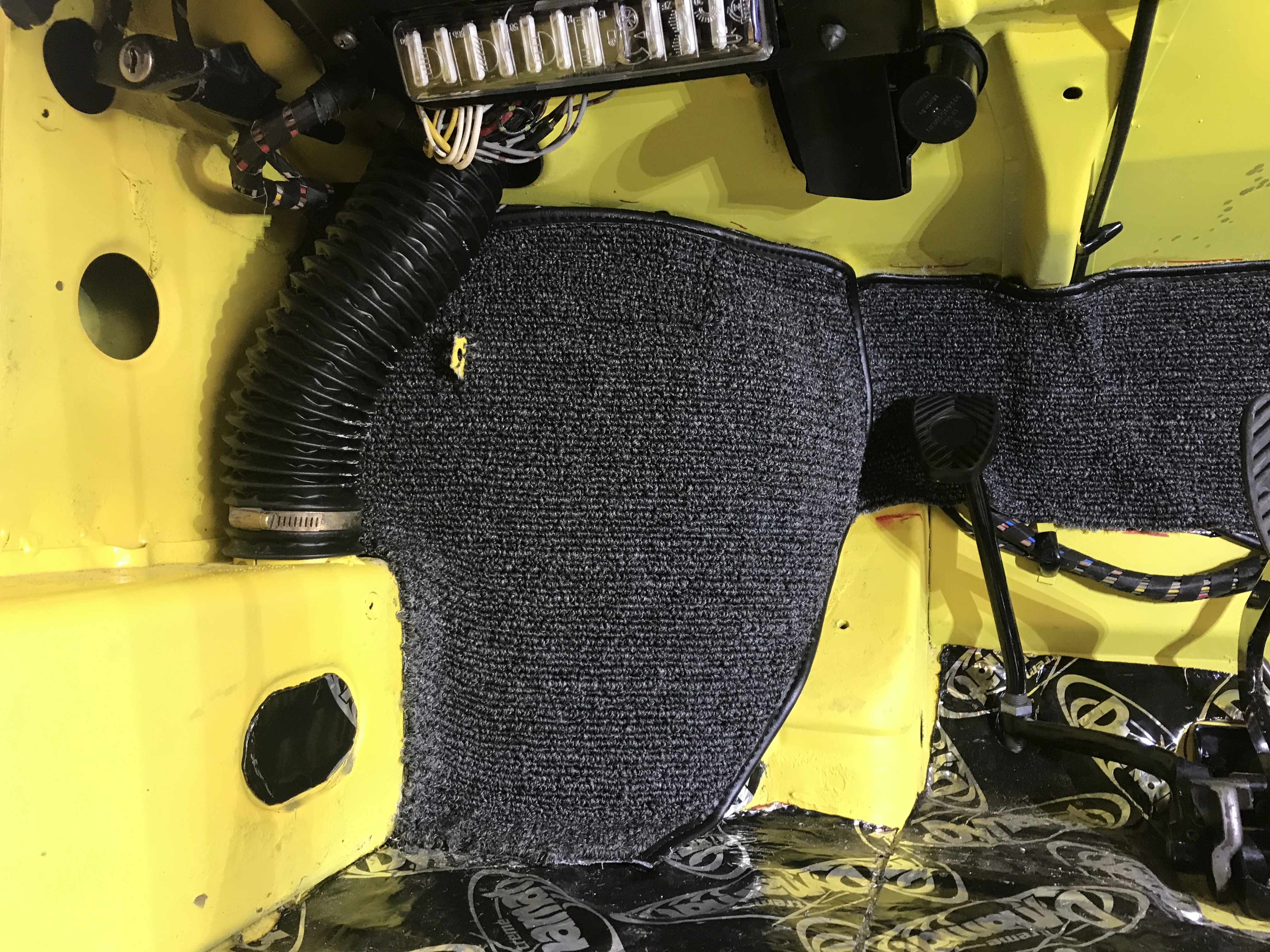

Then the left fender well cover.

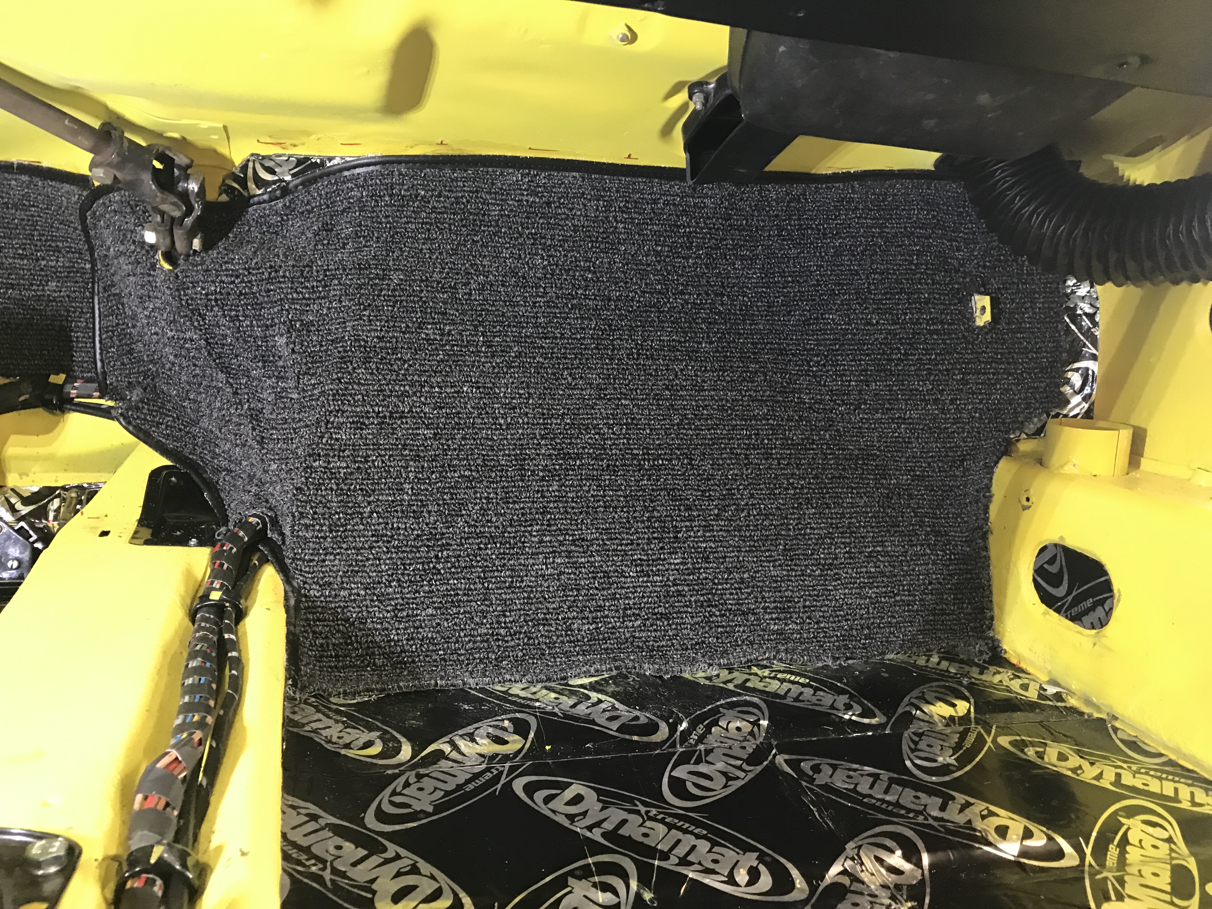

Joined: 3-August 19
From: SW Colorado
Member No.: 23,343
Passenger footwell and right fender well. I cut the opening to mount around the steering shaft.
bkrantz
post Jul 6 2021, 07:25 PM
Post #3274
Posts: 8,800
Joined: 3-August 19
From: SW Colorado
Member No.: 23,343

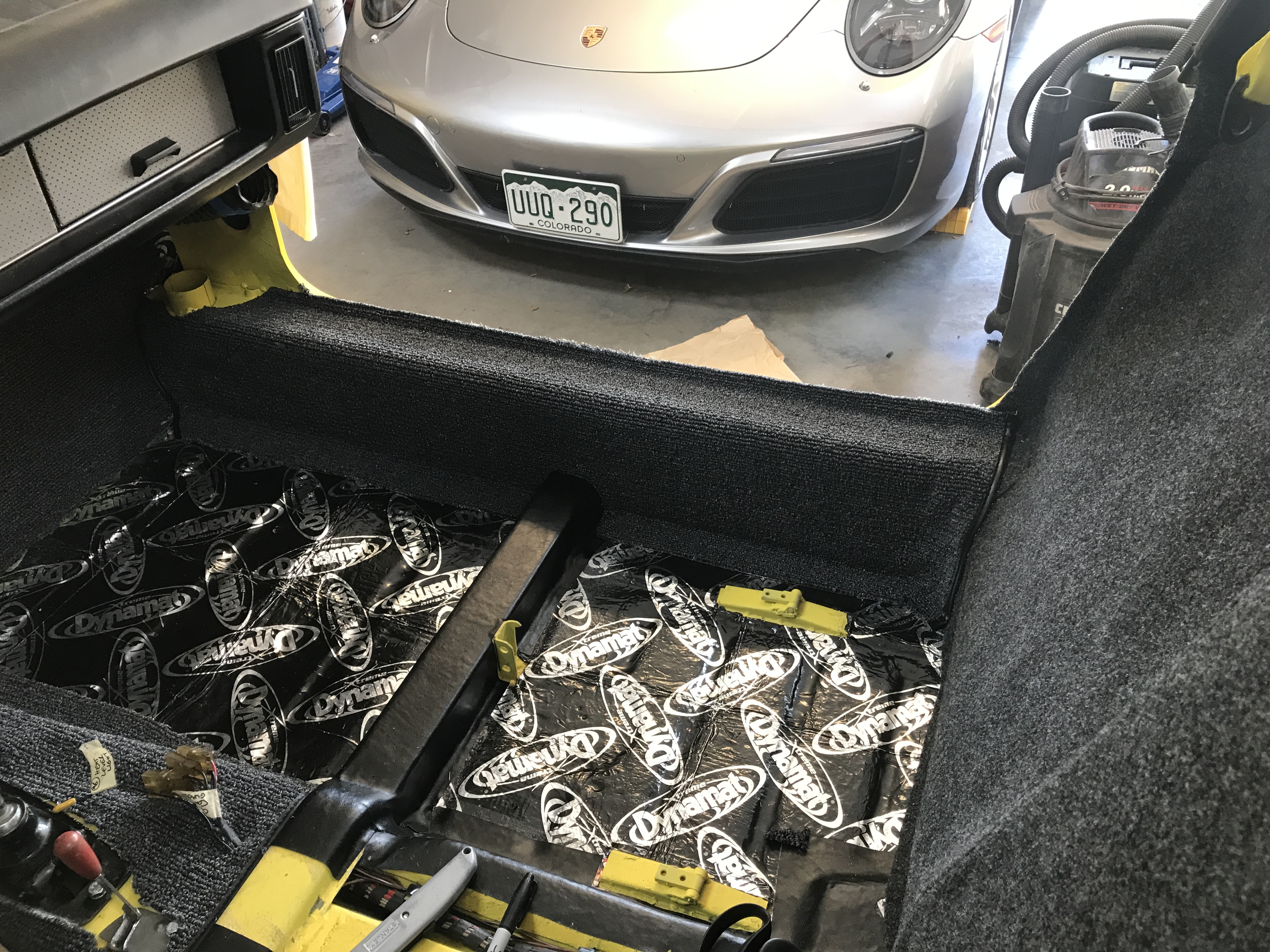

With all the complex shapes, I could not avoid some wrinkles. But the center console will hide those.

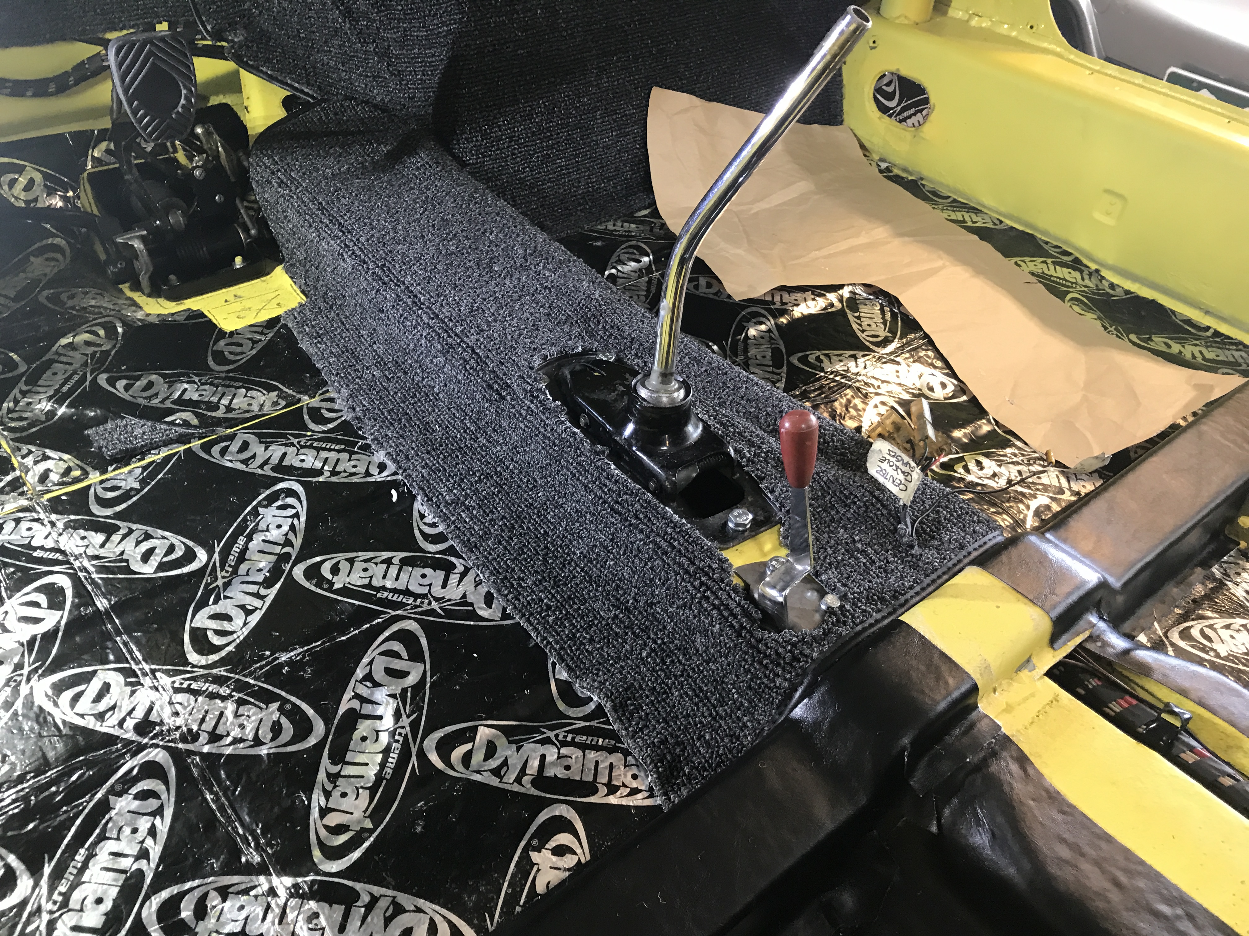

Joined: 3-August 19
From: SW Colorado
Member No.: 23,343
Front tunnel cover. I decided to trim it around the shifter flange.
bkrantz
post Jul 6 2021, 07:28 PM
Post #3276
Posts: 8,800
Joined: 3-August 19
From: SW Colorado
Member No.: 23,343
A bit fiddly, but done.

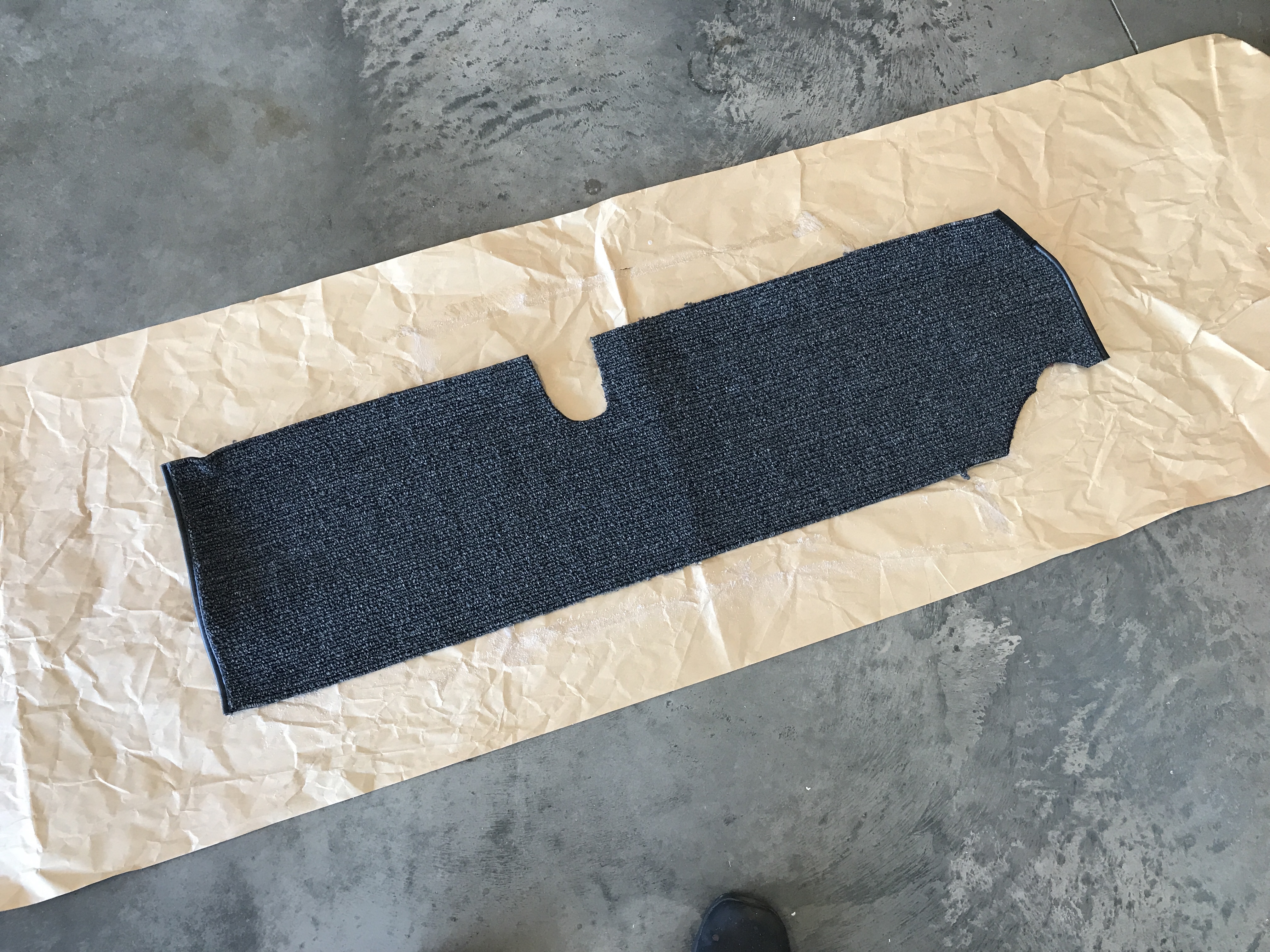

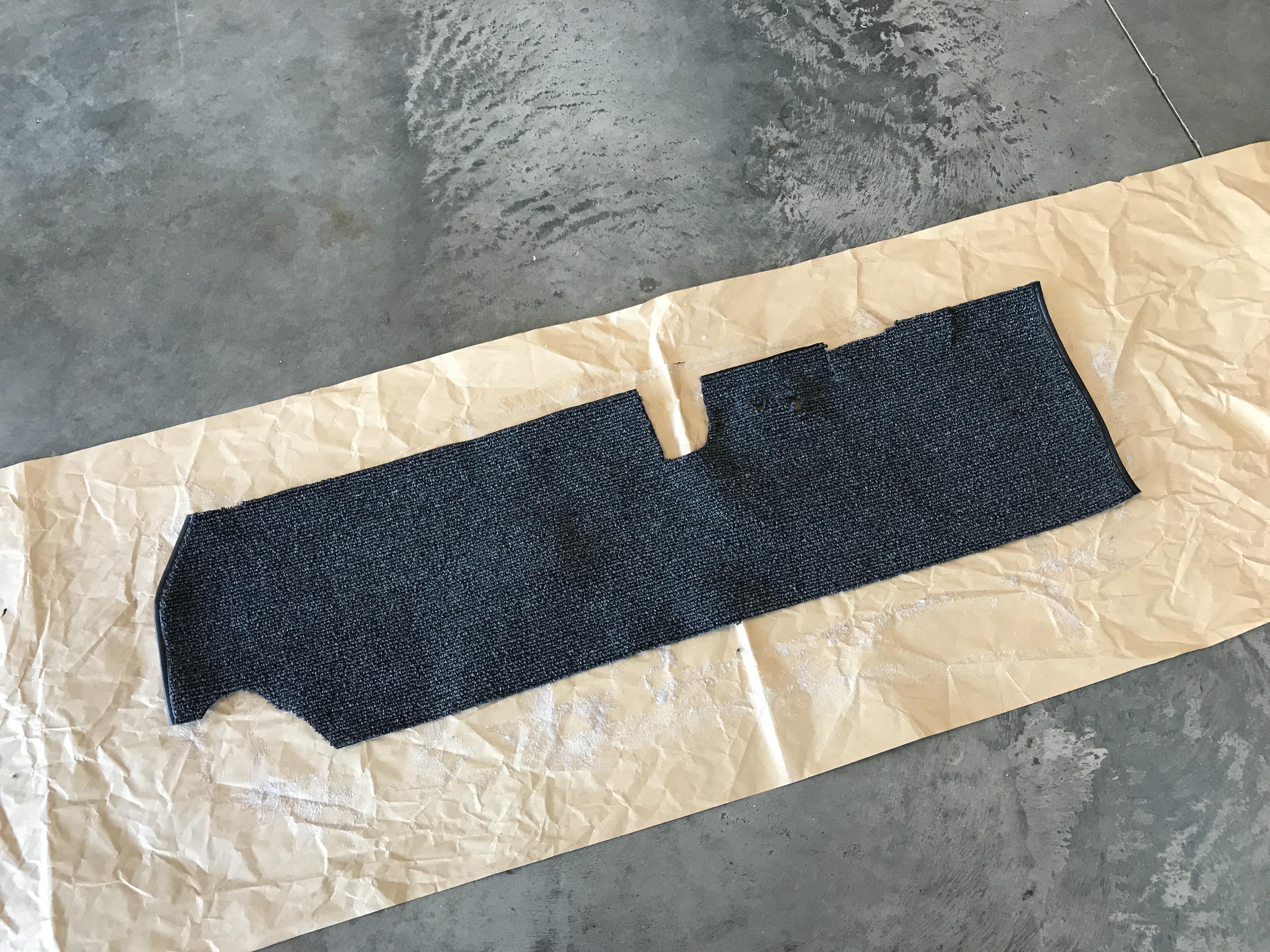

Carpet day 2!
Right sill piece.
bkrantz
post Jul 7 2021, 08:10 PM
Post #3279
Posts: 8,800
Joined: 3-August 19
From: SW Colorado
Member No.: 23,343
Installed, pretty straight.
bkrantz
post Jul 7 2021, 08:11 PM
Post #3280
Posts: 8,800
Joined: 3-August 19
From: SW Colorado
Member No.: 23,343
Left sill piece.
