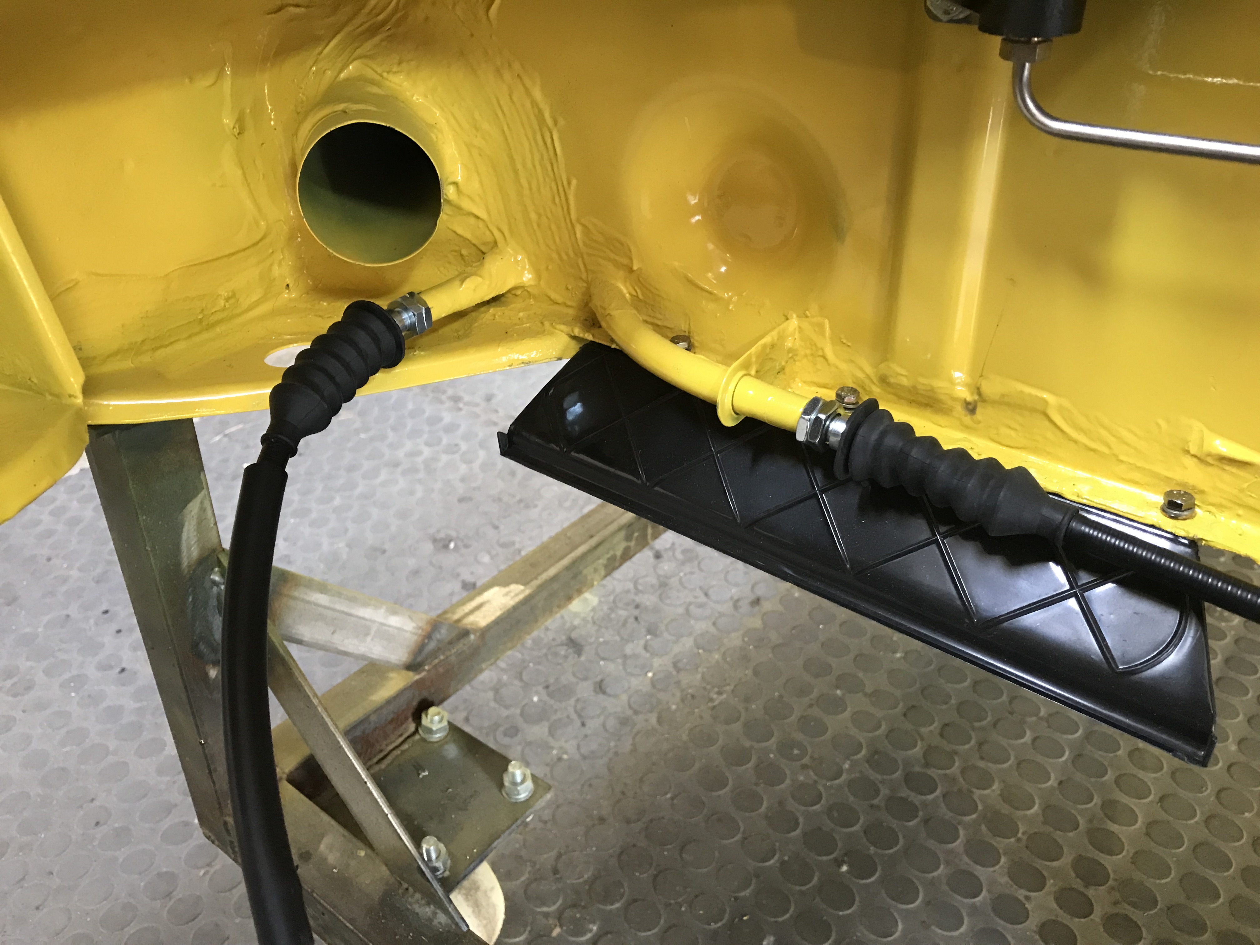

Member No.: 23,343

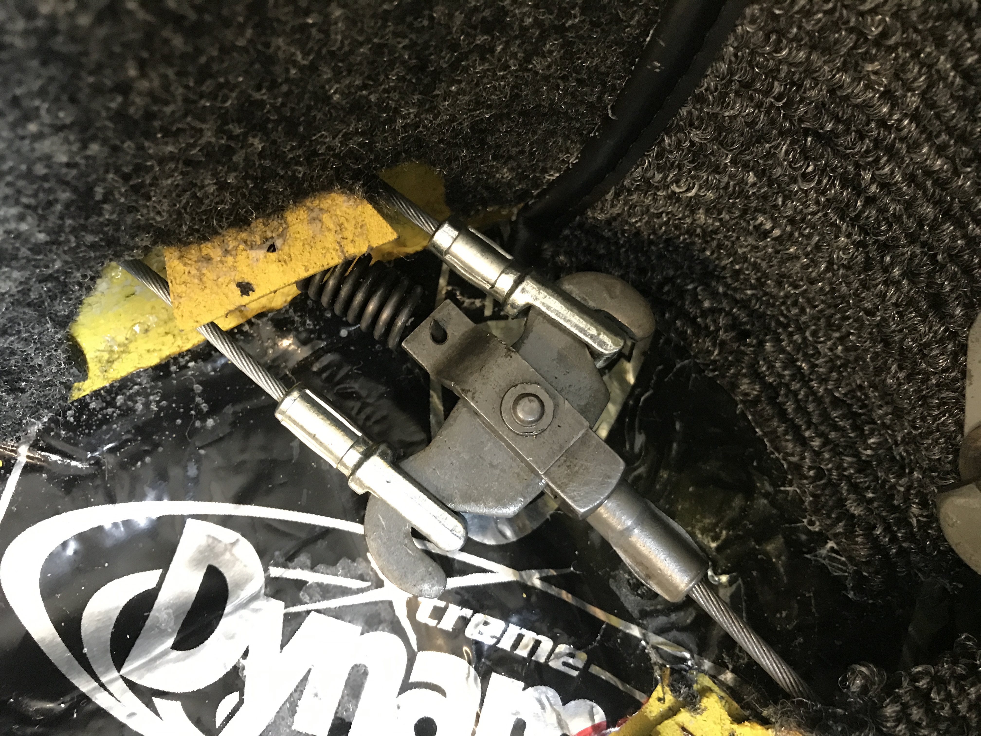

New cables inserted from the engine side. These will get adjusted later.

bkrantz

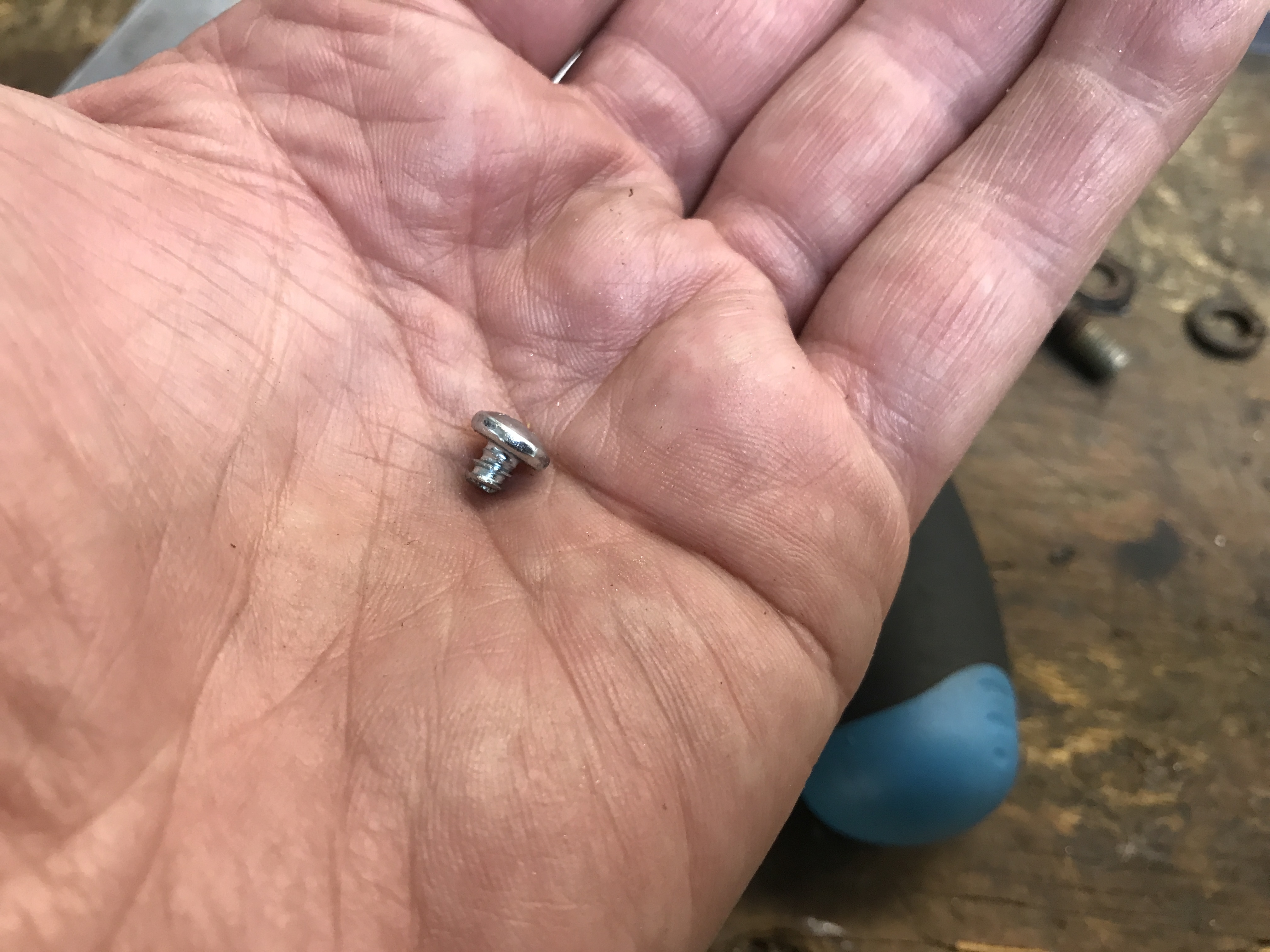

The screw for the cover was interfering with the spring, so I cut it short.

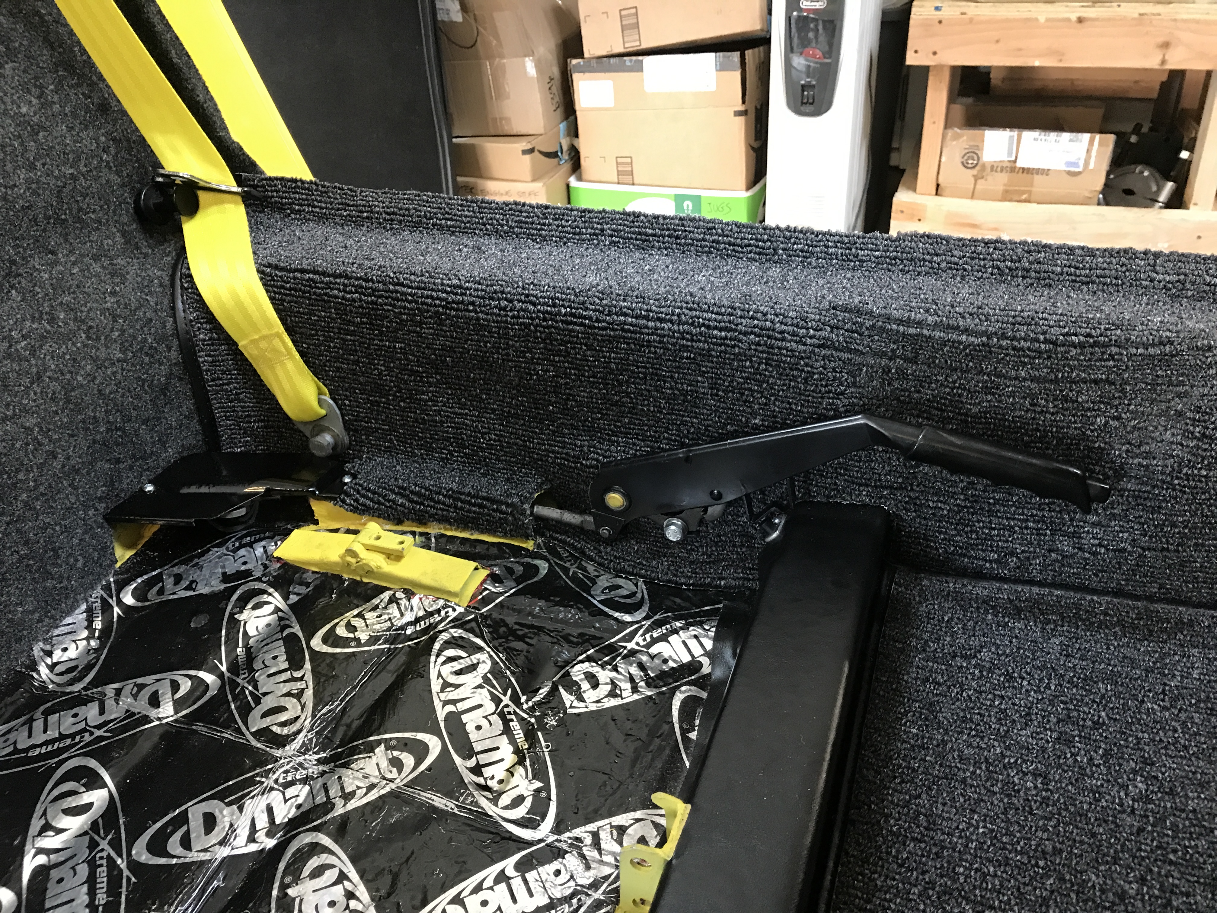

bkrantz
post Jul 8 2021, 08:00 PM
Post #3304
Posts: 8,800
Joined: 3-August 19
From: SW Colorado
Member No.: 23,343
Handle done.

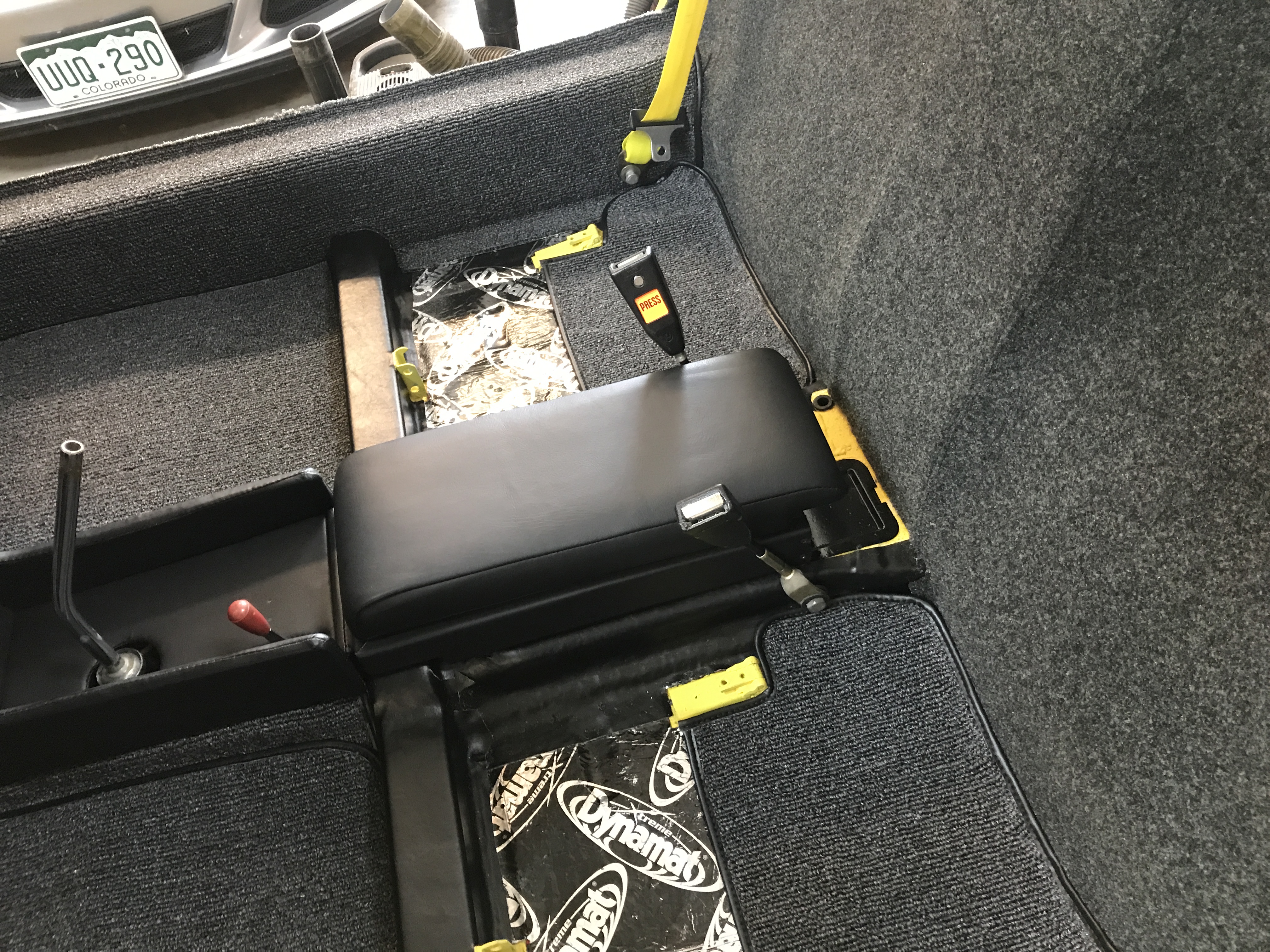

Member No.: 23,343

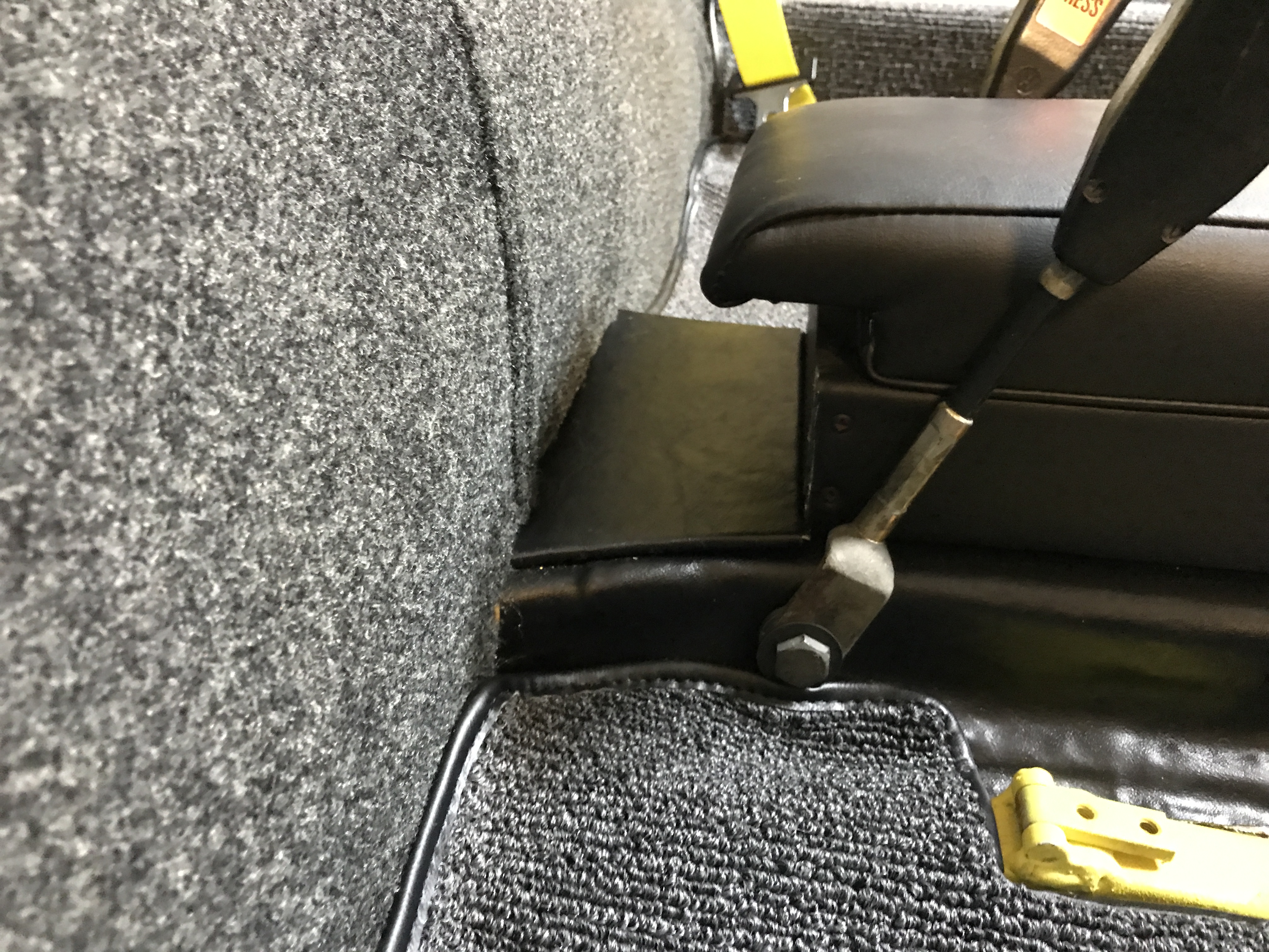

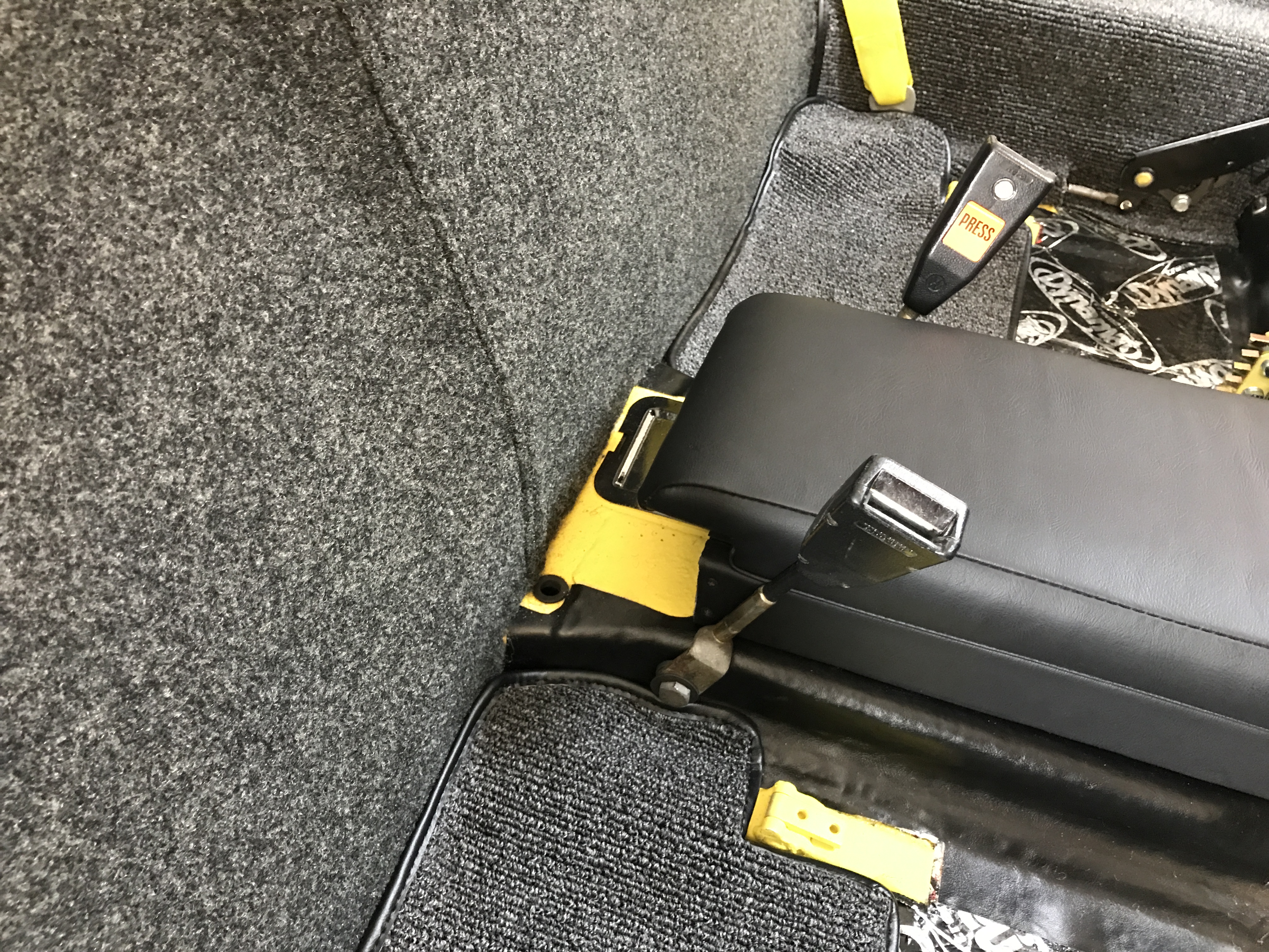

While thinking about the interior, I placed the center arm rest.

Member No.: 23,343
Have to do something to cover the exposed bit of tunnel.

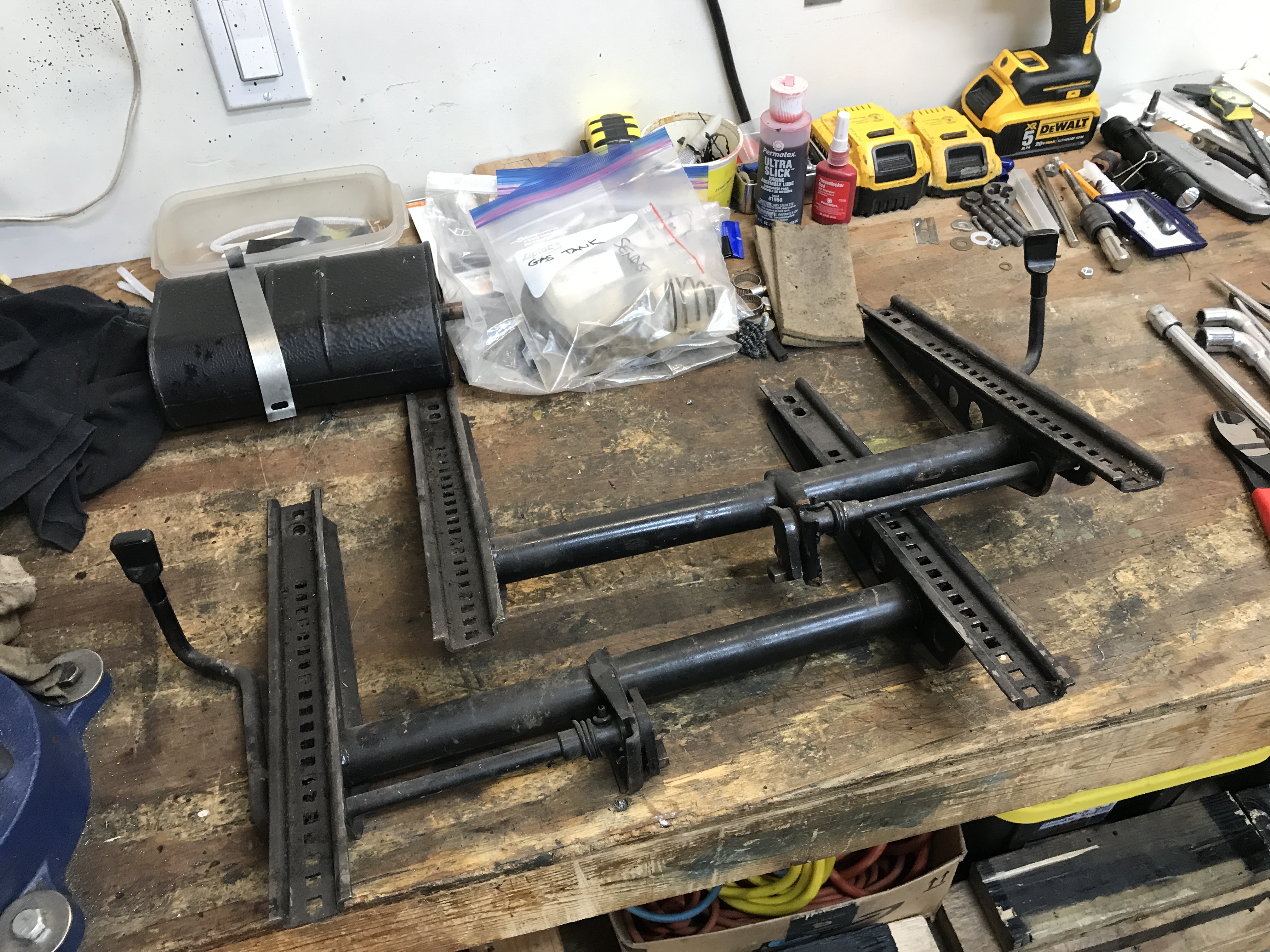

And then I got out the seat mounting stuff.

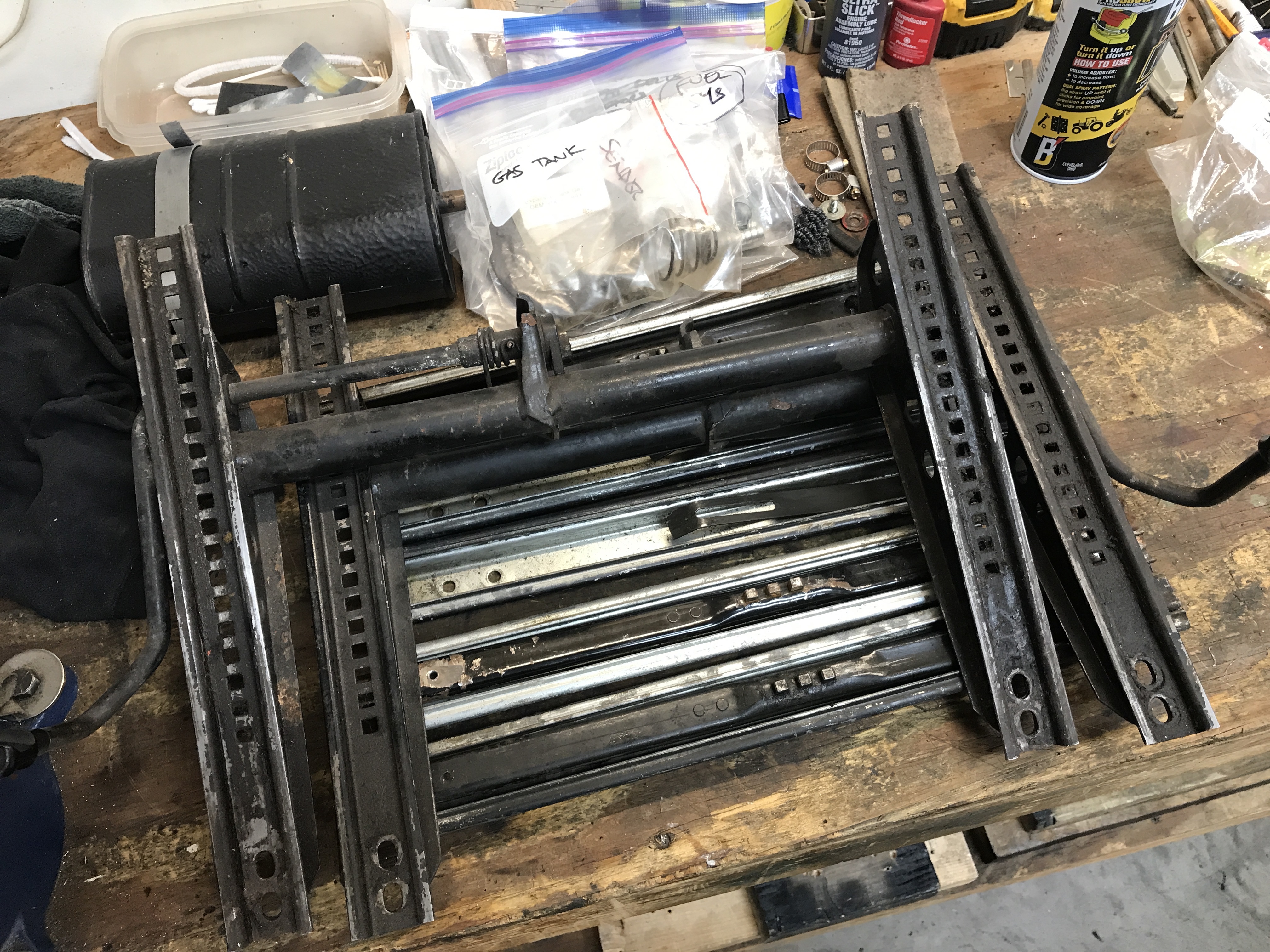

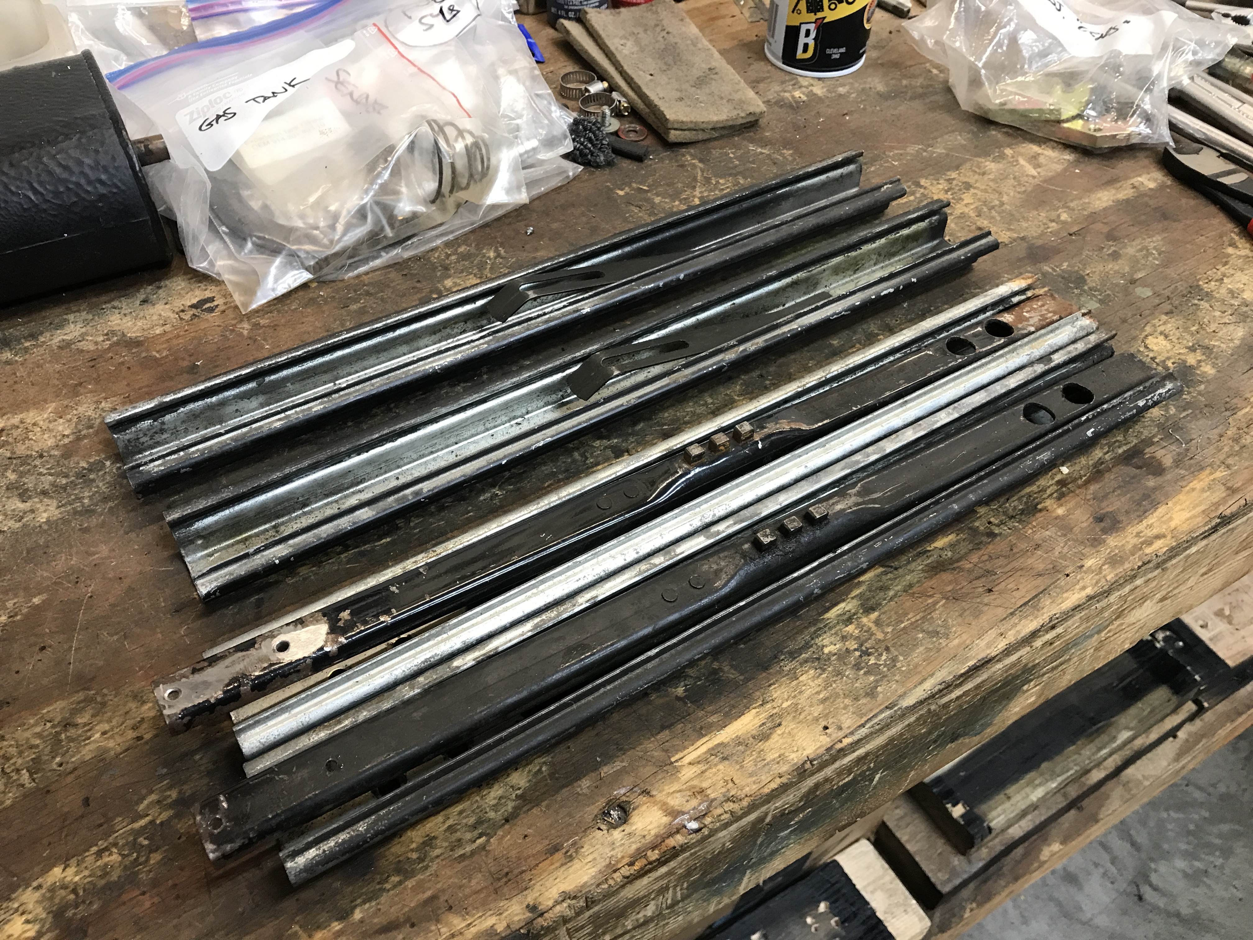

Paint on the frames looks sad, so I took these apart, and to the powder coat shop.
bkrantz
post Jul 9 2021, 07:43 PM
Post #3309
Posts: 8,800
Joined: 3-August 19
From: SW Colorado
Member No.: 23,343
The rails just need some clean-up (and new handles).

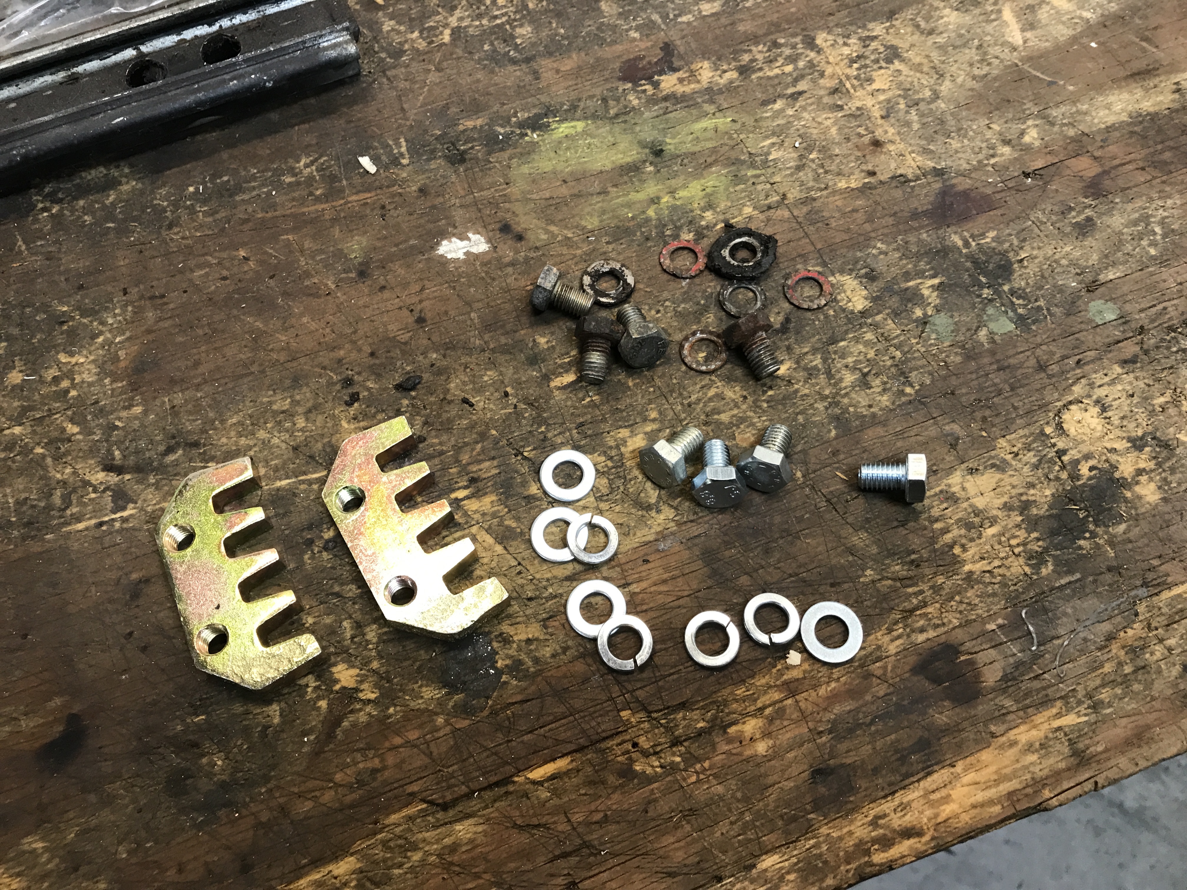

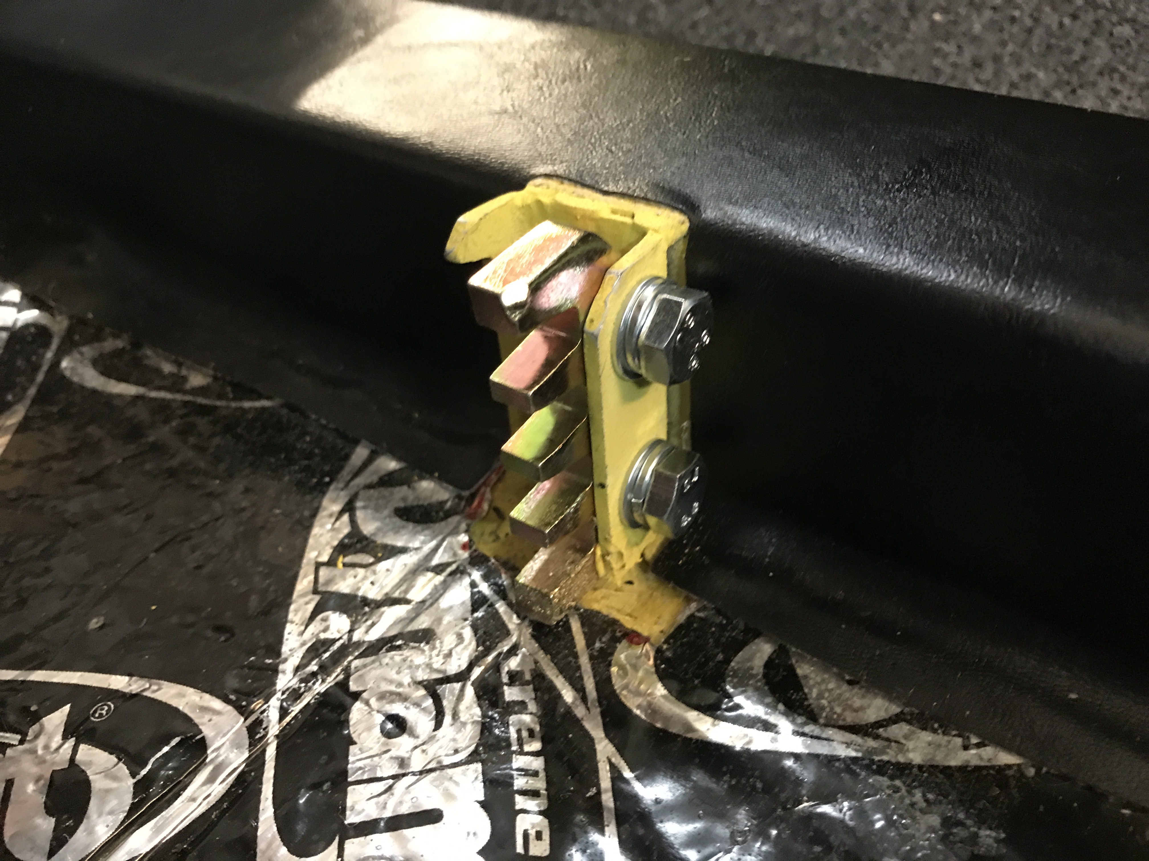

Shiny seat tilt teeth.

QUOTE(bkrantz @ Jul 9 2021, 06:40 PM) *
Bob....make sure to tell the powder coater where not to powder coat. Don't make the same mistake I did. That involved hours of sanding/filing/grinding that blasted hard powder coating off of the sliding surfaces. Uggh
Your car and work look incredible.

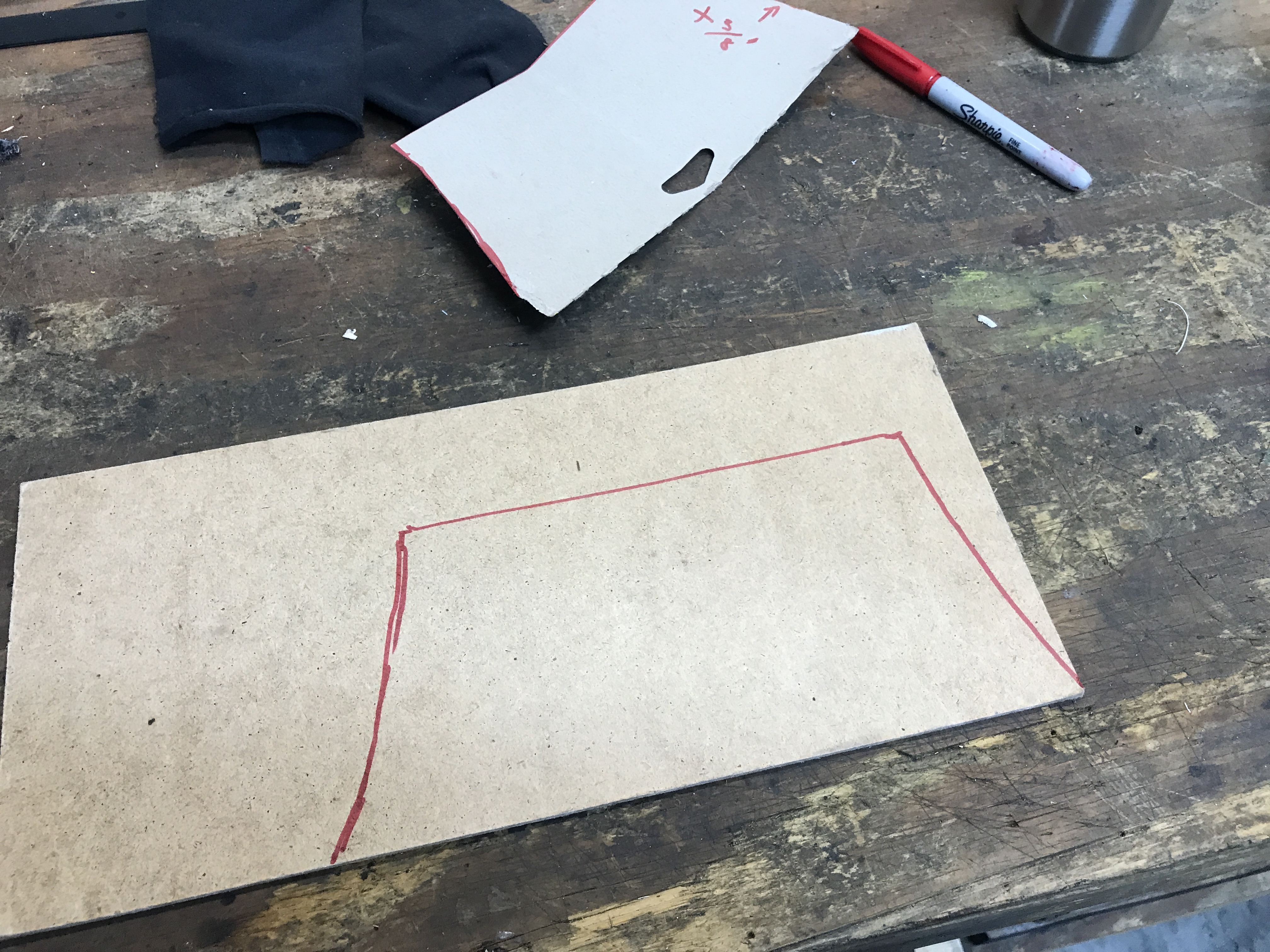

Member No.: 23,343
To hide the tunnel top exposed behind the arm rest, I made a small cover. I found a small scrap piece of 1/8" masonite.
bkrantz
post Jul 10 2021, 07:29 PM
Post #3317
Posts: 8,800
Joined: 3-August 19
From: SW Colorado

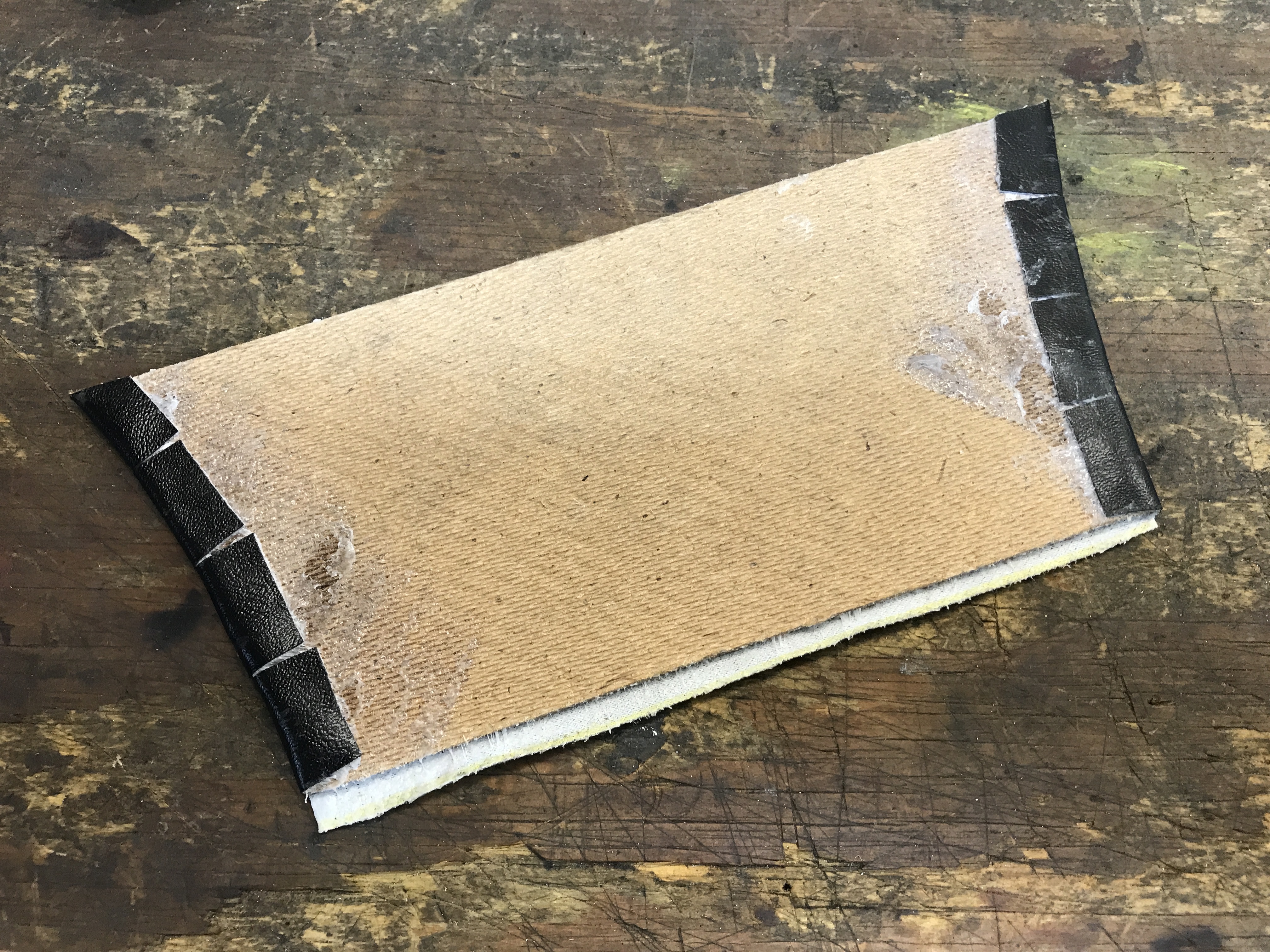

Member No.: 23,343
And a scrap of vinyl on top, and wrapped over the side edges.
bkrantz
Post #3318
Posts: 8,800
Joined: 3-August 19
From: SW Colorado

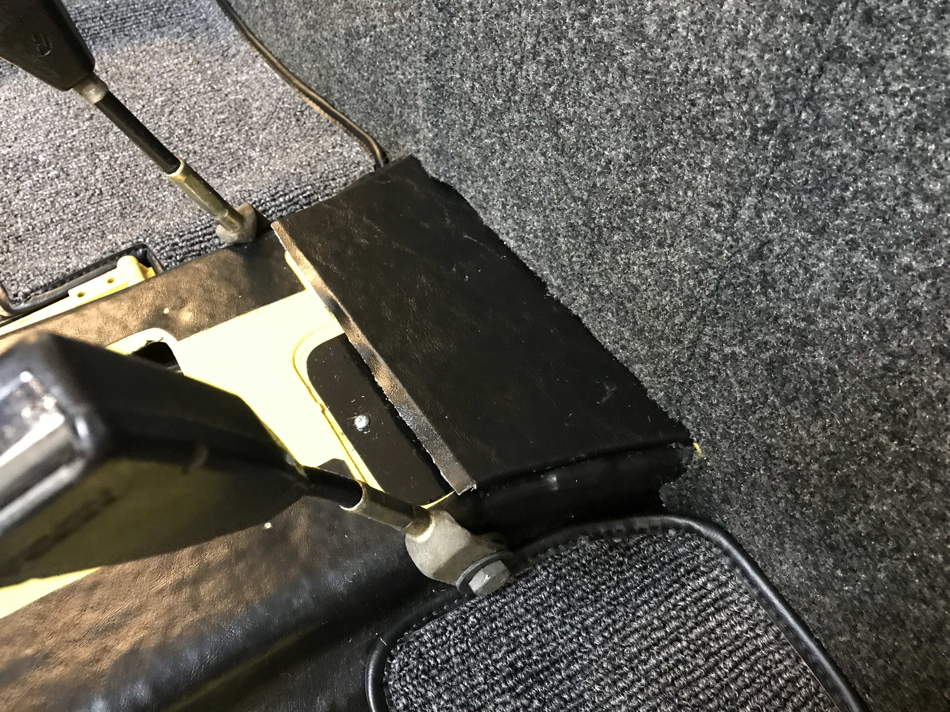

Member No.: 23,343
Cover in place.
bkrantz
post Jul 10 2021, 07:30 PM
Post #3319
Posts: 8,800
Joined: 3-August 19
From: SW Colorado
Member No.: 23,343
Better.

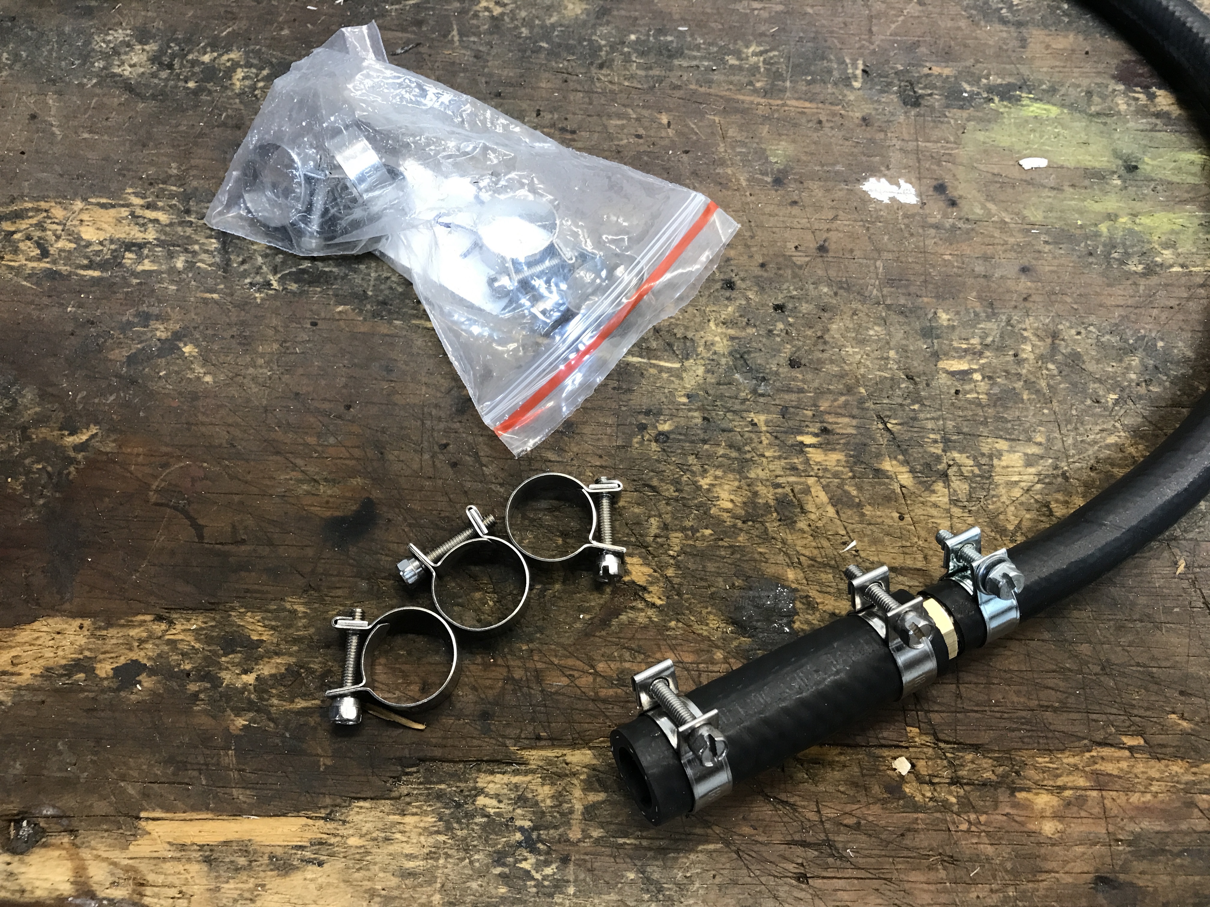

After that, I got ready to install the gas tank. I finally found some Euro style hose clamps (20 mm) big enough for 1/2" hose. (And not use the American worm drive clamps on fuel lines, as spotted by a couple of you guys.)
