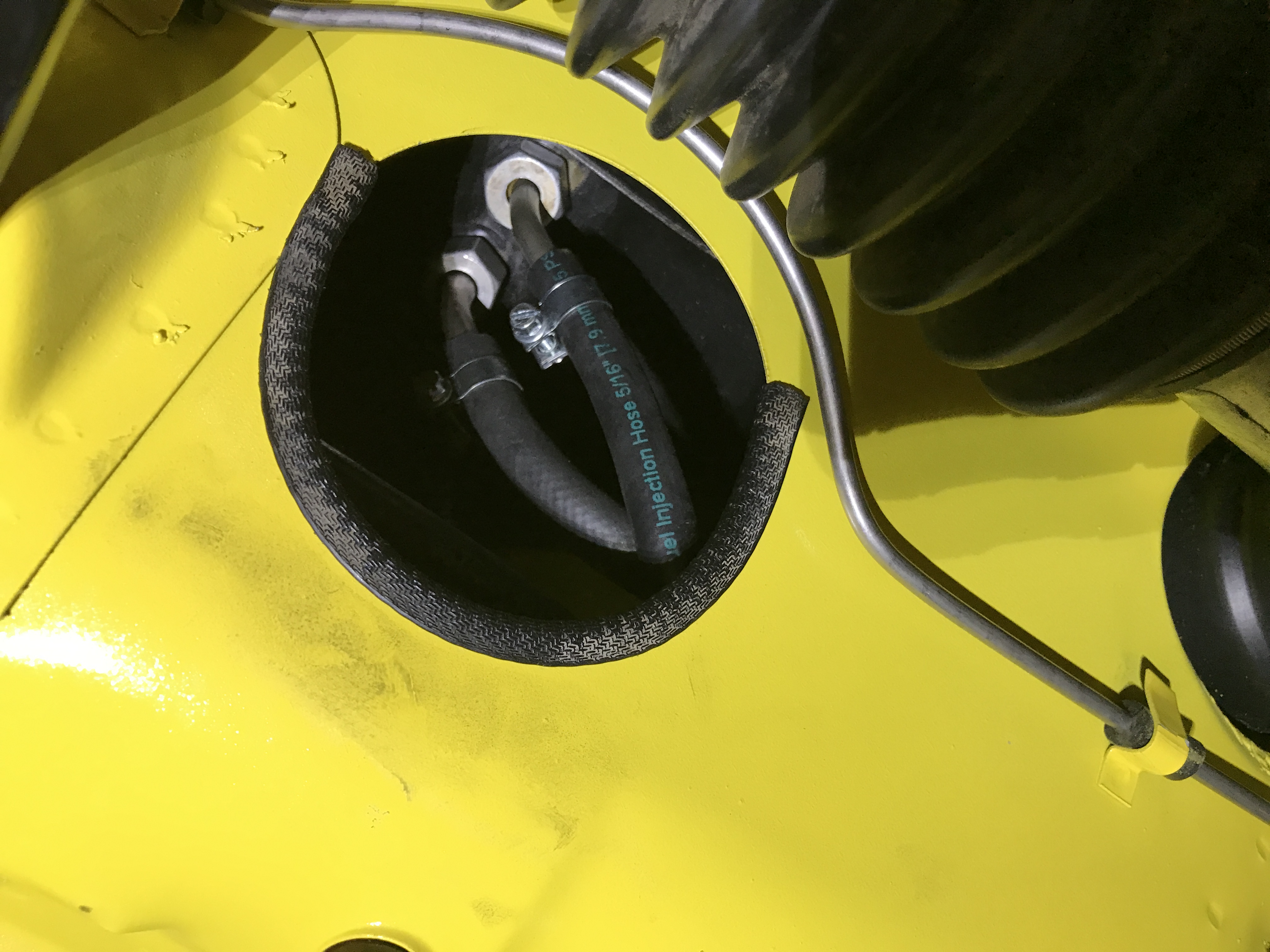

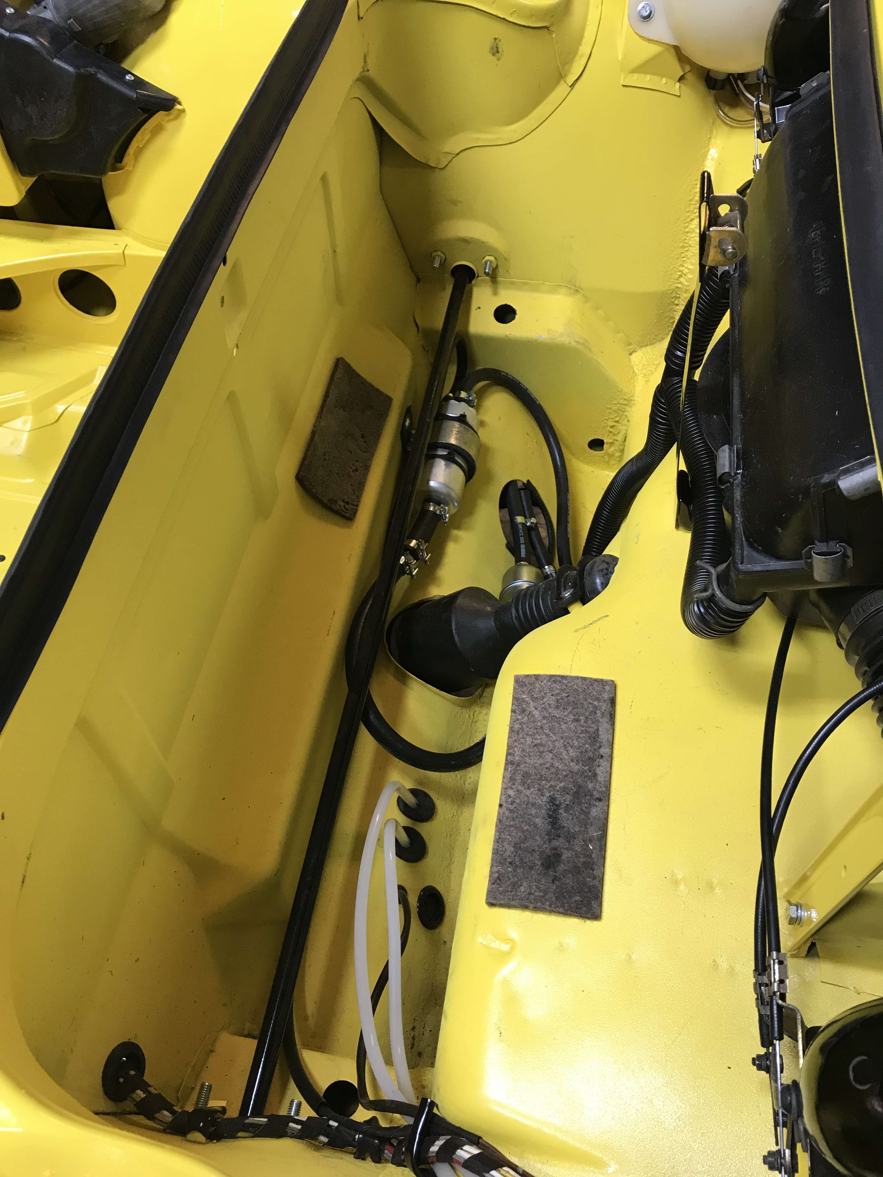

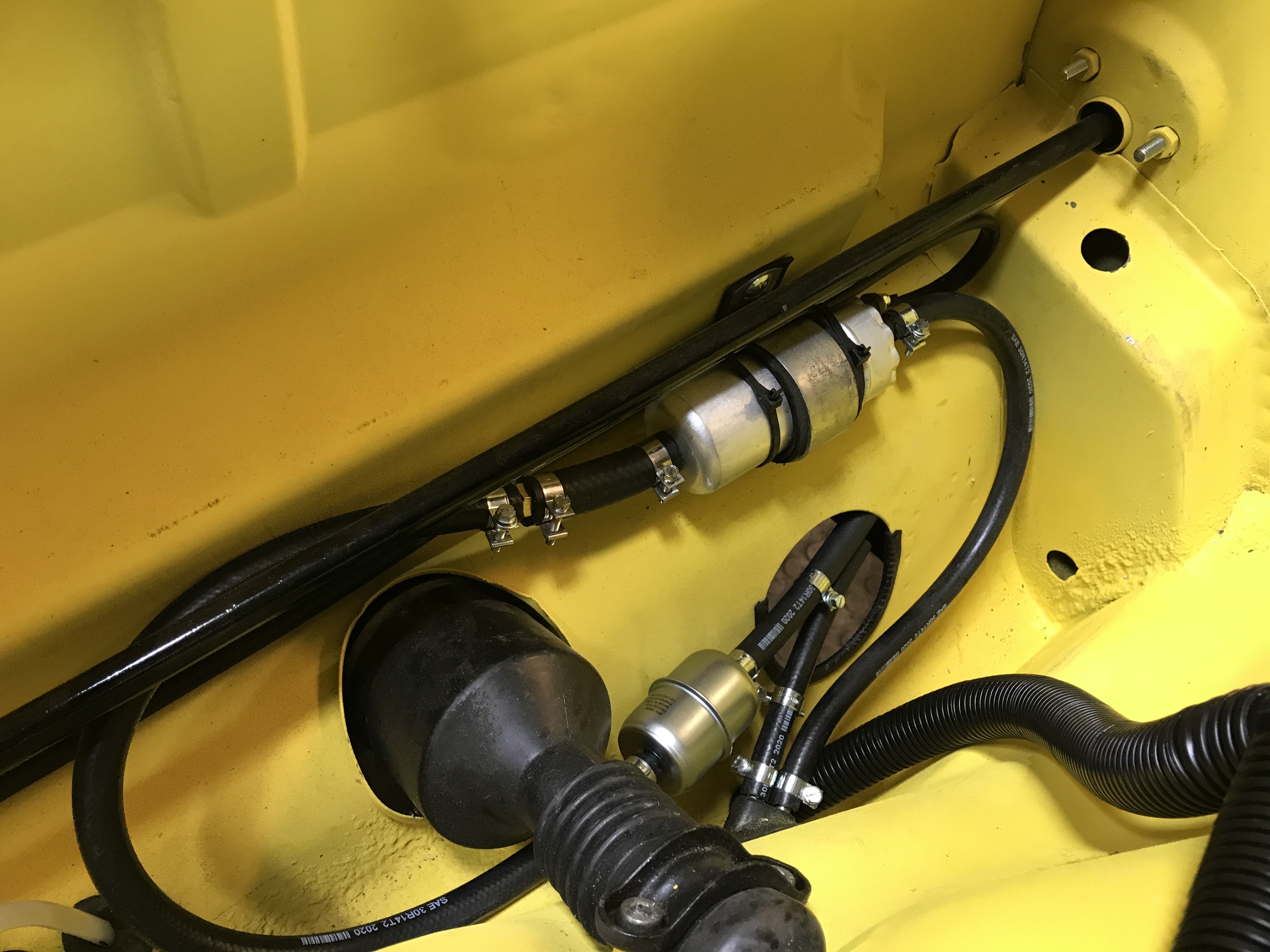

All the plumbing is now in place: tank supply to filter to pump to feed line in tunnel, and return line in tunnel to tank.
bkrantz
post Jul 10 2021, 07:40 PM
Post #3322
Posts: 8,800
Joined: 3-August 19
From: SW Colorado
Member No.: 23,343
I did re-use the stock felt pads, but soaked in rust prevent lube.

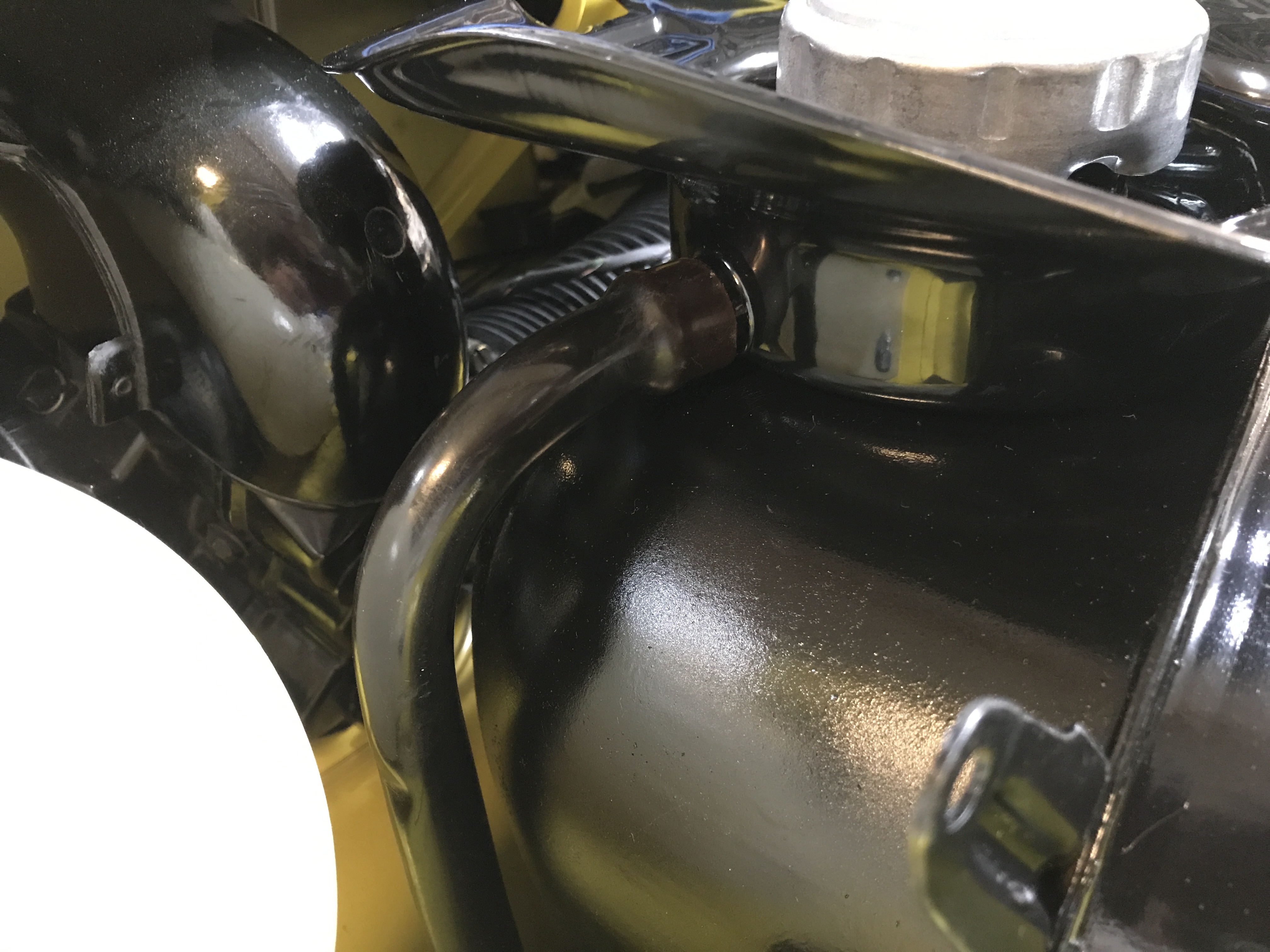

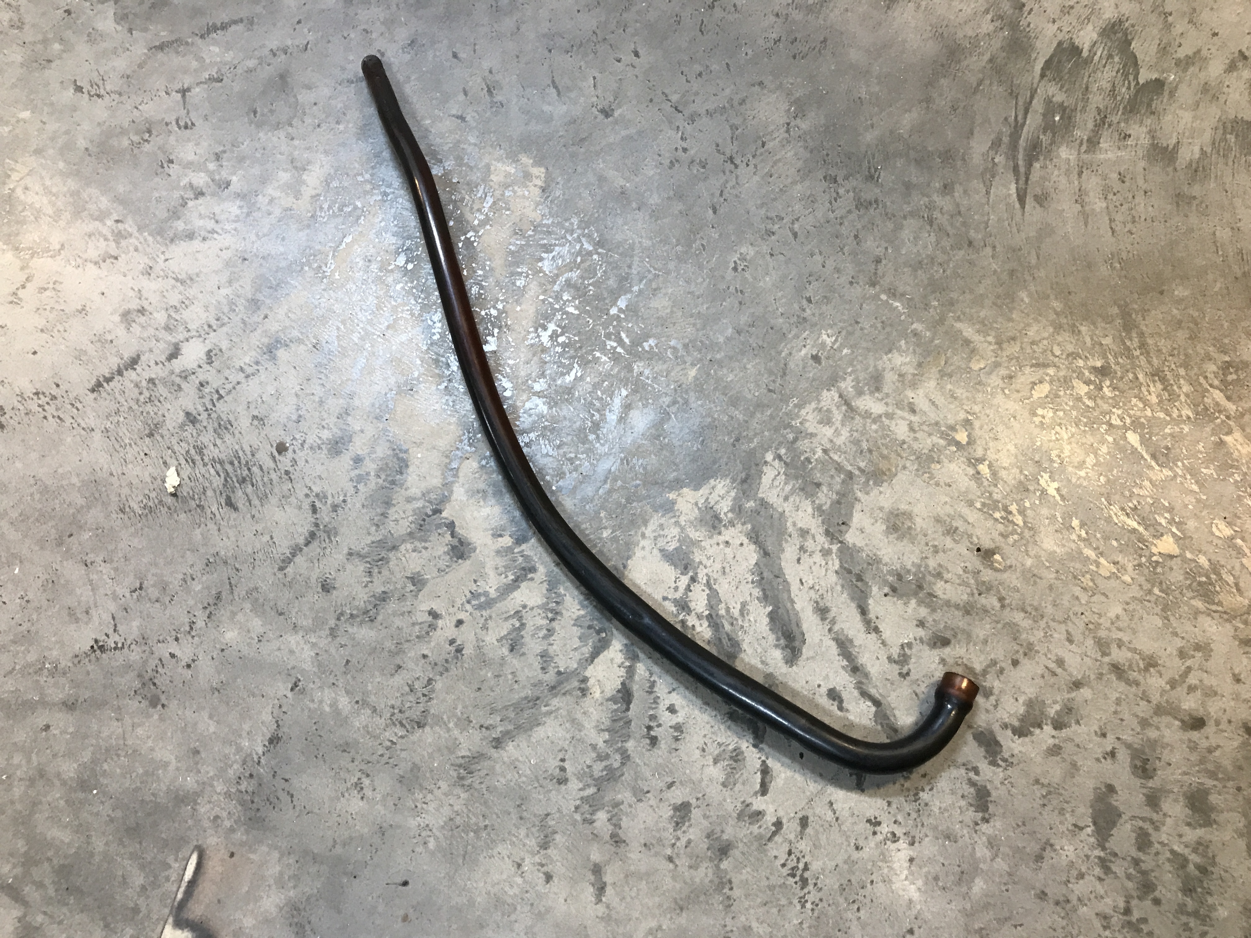

I also rehabbed the over-flow drain tube. The new hose I got was too large to feed out the bottom hole. The old tube is still flexible, just stained from the damned PO undercoating.
bkrantz
post Jul 10 2021, 07:43 PM
Post #3324
Posts: 8,800
Joined: 3-August 19
From: SW Colorado
Member No.: 23,343

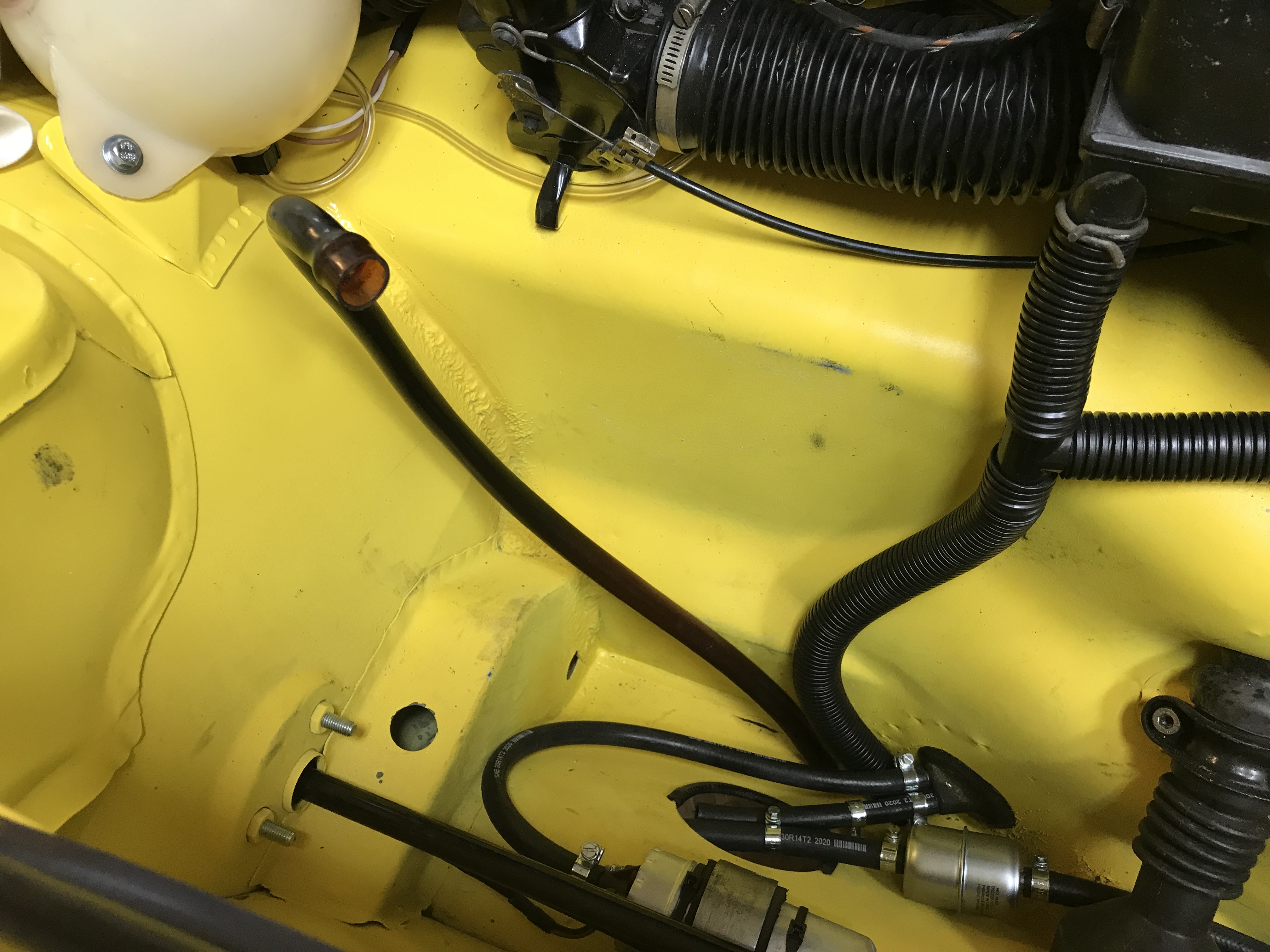

Overflow tube in place.

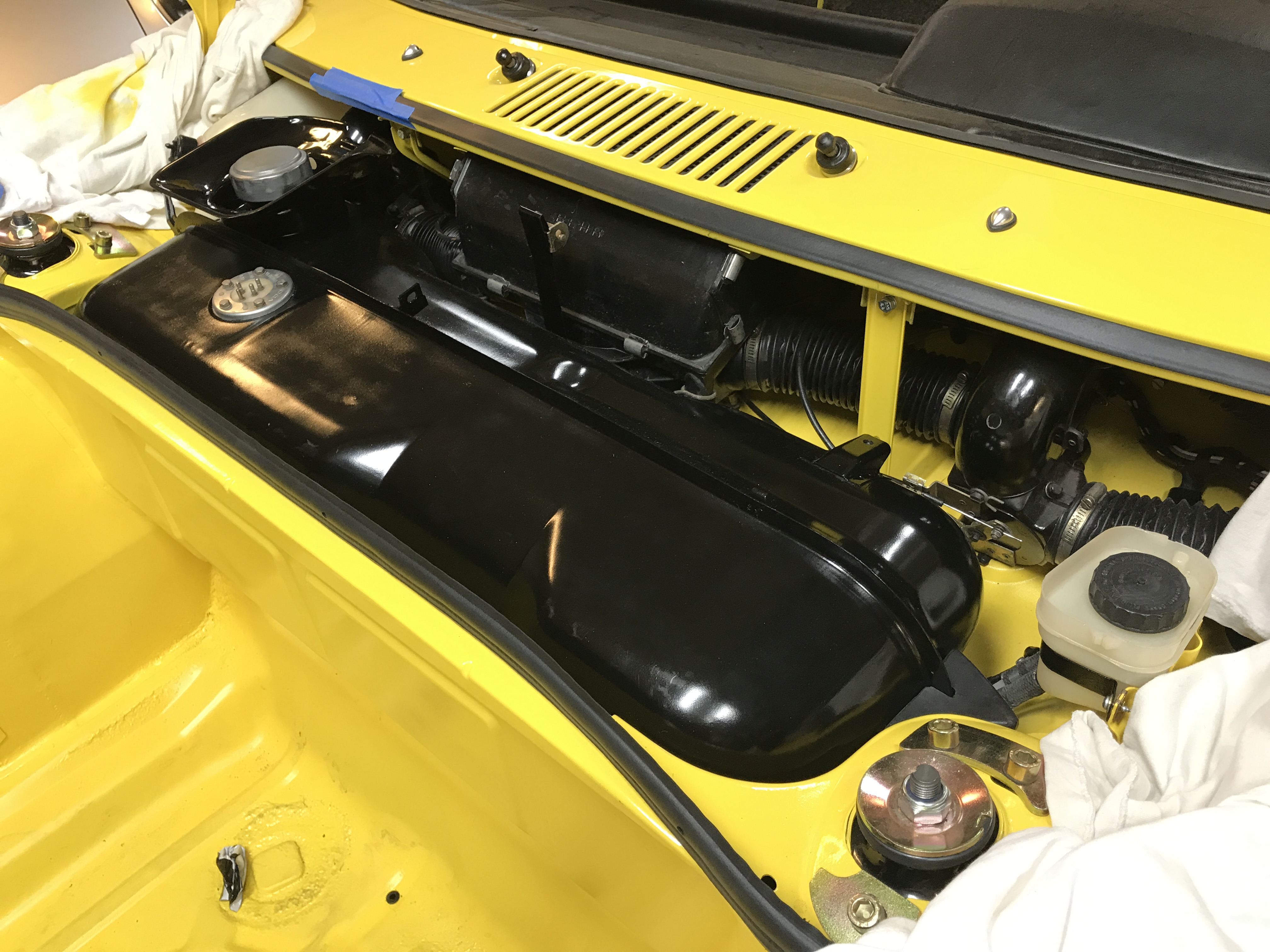

Tank "dropped" in. This was more fiddly than I expected, to get the tank seated evenly and all the way in.

Overflow hose connected.

And hoses connected to tank fittings.

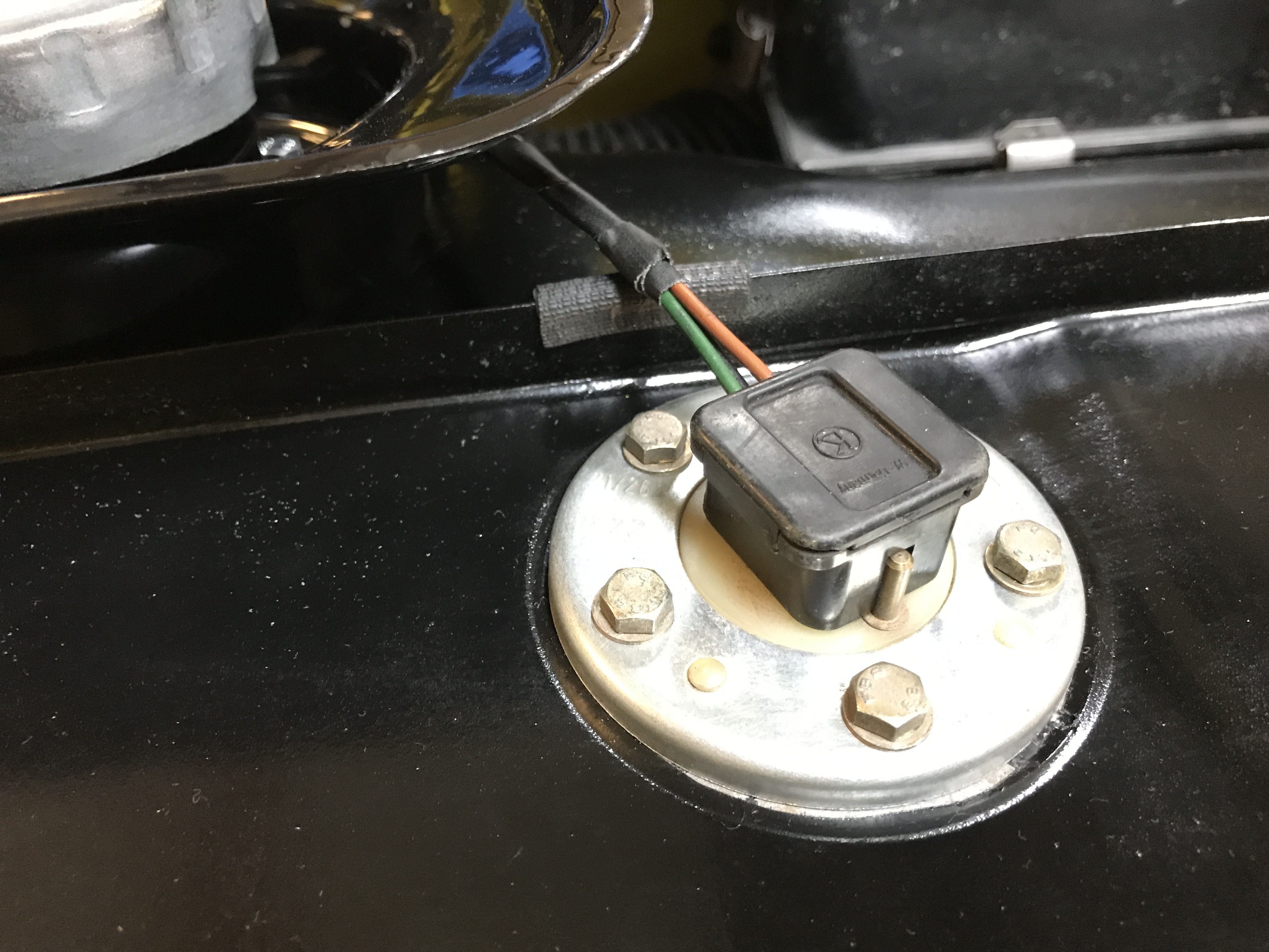

Fuel level sender plug (with a little bit of edging to protect the wires).

And finally, the hold-down clamp.

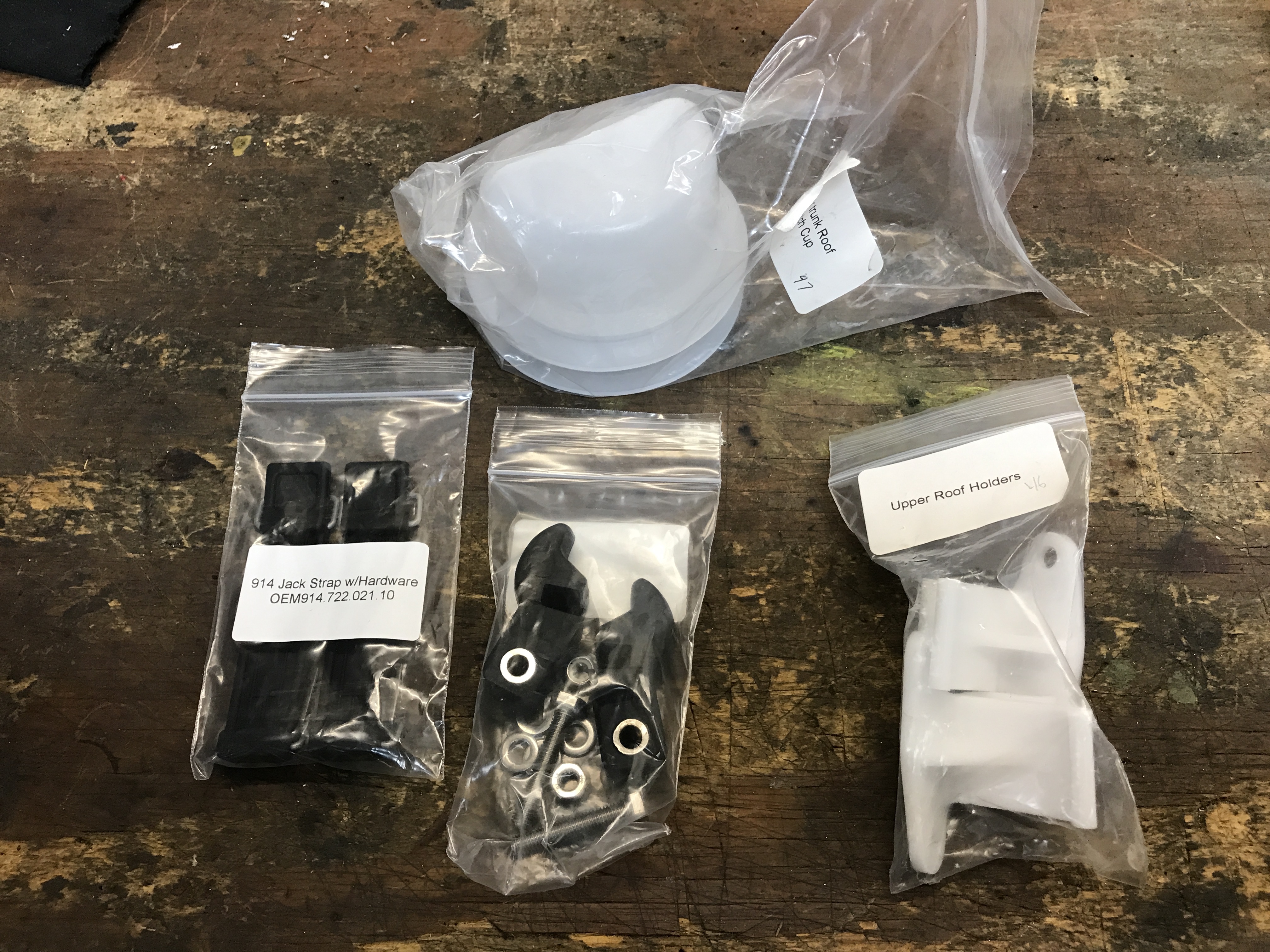

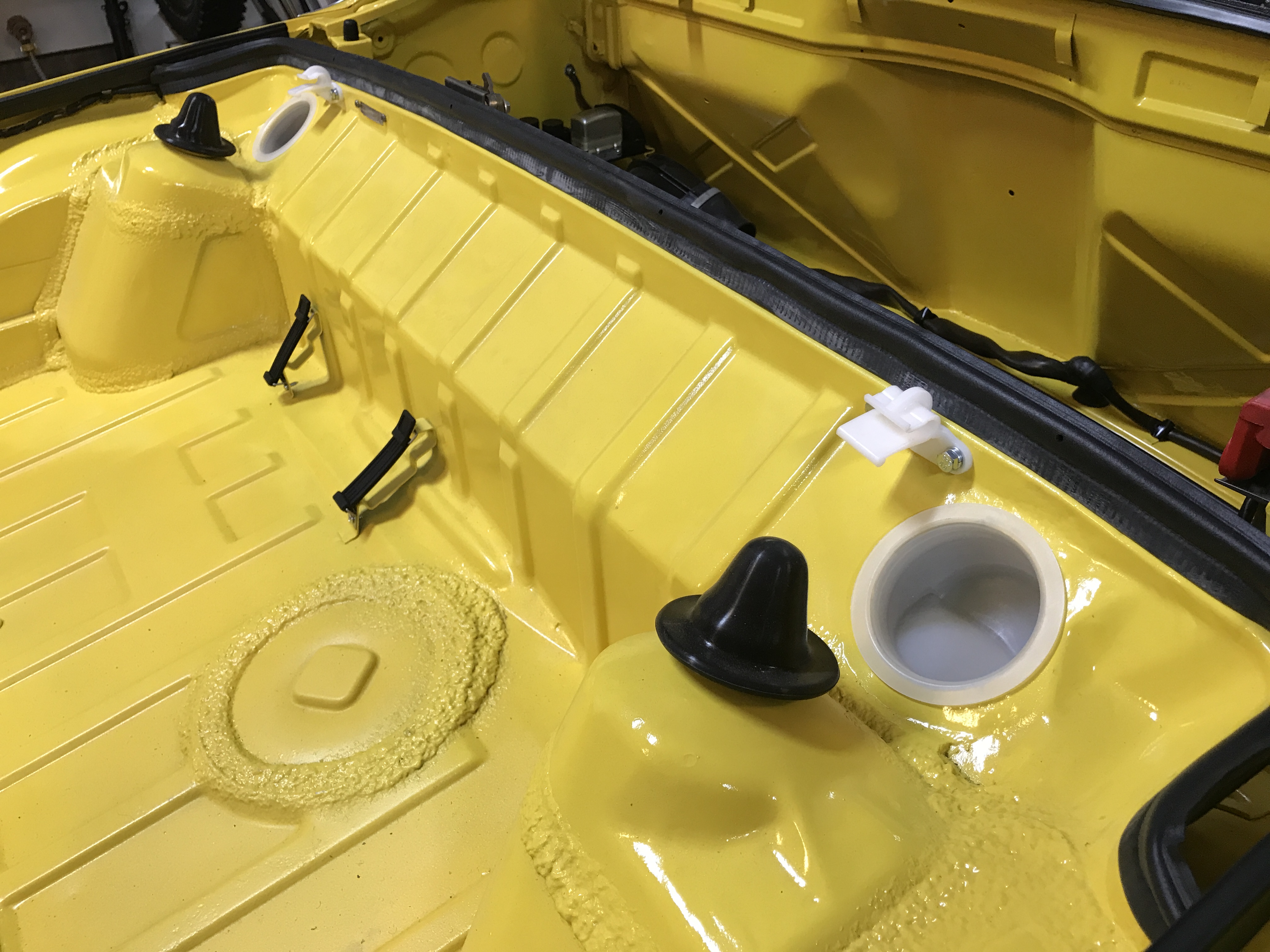

Just some little stuff today. I opened the bag with new trunk hardware, all from 914 Rubber.
bkrantz
post Jul 11 2021, 06:38 PM
Post #3332
Posts: 8,800
Joined: 3-August 19
From: SW Colorado
Member No.: 23,343

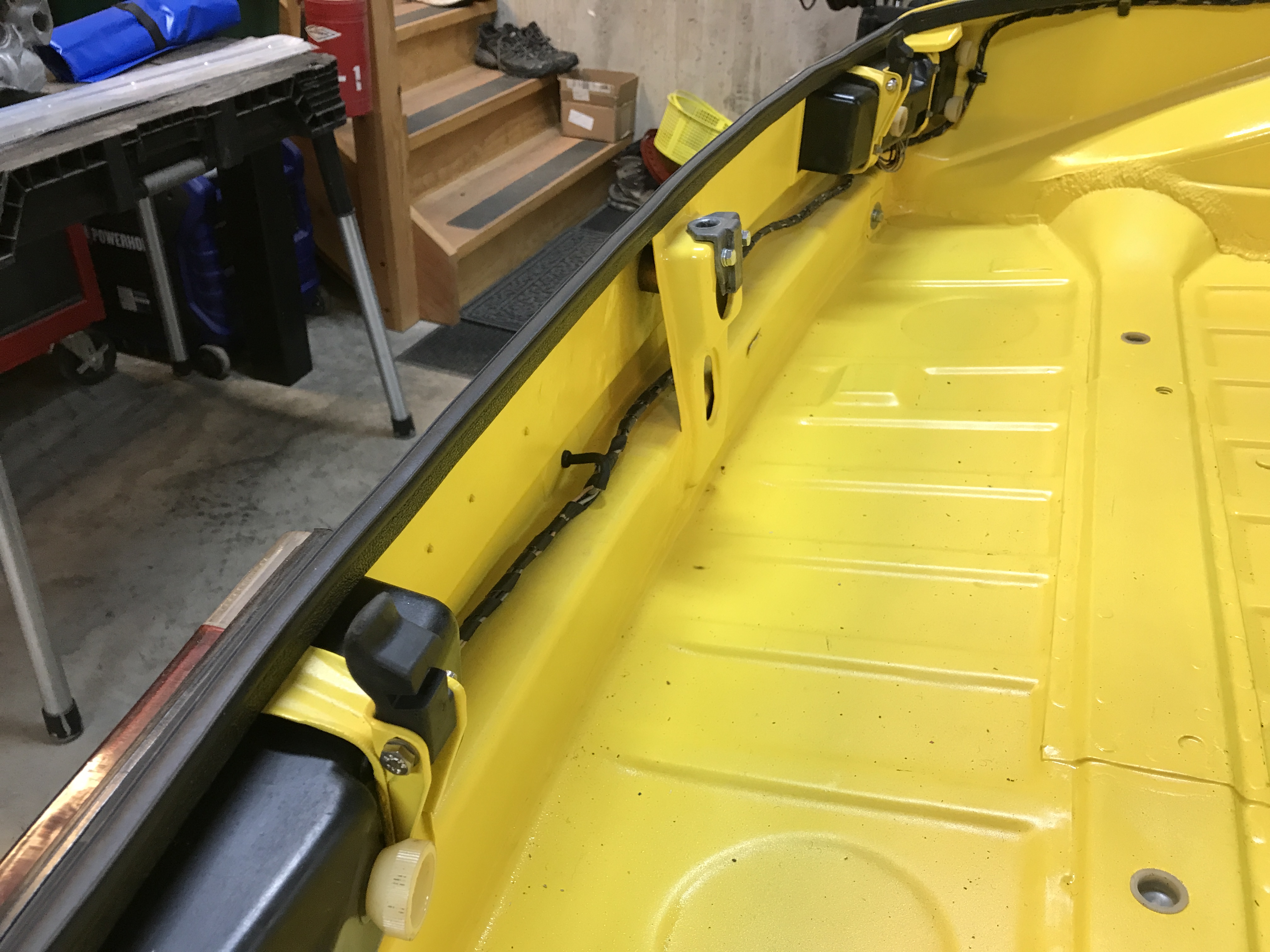

Front of the trunk.
bkrantz
post Jul 11 2021, 06:39 PM
Post #3333
Posts: 8,800
Joined: 3-August 19
From: SW Colorado
Member No.: 23,343
And rear.

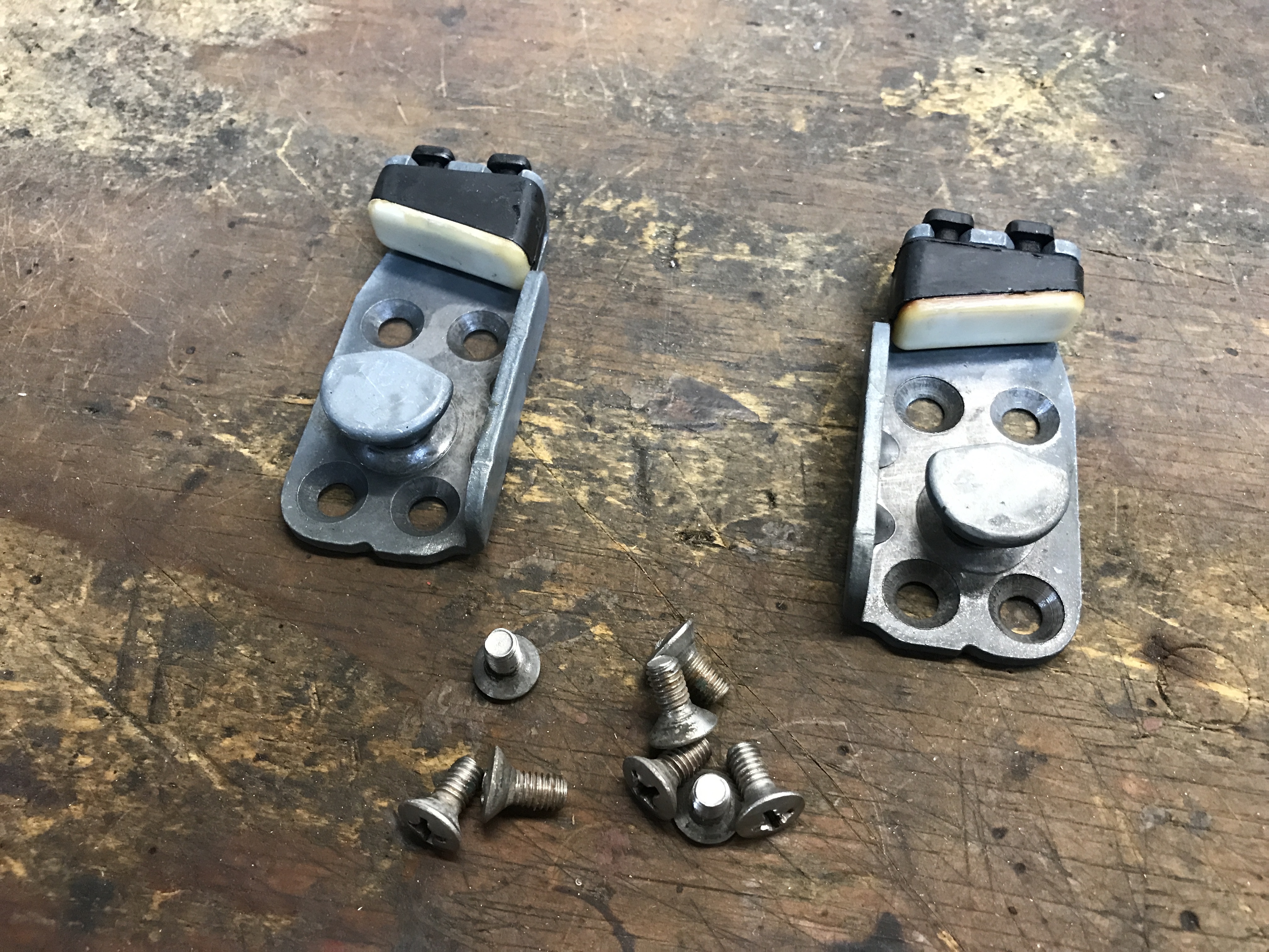

I also got out my rehabbed door strikers and installed those.

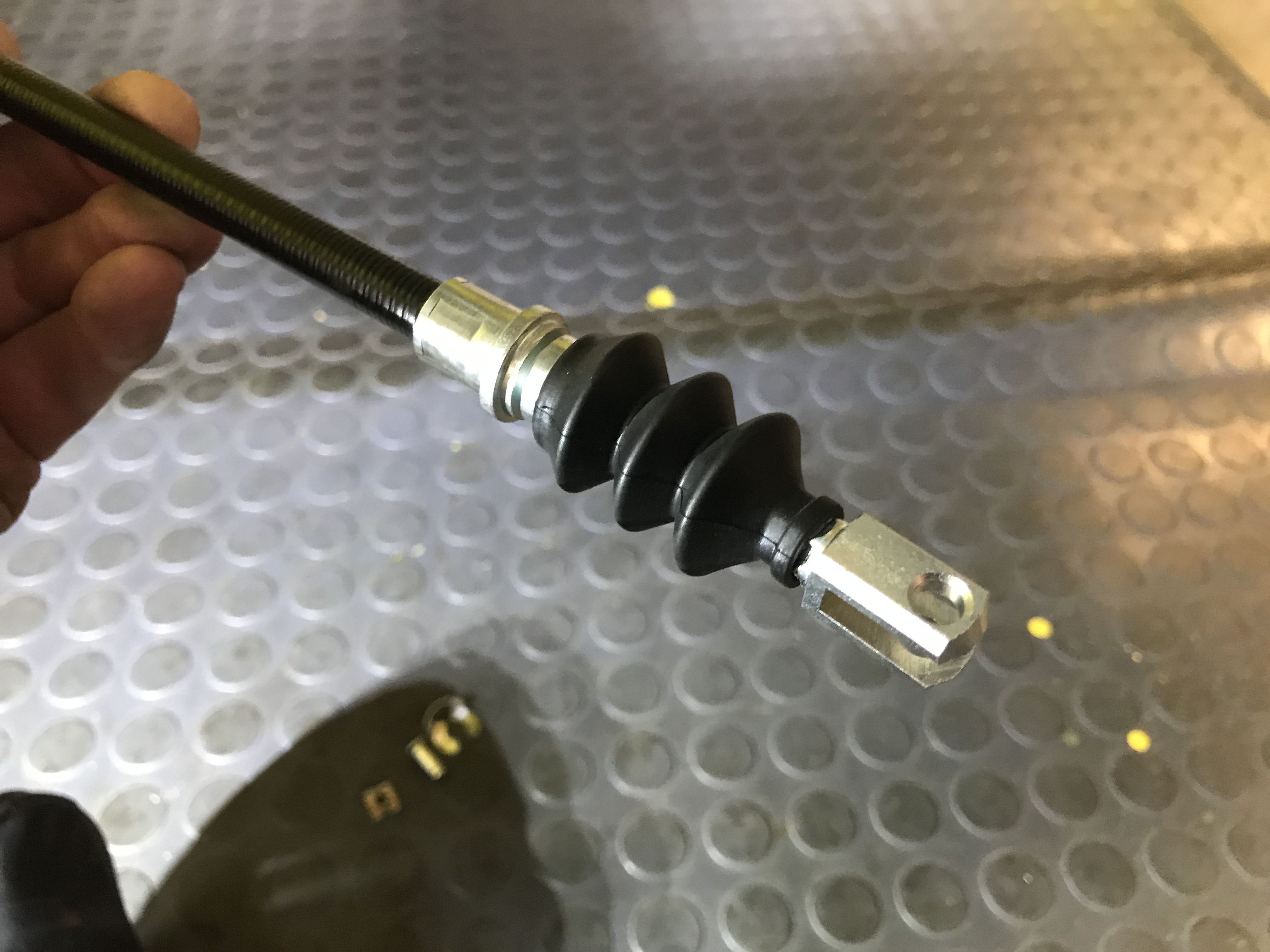

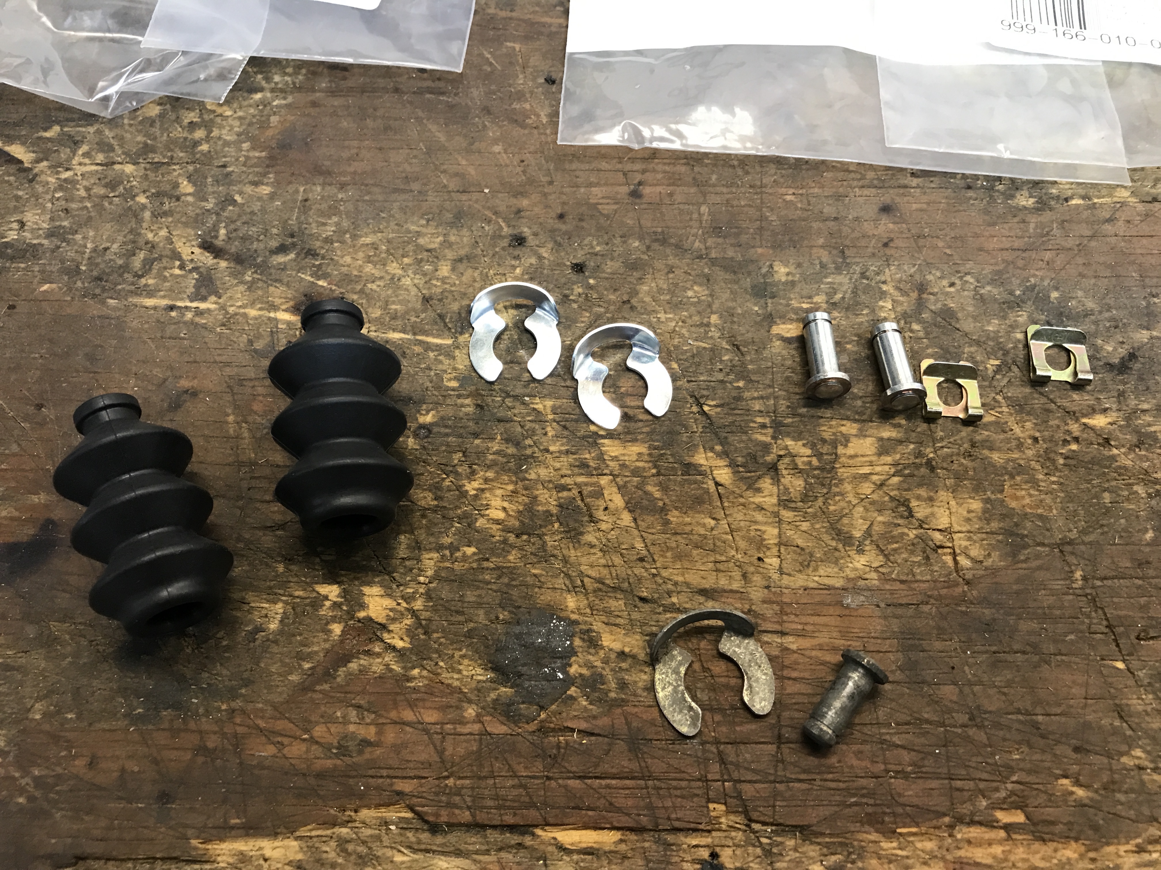

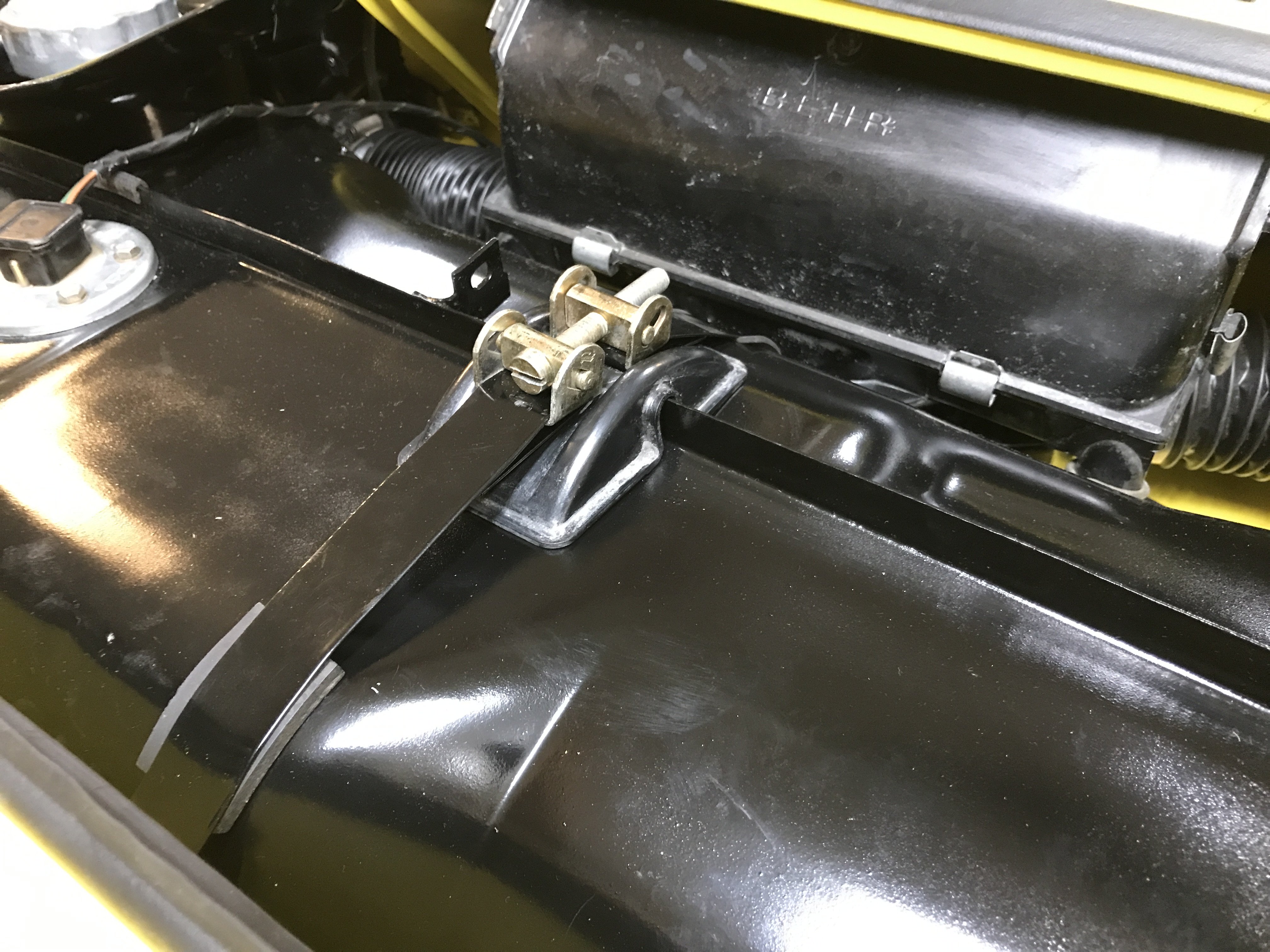

Finally, I found my new hardware for the parking brake cables.
bkrantz
post Jul 11 2021, 06:44 PM
Post #3336
Posts: 8,800
Joined: 3-August 19
From: SW Colorado
Member No.: 23,343

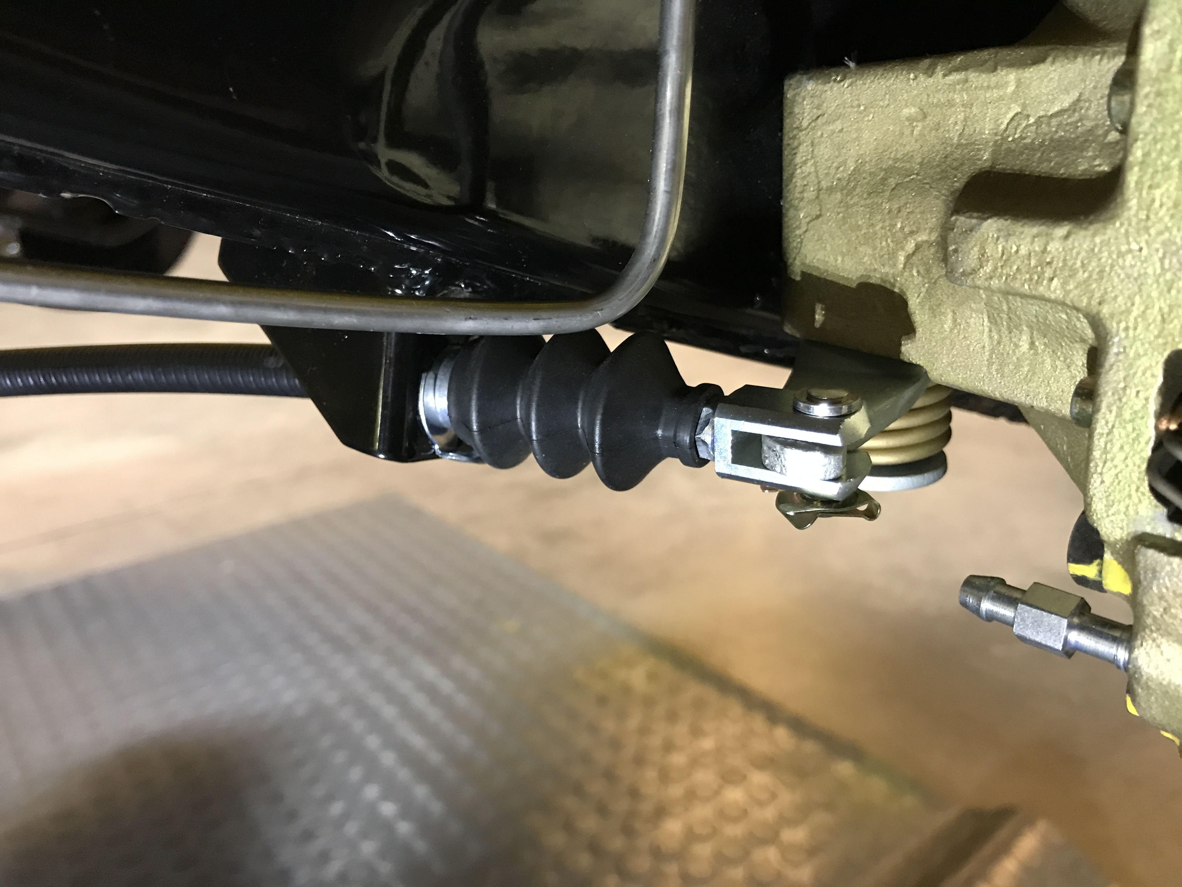

Step 1: swear at the rubber boots to help ease them over the clevis.
bkrantz
post Jul 11 2021, 06:45 PM
Post #3337
Posts: 8,800
Joined: 3-August 19
From: SW Colorado
Member No.: 23,343
Step 2: swear at the retaining clip until it fully seats on the cable ferrule.
Parking brakes work!

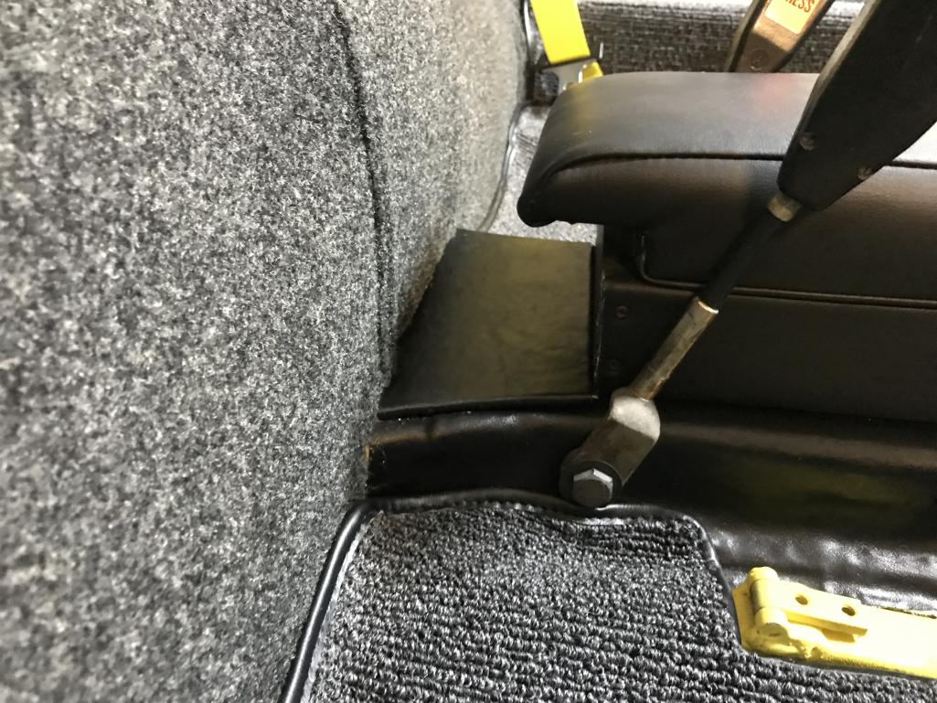

QUOTE(bkrantz @ Jul 10 2021, 06:30 PM) *
Looks good, Bob, but didn't your carpet kit come with a small piece to cover that spot ?
raynekat
post Jul 12 2021, 08:53 PM
Post #3339
Posts: 2,171
Joined: 30-December 14
From: Coeur d'Alene, Idaho
Member No.: 18,263
QUOTE(euro911 @ Jul 11 2021, 10:28 PM) *
Most would not have that small piece.
I put together my own fix on my car.
bkrantz
post Jul 12 2021, 09:40 PM
Post #3340
Posts: 8,800
Joined: 3-August 19
From: SW Colorado
Member No.: 23,343
QUOTE(raynekat @ Jul 12 2021, 08:53 PM) *
With the stock padded back panel, that spot is not exposed. It shows how much space the stock panel occupies, and gaining that space was part of my motivation for the carpet substitute.
Doug, what did you do?
