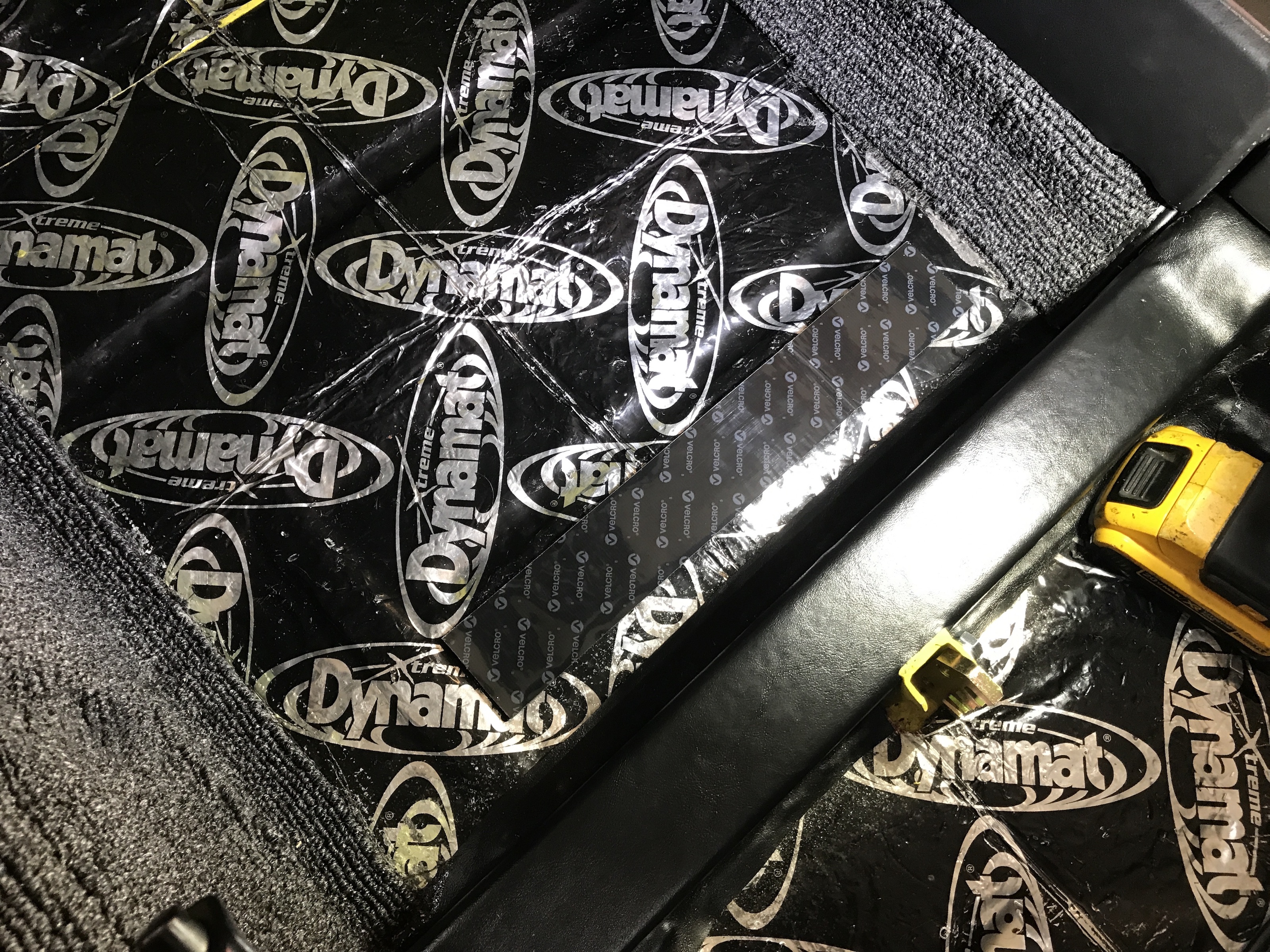

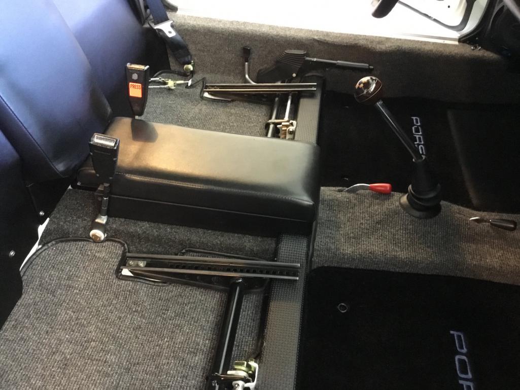

QUOTE(bkrantz @ Jul 12 2021, 08:40 PM) *
Doug, what did you do?
Think I just added some grey perlon in there.
I'll check the pics....
raynekat
post Jul 13 2021, 01:46 AM
Post #3342
Posts: 2,171
Joined: 30-December 14
From: Coeur d'Alene, Idaho
Member No.: 18,263
After further review....maybe nothing.
With the backpad in there and the different style center tray thingy, you don't see much.
Bet you don't have full length carpets under the seats...huh? (IMG:style_emoticons/default/tongue.gif)
bkrantz
post Jul 13 2021, 10:41 PM
Post #3343
Posts: 8,800
Joined: 3-August 19
From: SW Colorado
Member No.: 23,343
QUOTE(raynekat @ Jul 13 2021, 01:46 AM) *
Yup, the stock bulkhead pad obscures that space.
Yeah, my midget carpets only cover the area under the rear half of the seats. You win. (IMG:style_emoticons/default/cheer.gif)

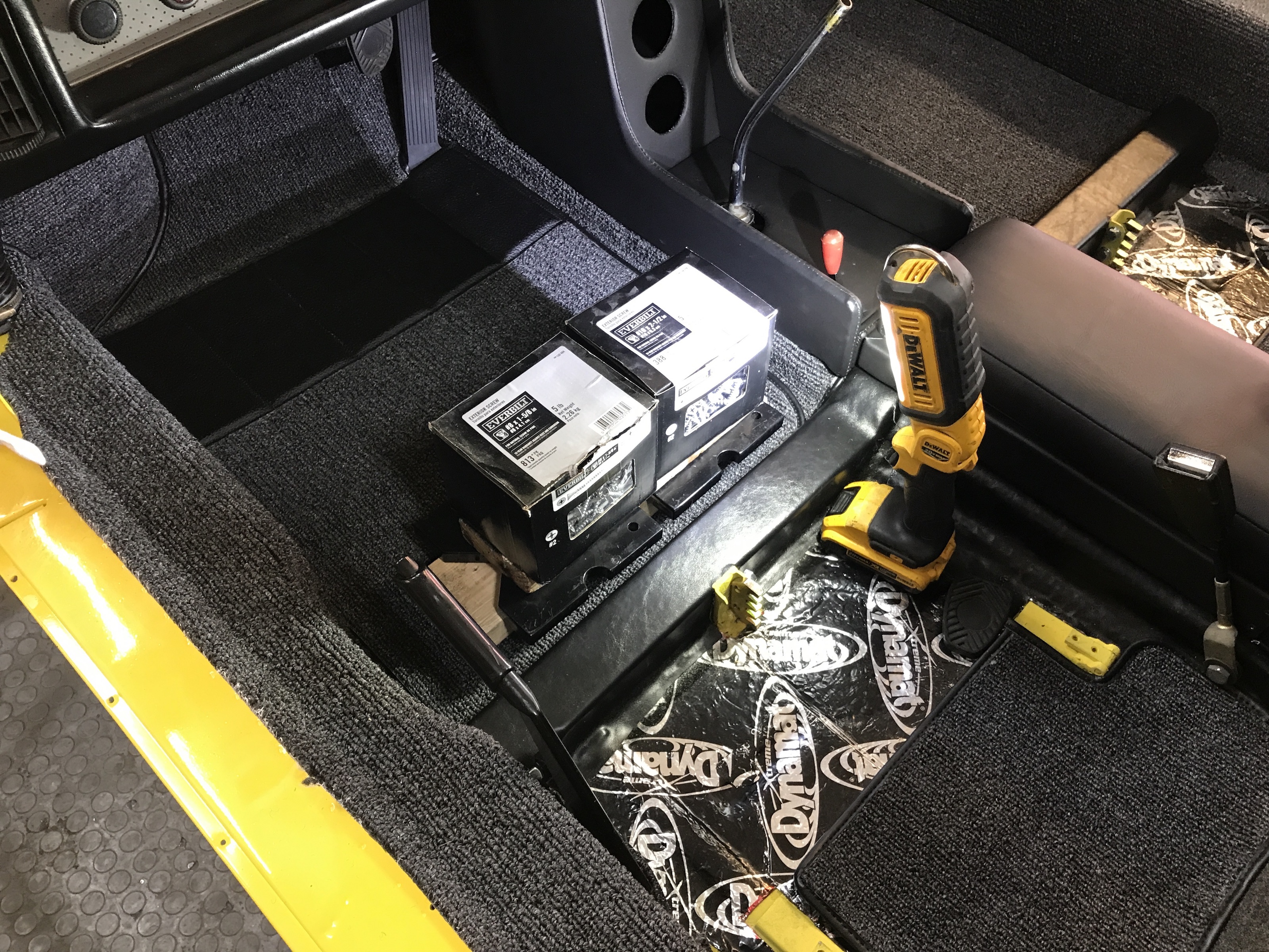

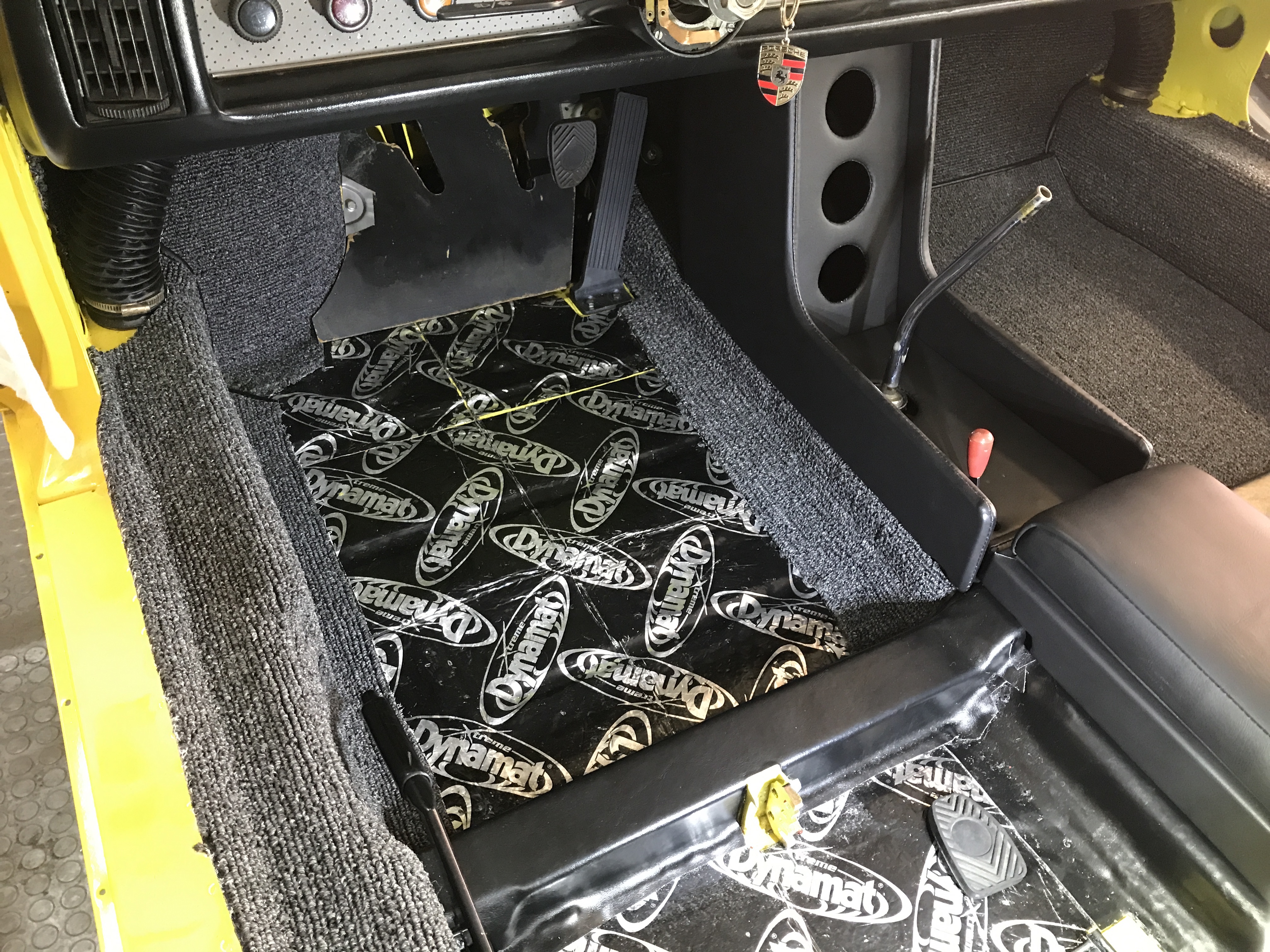

I finally got back to completing the carpet installation, especially for the main footwell pieces.
Here is the driver's side, carpet piece out, and too much and irregular projection of the side pieces onto the floor.

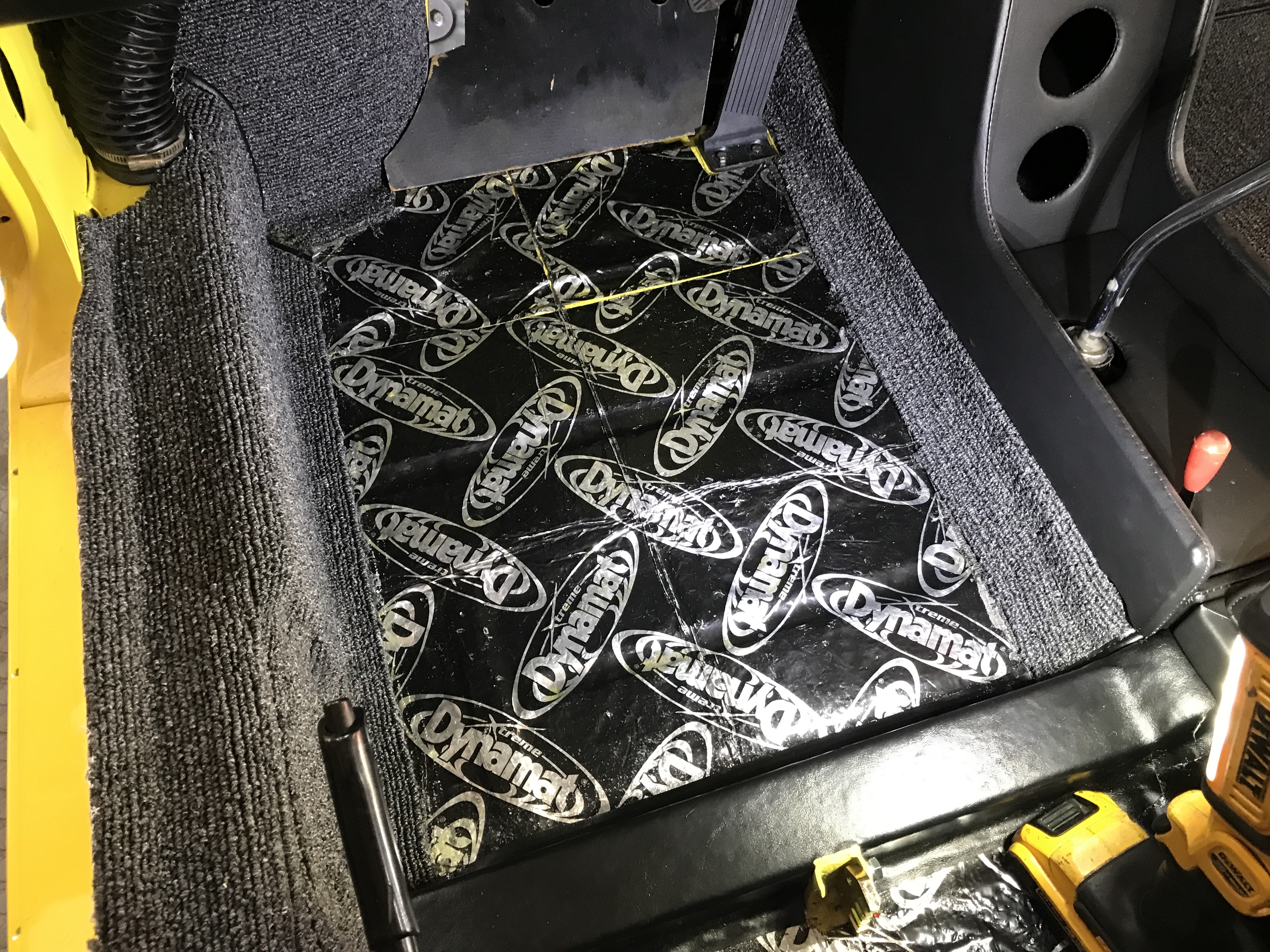

Member No.: 23,343
I trimmed the side pieces a bit, and neatened up the corners.

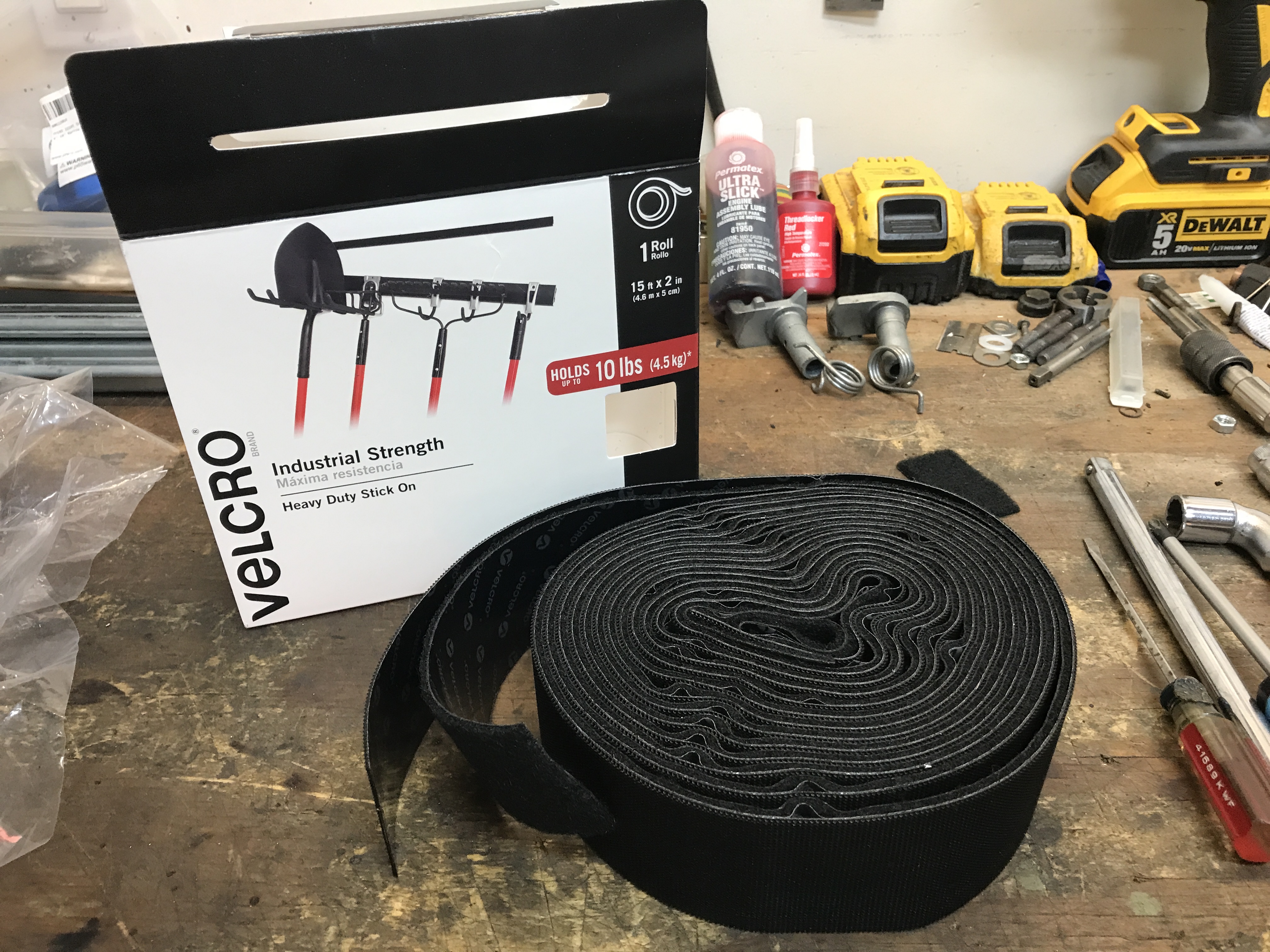

To hold the main carpet piece in place, I got this industrial strength Velcro. I left out the floor studs since I did not want big grommets in the carpet. But I still want to remove the main pieces easily.

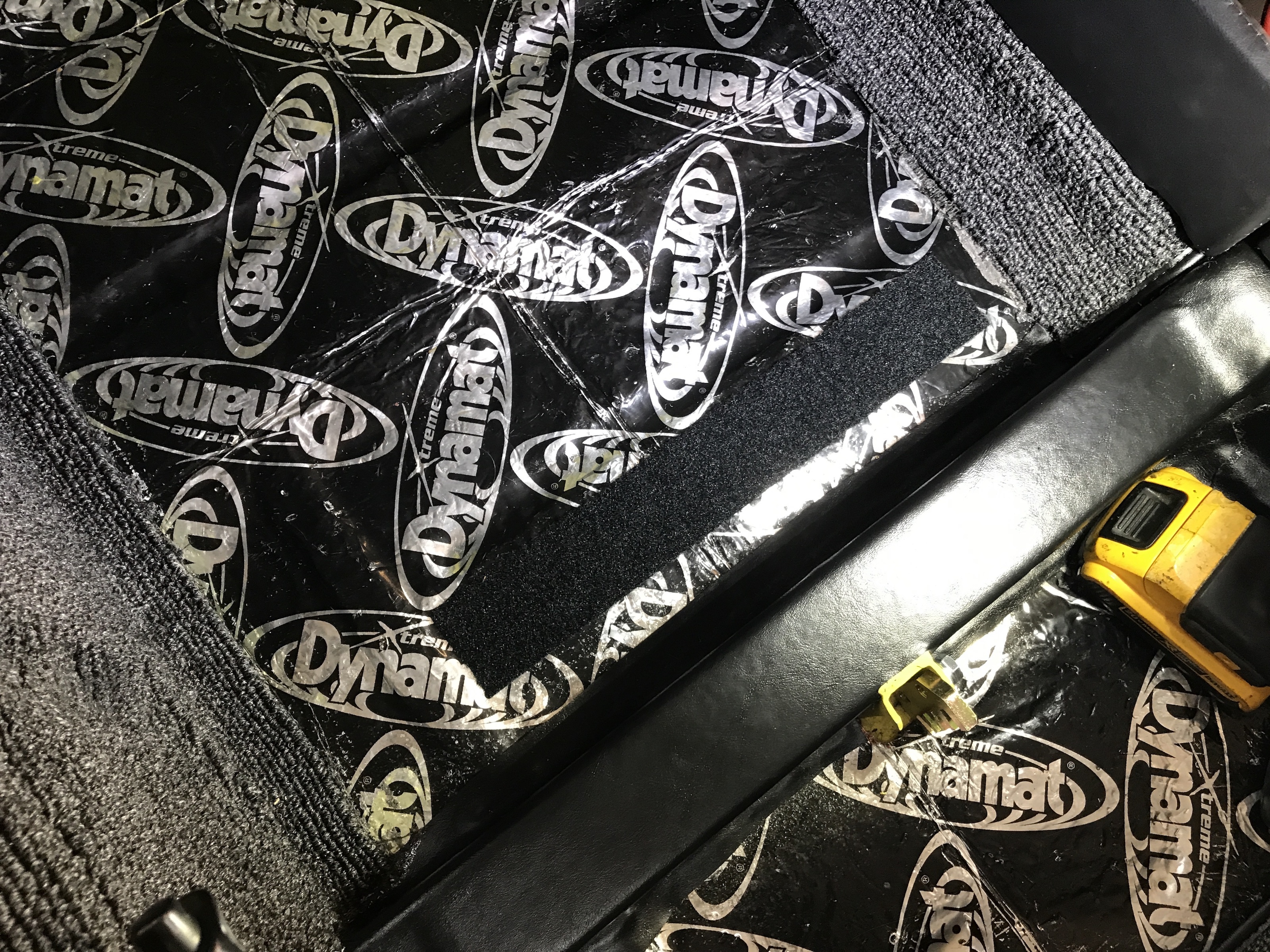

Member No.: 23,343
I stuck the fuzzy side to the floor. The adhesive is very strong, and sticks well--including to the back side of the carpet.

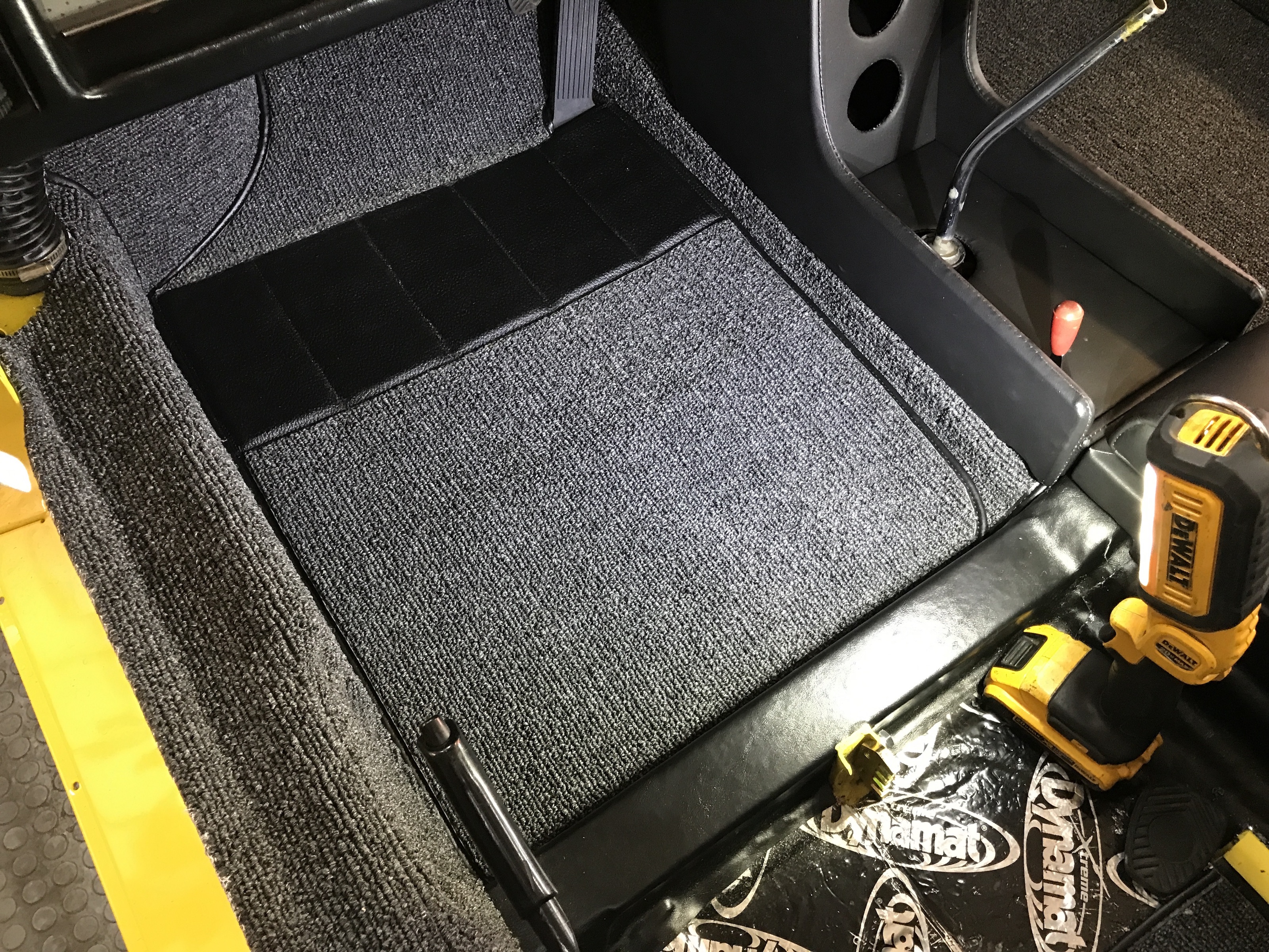

Carpet in place, and stuck to the Velcro.

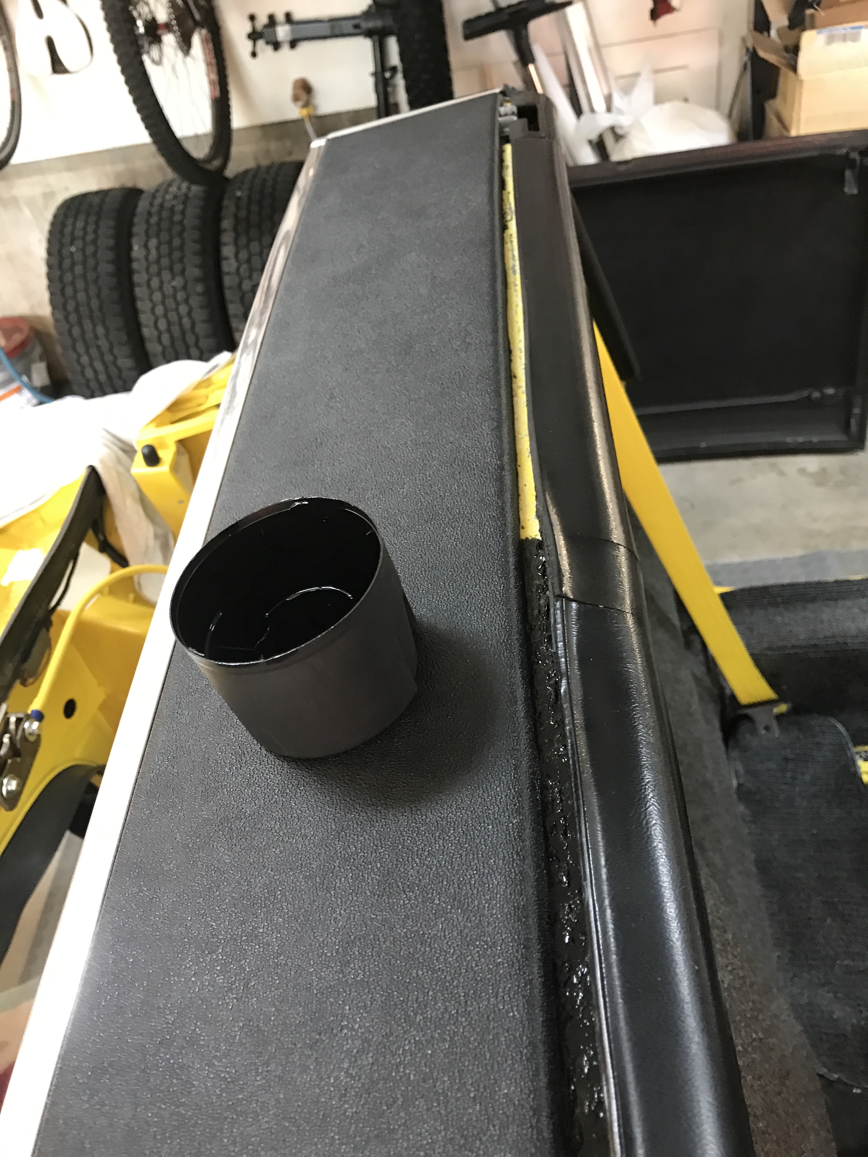

Member No.: 23,343
Another back-tracking detail. I used some paint to black out the flange of the targa bar that was barely visible behind the pad (in this shot ,the pad is pulled forward a bit). And yes, this pad is not really good enough, but maybe someday...

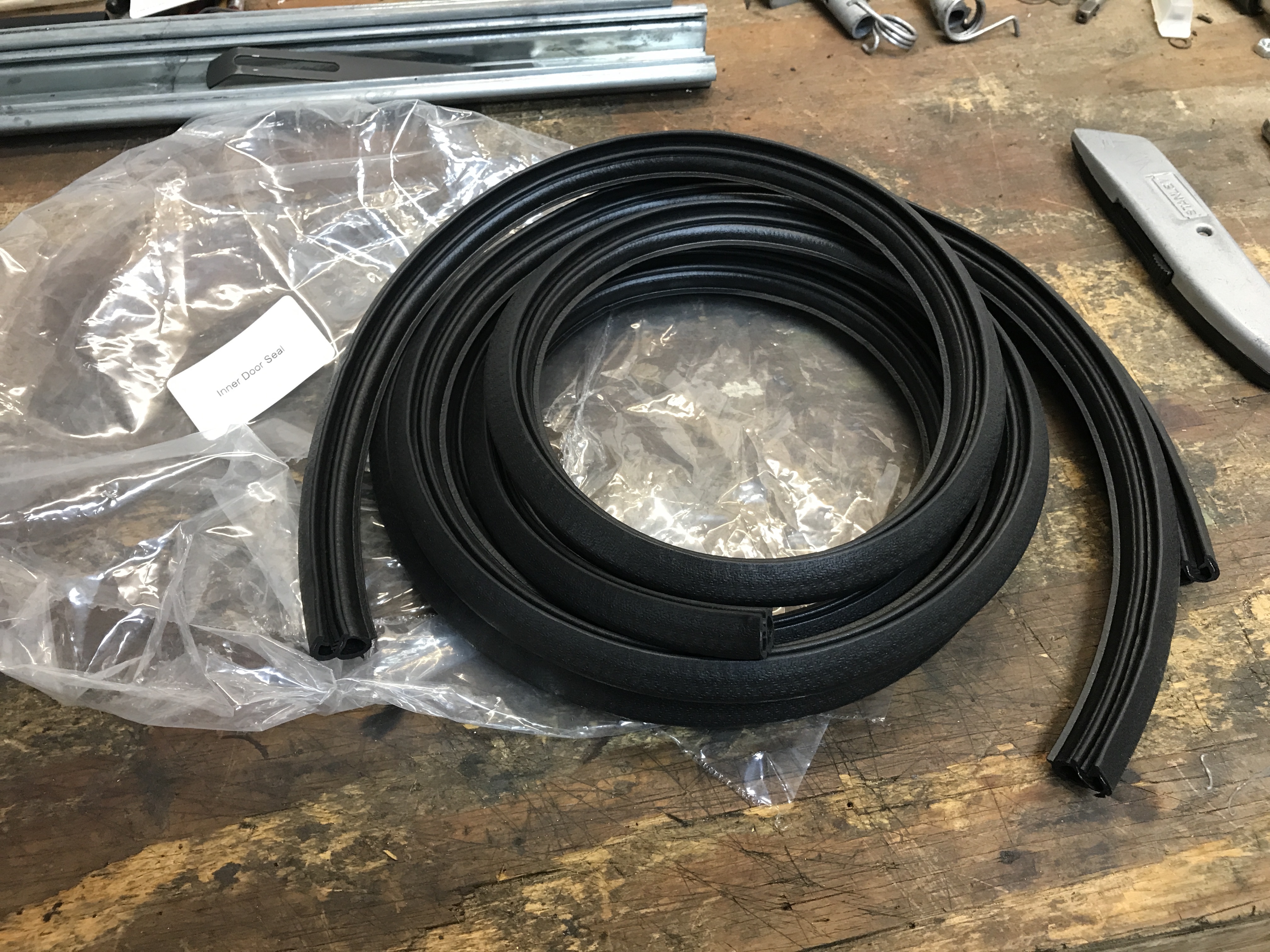

Now, onto the door frames. Here is a pair of new inner door seals.

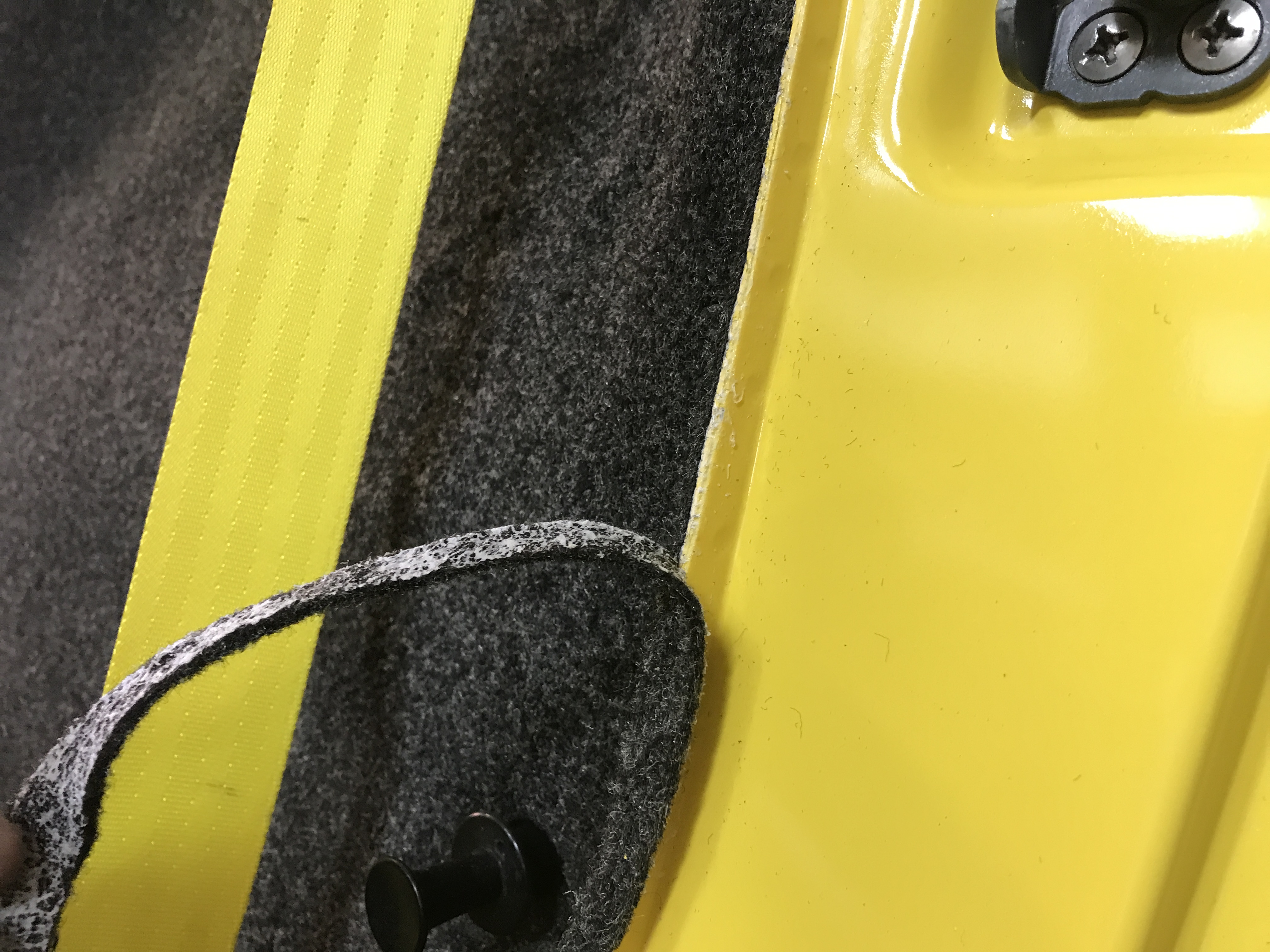

Member No.: 23,343
I trimmed the carpet around the door frame edge.

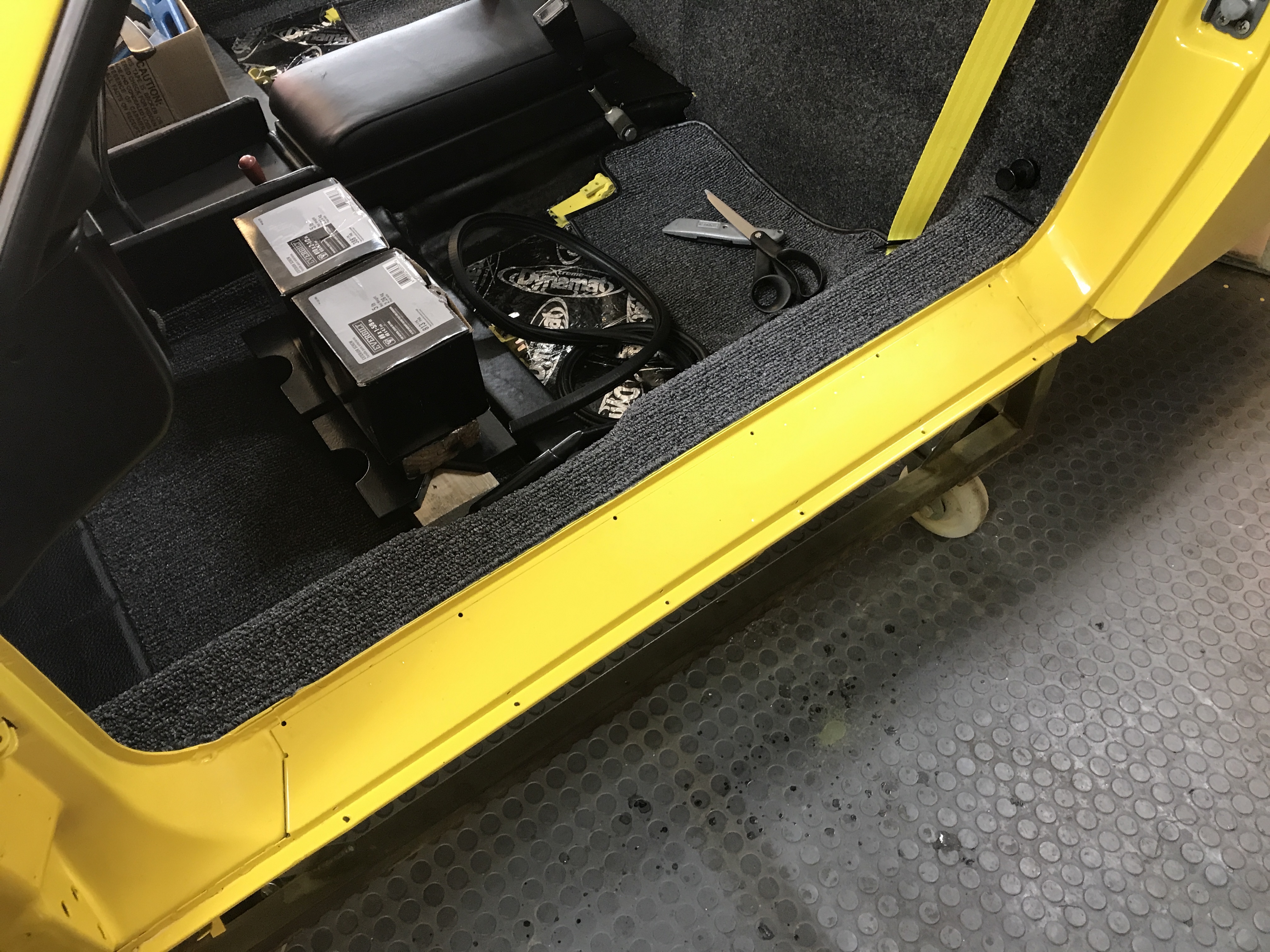

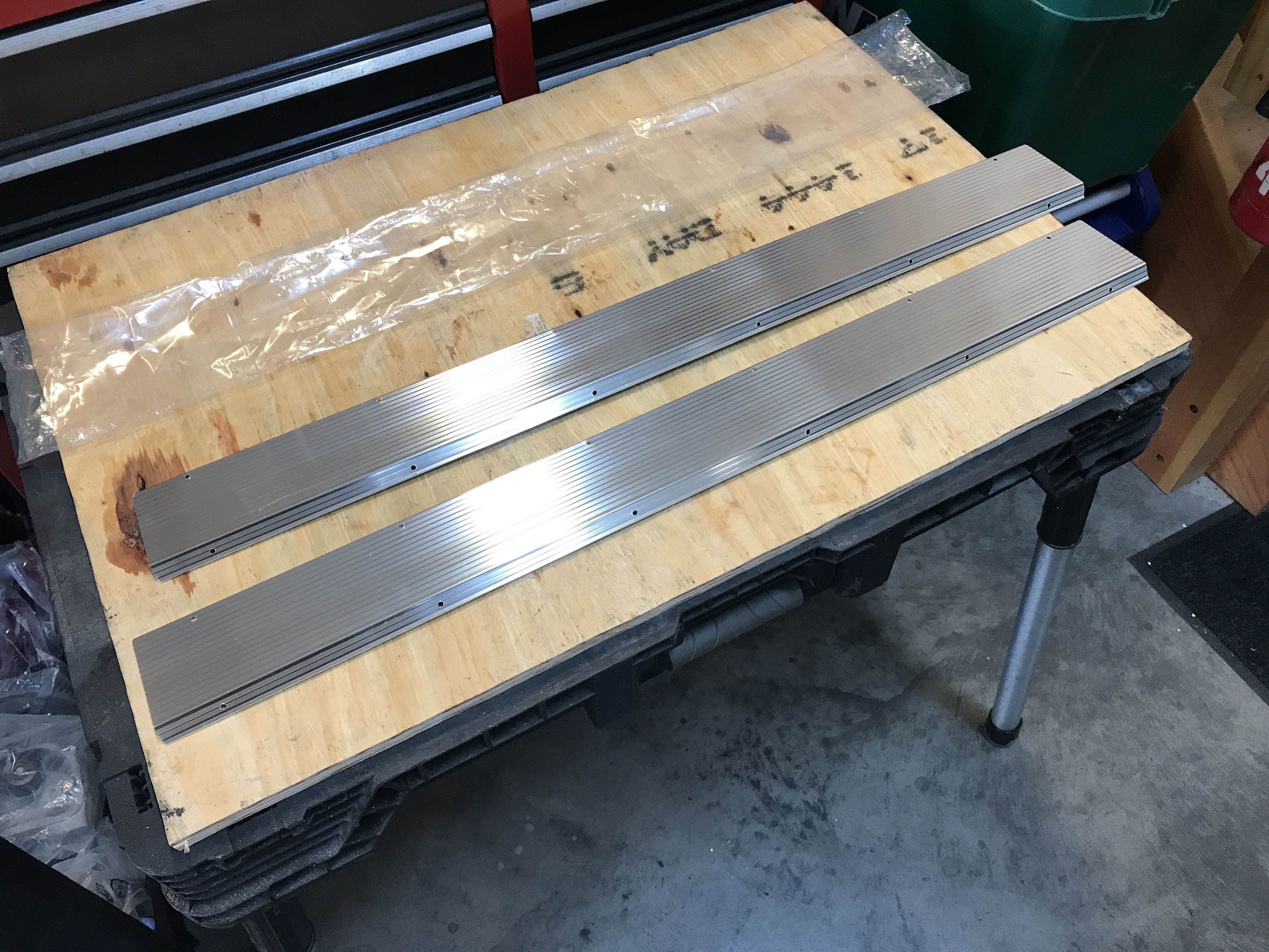

Member No.: 23,343

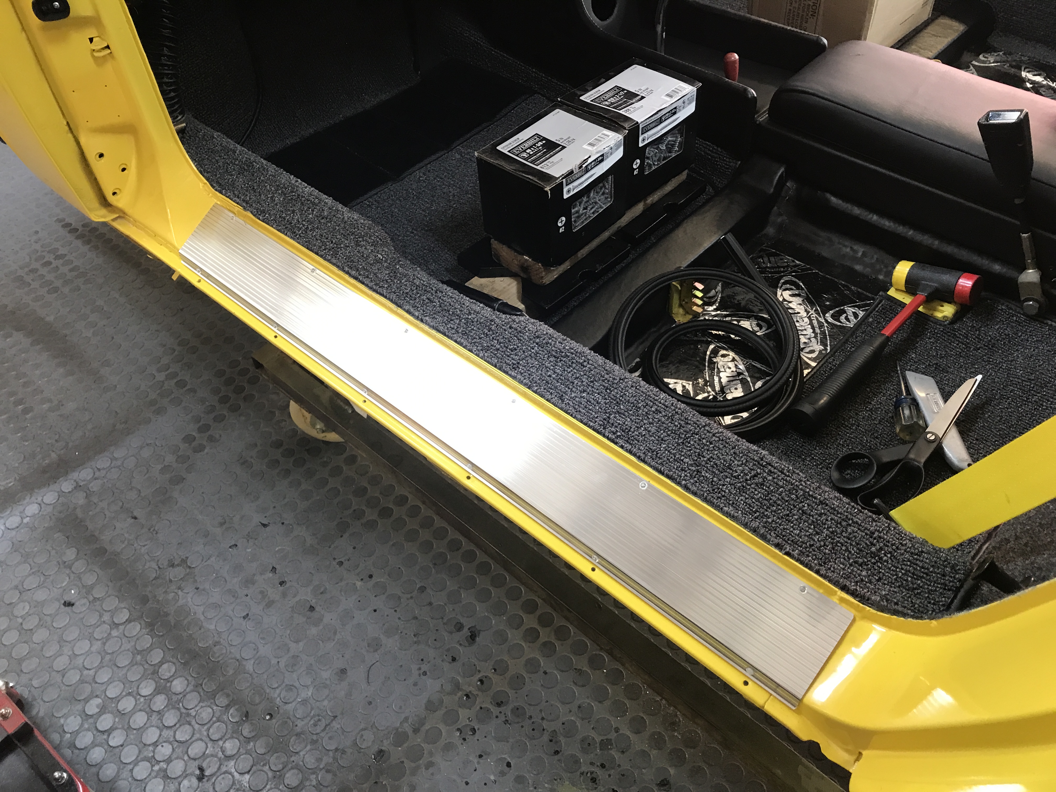

New aluminum sills.
bkrantz
post Jul 16 2021, 07:15 PM
Post #3356
Posts: 8,800
Joined: 3-August 19
From: SW Colorado

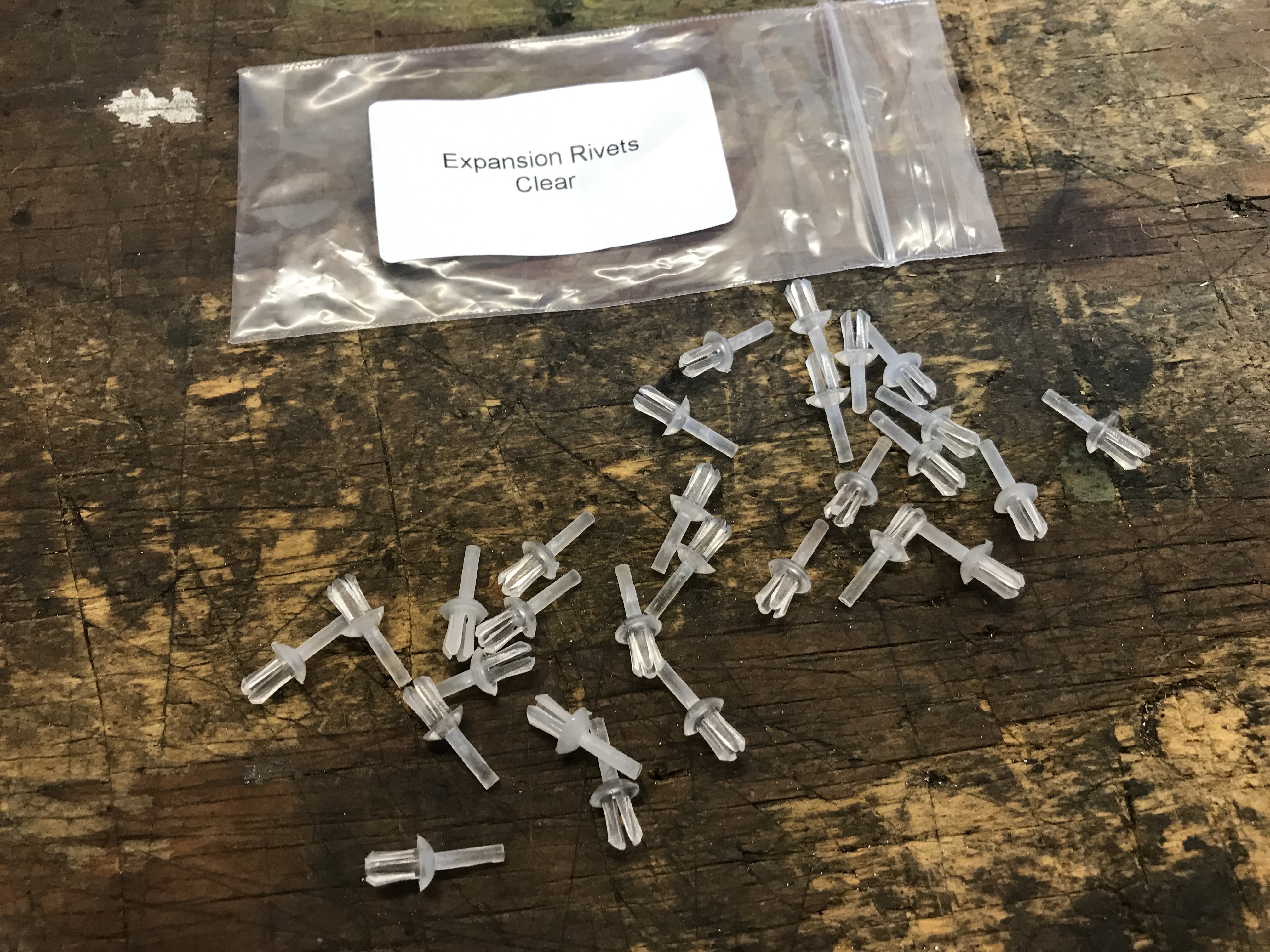

Member No.: 23,343
And new plastic rivets. BTW, I did discover that the center stud has to first be snapped off the base, and then inserted into the center hole.
bkrantz
post Jul 16 2021, 07:16 PM
Post #3357
Posts: 8,800
Joined: 3-August 19
From: SW Colorado
Member No.: 23,343
Left sill installed.
