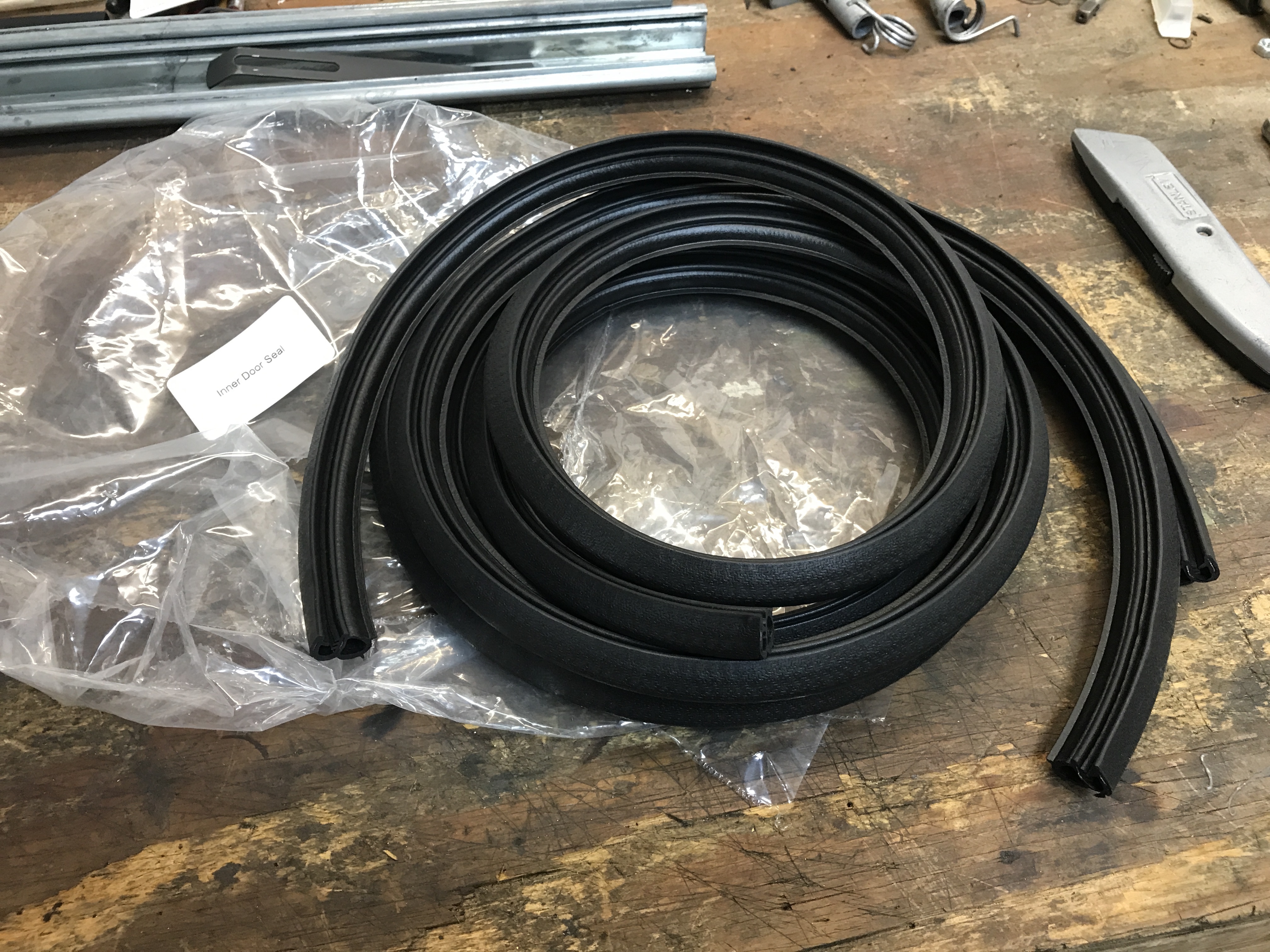

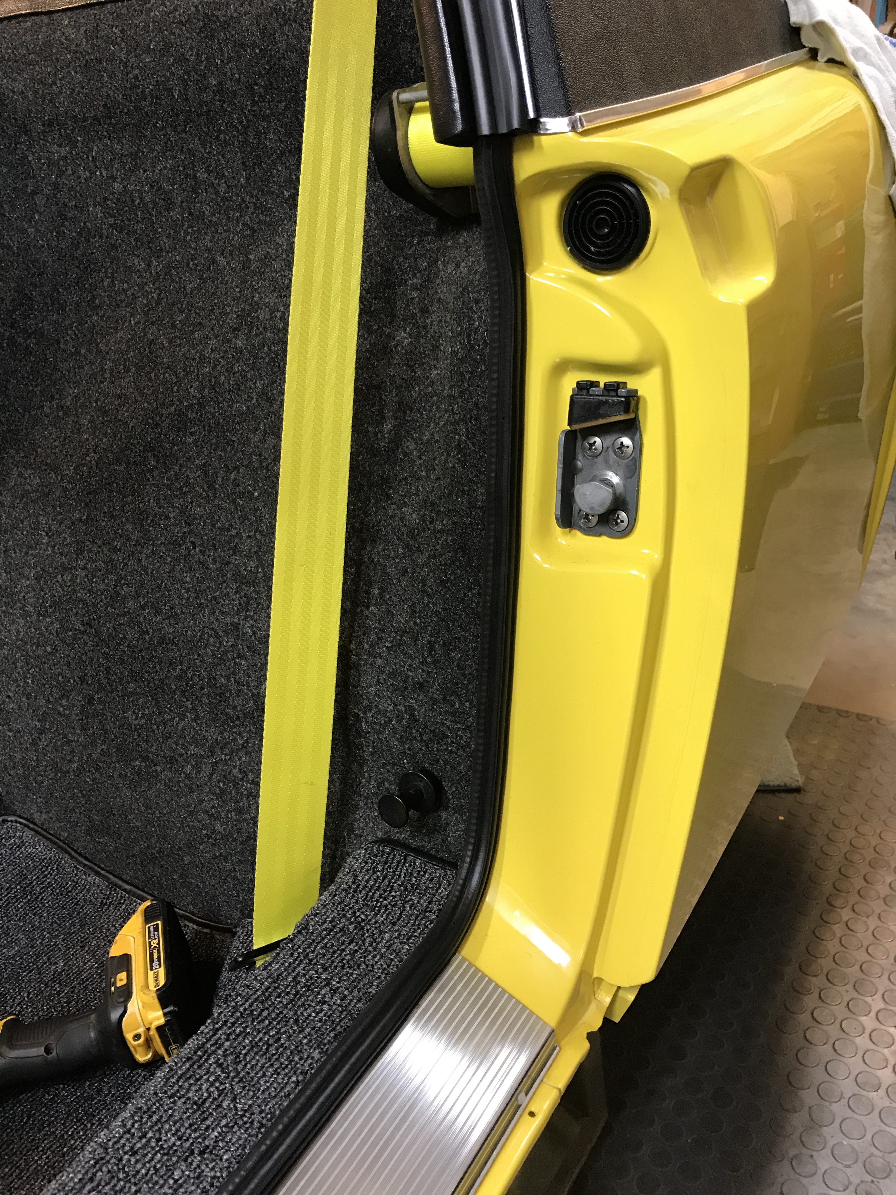

New inner door seals.
bkrantz
post Jul 17 2021, 08:36 PM
Post #3362
Posts: 8,800
Joined: 3-August 19
From: SW Colorado
Member No.: 23,343
Left side installed. It bulges a bit along the bottom.

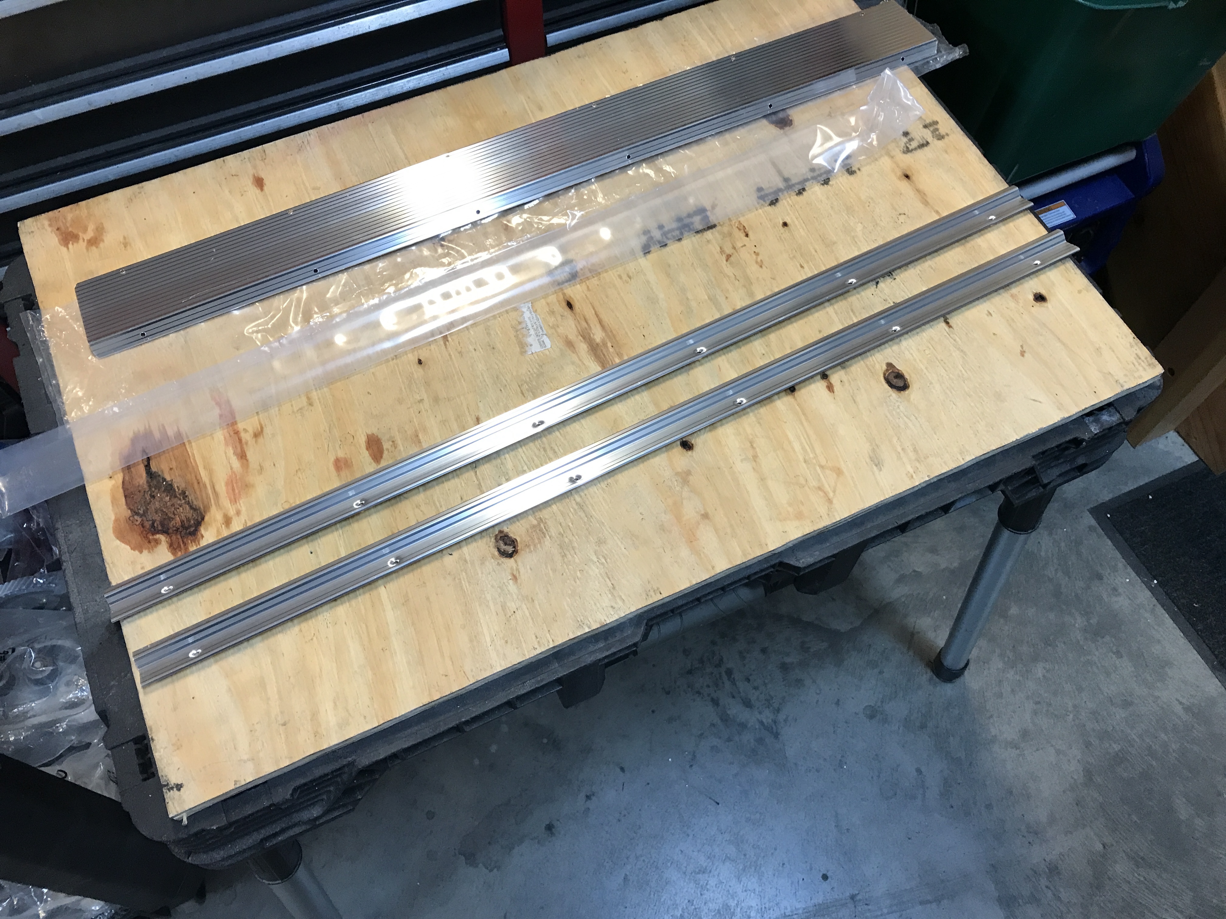

Member No.: 23,343

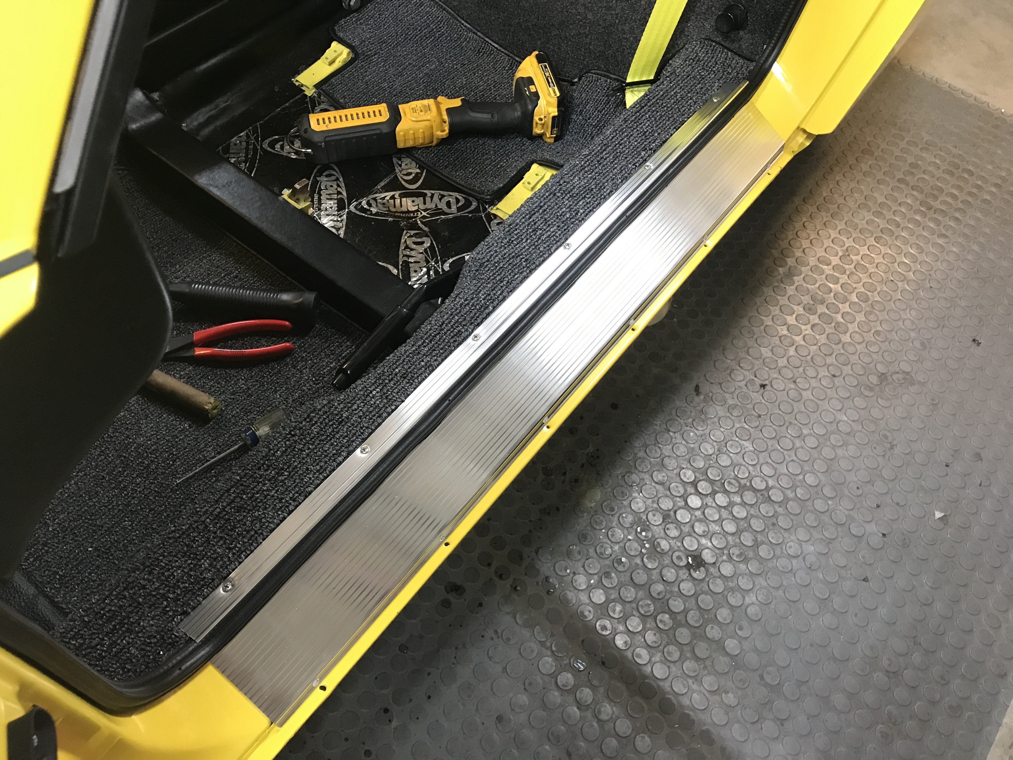

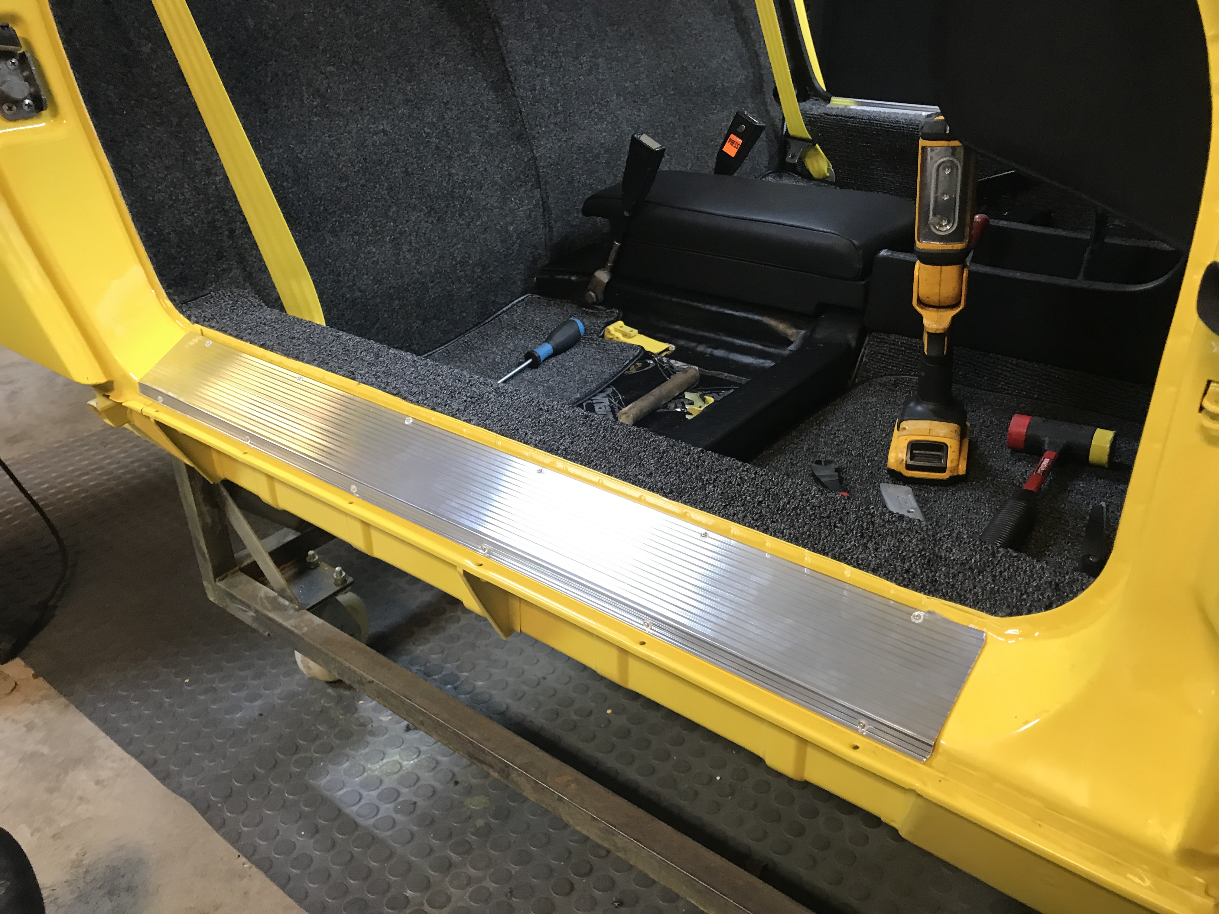

Now for the inner sill trim pieces.
bkrantz
post Jul 17 2021, 08:38 PM
Post #3364
Posts: 8,800
Joined: 3-August 19
From: SW Colorado
Member No.: 23,343
Installed with screws.
bkrantz
Post #3365
Posts: 8,800
Joined: 3-August 19
From: SW Colorado
Member No.: 23,343
Starting on the right side.
bkrantz
post Jul 17 2021, 08:39 PM
Post #3366
Posts: 8,800
Joined: 3-August 19
From: SW Colorado
Member No.: 23,343
And done.

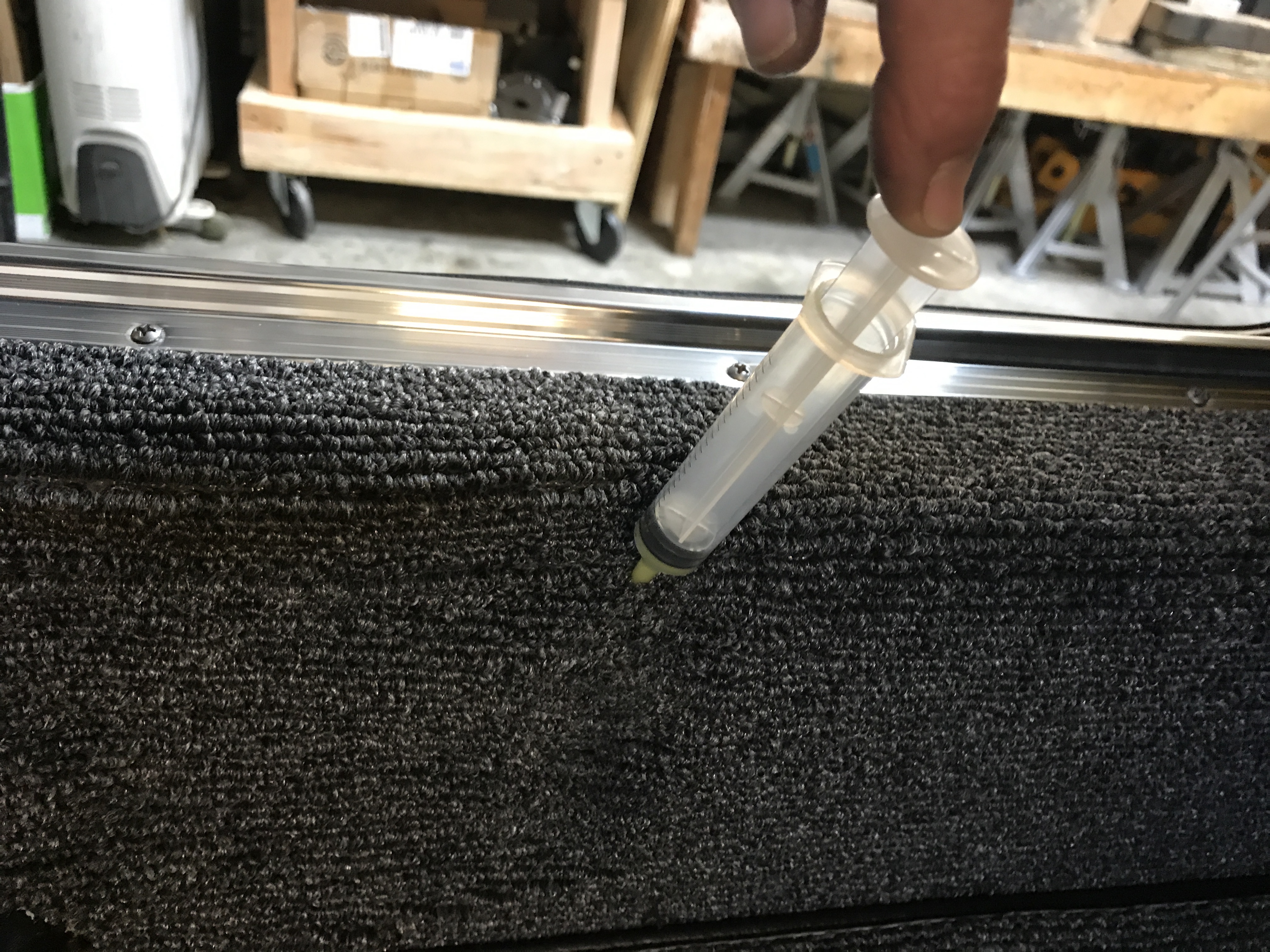

Member No.: 23,343

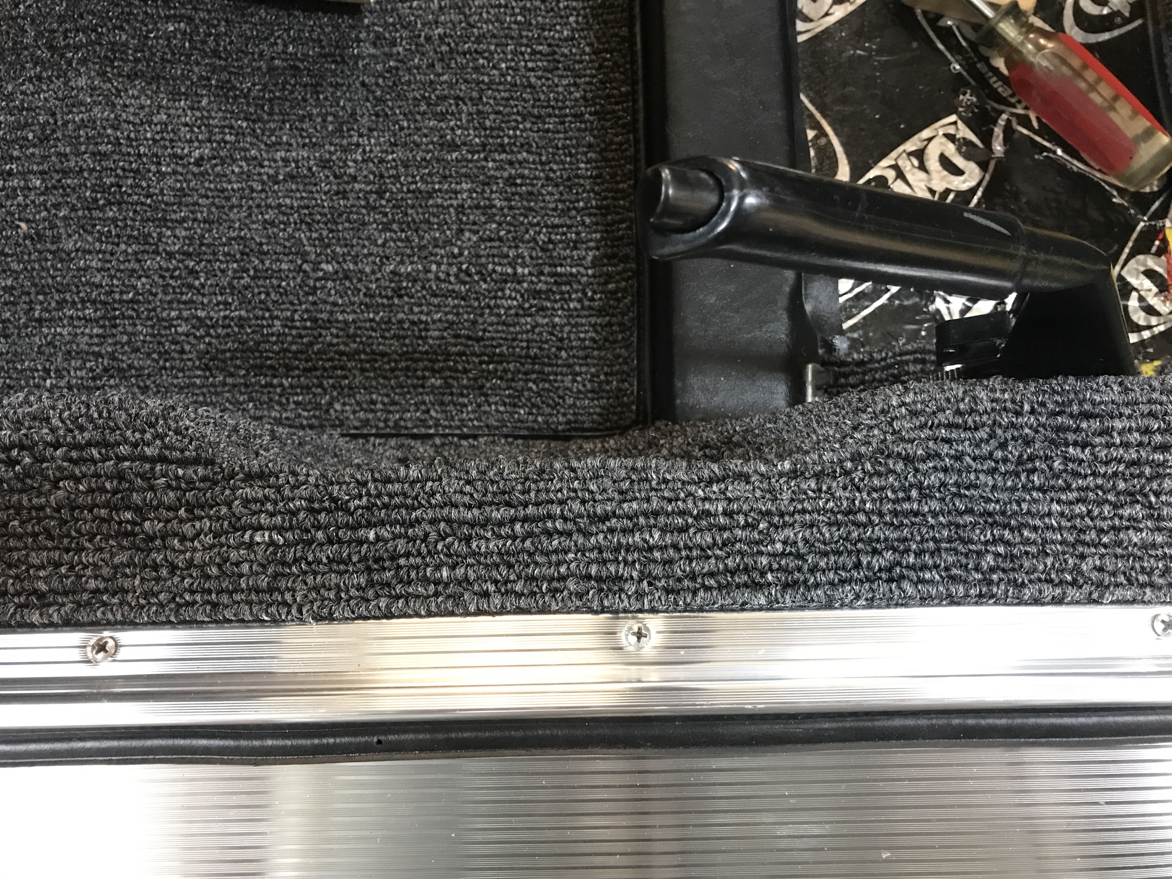

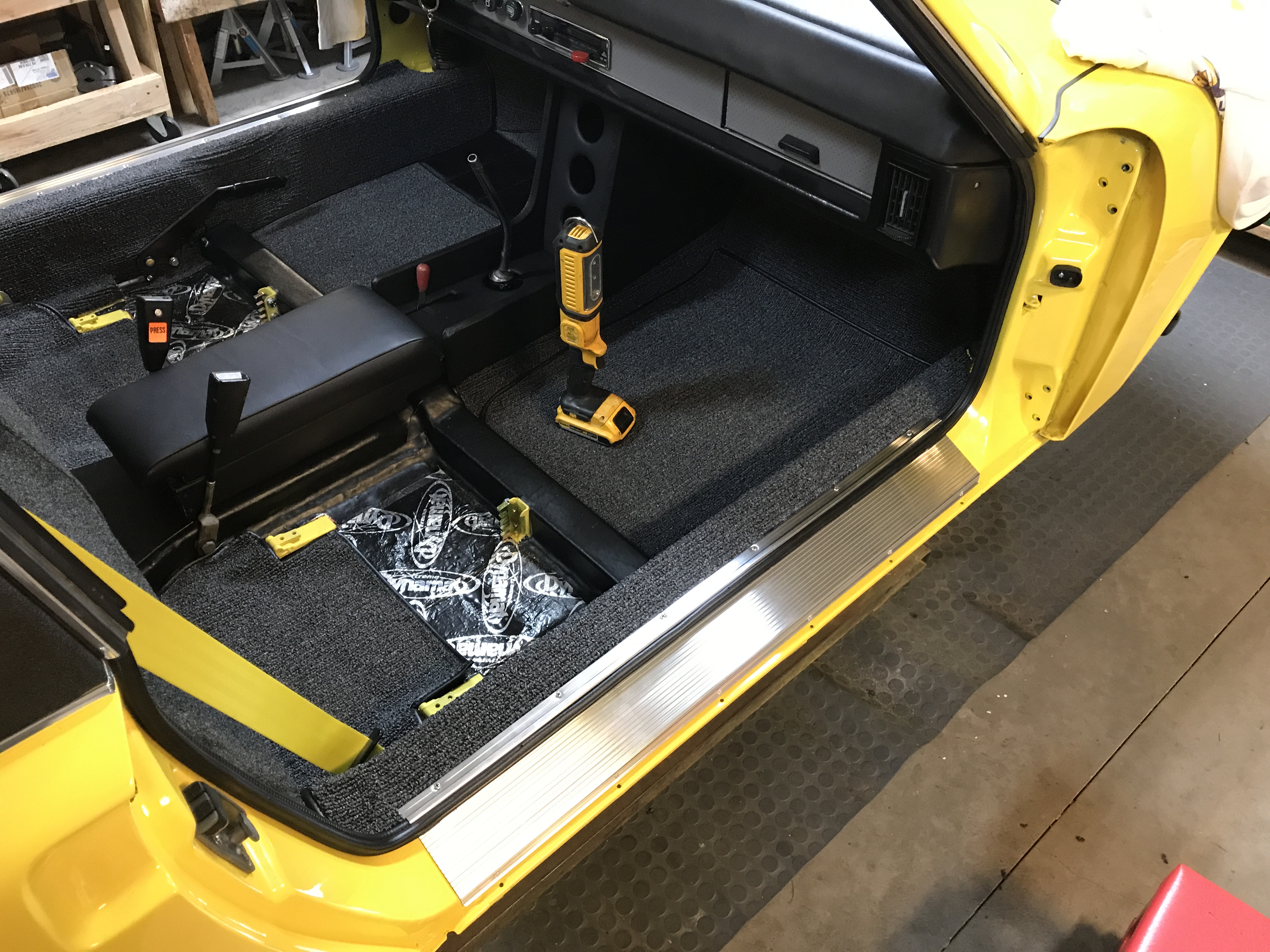

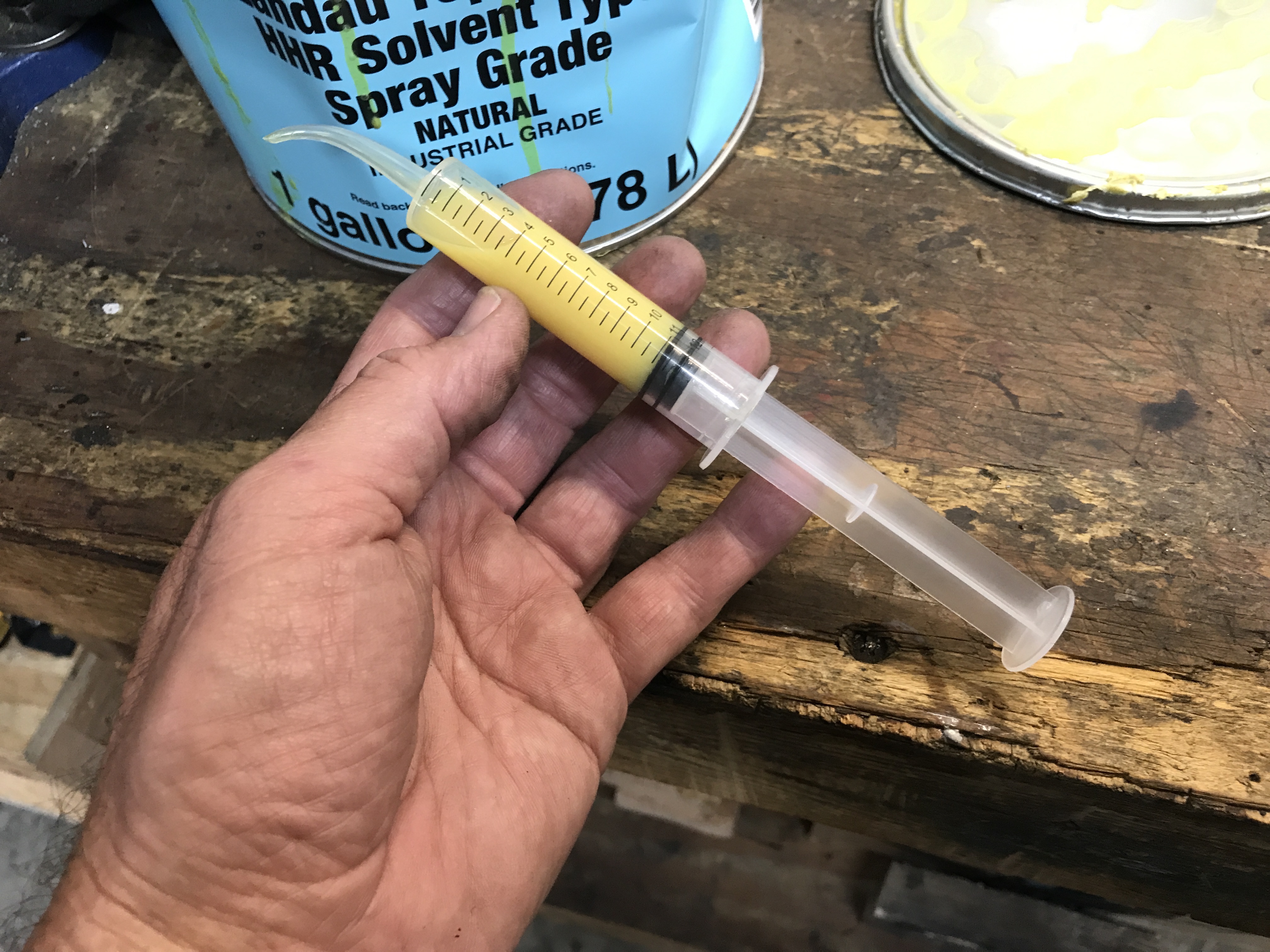

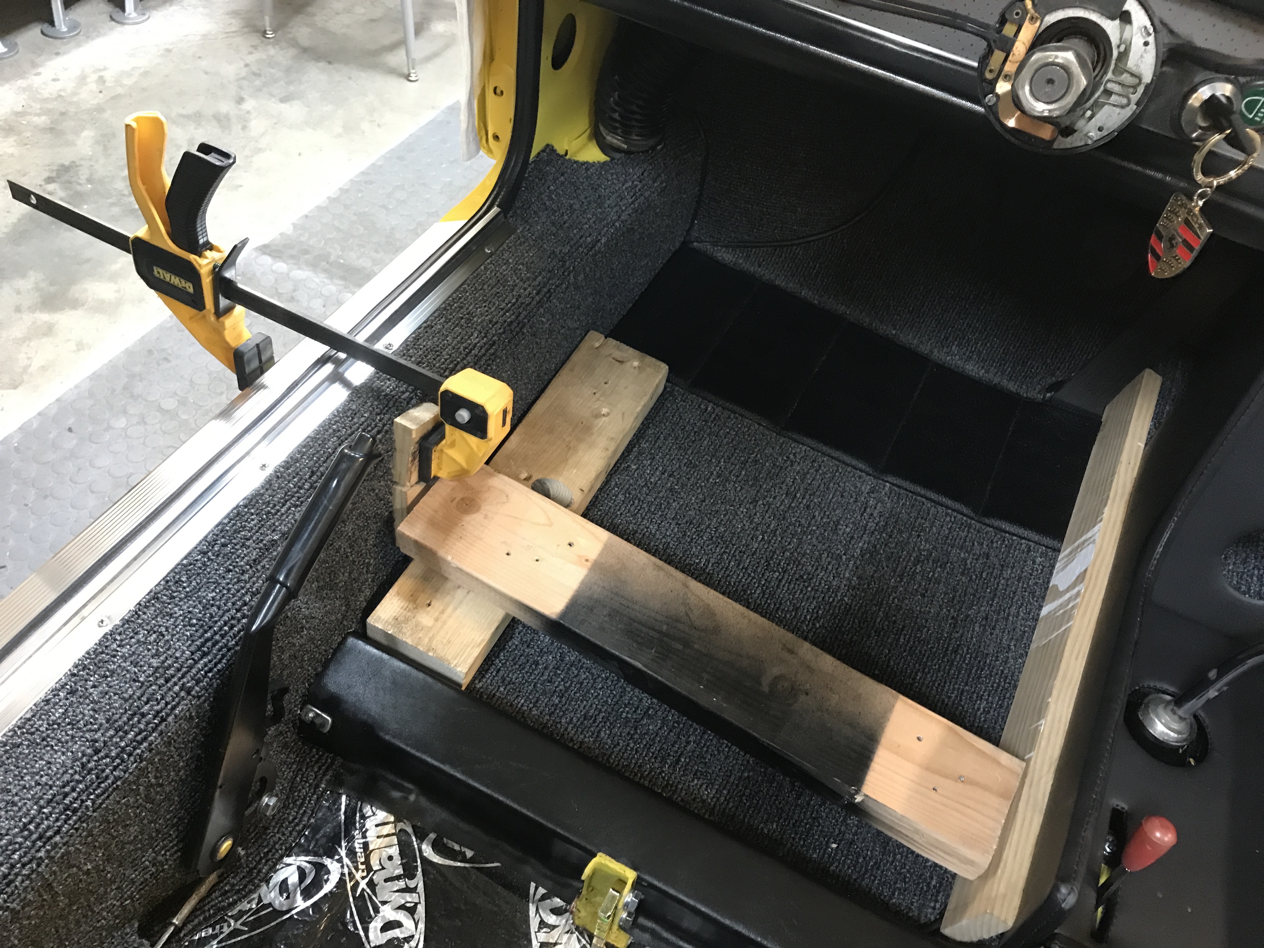

I noticed the carpet I tried to stretch into the hand brake recess had pulled loose along one side. I came up with an injection of contact cement.
bkrantz
post Jul 17 2021, 08:44 PM
Post #3368
Posts: 8,800
Joined: 3-August 19
From: SW Colorado
Member No.: 23,343
I tried to squirt it around inside the loose area.
bkrantz
post Jul 17 2021, 08:46 PM
Post #3369
Posts: 8,800
Joined: 3-August 19
From: SW Colorado
Member No.: 23,343
And then clamped the inner corner in place.

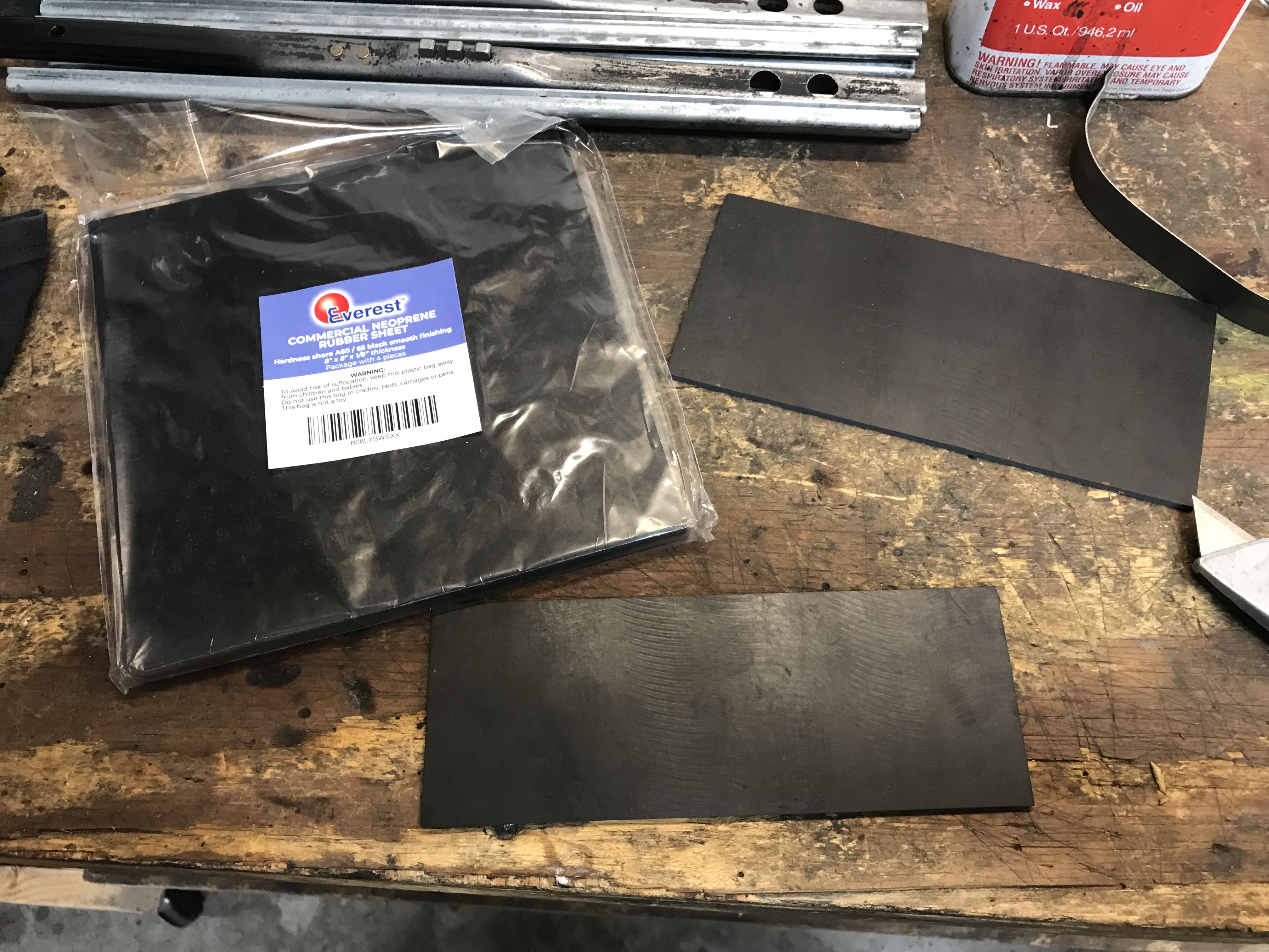

Member No.: 23,343

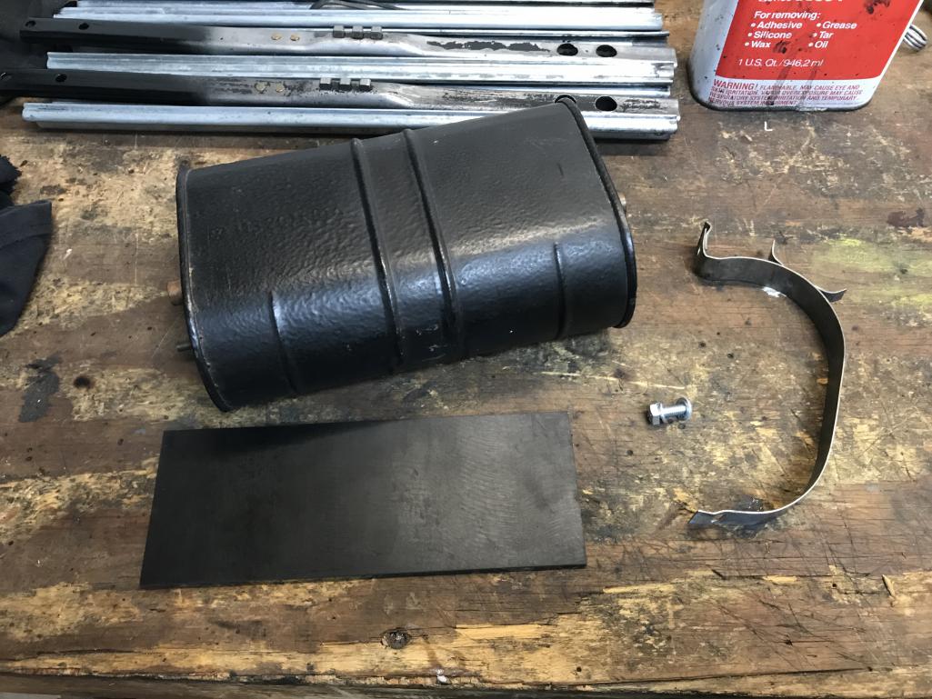

I got some rubber sheets, here 1/8".
bkrantz
post Jul 17 2021, 08:48 PM
Post #3371
Posts: 8,800
Joined: 3-August 19
From: SW Colorado

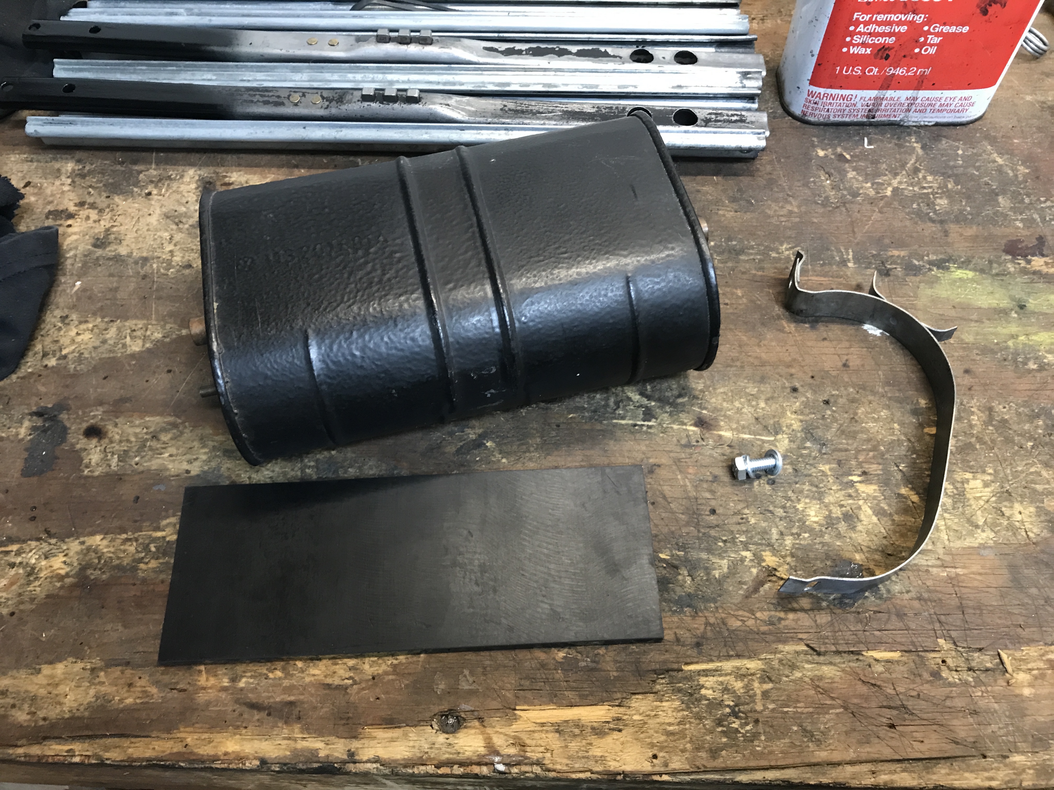

Member No.: 23,343
I used one piece to pad the mounting of the charcoal canister.

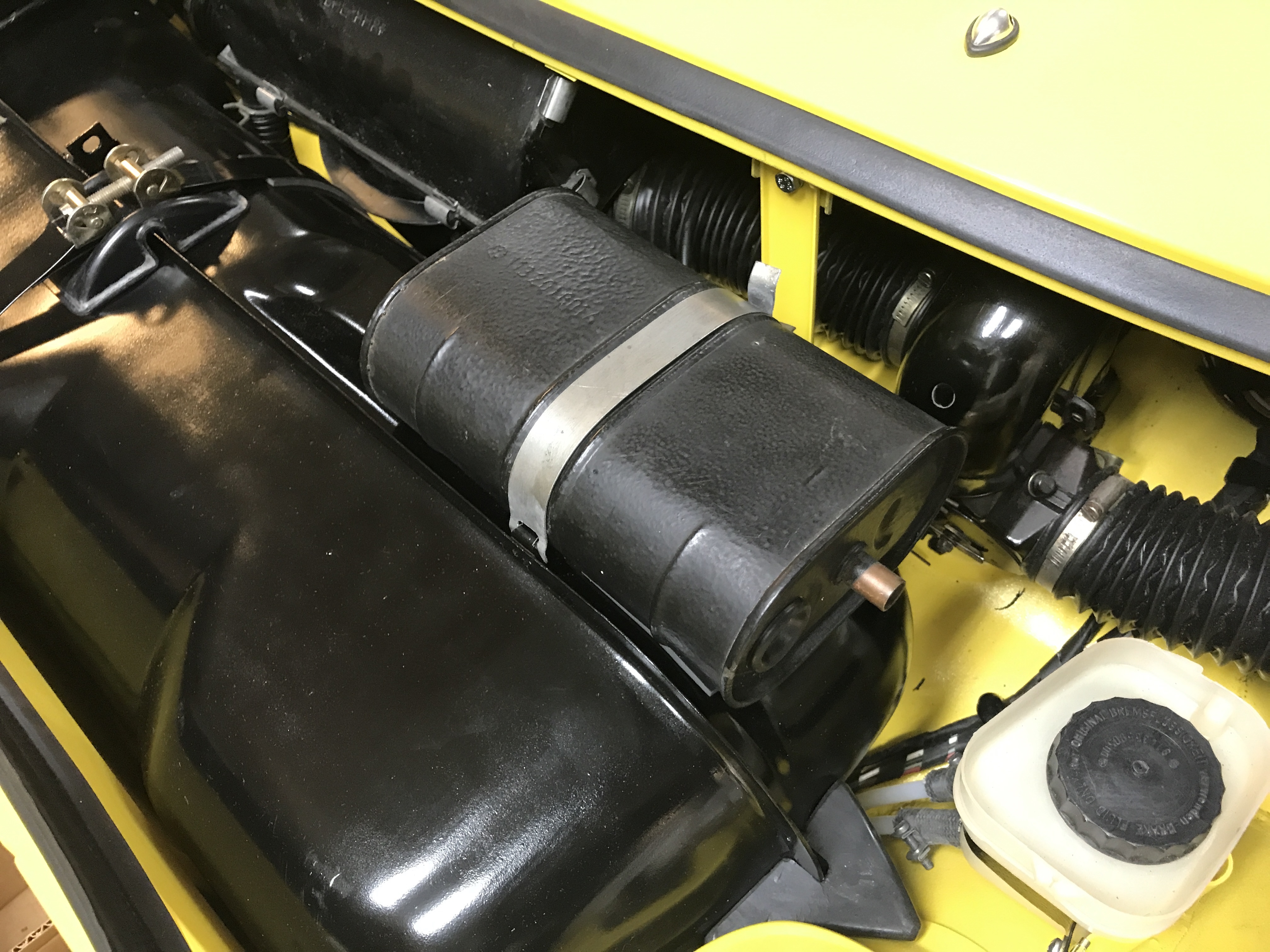

bkrantz
post Jul 17 2021, 08:49 PM
Post #3372
Posts: 8,800
Joined: 3-August 19
From: SW Colorado

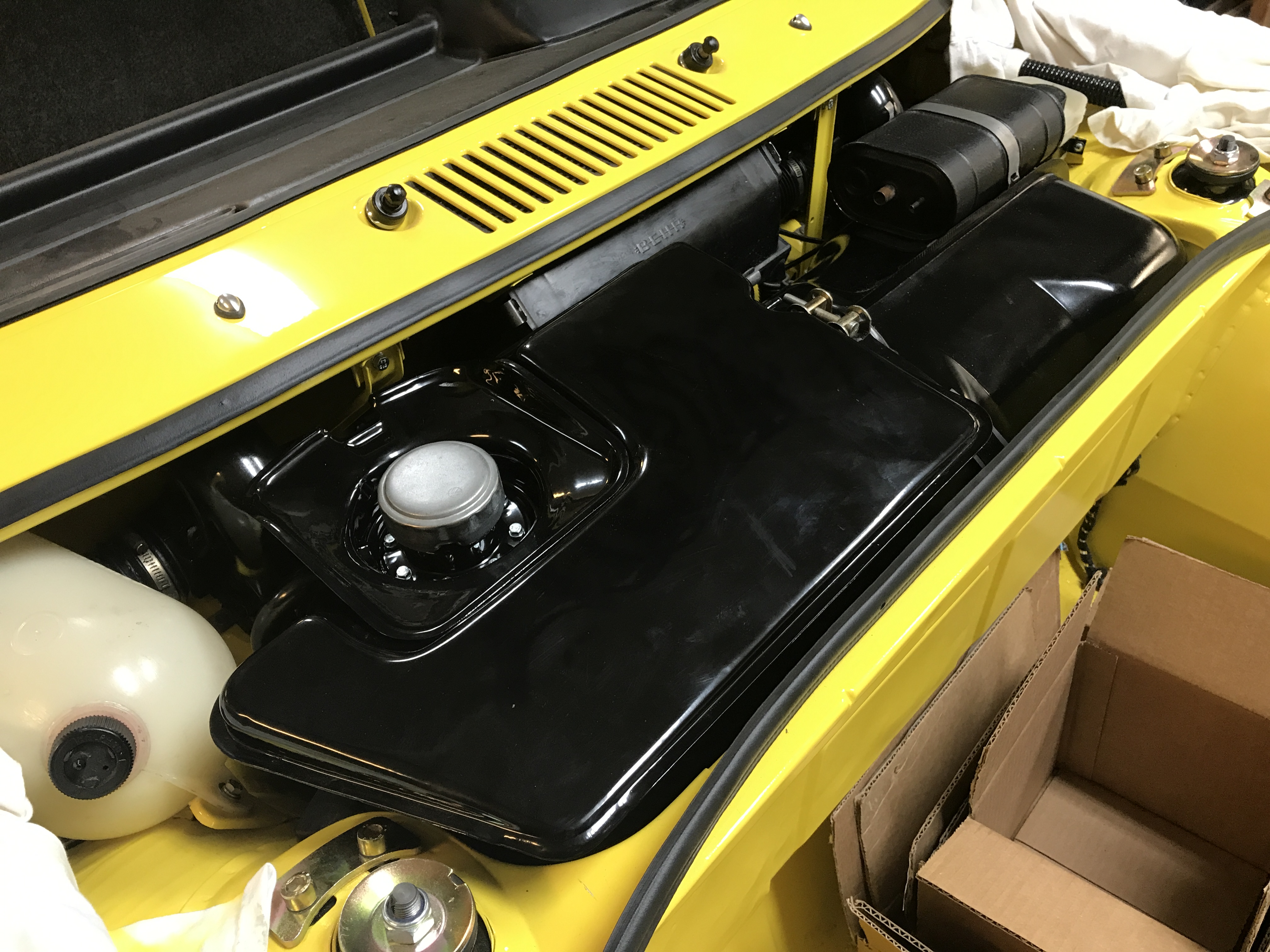

Member No.: 23,343
Canister installed.
bkrantz
Post #3373
Posts: 8,800
Joined: 3-August 19
From: SW Colorado
Member No.: 23,343
And then the expansion tank.

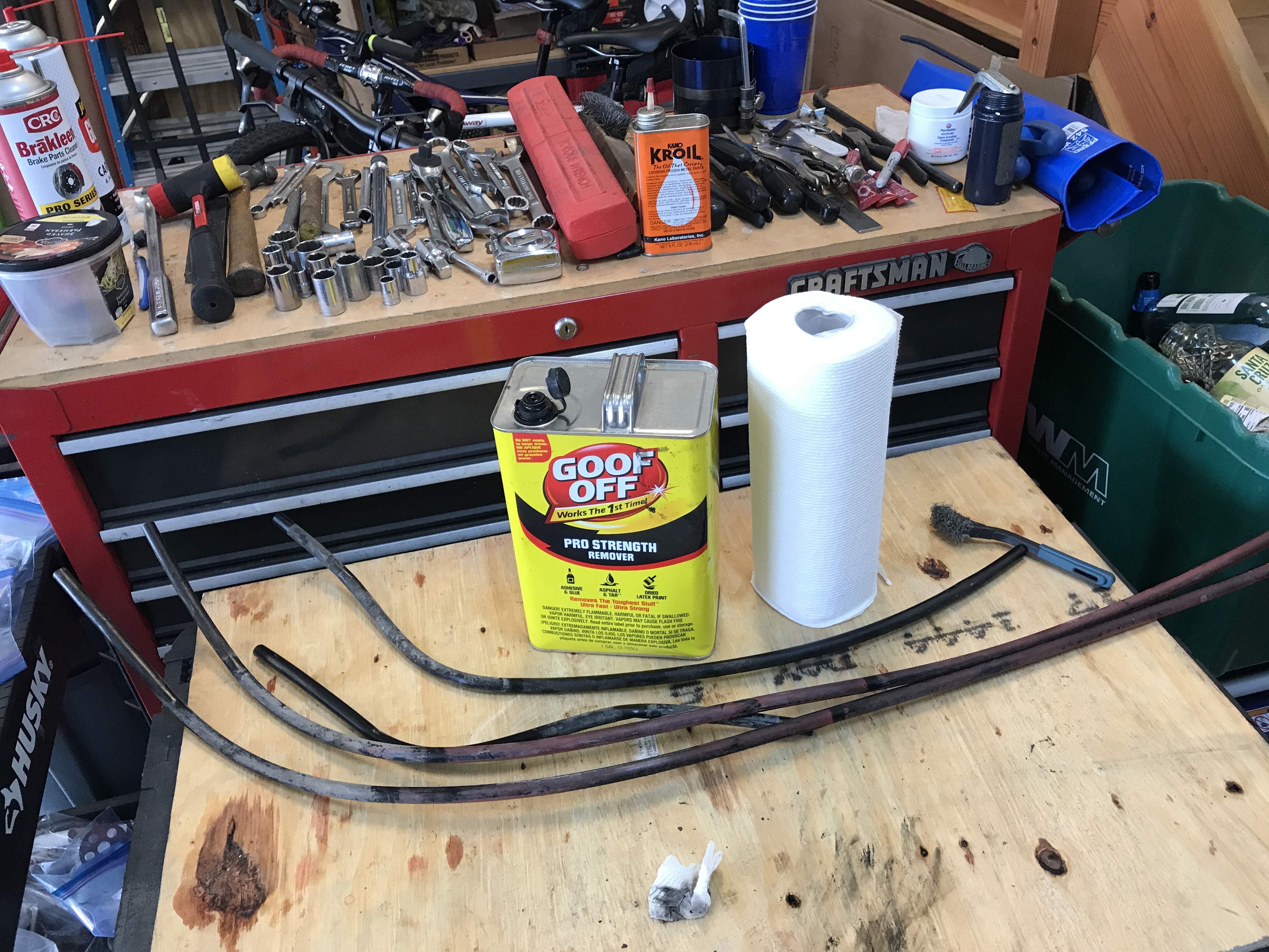

Member No.: 23,343

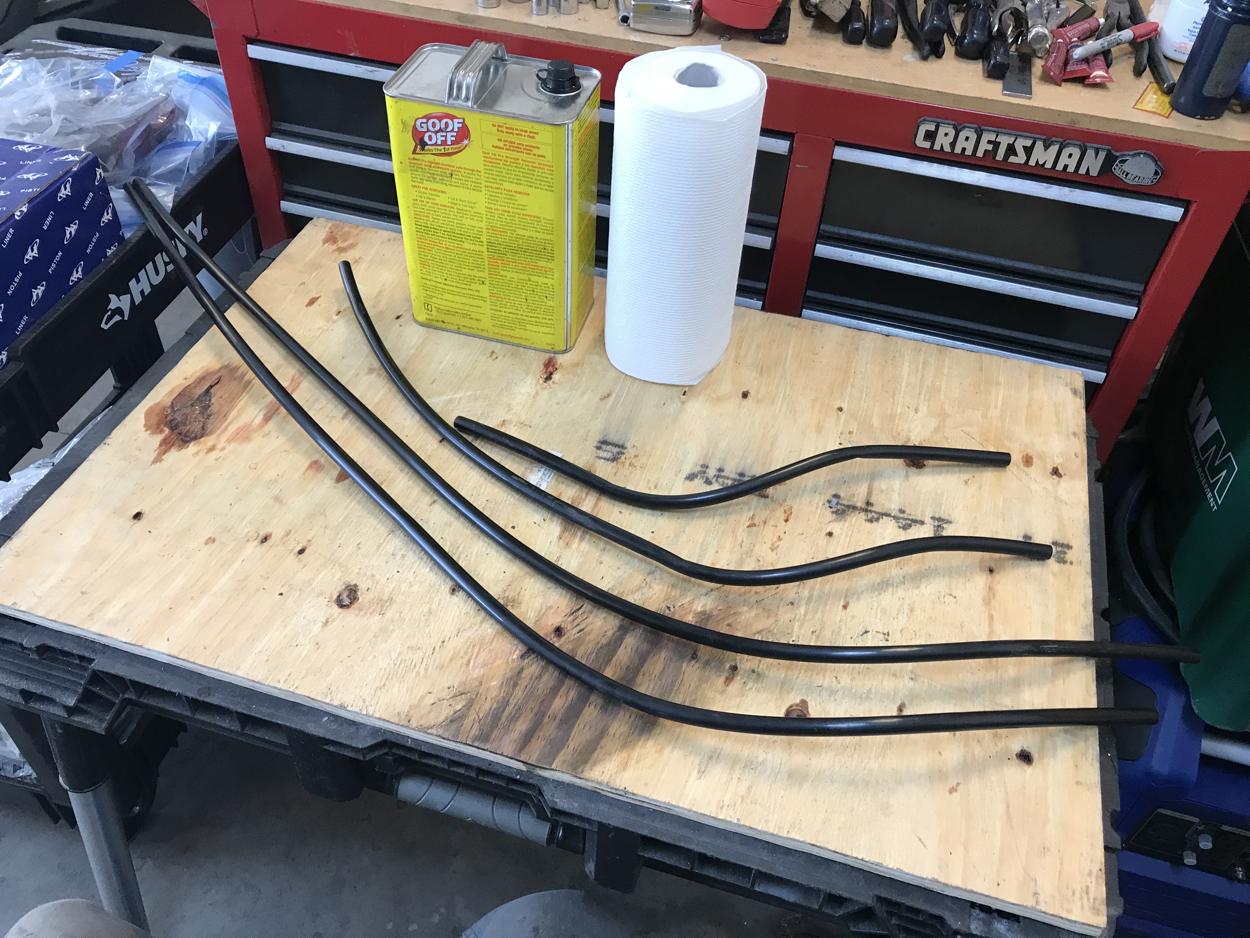

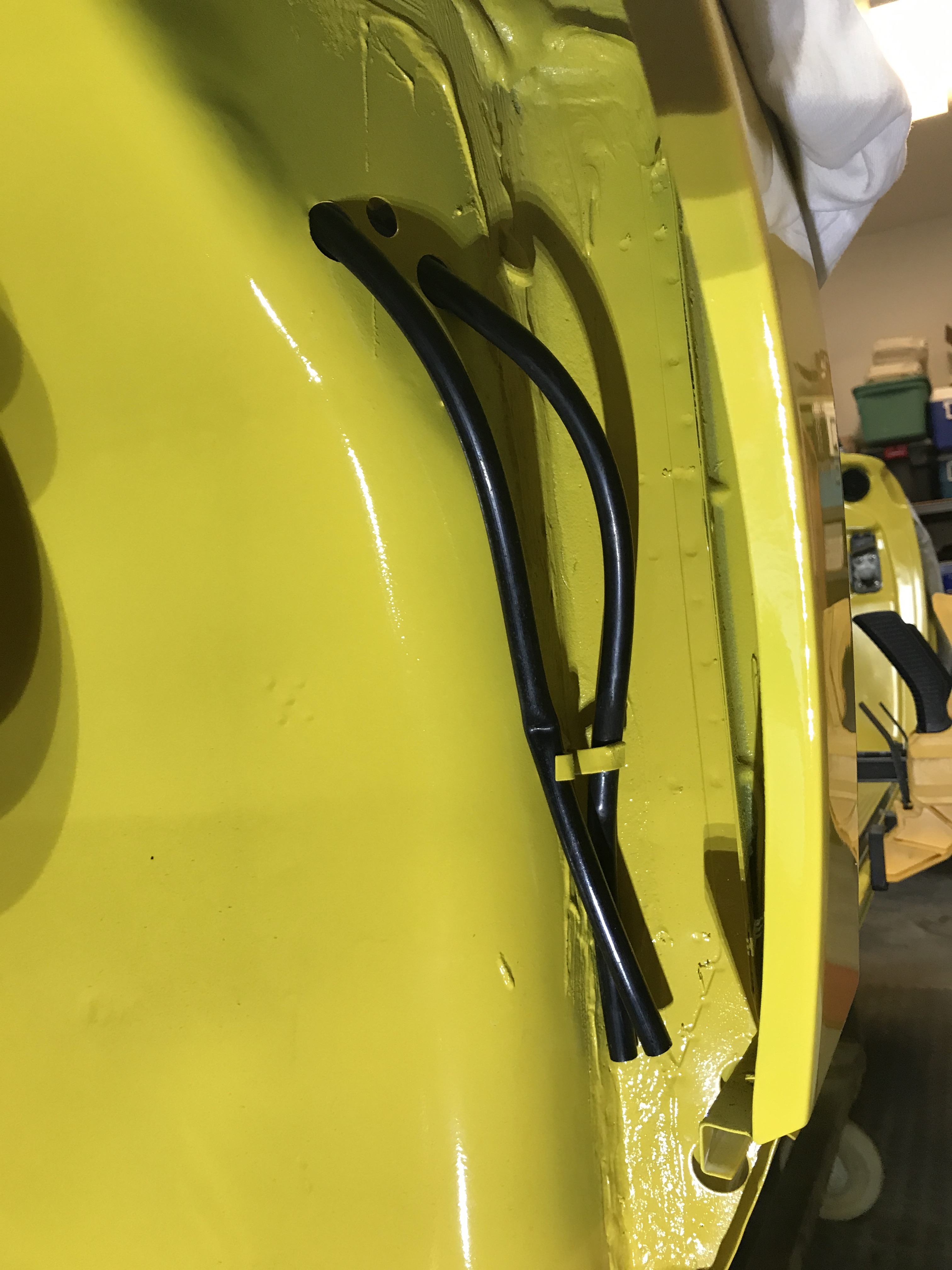

Not too much today, but I cleaned up the plastic tubing segments for the evaporative control system. These could be the last parts that I have to deal with PO red overspray and undercoating.
bkrantz
post Jul 18 2021, 07:10 PM
Post #3377
Posts: 8,800
Joined: 3-August 19
From: SW Colorado
Member No.: 23,343
That's better. Once again, Goofoff works well to remove crud, and also leaves a bit of shine on the plastic.
bkrantz
post Jul 18 2021, 07:12 PM
Post #3378
Posts: 8,800
Joined: 3-August 19
From: SW Colorado
Member No.: 23,343

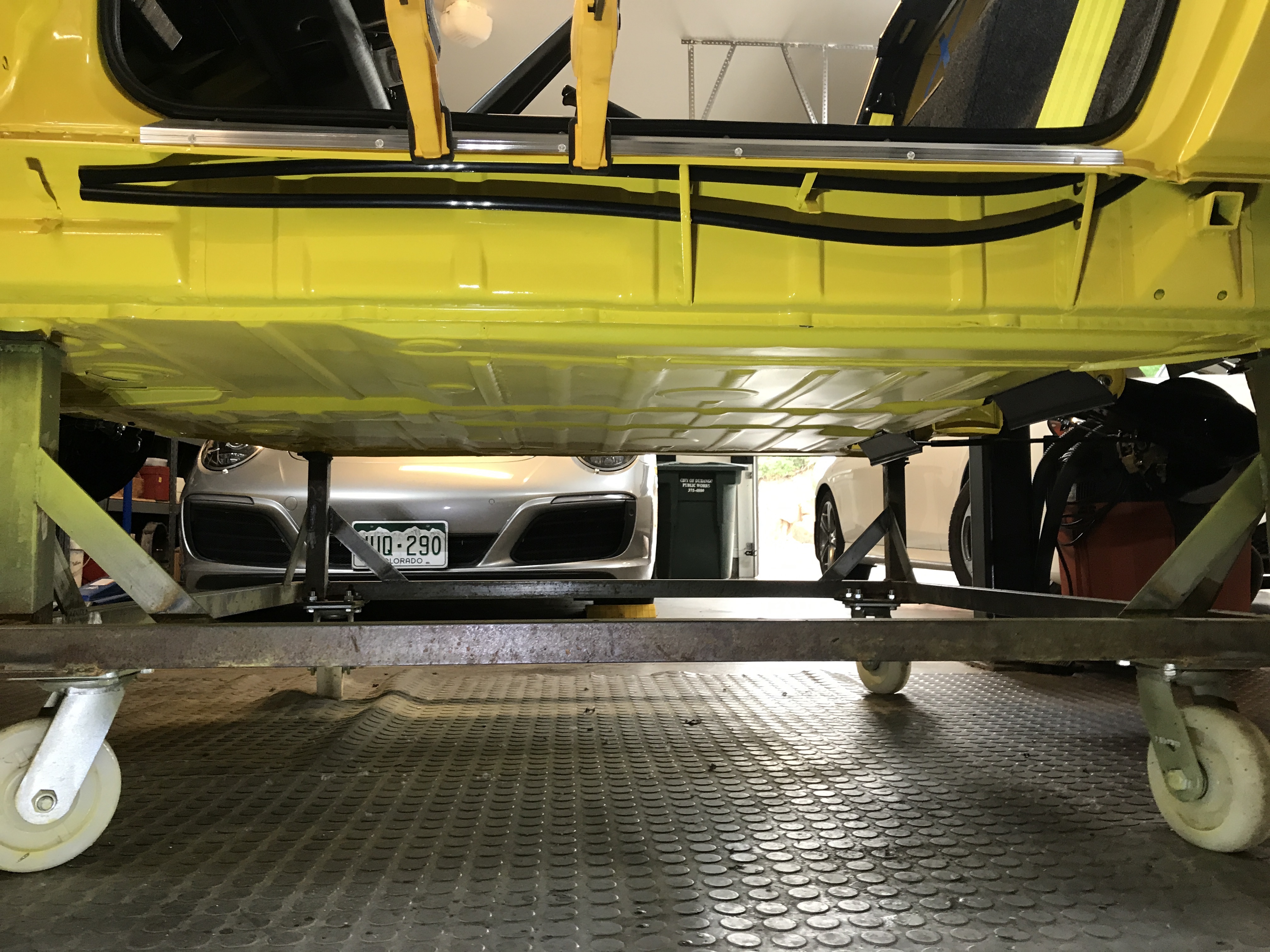

Just for fun, I test fit the pieces. I need to get some vent hose and grommets before I can install these for real.
Left front fender well.
bkrantz
Post #3379
Posts: 8,800
Joined: 3-August 19
From: SW Colorado
Member No.: 23,343
Left outer sill.

Member No.: 23,343
I took the clamps off the carpet in the hand brake lever indentation. It seems stuck on now.
