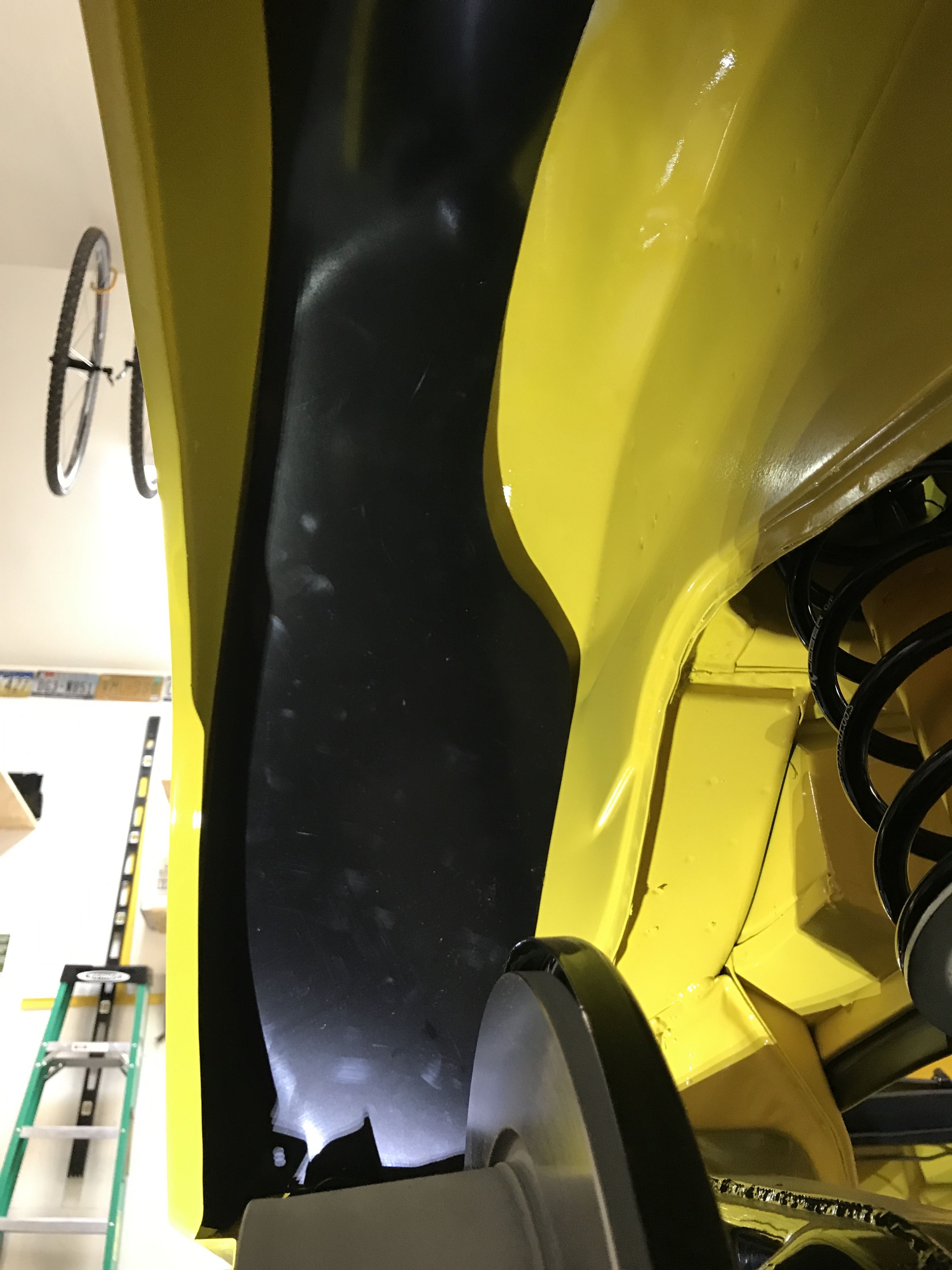

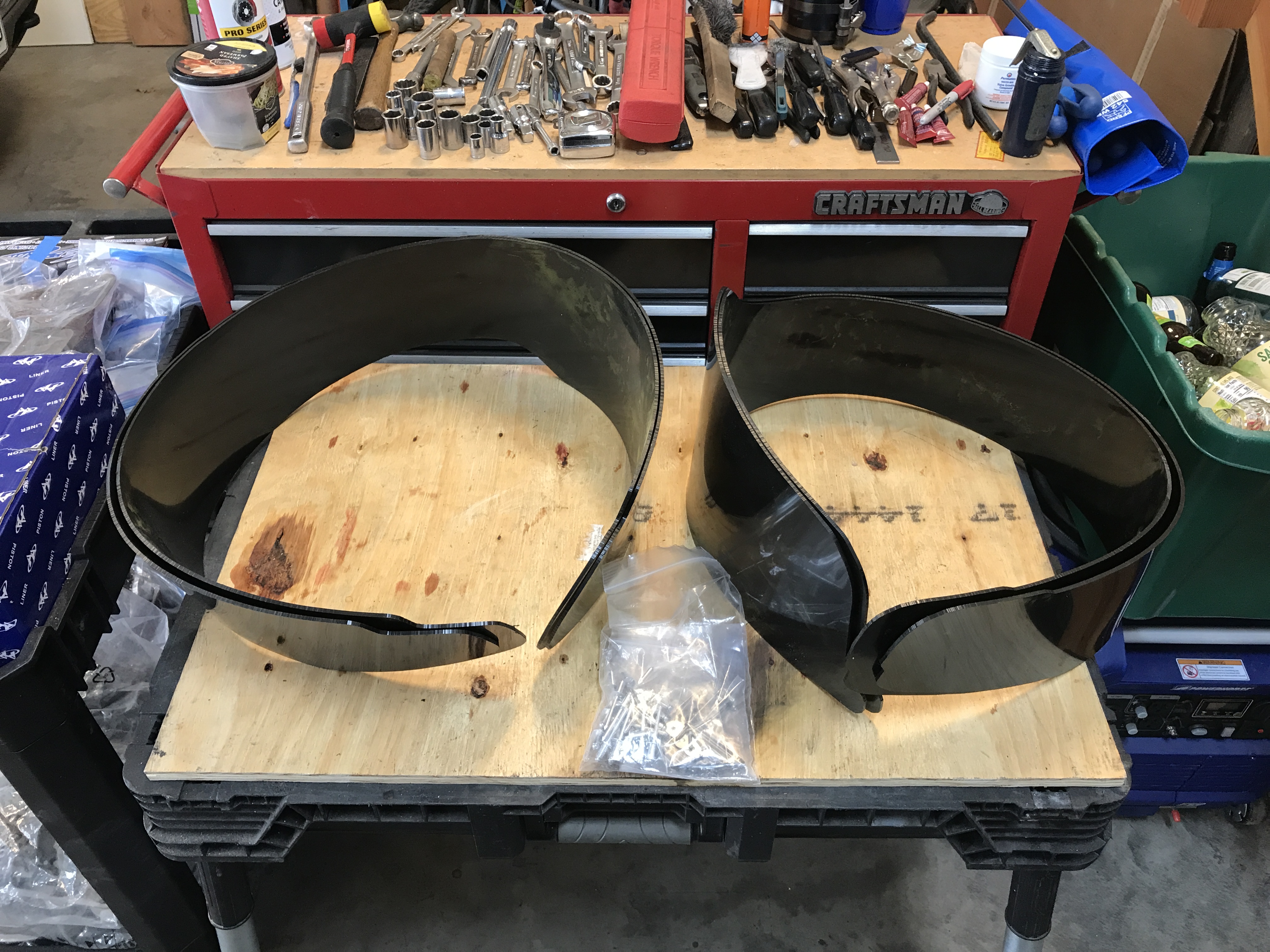

While I am waiting for stuff, I got out the fender liner kit from 914 Rubber.
bkrantz
post Jul 20 2021, 07:17 PM
Post #3382
Posts: 8,800
Joined: 3-August 19
From: SW Colorado

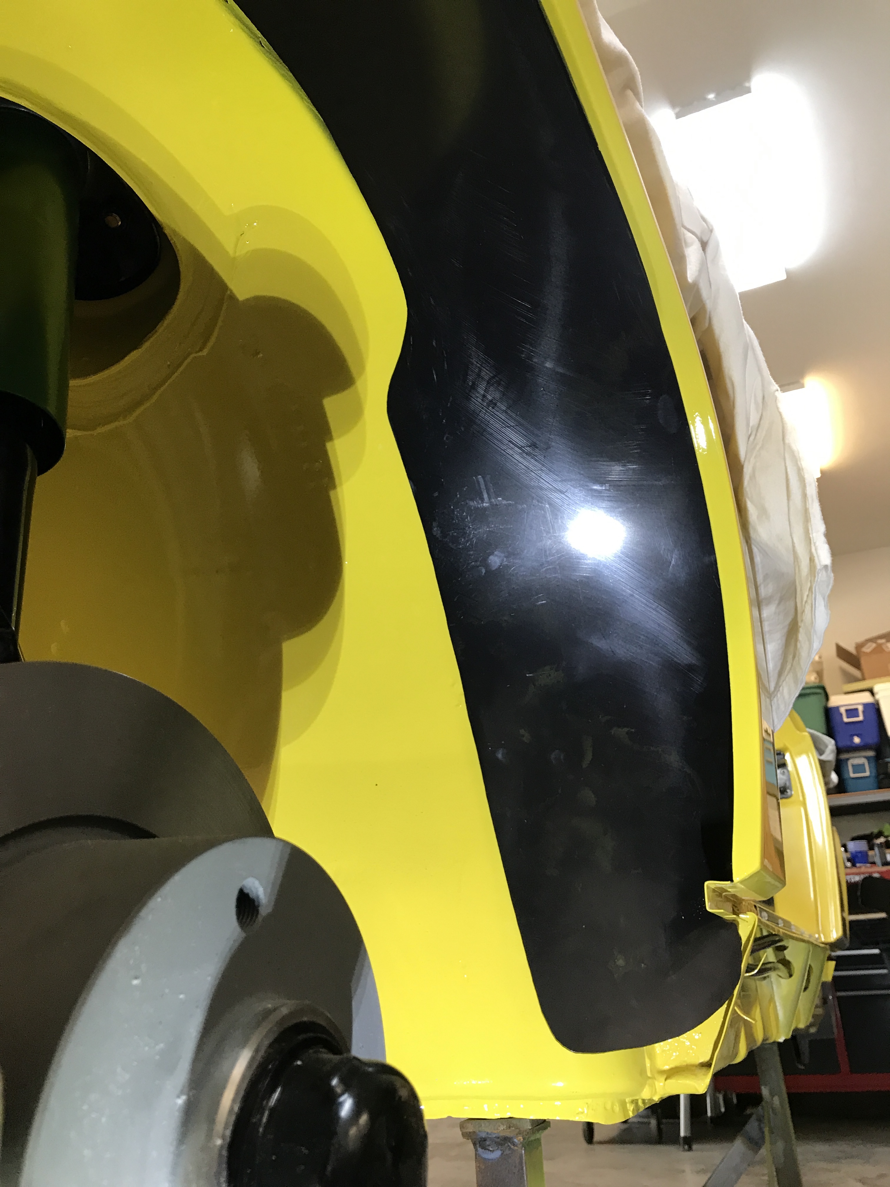

Member No.: 23,343
First trial fitting, in the front.
bkrantz
post Jul 20 2021, 07:18 PM
Post #3383
Posts: 8,800
Joined: 3-August 19
From: SW Colorado
Member No.: 23,343
And the rear.
I need to think about how to best attach these.

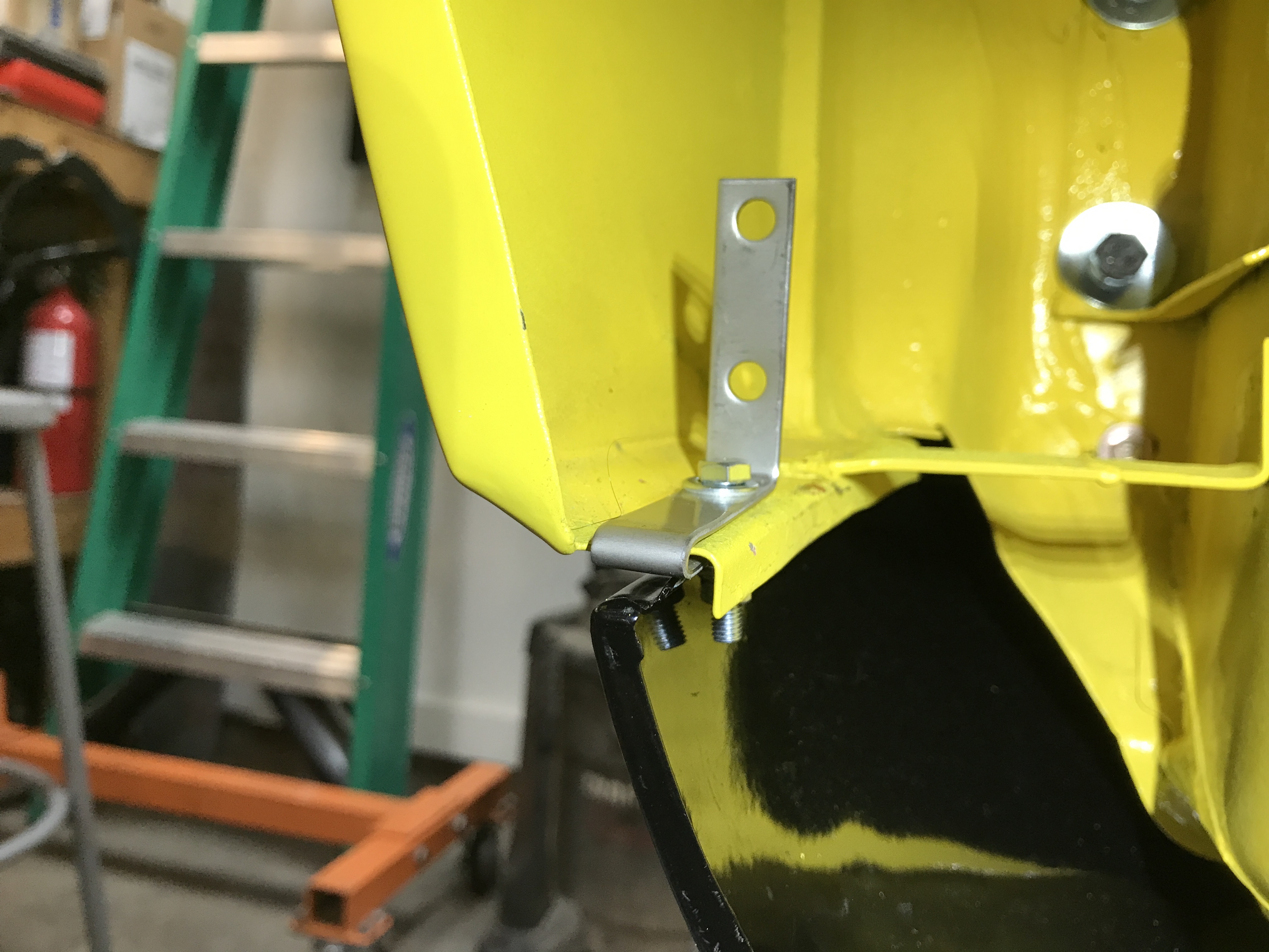

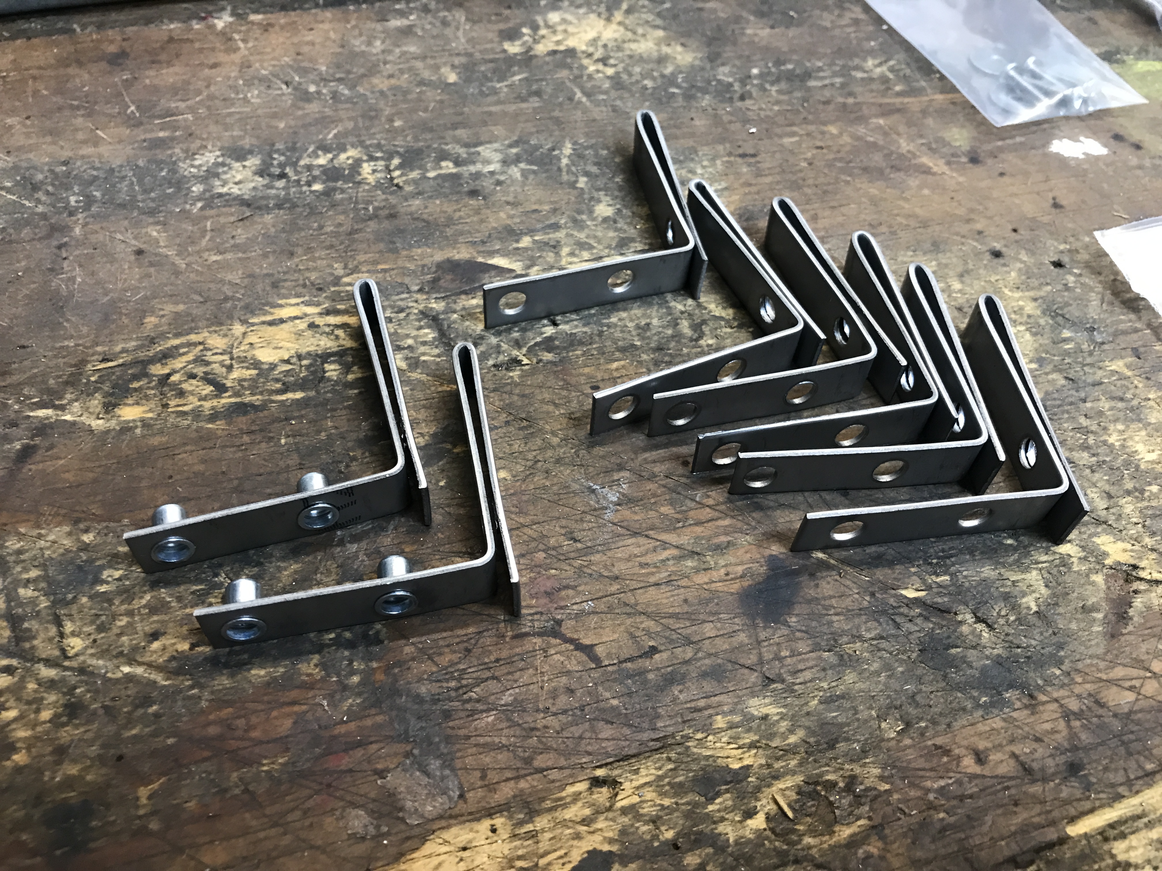

I decided to keep going with the fender liner installation. Here are the mounting clips from 914 Rubber, now in stainless.

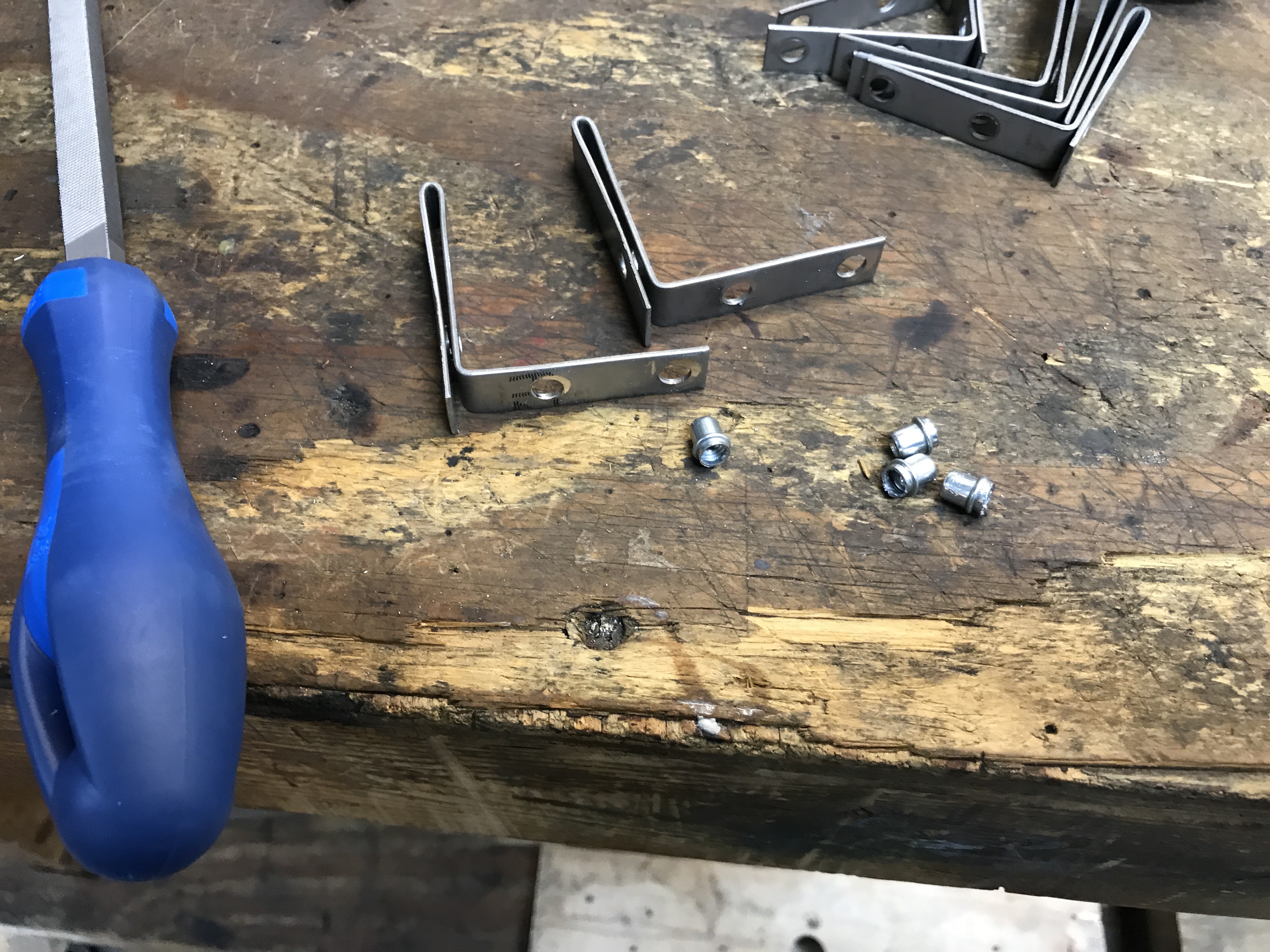

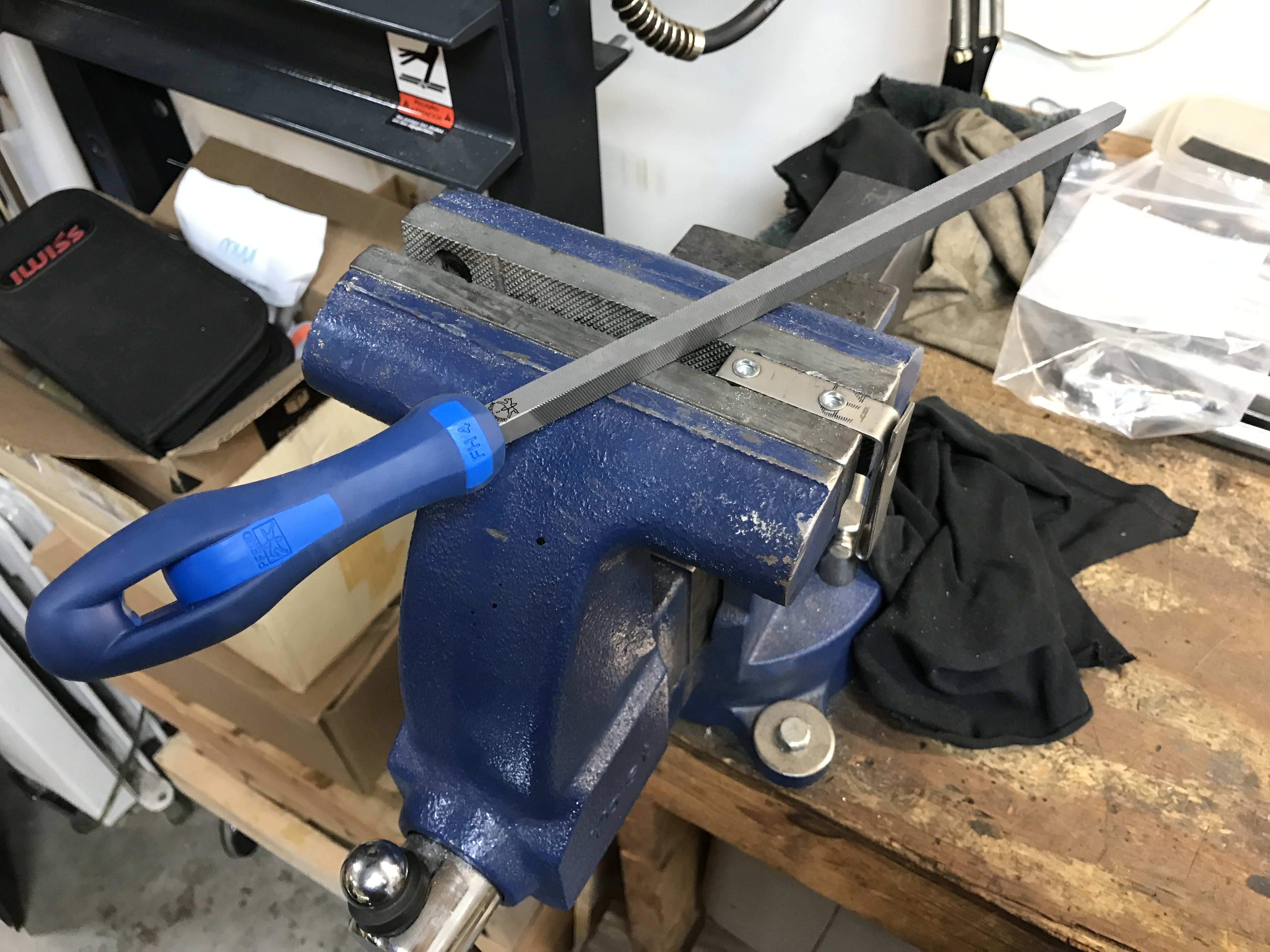

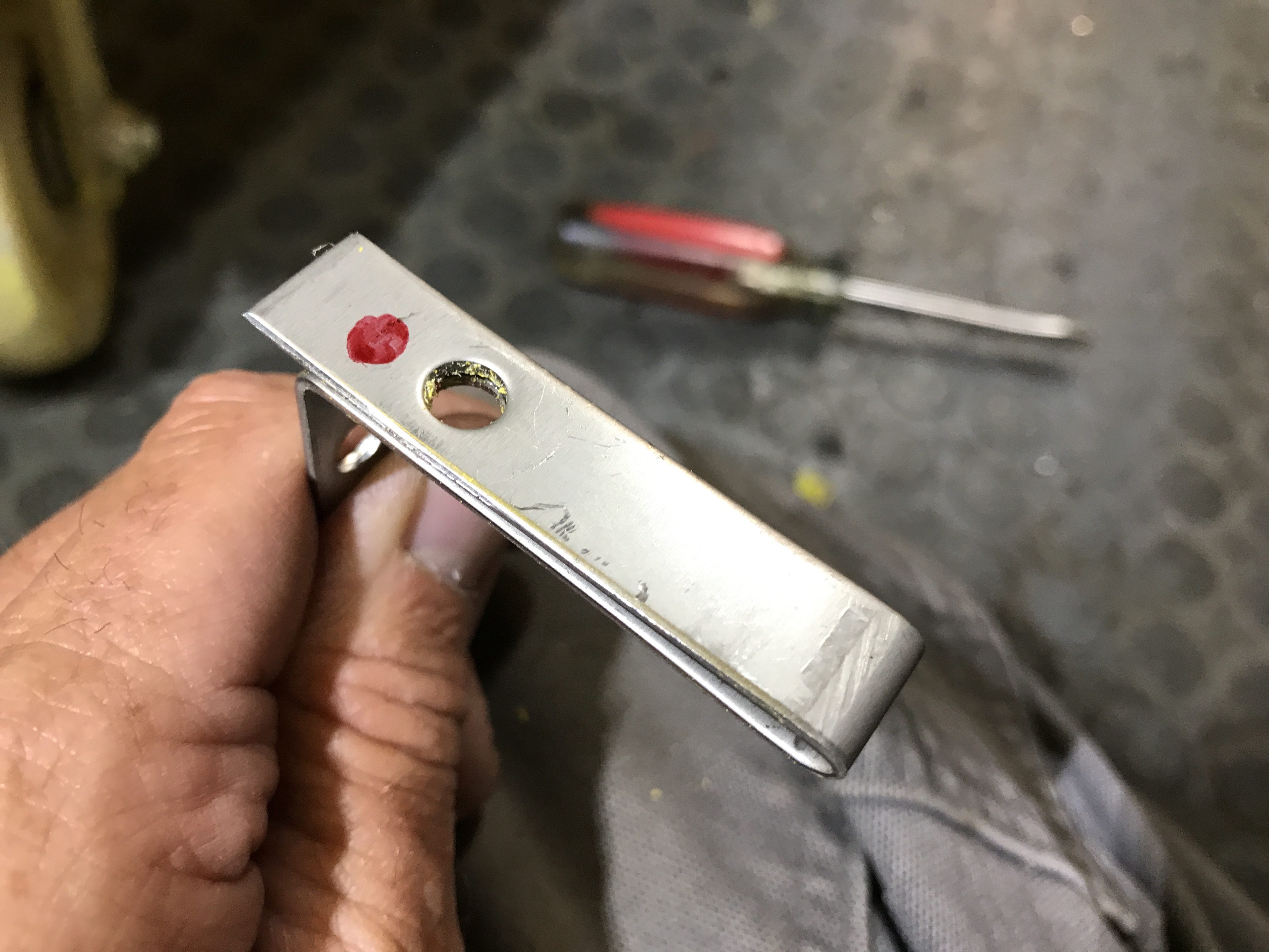

Most are designed for pop-rivets (included in the kit). I decided to use screws to attach the liners to the clips, the raynekat method. Two of the clips have riv-nuts attached, but my OCD wants them all the same, so I used a file to undo the rib-nuts. BTW, I treated myself to new files for the first time in at least 30 years--wow!
bkrantz
post Jul 21 2021, 06:29 PM
Post #3388
Posts: 8,800
Joined: 3-August 19
From: SW Colorado
Member No.: 23,343
Now all the clips match! (IMG:style_emoticons/default/biggrin.gif)

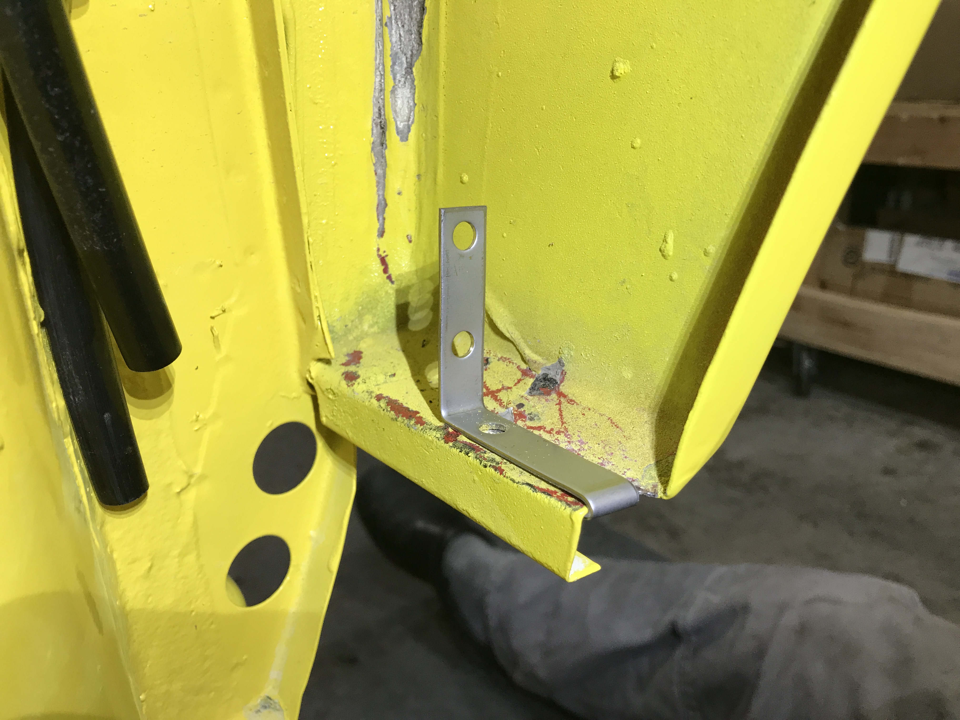

On the leading edge, the clips fit over the fender flange deep enough for the holes to line up.
bkrantz
post Jul 21 2021, 06:33 PM
Post #3390
Posts: 8,800
Joined: 3-August 19
From: SW Colorado
Member No.: 23,343

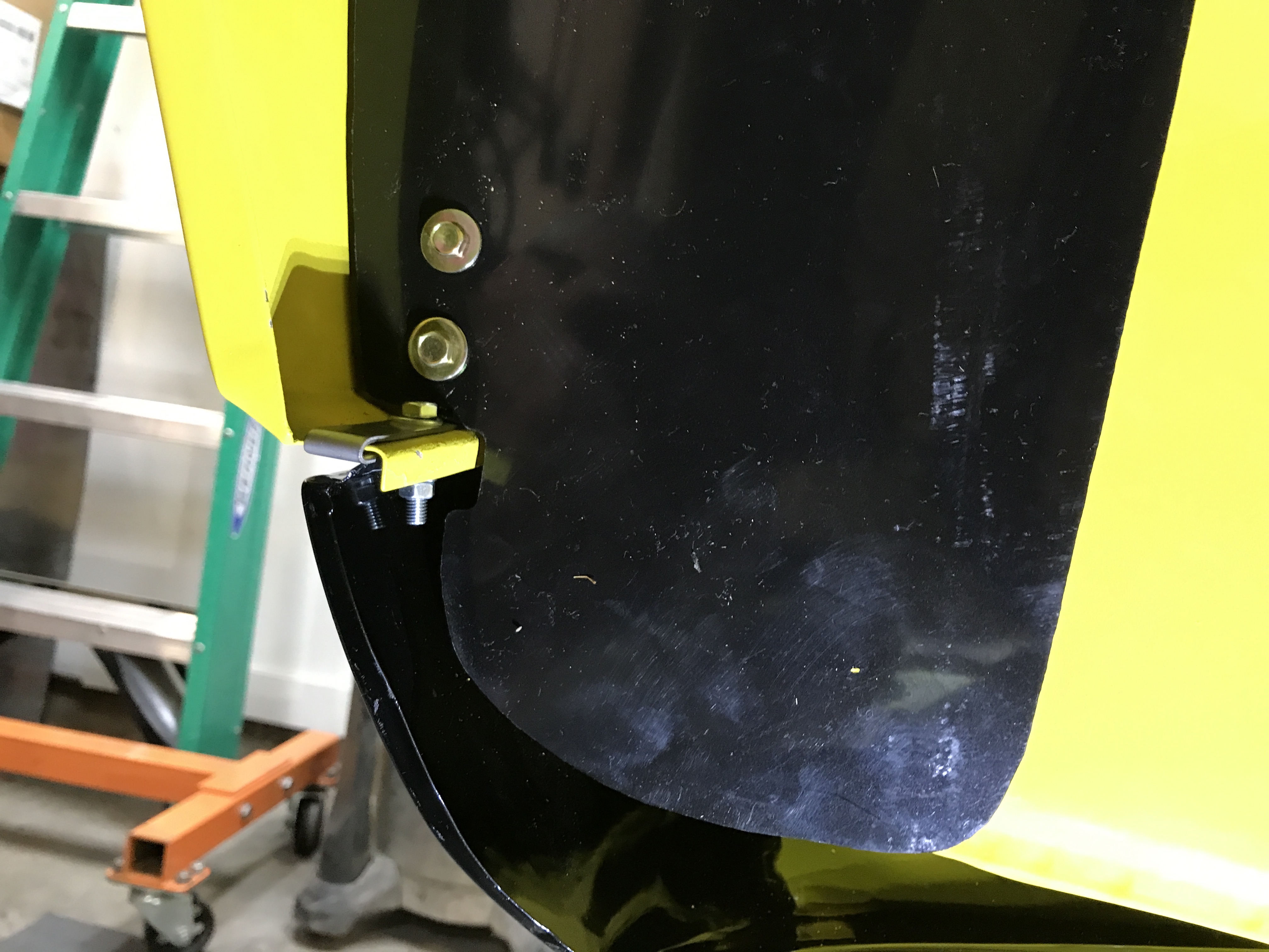

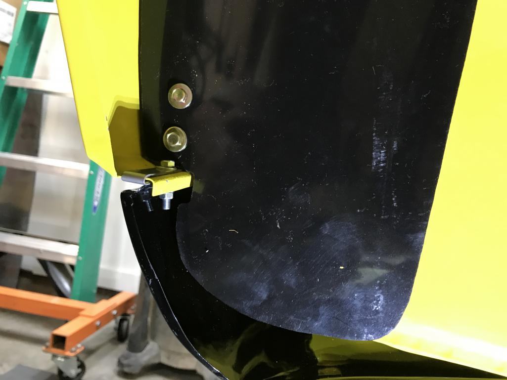

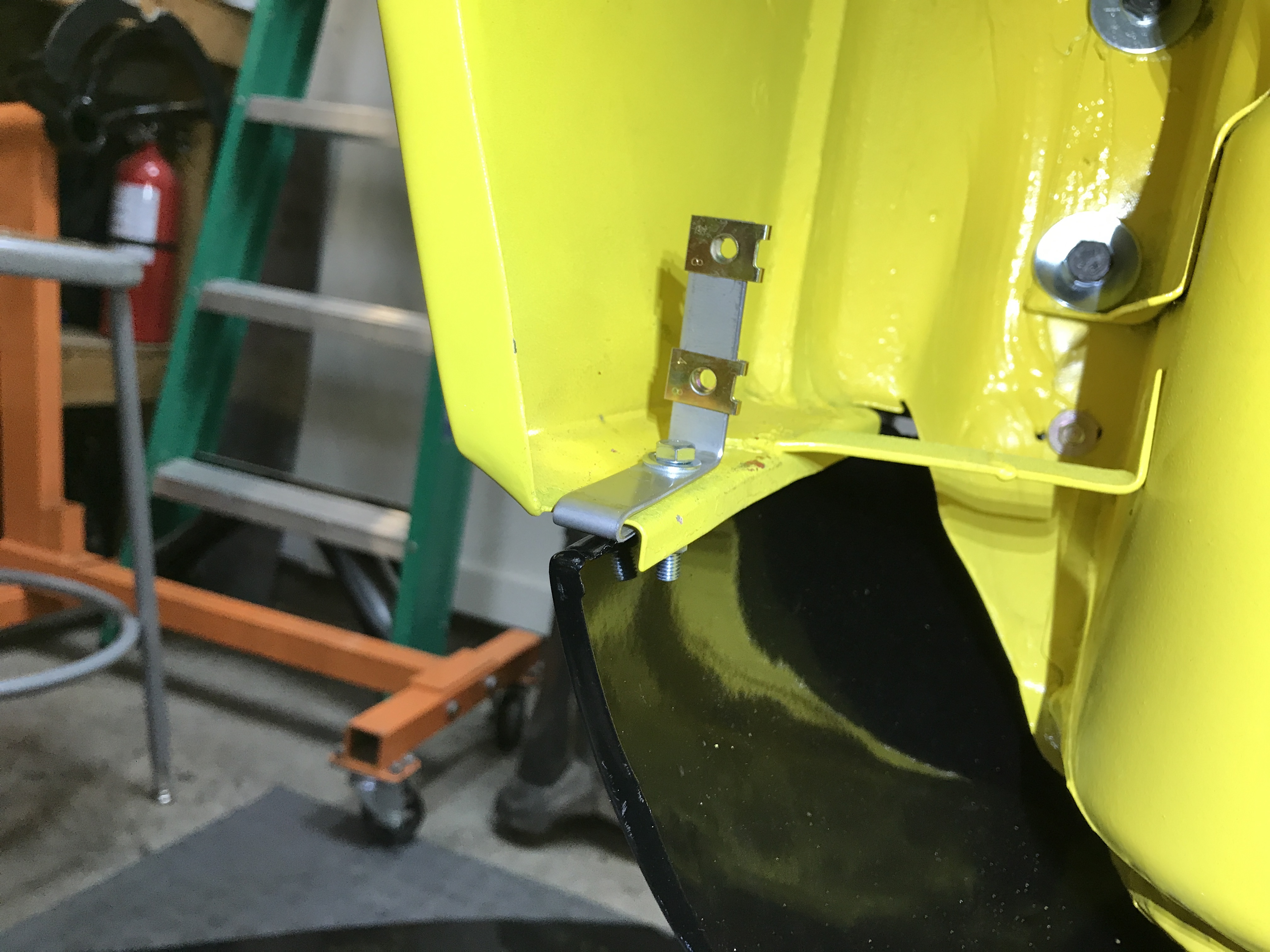

On the trailing side, the clip base is not deep enough to reach the hole.
bkrantz
post Jul 21 2021, 06:35 PM
Post #3391
Posts: 8,800
Joined: 3-August 19
From: SW Colorado
Member No.: 23,343

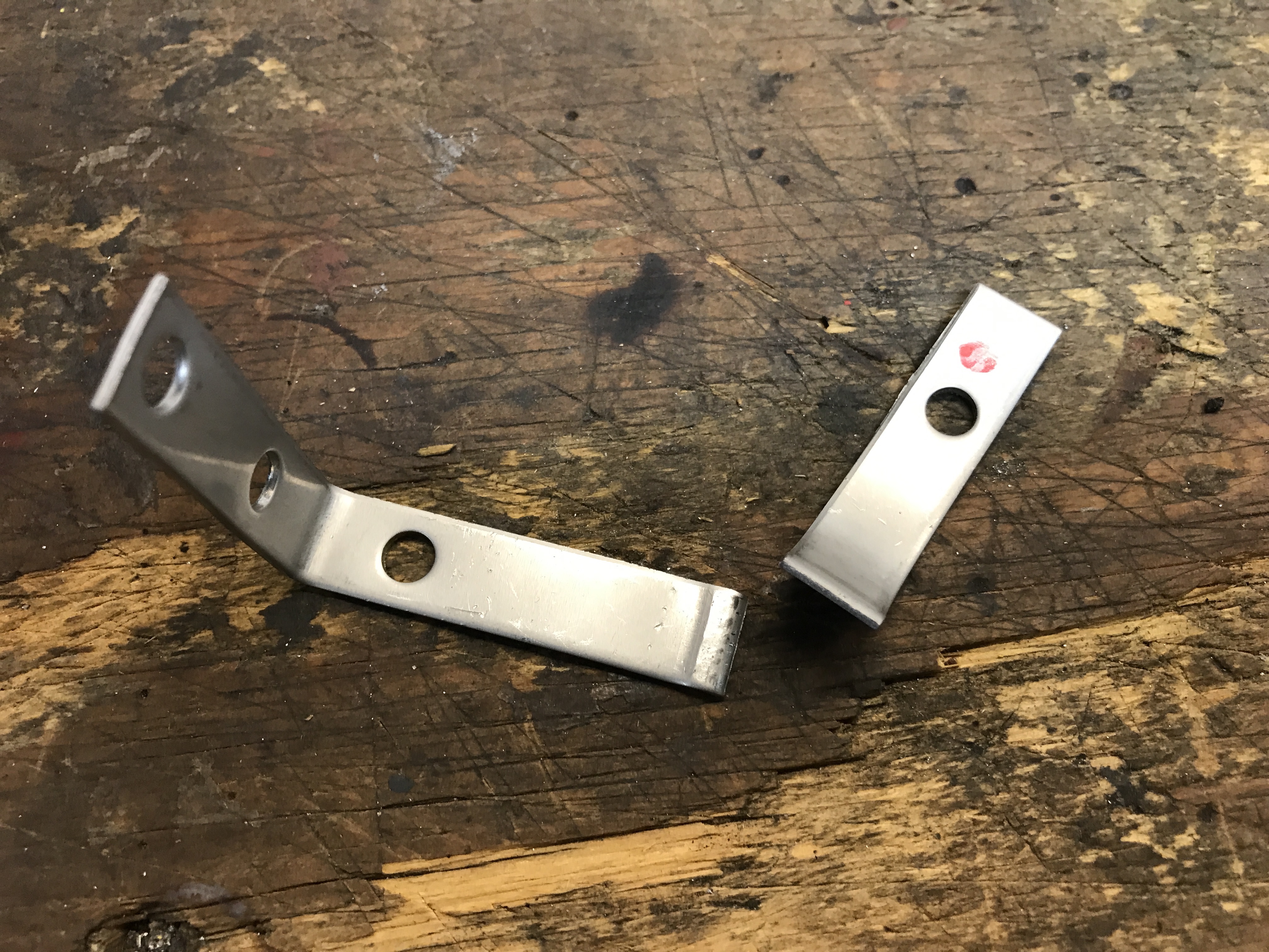

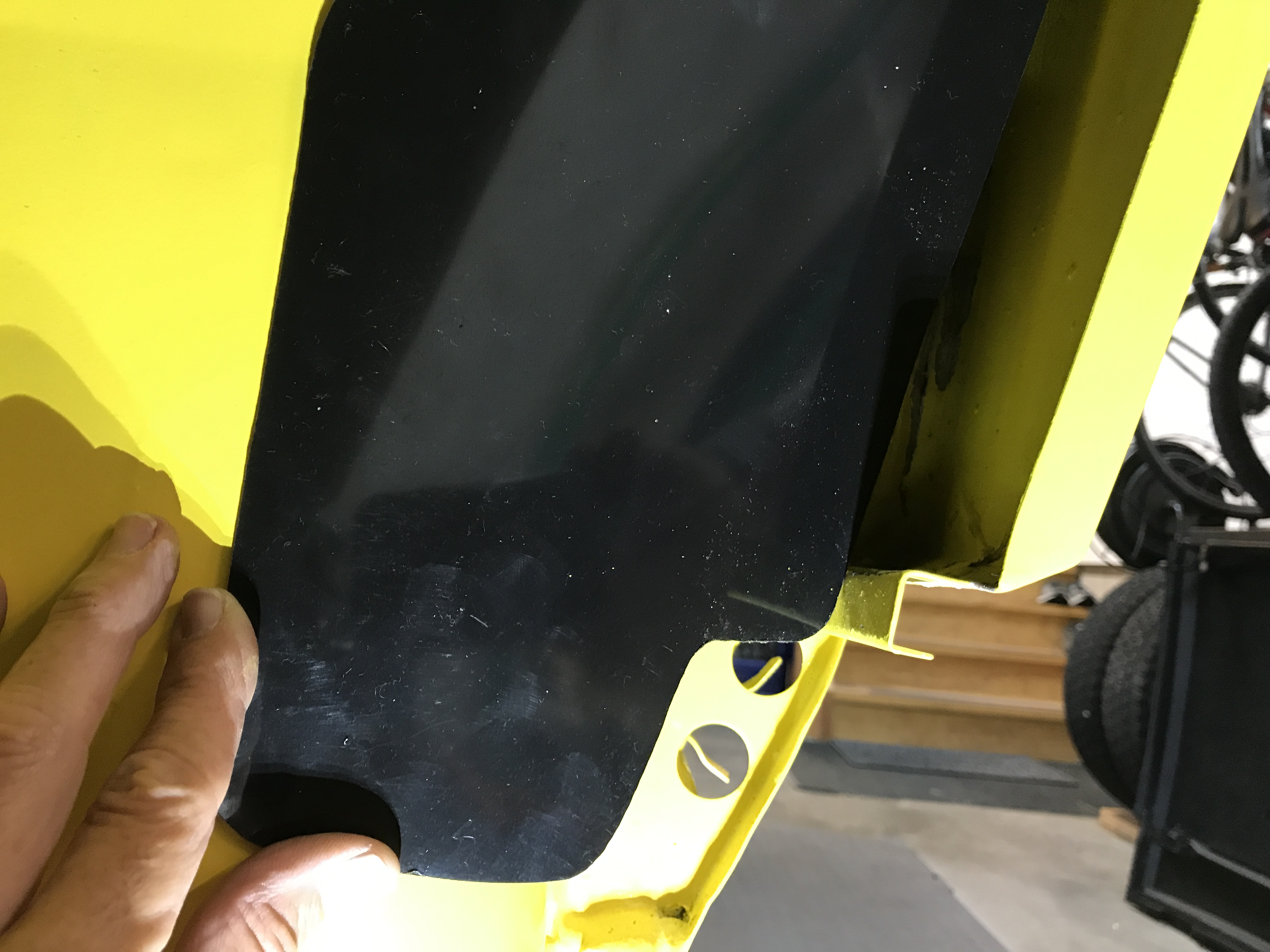

This is how far off the hole position is.
bkrantz
post Jul 21 2021, 06:36 PM
Post #3392
Posts: 8,800
Joined: 3-August 19
From: SW Colorado
Member No.: 23,343
I tried unfolding the clip, but the stainless stock was too brittle.
bkrantz

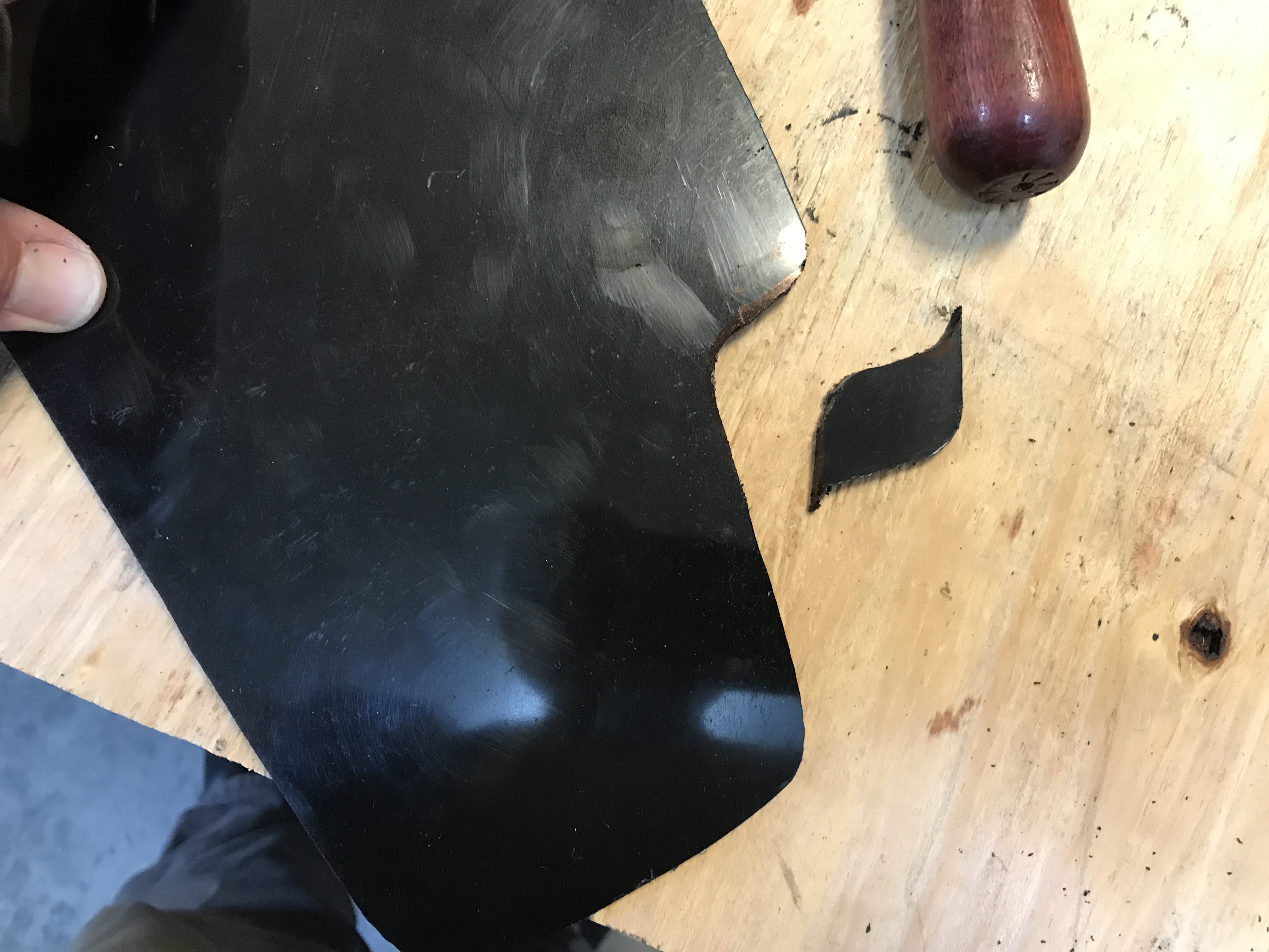

With the liner seated evenly, the length seems too long, by about 3/4". When I forced the flu length in, the liner does not sit tightly against the inside of the fender.
bkrantz
post Jul 21 2021, 06:42 PM
Post #3394
Posts: 8,800
Joined: 3-August 19
From: SW Colorado
Member No.: 23,343
I trimmed the liner with a jig saw.
bkrantz

I fitted the liner again, marked and drilled the holes, and then screwed the liner to the clips.

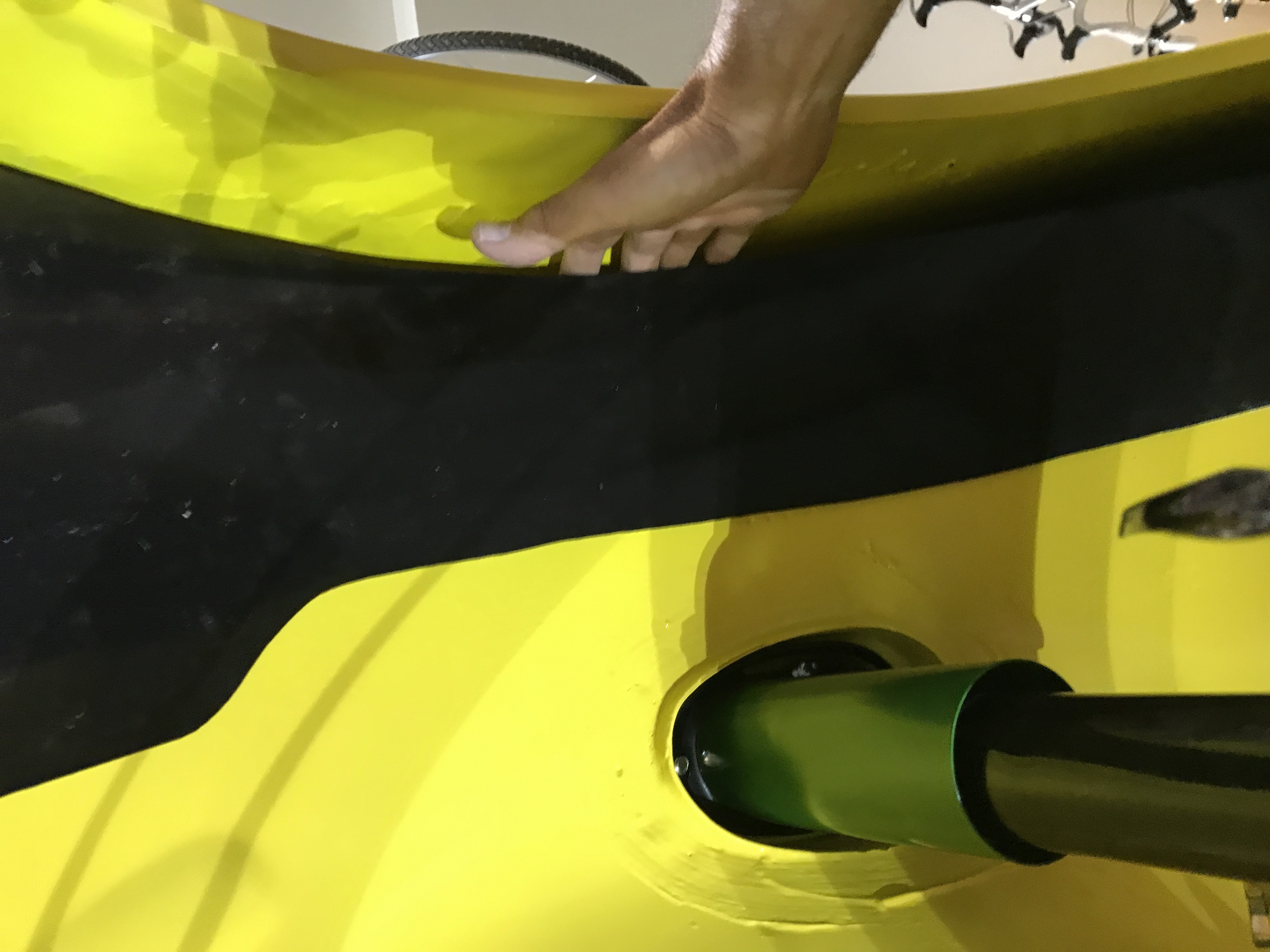

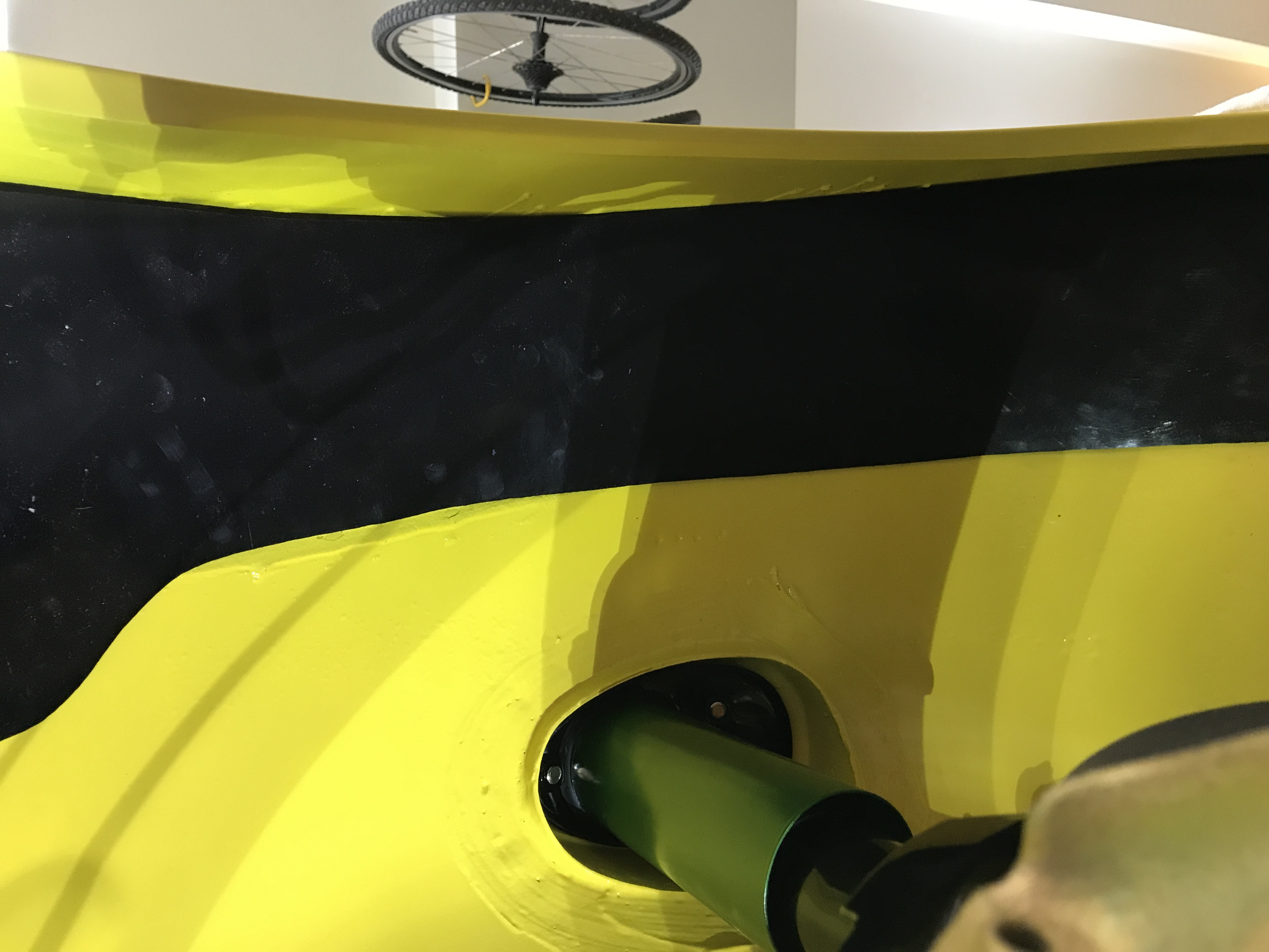

One problem: when unmolested, the liner sits snug against the outer fender.
bkrantz
post Jul 21 2021, 06:50 PM
Post #3398
Posts: 8,800
Joined: 3-August 19
From: SW Colorado
Member No.: 23,343
But the liner is free to shift about an inch to the inside.
bkrantz

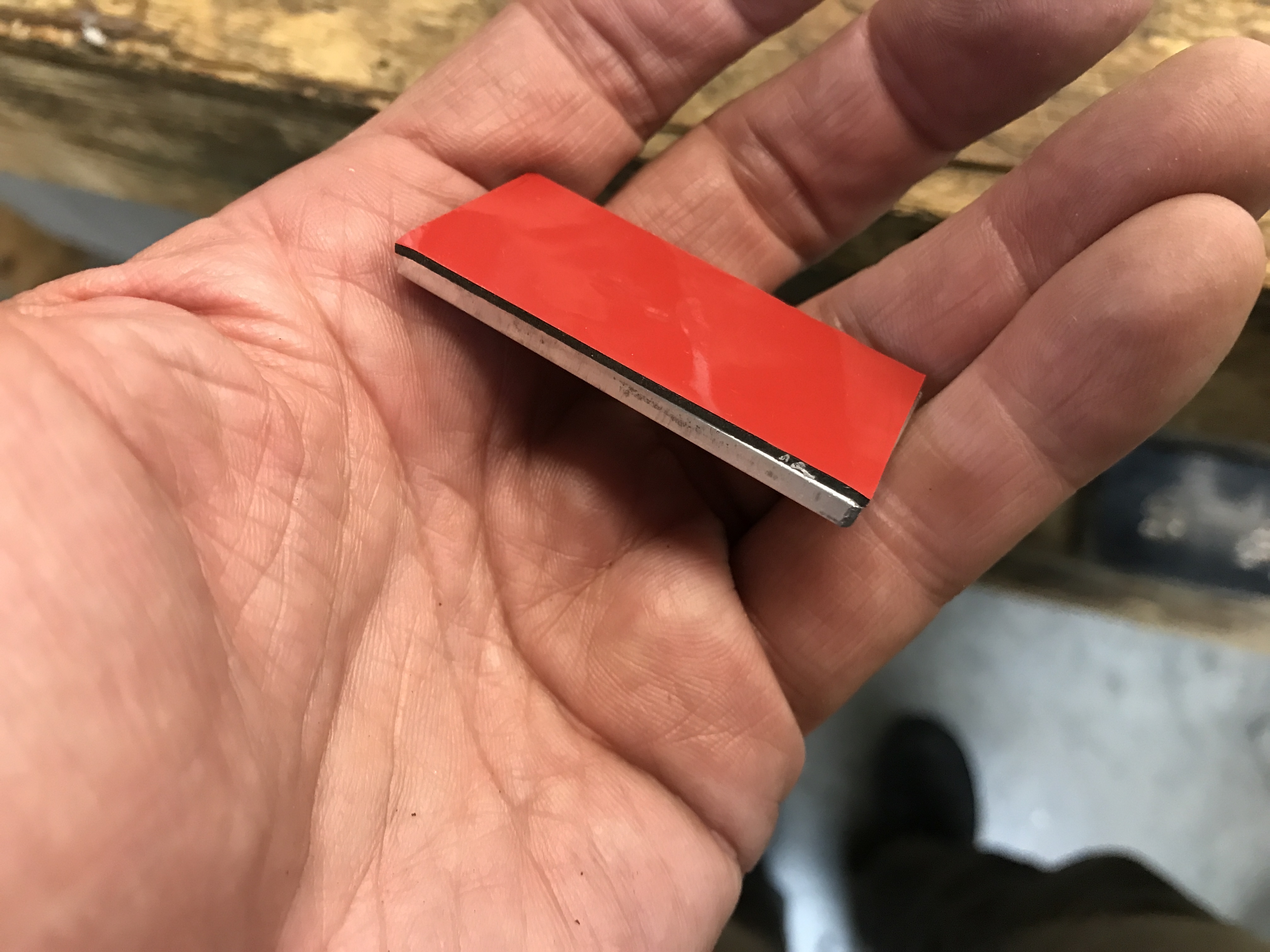

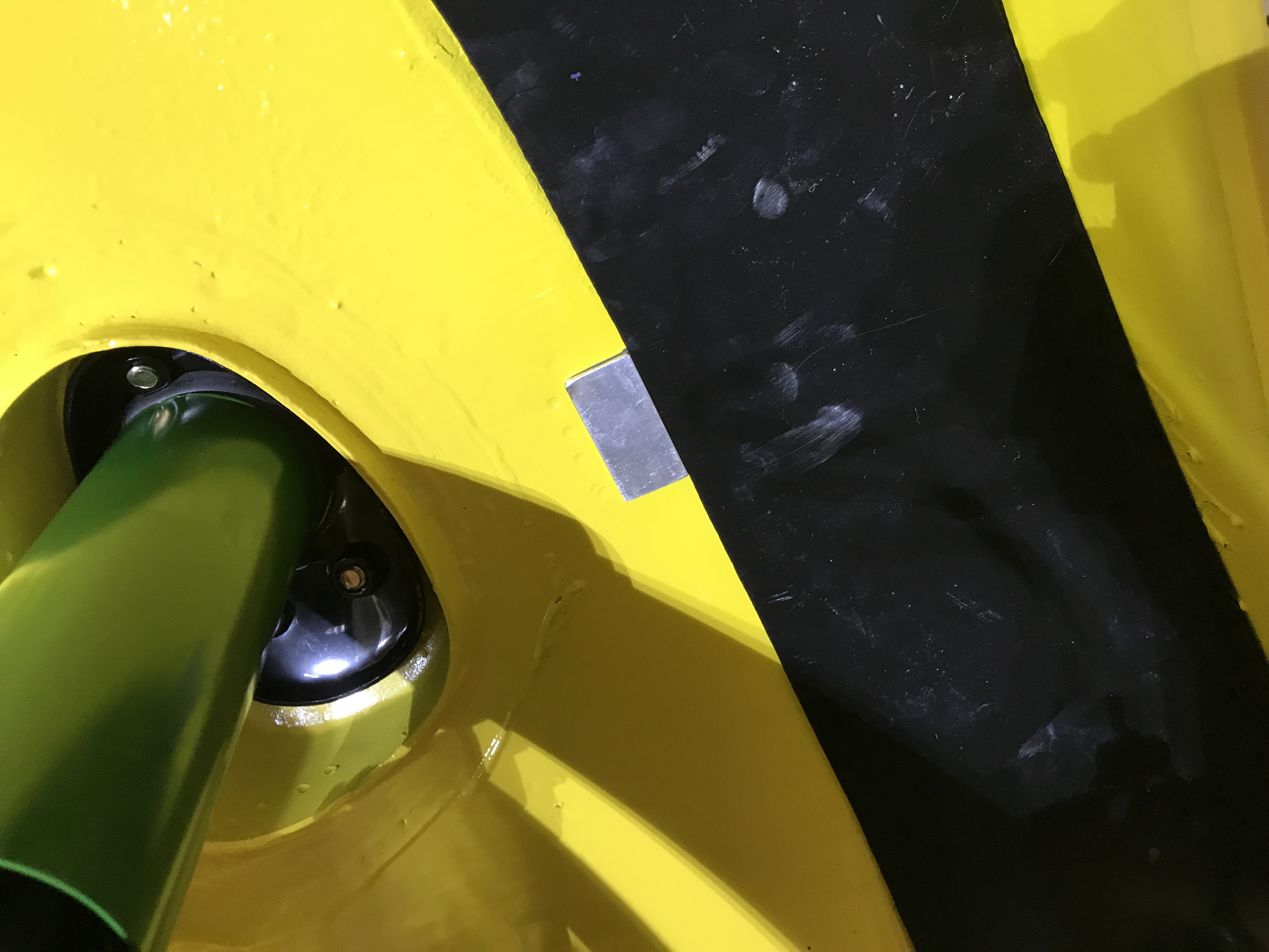

Rather than drill holes in the inner fender wall I decided to make a small block from aluminum stock and 3M adhesive tape.
bkrantz
post Jul 21 2021, 06:52 PM
Post #3400
Posts: 8,800
Joined: 3-August 19
From: SW Colorado
Member No.: 23,343
That should be enough to keep the liner from shifting inward.
