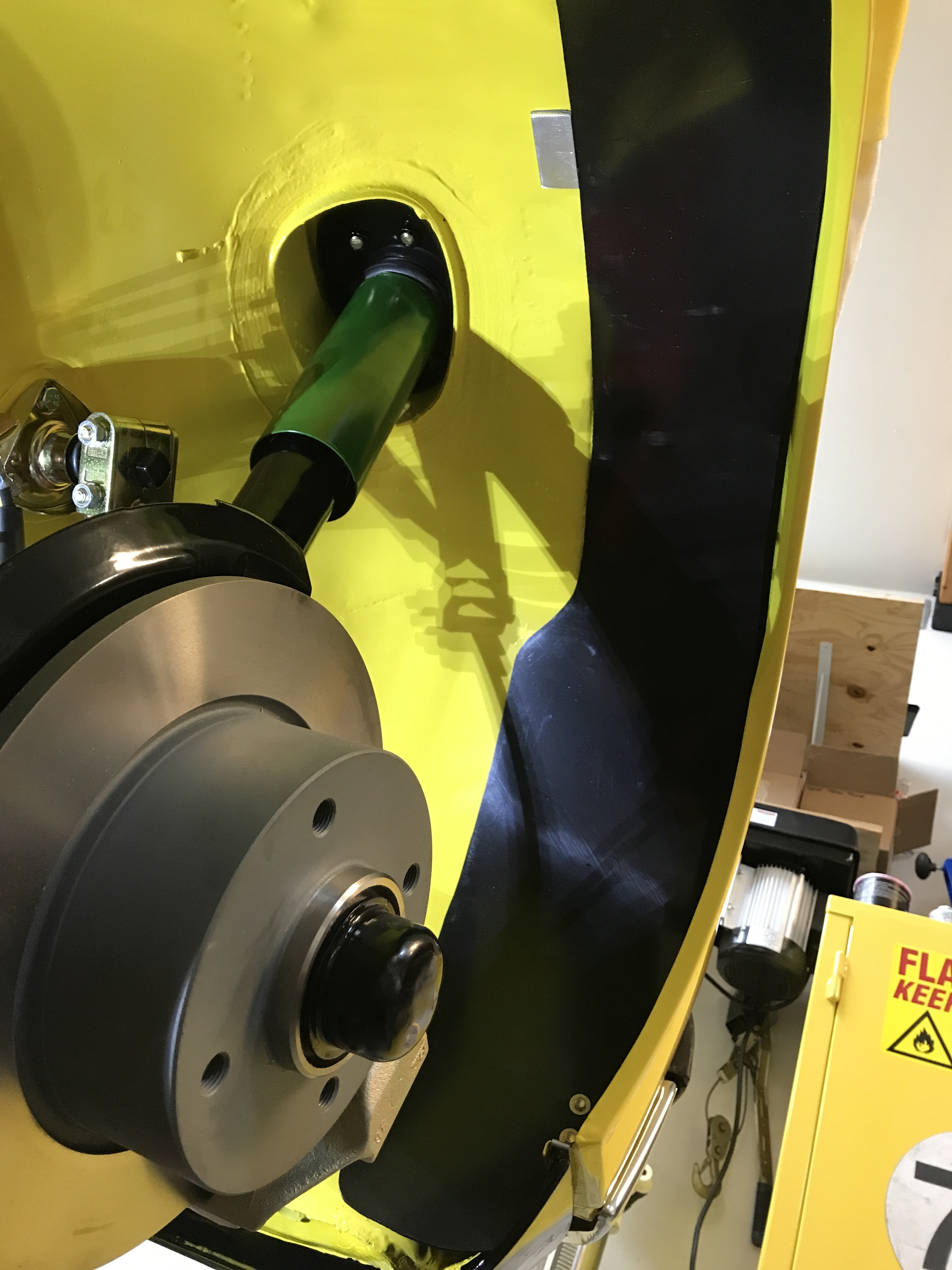

QUOTE(bkrantz @ Jul 21 2021, 05:42 PM) *
I trimmed the liner with a jig saw.
Did the same in a number of places for a "better" fit. (IMG:style_emoticons/default/wink.gif)

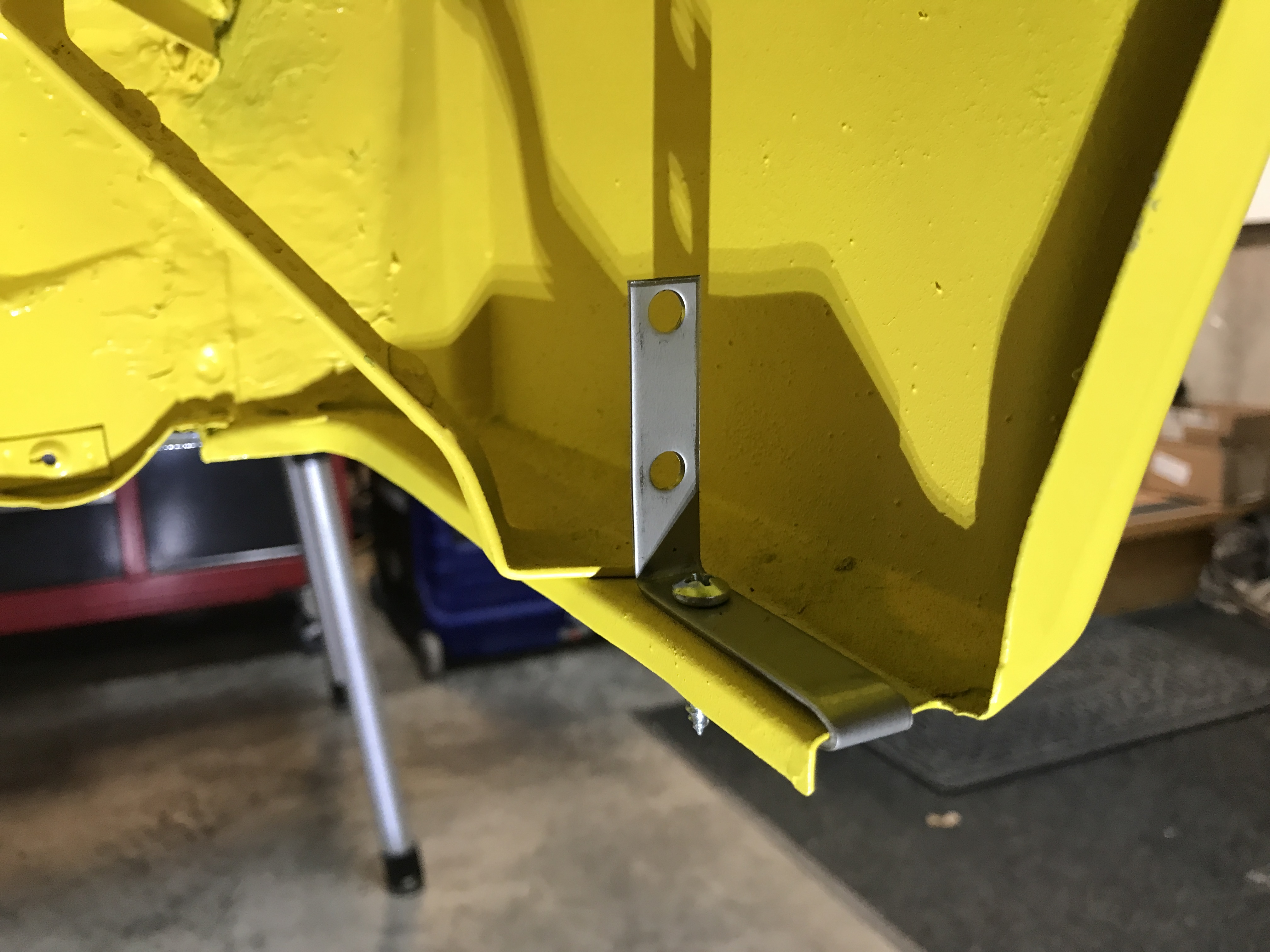

QUOTE(bkrantz @ Jul 21 2021, 05:52 PM) *
That should be enough to keep the liner from shifting inward.
Great idea!

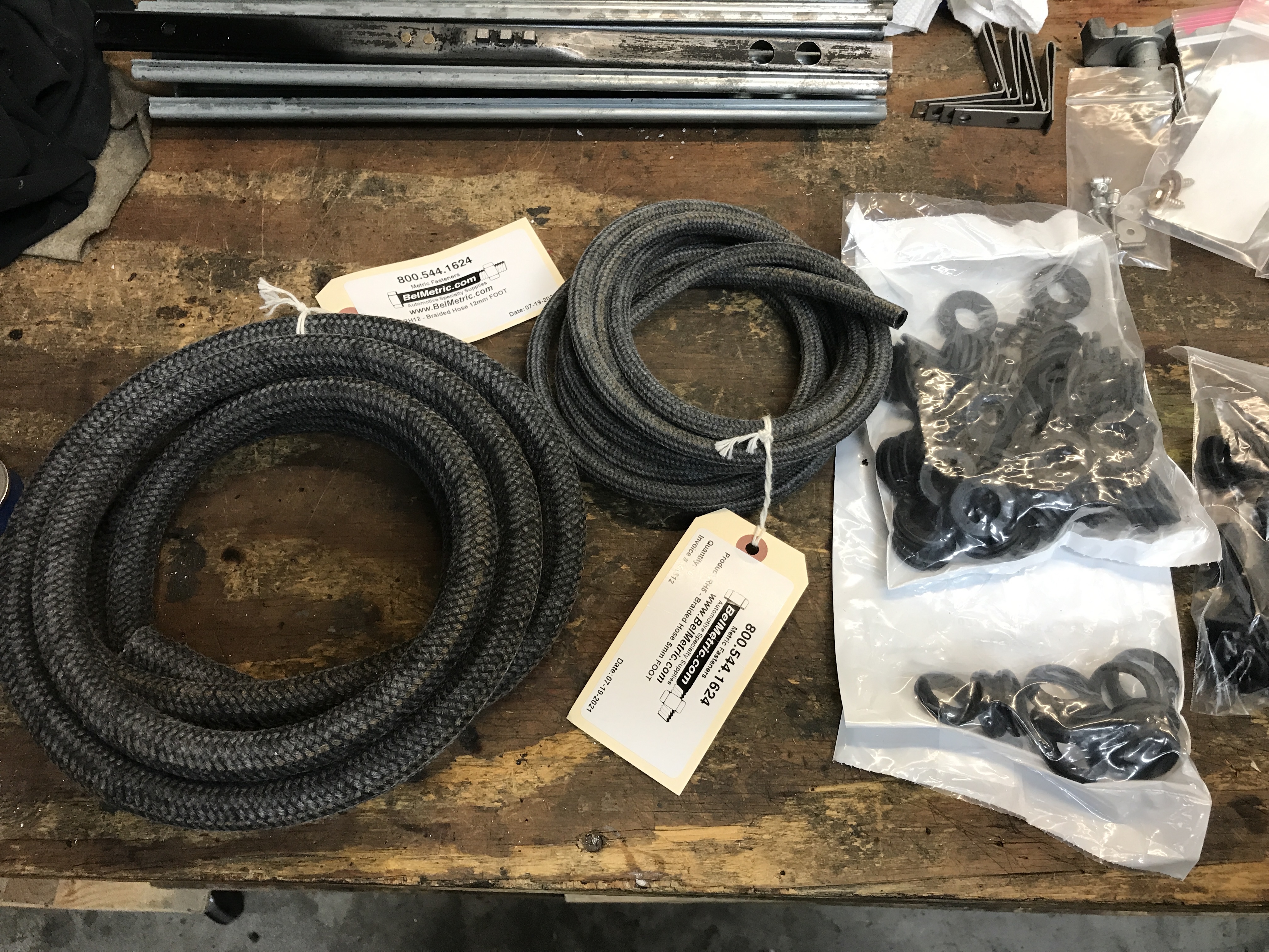

New hose and grommet stock!
bkrantz
post Jul 22 2021, 07:16 PM
Post #3406
Posts: 8,800
Joined: 3-August 19
From: SW Colorado
Member No.: 23,343

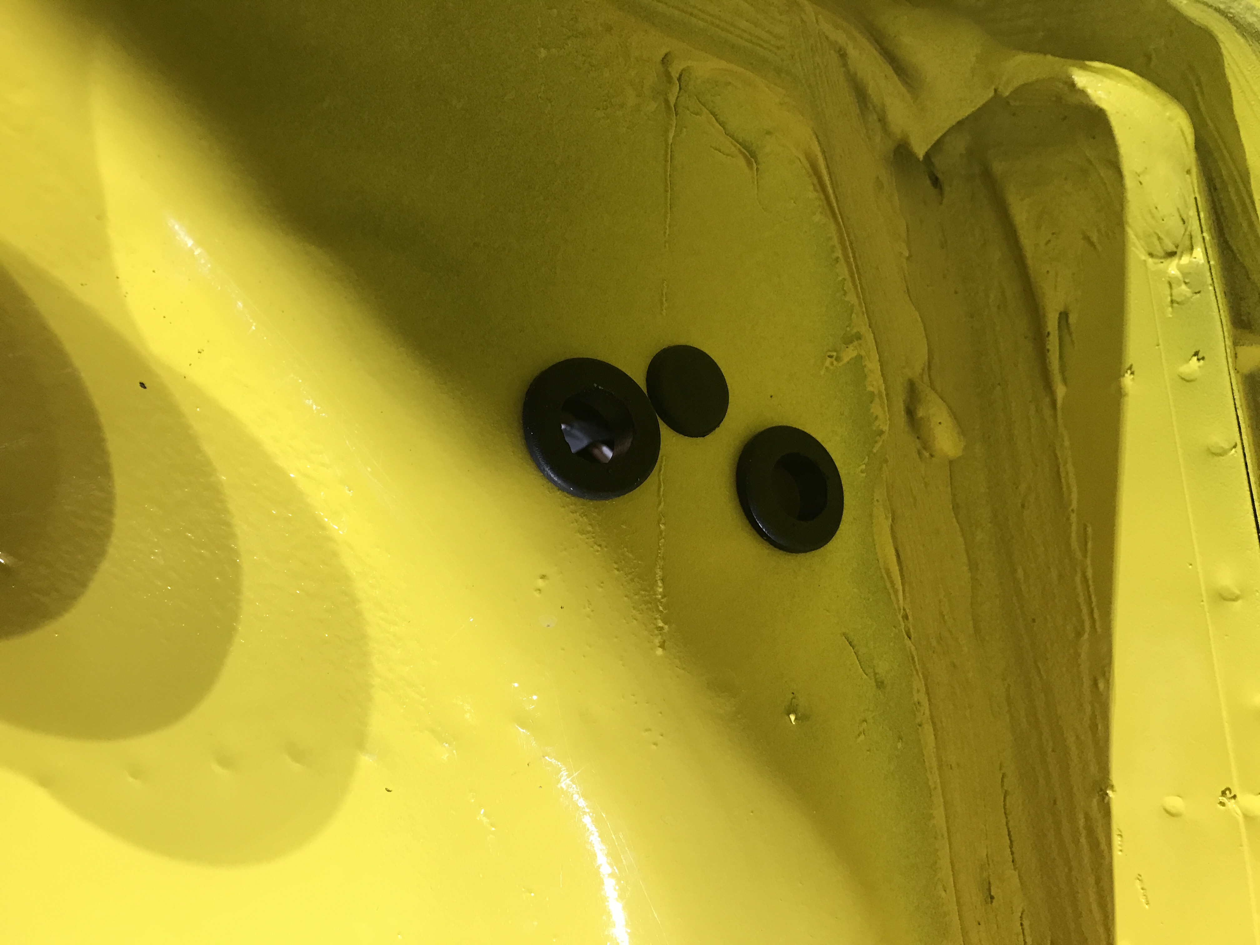

Grommets are for the same hole size (20-22 mm) but with inner diameters for the plastic tubing or the braided hose.

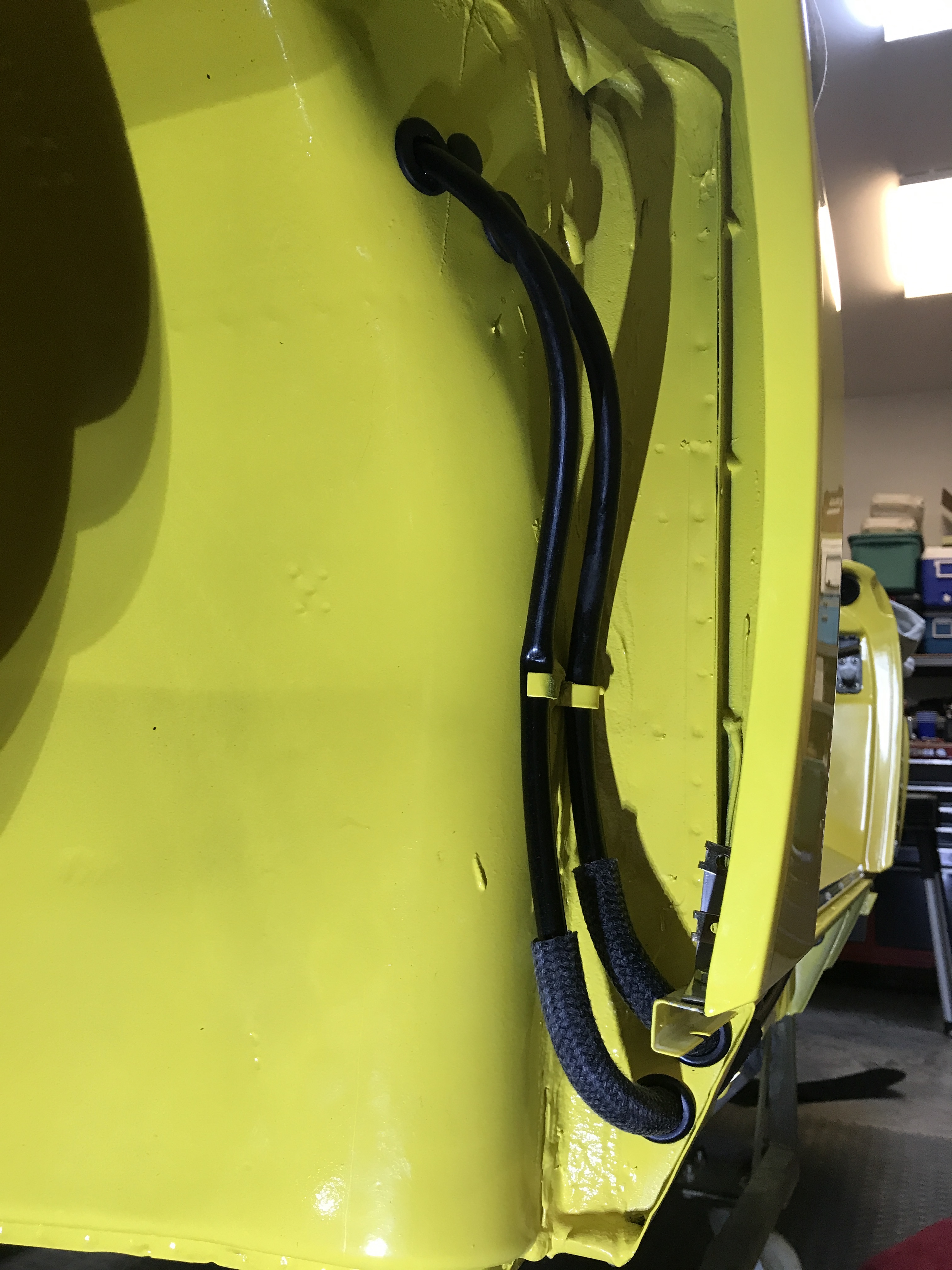

Plumbing done in fender well.

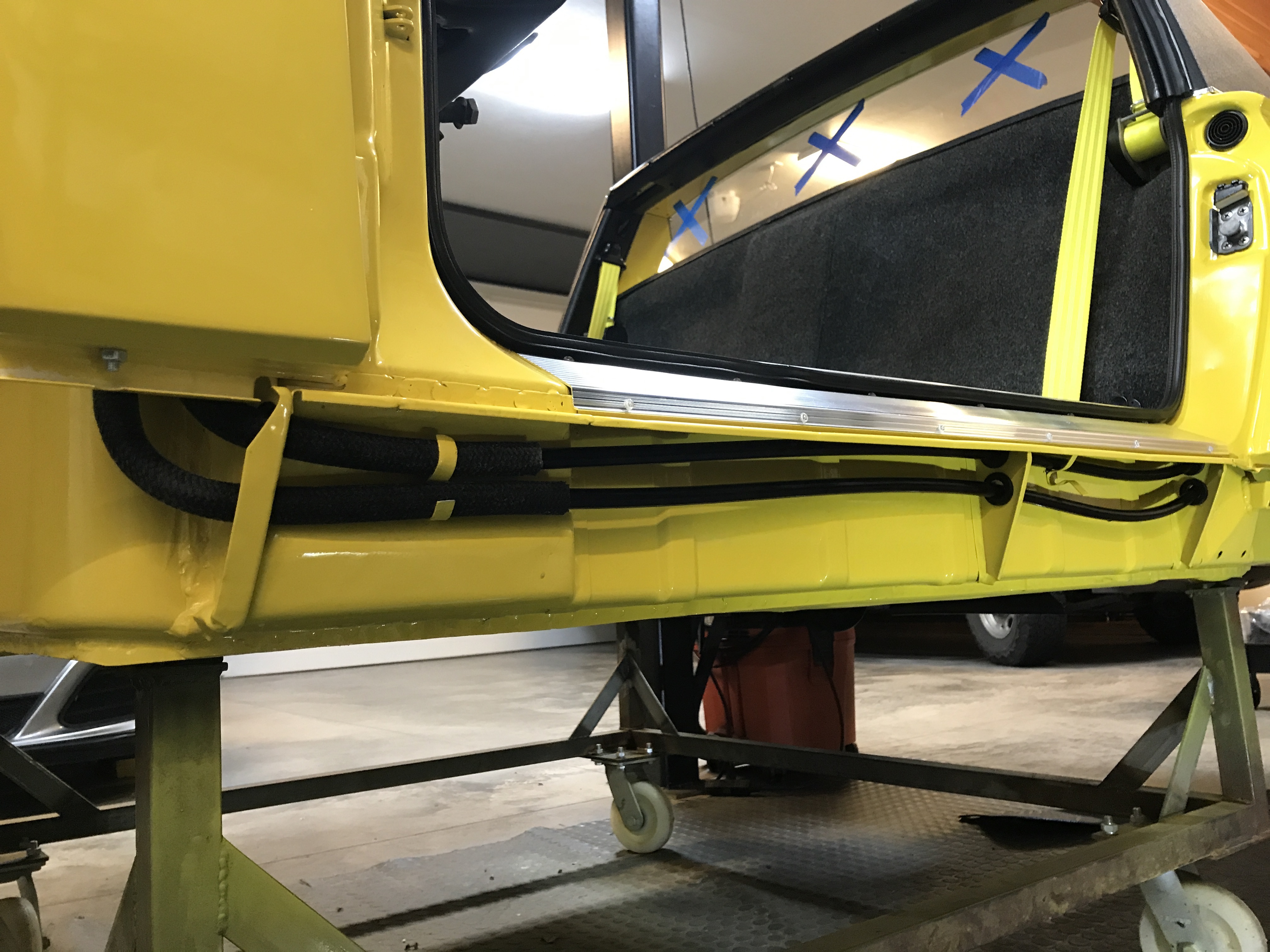

And along the rocker.

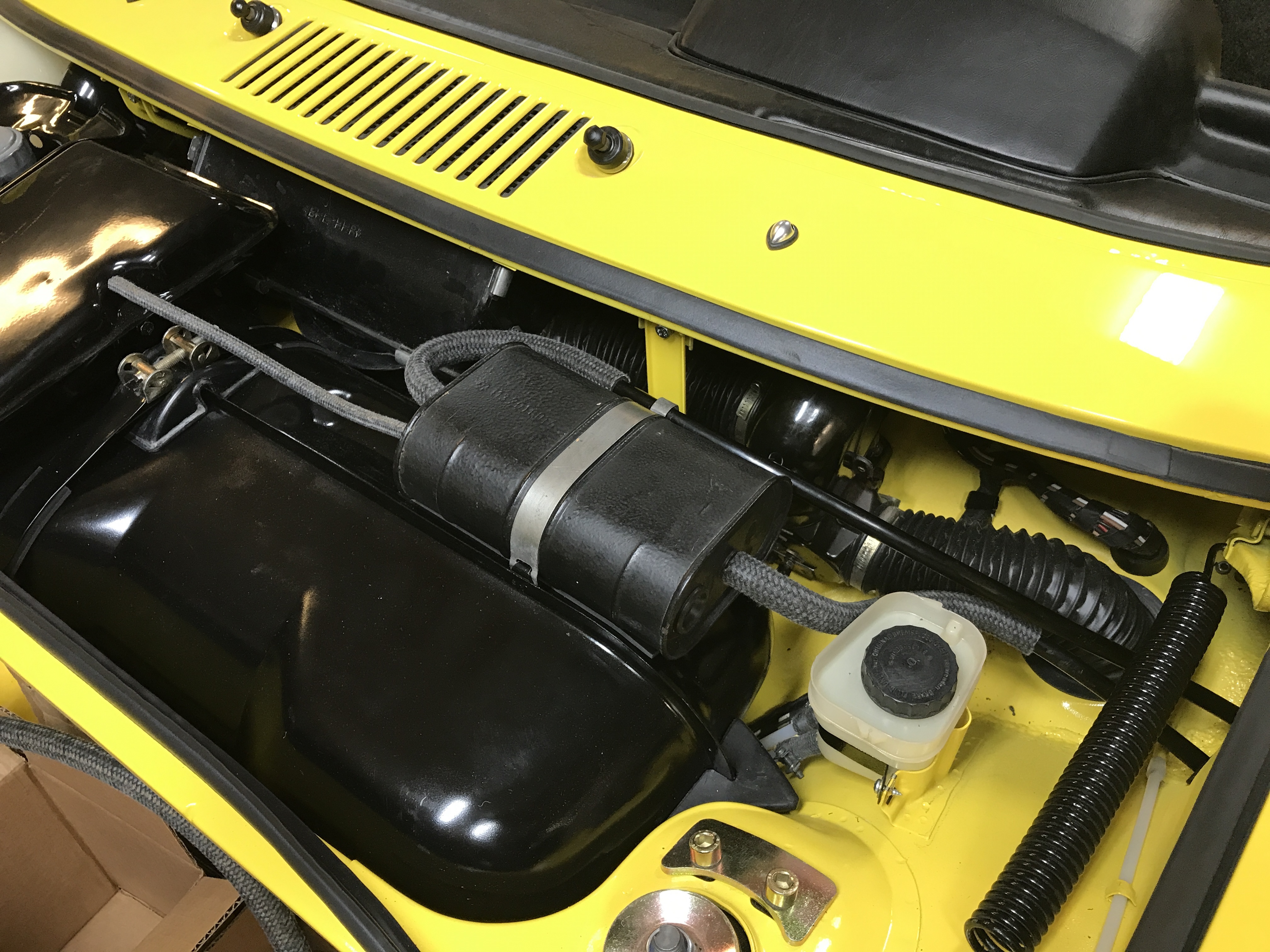

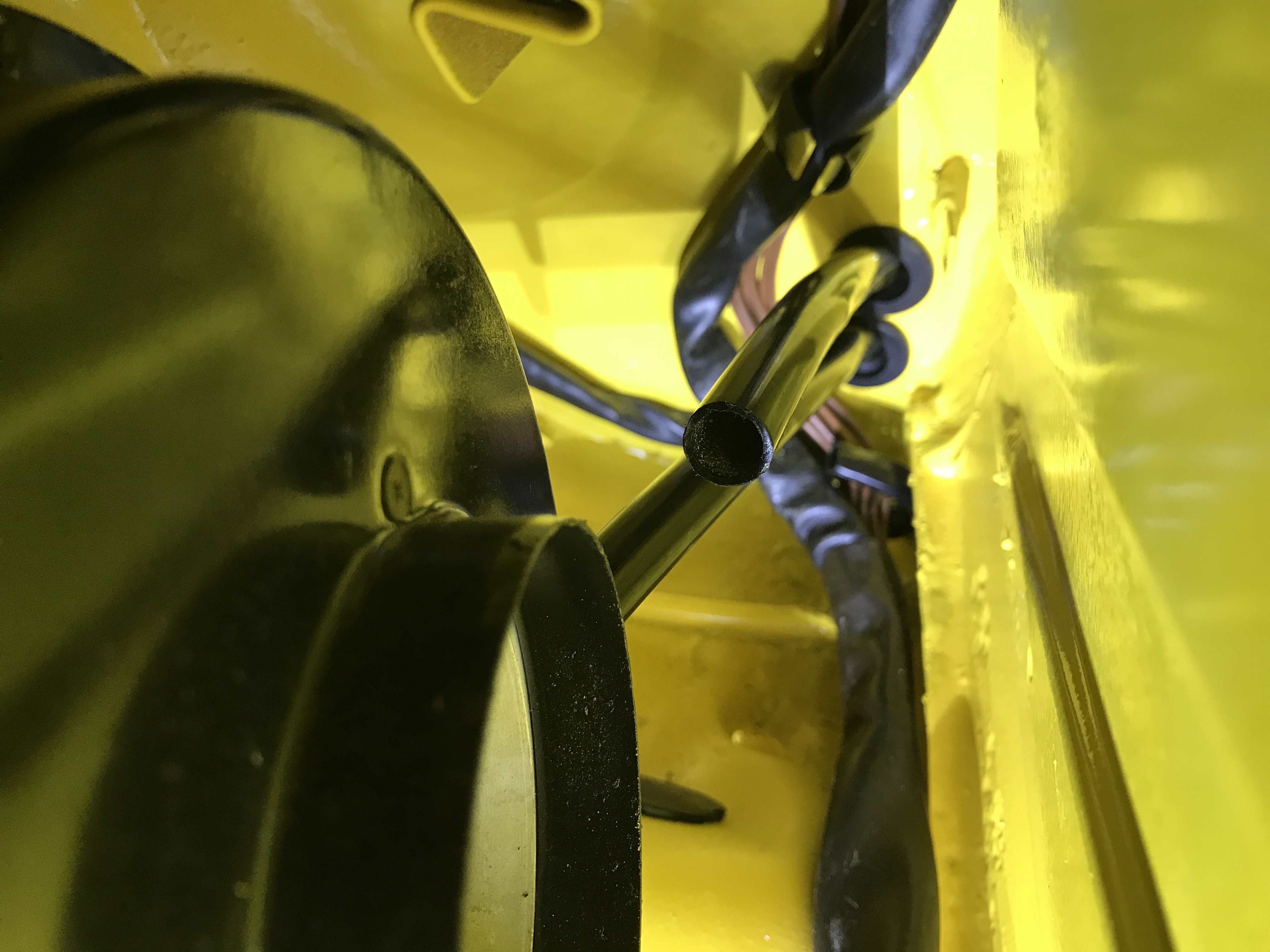

Into the engine compartment.

And by the fuel tank.

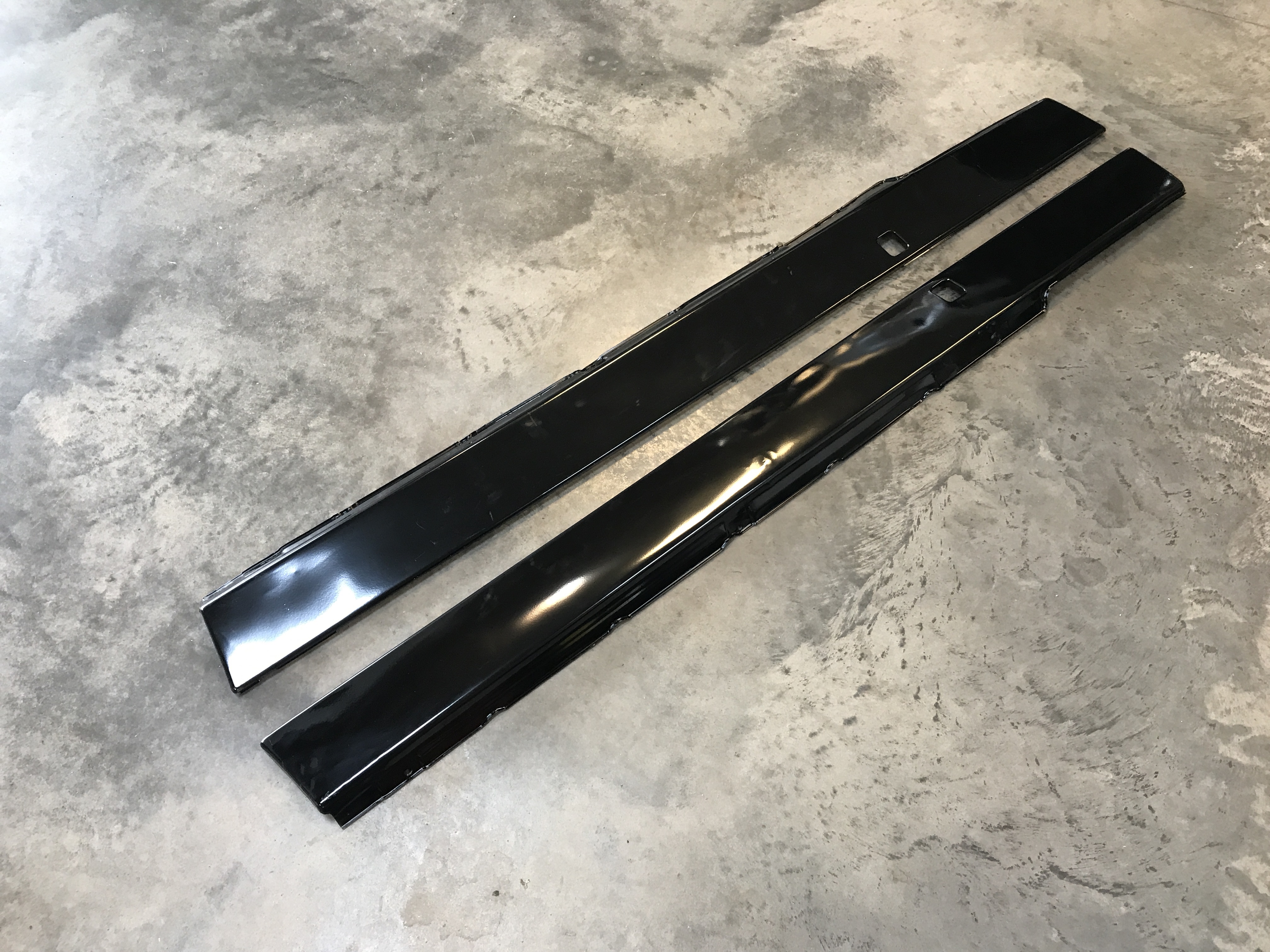

Then I got out the rocker covers. They are a little lumpy, but I had them powder-coated so no filler allowed.

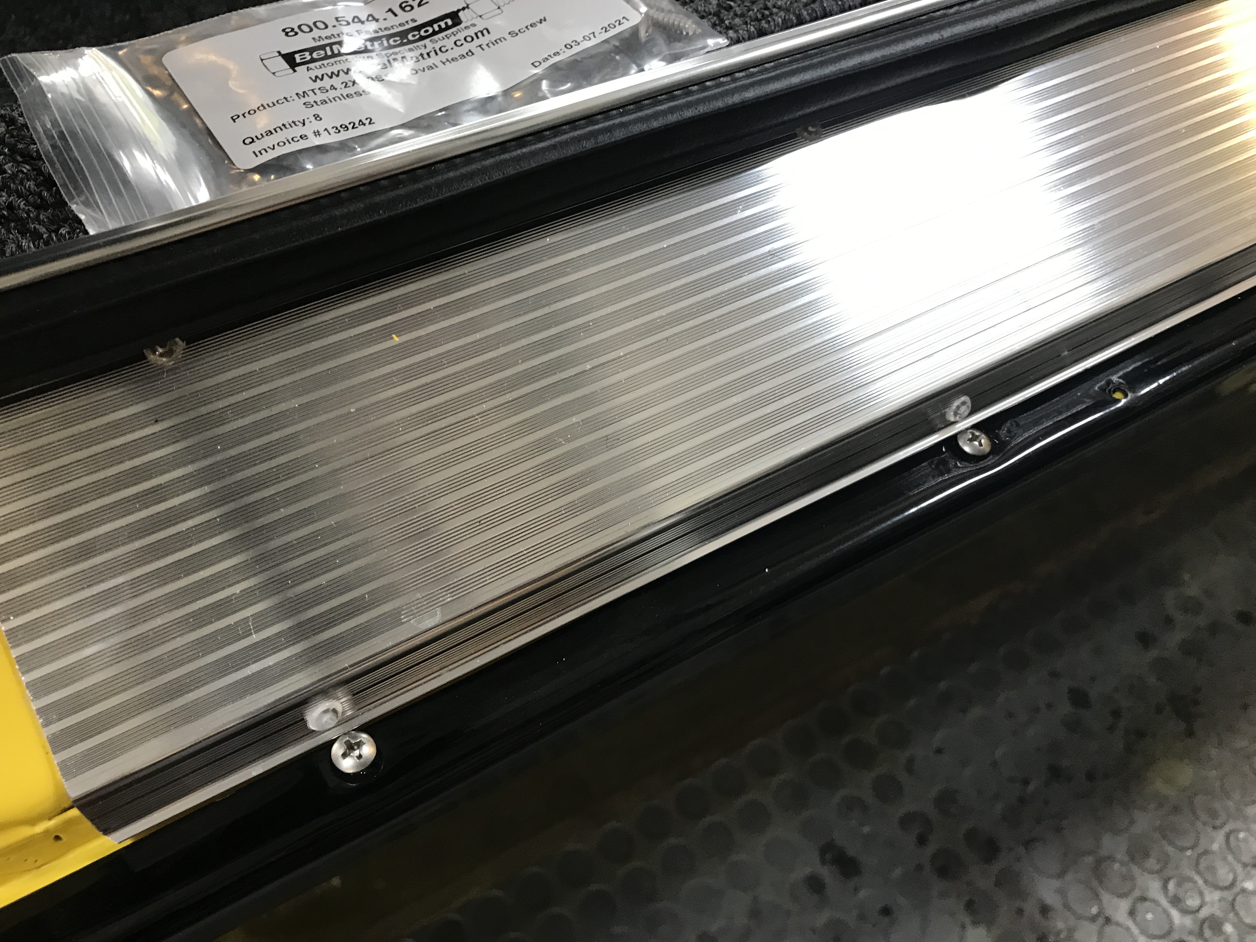

I used stainless screws so I can easily open things up for cleaning.

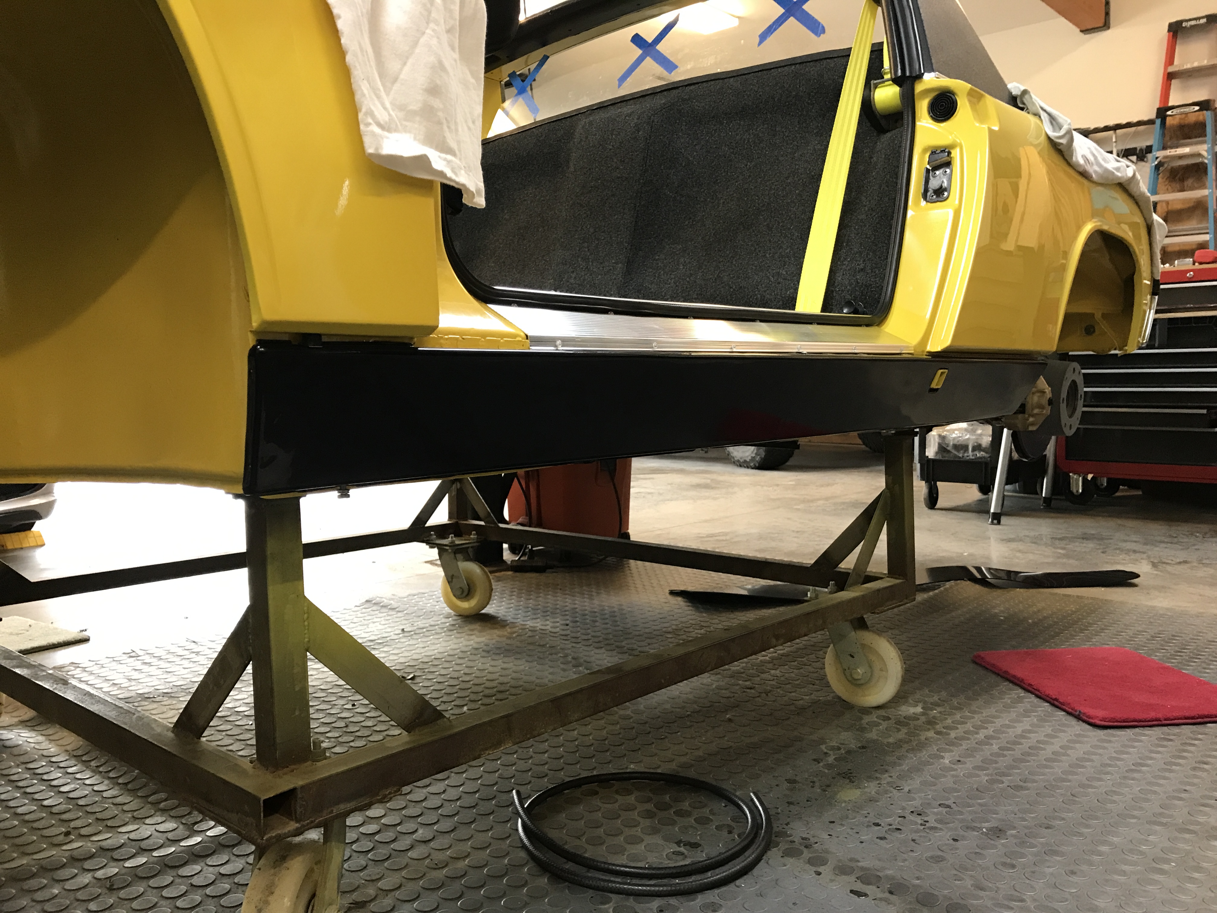

Left side on, and now I can finish the fender liners.

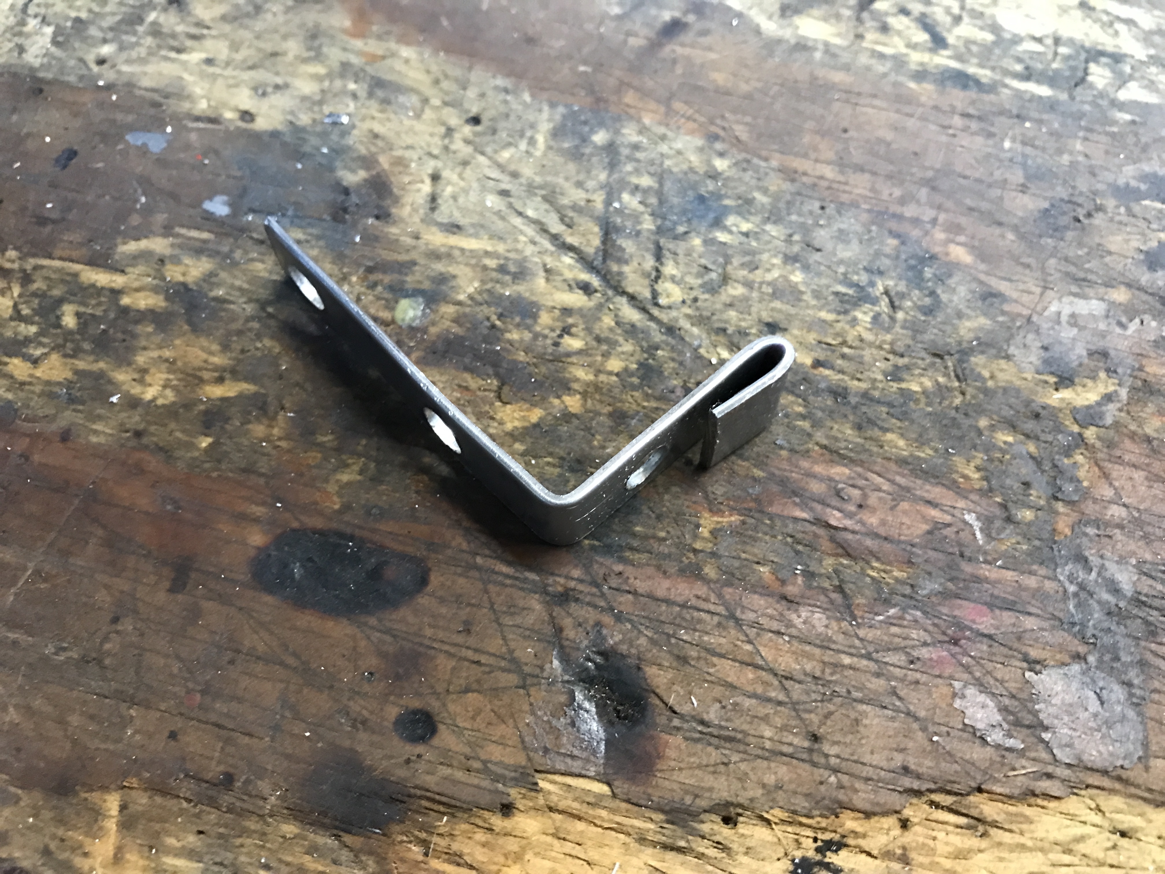

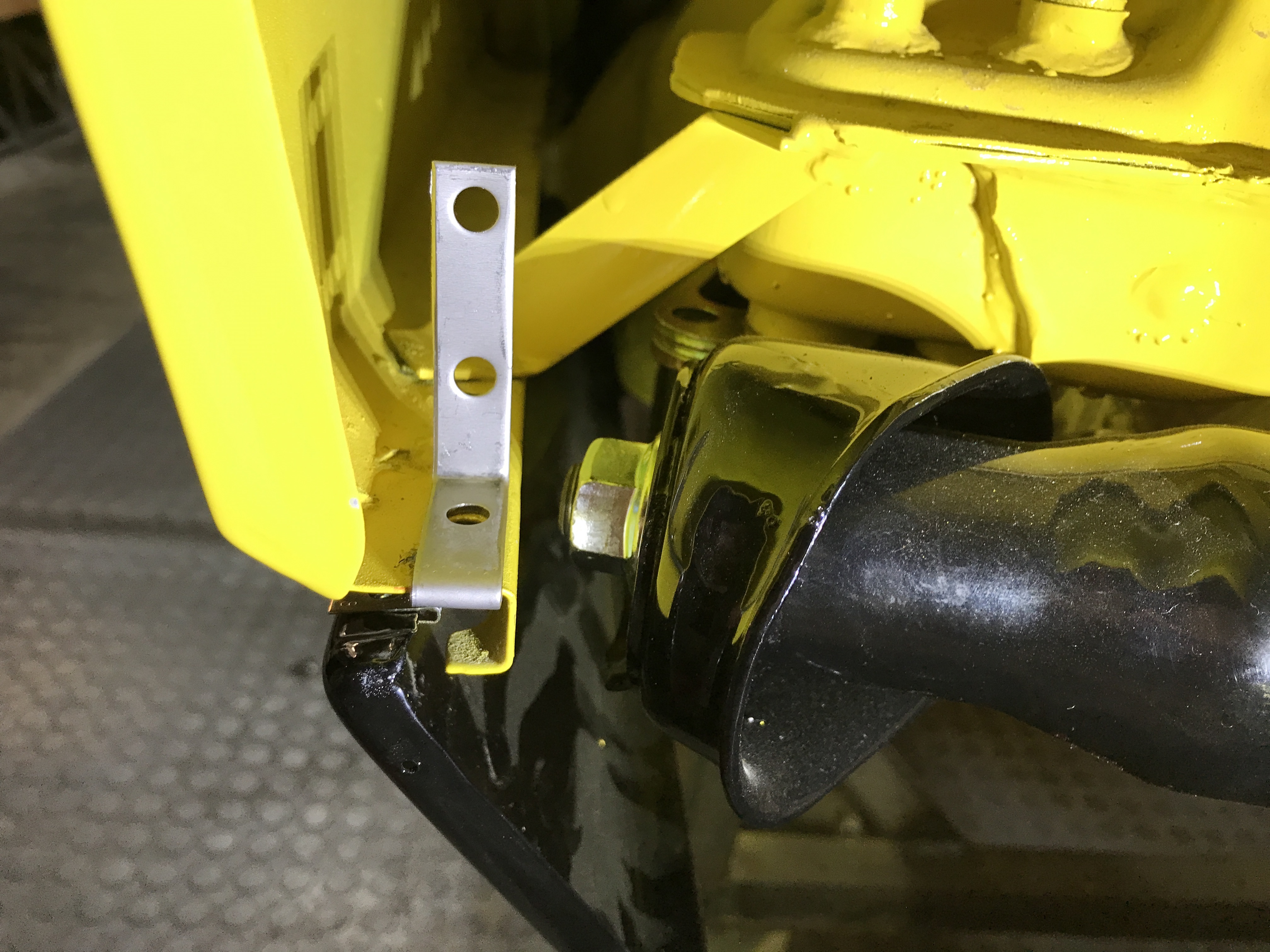

I started on the left rear fender liner. I modified another clip for the leading edge
bkrantz
post Jul 23 2021, 07:09 PM
Post #3415
Posts: 8,800
Joined: 3-August 19
From: SW Colorado
Member No.: 23,343
Leading edge clip in place.

On the trailing edge, the clip just reaches the hole.
bkrantz
post Jul 23 2021, 07:13 PM
Post #3417
Posts: 8,800
Joined: 3-August 19
From: SW Colorado
Member No.: 23,343

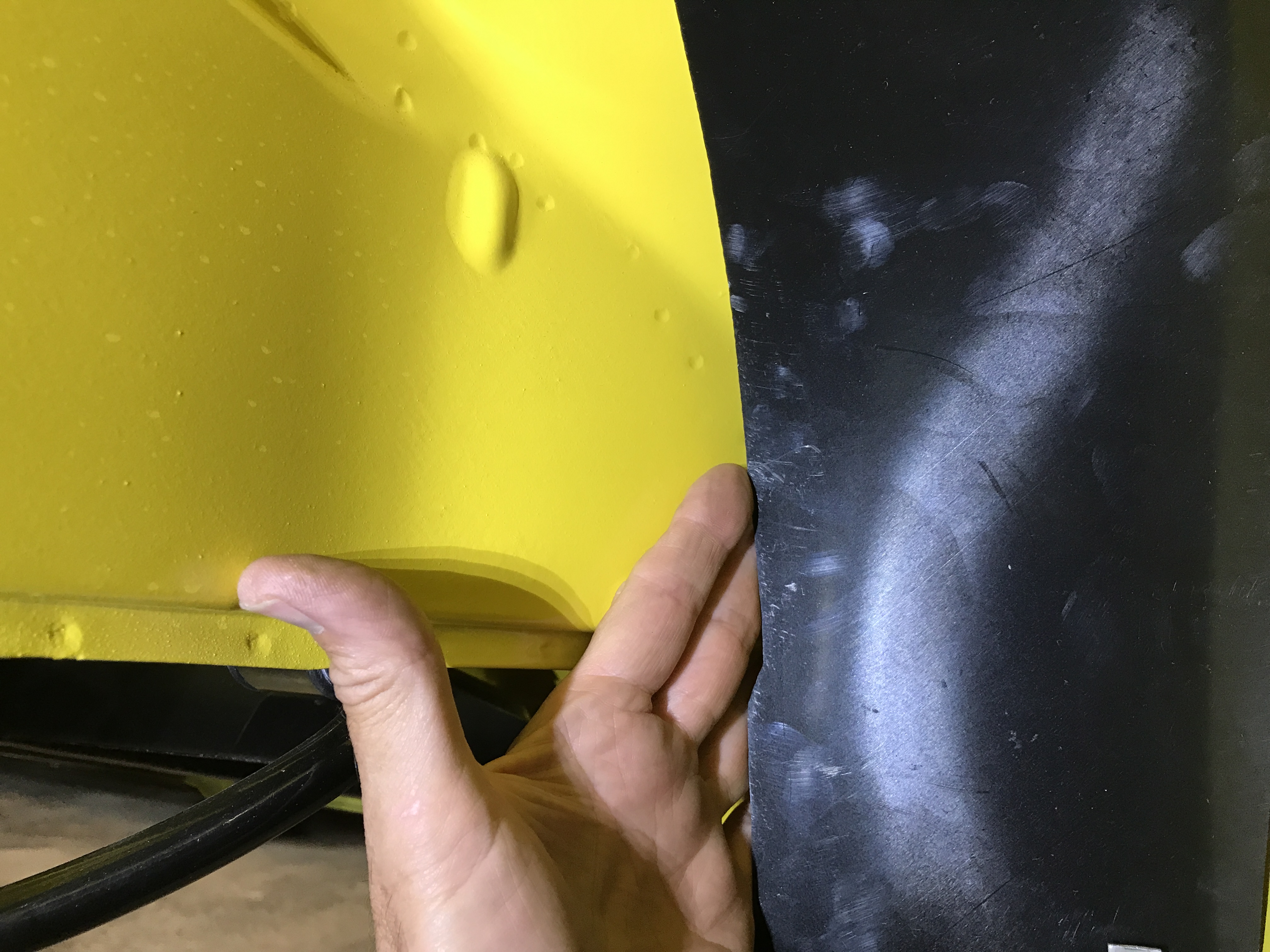

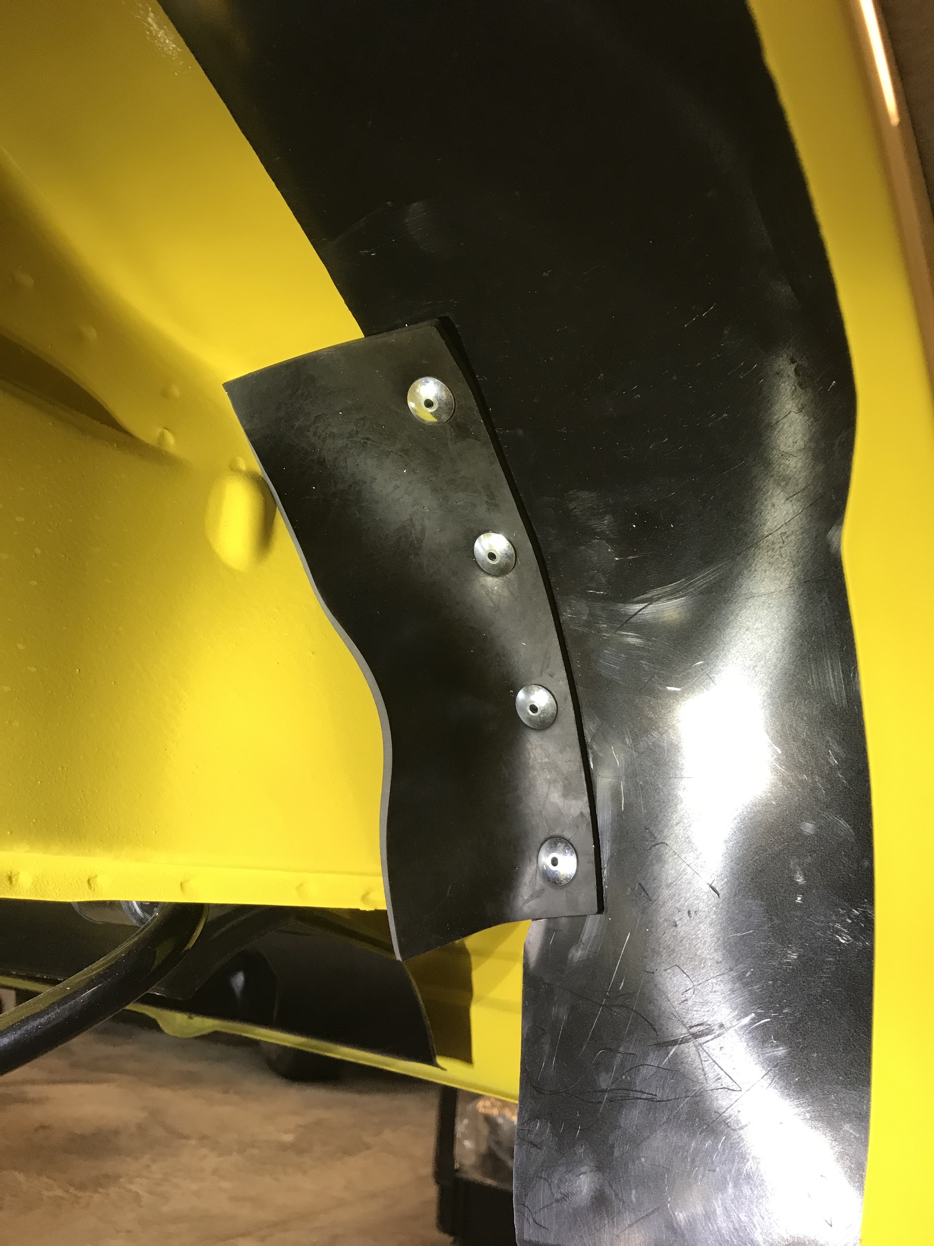

Test fitting the liner. It sits snugly against the outer edge, but leaves a gap along the inner wall, just in the line of fire of debris coming off the tire.
bkrantz
post Jul 23 2021, 07:16 PM
Post #3418
Posts: 8,800
Joined: 3-August 19
From: SW Colorado
Member No.: 23,343

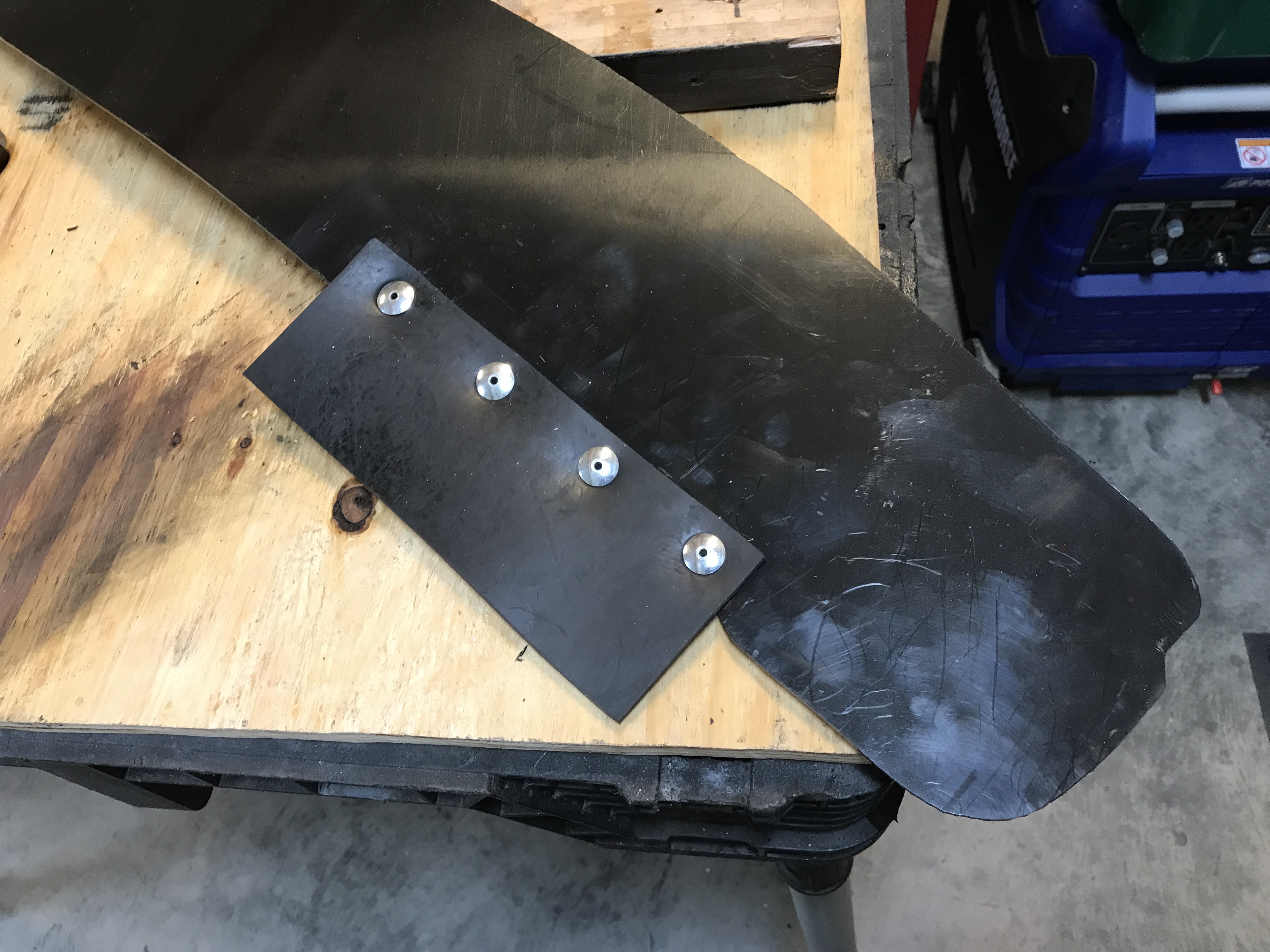

Time to use some 1/8" rubber sheet, pop-riveted to the liner.
bkrantz
post Jul 23 2021, 07:19 PM
Post #3419
Posts: 8,800
Joined: 3-August 19
From: SW Colorado
Member No.: 23,343

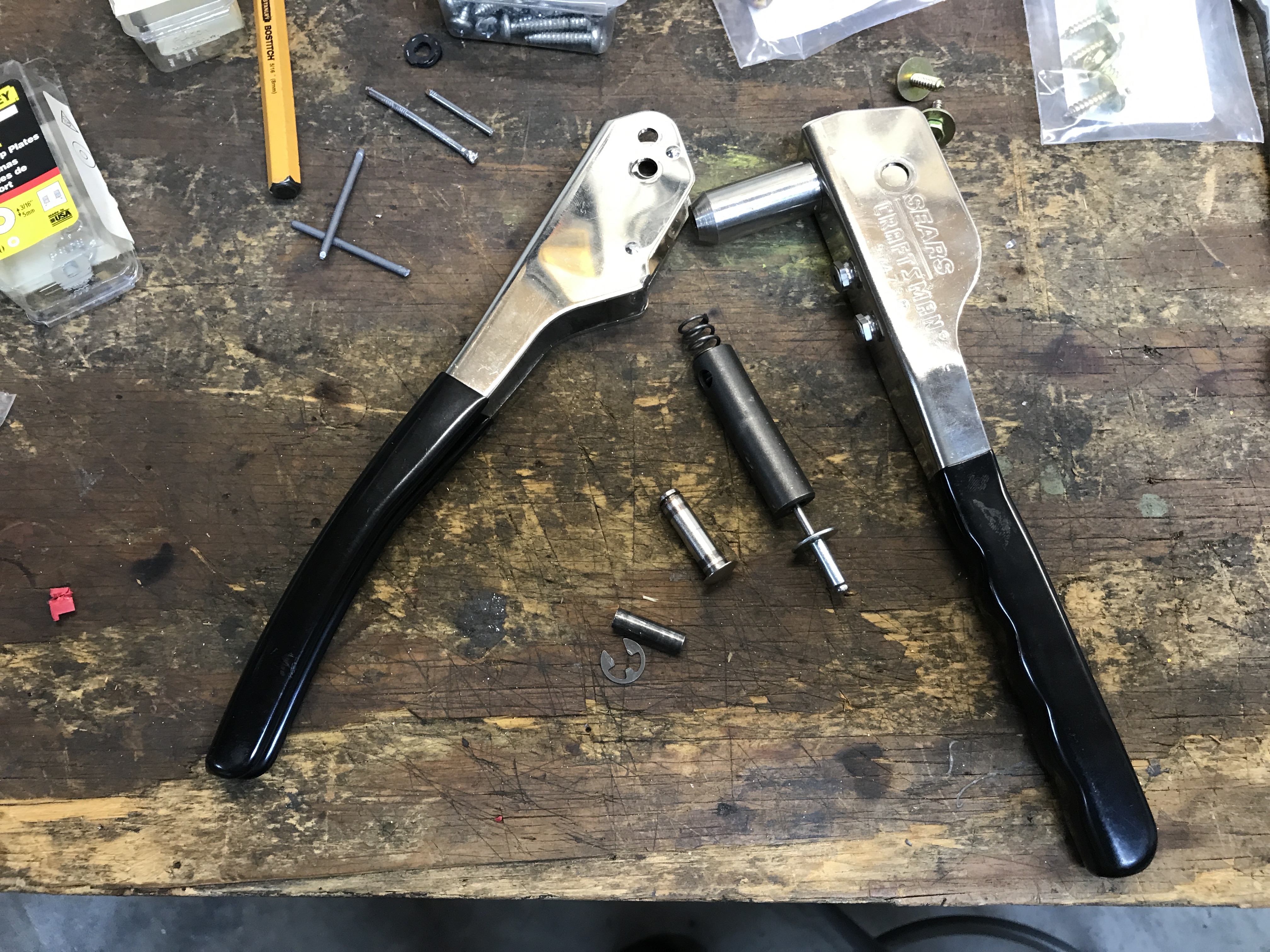

Of course, today my rivet tool choked on one of the studs. I had to take it apart, and then it took me three attempts to get it back together and working properly.
