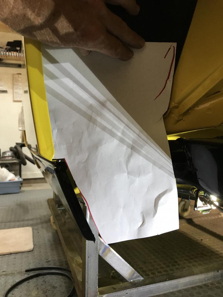

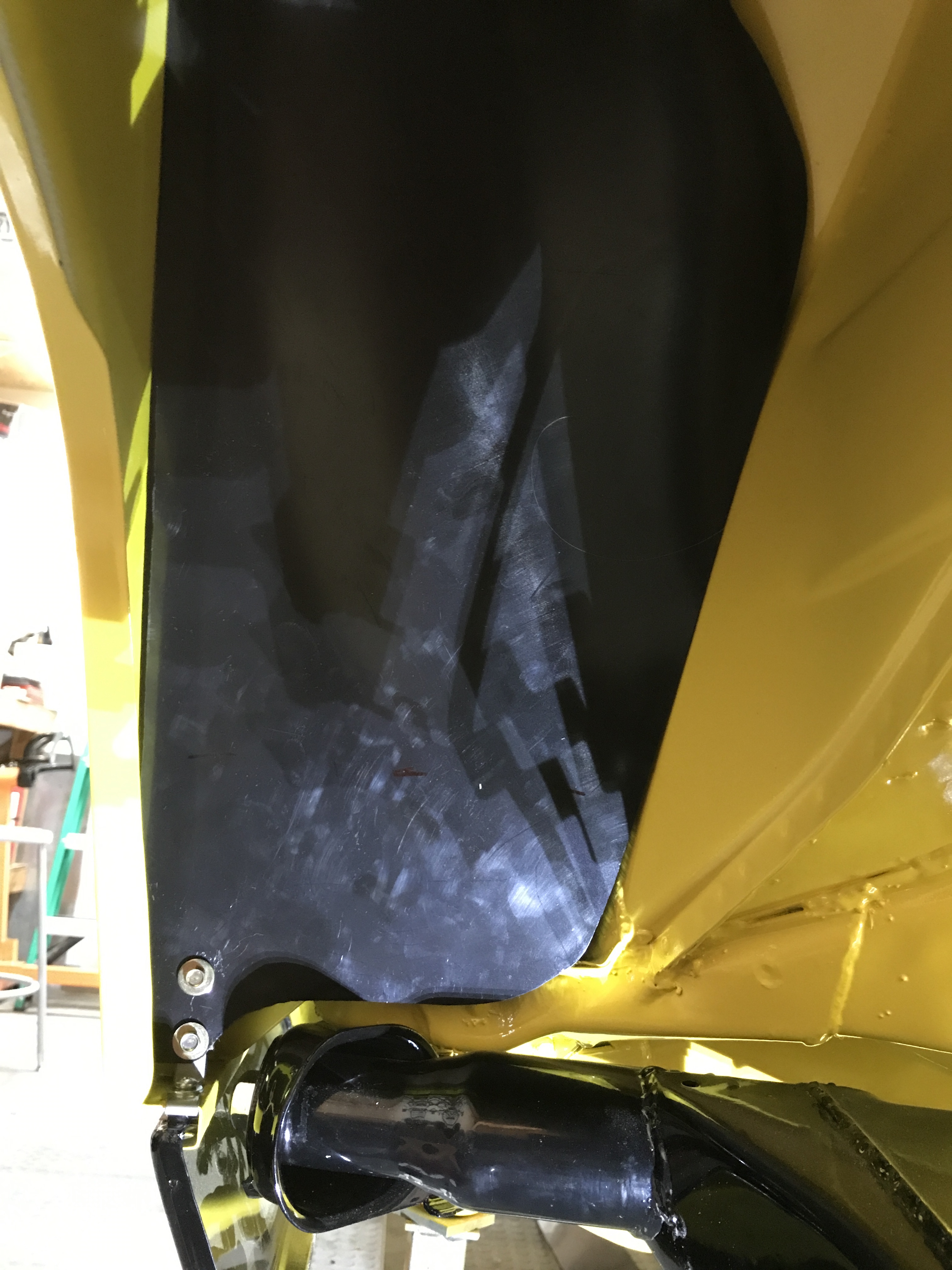

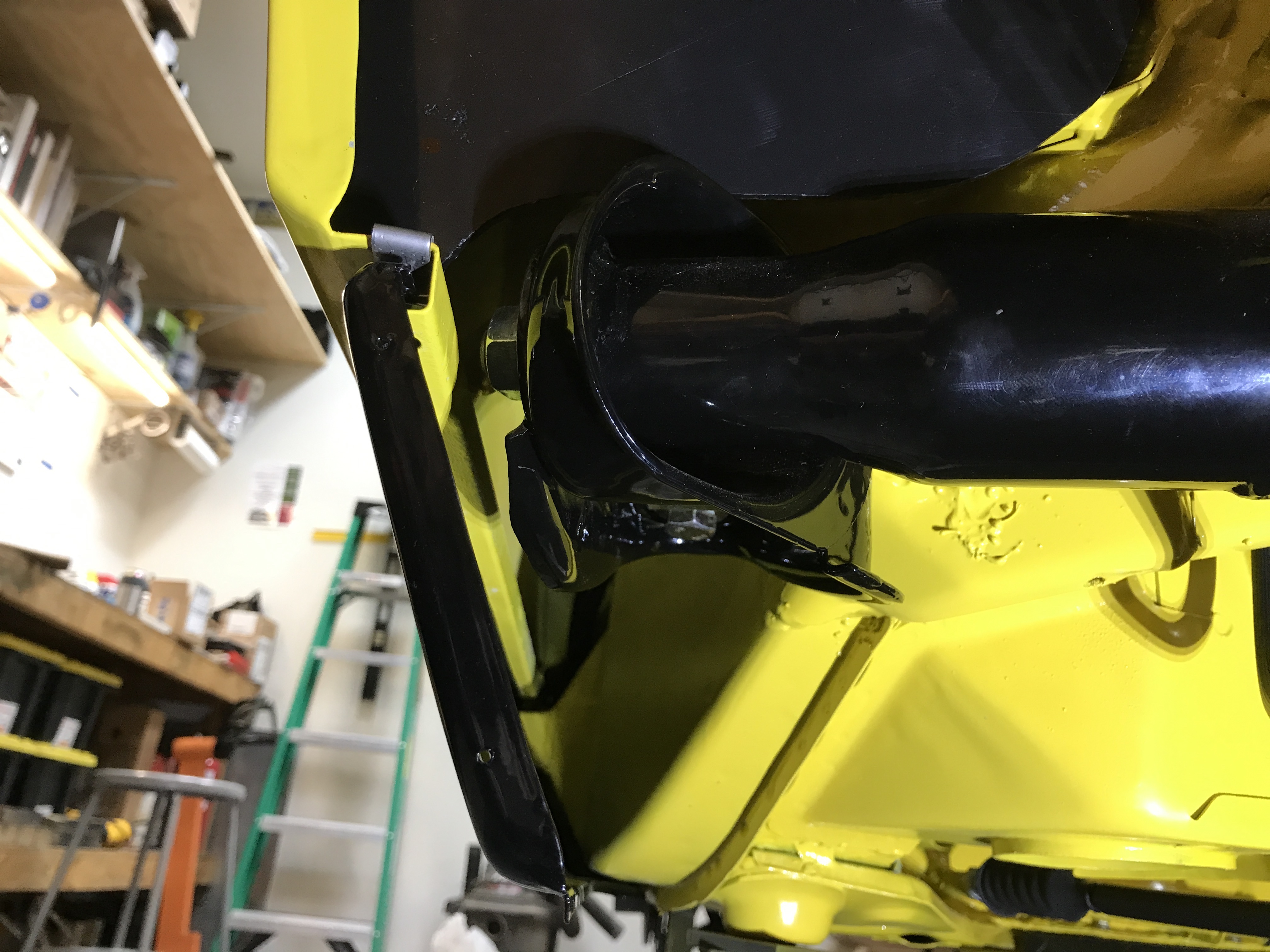

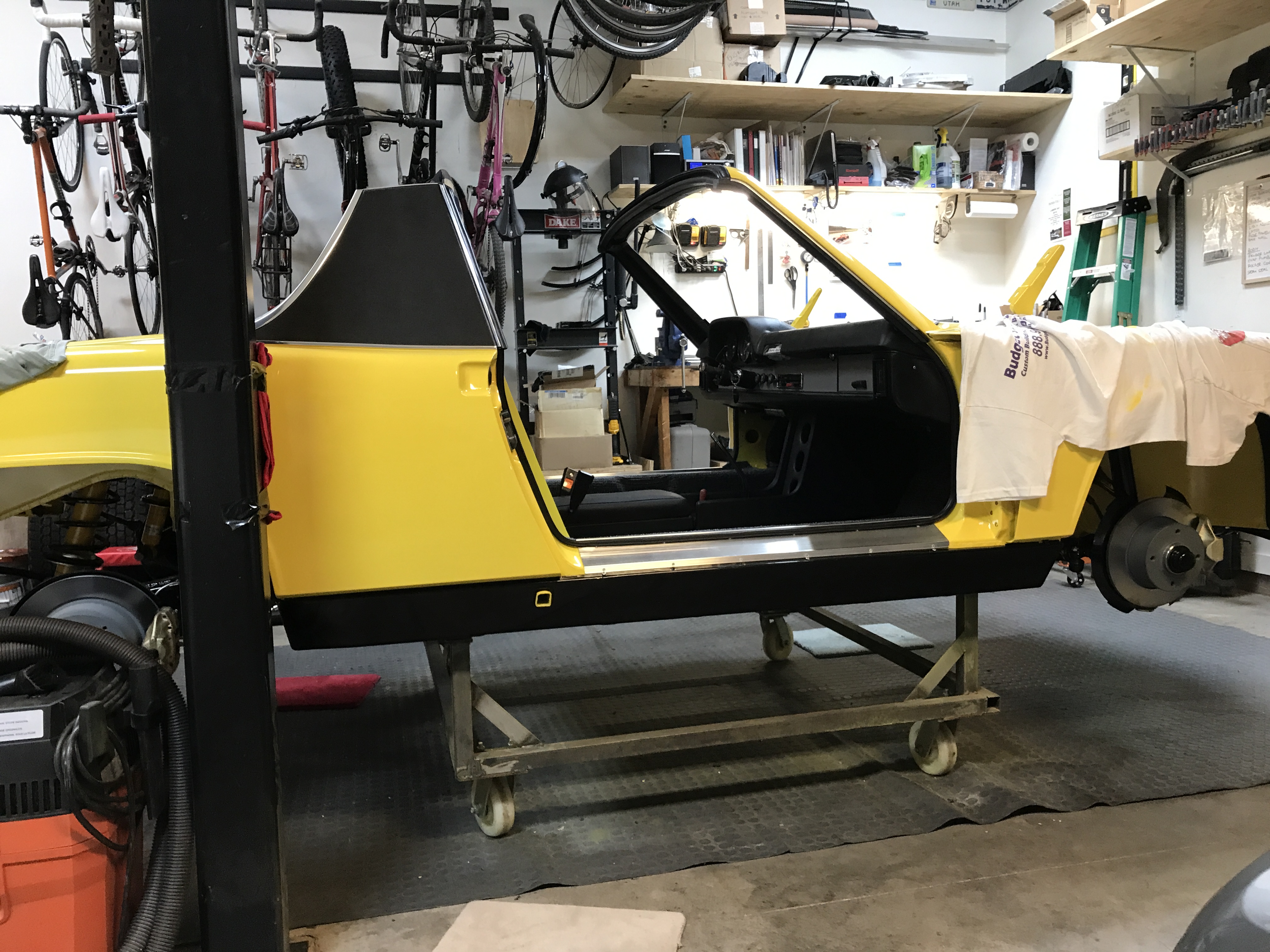

Second attempt: some slits, and the flaps lay tight against the inner fender.
post Jul 23 2021, 07:24 PM
Post #3422
Posts: 8,800

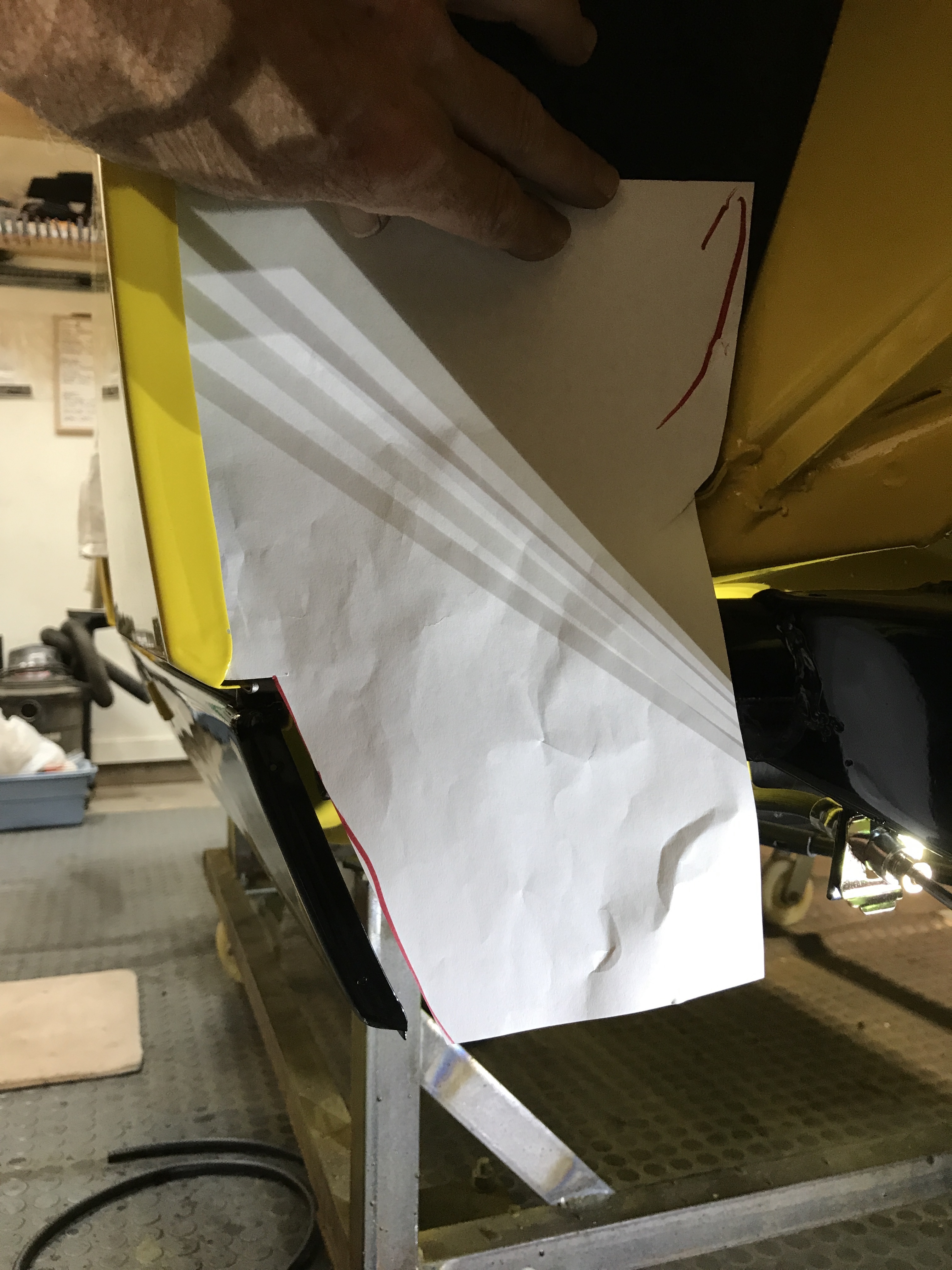

Of course, fussing with the rear side made me think about the exposure on the leading side. Stuff going this way creates the classic dirt pile inside the rocker covers.
post Jul 23 2021, 07:27 PM
Post #3423
Posts: 8,800

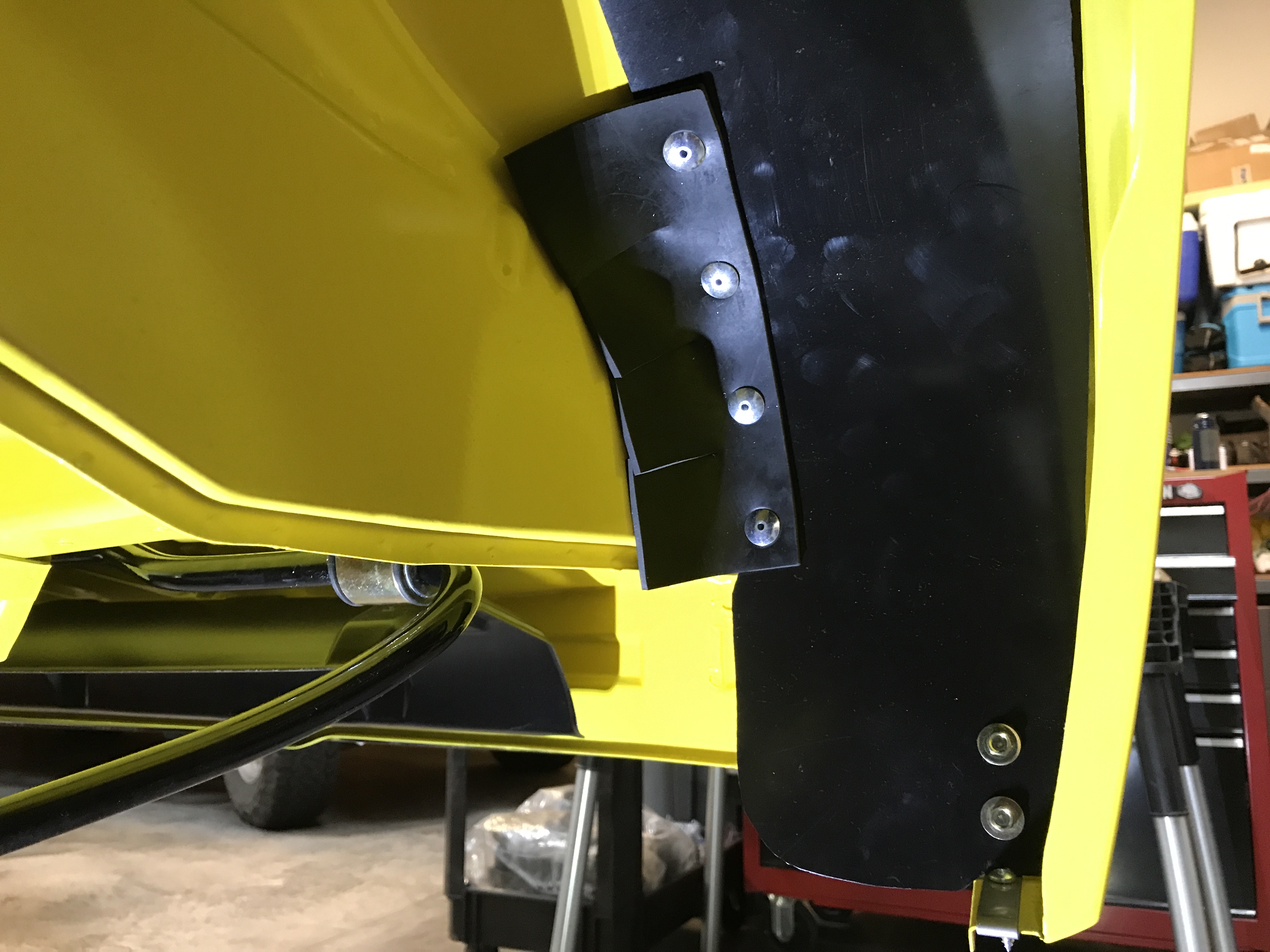

Maybe something like this? I need bigger rubber sheets. And to think some more.
post Jul 23 2021, 07:29 PM
Post #3424
Posts: 8,800
For now, it looks like this.
post Jul 23 2021, 07:30 PM
Post #3425
Posts: 8,800
The last thing I did today was mount the right side rocker cover.

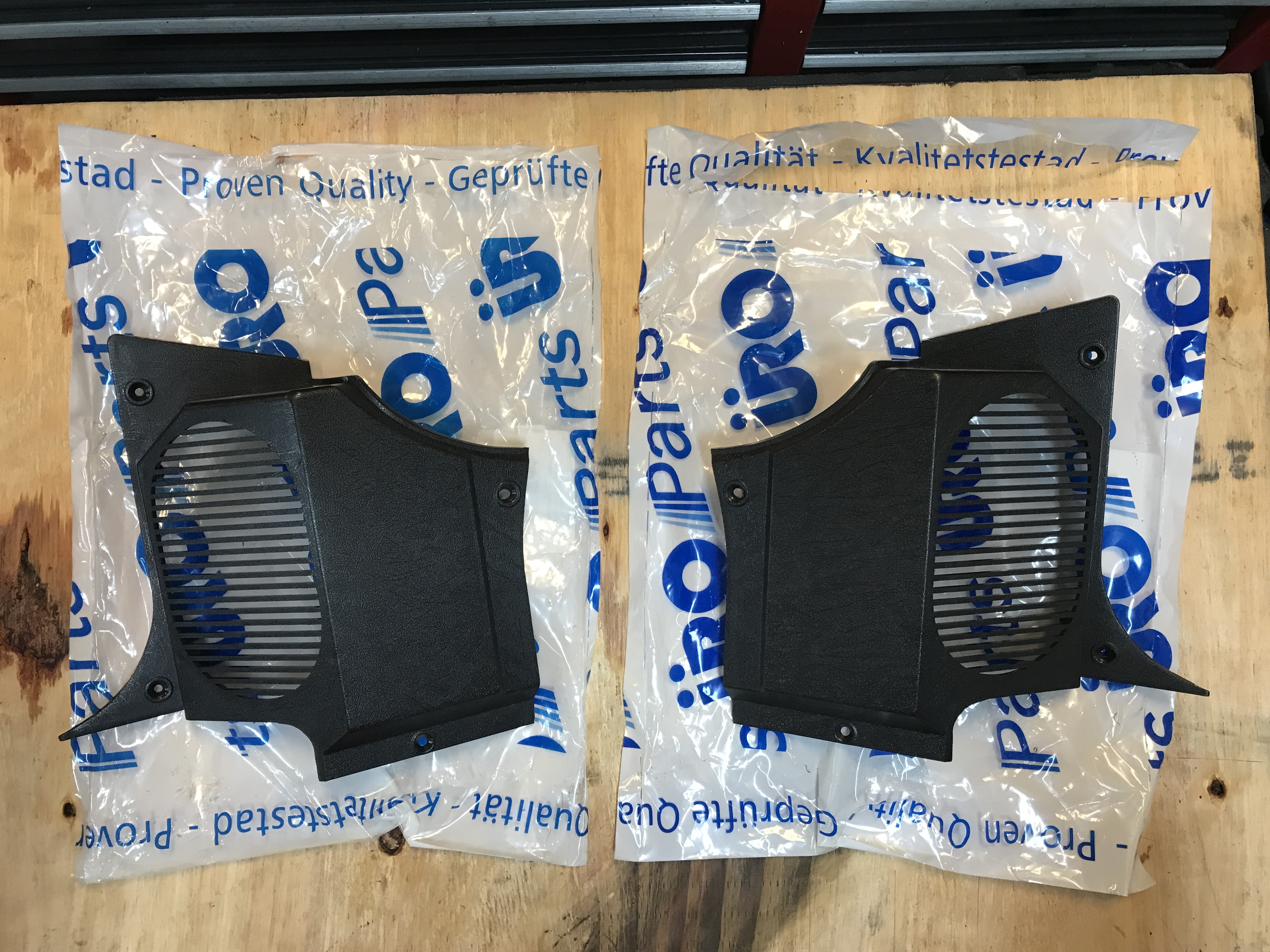

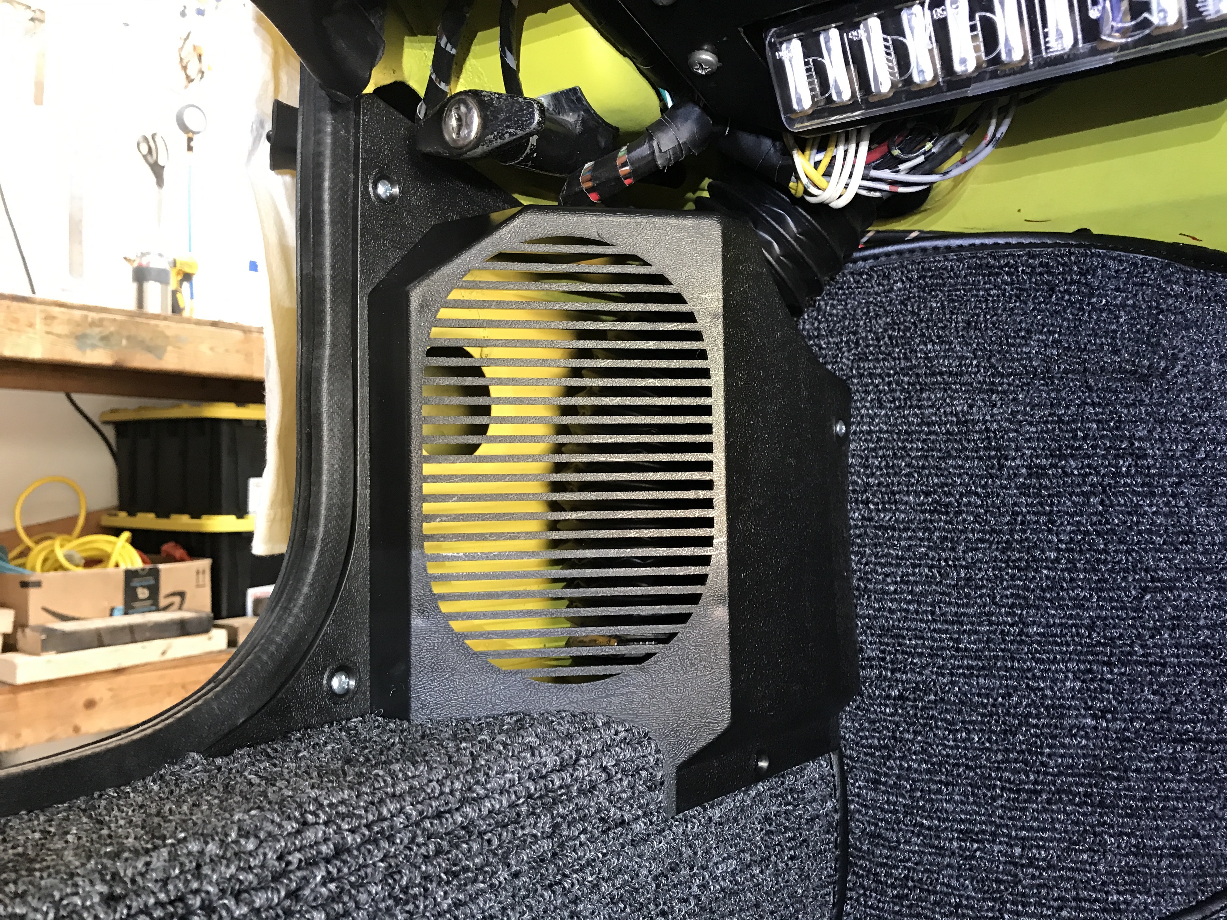

Next interior bit: speakers and pods.
I decided to use the standard design, since they take less physical and visual space. And since audio is a secondary goal for me.
post Jul 24 2021, 07:18 PM
Post #3427

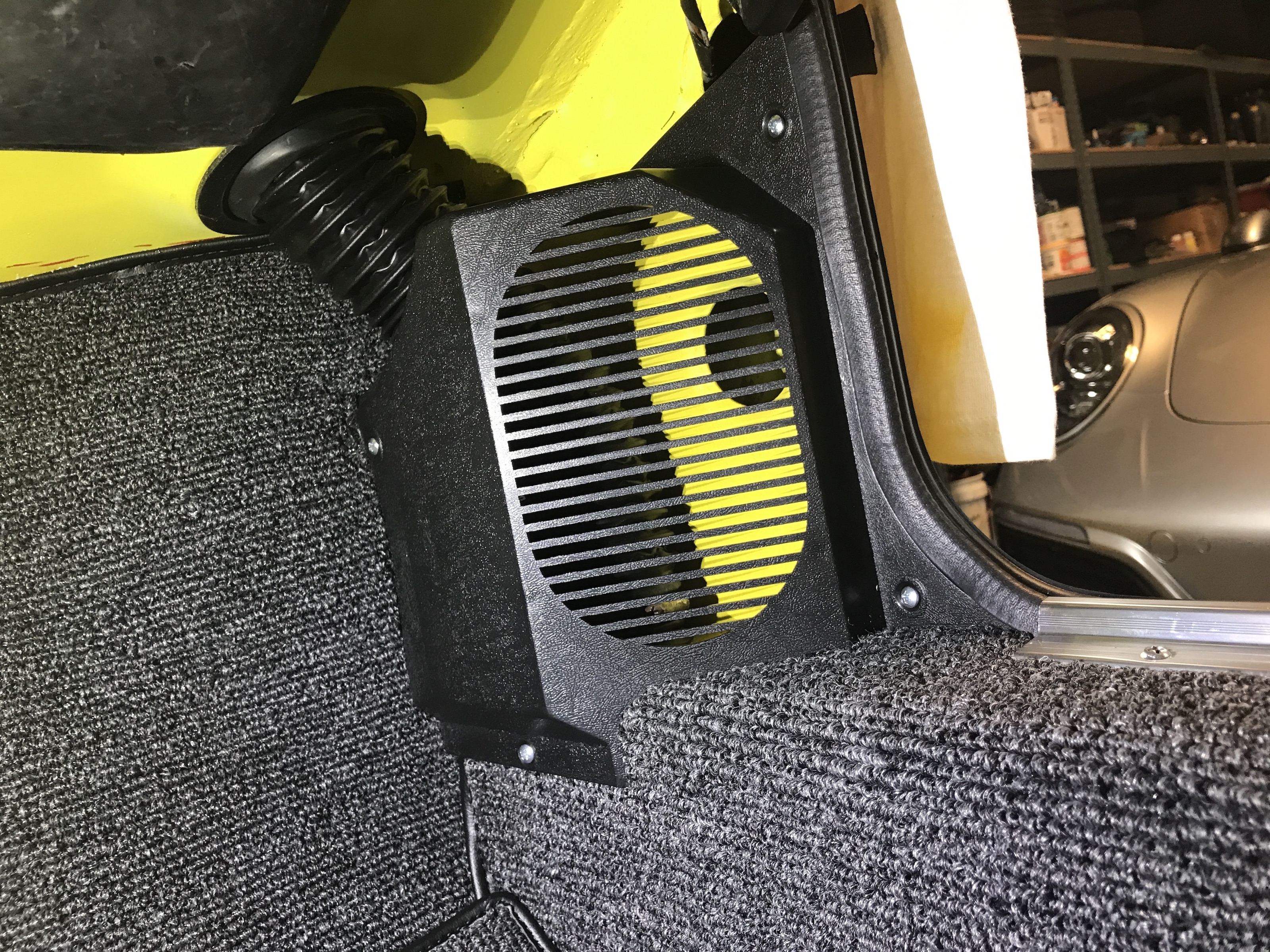

Posts: 8,800

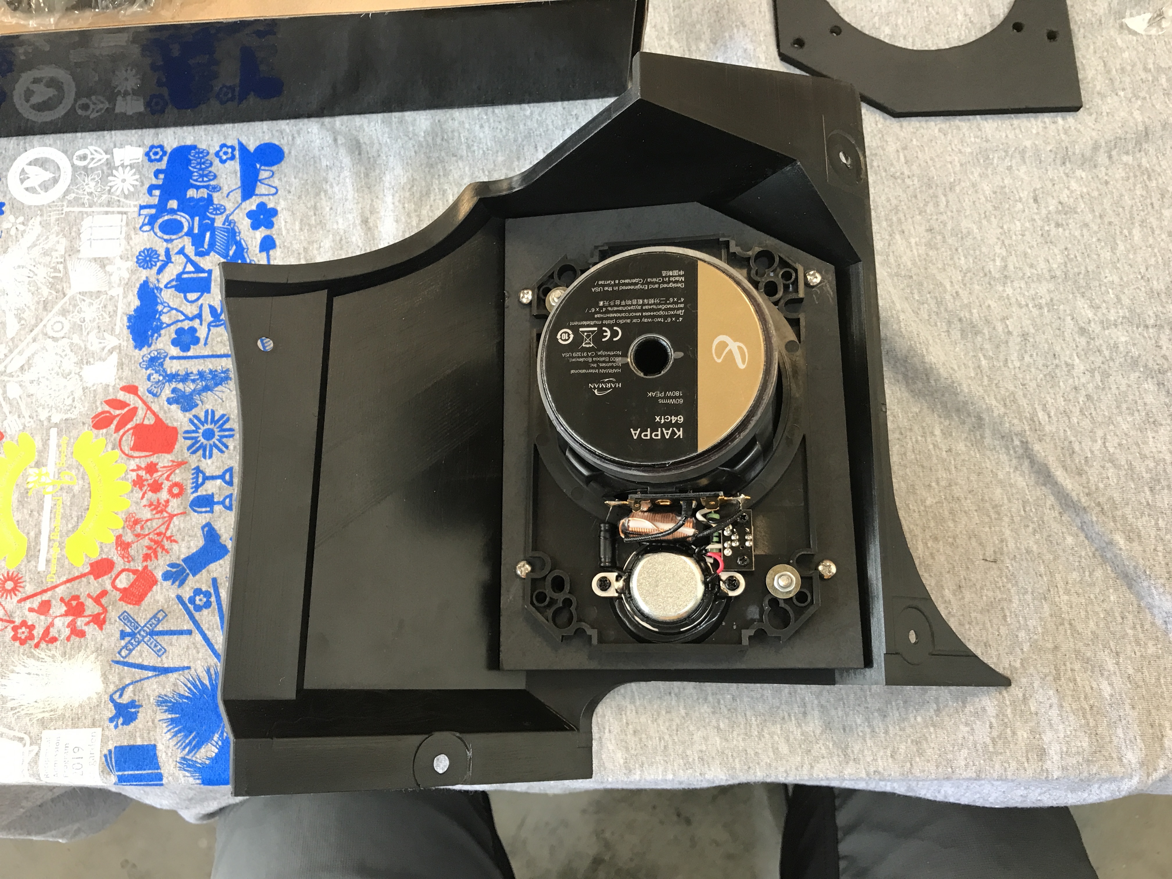

Here's how the left side fits, with limited space inside the box--as everyone knows.
post Jul 24 2021, 07:20 PM
Post #3428
Posts: 8,800

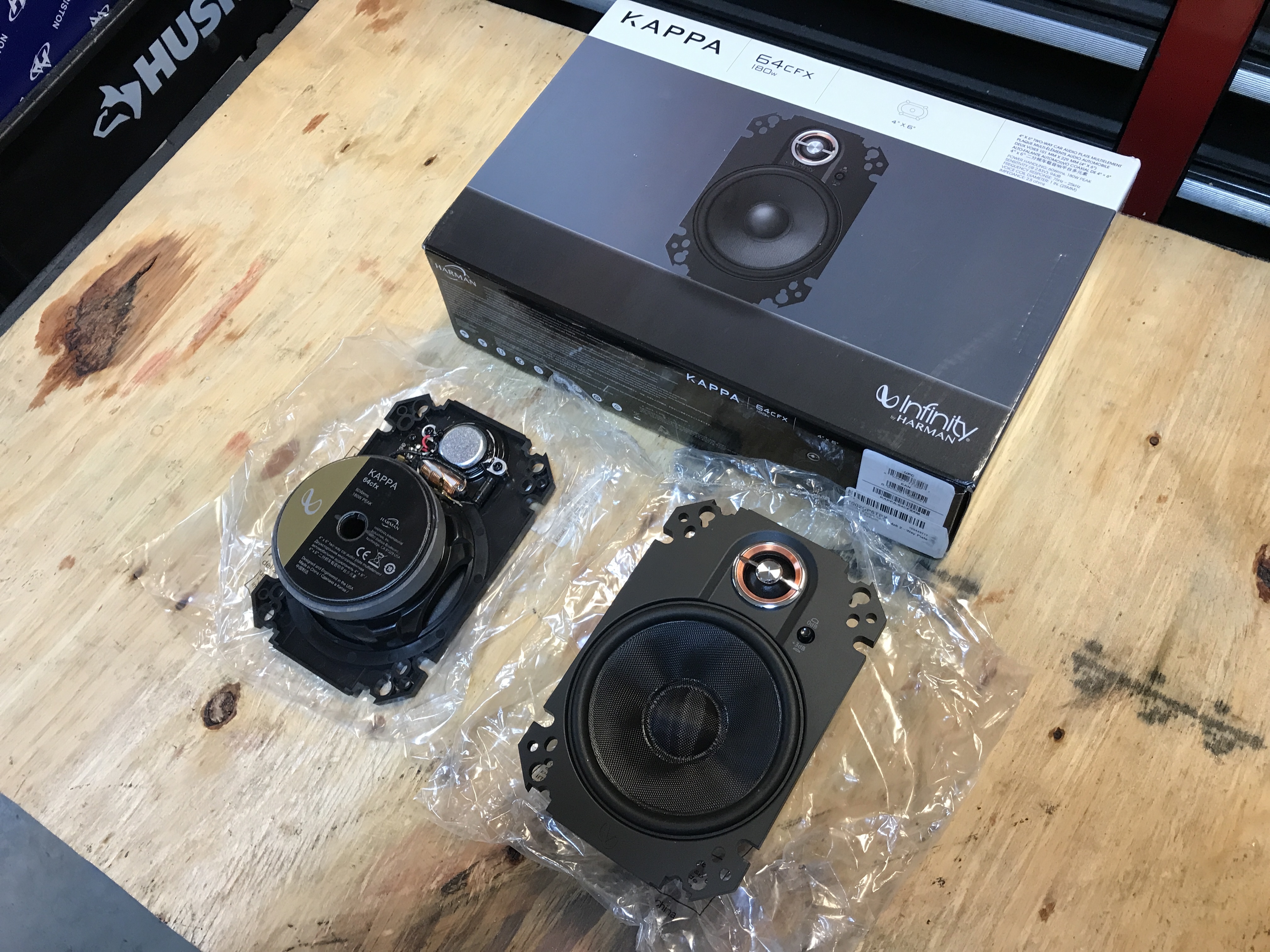

I got these Infinity plate speakers, which should fit, as bbrock demonstrated.
post Jul 25 2021, 07:17 PM
Post #3429

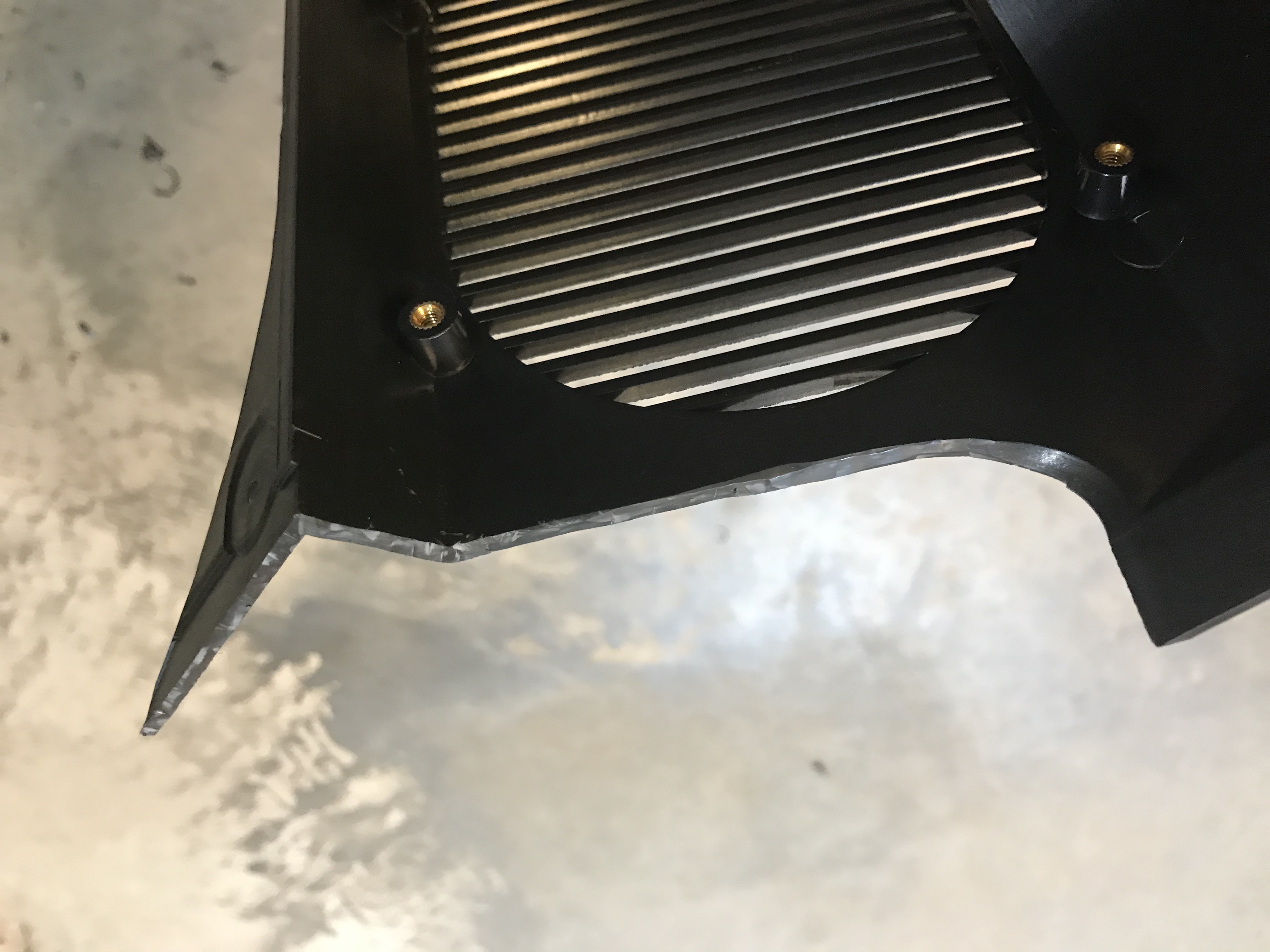

Posts: 8,800

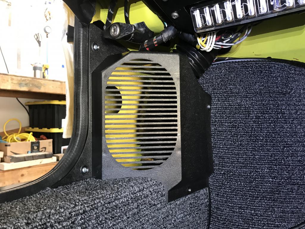

The right side box sits too high for the screw holes to line up, by about 2 mm.
post Jul 25 2021, 07:18 PM
Post #3430
Posts: 8,800
I used a new utility blade to shave about 1.5 mm off the base edge.
post Jul 25 2021, 07:21 PM
Post #3431
Posts: 8,800
That was enough for things to line up.

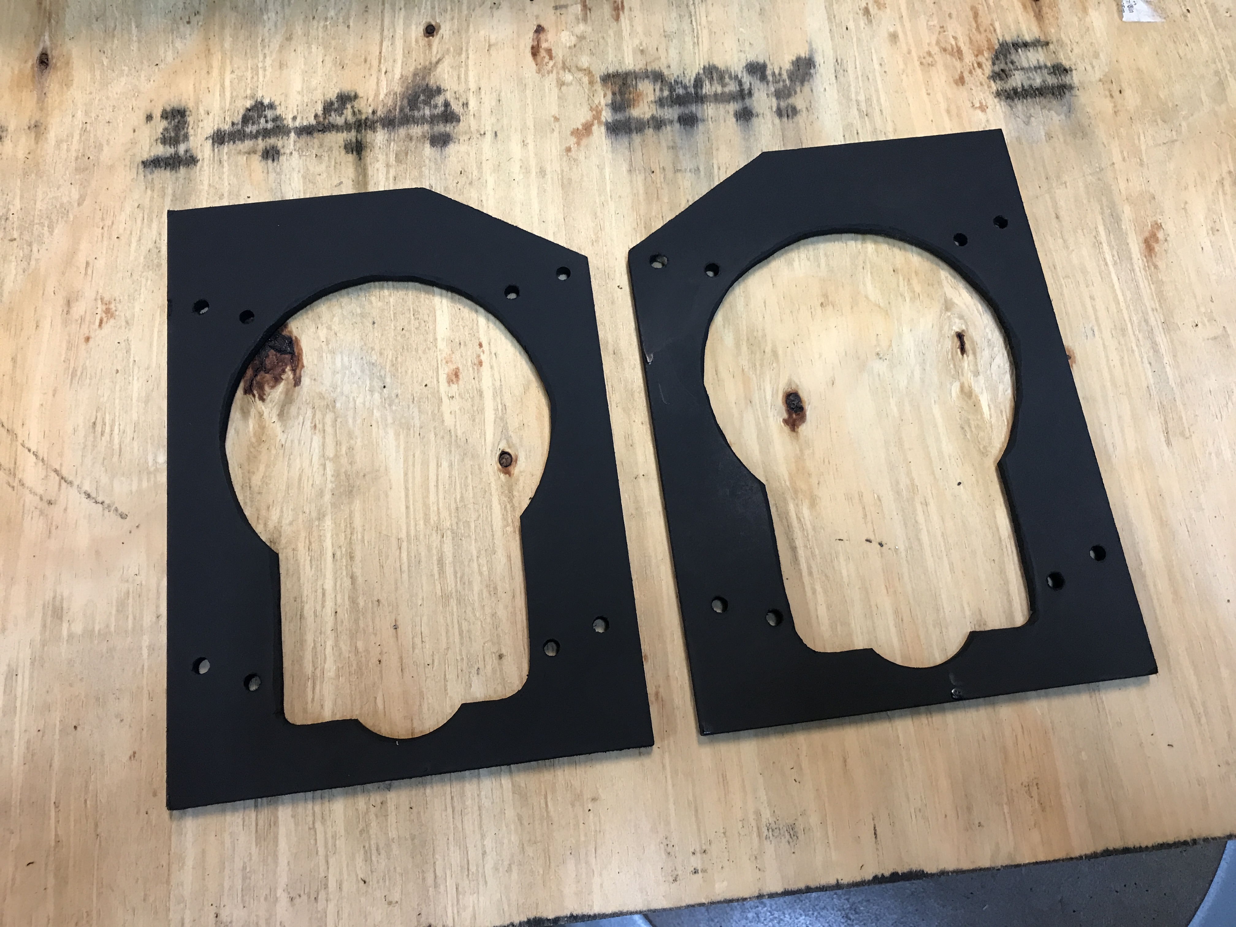

Posts: 8,800

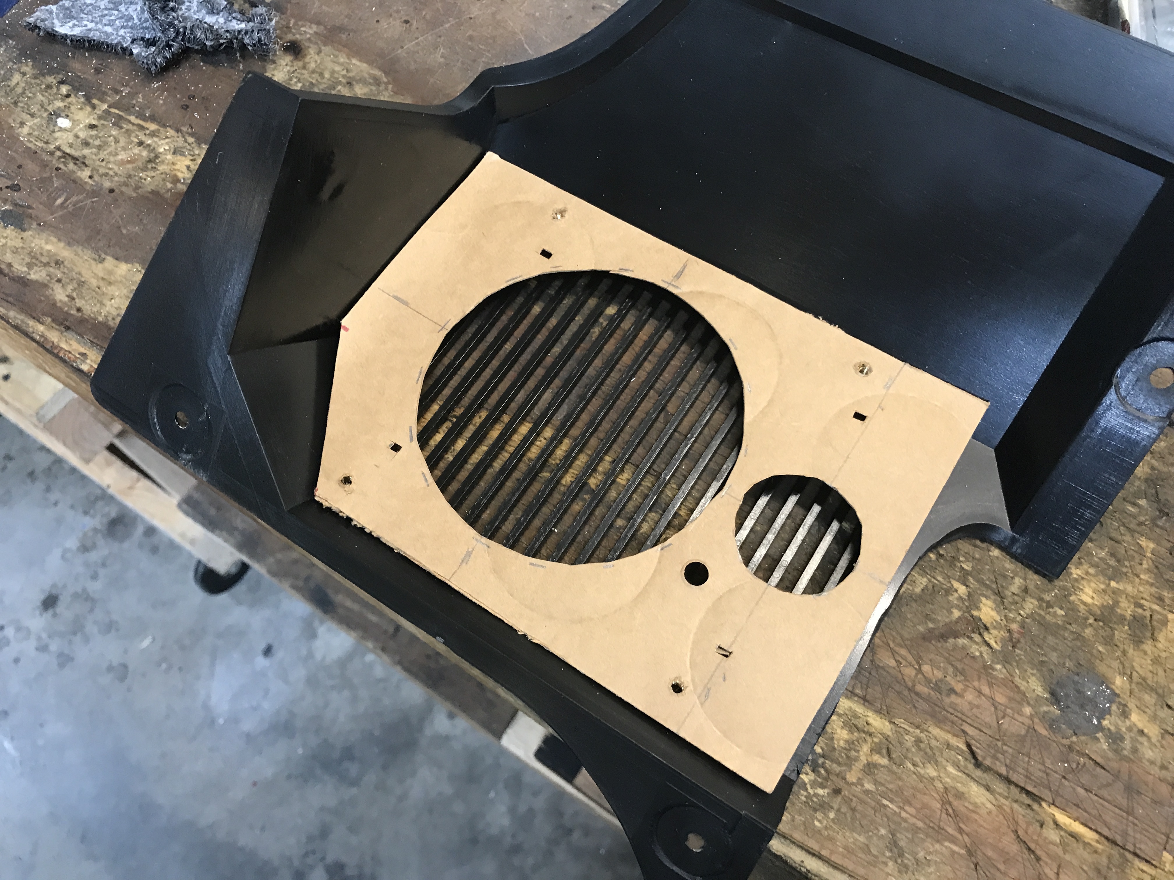

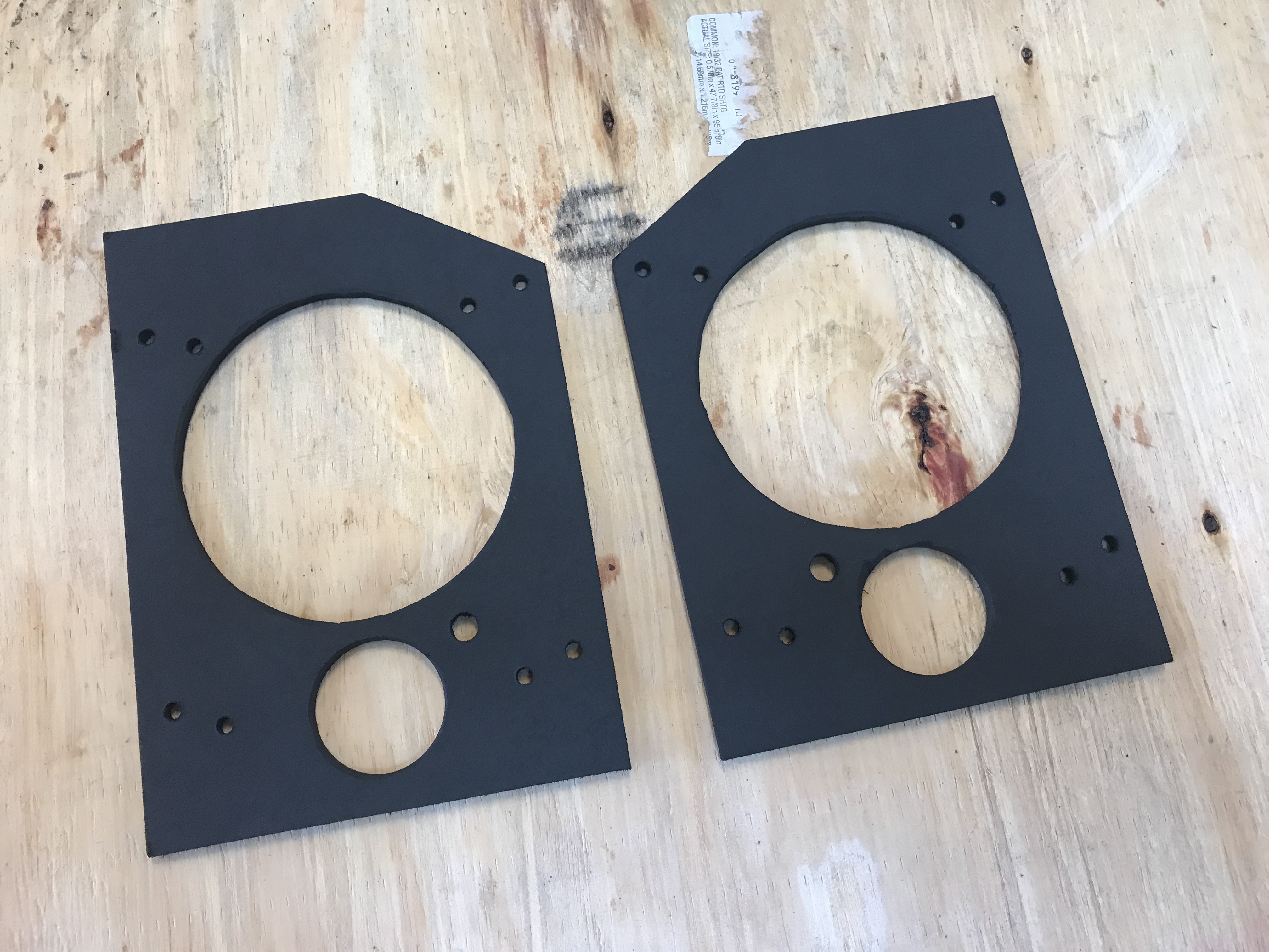

Now to develop some speaker mounting adapters.
post Jul 25 2021, 07:25 PM
Post #3433
Posts: 8,800
I made these from 1/4" MDF. Once I get some hardware I can see if everything fits.

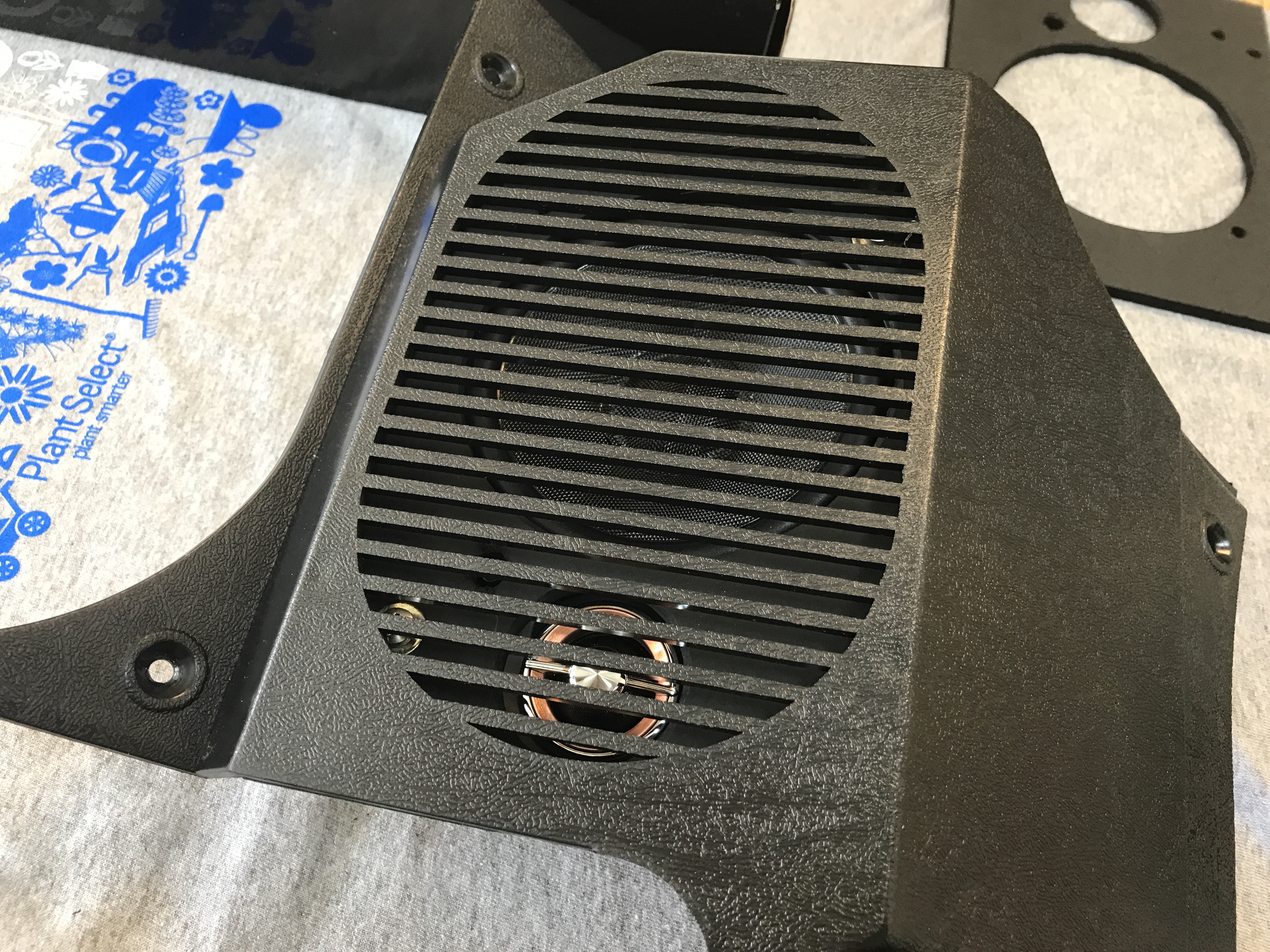

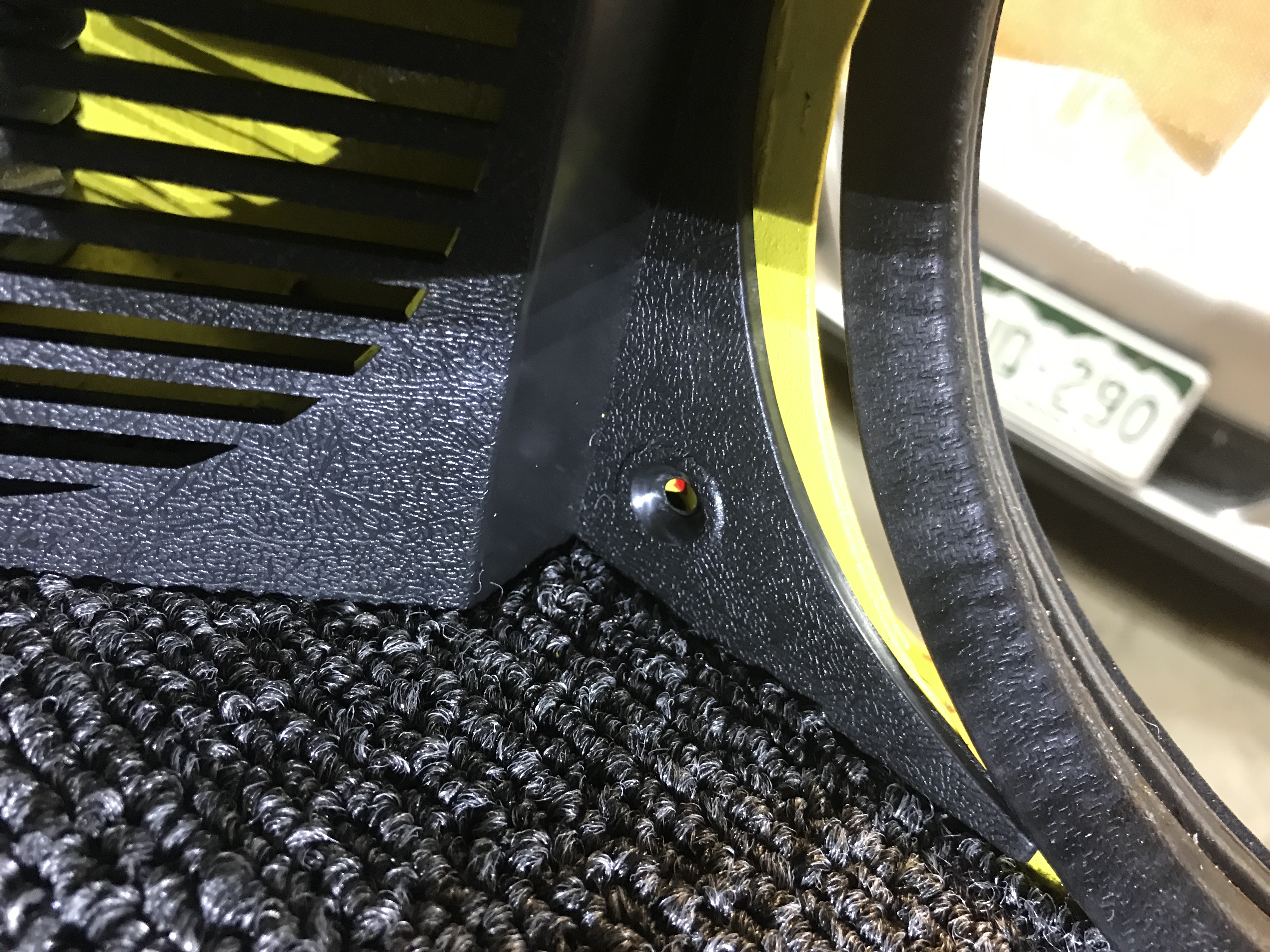

Posts: 8,800
Here is my first version: the mounting board sits between the grill and the speaker.
post Jul 26 2021, 07:01 PM
Post #3435
Posts: 8,800
That leaves almost 1/2" between the grill and the face of the speaker.
post Jul 26 2021, 07:02 PM
Post #3436
Posts: 8,800
It does sorta fit, by bending the pod a bit.
post Jul 26 2021, 07:04 PM
Post #3437

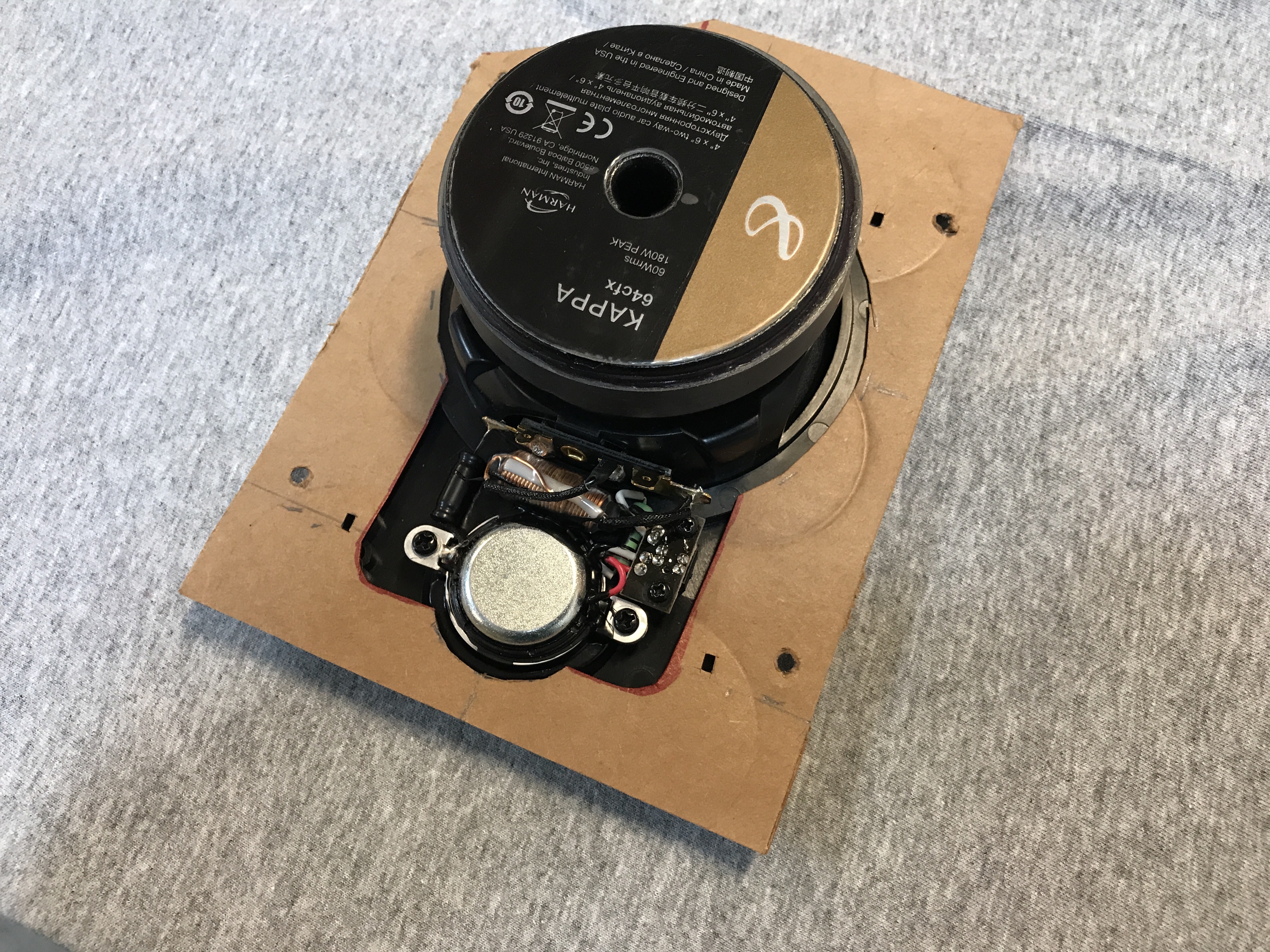

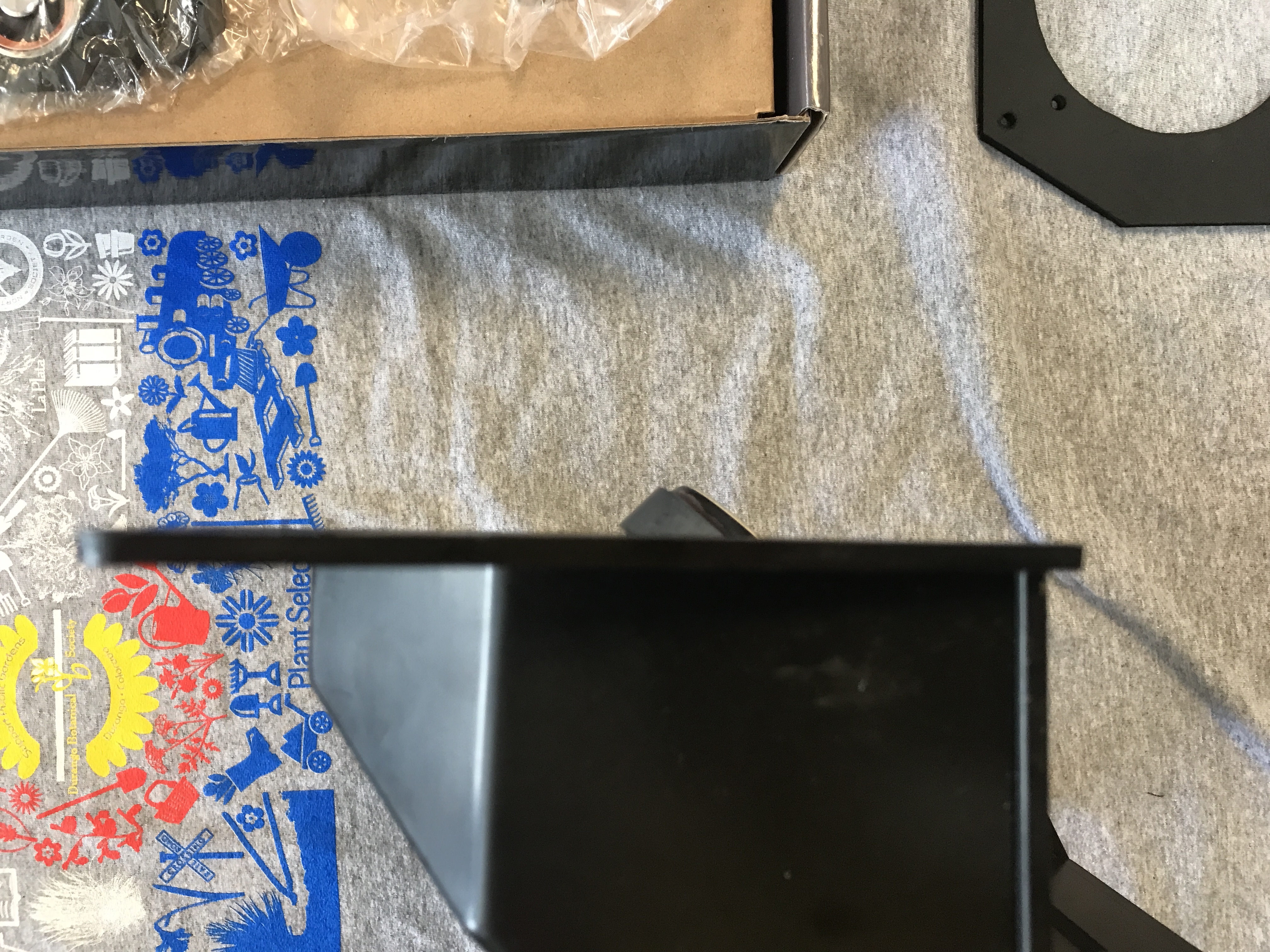

Posts: 8,800
Here's the problem: the magnet of the mid-range speaker projects beyond the mounting plane of the back side of the pod.
post Jul 26 2021, 07:13 PM
Post #3438
Posts: 8,800

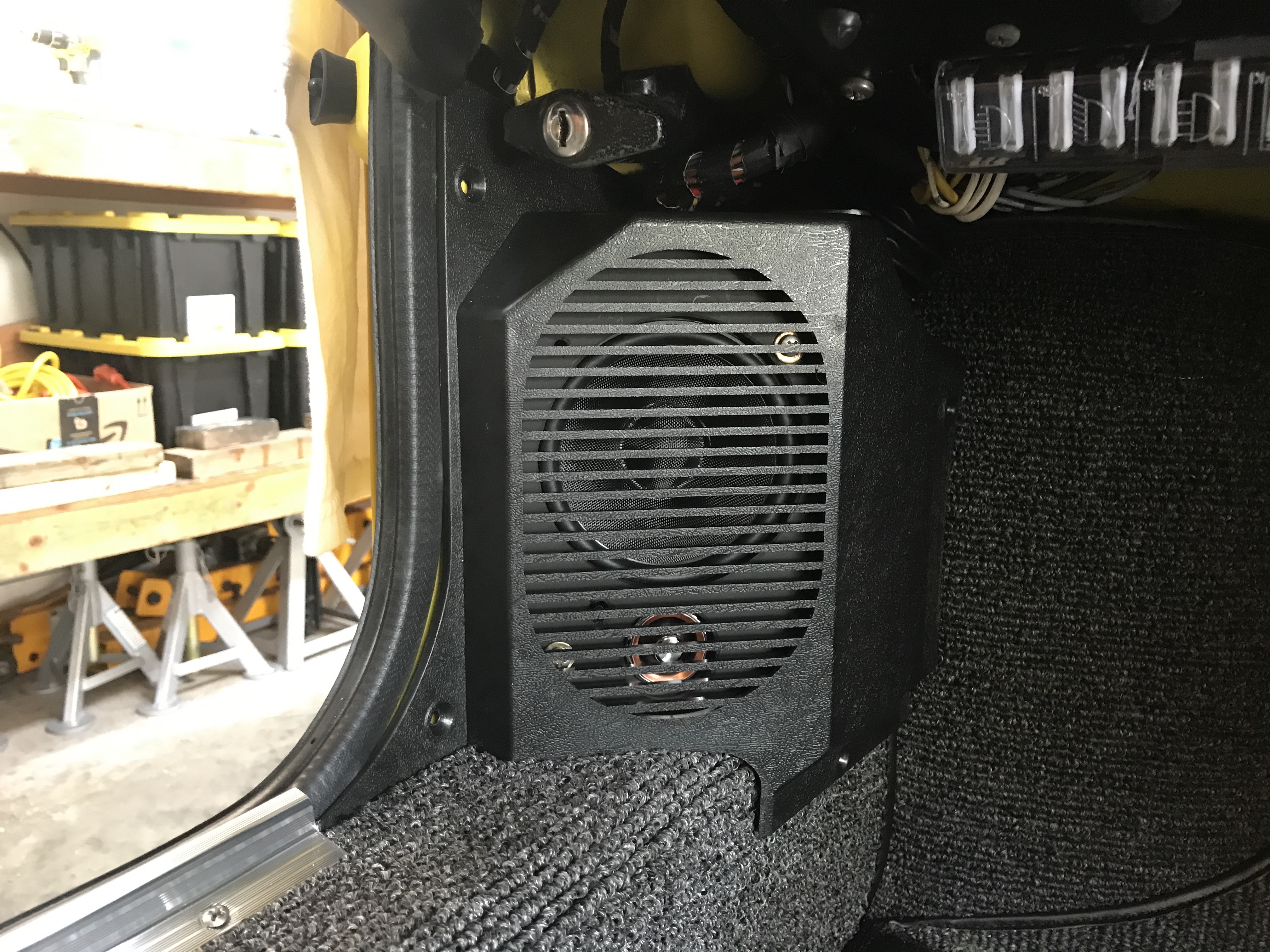

Here is version 2. Like Brent, I moved the mounting board to sit on the back side of the speaker plate.
post Jul 26 2021, 07:14 PM
Post #3439
Posts: 8,800
Modified boards, repainted.
post Jul 26 2021, 07:16 PM
Post #3440
Posts: 8,800

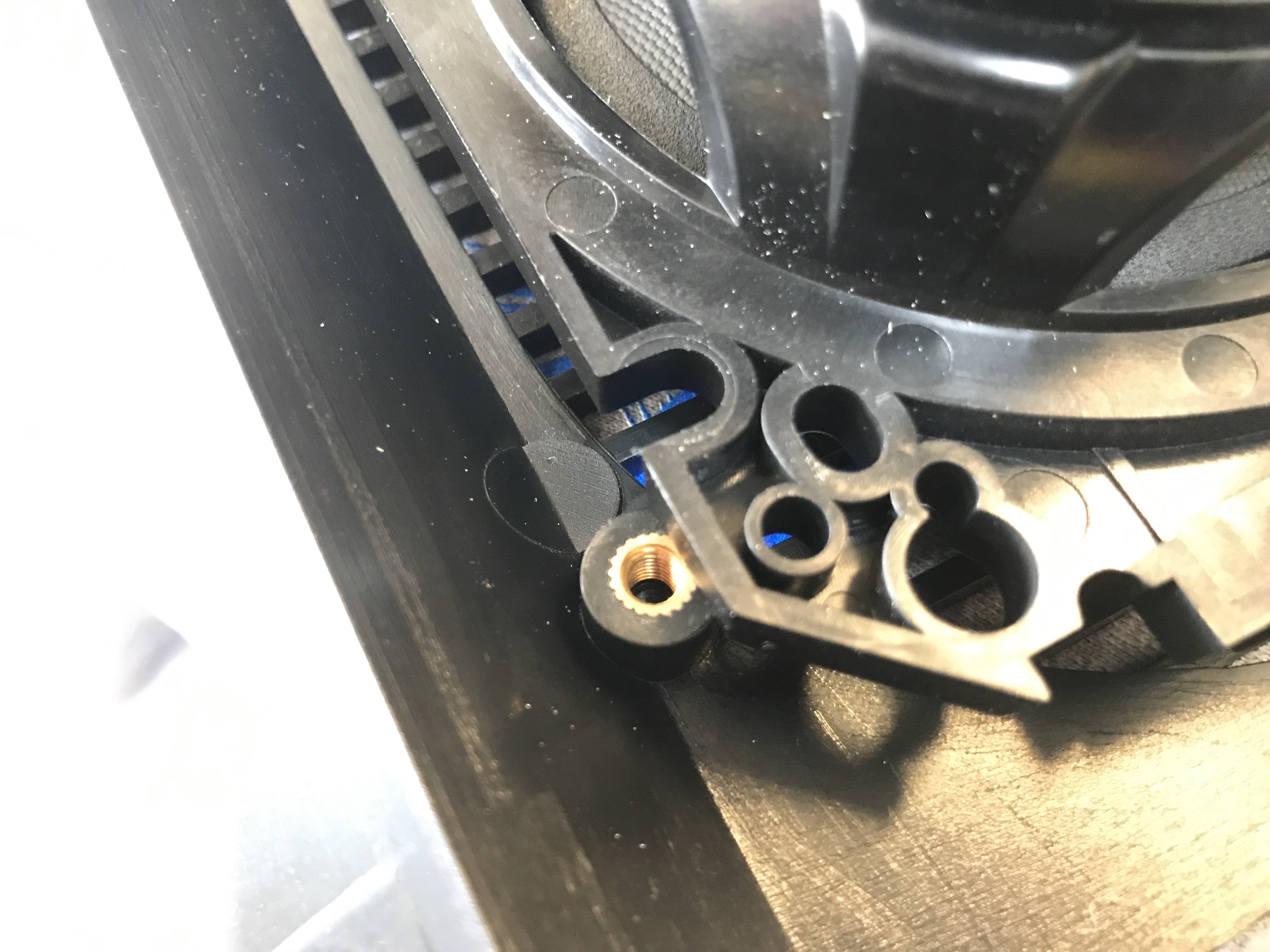

One more mod: for the speaker to sit closer to the grill, it has to sit between the pod mounting studs. But the speaker plate is about 4 mm too wide.
