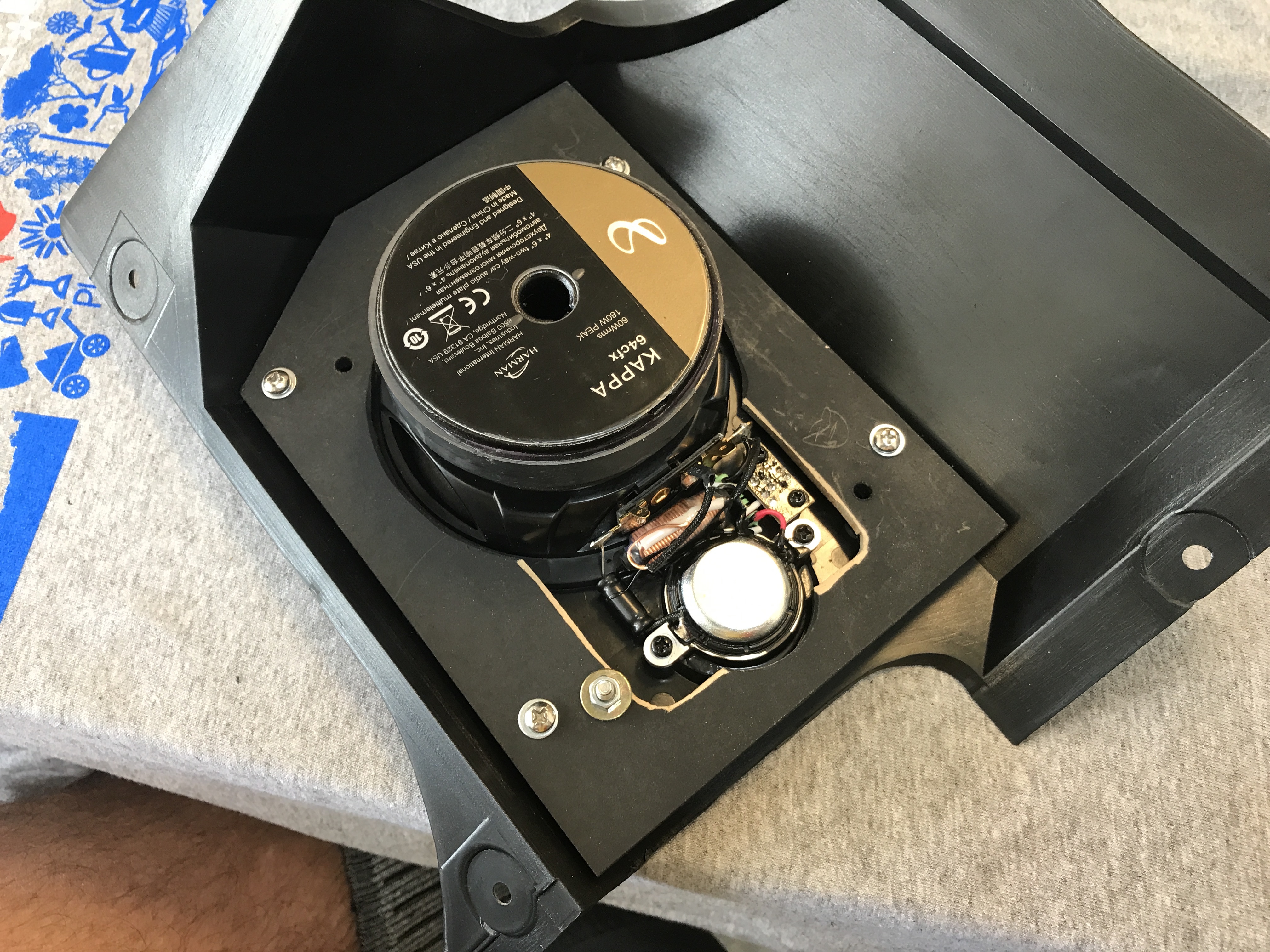

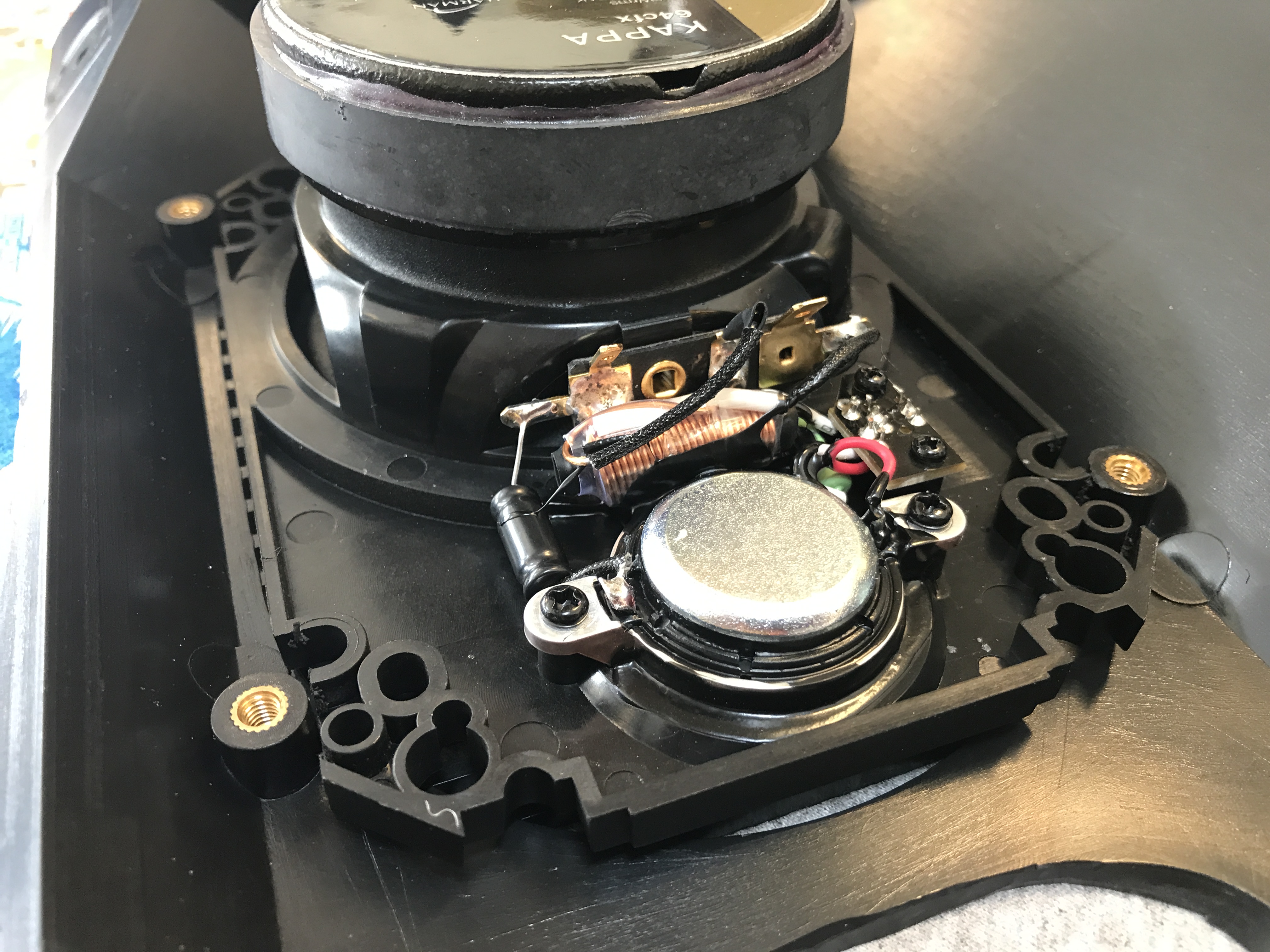

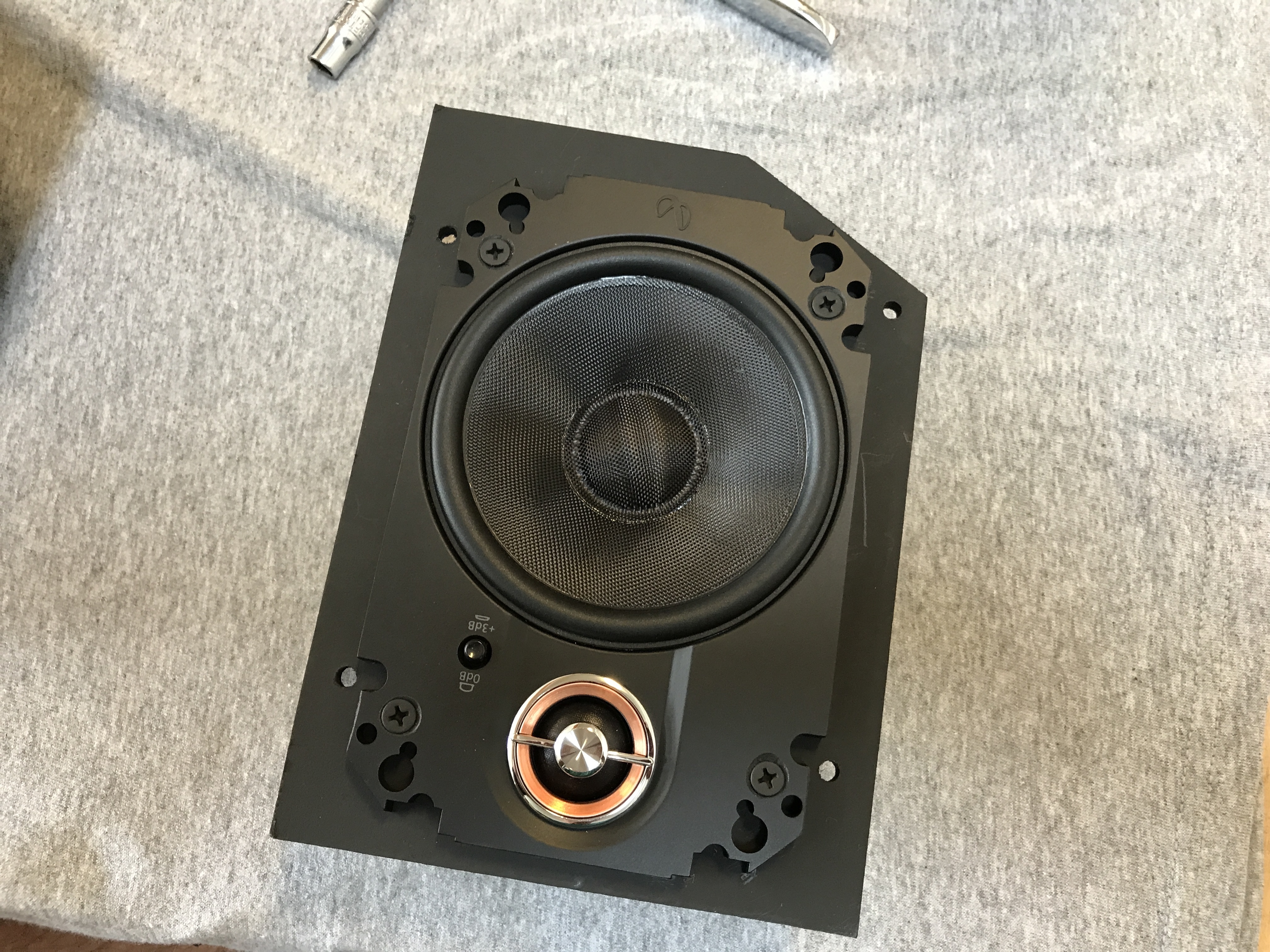

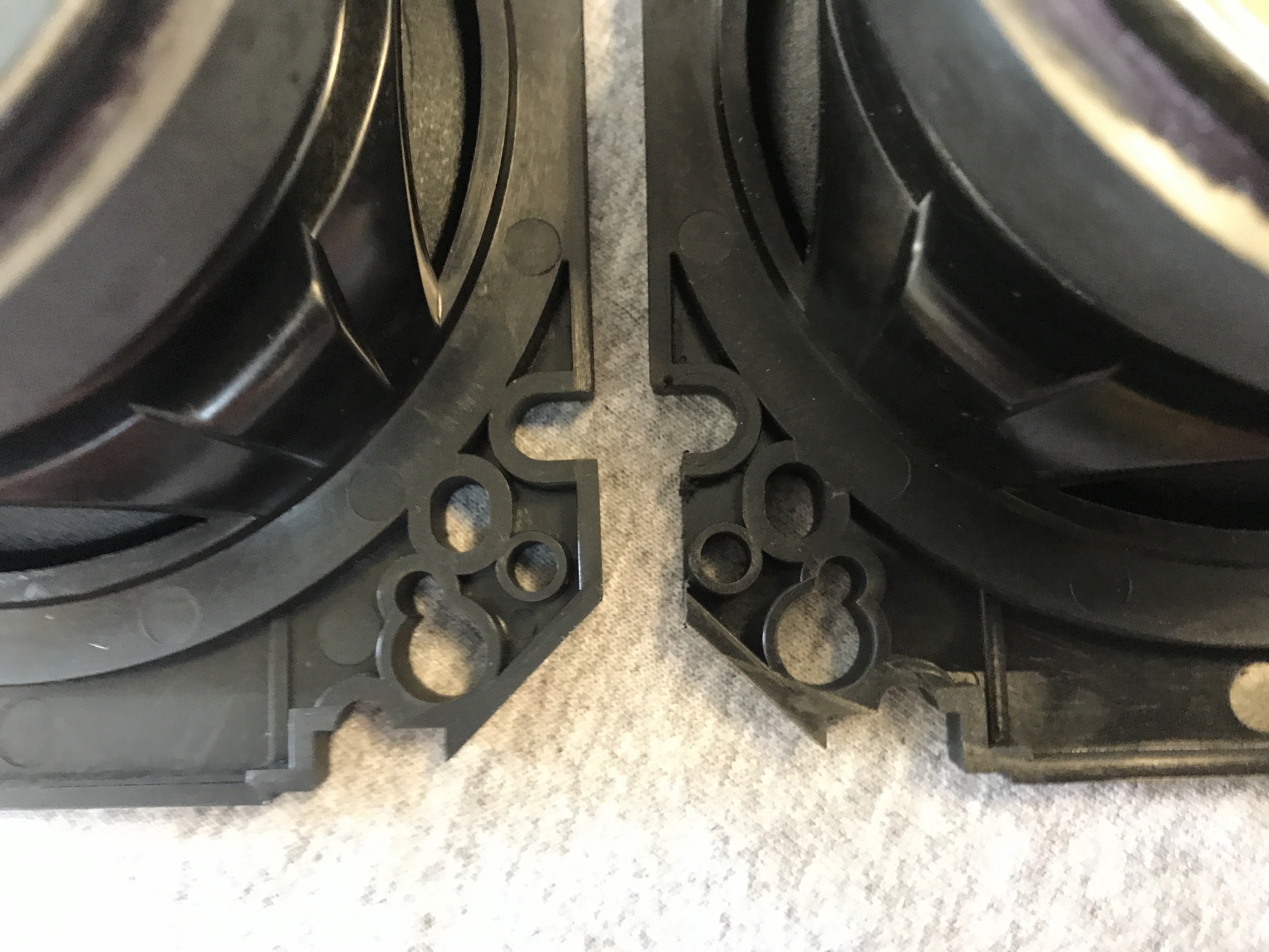

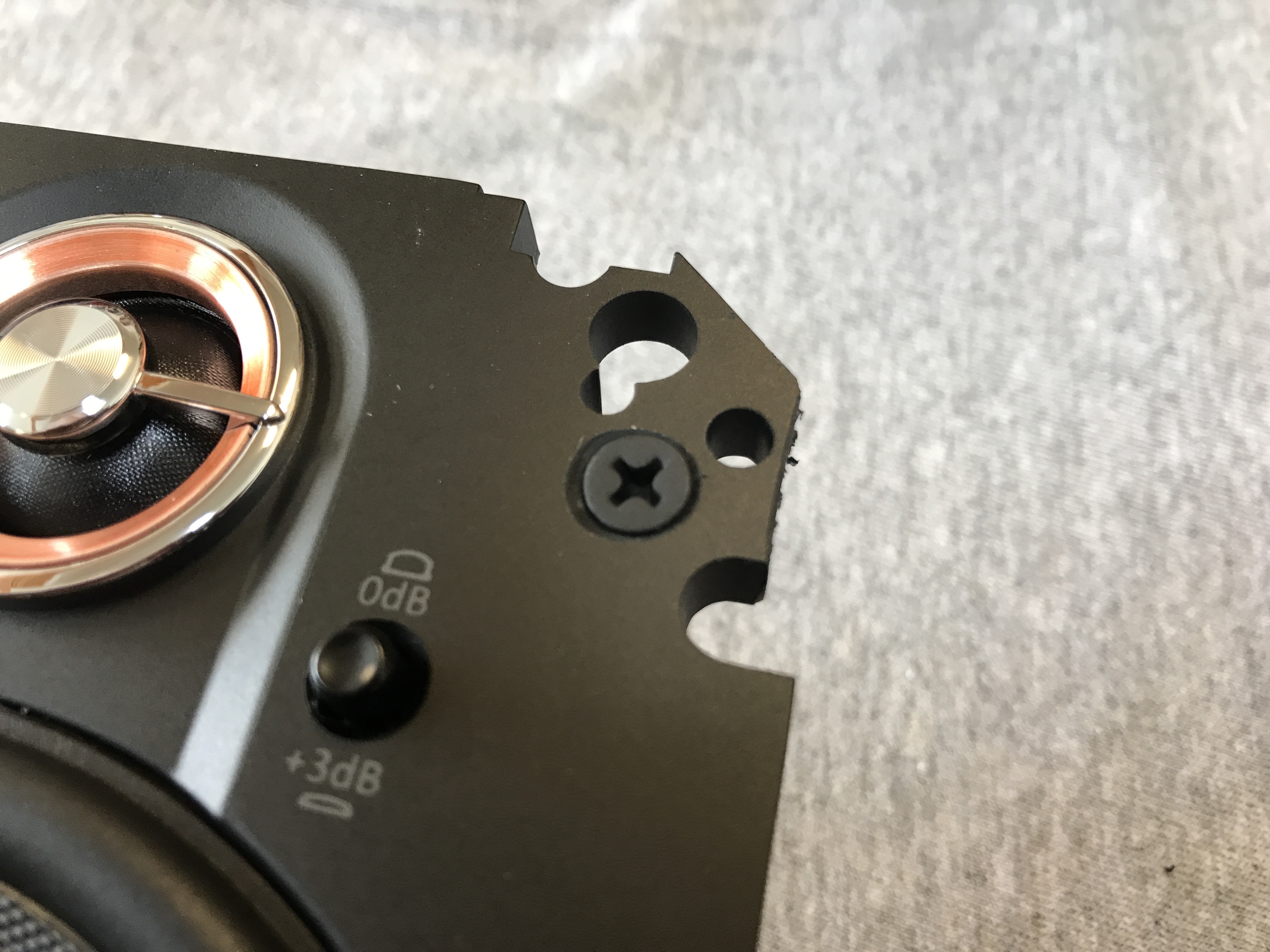

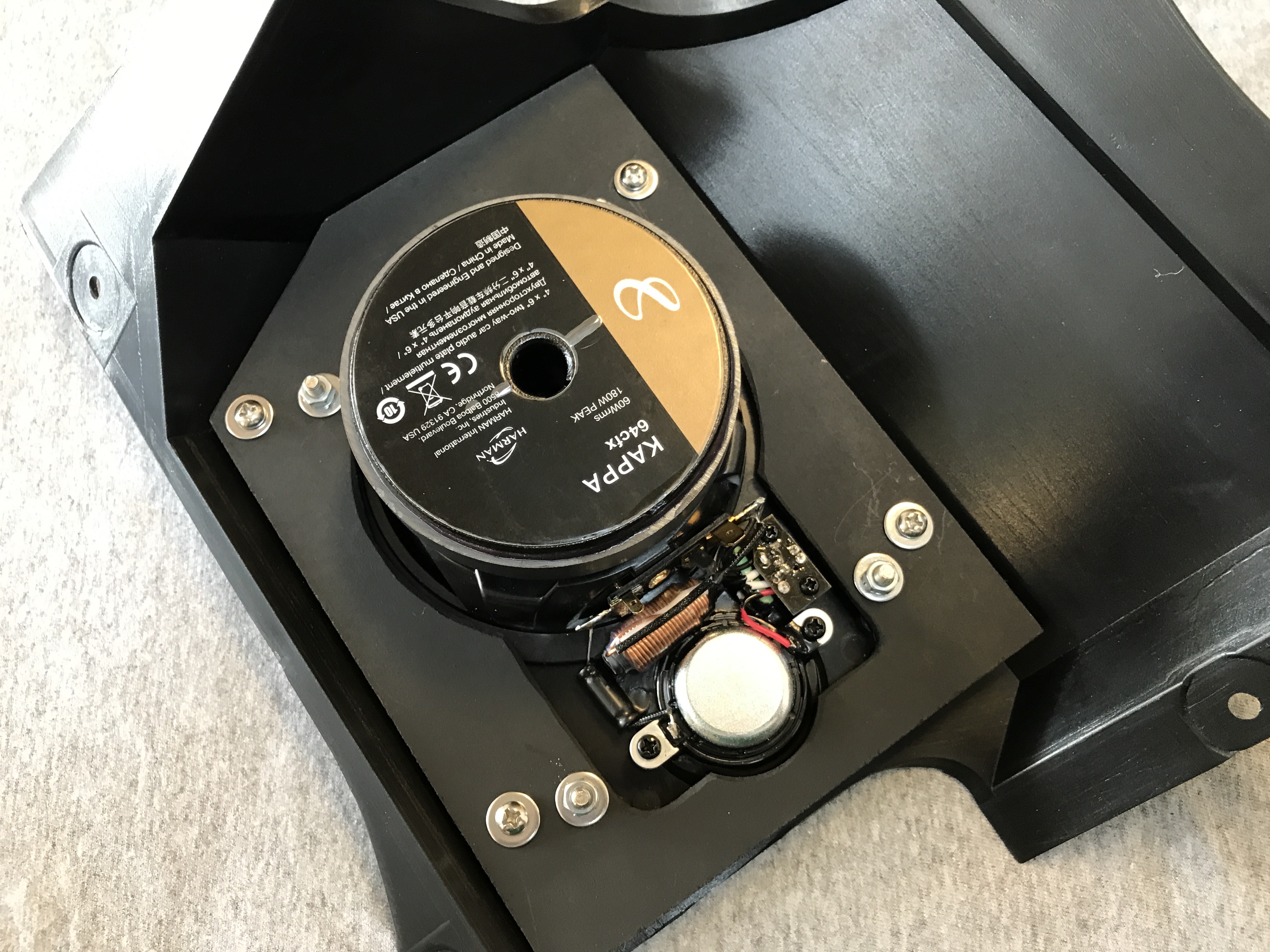

So, a quick trim of the speaker plate. Original on the left, trimmed on the right.
bkrantz
post Jul 26 2021, 07:18 PM
Post #3442
Posts: 8,800
Joined: 3-August 19
From: SW Colorado
Member No.: 23,343
Now the speaker fits between the studs, and can sit flush on the inside of the grill.
bkrantz
post Jul 26 2021, 07:20 PM
Post #3443
Posts: 8,800
Joined: 3-August 19
From: SW Colorado
Member No.: 23,343
So now the speaker and the pod mount to the same side of the board. There is still a bit of space between the grill and the speaker.
bkrantz
post Jul 26 2021, 07:22 PM
Post #3444
Posts: 8,800
Joined: 3-August 19
From: SW Colorado
Member No.: 23,343
Now the speaker magnet protrudes just a little bit. But that's OK because...

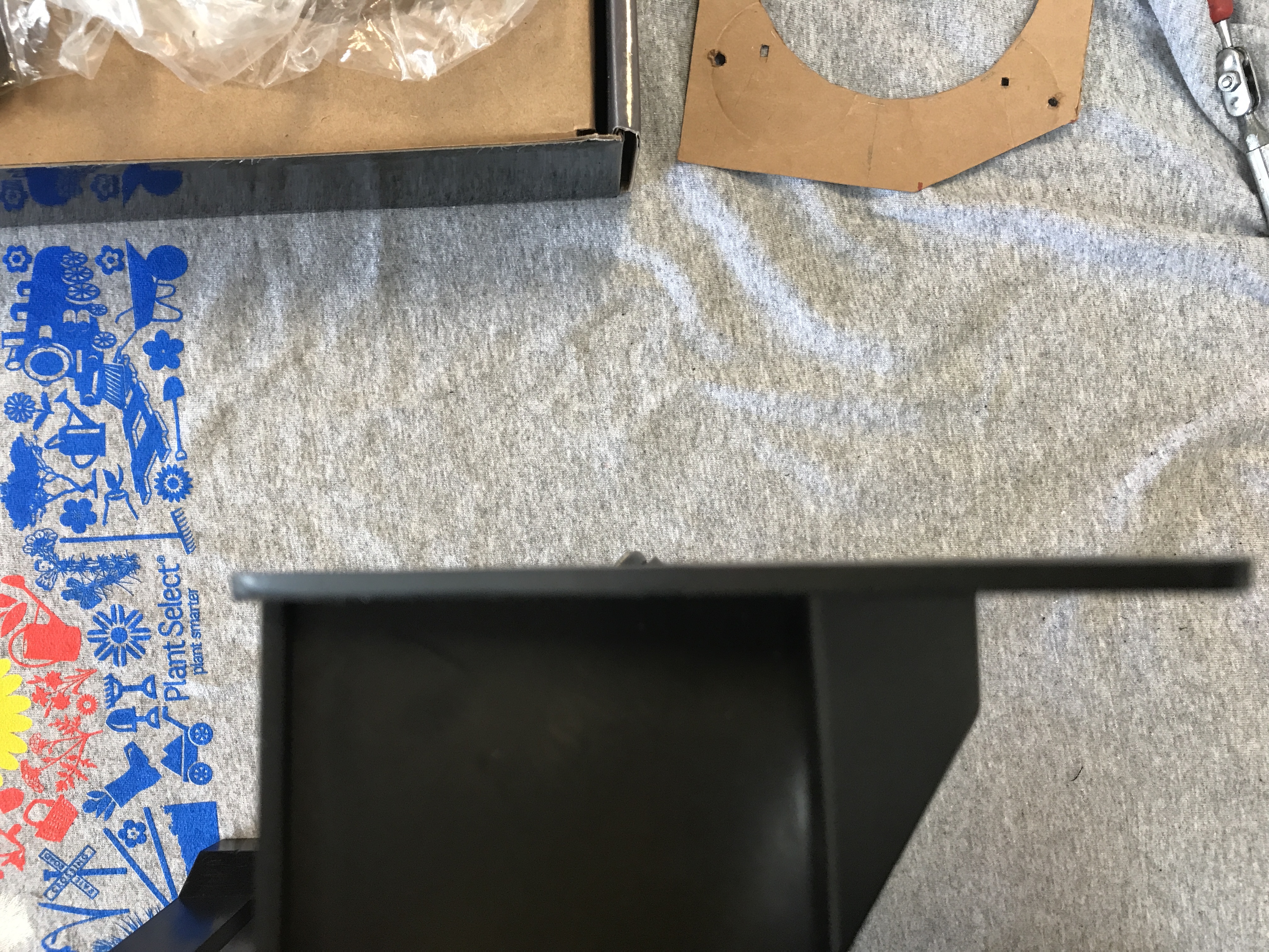

bkrantz
post Jul 26 2021, 07:23 PM
Post #3445
Posts: 8,800
Joined: 3-August 19
From: SW Colorado
Member No.: 23,343

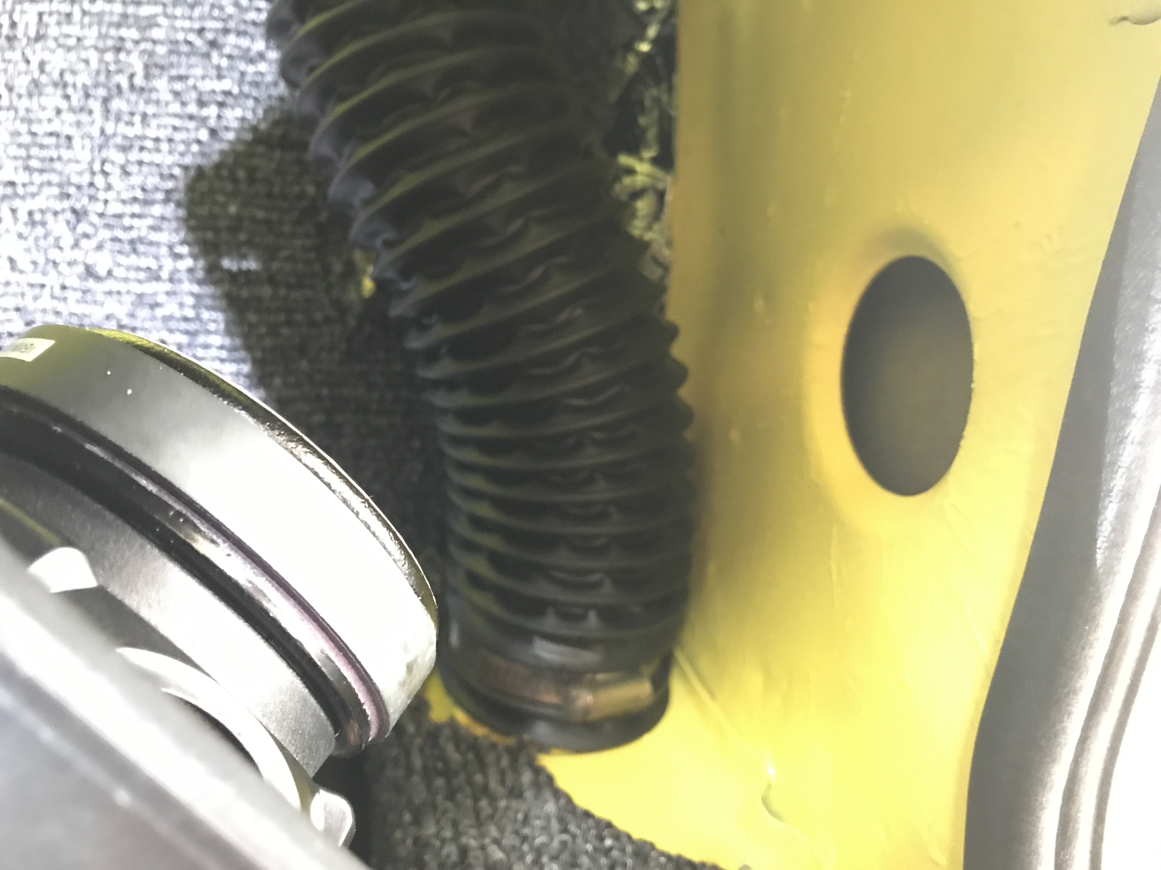

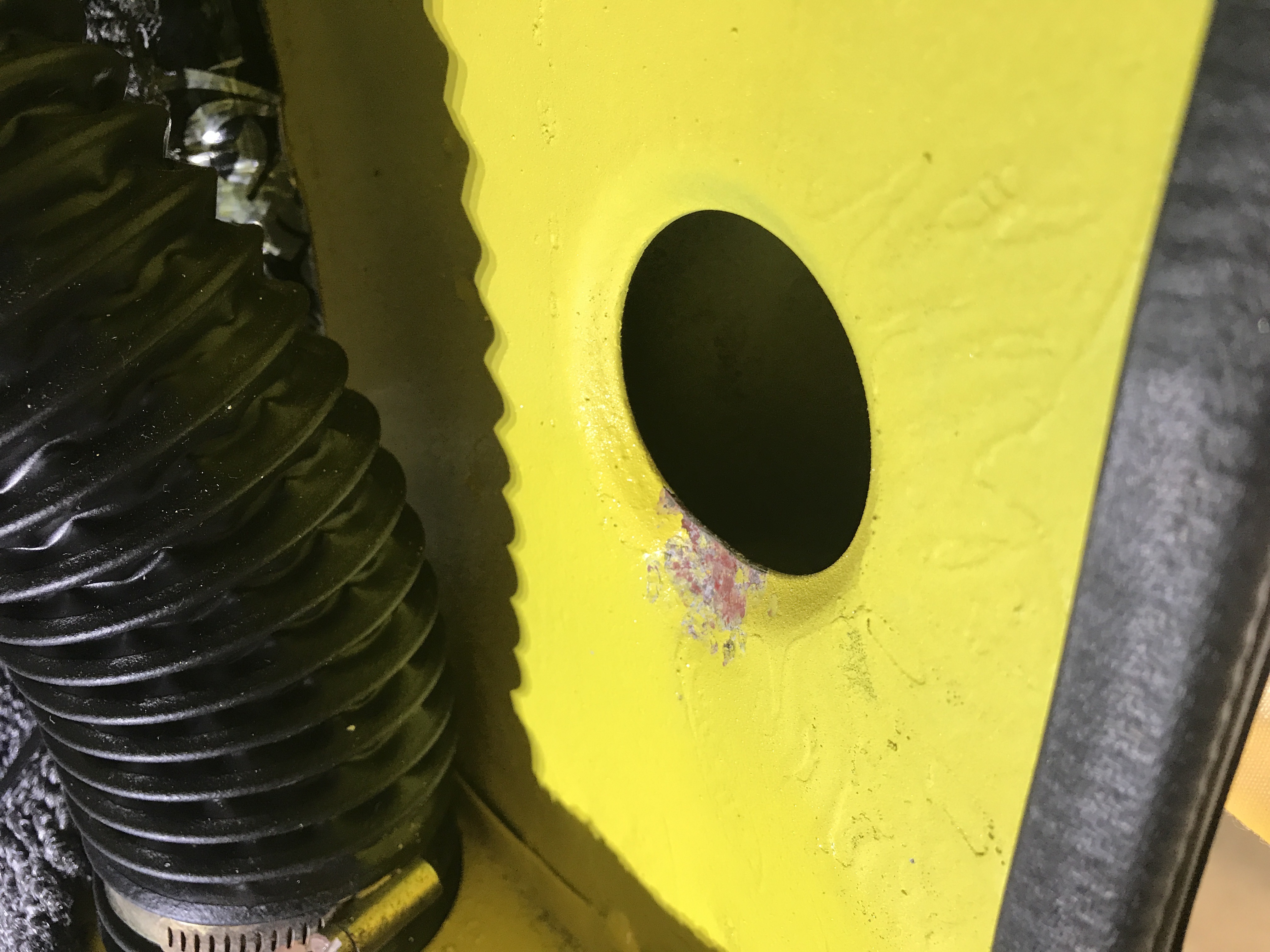

With the tweeter down, the mid range magnet almost aligns with the body panel hole.

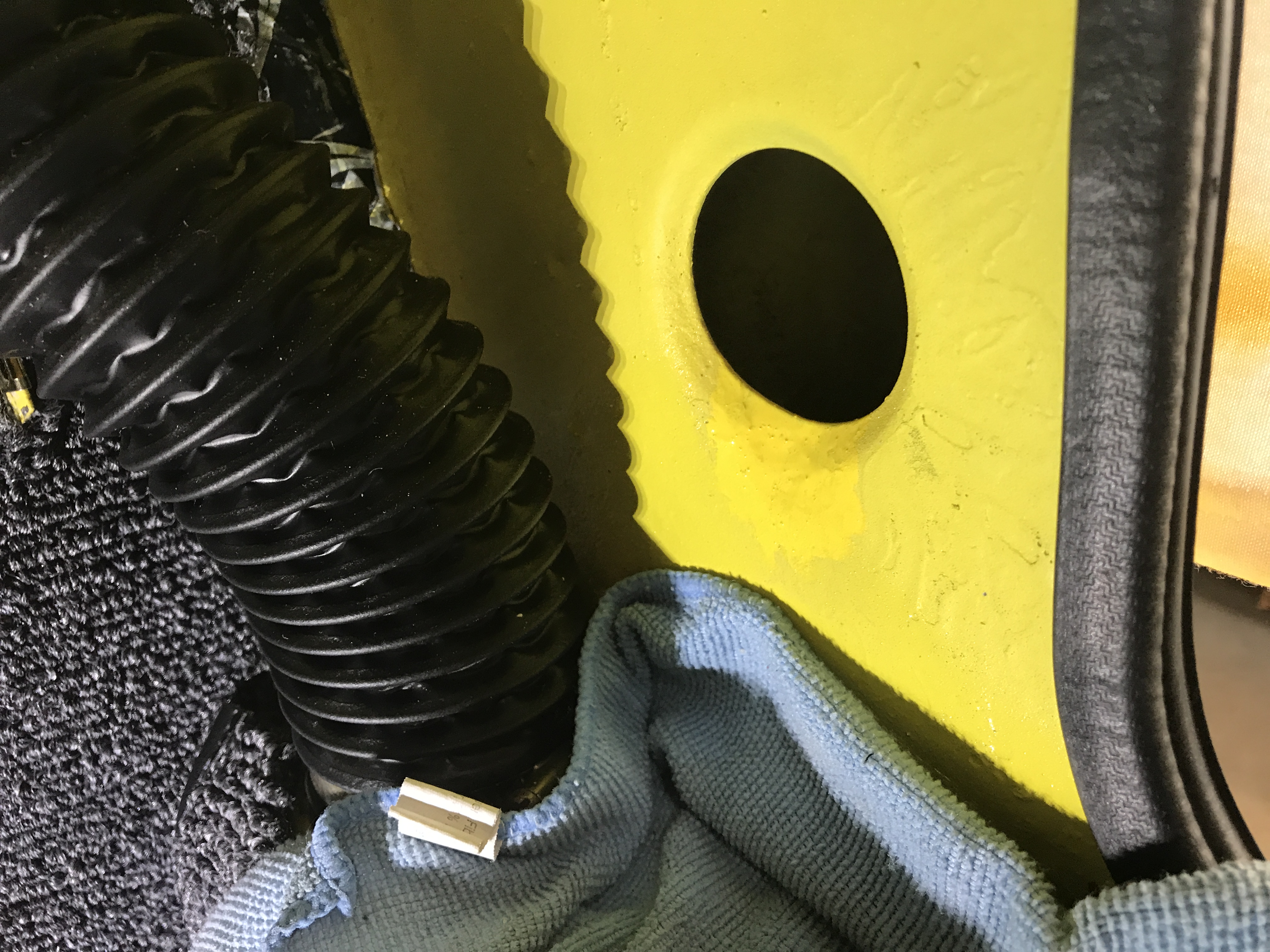

bkrantz
post Jul 26 2021, 07:24 PM
Post #3446
Posts: 8,800
Joined: 3-August 19
From: SW Colorado
Member No.: 23,343

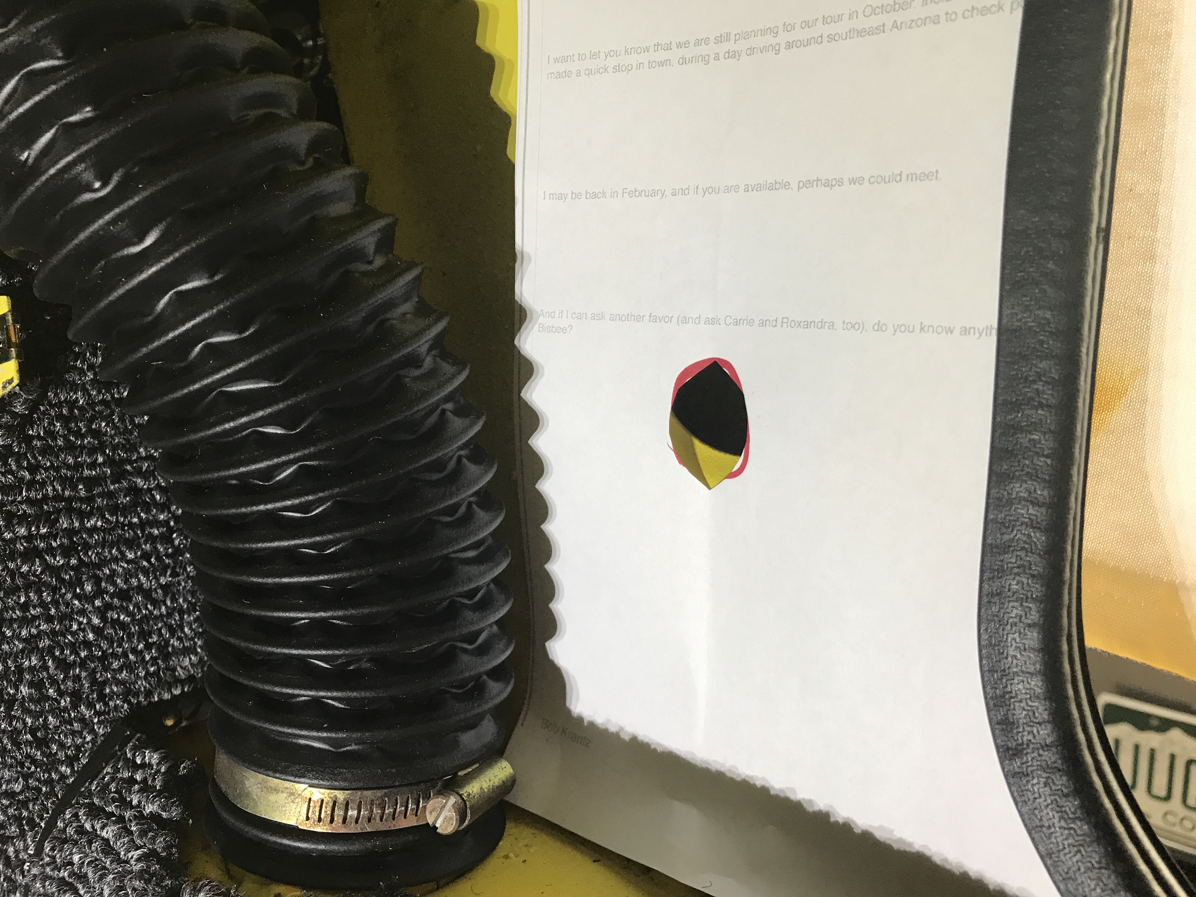

The paper template shows where the magnet projects, near the edge of the body hole.
bkrantz
post Jul 26 2021, 07:26 PM
Post #3447
Posts: 8,800
Joined: 3-August 19
From: SW Colorado
Member No.: 23,343
Just a quick bit of hammer work to ease the lower edge of the hole into the body cavity.
bkrantz
post Jul 26 2021, 07:28 PM
Post #3448
Posts: 8,800
Joined: 3-August 19
From: SW Colorado
Member No.: 23,343
A bit of paint touch-up.

bkrantz
post Jul 28 2021, 08:13 PM
Post #3450
Posts: 8,800
Joined: 3-August 19
From: SW Colorado
Member No.: 23,343
I counter-sunk the holes on the front of the speaker.
bkrantz
post Jul 28 2021, 08:14 PM
Post #3451
Posts: 8,800
Joined: 3-August 19
From: SW Colorado
Member No.: 23,343
Speaker mounted to board.

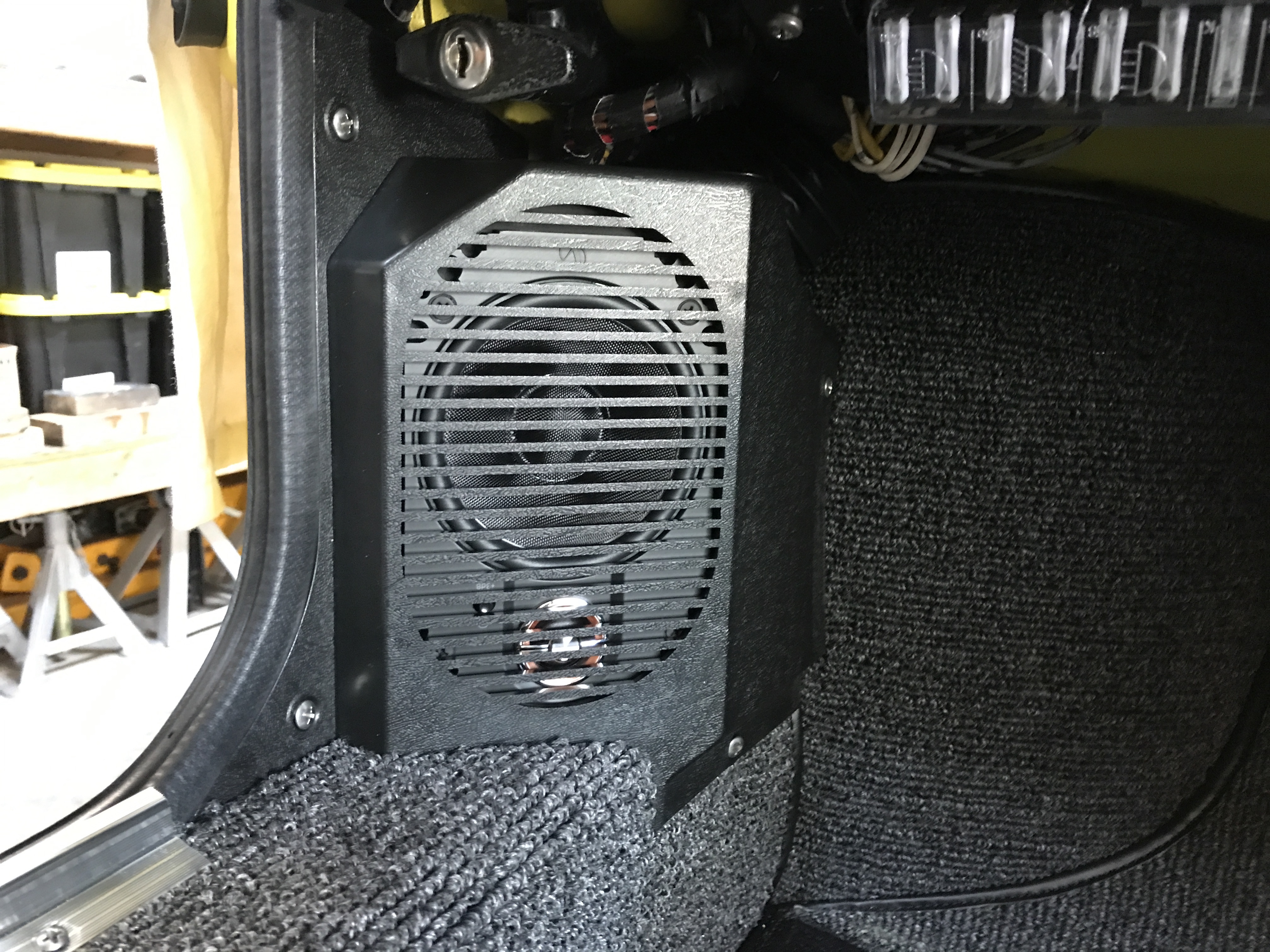

bkrantz
post Jul 28 2021, 08:15 PM
Post #3452
Posts: 8,800
Joined: 3-August 19
From: SW Colorado
Member No.: 23,343

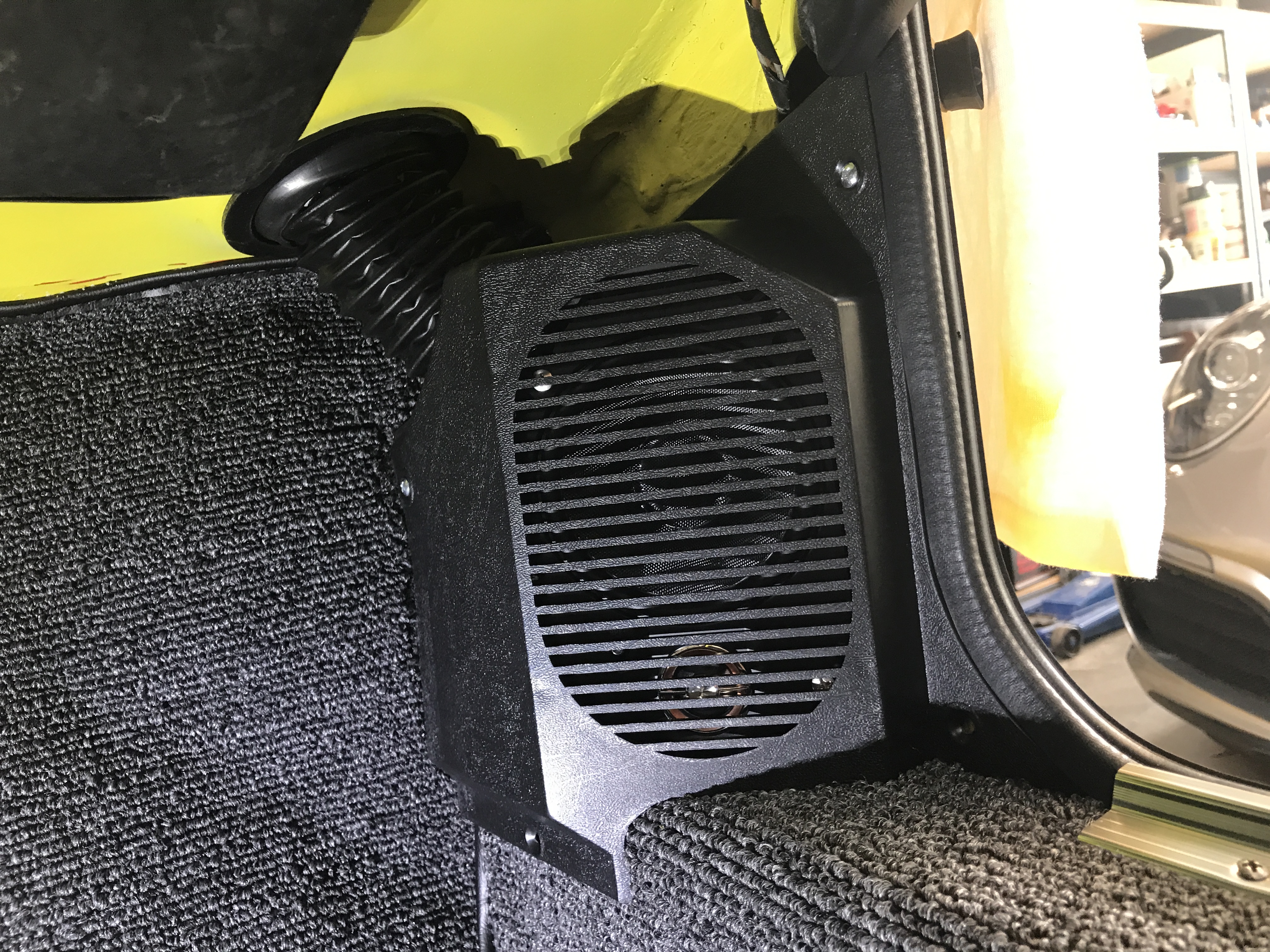

Board and speaker mounted to pod.
bkrantz
post Jul 28 2021, 08:16 PM
Post #3453
Posts: 8,800
Joined: 3-August 19
From: SW Colorado
Member No.: 23,343
Pod, board, and speaker mounted to car.
djway
post Jul 28 2021, 10:05 PM
Post #3454
Posts: 787
Joined: 16-October 15
From: Riverside
Member No.: 19,266
Rock On
bkrantz
post Jul 29 2021, 09:19 PM
Post #3455
Posts: 8,800
Joined: 3-August 19
From: SW Colorado
Member No.: 23,343
QUOTE(djway @ Jul 28 2021, 10:05 PM) *
Rock On
Now I just need a source!

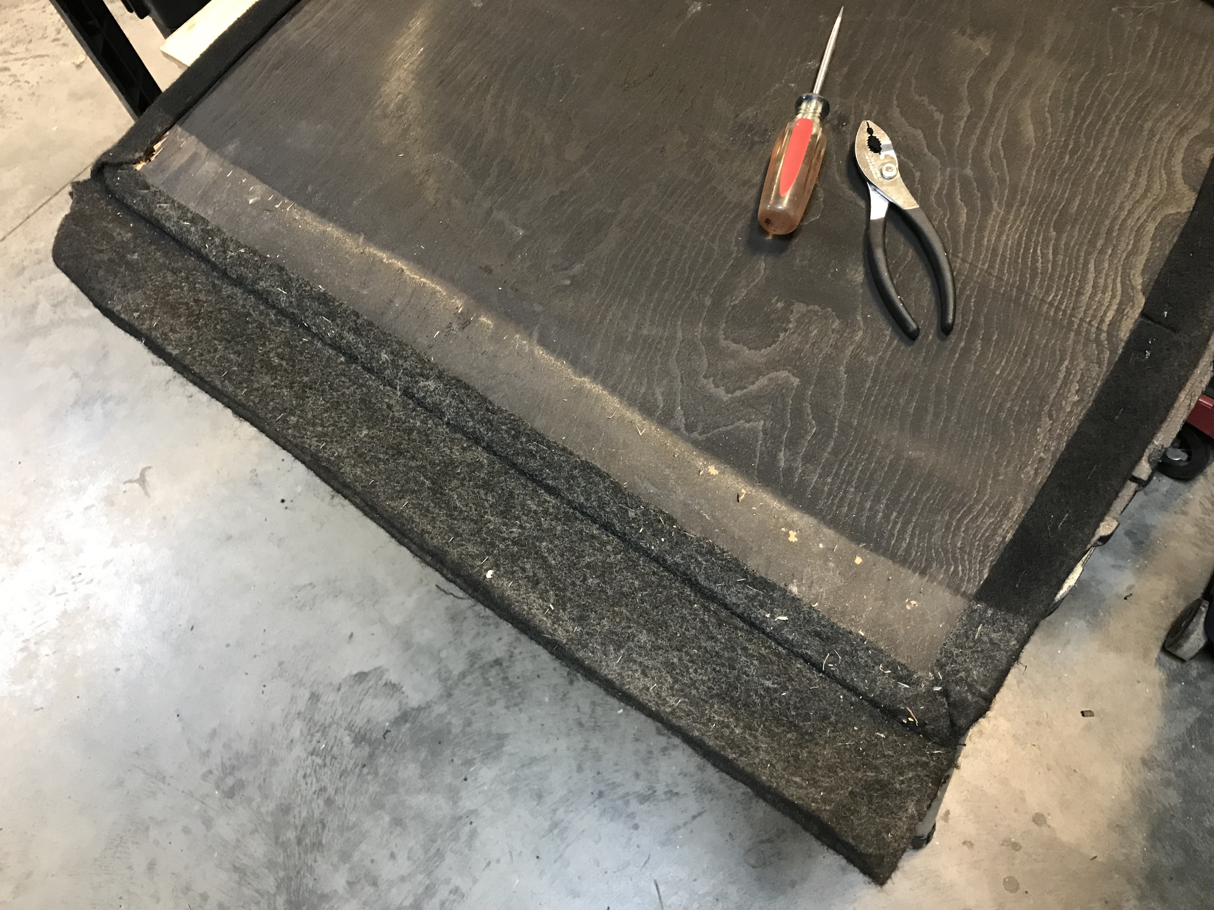

Today, I played with the frunk floor, starting with what came in my car. This looks essentially black.

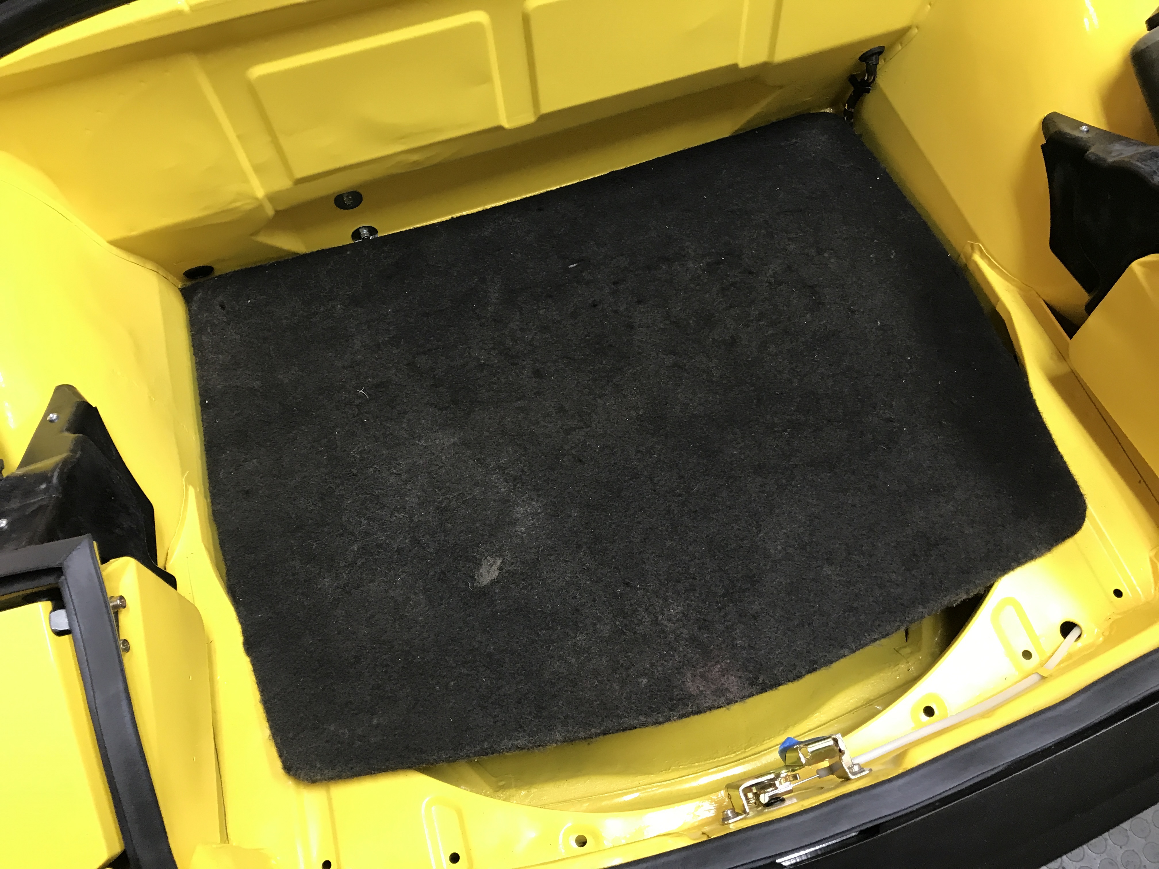

bkrantz
post Jul 29 2021, 09:24 PM
Post #3457
Posts: 8,800
Joined: 3-August 19
From: SW Colorado
Member No.: 23,343
First, I undid some PO staples along the rear edge. This exposed a flap of perlon, and the original(?) gray color.

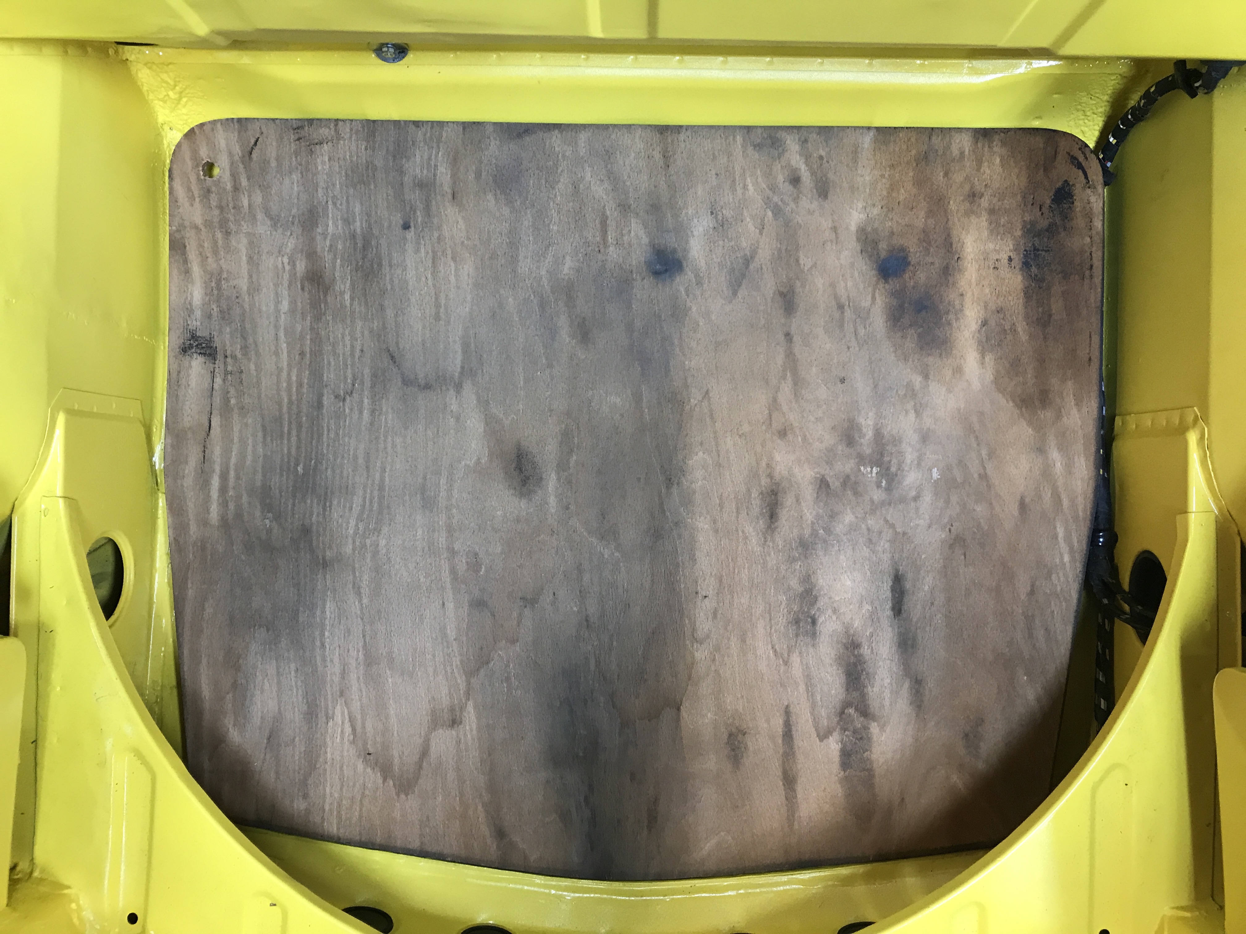

bkrantz
post Jul 29 2021, 09:27 PM
Post #3458
Posts: 8,800
Joined: 3-August 19
From: SW Colorado
Member No.: 23,343

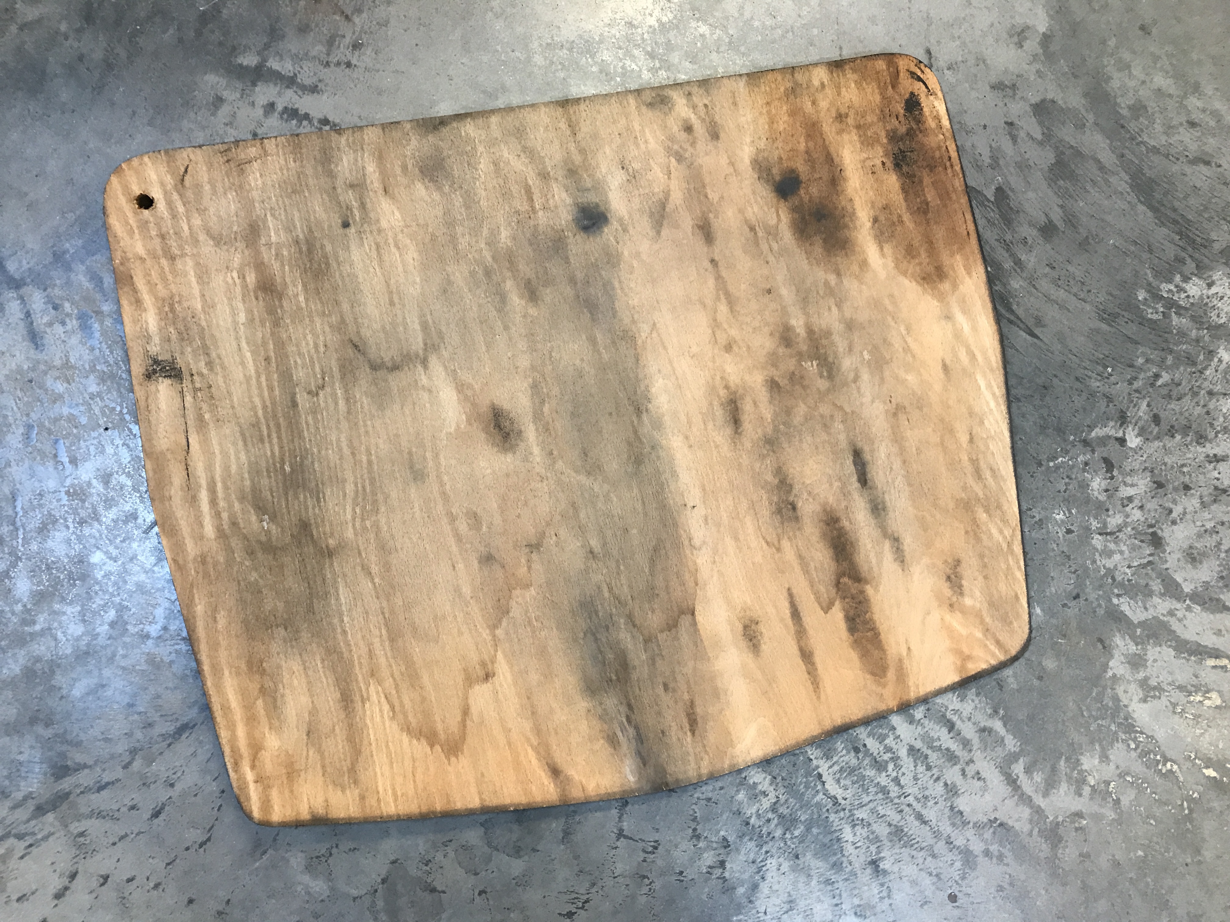

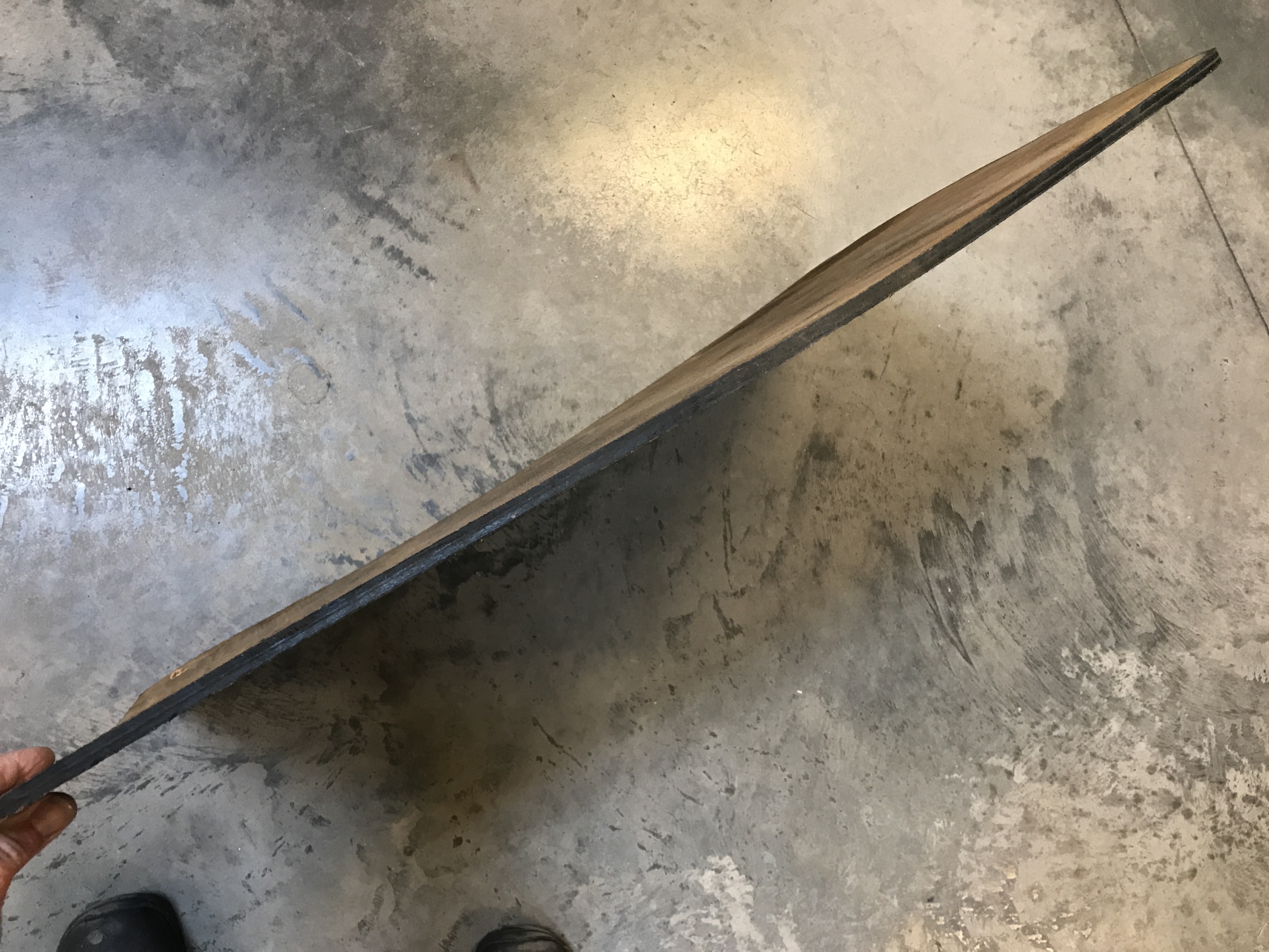

After I removed all the perlon, I exposed the plywood, that I think is OE.
bkrantz
post Jul 29 2021, 09:28 PM
Post #3459
Posts: 8,800
Joined: 3-August 19
From: SW Colorado
Member No.: 23,343
But it looks just a little warped.
bkrantz
post Jul 29 2021, 09:30 PM
Post #3460
Posts: 8,800
Joined: 3-August 19
From: SW Colorado
Member No.: 23,343
The OE plywood fits almost precisely sitting on the floor, without a spare tire in place. Of course, this means a very sloppy fit when the plywood sits on top of a spare.
