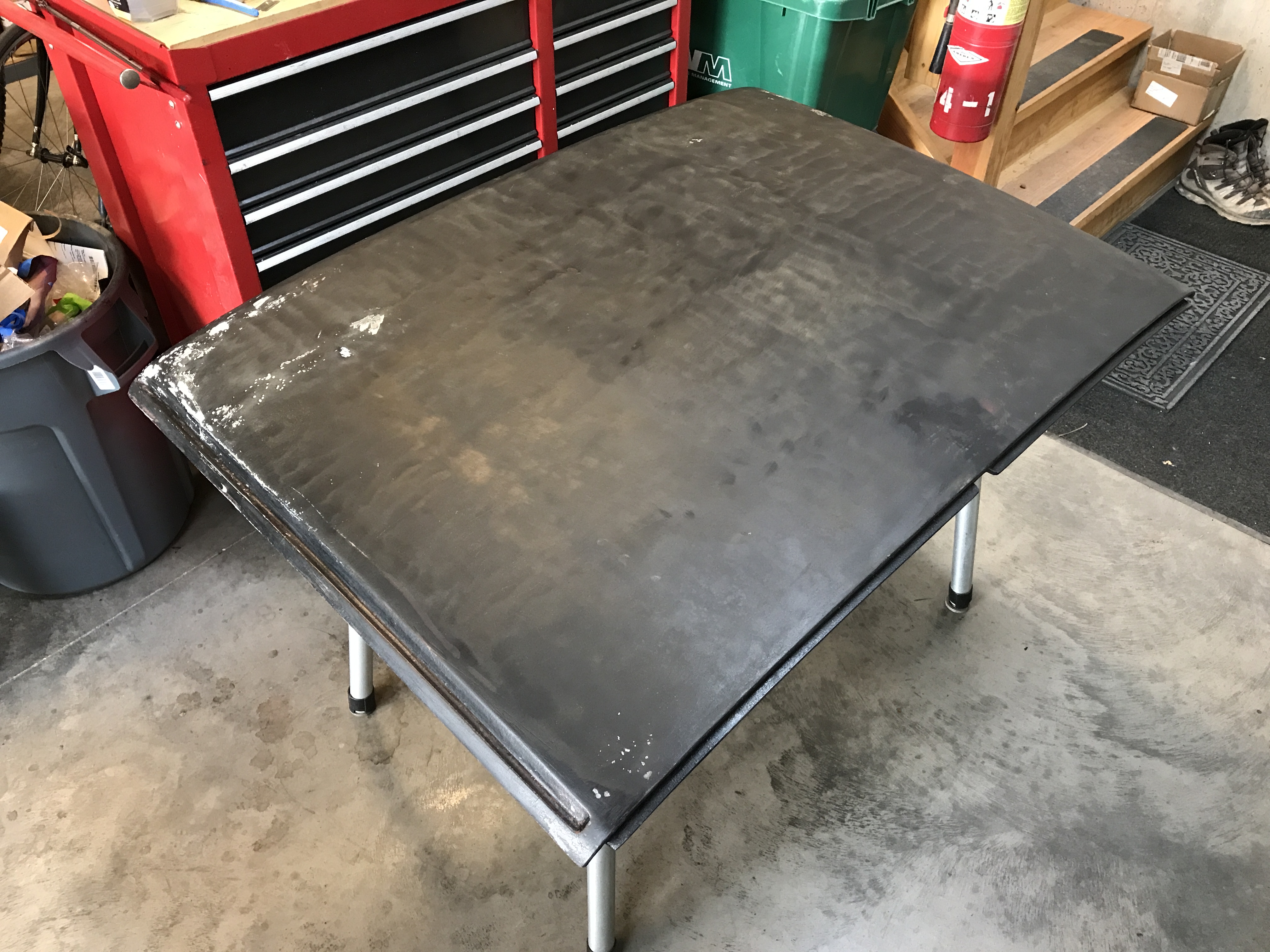

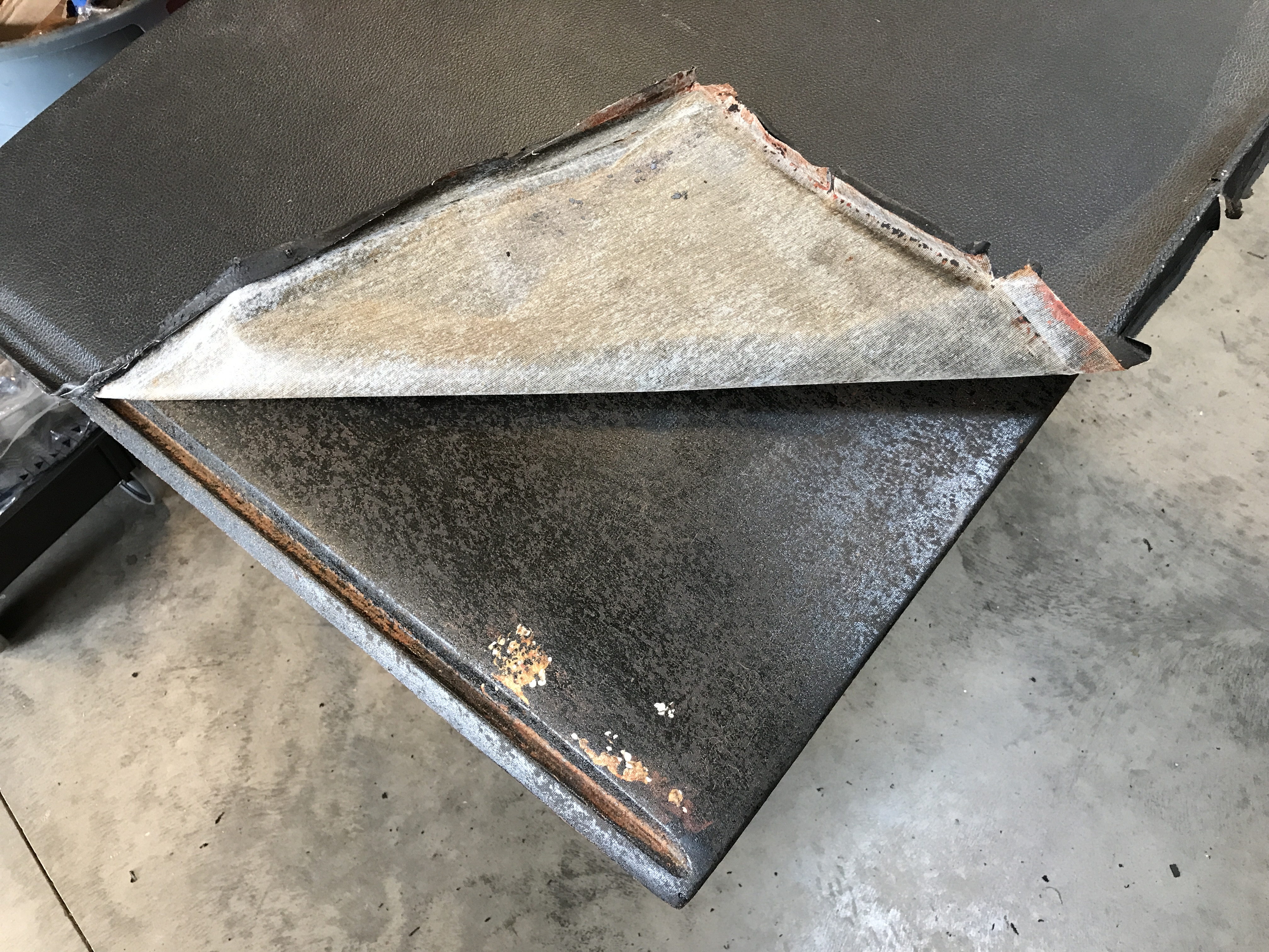

Pulling the vinyl off. Surprise! Some earlier damage.
bkrantz
post Aug 1 2021, 06:48 PM
Post #3482
Posts: 8,800
Joined: 3-August 19
From: SW Colorado
Member No.: 23,343

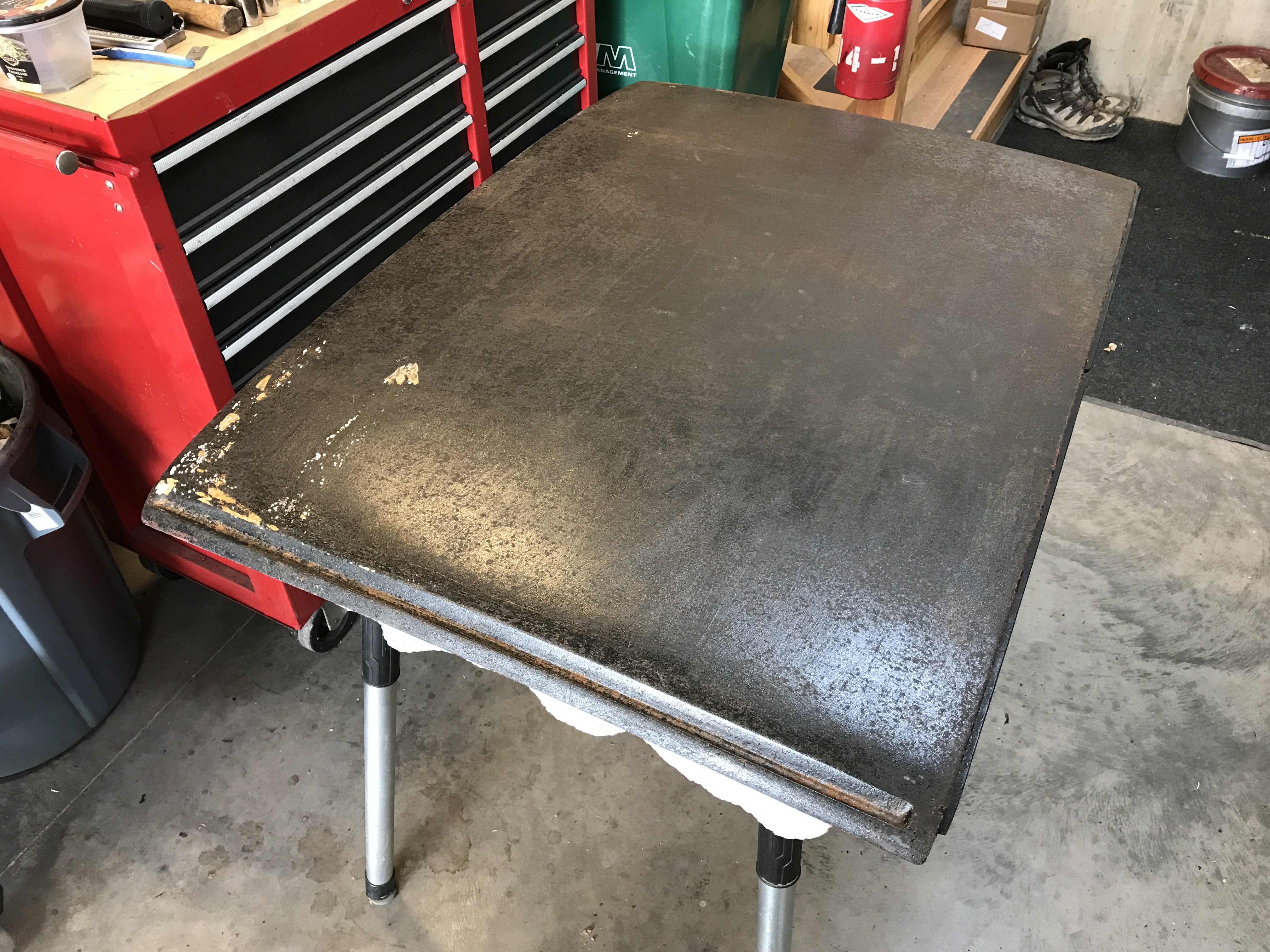

De-skinned. More damage spots and lots of dried up contact cement, that was pretty impervious to all the solvents I tried.
bkrantz
post Aug 1 2021, 06:50 PM
Post #3483
Posts: 8,800
Joined: 3-August 19
From: SW Colorado
Member No.: 23,343
After an hour with a brass wire brush. Next, I will visit my paint shop and see if they can try to duplicate the original splatter finish.

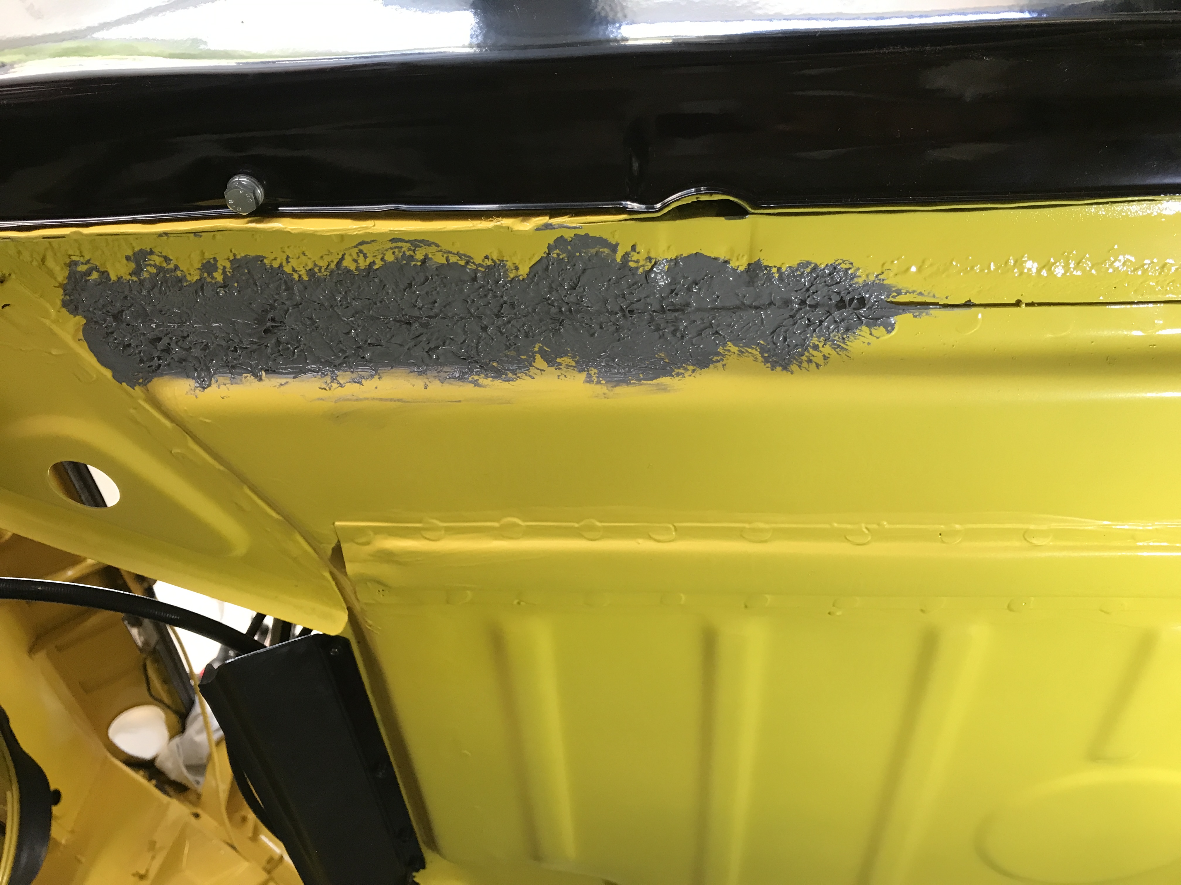

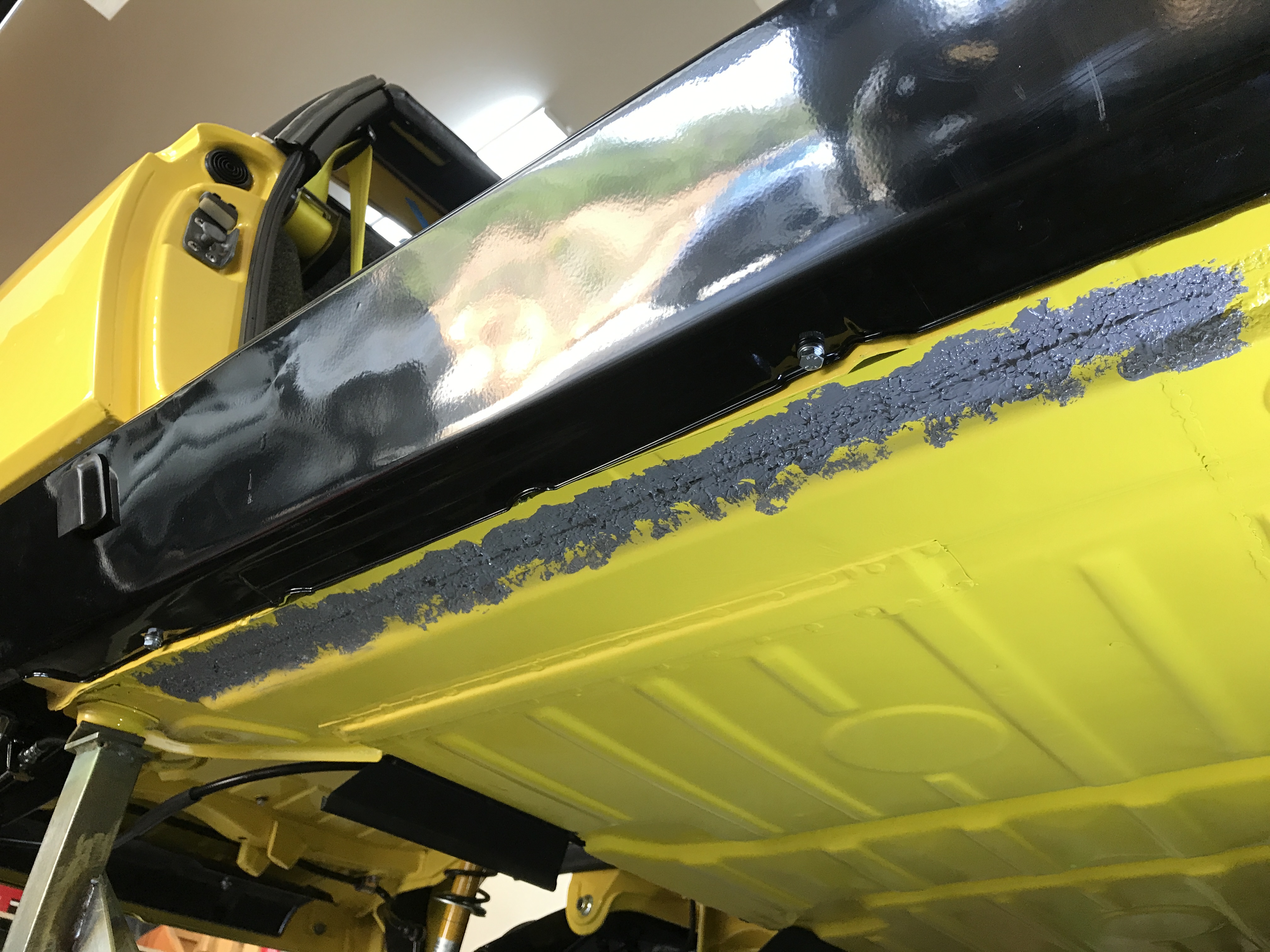

While waiting to get my engine case back, I found another diversion. When I got the body back from the paint shop, I noticed a few seams that needed more sealing. For various reasons, I did not take action early on--my bad. I went back and forth on leaving it alone, but finally decided to do something.
So, my half-baked and late plan: use some brush on seam sealer, followed by brush on primer and paint.
Here's where I started, on the right side along the edge of the new floor panel I welded in. On the right side, you can see the open seam edge. On the left, I started brushing on sealer, and then stippling it to look a little like the remaining sprayed-on sealer.
bkrantz
post Aug 2 2021, 07:56 PM
Post #3485
Posts: 8,800
Joined: 3-August 19
From: SW Colorado
Member No.: 23,343
I did both sides, plus seam across the floor between the new rear section and the original front section, and the front floor corners where I welded in patches.

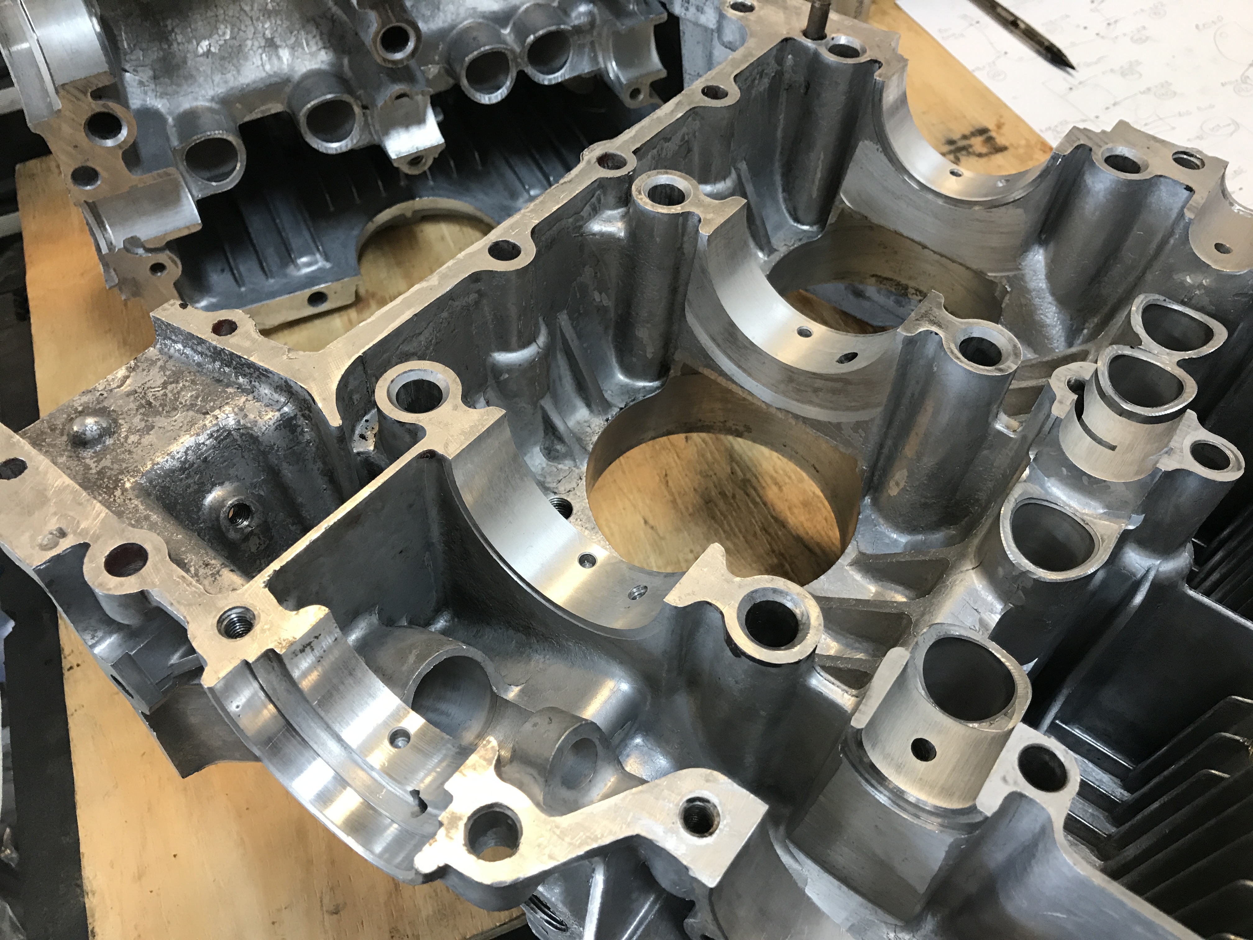

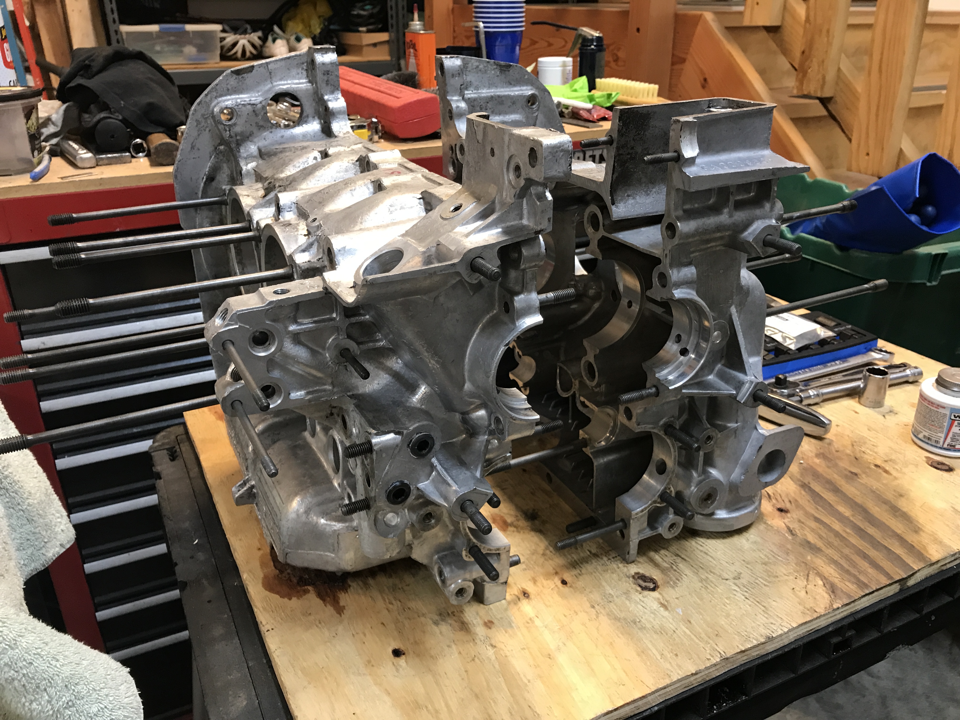

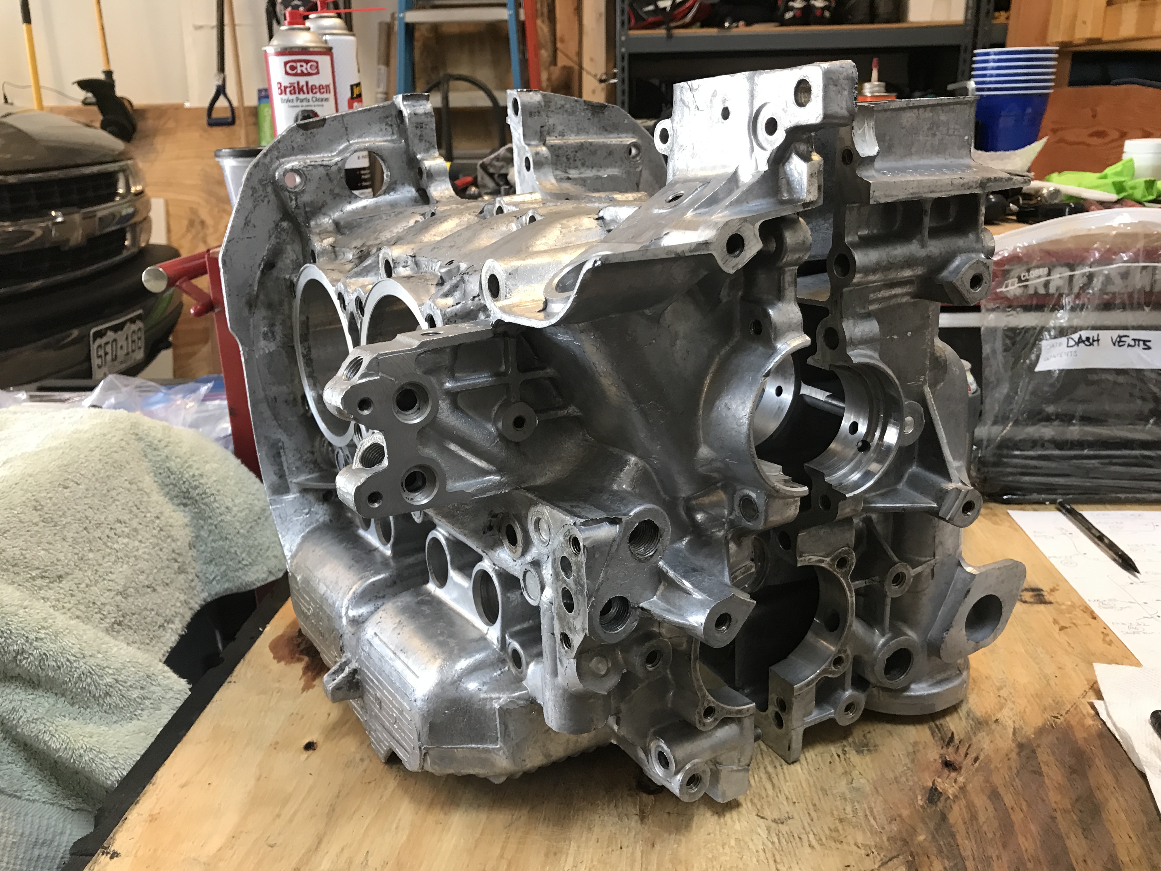

My engine case is back in the house (garage actually, but I did use the kitchen sink and sprayer to wash out any dirt and debris--don't tell my wife). Thanks to European Motorworks for rapid and quality work.
bkrantz
post Aug 3 2021, 07:28 PM
Post #3487
Posts: 8,800
Joined: 3-August 19
From: SW Colorado

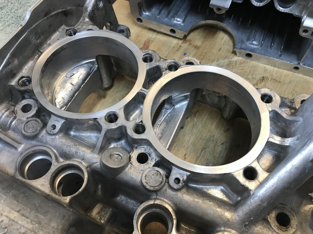

Member No.: 23,343

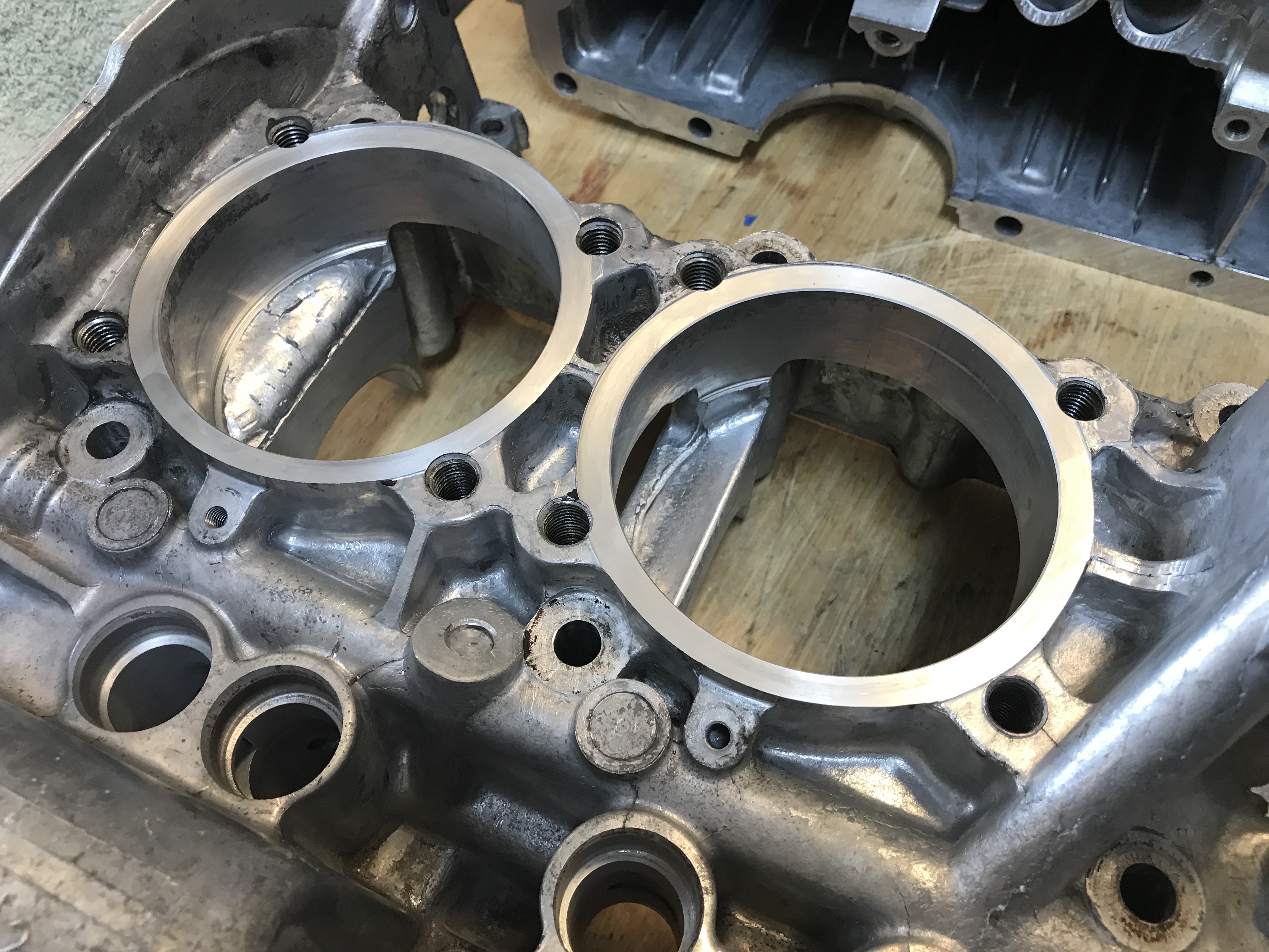

George and crew did the decking, with a wide enough cut so my AA cylinders can sit flat.
bkrantz
post Aug 3 2021, 07:30 PM
Post #3488
Posts: 8,800
Joined: 3-August 19
From: SW Colorado
Member No.: 23,343
And also did a line bore, to 0.25 mm oversize. Now I can hope again that everything will be straight.

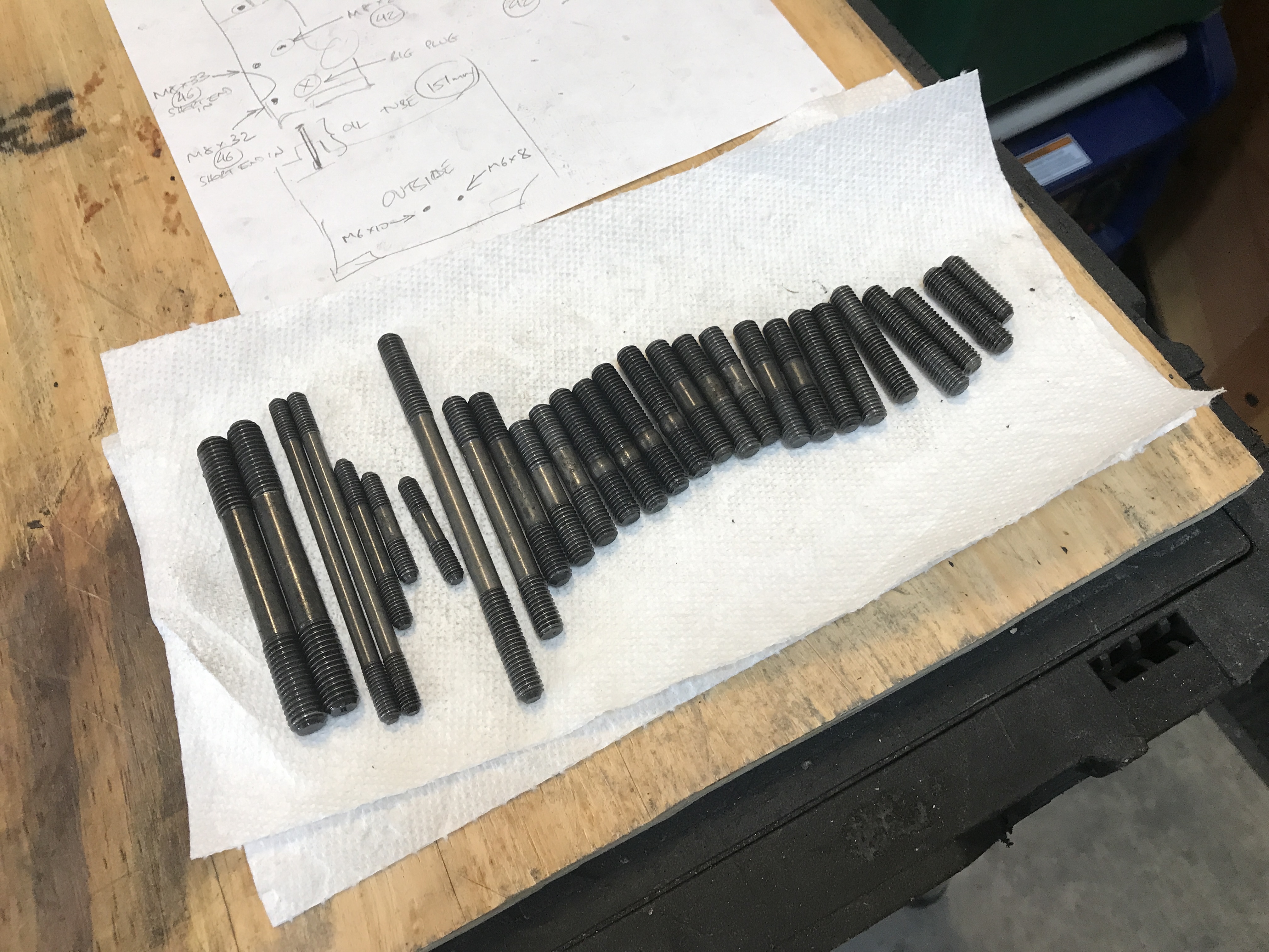

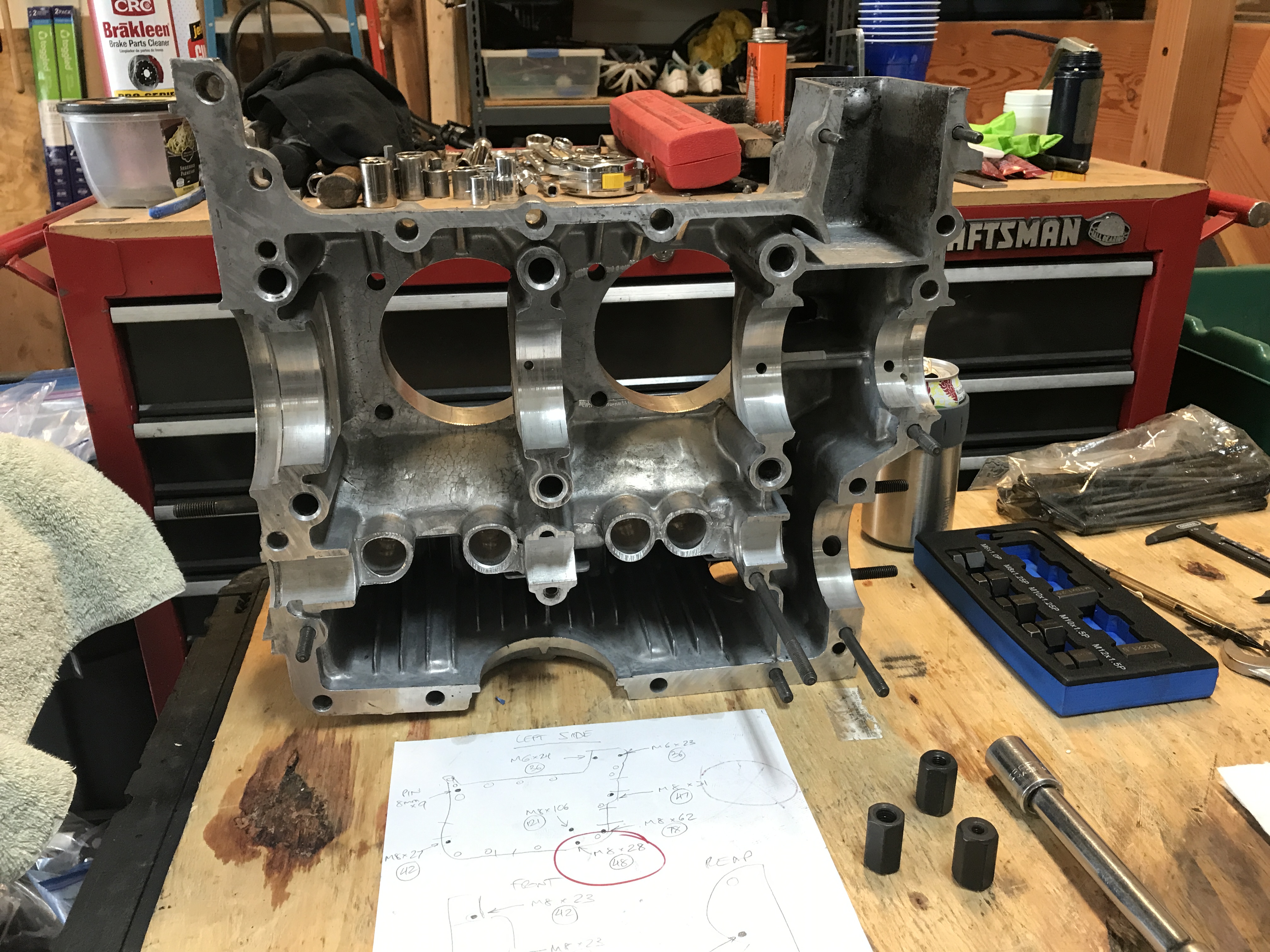

I got out all the studs I had removed and cleaned.
bkrantz
post Aug 3 2021, 07:32 PM
Post #3490
Posts: 8,800
Joined: 3-August 19
From: SW Colorado
Member No.: 23,343
And I got started installing the studs in the case halves. Good thing I took notes on locations.

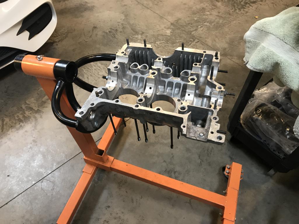

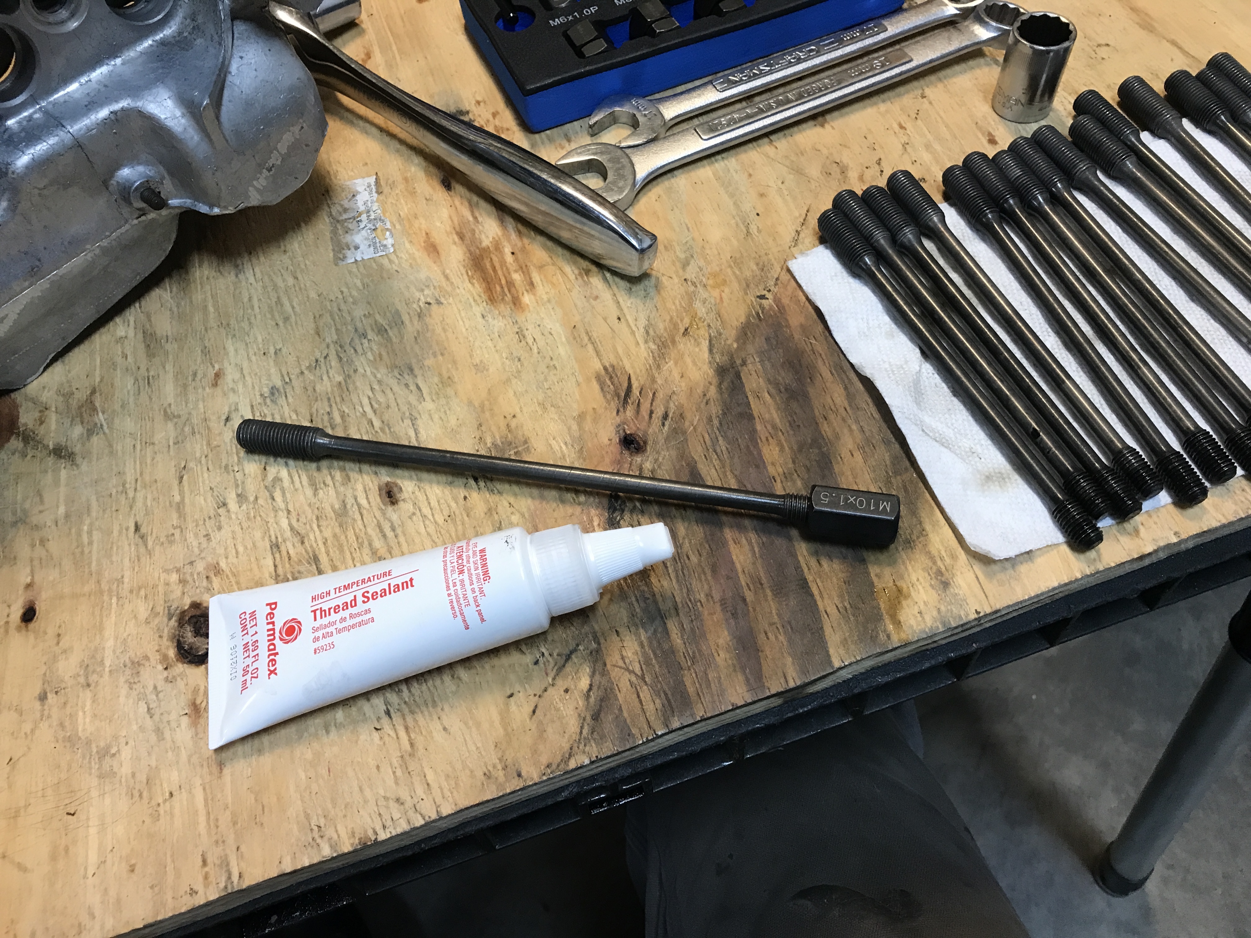

I got to work today, since I want to get the enginery assembly done ASAP so I can measure deck height.
Here are the cylinder studs ready, and new thread sealant.
bkrantz
post Aug 4 2021, 09:07 PM
Post #3496
Posts: 8,800
Joined: 3-August 19
From: SW Colorado
Member No.: 23,343

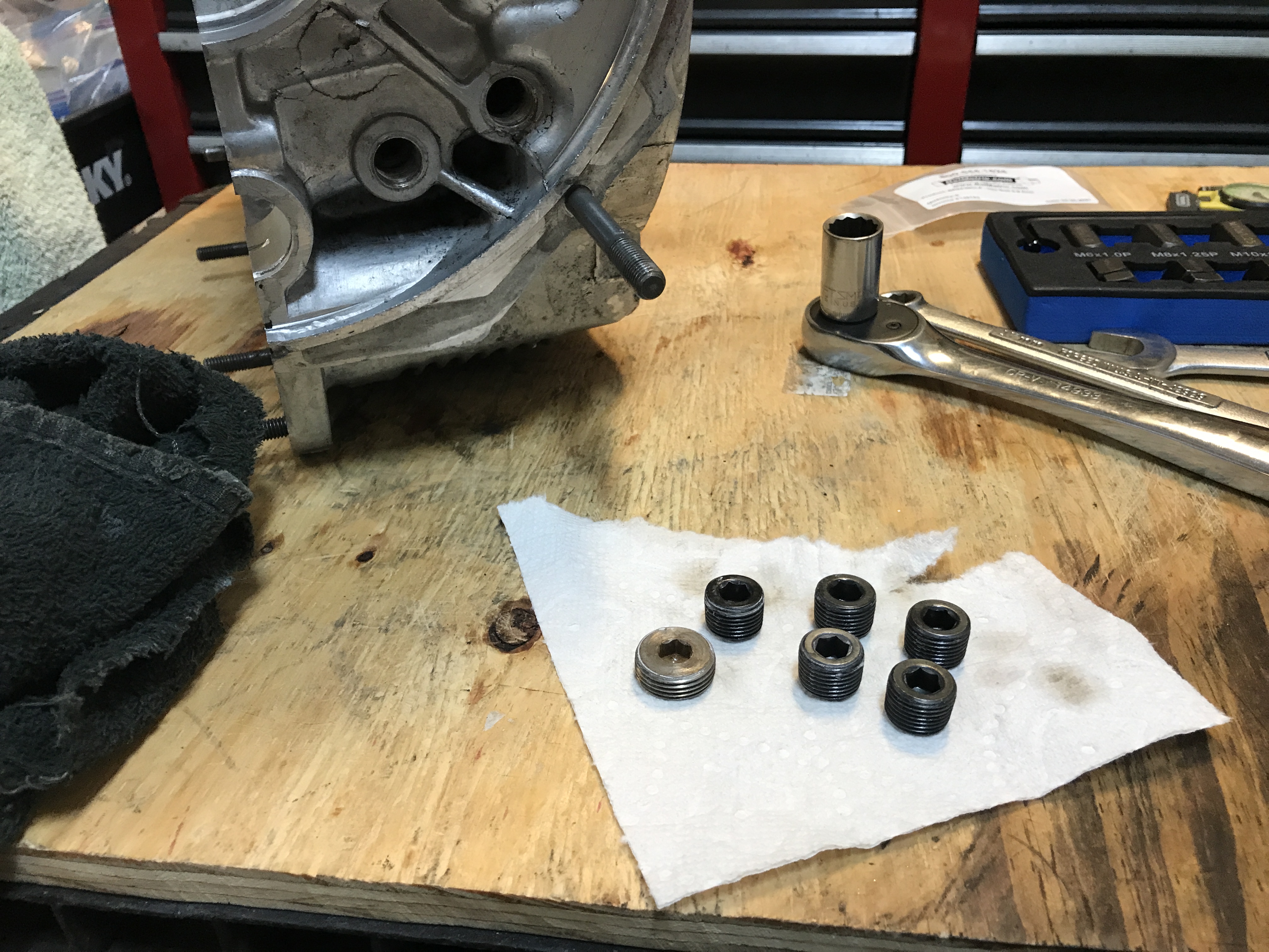

Then the threaded plugs.

Member No.: 23,343
Engine case halves ready.

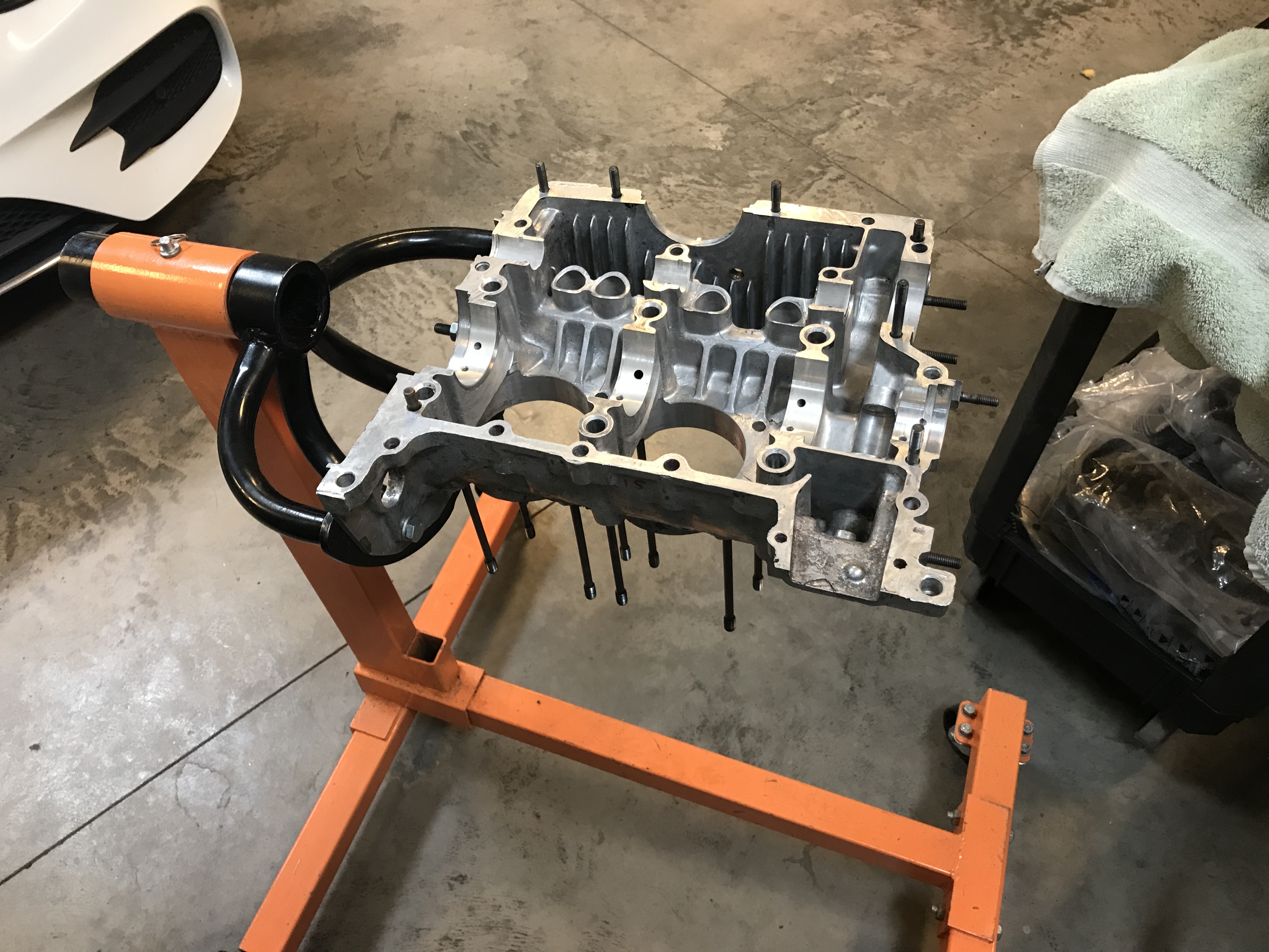

bkrantz
post Aug 4 2021, 09:08 PM
Post #3498
Posts: 8,800
Joined: 3-August 19
From: SW Colorado
Member No.: 23,343
And the right half mounted on the stand again.

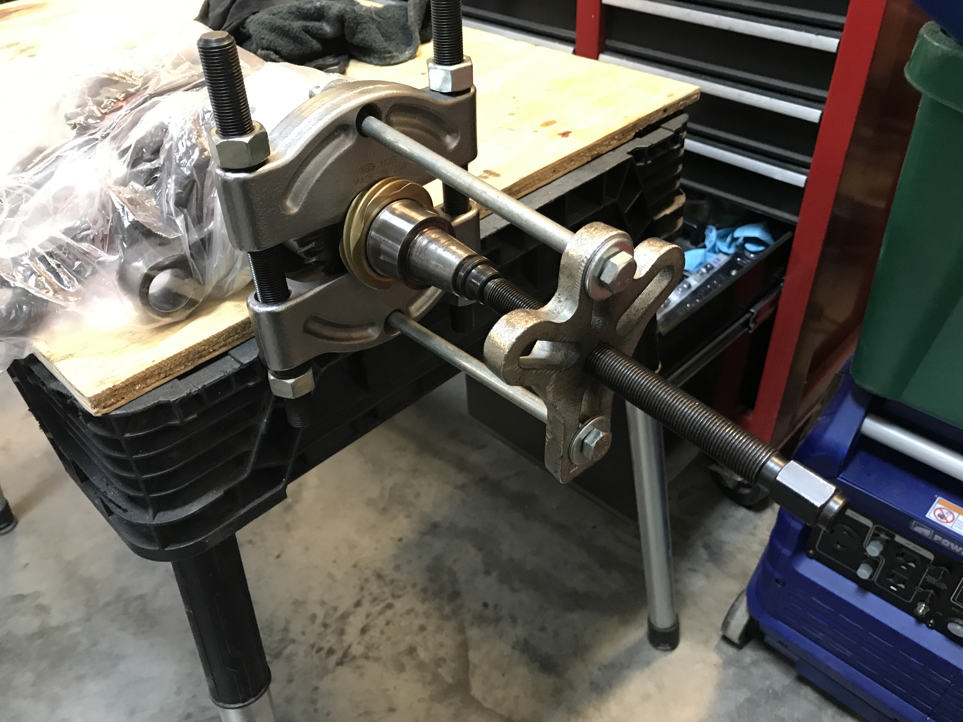

Member No.: 23,343

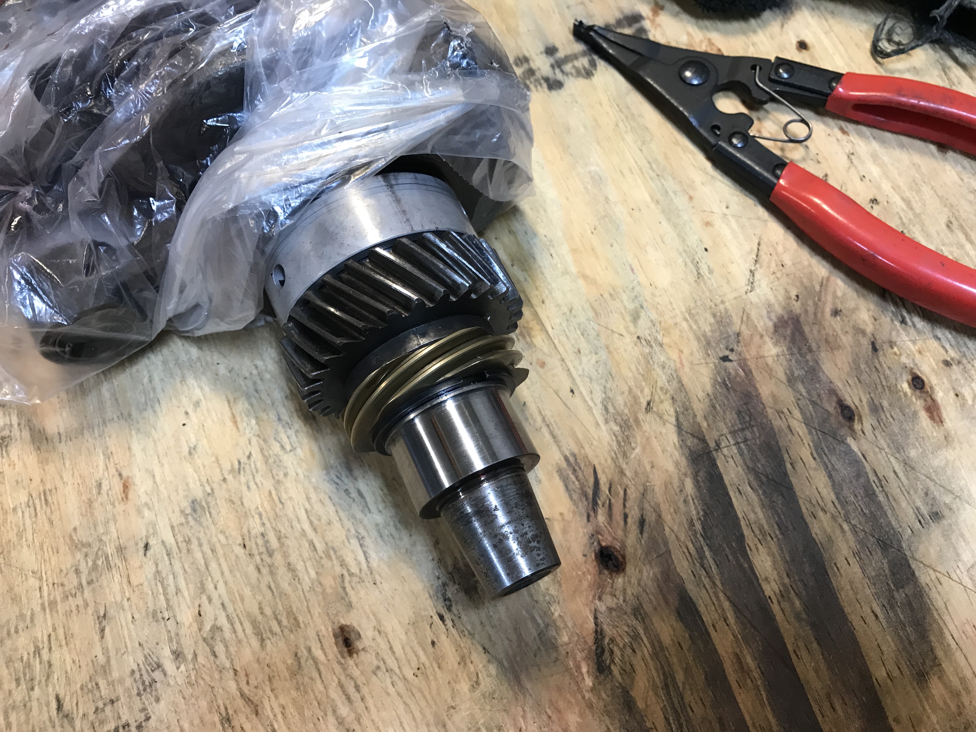

Now to replace the #3 bearing. This is from my previous build attempt, correct for a standard size case saddle. Of course to change this bearing, I had to pull the timing gear and other stuff on the crank nose.
bkrantz
post Aug 4 2021, 09:17 PM
Post #3500
Posts: 8,800
Joined: 3-August 19
From: SW Colorado
Member No.: 23,343
Since I did not want to remove the con rods, and deal with the crank plus rods on my press, I rigged up a gear puller. It took little force to pull the distributor gear, and just a bit more to pull the timing gear.
