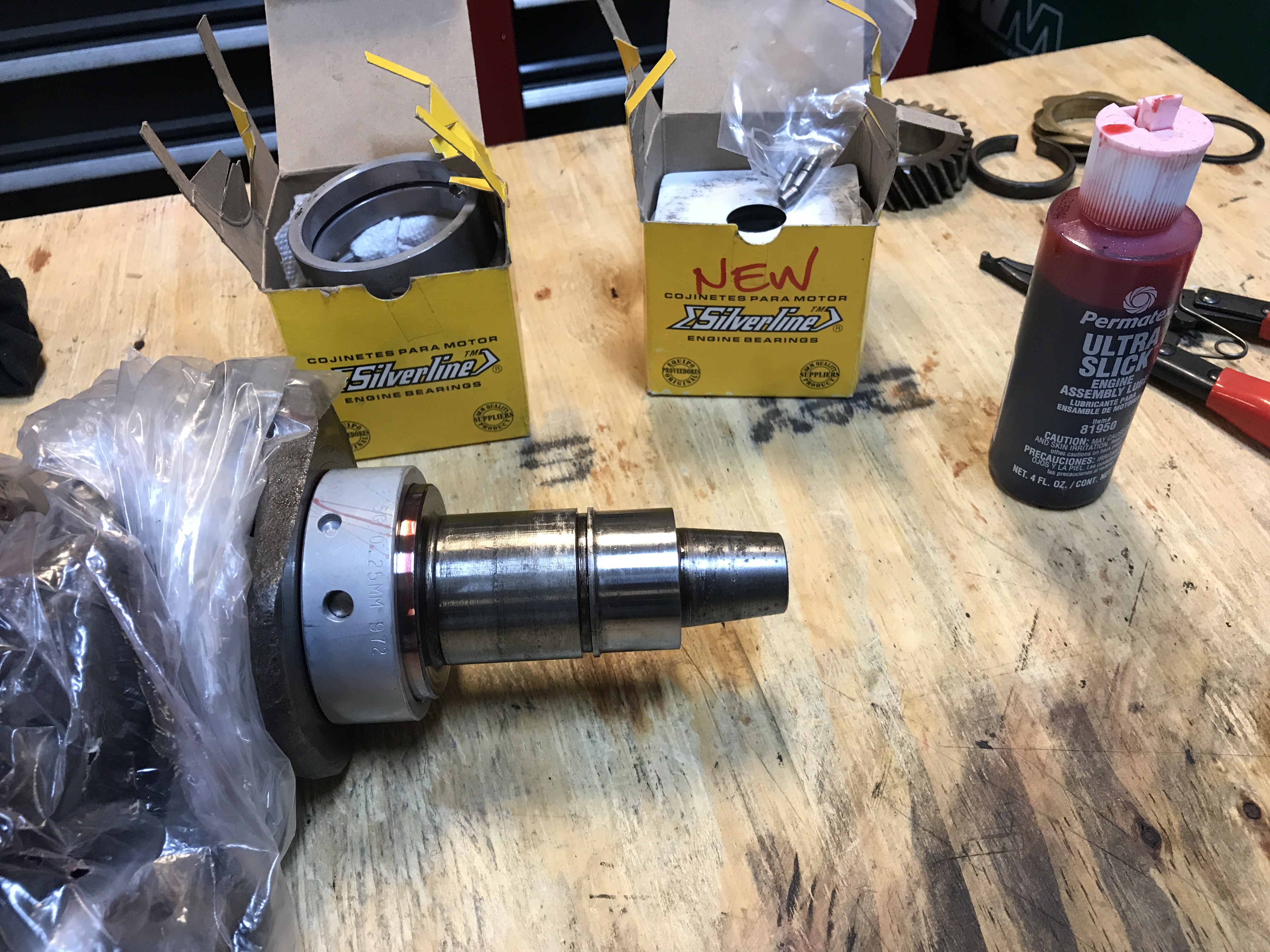

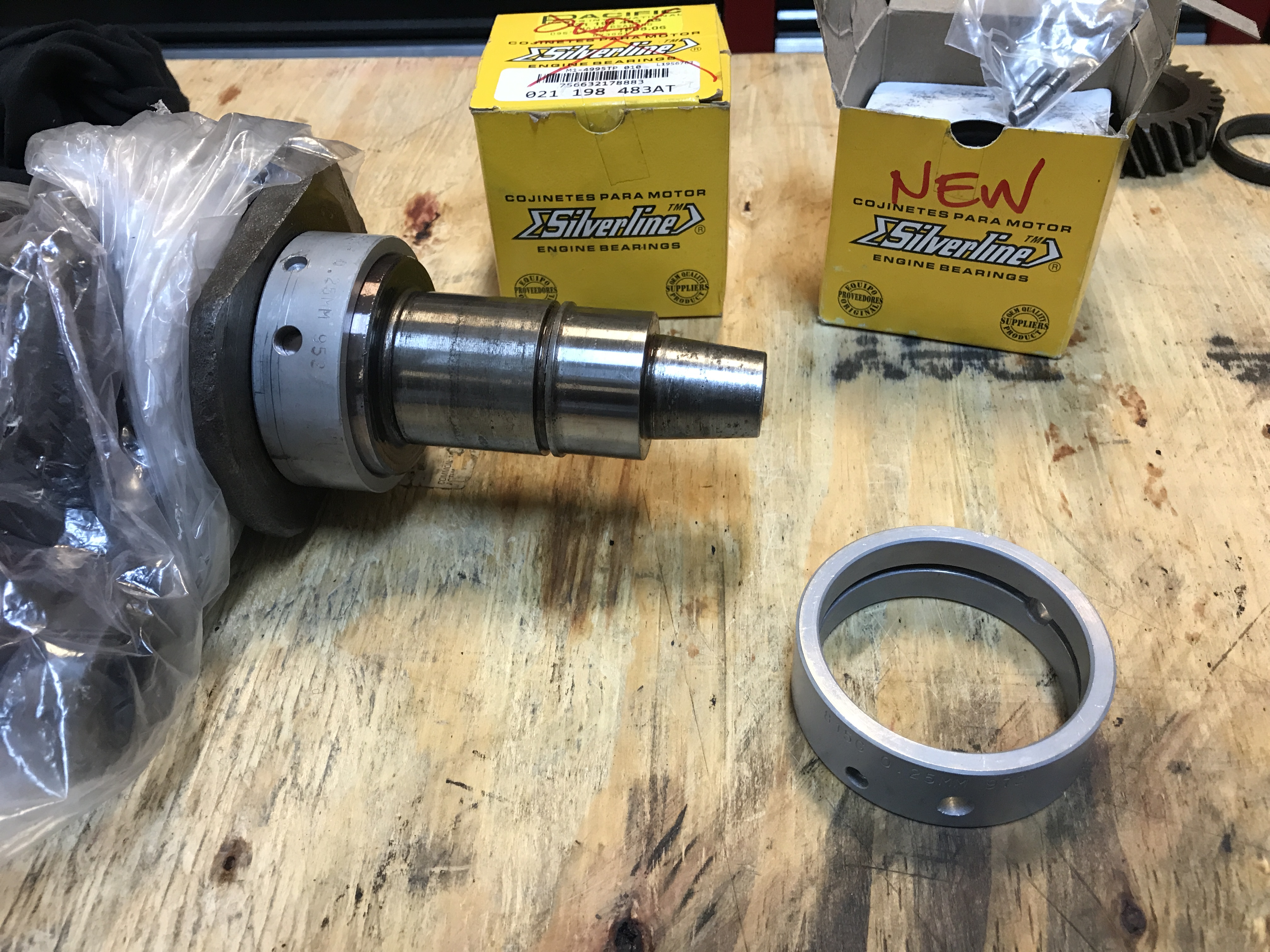

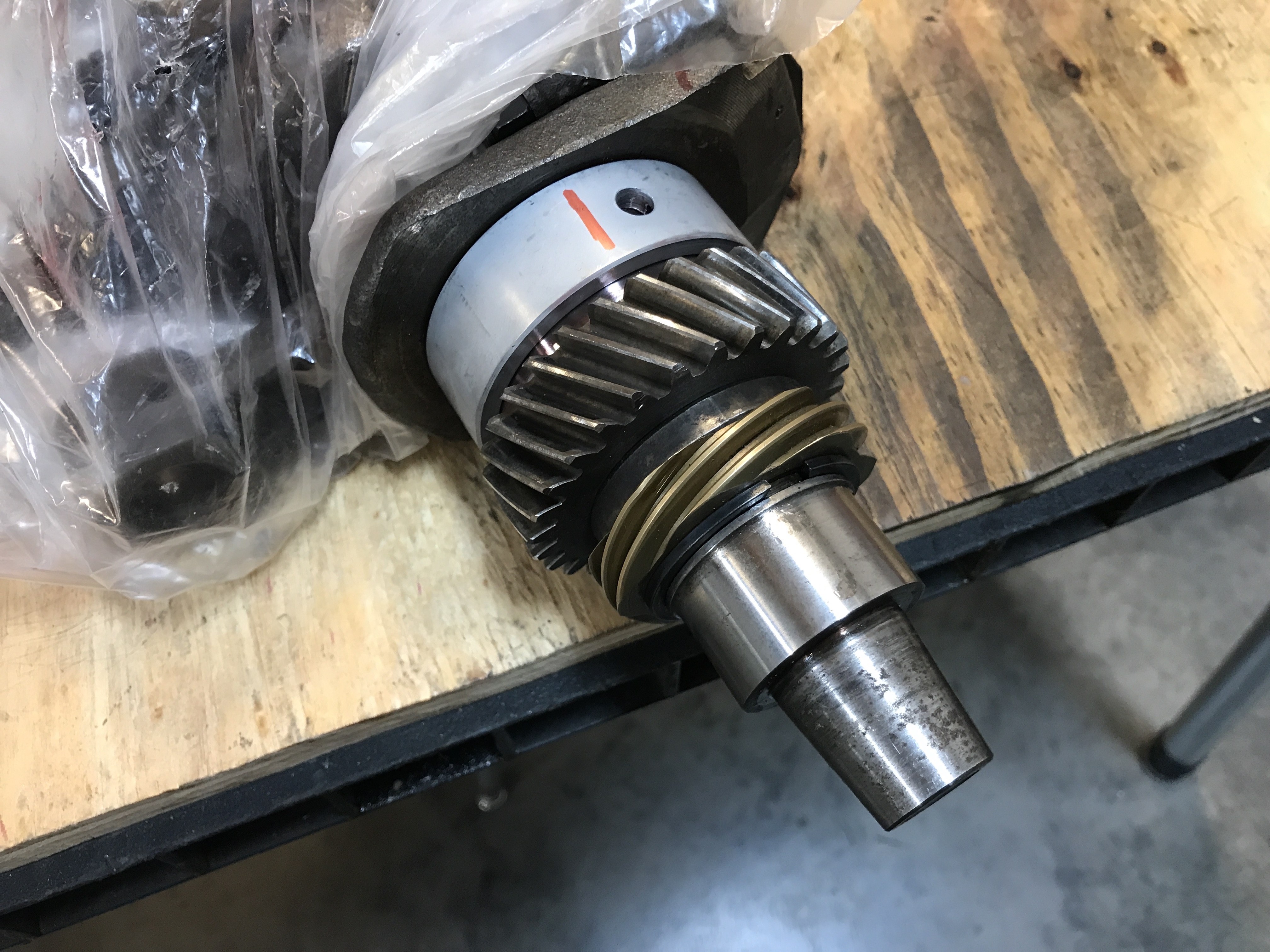

With the gears out of the way, off with the old bearing...
bkrantz
post Aug 4 2021, 09:18 PM
Post #3502
Posts: 8,800
Joined: 3-August 19
From: SW Colorado
Member No.: 23,343

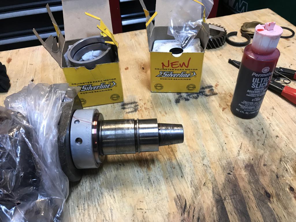

And on with the new.

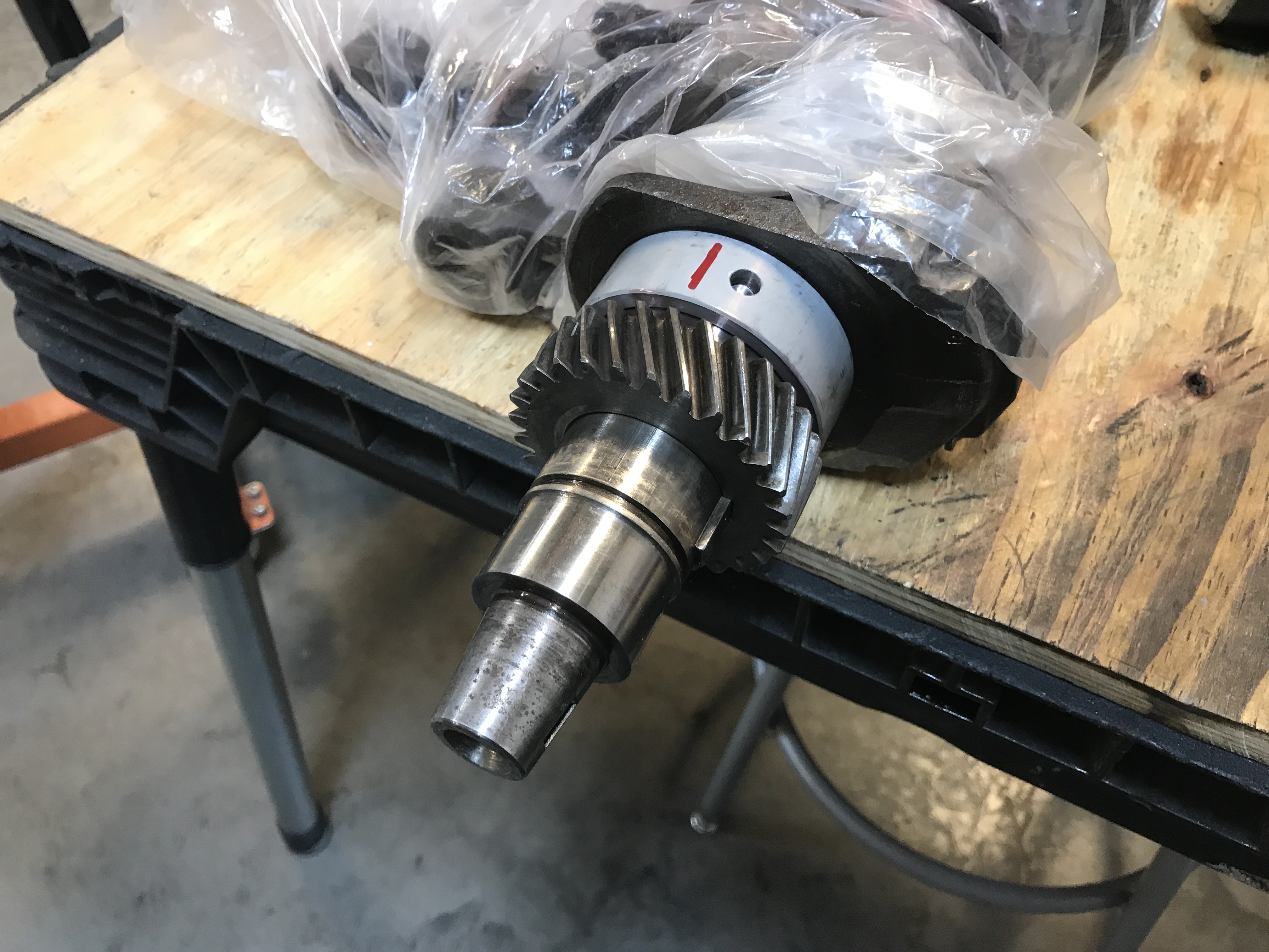

Then a quick bake in the toaster oven to heat the gear, so it literally slides on.
bkrantz
post Aug 4 2021, 09:21 PM
Post #3504
Posts: 8,800
Joined: 3-August 19
From: SW Colorado
Member No.: 23,343
Plus the spacer, distributor gear, and cir-clip. The crank is ready.

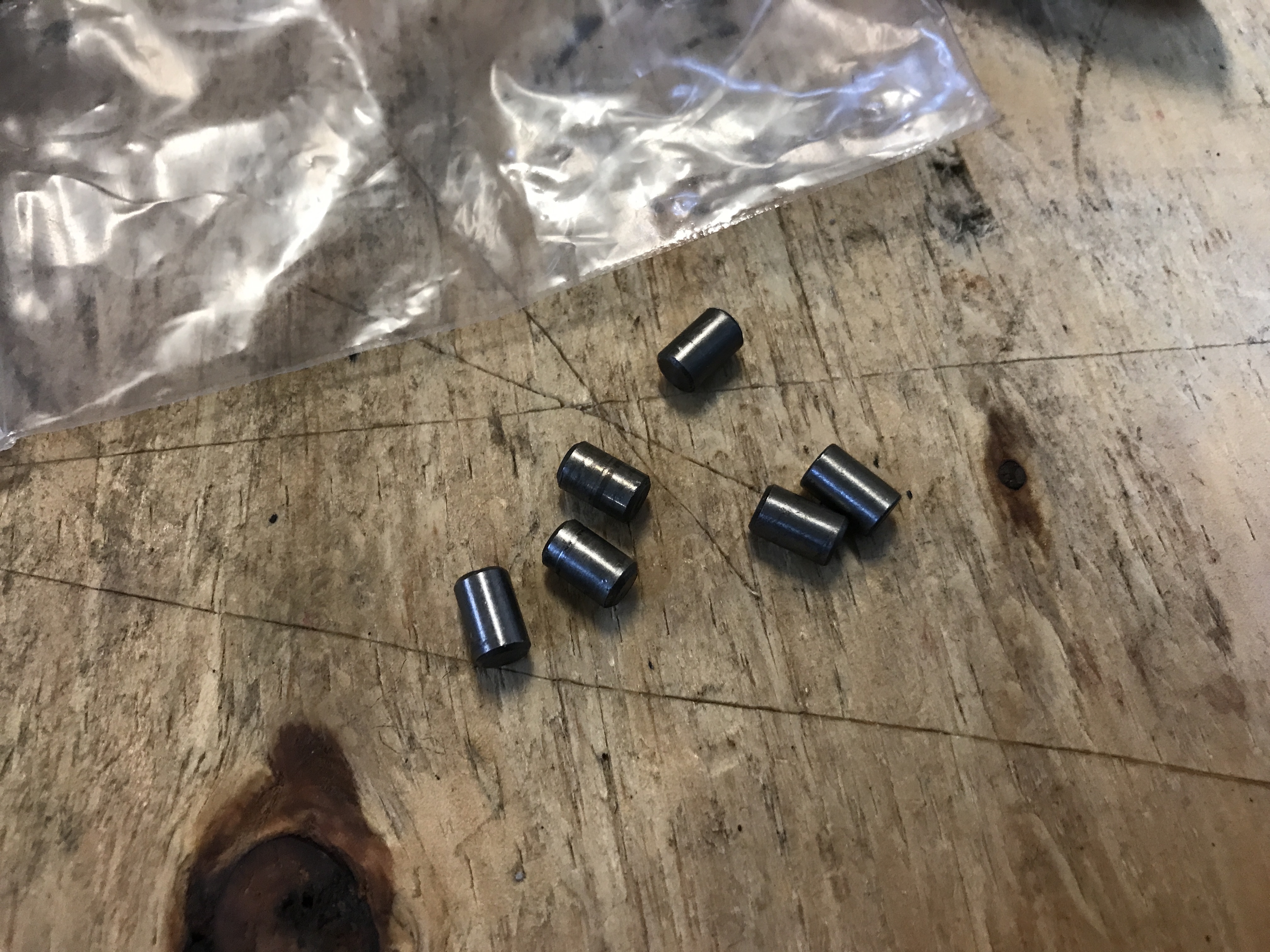

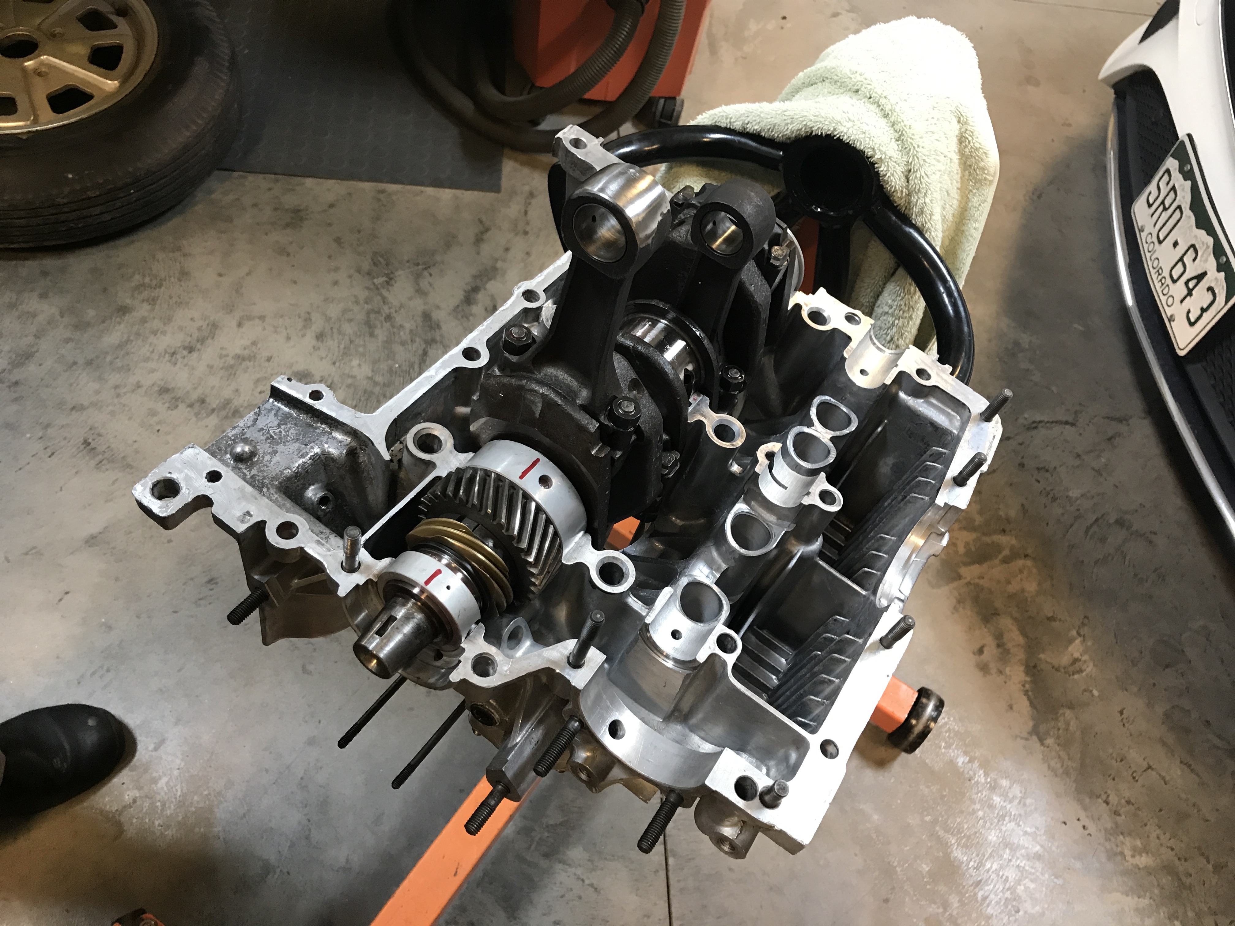

Before installing the rest of the new bearings and crank, I remembered the bearing pins.
bkrantz
post Aug 4 2021, 09:22 PM
Post #3506
Posts: 8,800
Joined: 3-August 19
From: SW Colorado
Member No.: 23,343

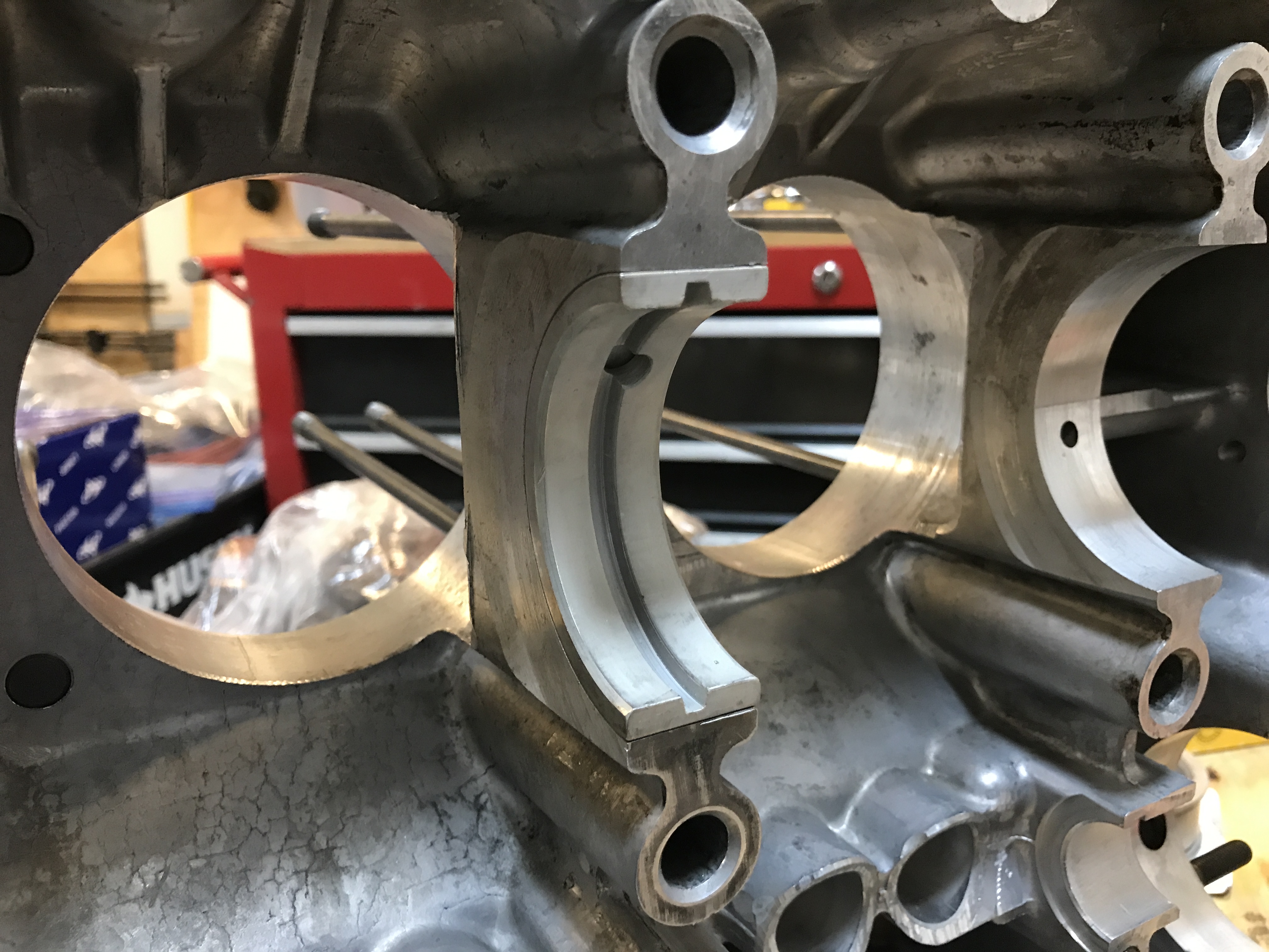

The the #2 bearing halves in both case halves.
bkrantz
post Aug 4 2021, 09:23 PM
Post #3507
Posts: 8,800
Joined: 3-August 19
From: SW Colorado
Member No.: 23,343

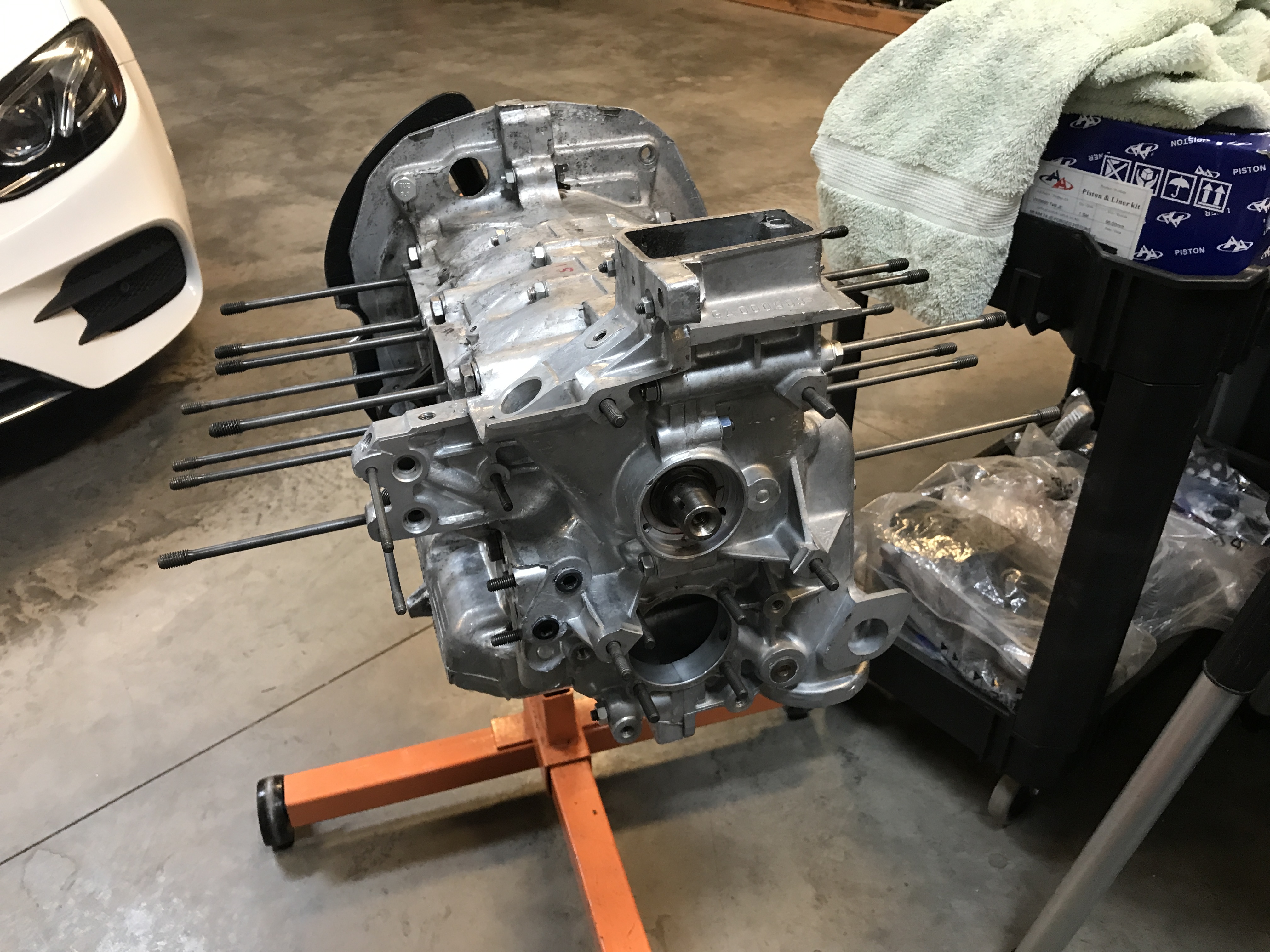

I dropped the crank in place. No camshaft or other stuff now.
bkrantz
post Aug 4 2021, 09:25 PM
Post #3508
Posts: 8,800
Joined: 3-August 19
From: SW Colorado
Member No.: 23,343
And then bolted the other side in place. The crank spins easy, so I think I am ready to install the pistons and cylinders and see about deck height.

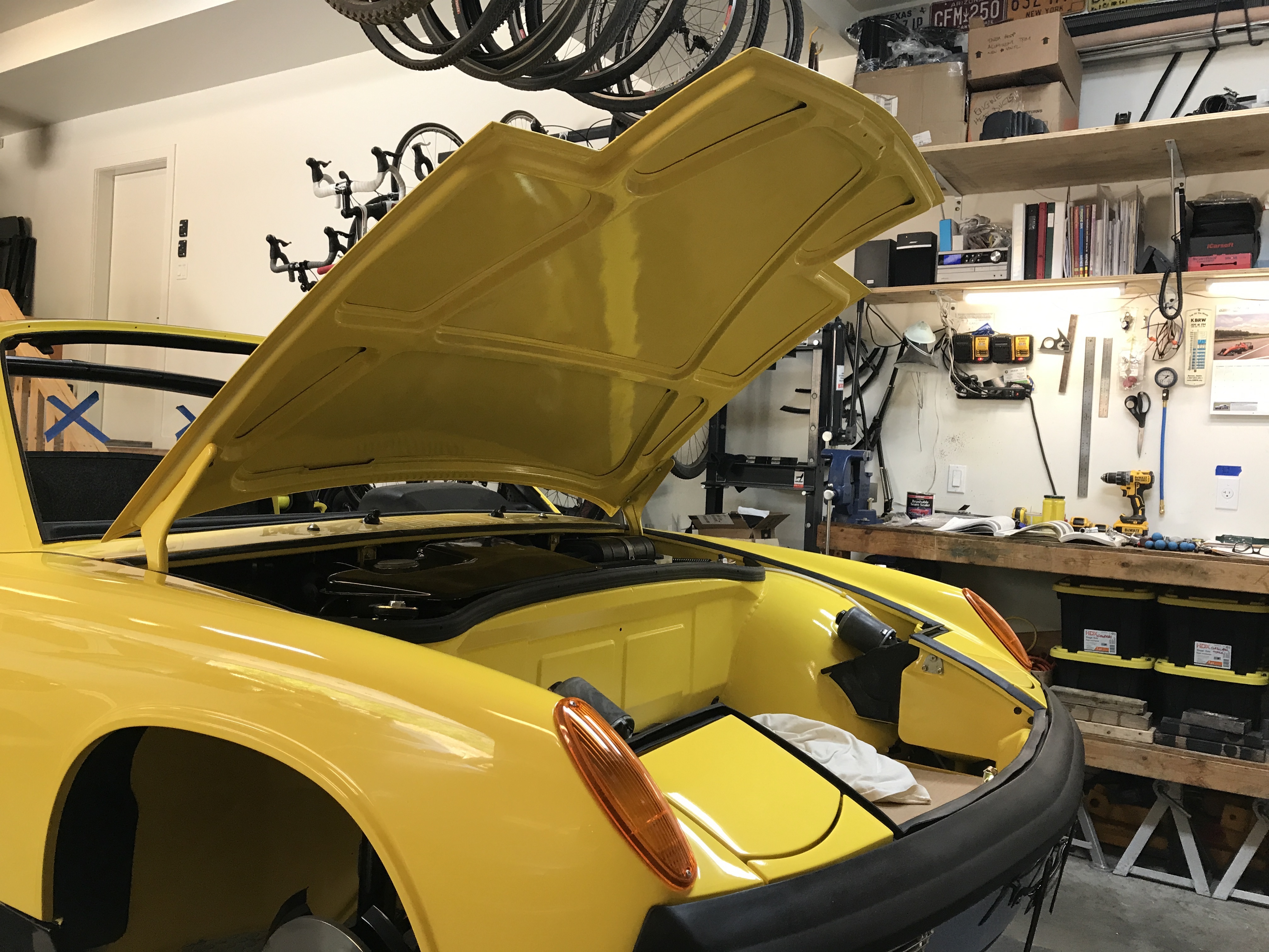

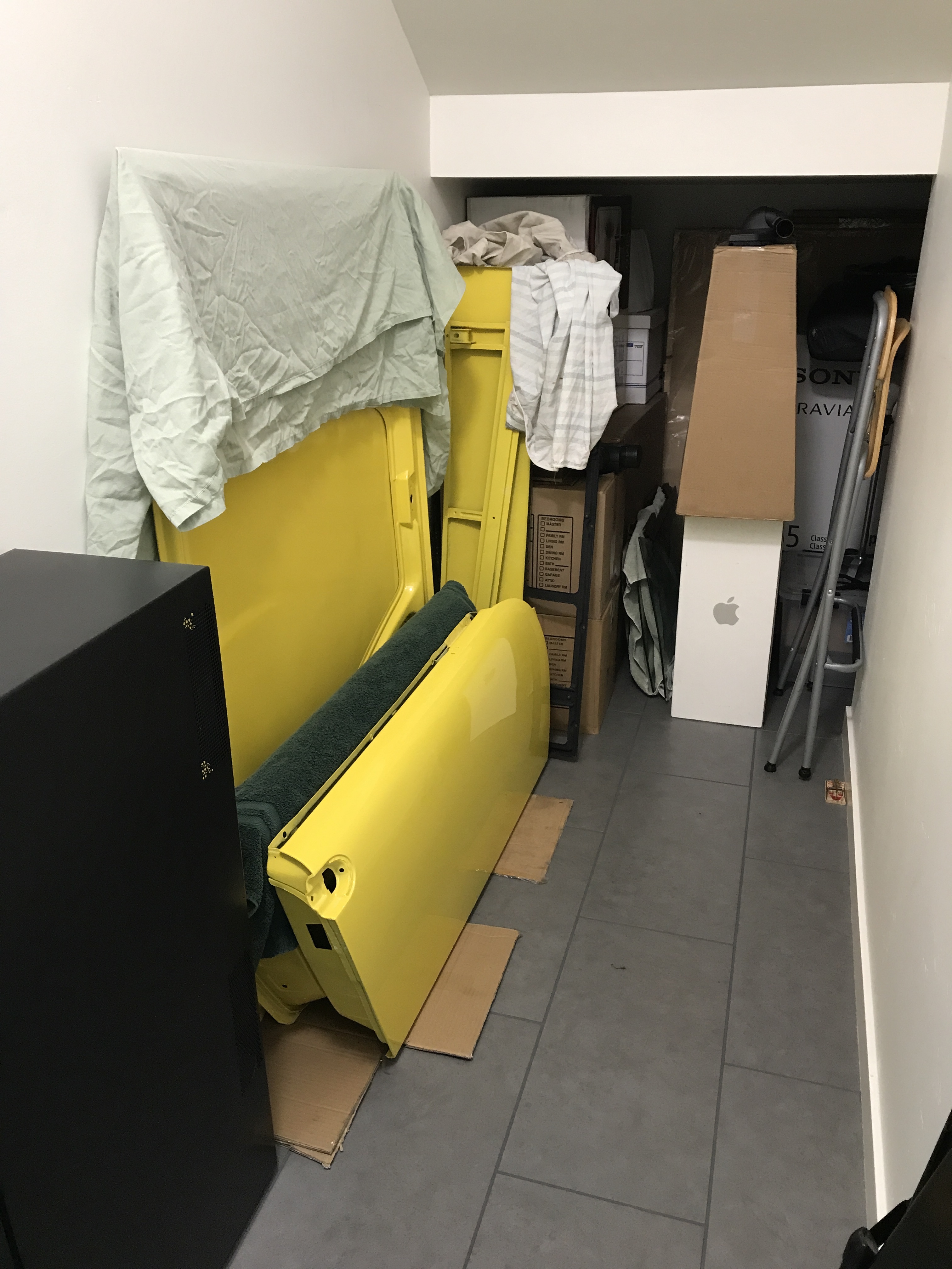

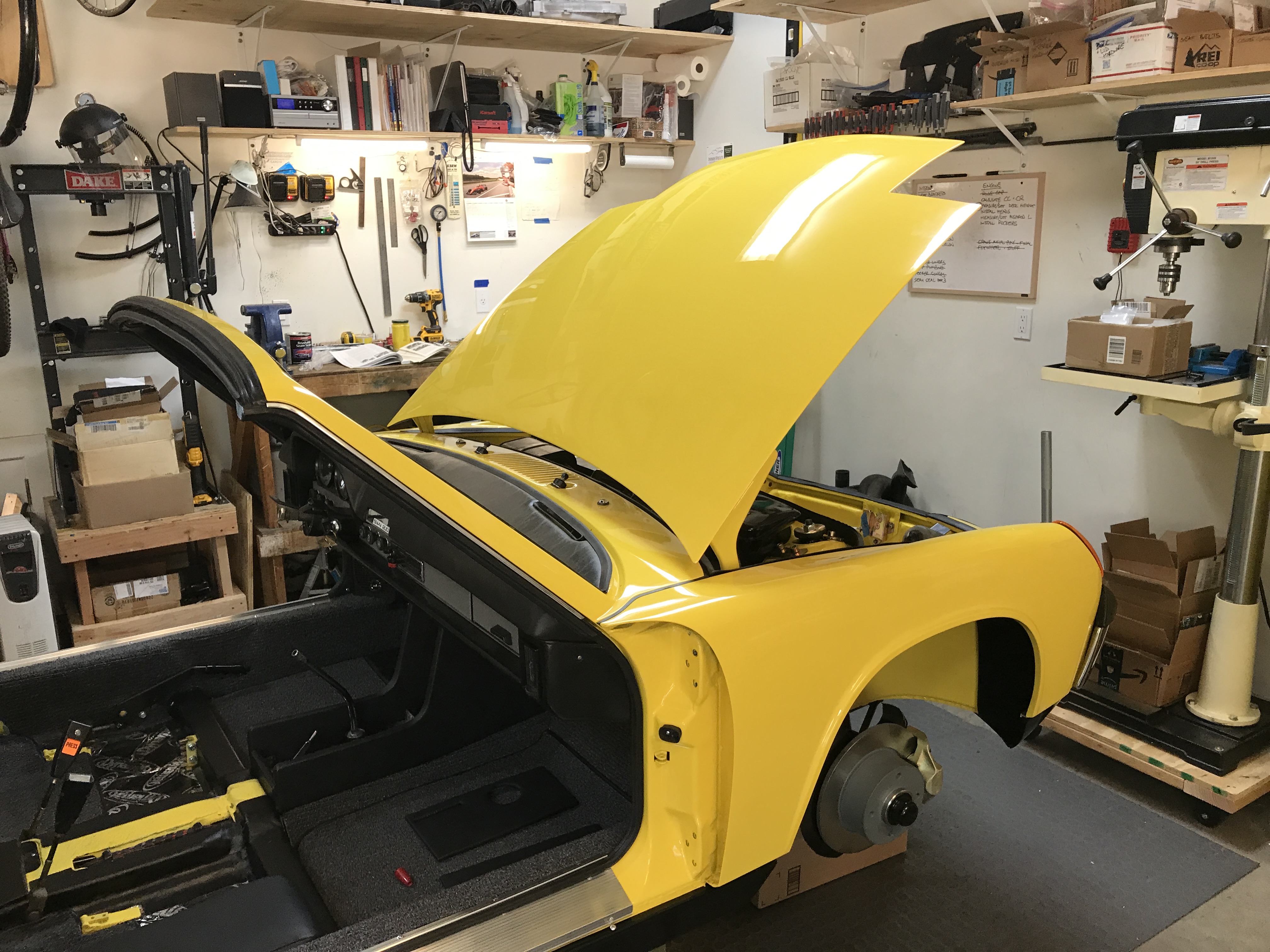

I took advantage of my son's visit, and opened the body part vault (AKA my downstairs closet) and got out the frunk lid.
bkrantz
post Aug 5 2021, 07:40 PM
Post #3510
Posts: 8,800
Joined: 3-August 19
From: SW Colorado
Member No.: 23,343

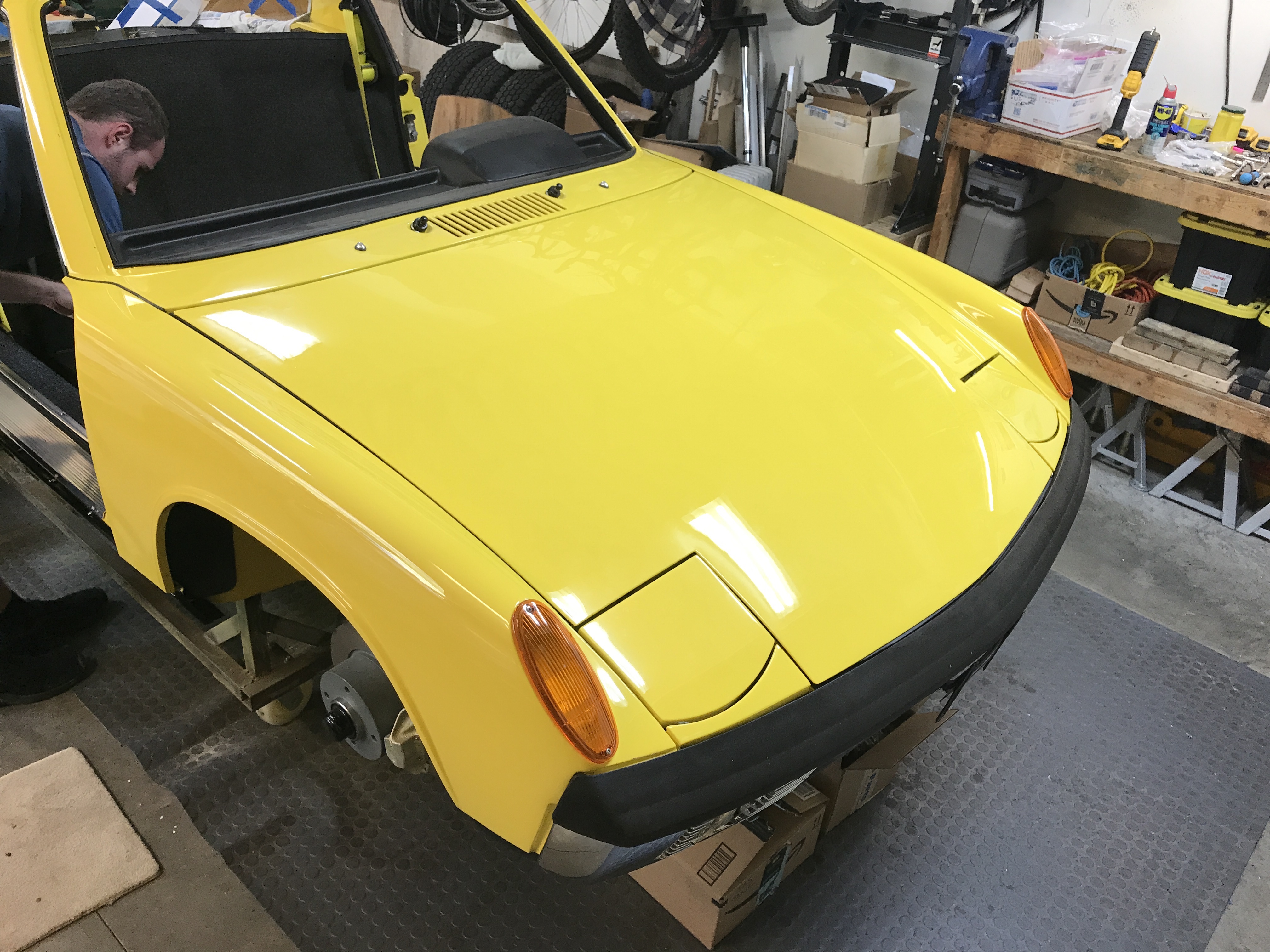

With extra hands, it was easy to bolt the lid to the hinges.
bkrantz
post Aug 5 2021, 07:42 PM
Post #3511
Posts: 8,800
Joined: 3-August 19
From: SW Colorado
Member No.: 23,343
We then spent about 30 minutes getting the lid aligned and leveled.
bkrantz
post Aug 5 2021, 07:44 PM
Post #3512
Posts: 8,800
Joined: 3-August 19
From: SW Colorado
Member No.: 23,343

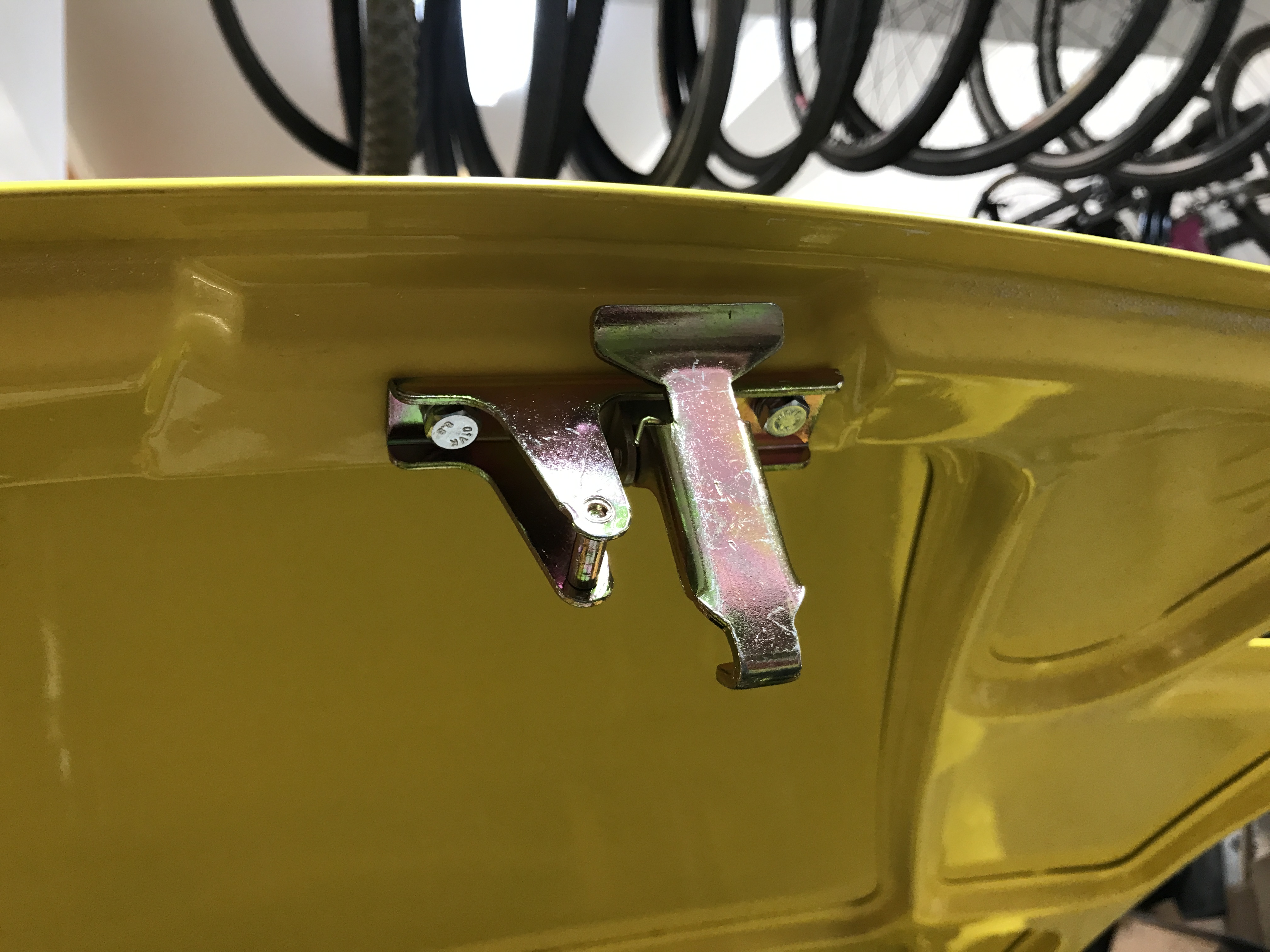

Here's the re-plated latch installed.
bkrantz
post Aug 5 2021, 07:46 PM
Post #3513
Posts: 8,800
Joined: 3-August 19
From: SW Colorado
Member No.: 23,343
I am pretty happy with how the lid fits, even with the new gasket. The right headlight also looks good, and the left one needs a little work.

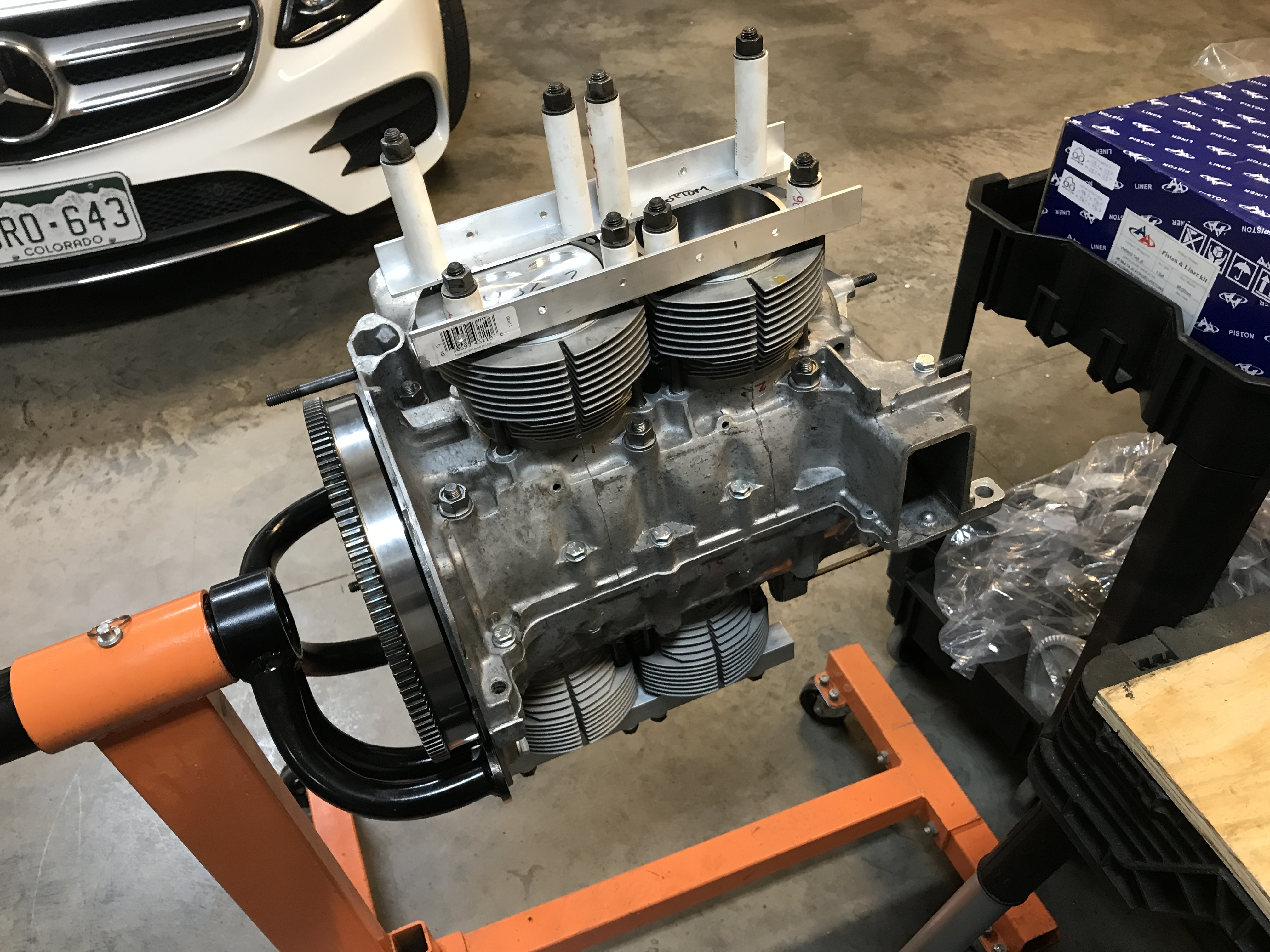

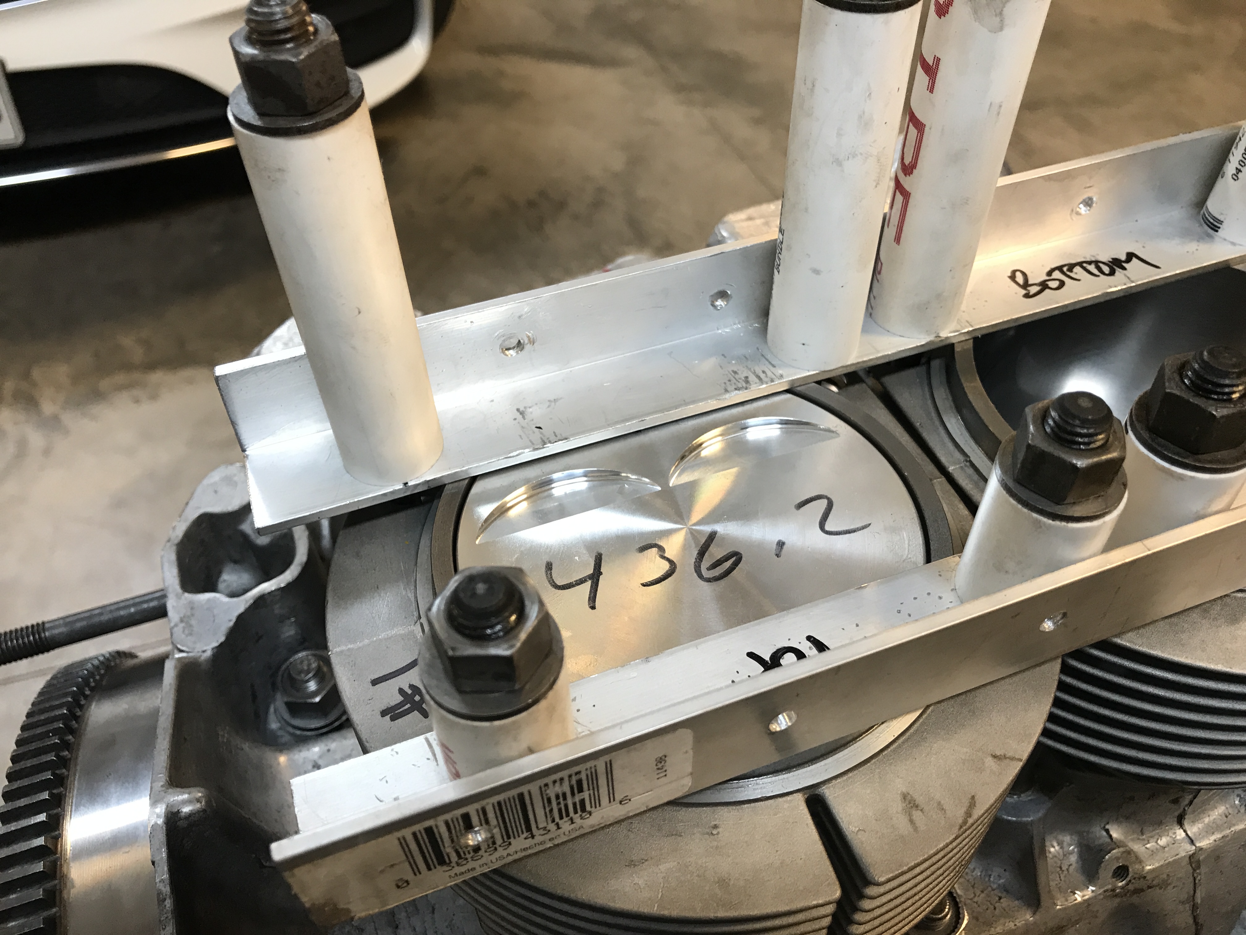

I had time today to get the pistons and cylinders mounted on the case (again, built with just the crank).
bkrantz
post Aug 6 2021, 06:24 PM
Post #3517
Posts: 8,800
Joined: 3-August 19
From: SW Colorado
Member No.: 23,343
Tomorrow, I can get serious about measuring the deck height (again).

No pictures, but I made a first round of deck height measurements today. I found a range of .037 to .041. That's in the target range I want.

QUOTE(bkrantz @ Aug 7 2021, 07:35 PM) *
Great progress Bob, will you be using a "head gasket"
bkrantz
post Aug 8 2021, 07:09 PM
Post #3520
Posts: 8,800
Joined: 3-August 19
From: SW Colorado
Member No.: 23,343
Based on what I hear from my vendors and others on 914World, no.
