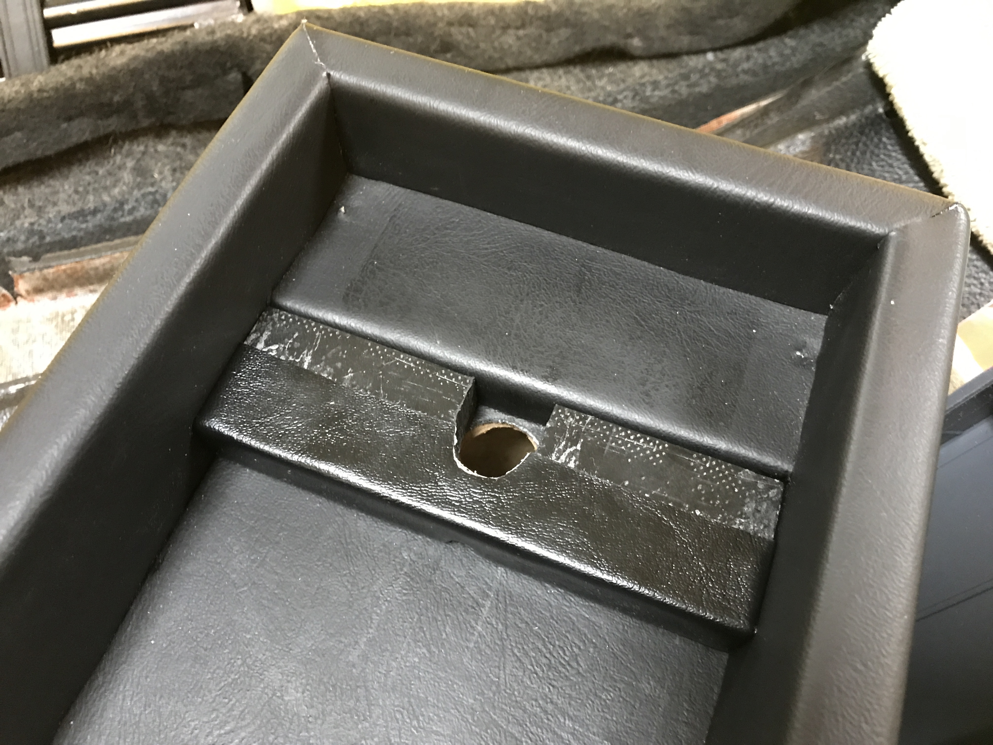

I need to cut the shine on the vinyl a bit to match the recovered arm rest box.

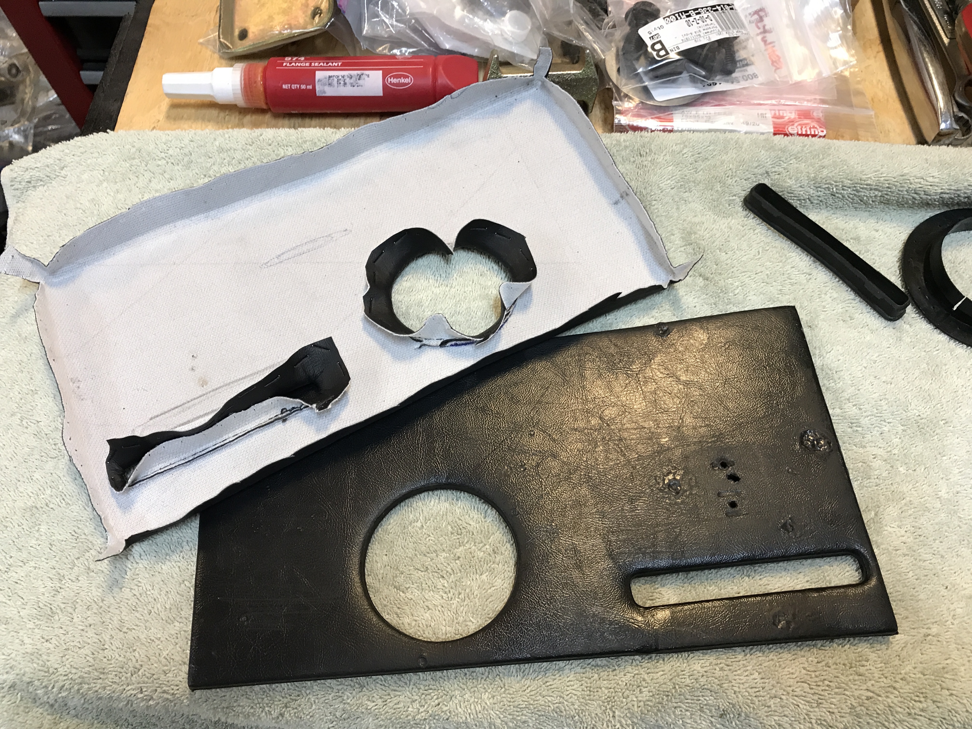

Member No.: 23,343
I then un-made a thing. When the upholstery shop recovered the shift panel, they put a new layer of vinyl over the old. That double layer made the holes for the gear shift boot and the heater lever guide too small. So I removed the new vinyl expecting to simply cut the old vinyl away from the holes.

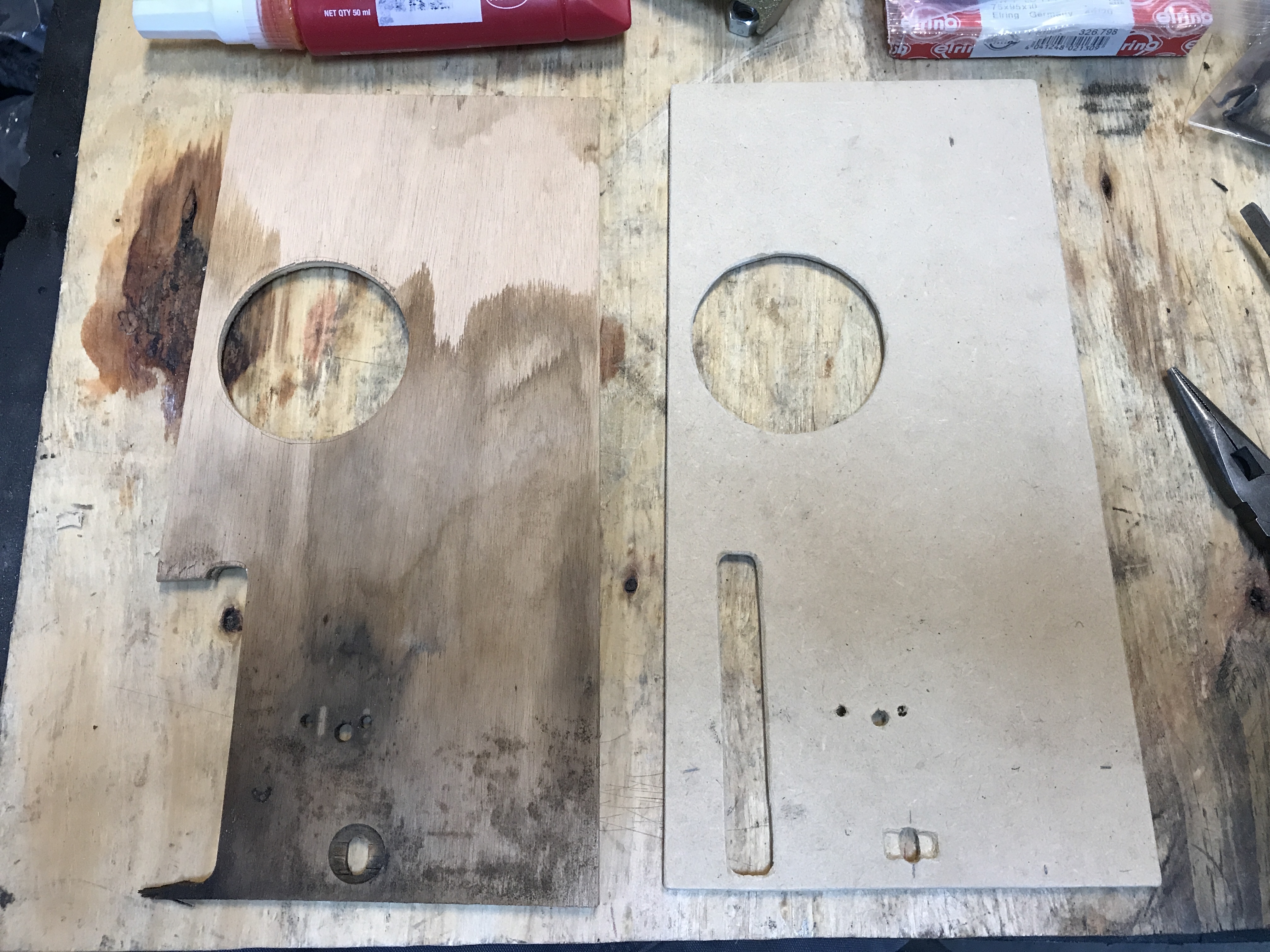

Member No.: 23,343

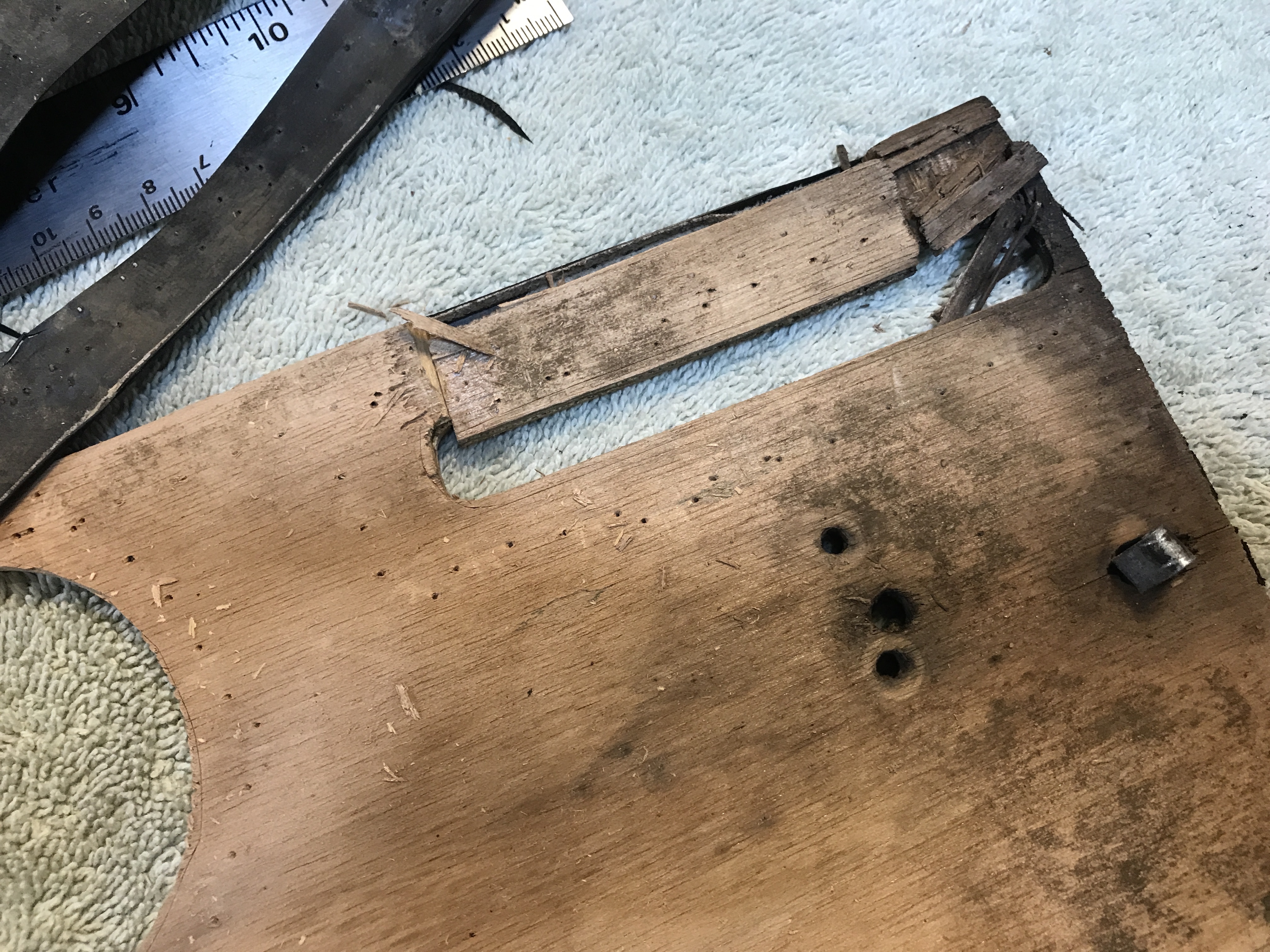

But then I found a bigger problem, with some ancient decay in the 5 mm plywood.

Member No.: 23,343
I had time today to make a new wood panel for the gear shift surround. I used 5mm MDF to replace the original 5mm plywood.

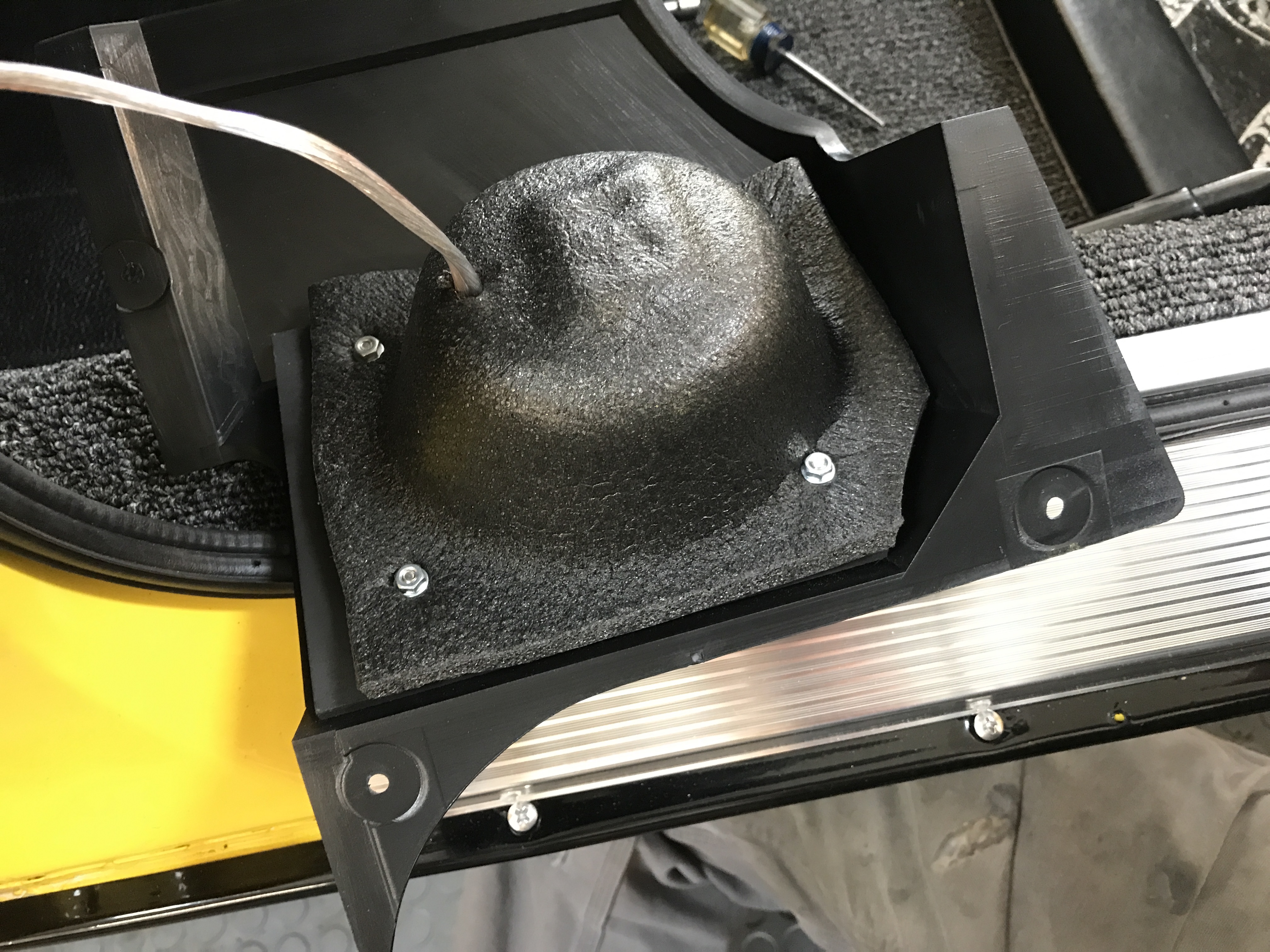

We finished the audio system today. I put foam baffles on the back of the speakers to reduce stray echos.

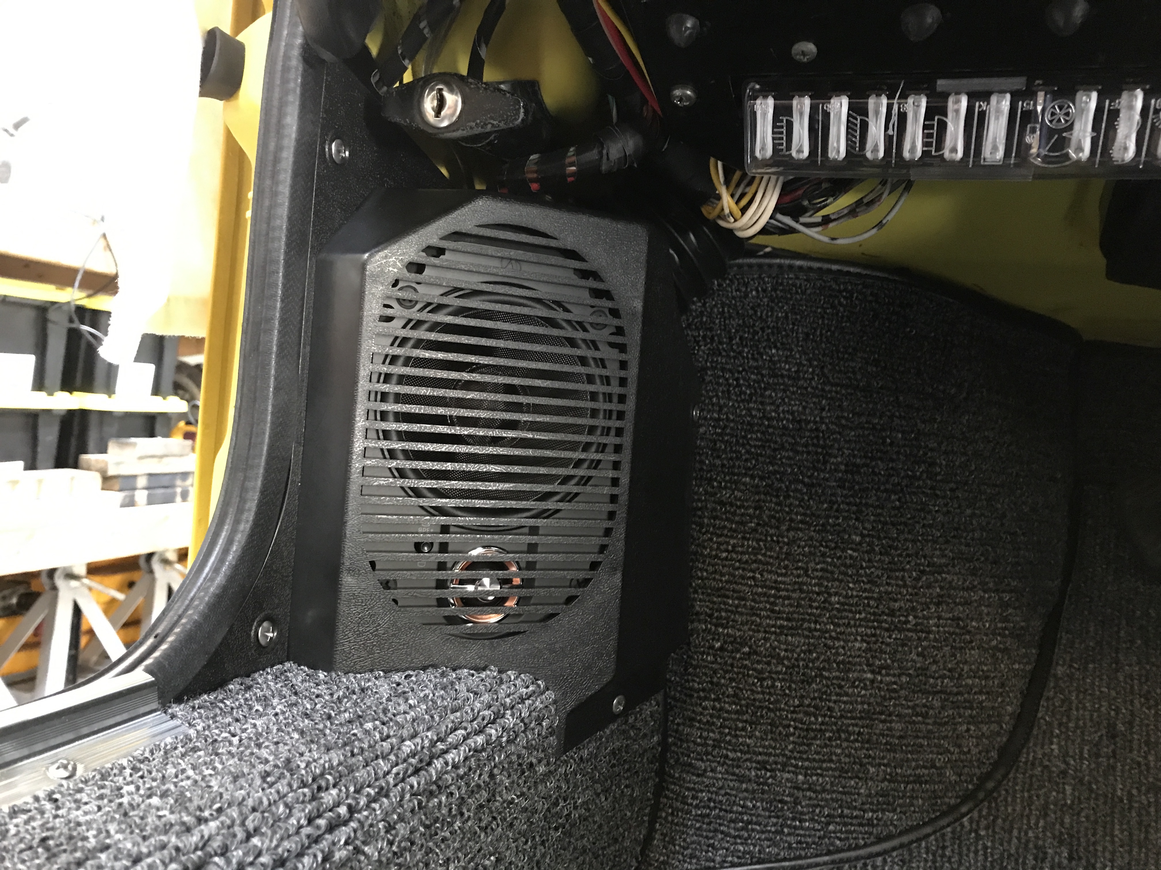

Member No.: 23,343
Left speaker installed for real.

Joined: 3-August 19

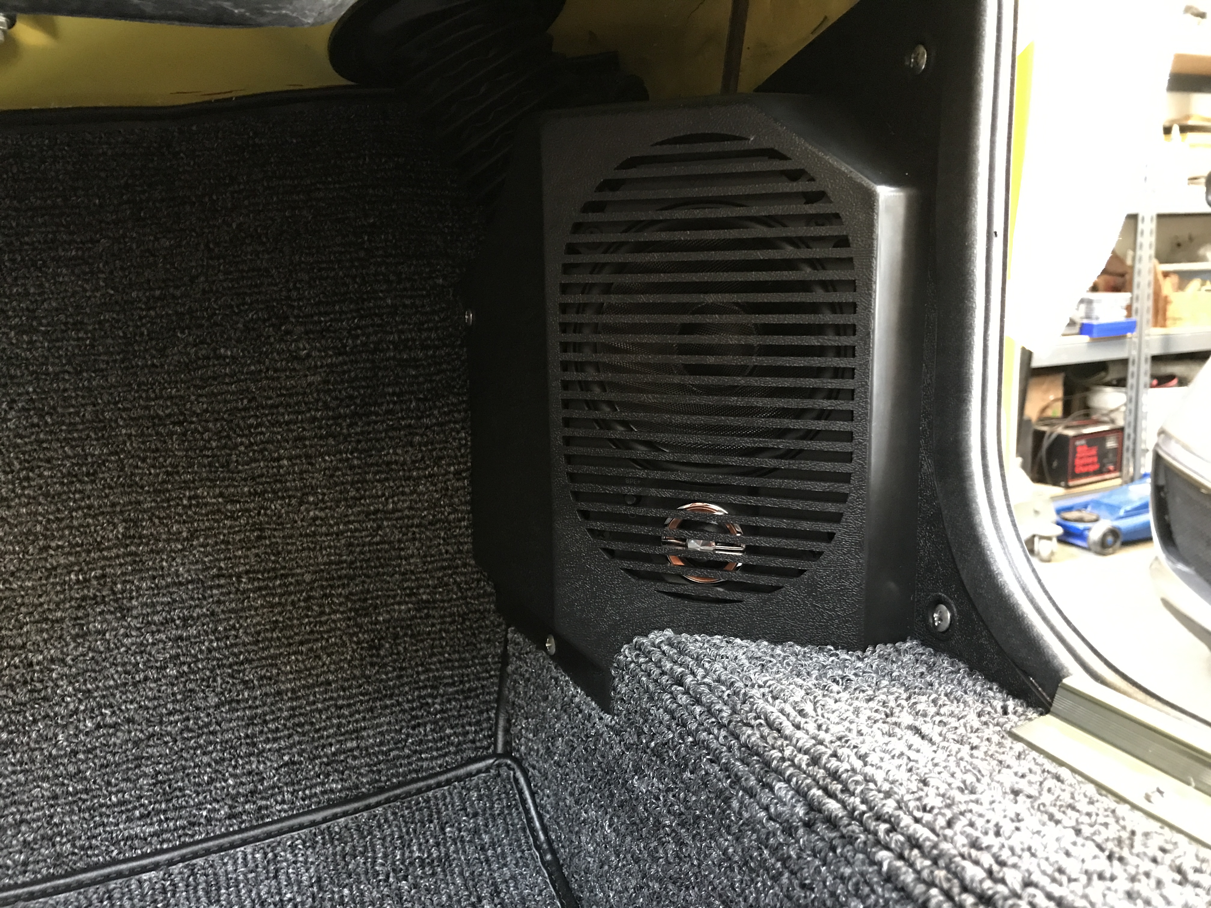

From: SW Colorado
Member No.: 23,343
And right.

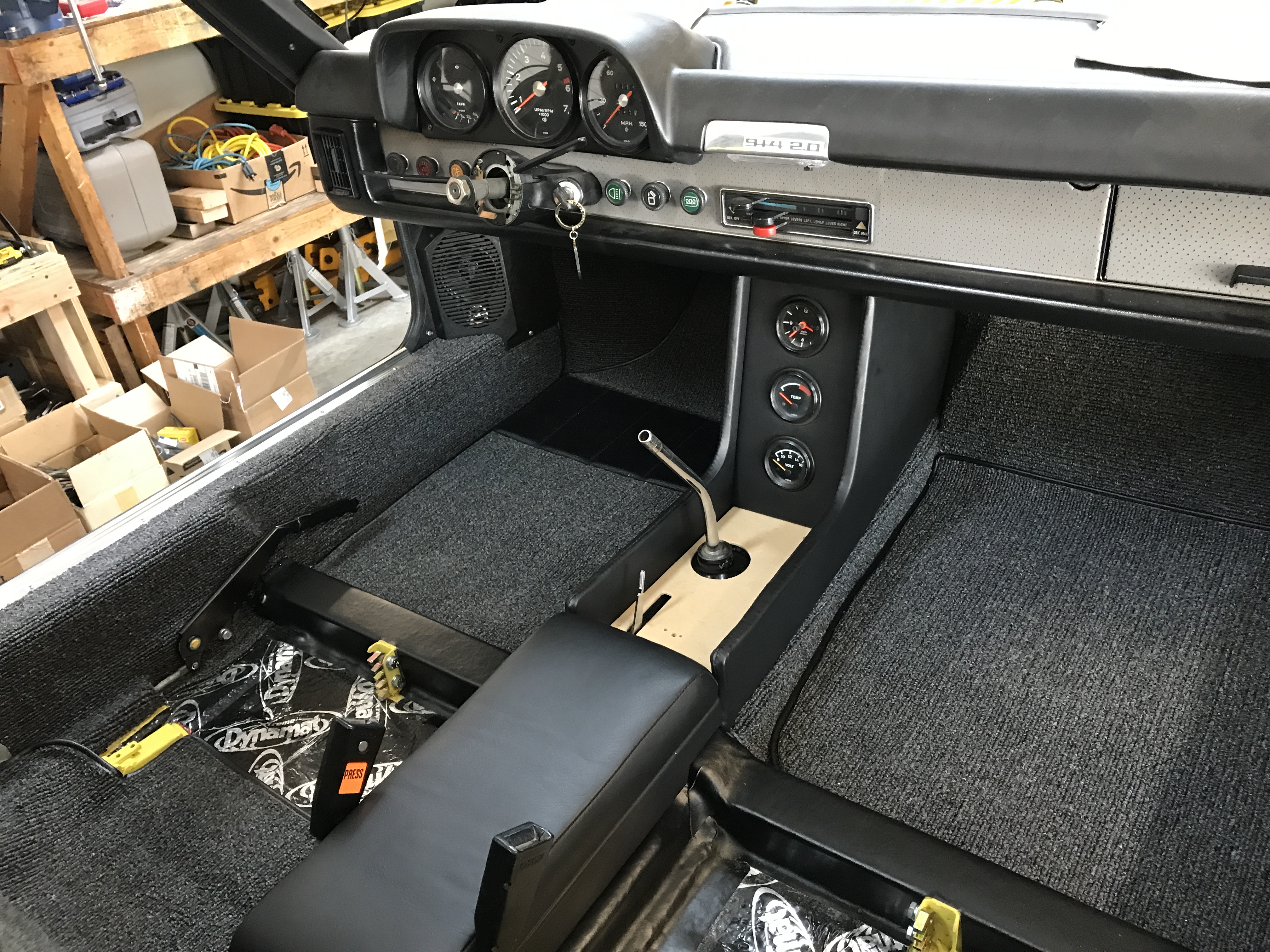

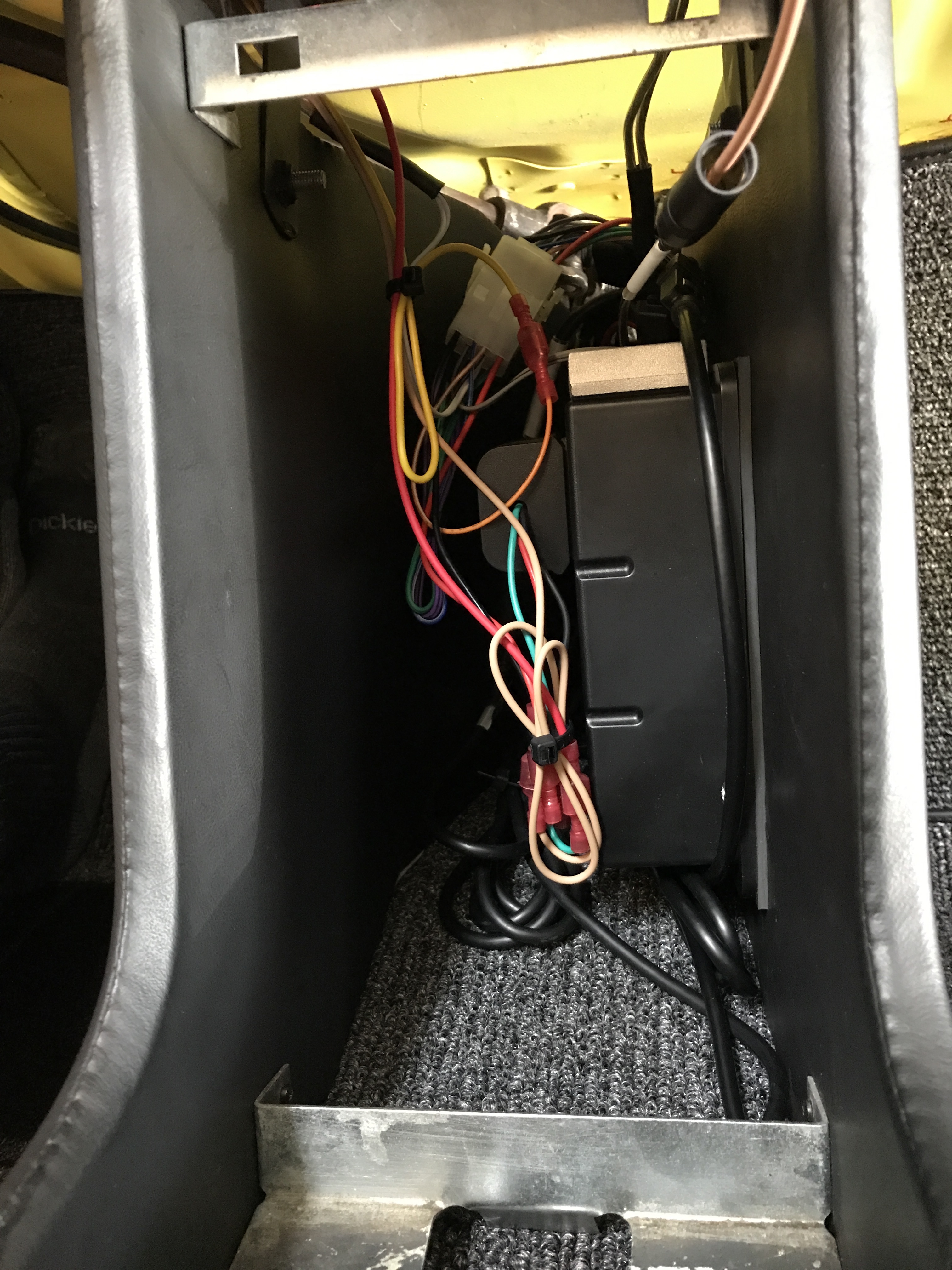

We tried to make all the wiring tidy.
bkrantz
post Aug 18 2021, 08:22 PM
Post #3571
Posts: 8,800
Joined: 3-August 19
From: SW Colorado
Member No.: 23,343
Here you can see the hidden audio system. (IMG:style_emoticons/default/biggrin.gif)

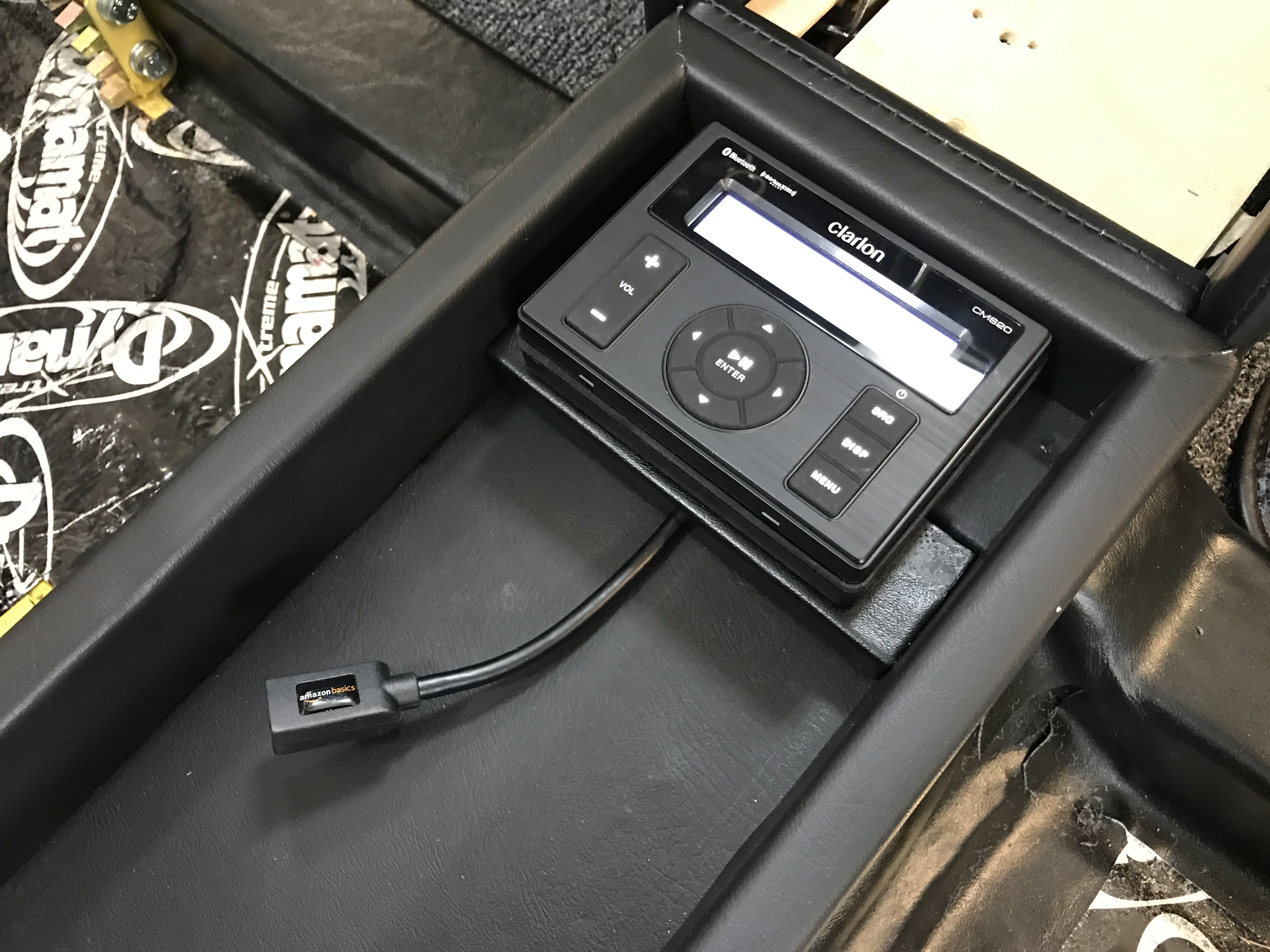

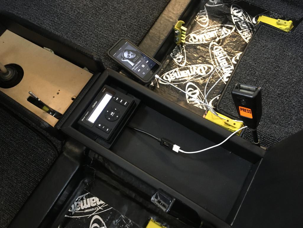

But open the arm rest...
bkrantz
post Aug 18 2021, 08:27 PM
Post #3573
Posts: 8,800
Joined: 3-August 19
From: SW Colorado
Member No.: 23,343
Turn it on, and hear radio (weather, in this shot).

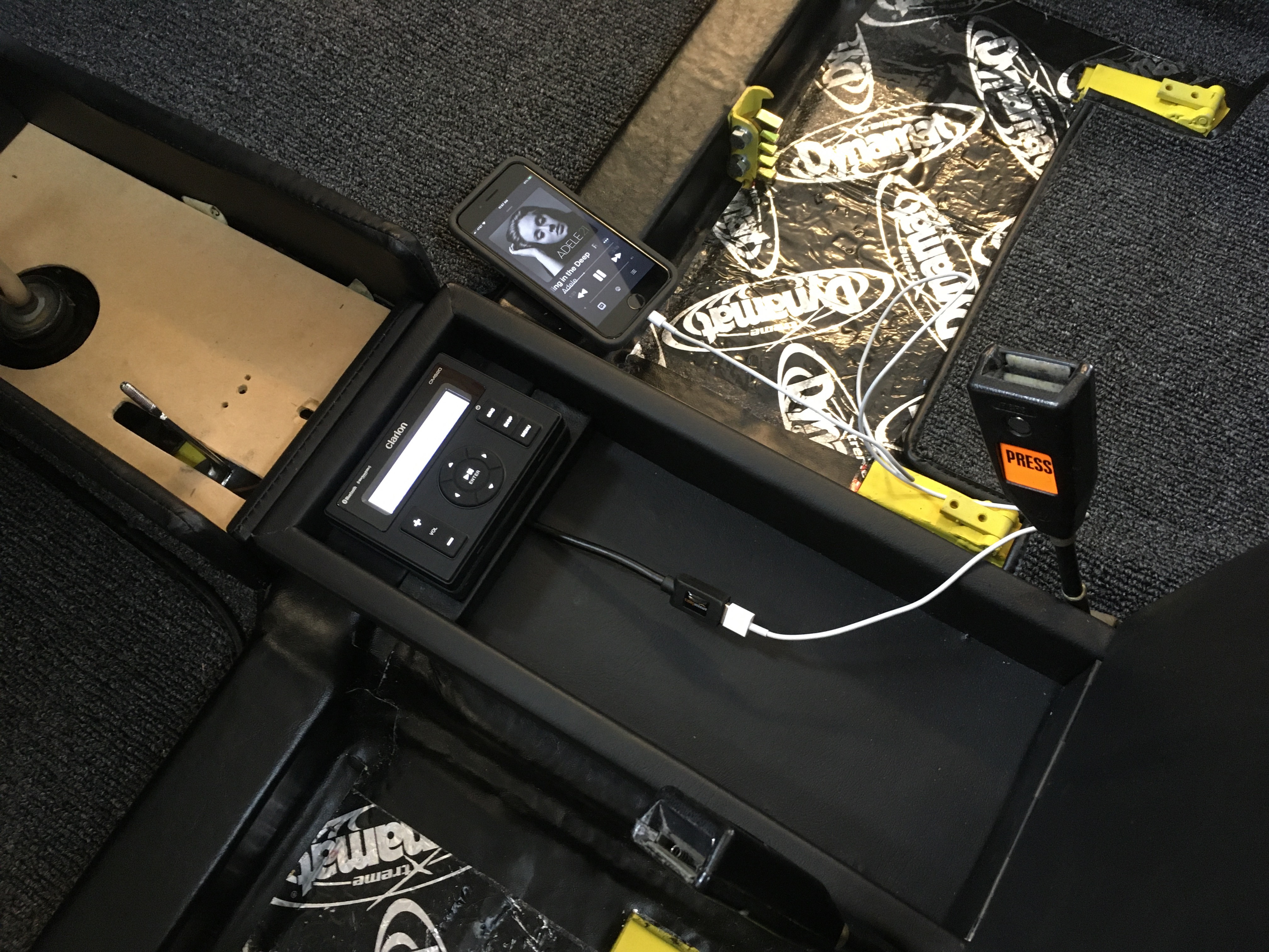

bkrantz
post Aug 18 2021, 08:30 PM
Post #3574
Posts: 8,800
Joined: 3-August 19
From: SW Colorado
Member No.: 23,343
Or plug in an iPhone, and stream music.

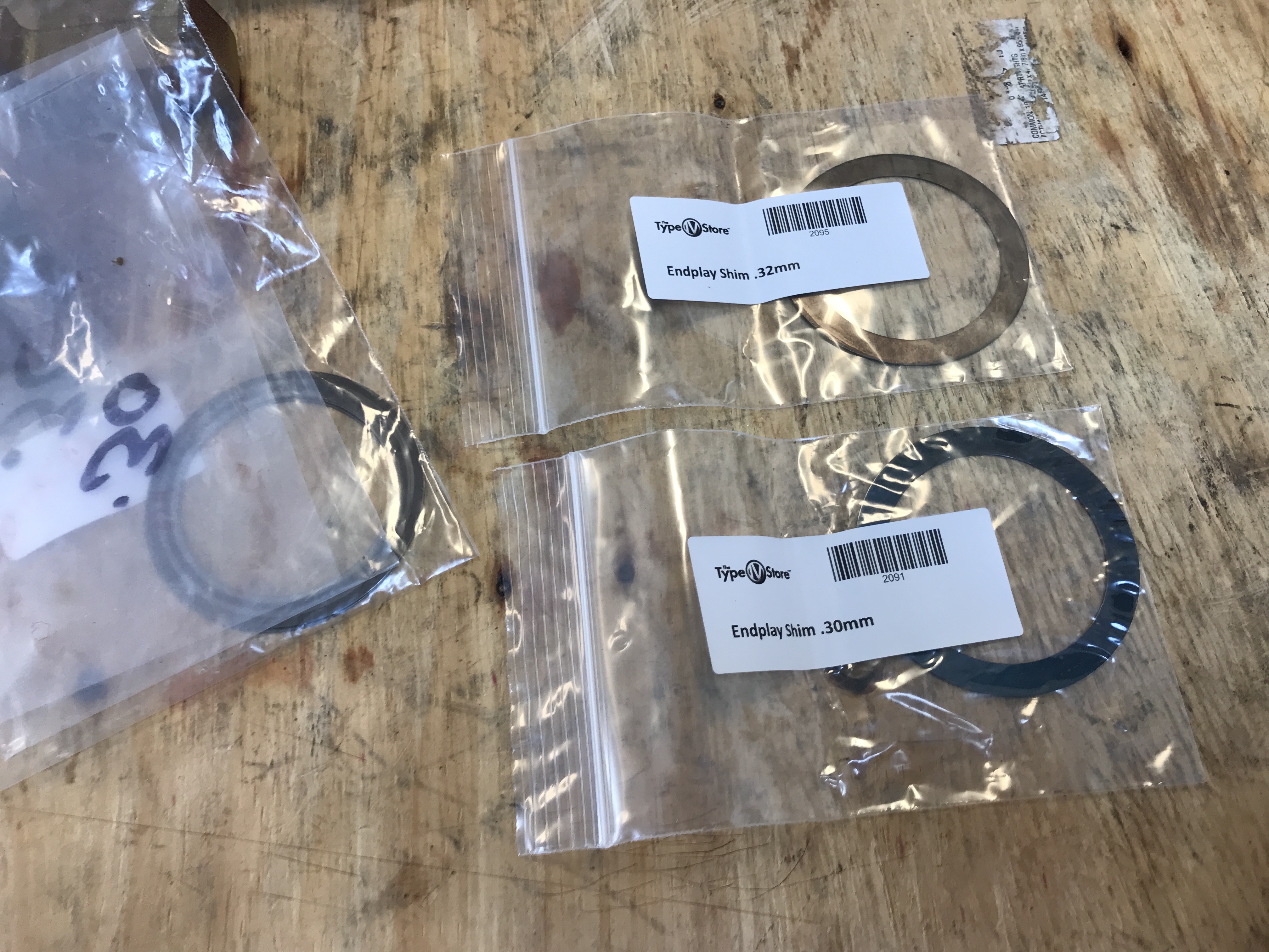

While I was gone, some new crankshaft shims arrived.
bkrantz
post Aug 27 2021, 07:26 PM
Post #3578
Posts: 8,800
Joined: 3-August 19
From: SW Colorado
Member No.: 23,343
One of these should do the job. (Turned out the 0.30mm is the 0.012 shim I needed.)
bkrantz
post Aug 27 2021, 07:27 PM
Post #3579
Posts: 8,800
Joined: 3-August 19
From: SW Colorado
Member No.: 23,343

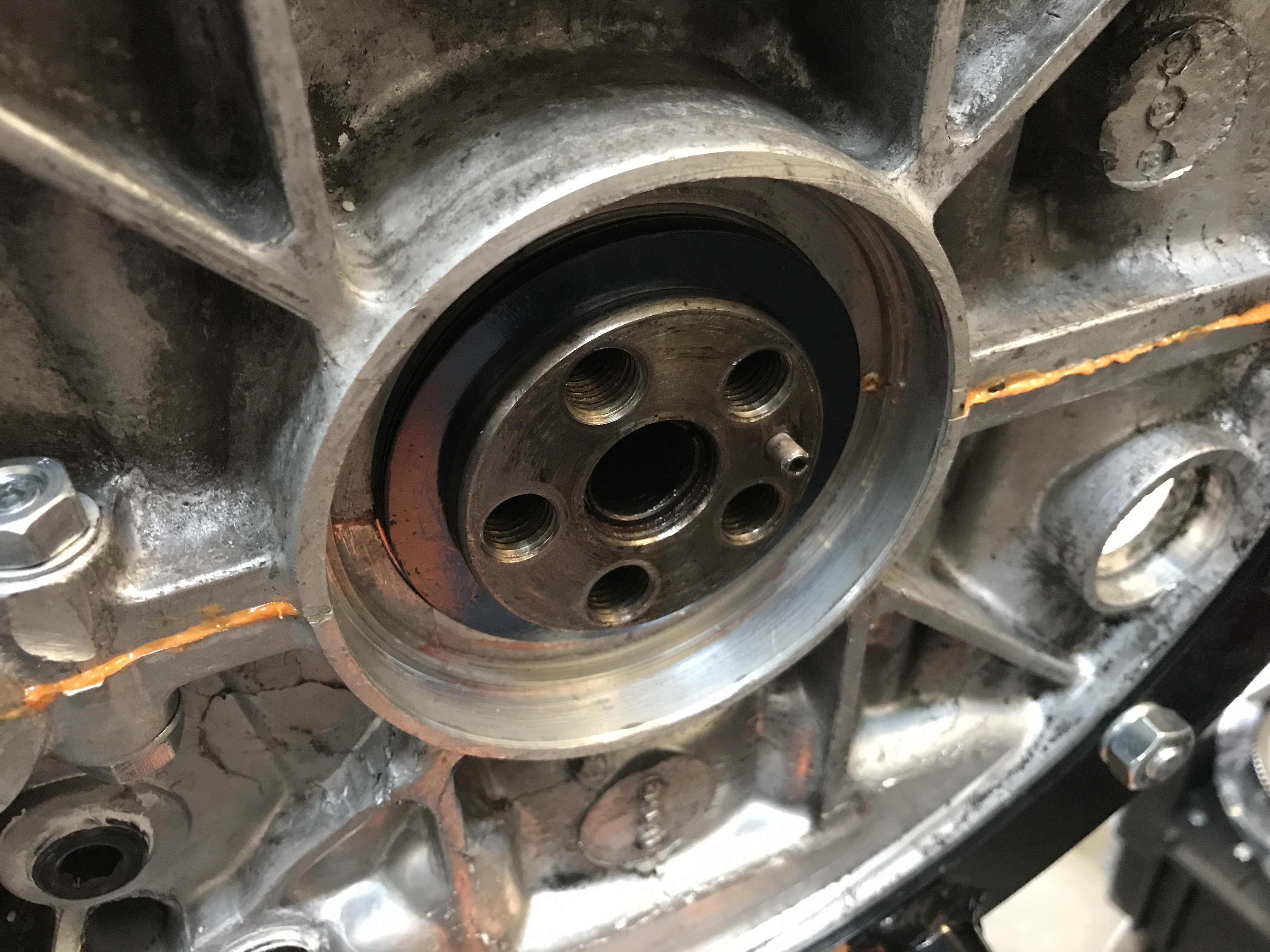

New shim in place--that makes the proper 3.

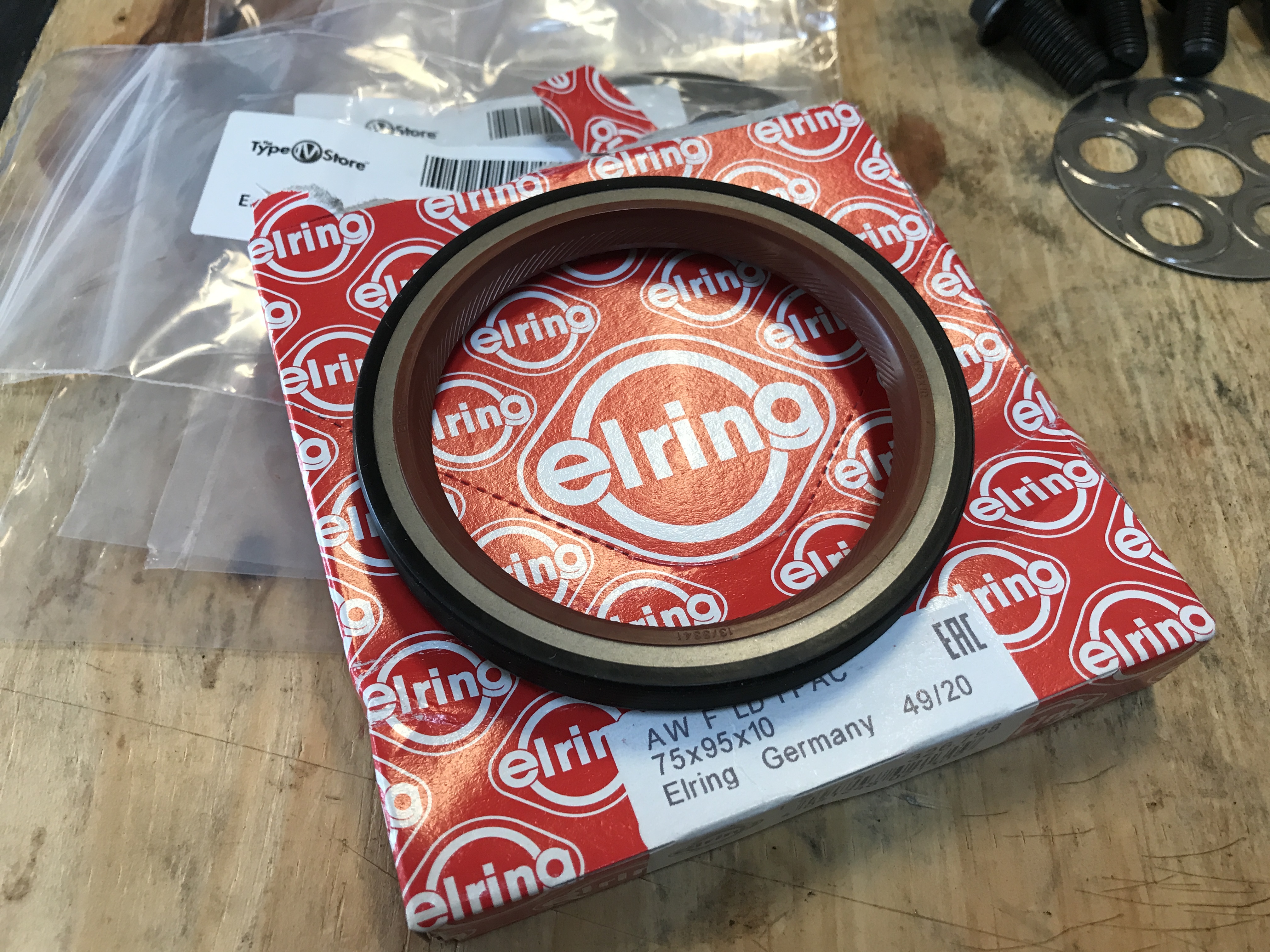

New rear seal.
