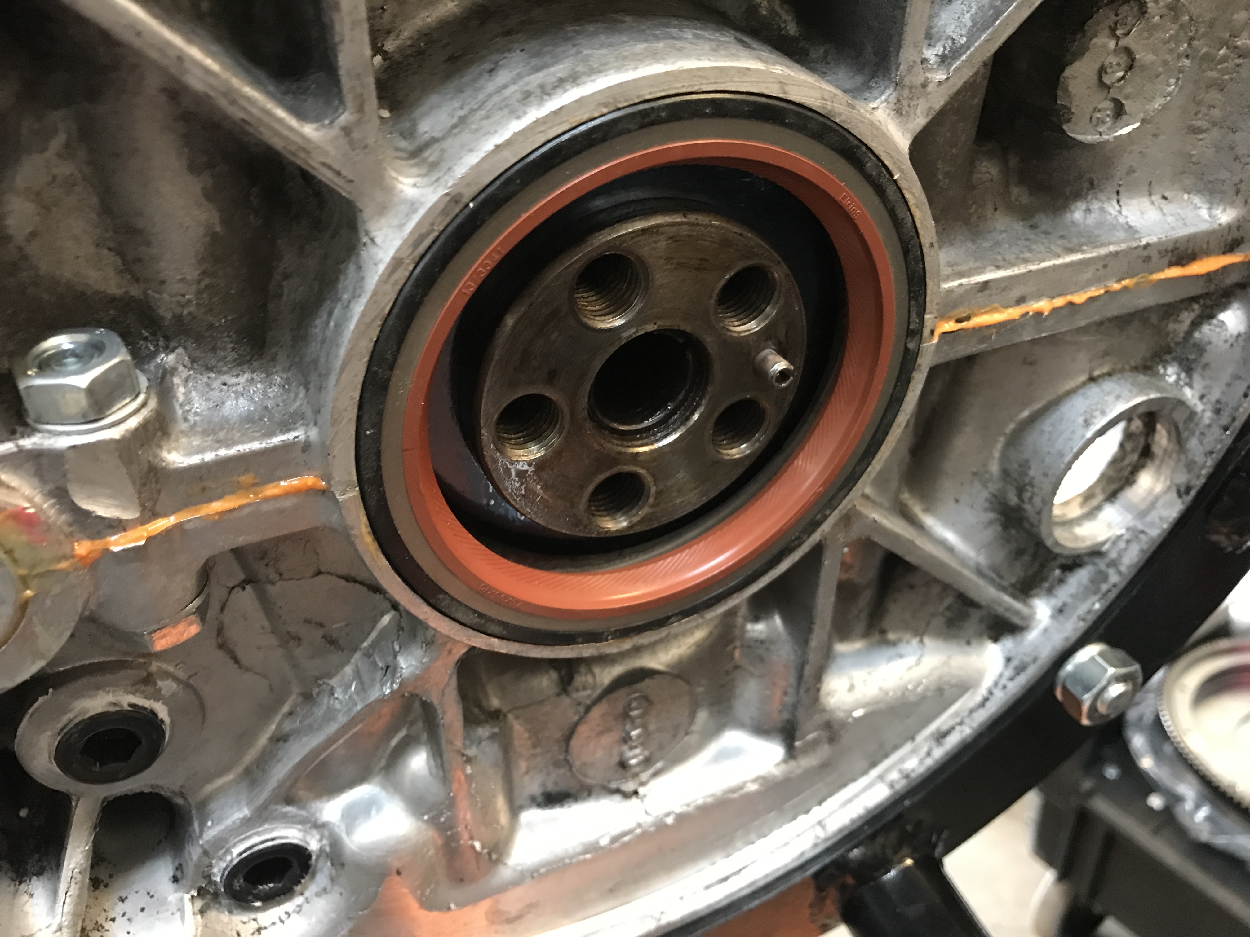

Seal in place. It was a snug but not super tight fit.

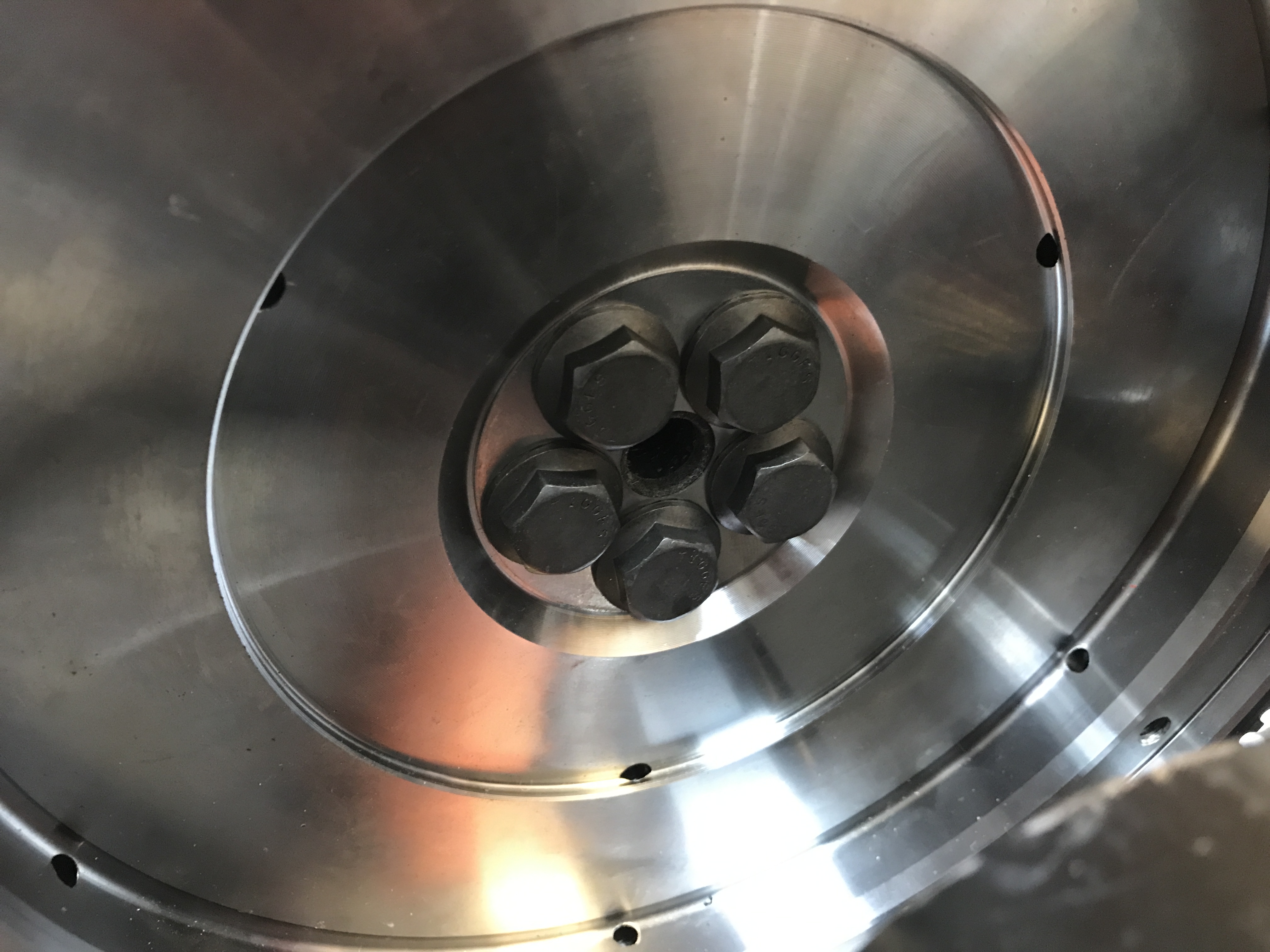

Member No.: 23,343

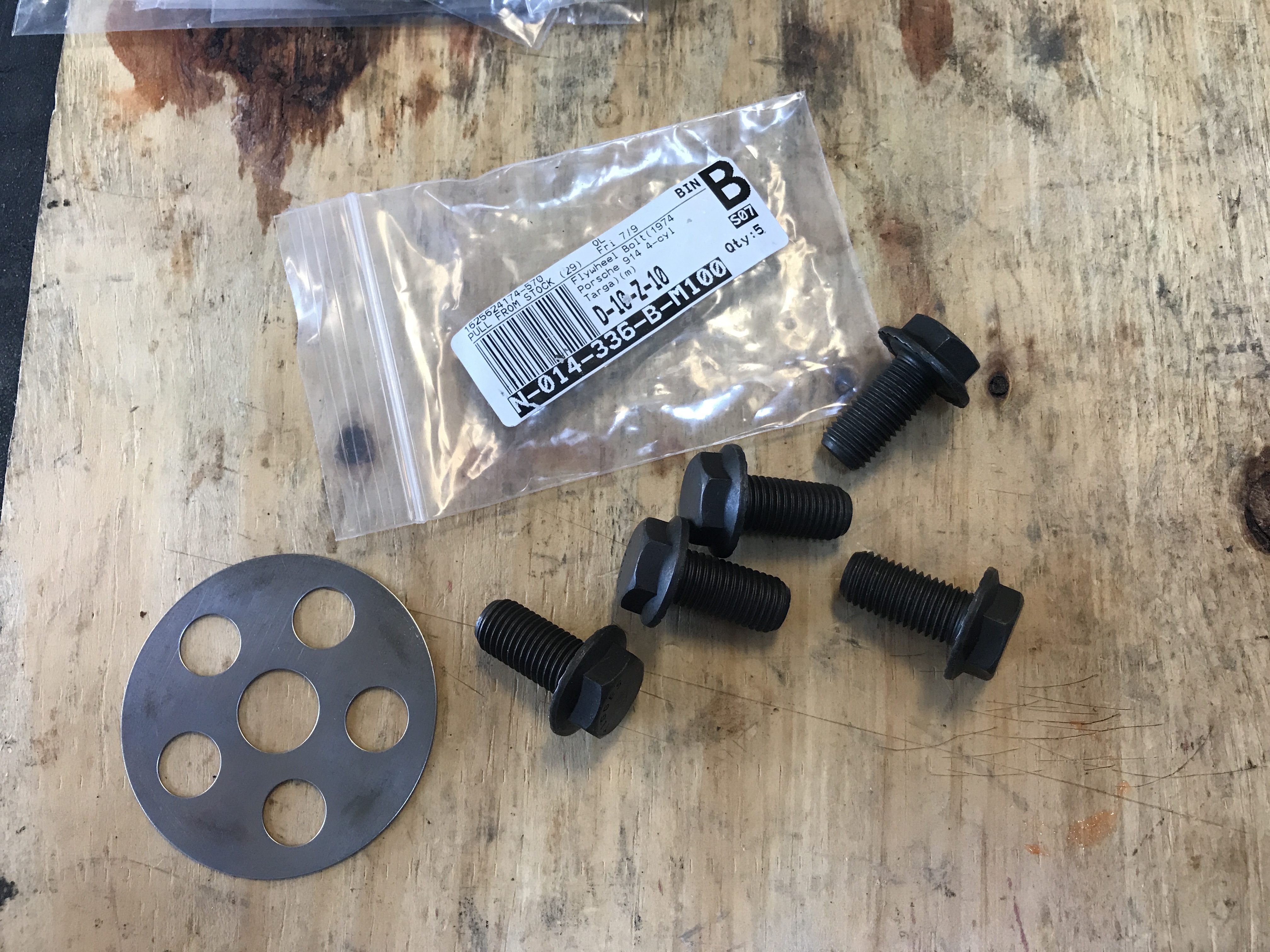

New flywheel bolts and plate. This might be over-kill but some sources suggest not re-using bolts that have been torqued before.
bkrantz
post Aug 27 2021, 07:34 PM
Post #3583
Posts: 8,800
Joined: 3-August 19
From: SW Colorado
Member No.: 23,343
Flywheel mounted and bolts torqued.

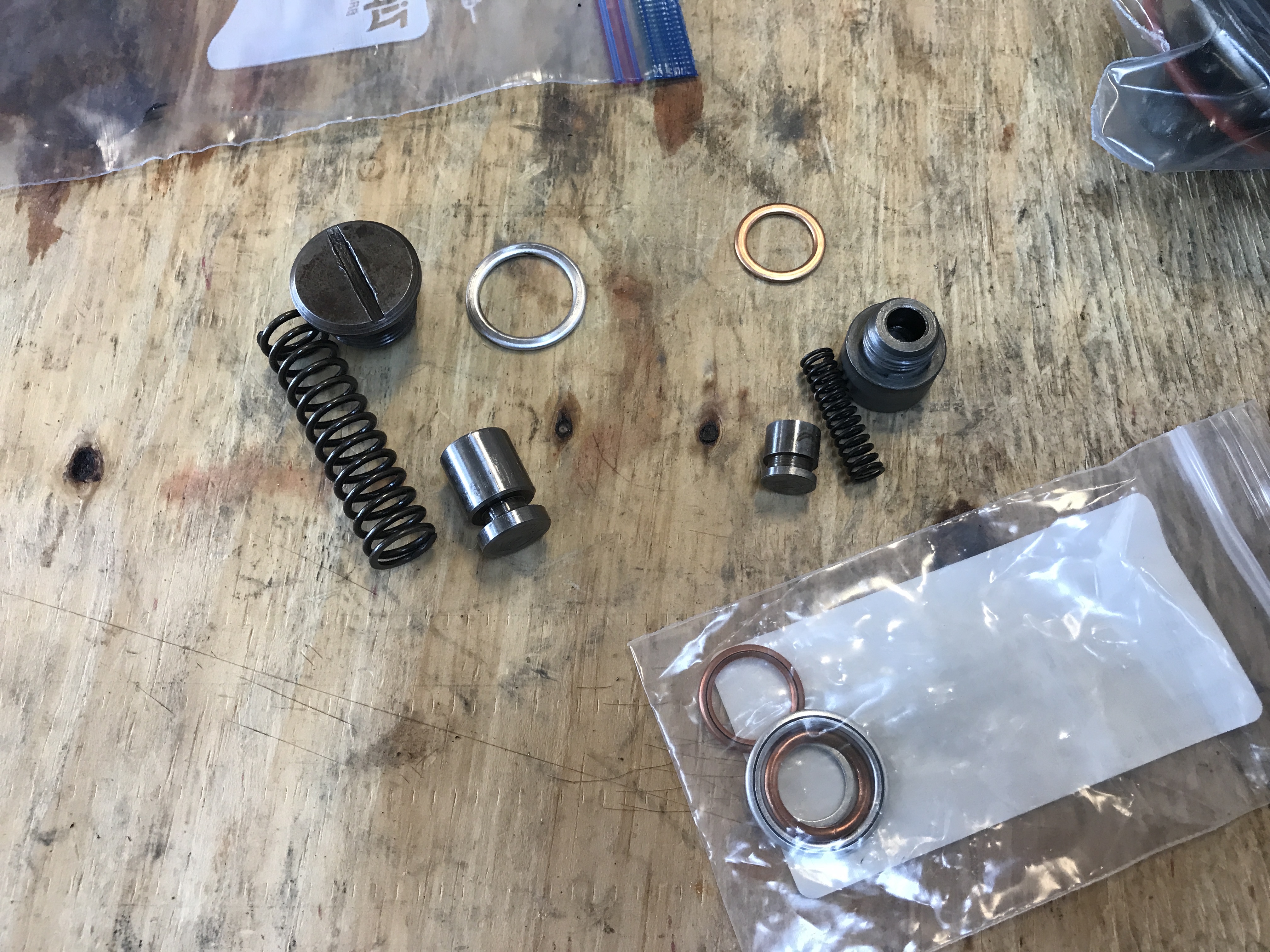

Then I got out the parts for the oil pressure valves, and new seals.

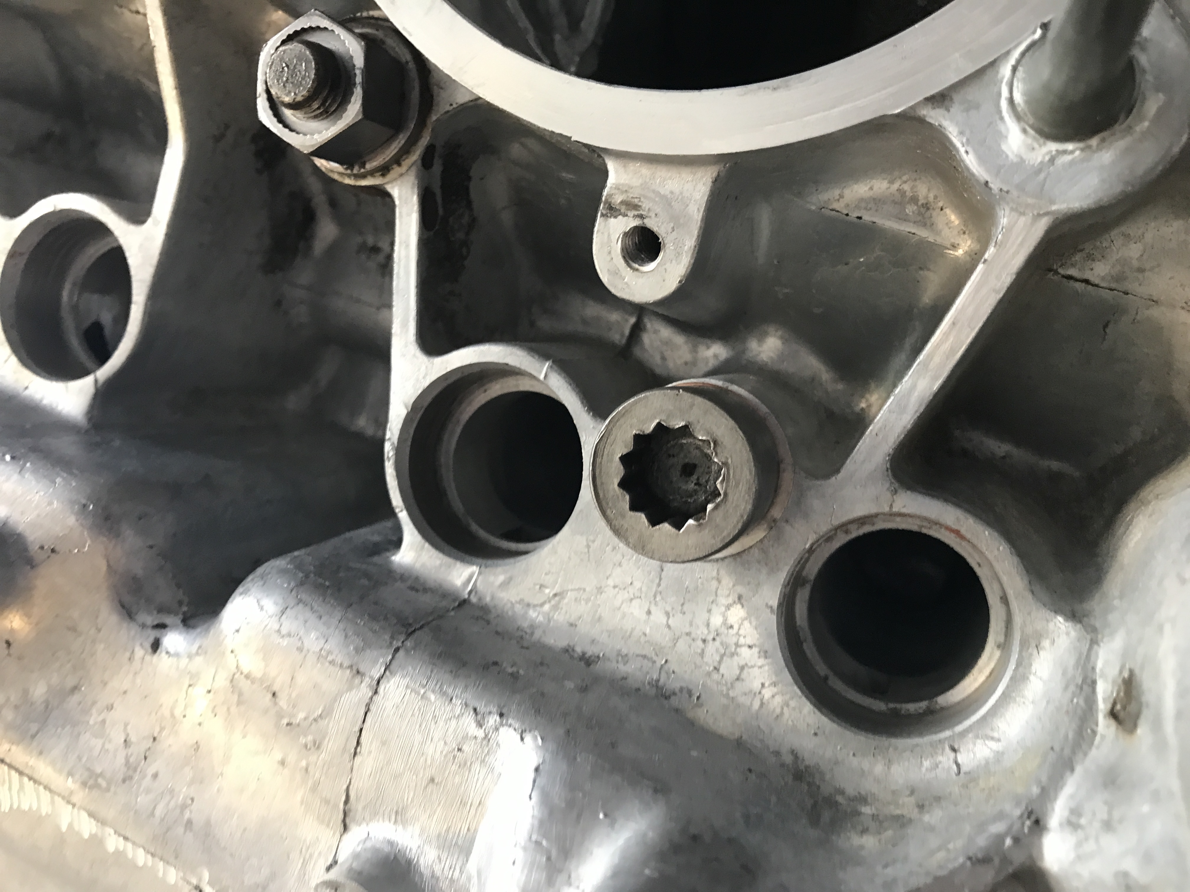

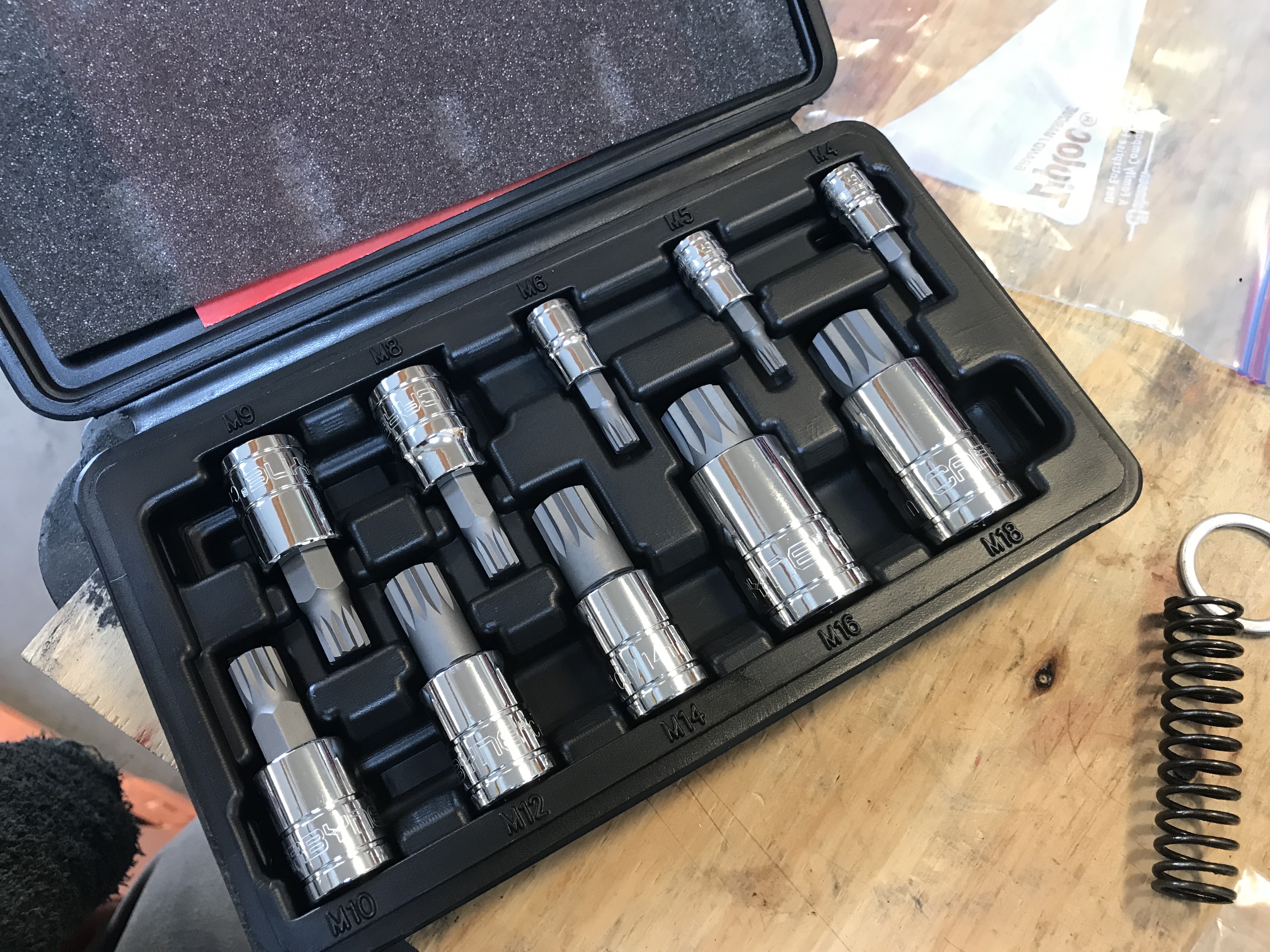

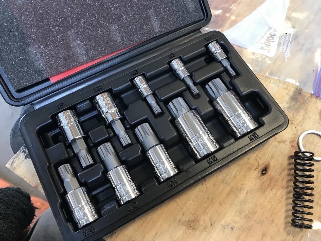

I got to use my new triple-square bits.
bkrantz
post Aug 27 2021, 07:38 PM
Post #3586
Posts: 8,800
Joined: 3-August 19
From: SW Colorado
Member No.: 23,343
Small valve installed, with a 14 mm triple-square.

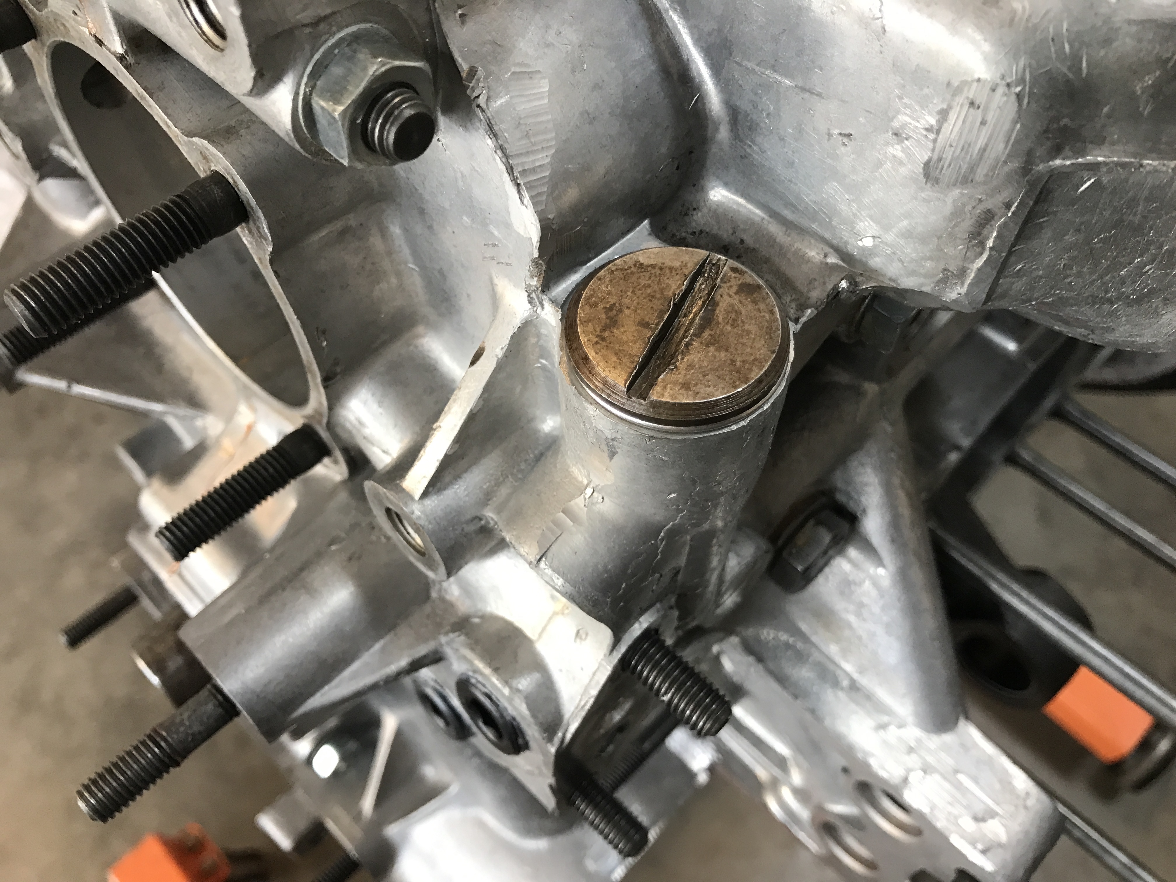

Joined: 3-August 19
From: SW Colorado
Member No.: 23,343
And back to my home-made tool for the larger valve retaining plug.
bkrantz
post Aug 27 2021, 07:39 PM
Post #3588
Posts: 8,800
Joined: 3-August 19
From: SW Colorado
Member No.: 23,343
Installed.

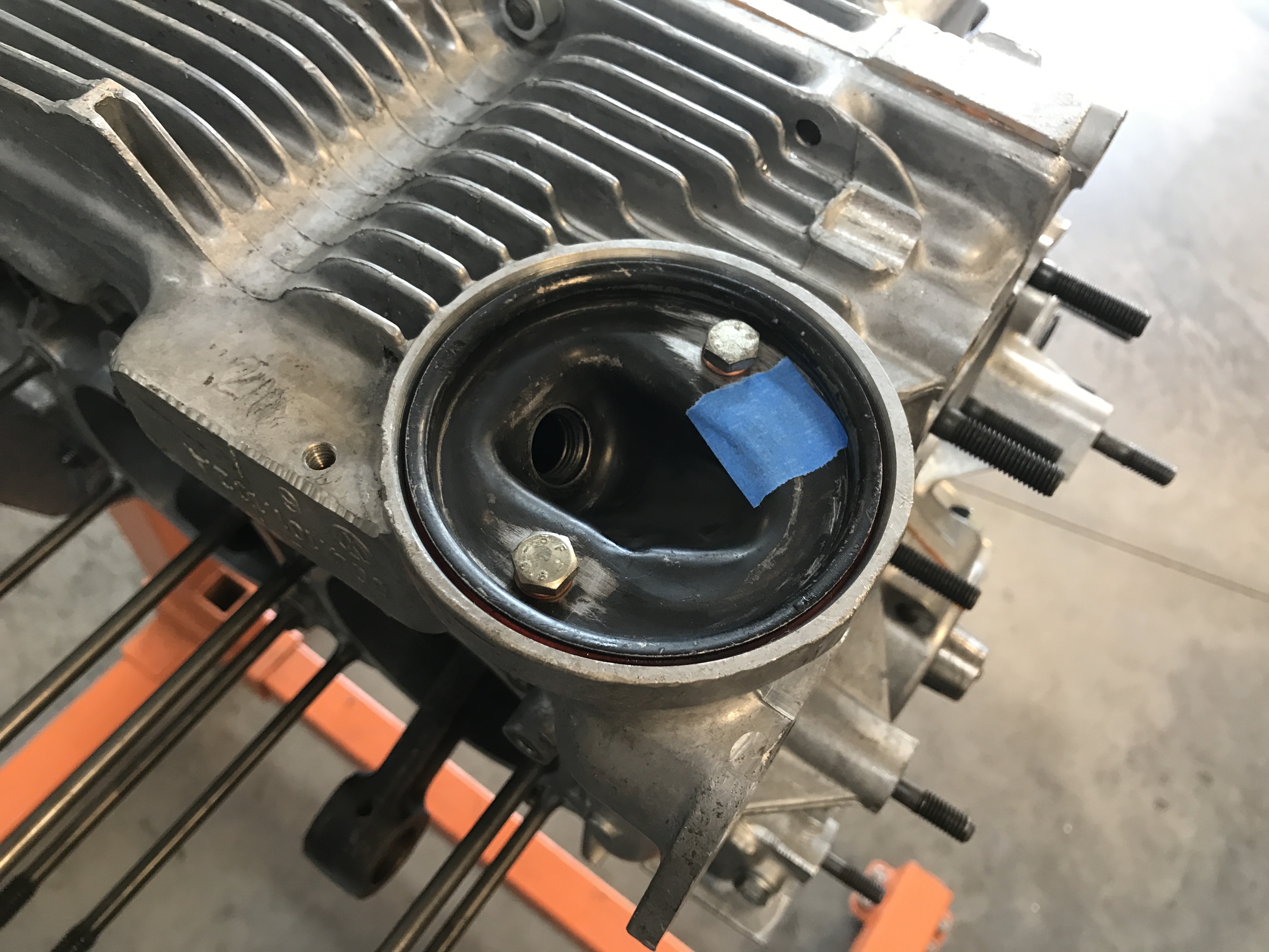

Member No.: 23,343

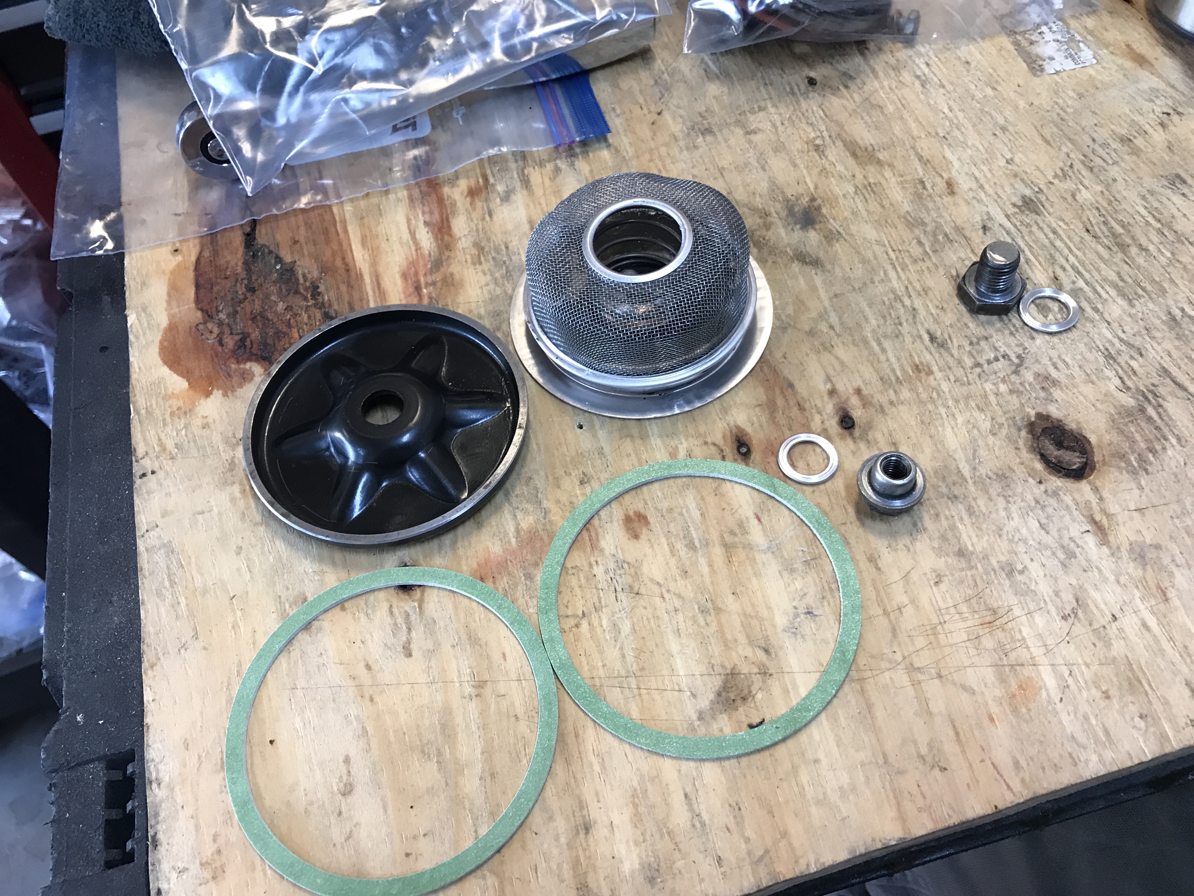

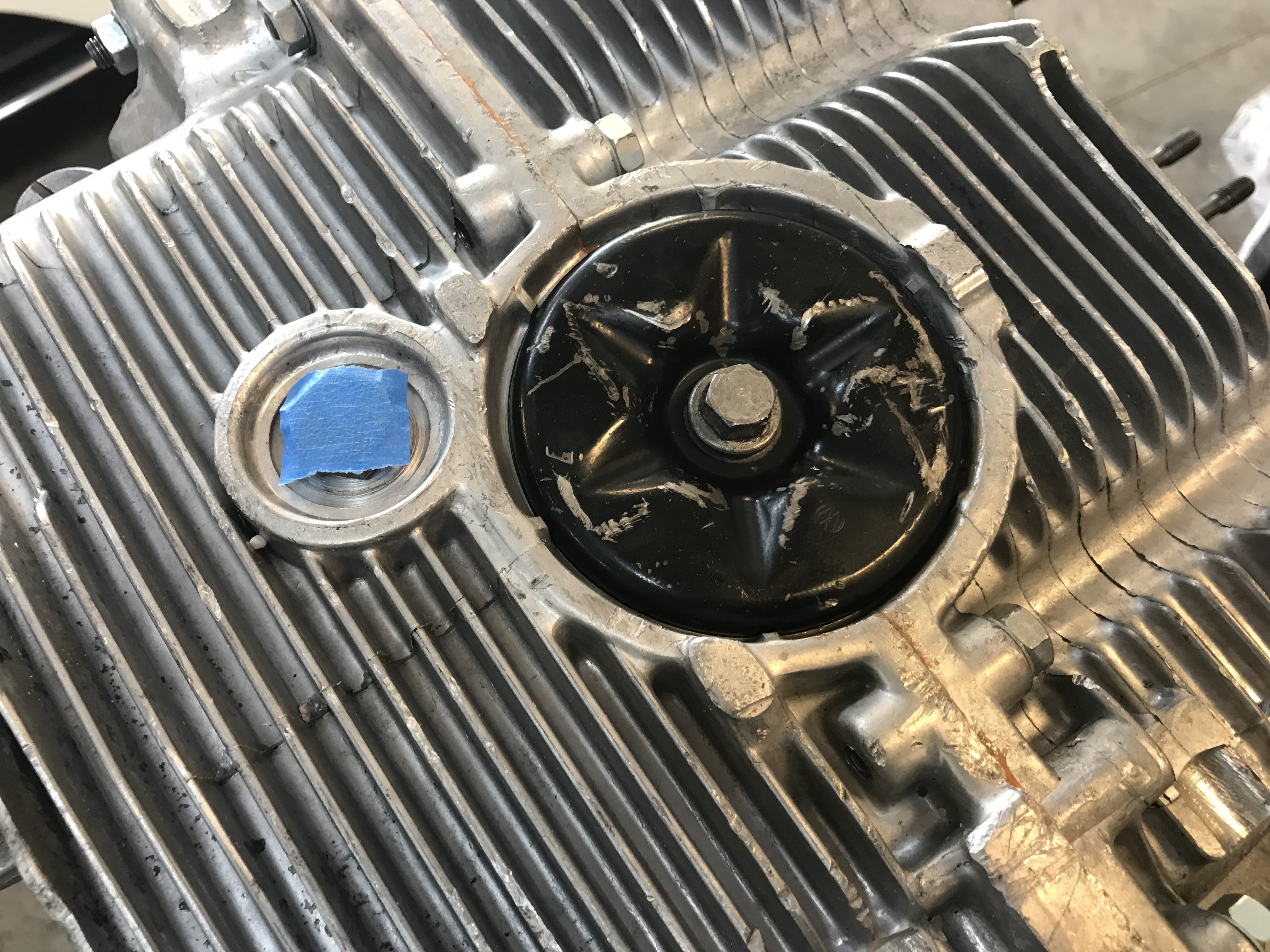

And then the strainer. I re-used the paper ring gaskets, but new got new crush rings.
bkrantz
post Aug 27 2021, 07:42 PM
Post #3590
Posts: 8,800
Joined: 3-August 19
From: SW Colorado
Member No.: 23,343
Strainer and cover in place. The blue tape is a reminder that the drain plug is only finger tight.

Any tips on getting the rear main seal in place? That's coming up on my list of things to do.
Thanks!
bkrantz
post Aug 28 2021, 07:43 PM
Post #3592
Posts: 8,800
Joined: 3-August 19
From: SW Colorado
Member No.: 23,343
QUOTE(krazykonrad @ Aug 28 2021, 04:51 PM) *
Thanks!
I was able to push mine into place--a strong push but I did not need to use a hammer or other impact until the last couple of mm. By then it was in straight.

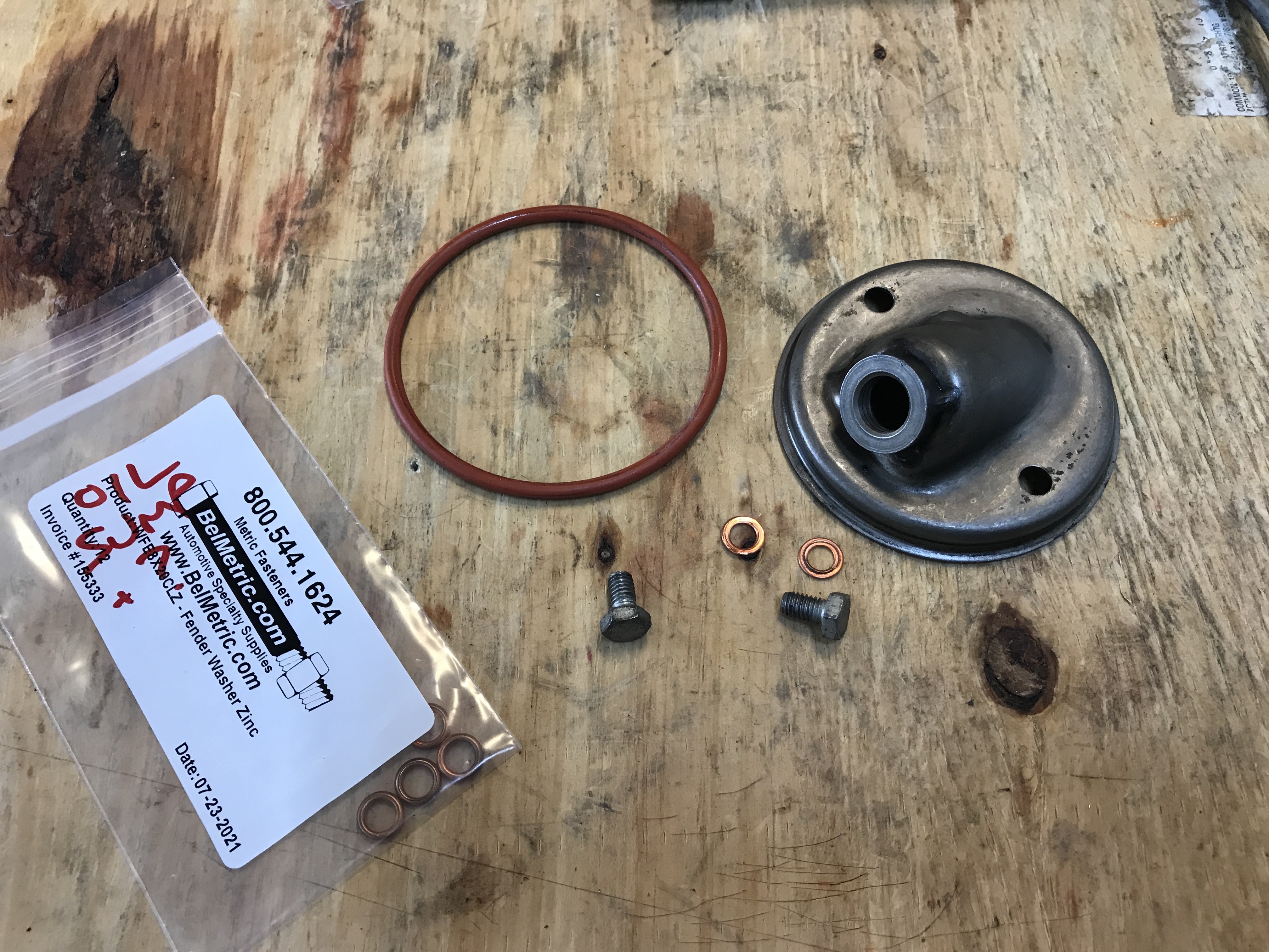

Parts for the oil temp sensor, including the taco plate.

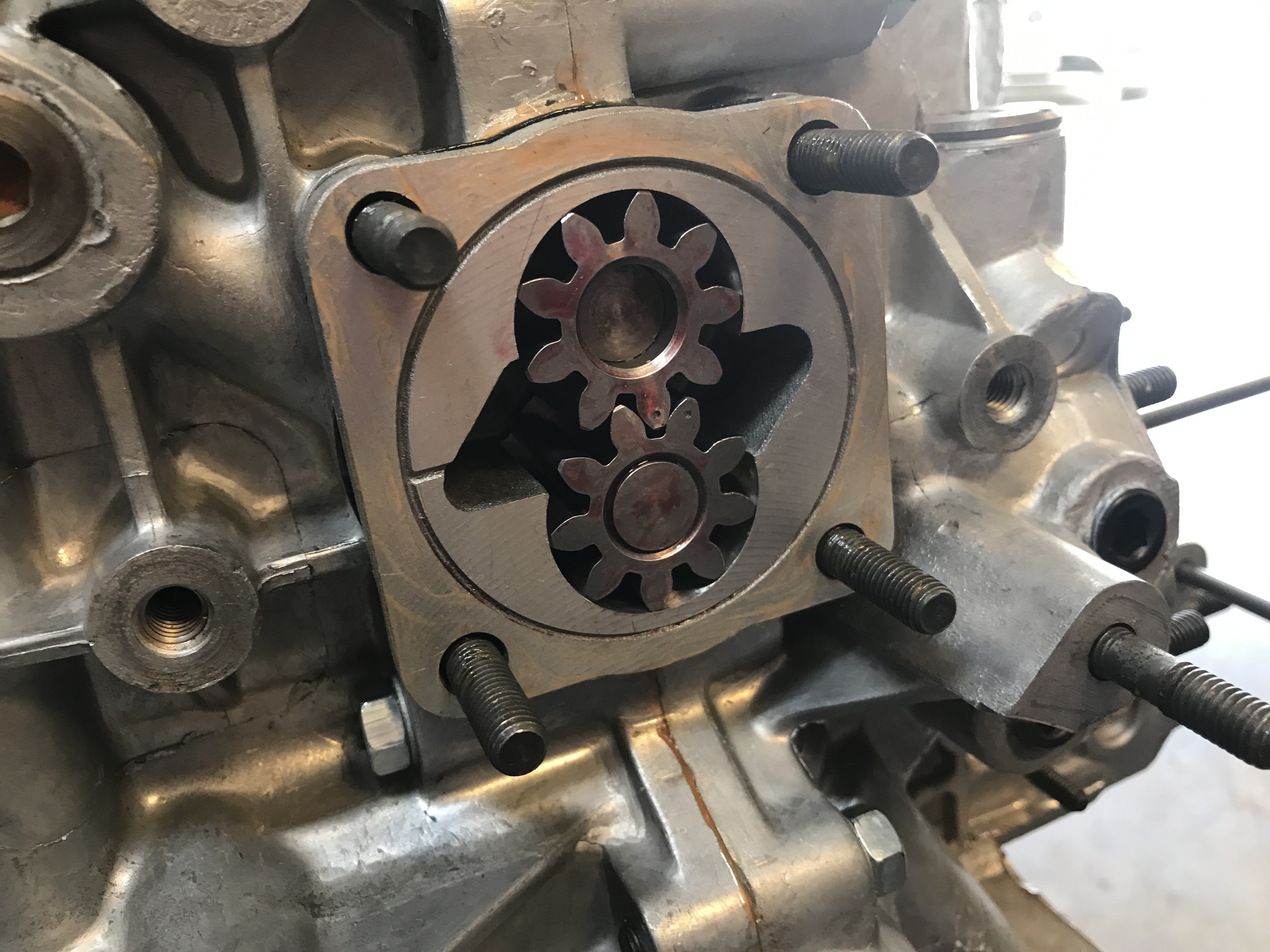

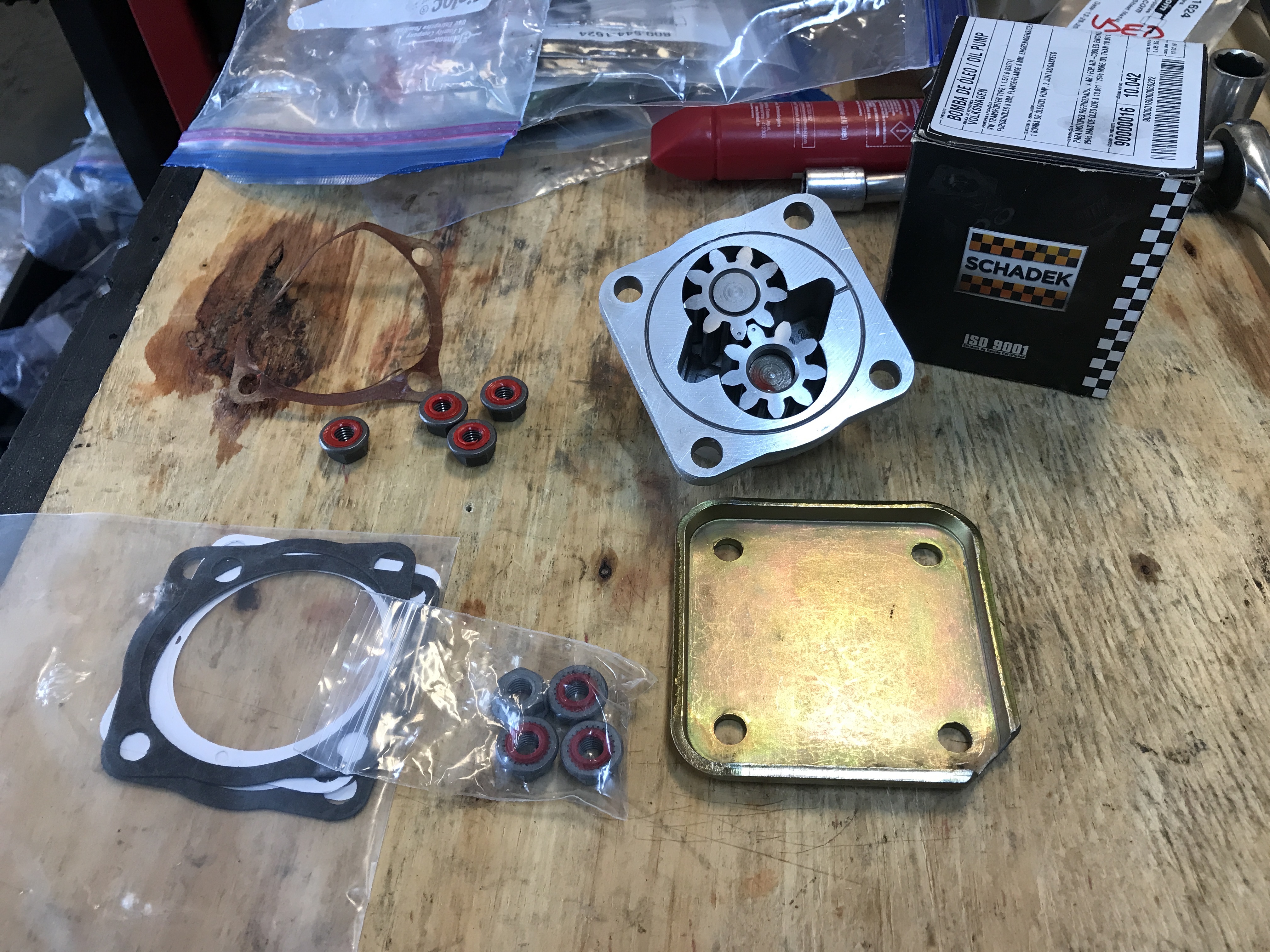

Then the oil pump stuff, plus new gaskets and sealing nuts.
bkrantz
post Aug 28 2021, 07:48 PM
Post #3596
Posts: 8,800
Joined: 3-August 19
From: SW Colorado
Member No.: 23,343

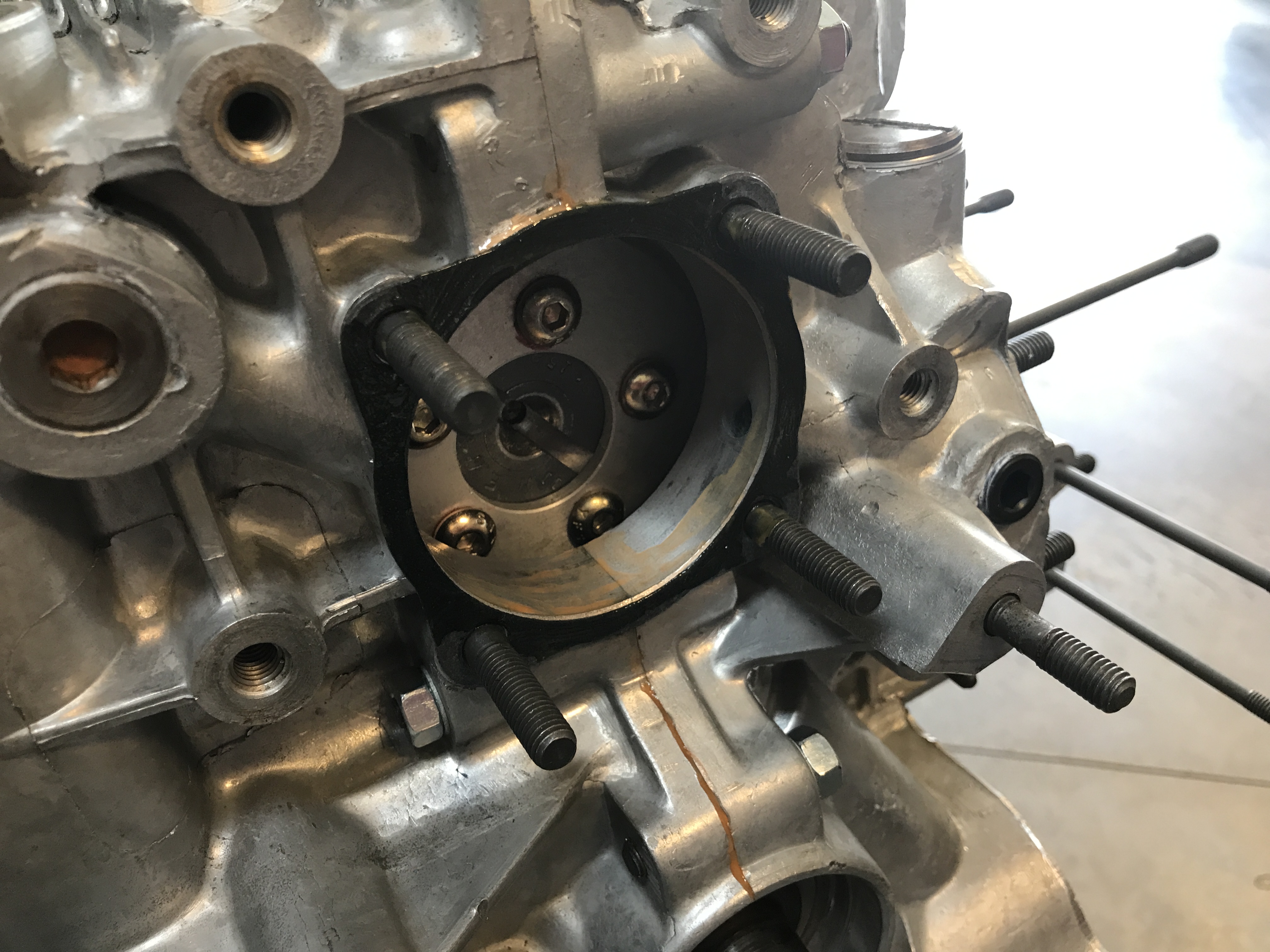

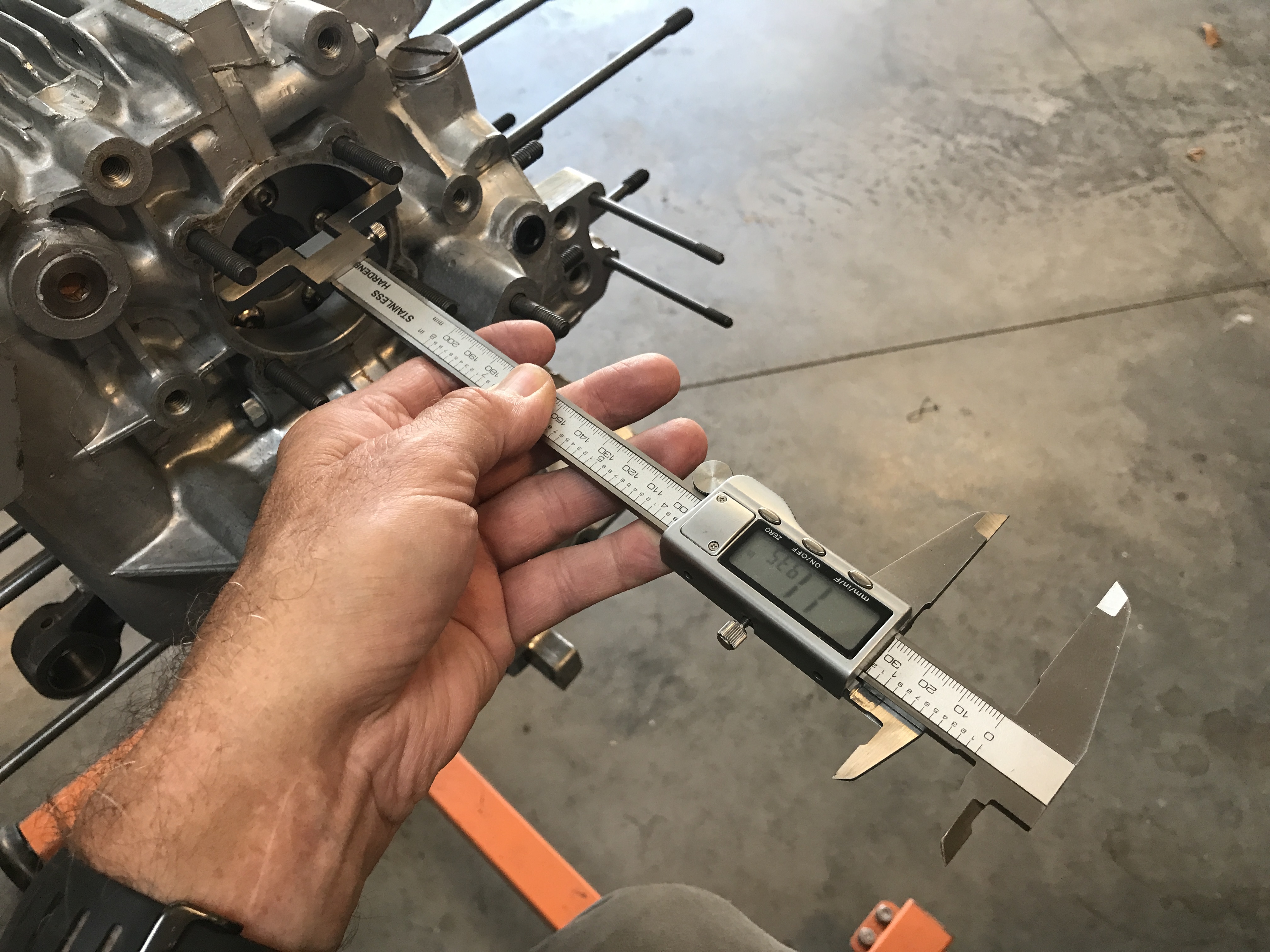

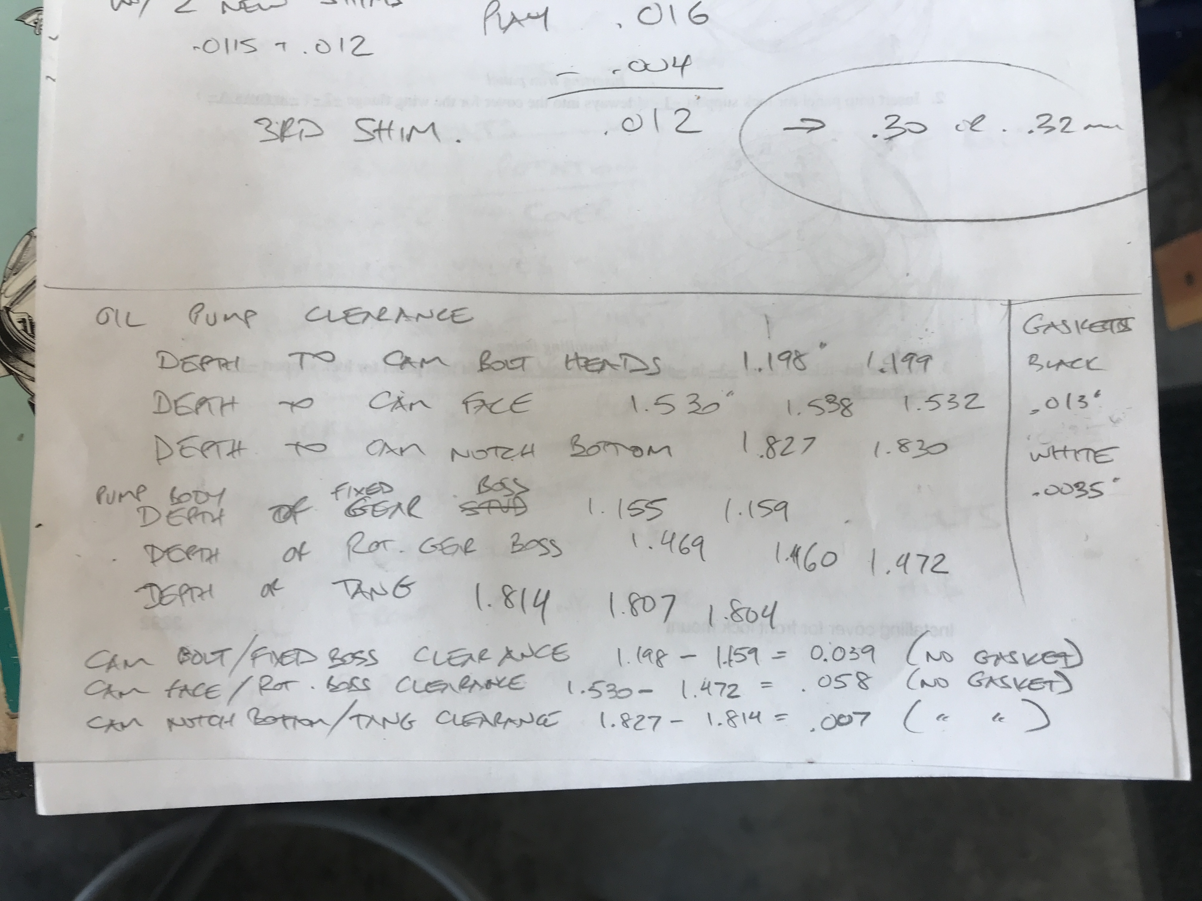

I had previously measured everything, but decided to check again.
bkrantz
Post #3597
Posts: 8,800
Joined: 3-August 19
From: SW Colorado
Member No.: 23,343
Here's what I measured, and the calculated clearances.
bkrantz
post Aug 28 2021, 07:50 PM
Post #3598
Posts: 8,800

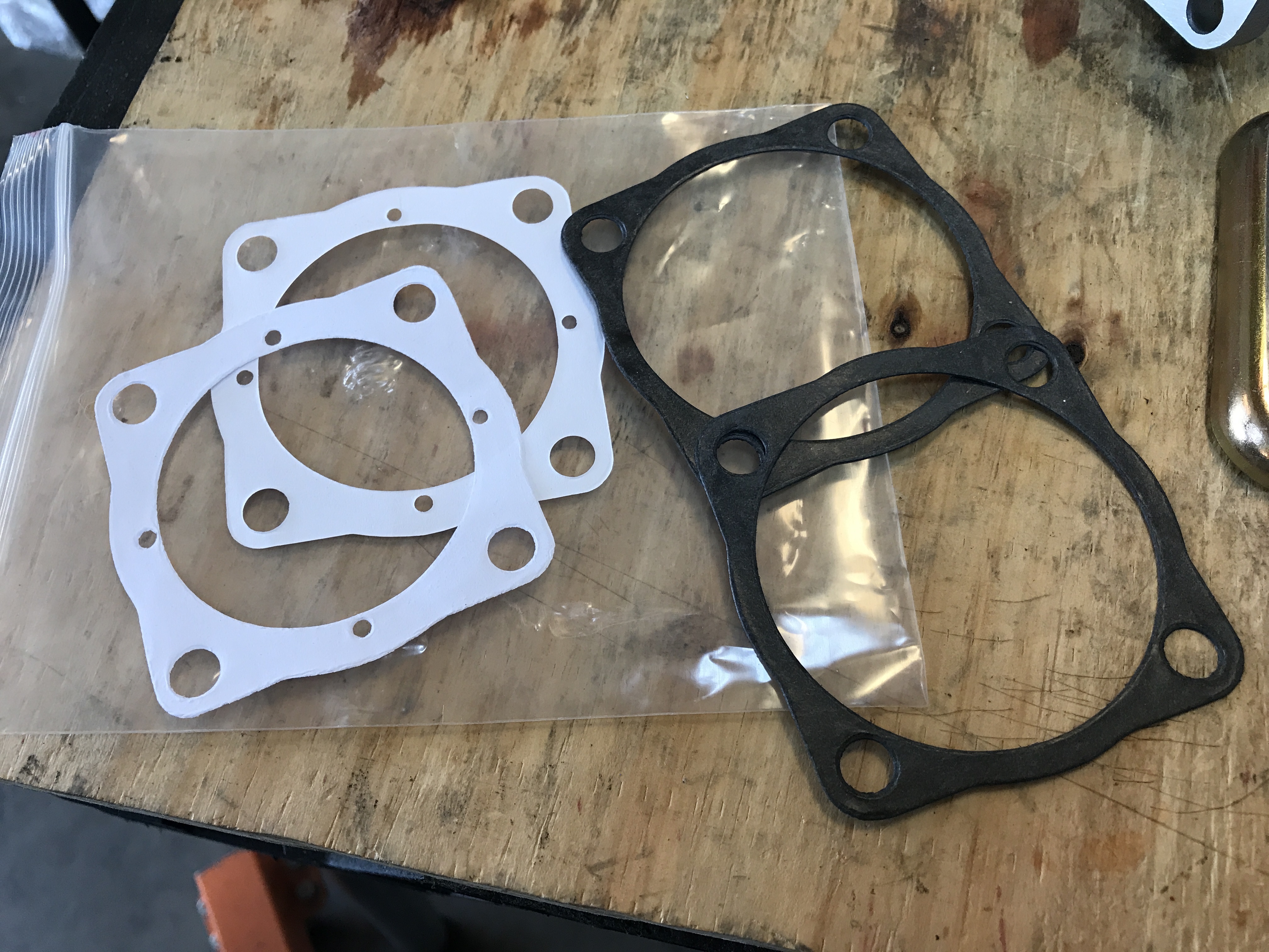

Joined: 3-August 19
From: SW Colorado
Member No.: 23,343

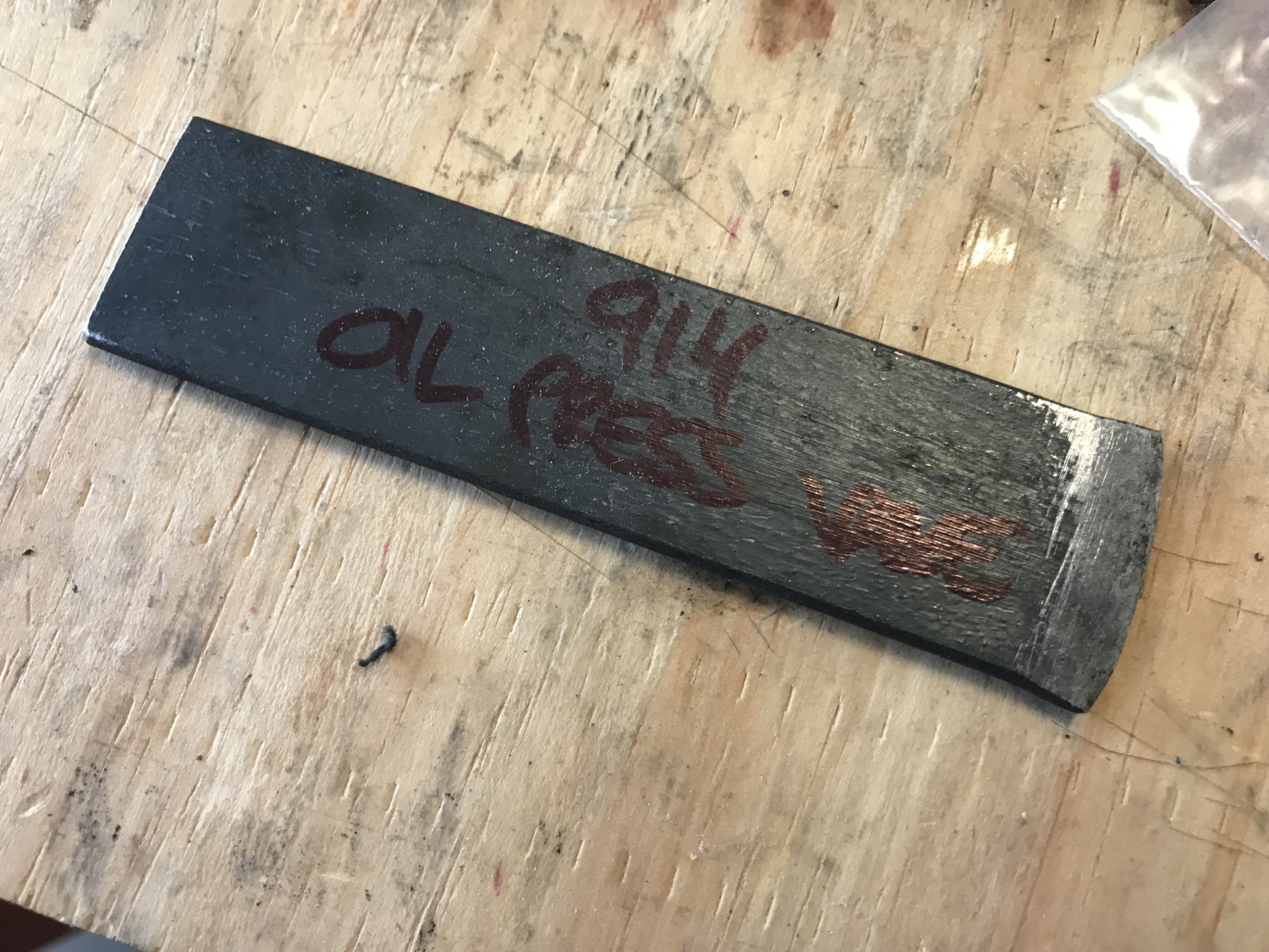

To get a bit more clearance, I used the thicker black gasket, which should add about 0.010" when compressed.

bkrantz
post Aug 28 2021, 07:54 PM
Post #3600
Posts: 8,800
Joined: 3-August 19
From: SW Colorado
Member No.: 23,343
Pump in place, with a very thin smear of sealant on the face, and assembly lube on the gears.
