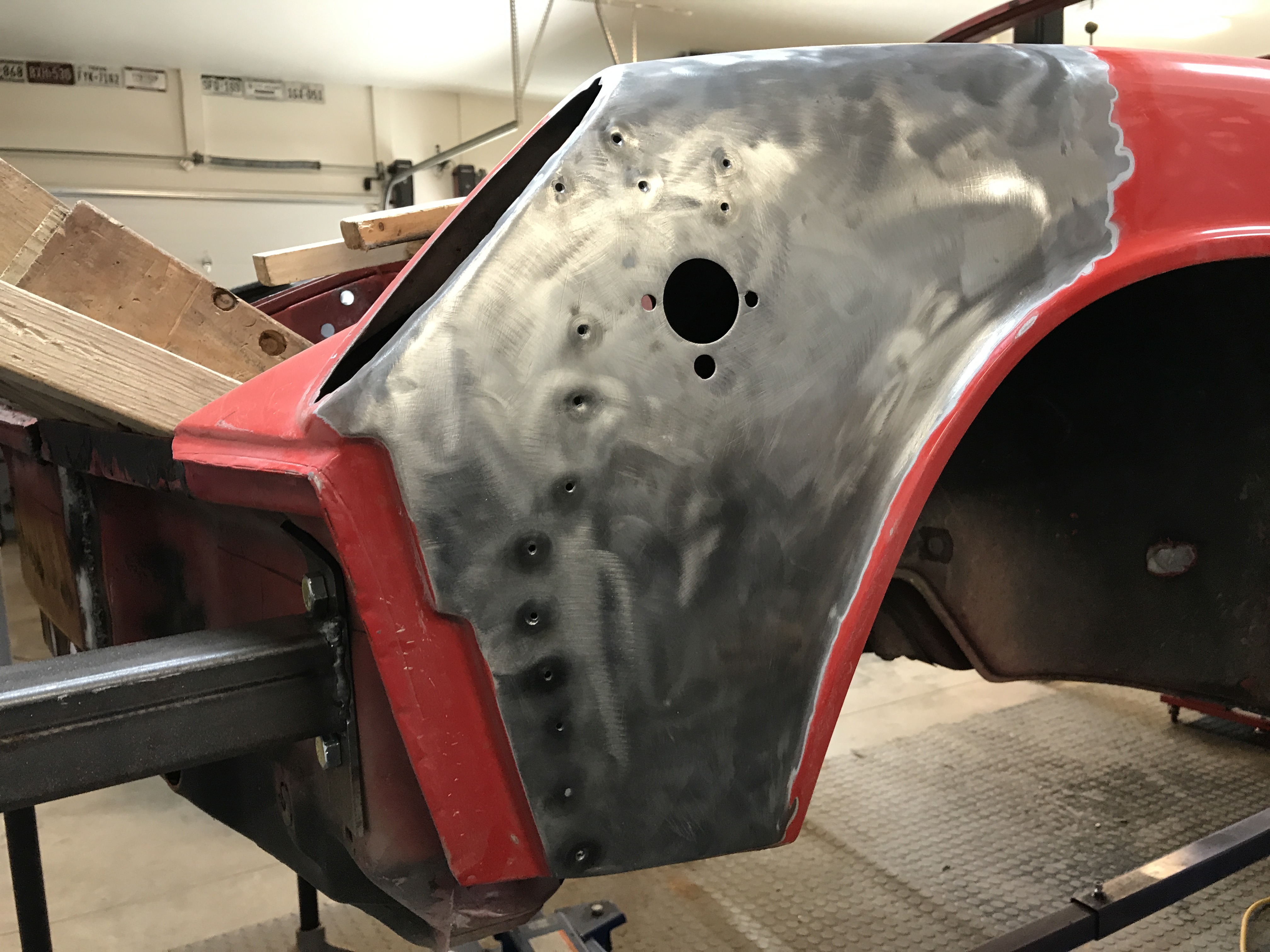

I guess PO decided not to have a radio antenna.

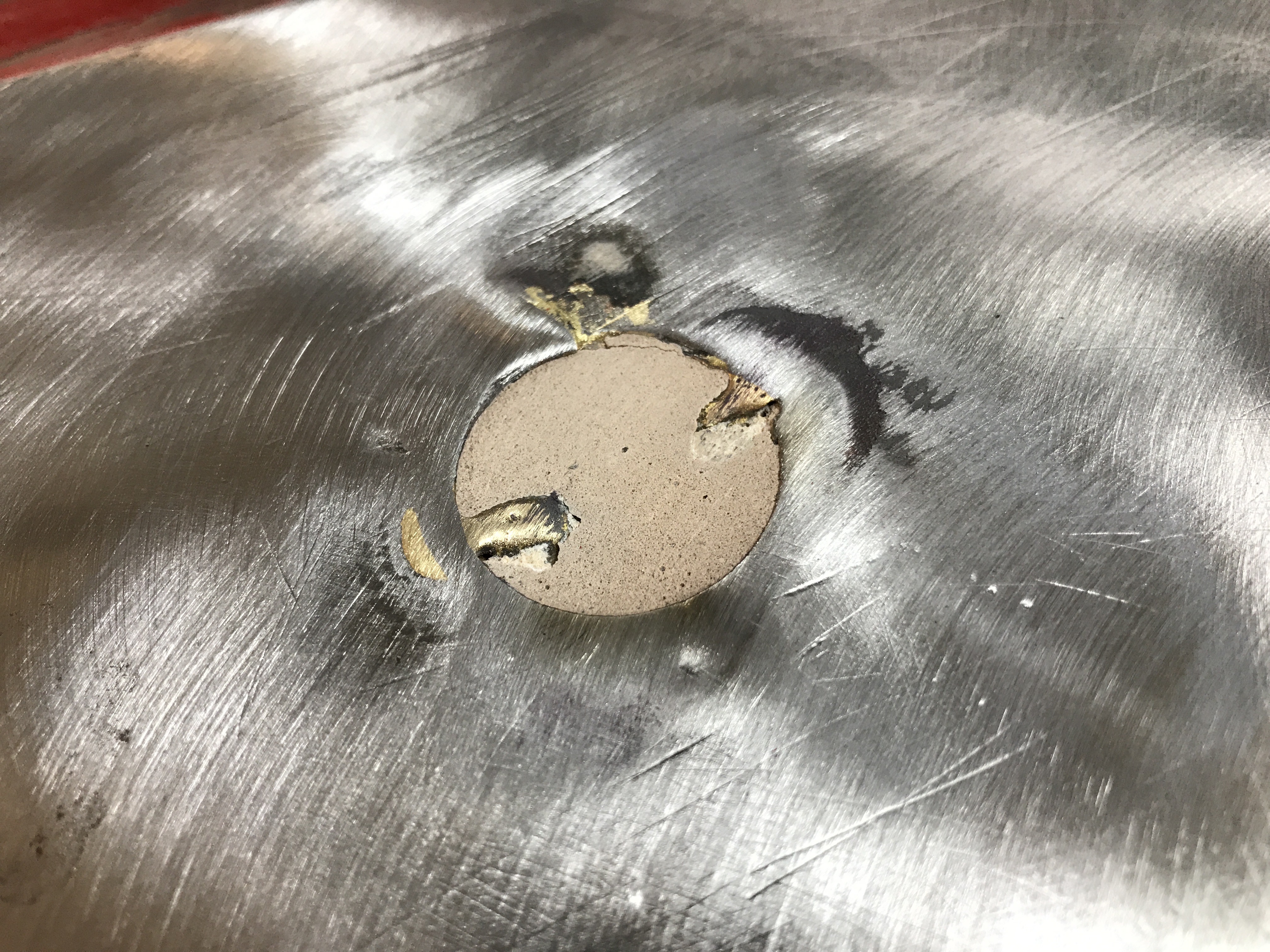

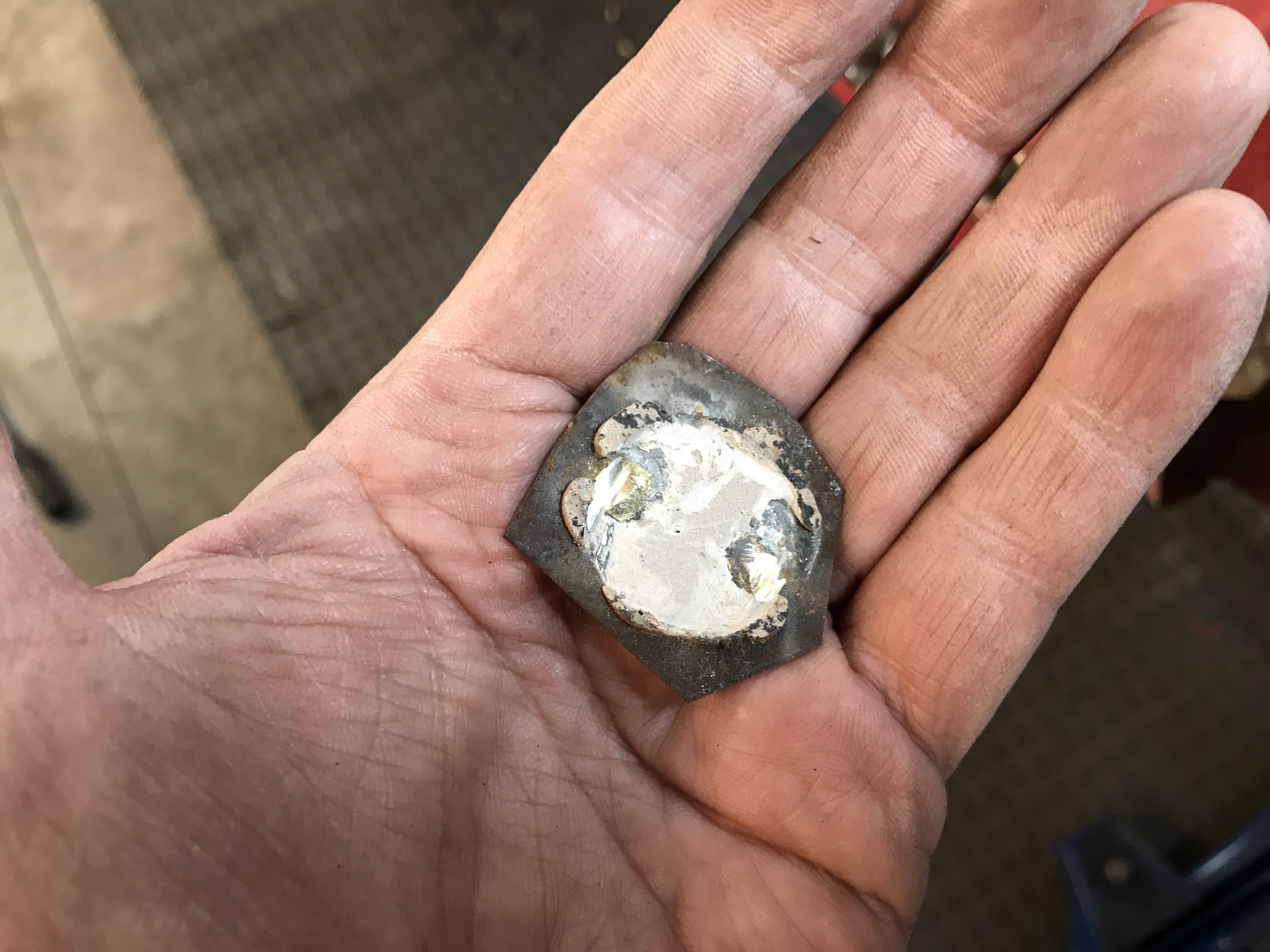

Got the Dremel tool out and cut the brazing. The hole is whole again.

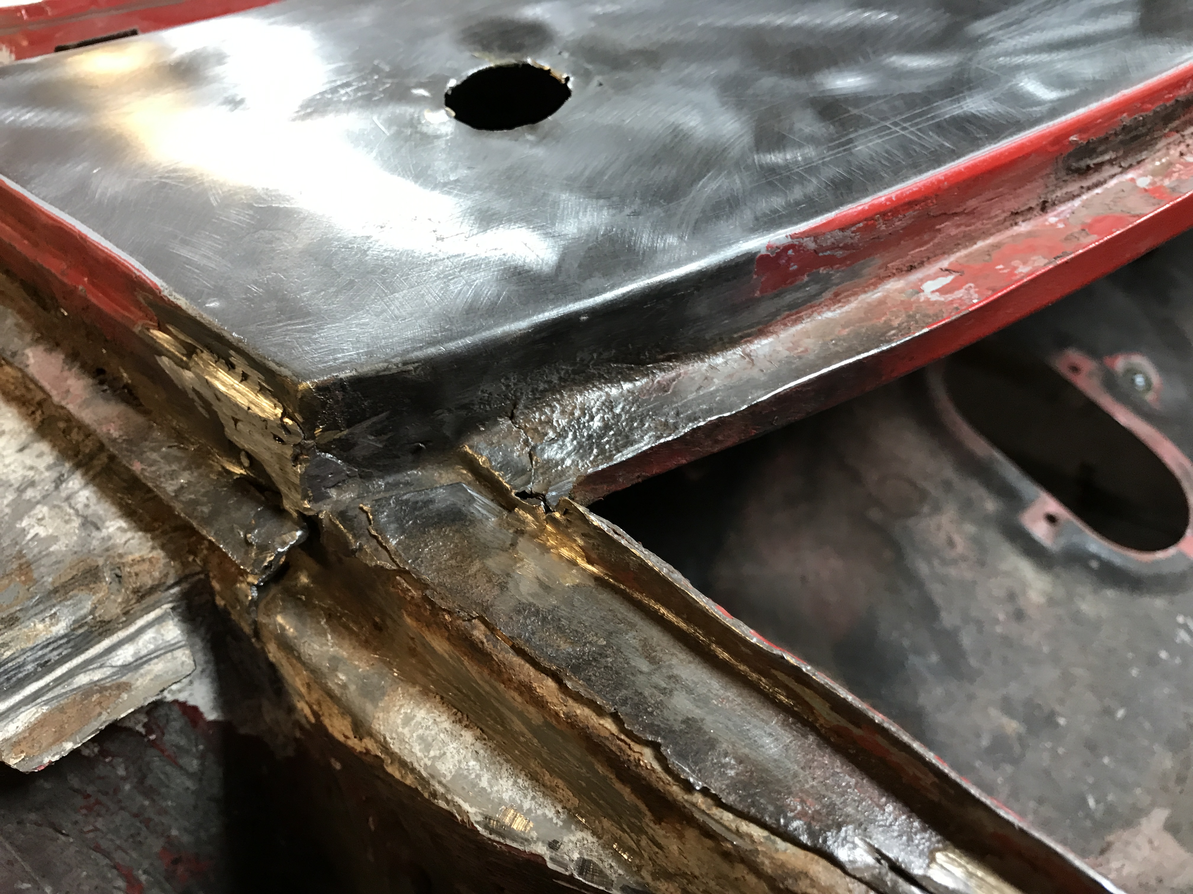

And in keeping with PO repair quality, check the piece they brazed on the underside. Nice shape!

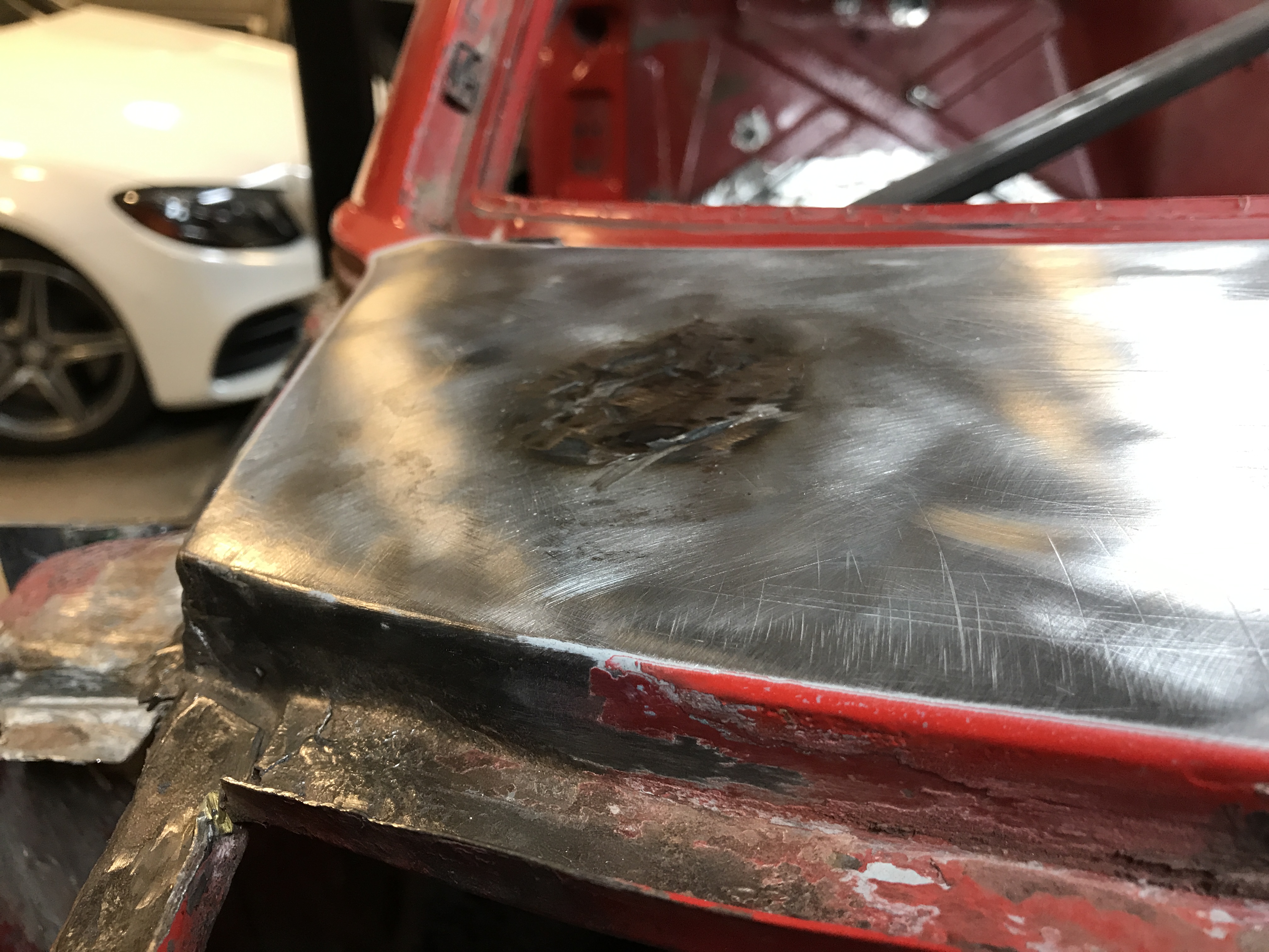

One more job for the grinder: the left front fender. And if you are keeping score, this means the only panel not (yet) subject to repair or replacement is the left rear fender.
Anyway, I knew the front part of the fender had been repaired, with puller holes showing on the inside and some filler. Turns out quite a bit of filler.
The metal can be made lots better.

Am I seeing right that the antenna hole is in the cowl? I've never seen one mounted there. Usually on driver's side fender or sometimes passenger side.

Thats my guess for the purpose of the hole. Now you reminded me to do more research for the standard location for 1973.
In any case, the metal is not really strong enough there.

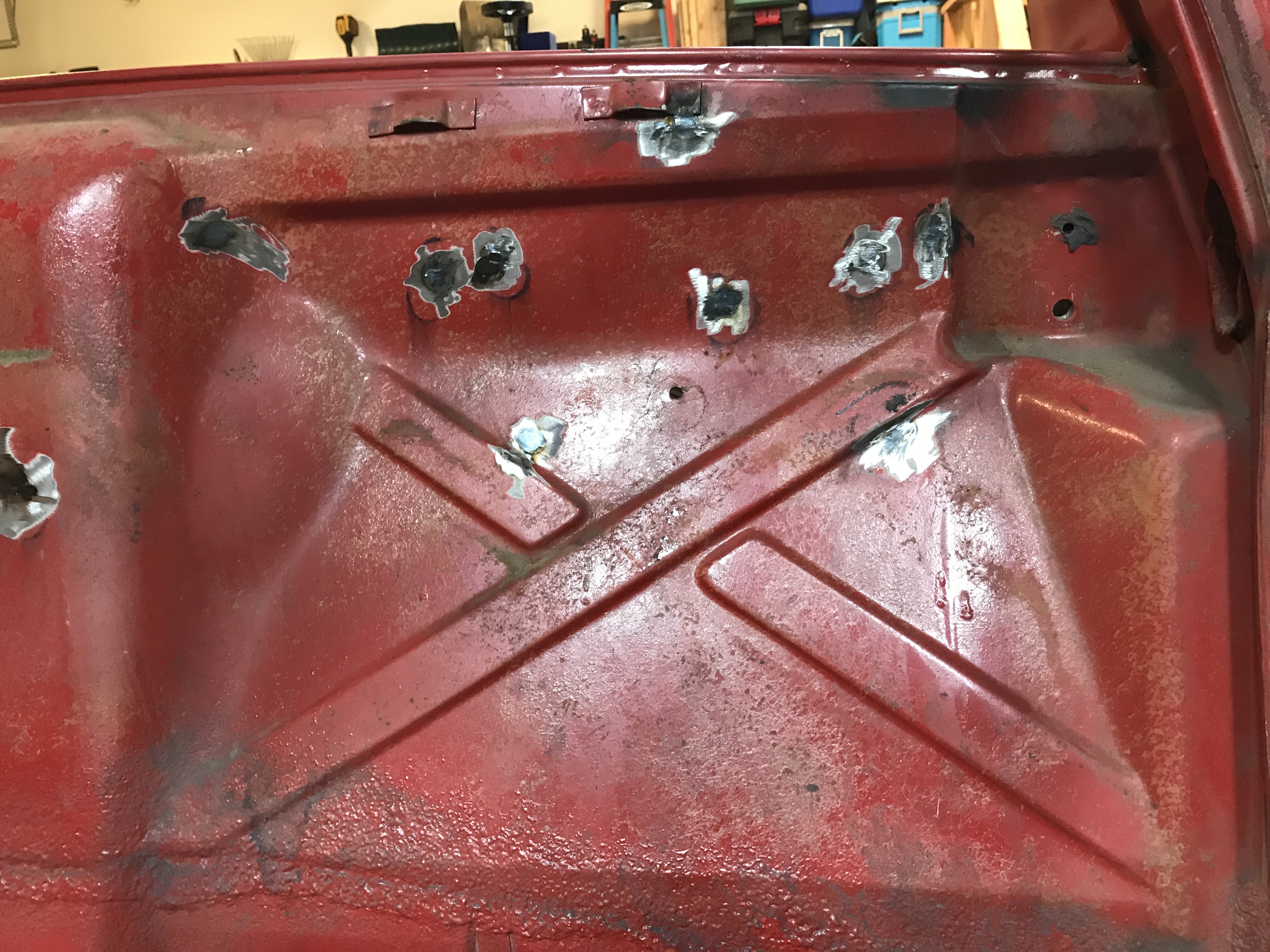

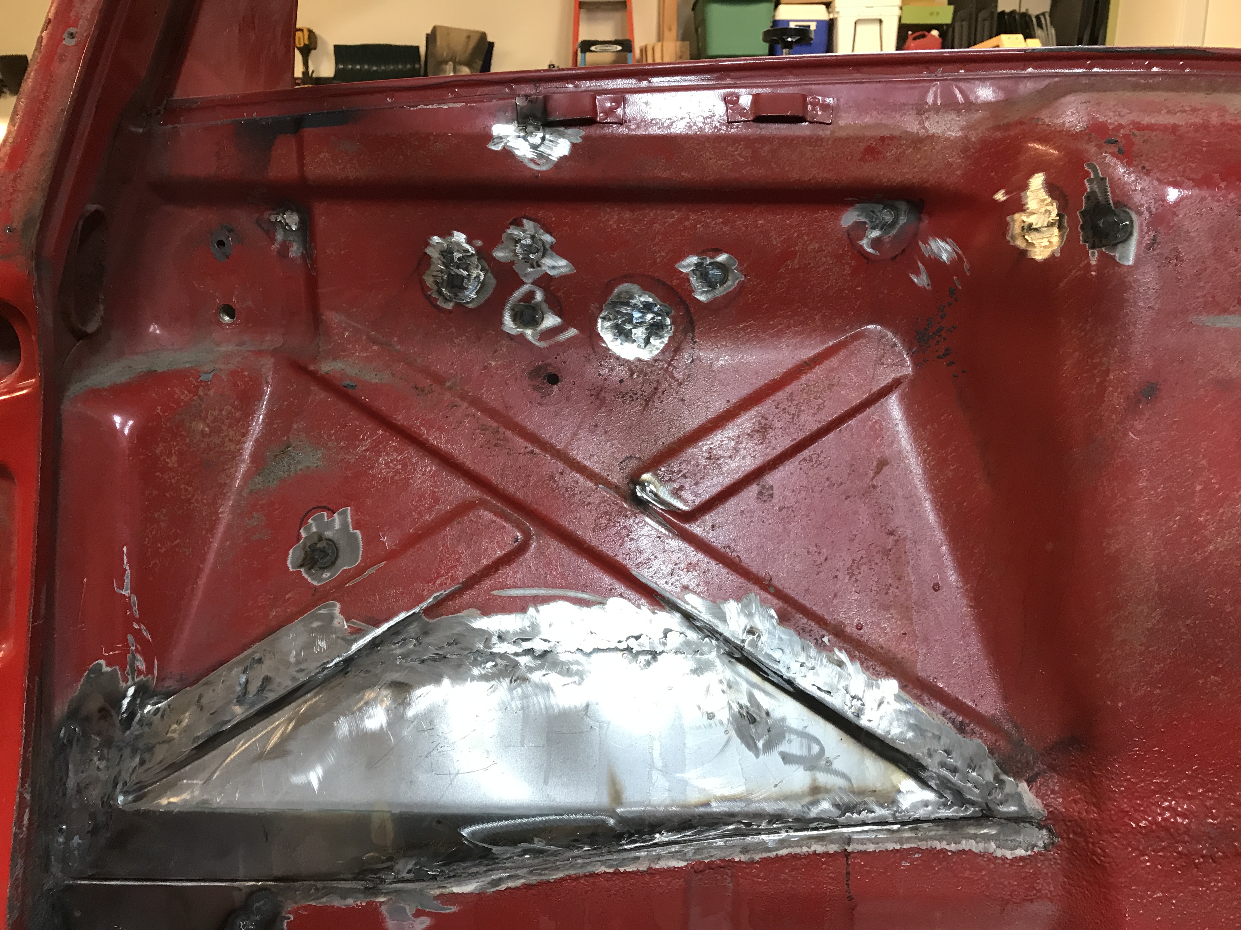

Finished the festival of holes, with step 3: grinding. Here is the right side of the firewall.

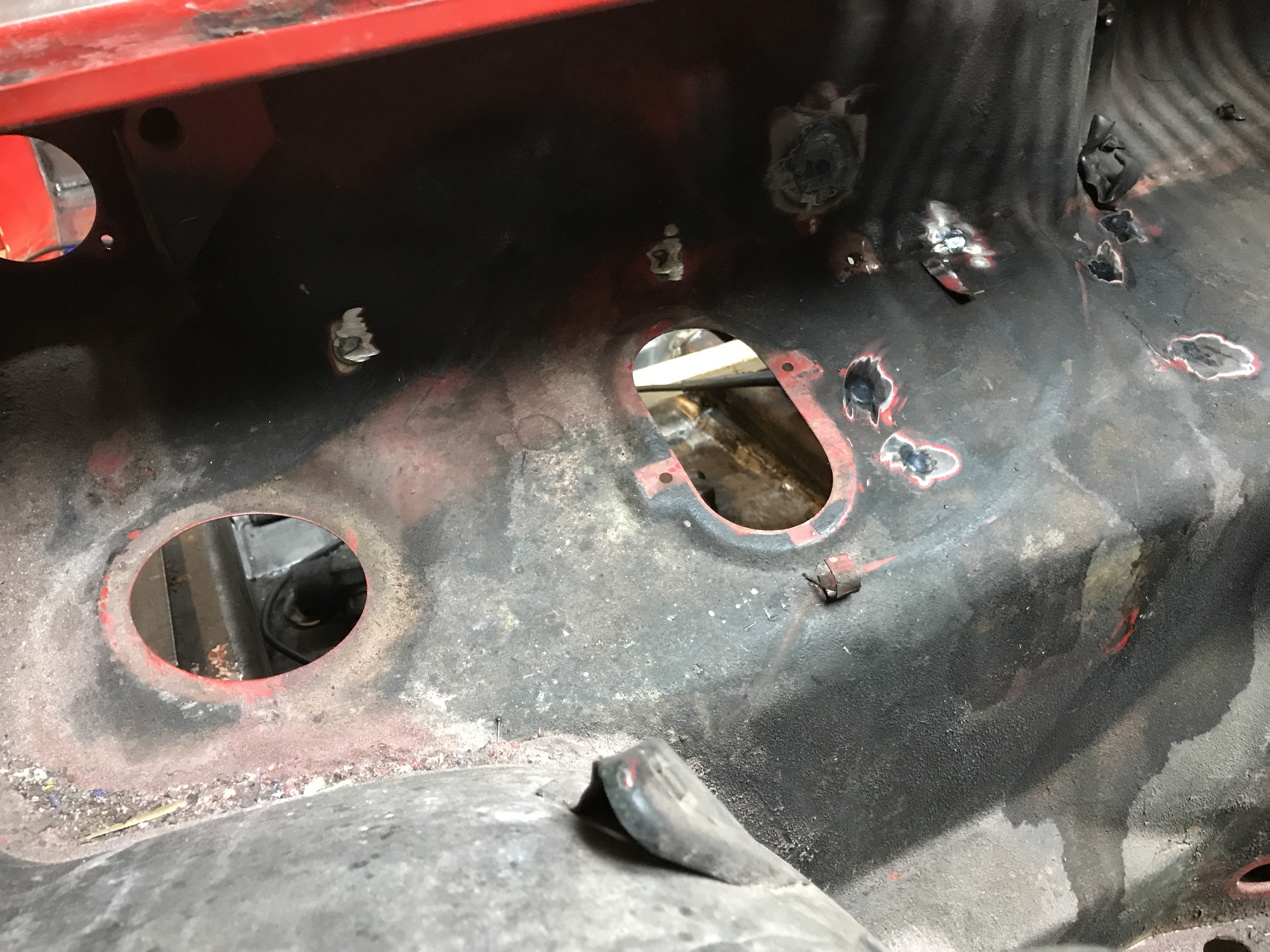

And the left side.

And the dash under-panel.

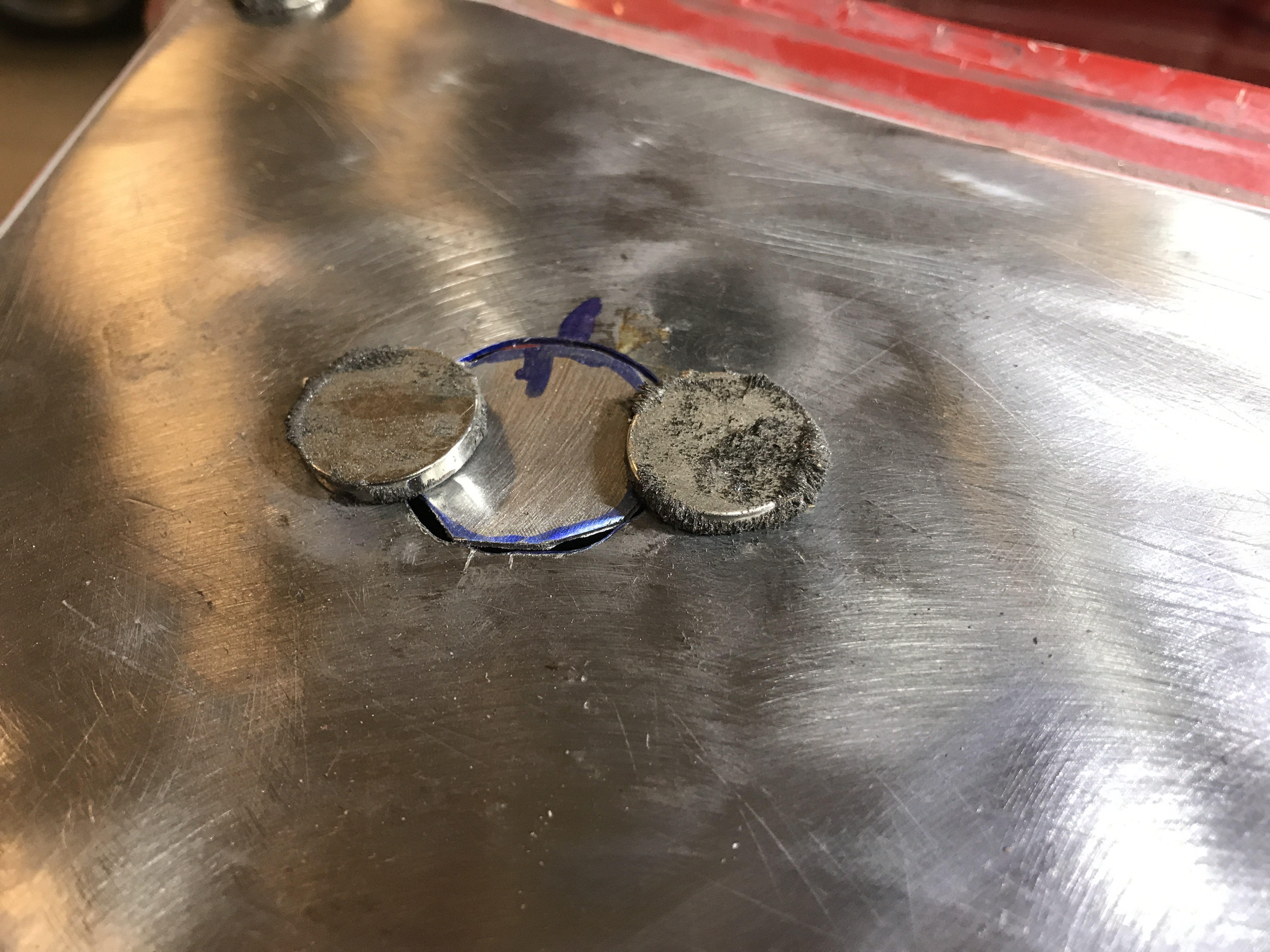

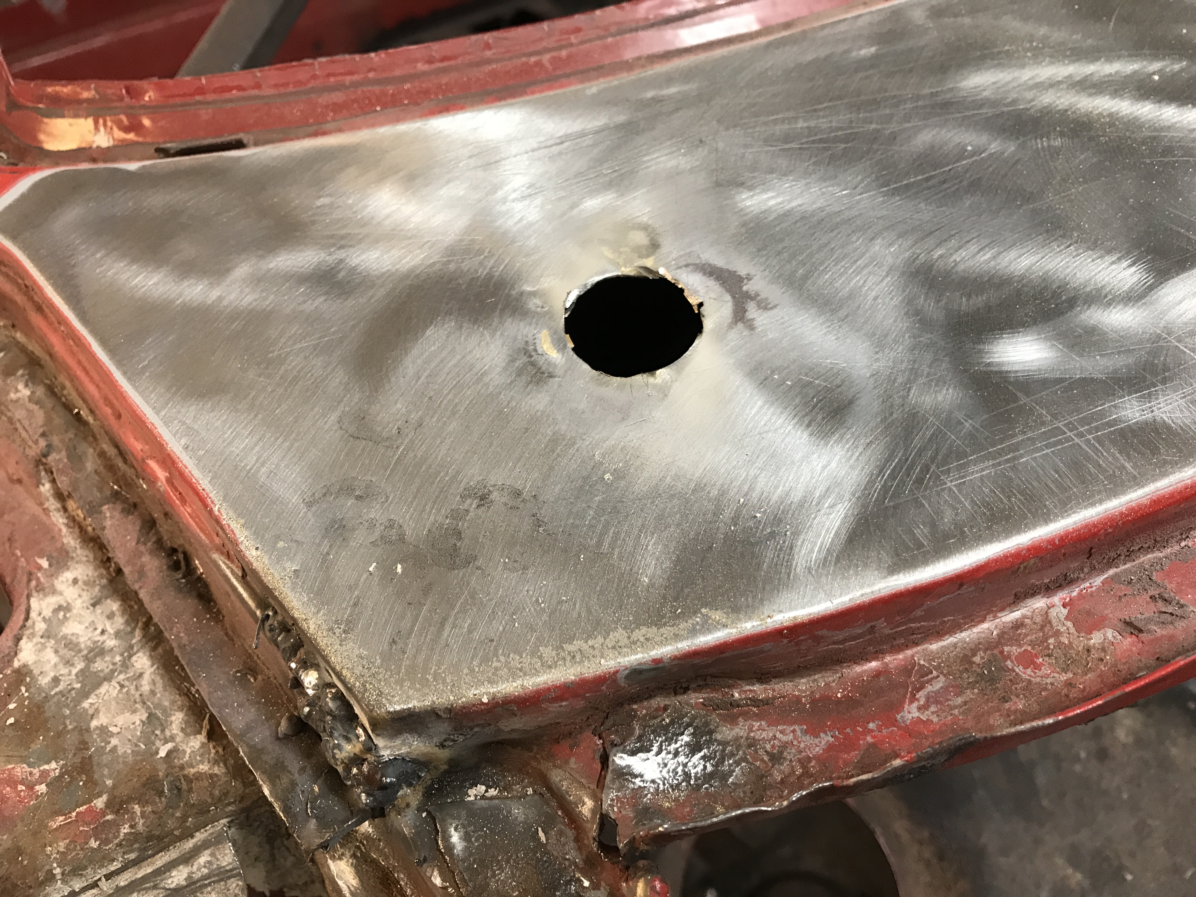

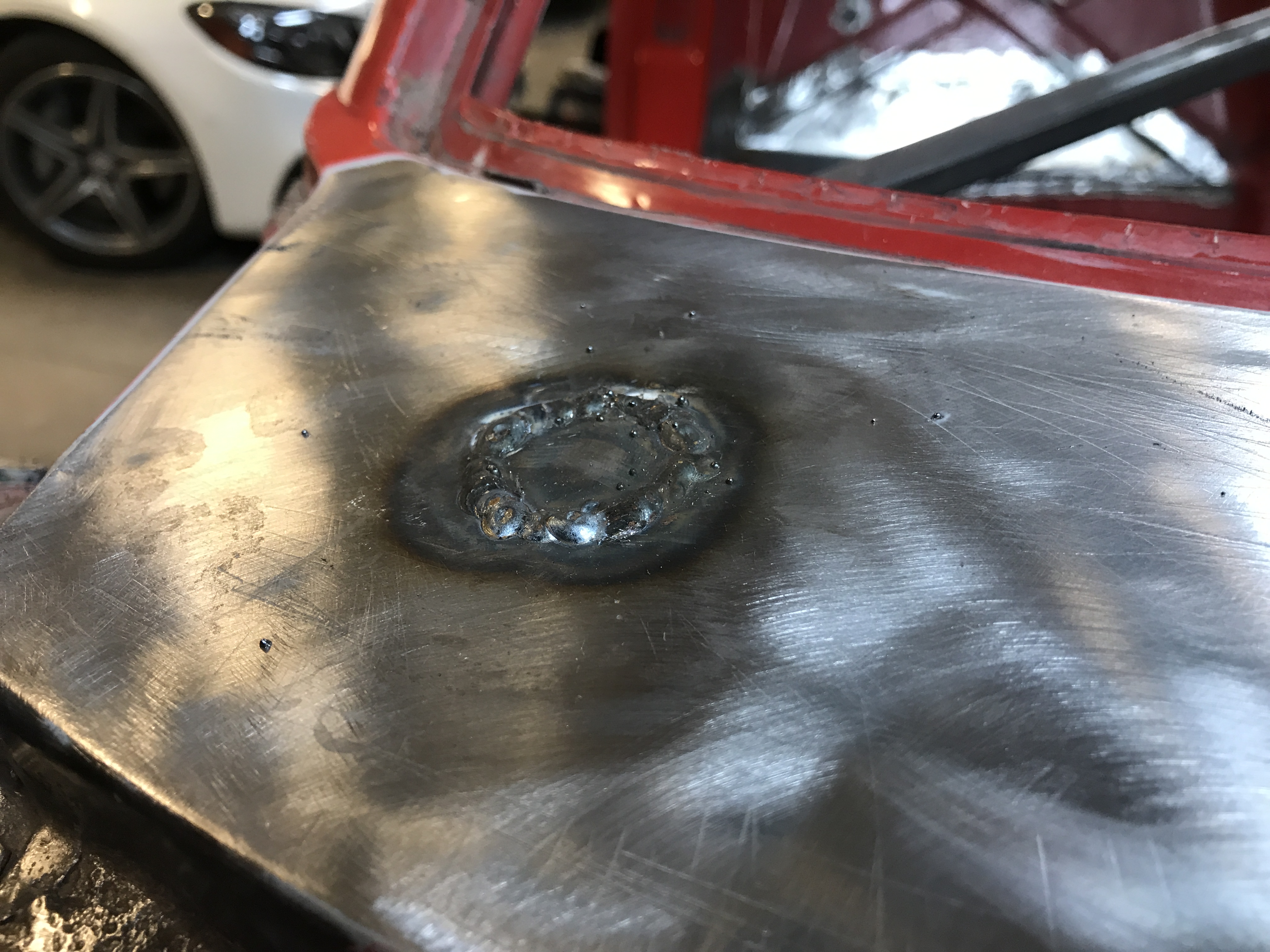

I also refilled the antenna hole in the right cowl. Besides not being a stock location, the metal is not strong or stiff enough. Here is a patch cut to fit from genuine 914 sheet metal.

Welded in place.

And after a quick grinding.

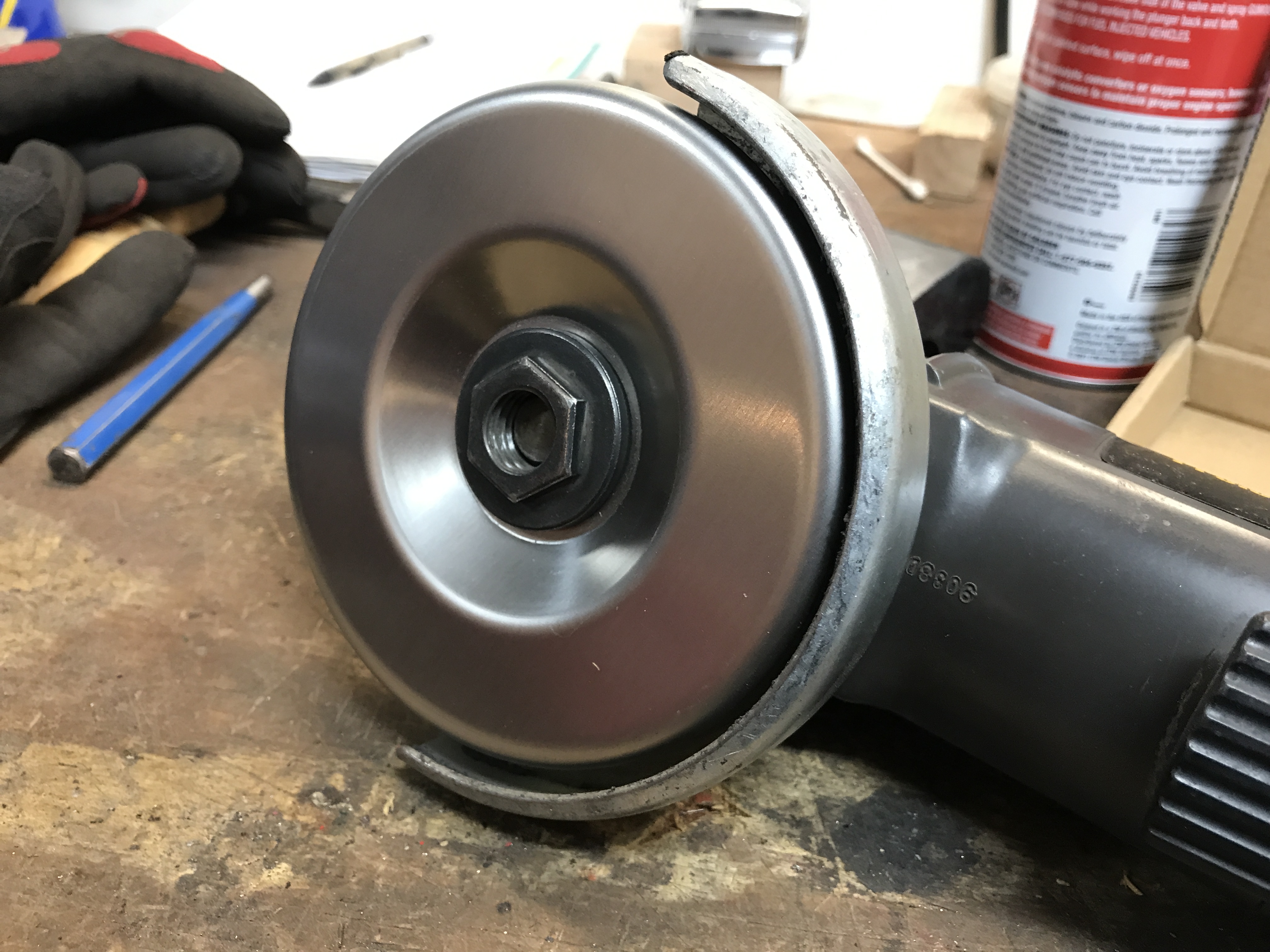

I got to try my latest tool acquisition: a shrinking disk. This is a polished stainless steel disk with a raised edge. On the grinder, it spins against sheet metal and the friction creates local heat. A quick spray of water cools and shrinks the hot spot.

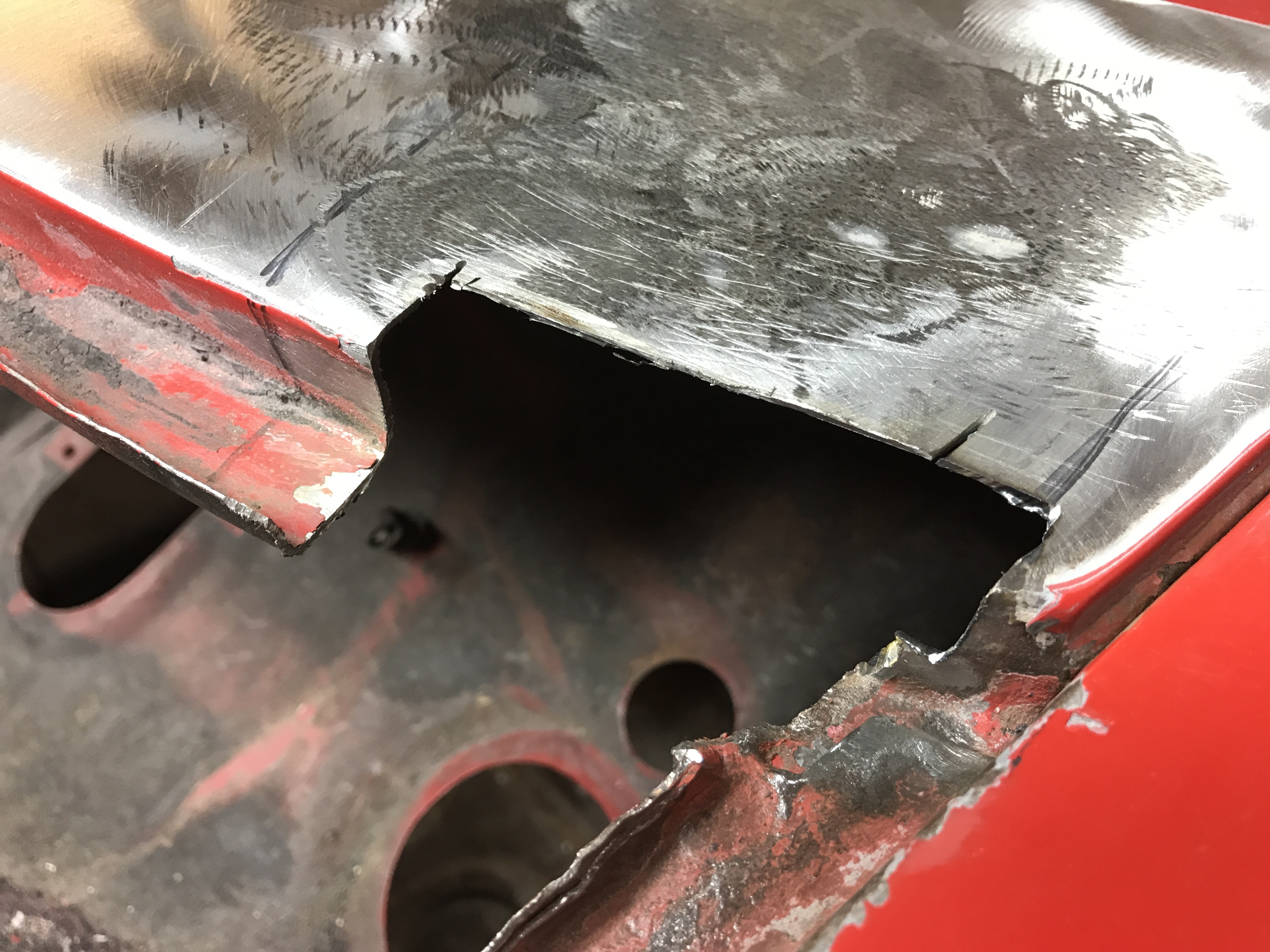

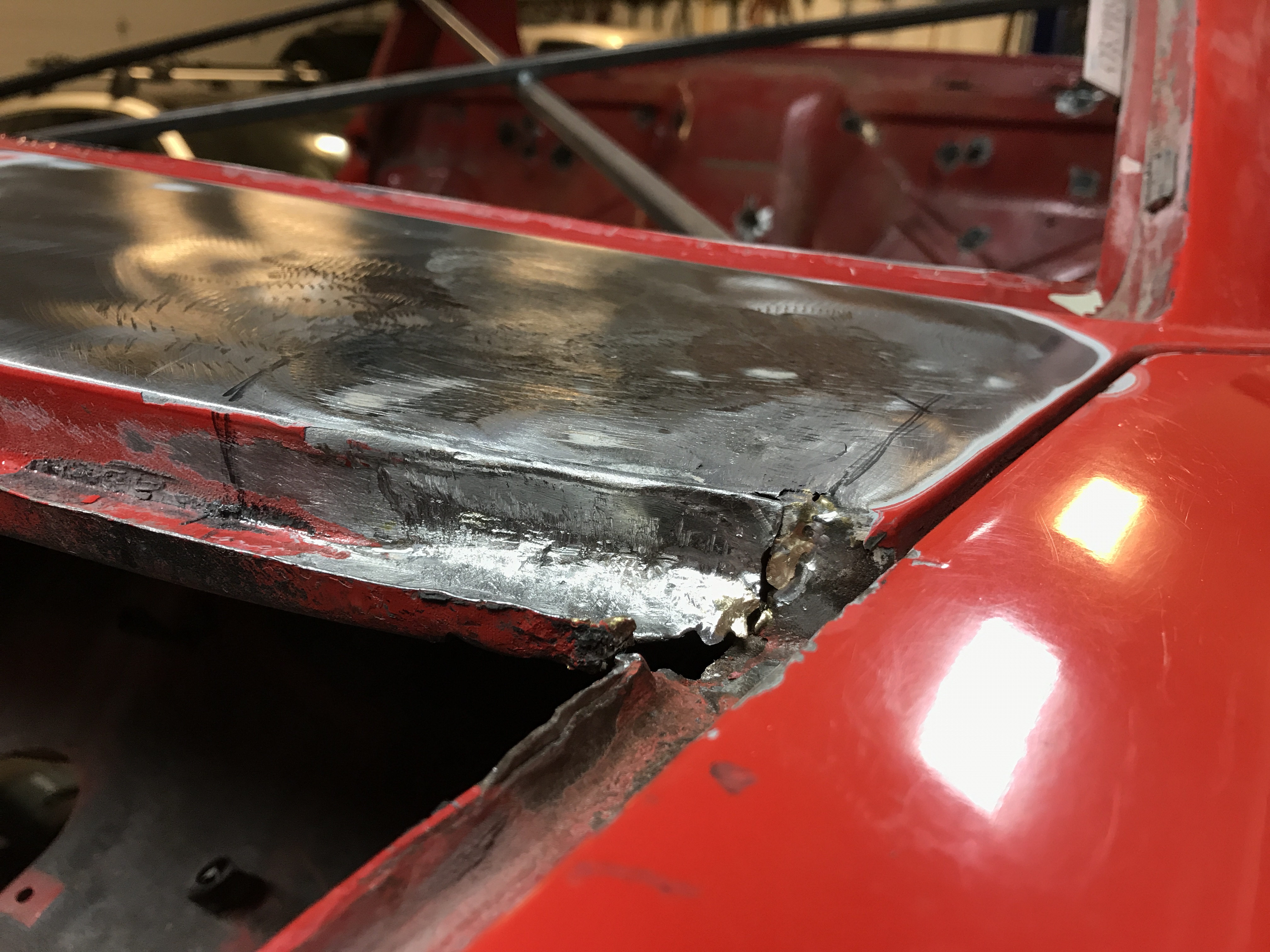

I did this for about 20 minutes on the left side of the cowl, where previous deformation and repair had stretched the metal and created a 4 inch spot that oil-canned up and down. The shrinking worked great and made the cowl section flatter and more rigid.

After the shrinking work, I decided to cut out a smaller area than planned.

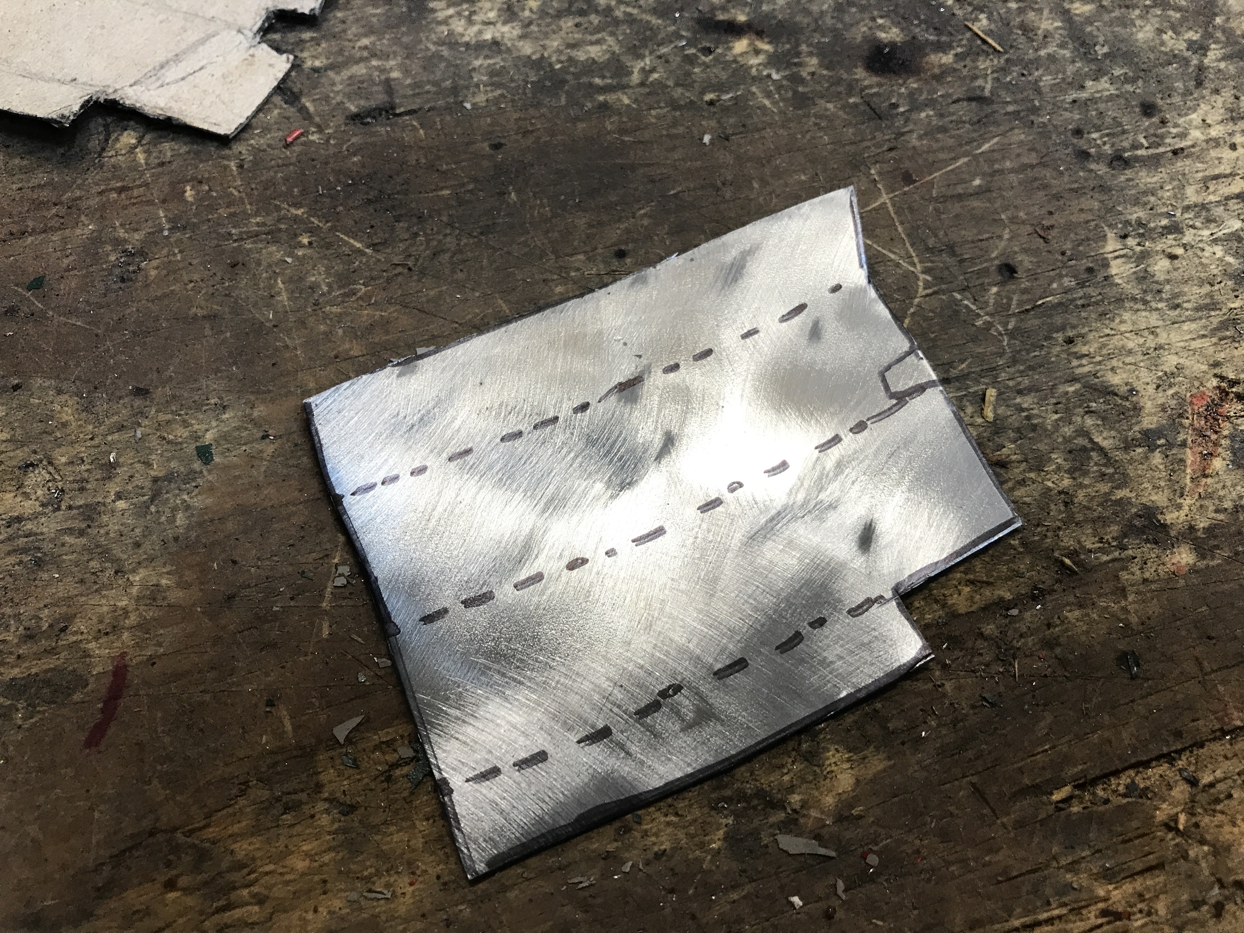

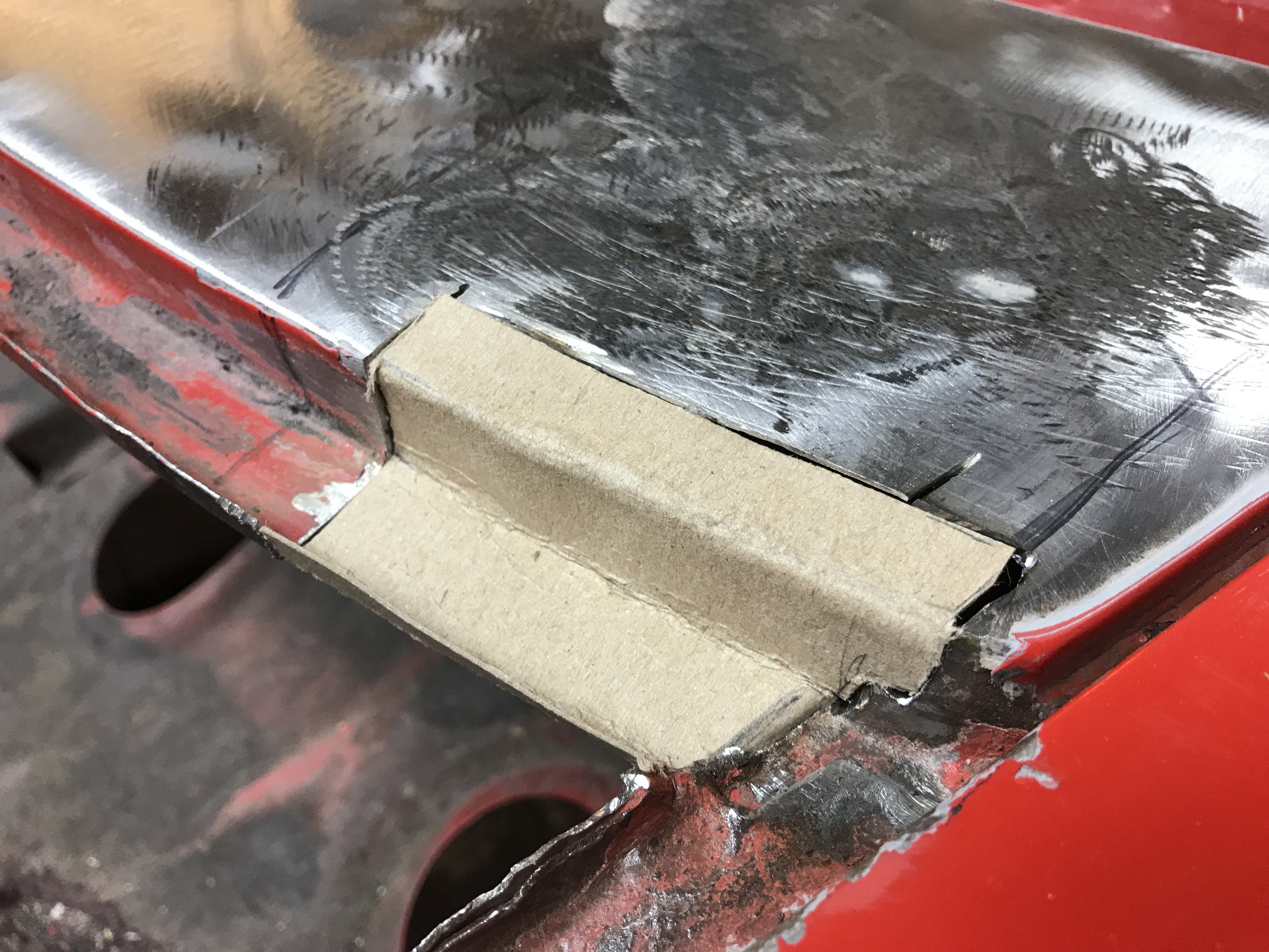

And I had time to fit a cardboard template for the patch. Too bad metal does not work as fast.

Translating cardboard into recycled 914 sheet metal. Here is the piece cut out and marked.
