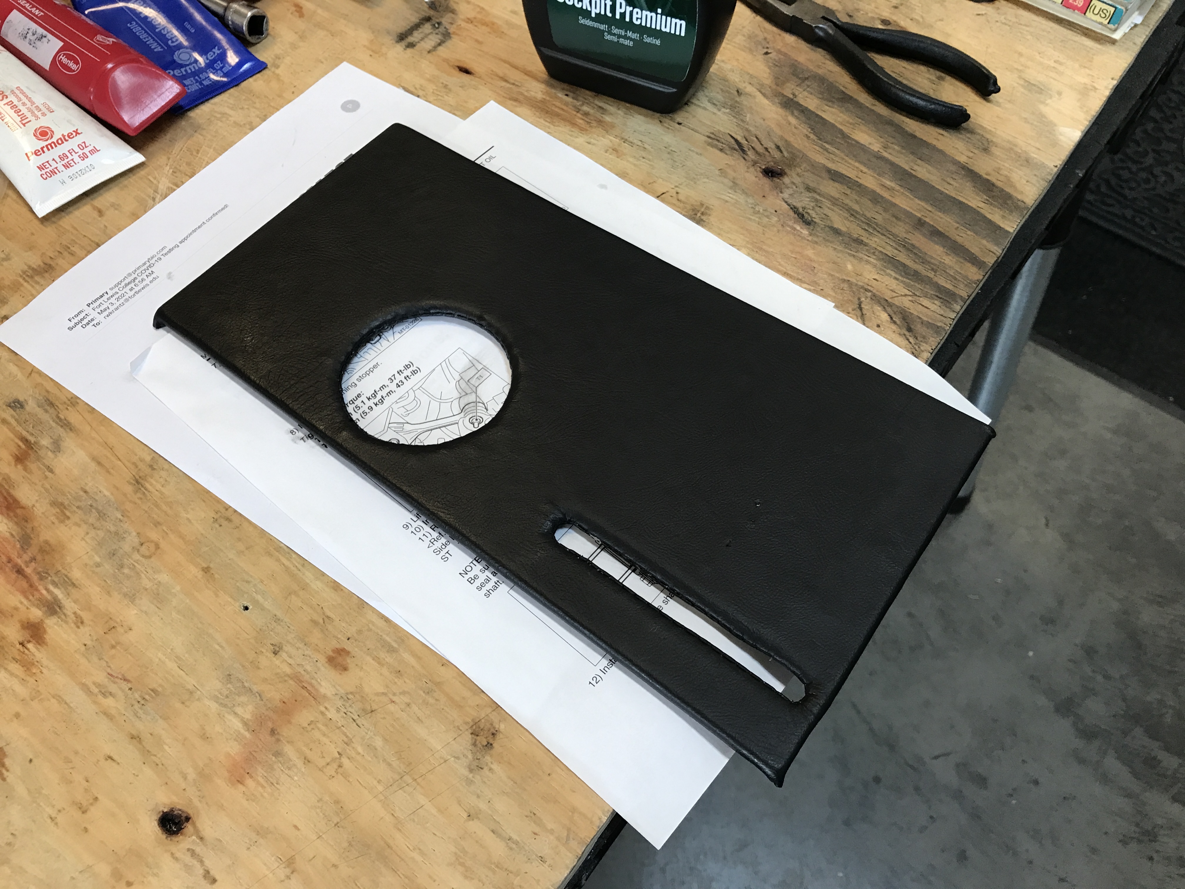

Member No.: 23,343
I cleaned up both sides, first with 3M and then a vinyl cleaner.
bkrantz
post Sep 6 2021, 07:01 PM
Post #3646
Posts: 8,800
Joined: 3-August 19
From: SW Colorado
Member No.: 23,343
This should do.

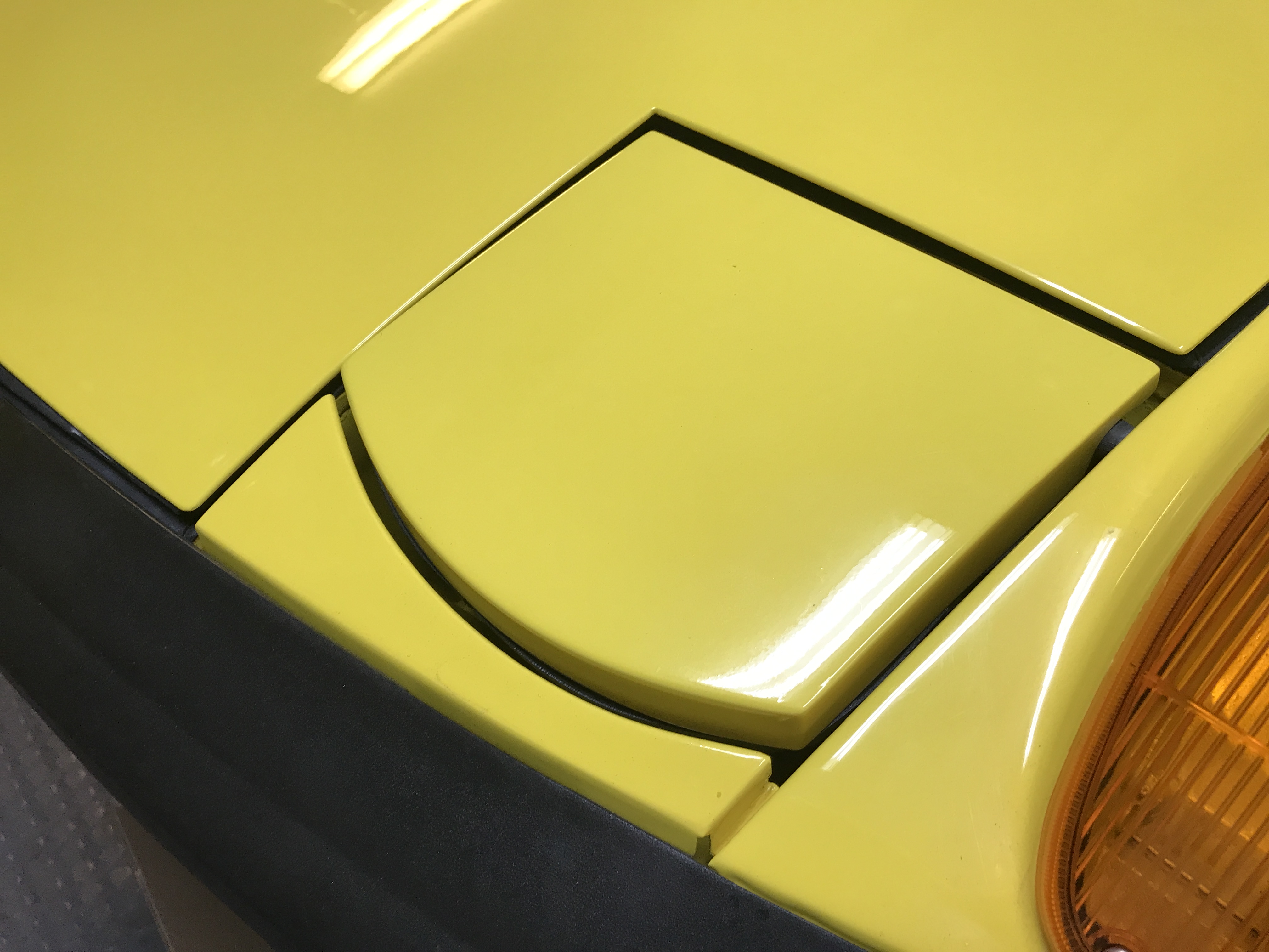

Member No.: 23,343

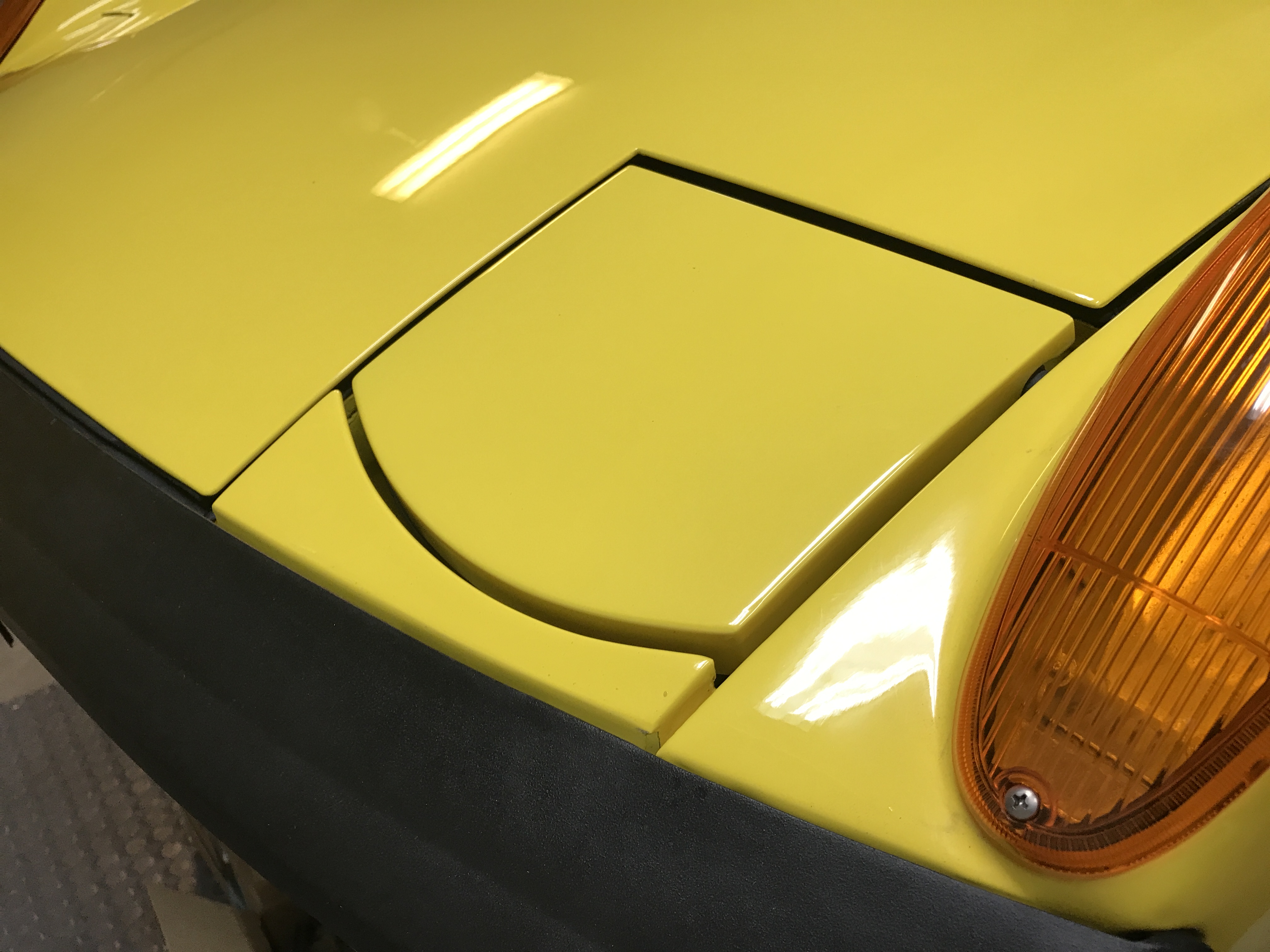

I spent some time refining fits. Here is the left headlight after the last quick adjustment--not quite right.
bkrantz
post Sep 8 2021, 07:40 PM
Post #3648
Posts: 8,800
Joined: 3-August 19
From: SW Colorado
Member No.: 23,343
This is better, and the best I can do without enlarging some of the mounting holes.

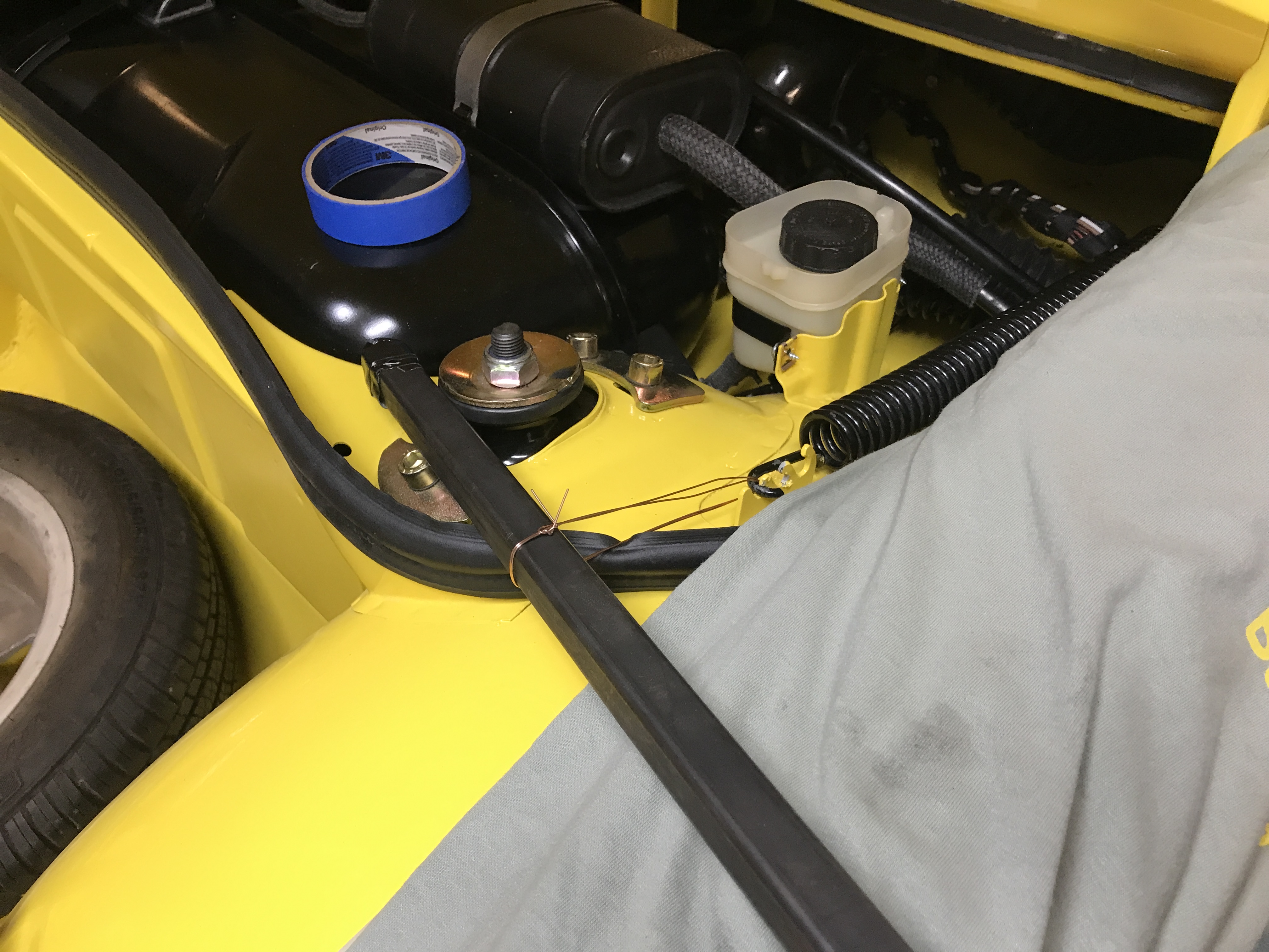

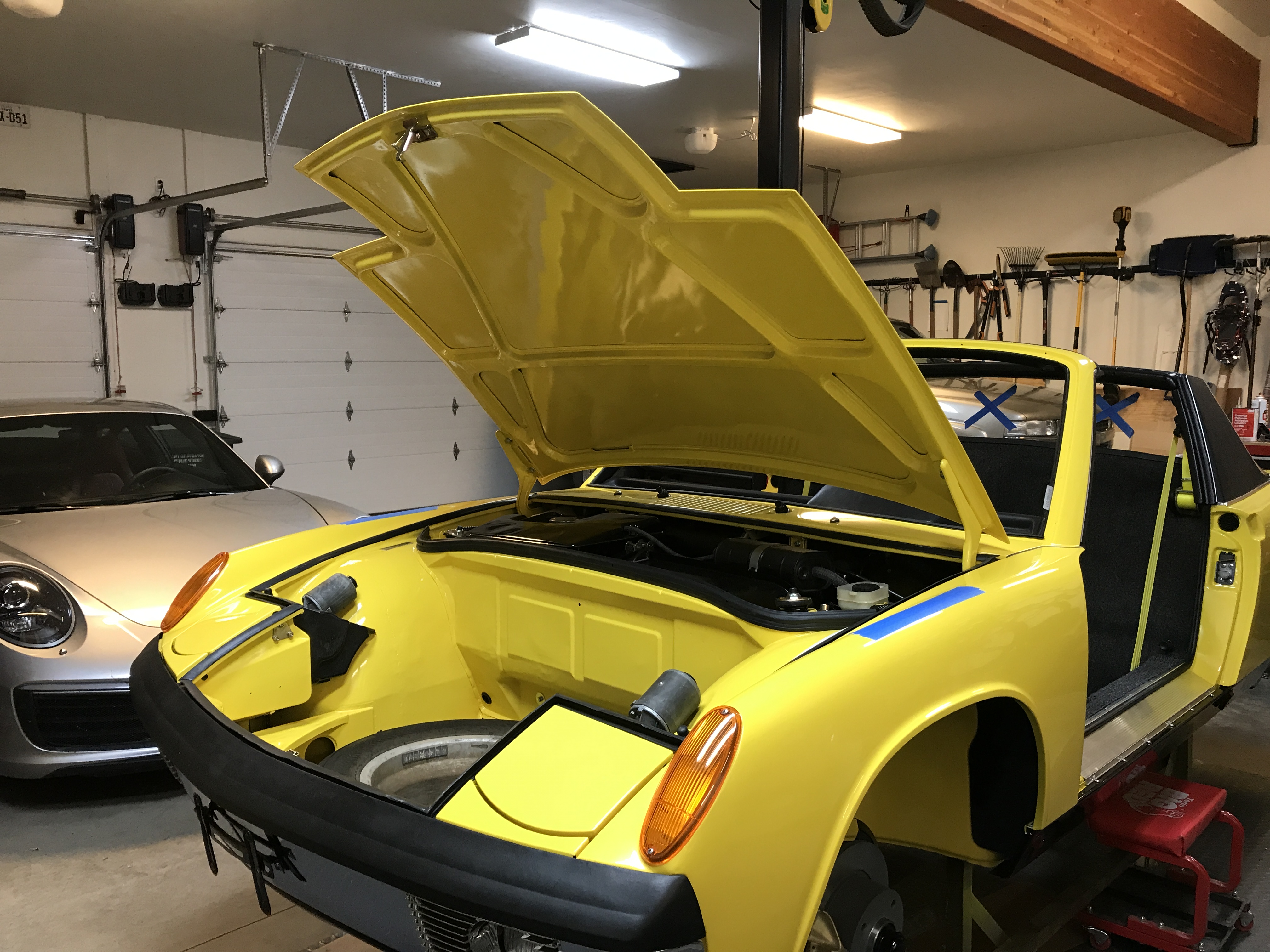

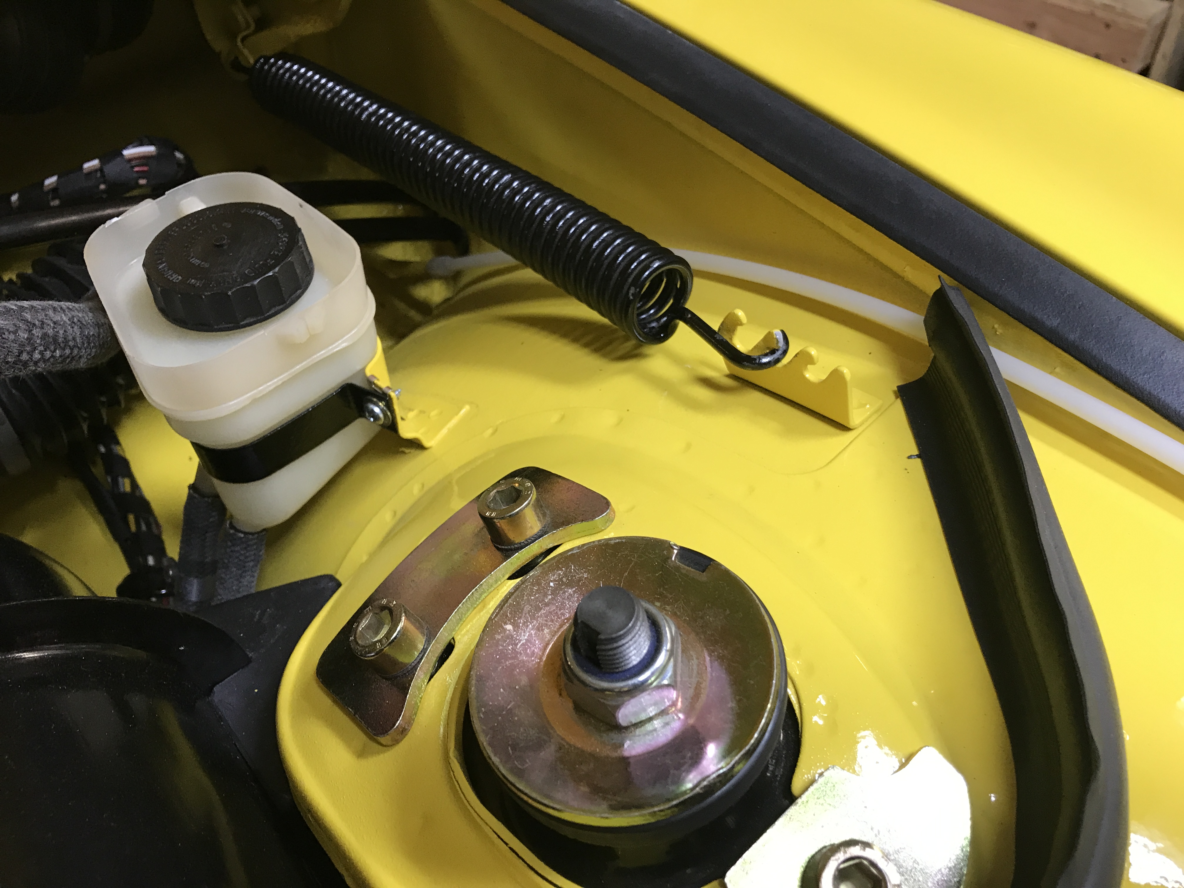

I then tackled the sagging hood. Initially, I put the springs in the middle notch.
bkrantz
post Sep 8 2021, 07:42 PM
Post #3650
Posts: 8,800
Joined: 3-August 19
From: SW Colorado
Member No.: 23,343
I put my special tool back together, and moved the spring to the "longest" notch.
bkrantz
post Sep 8 2021, 07:43 PM
Post #3651
Posts: 8,800
Joined: 3-August 19
From: SW Colorado
Member No.: 23,343
Now the hood stays up.

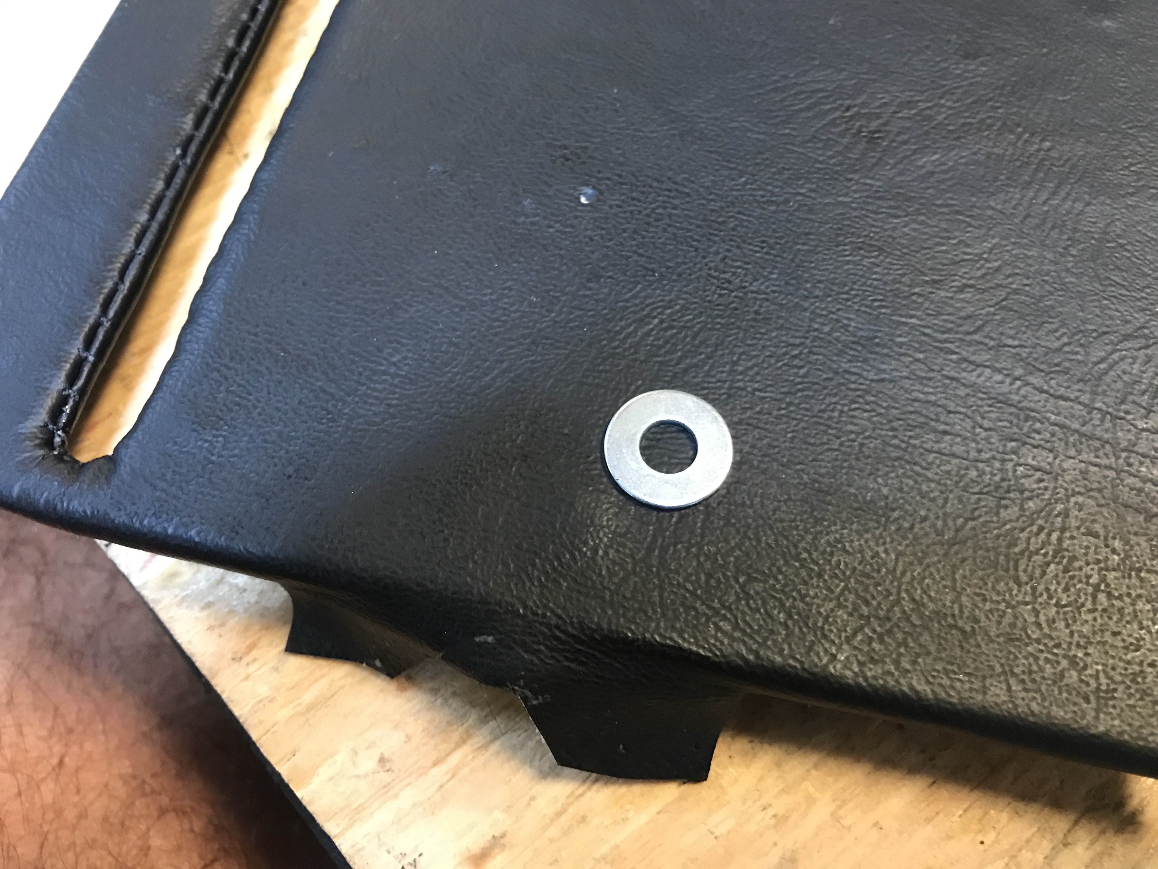

Member No.: 23,343

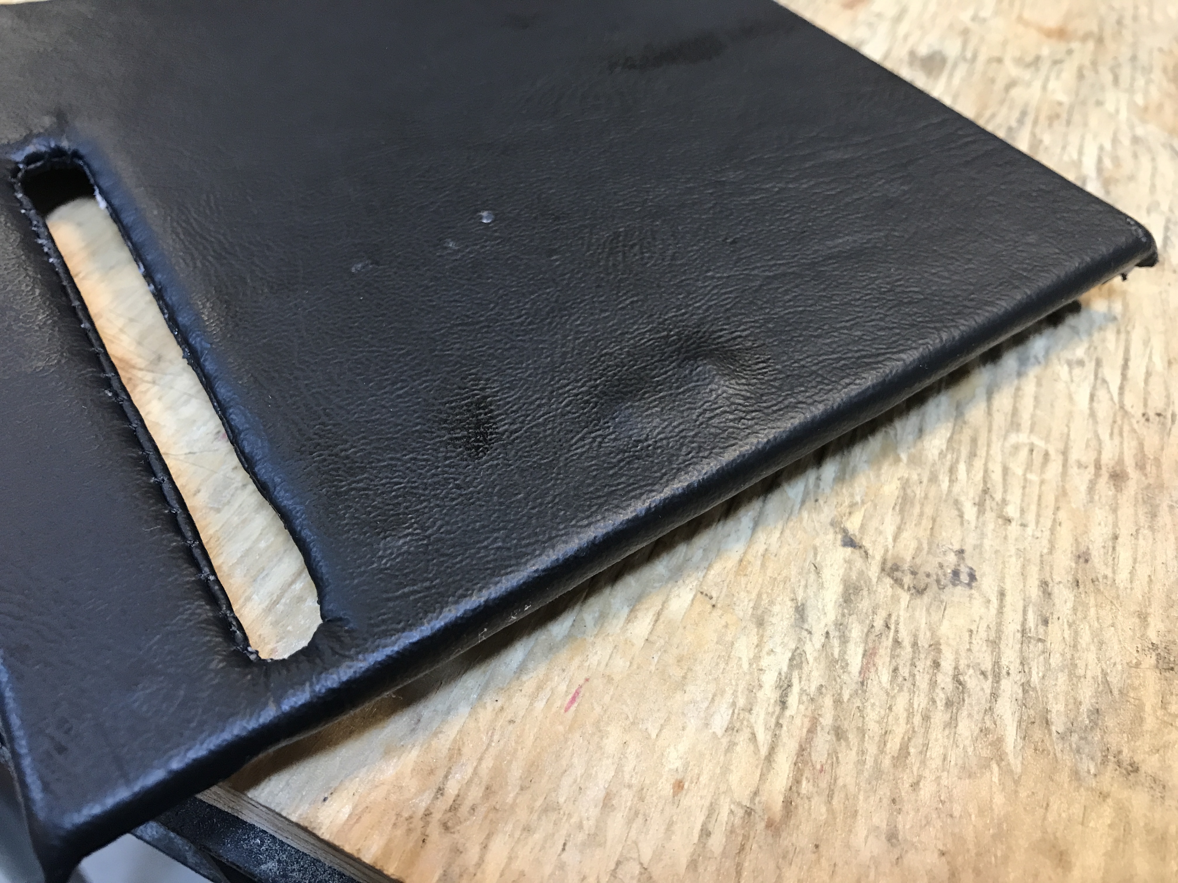

I found a problem with the console shift panel. The mounting clip likes to poke up against the vinyl cover.
bkrantz
post Sep 9 2021, 07:49 PM
Post #3653
Posts: 8,800
Joined: 3-August 19
From: SW Colorado
Member No.: 23,343
To keep the clip down, I teased open the vinyl along the edge and inserted a thin washer.

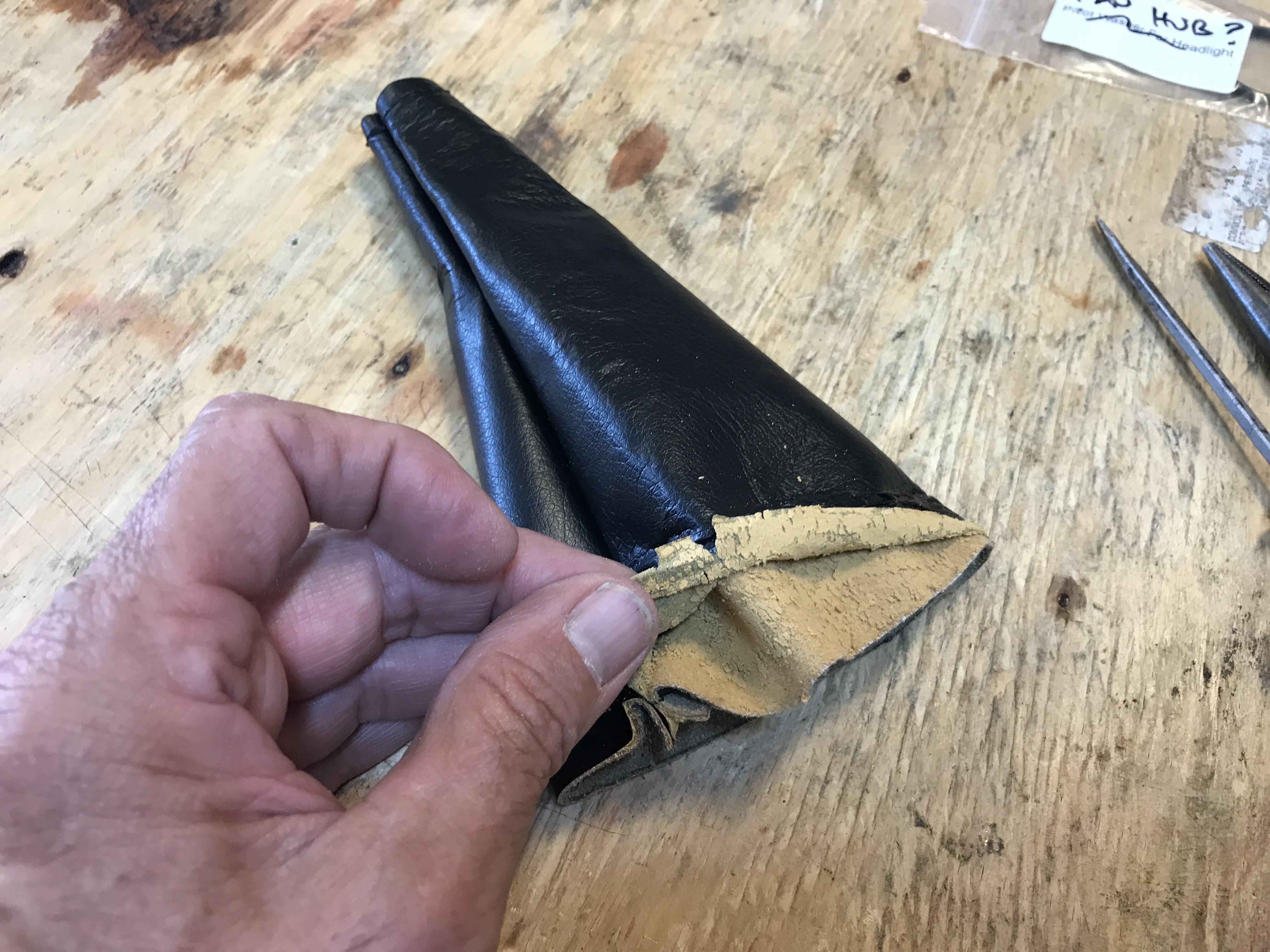

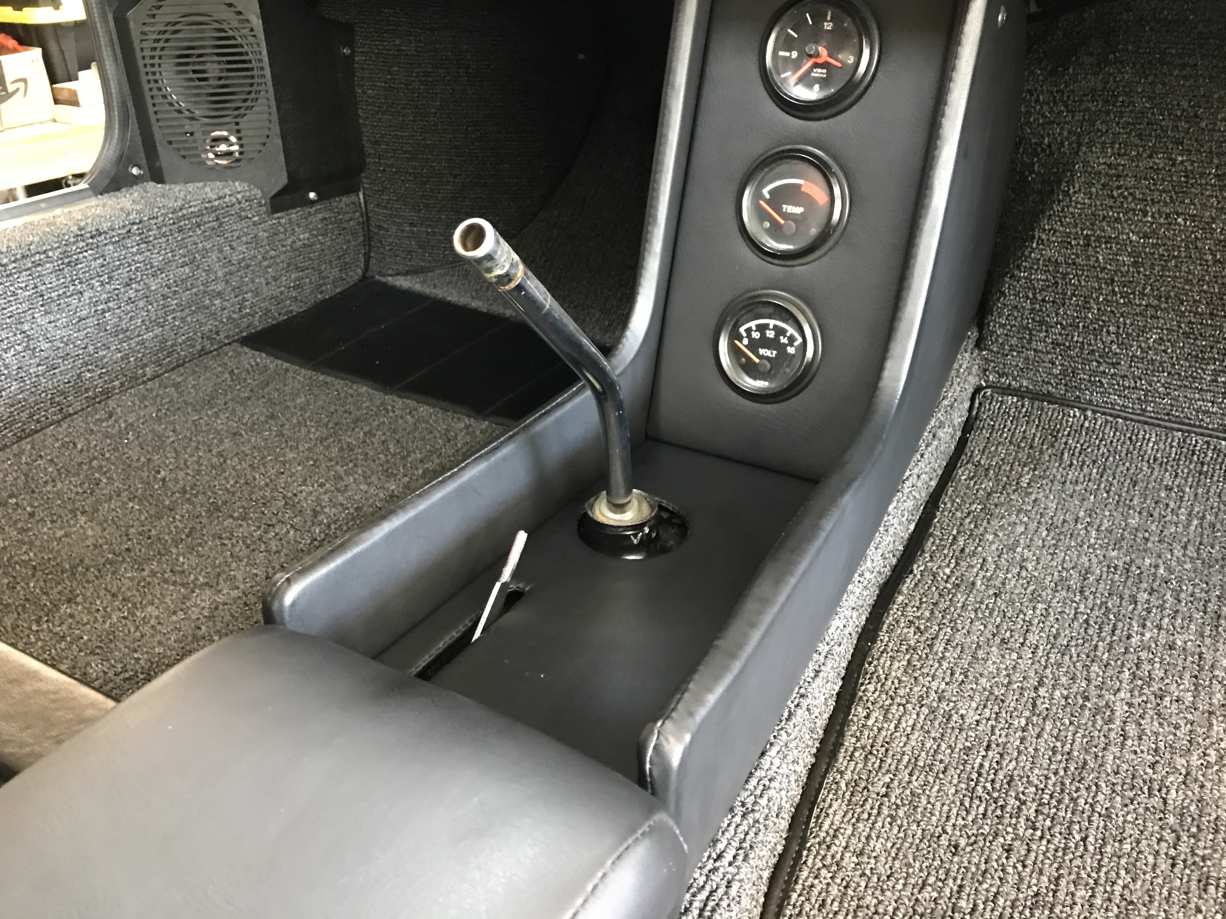

The last thing I need to do is attach the shift lever boot. But the replacement I bough last year is falling apart, and the thin outer layer has separated from the inner material. Very disappointing.
Morph914
post Sep 9 2021, 08:15 PM
Post #3655
Posts: 435
Joined: 22-August 16
From: St Augustine, FL
Member No.: 20,326
I think I have a decent one, I can take pictures for you tomorrow. If you want it it’s yours, no charge!

Member No.: 20,326

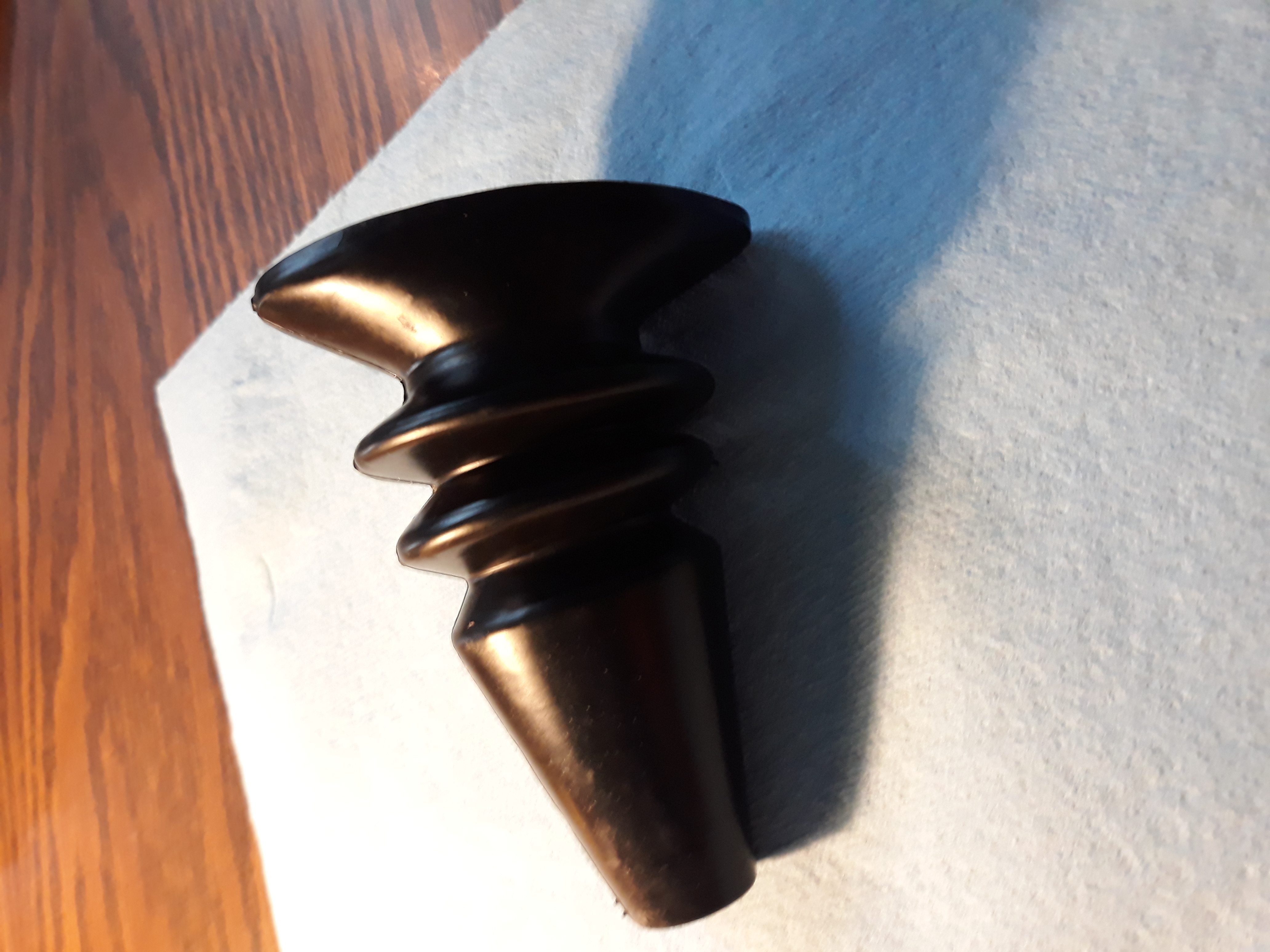

I thought I had the leather boot, but this is what I found. You are welcome to it if you can use. If I find the leather boot I'll let you know.
bkrantz
post Sep 10 2021, 07:09 PM
Post #3658
Posts: 8,800
Joined: 3-August 19
From: SW Colorado
Member No.: 23,343
QUOTE(Morph914 @ Sep 10 2021, 10:37 AM) *
Yes, please. I think I need that for inside the leather boot. I will send you a PM with my address. And thanks!

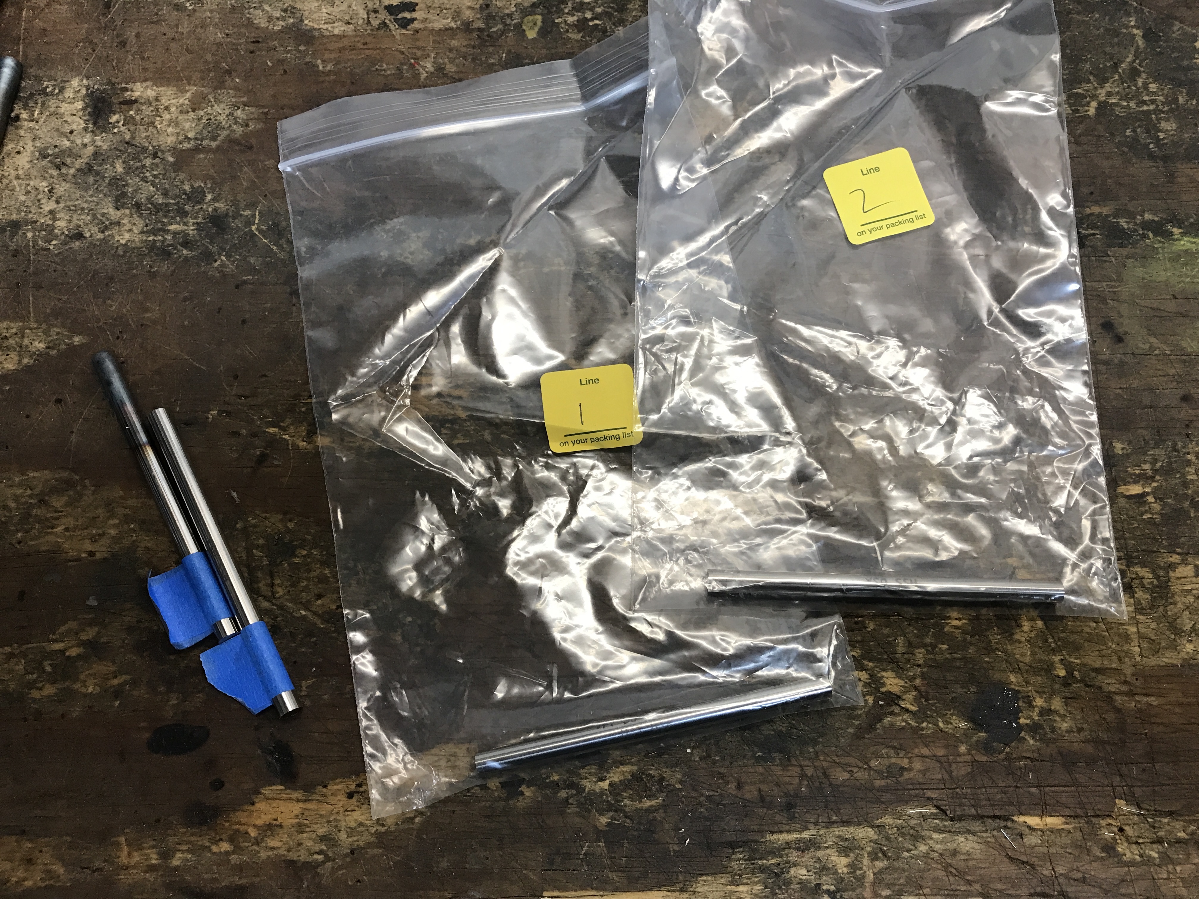

I got my 7.2 and 7.3 mm rods, so I went back to making a new oil dipstick tube.
