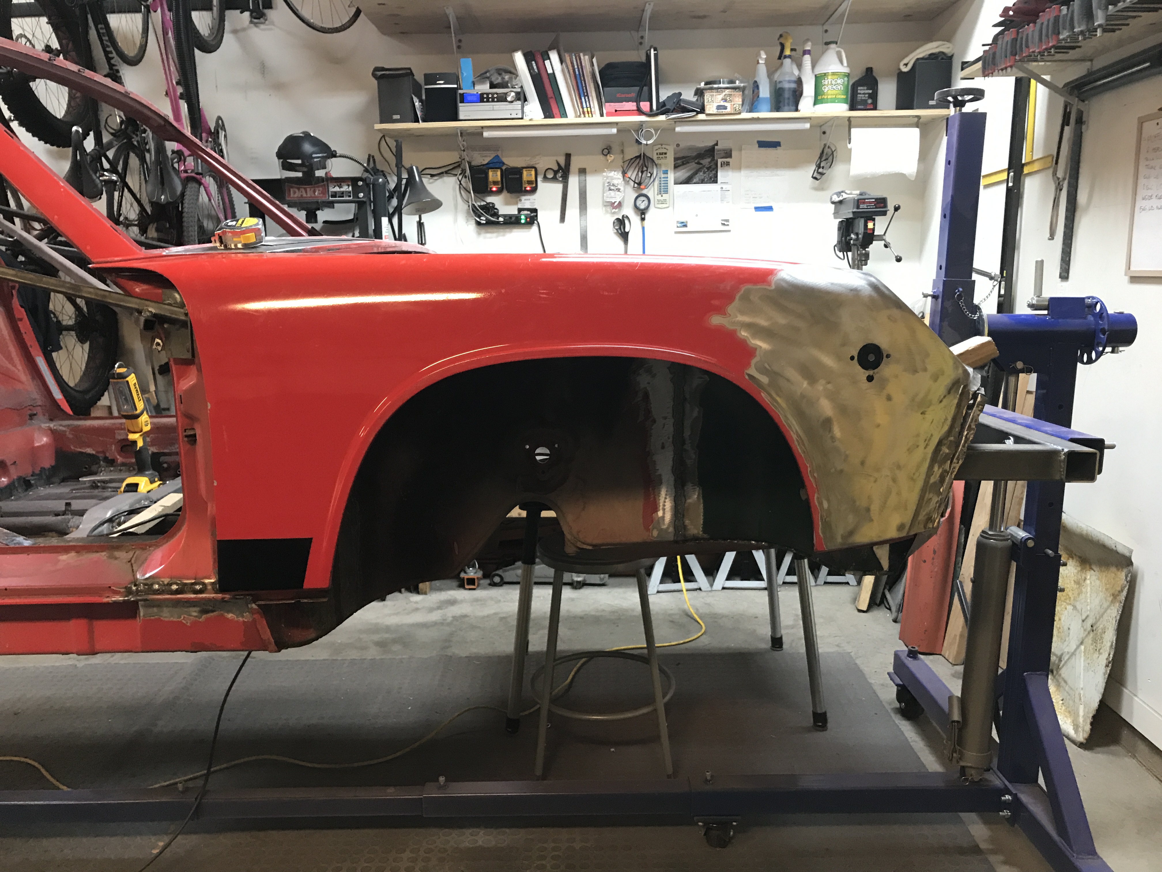

And after an hour of metal work, I had this. I evened managed to get some curvature in the piece.

And fitted into place.

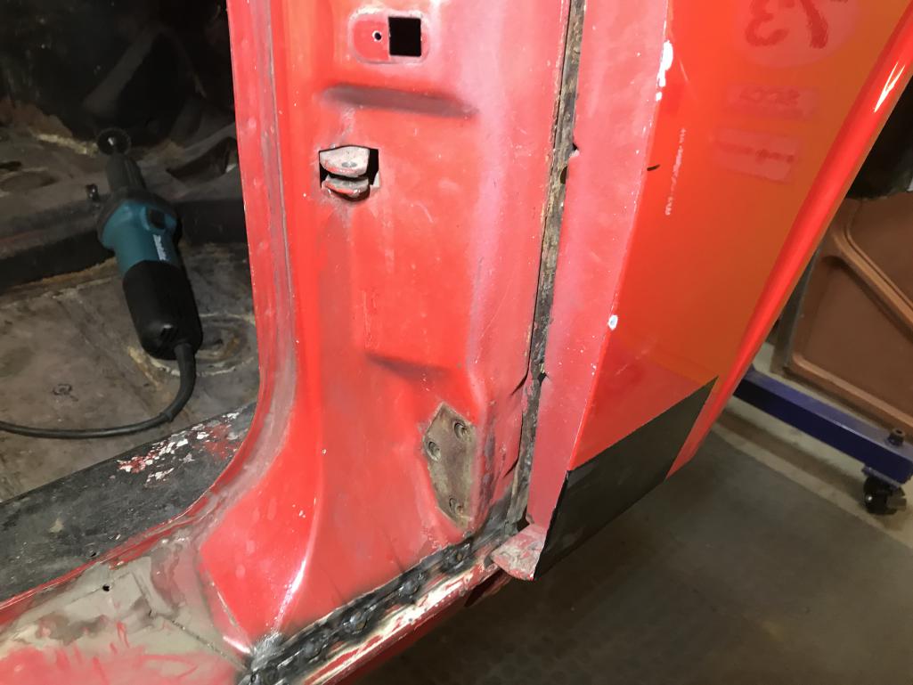

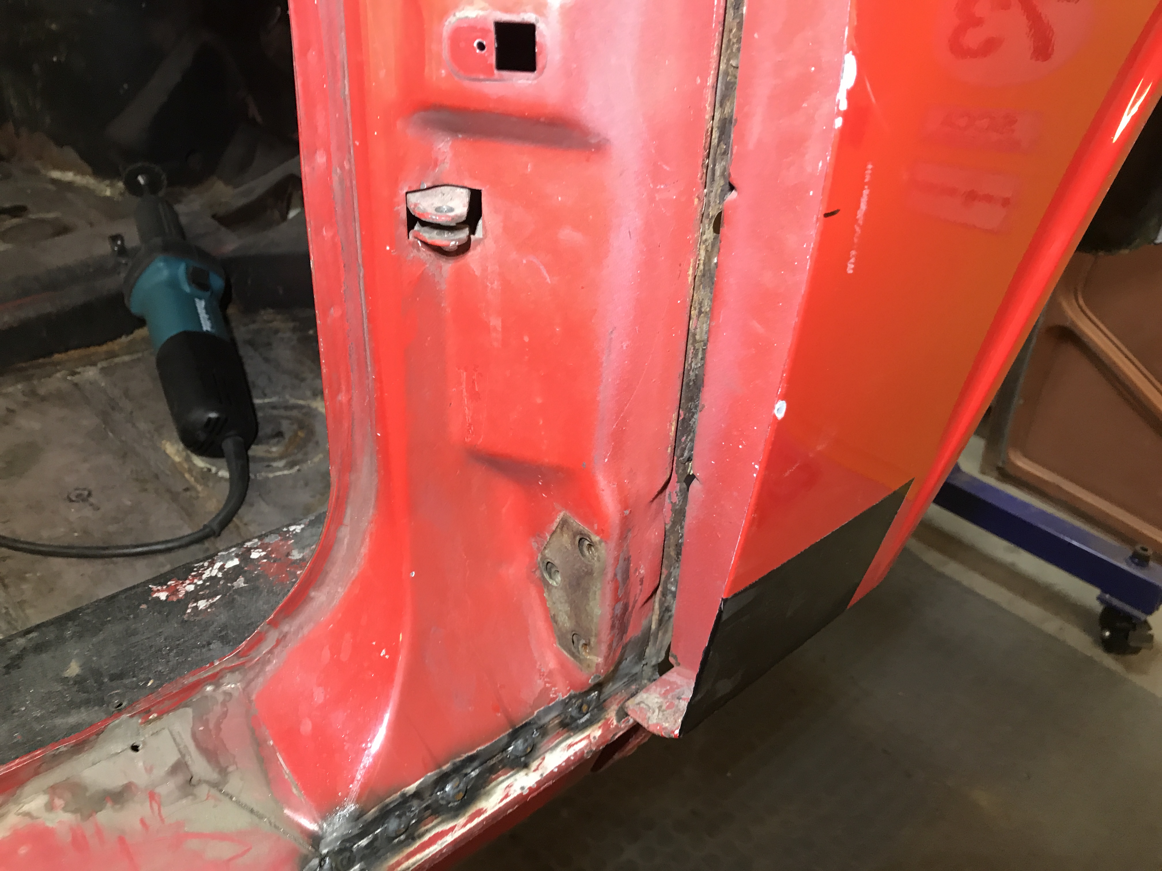

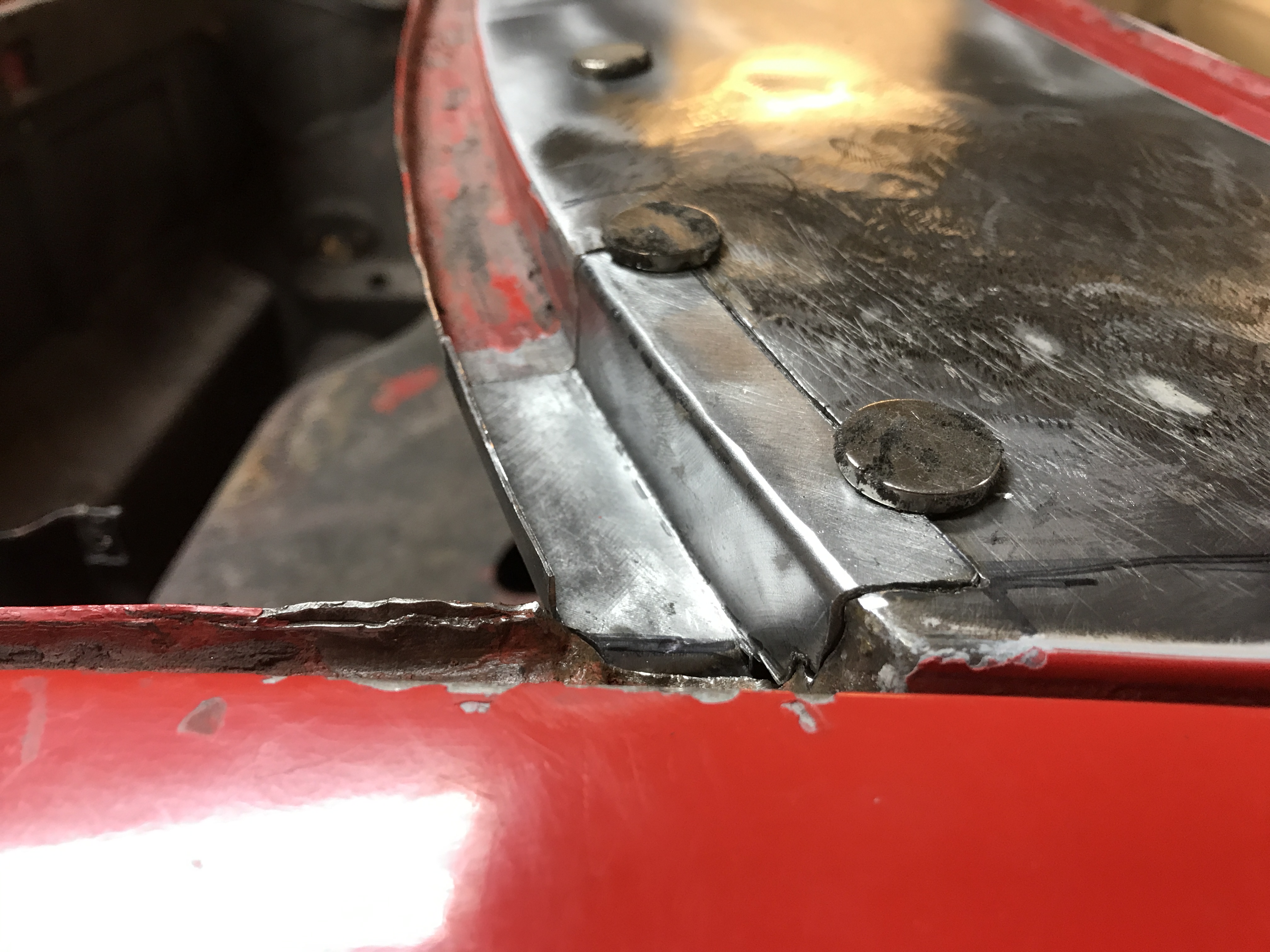

While in the mood, I started on the last big job--reinstalling the right front fender. Here's the mounting flange on the A-pillar after cutting out a segment that was mangled.

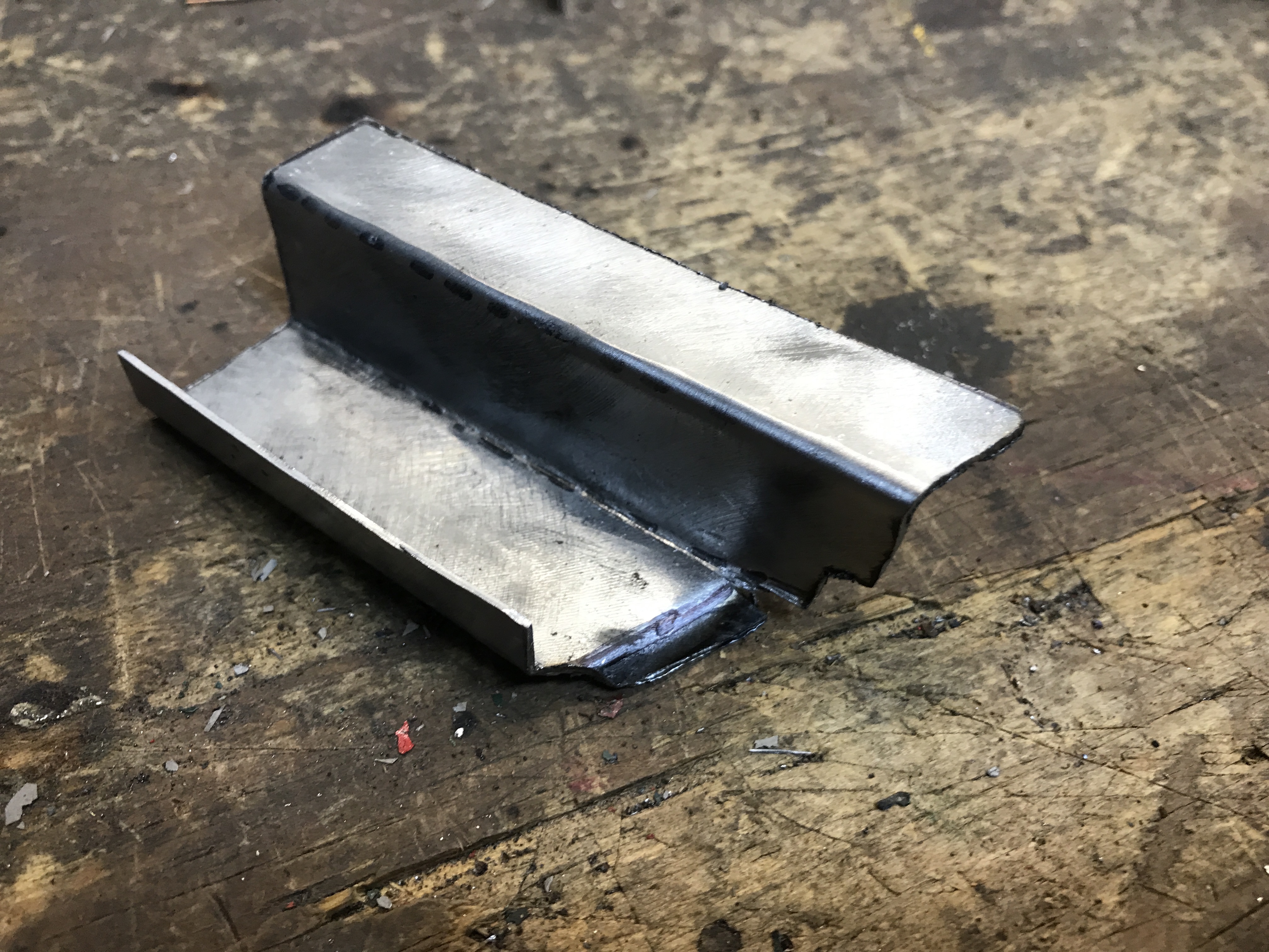

And a small patch ready for welding.

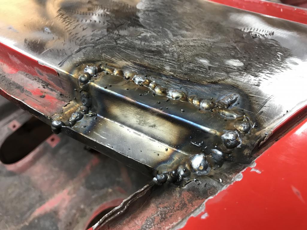

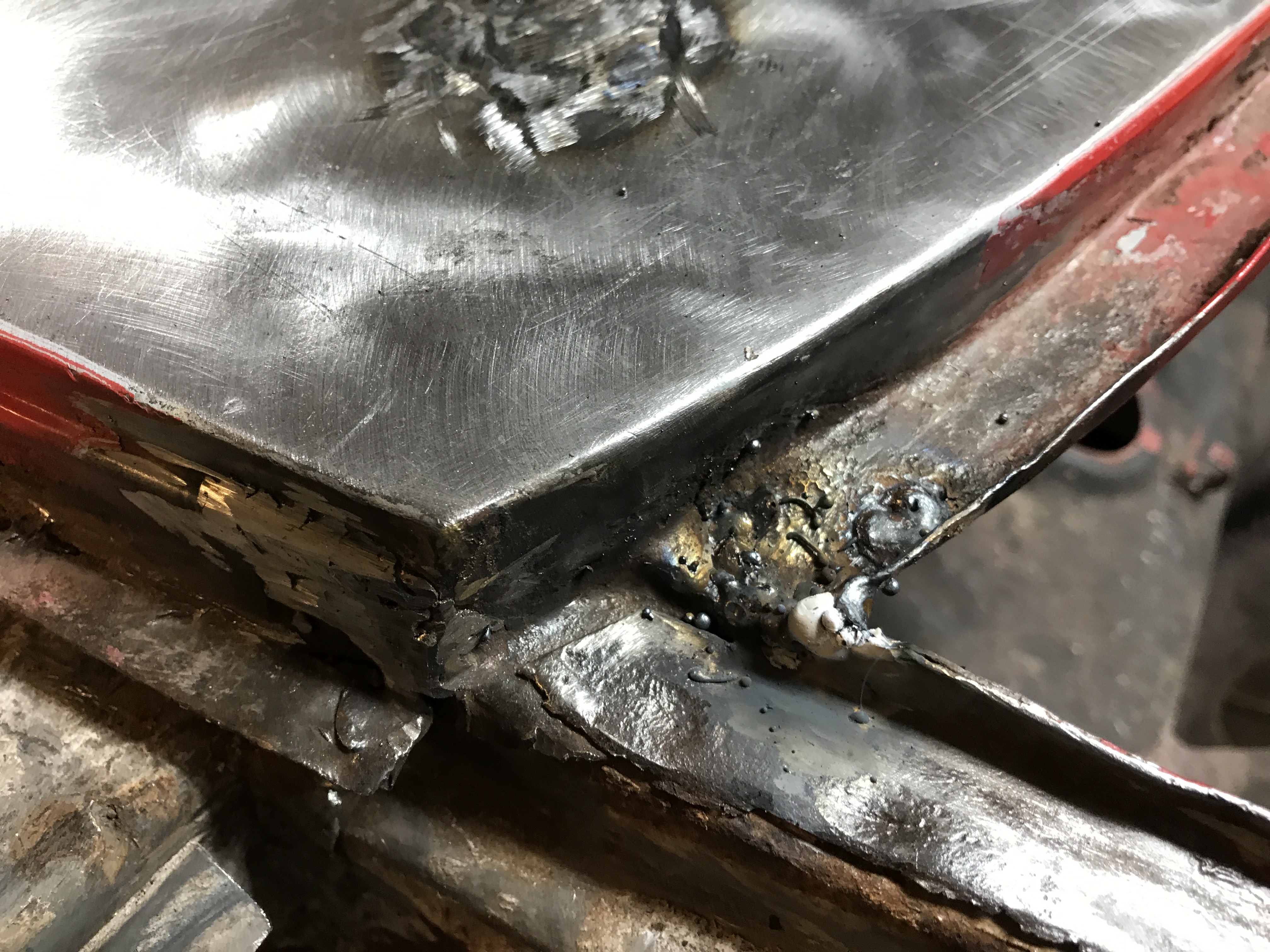

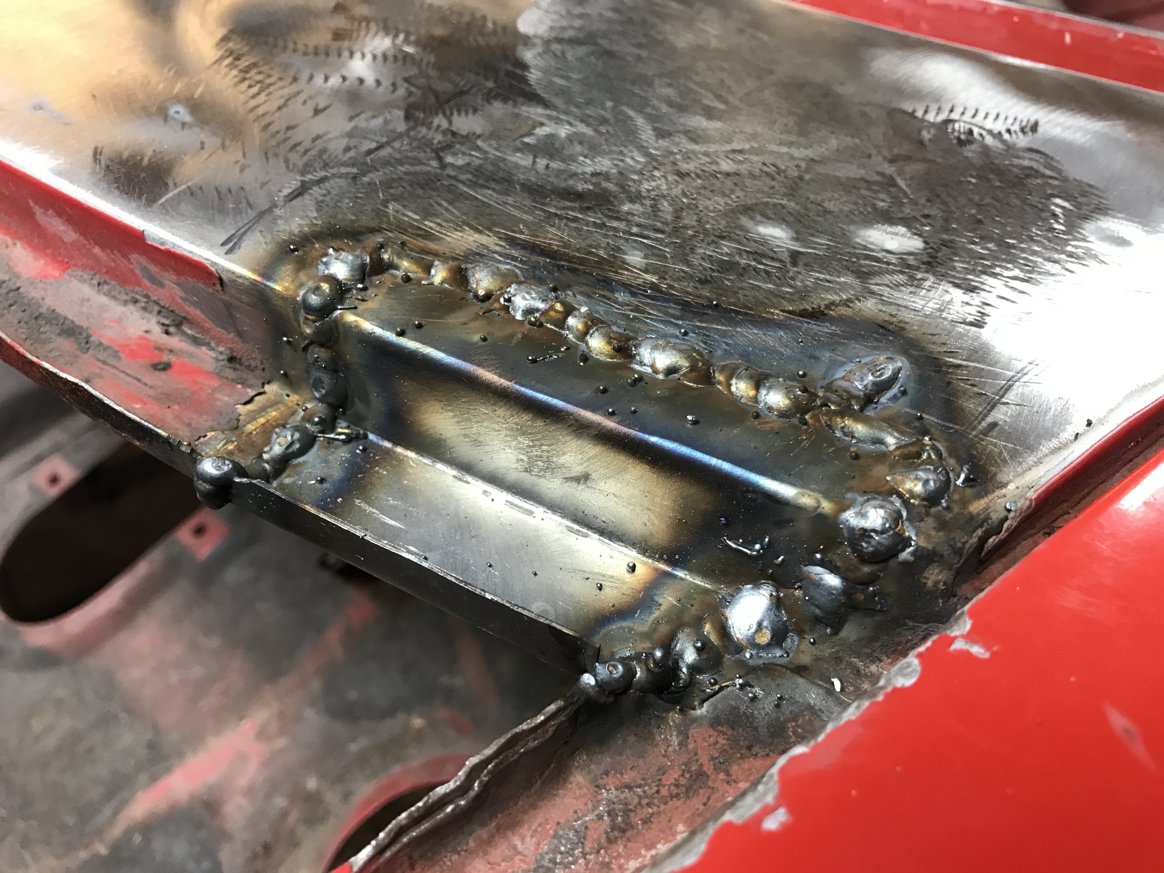

MIG time today. First, the patch in the left side of the cowl.
bkrantz
post Mar 23 2020, 08:50 PM
Post #386
Posts: 8,796
Joined: 3-August 19
From: SW Colorado
Member No.: 23,343

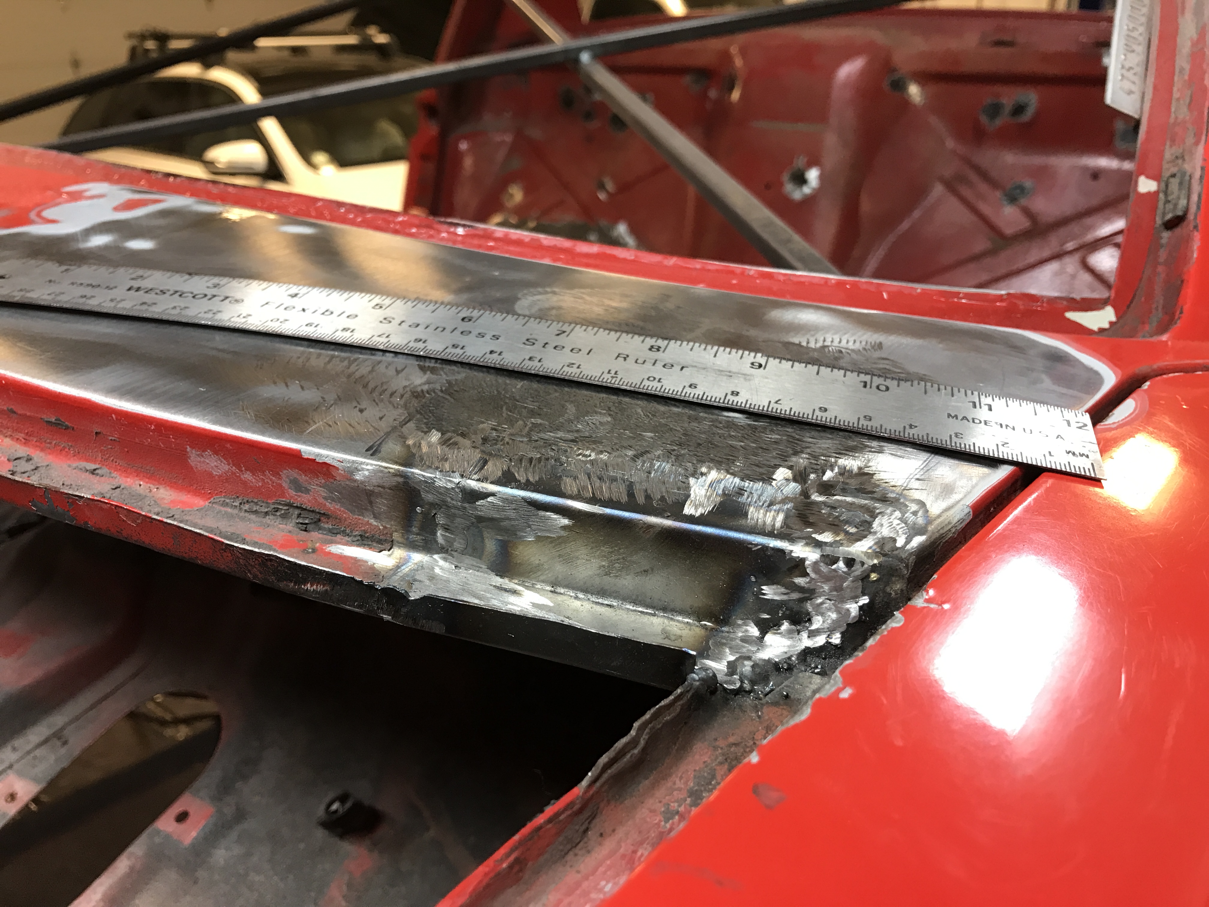

Then a bit of grinding.

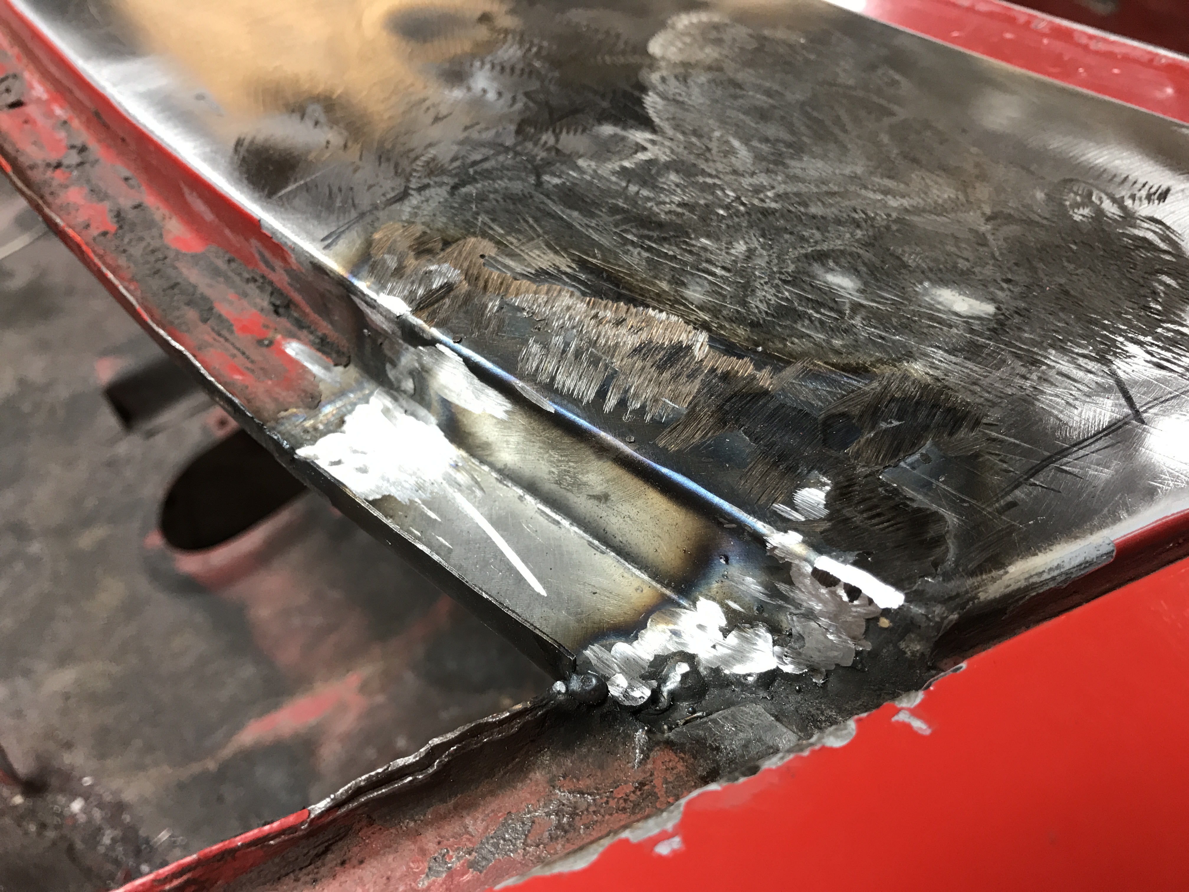

And then another session with the shrinking disk, to get the profile near right.

Then the right side, welding up the semi-rotten metal in the trough.
bkrantz
post Mar 23 2020, 08:53 PM
Post #389
Posts: 8,796
Joined: 3-August 19
From: SW Colorado
Member No.: 23,343
And ground down.

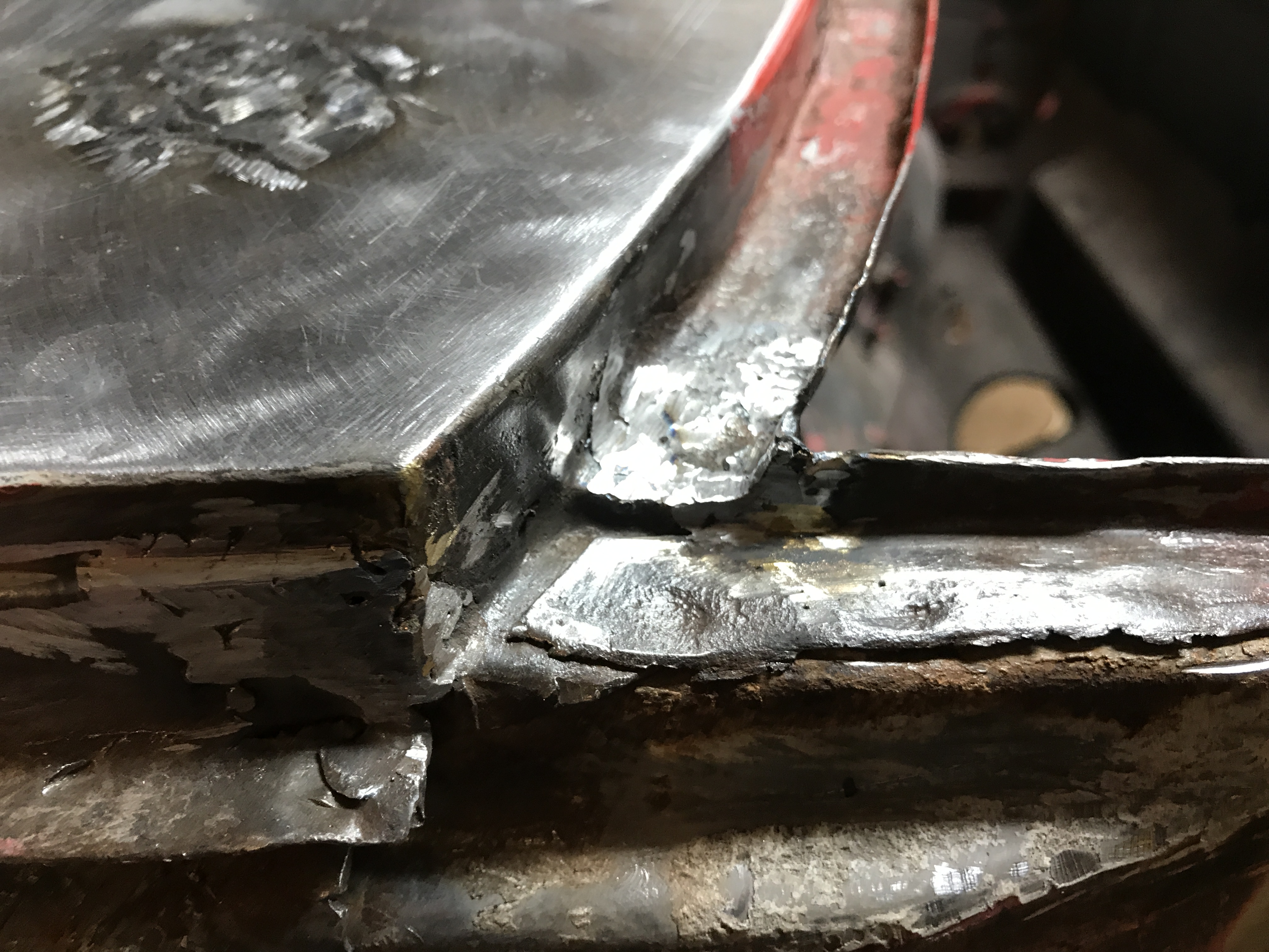

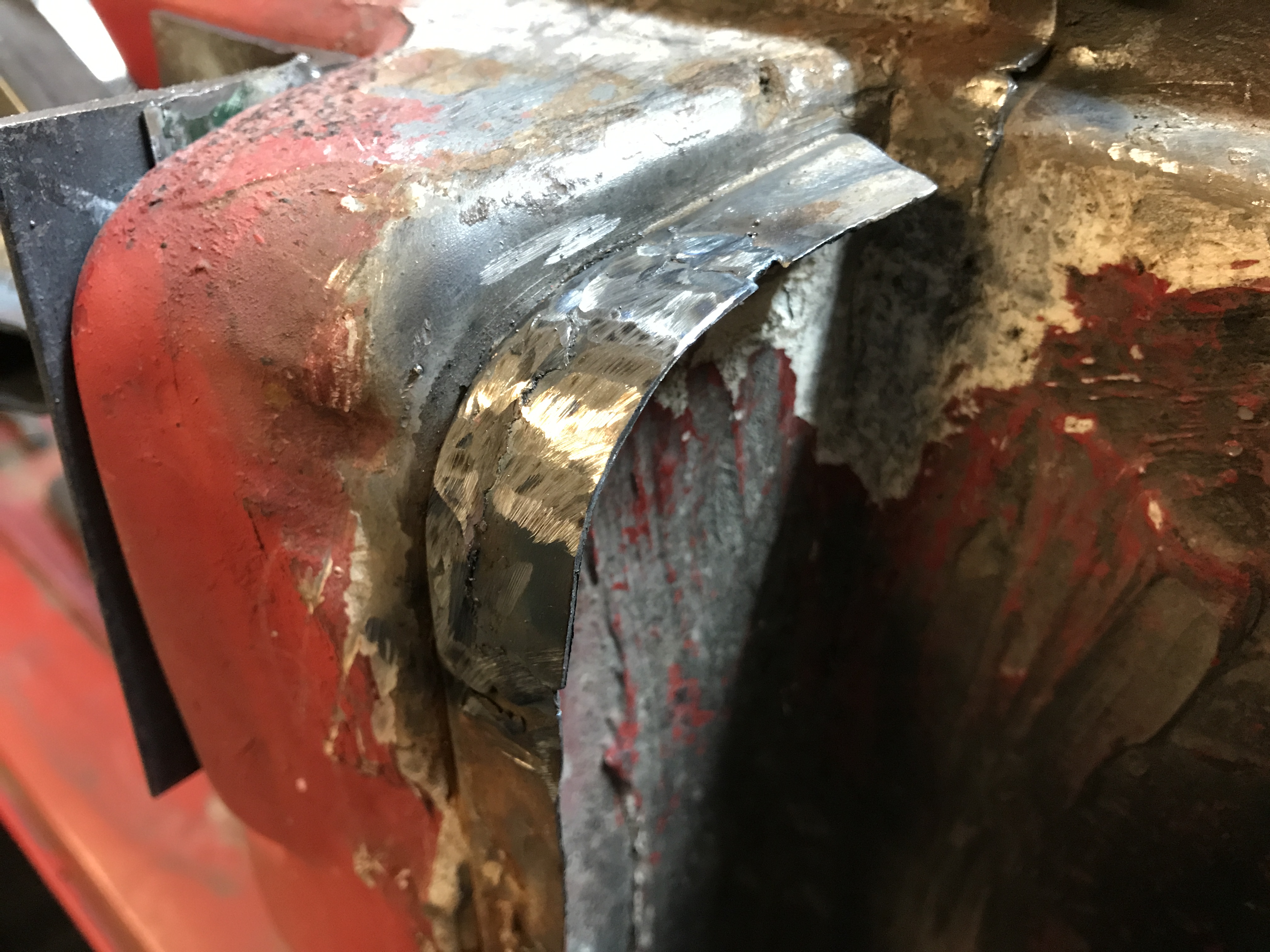

Finally, the section of the fender mounting flange.

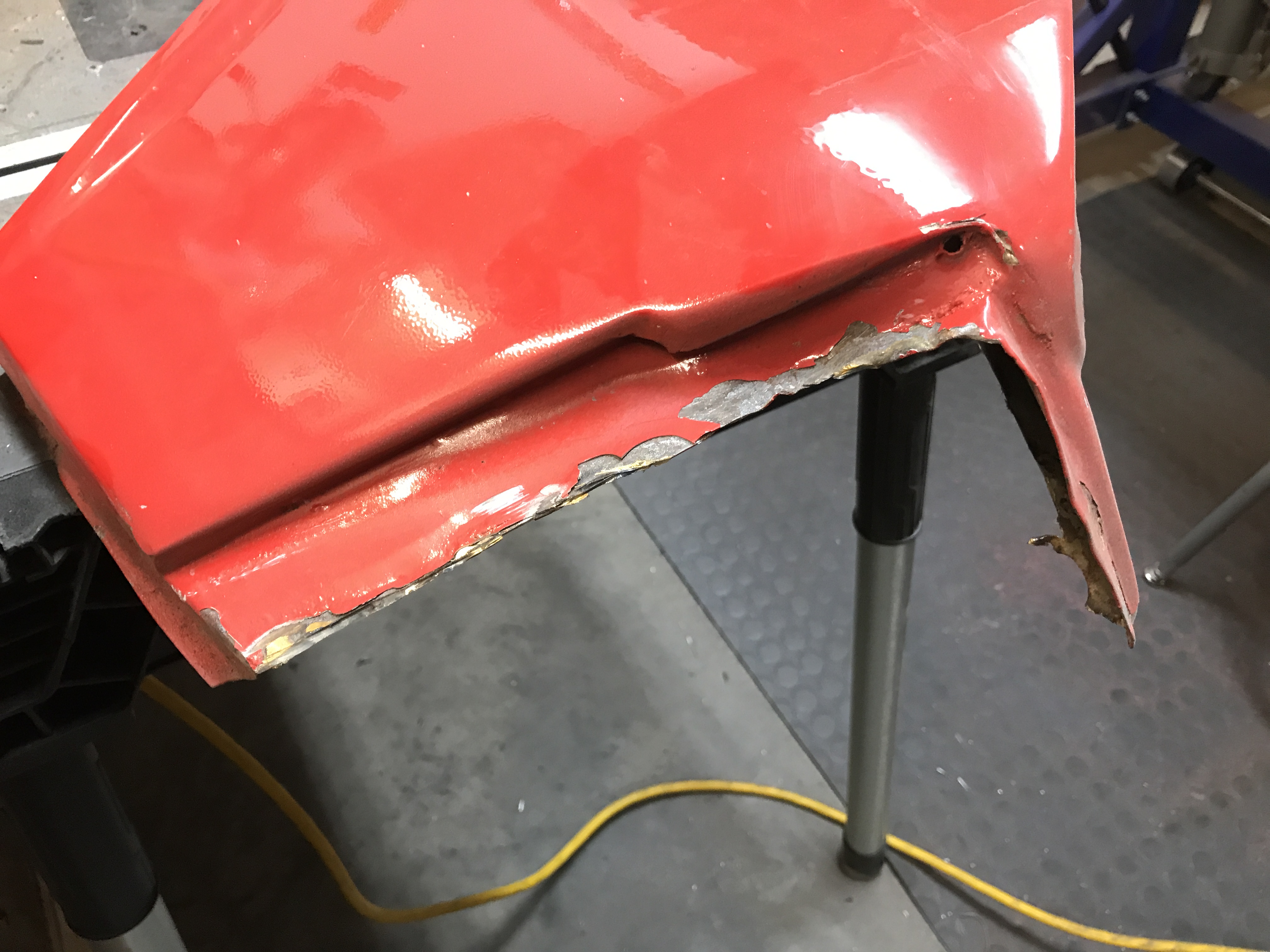

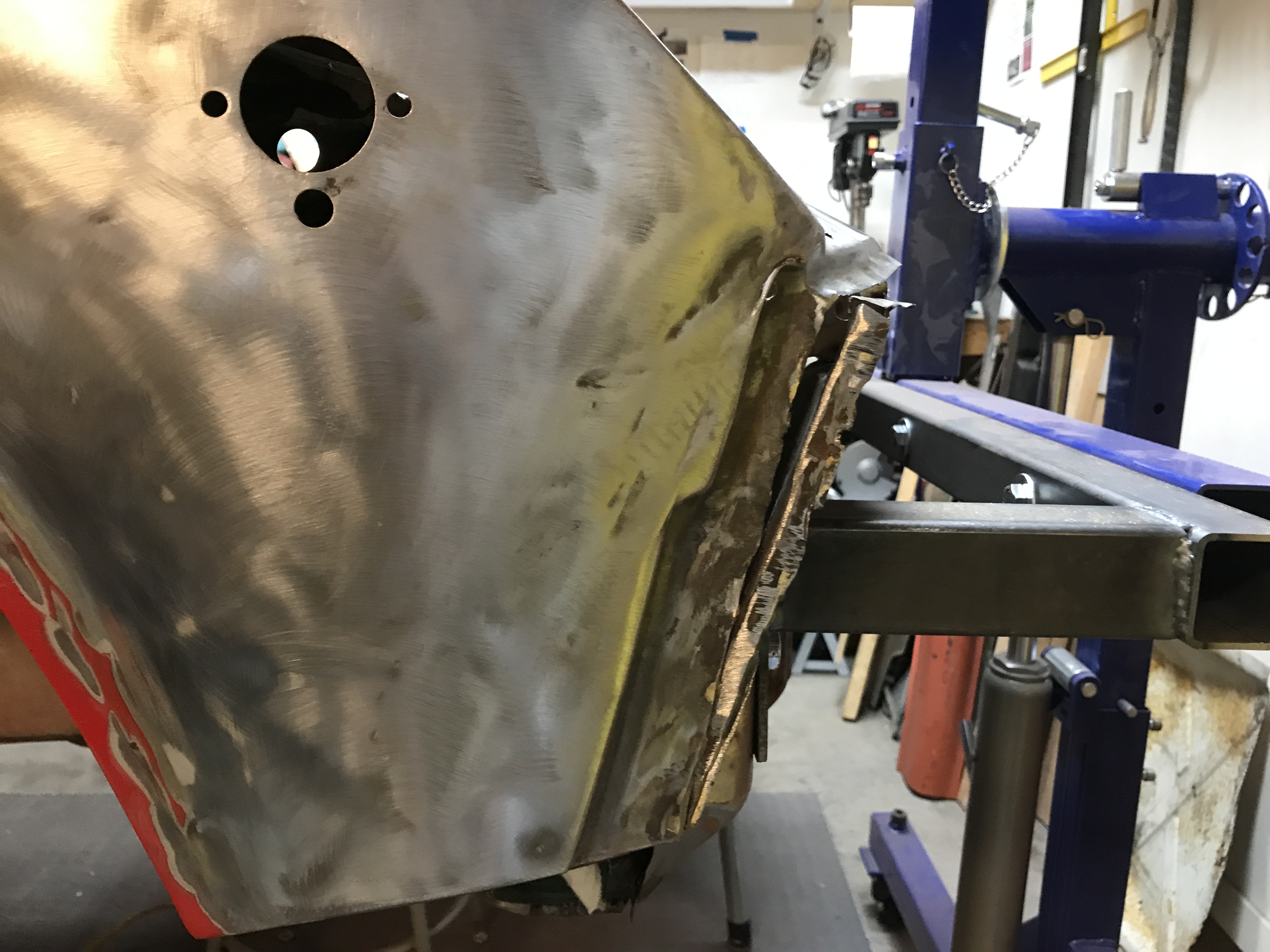

The fender needs a little work first, along the leading edge where it meets the side of the front panel, by the end of the bumper.

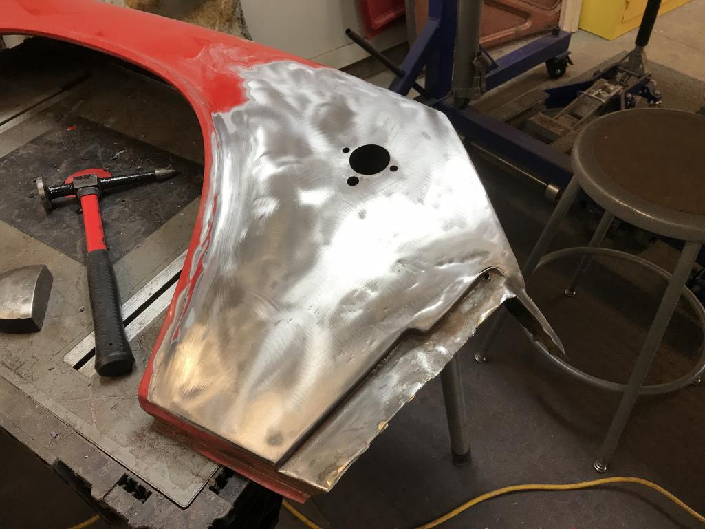

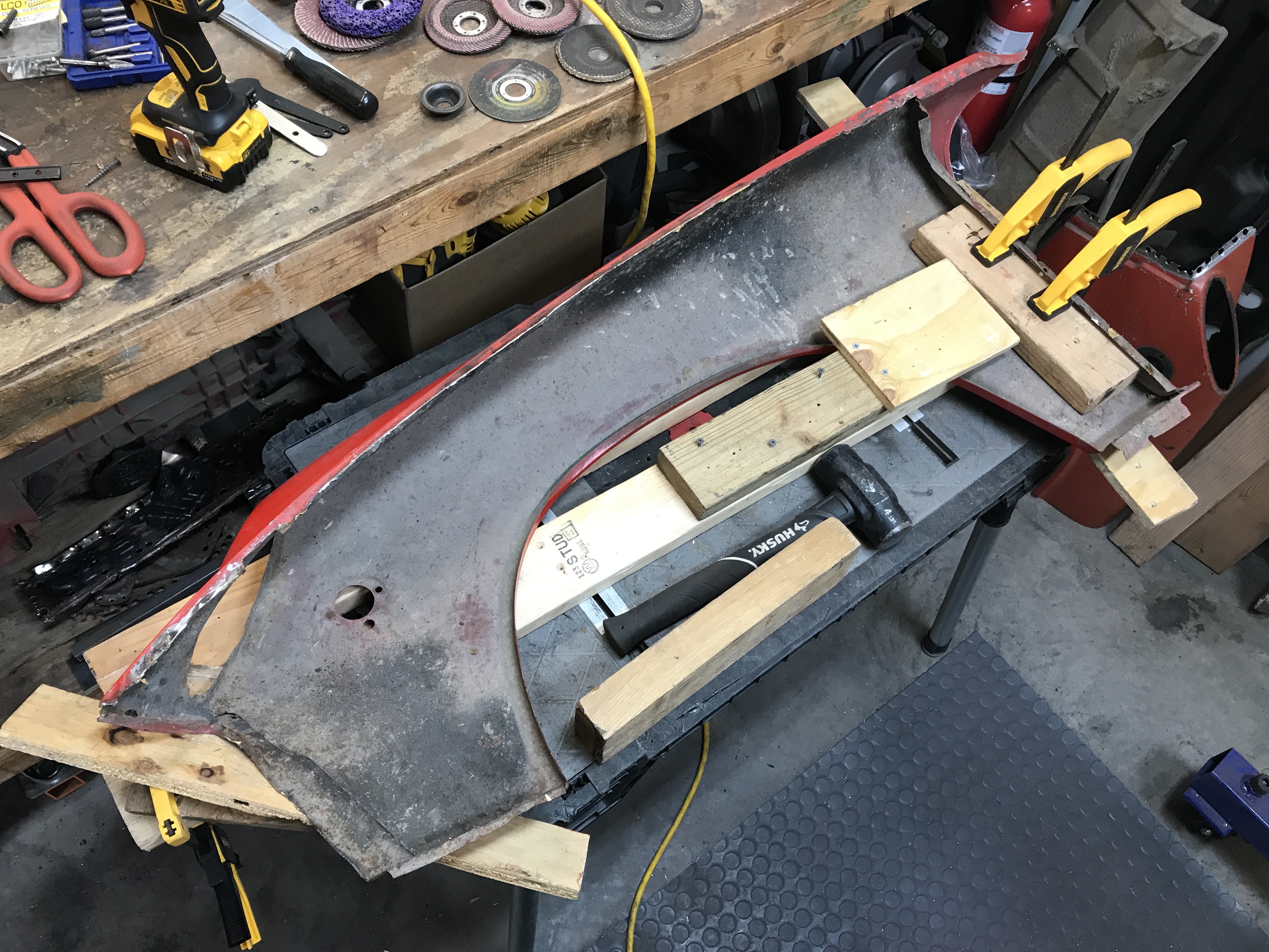

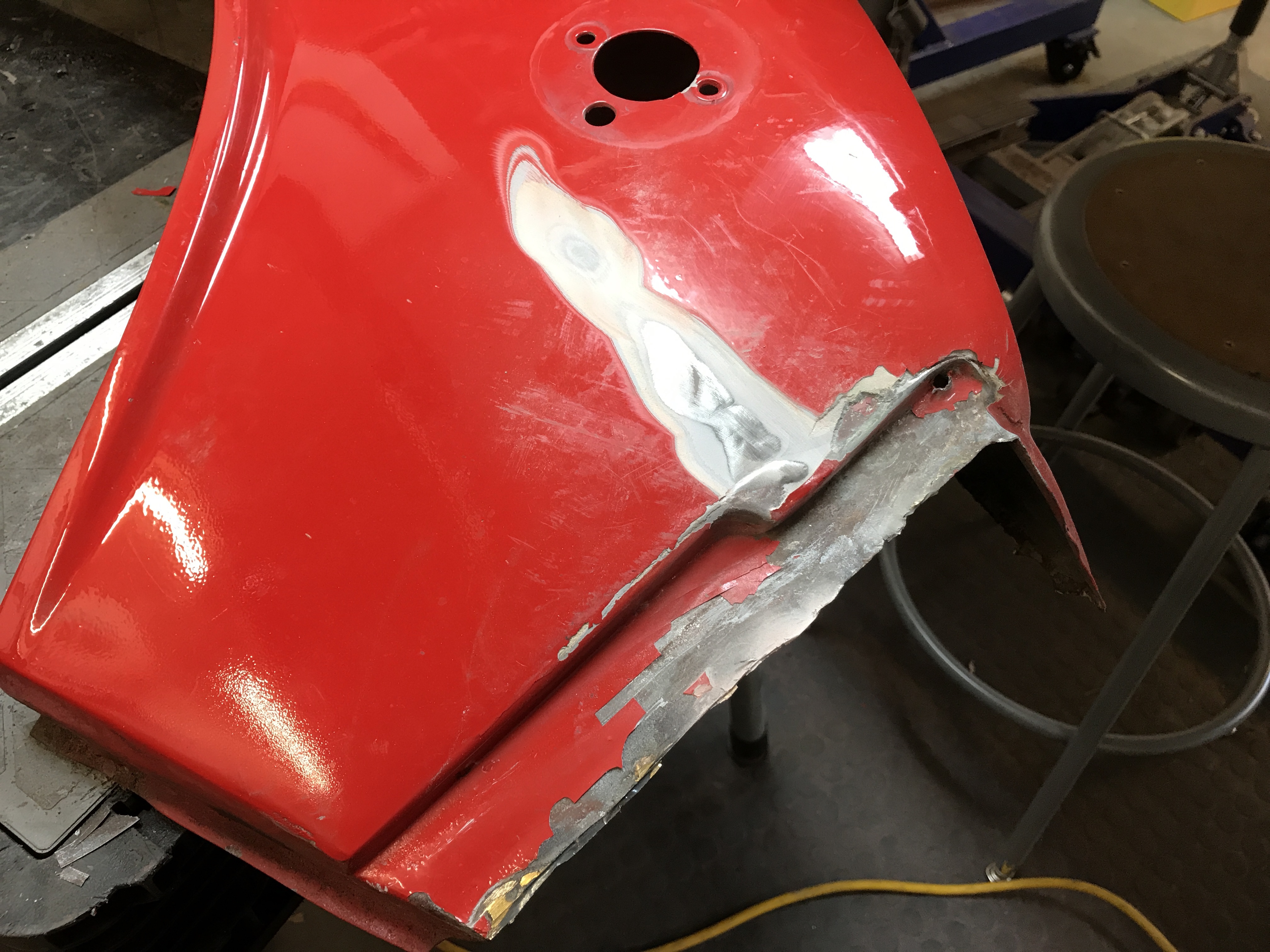

Got to work on the fender today. Here it is in a quick jig to stabilize it while I removed the crumple along the leading edge bumper recess. And my big movement tools (section of 2x4 and 4 lb hammer).

With the recess 90% straight, the next step is stripping paint to expose the bare metal. Guess what--bondo!

And with metal exposed, I can see what I need to fix: mostly along the leading 3 or 4 inches.

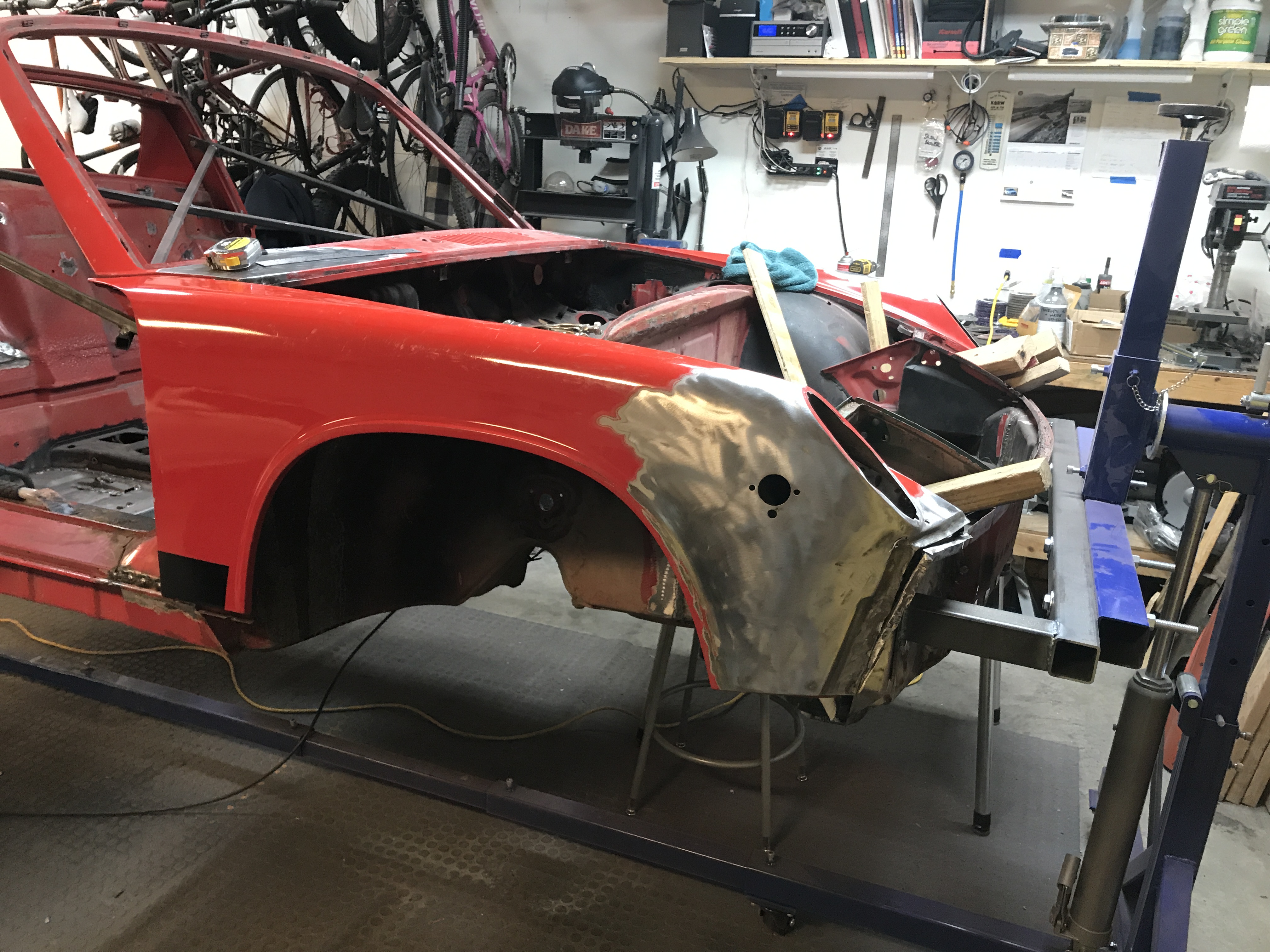

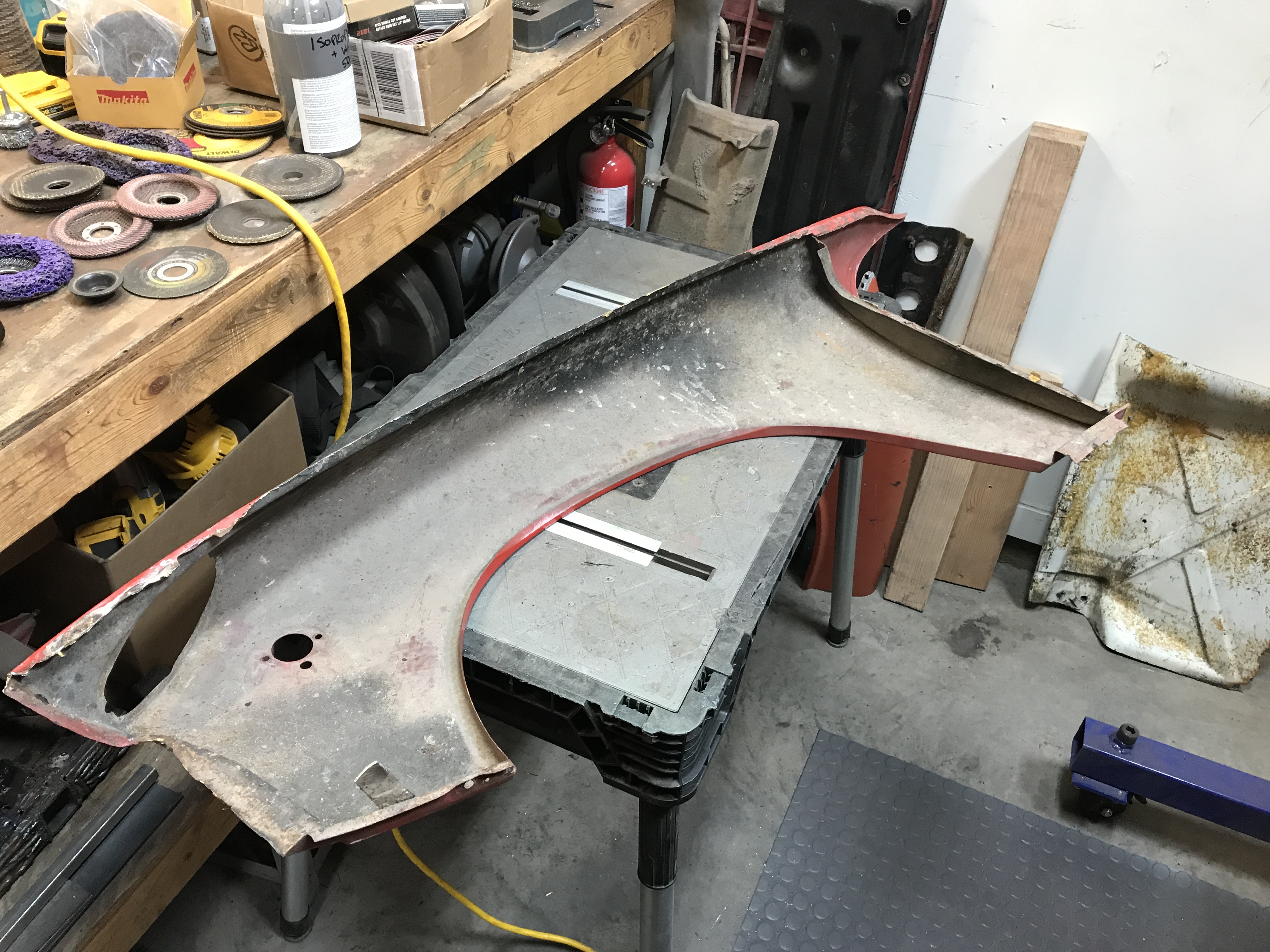

Before any more metal work, I wanted to see how the fender fits overall. Here is it roughly in place.

Another view.

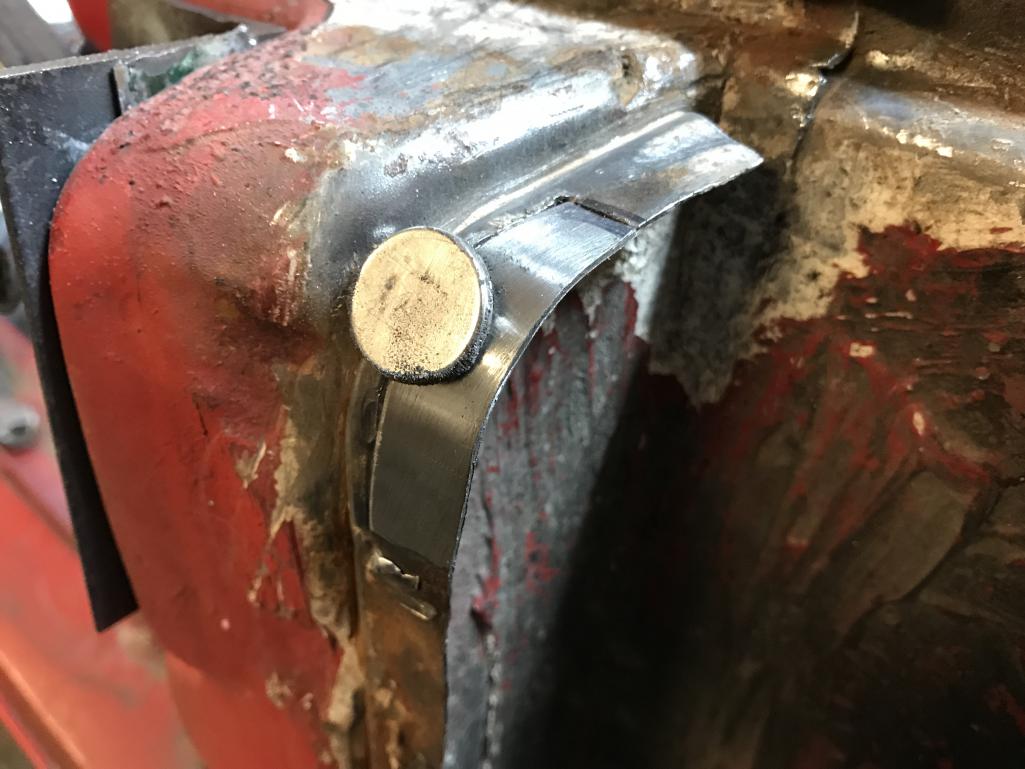

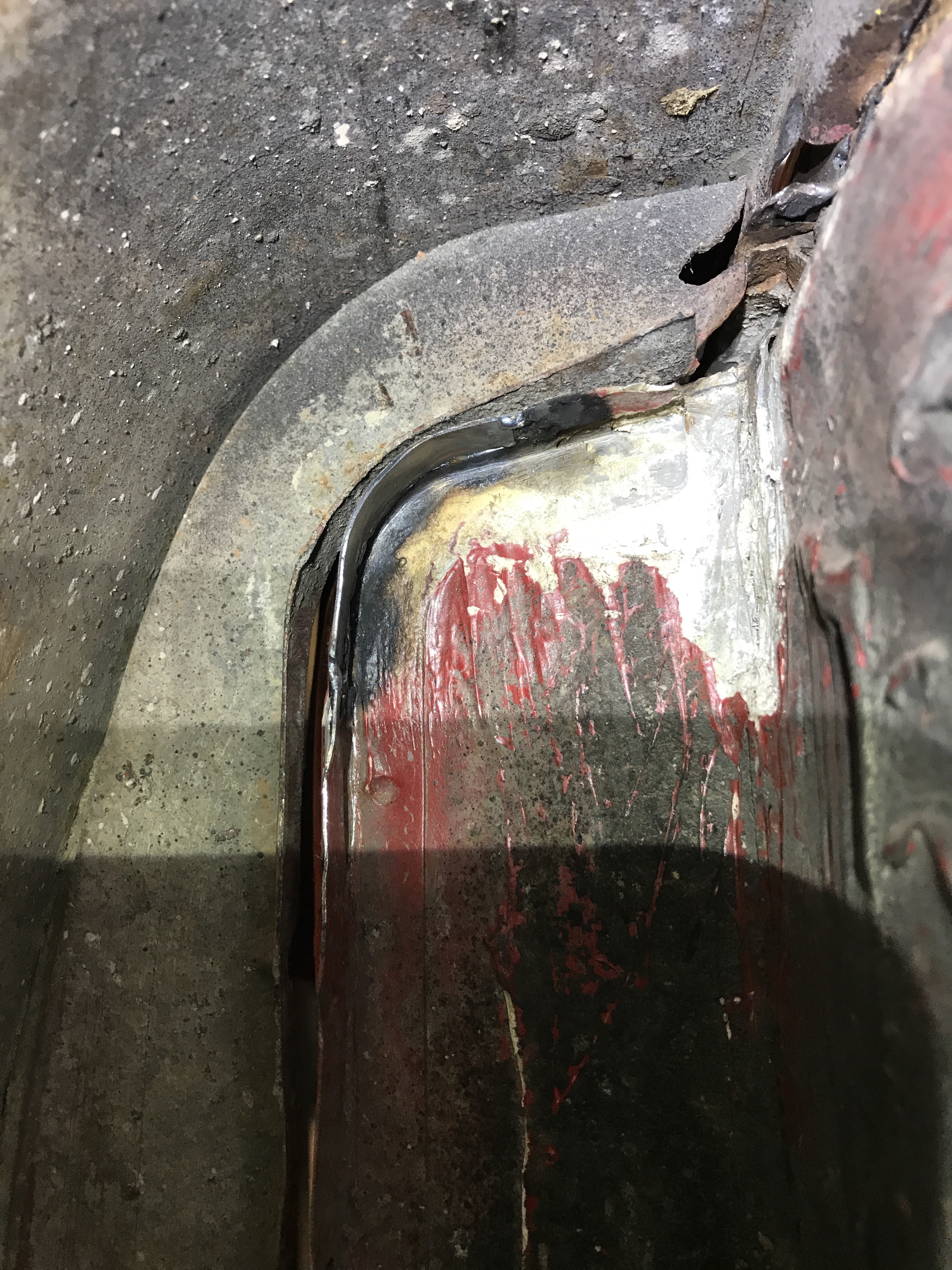

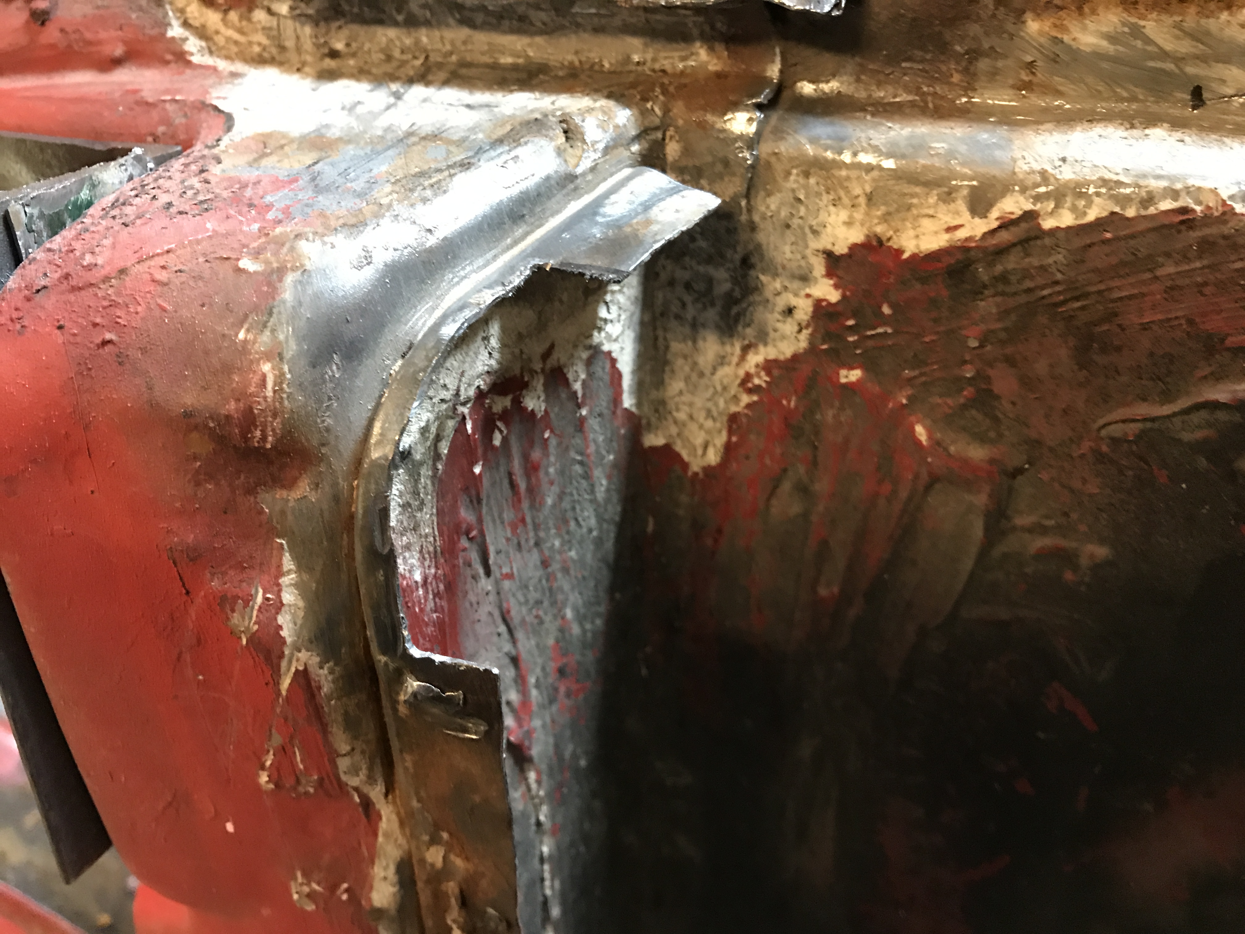

Looking inside the fender, where it meets the mounting flange on the A-pillar.

And from the back side of the A-pillar.
