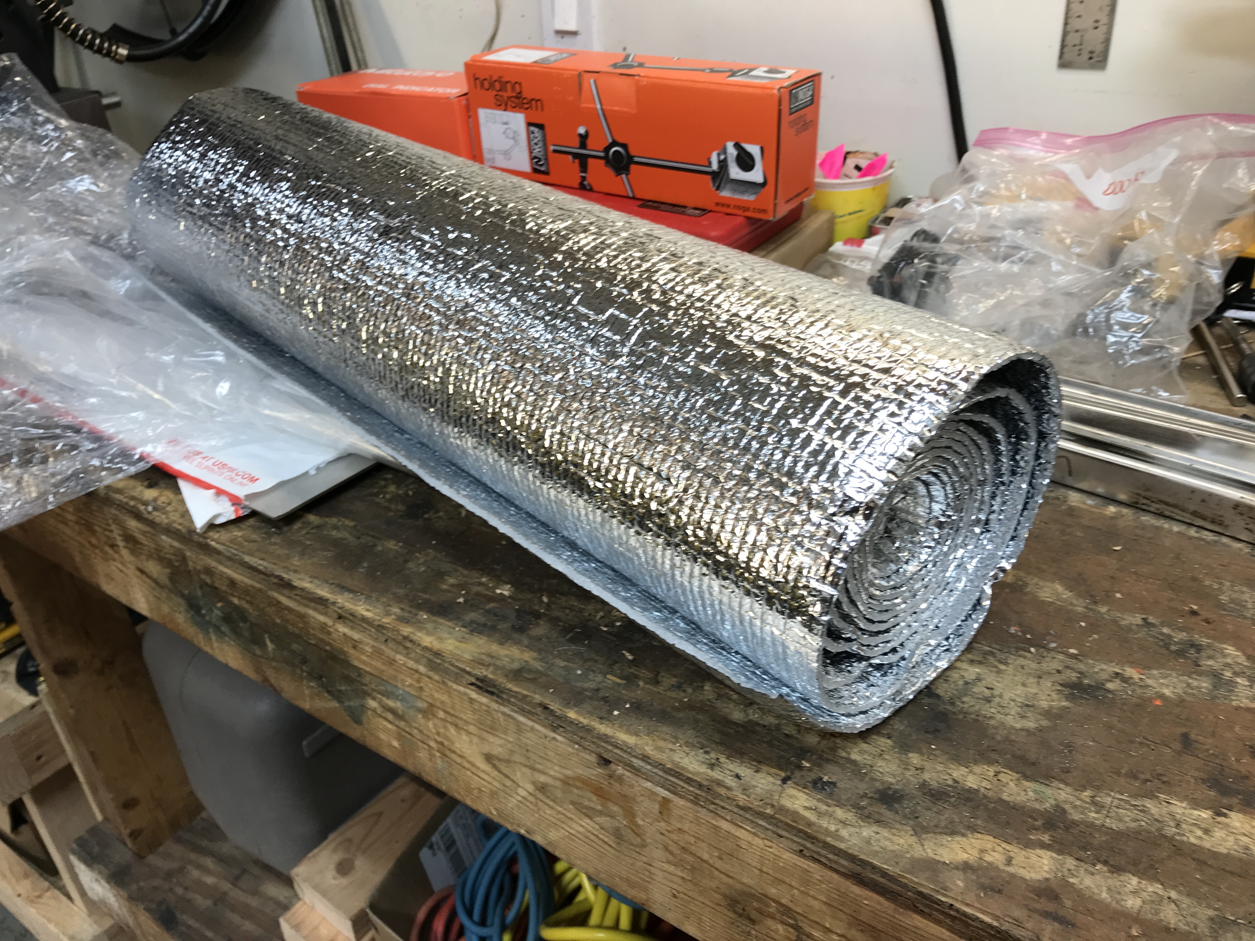

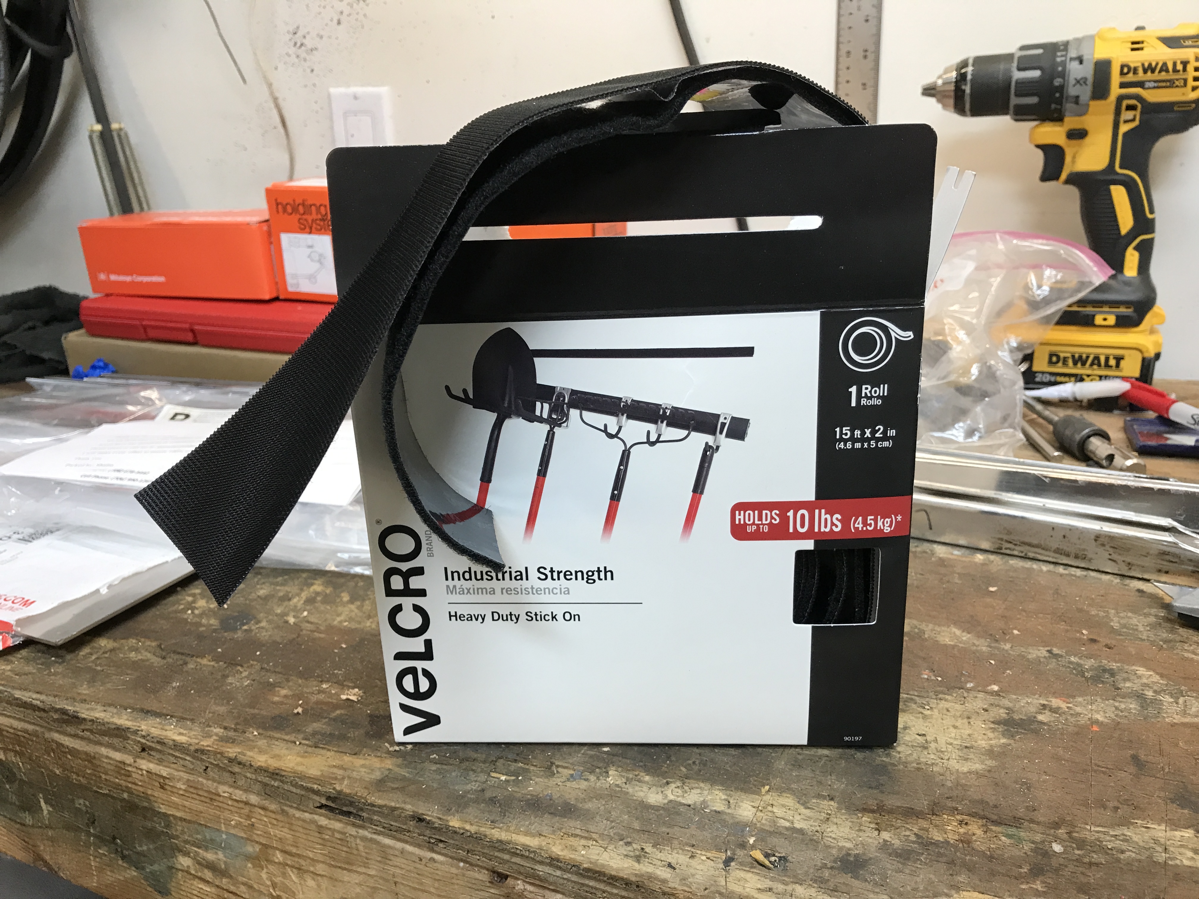

Back home and back at 914 work. A few things got delivered while I was away, including some heat reflecting material. This has foil on both sides.

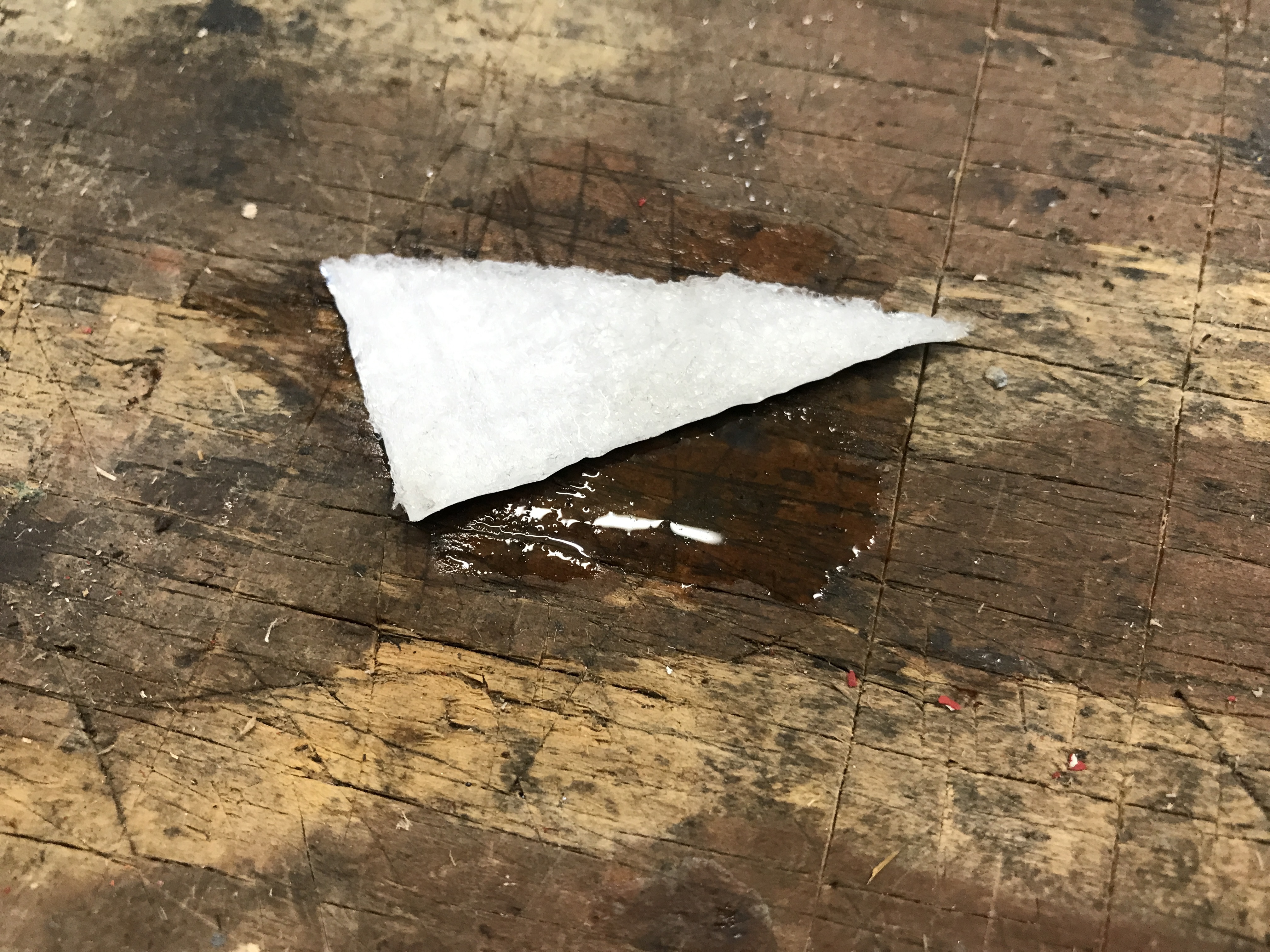

And the internal foam is closed-cell, so it can't absorb water. I figure that the risk of rust under this stuff is minimal.

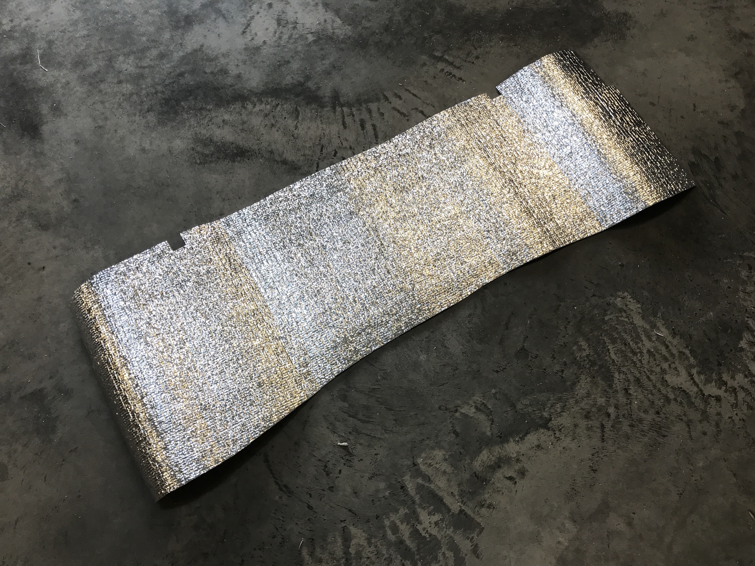

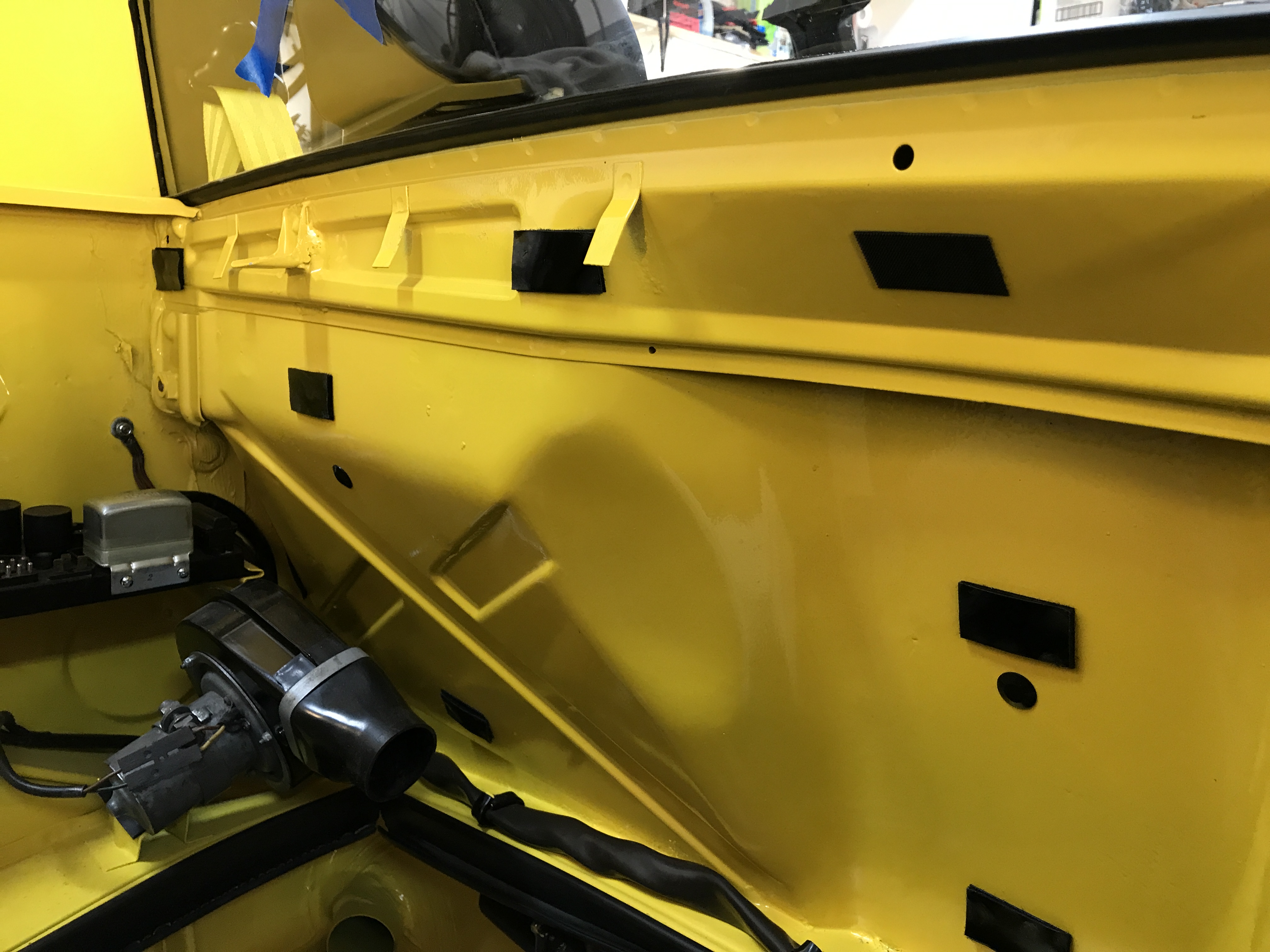

New firewall blanket cut out.

For attachment, I grabbed my high-strength Velcro.

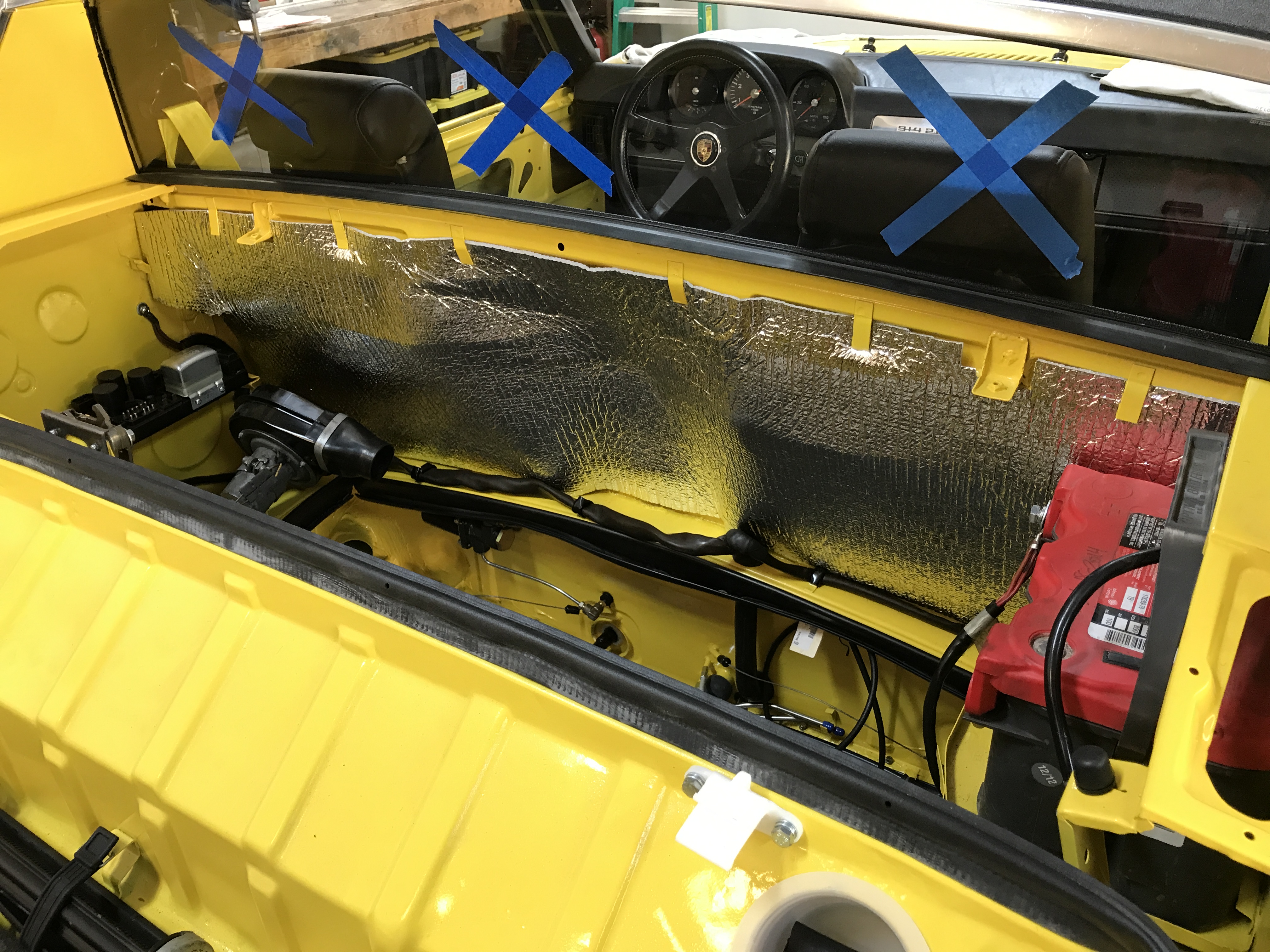

I stuck the hook side onto the car, and then velcro-ed the loop side pieces on, with the sticky side out and bare. BTW, I ended up adding more patches than in this photo.
bkrantz
post Oct 6 2021, 08:08 PM
Post #3829
Posts: 8,800
Joined: 3-August 19
From: SW Colorado
Member No.: 23,343
This should help reduce heat transfer, and maybe noise.

That came out really nice (not surprised) and I am pretty sure you will get a noise reduction benefit. (IMG:style_emoticons/default/beerchug.gif)

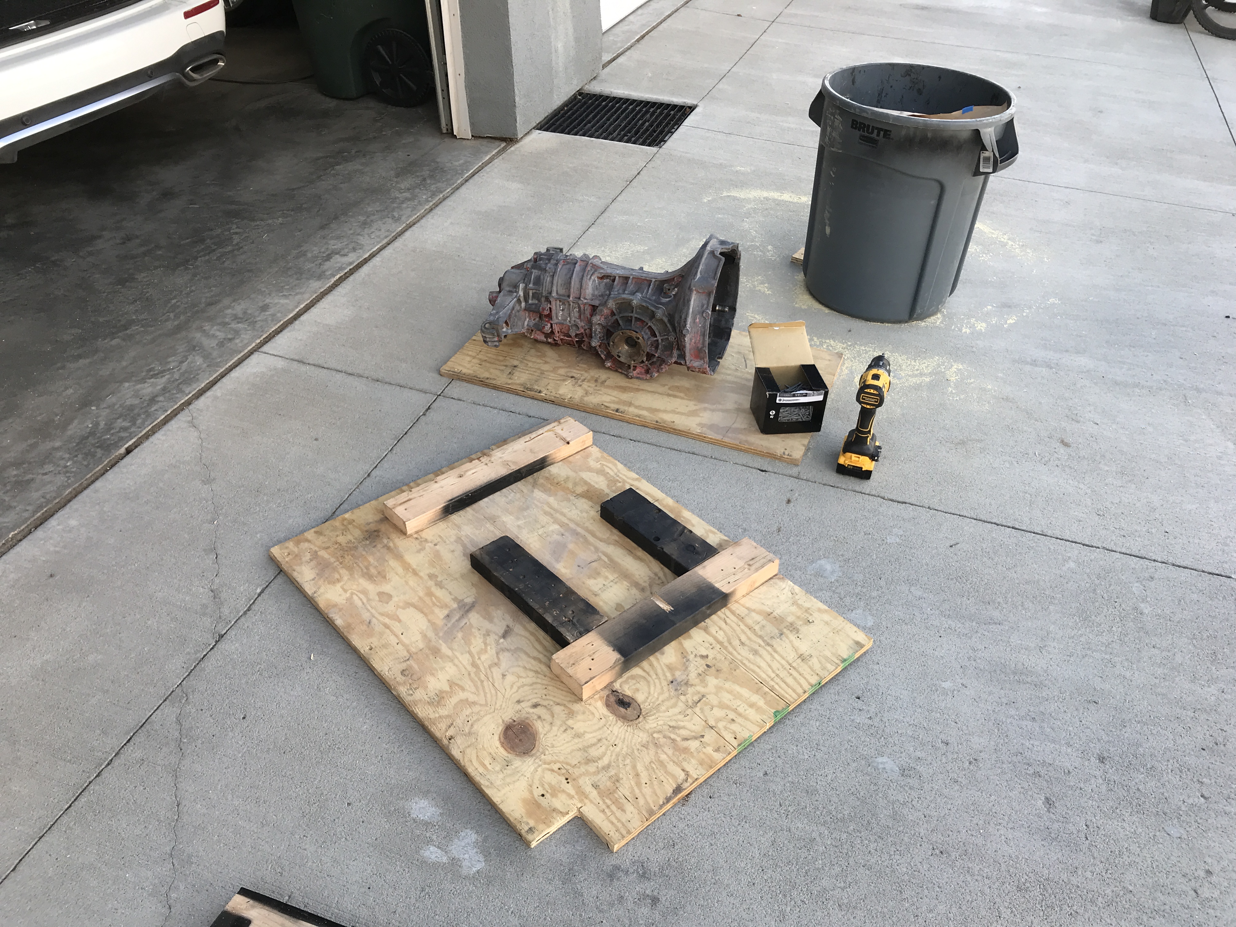

A little side job today. I plan to take my transaxle to CMS, as a little side detour on our next Arizona road trip. To tie it down, I made a cradle.

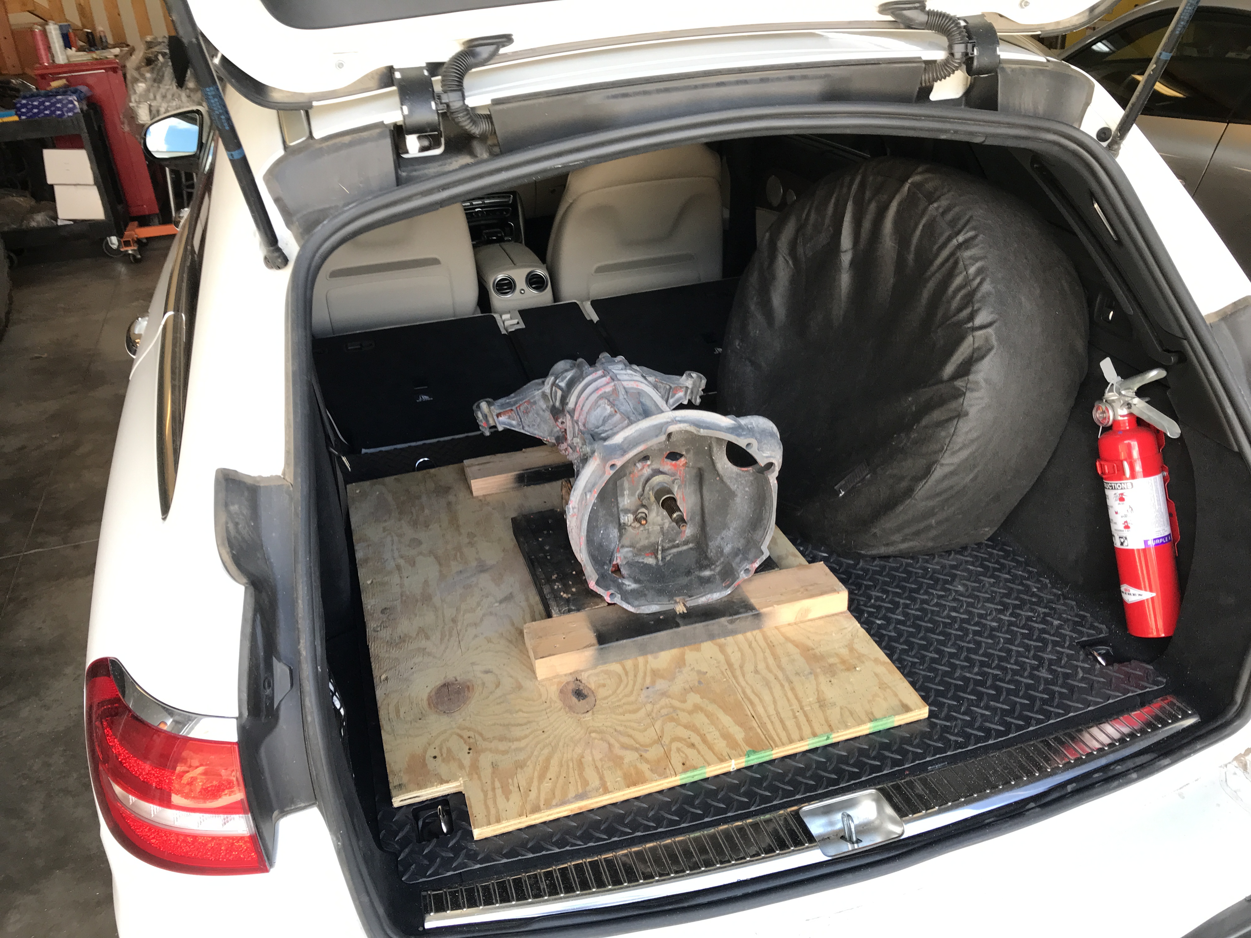

Test fit. I will use the floor tie-downs and ratchet straps when its time to go. This would be easier in the Suburban, but the E400 is much more plush.

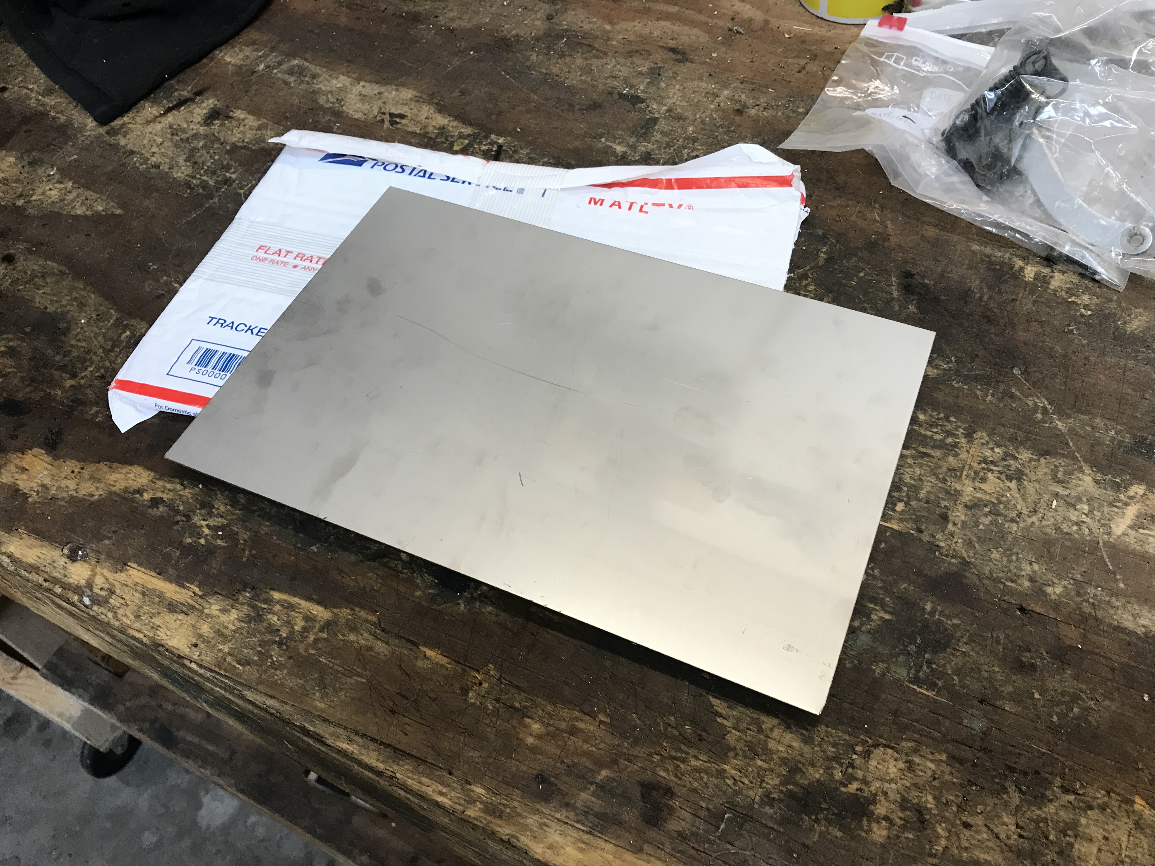

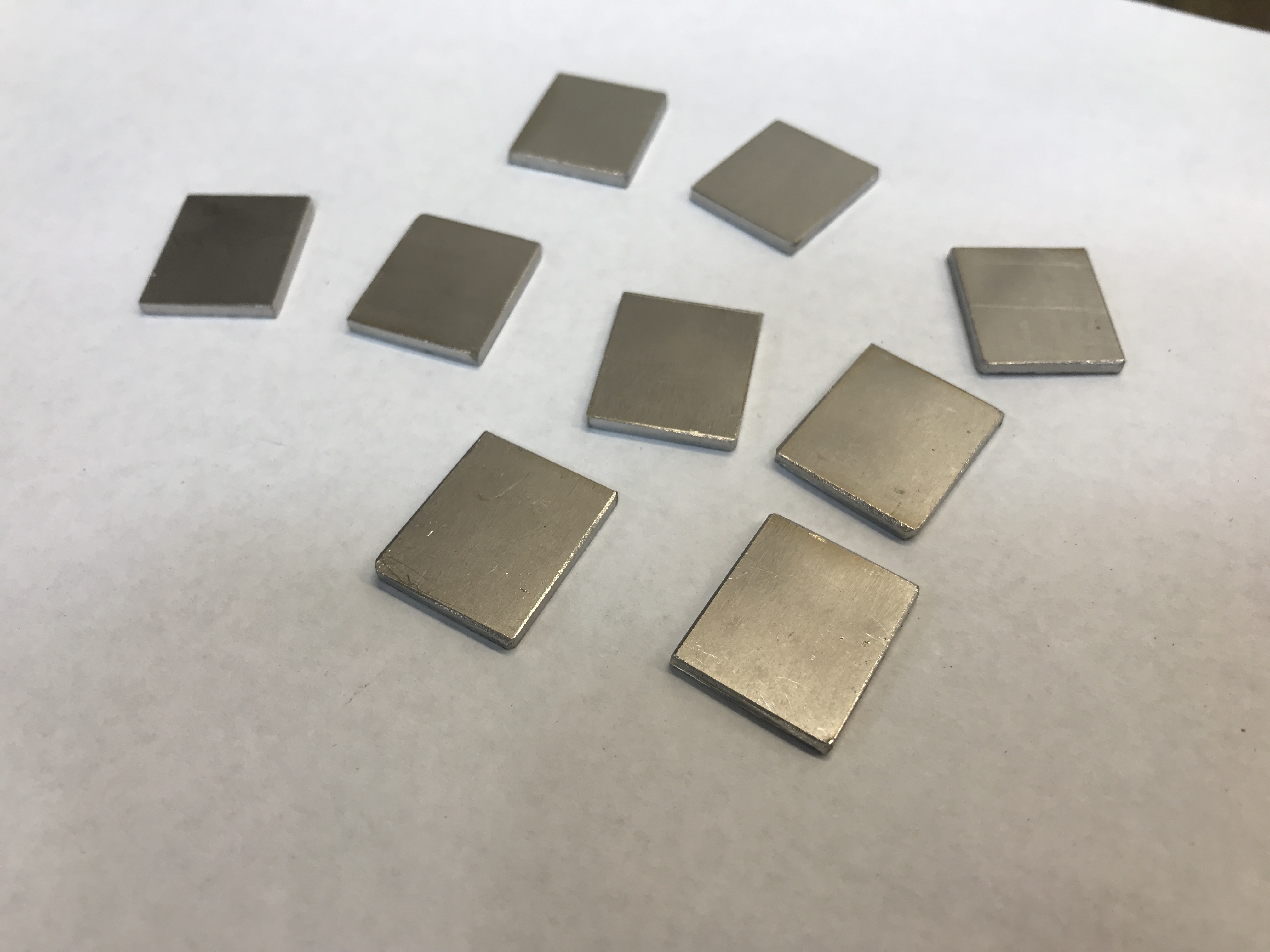

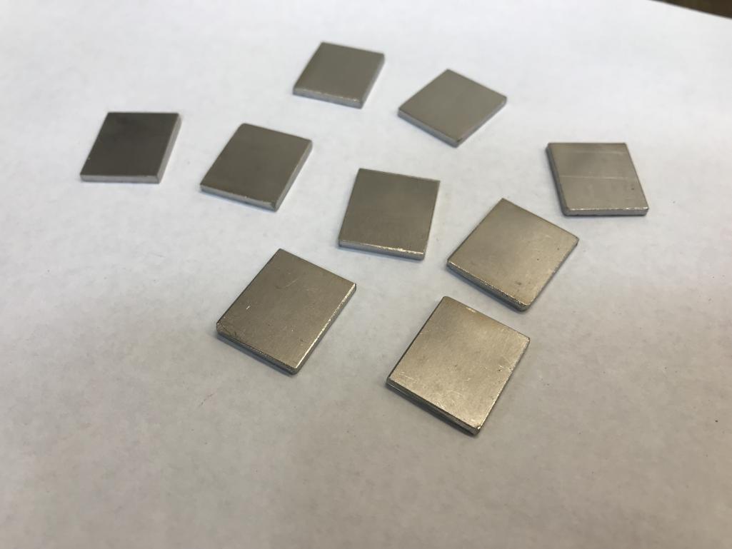

I then tried making shims for the rocker arm shaft supports. I got some 14 gauge stainless steel (stainless was all I could find quickly last week.
bkrantz
post Oct 7 2021, 08:19 PM
Post #3834
Posts: 8,800
Joined: 3-August 19
From: SW Colorado
Member No.: 23,343

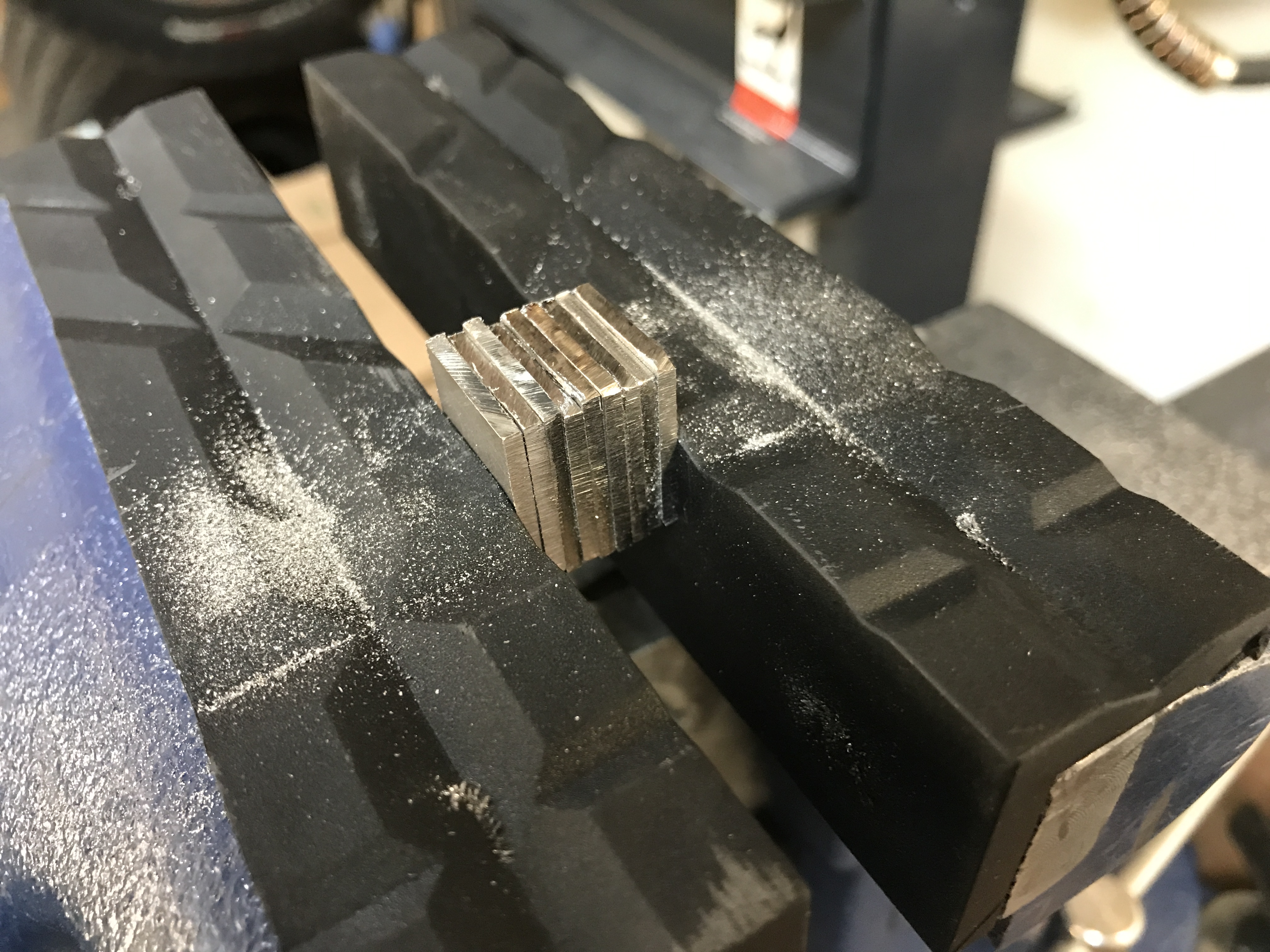

I cut 9 blanks to rough size, and then did some manual filing to even them up. BTW that makes 8 plus a spare.

Here are 9 blanks all finished, but lacking holes.

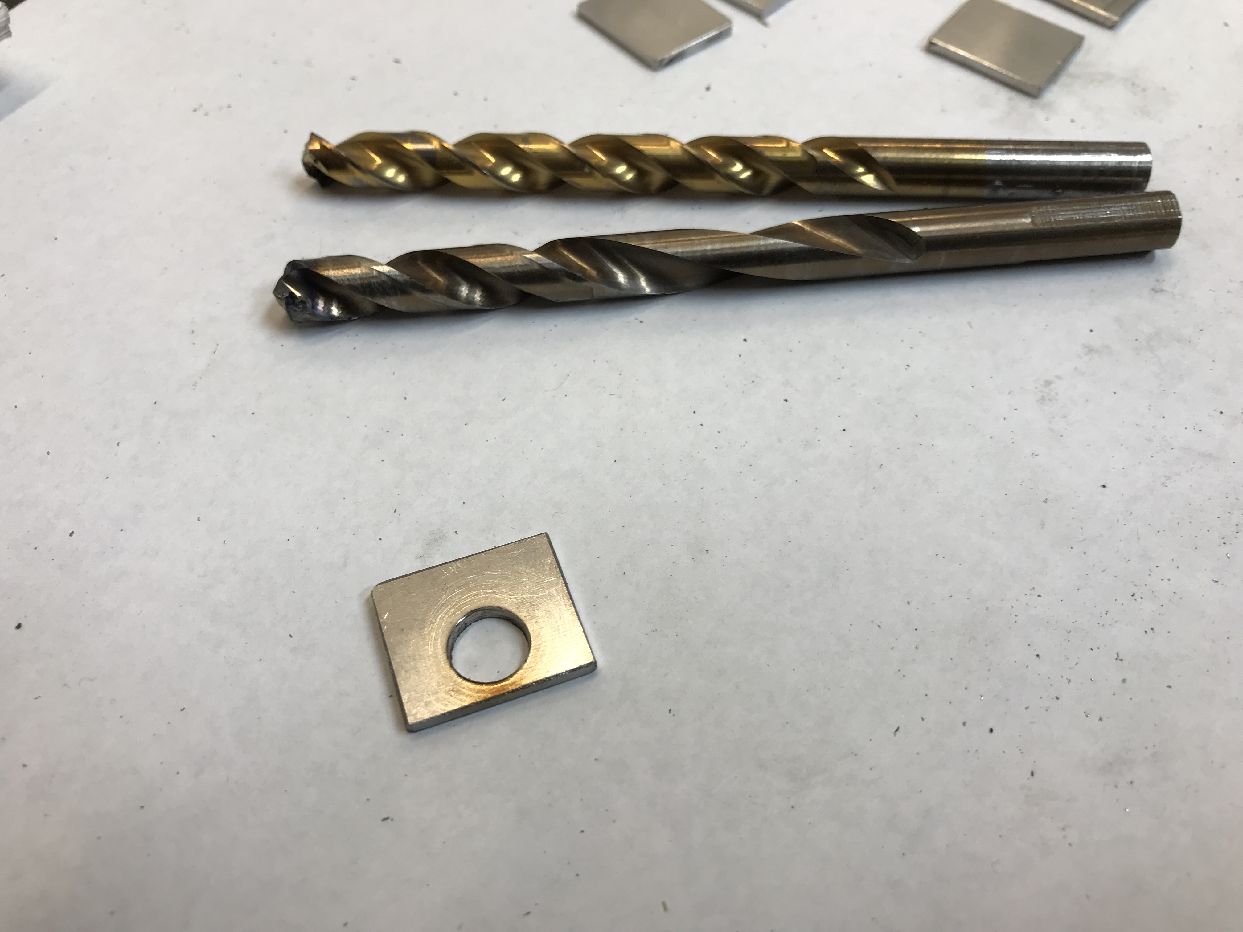

I set up my drill press, but the vise shifted and the first hole is too far off-center. So much for the spare shim.
When I reset the vise and tried drilling again, I was careless a second time, and let the shim and bit over-heat. That took care of the bit, and work-hardened the shim. An extra bit I had also met its end on the same shim.

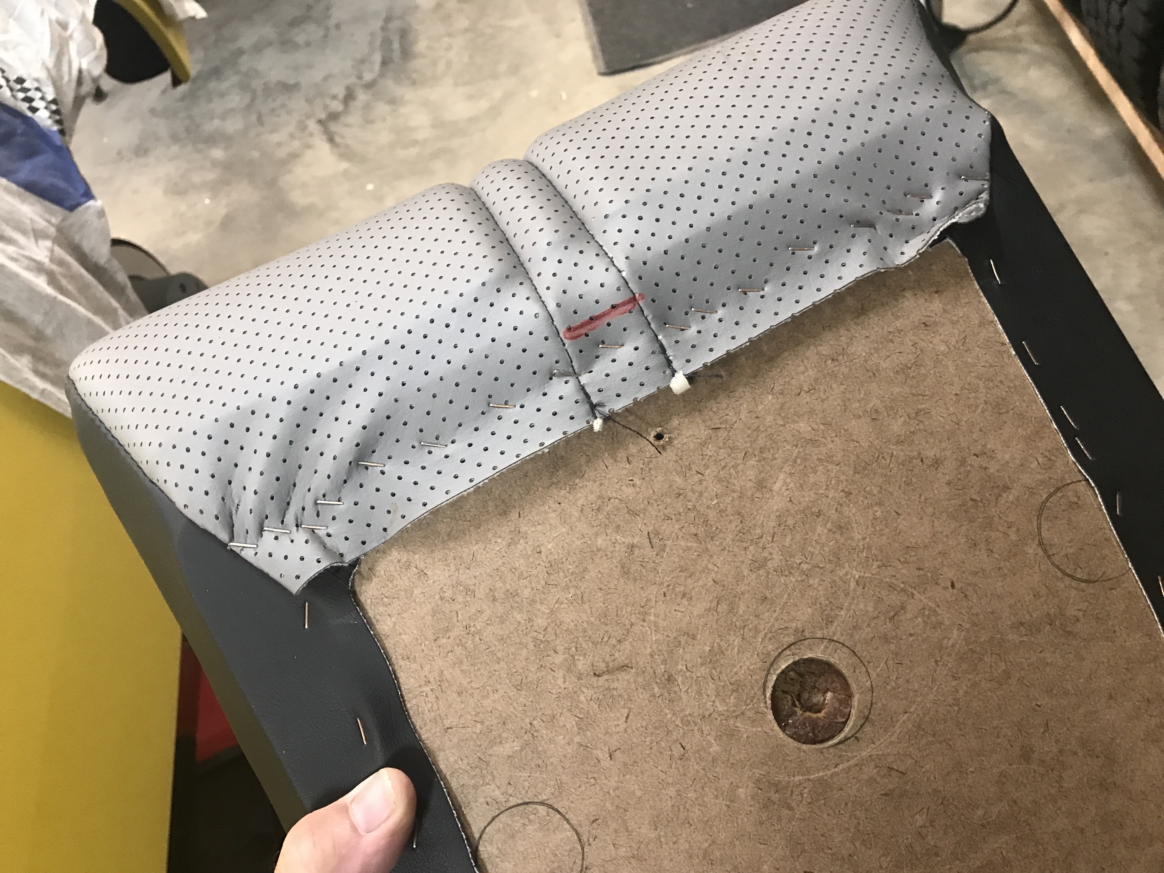

I needed to make replacement clips for the seat bottoms, that fit into the slot in the base and keep the cushion in place.
bkrantz

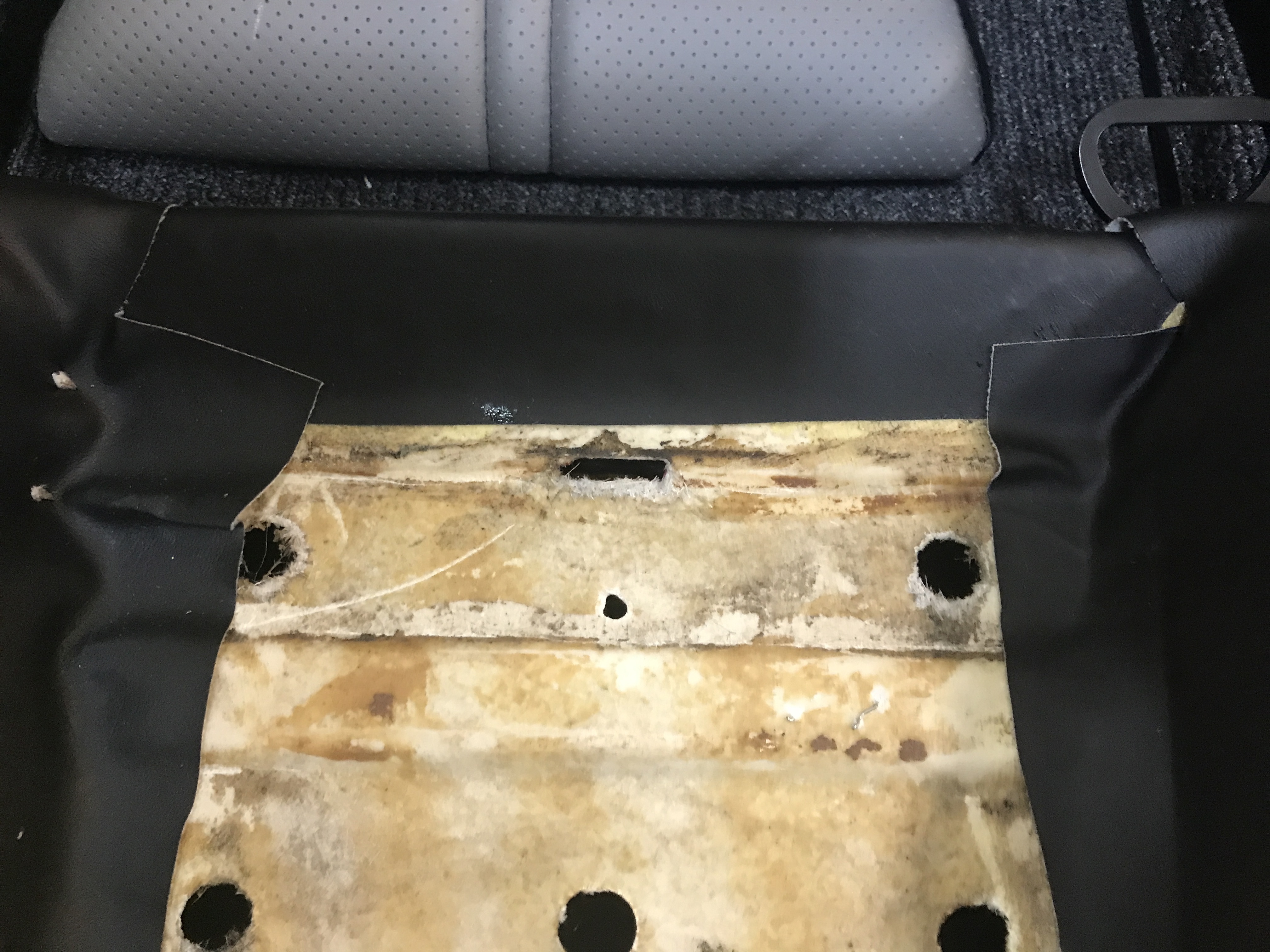

When I had the seats recovered, they made new bottom panels, but lost the stock metal clips.
To start, I marked the position of the slot on the cushion bottom.

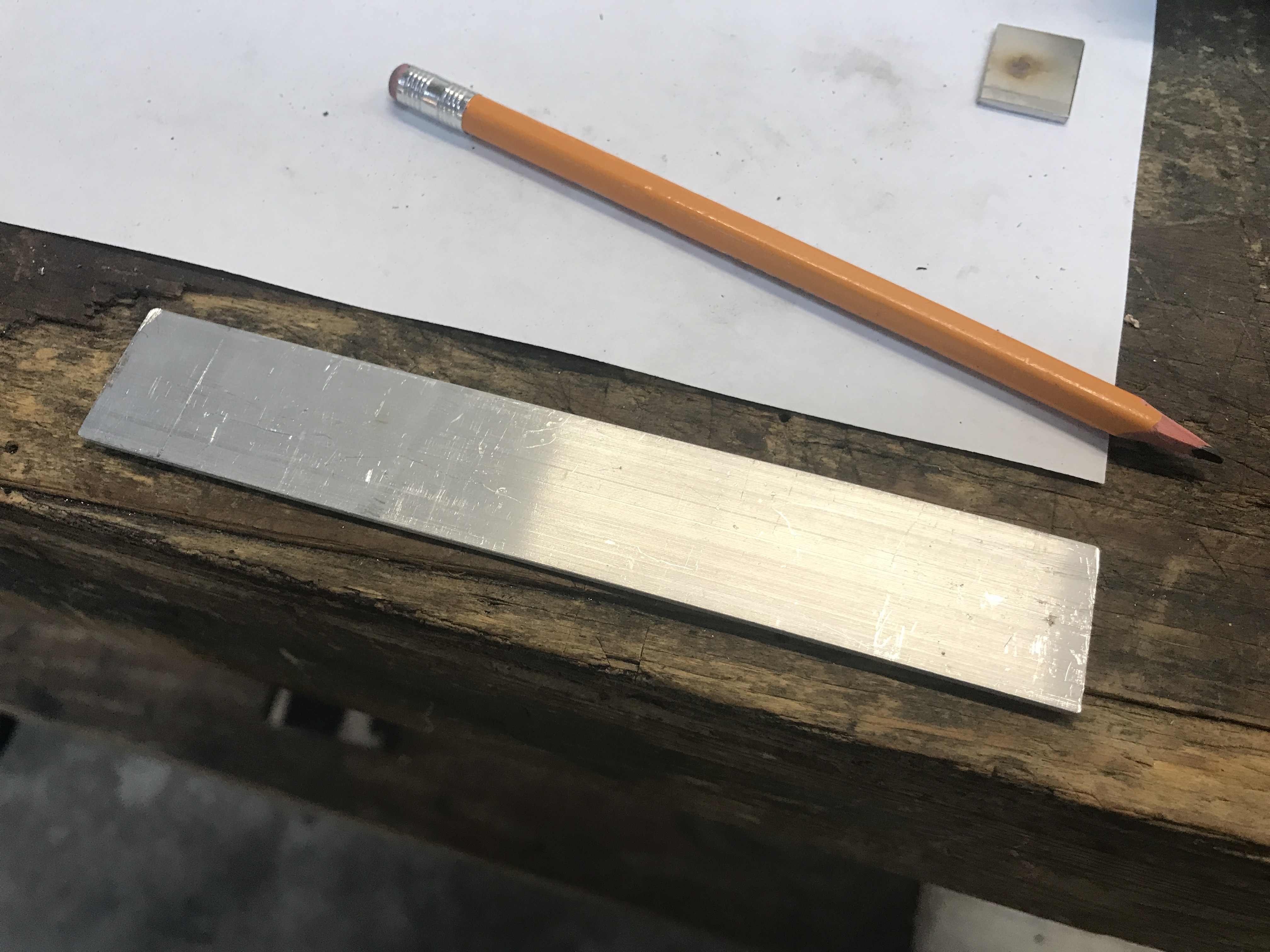

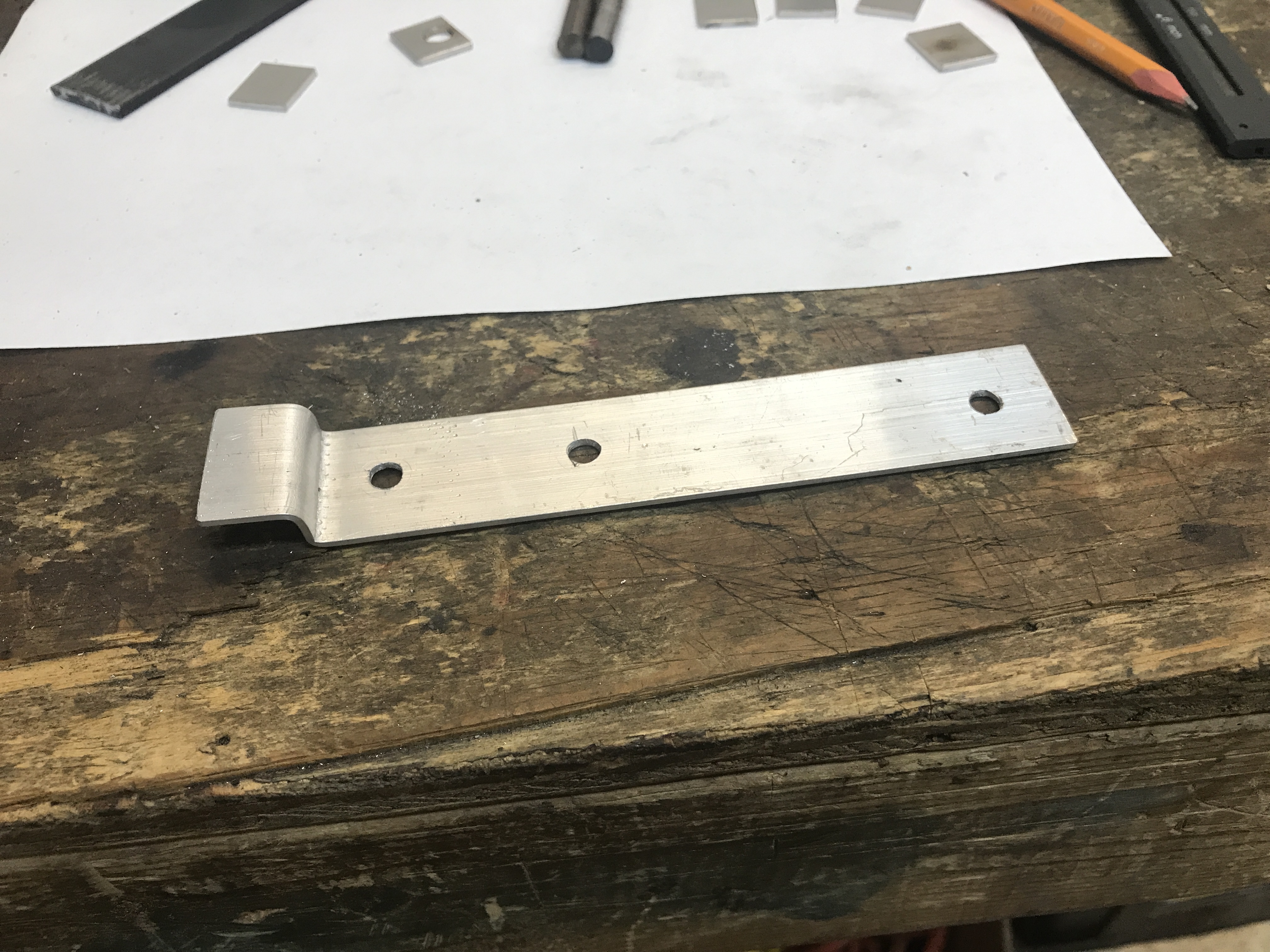

I used some thin aluminum bar stock, to save, you know, weight.

Here's the initial shape.
