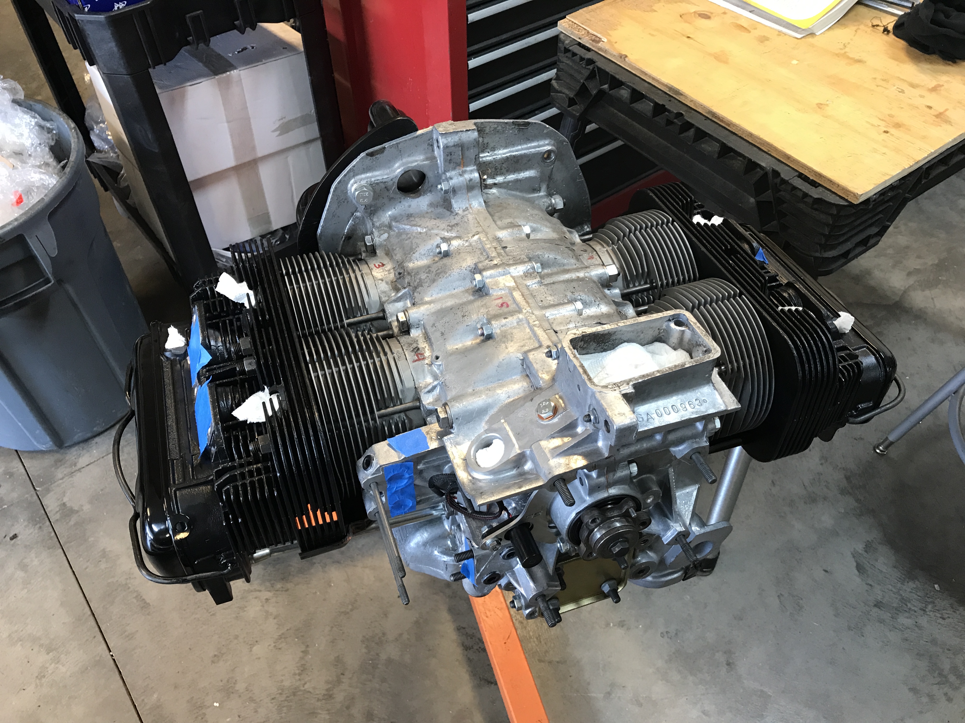

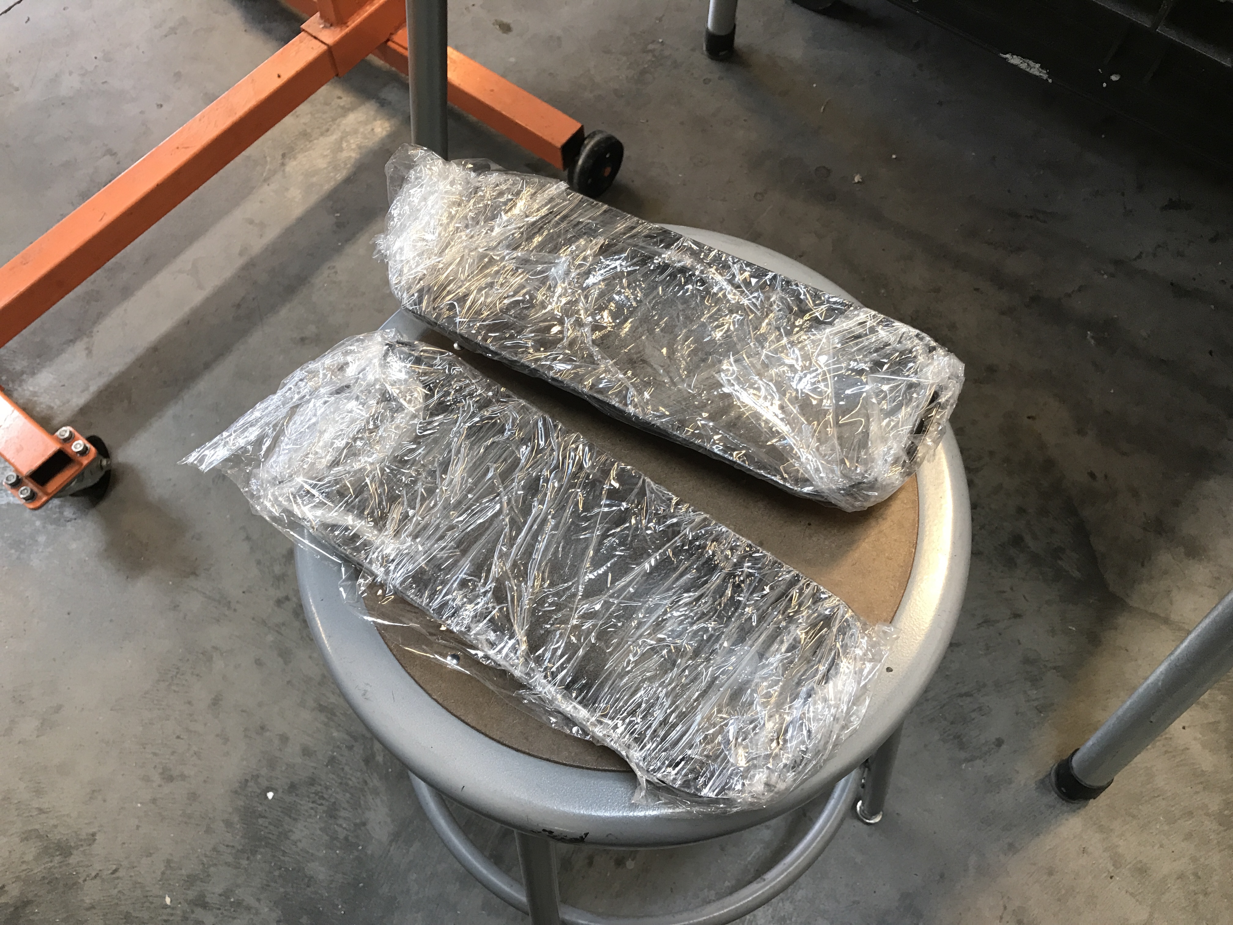

OK, finally--time to keep going on engine assembly.

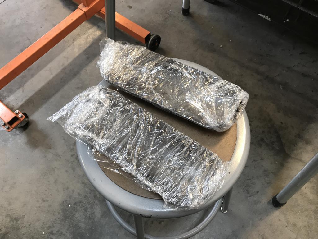

I reached into the powder coat part box, with everything still wrapped.

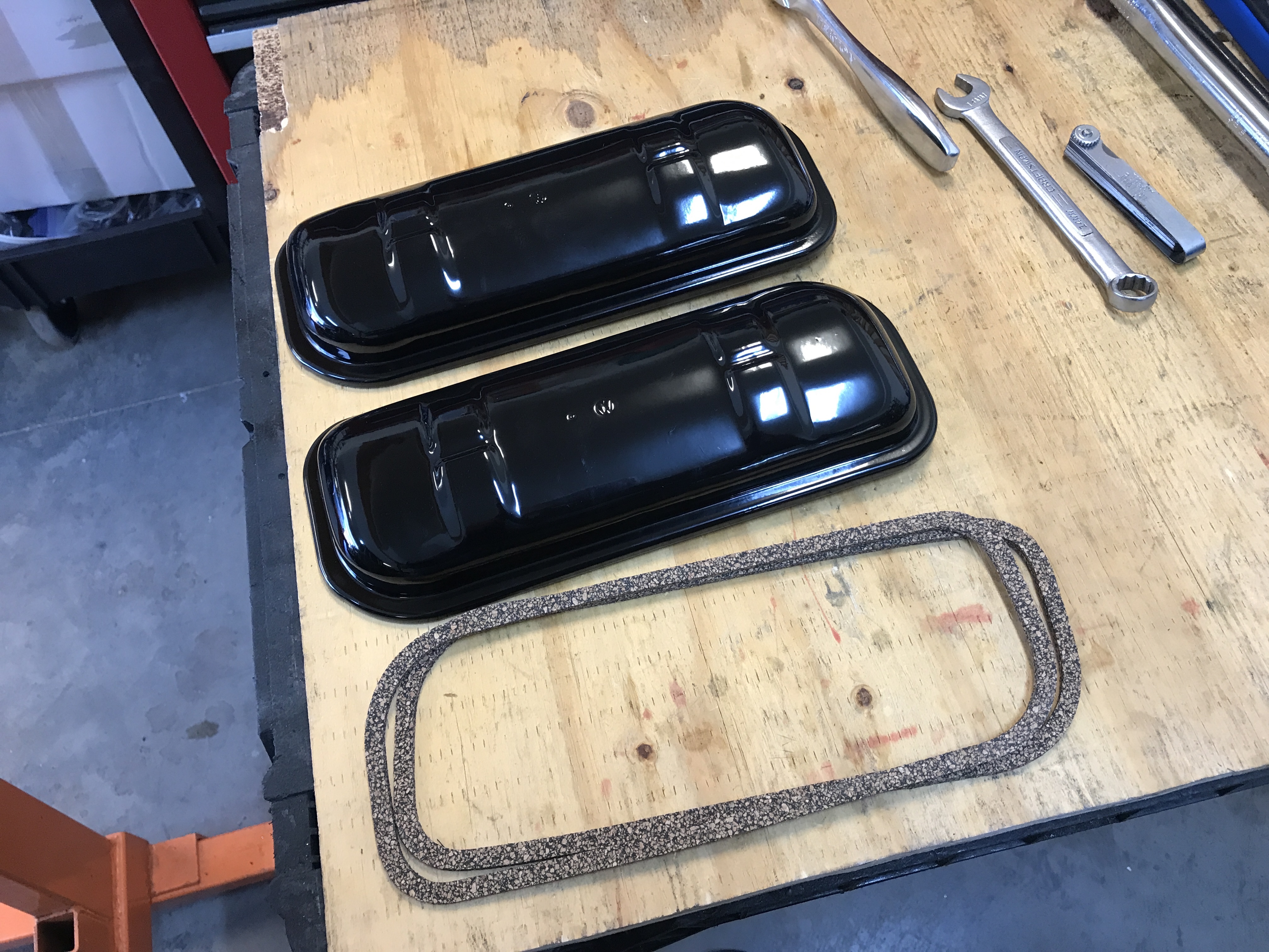

bkrantz
post Oct 11 2021, 07:25 PM
Post #3862
Posts: 8,800
Joined: 3-August 19
From: SW Colorado
Member No.: 23,343
Pretty valve covers and new gaskets.
bkrantz
post Oct 11 2021, 07:27 PM
Post #3863
Posts: 8,800
Joined: 3-August 19
From: SW Colorado
Member No.: 23,343
Valve covers in place--looks more complete!

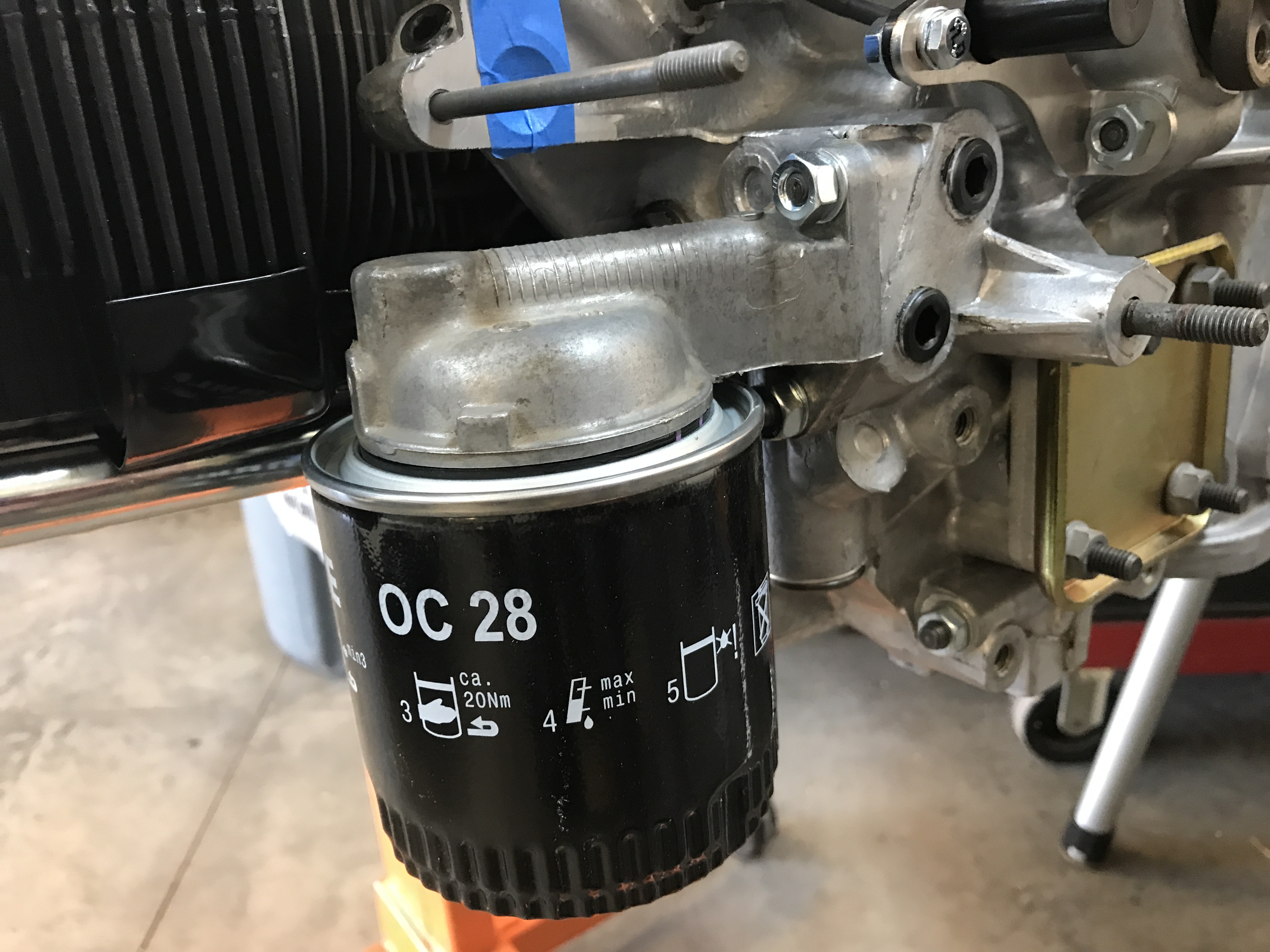

Oil filter mount and new filter. Gotta remember to fill this later when I get close to startup.

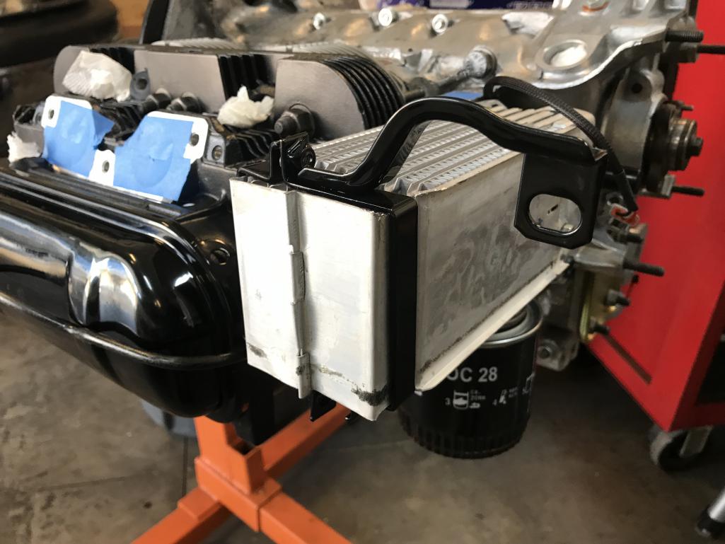

Then it was time for the oil cooler. I bought a new "Original Equipment" version from Pelican.

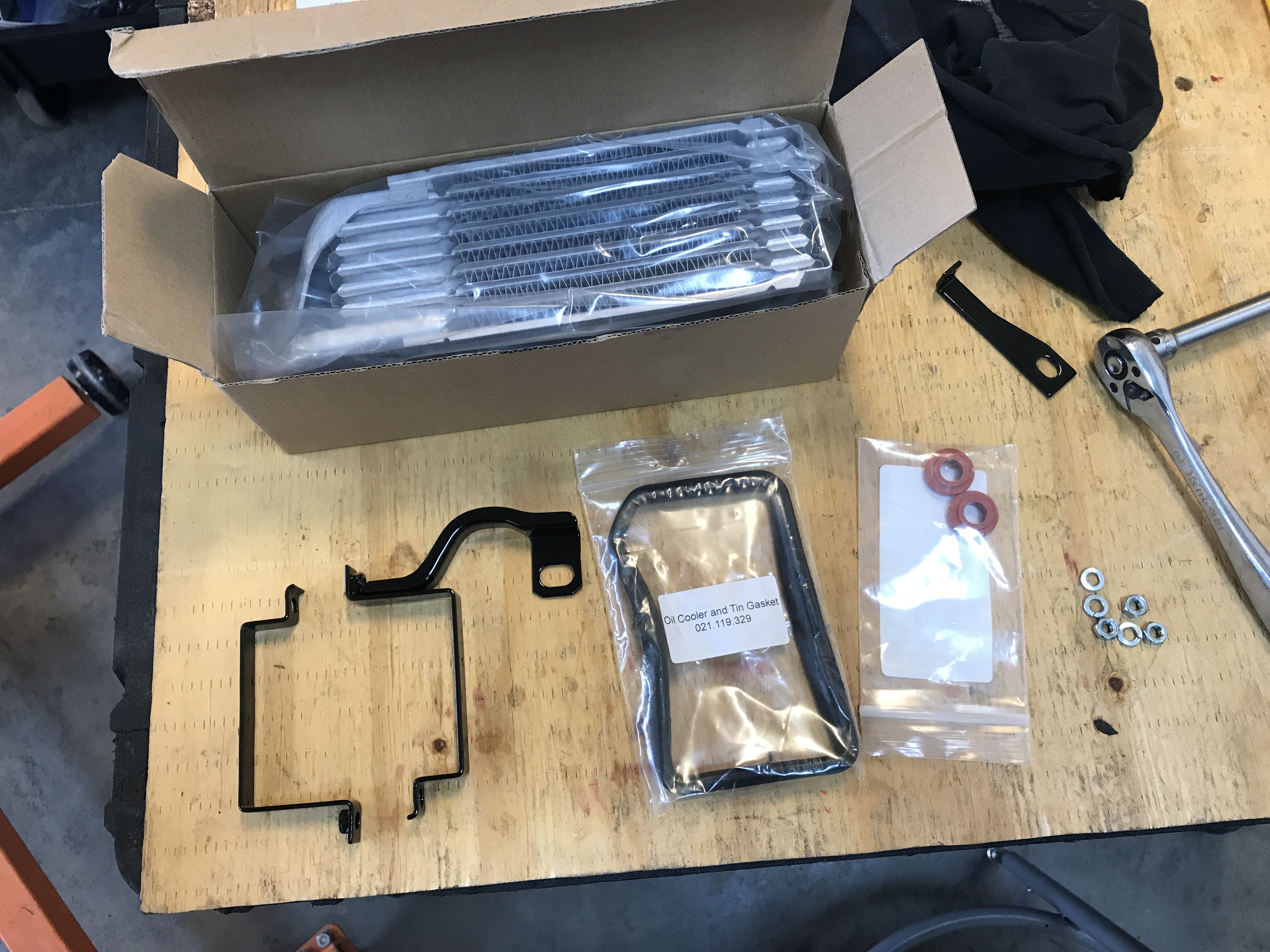

bkrantz
post Oct 11 2021, 07:34 PM
Post #3866
Posts: 8,800
Joined: 3-August 19
From: SW Colorado
Member No.: 23,343

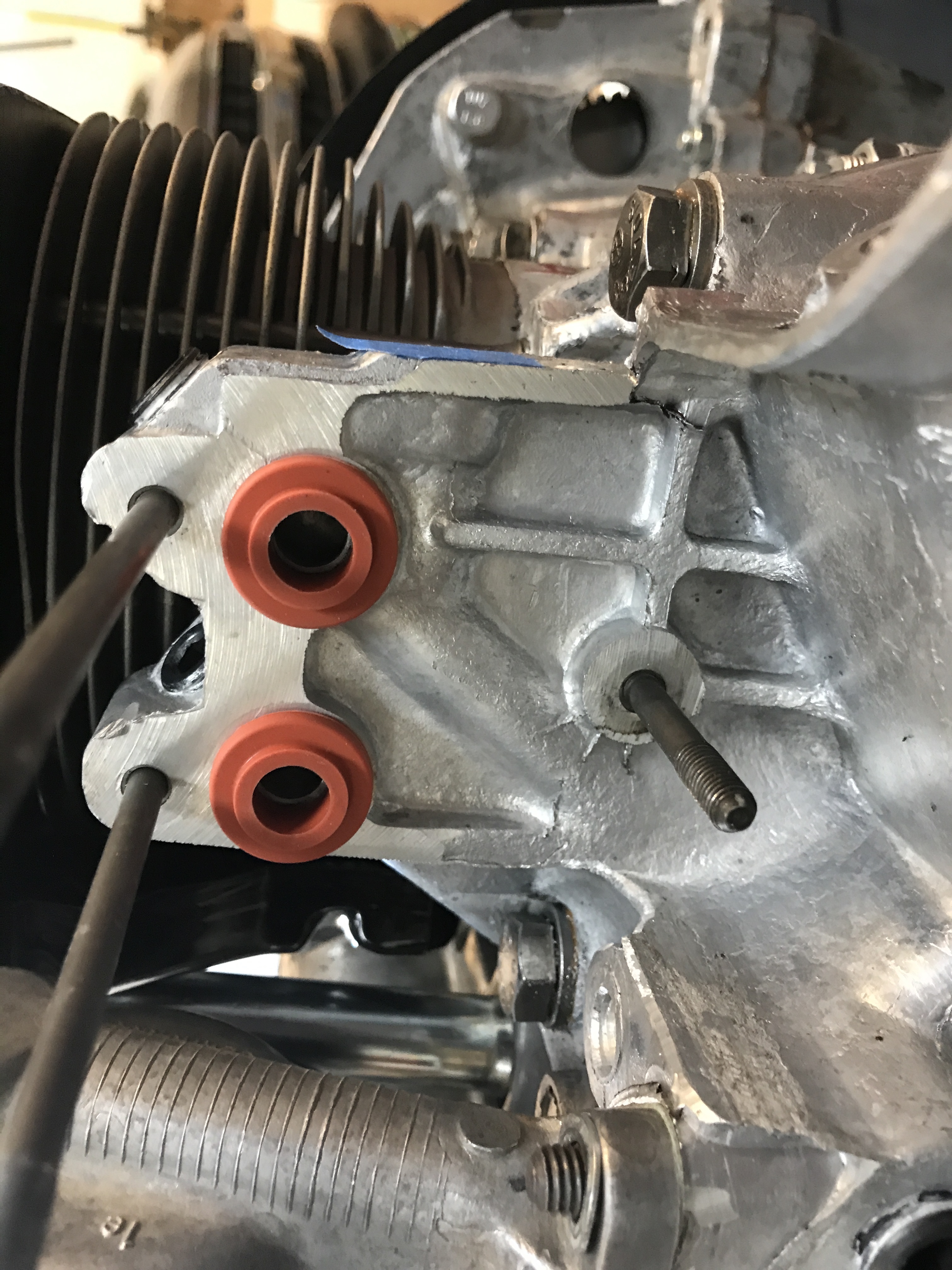

A test fit, and interference with the bracket for the EFI Hall sensor. So the sensor and bracket had to come off.

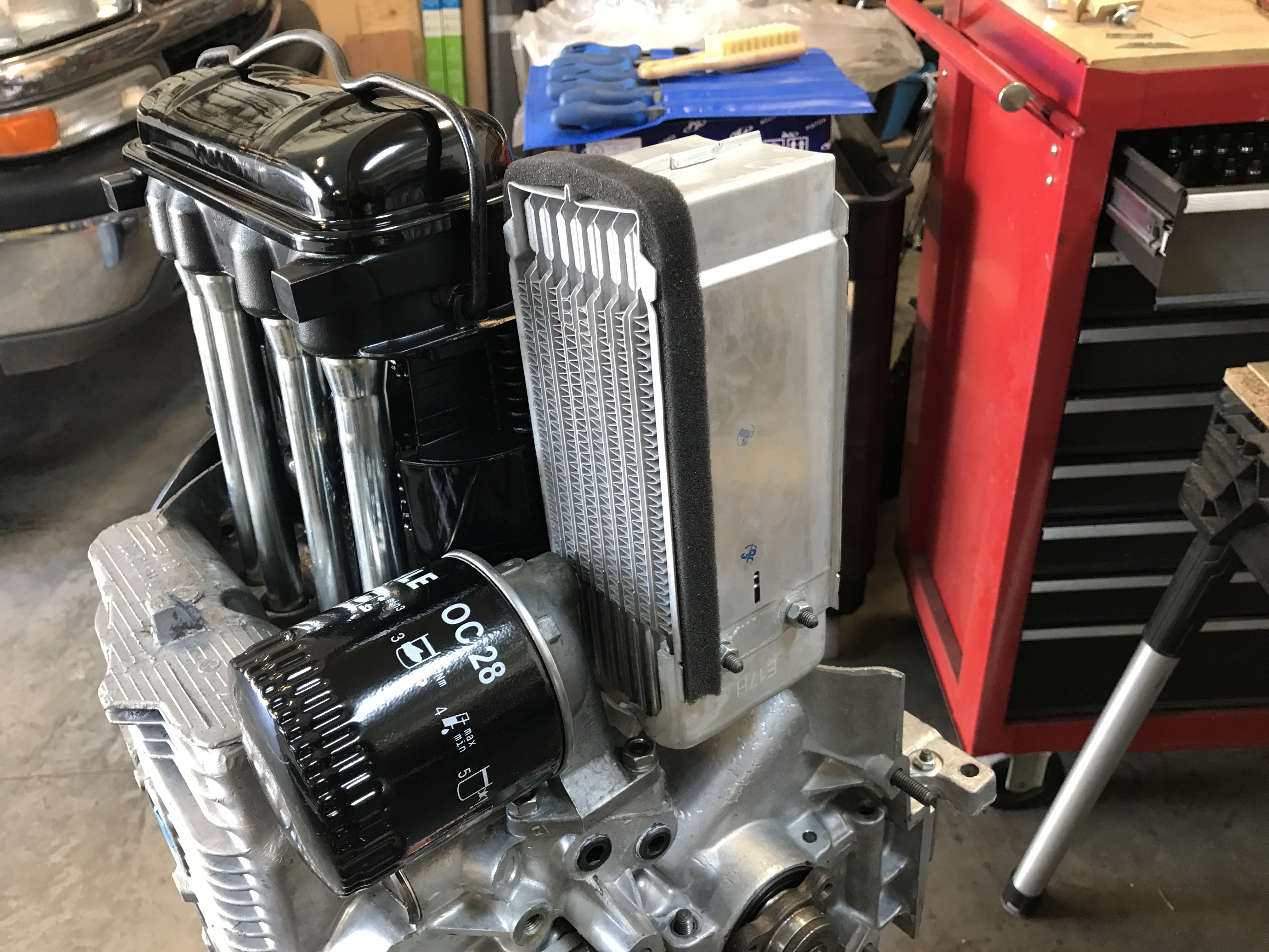

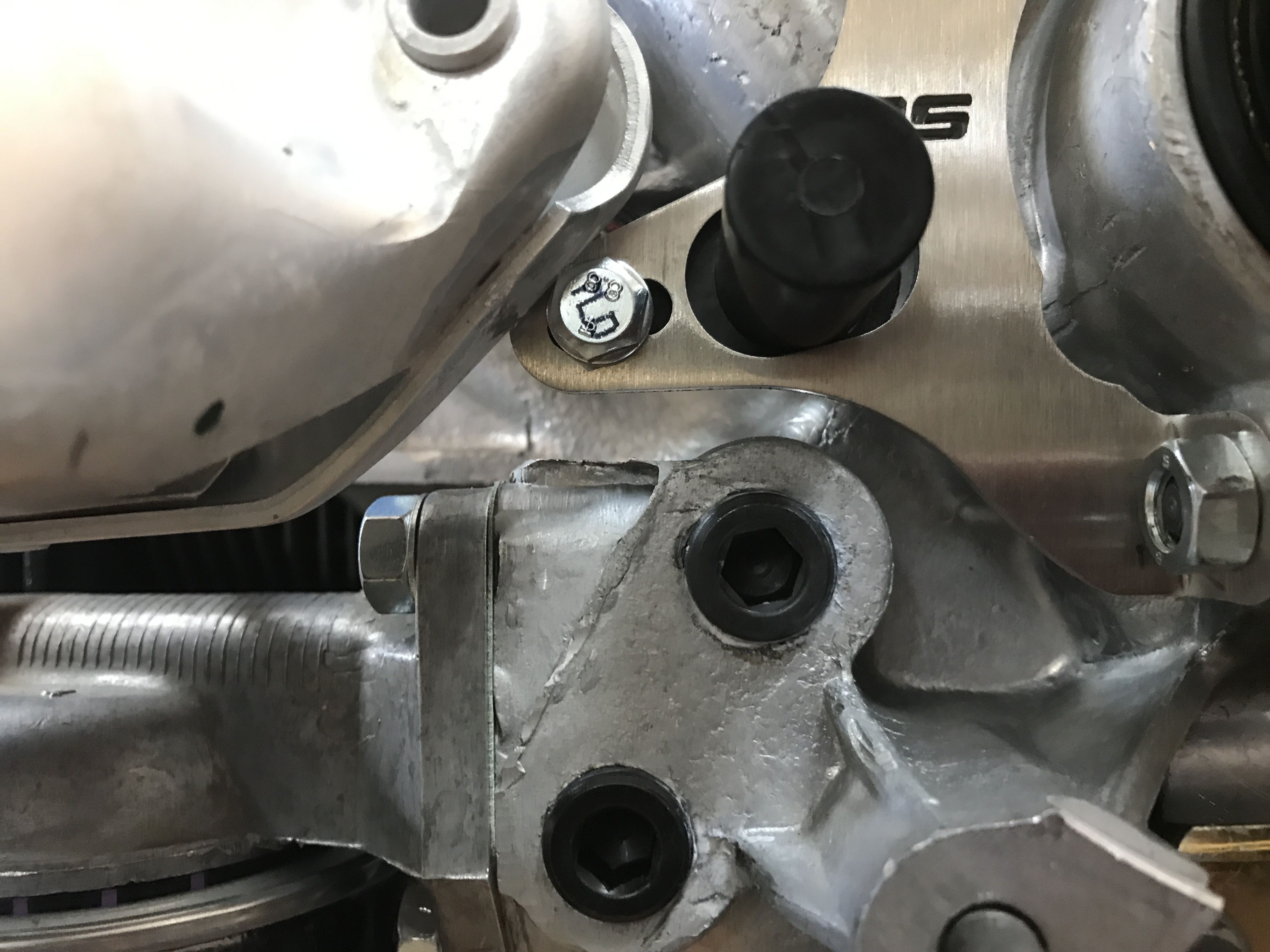

bkrantz
post Oct 11 2021, 07:37 PM
Post #3867
Posts: 8,800
Joined: 3-August 19
From: SW Colorado
Member No.: 23,343
I also found very minor interference with the upper nut on the oil filter mount. That led to a quick re-contouring of the cooler frame. It is all aluminum so pretty easy to adjust.

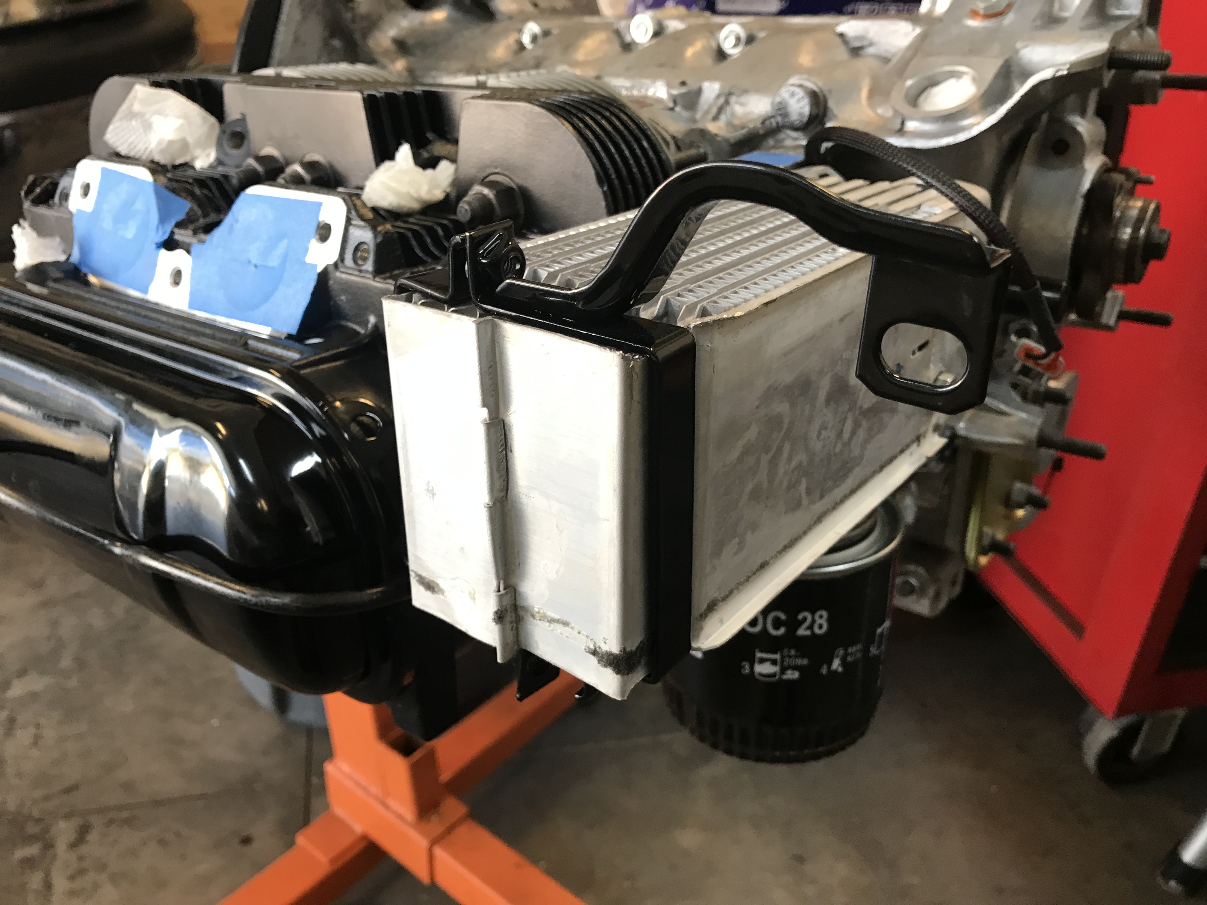

bkrantz
post Oct 11 2021, 07:42 PM
Post #3870
Posts: 8,800
Joined: 3-August 19
From: SW Colorado
Member No.: 23,343

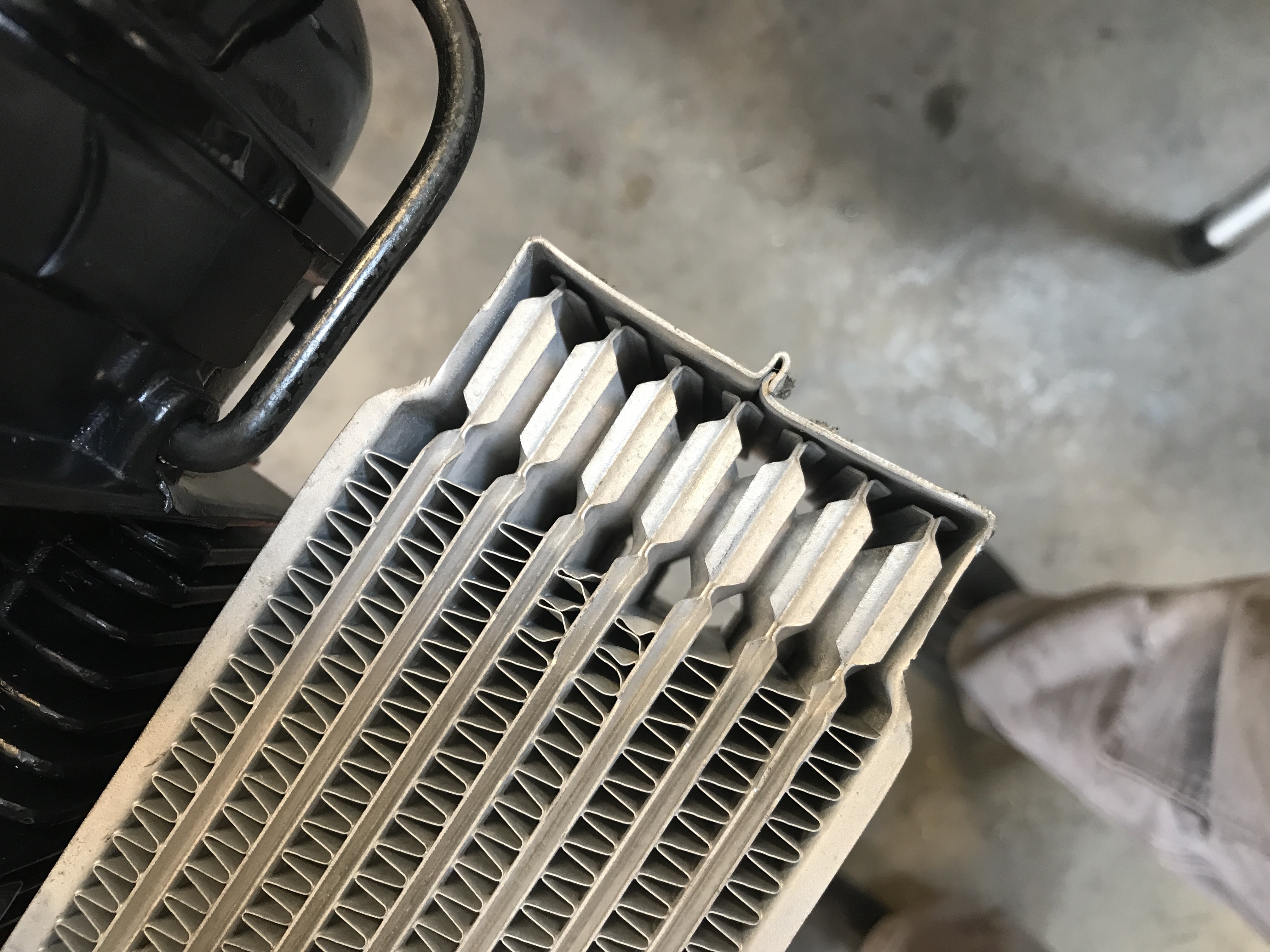

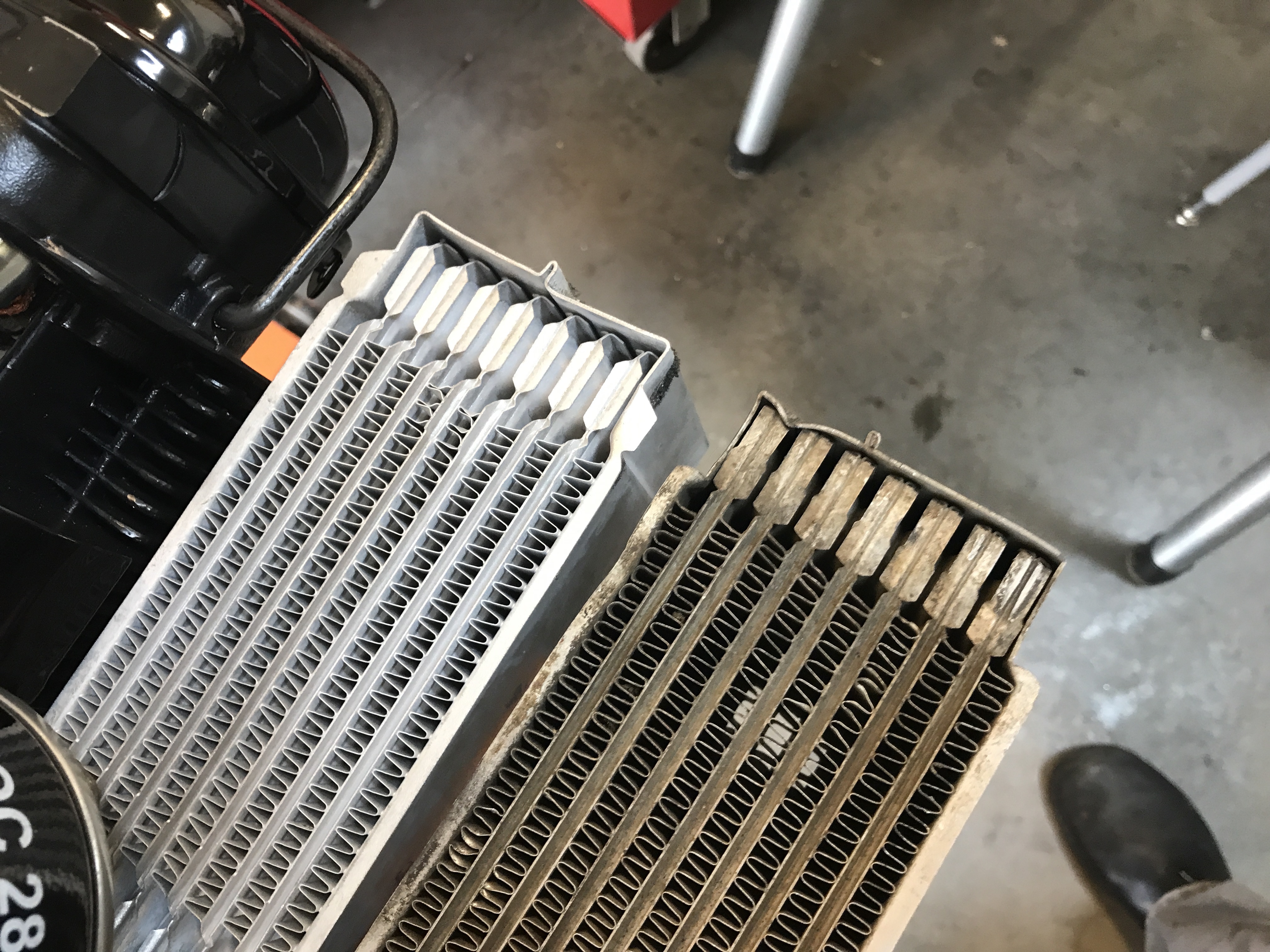

The replacement cooler has extended edges on the outer wall. Compare to the dirty original.

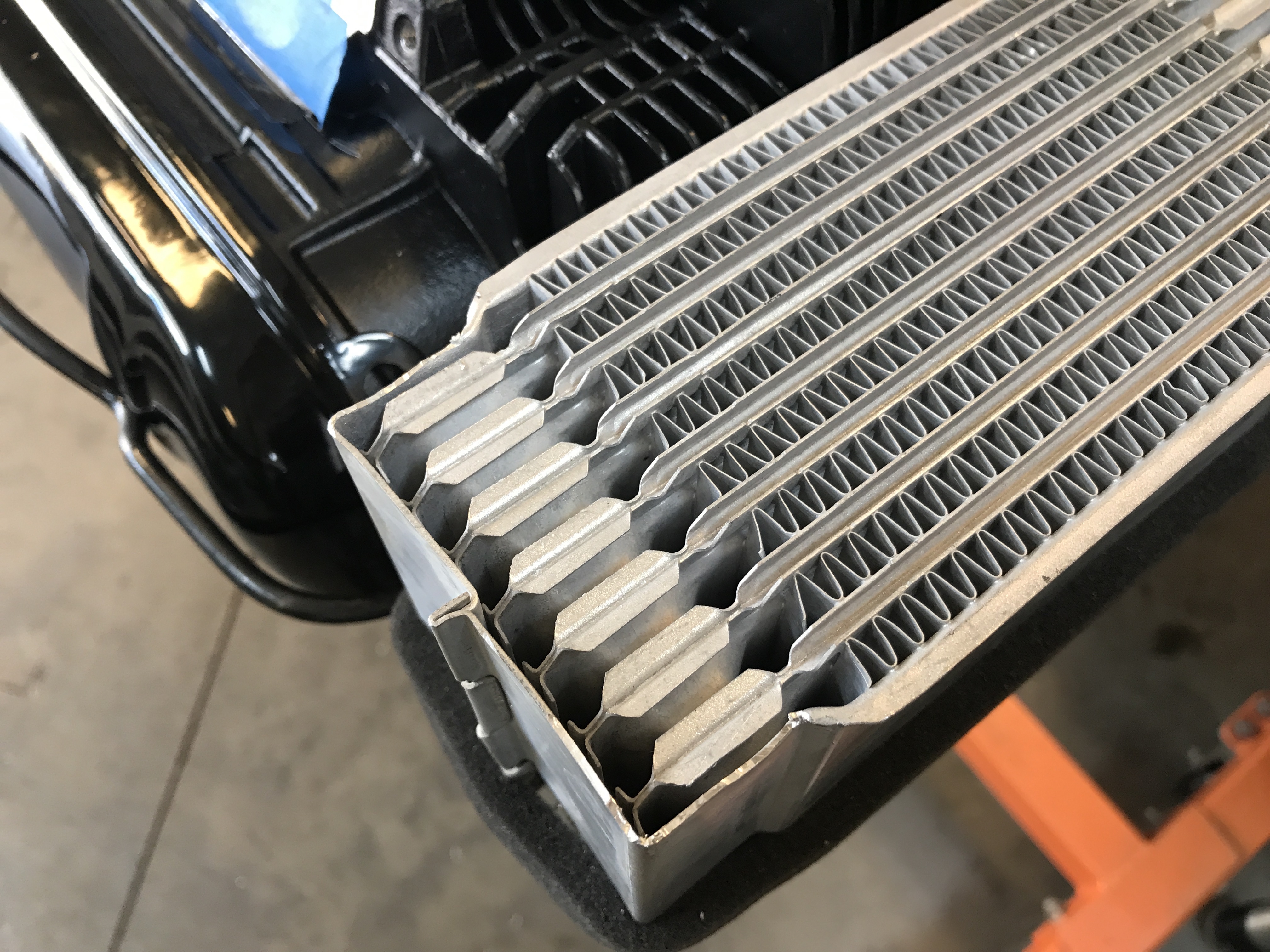

bkrantz
post Oct 11 2021, 07:44 PM
Post #3871
Posts: 8,800
Joined: 3-August 19
From: SW Colorado
Member No.: 23,343

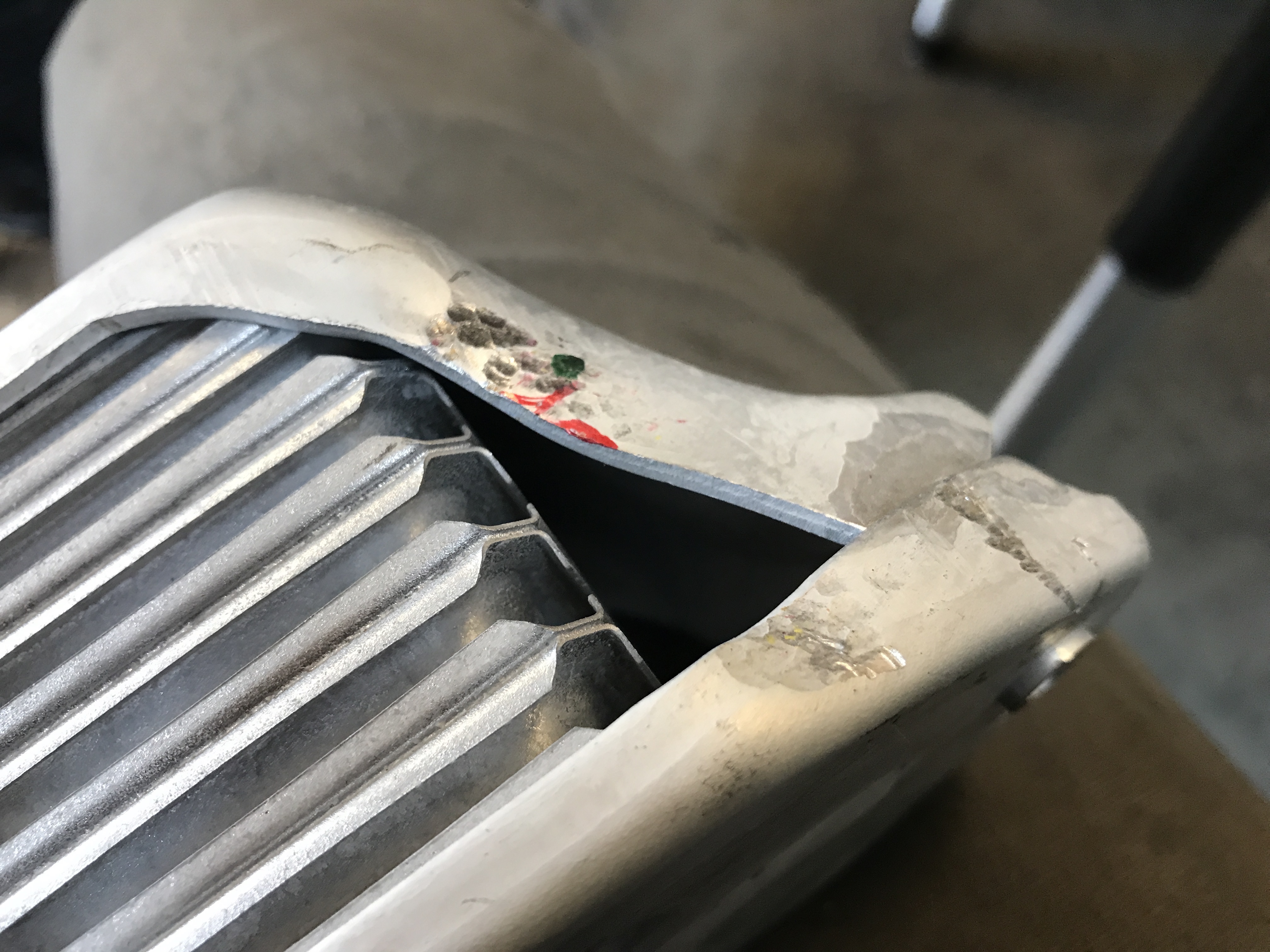

The wall is also aluminum, so pretty easy to trim with a new blade.
bkrantz
Post #3872
Posts: 8,800
Joined: 3-August 19
From: SW Colorado
Member No.: 23,343

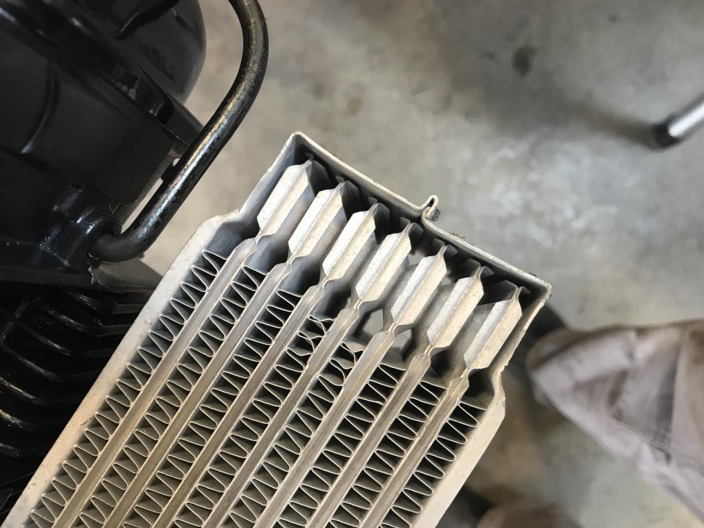

Same on the other side.
bkrantz
post Oct 11 2021, 07:46 PM
Post #3873
Posts: 8,800
Joined: 3-August 19
From: SW Colorado
Member No.: 23,343
Good clearance now for the bracket.

QUOTE(bkrantz @ Oct 11 2021, 09:29 PM) *
There's some debate about this. Jake Raby advises not to fill the filter first...so maybe one less thing to do (IMG:style_emoticons/default/wink.gif) Everything looks awesome, as usual!
http://www.914world.com/bbs2/index.php?sho...p;#entry1595700
bkrantz
post Oct 12 2021, 07:34 PM
Post #3875
Posts: 8,800
Joined: 3-August 19
From: SW Colorado
Member No.: 23,343
QUOTE(iankarr @ Oct 11 2021, 08:10 PM) *
Thanks Ian. And interesting info on pre-filling the filter.

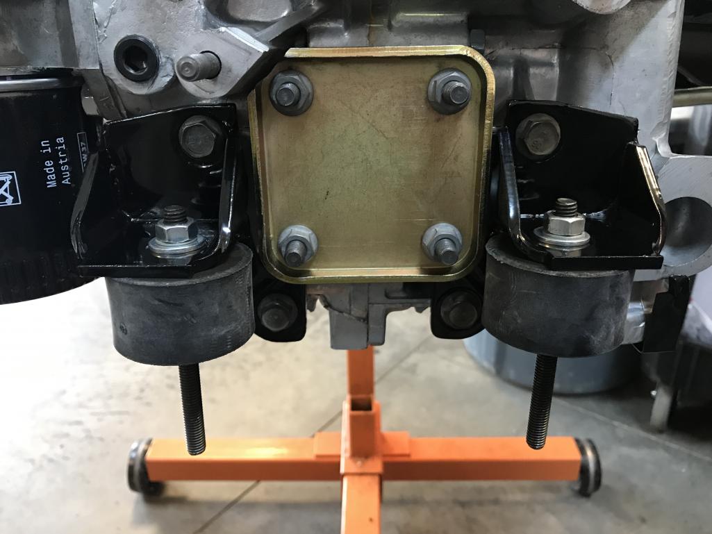

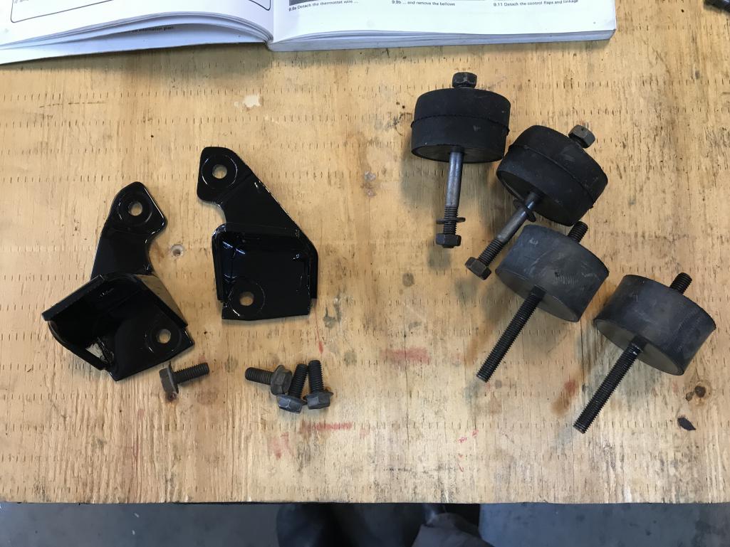

bkrantz
post Oct 12 2021, 07:36 PM
Post #3876
Posts: 8,800
Joined: 3-August 19
From: SW Colorado
Member No.: 23,343

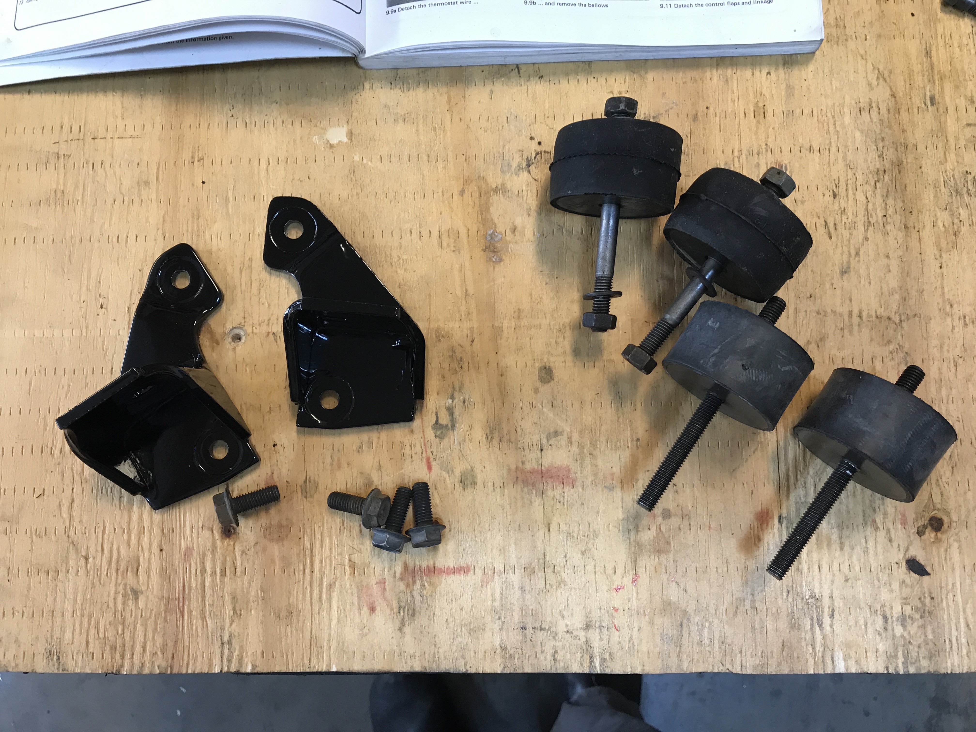

Next, the engine mount brackets and bushings.

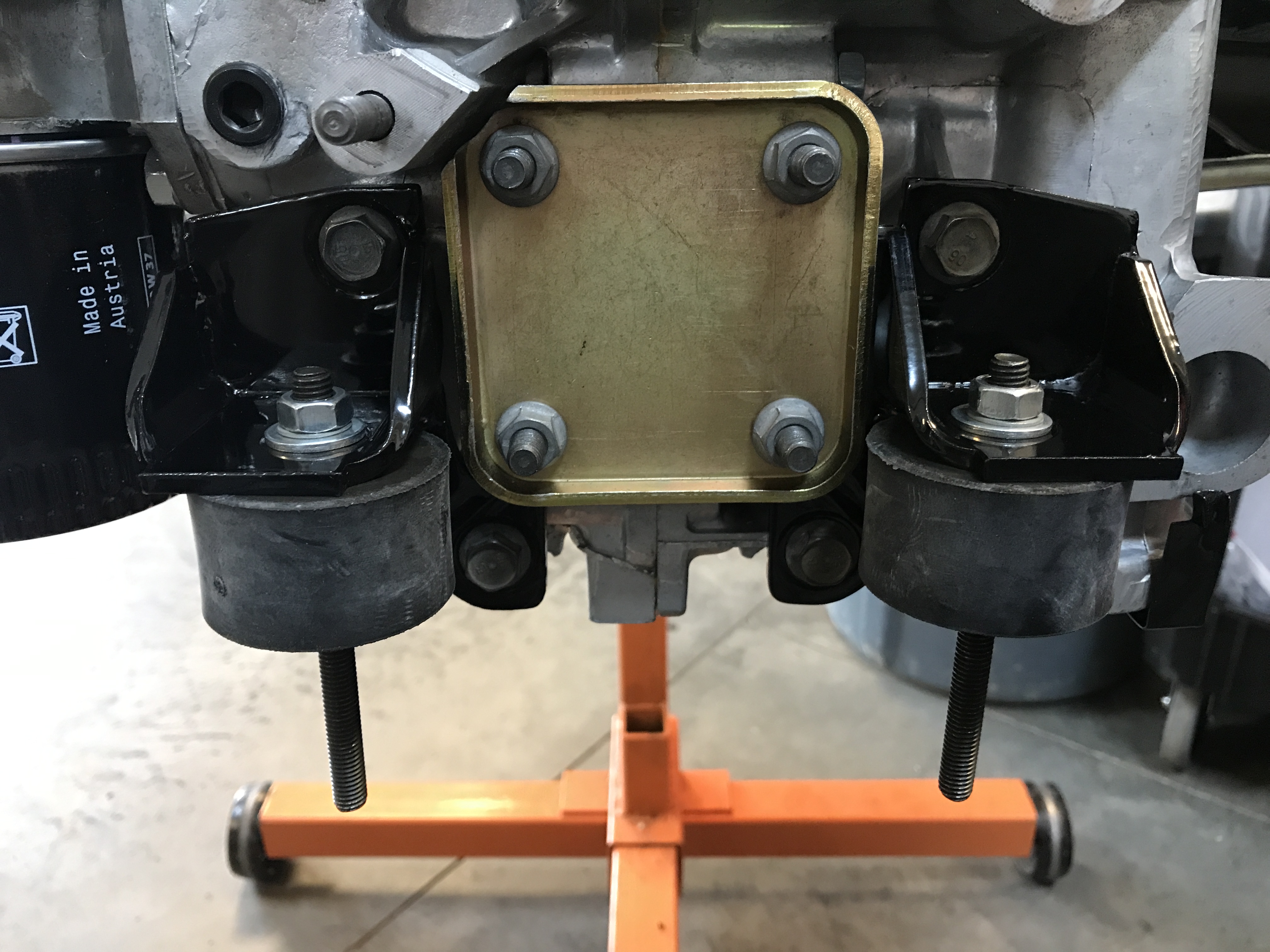

bkrantz
post Oct 12 2021, 07:37 PM
Post #3877
Posts: 8,800
Joined: 3-August 19
From: SW Colorado
Member No.: 23,343
Done.

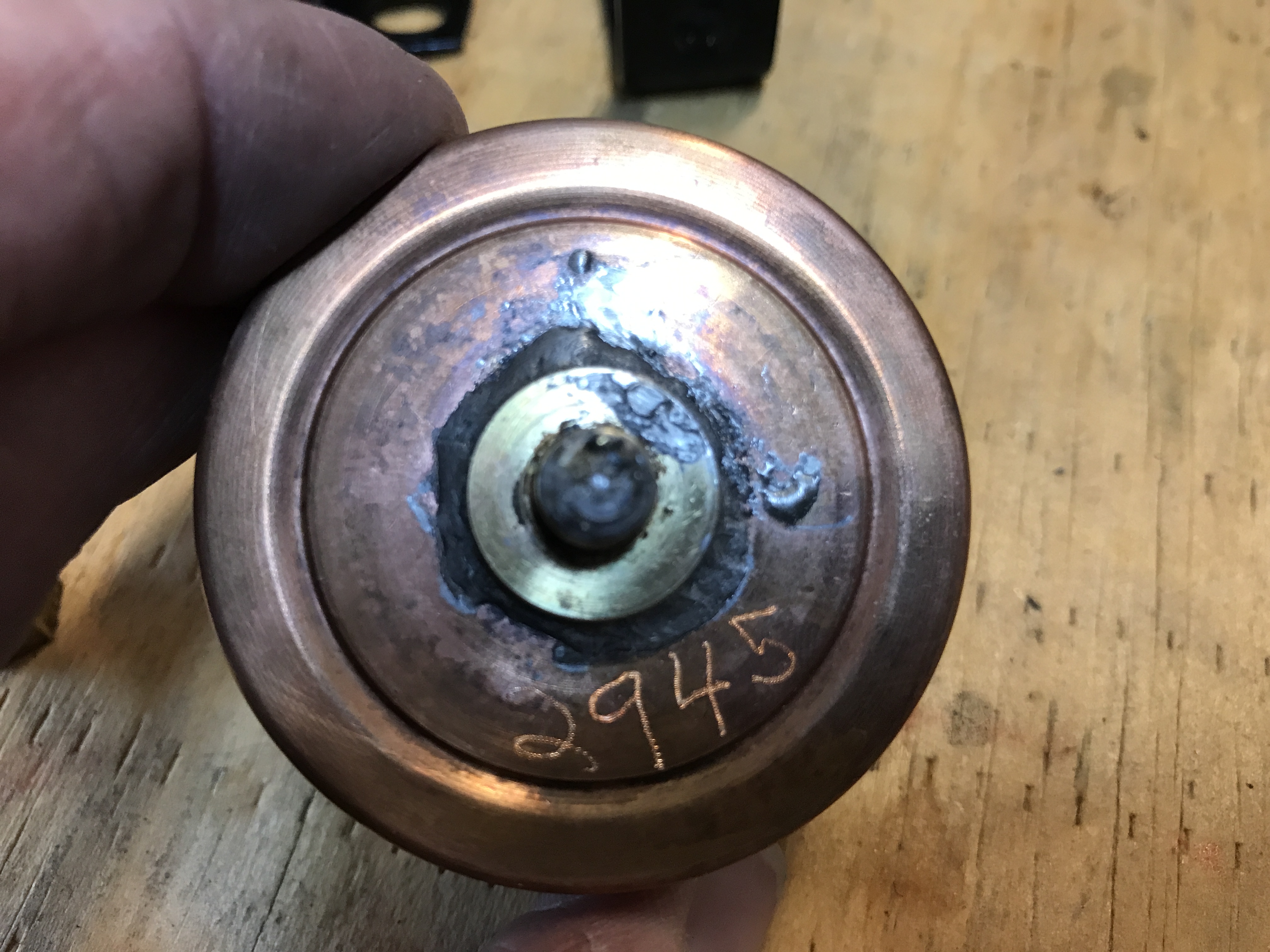

bkrantz
post Oct 12 2021, 07:39 PM
Post #3878
Posts: 8,800
Joined: 3-August 19
From: SW Colorado
Member No.: 23,343

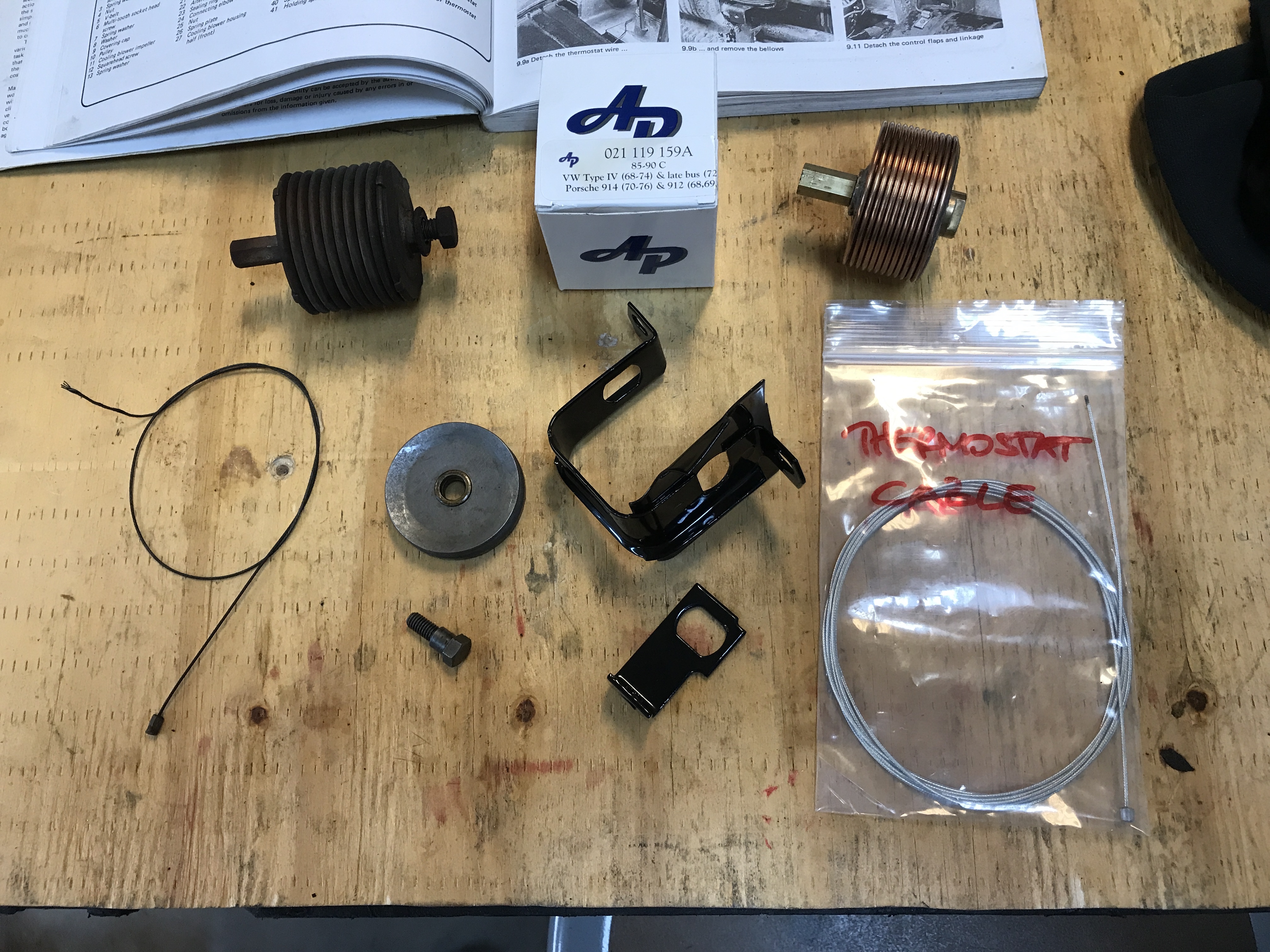

Then the thermostat. Here are the old and new parts.

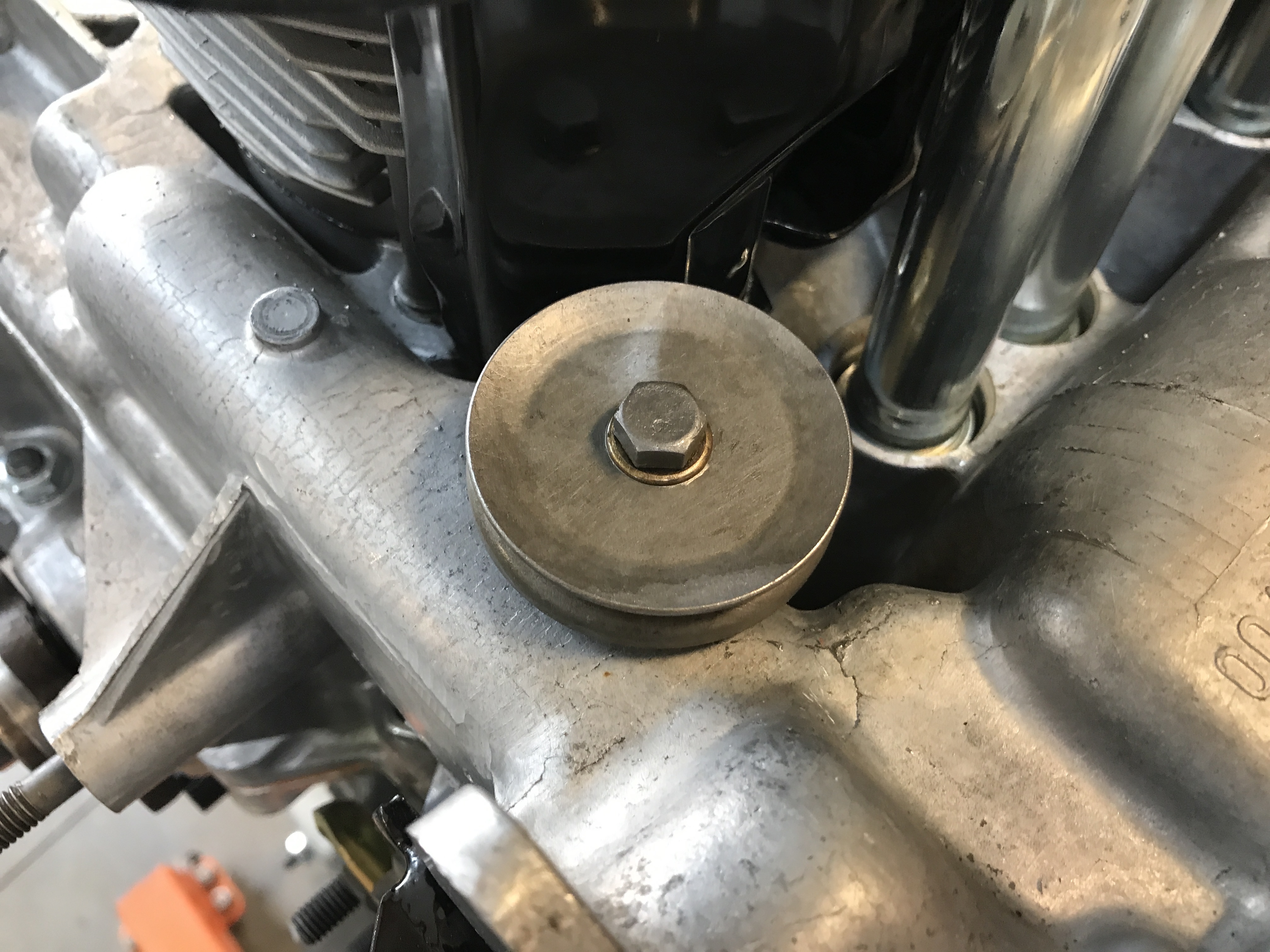

bkrantz
post Oct 12 2021, 07:40 PM
Post #3879
Posts: 8,800
Joined: 3-August 19
From: SW Colorado
Member No.: 23,343
I installed the pulley and mounting bolt with some teflon dry lube.
bkrantz
post Oct 12 2021, 07:48 PM
Post #3880
Posts: 8,800
Joined: 3-August 19
From: SW Colorado
Member No.: 23,343
New thermostat. I hope this is not the operating temp.
