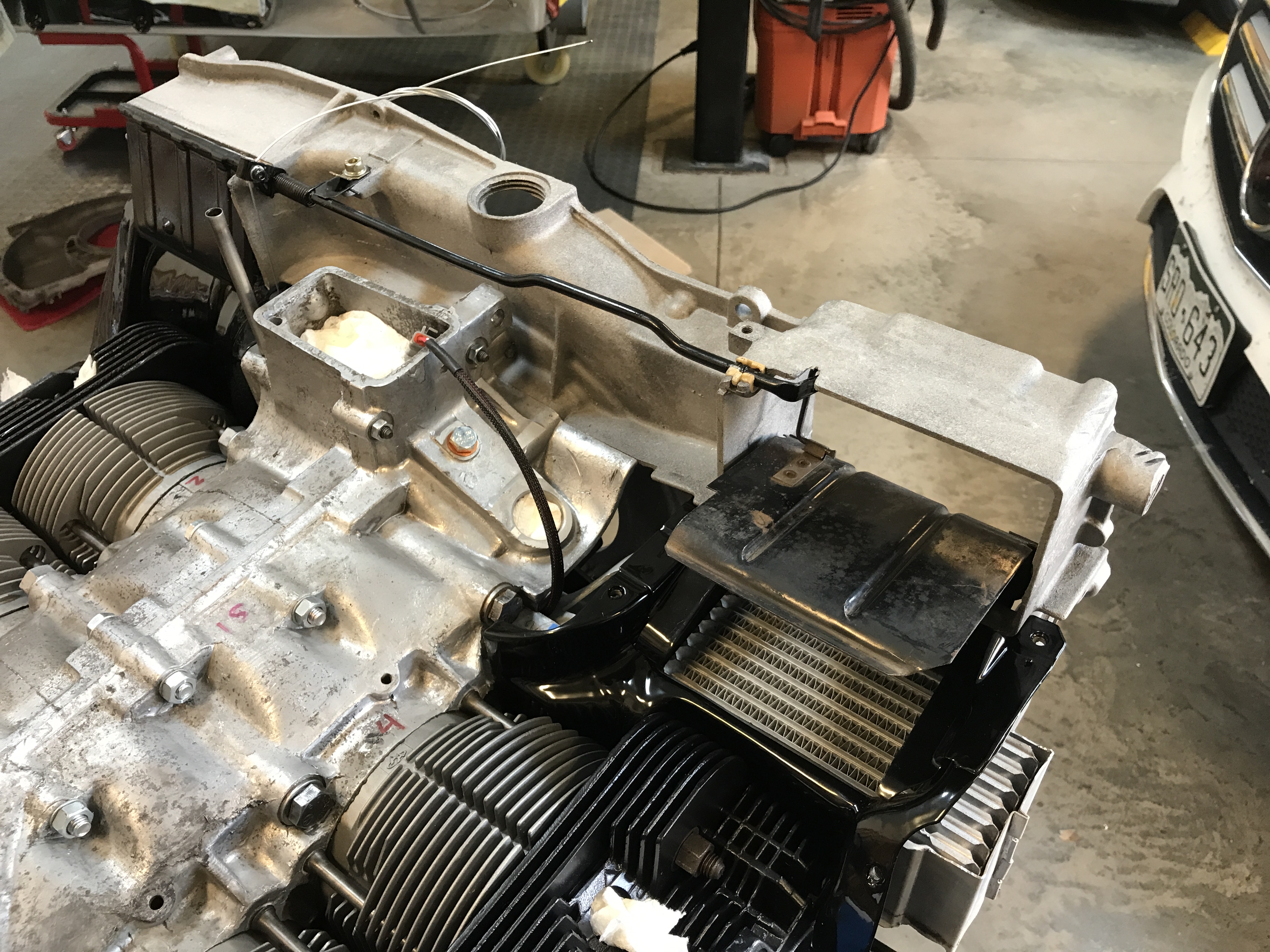

Flaps correct for cold engine.

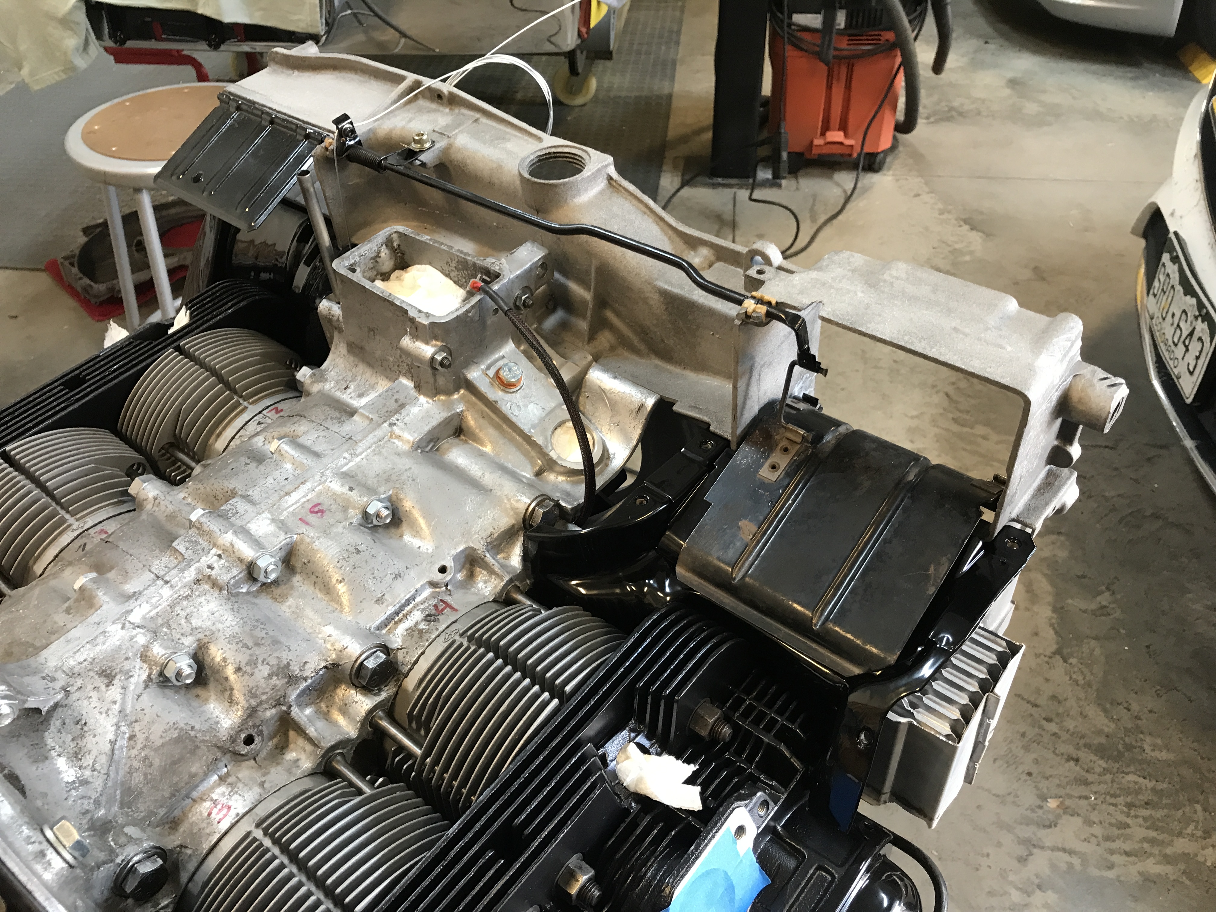

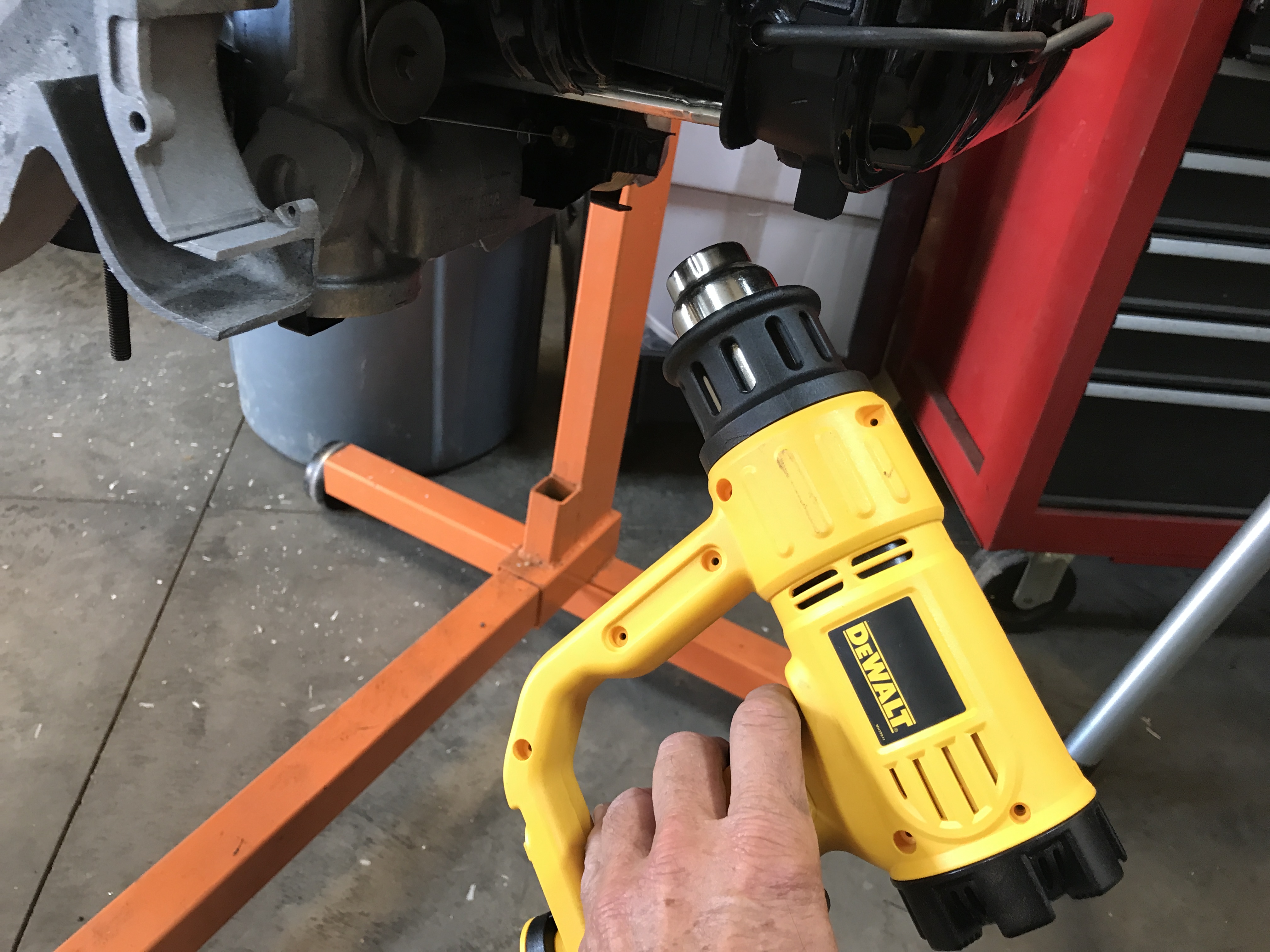

Just for fun, I hit the thermostat with a heat gun.
bkrantz
post Oct 24 2021, 07:18 PM
Post #3963
Posts: 8,530
Joined: 3-August 19
From: SW Colorado
Member No.: 23,343
Flaps now correct for a hot engine.

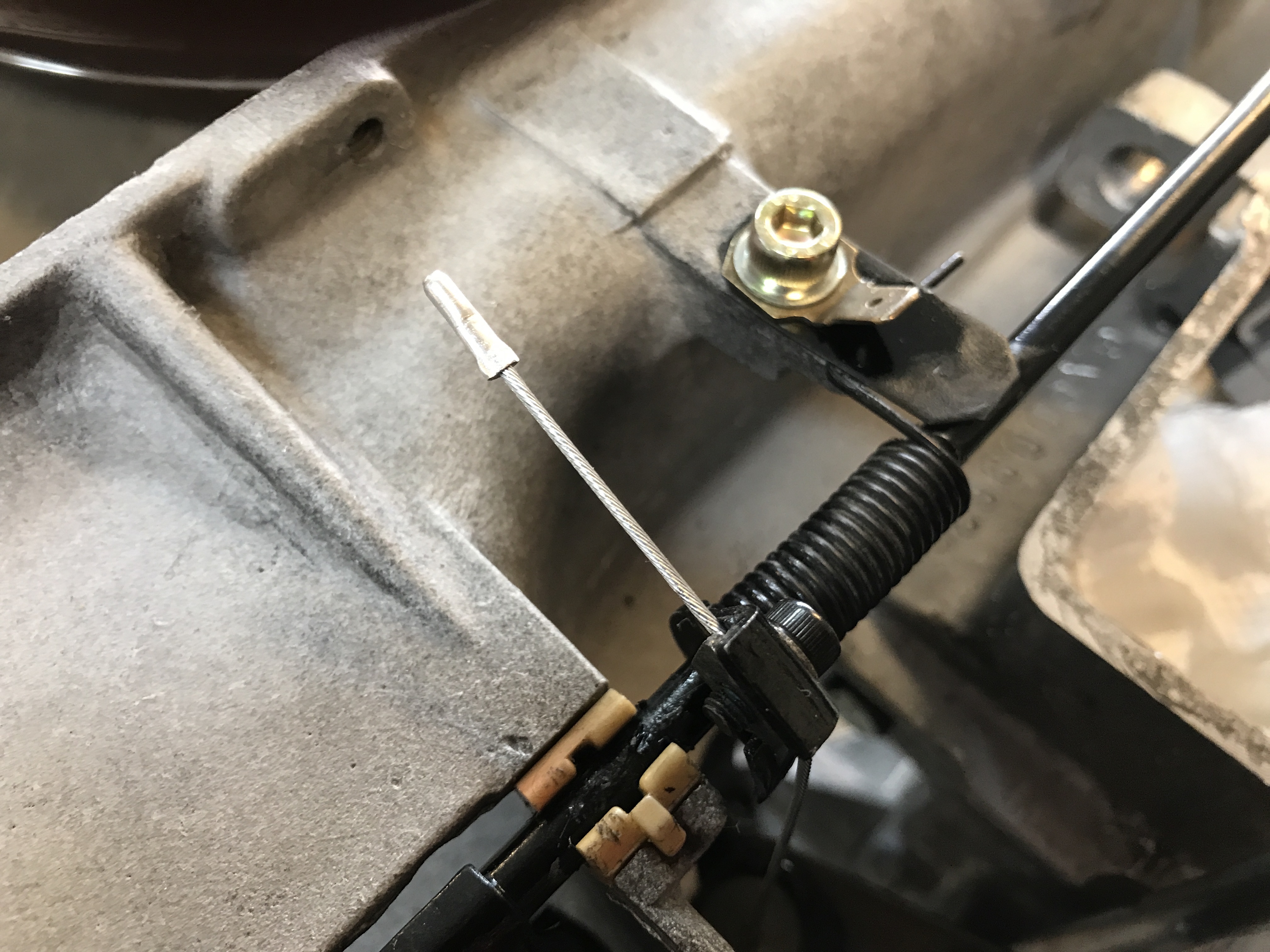

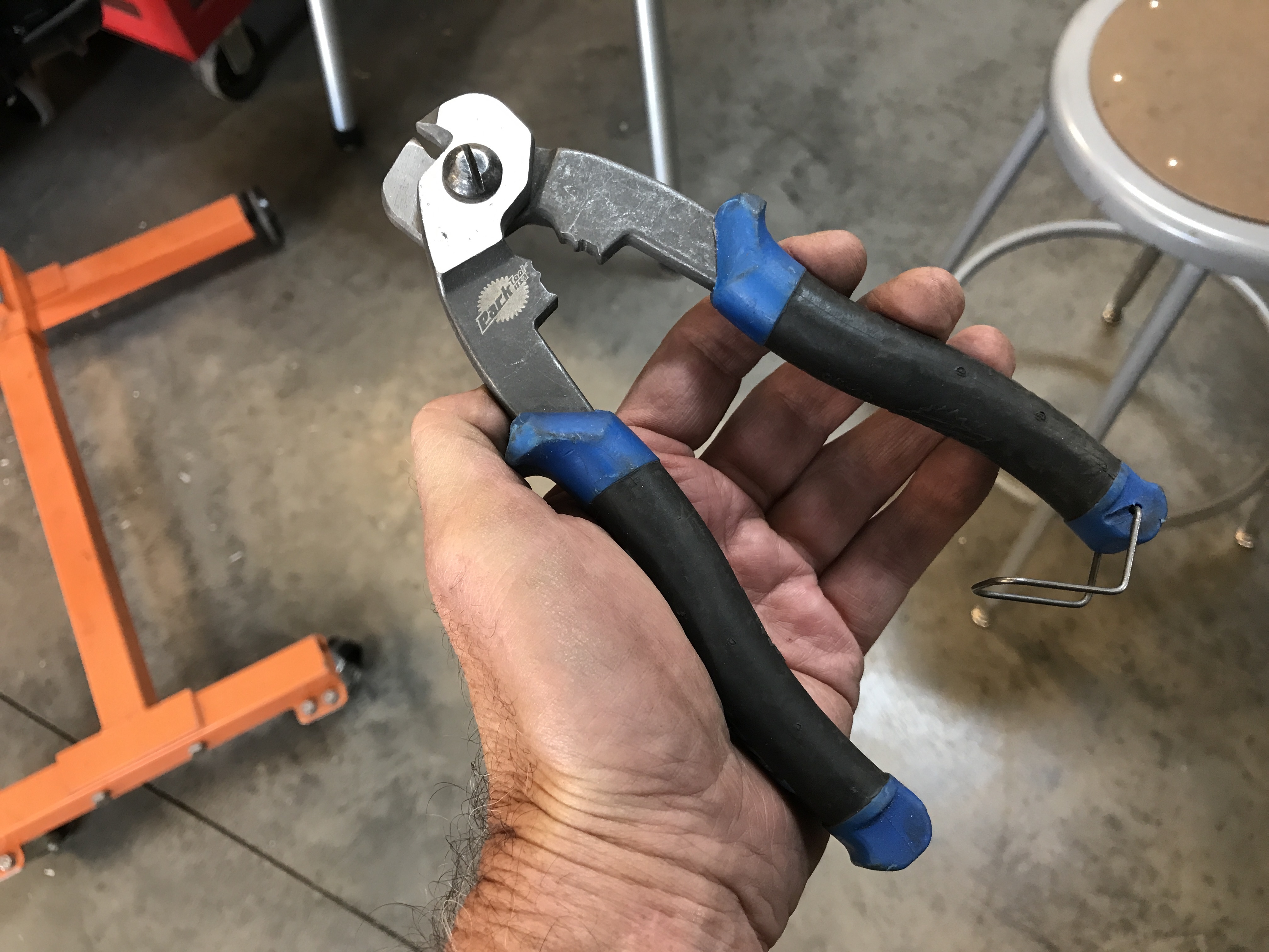

Since the thermostat cable looks just like a bike shifter cable, I got out my bike cable shears.
bkrantz
post Oct 24 2021, 07:22 PM
Post #3965
Posts: 8,530
Joined: 3-August 19
From: SW Colorado
Member No.: 23,343

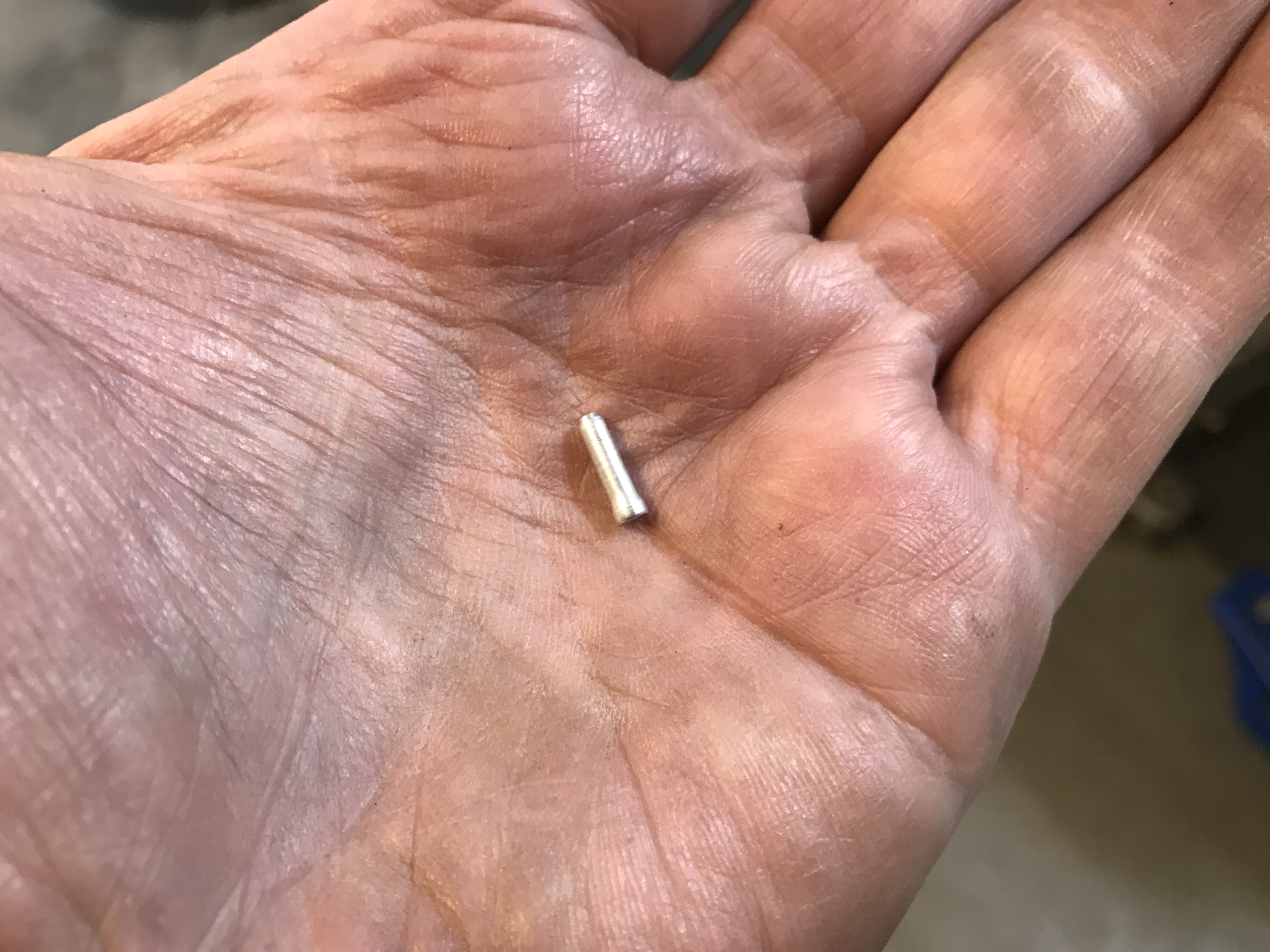

Then a bike cable end cap.
bkrantz
post Oct 24 2021, 07:23 PM
Post #3966
Posts: 8,530
Joined: 3-August 19
From: SW Colorado
Member No.: 23,343
Should be all set.

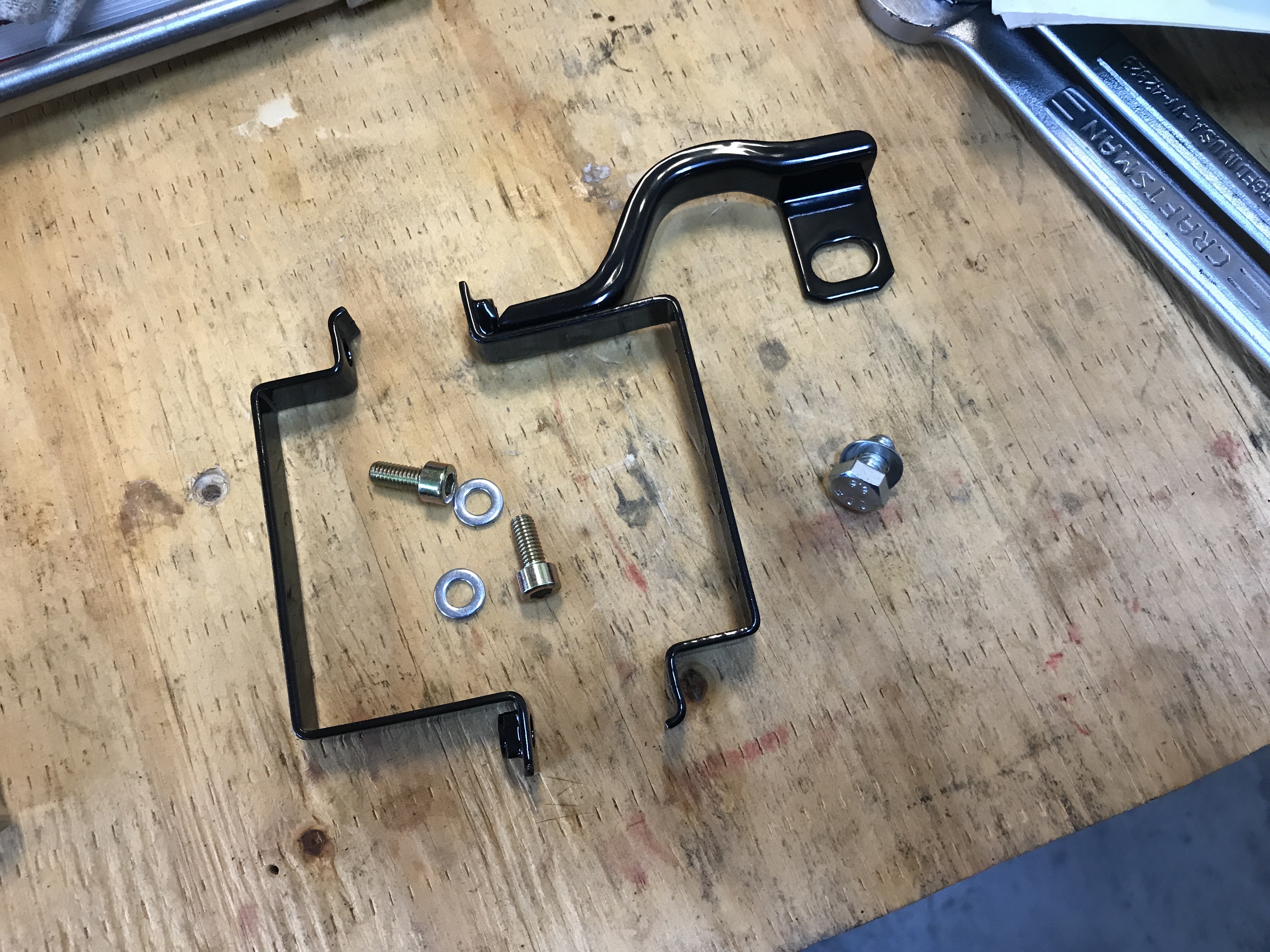

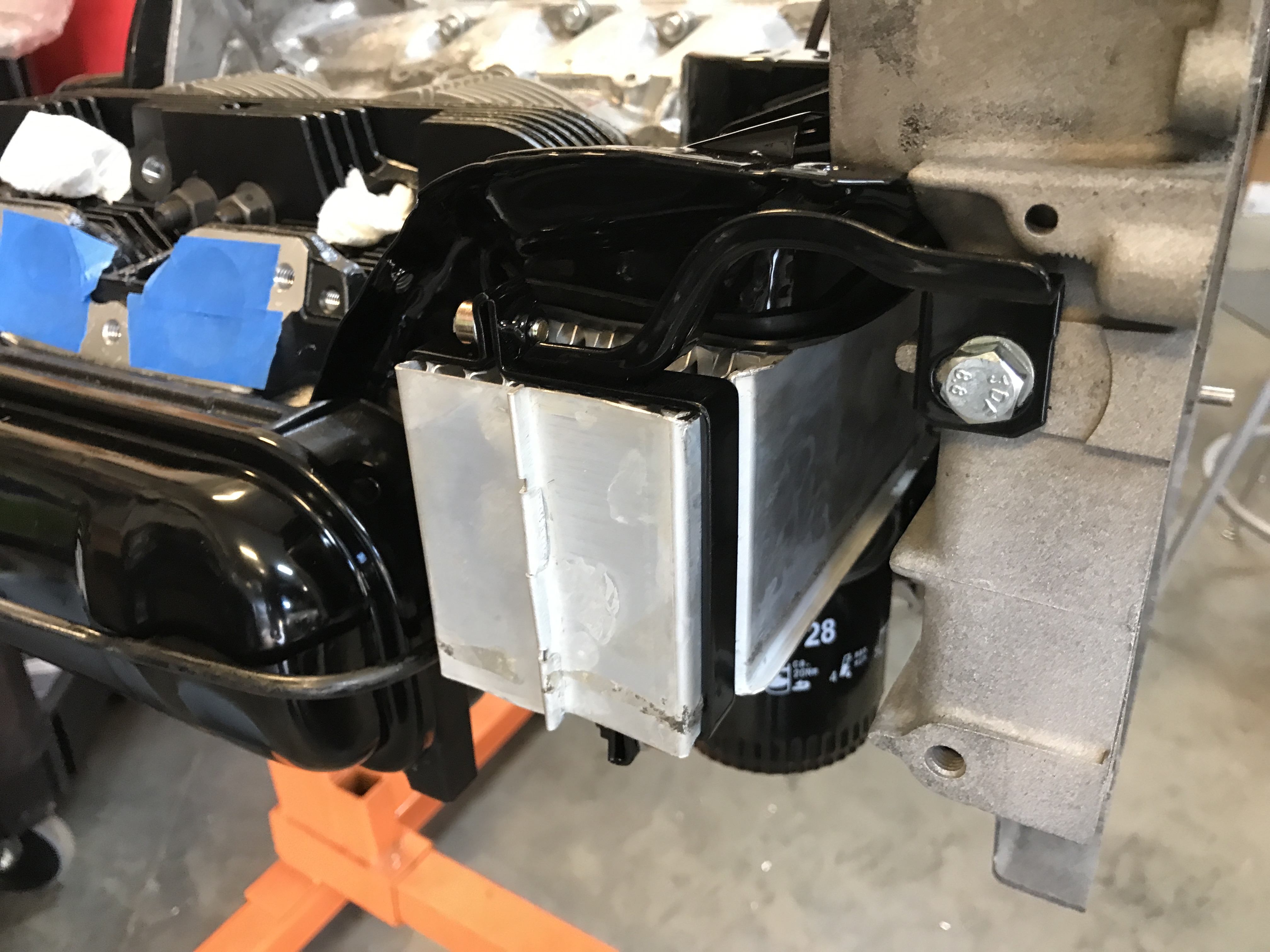

With the rear housing half mounted, I got the oil cooler bracket.
bkrantz
post Oct 24 2021, 07:24 PM
Post #3968
Posts: 8,530
Joined: 3-August 19
From: SW Colorado
Member No.: 23,343
Installed.

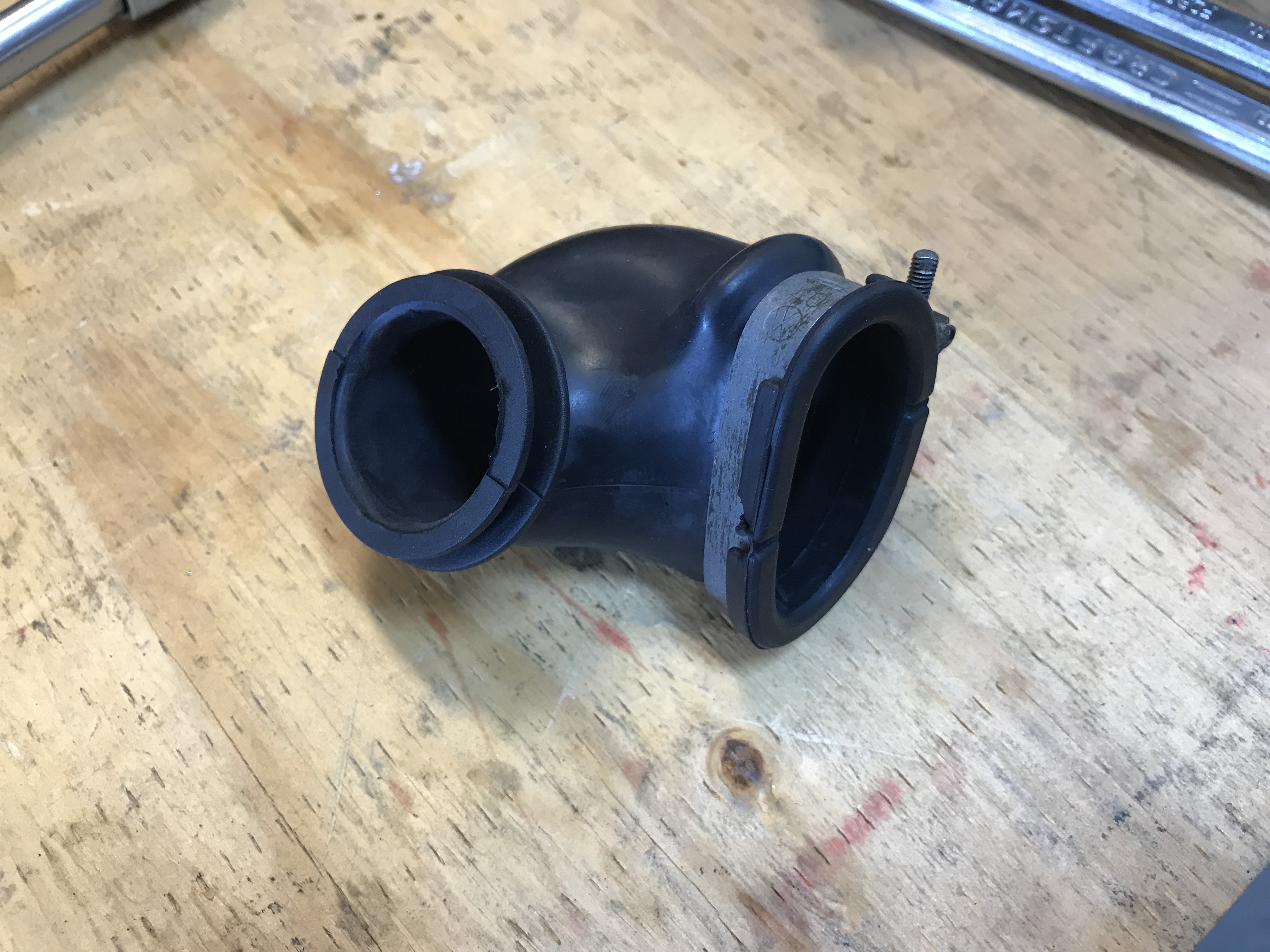

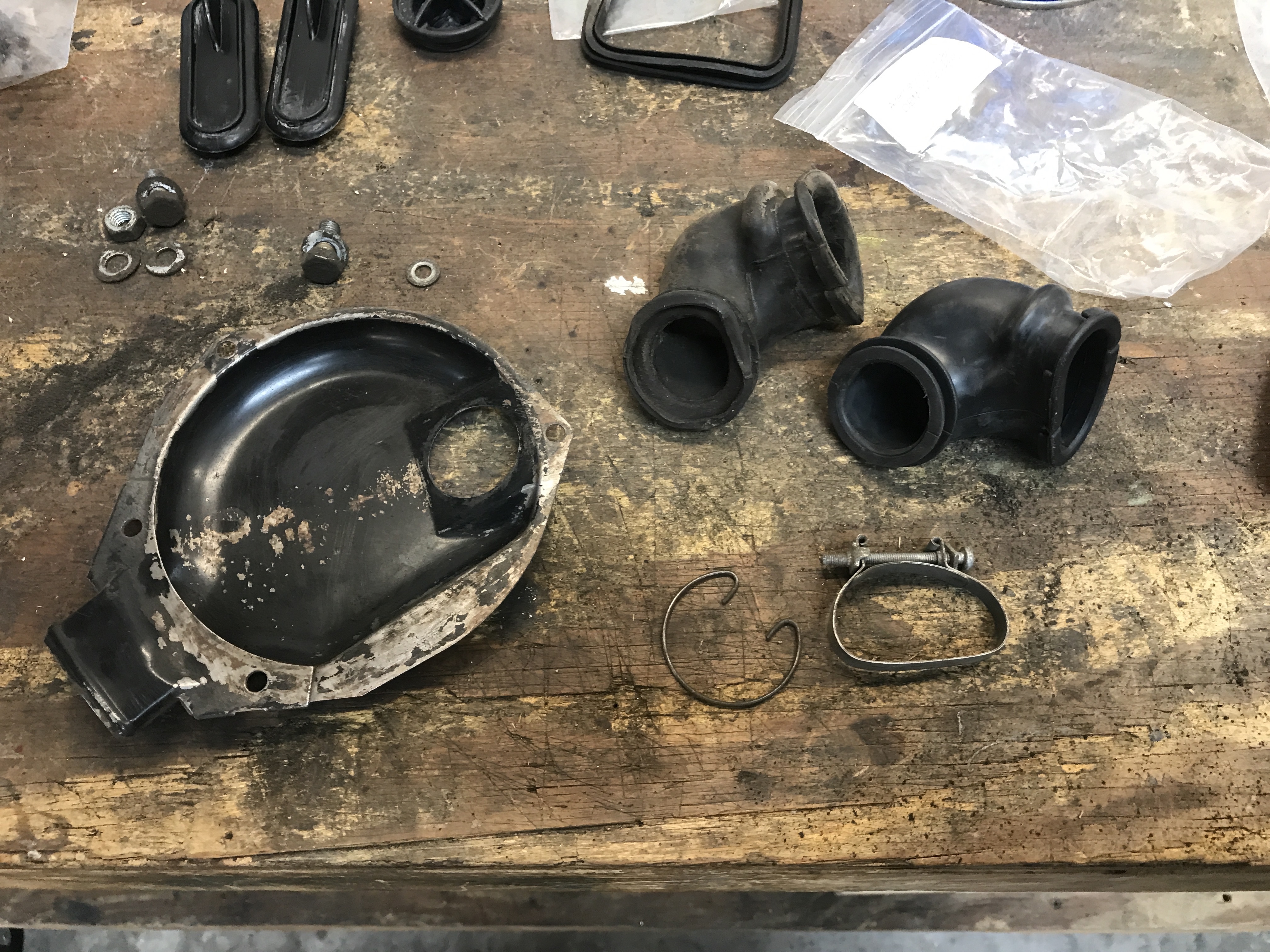

Now for the alternator duct.
bkrantz
post Oct 24 2021, 07:26 PM
Post #3970
Posts: 8,530
Joined: 3-August 19
From: SW Colorado
Member No.: 23,343

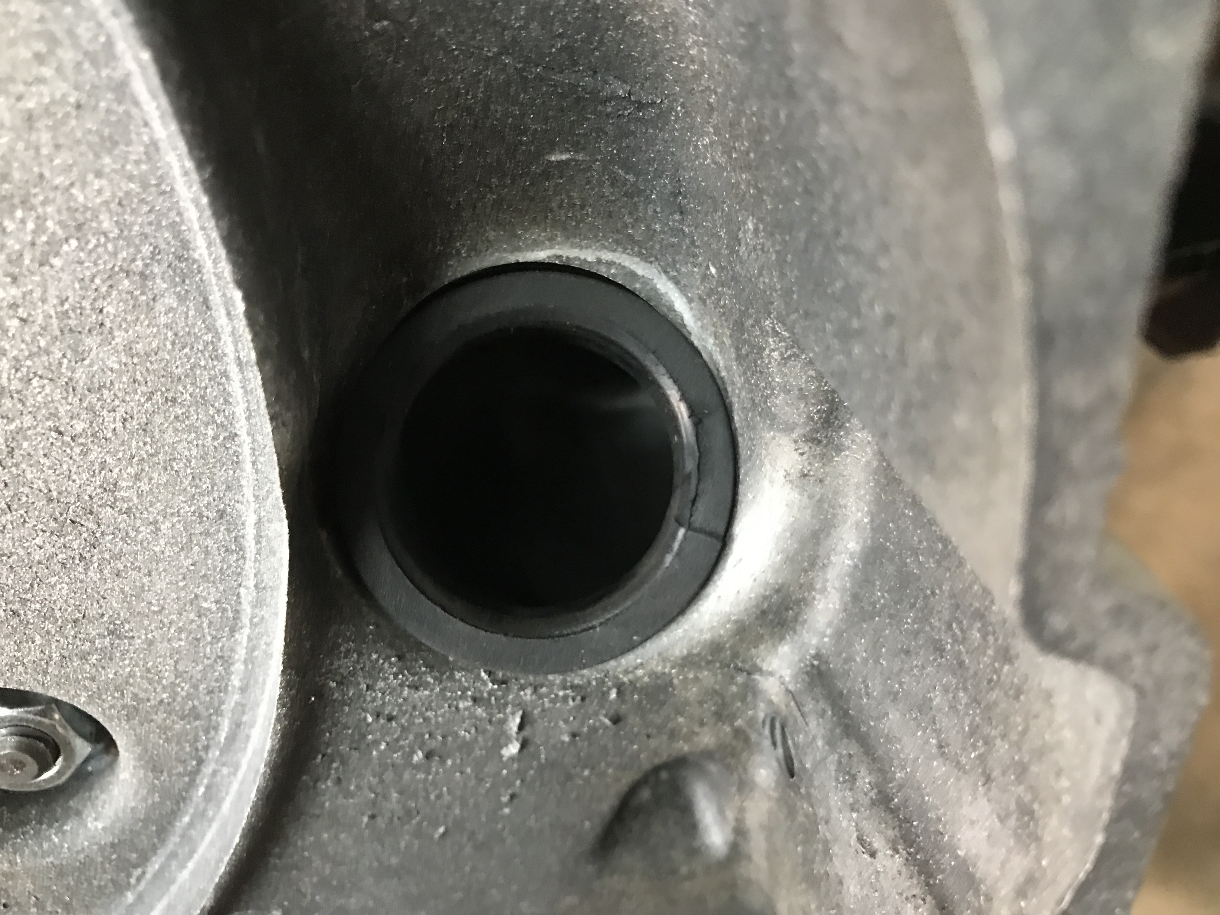

New replacement rubber duct.
bkrantz
post Oct 24 2021, 07:27 PM
Post #3971
Posts: 8,530
Joined: 3-August 19
From: SW Colorado
Member No.: 23,343
But the fit is kinda loose. Note the gap at the top. And unlike the original, there is no groove for the wire clip.

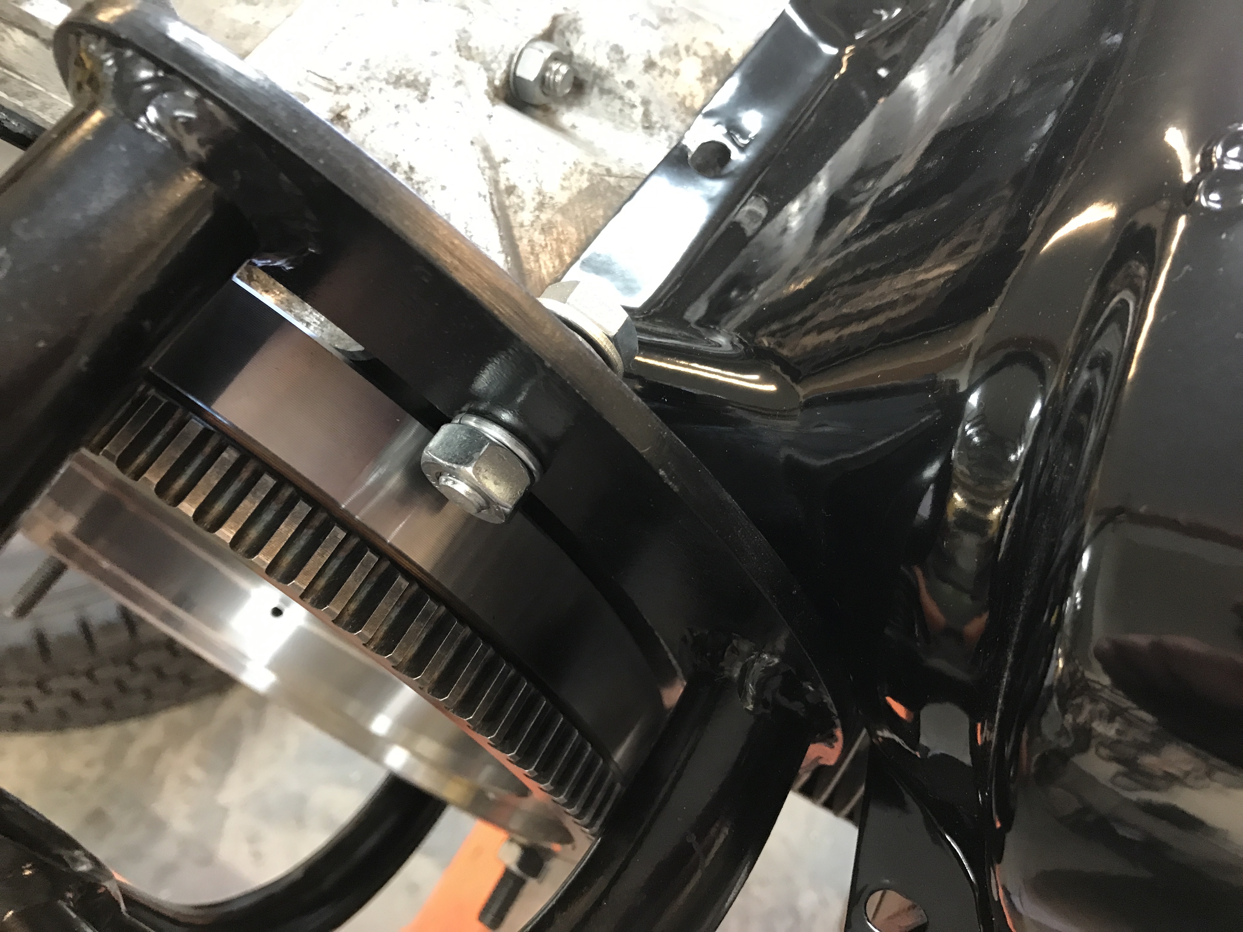

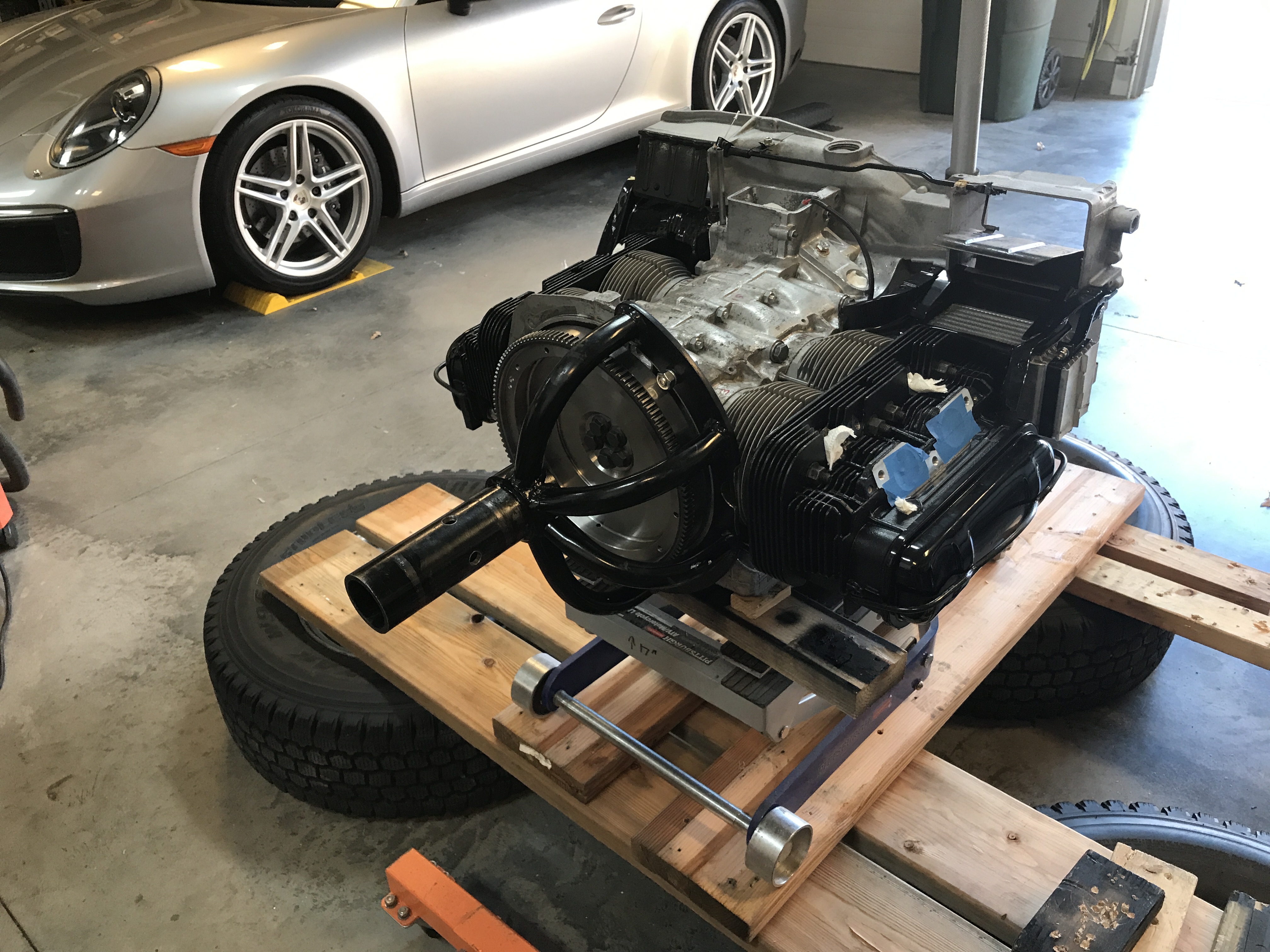

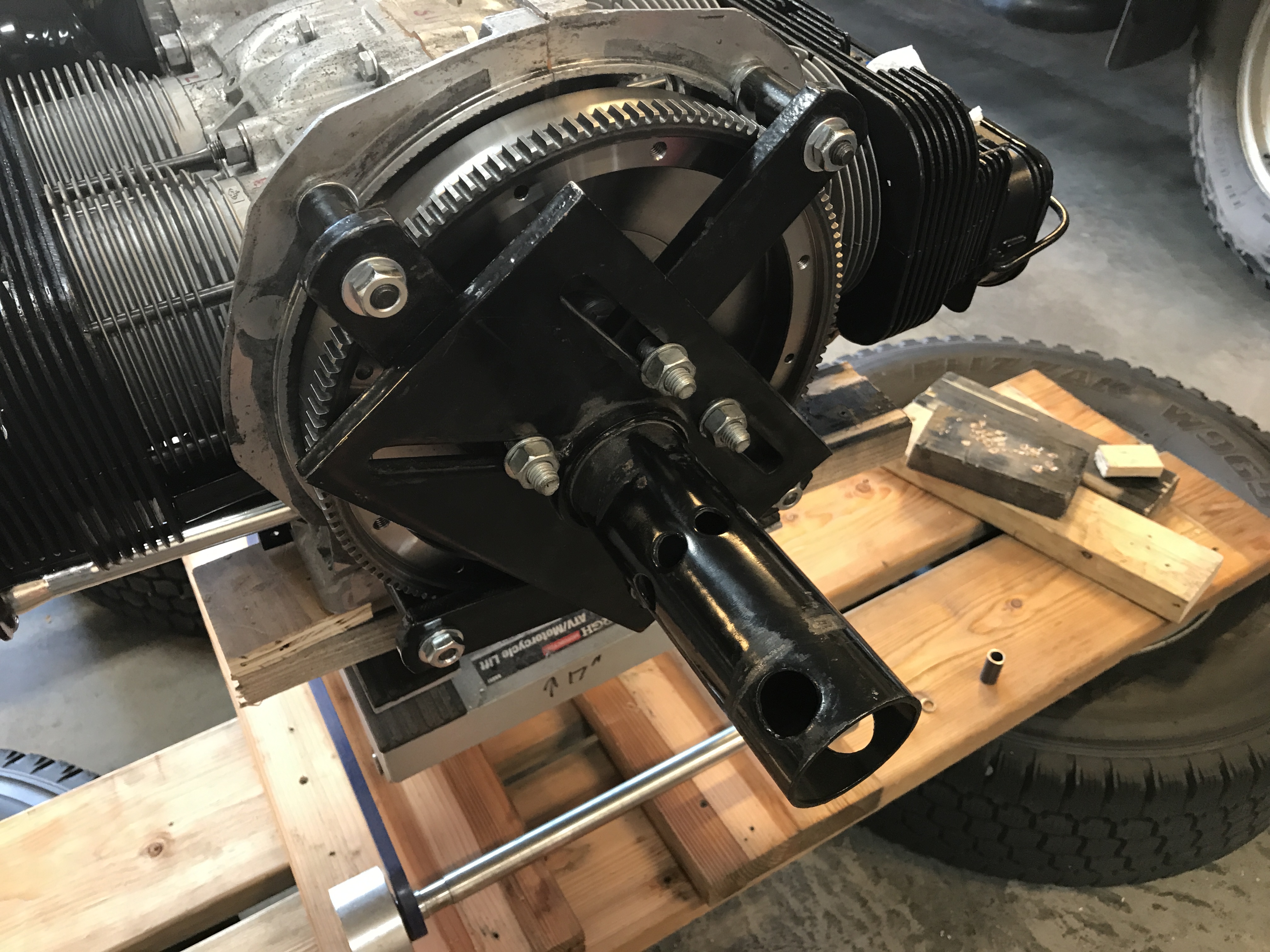

As expected, the engine stand yoke interferes with the sheet metal on the right side. The yoke made it possible to install the flywheel, but now has to get out of the way.
bkrantz
post Oct 25 2021, 07:58 PM
Post #3975
Posts: 8,530
Joined: 3-August 19
From: SW Colorado
Member No.: 23,343

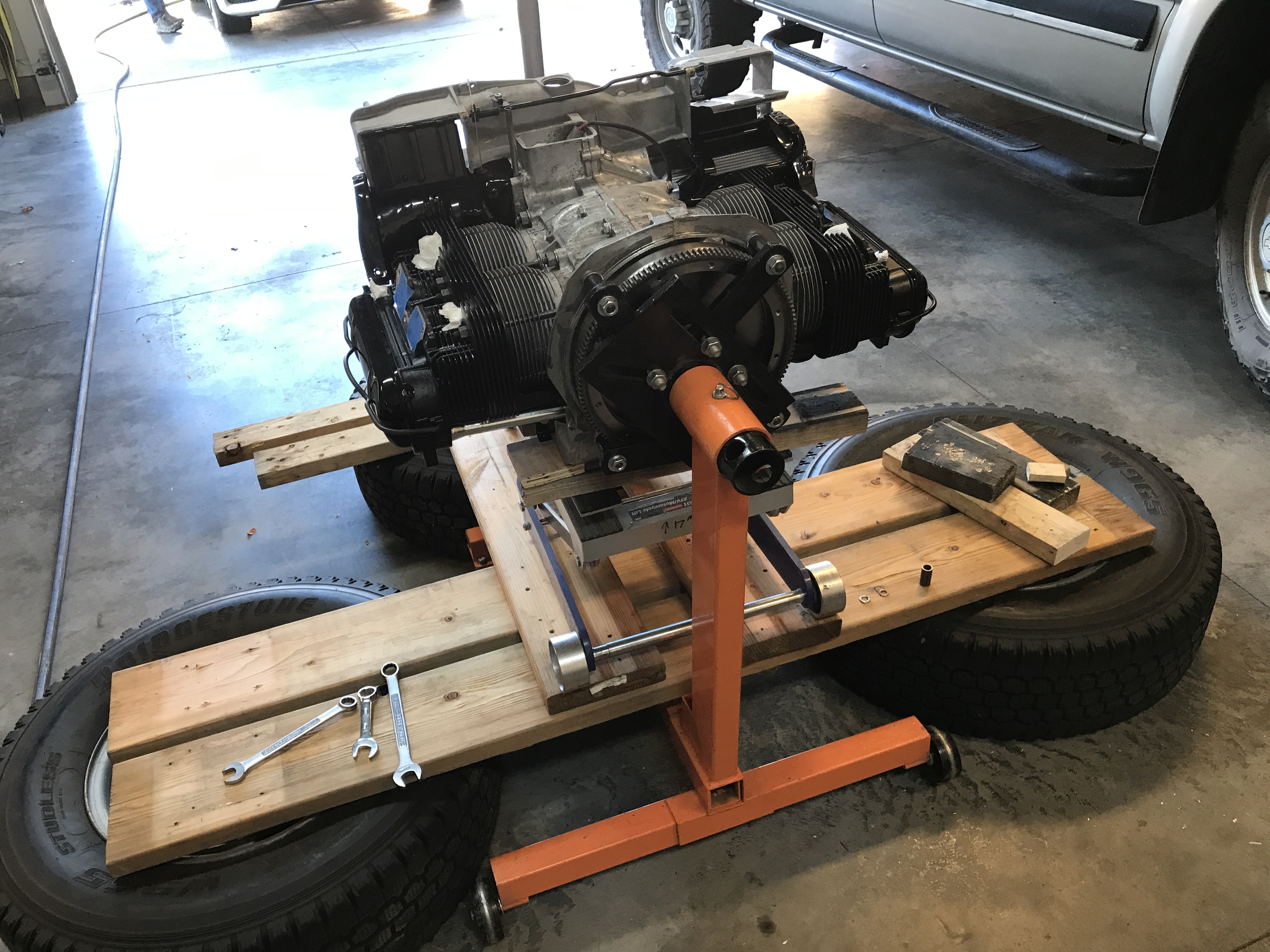

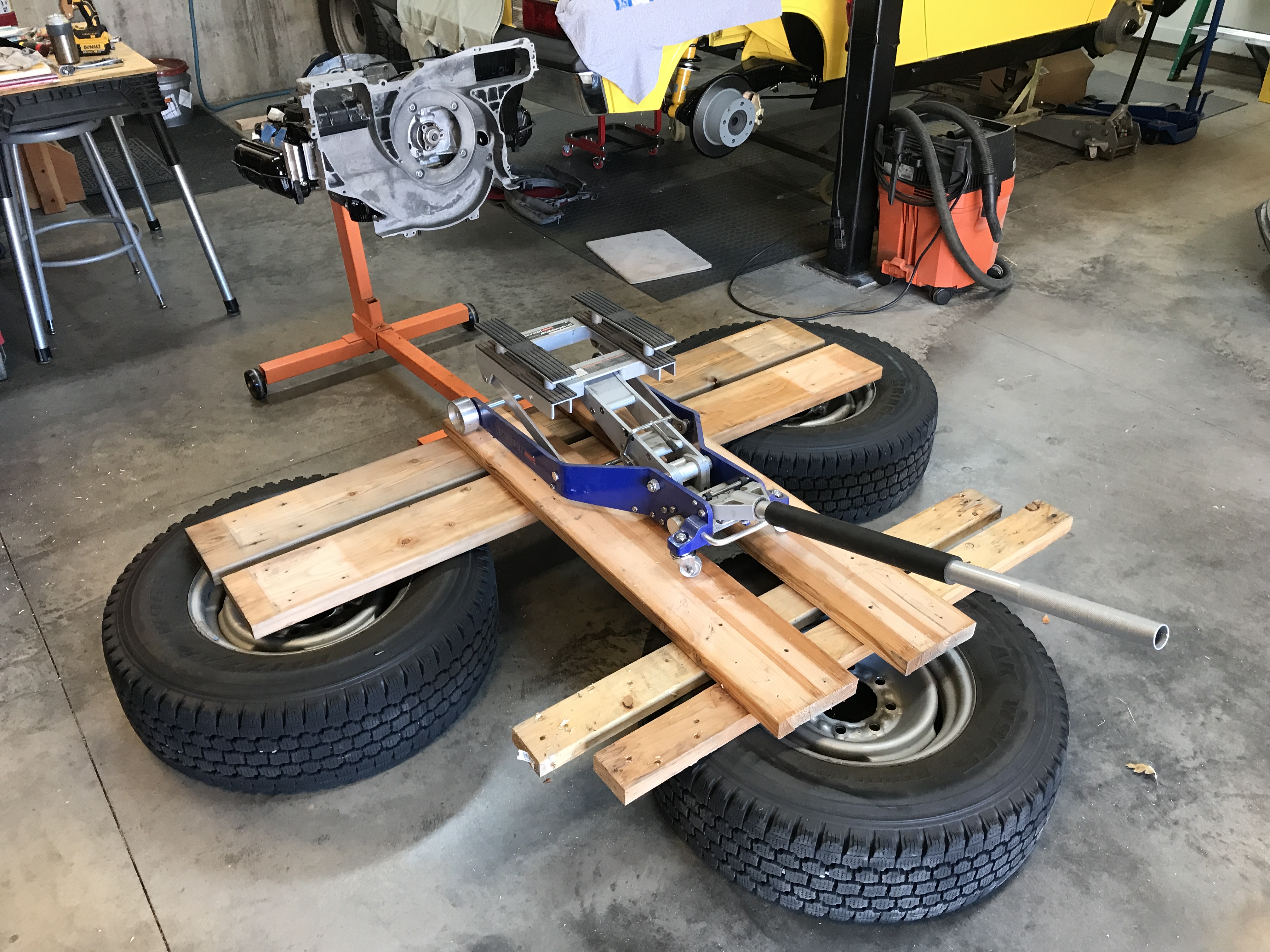

First, build a raised support for my engine jack. Step 1: lay out some handy truck tires.
bkrantz
post Oct 25 2021, 08:00 PM
Post #3976
Posts: 8,530
Joined: 3-August 19
From: SW Colorado
Member No.: 23,343
Step 2: screw together some handy lengths of 2x8, and sit the jack in place. BTW, this is a Harbor Freight motorcycle jack that almost perfectly supports the 914 engine case.
bkrantz
post Oct 25 2021, 08:01 PM
Post #3977
Posts: 8,530
Joined: 3-August 19
From: SW Colorado
Member No.: 23,343

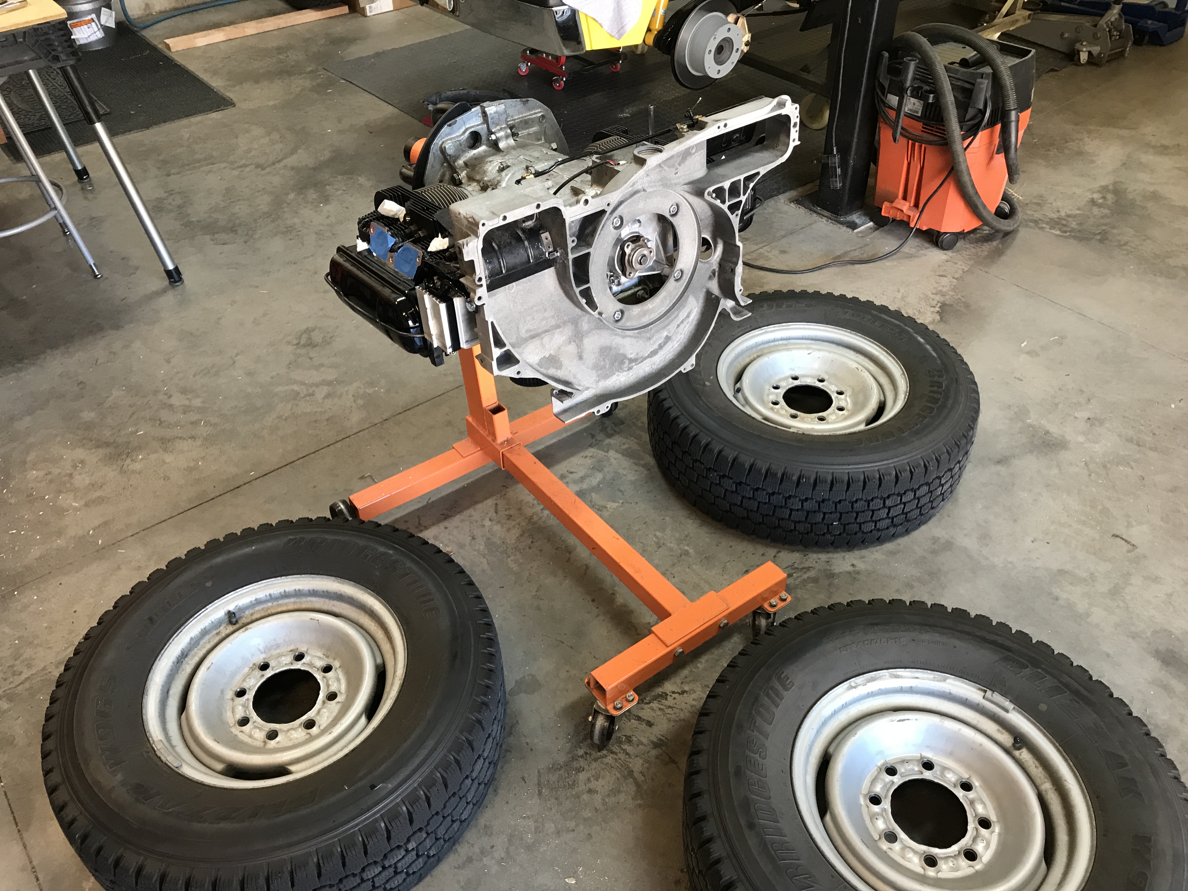

Engine supported, and the stand pulled back. That made it easy to unbolt the yoke.
bkrantz
post Oct 25 2021, 08:03 PM
Post #3978
Posts: 8,530
Joined: 3-August 19
From: SW Colorado

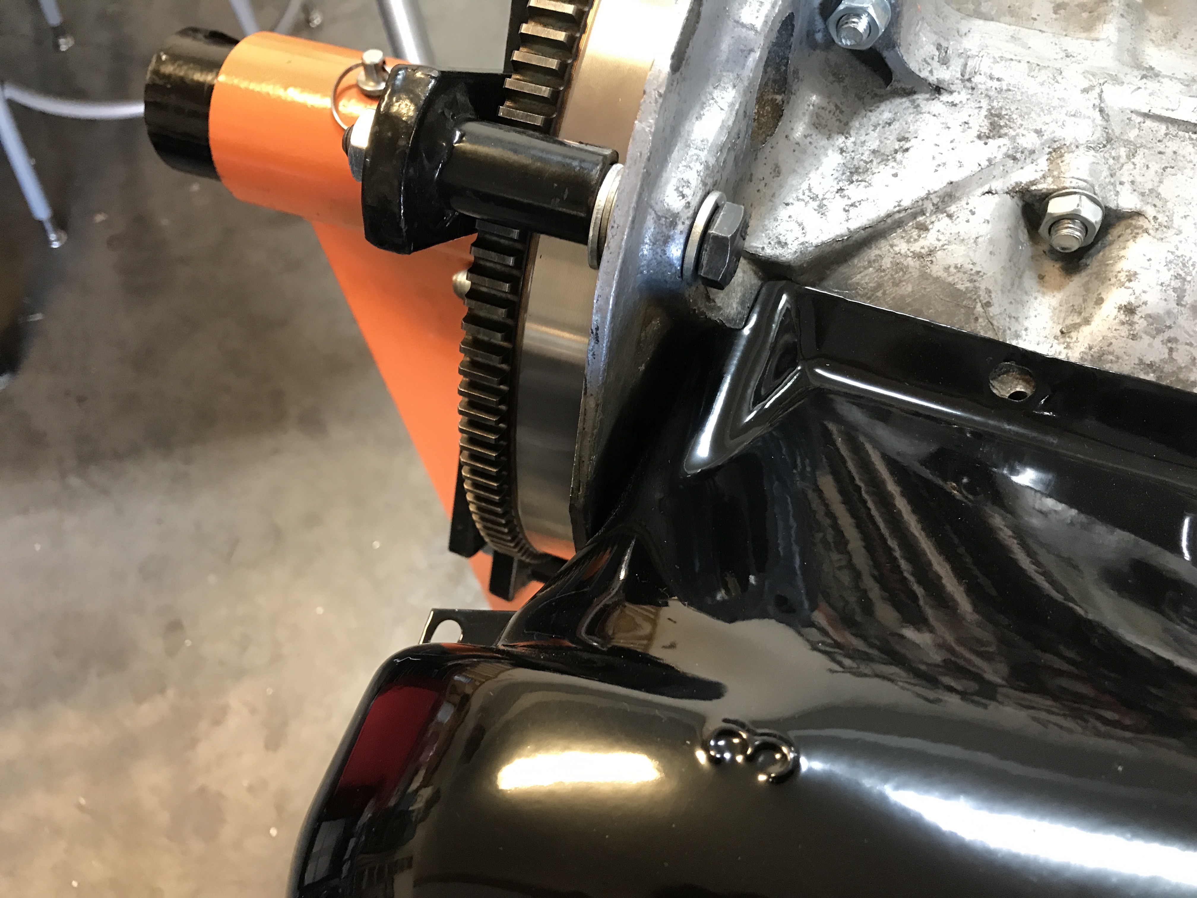

Member No.: 23,343
Old engine stand adjustable yoke bolted on. This requires some clever spaces and washers with one side ground away to clear the lip on the engine case.
bkrantz
post Oct 25 2021, 08:04 PM
Post #3979
Posts: 8,530
Joined: 3-August 19
From: SW Colorado
Member No.: 23,343
Back on the stand. Ready to roll back.
bkrantz
post Oct 25 2021, 08:05 PM
Post #3980
Posts: 8,530
Joined: 3-August 19
From: SW Colorado
Member No.: 23,343
Full clearance now for sheet metal all around.
