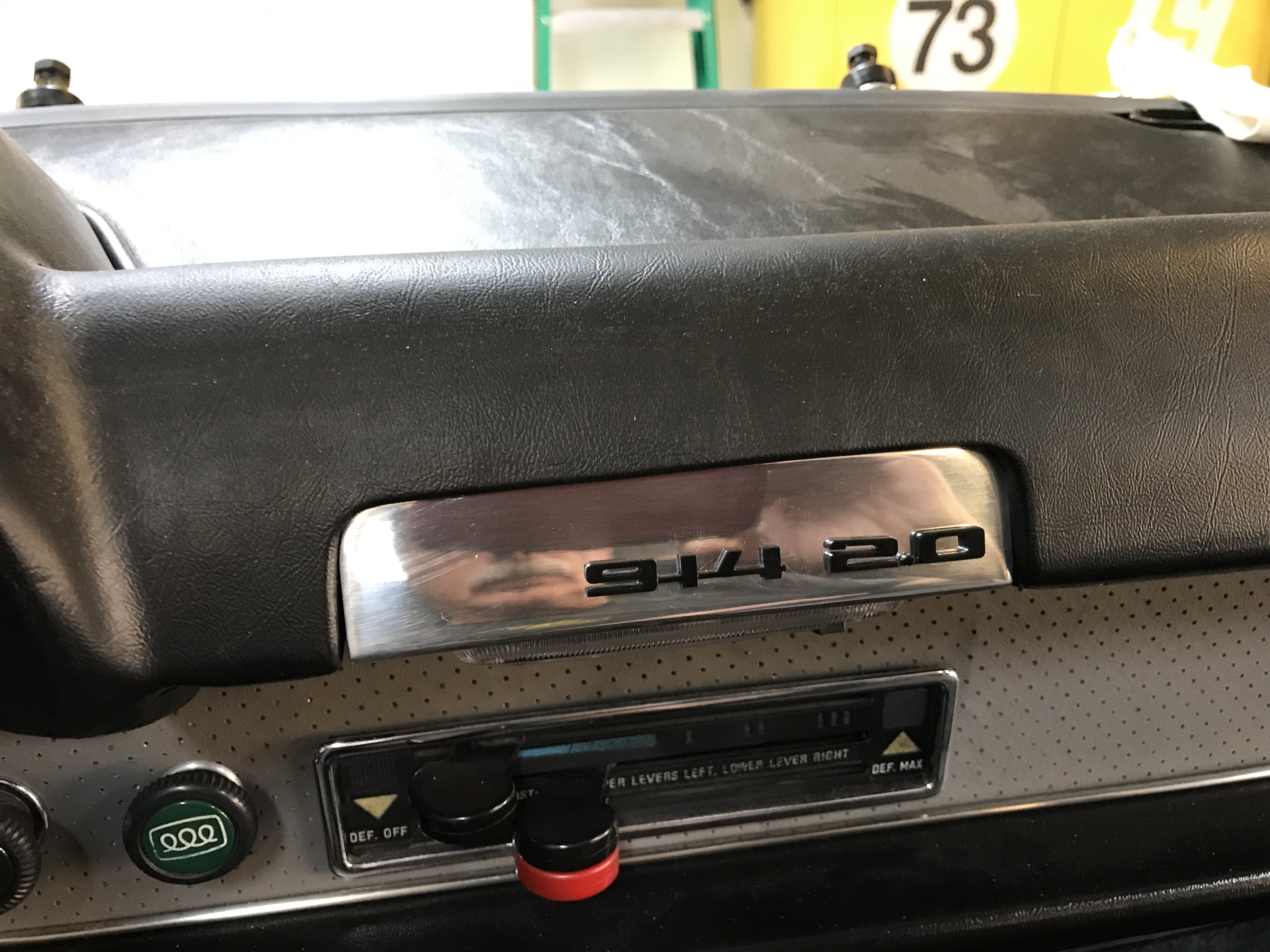

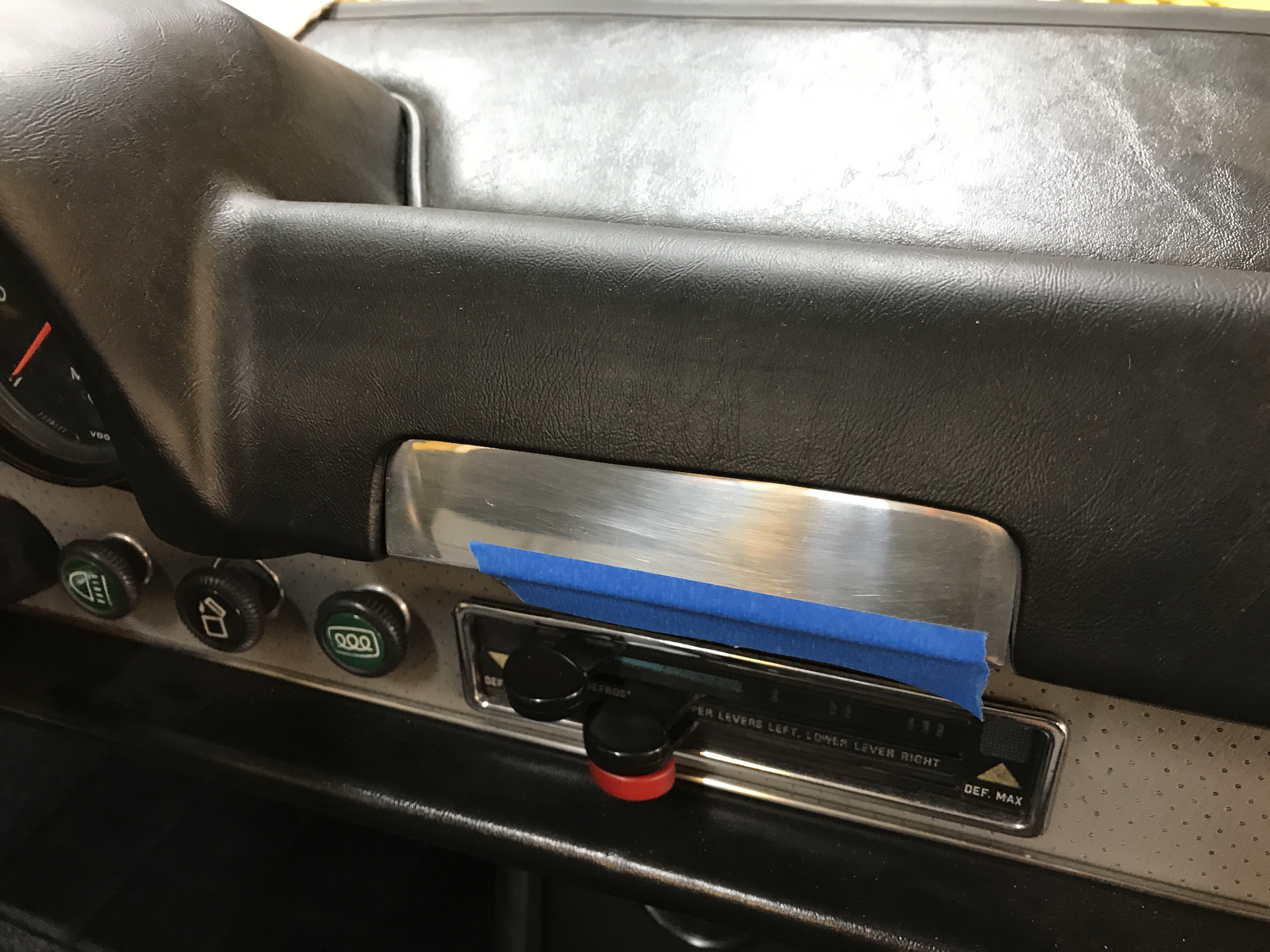

One more task for today, using the 3D printed miniature lettering. This is the insert I made to replace the ash tray, and mount the interior light.
bkrantz
post Oct 25 2021, 08:07 PM
Post #3982
Posts: 8,530
Joined: 3-August 19
From: SW Colorado
Member No.: 23,343
I like it. What do you guys think?
Van B
post Oct 25 2021, 08:10 PM
Post #3983
Posts: 1,621
Joined: 20-October 21
From: WR, GA
Member No.: 26,011
Dude! That is sweet!
Great call on the asymmetric placement too

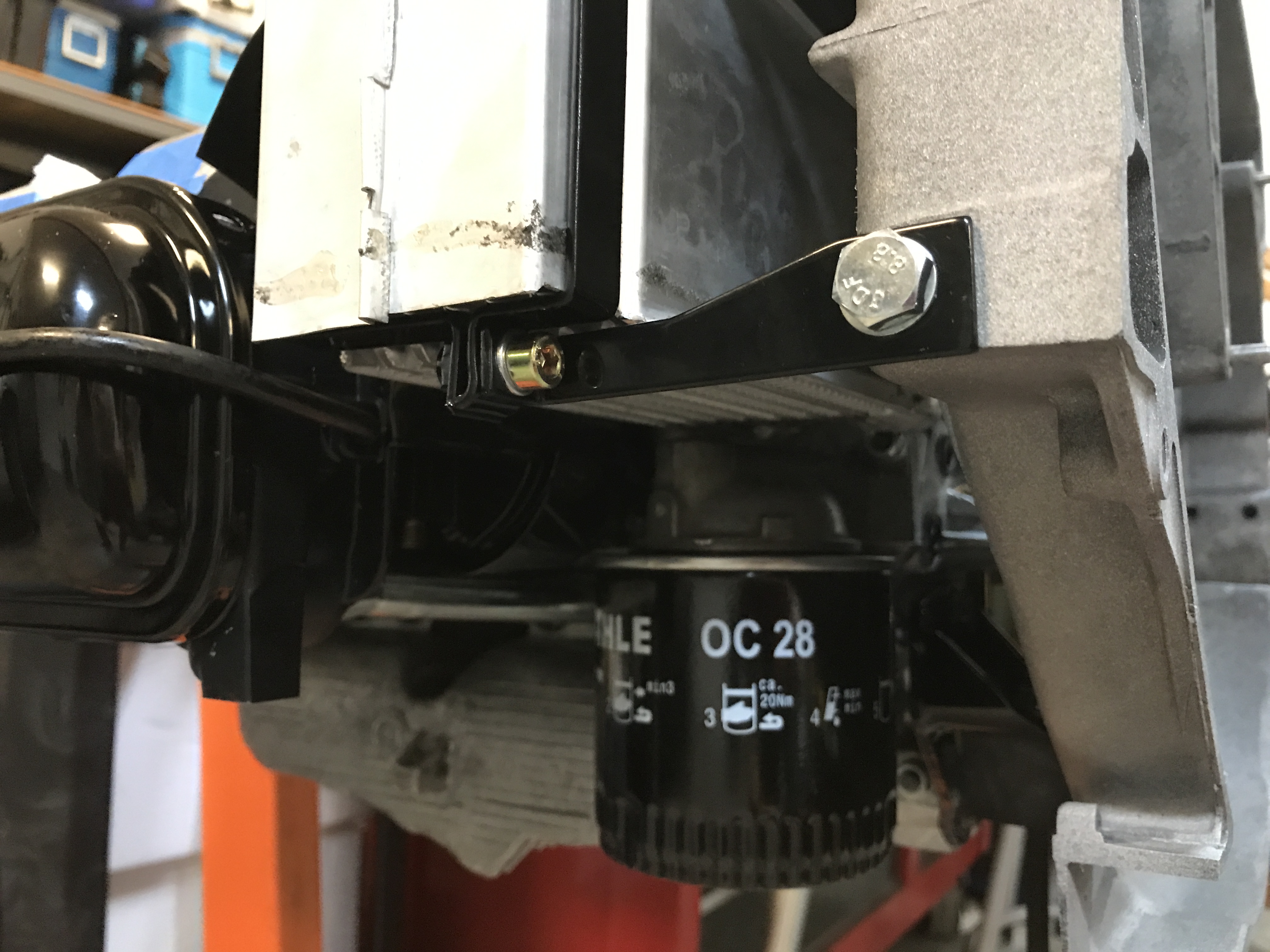

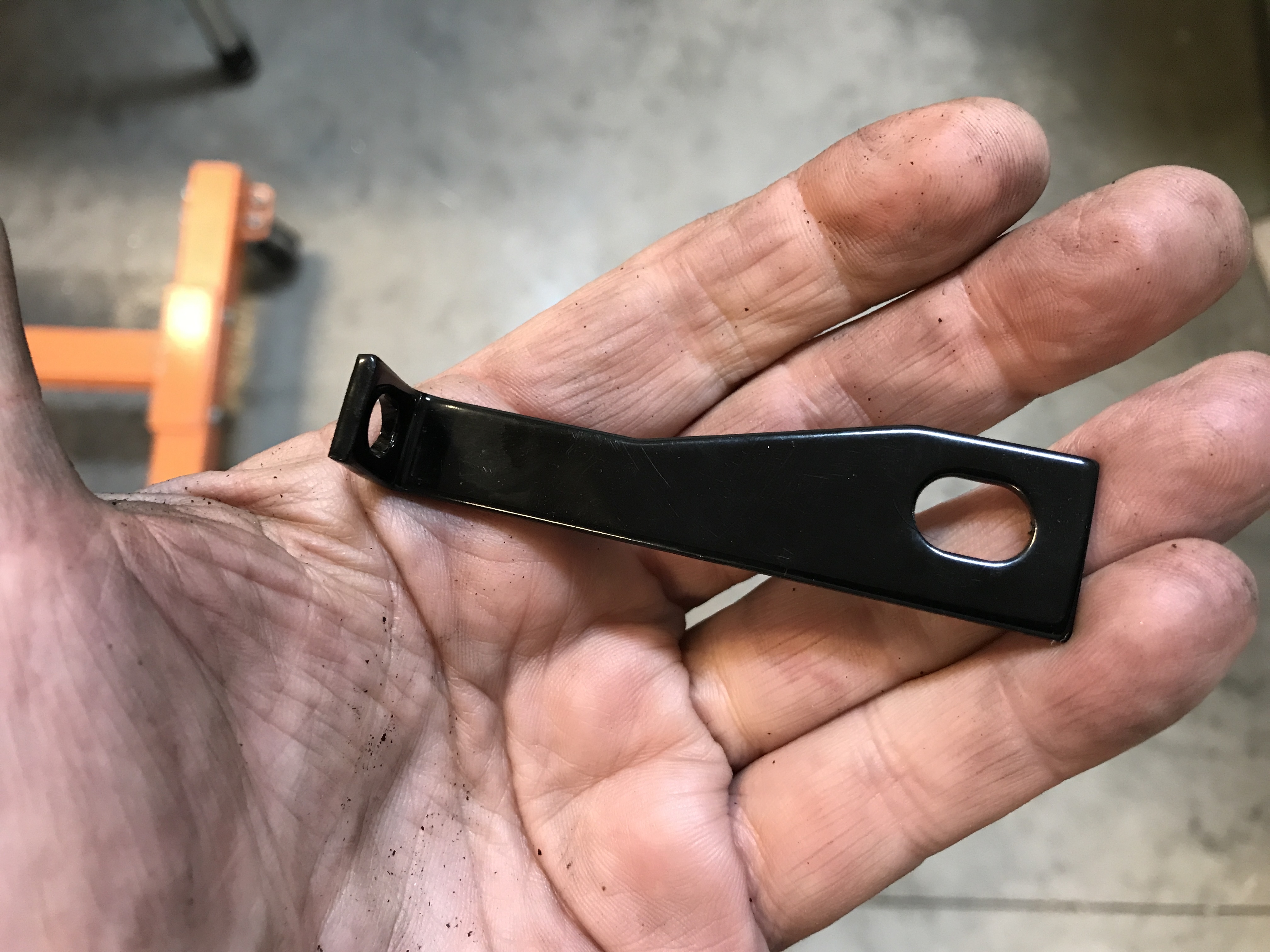

I almost forgot the lower support for the oil cooler.
bkrantz
post Oct 26 2021, 07:10 PM
Post #3987
Posts: 8,530
Joined: 3-August 19
From: SW Colorado
Member No.: 23,343
Installed.

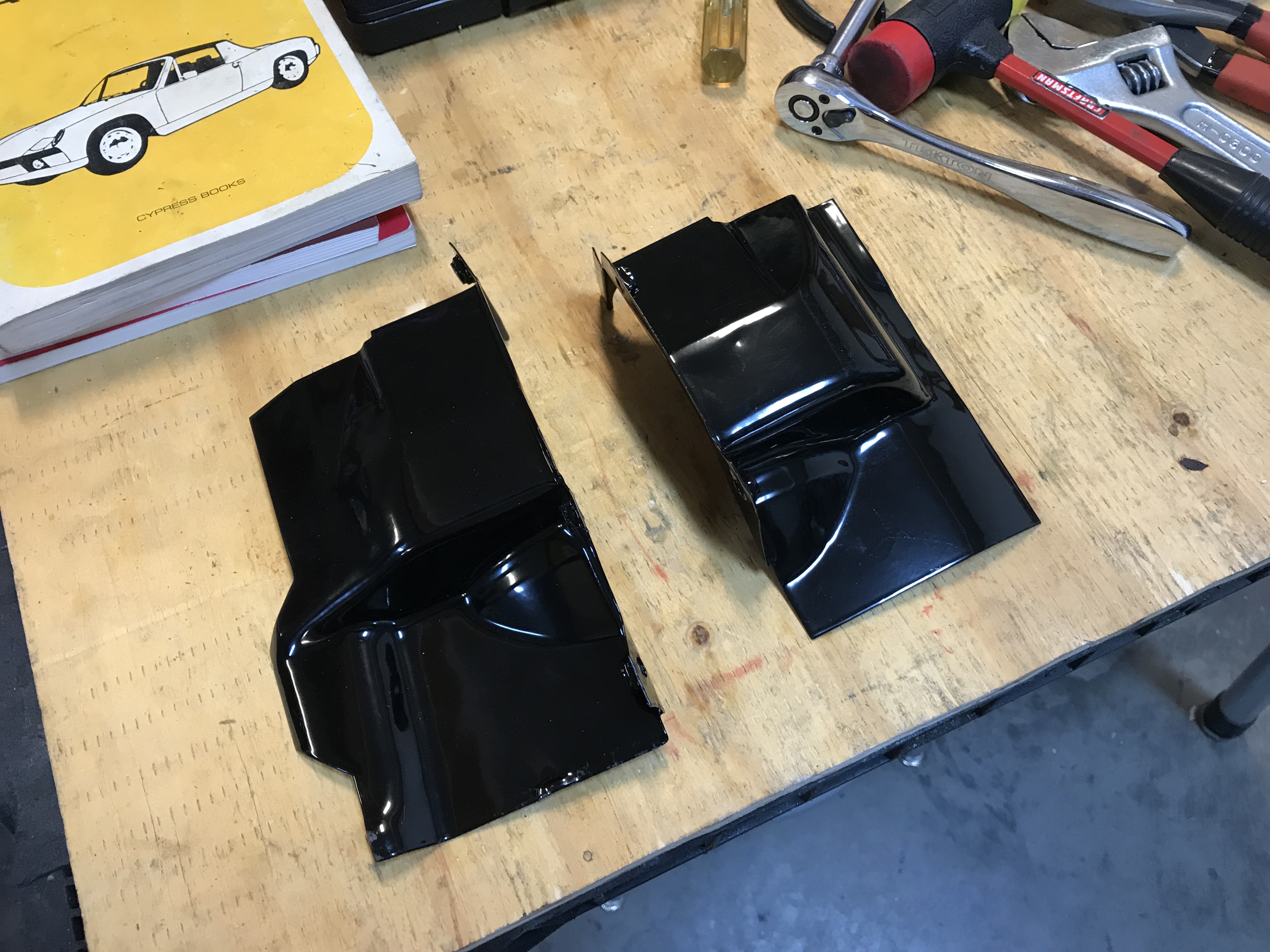

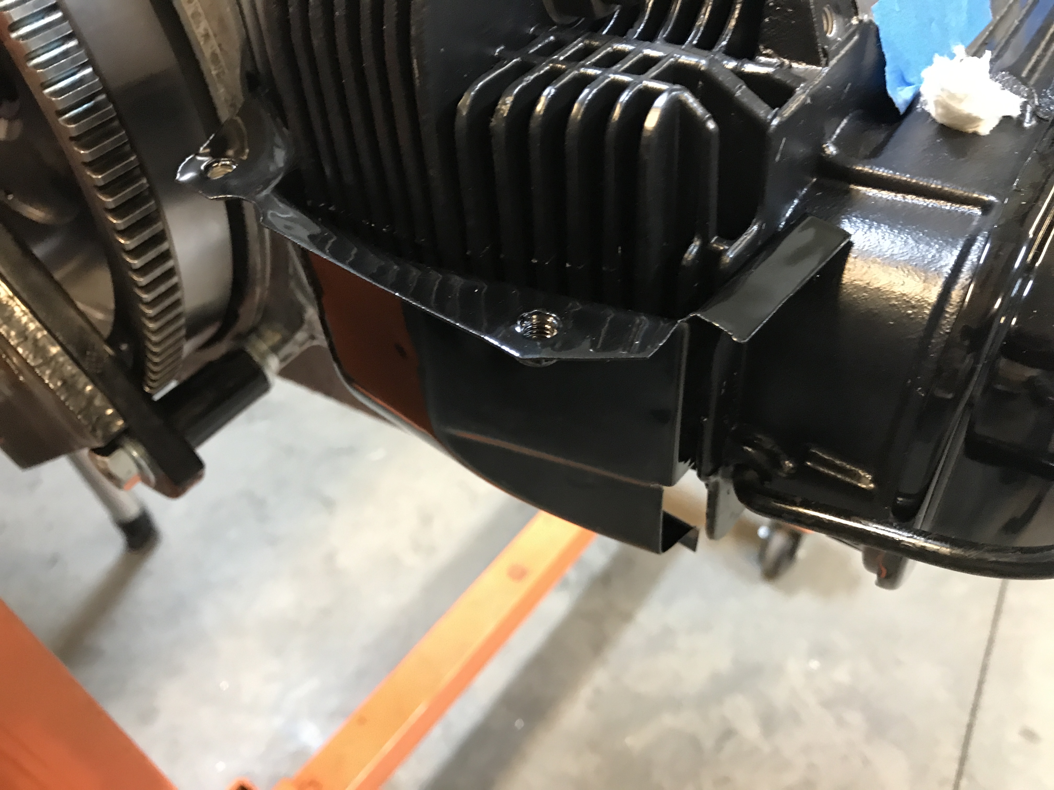

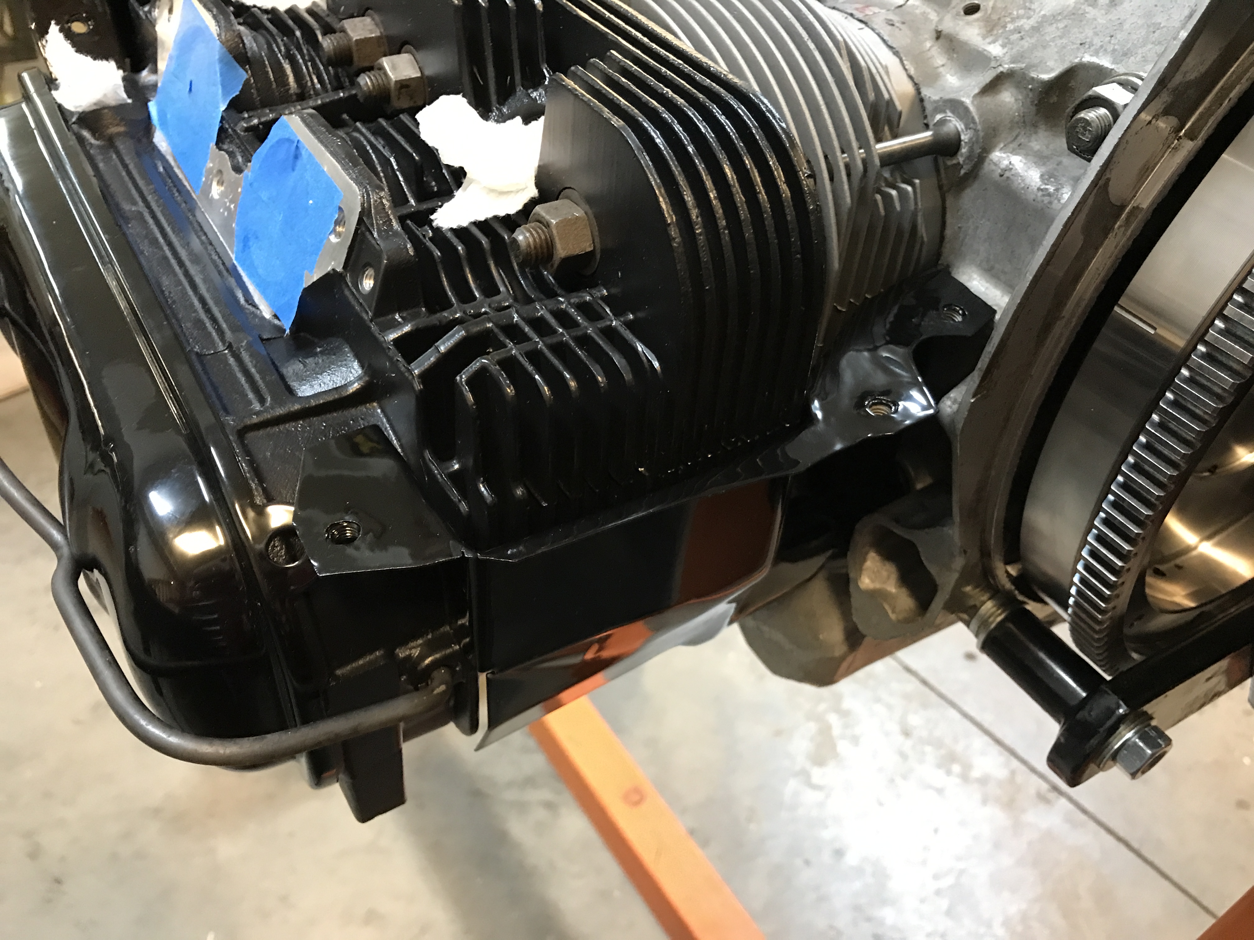

Rear cylinder baffles.
bkrantz
post Oct 26 2021, 07:13 PM
Post #3989
Posts: 8,530
Joined: 3-August 19
From: SW Colorado
Member No.: 23,343
Left side.
bkrantz
post Oct 26 2021, 07:14 PM
Post #3990
Posts: 8,530
Joined: 3-August 19
From: SW Colorado
Member No.: 23,343
Right side.

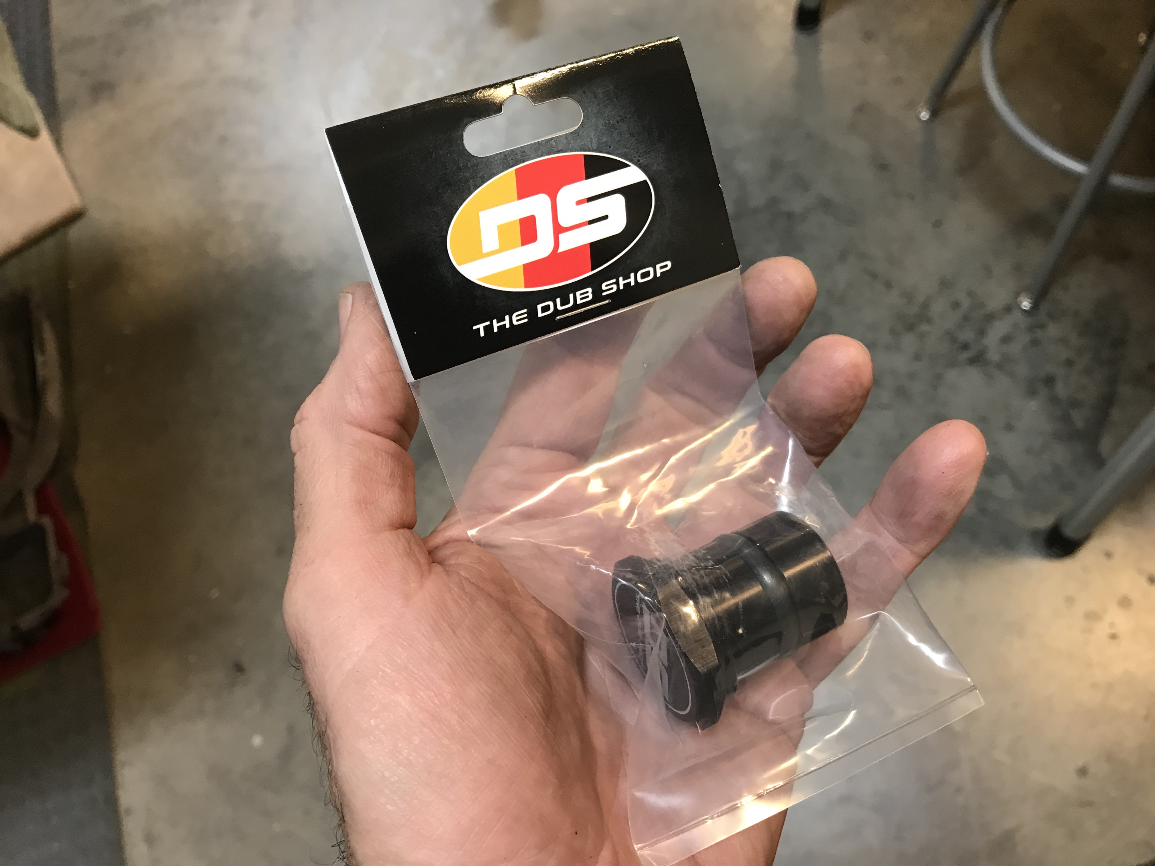

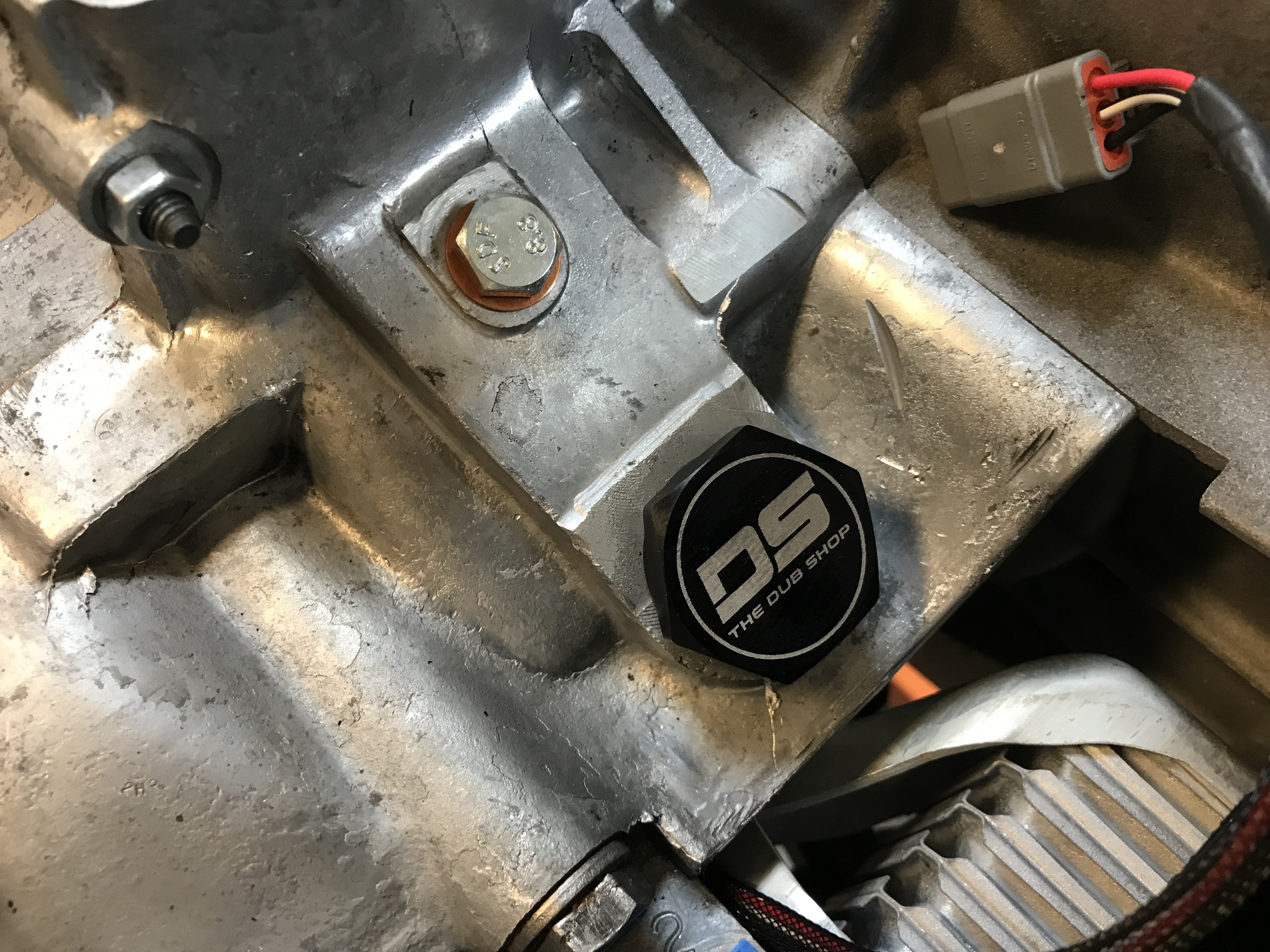

Distributor hole plug from the Dub Shop.
bkrantz
post Oct 26 2021, 07:16 PM
Post #3992
Posts: 8,530
Joined: 3-August 19
From: SW Colorado
Member No.: 23,343
A very tight press fit. I also plugged the distributor retainer stud hole.

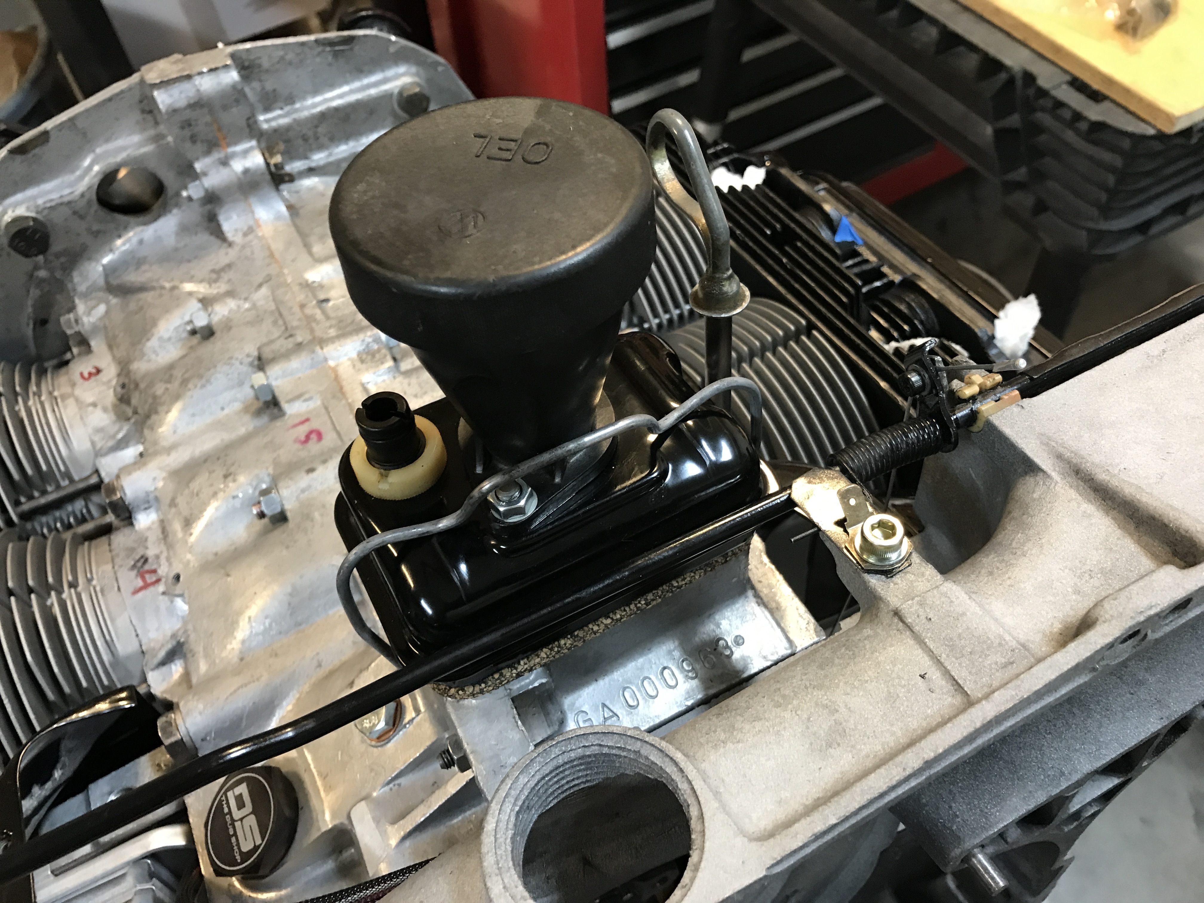

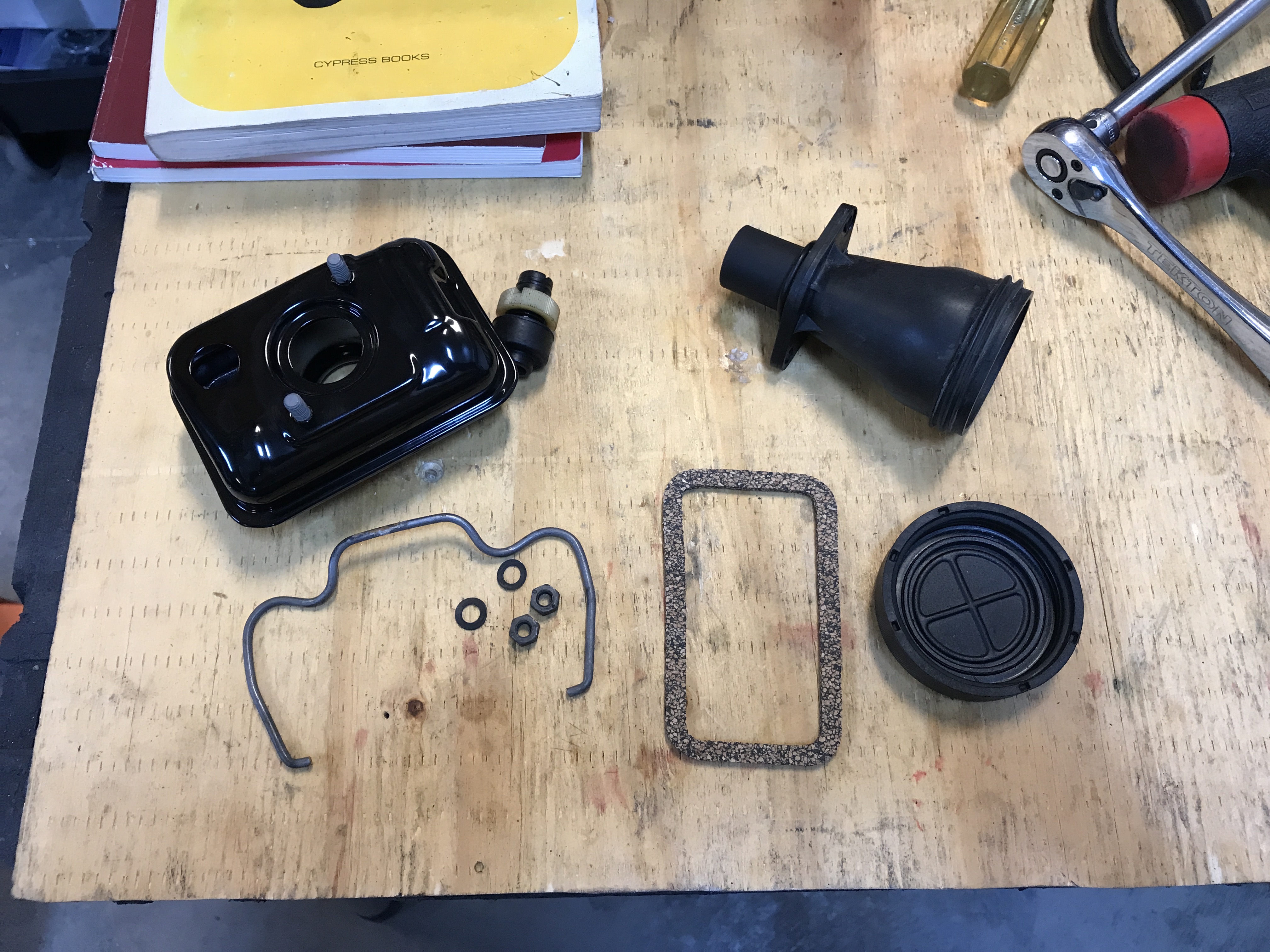

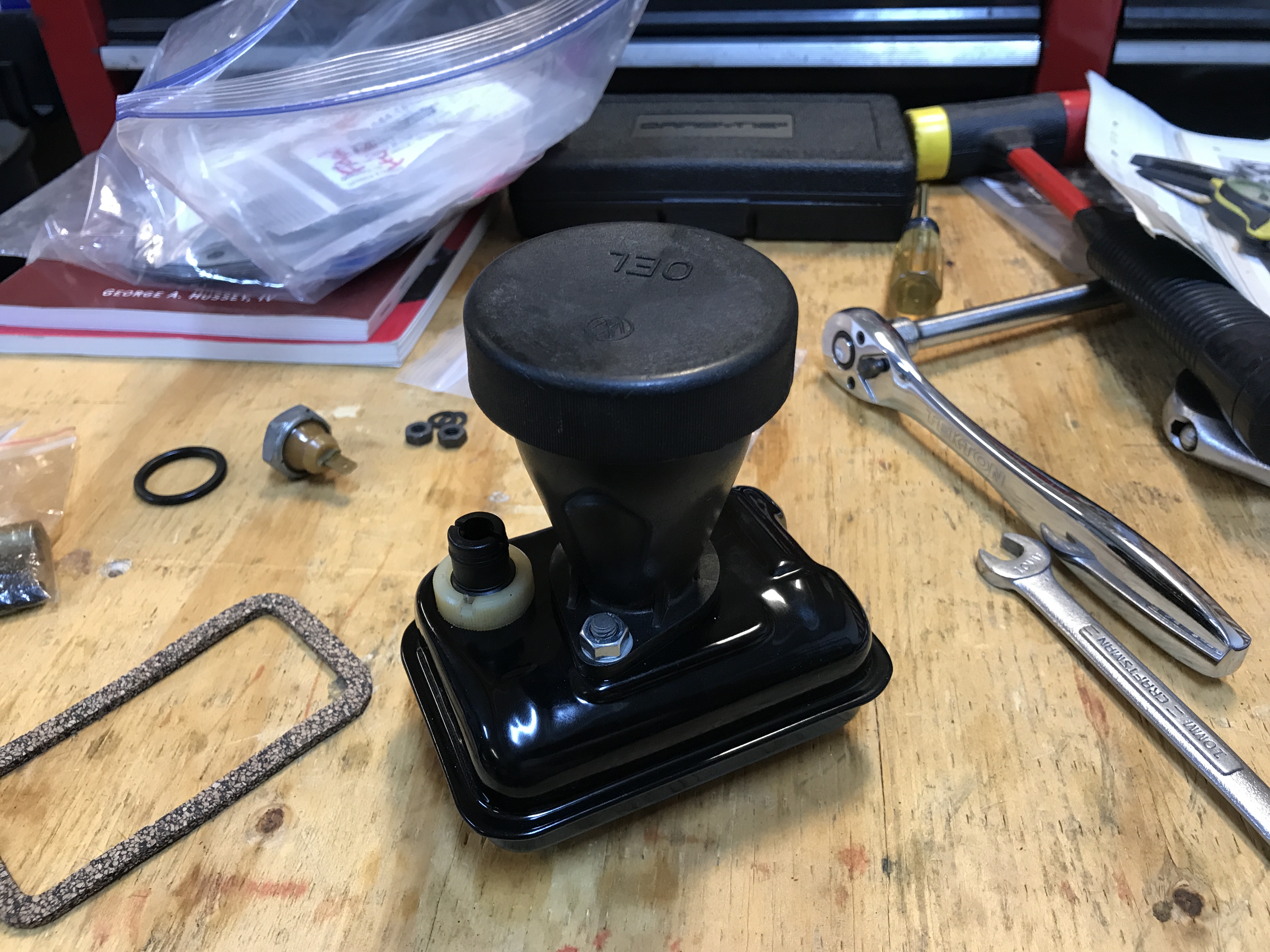

Oil breather stuff.
bkrantz
post Oct 26 2021, 07:18 PM
Post #3994
Posts: 8,530
Joined: 3-August 19
From: SW Colorado
Member No.: 23,343
Built up, with a new O-ring on the filler base.
bkrantz
Post #3995
Posts: 8,530
Joined: 3-August 19
From: SW Colorado
Member No.: 23,343
In place.

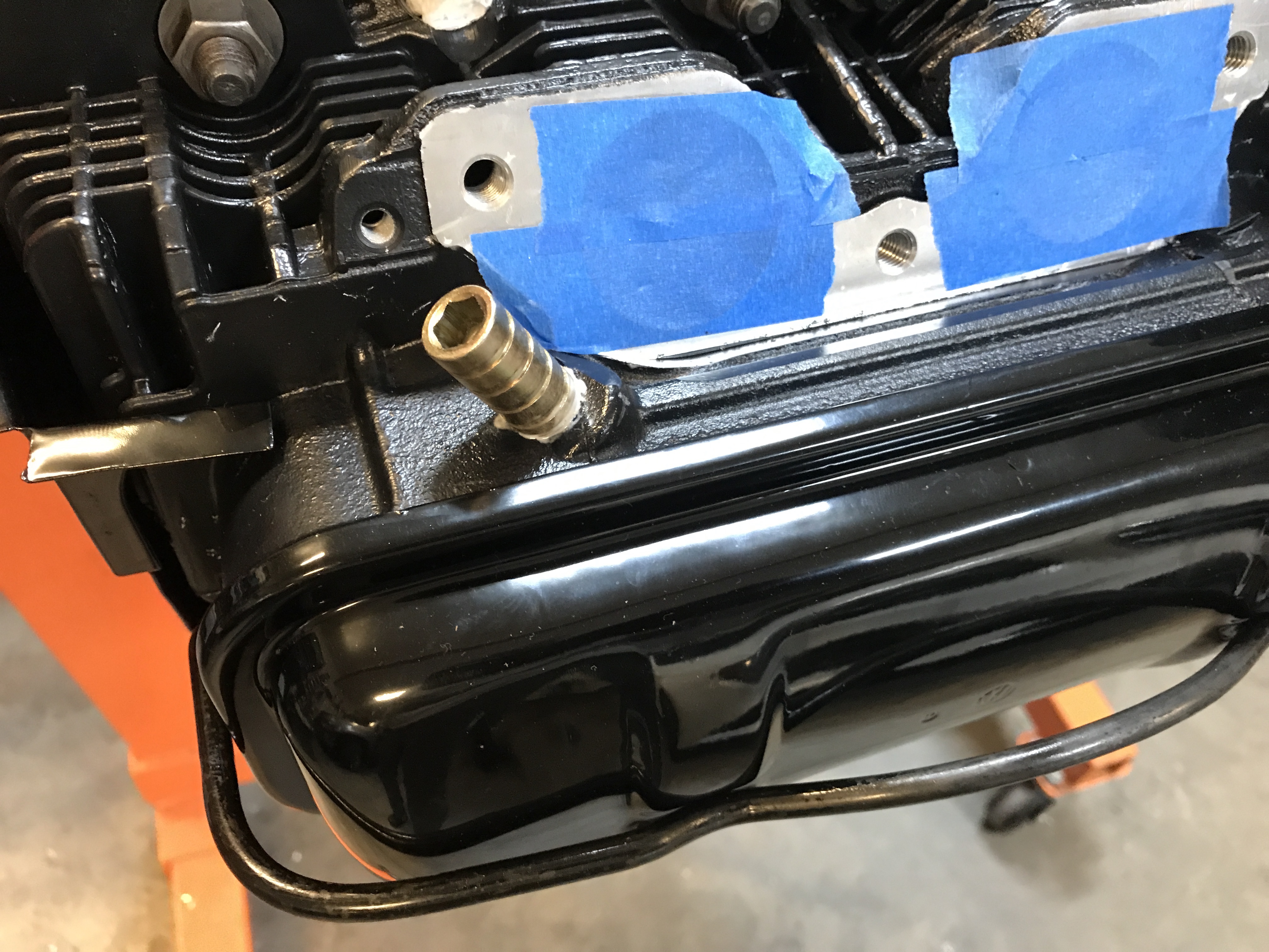

Cylinder head breather fittings.
bkrantz
post Oct 26 2021, 07:20 PM
Post #3997
Posts: 8,530
Joined: 3-August 19
From: SW Colorado
Member No.: 23,343
Installed with thread sealant.

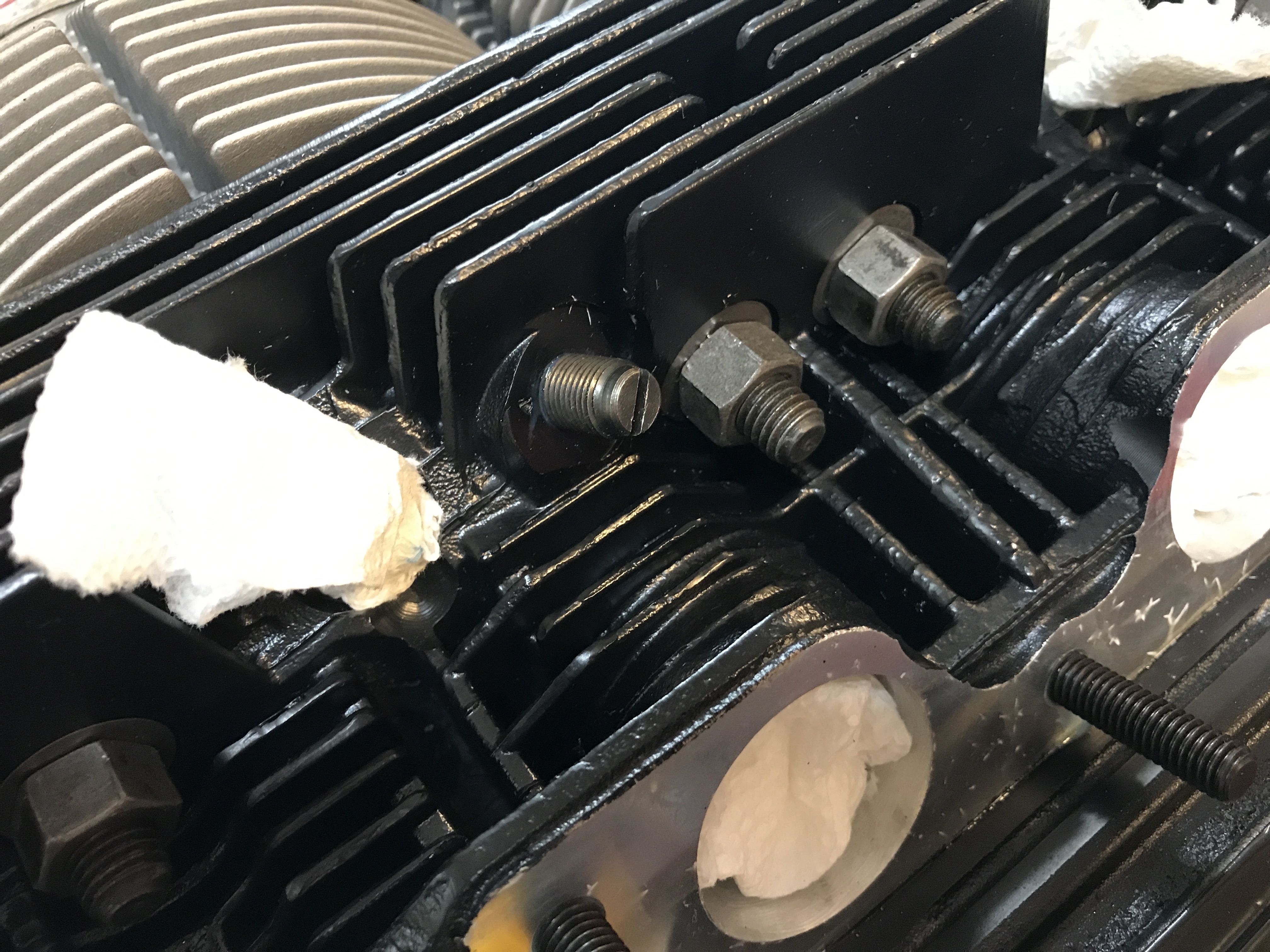

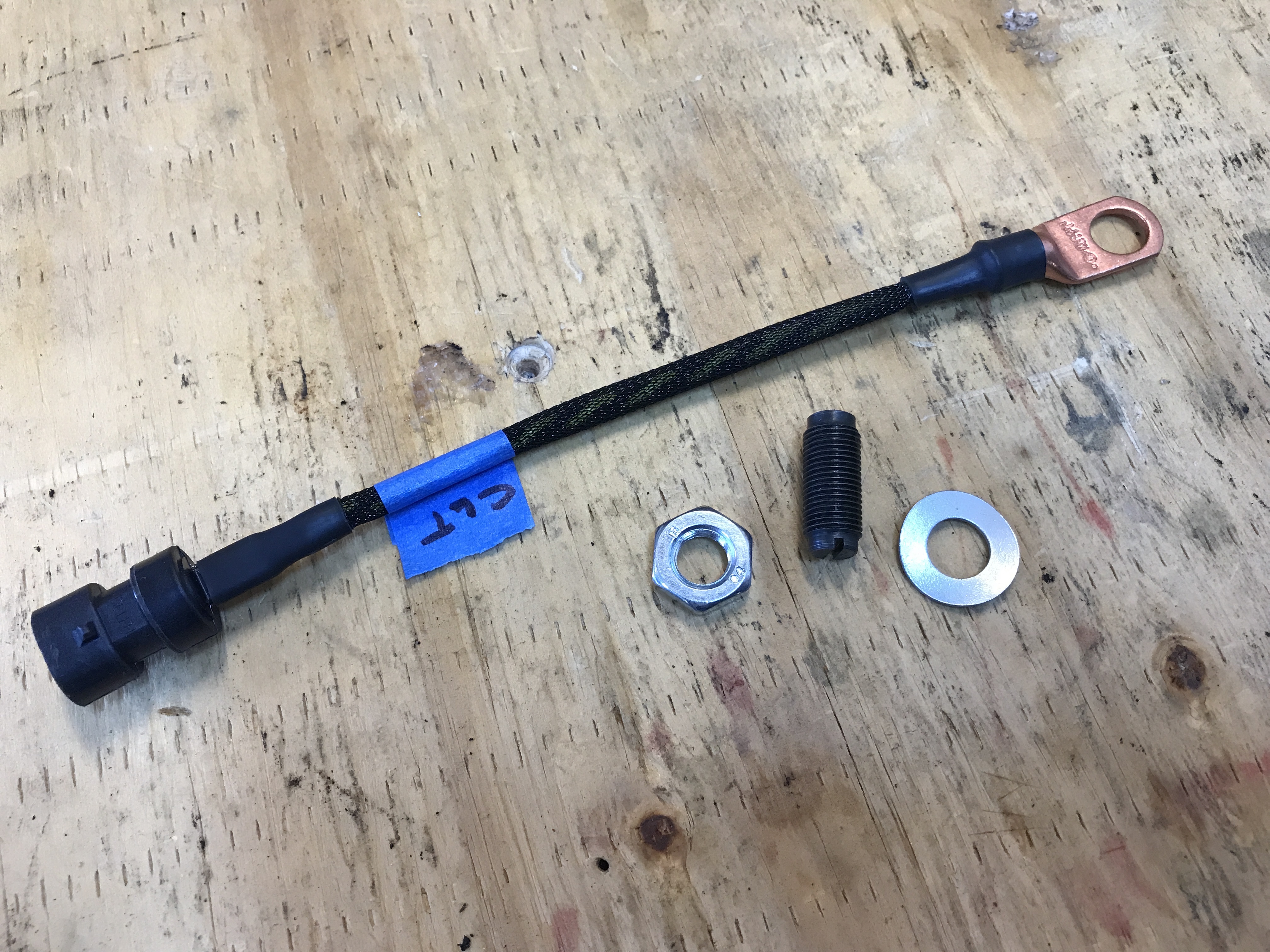

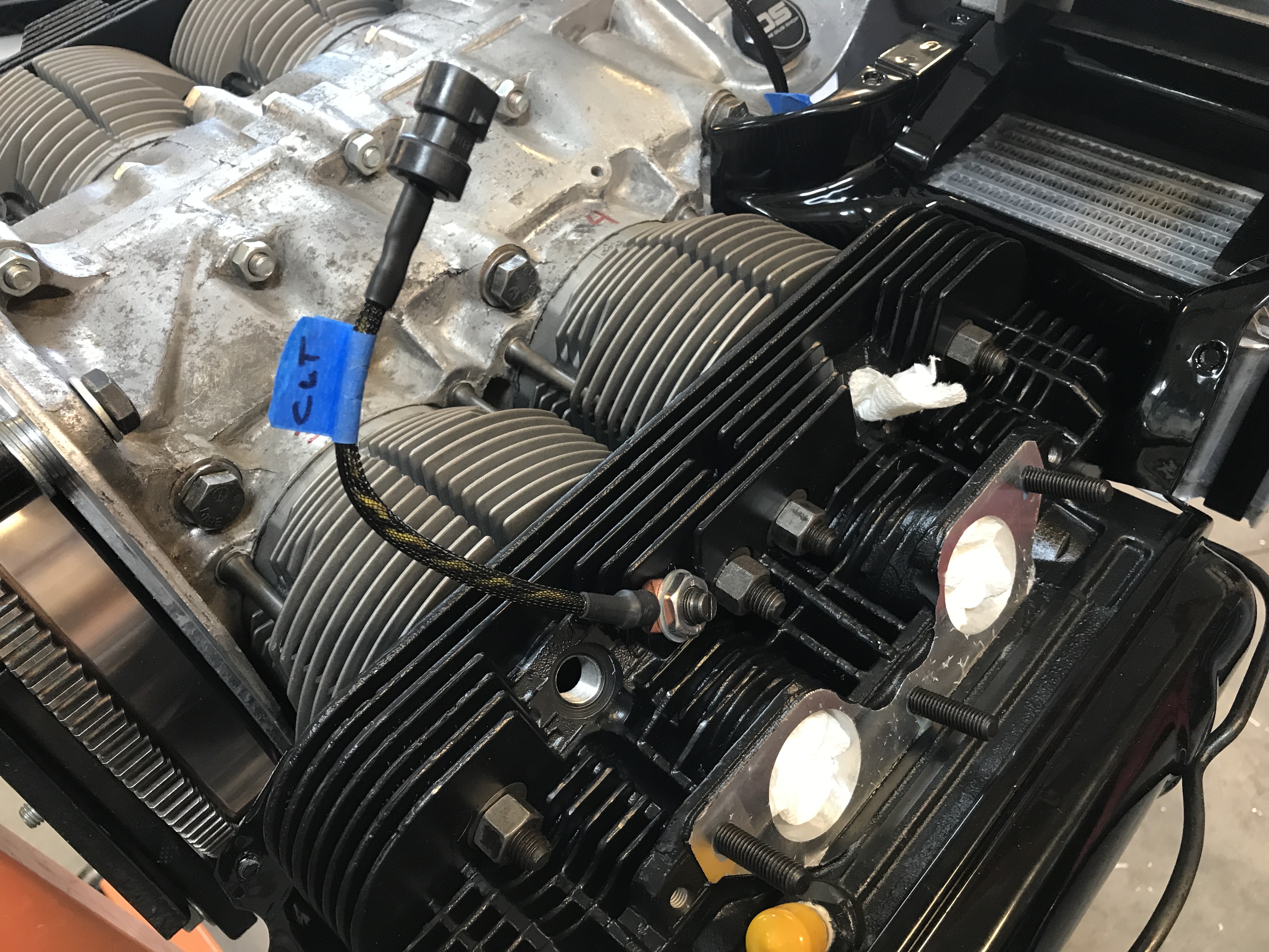

One more thing before the sheet metal can go on: the new head temperature sensor for the Dub Shop EFI system.
bkrantz
post Oct 27 2021, 07:32 PM
Post #3999
Posts: 8,530
Joined: 3-August 19
From: SW Colorado
Member No.: 23,343

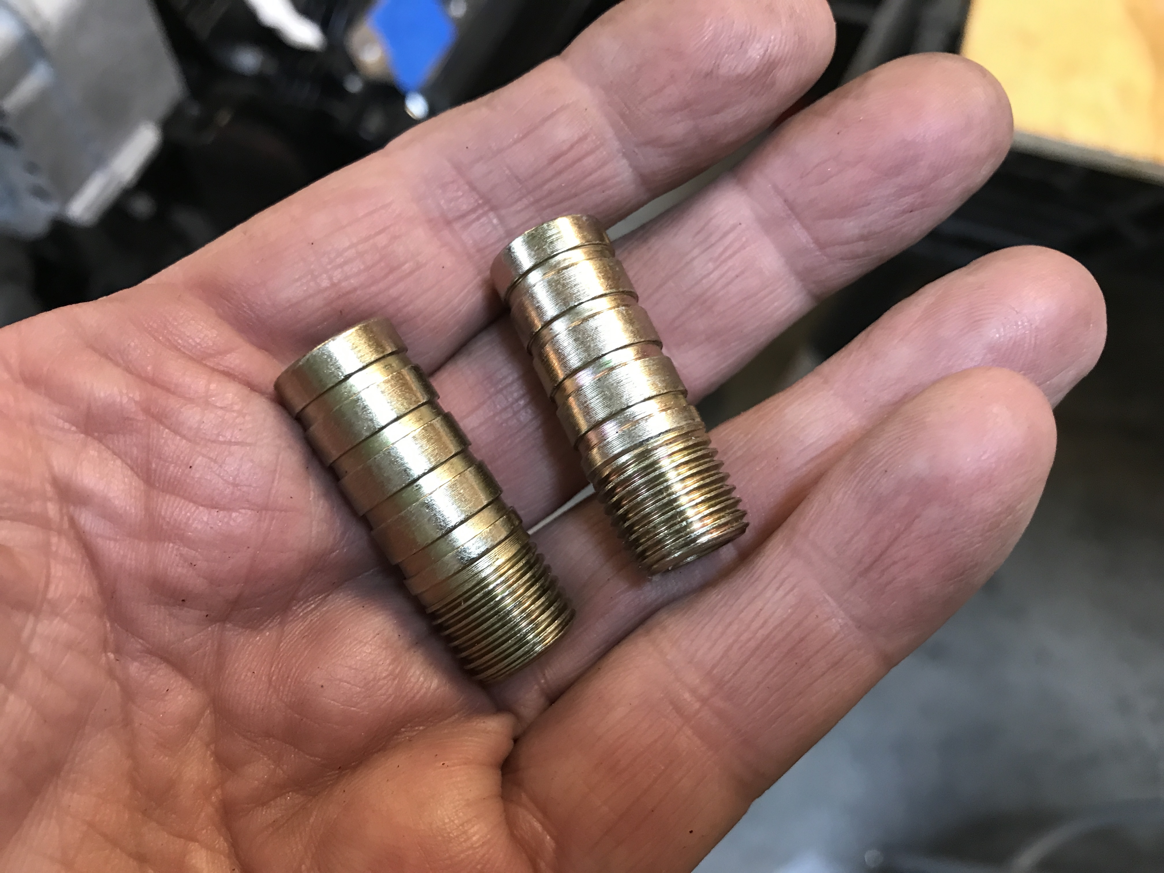

This goes on #3. The stock sensor hole needs a M10x1.0 stud--just the place to recycle a stock valve adjuster.
bkrantz
Post #4000
Posts: 8,530
Joined: 3-August 19
From: SW Colorado
Member No.: 23,343
Temp sensor installed.
