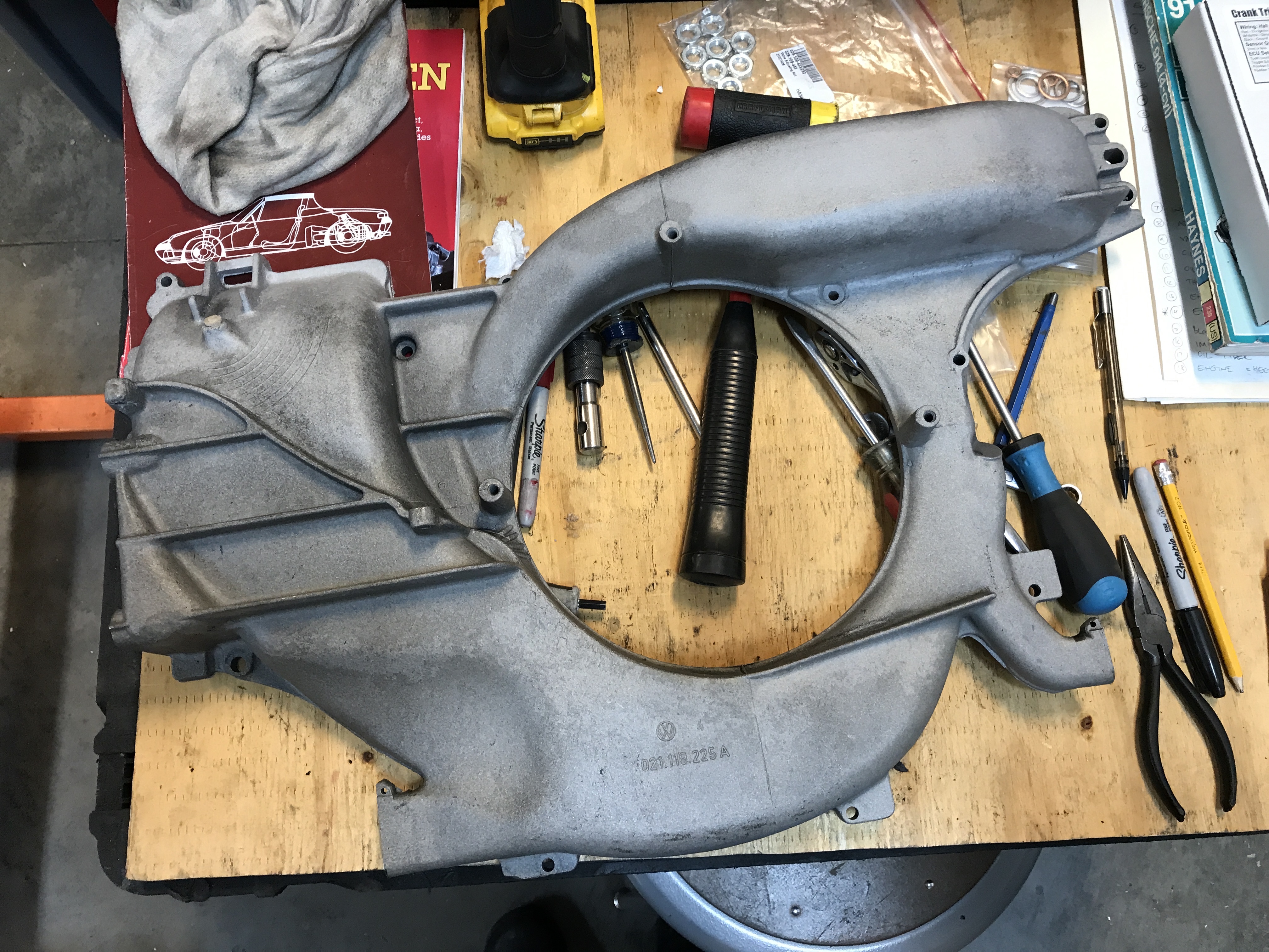

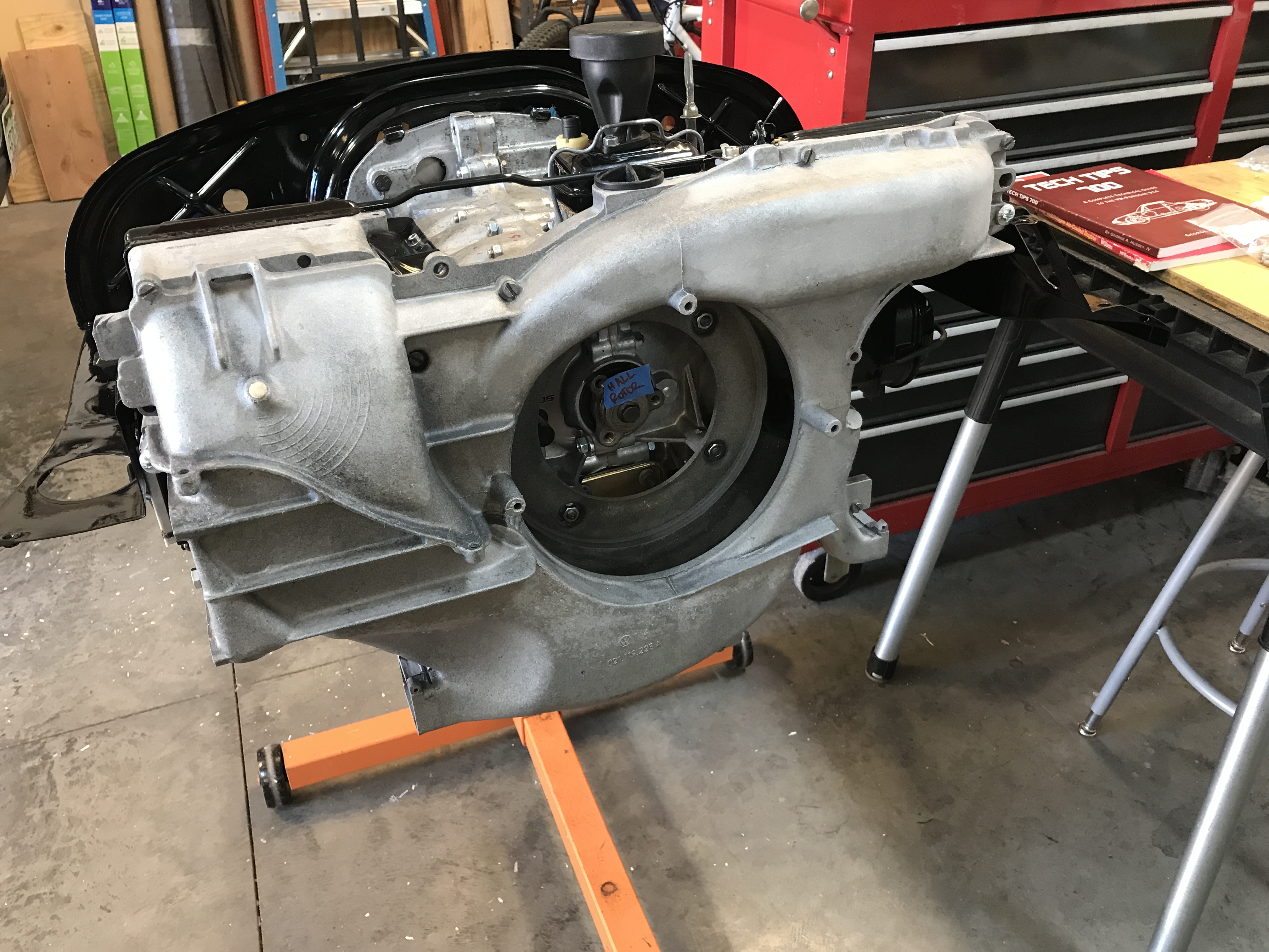

Time to install the front half of the blower housing.

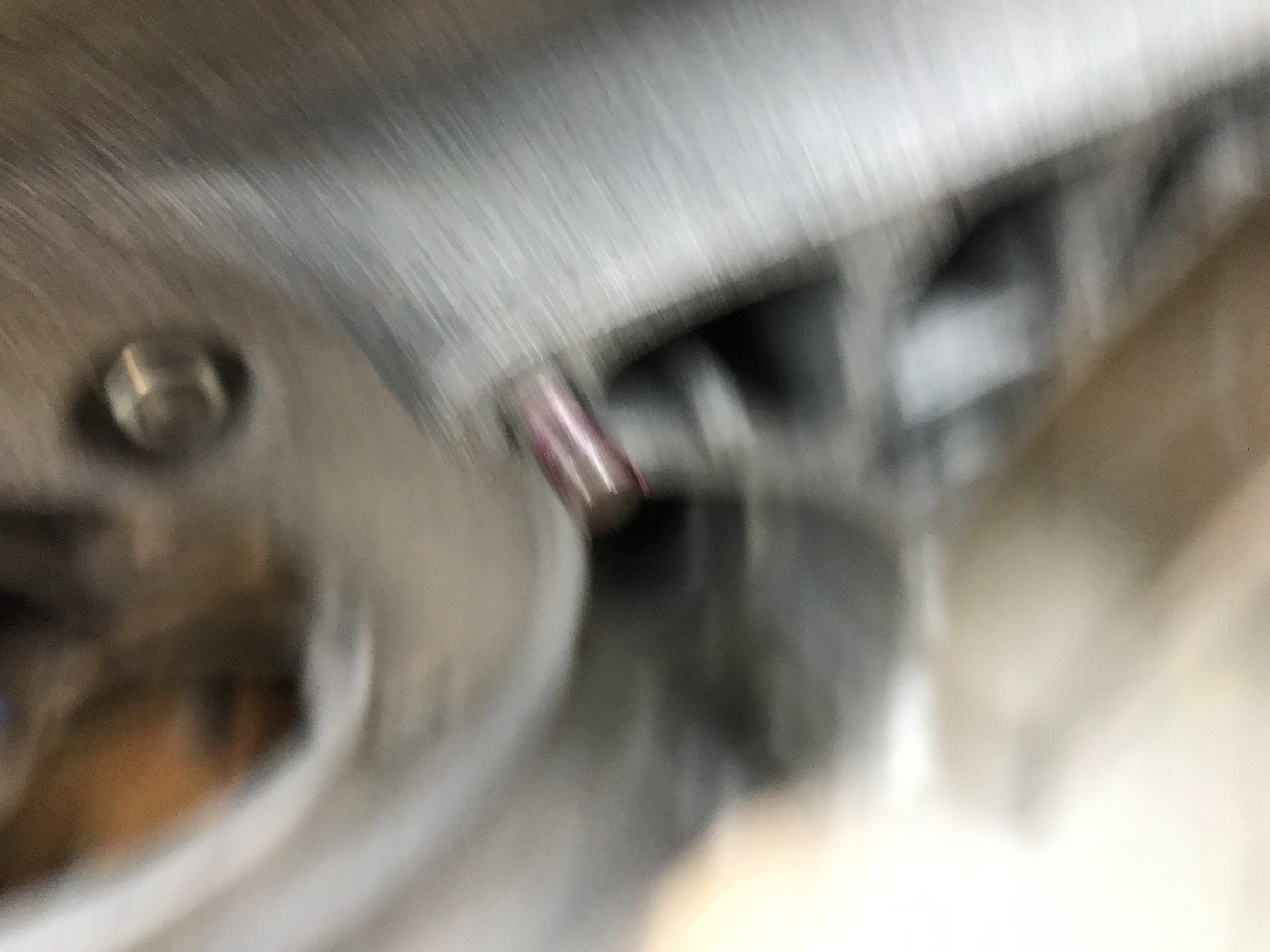

A smear of grease on the locator pins. Sorry for the blurry photo.

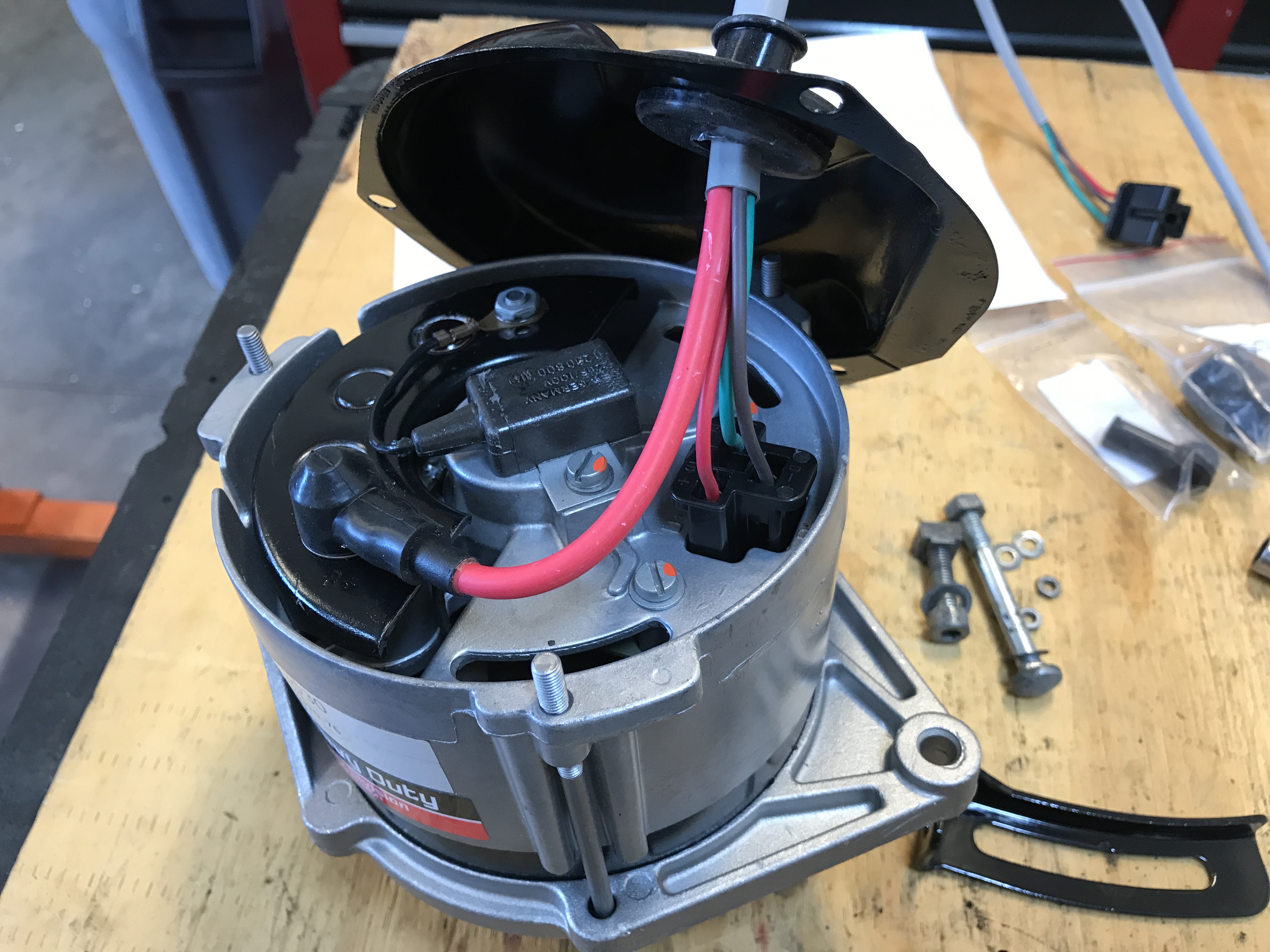

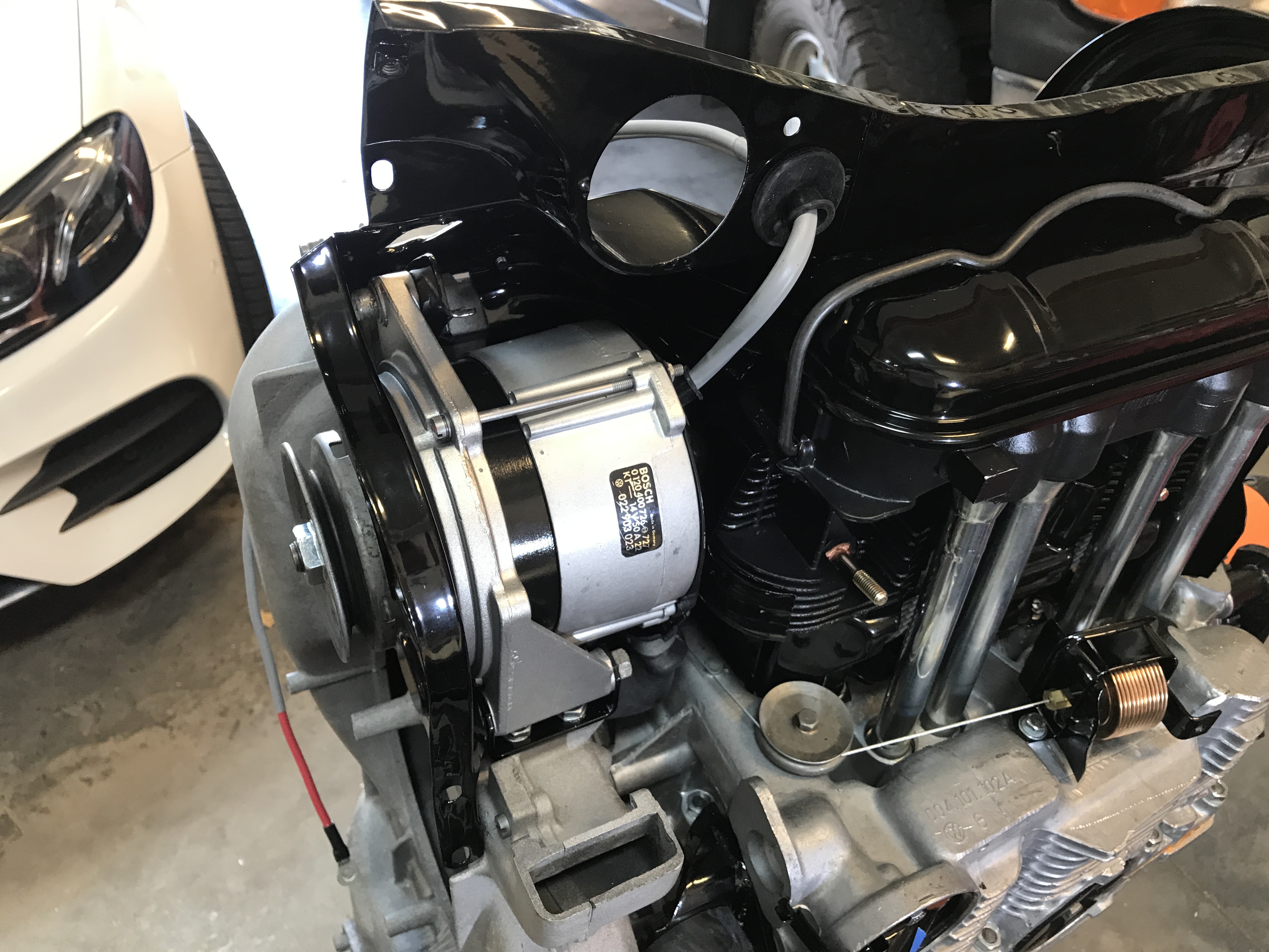

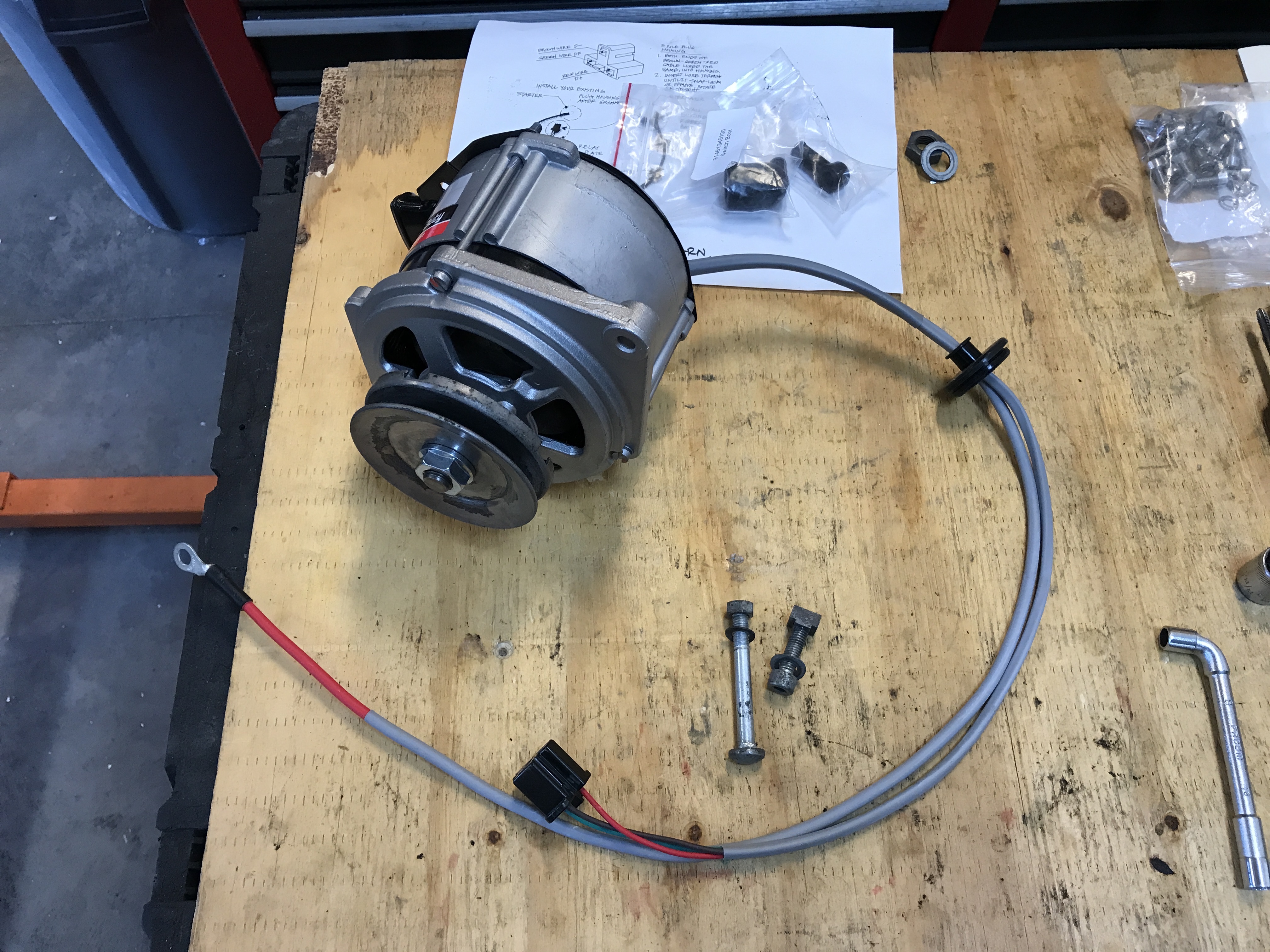

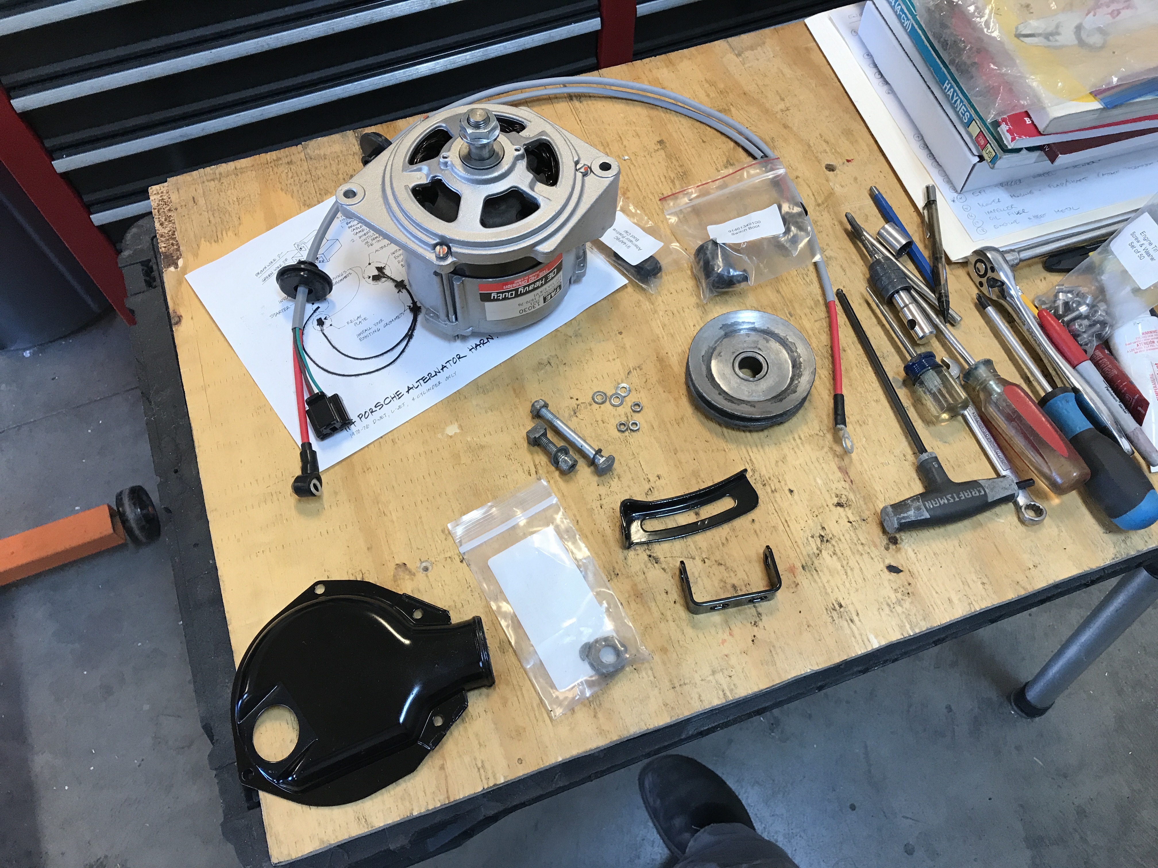

With the housing together, I can install the alternator. First to put together the rebuilt unit with all the other parts, including a new wiring harness.
post Oct 29 2021, 07:33 PM
Post #4025
Posts: 8,530
Connections on the alternator.
post Oct 29 2021, 07:35 PM
Post #4026
Posts: 8,530
Alternator ready to install.
post Oct 29 2021, 07:37 PM
Post #4027
Posts: 8,530

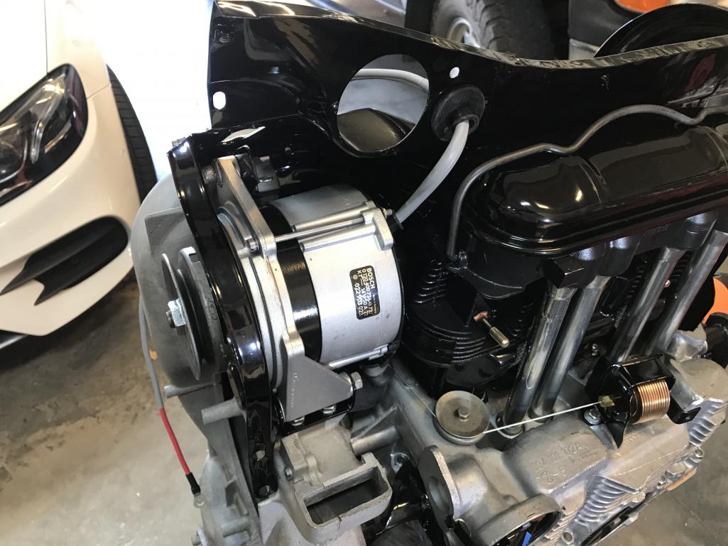

Brackets, sheet metal, and alternator installed, with the new cables routed through the side sheet metal.

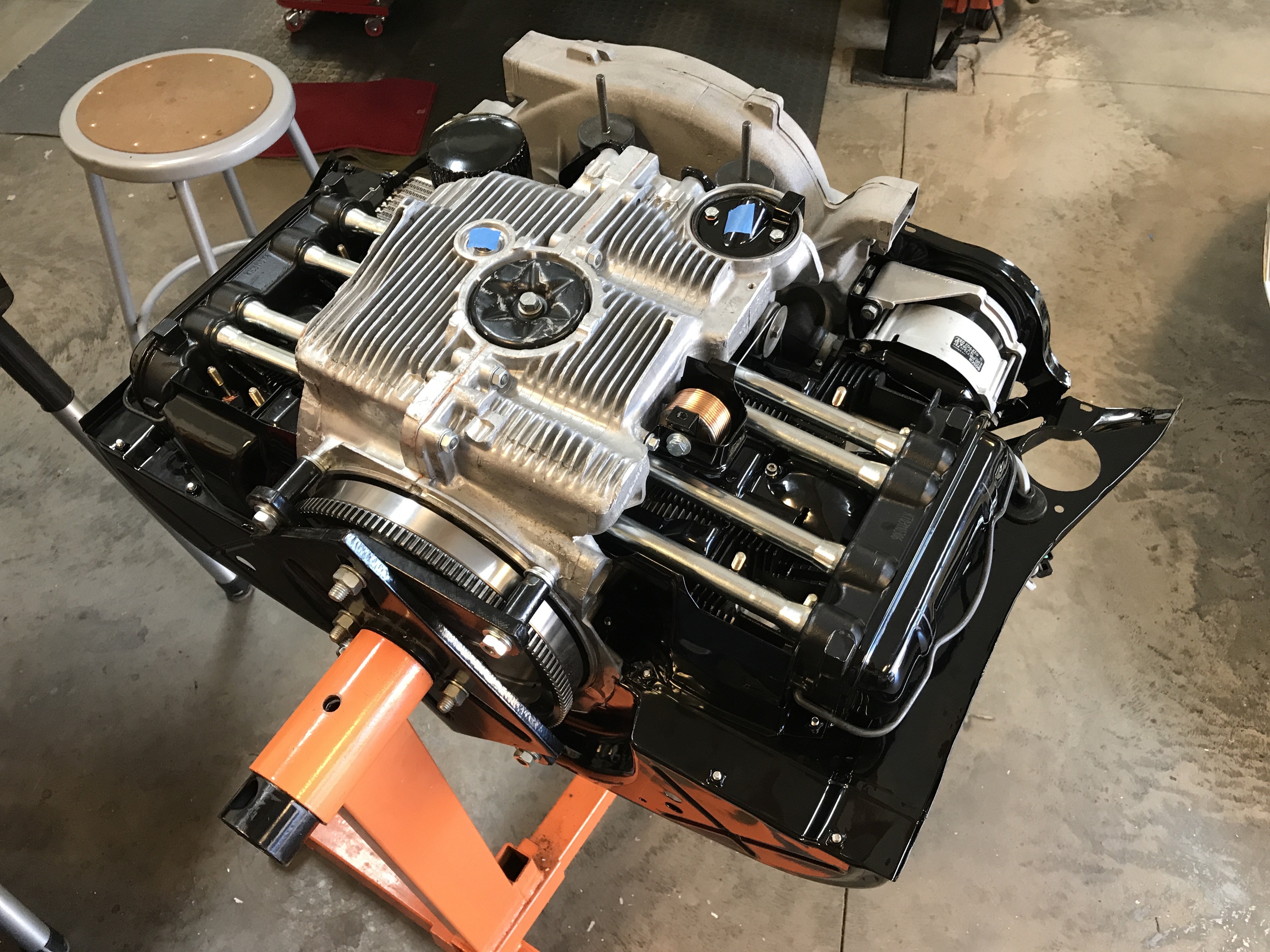

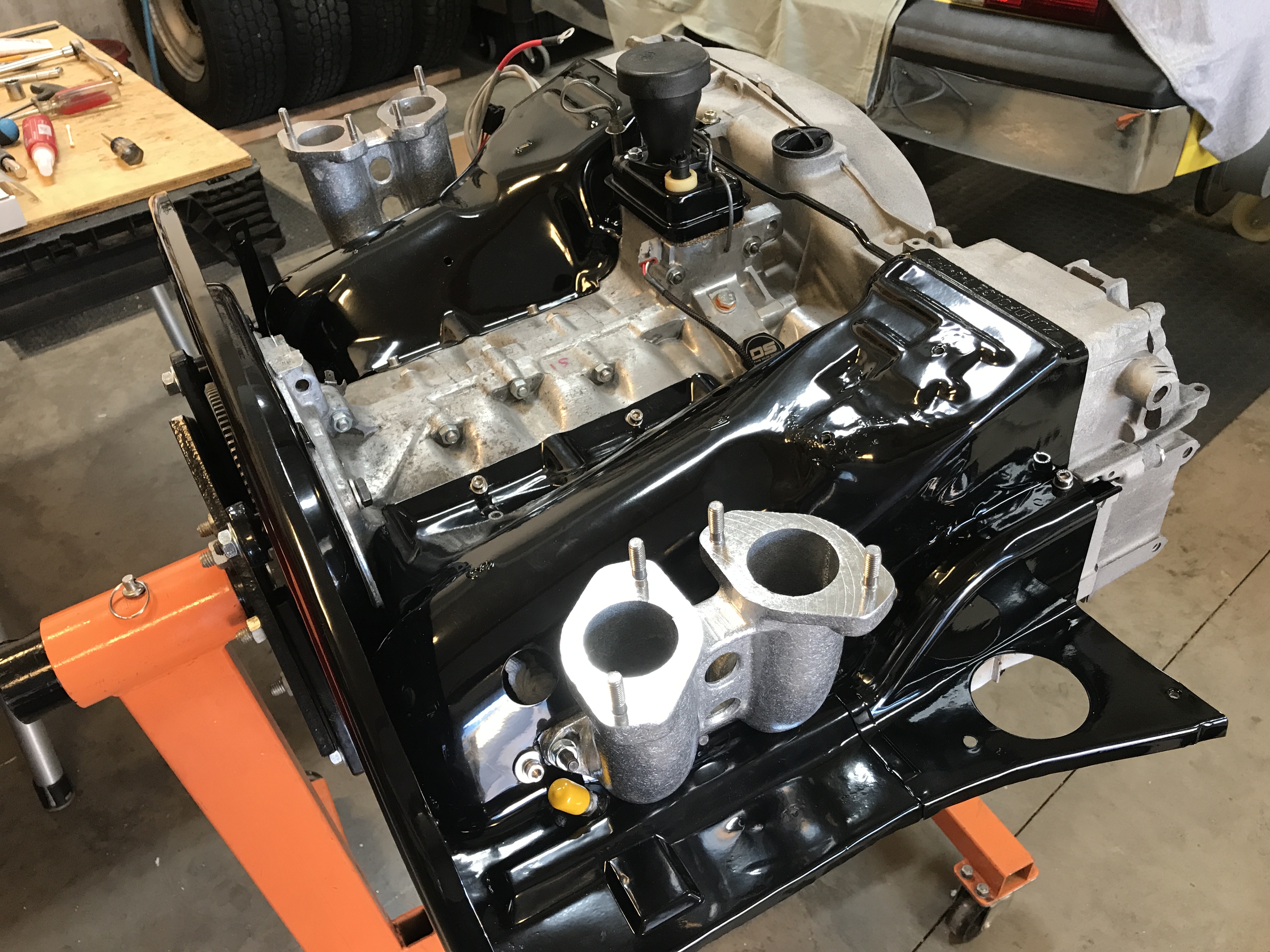

Now, for the new EFI fun. Just to get started, I temporarily installed the twin manifolds.

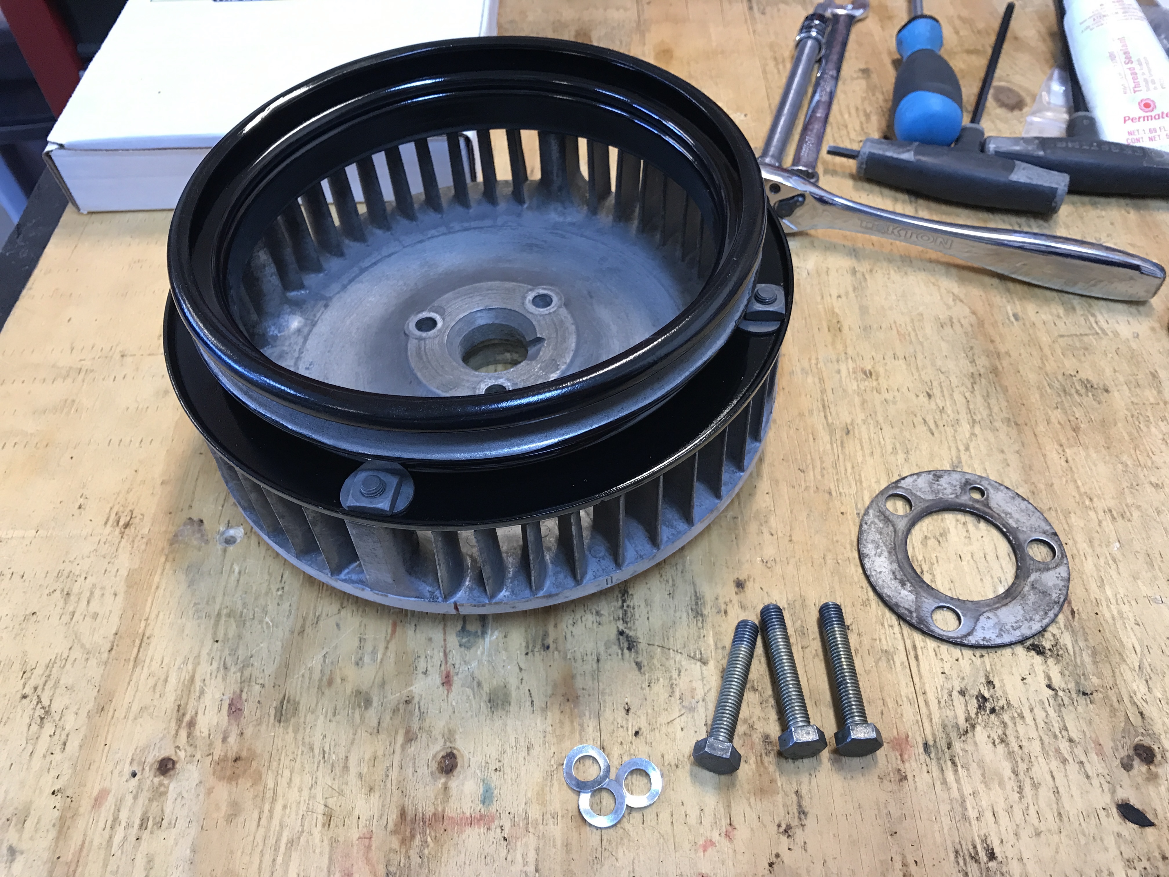

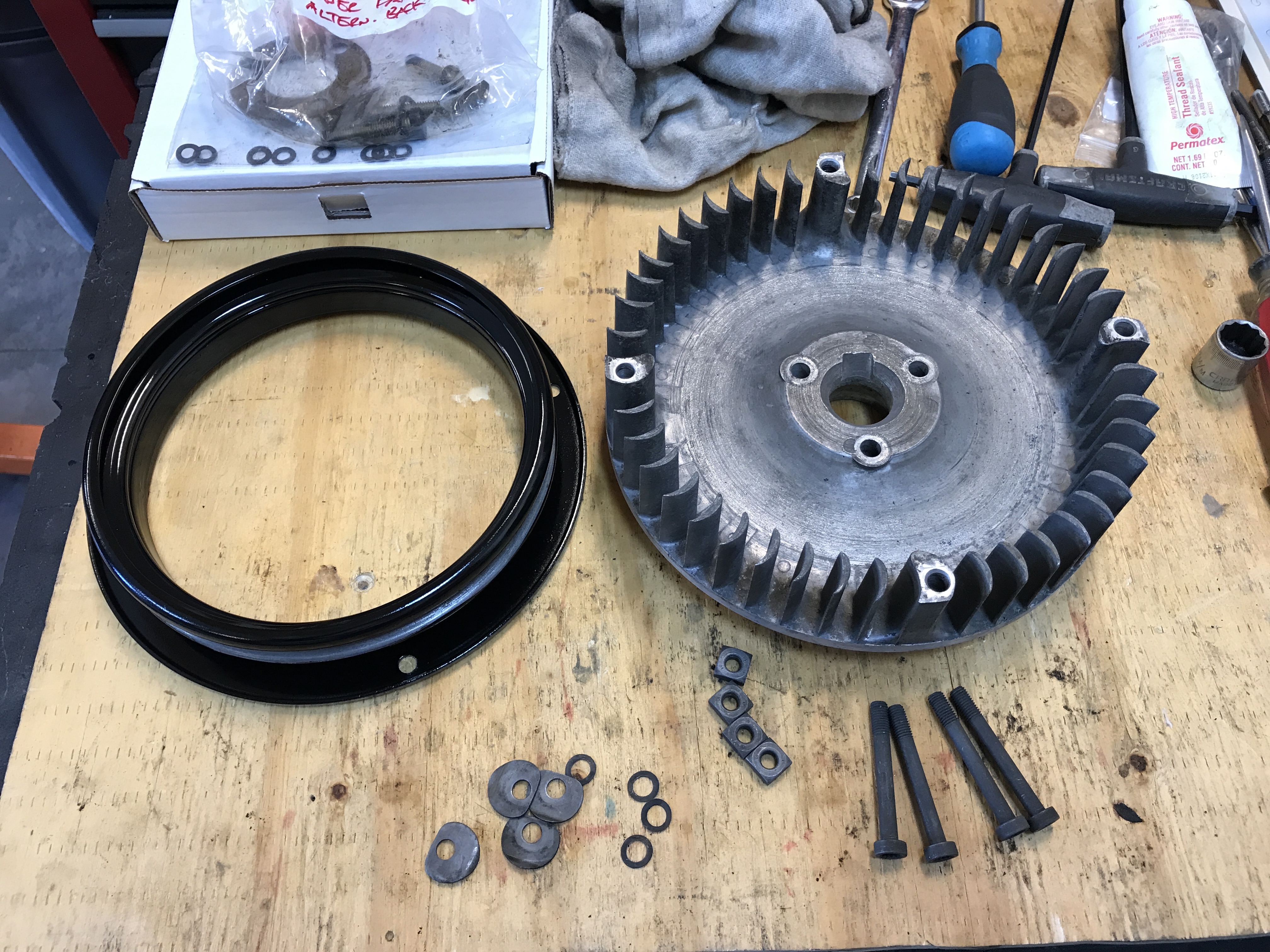

Last stock engine component: blower fan components.
post Oct 30 2021, 08:36 PM
Post #4031
Posts: 8,530
Ready to install. I reused the original mounting bolts since they are an unusual length.

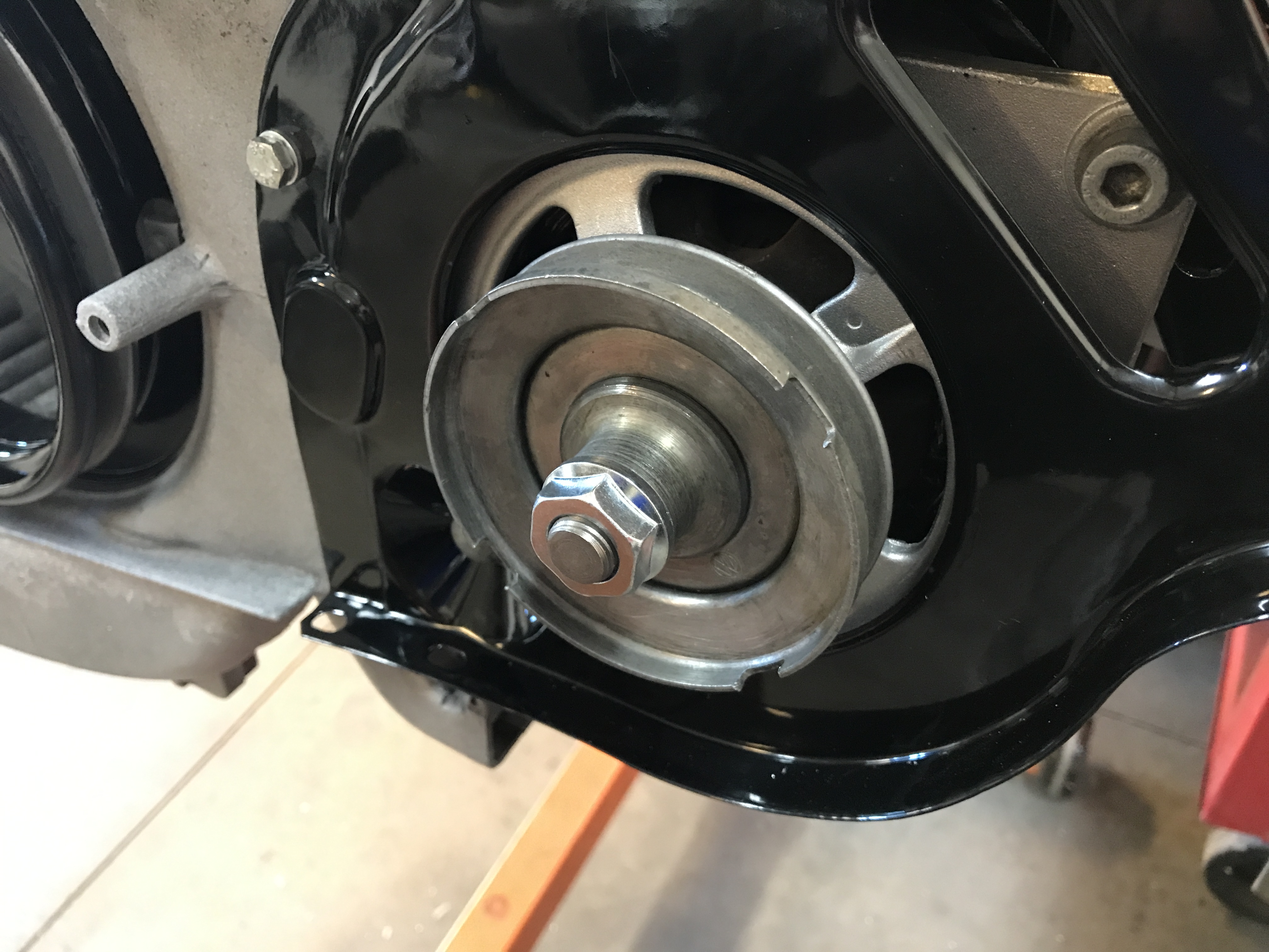

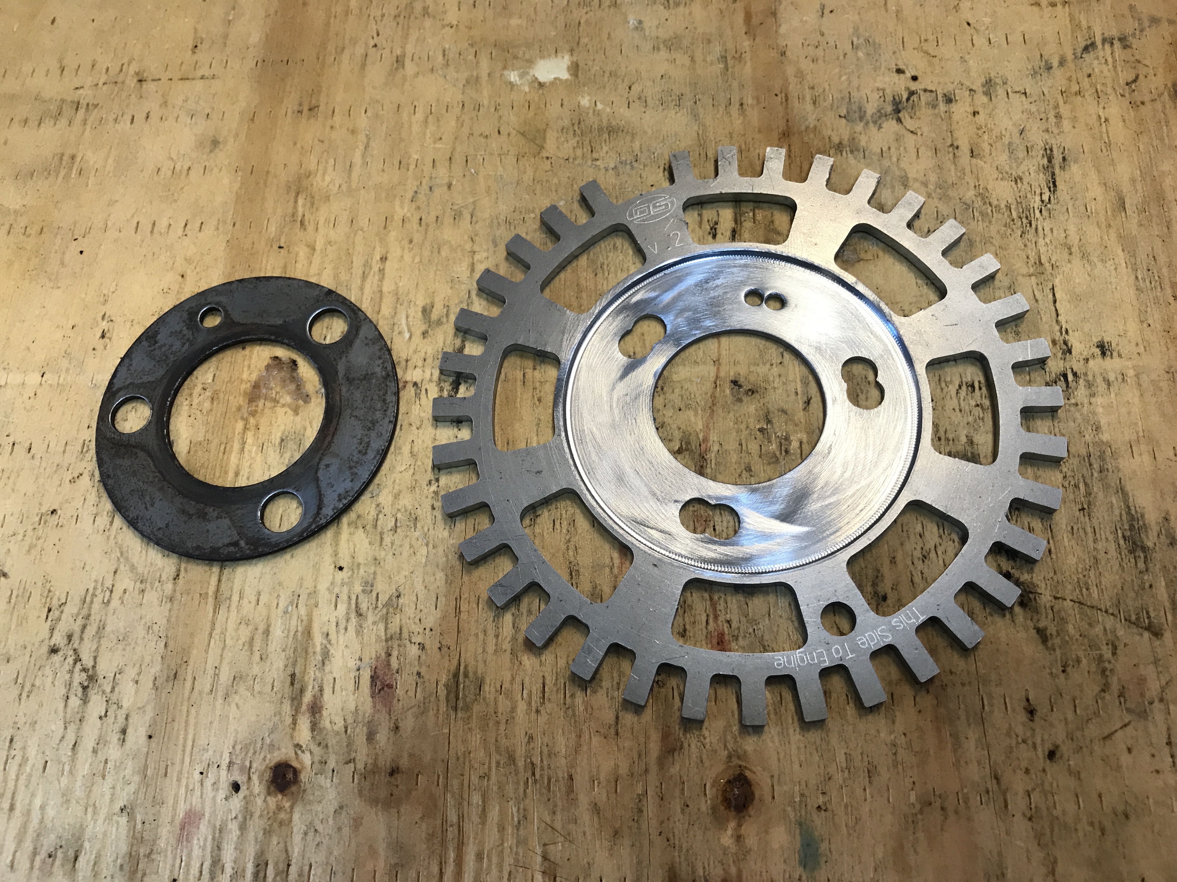

But I did not used the original A/C washer, since the Hall sensor trigger wheel replaces that.

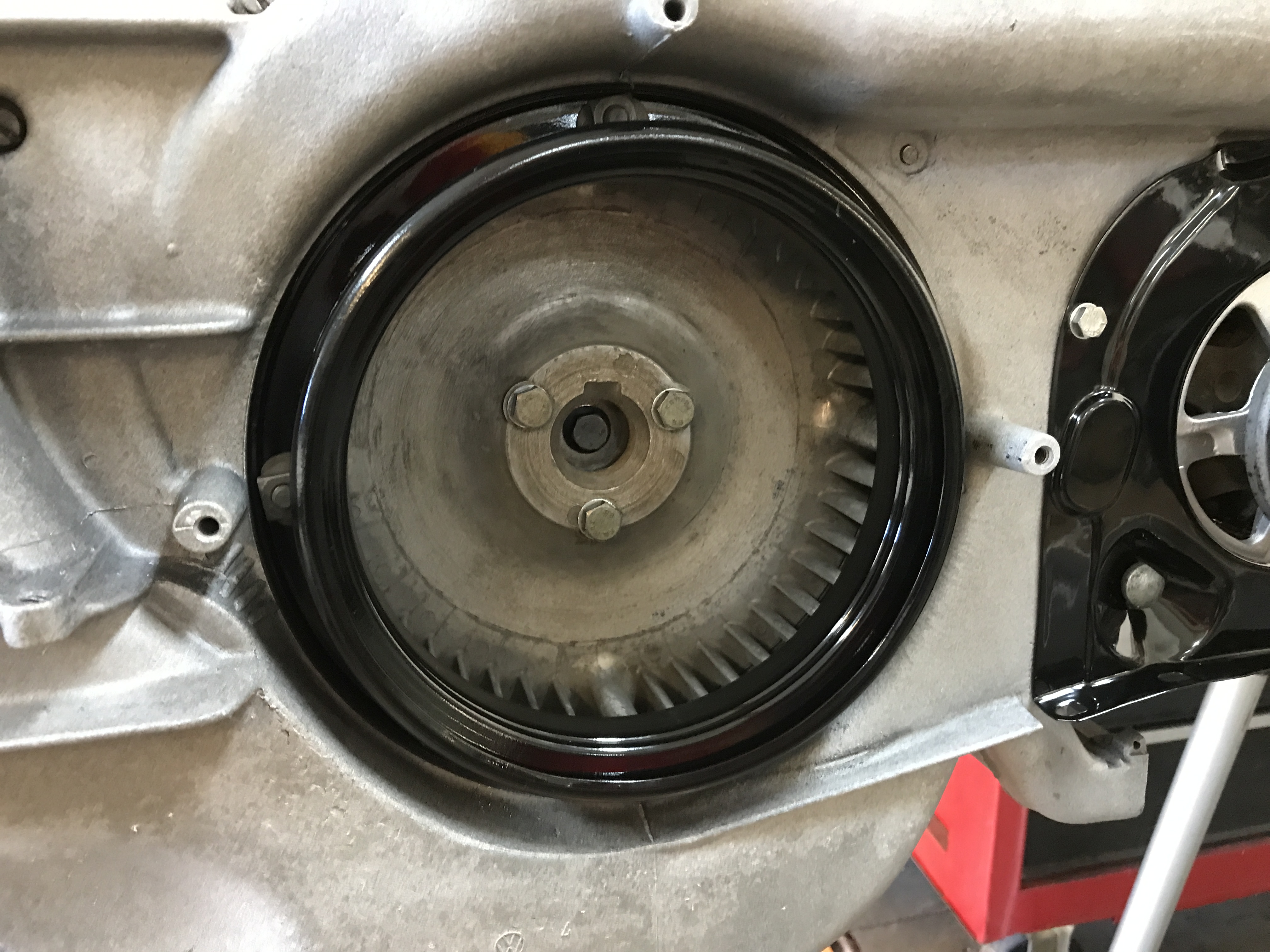

post Oct 30 2021, 08:41 PM
Post #4033
Posts: 8,530

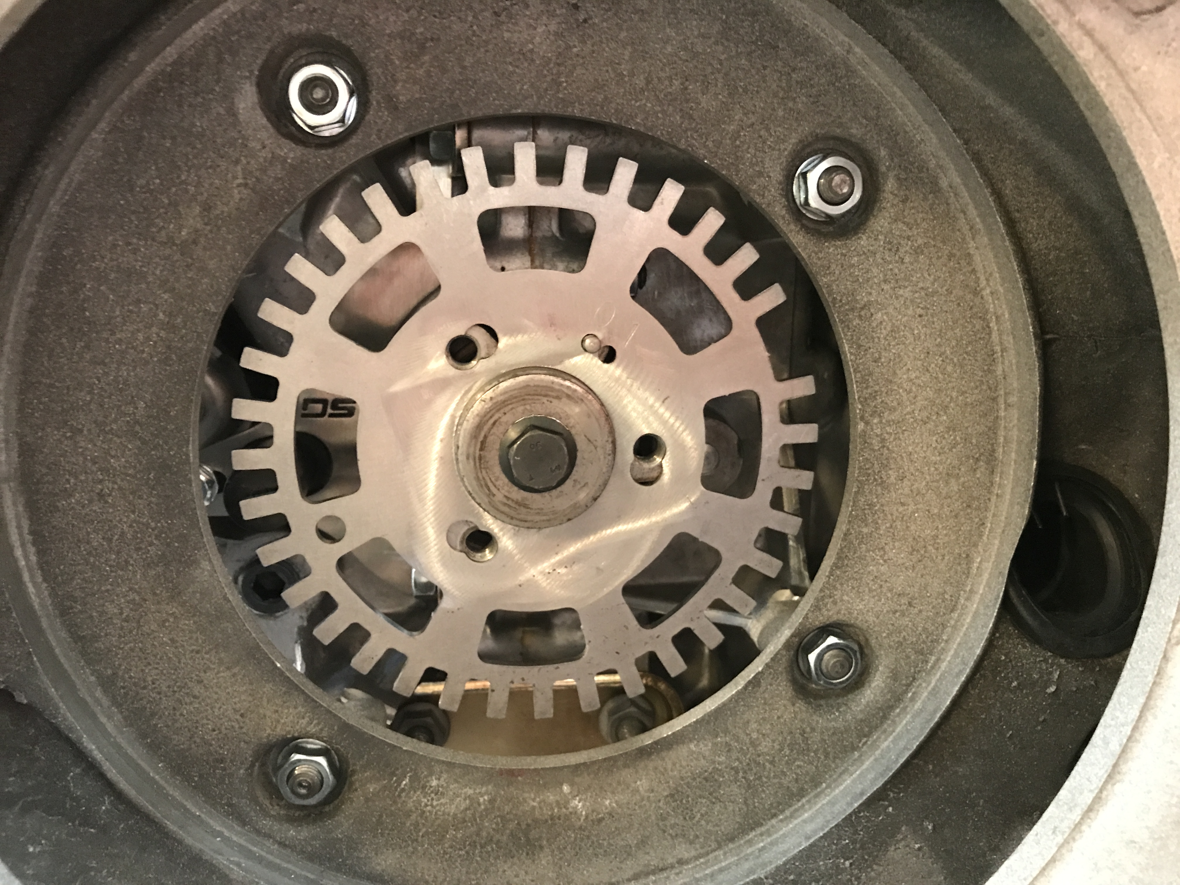

Trigger wheel in place. I double checked the clearance with the sensor, which is about 1.5 mm (spec is less than 2.0).

Fan installed.
post Oct 30 2021, 08:44 PM
Post #4035
Posts: 8,530

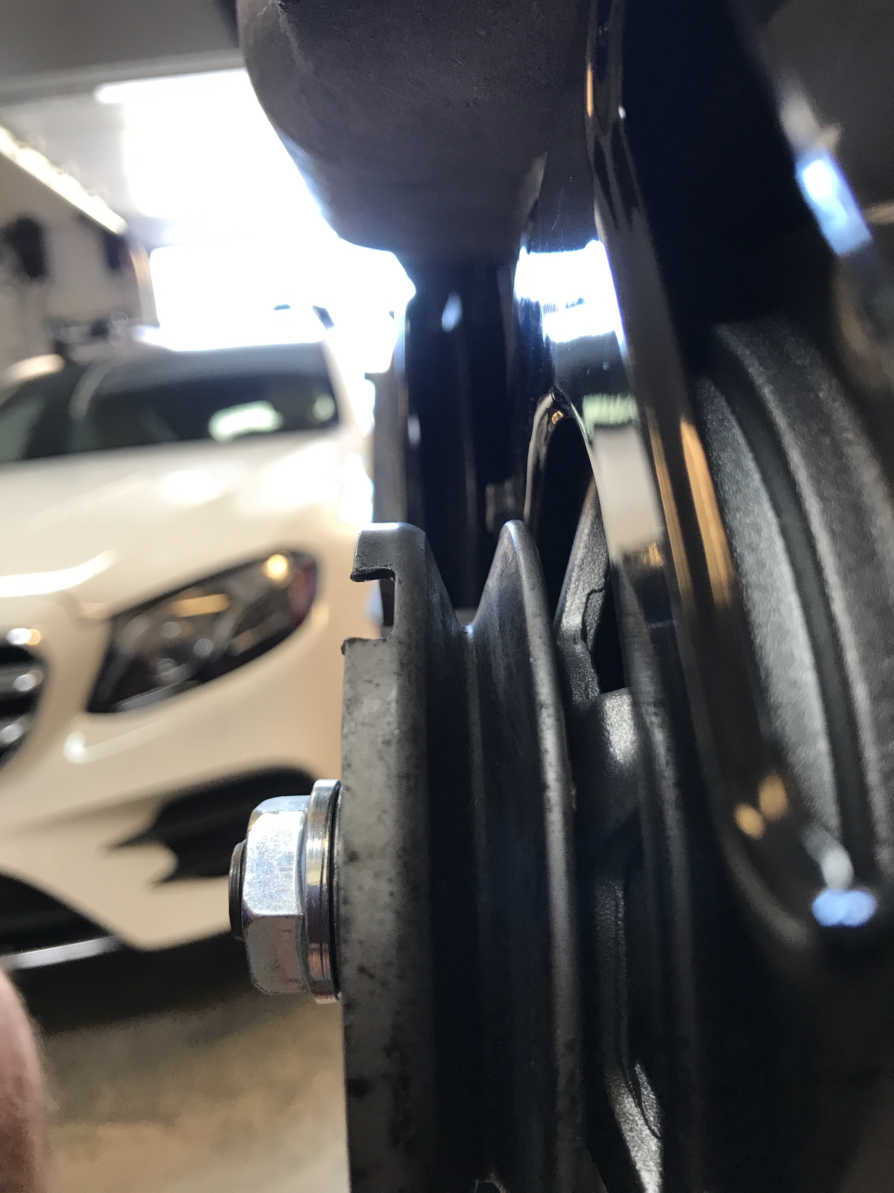

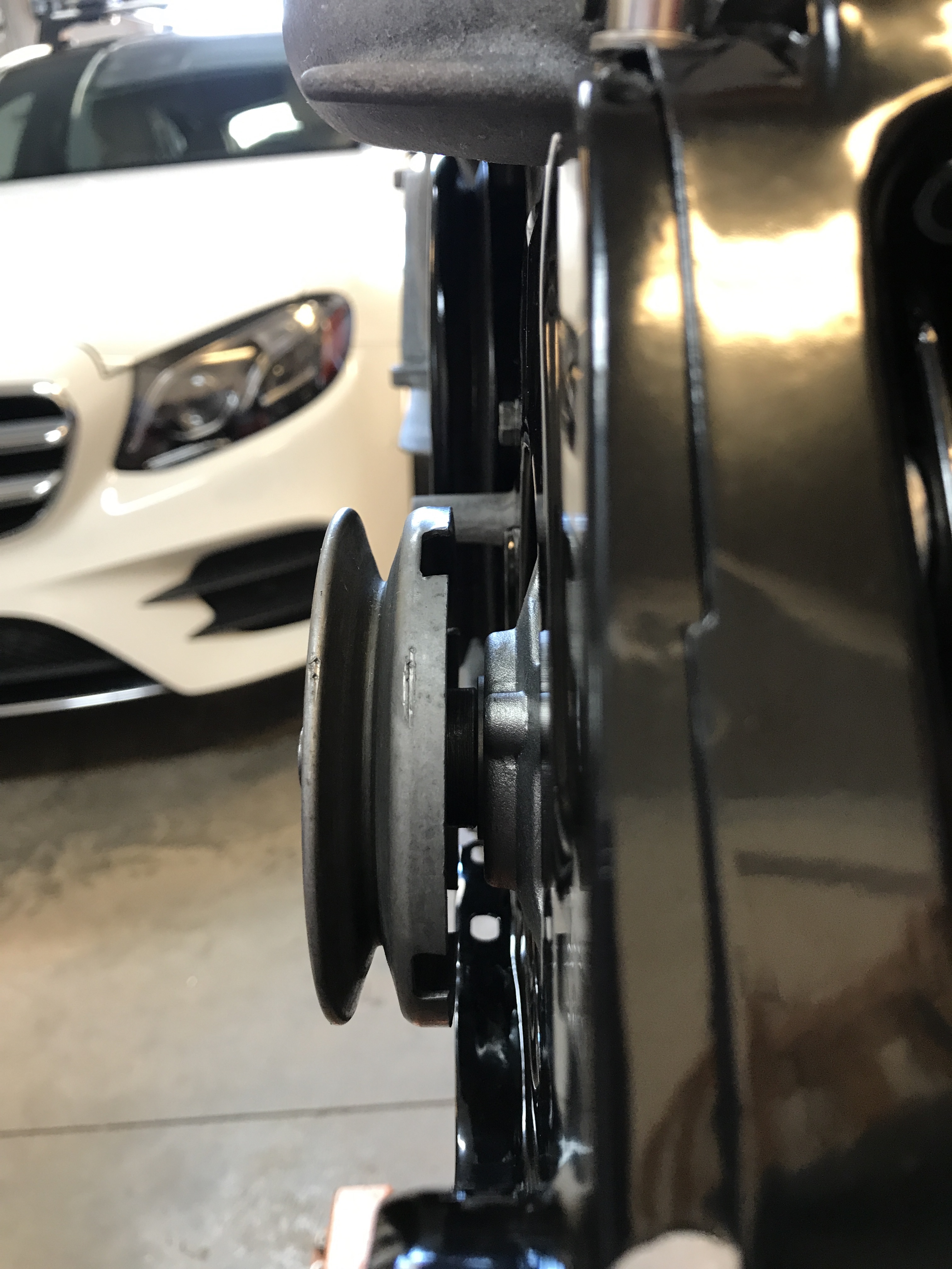

But then I saw that the fan belt grooves were not aligned, and I had installed the alternator pulley backwards.
(And nobody noticed? What good are you guys?)
post Oct 30 2021, 08:45 PM
Post #4036
Posts: 8,530
Now, this is correct.
post Oct 30 2021, 08:46 PM
Post #4037
Posts: 8,530
Grooves now line up.
post Oct 30 2021, 08:47 PM
Post #4038
Posts: 8,530
Checking the engine underside. Looks good to me.
post Oct 31 2021, 11:34 AM
Post #4039
Posts: 4,328
Joined: 12-November 20
From: Buffalo
Member No.: 24,877
QUOTE(bkrantz @ Oct 30 2021, 08:44 PM) *
Sorry, I was blinded by all the shiny parts.
post Oct 31 2021, 07:15 PM
Post #4040
Posts: 8,530
QUOTE(930cabman @ Oct 31 2021, 11:34 AM) *
Me too (at least that's my excuse this time).
