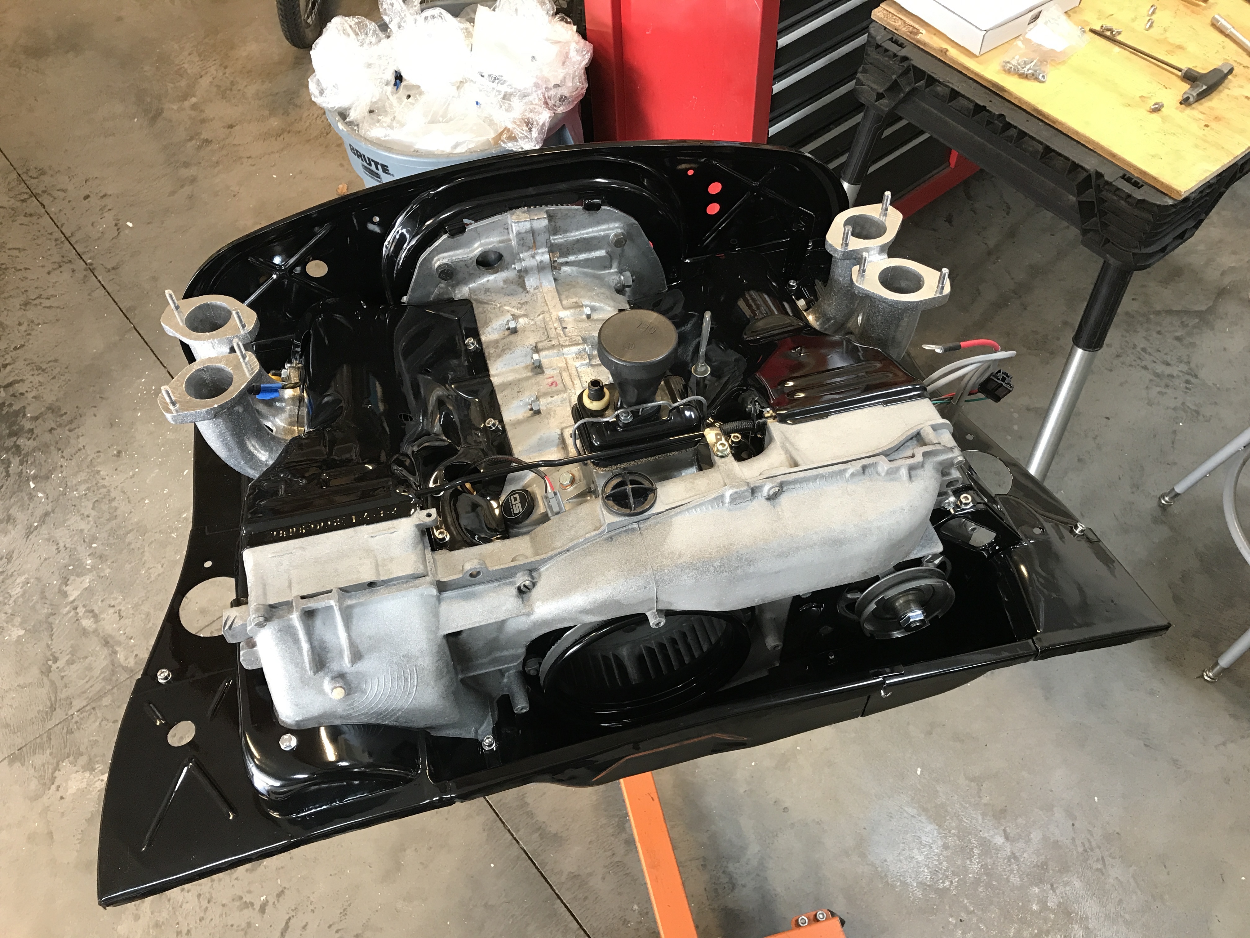

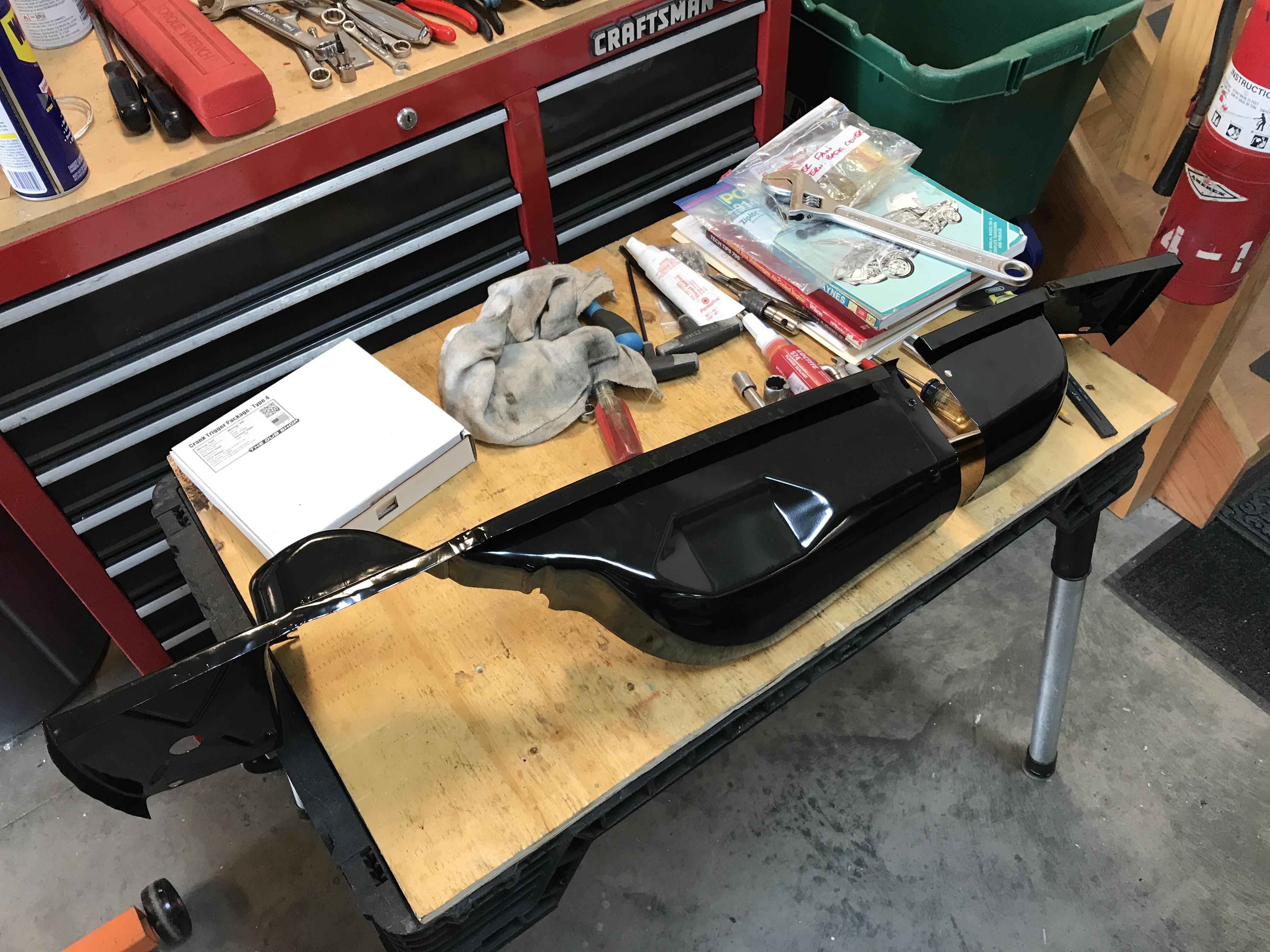

The last of the sheet metal, front pieces.
post Oct 31 2021, 07:20 PM
Post #4042
Posts: 8,530
Fully dressed.

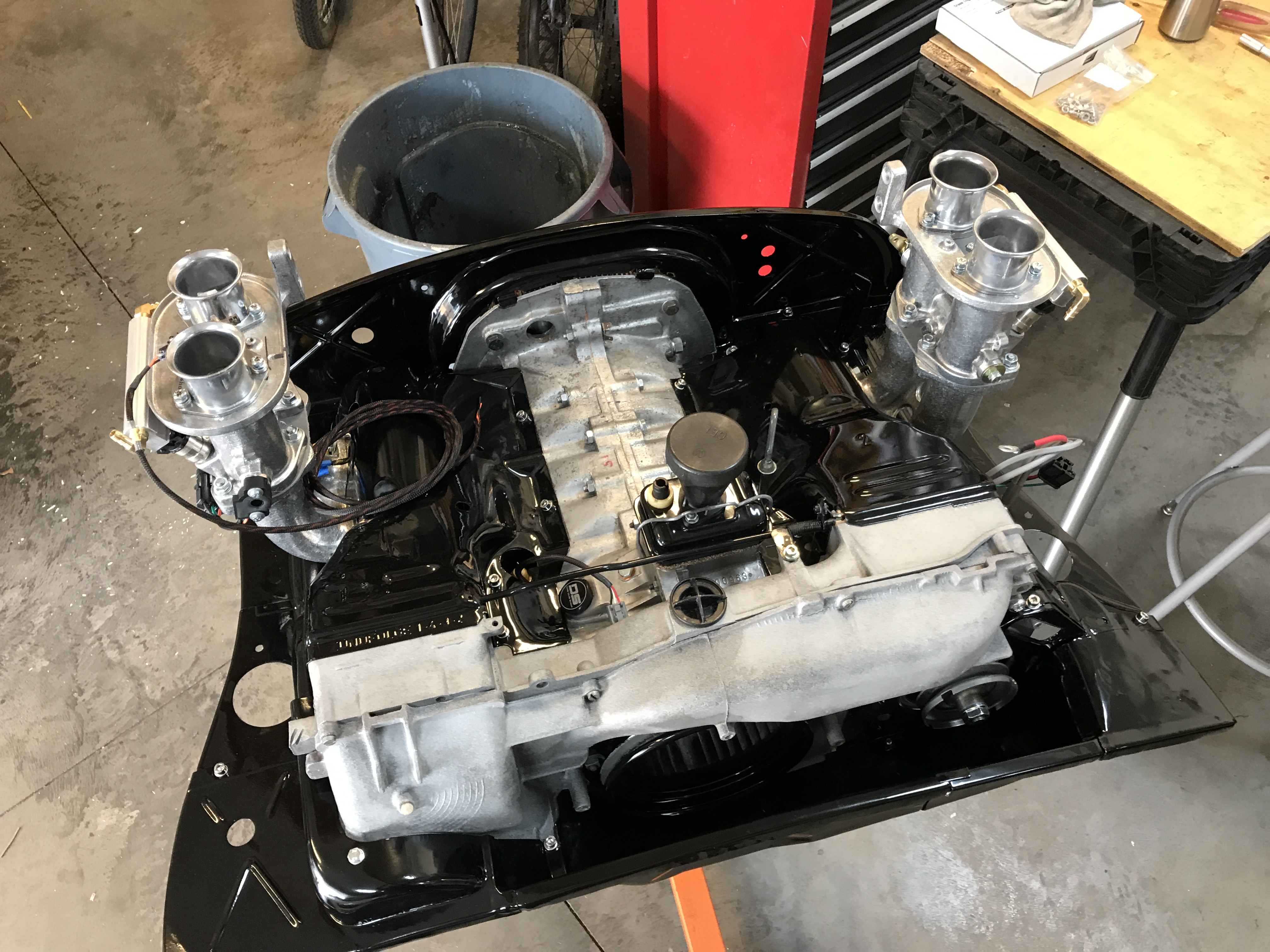

Time to get serious about the new EFI system. Starting with an eye-candy shot.

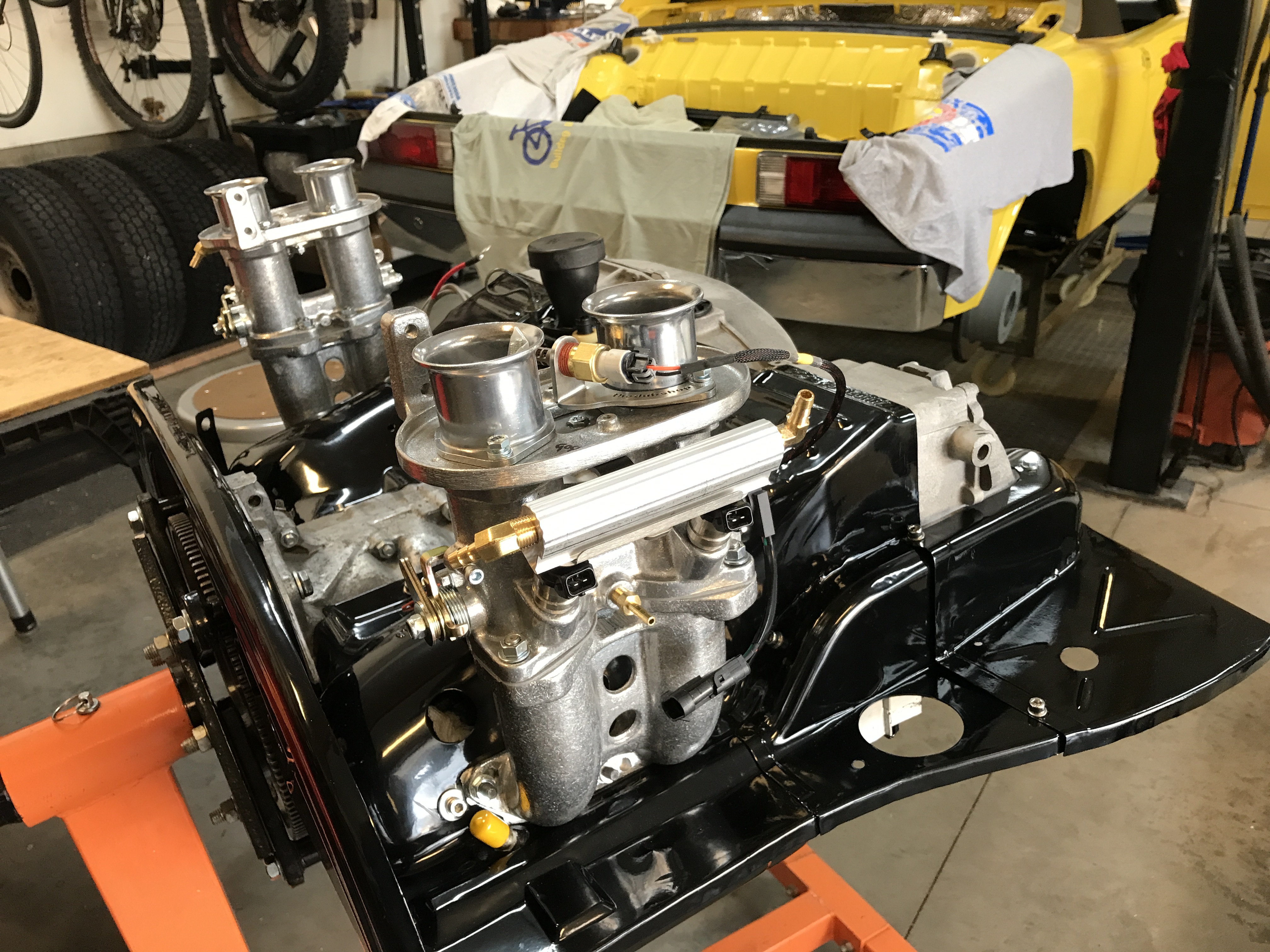

But more seriously, I hope to get as much plumbing and wiring, plus the throttle linkage, done with the engine out.

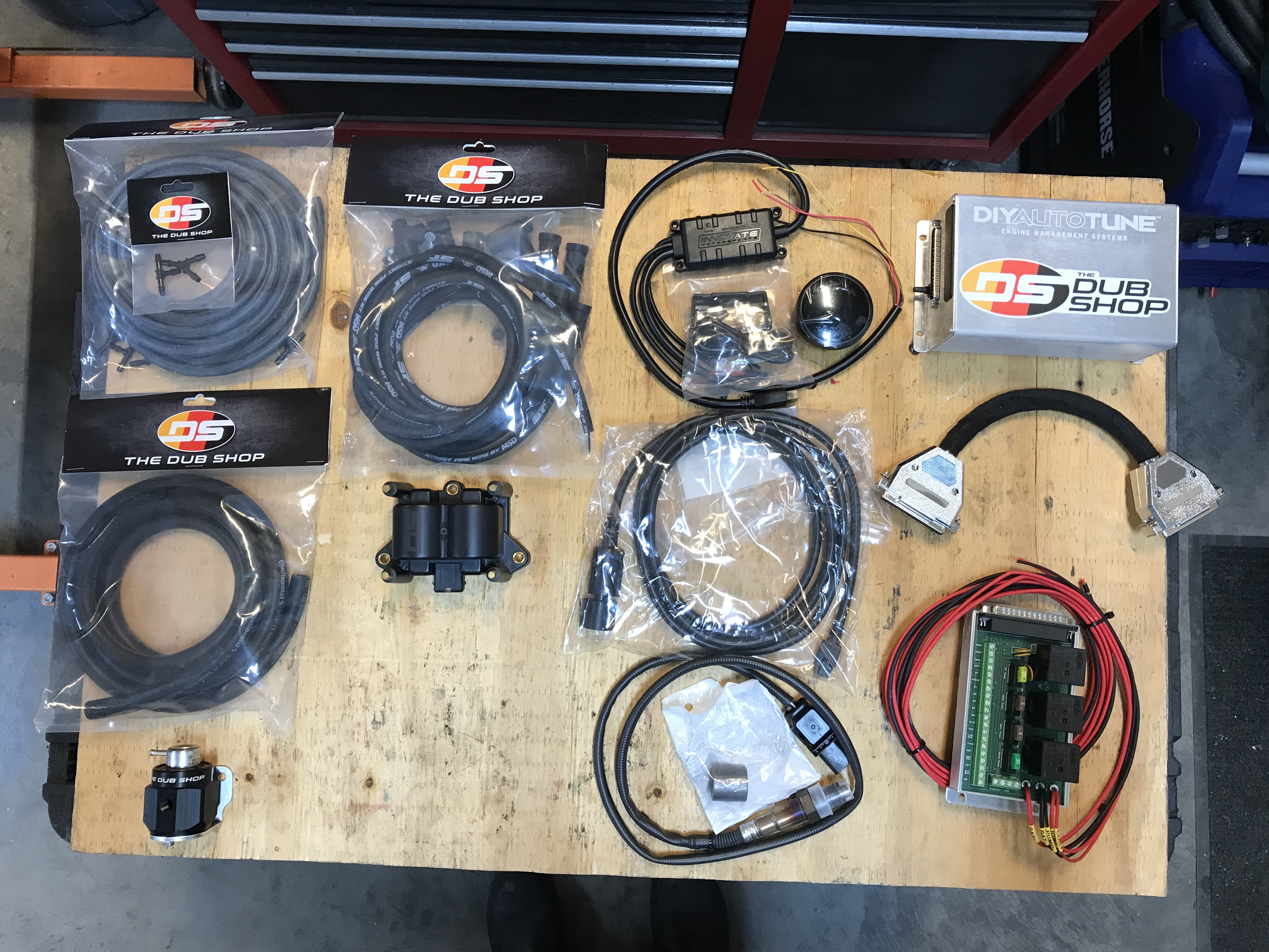

So here are the major components of the EFI and ignition system I need to install.
On the left, vacuum lines, fuel lines, and fuel pressure regulator.
Next, plug wire kit and electronic coil.
Next, air-fuel ration gauge, lamda kit, cables, and O2 sensor (with bung to be welded into exhaust).
Right, the ECU, relay board, and cable to connect them.

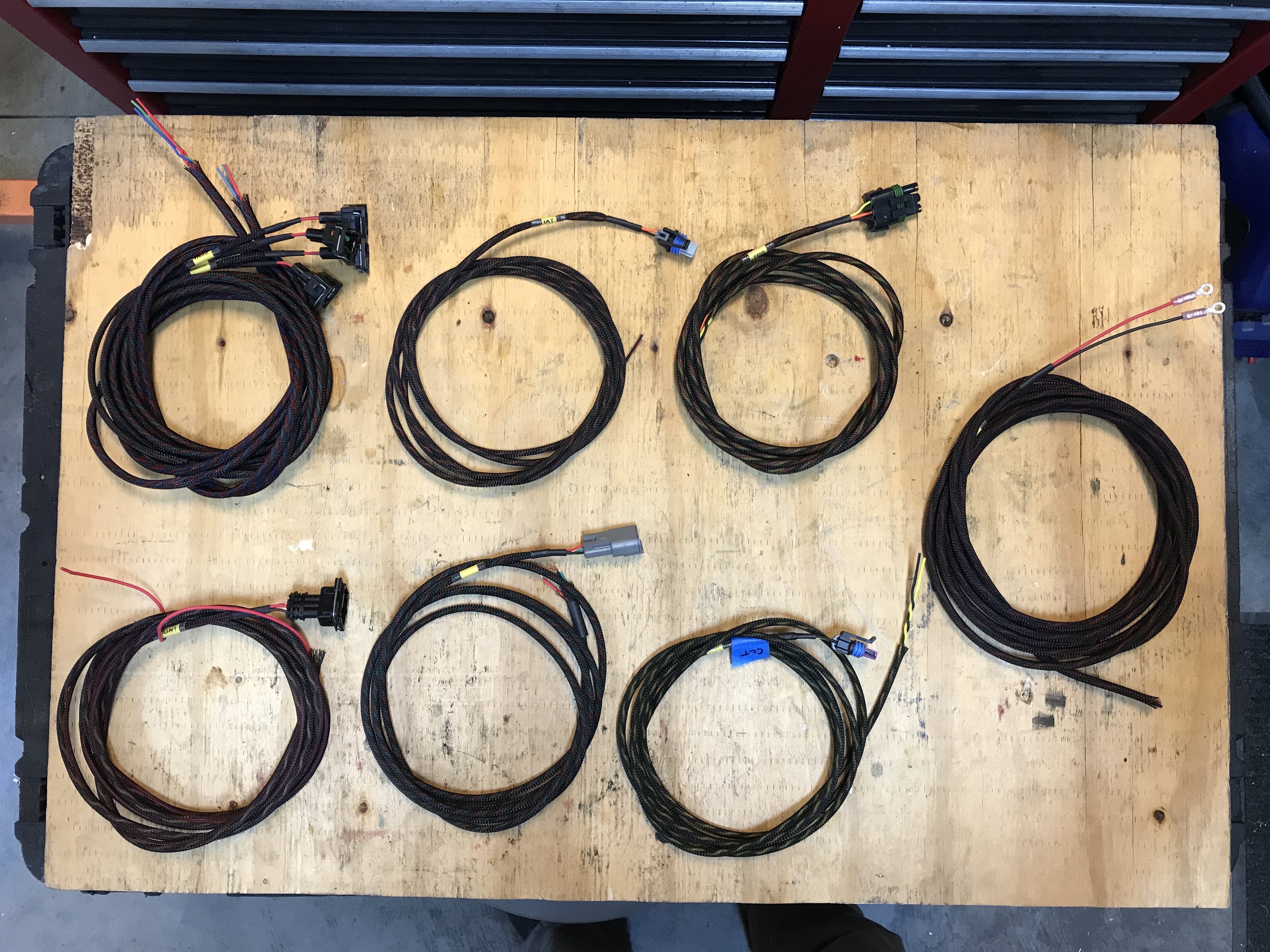

Posts: 8,530
Plus a bunch of wires to connect them all.
Looks like fun, right?

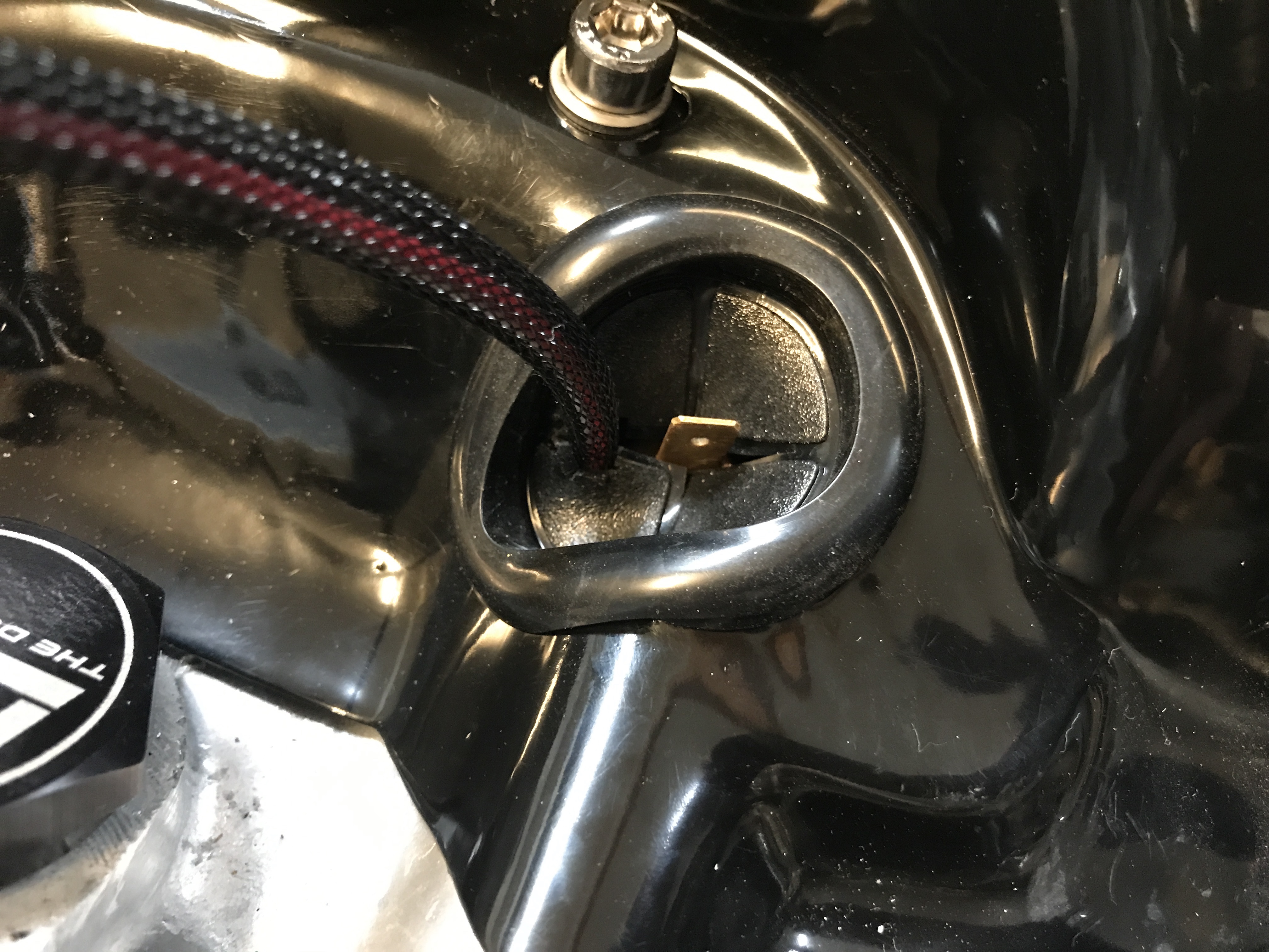

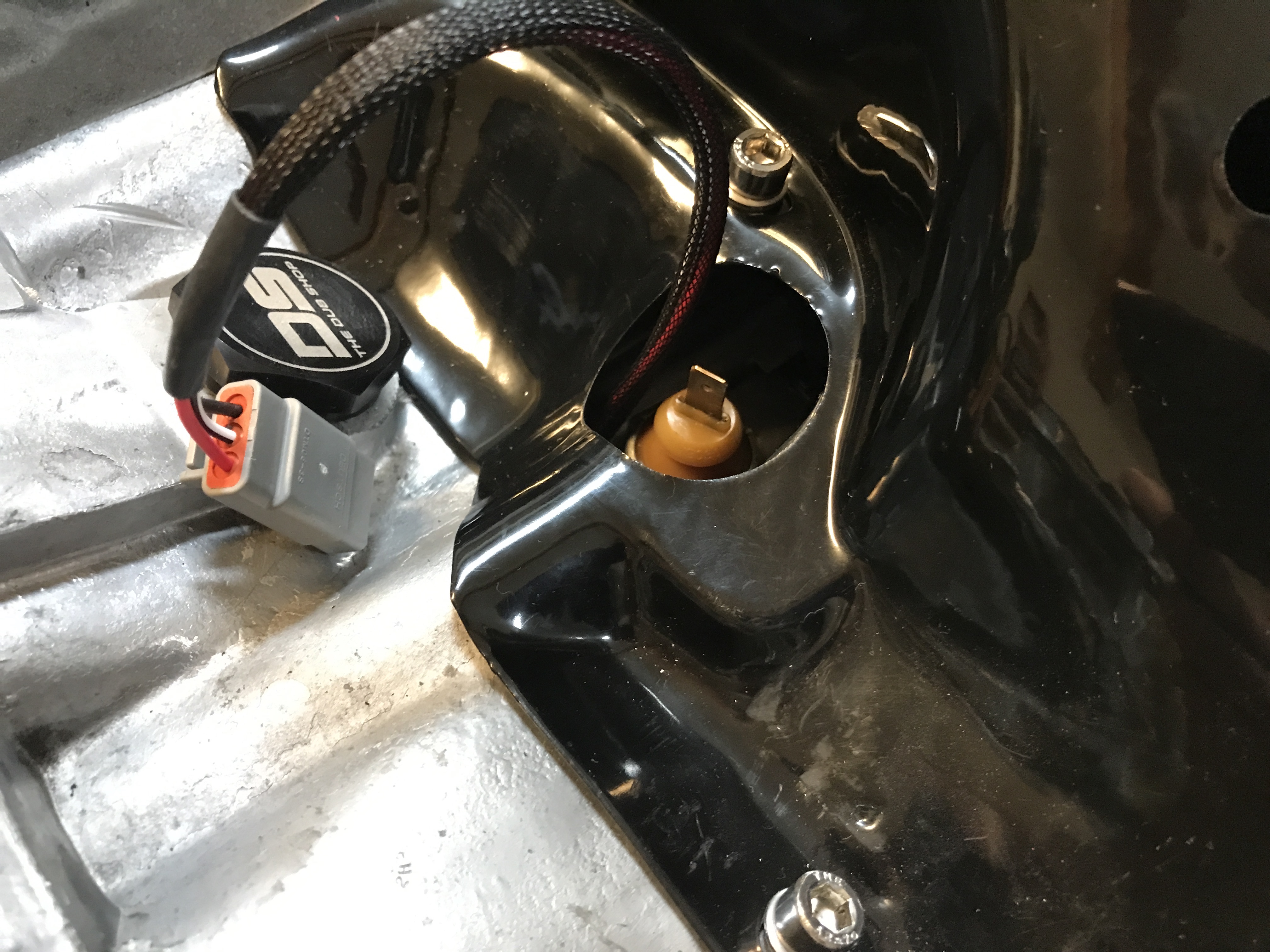

Just a bit of garage time today. Here is the hole in the sheet metal for the oil pressure sensor, and now the lead for the CPS Hall sensor. This needs to be closed to contain the cooling air. Note the odd shape, with the hole centered on a fold in the sheet metal.
post Nov 2 2021, 07:51 PM
Post #4054

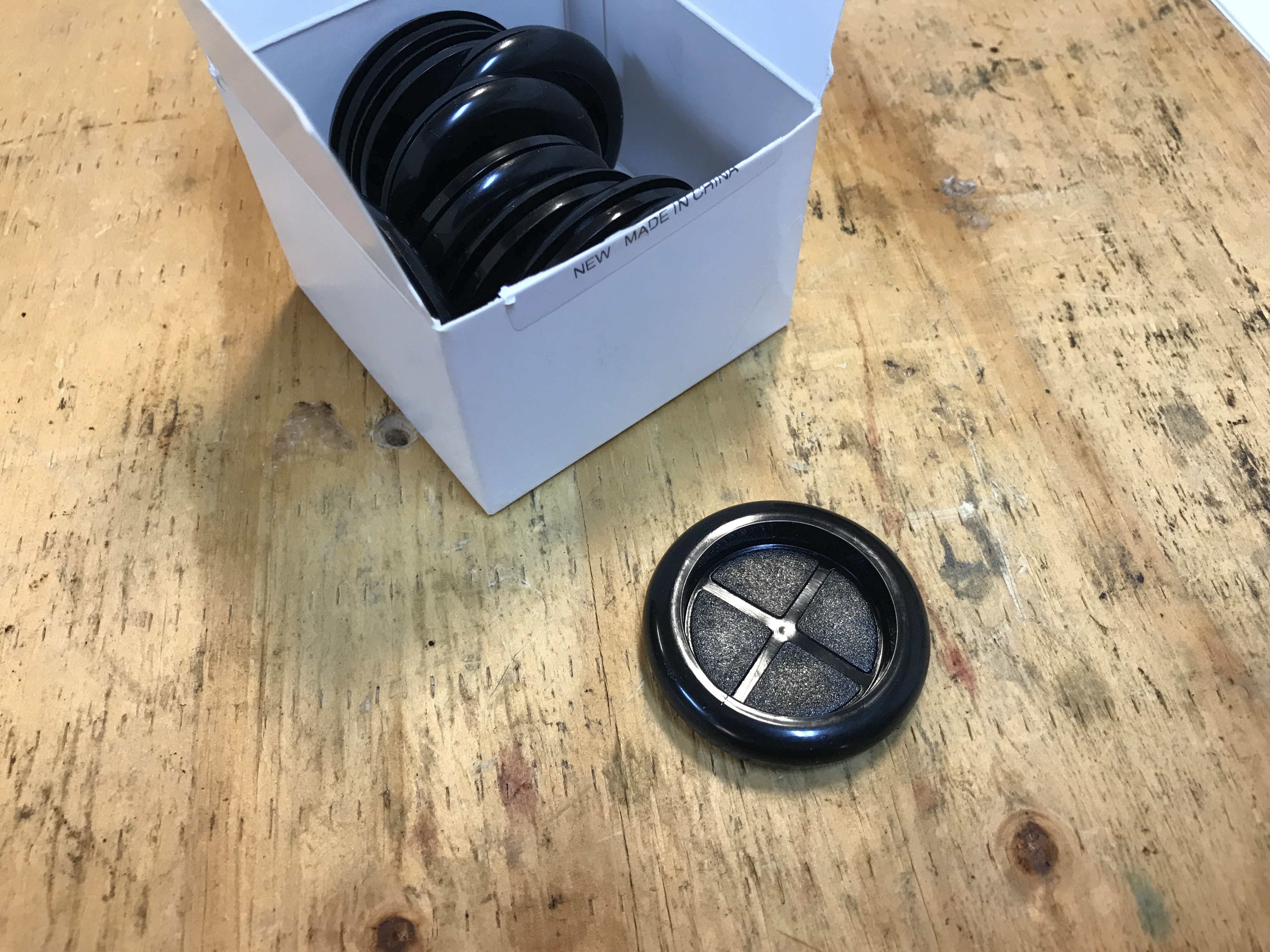

Posts: 8,530
Let's try this: a 35 mm hole plug.
post Nov 2 2021, 07:53 PM
Post #4055
Posts: 8,530
This could work, if it stays in place with air pressure inside.
