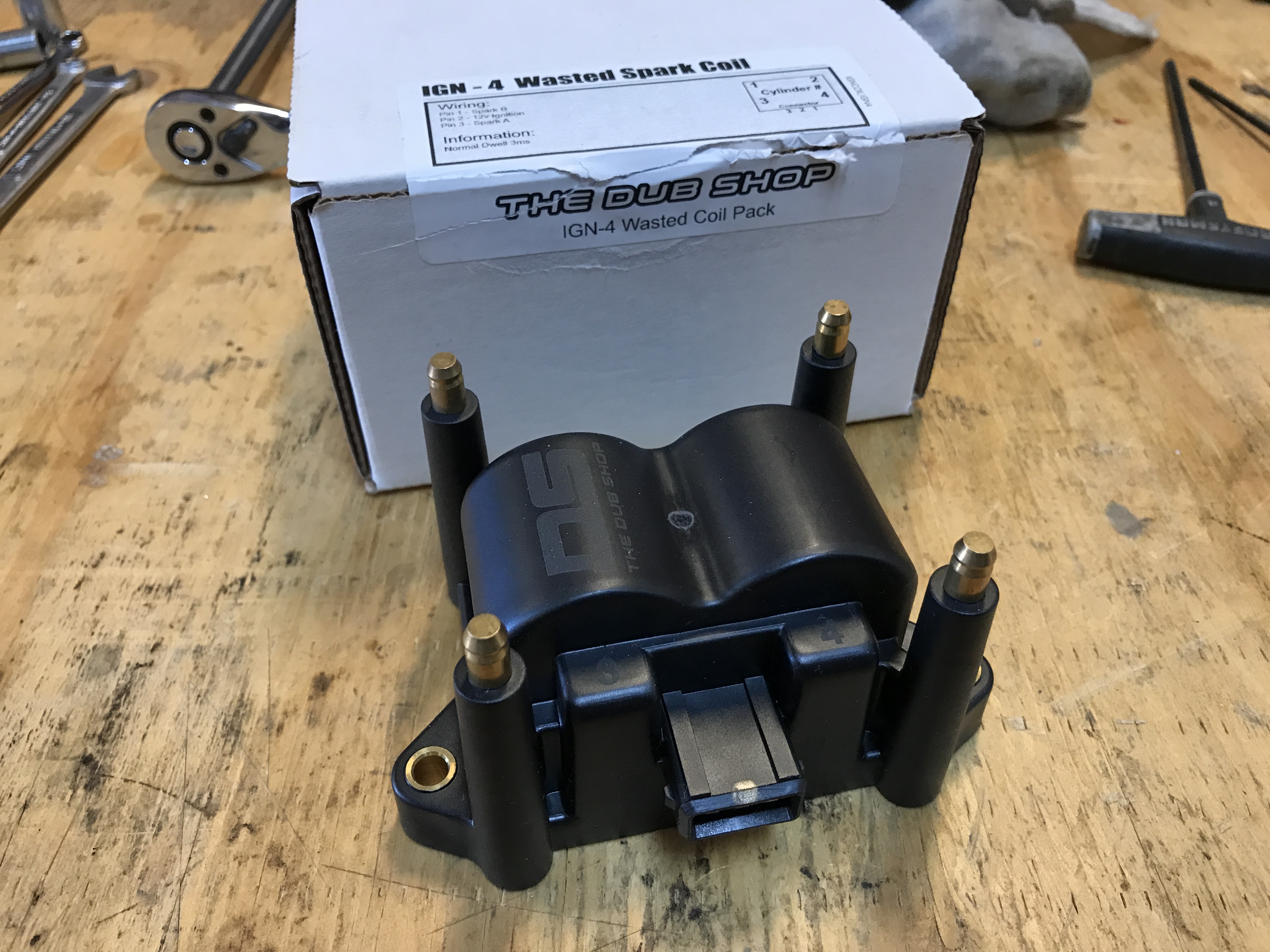

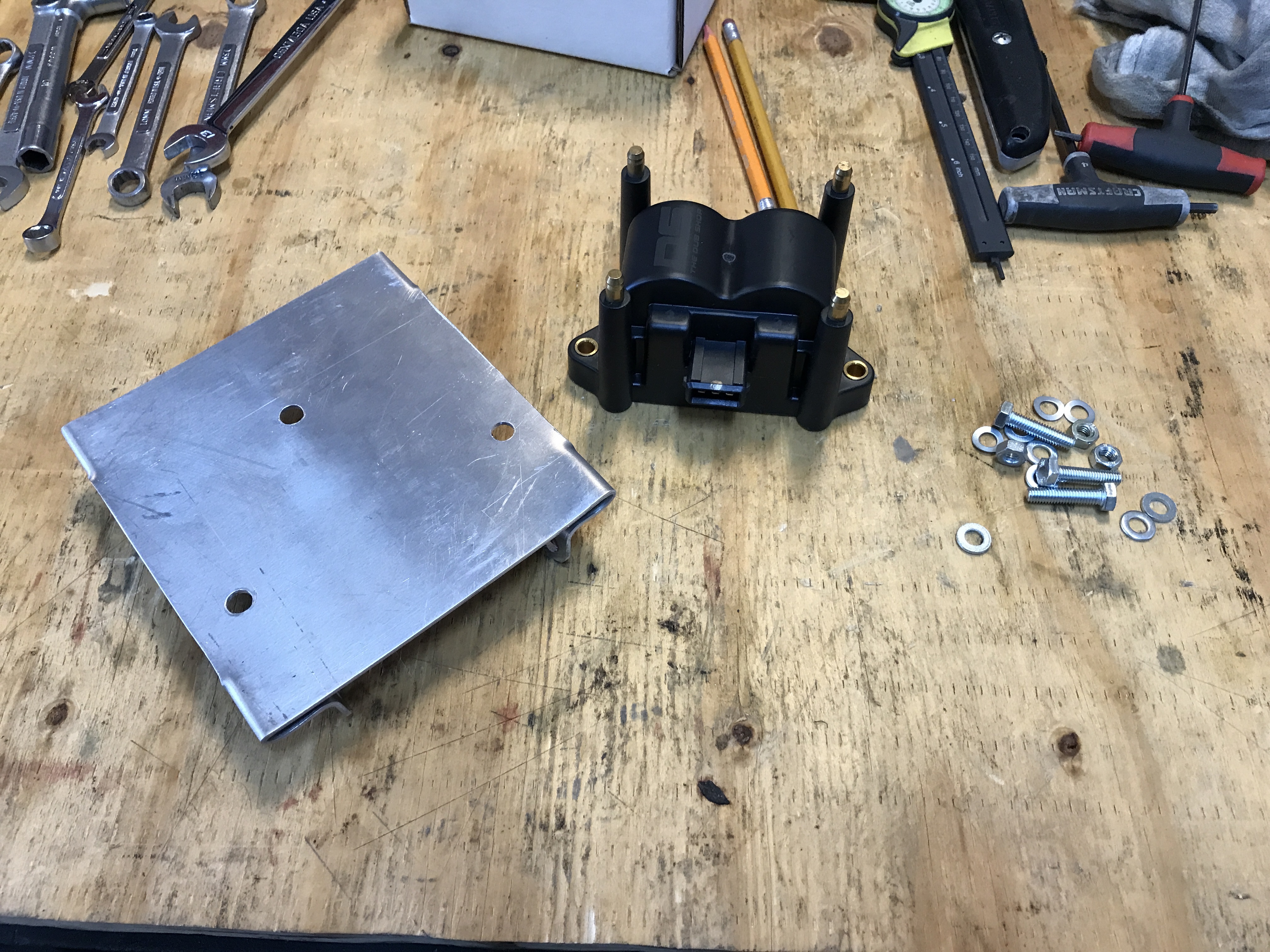

I got out the new coil, to explore location and mounting.

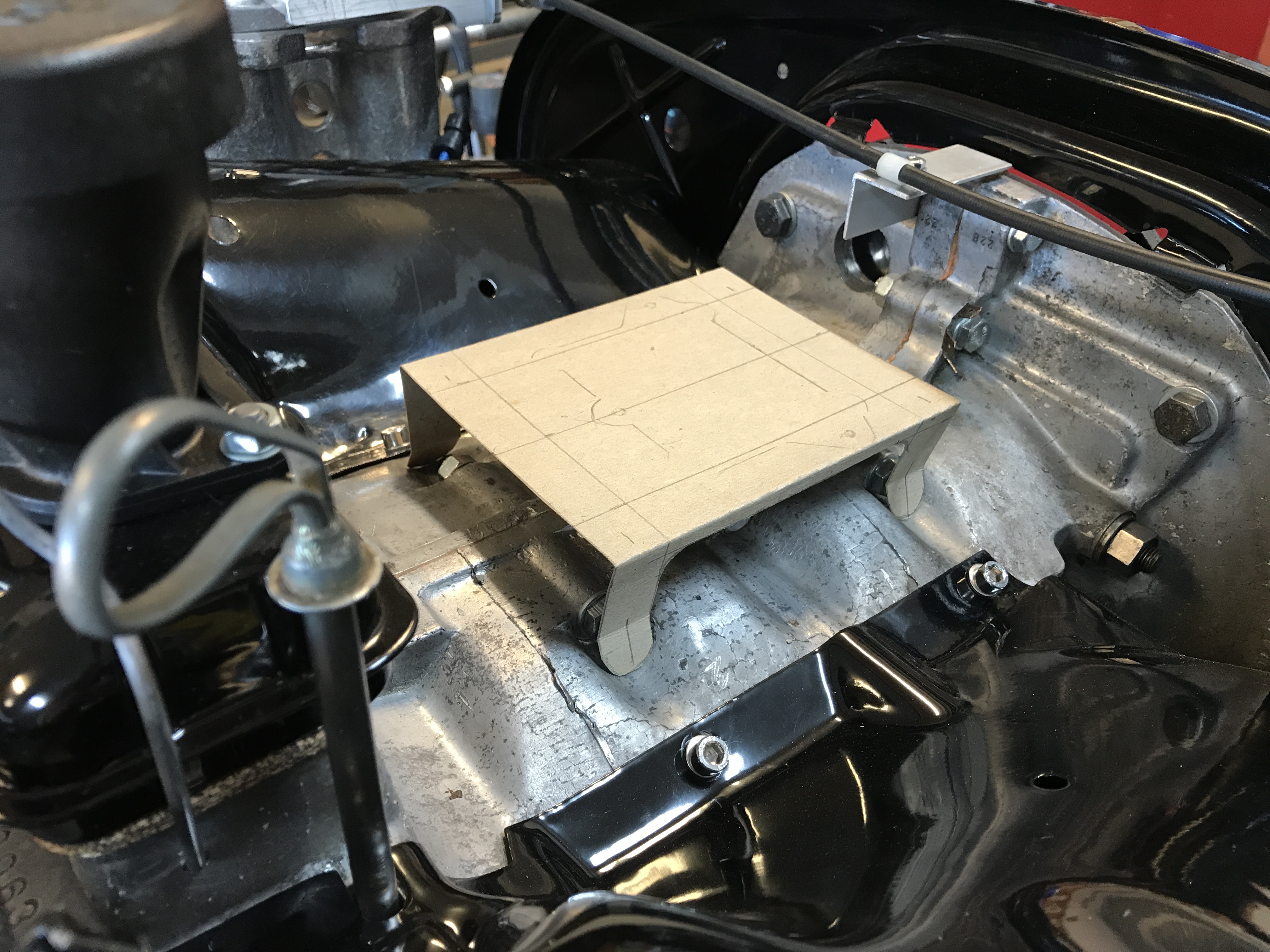

My first idea is to mount it on top of the engine case, with a new bracket. Mock up in cardboard.

QUOTE(bkrantz @ Nov 17 2021, 08:51 PM) *
I like the mounts that replace and plug the distributor hole with the coil mount.
Just my $.02.
Clay

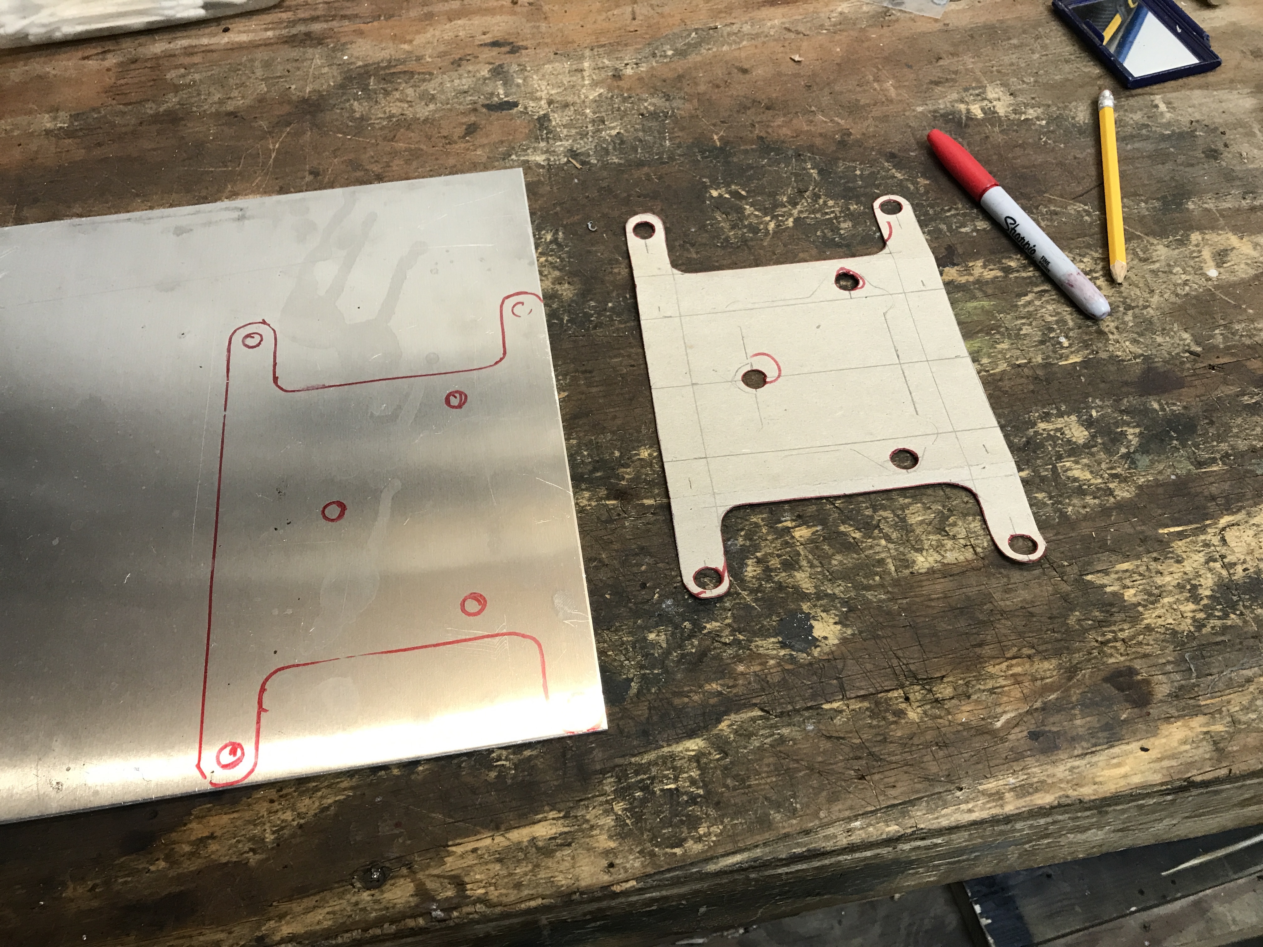

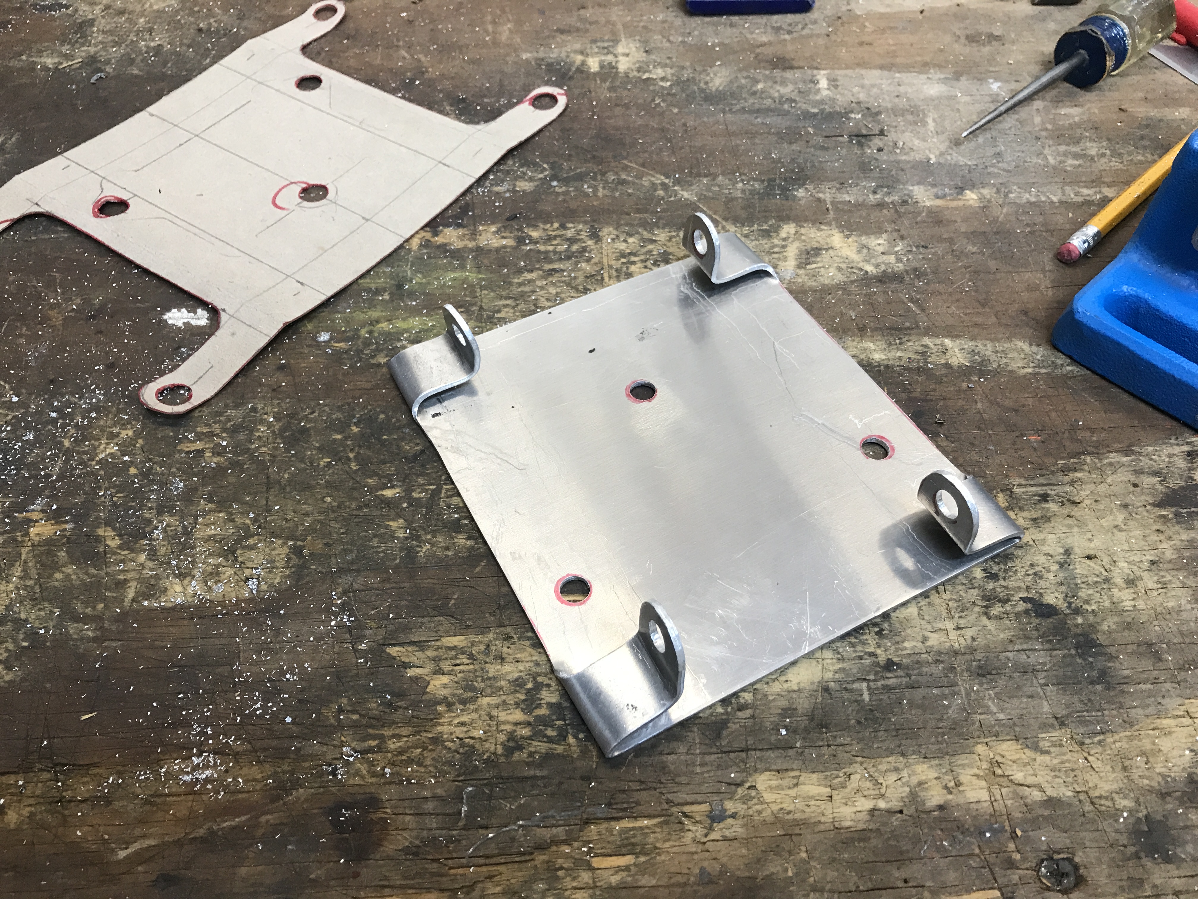

I laid out the pattern on some 10 gauge aluminum.
bkrantz
post Nov 19 2021, 07:50 PM
Post #4187
Posts: 8,530
Joined: 3-August 19
From: SW Colorado
Member No.: 23,343
Cut and bent.

Ready to mount the new coil.

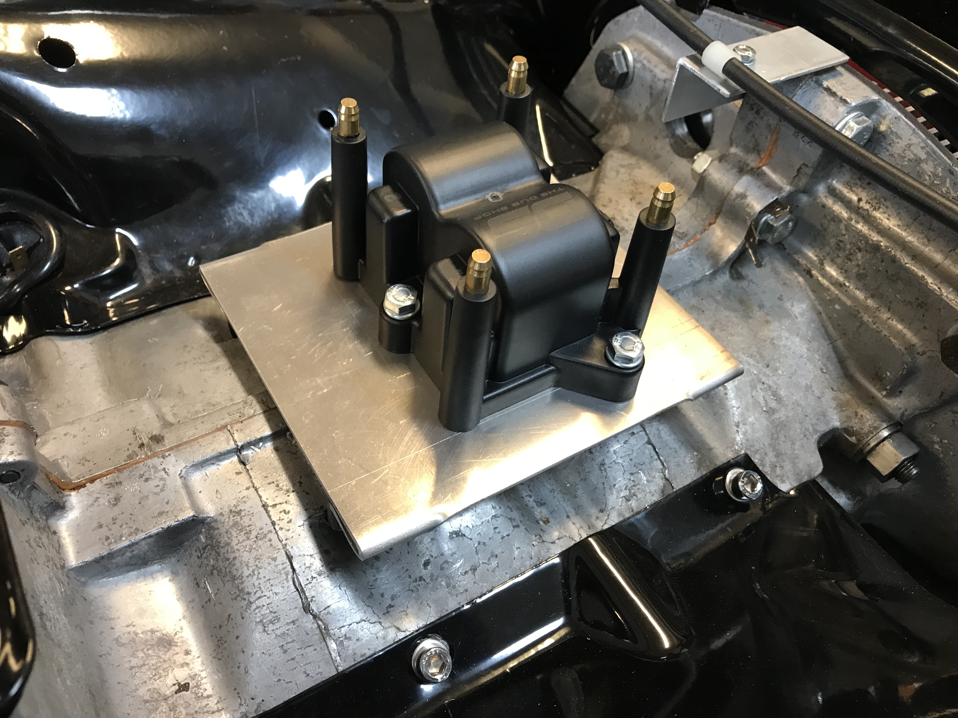

This should work, but I need some longer case bolts.

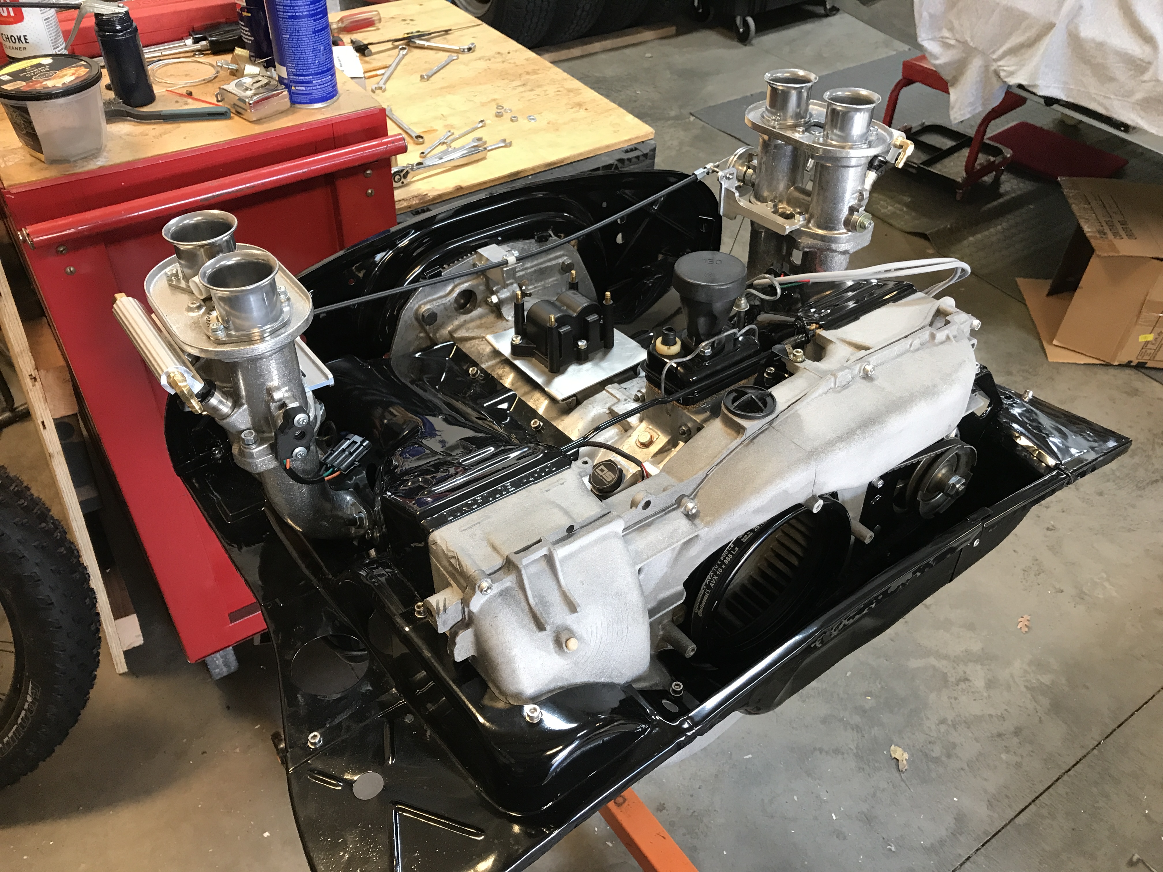

The engine is just about dressed.

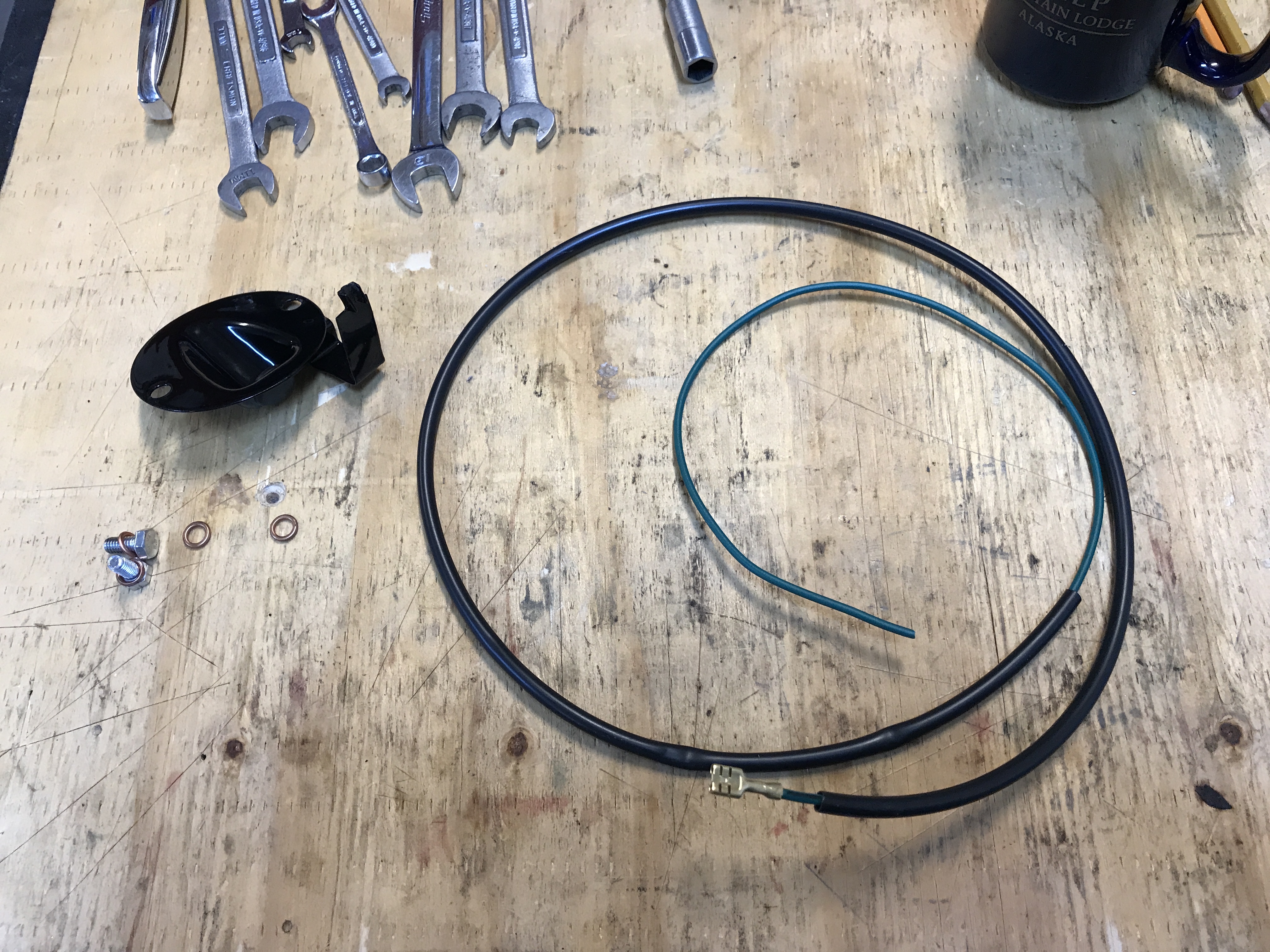

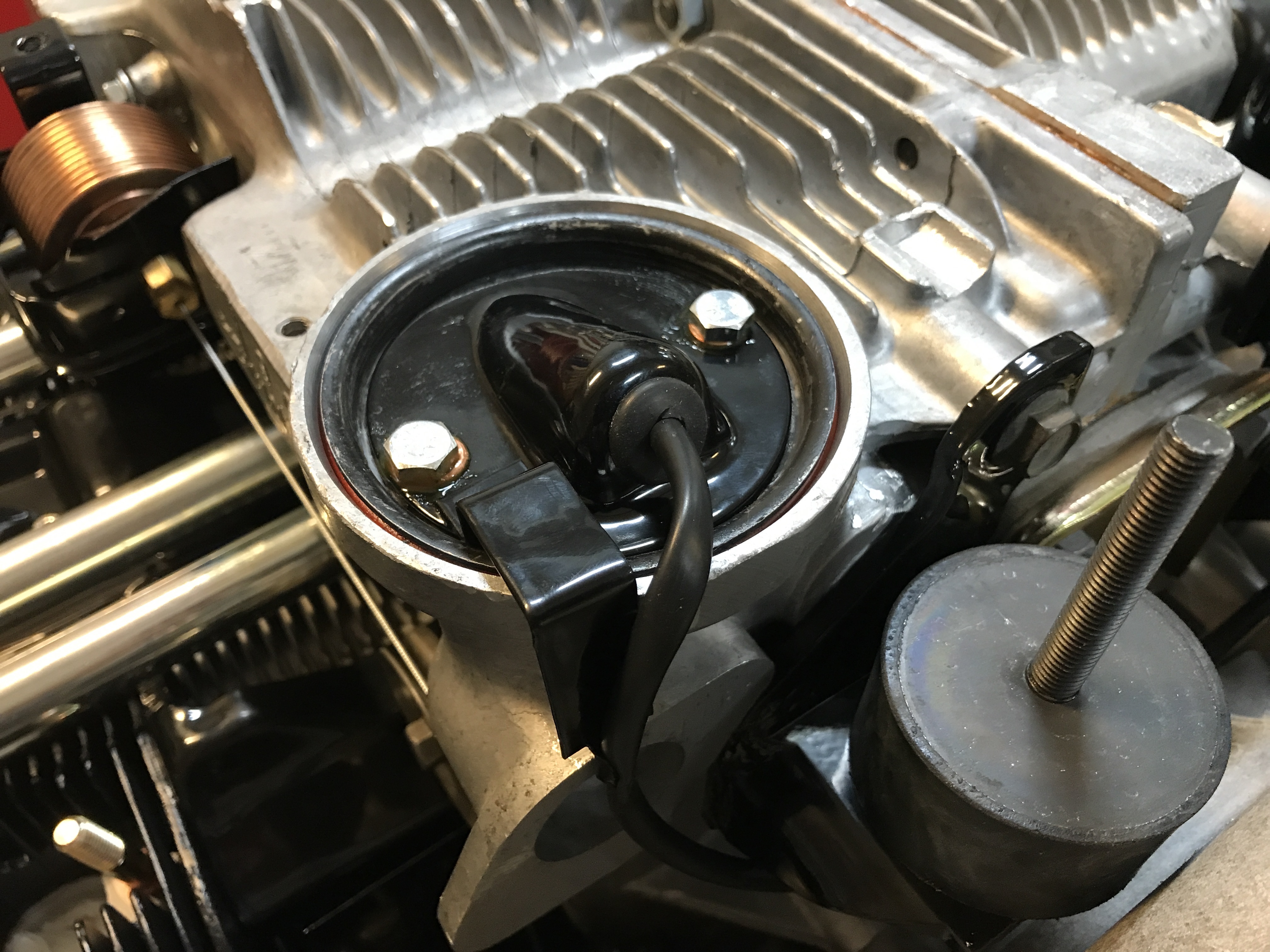

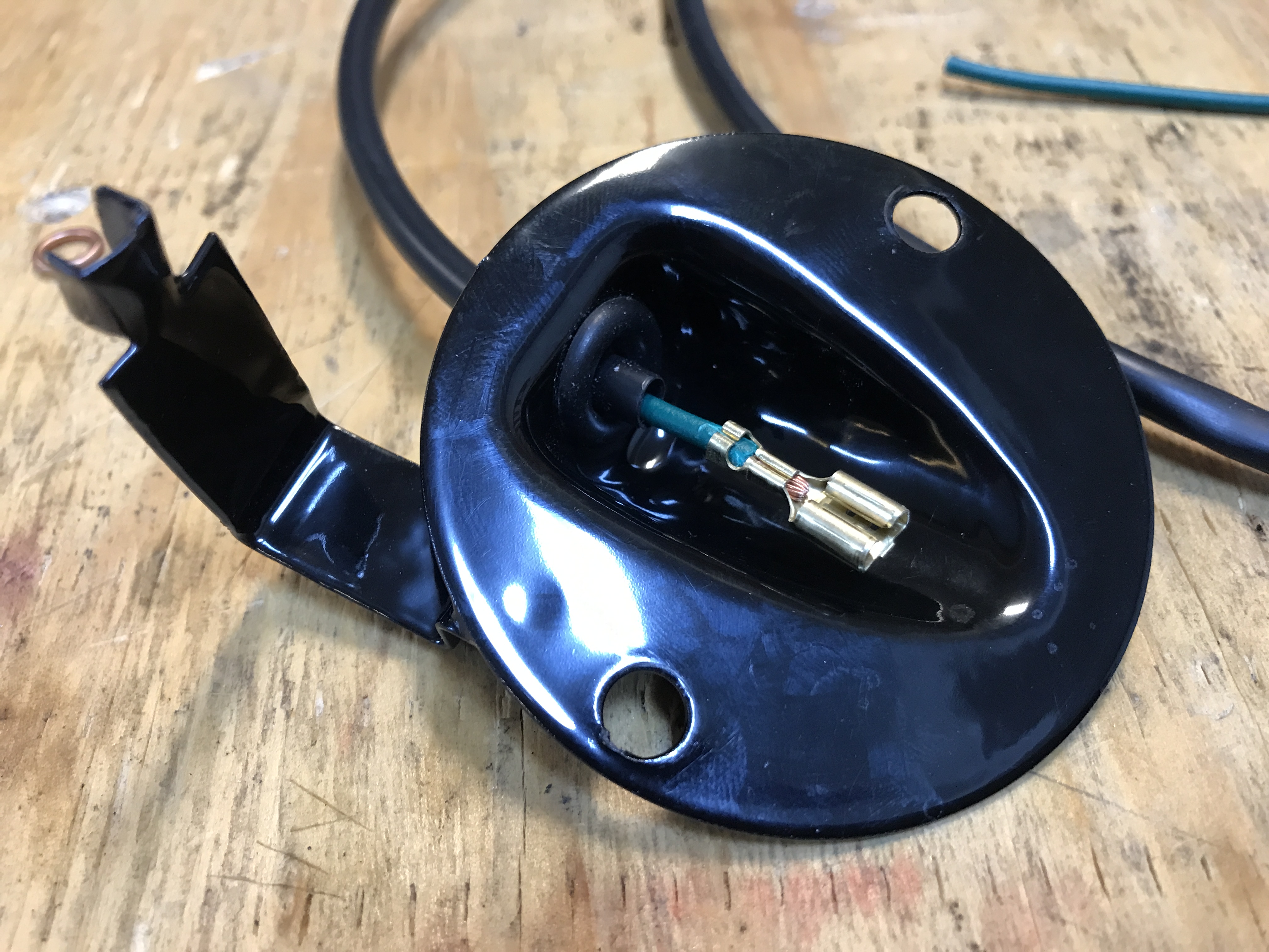

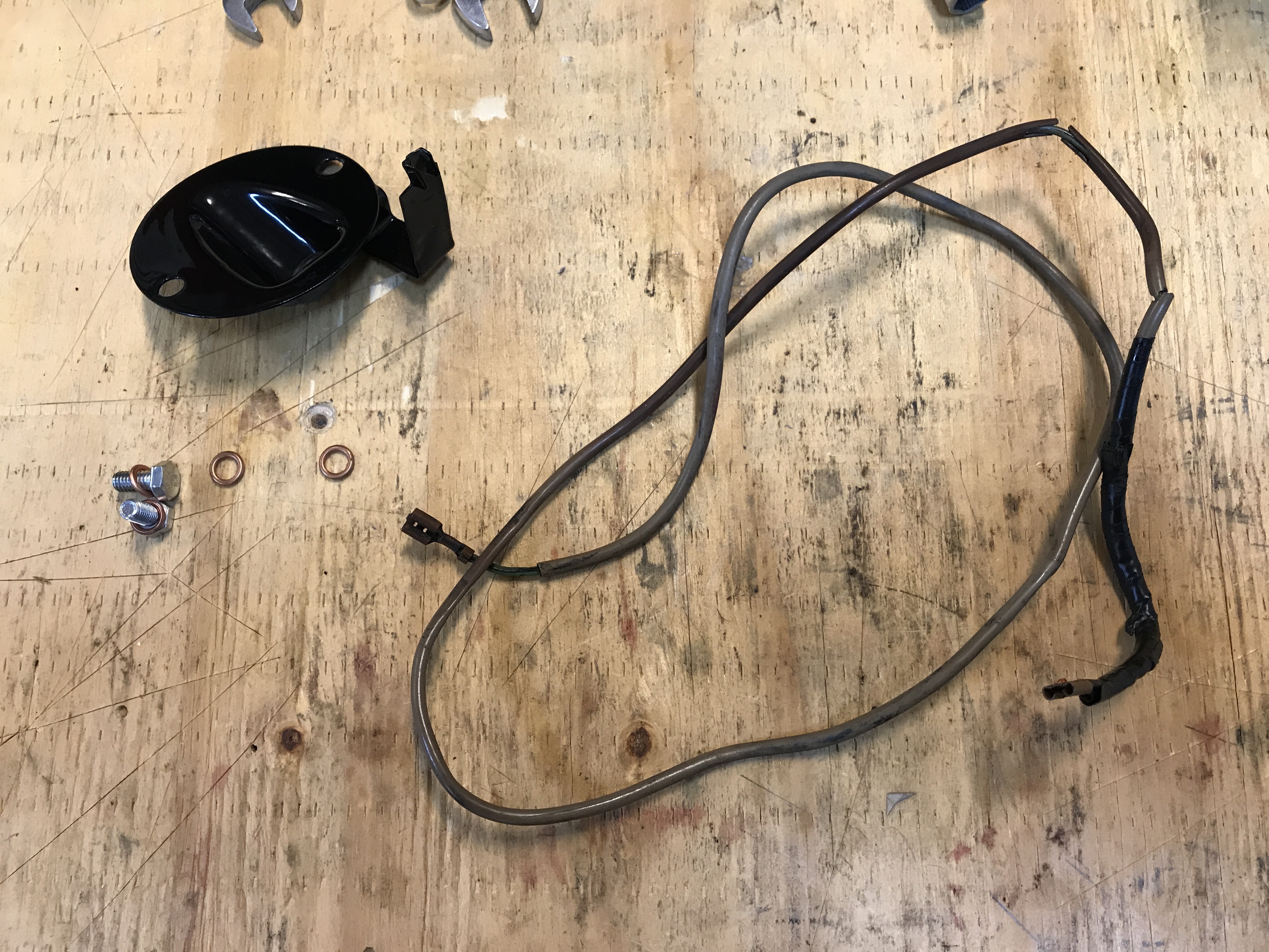

Another neglected detail: the wire for the oil temp sender. The original is pretty ratty.
bkrantz
post Nov 20 2021, 08:41 PM
Post #4194
Posts: 8,530
Joined: 3-August 19
From: SW Colorado
Member No.: 23,343
My new wire (green, with a hand-drawn black stripe!).
bkrantz
post Nov 20 2021, 08:43 PM
Post #4195
Posts: 8,530
Joined: 3-August 19
From: SW Colorado
Member No.: 23,343
Through the grommet in the taco plate cover.
bkrantz
post Nov 20 2021, 08:44 PM
Post #4196
Posts: 8,530
Joined: 3-August 19
From: SW Colorado
Member No.: 23,343

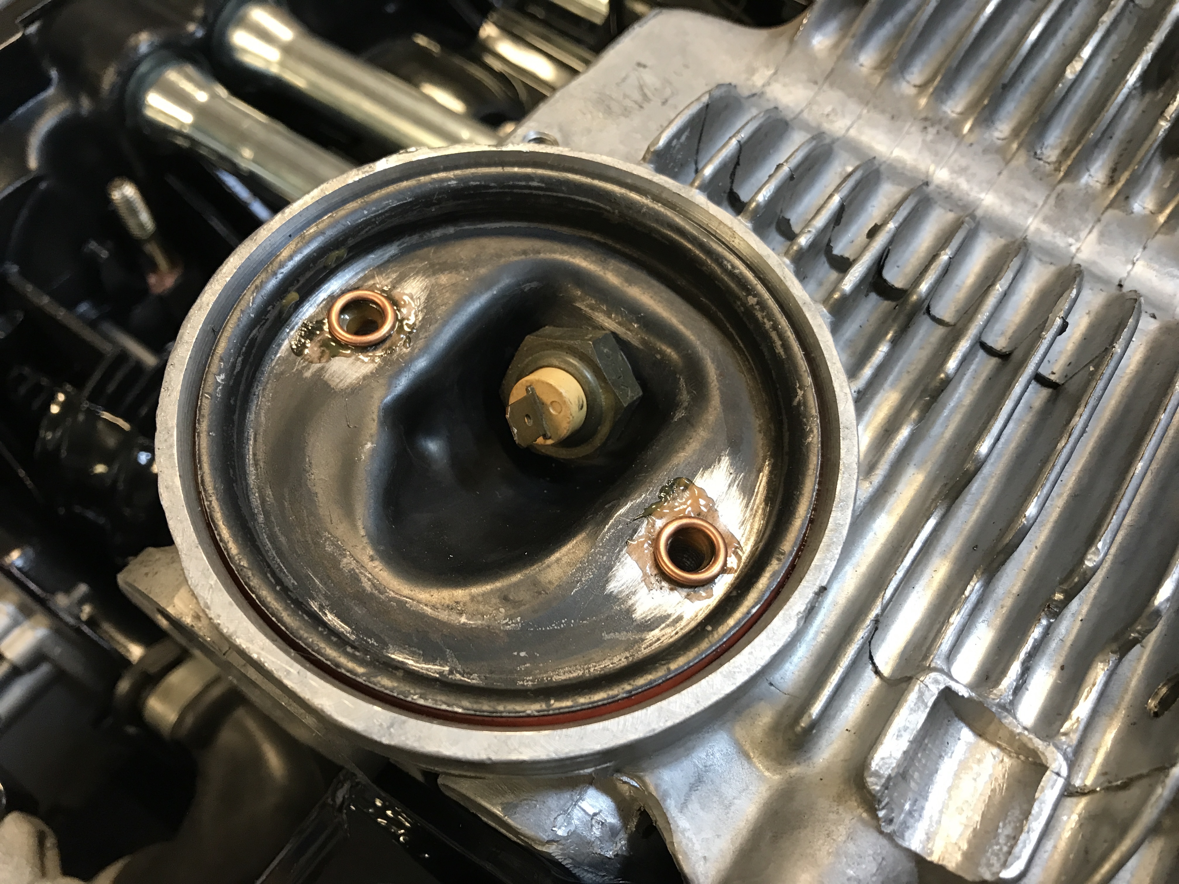

New crush washers and a dab of gasket sealant.
bkrantz
post Nov 20 2021, 08:45 PM
Post #4197
Posts: 8,530
Joined: 3-August 19
From: SW Colorado
Member No.: 23,343
Cover plate installed, and wire crimped in the holder.

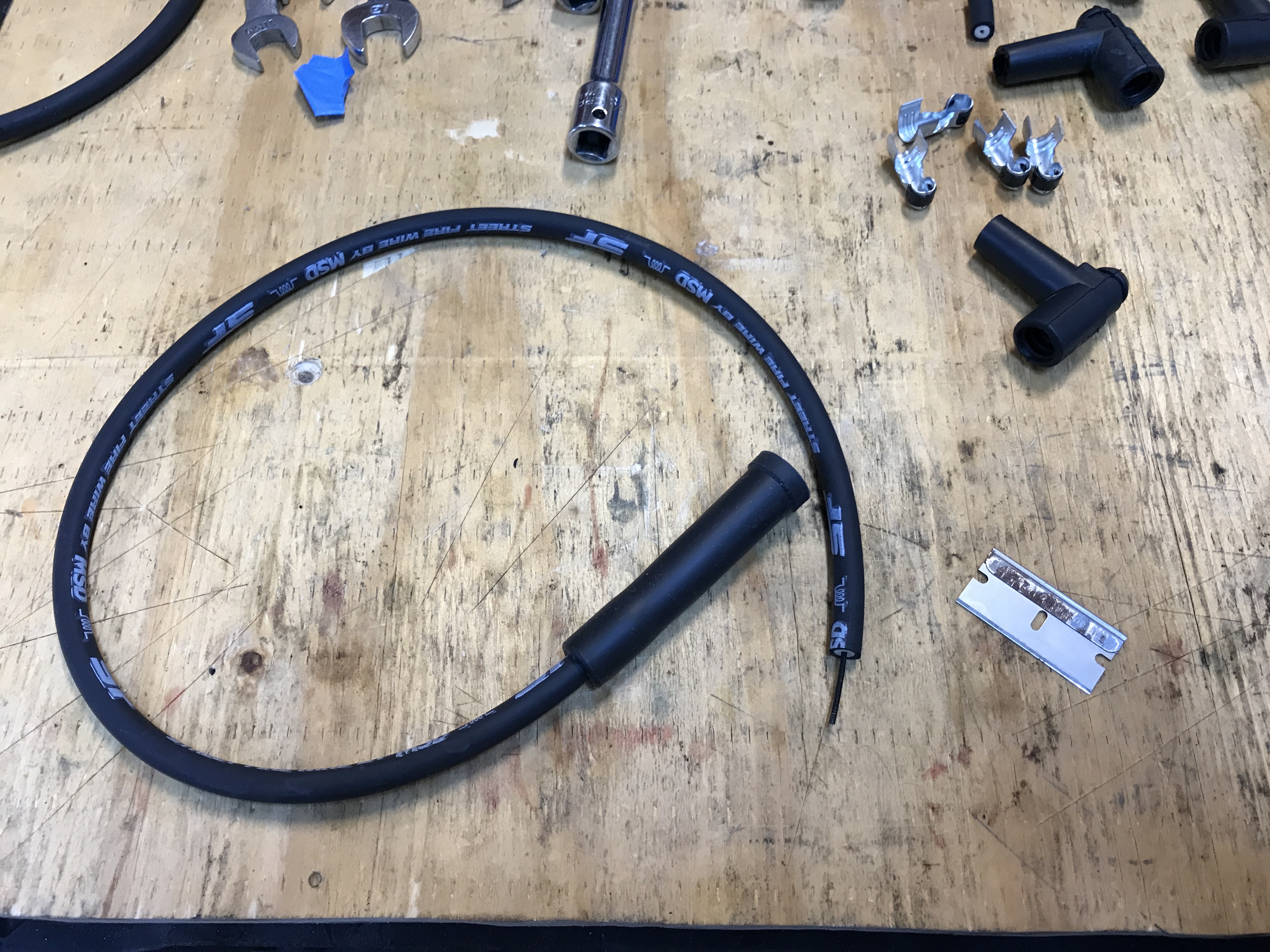

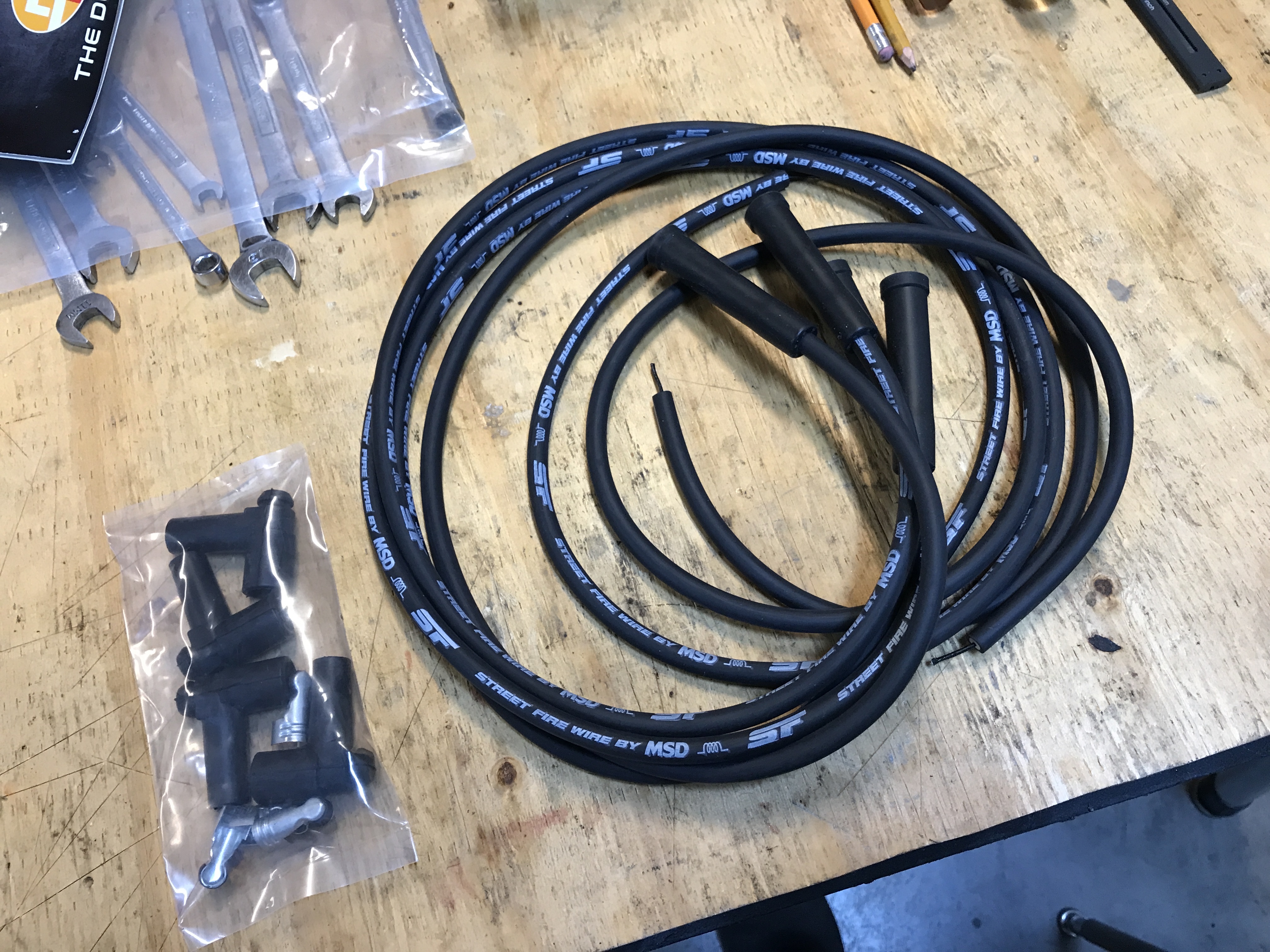

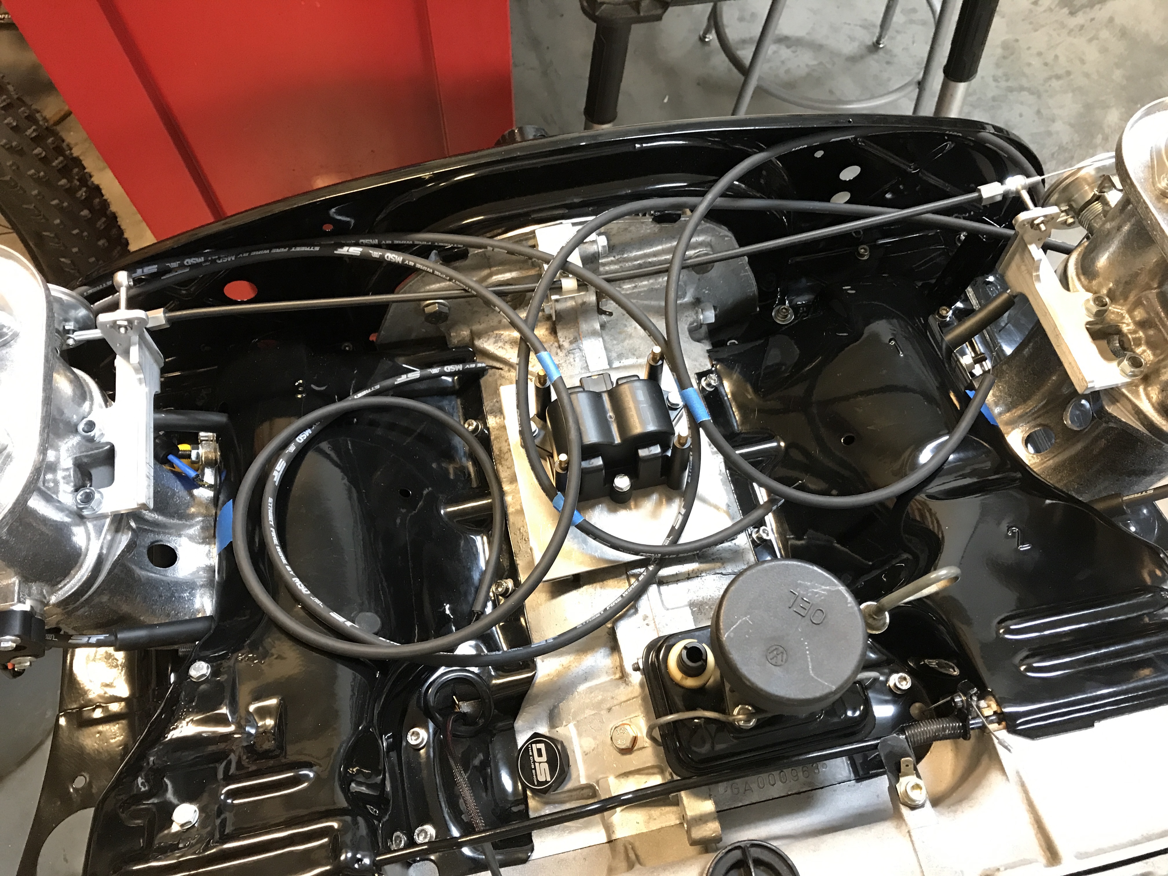

Next job: new plug wires. This is the MSD kit that is part of the Dub Shop system.
bkrantz
post Nov 20 2021, 08:48 PM
Post #4199
Posts: 8,530
Joined: 3-August 19
From: SW Colorado
Member No.: 23,343
Plug wires laid out, from spark plugs to the new coil.
bkrantz
post Nov 20 2021, 08:49 PM
Post #4200
Posts: 8,530
Joined: 3-August 19
From: SW Colorado
Member No.: 23,343
Now to cut each wire to length.
