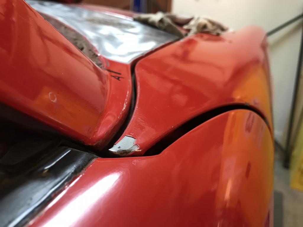

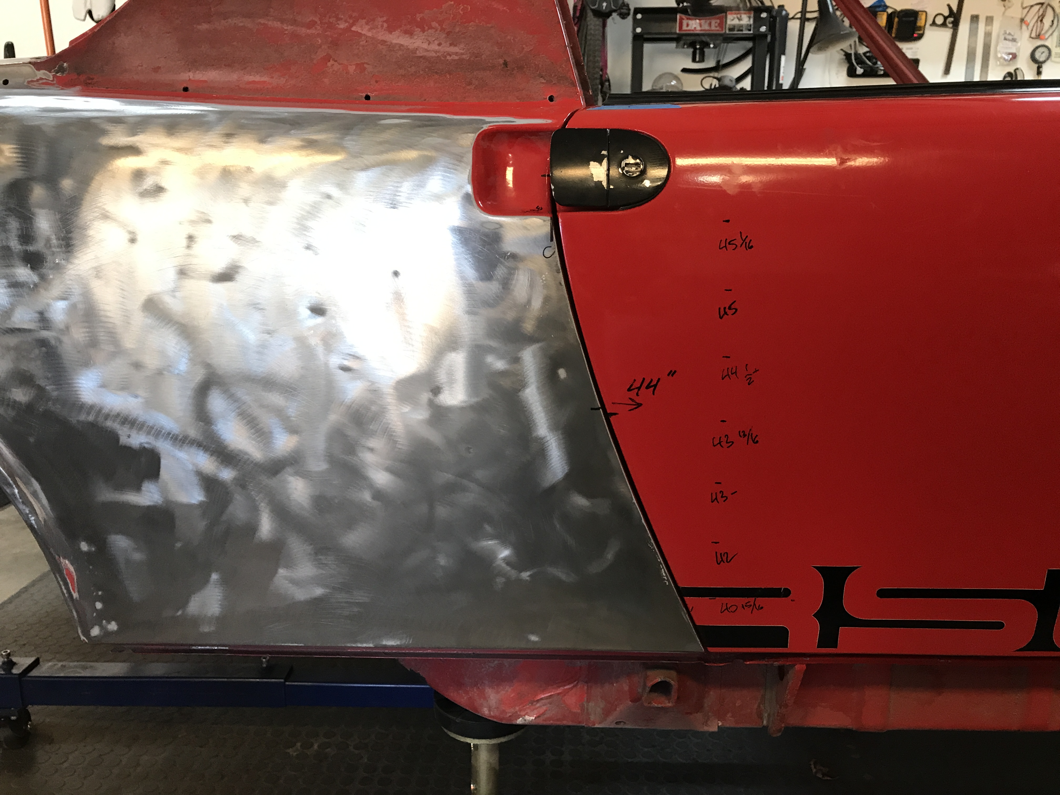

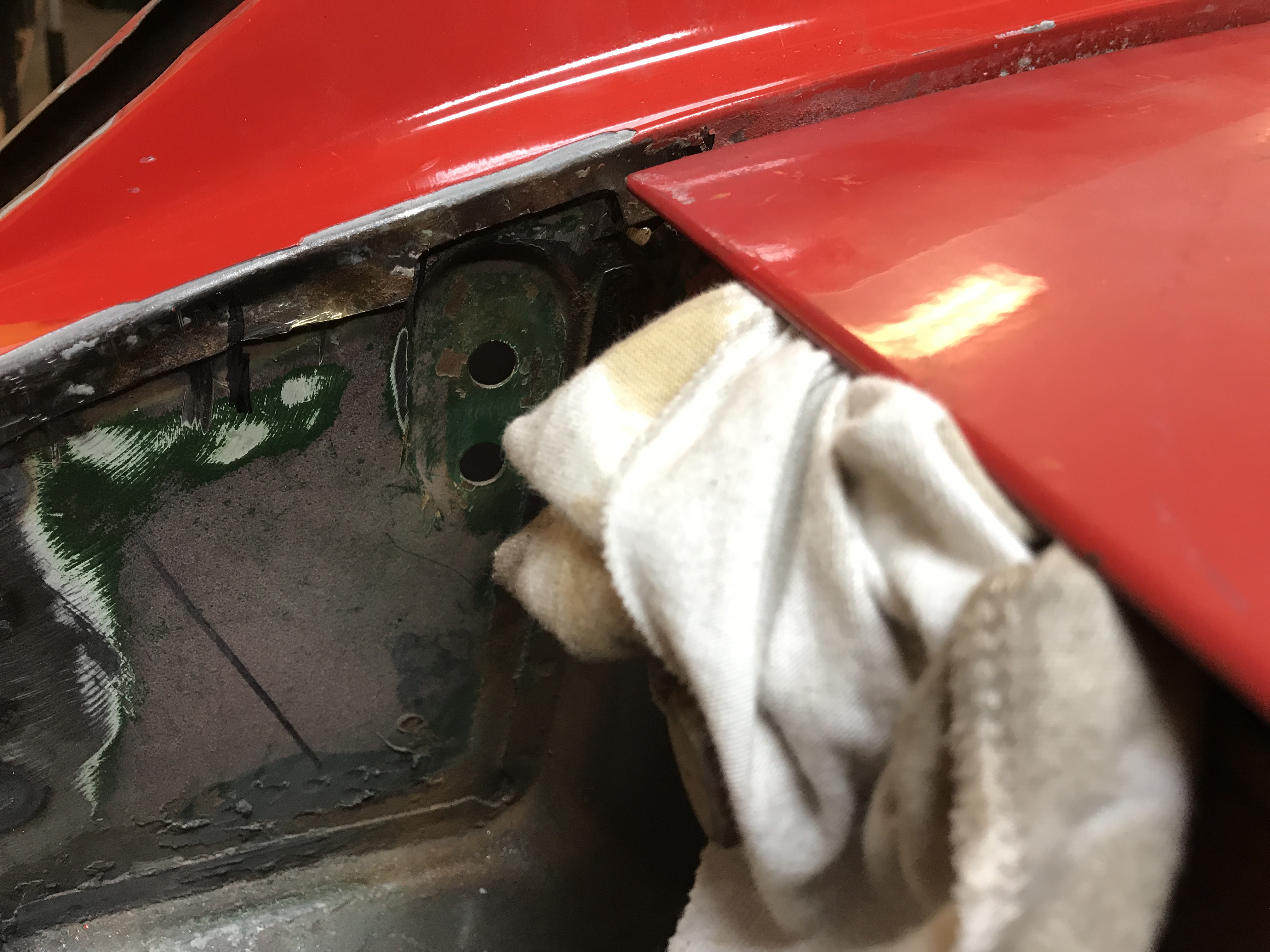

To me, the alignment looks pretty good--about as good on the right as on the left, and the dimensions are within 1/16 from side to side in most cases.
The only mismatch is the recess in the fender lap edge, where it clears the mounting area in the headlight box for the pivot.

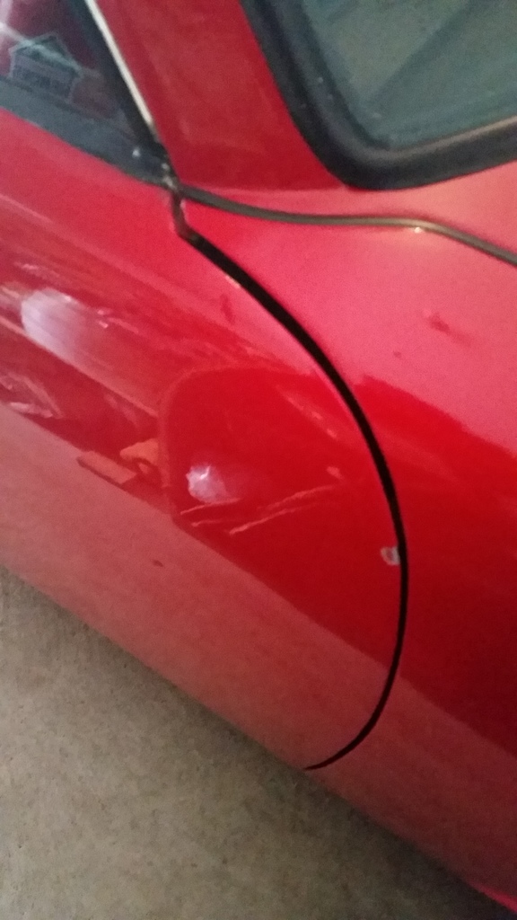

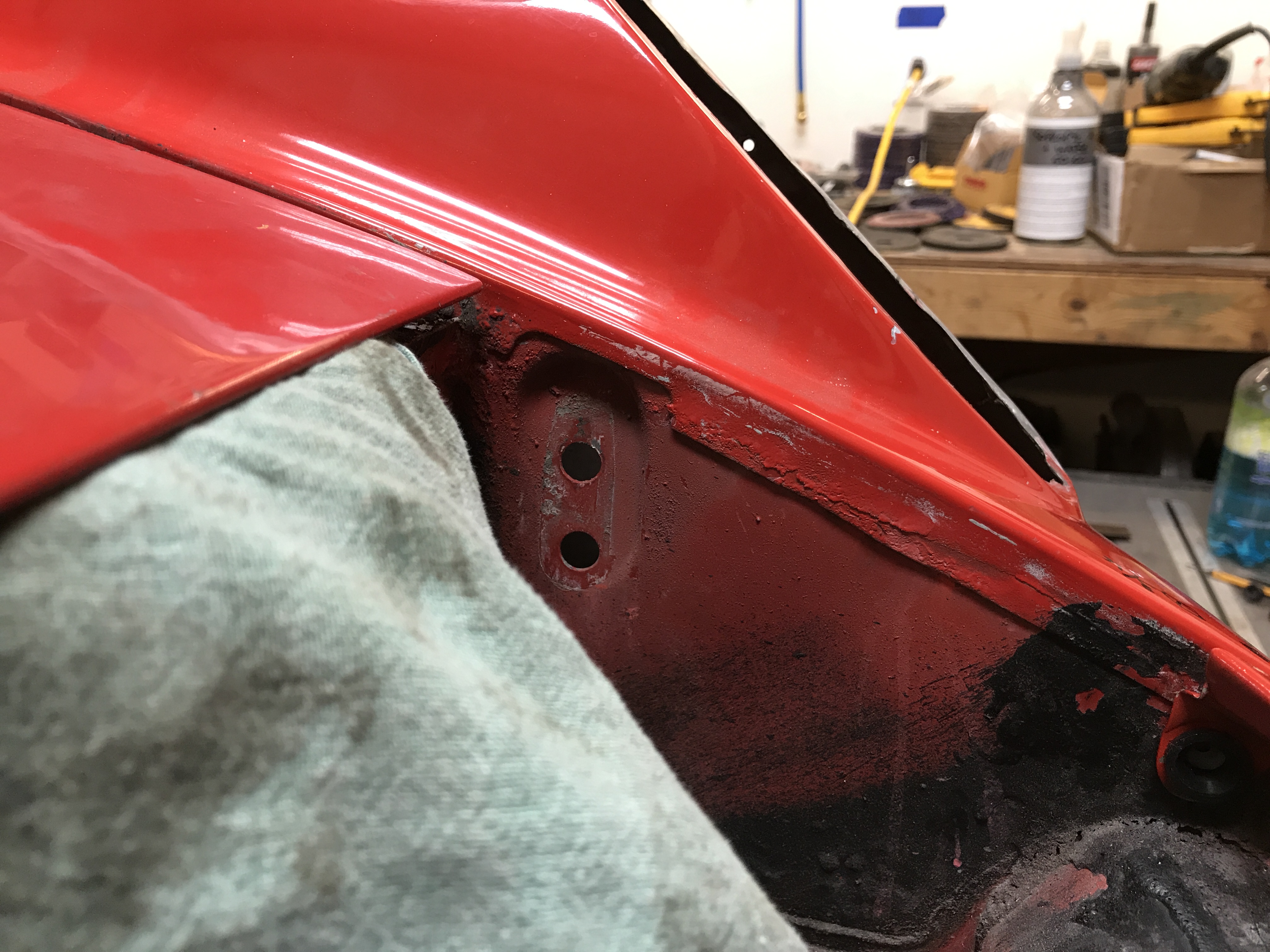

Compared to the left side, where the recess sits more centered above the mounting point.

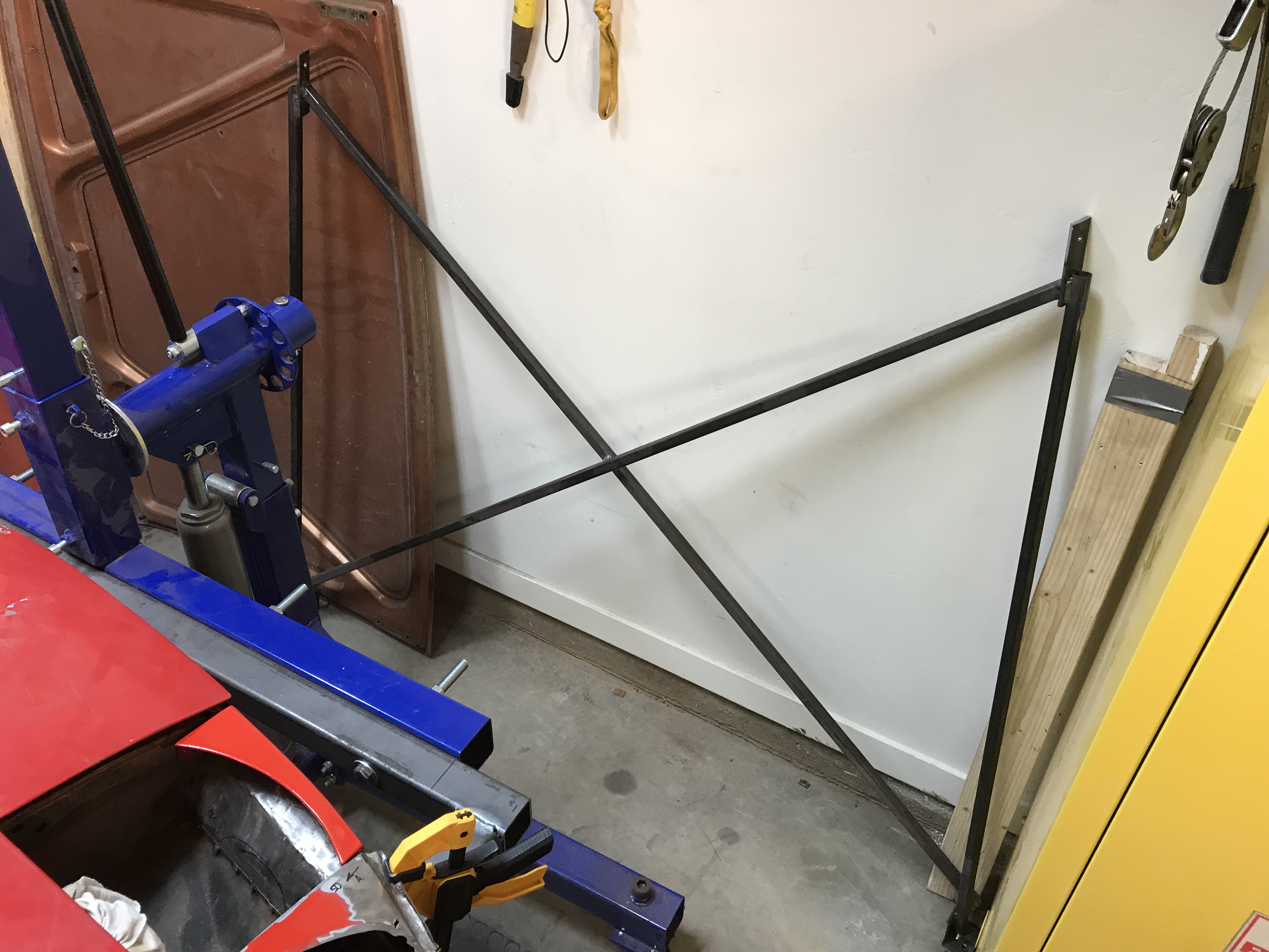

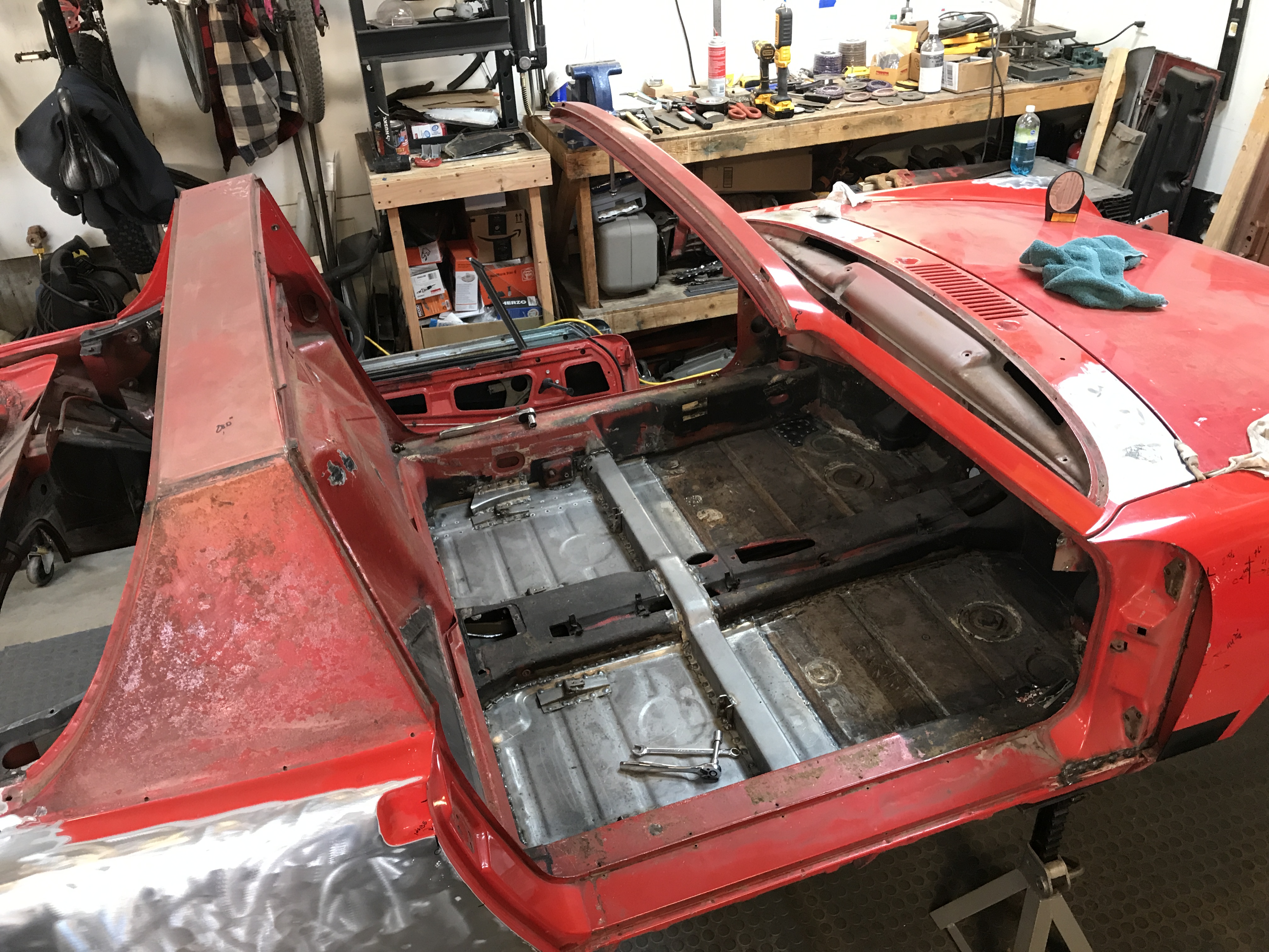

With the encouragement from fellow 914Worlders, I decided to do the right thing and mount the door in order to assure a good fit for the front fender. To do that, I had to remove the interior brace. And to do that, I had to lower the car onto jack stands and take the weight off the rotisserie mounts.
Odd to see the interior looking empty, without the brace for the first time in months.
bkrantz
post Mar 30 2020, 08:29 PM
Post #424
Posts: 8,796
Joined: 3-August 19
From: SW Colorado
Member No.: 23,343
I had doubts that the brace could come out in one piece, but with a bit of persuasion it did.

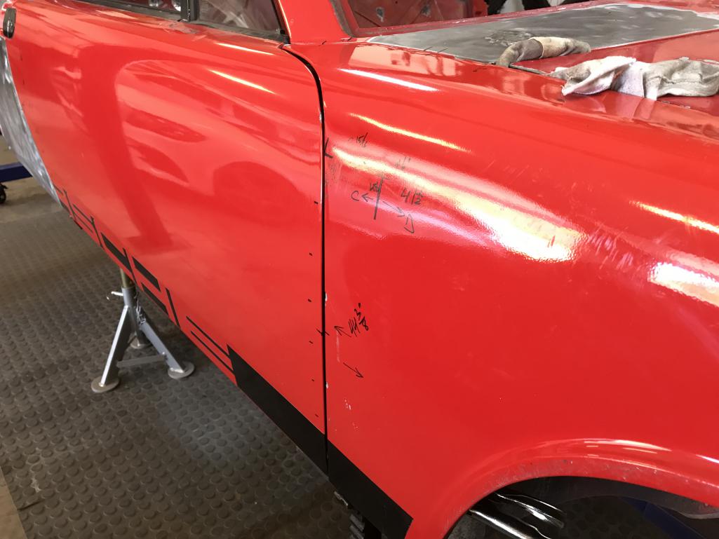

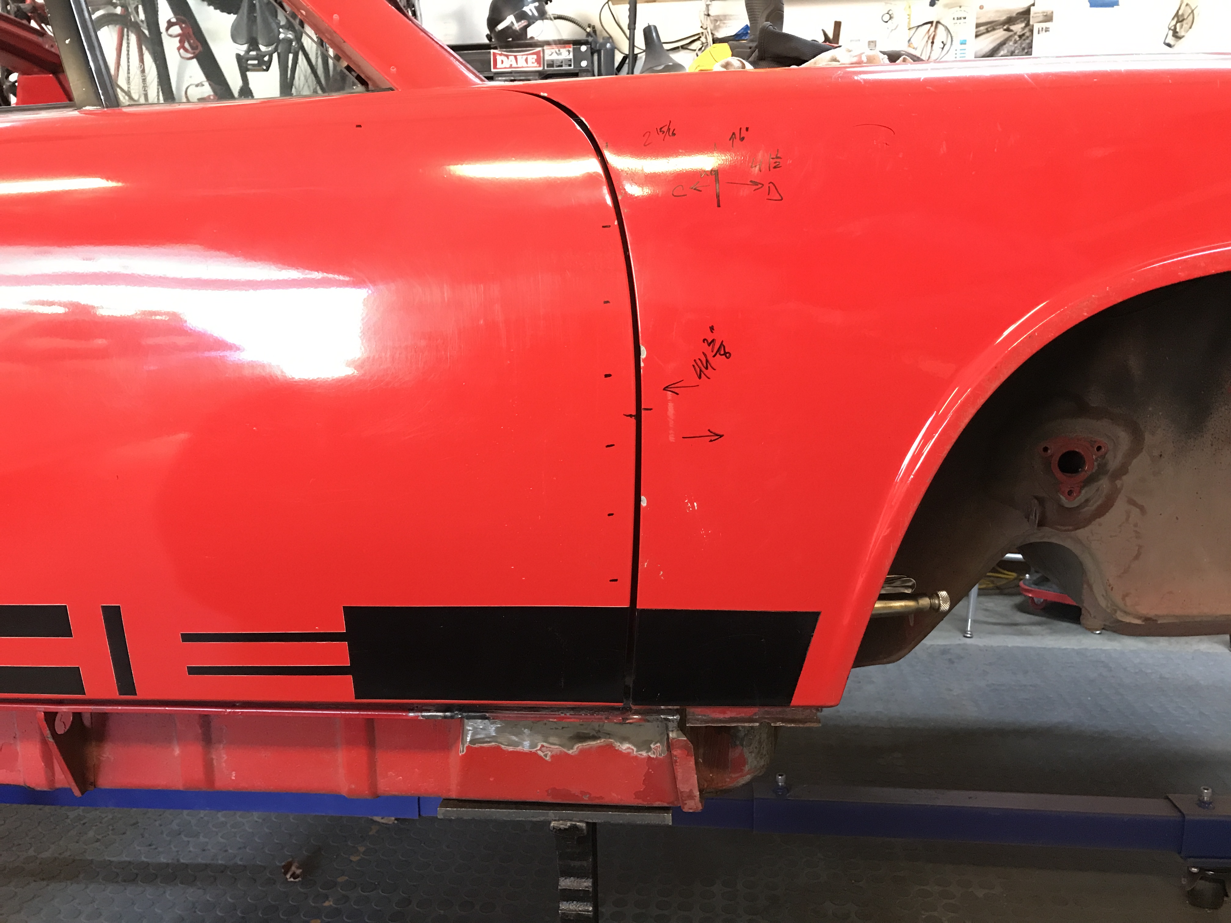

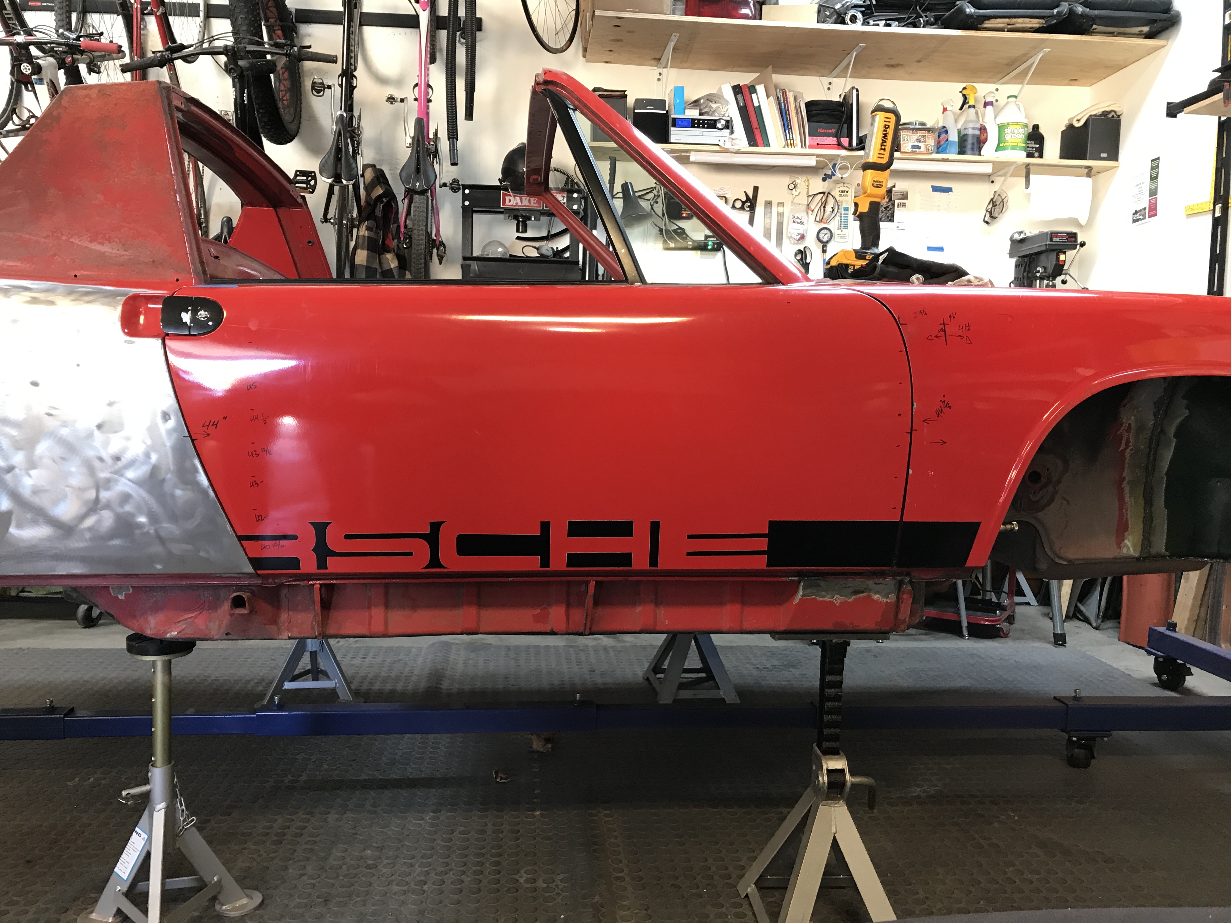

Here's the door in place, without much adjustment.
bkrantz
post Mar 30 2020, 08:36 PM
Post #426
Posts: 8,796
Joined: 3-August 19
From: SW Colorado
Member No.: 23,343
The rear gap looks just a bit narrow, but even from top to bottom.
bkrantz
post Mar 30 2020, 08:37 PM
Post #427
Posts: 8,796
Joined: 3-August 19
From: SW Colorado
Member No.: 23,343
The front gap is a little wider, but also even.
bkrantz
post Mar 30 2020, 08:39 PM
Post #428
Posts: 8,796
Joined: 3-August 19
From: SW Colorado
Member No.: 23,343

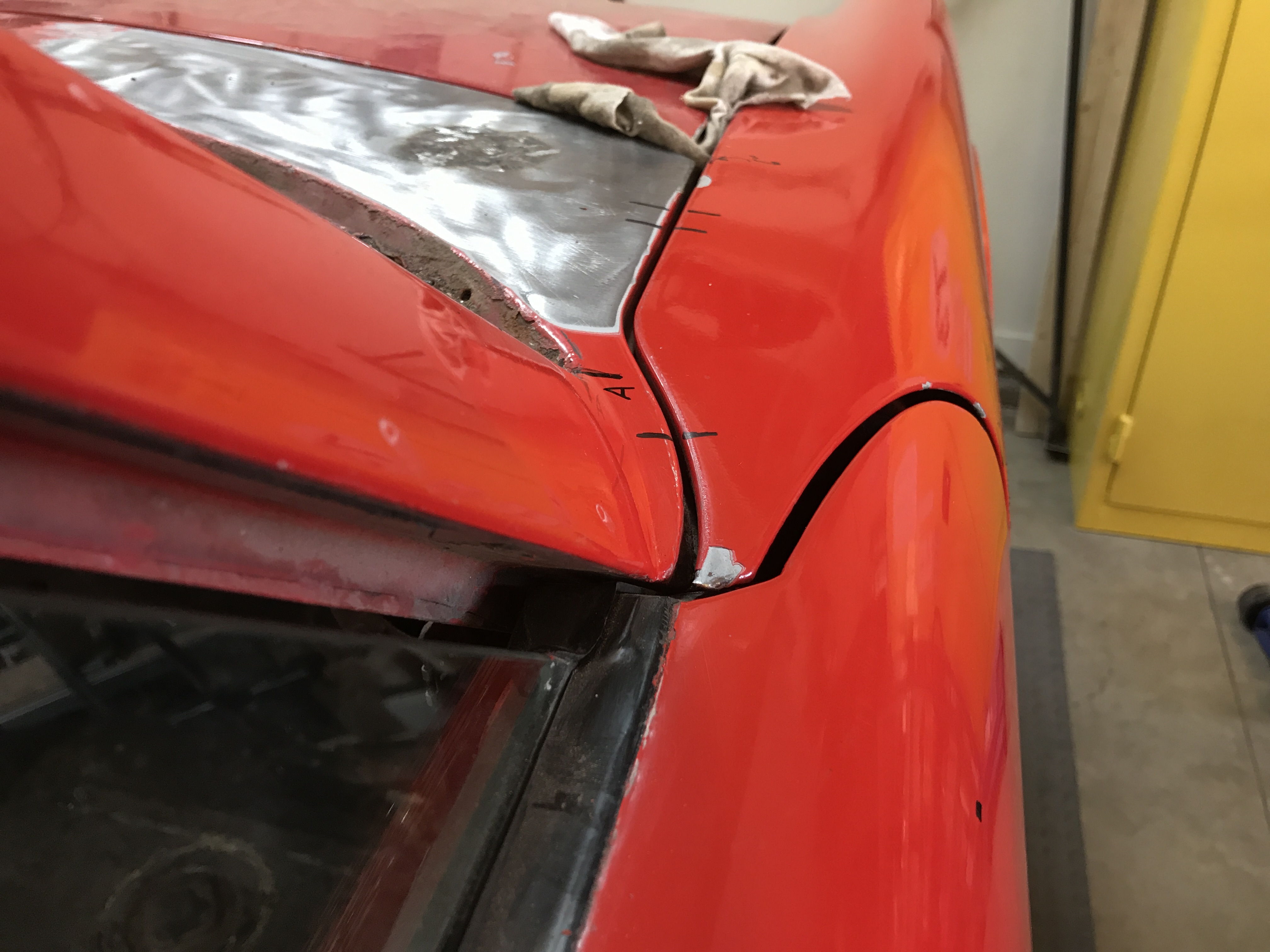

At the top, where the door, fender, and cowl come together, it looks good (the top of the door needs to move in--easy adjustment). I am feeling good about the fender position fit.

raynekat
post Mar 30 2020, 09:13 PM
Post #430
Posts: 2,171
Joined: 30-December 14
From: Coeur d'Alene, Idaho
Member No.: 18,263

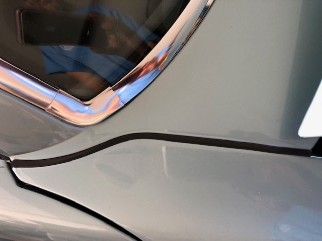

Bob, my car has a slightly wider door gap in the leading edge (front) vs the trailing edge (rear). Just like yours. Now that doesn't mean it's correct, but that's just how mine is.

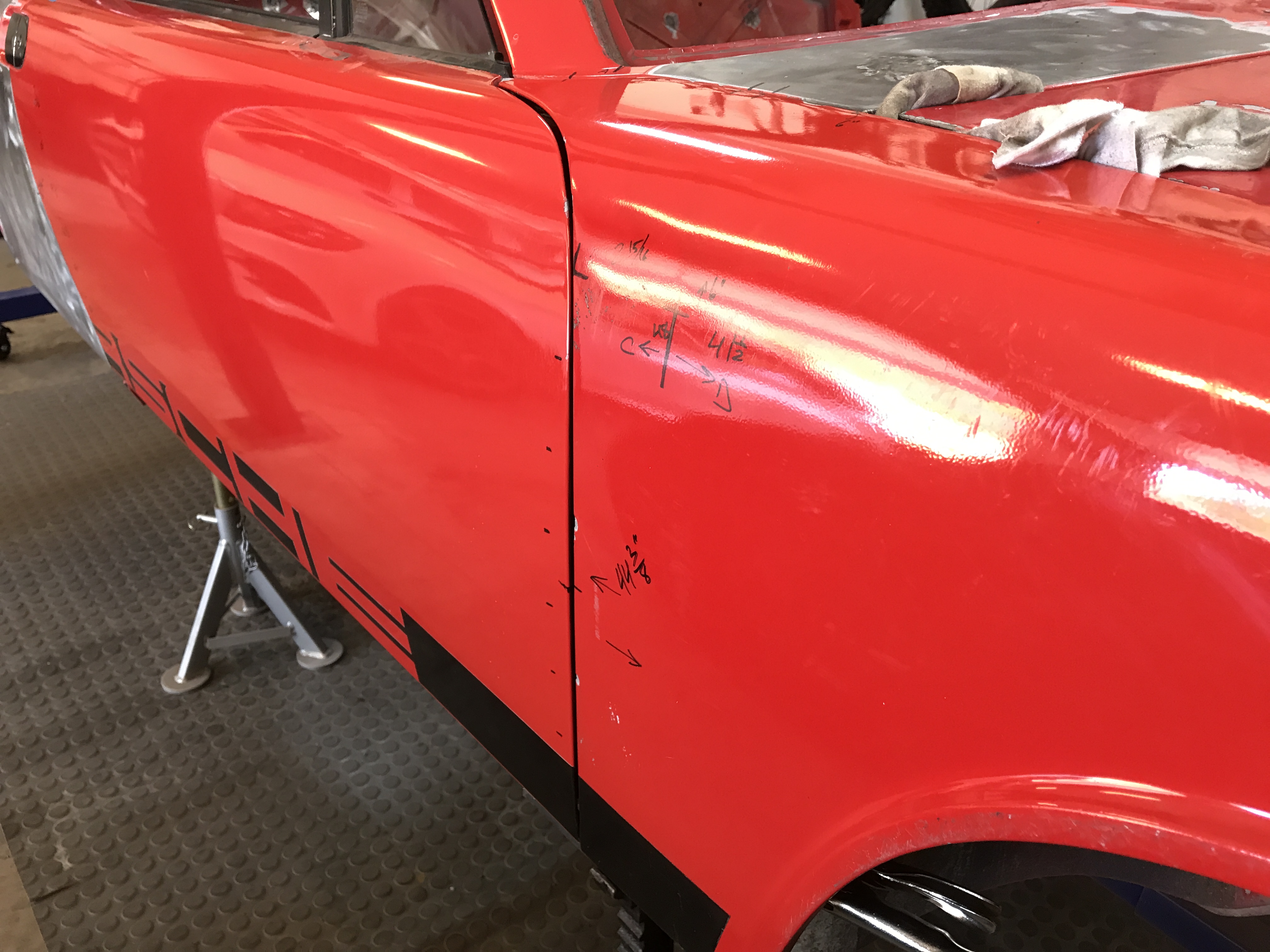

Once last session to check the fender fit. I adjusted the door to align better.
bkrantz
post Mar 31 2020, 08:47 PM
Post #433
Posts: 8,796
Joined: 3-August 19
From: SW Colorado
Member No.: 23,343
The final judgement: this is good enough to proceed, and get the fender welded on.

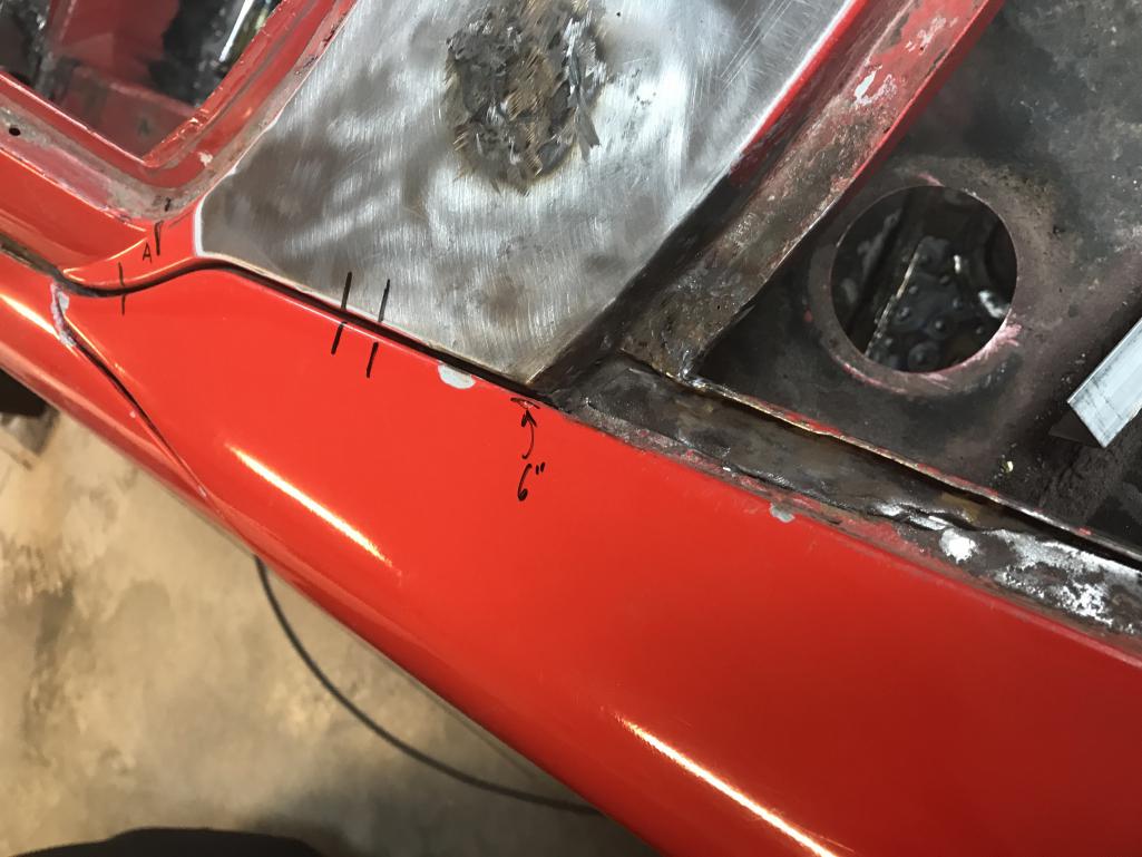

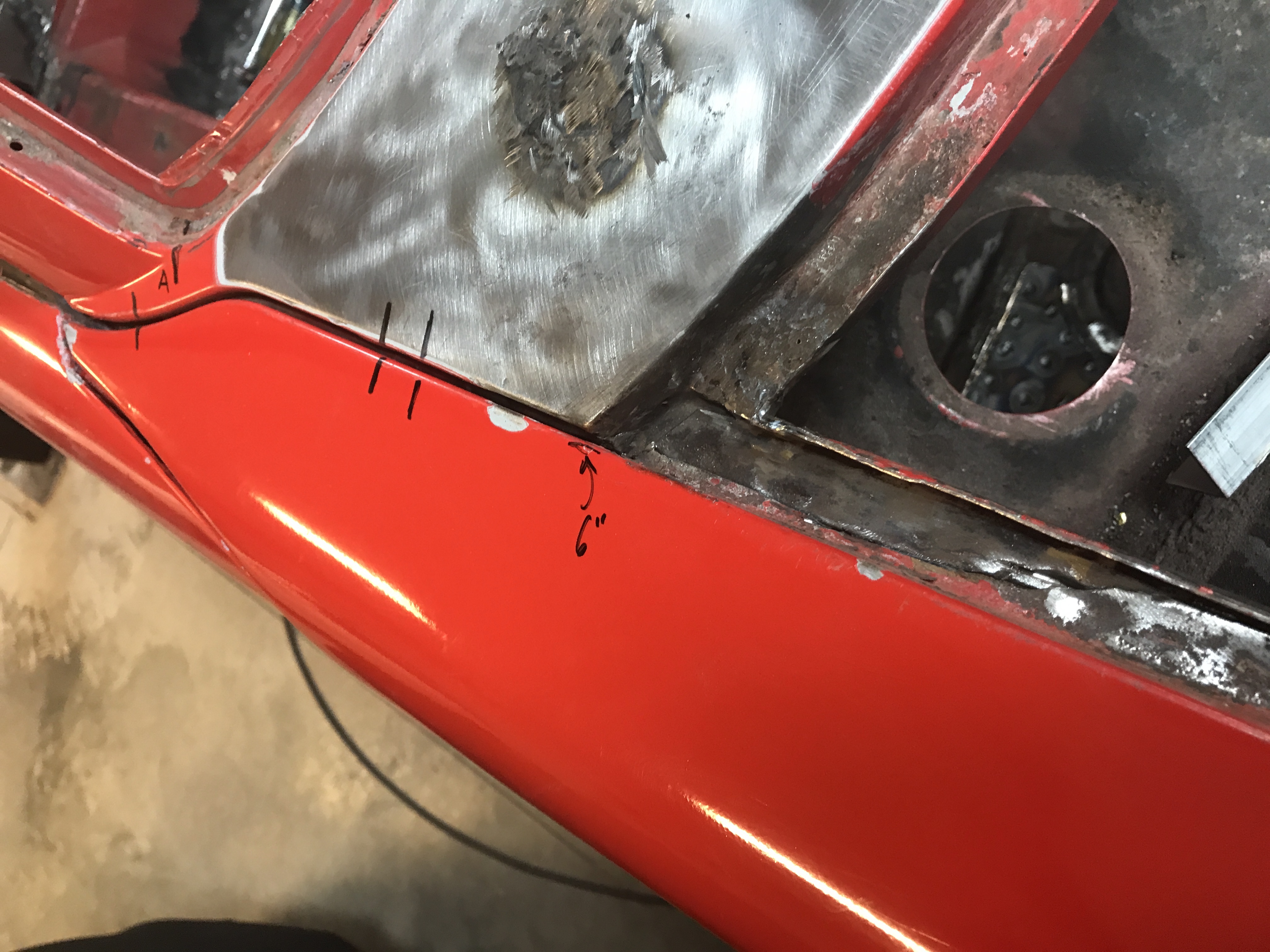

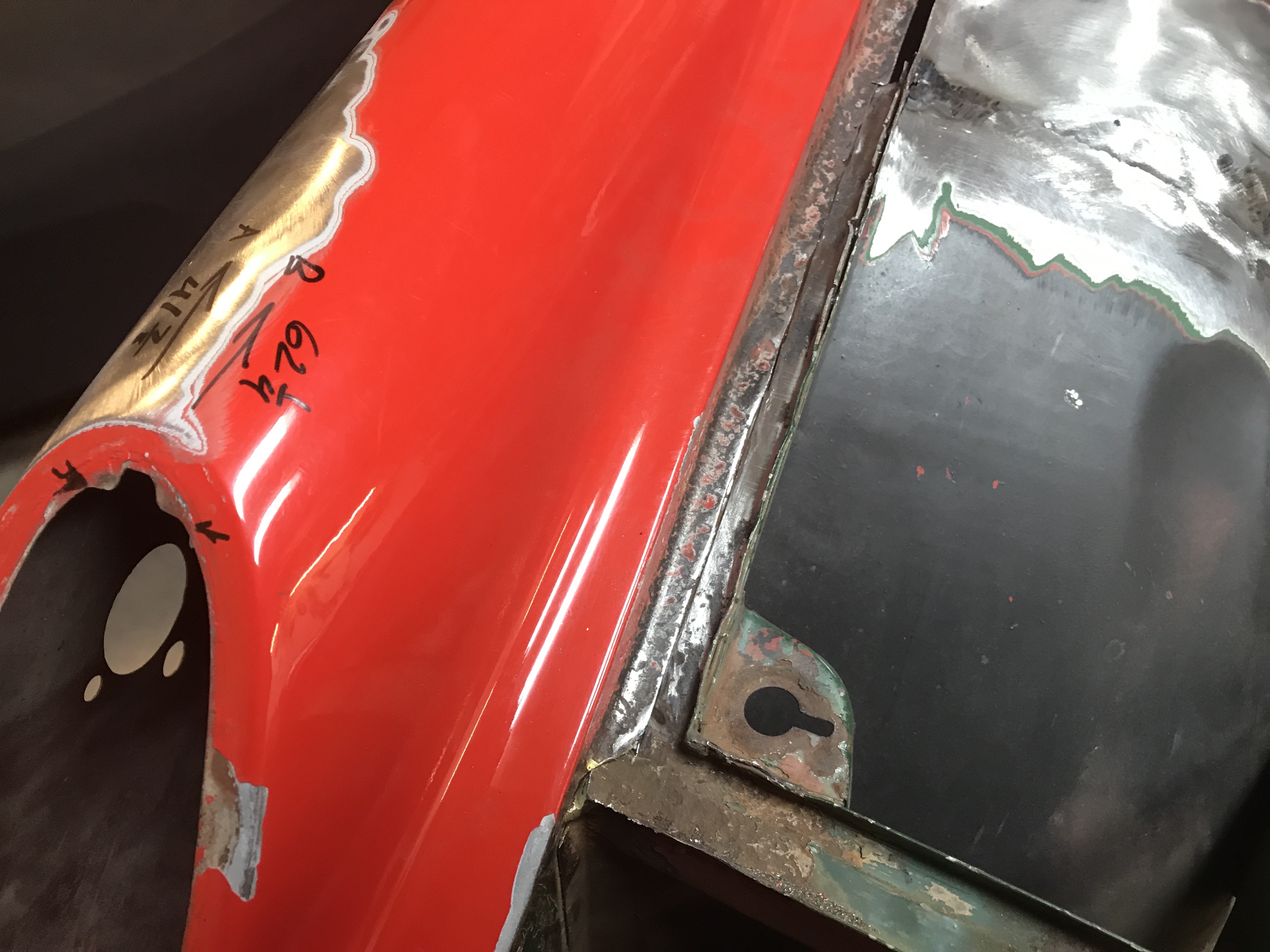

Getting on with the final fender fit, working on all the seams and junctions now, starting with the top seam near the cowl.
bkrantz
post Apr 1 2020, 07:57 PM
Post #437
Posts: 8,796
Joined: 3-August 19
From: SW Colorado
Member No.: 23,343

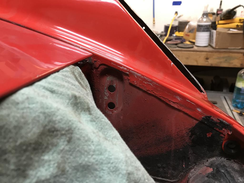

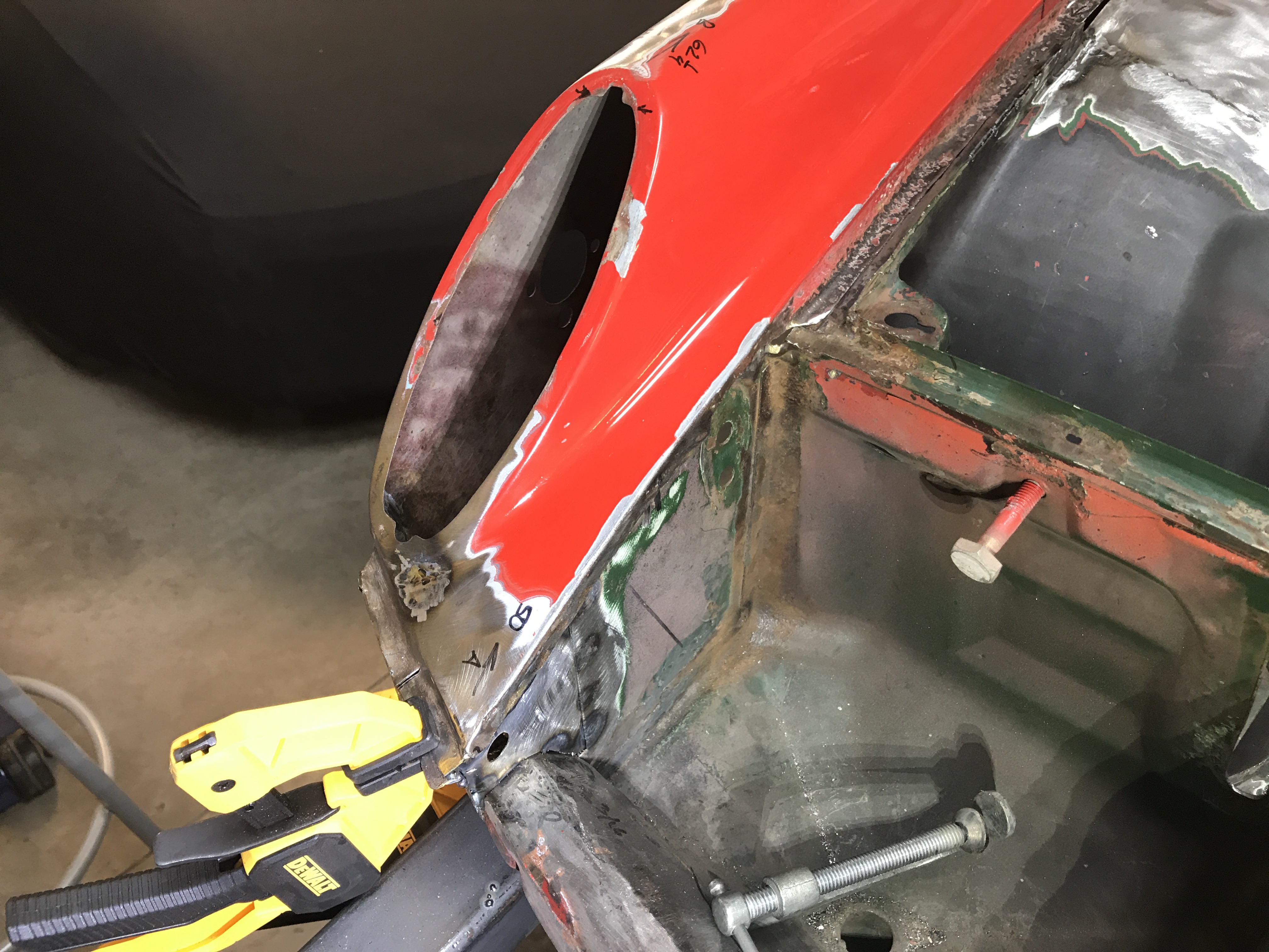

And near the headlight box.
bkrantz
post Apr 1 2020, 07:59 PM
Post #438
Posts: 8,796
Joined: 3-August 19
From: SW Colorado
Member No.: 23,343

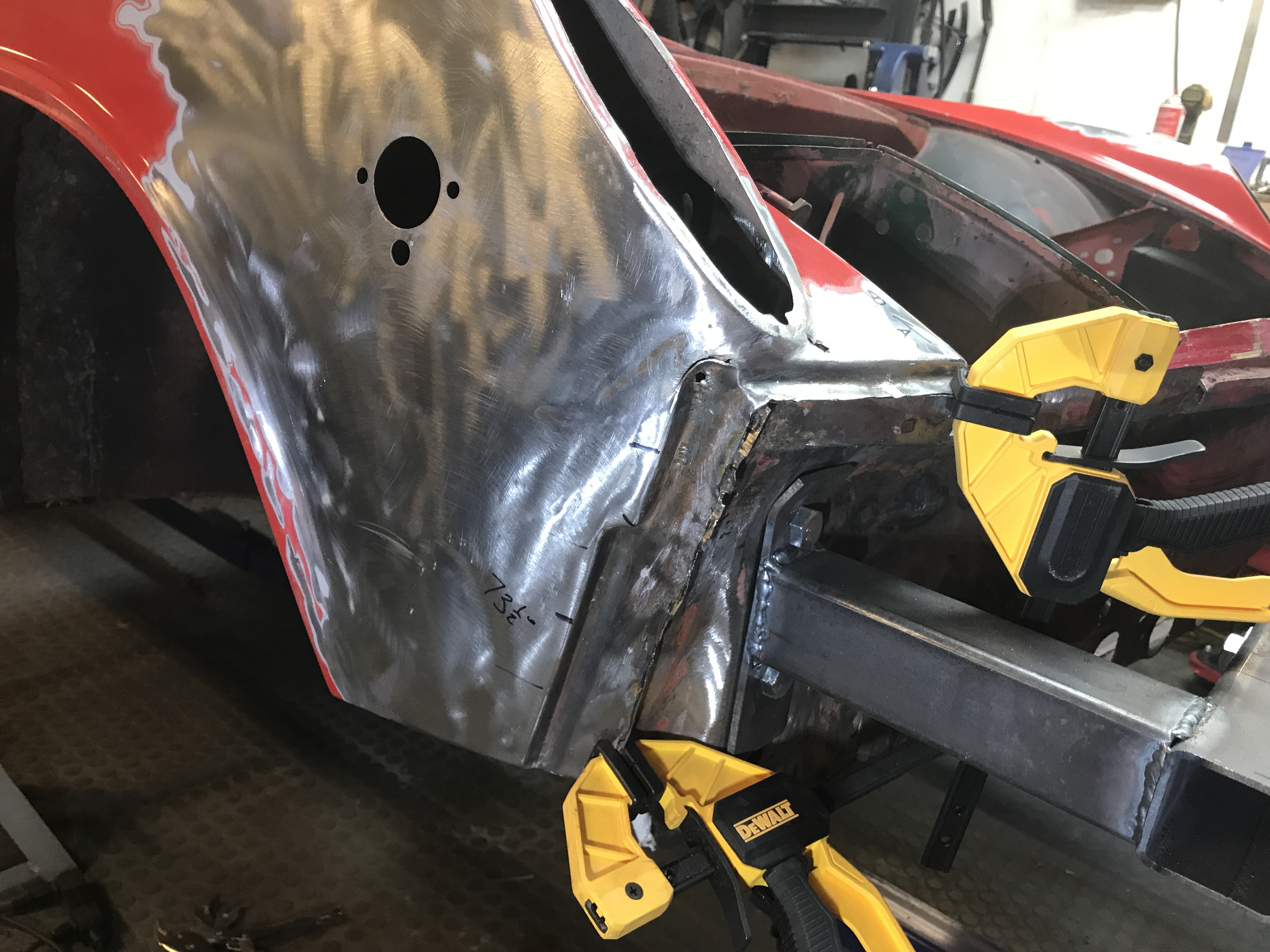

And the junction with the front panel. Fun fitting lumpy to lumpy.

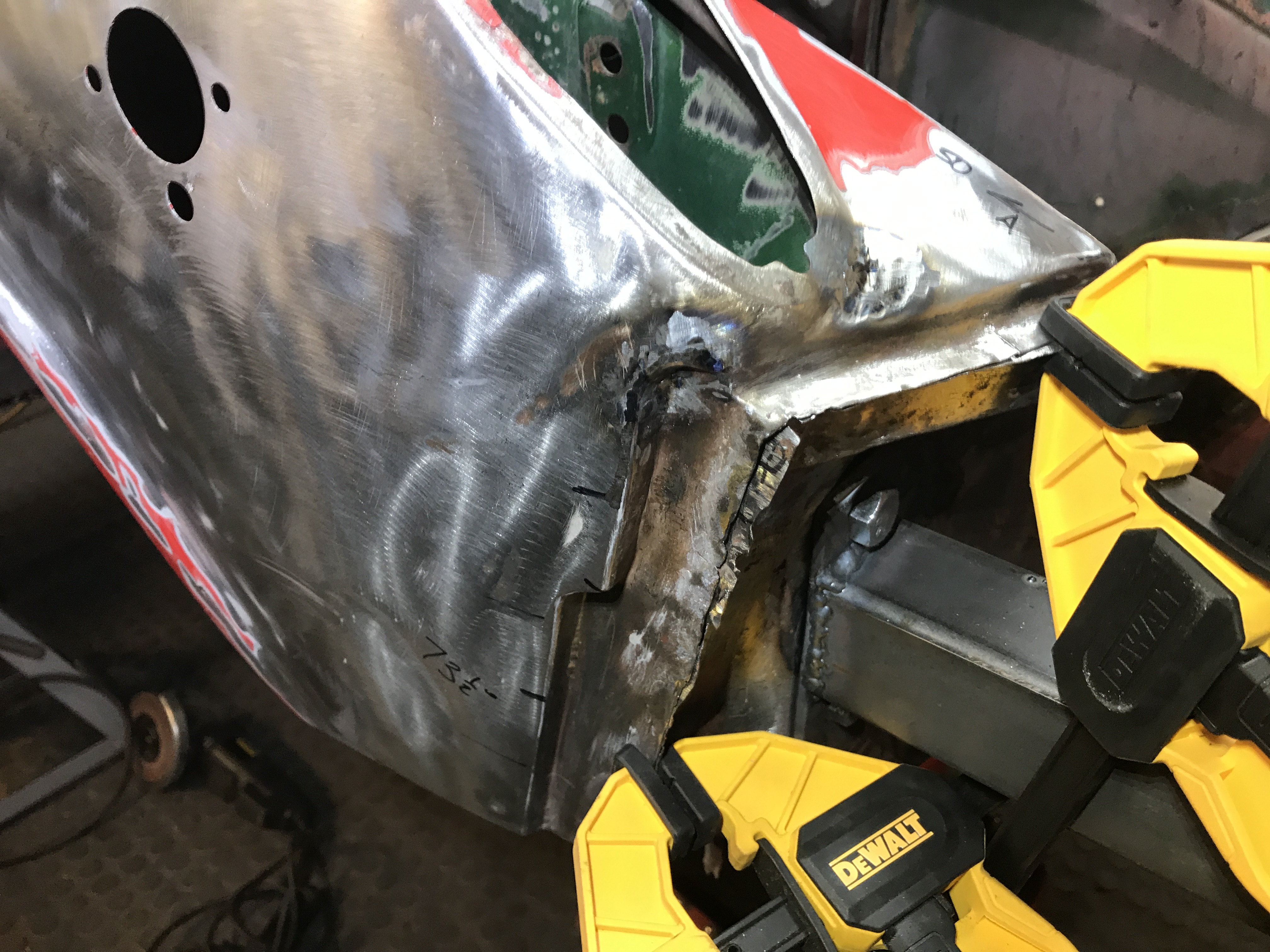

More fiddly work today. Welded the holes and tears in the fender, and some other minor bits.

And some adjustments to the front flange and the tabs on the headlight box wall.
I sure hope all this slow, deliberate fitting before I weld the fender on pays off.
