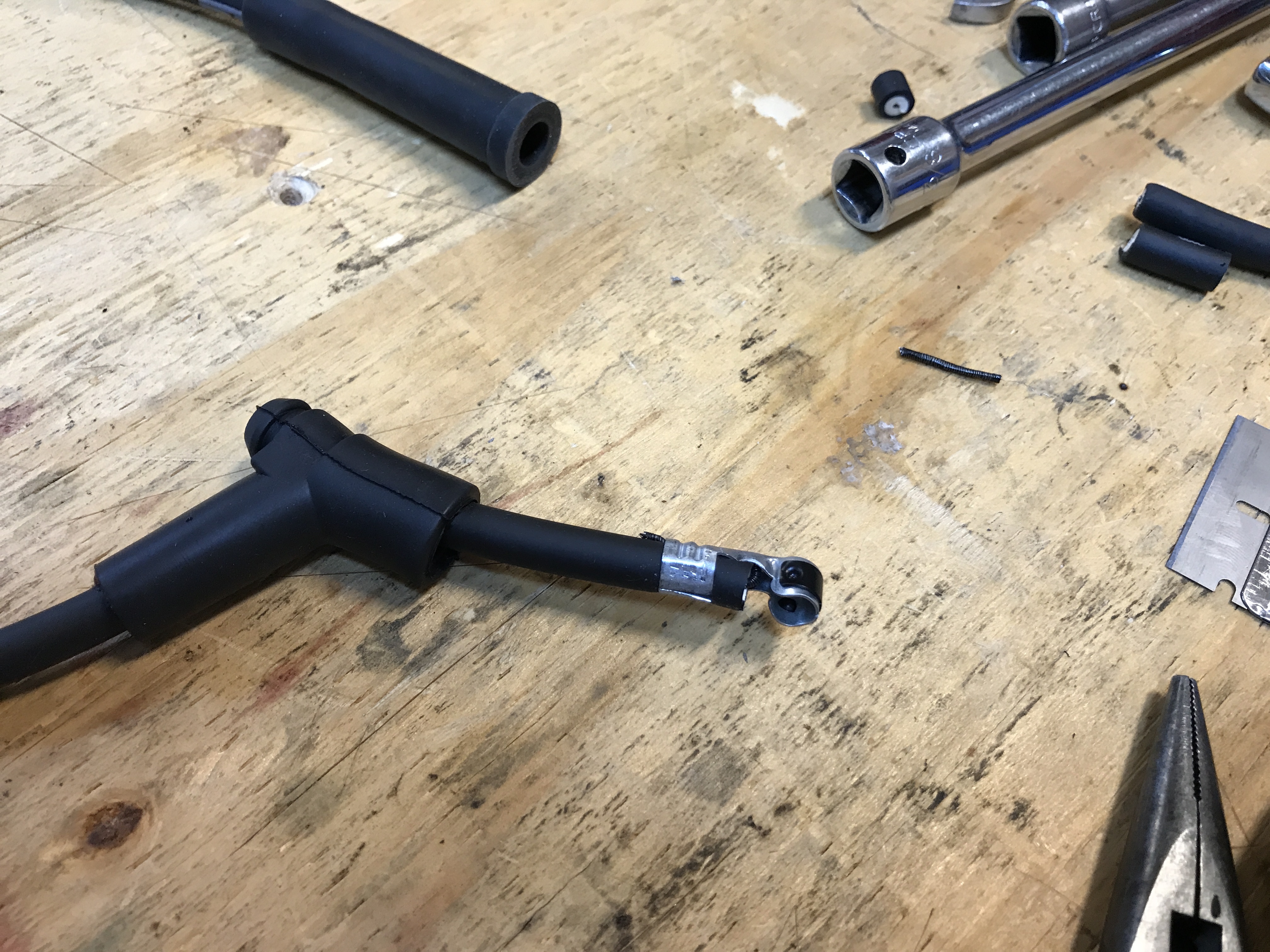

Member No.: 23,343

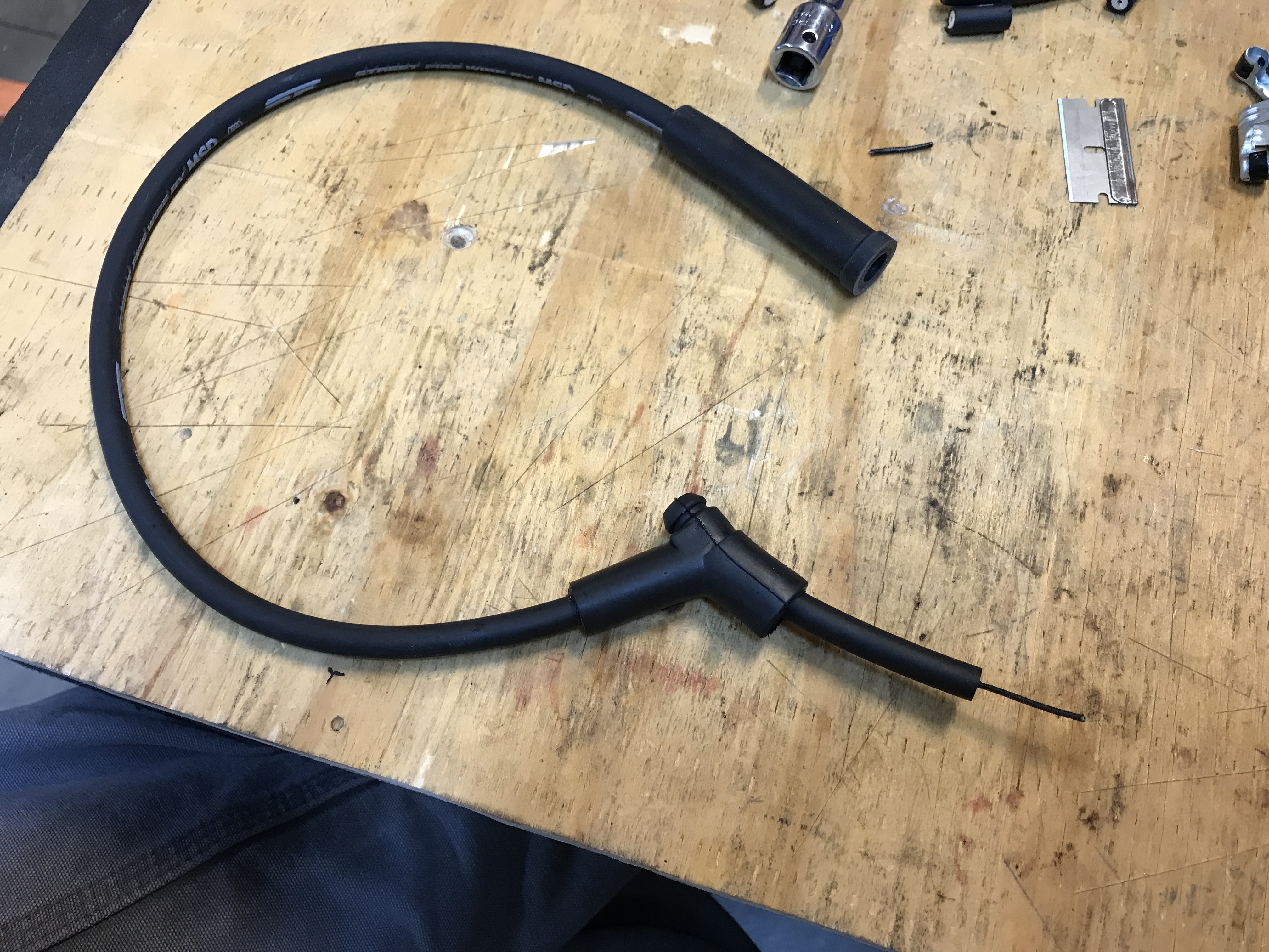

Then slide the boot on (tight!).

Member No.: 23,343

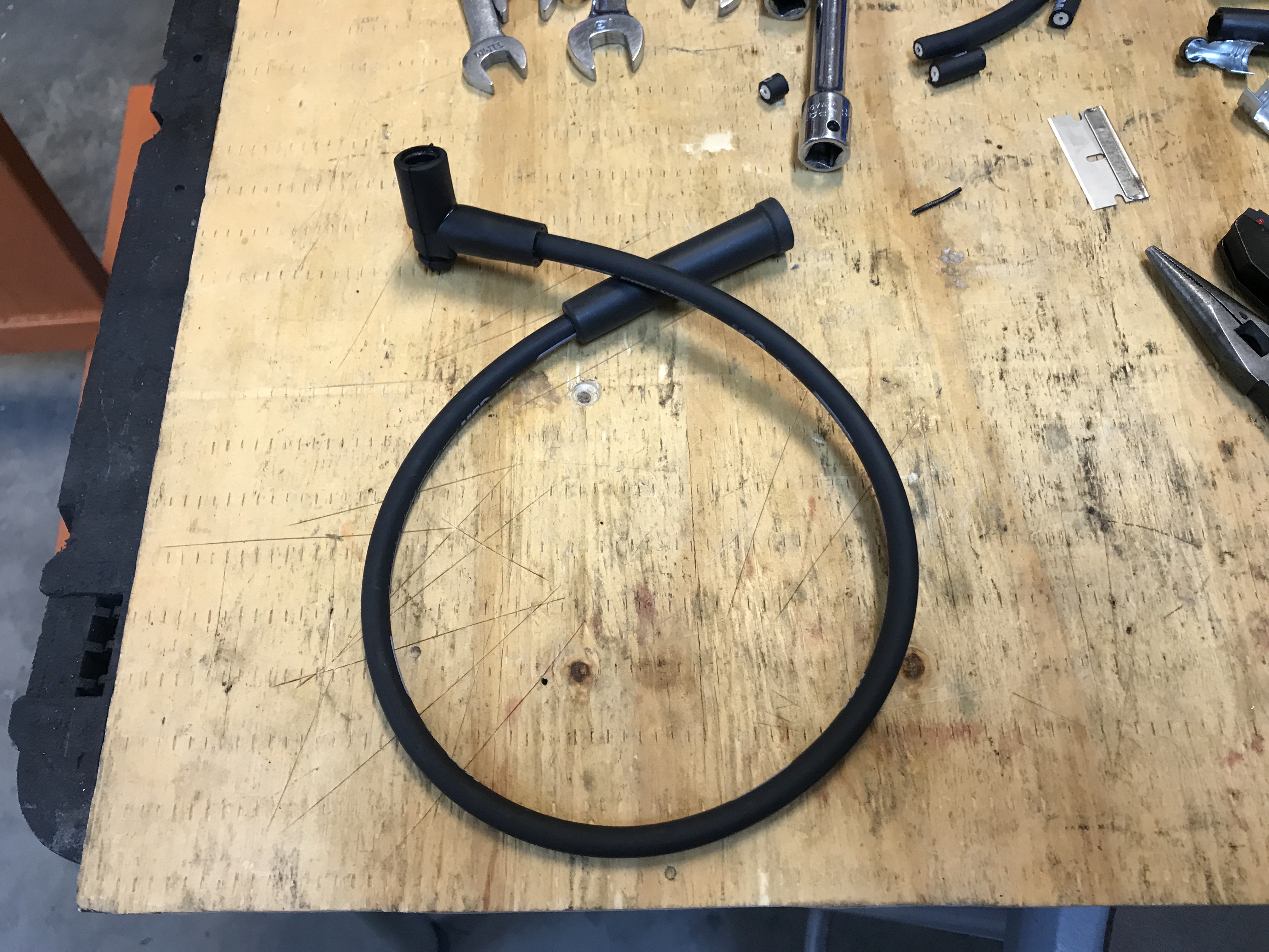

Crimp the connector.
bkrantz
post Nov 20 2021, 08:52 PM
Post #4203
Posts: 8,530
Joined: 3-August 19
From: SW Colorado
Member No.: 23,343
First wire done.

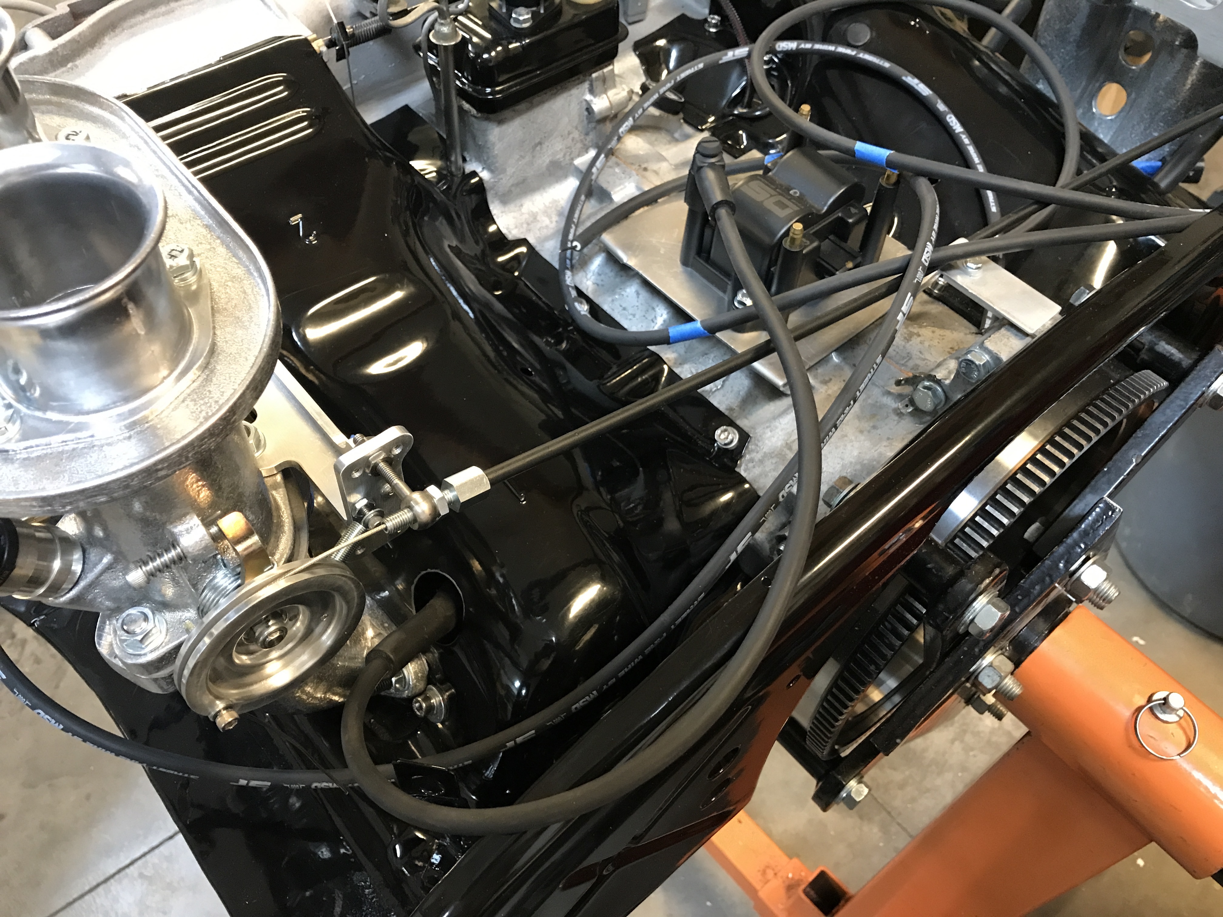

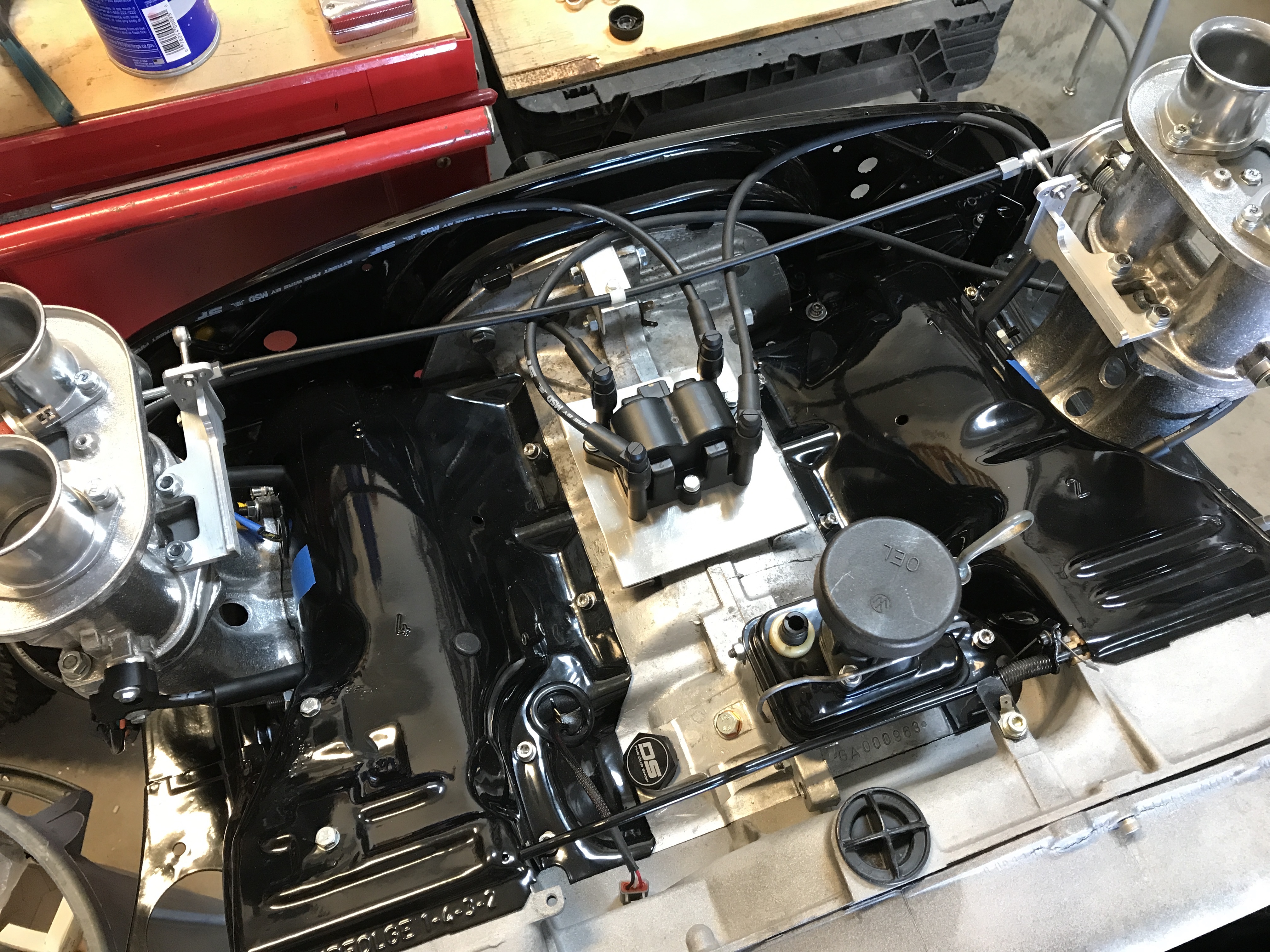

I made up the other 3 plug wires today, and plugged everything together. This layout should work, but I want to add a couple of wire holders.

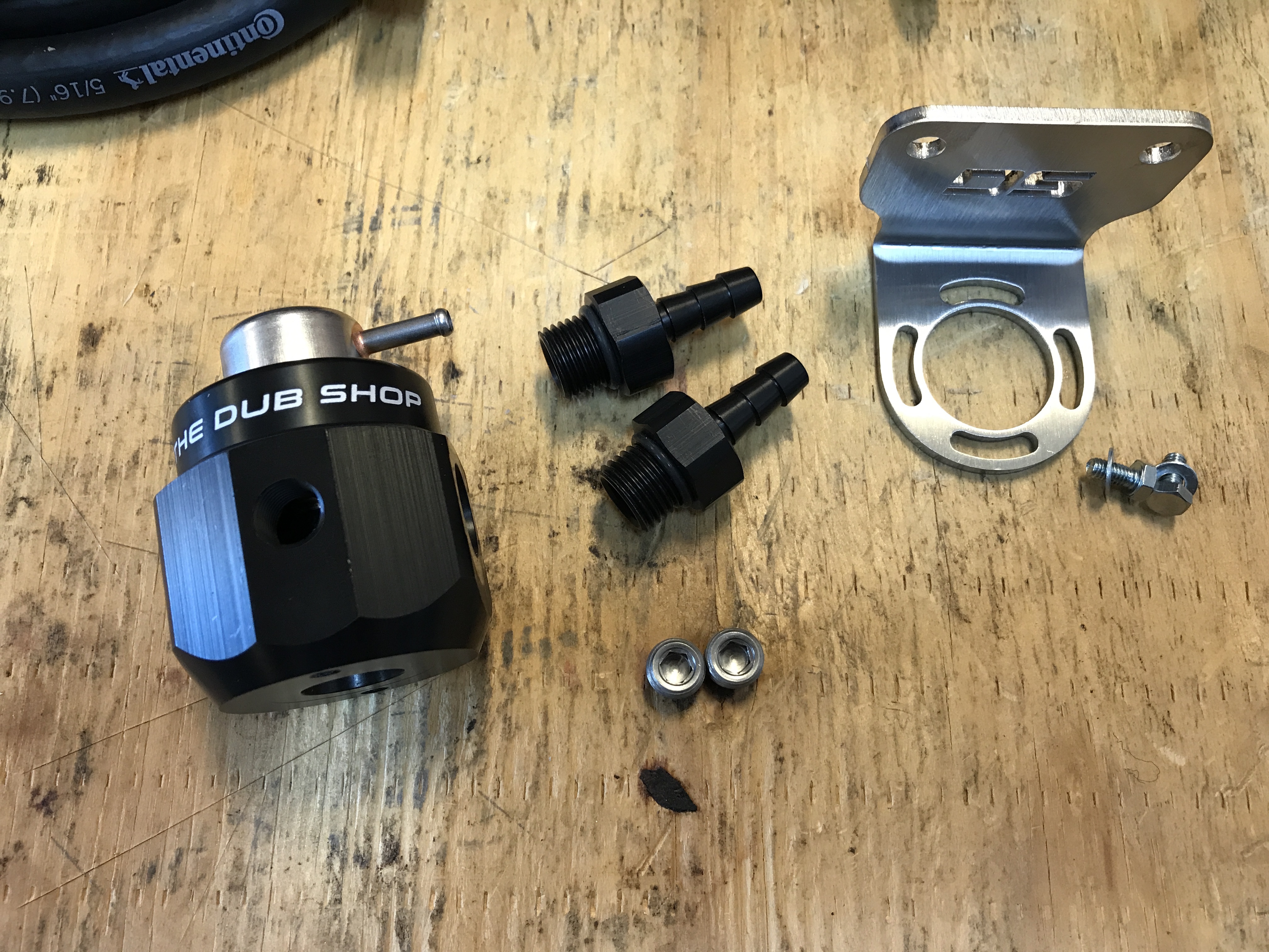

Member No.: 23,343

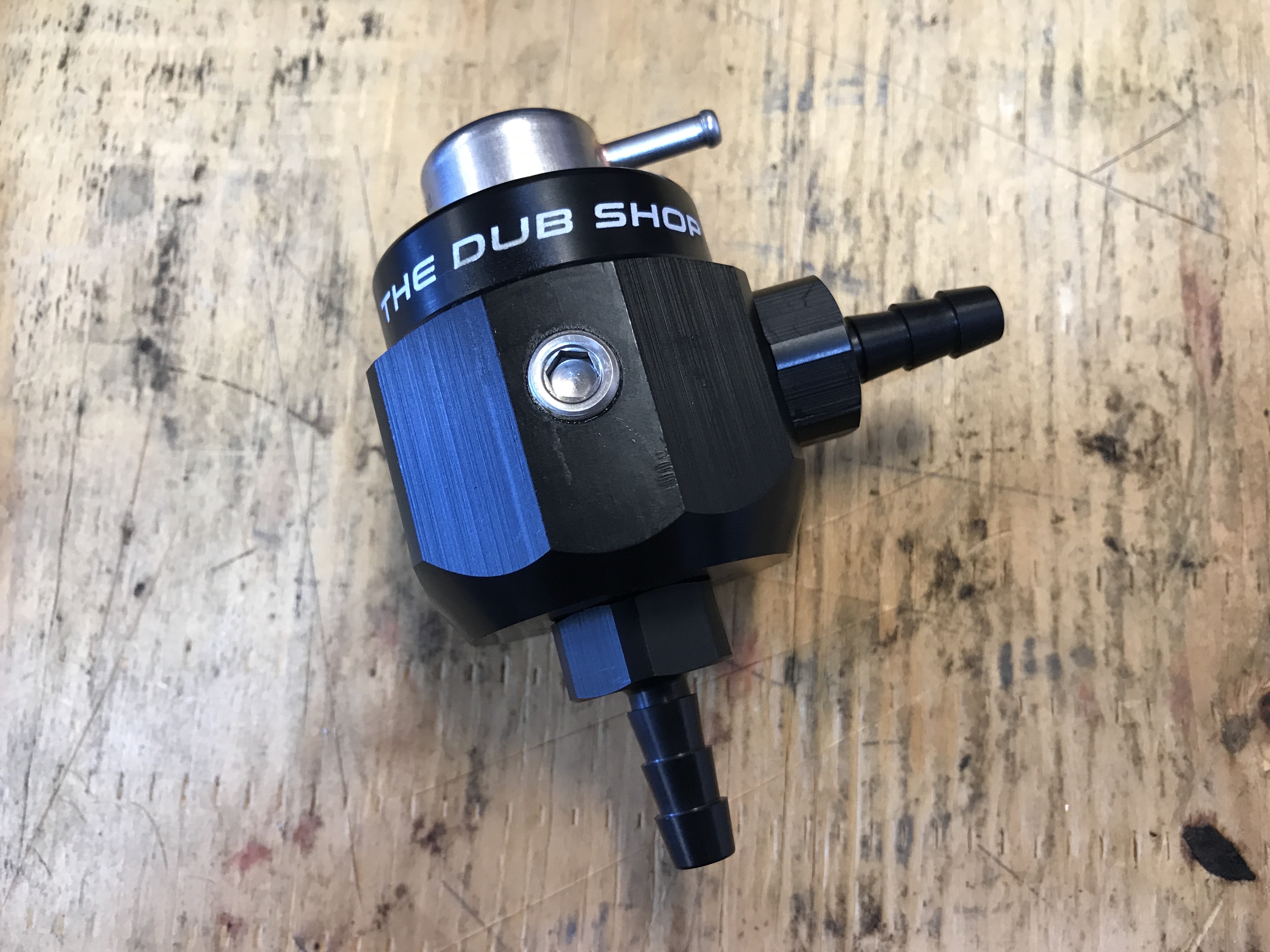

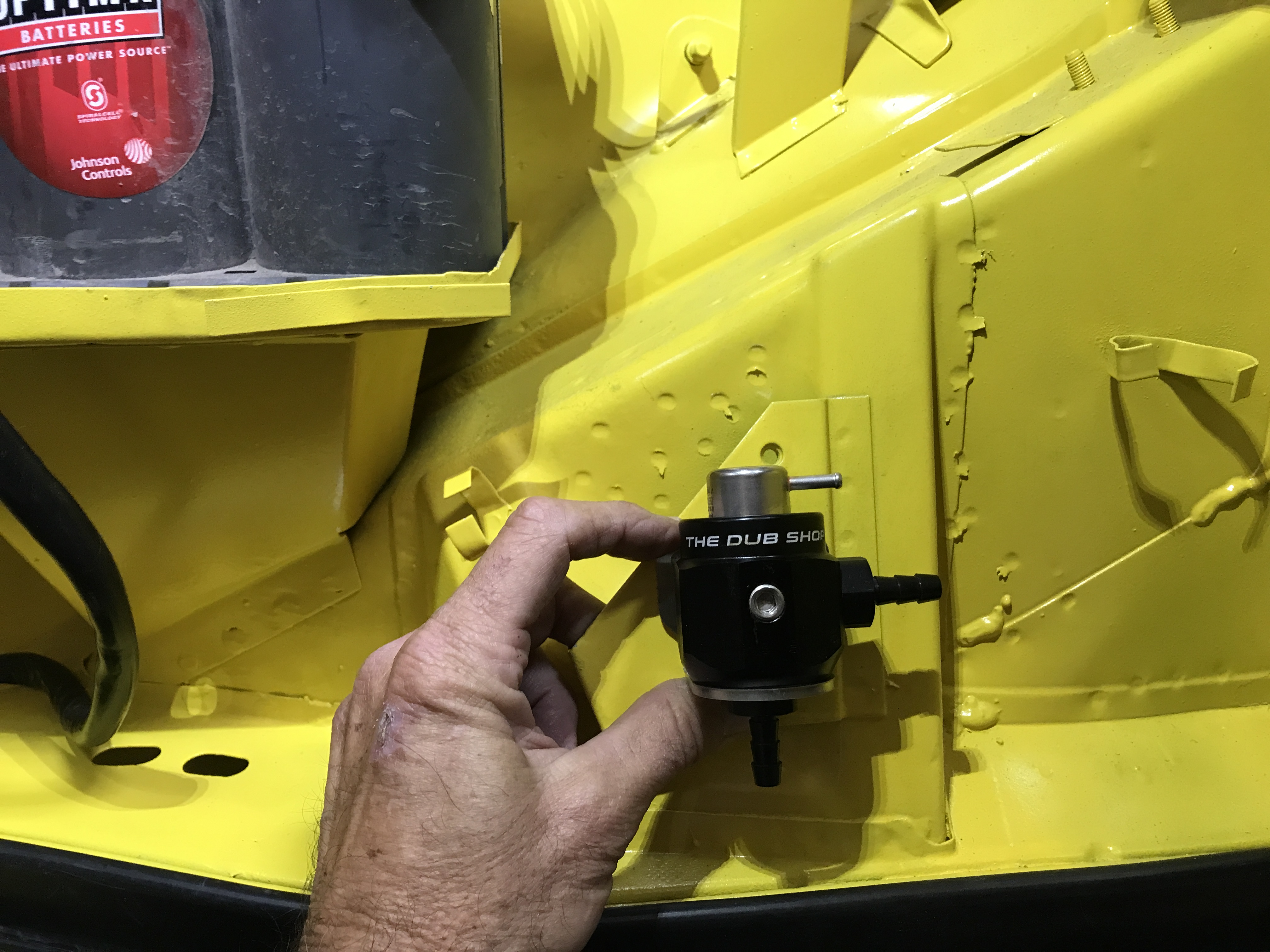

This is the pressure regulator, and the Dub Shop bracket. More cool stuff!
bkrantz
post Nov 21 2021, 08:32 PM
Post #4210
Posts: 8,530
Joined: 3-August 19
From: SW Colorado

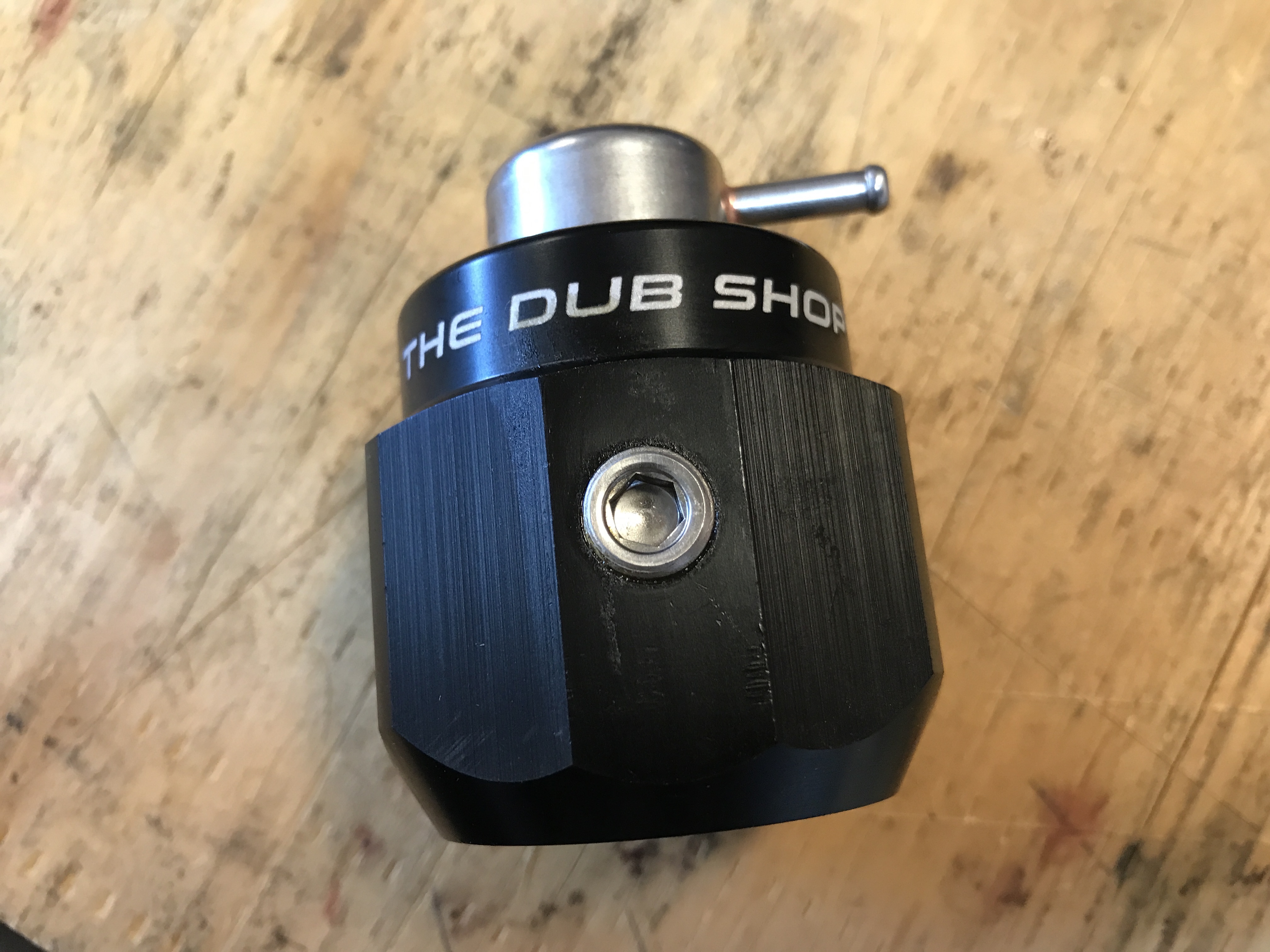

Member No.: 23,343
I don't need the auxiliary ports, so installed the plugs, with a bit of #3 sealant on the threads.
bkrantz
post Nov 21 2021, 08:34 PM
Post #4211
Posts: 8,530
Joined: 3-August 19
From: SW Colorado
Member No.: 23,343
And then the barbed fittings for input (side) and return (bottom). These have O-rings and don't need any sealant.

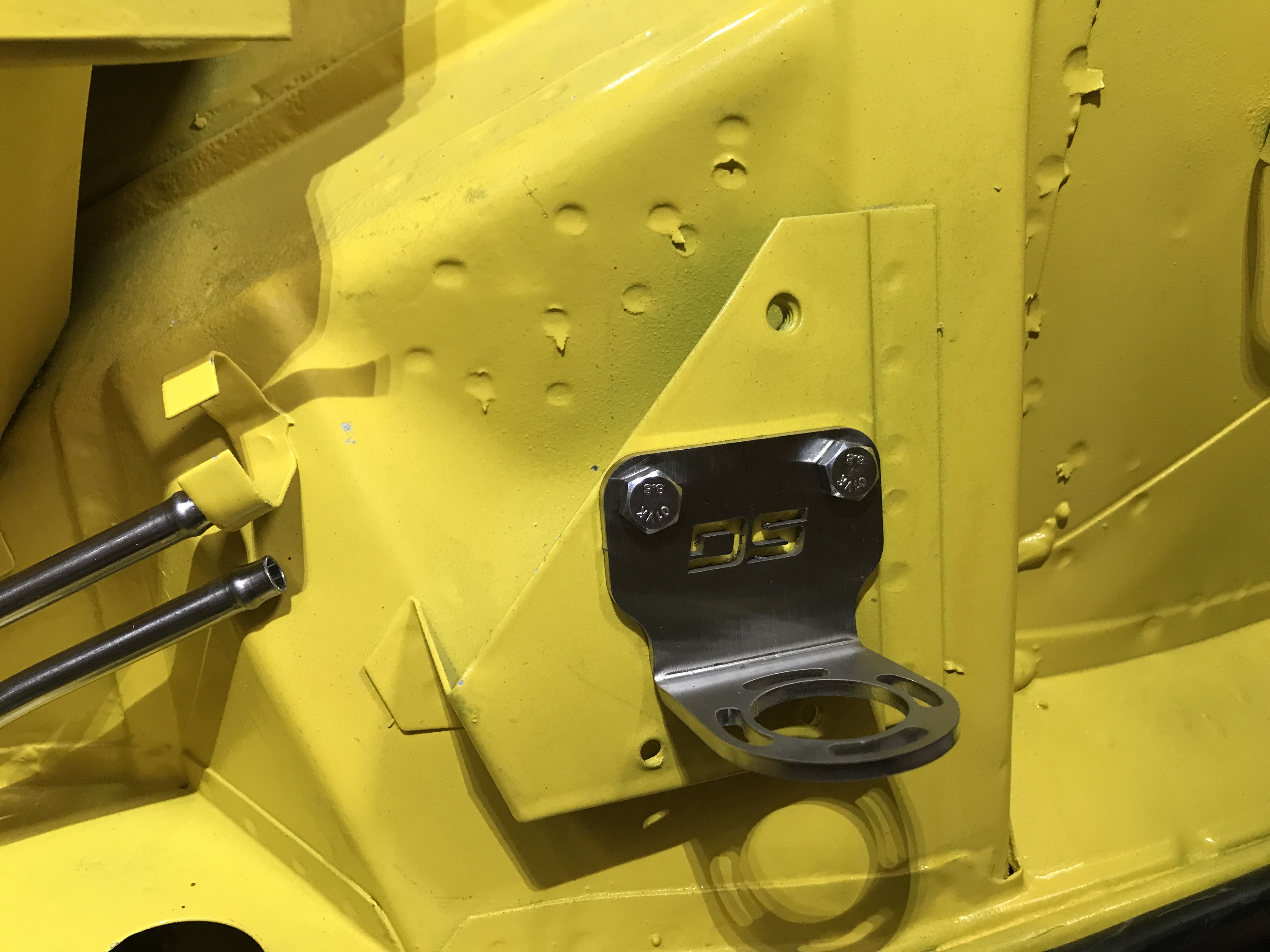

I will mount this on the bracket for the original MPS.
bkrantz
post Nov 21 2021, 08:35 PM
Post #4213
Posts: 8,530
Joined: 3-August 19
From: SW Colorado
Member No.: 23,343
Drilled some new holes, and mounted the bracket.
bkrantz
post Nov 21 2021, 08:36 PM
Post #4214
Posts: 8,530
Joined: 3-August 19
From: SW Colorado
Member No.: 23,343
And then the regulator.

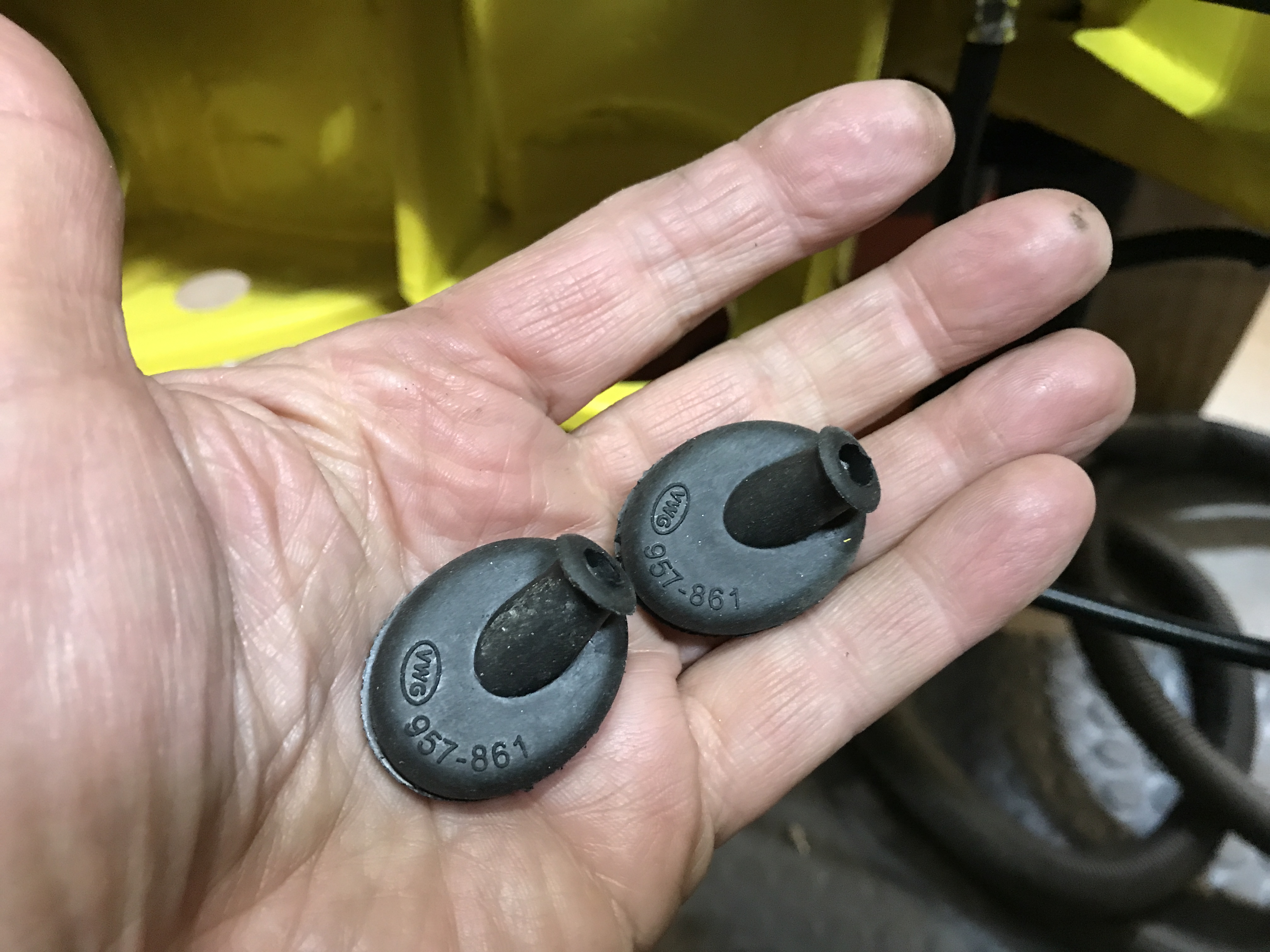

Member No.: 23,343

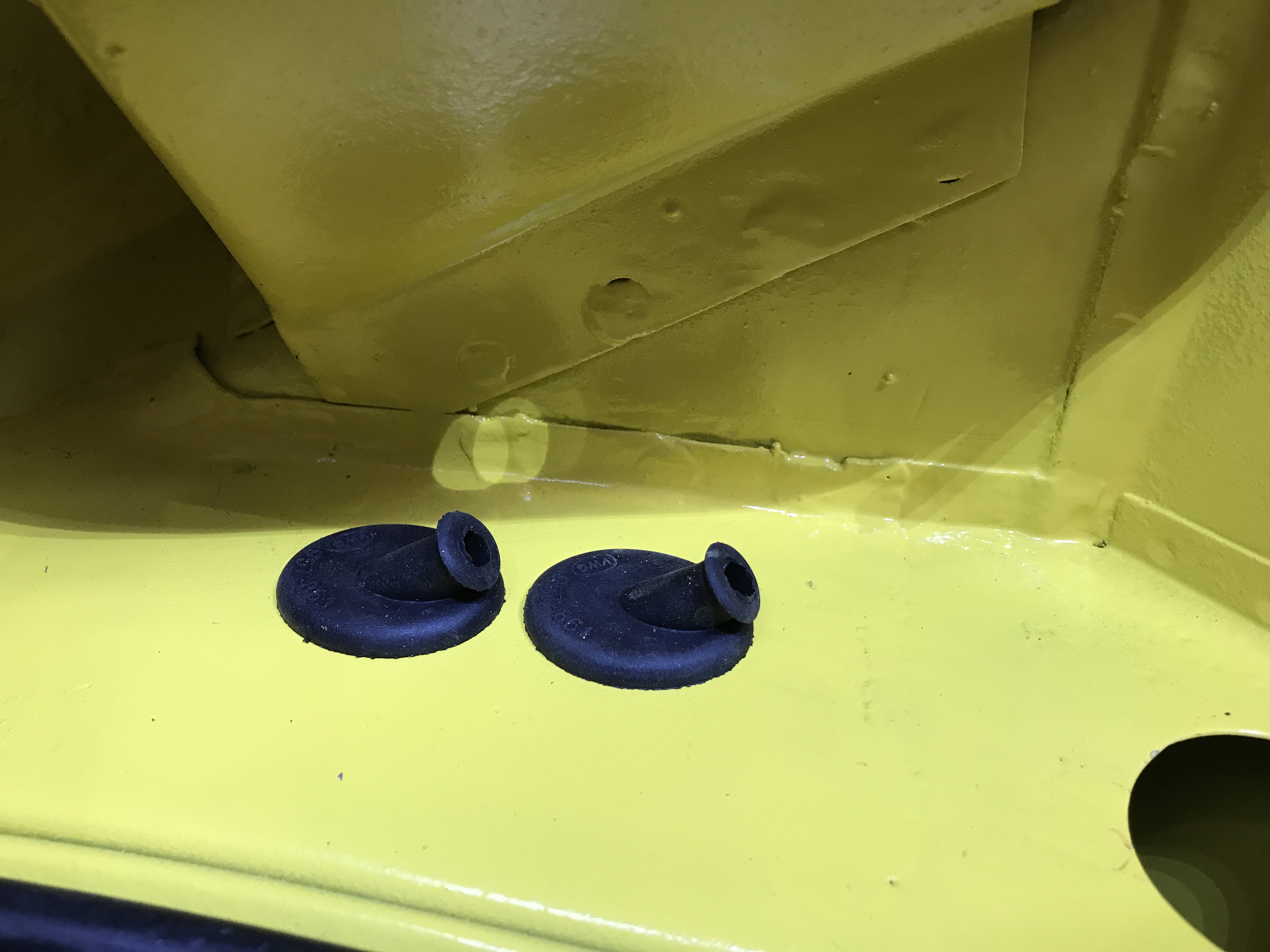

Now time for the fuel lines, starting with new grommets for the side shelf.
bkrantz
post Nov 21 2021, 08:42 PM
Post #4216
Posts: 8,530
Joined: 3-August 19
From: SW Colorado
Member No.: 23,343
Grommets in place.

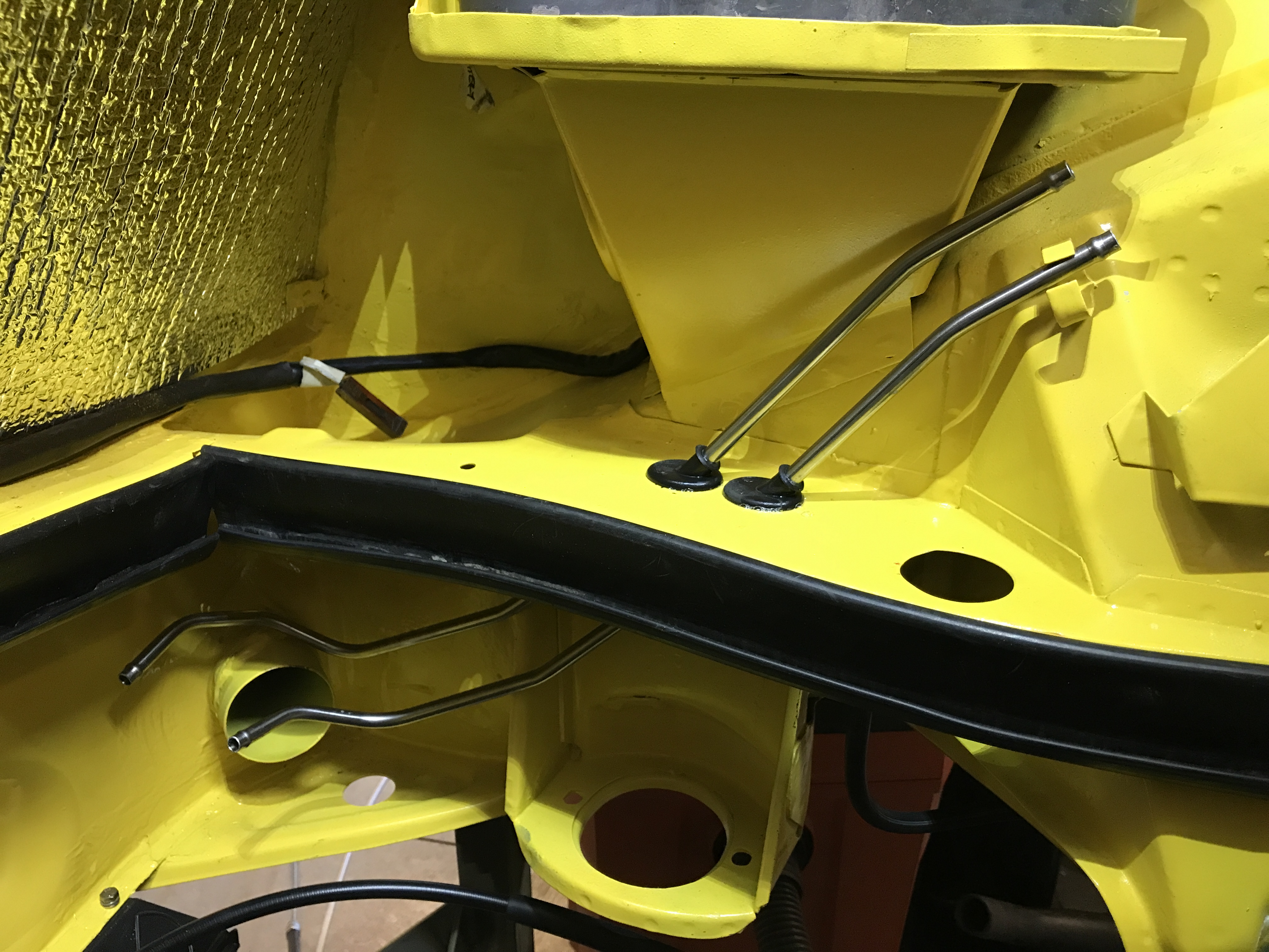

Member No.: 23,343

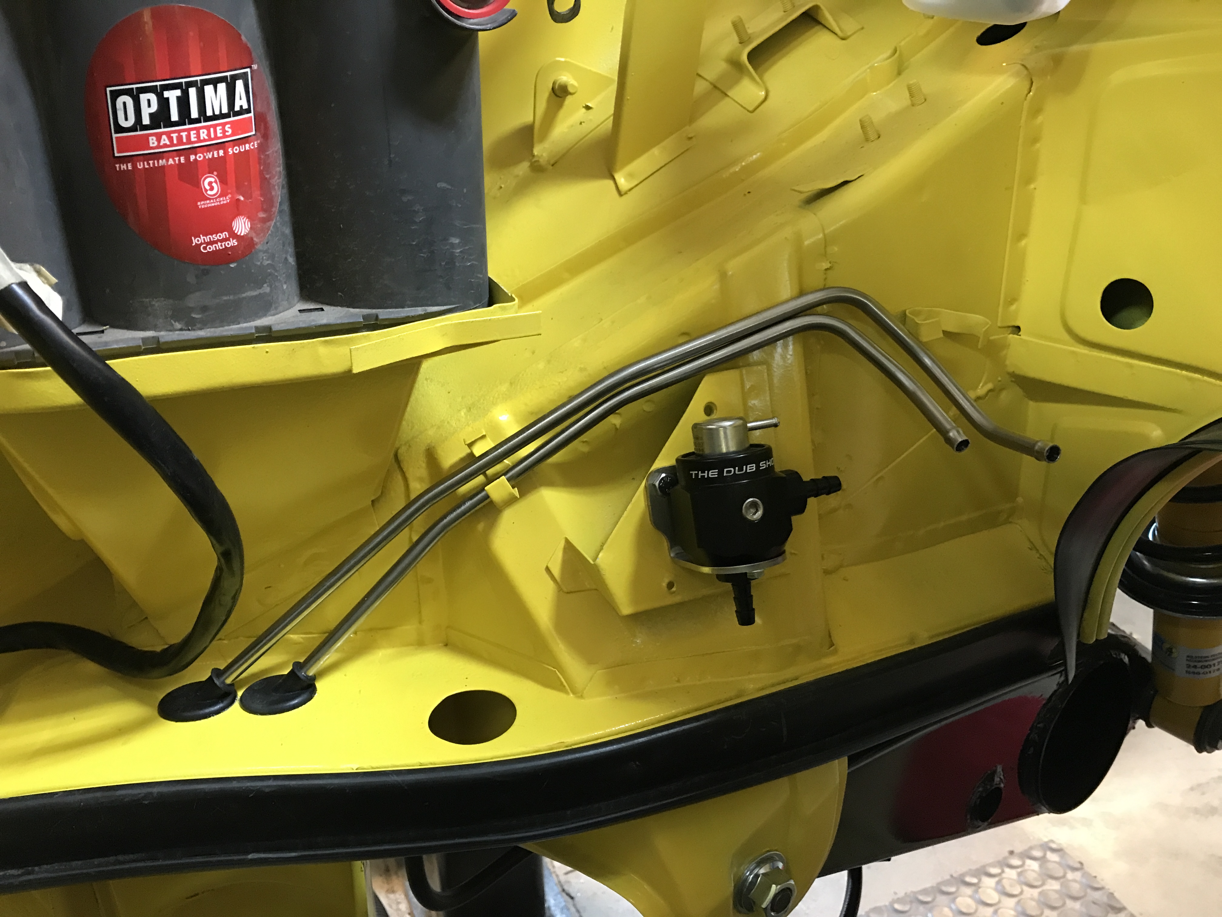

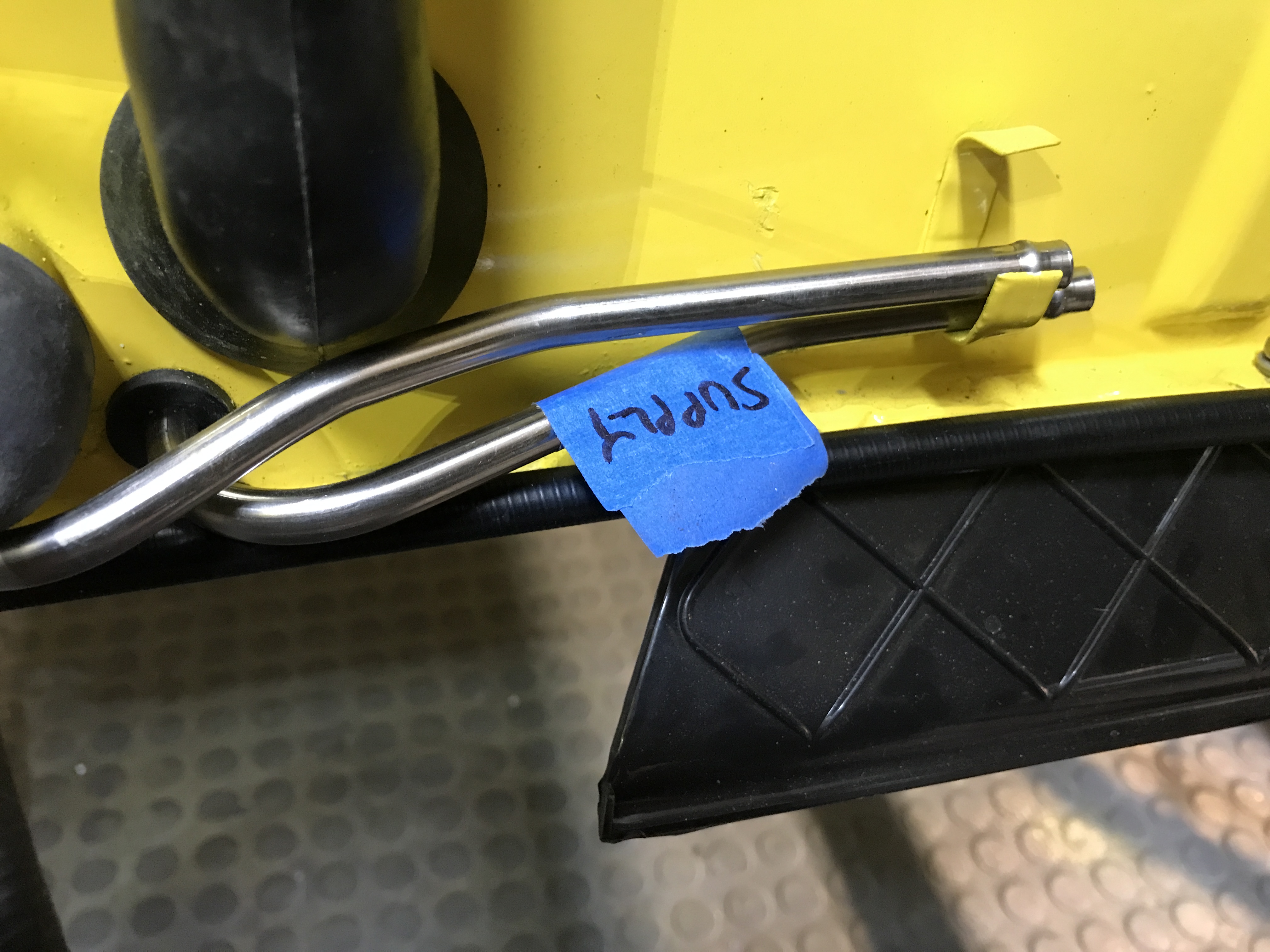

First, I tried the short hard-lines upside-down, since I moved the pump to the front. Not really a good fit.
bkrantz
post Nov 21 2021, 08:47 PM
Post #4218
Posts: 8,530
Joined: 3-August 19
From: SW Colorado
Member No.: 23,343
The "correct" way looks better.

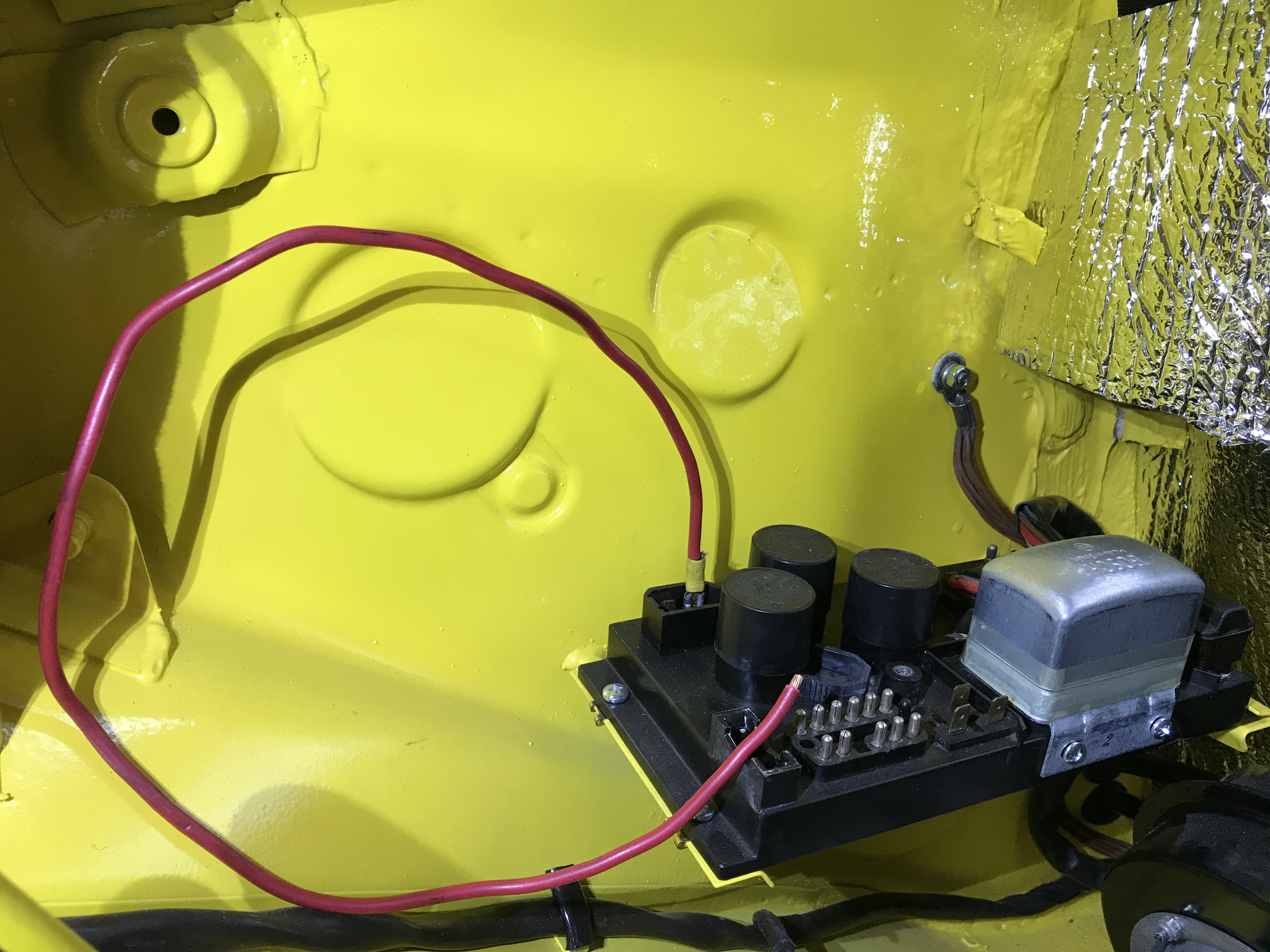

Once upon a time, I had a label on the supply line coming out of the tunnel, but that got lost. So I tried running the fuel pump, using a jumper between the number III tab on the FI system plug on the relay board and ground (ignition on).
bkrantz
post Nov 21 2021, 08:51 PM
Post #4220
Posts: 8,530
Joined: 3-August 19
From: SW Colorado
Member No.: 23,343
That worked, with a subtle but distinct air pressure build up in the supply line coming from the pump.
