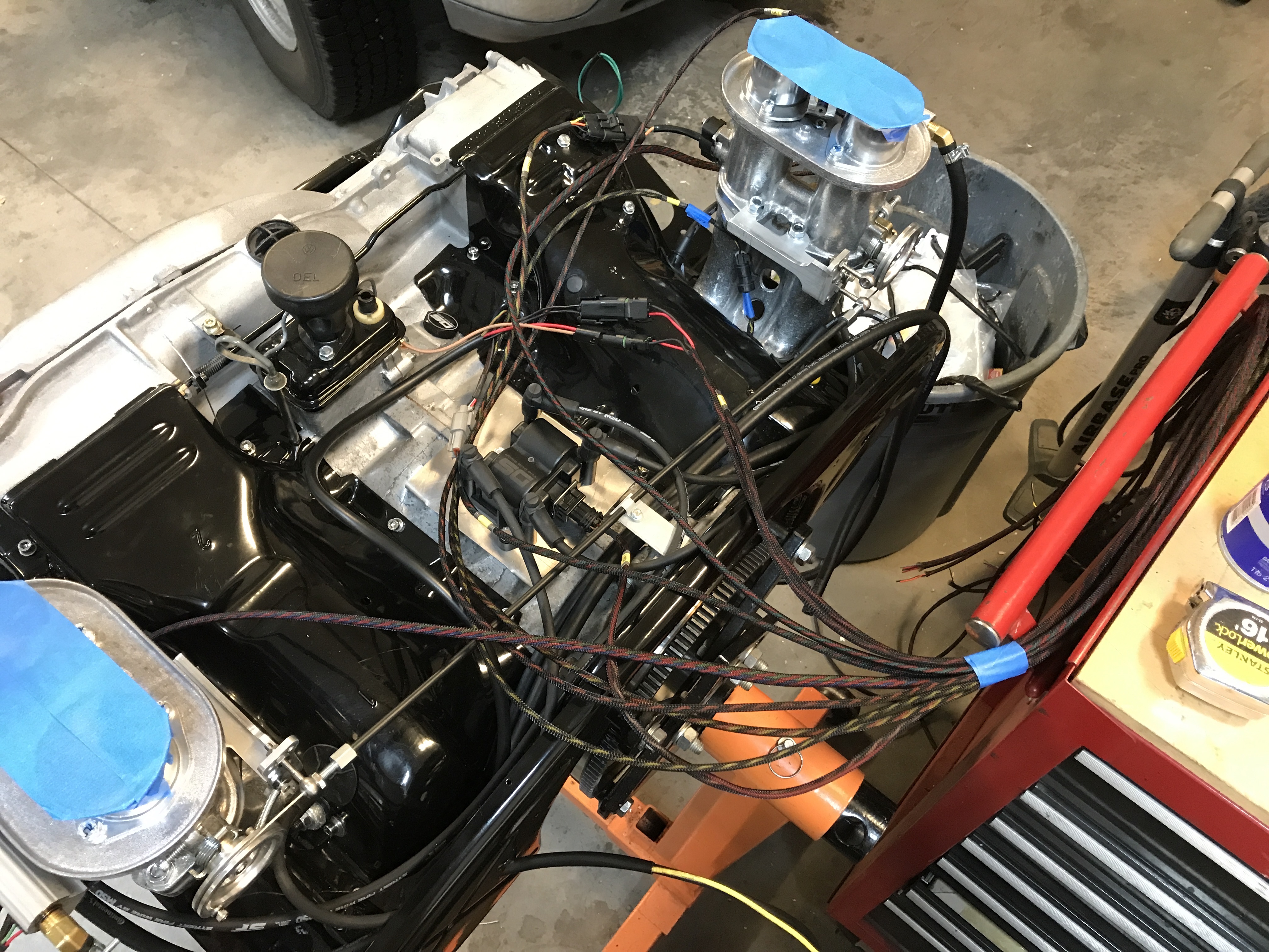

That should be all the cables and leads, old and new. Now to organize this mess before it goes in the car.

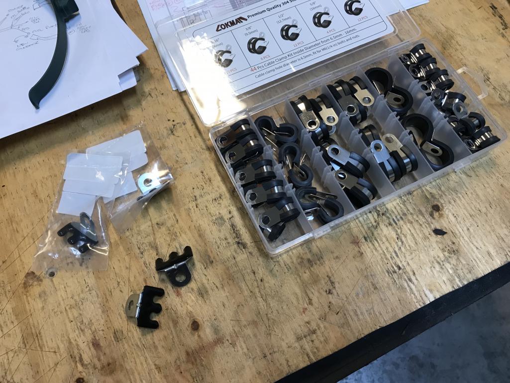

Stuff that might help: spark plug wire brackets and cable clamps/hangers.

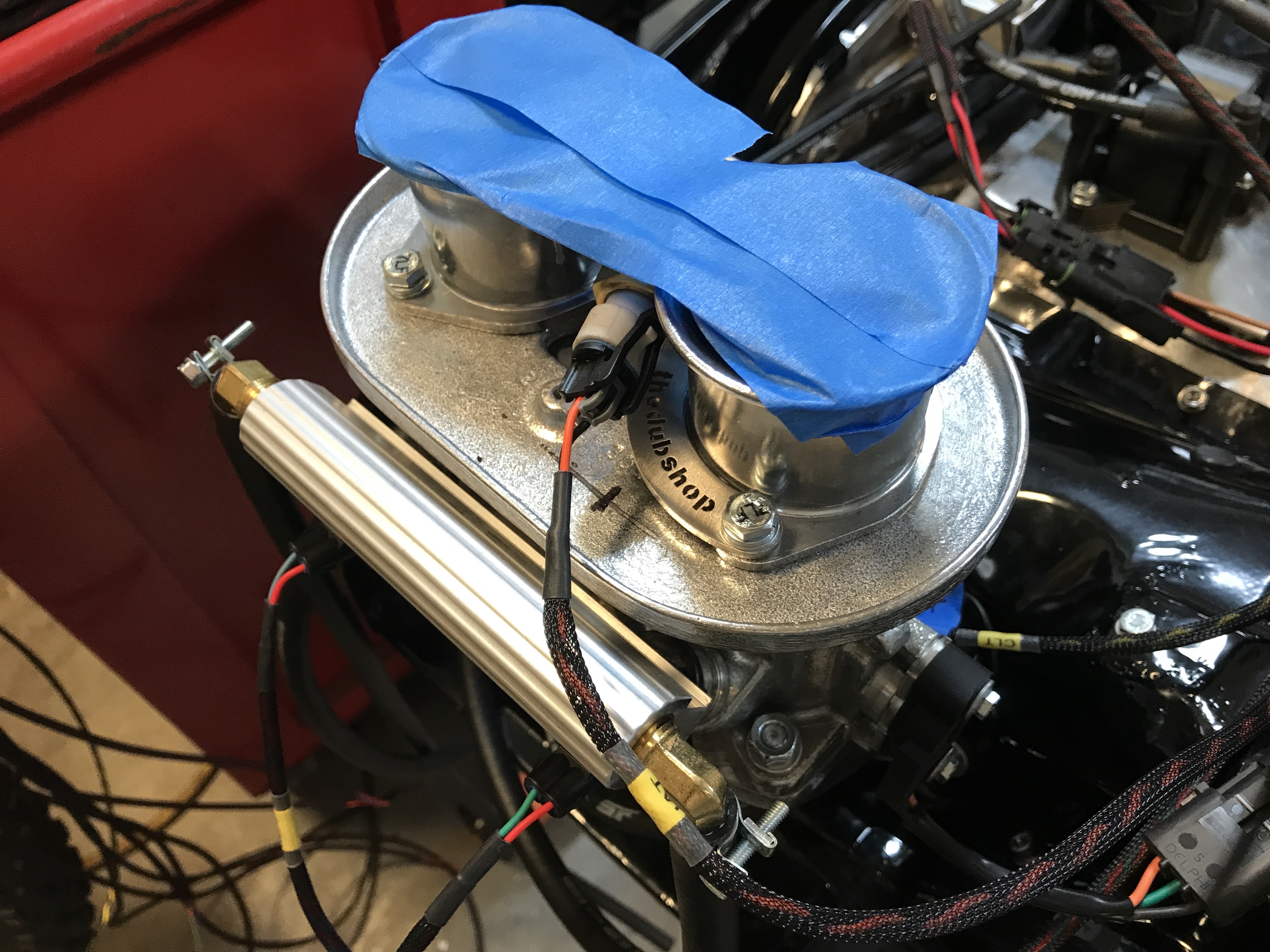

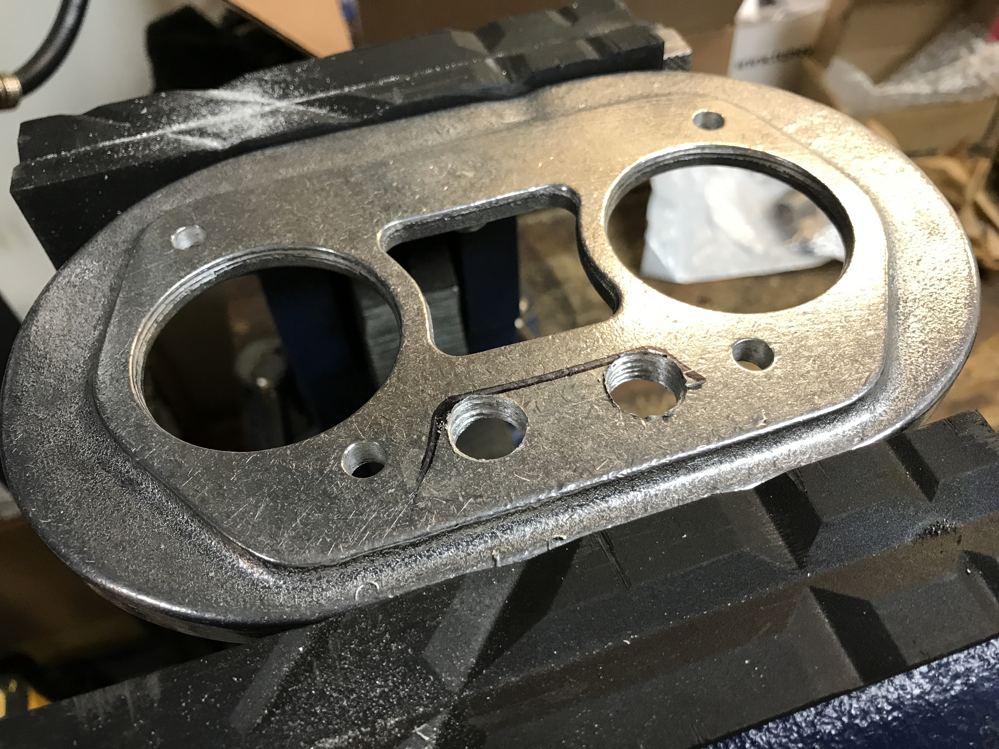

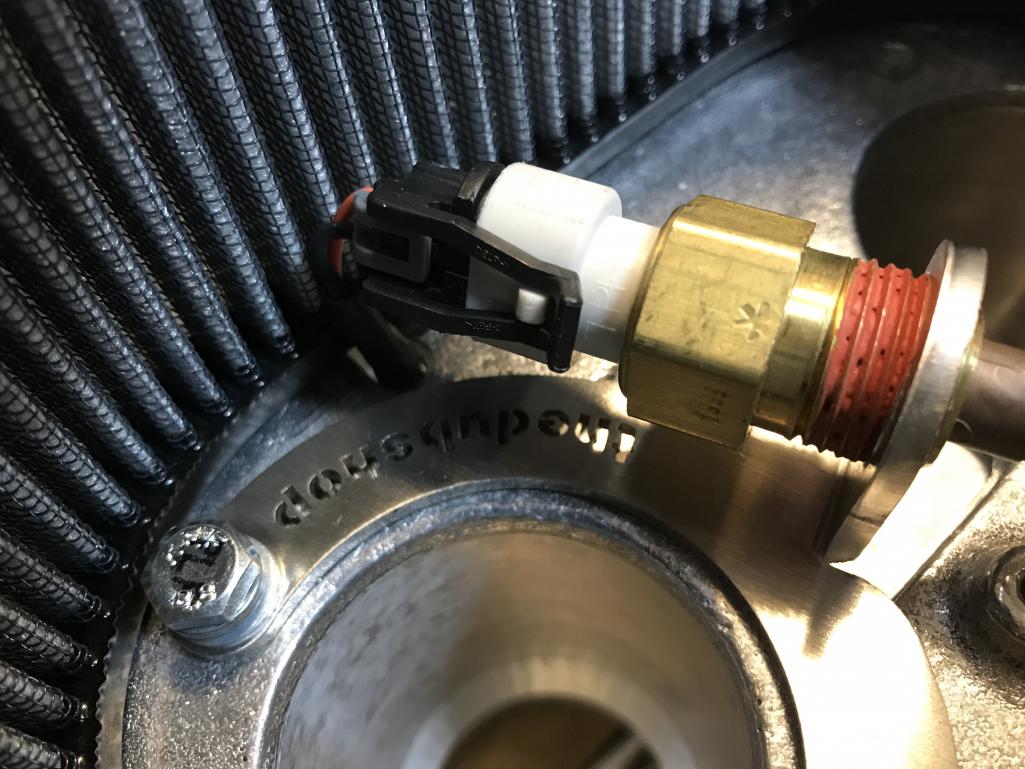

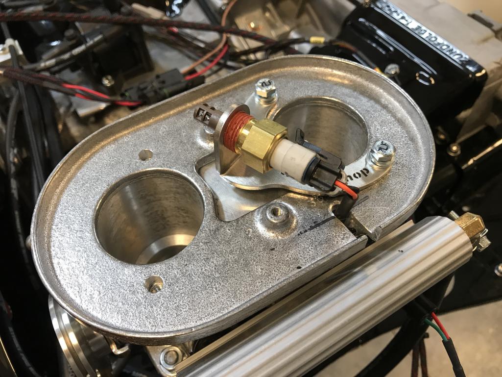

Some more engine details. First, I need to make a way for the intake temp sensor cable to reach inside the air filter.
post Dec 10 2021, 08:33 PM
Post #4265
Posts: 8,530
Per Dup Shop design, I notched the base plate.
post Dec 10 2021, 08:34 PM
Post #4266
Posts: 8,530

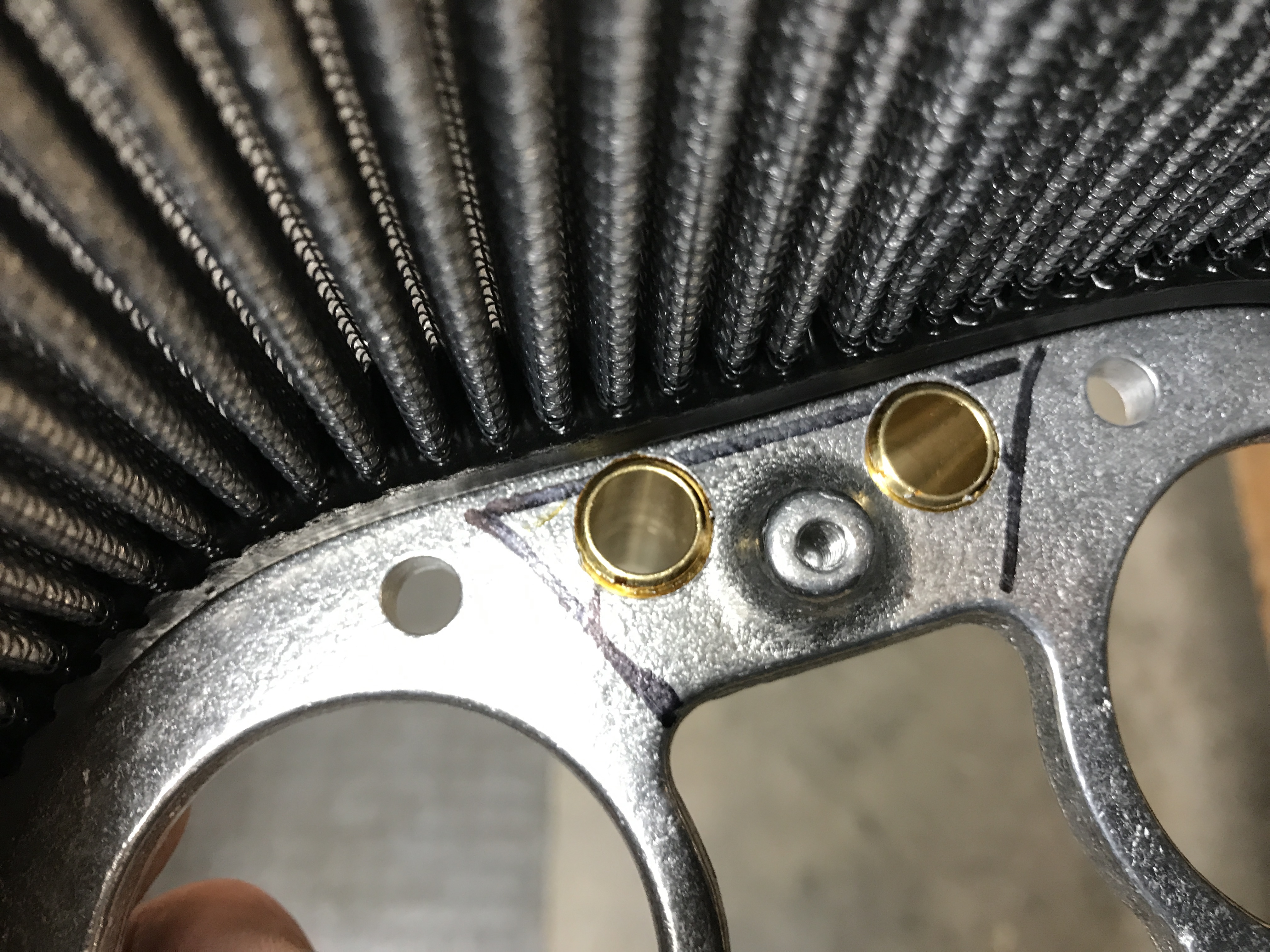

The filter element covers most of the notch. Maybe a dap of silicone for where the wire passes through.

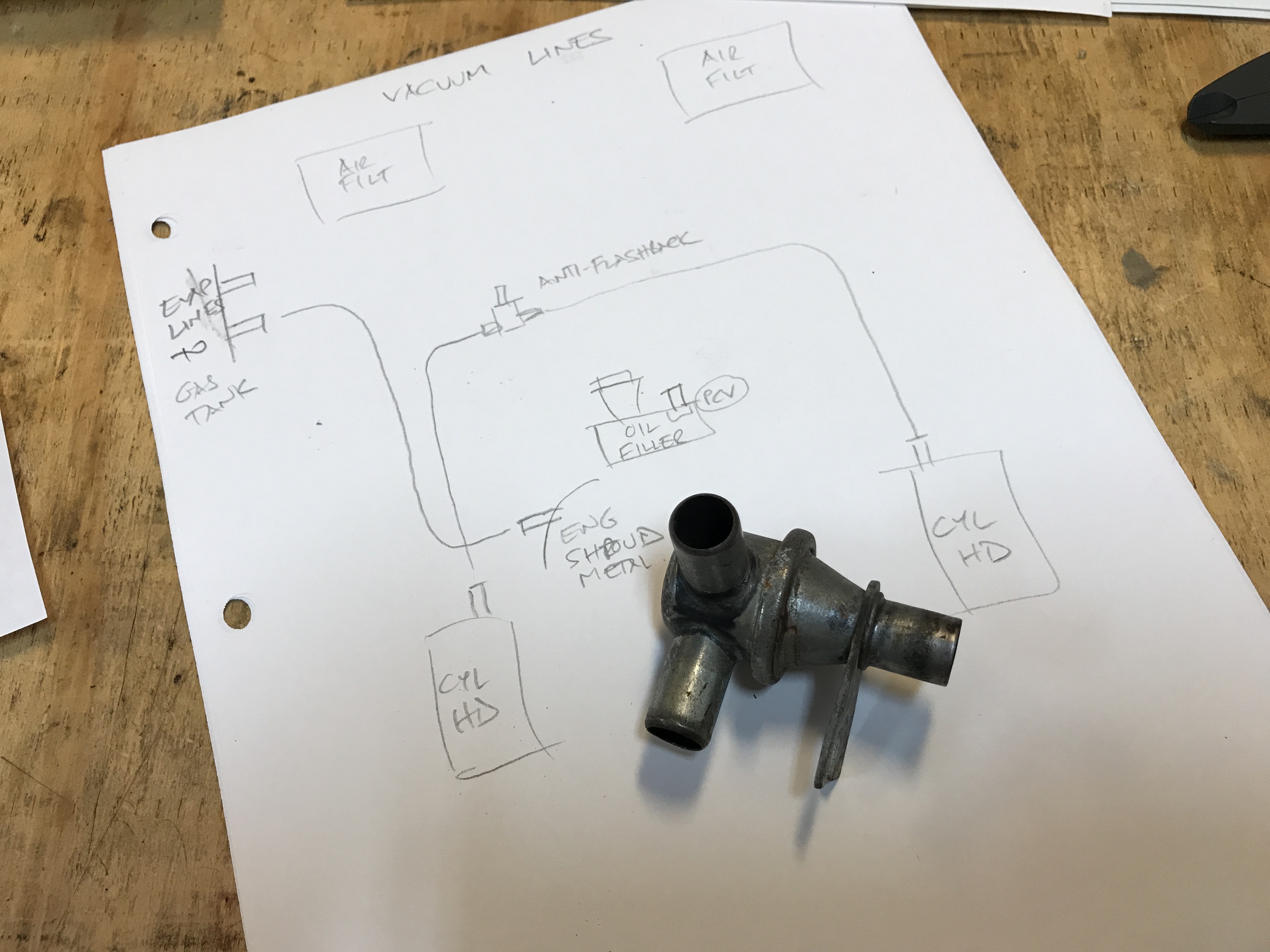

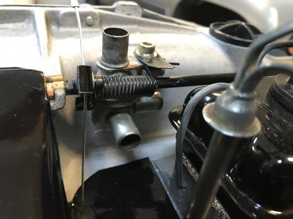

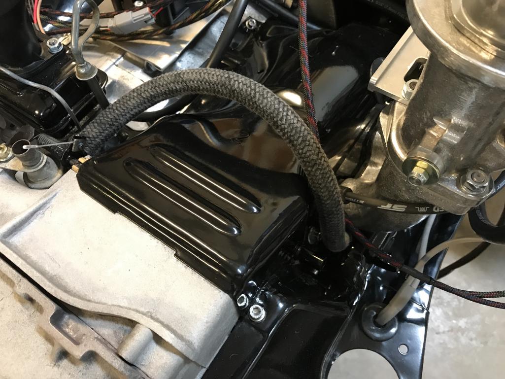

Then, I started plumbing the engine vacuum system--still under design. Here is the stock anti-flashback valve.
post Dec 10 2021, 08:37 PM
Post #4268
Posts: 8,530
Valve installed in the stock location.

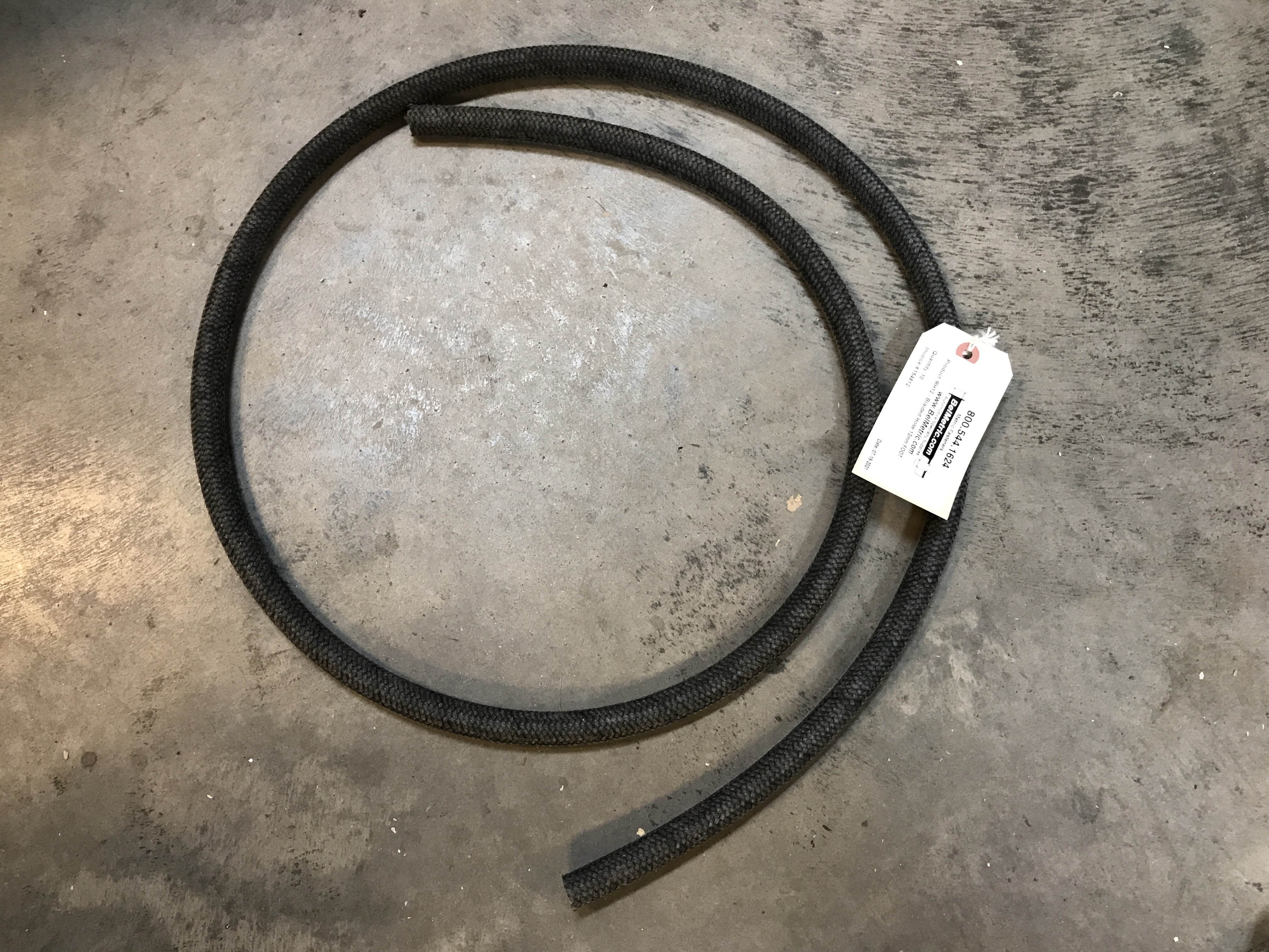

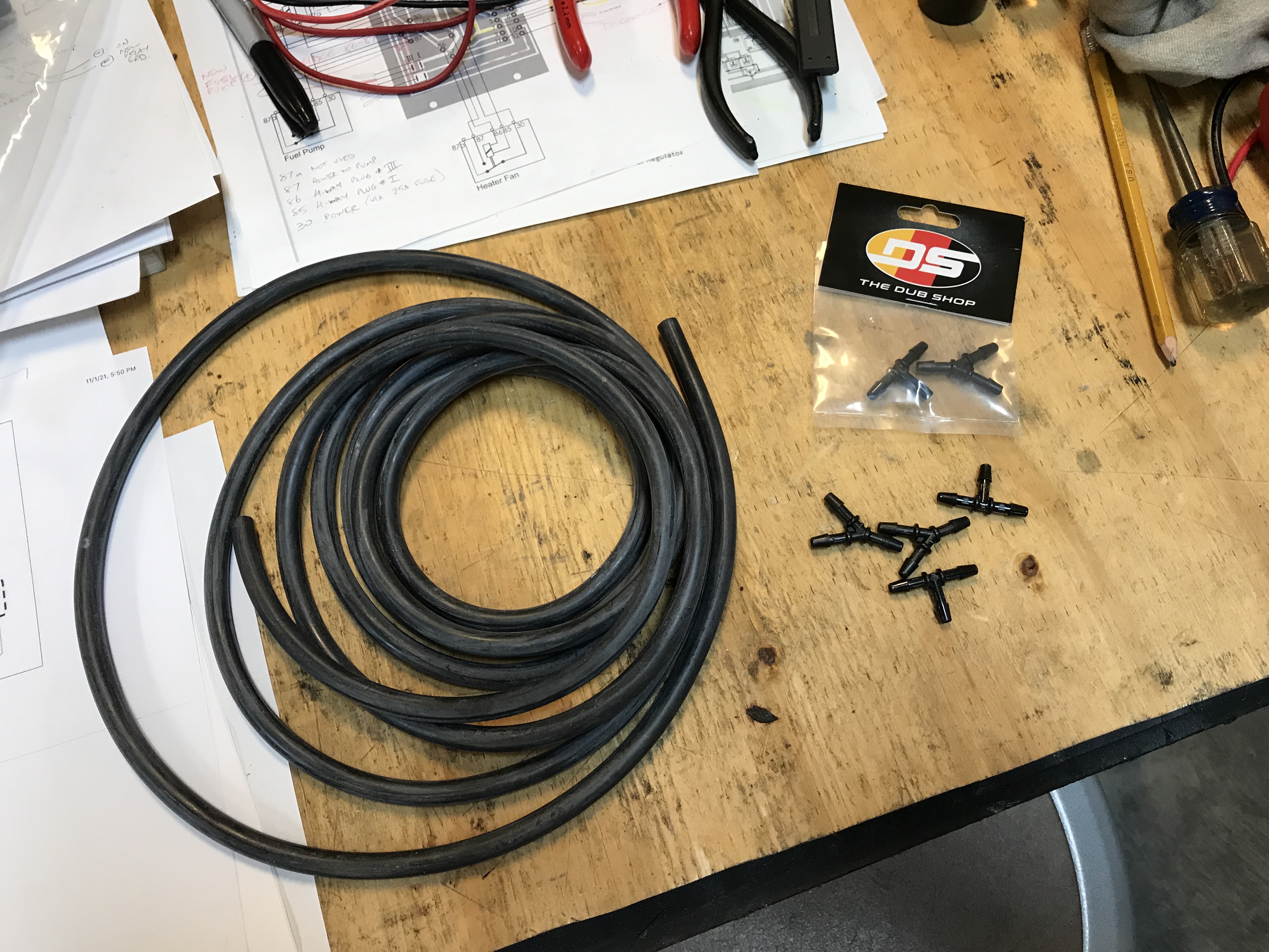

Some stock-type 12mm vacuum hose, from Belmetric.
post Dec 10 2021, 08:39 PM
Post #4270
Posts: 8,530
Left cylinder head to valve.
Post #4271
Posts: 8,530
Right cylinder head to valve.

Now for the small vacuum line, to connect the throttle bodies to the EFI control box and the fuel pressure regulator.

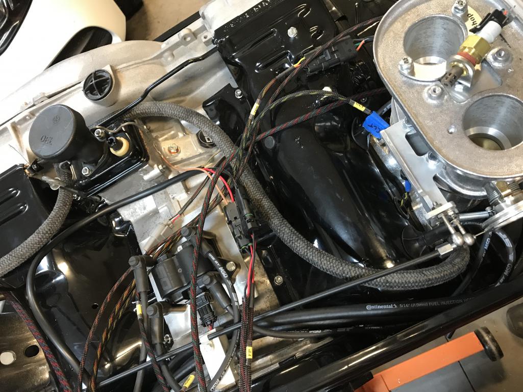

I bolted one spark plug wire holder to each side of the rear sheet metal panel.
post Dec 10 2021, 08:44 PM
Post #4274
Posts: 8,530

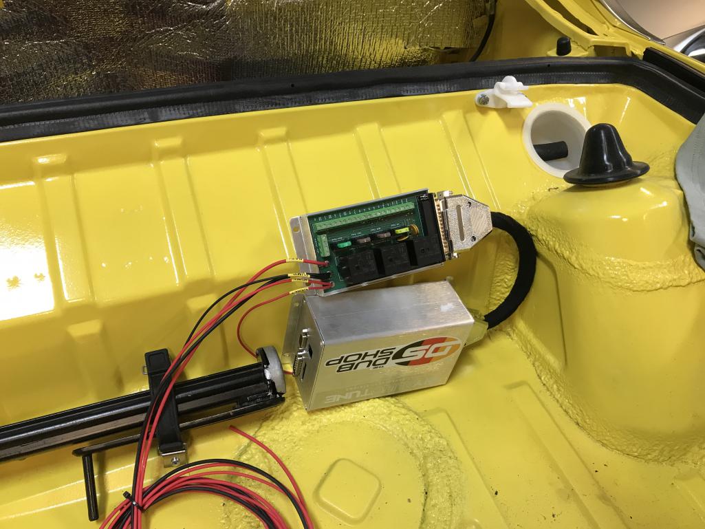

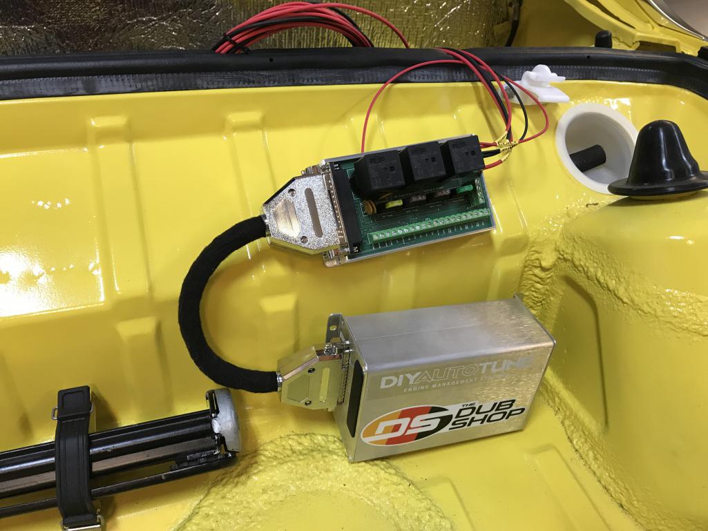

Now starting to think about where to put the control box and the relay box. The trunk is the obvious place, away from wet conditions.
Post #4275
Posts: 8,530
Or maybe like this? Suggestions welcome!

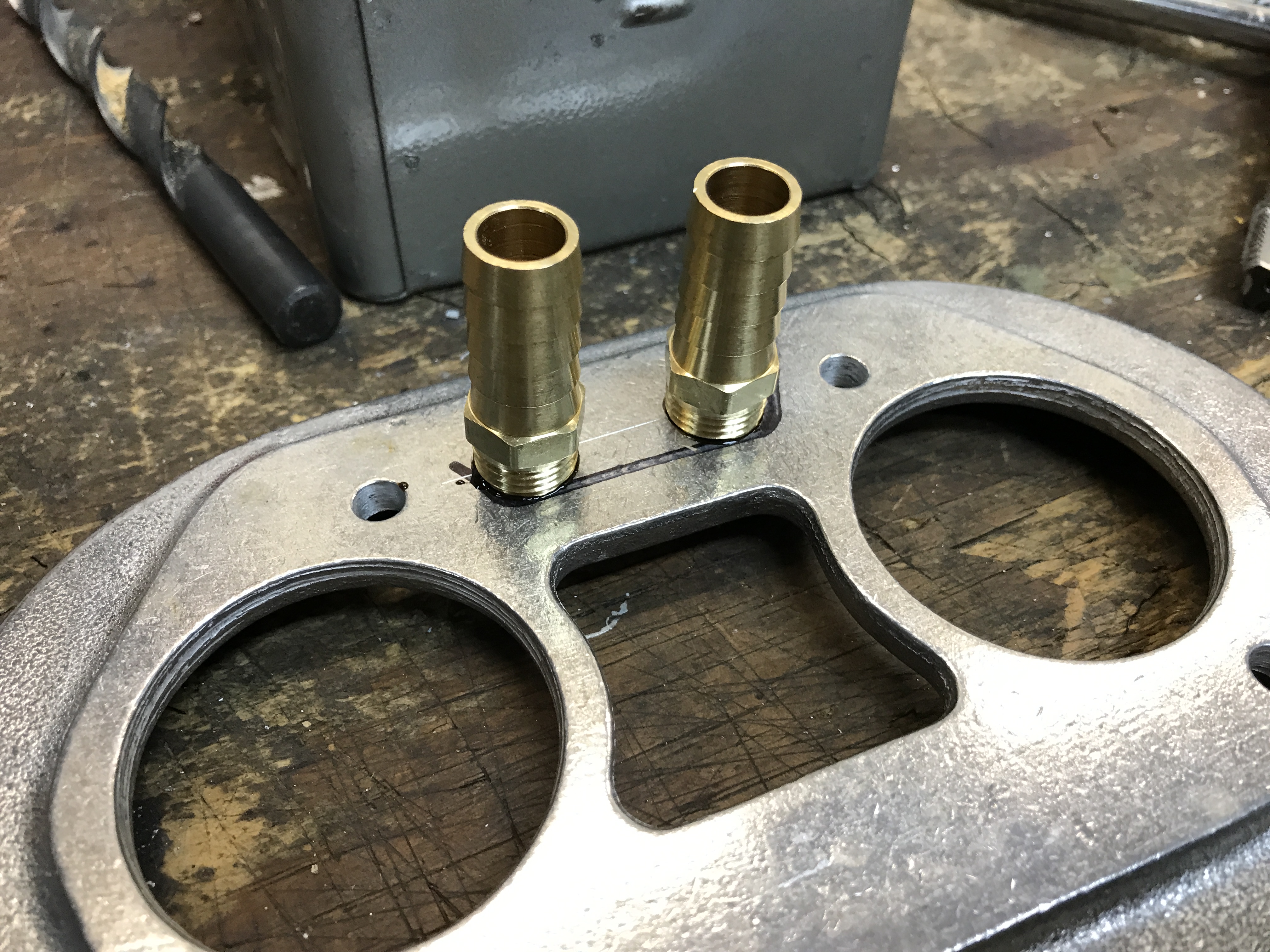

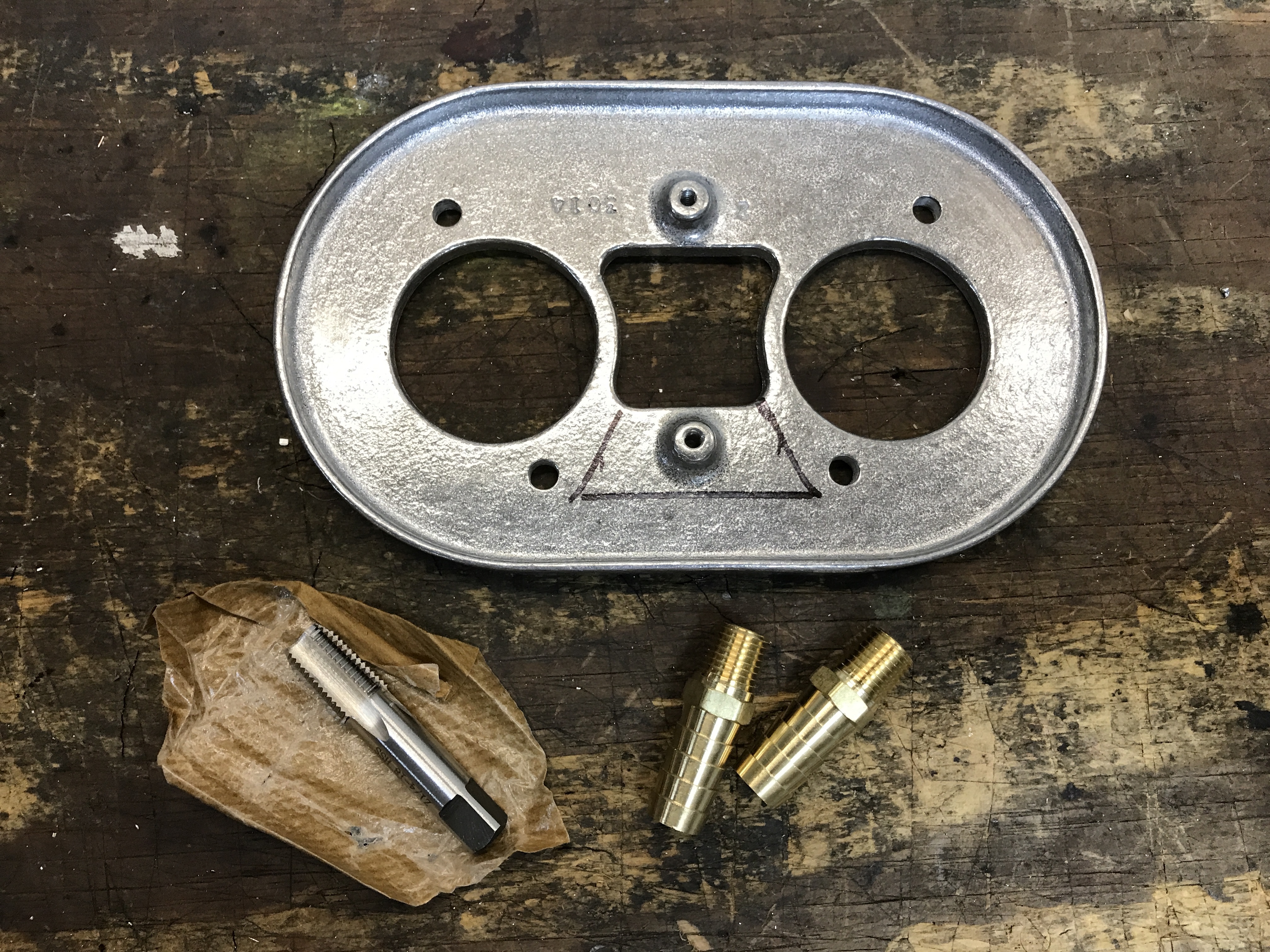

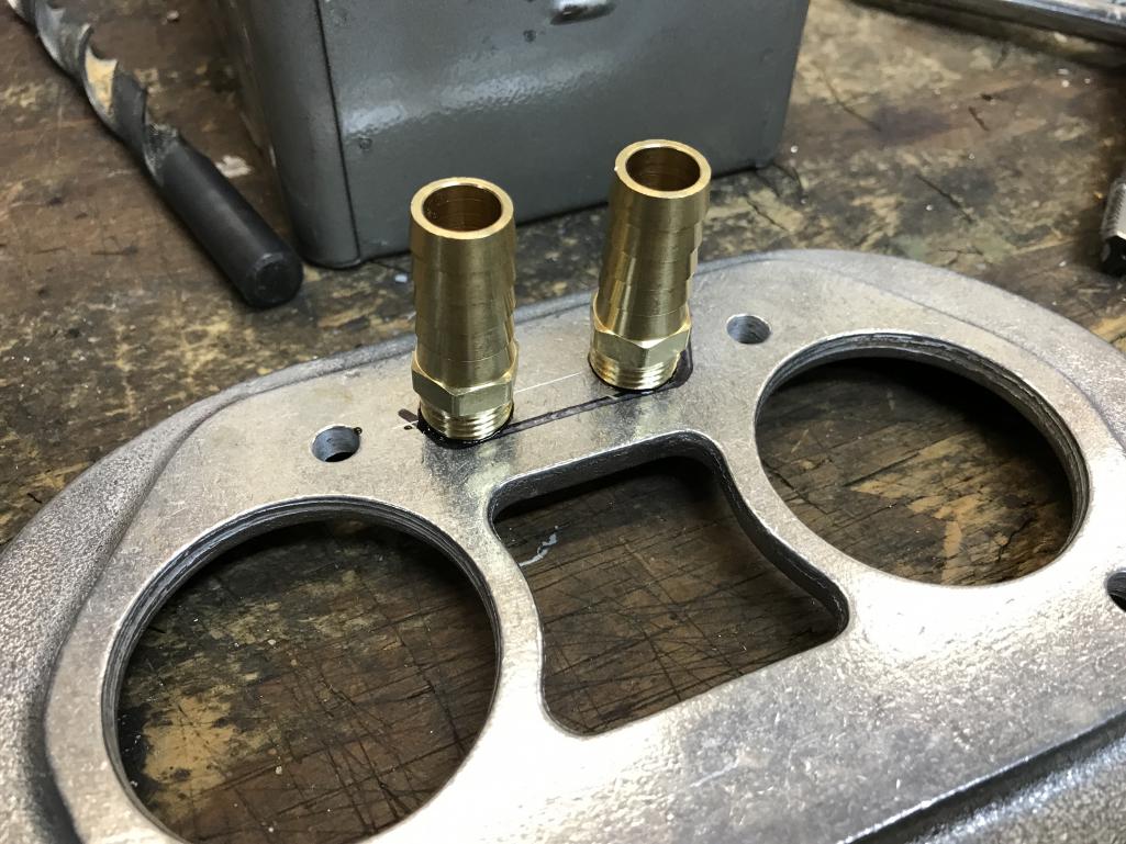

More details on the engine while it is still on the stand.
I need vent lines attached to the air filter housing, and got a pair of brass fittings, with 1/2 inch NPT threads. I also got a set of NPT taps. (Always buy more tools!)

Posts: 8,530

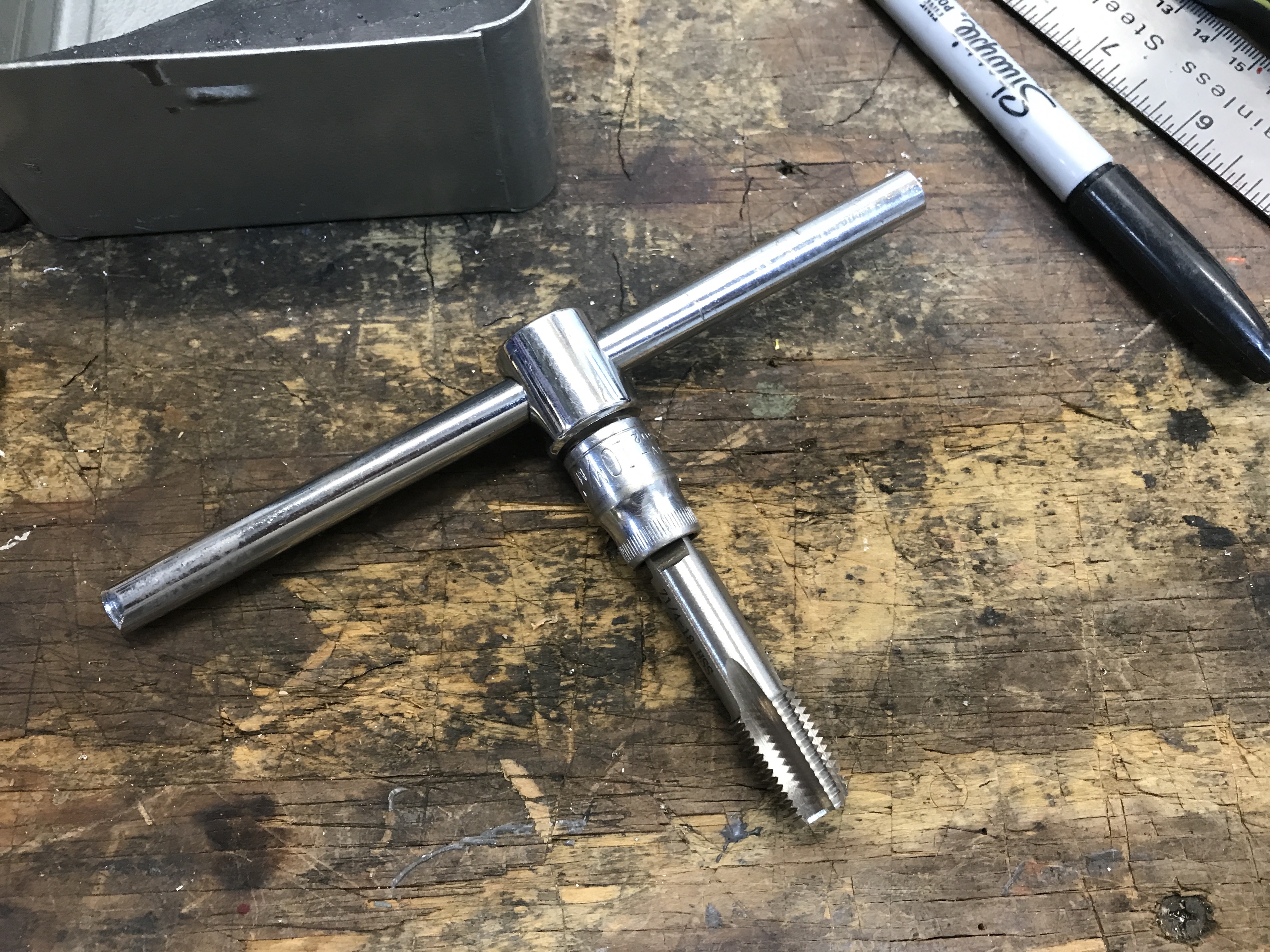

Speaking of tools, in the back of my ratchet-socket drawer, I found this cross-bar socket driver, that filled in for a large diameter tap handle.
post Dec 11 2021, 09:12 PM
Post #4278
Posts: 8,530
Holes drilled and tapped.
post Dec 11 2021, 09:13 PM
Post #4279
Posts: 8,530
Fittings installed with sealant.
post Dec 11 2021, 09:14 PM
Post #4280
Posts: 8,530
No interference with the filter element.
