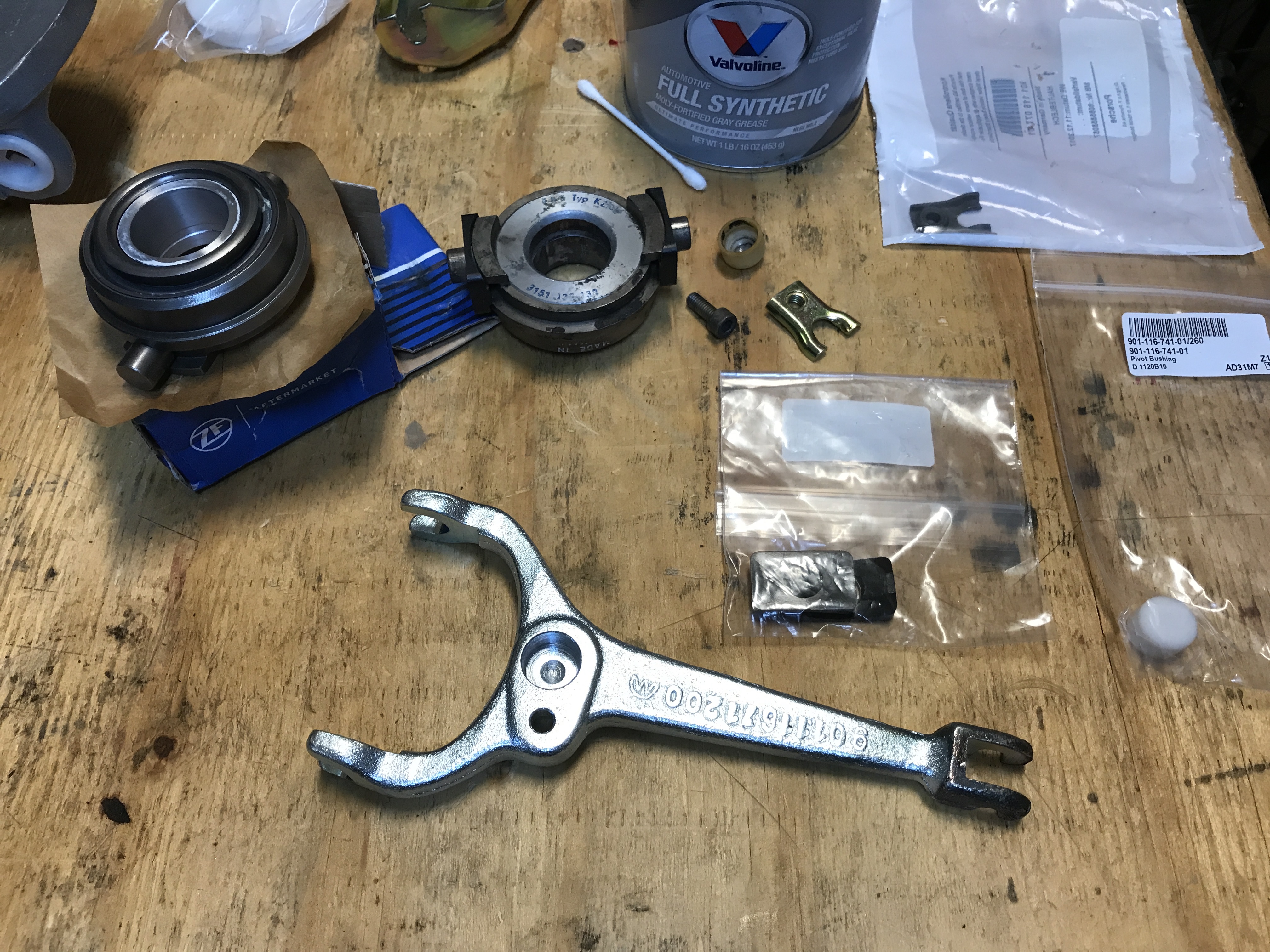

Member No.: 23,343

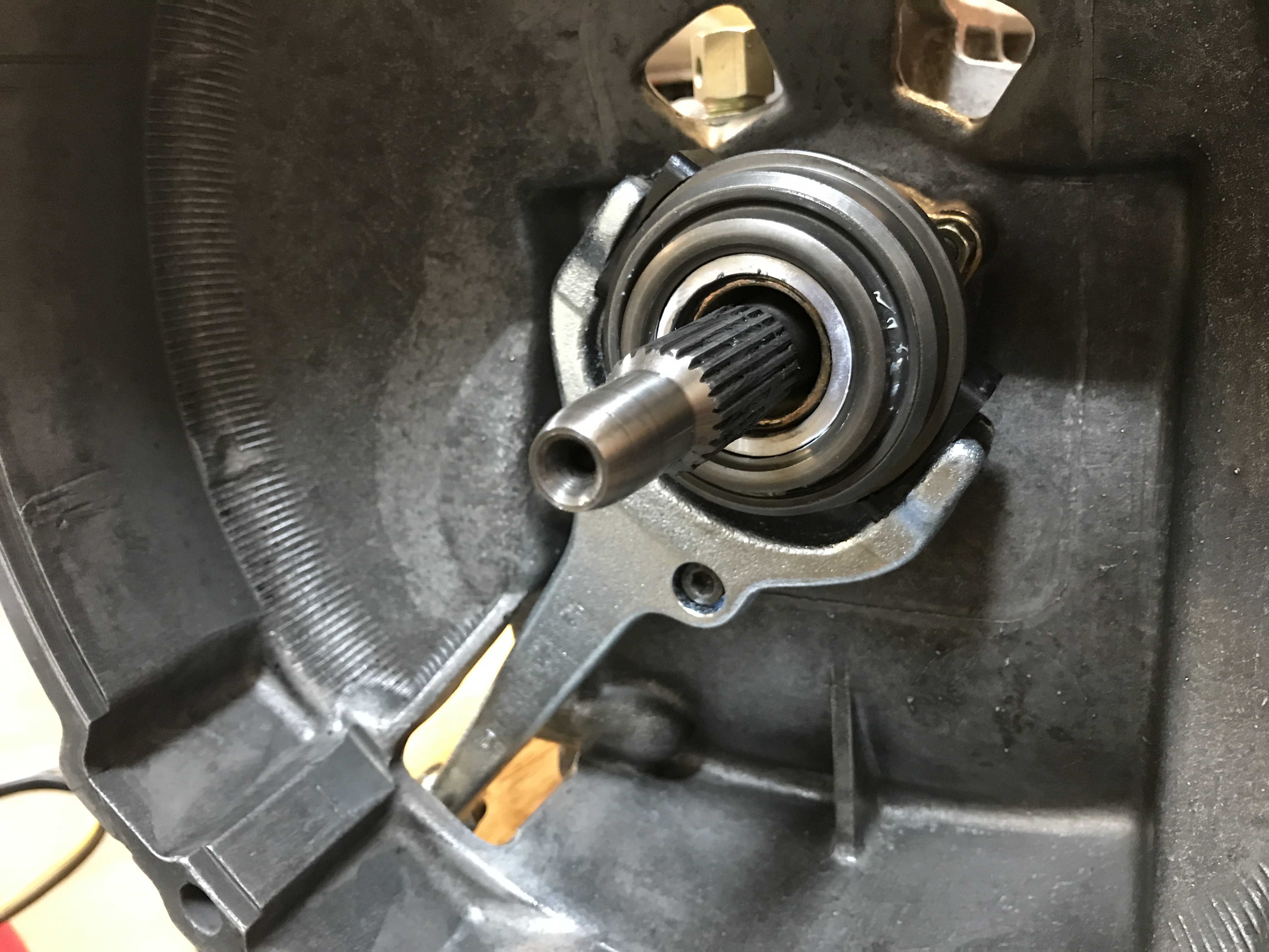

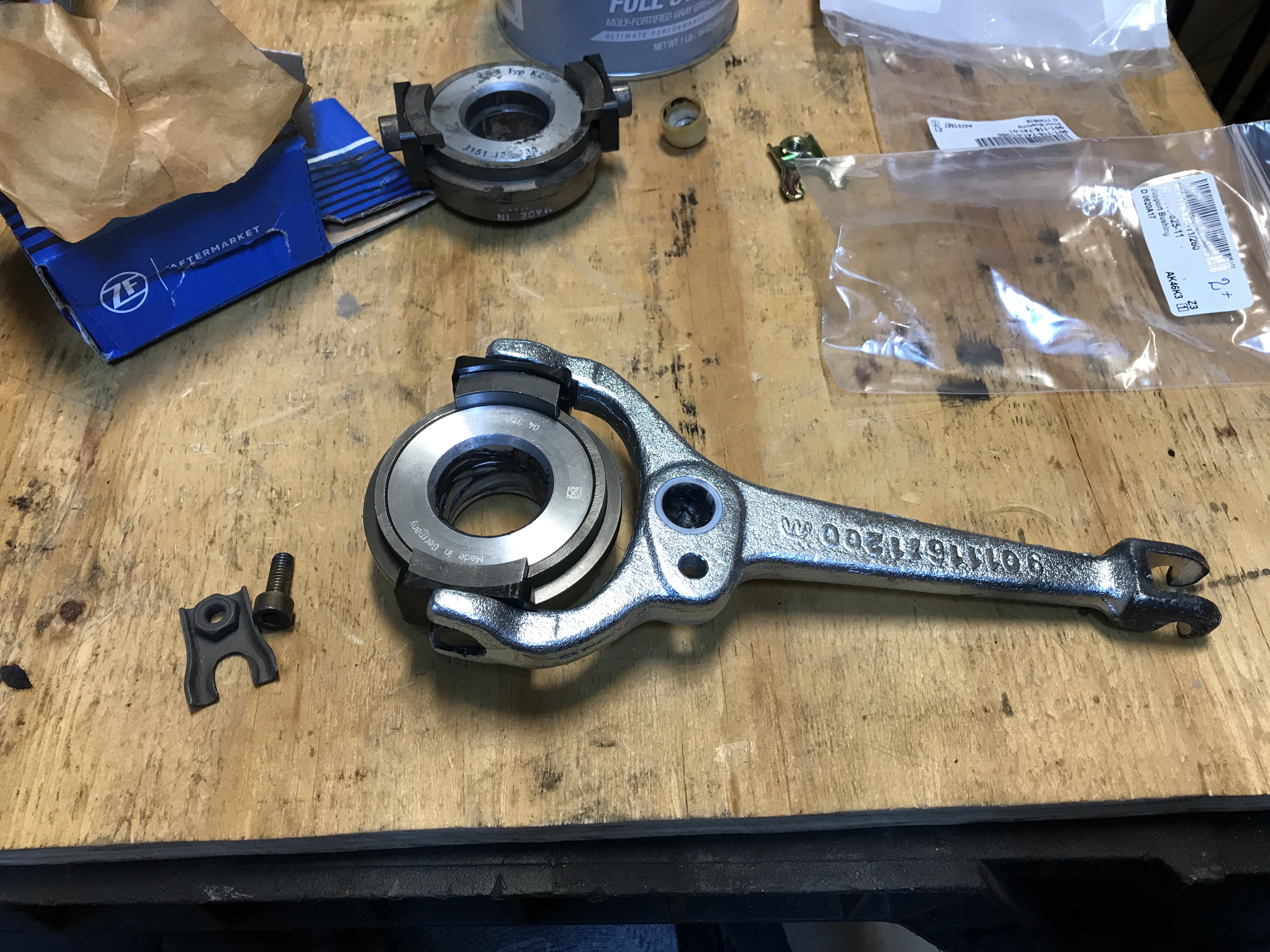

Clutch fork (yes, glamorous plating that nobody will see), throw-out bearing, and new bushings.
bkrantz
post Dec 13 2021, 08:29 PM
Post #4302
Posts: 8,530
Joined: 3-August 19
From: SW Colorado
Member No.: 23,343
A light smear of grease on the guide tube, fork pivot, and splines.
bkrantz
post Dec 13 2021, 08:30 PM
Post #4303
Posts: 8,530
Joined: 3-August 19
From: SW Colorado
Member No.: 23,343
Fork and bearings with new bushings, and a bit more grease.
bkrantz
post Dec 13 2021, 08:31 PM
Post #4304
Posts: 8,530
Joined: 3-August 19
From: SW Colorado
Member No.: 23,343

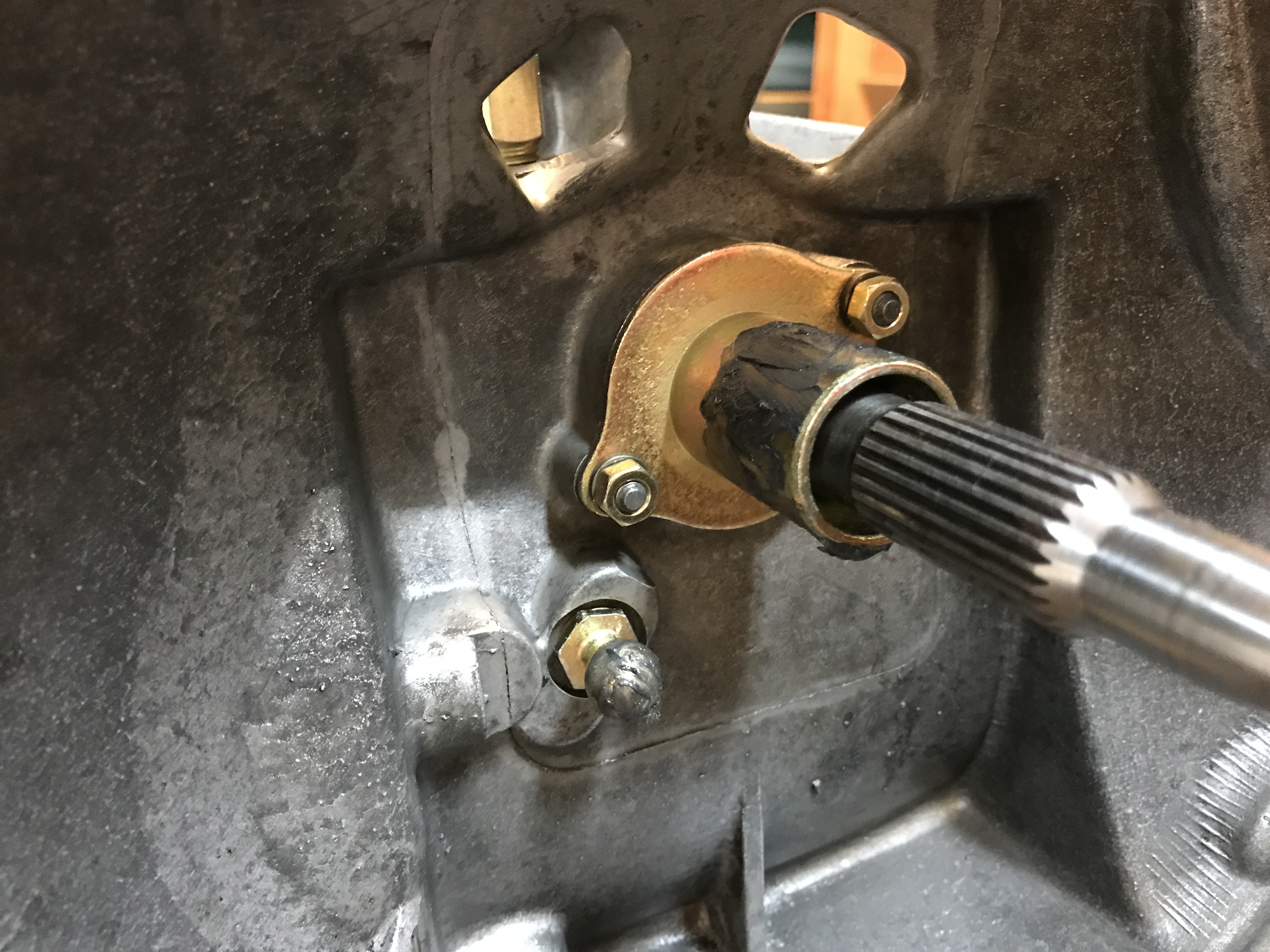

Installed, with a new pivot retainer.

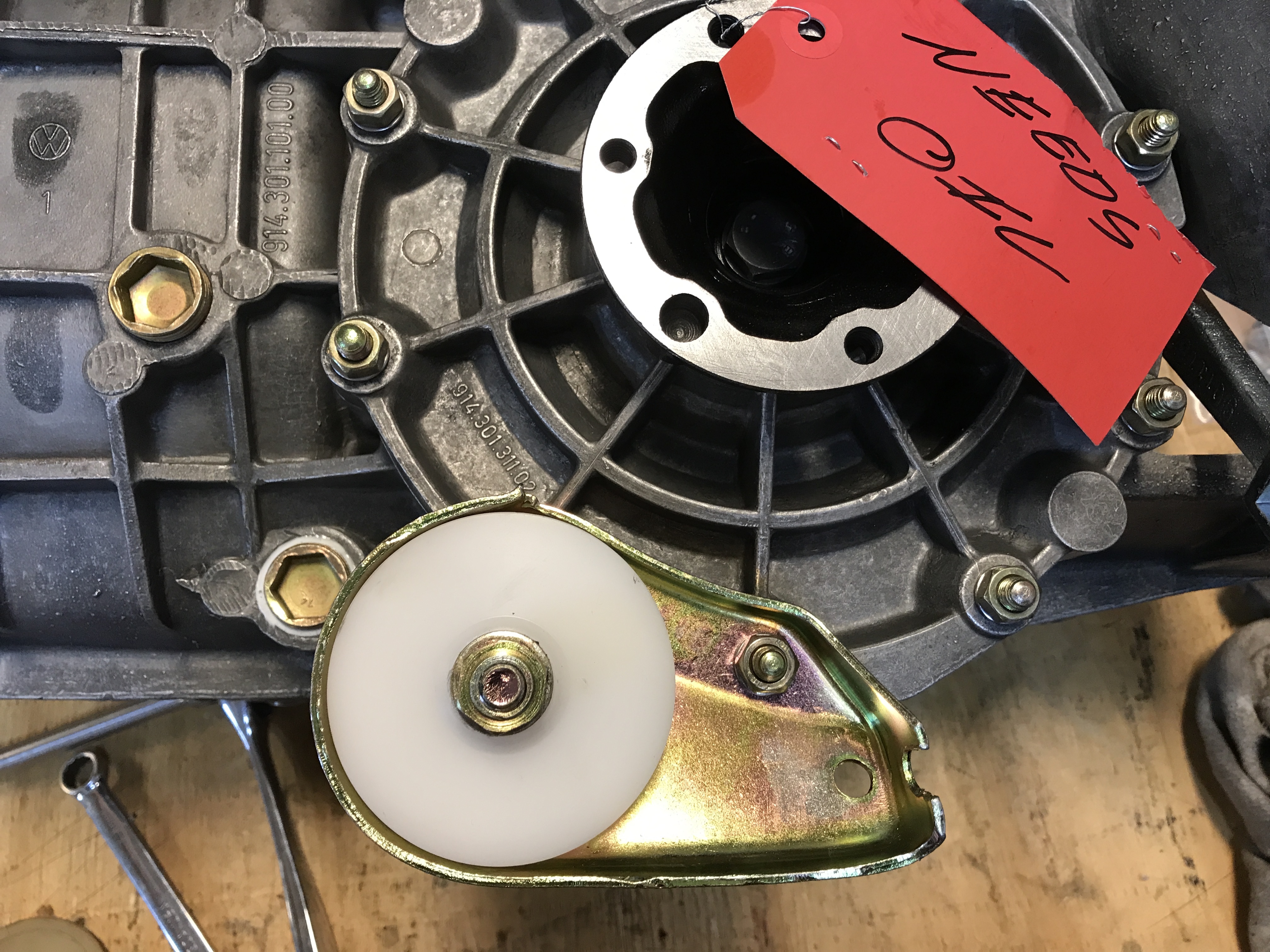

Member No.: 23,343

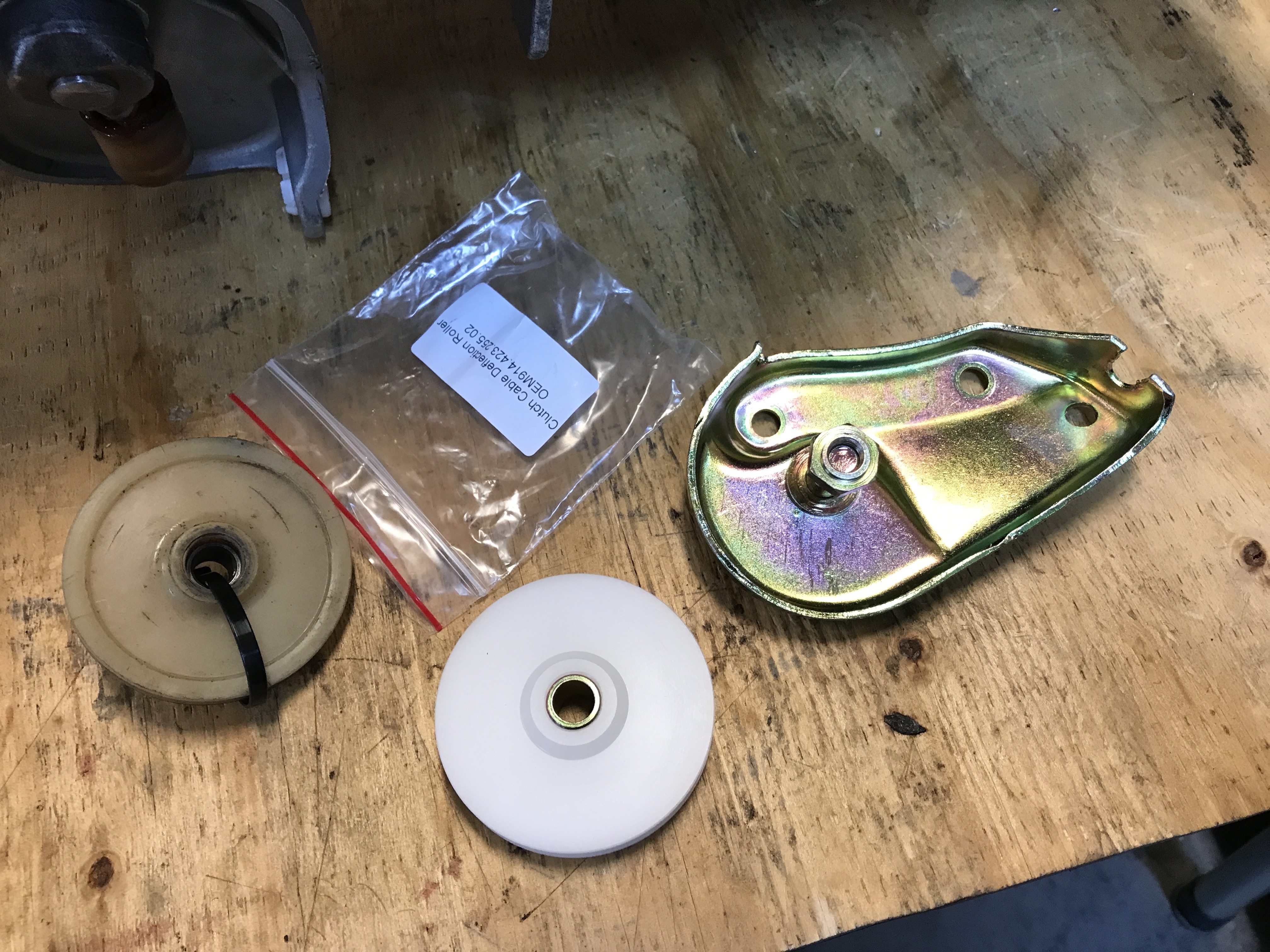

Clutch cable pulley and housing.
bkrantz
post Dec 13 2021, 08:36 PM
Post #4306
Posts: 8,530
Joined: 3-August 19
From: SW Colorado
Member No.: 23,343
Installed (and yes, needs a lube fill, since CMS emptied the initial fill after they ran the rebuilt trans on the bench).

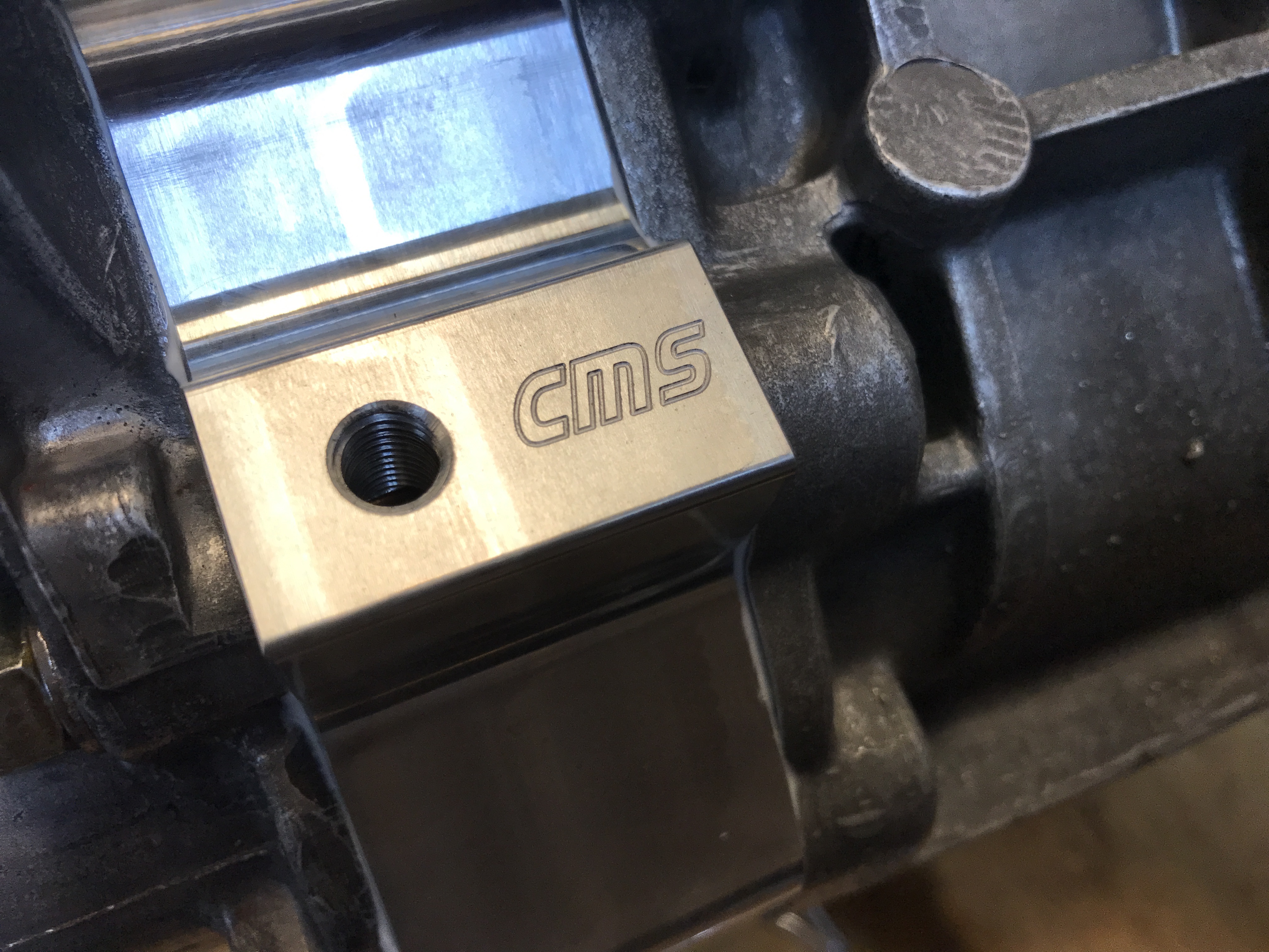

Member No.: 23,343

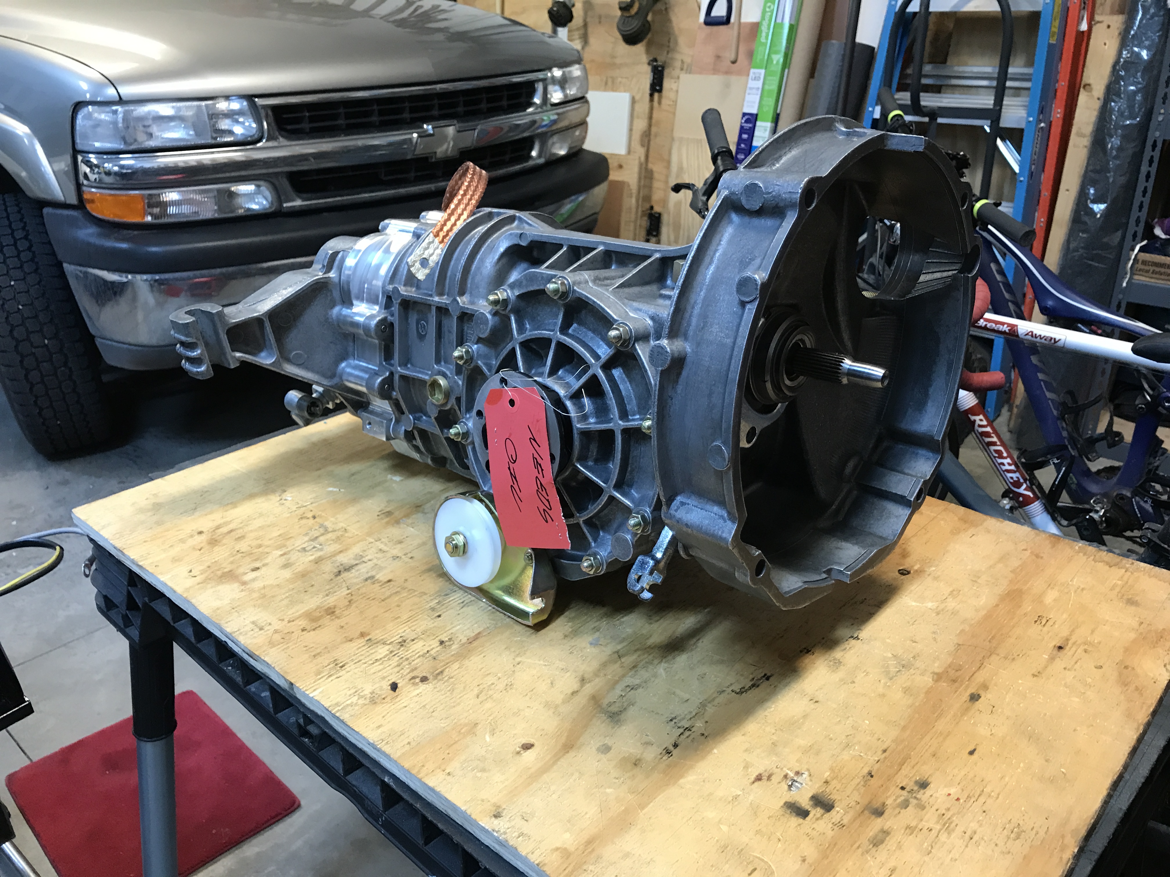

Speaking of CMS, I just noticed their logo on their custom-machined intermediate plate.
bkrantz
post Dec 13 2021, 08:39 PM
Post #4308
Posts: 8,530
Joined: 3-August 19
From: SW Colorado
Member No.: 23,343
Ready to install.

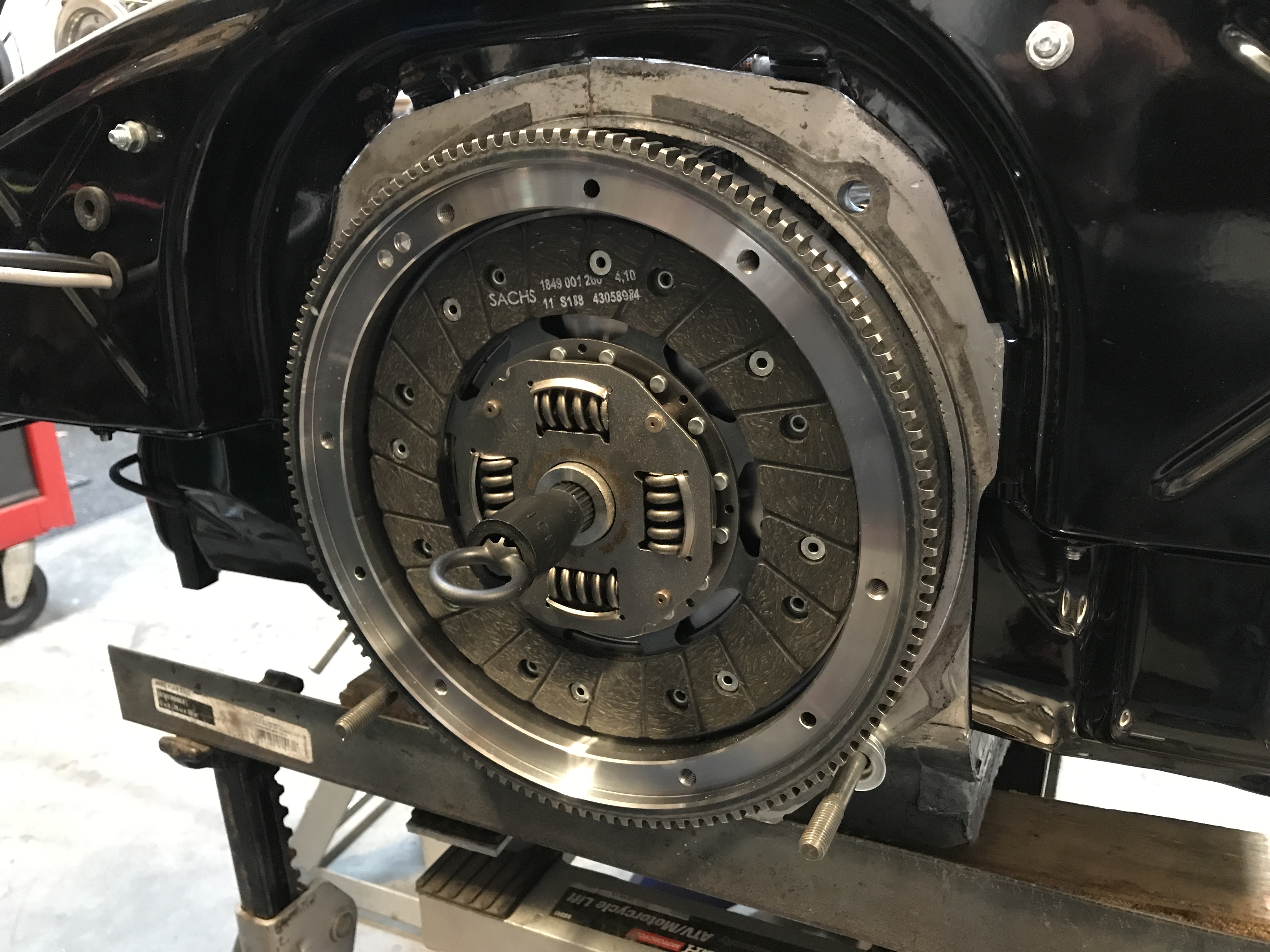

Member No.: 23,343

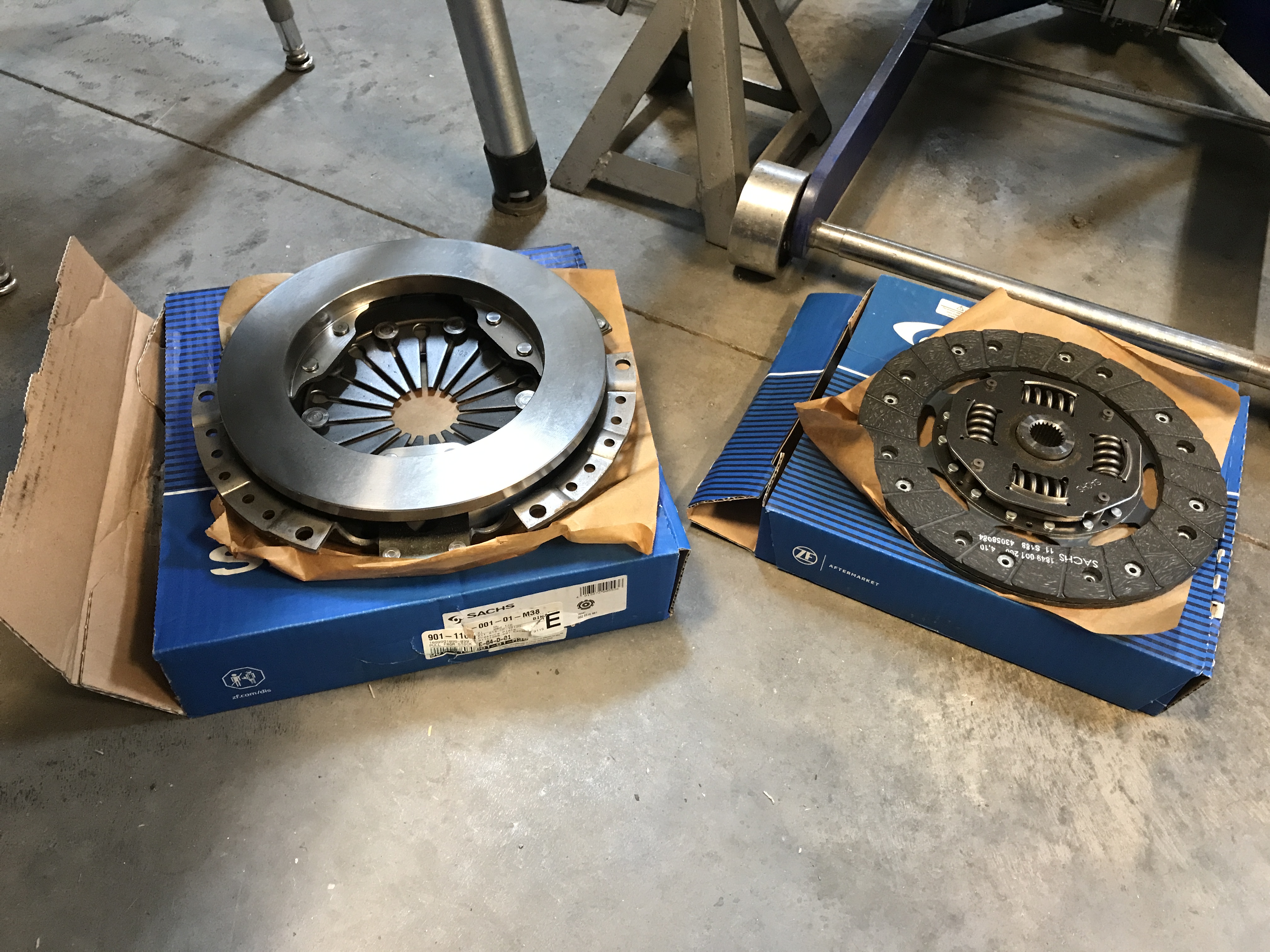

New clutch disk and cover.
bkrantz
post Dec 13 2021, 08:44 PM
Post #4310
Posts: 8,530
Joined: 3-August 19
From: SW Colorado
Member No.: 23,343

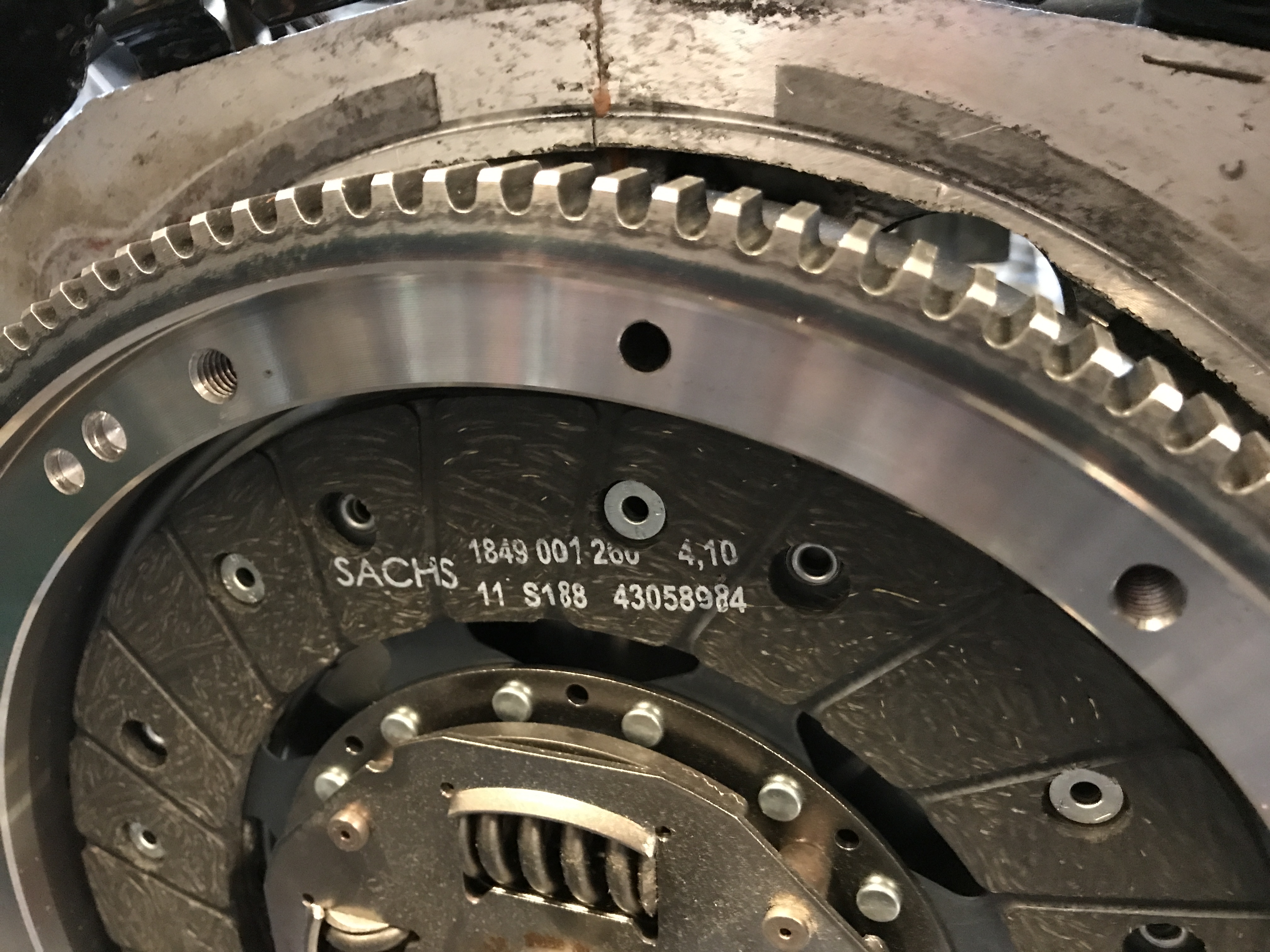

Disk in place, with the alignment too (dummy shaft). Ready to install the cover, right? But something is missing--can you guess?
bkrantz
post Dec 13 2021, 08:46 PM
Post #4311
Posts: 8,530
Joined: 3-August 19
From: SW Colorado
Member No.: 23,343
My new flywheel has no locating pins for the clutch cover. No problem, I will get the pins from the old flywheel. But that one also has no pins. Time to make another rush order.

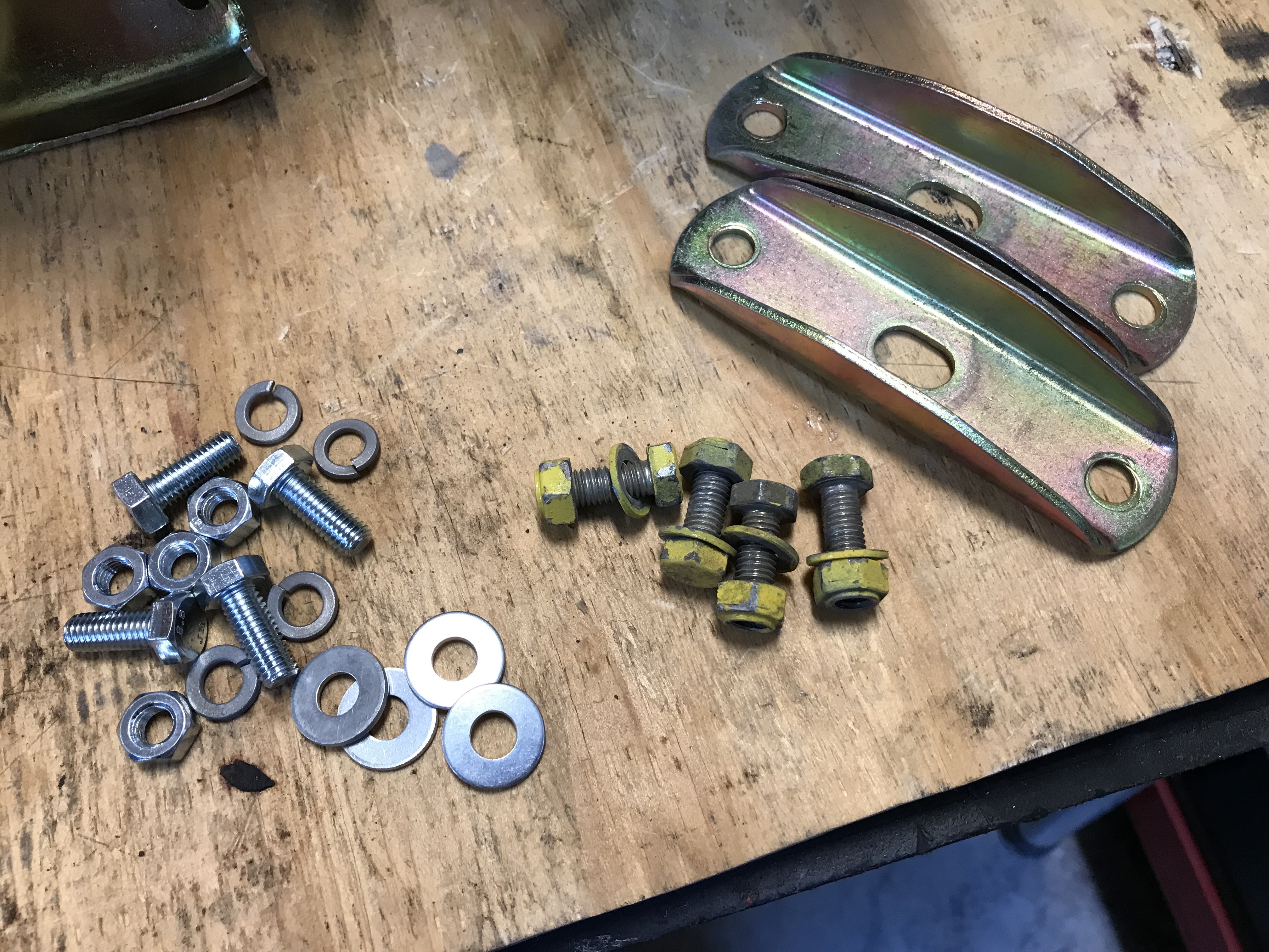

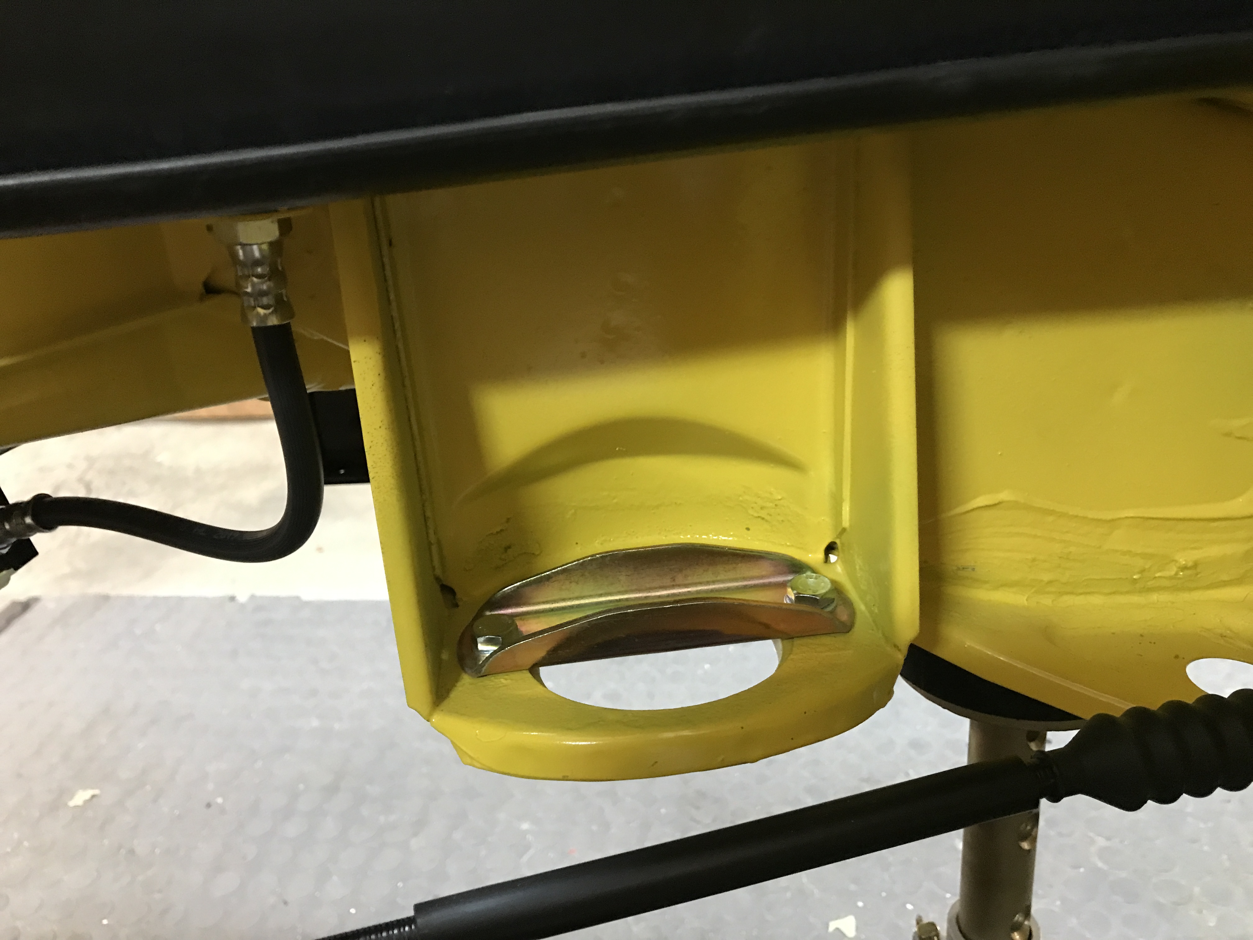

So, in the time remaining, I got out the brackets for the engine support bar.
bkrantz
post Dec 13 2021, 08:50 PM
Post #4313
Posts: 8,530
Joined: 3-August 19
From: SW Colorado
Member No.: 23,343
Pretty quick to get those installed. Snug for now, and will adjust and tighten after the engine is in place.

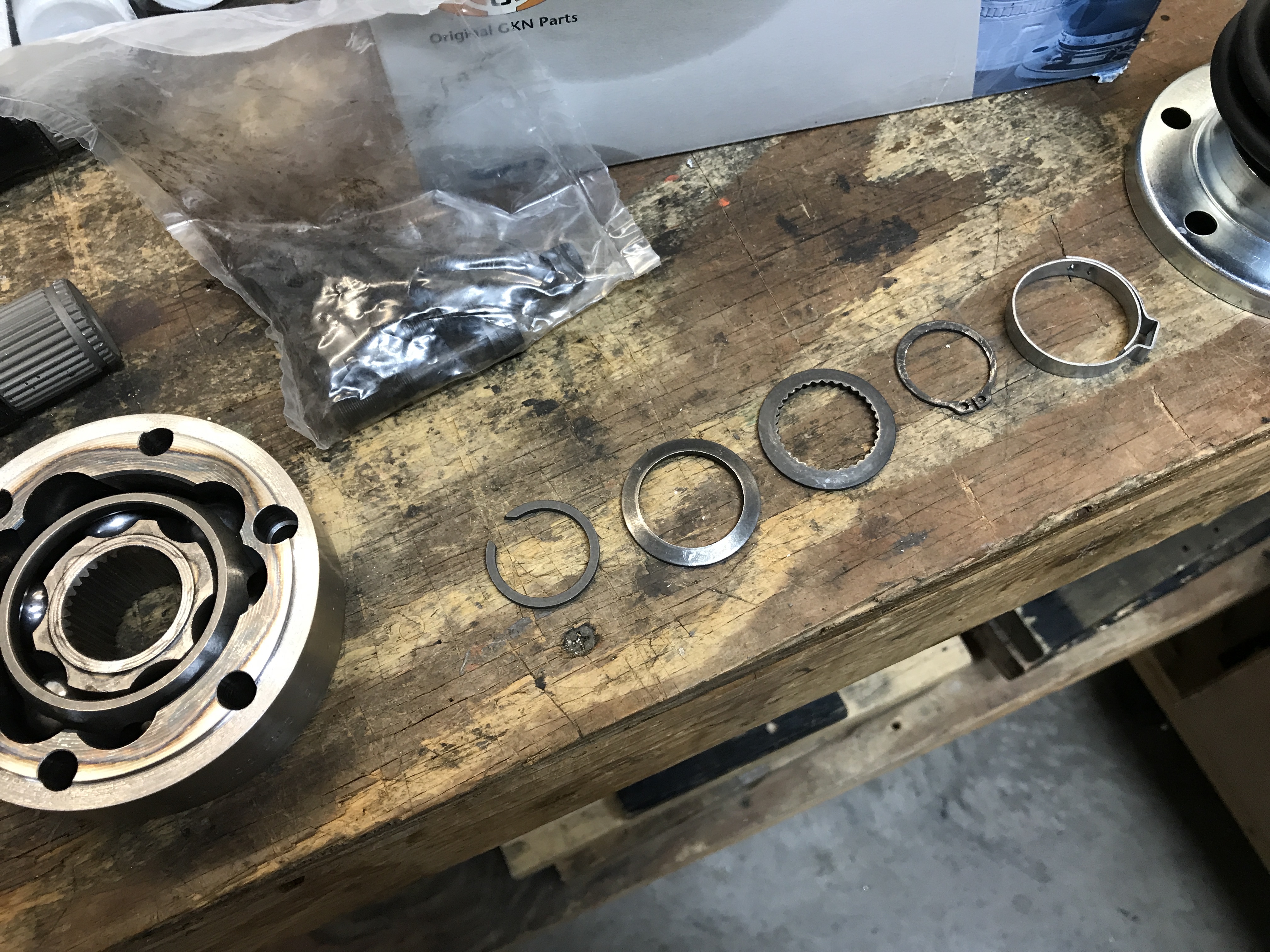

Member No.: 23,343

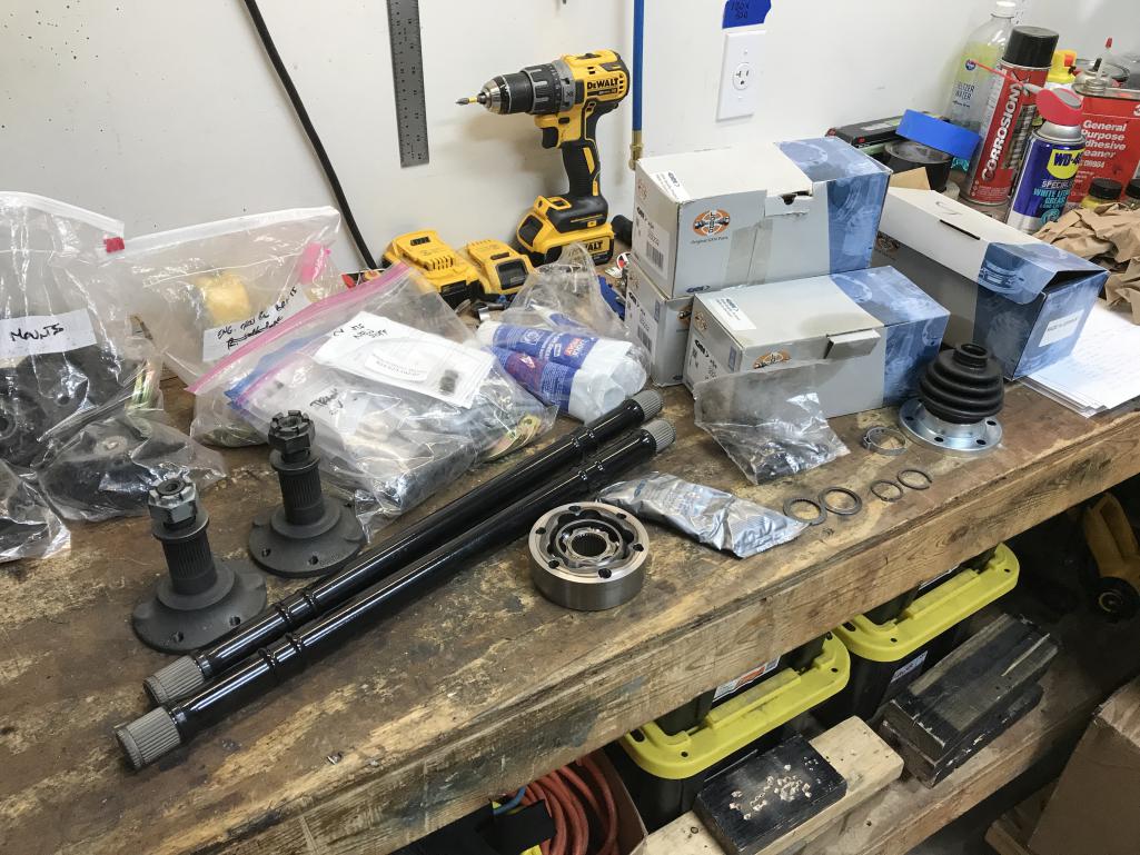

So, with more time I got out all the half-shaft parts, including new CVs from PMB. I got the version machined for the original fiber gasket. BTW, PMB was the only source I could find for new CVs with the proper 914-4 half-shaft splines.
bkrantz
post Dec 13 2021, 08:54 PM
Post #4315
Posts: 8,530
Joined: 3-August 19
From: SW Colorado
Member No.: 23,343
Now I need to sort out the arrangement of circlips, washers, and spacers.

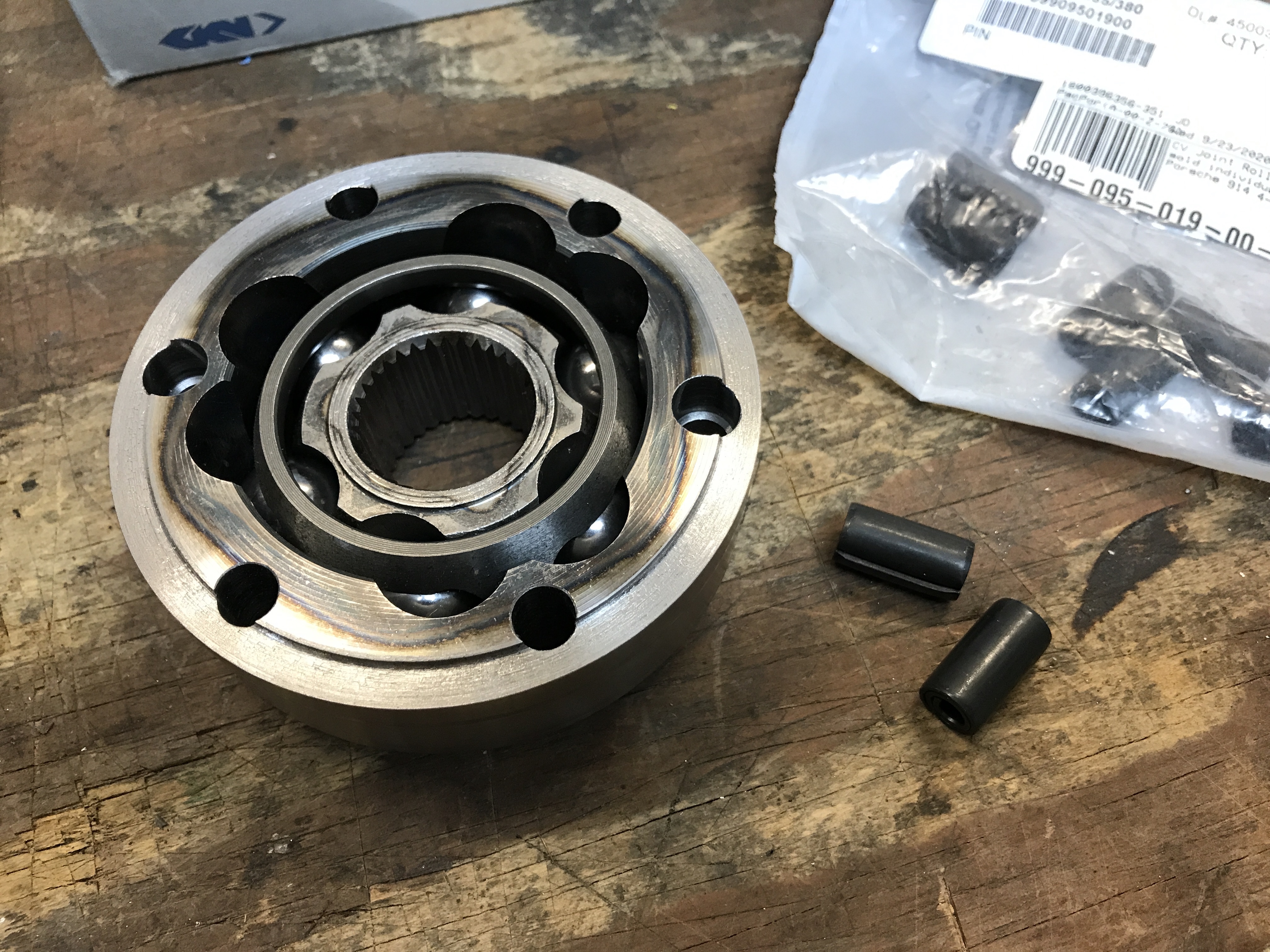

Member No.: 23,343

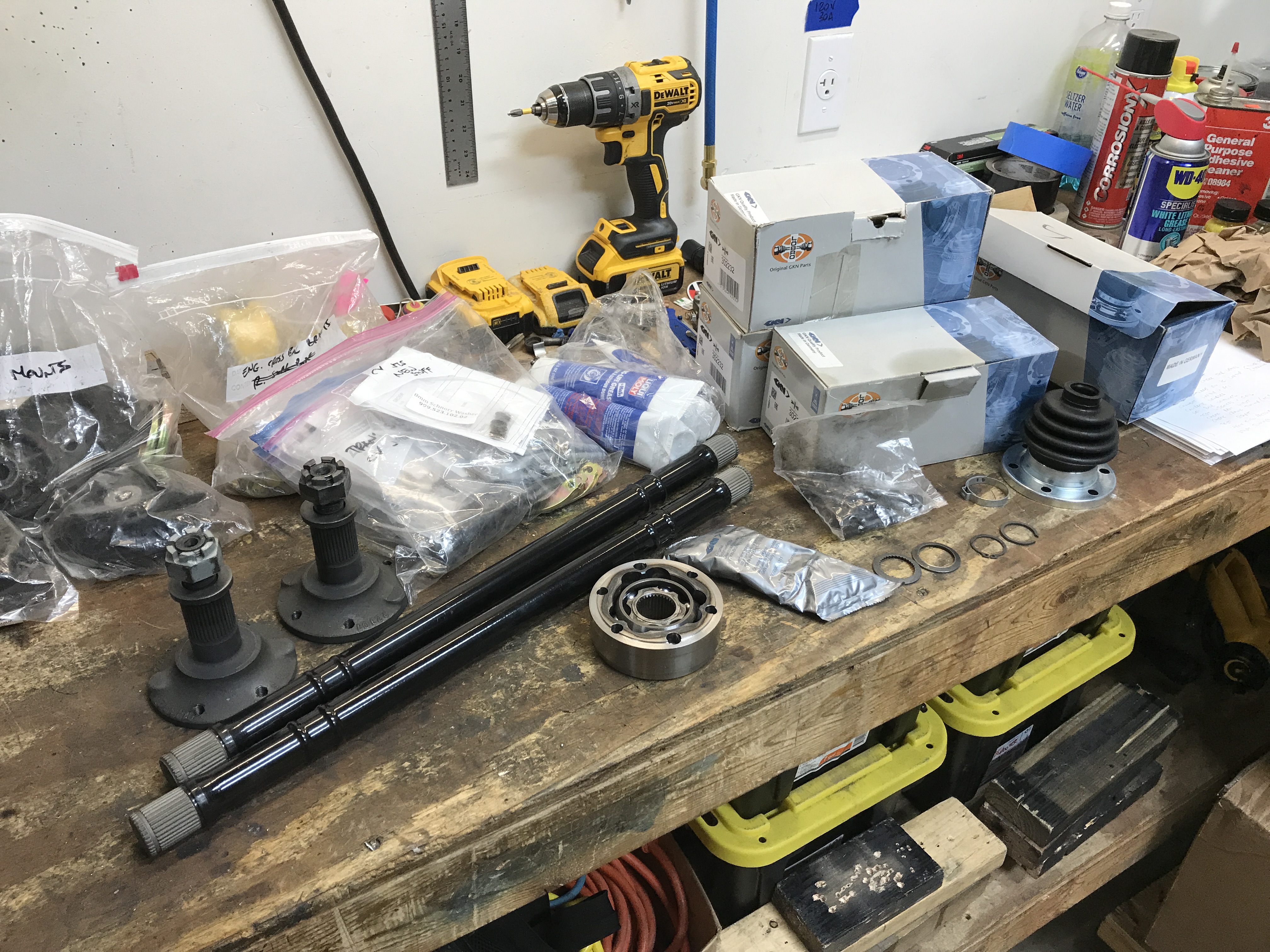

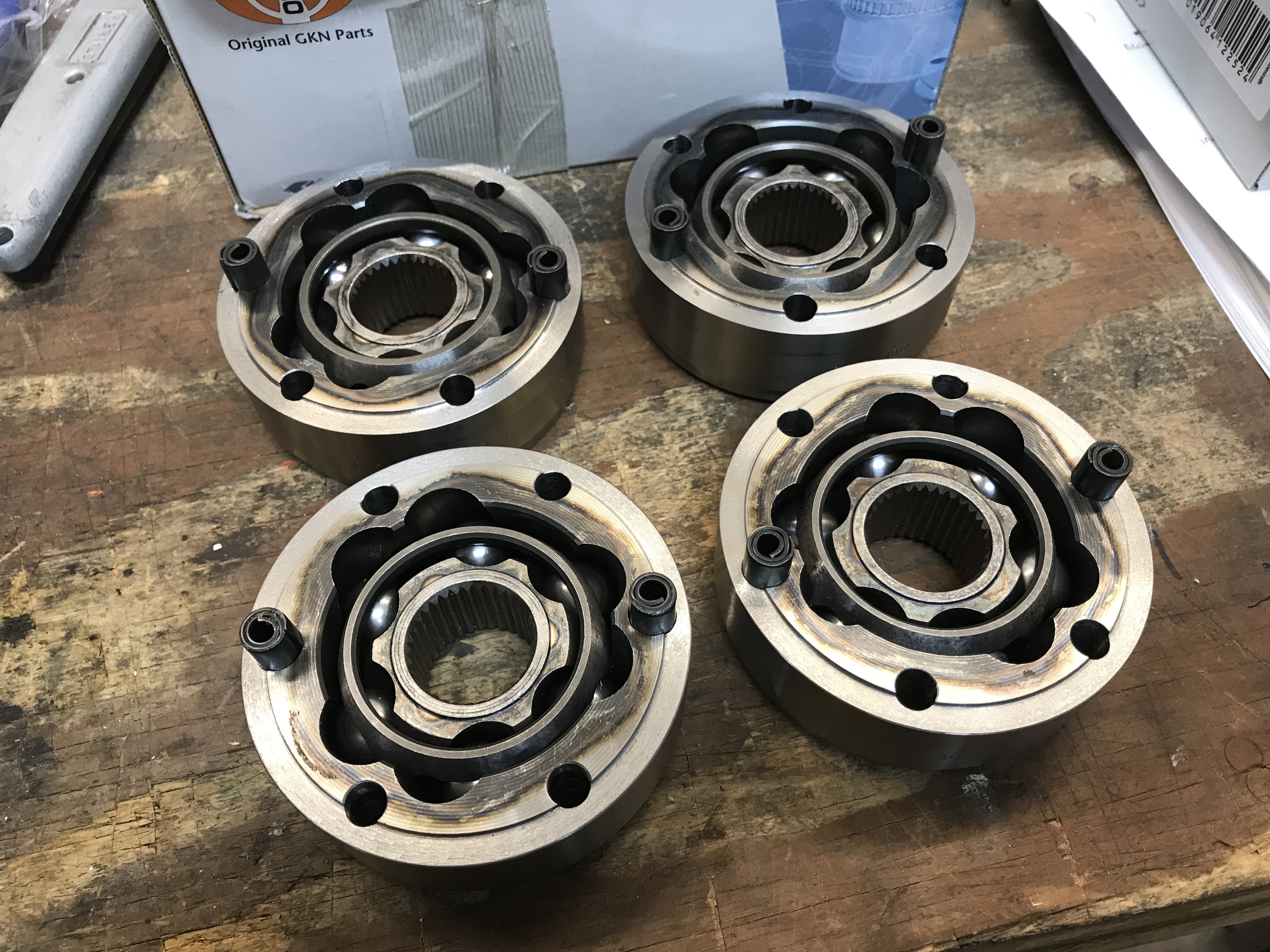

More partial tasks today, starting with CV joints and half-shafts.
Step 1 joins the new locating pins in the new type 1 CVs from PMB, modified for the pins and the paper gasket on the flange side..
bkrantz
post Dec 14 2021, 08:21 PM
Post #4319
Posts: 8,530
Joined: 3-August 19
From: SW Colorado

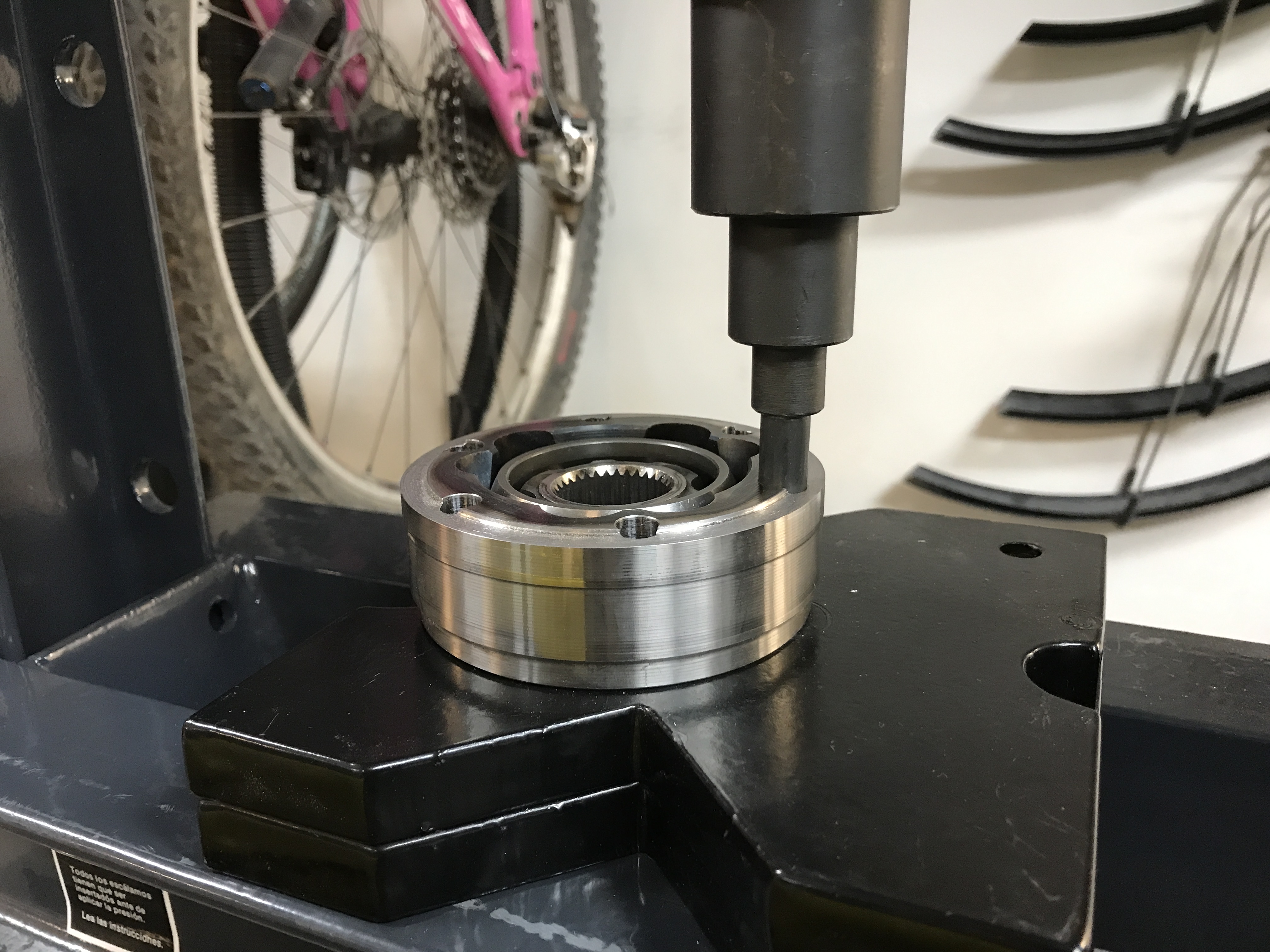

Member No.: 23,343
Easy job on the press.
bkrantz
Post #4320
Posts: 8,530
Joined: 3-August 19
From: SW Colorado
Member No.: 23,343
All four with new pins.
