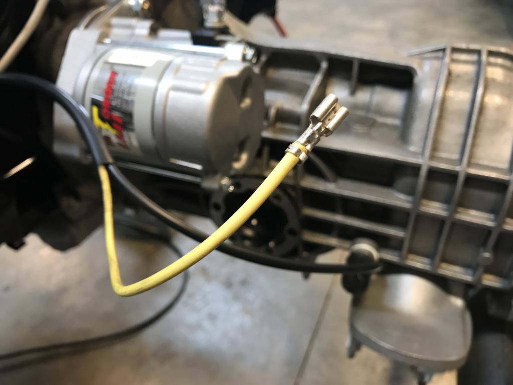

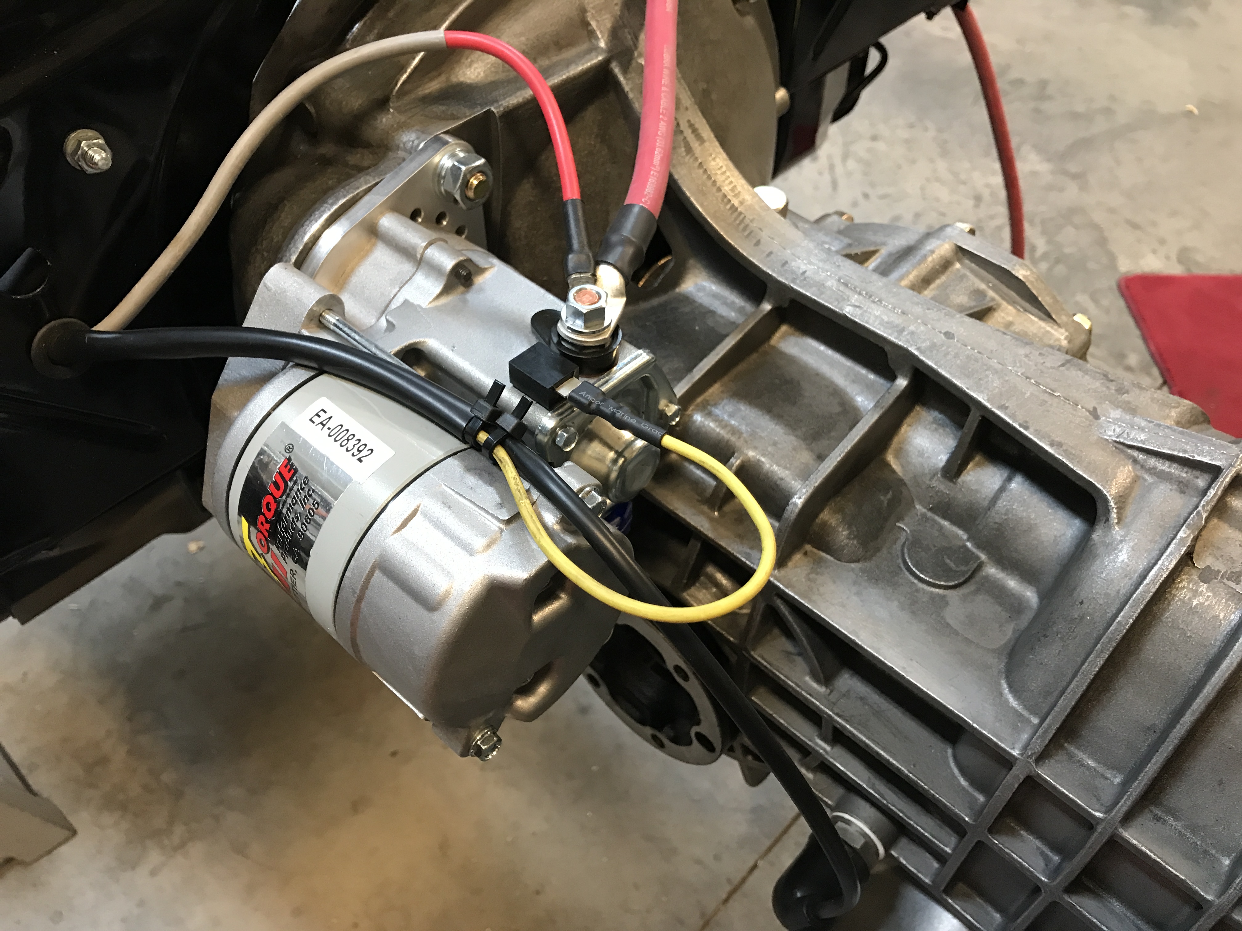

I shortened the lead I made for the solenoid. Another soldered terminal.

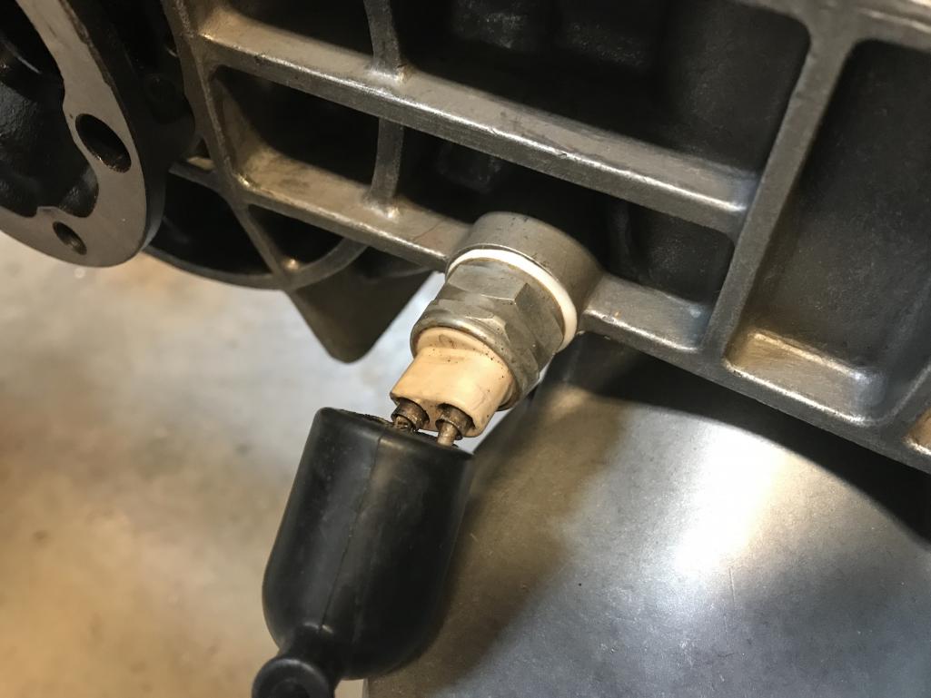

Then the connectors for the reverse light switch. These are not quite in all the way yet. Plus a new rubber boot.

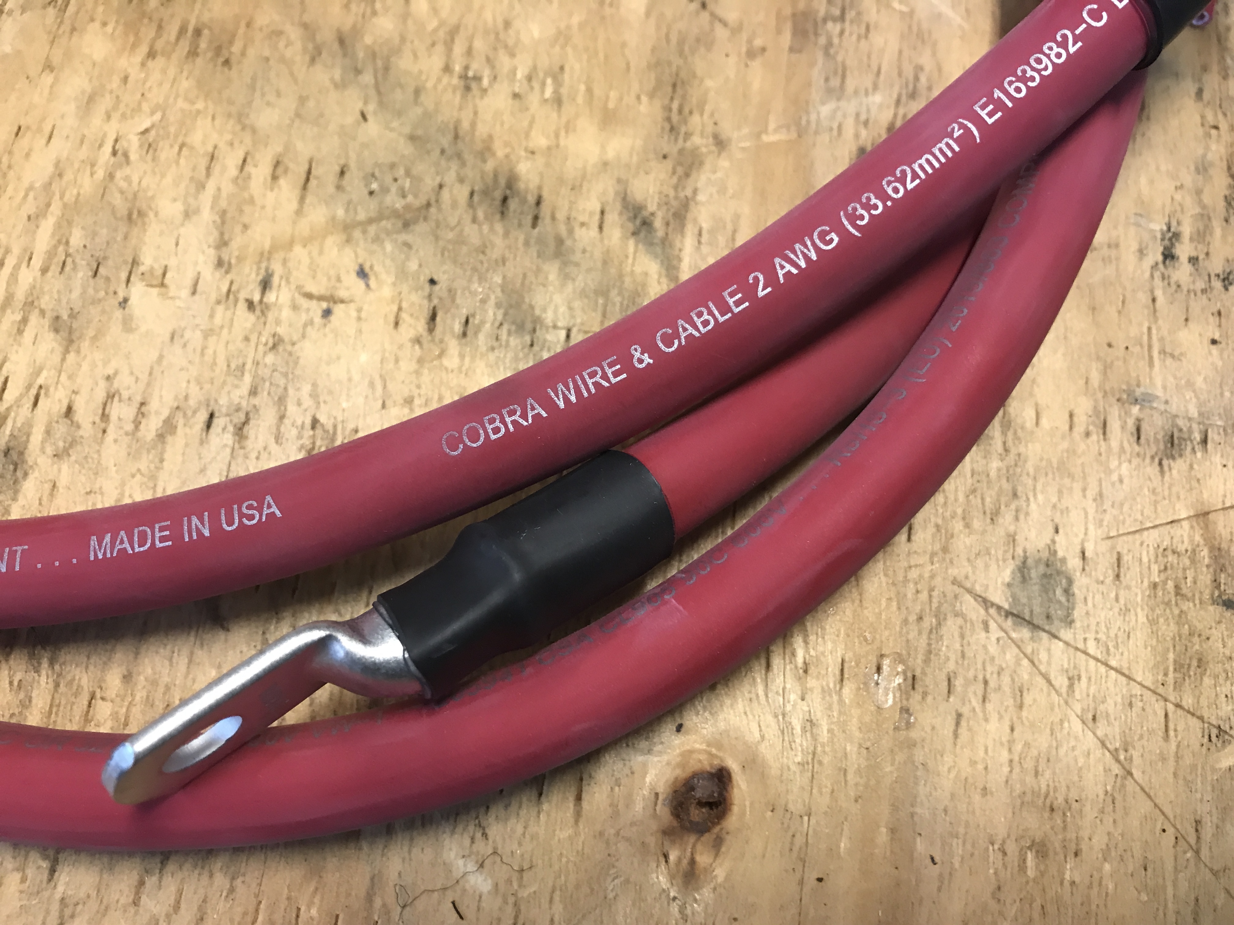

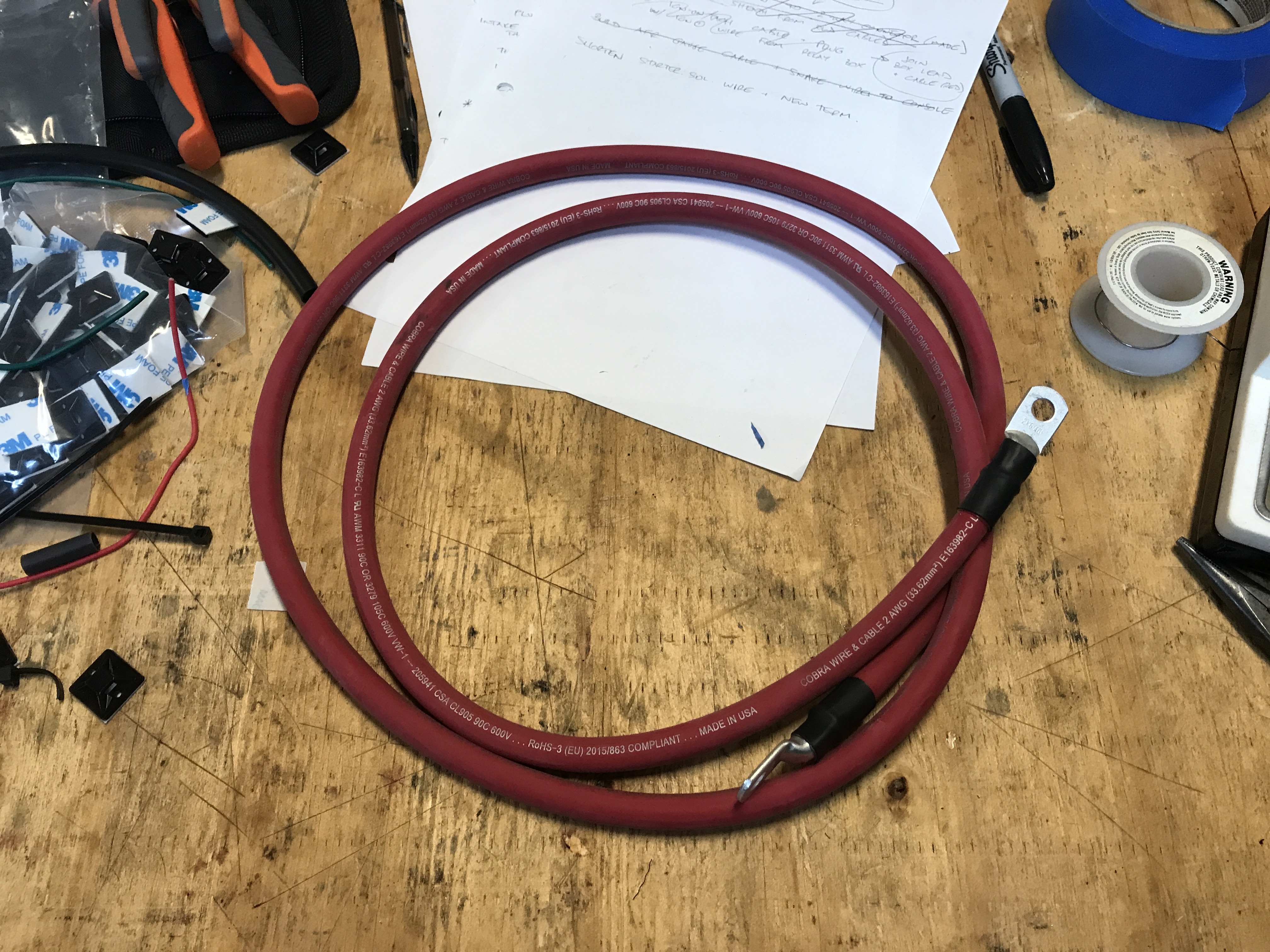

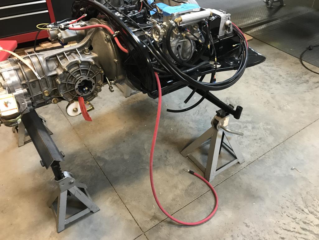

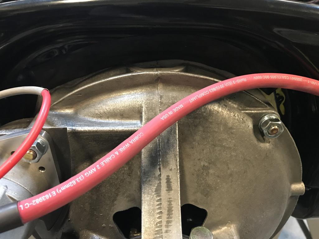

For the power lead to the starter, I got a massive pre-made cable.
bkrantz
post Dec 21 2021, 08:16 PM
Post #4424
Posts: 8,530
Joined: 3-August 19
From: SW Colorado
Member No.: 23,343
This should carry as many amps as needed.

Member No.: 23,343
Starter power lead, through the rear sheet metal.

Member No.: 23,343
Starter, all connections.

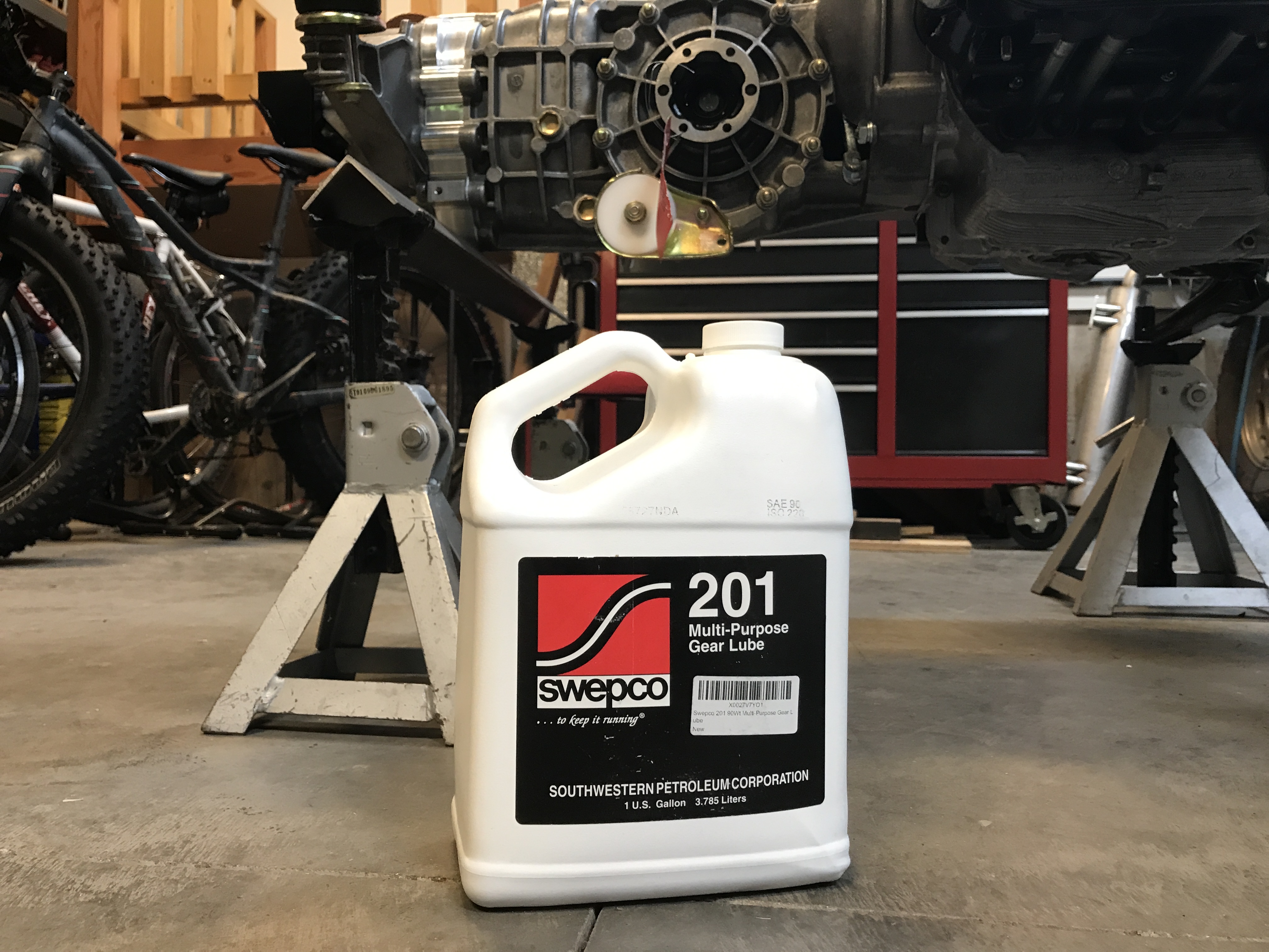

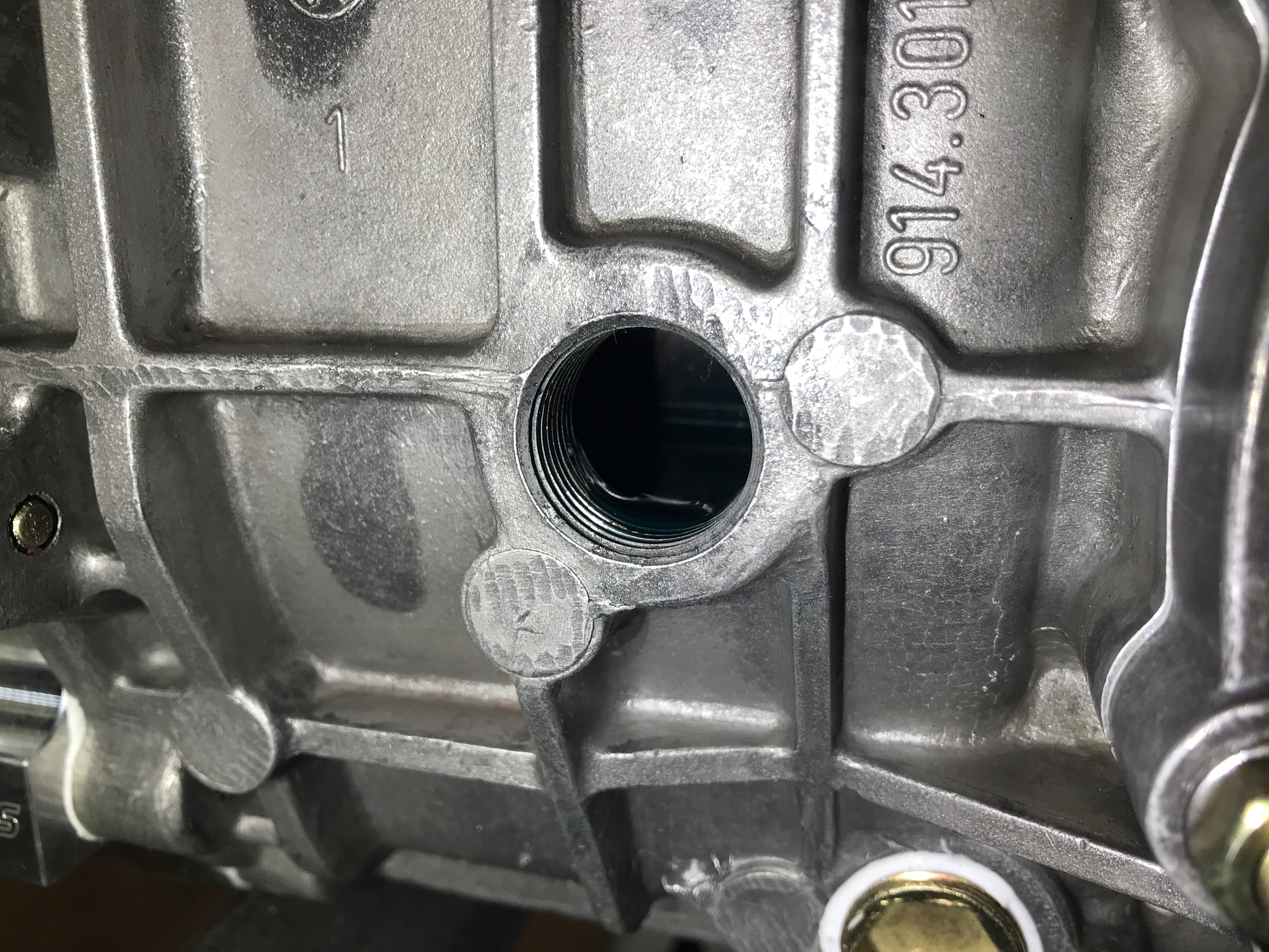

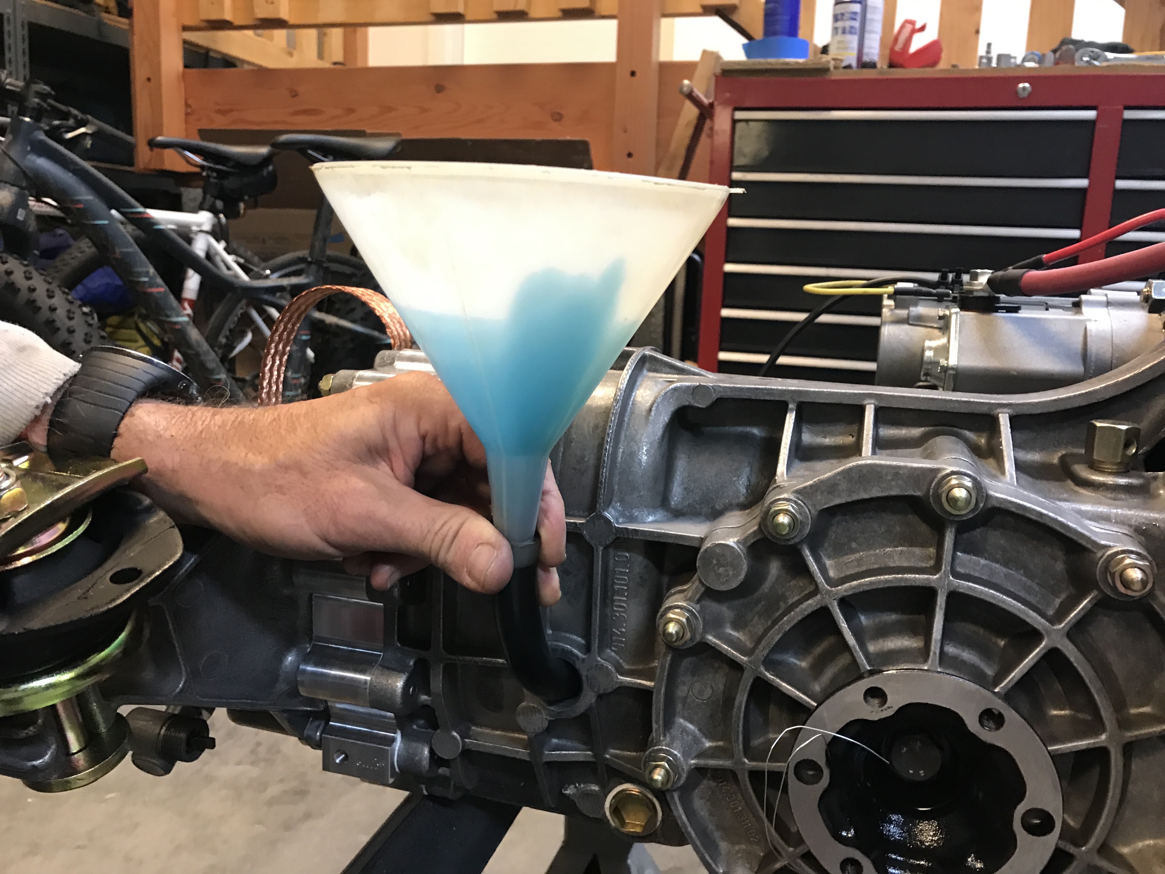

Time to fill the transaxle. I used Swepco 201 90W, as recommended by CMS.
bkrantz
post Dec 21 2021, 08:28 PM
Post #4430
Posts: 8,530
Joined: 3-August 19
From: SW Colorado
Member No.: 23,343

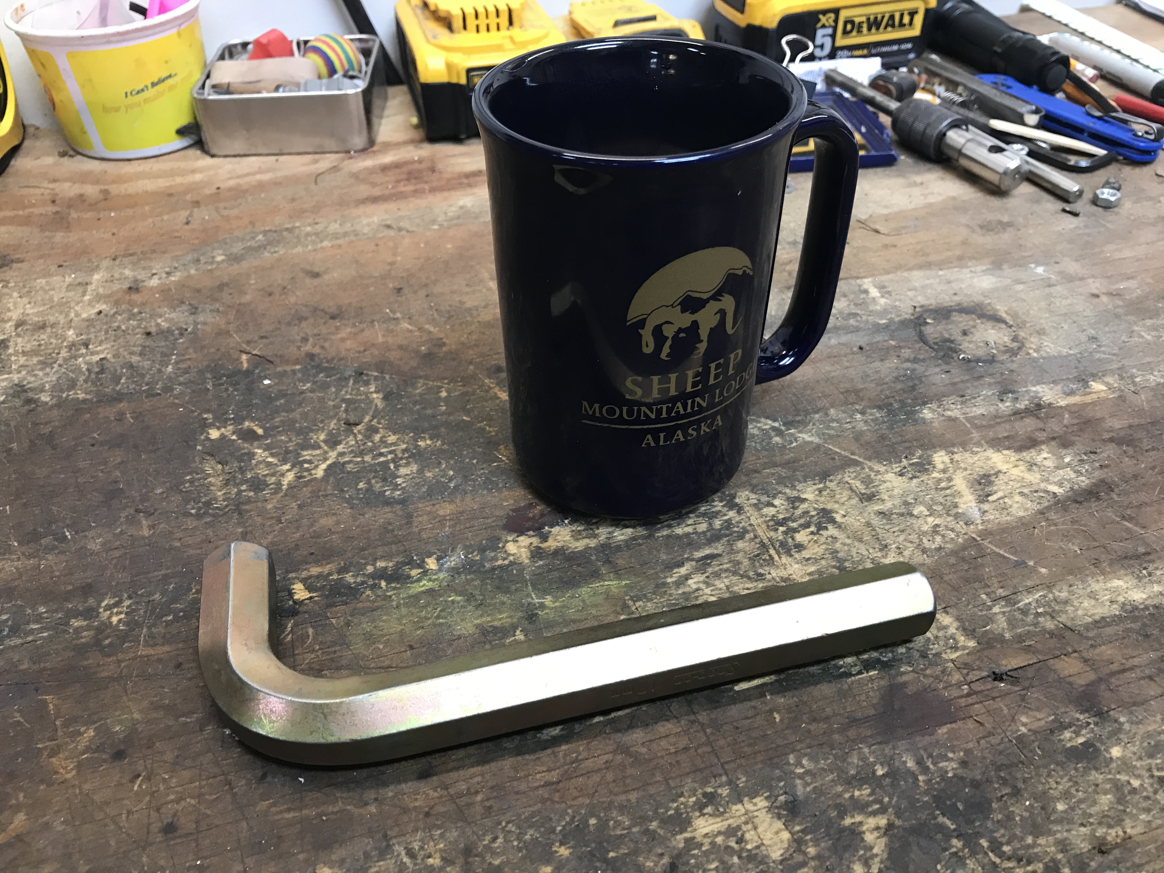

And my trusty 17 mm hex wrench. This has been hiding in the back of my tool chest for a while.
bkrantz
post Dec 21 2021, 08:29 PM
Post #4431
Posts: 8,530
Joined: 3-August 19
From: SW Colorado
Member No.: 23,343
Sure easier with the trans out of the car.
bkrantz
post Dec 21 2021, 08:31 PM
Post #4432
Posts: 8,530
Joined: 3-August 19
From: SW Colorado
Member No.: 23,343
The fill took about 3/4 gallon. CMS did run the transaxle on the bench, and drained the original lube.

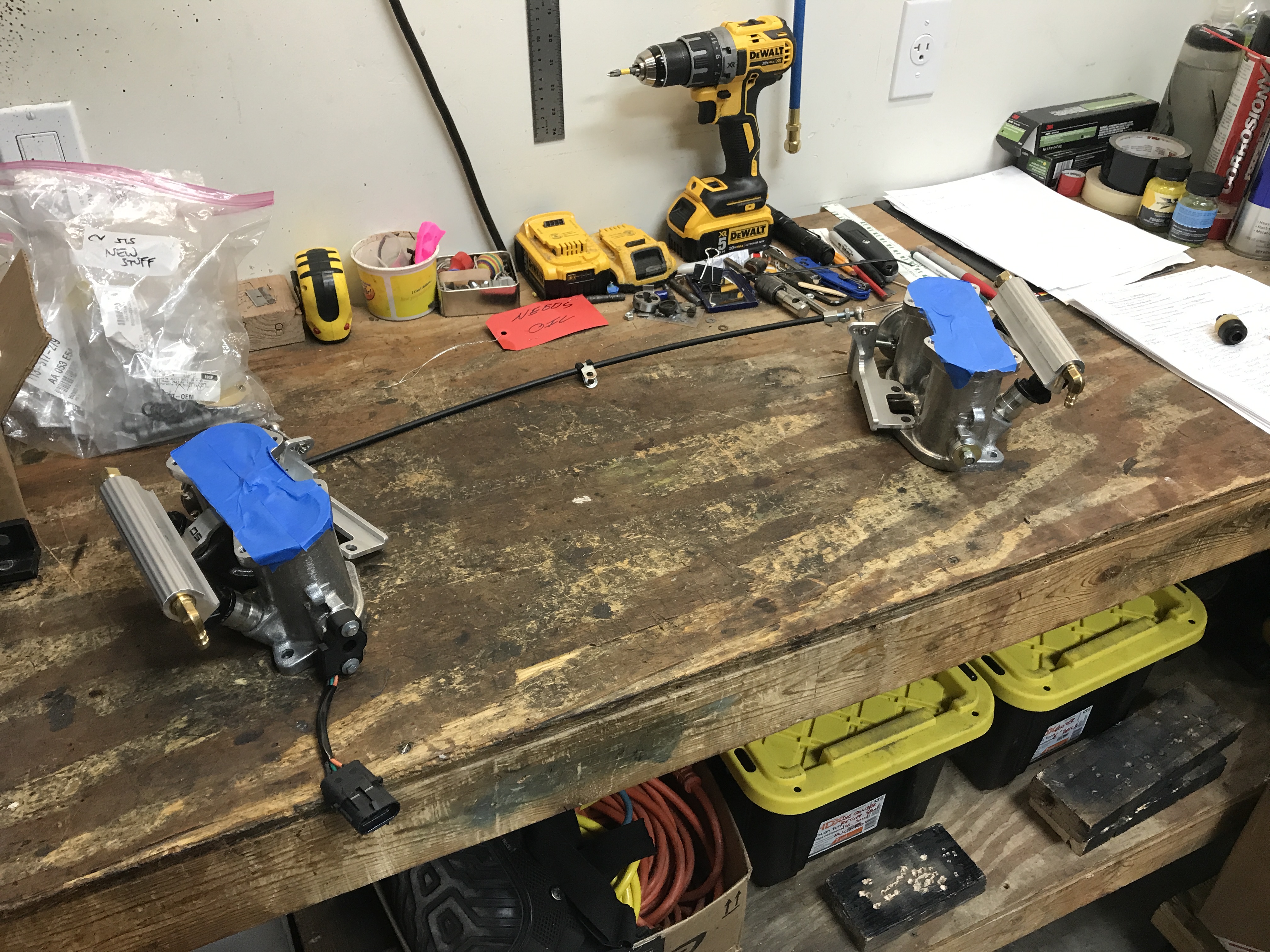

More prep for the installation: I removed the throttle bodies.
bkrantz

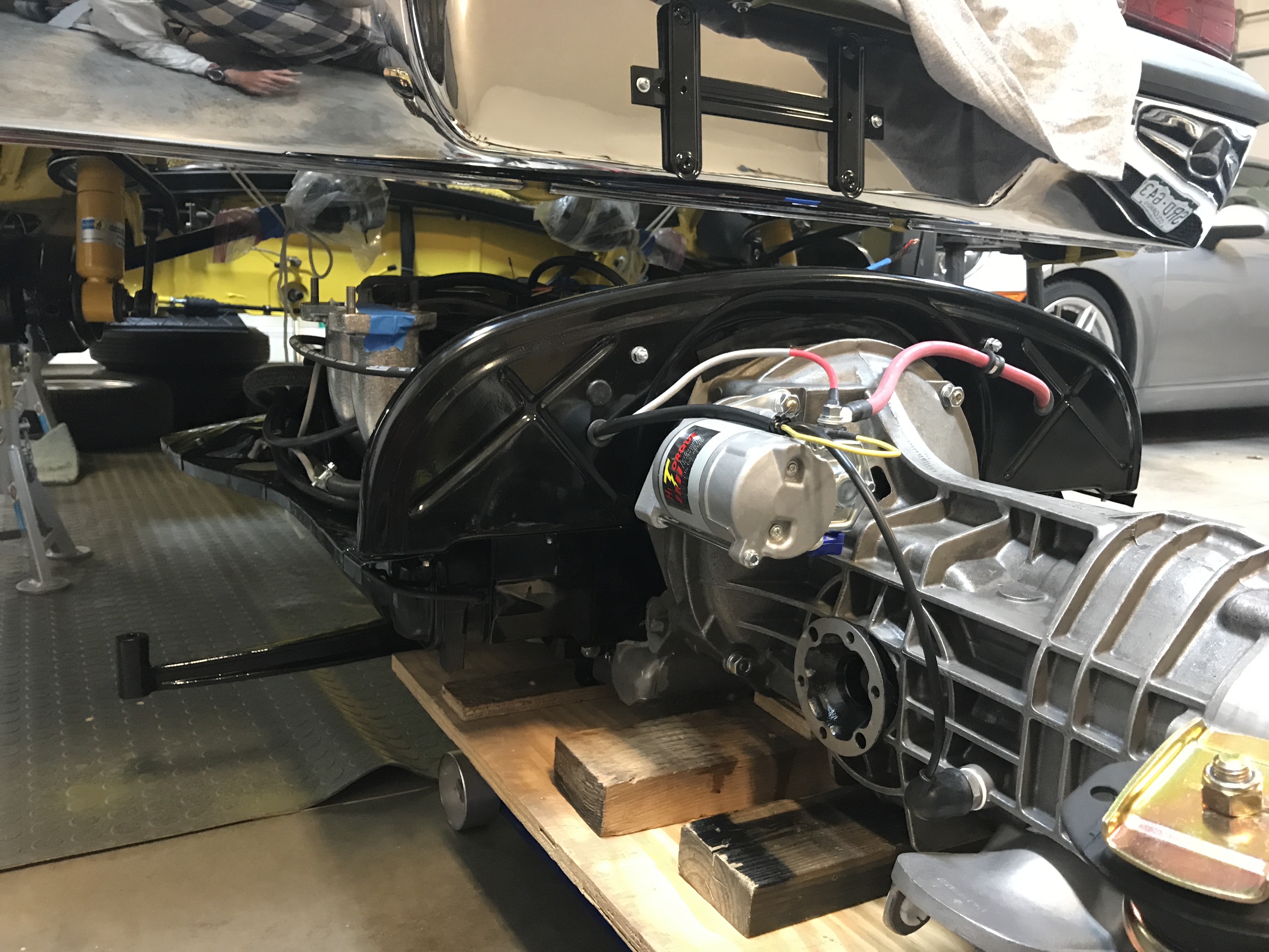

Member No.: 23,343

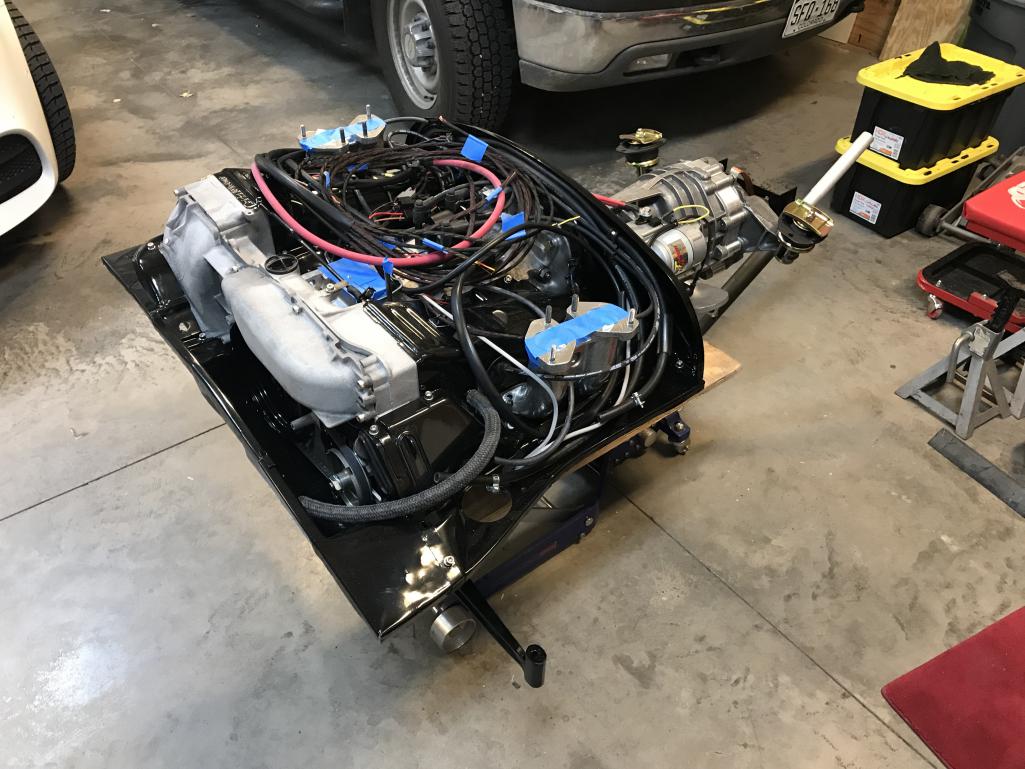

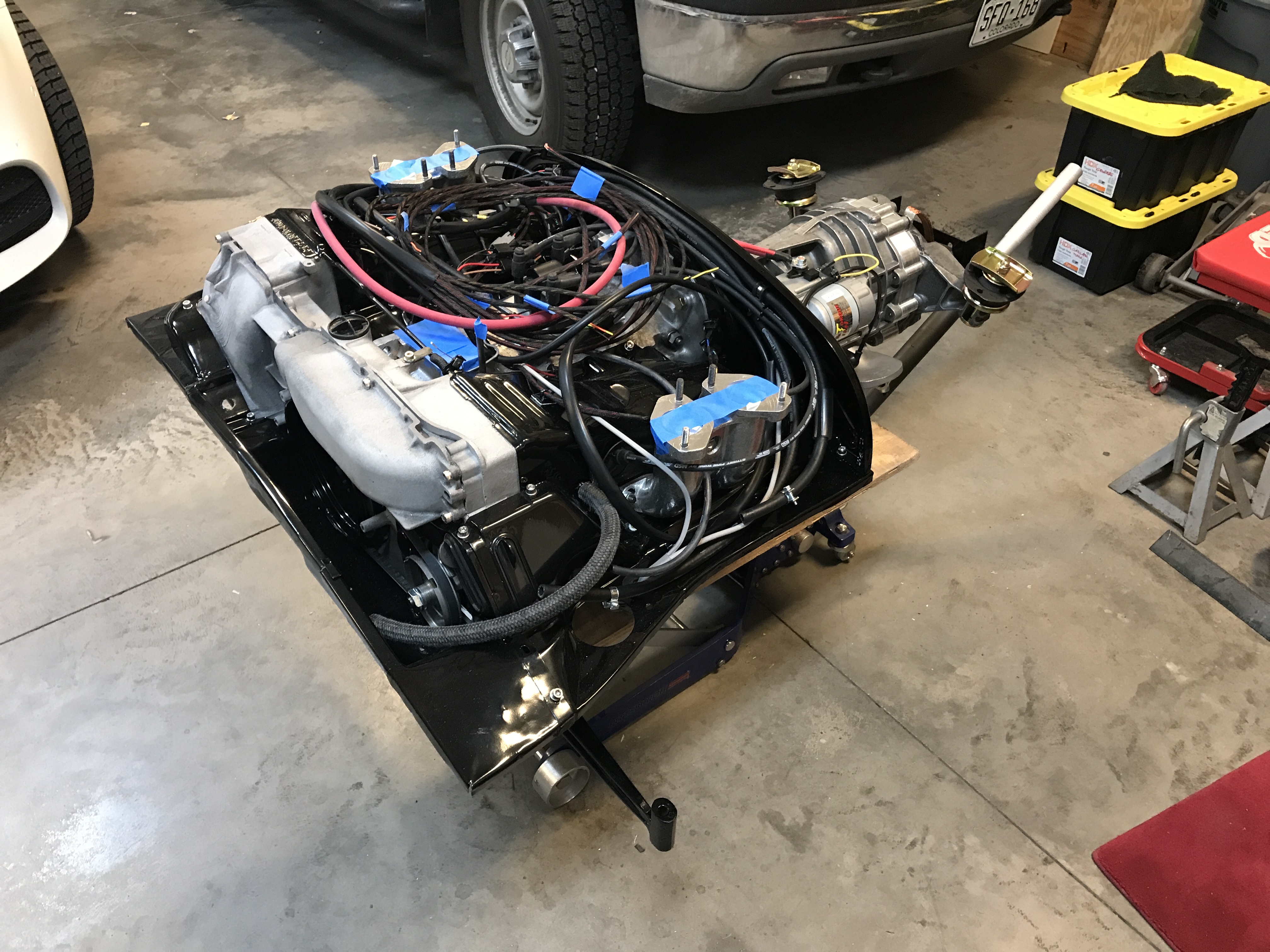

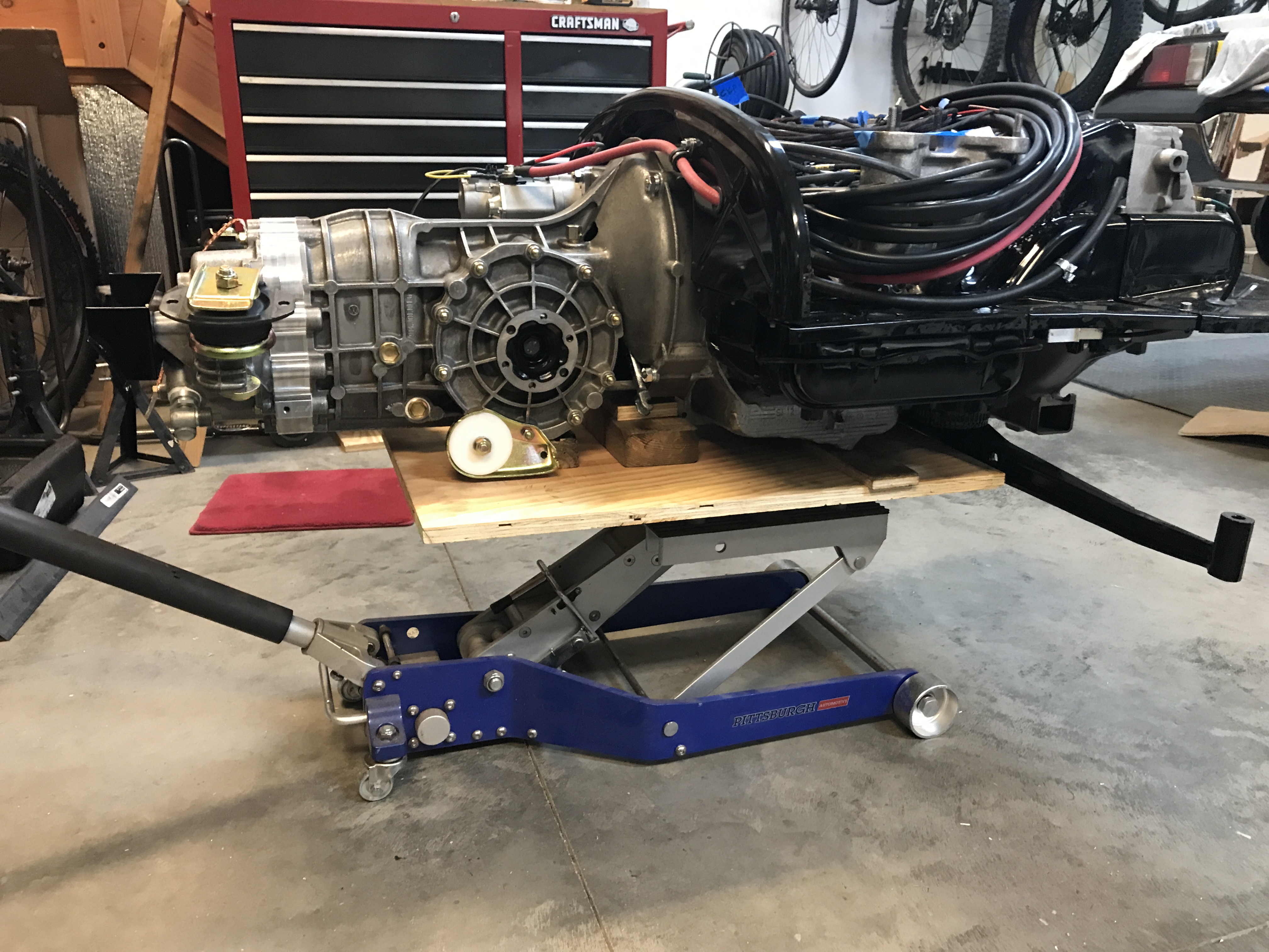

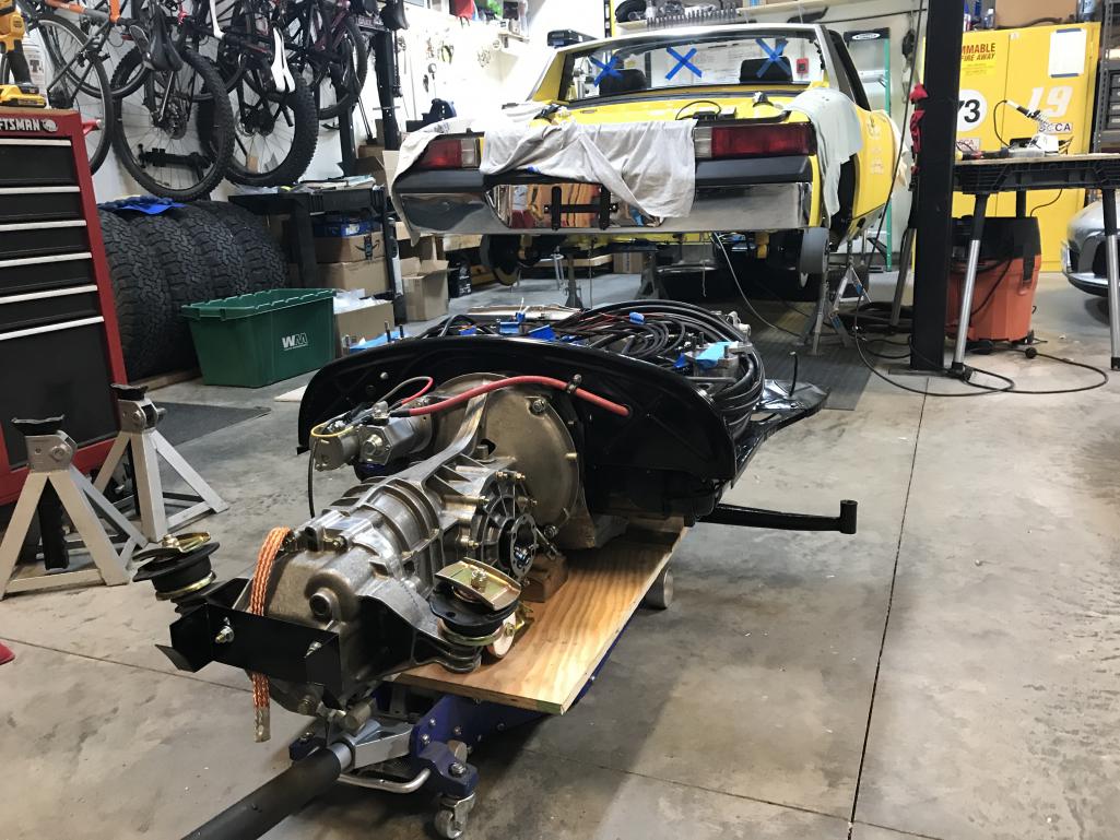

Here's the engine and trans braced and balanced on my "motorcycle lift".
bkrantz
post Dec 21 2021, 08:36 PM
Post #4436
Posts: 8,530
Joined: 3-August 19
From: SW Colorado
Member No.: 23,343
Look out, car--here it comes!

Member No.: 23,343
Decent clearance under the rear bumper, with the valance removed.

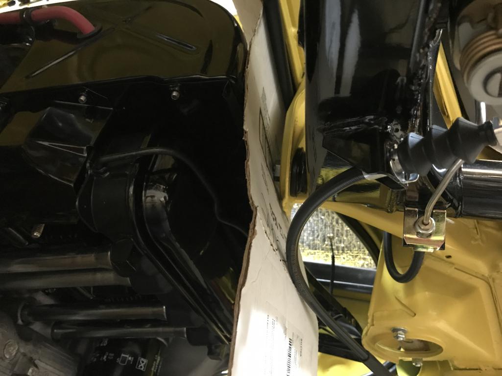

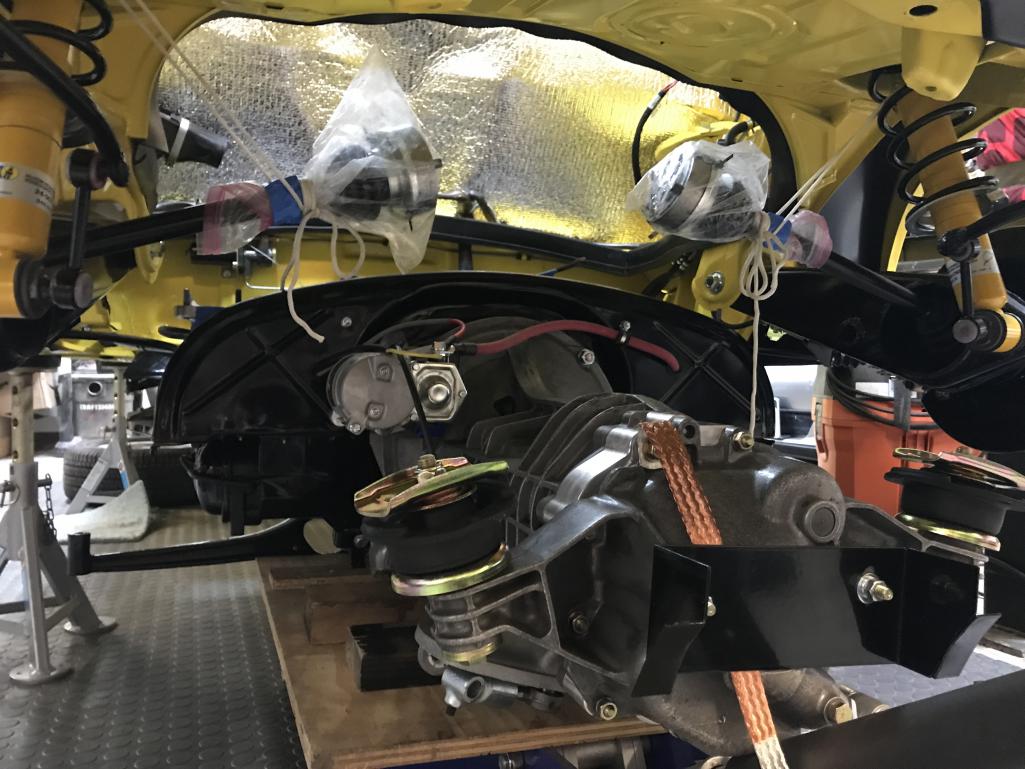

Got it centered and lined up. I lifted one inch at a time, and then checked all around, top and bottom.
bkrantz
post Dec 21 2021, 08:40 PM
Post #4439
Posts: 8,530
Joined: 3-August 19
From: SW Colorado
Member No.: 23,343

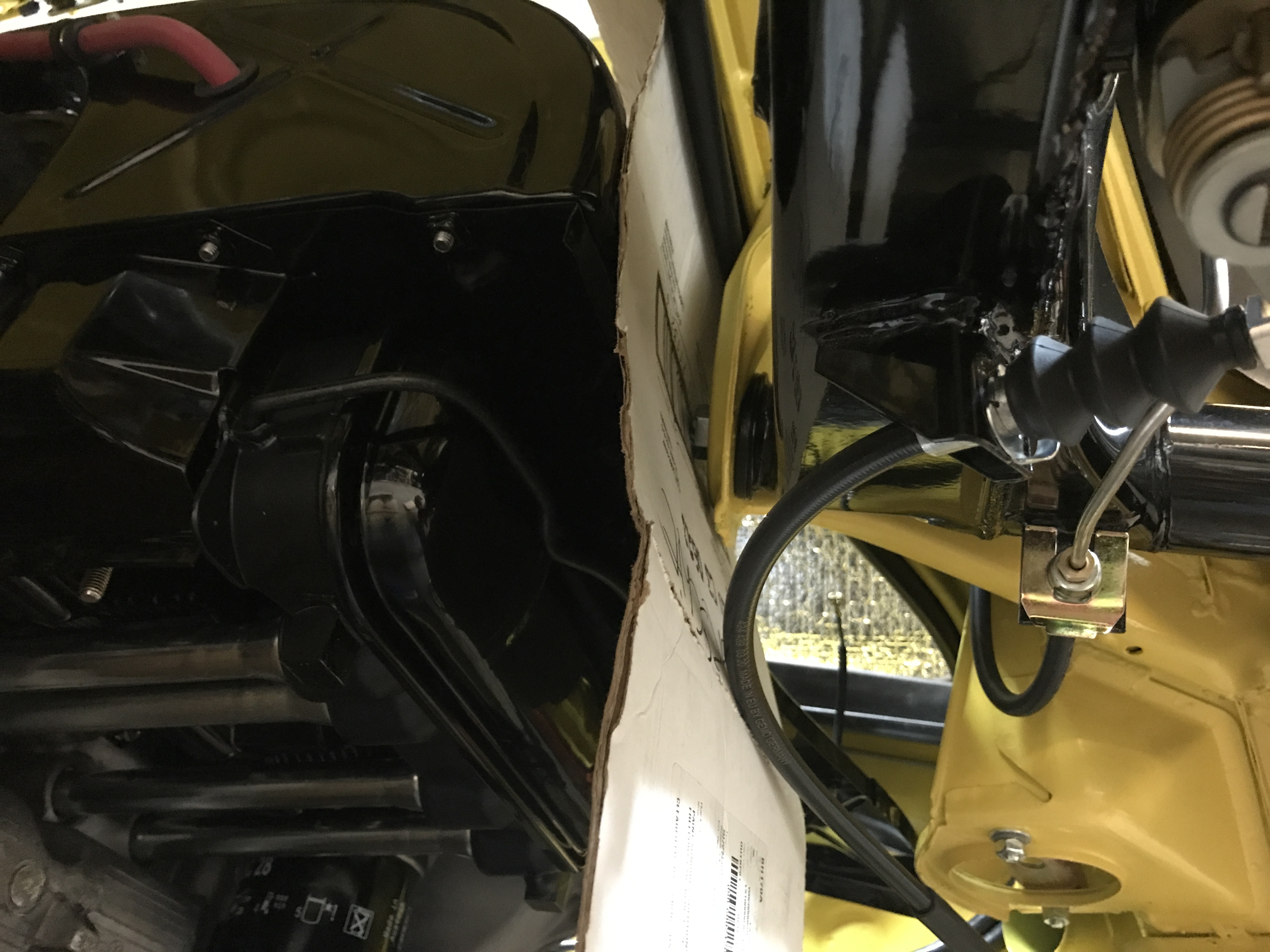

I used some cardboard to protect the edges of the sheet metal from the suspension nuts.

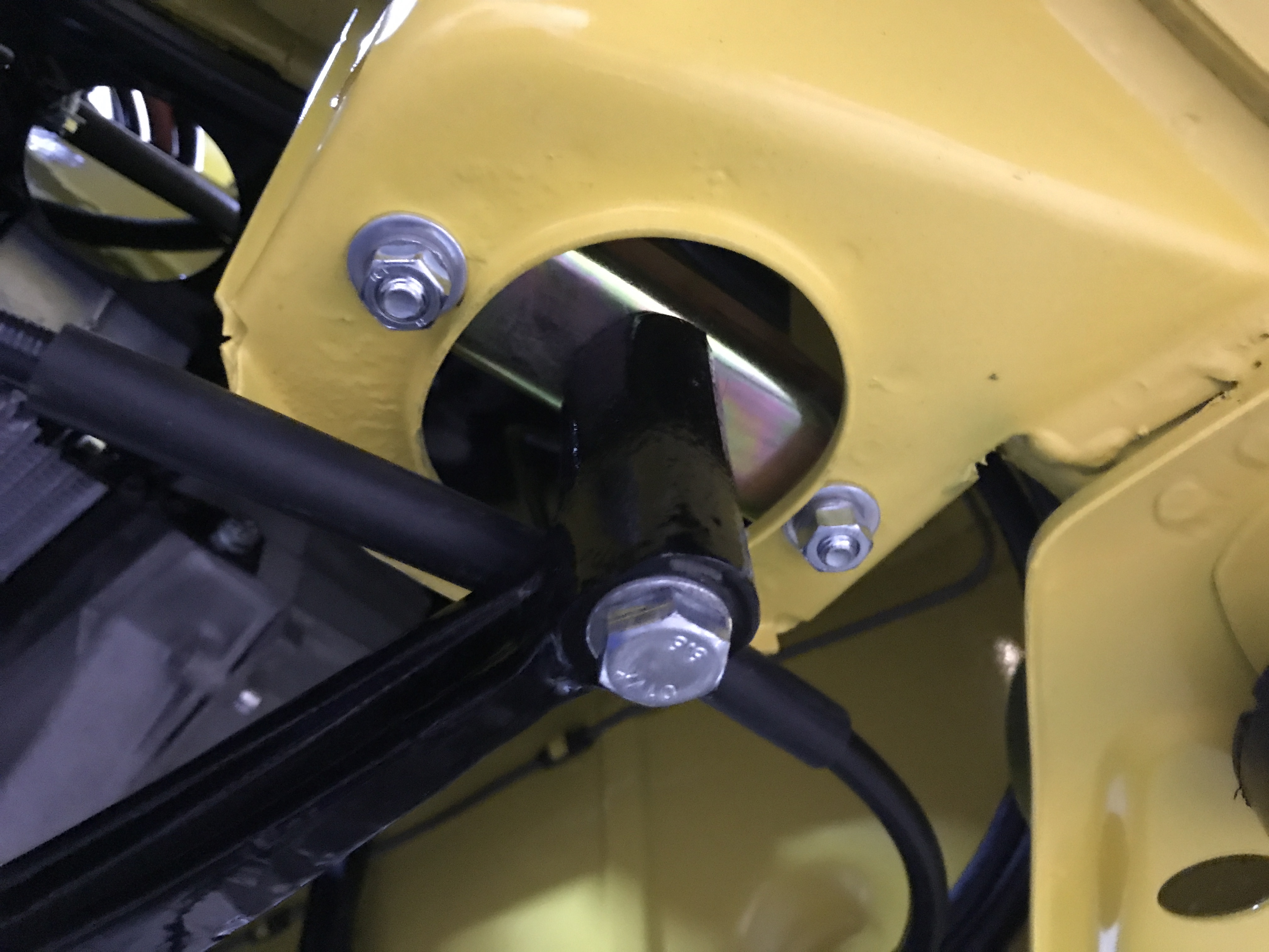

Eventually, I got the engine and trans lifted into place, and the mounts aligned. In the front, I used new bolts, inserted from below. This protects the nut end (and matches the PET).
