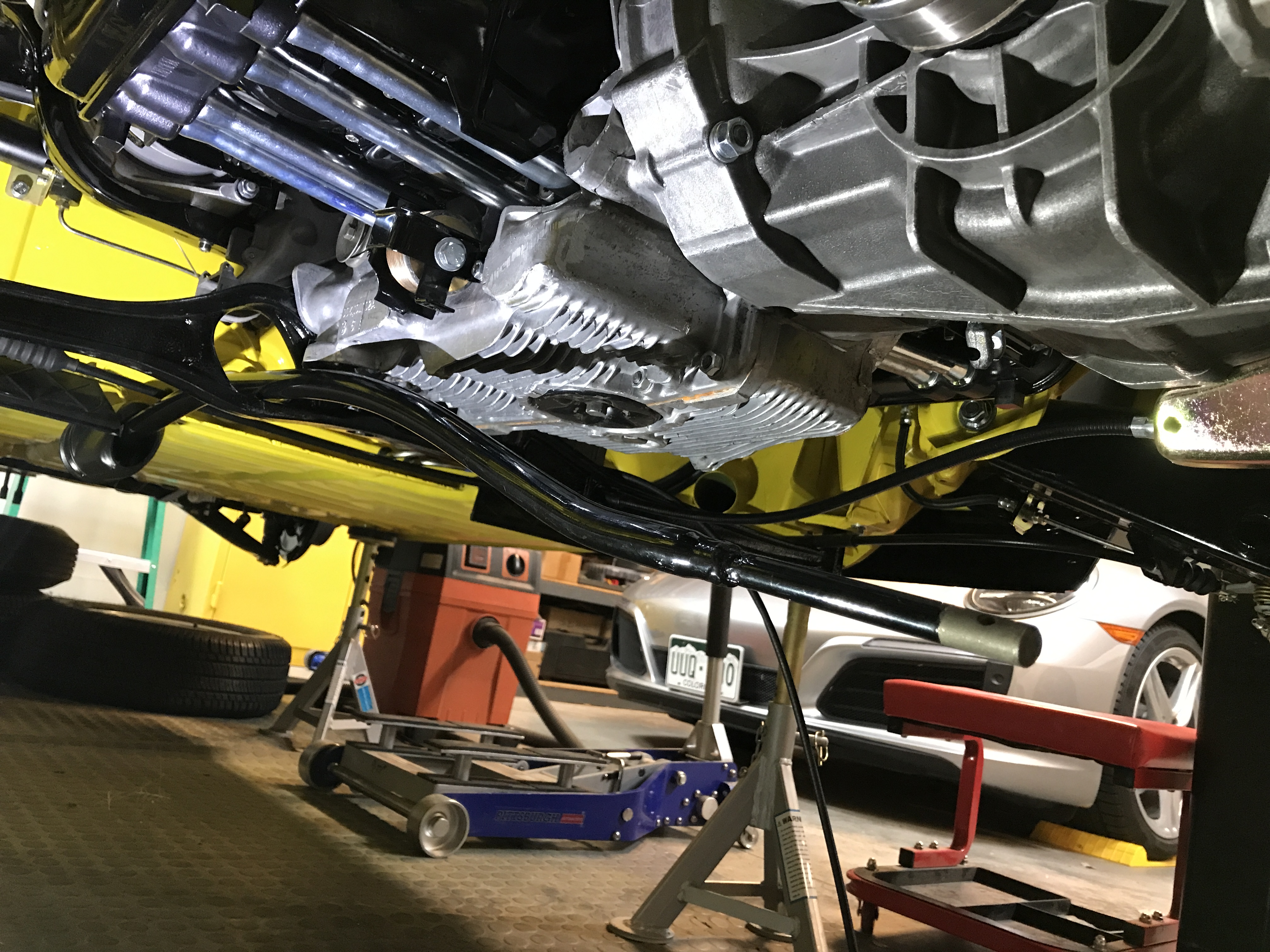

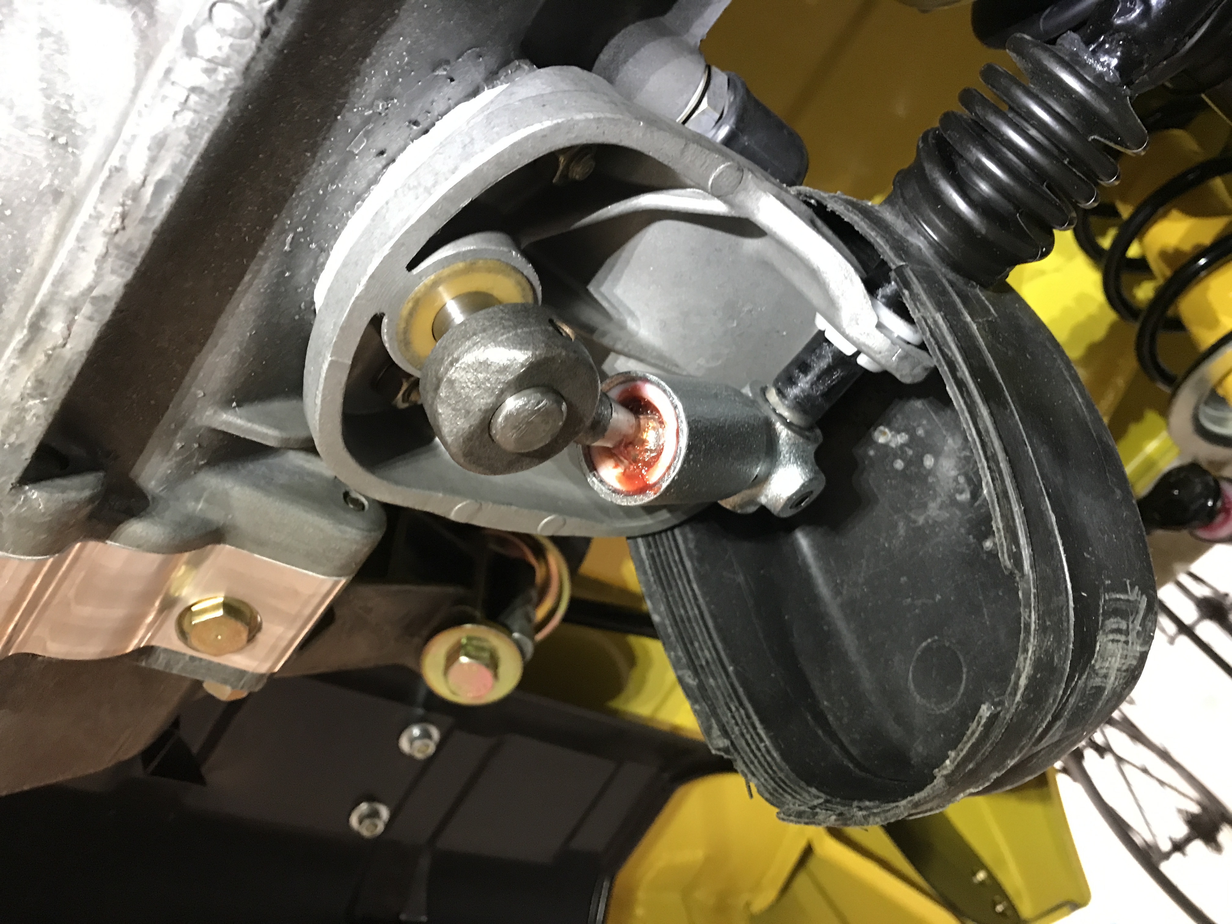

Next, the shift control rod.
bkrantz
post Dec 22 2021, 09:09 PM
Post #4462
Posts: 8,530
Joined: 3-August 19
From: SW Colorado
Member No.: 23,343
Attached at the trans end, with a new conical screw. I re-used the cover, one of the few original parts in OK shape.
bkrantz
post Dec 22 2021, 09:10 PM
Post #4463
Posts: 8,530
Joined: 3-August 19
From: SW Colorado
Member No.: 23,343

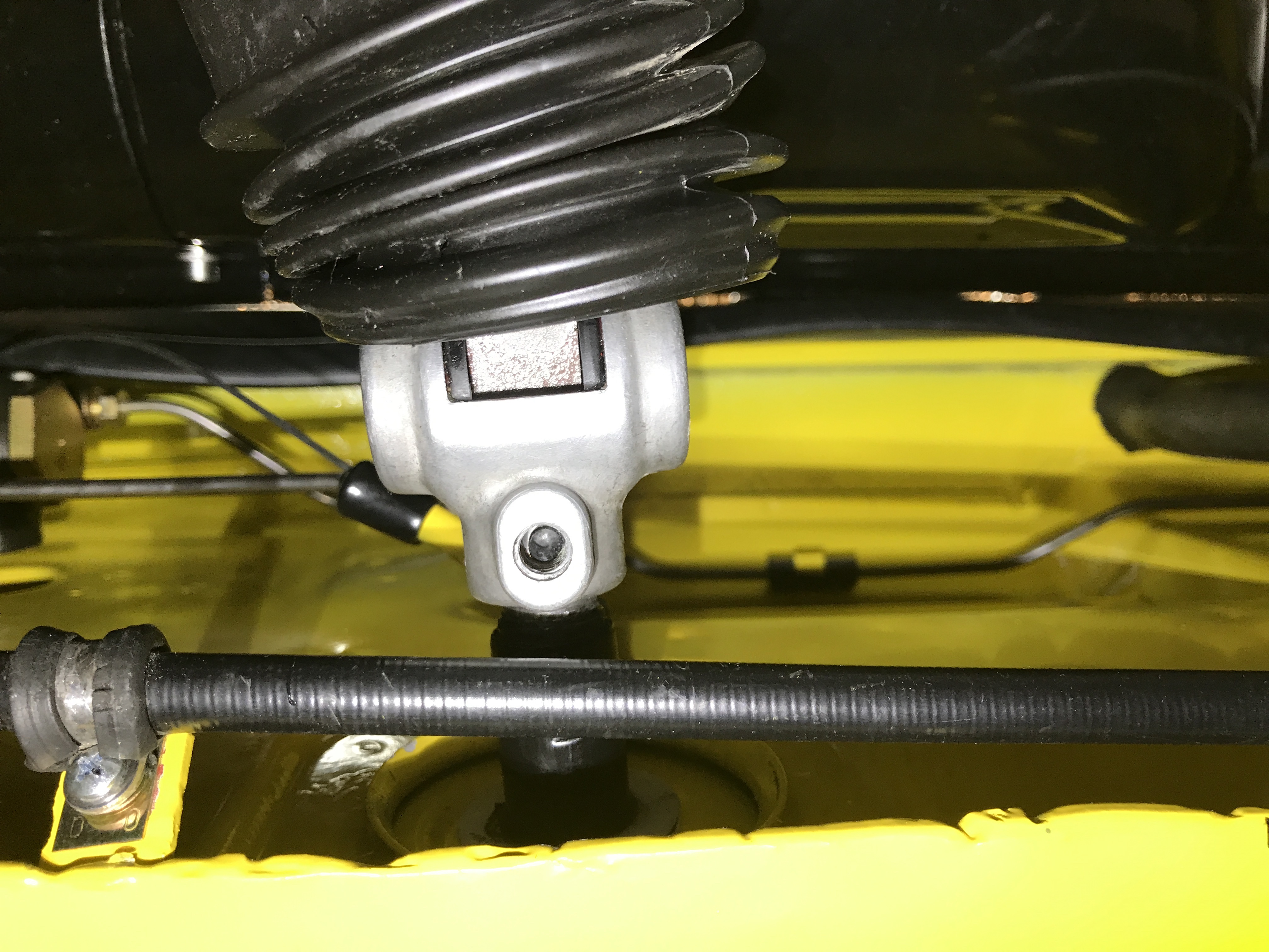

And then the coupling at the front end, with another new screw.
bkrantz
post Dec 22 2021, 09:12 PM
Post #4464
Posts: 8,530
Joined: 3-August 19
From: SW Colorado
Member No.: 23,343

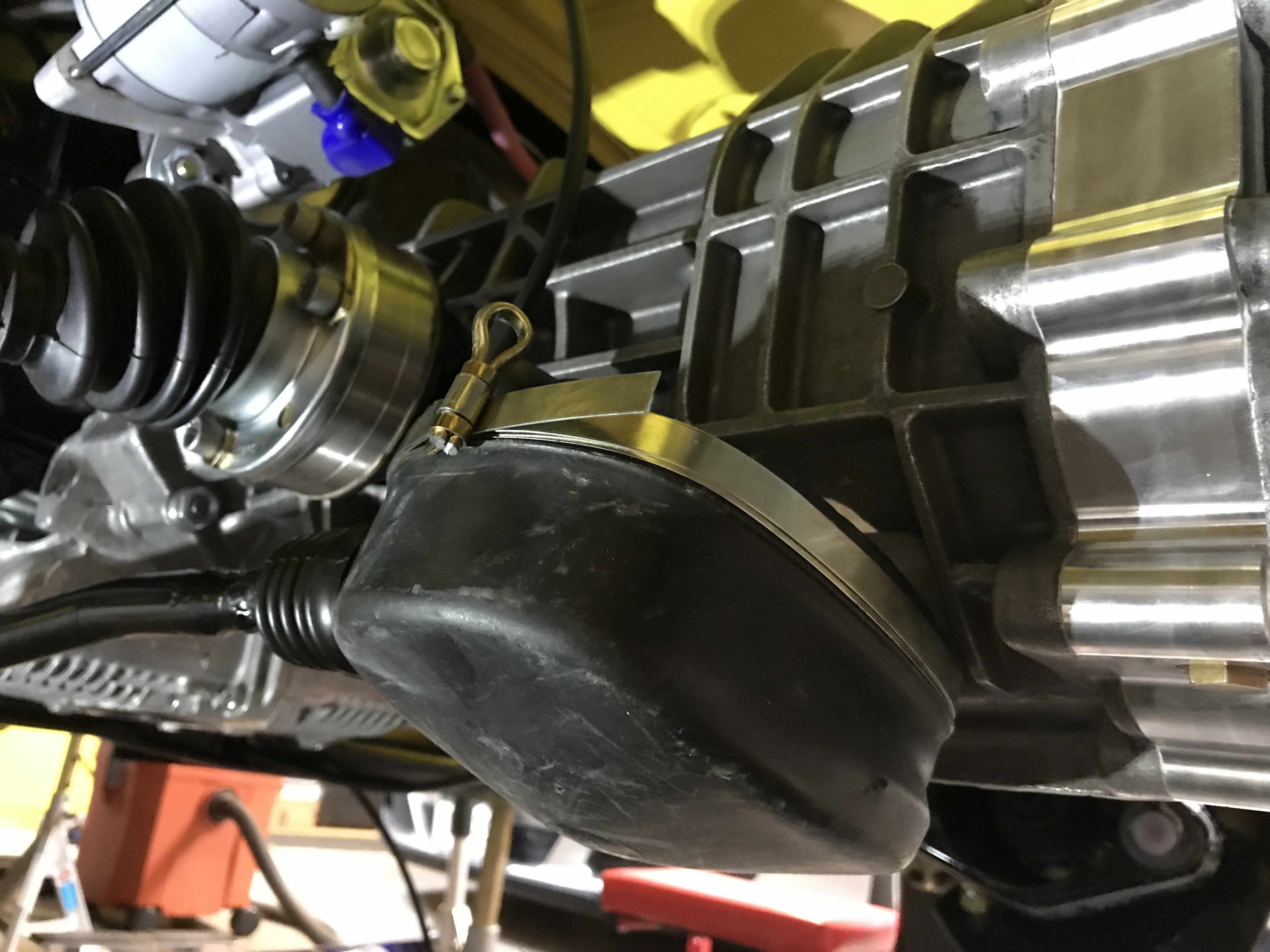

Getting the rubber boot in place was a bit of a pain.

And a new retaining strap for the rear cover.

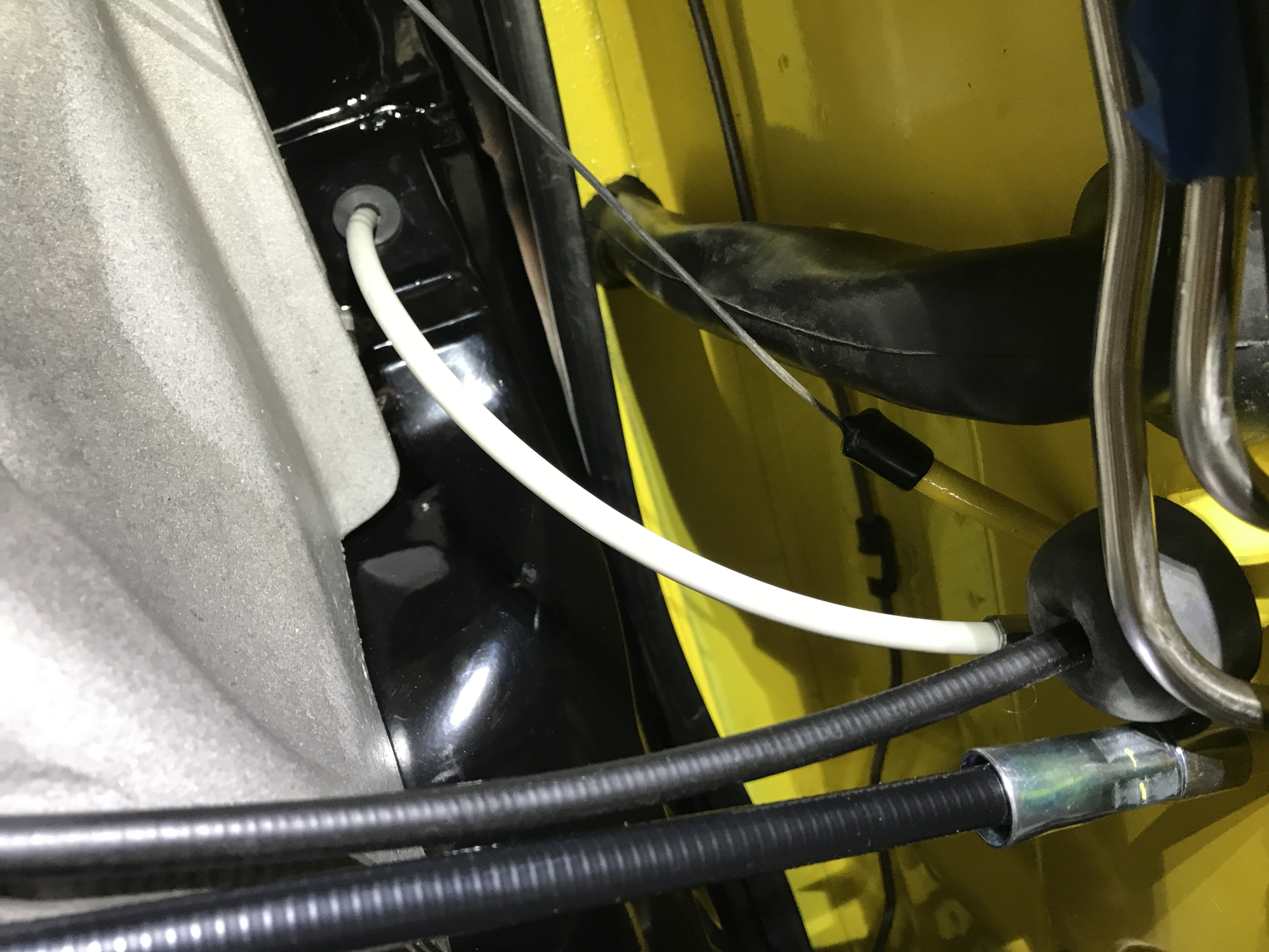

bkrantz
post Dec 24 2021, 06:17 PM
Post #4475
Posts: 8,530
Joined: 3-August 19
From: SW Colorado
Member No.: 23,343
Here's my new routing for the accelerator cable, so it comes up near engine-center.

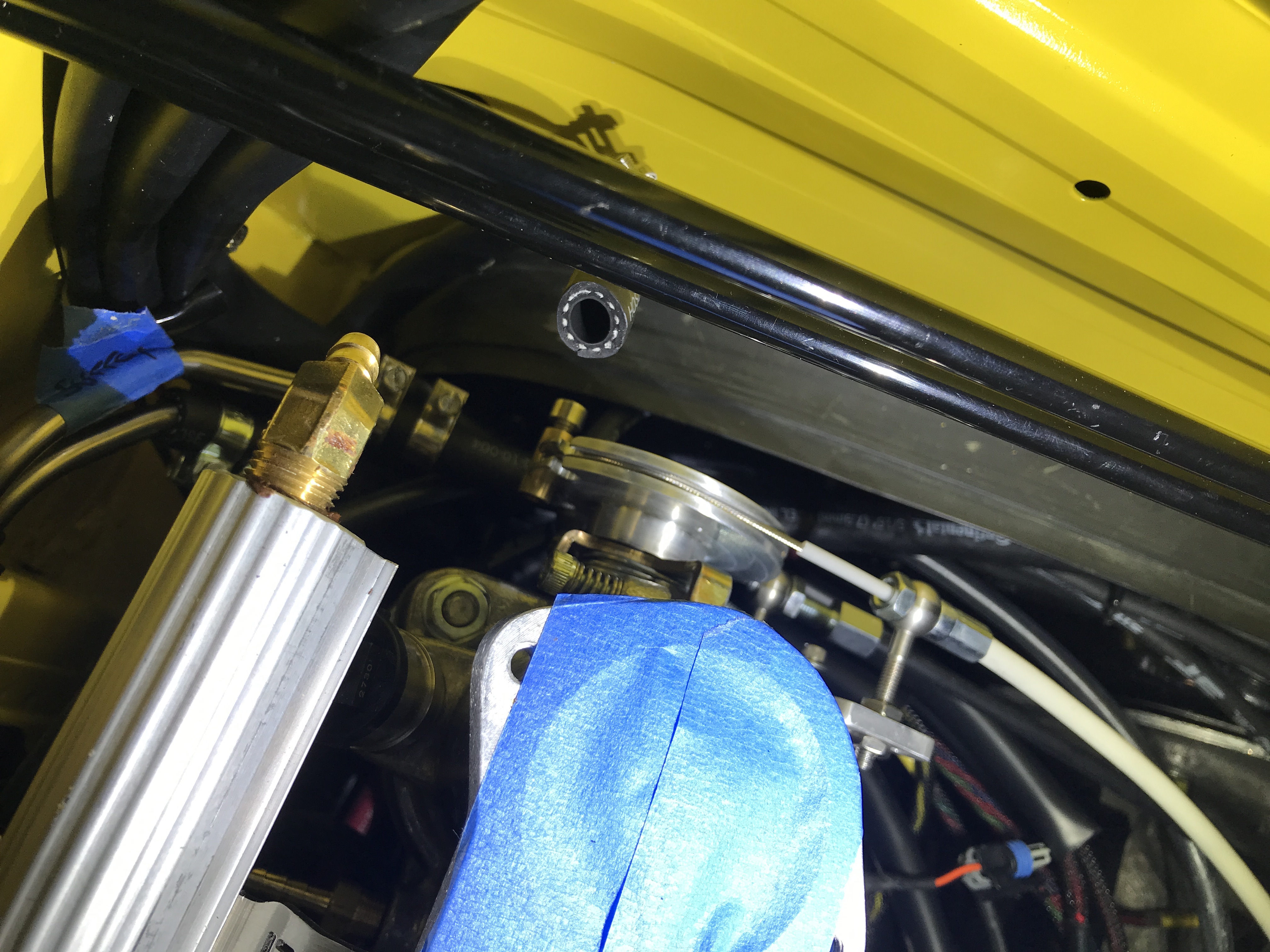

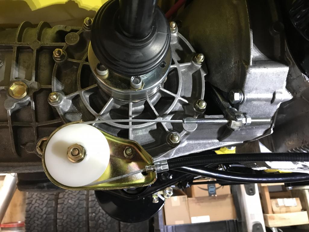

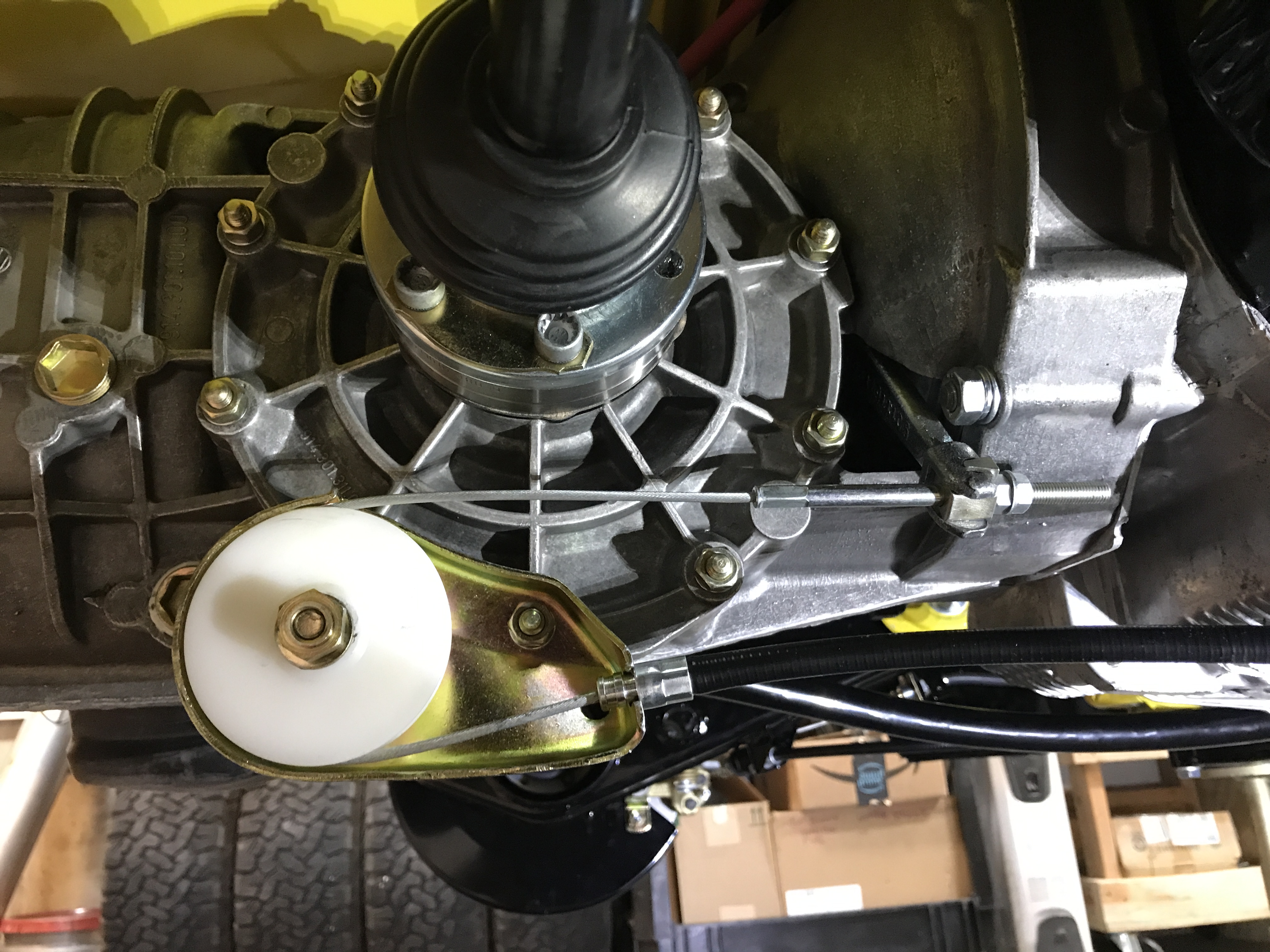

bkrantz
post Dec 24 2021, 06:20 PM
Post #4476
Posts: 8,530
Joined: 3-August 19
From: SW Colorado
Member No.: 23,343

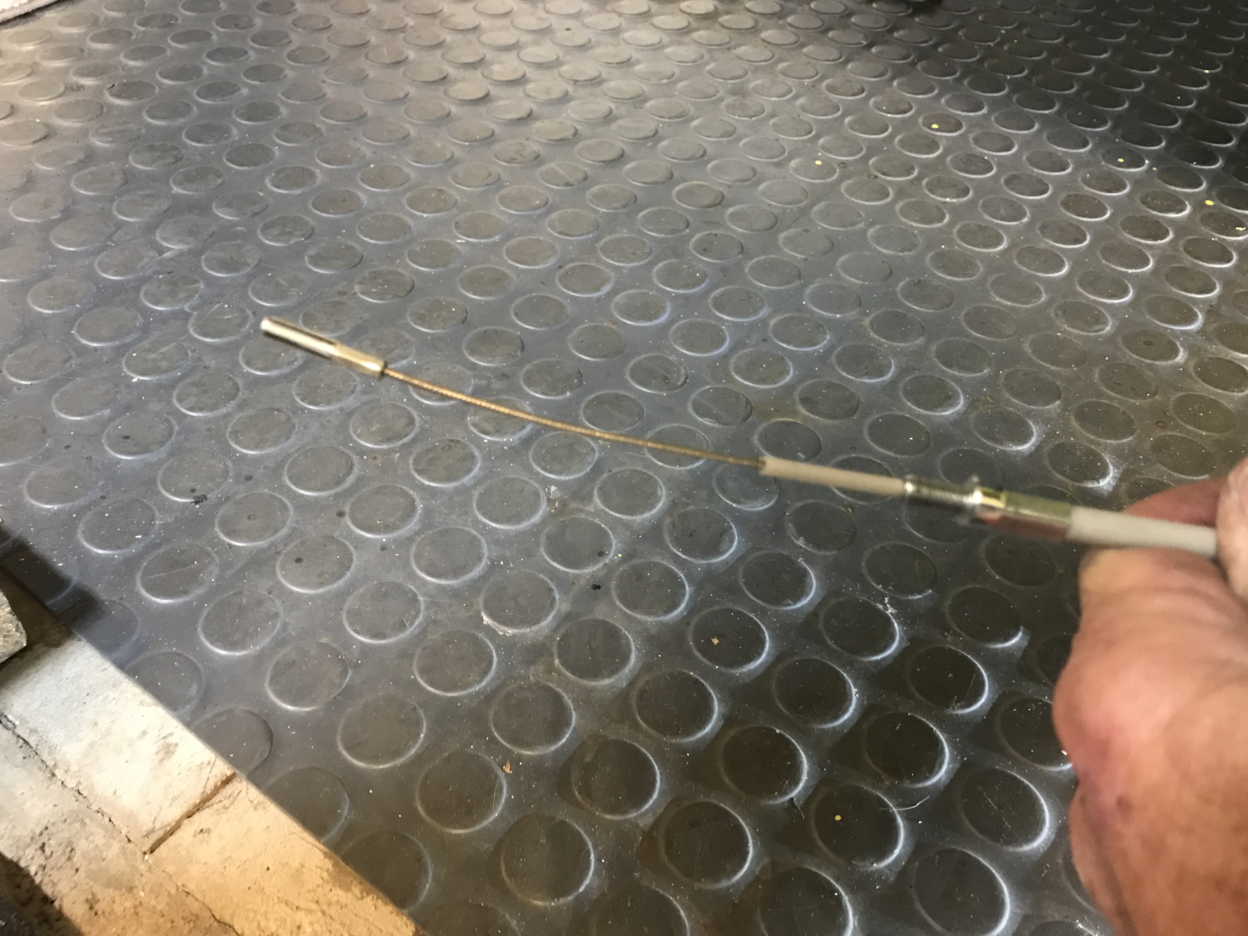

And here's my mods of the cable end: I trimmed about an inch from the nylon center sheath, and about 3/4 inch from the rigid end so it does not project from the pulley.
bkrantz
post Dec 24 2021, 06:25 PM
Post #4477
Posts: 8,530
Joined: 3-August 19
From: SW Colorado
Member No.: 23,343
And here's the cable connected to the pulley, with good clearance. That right rear corner of the engine compartment is getting busy. Note the bundles of cables in vinyl sheaths in the body clip on the left.

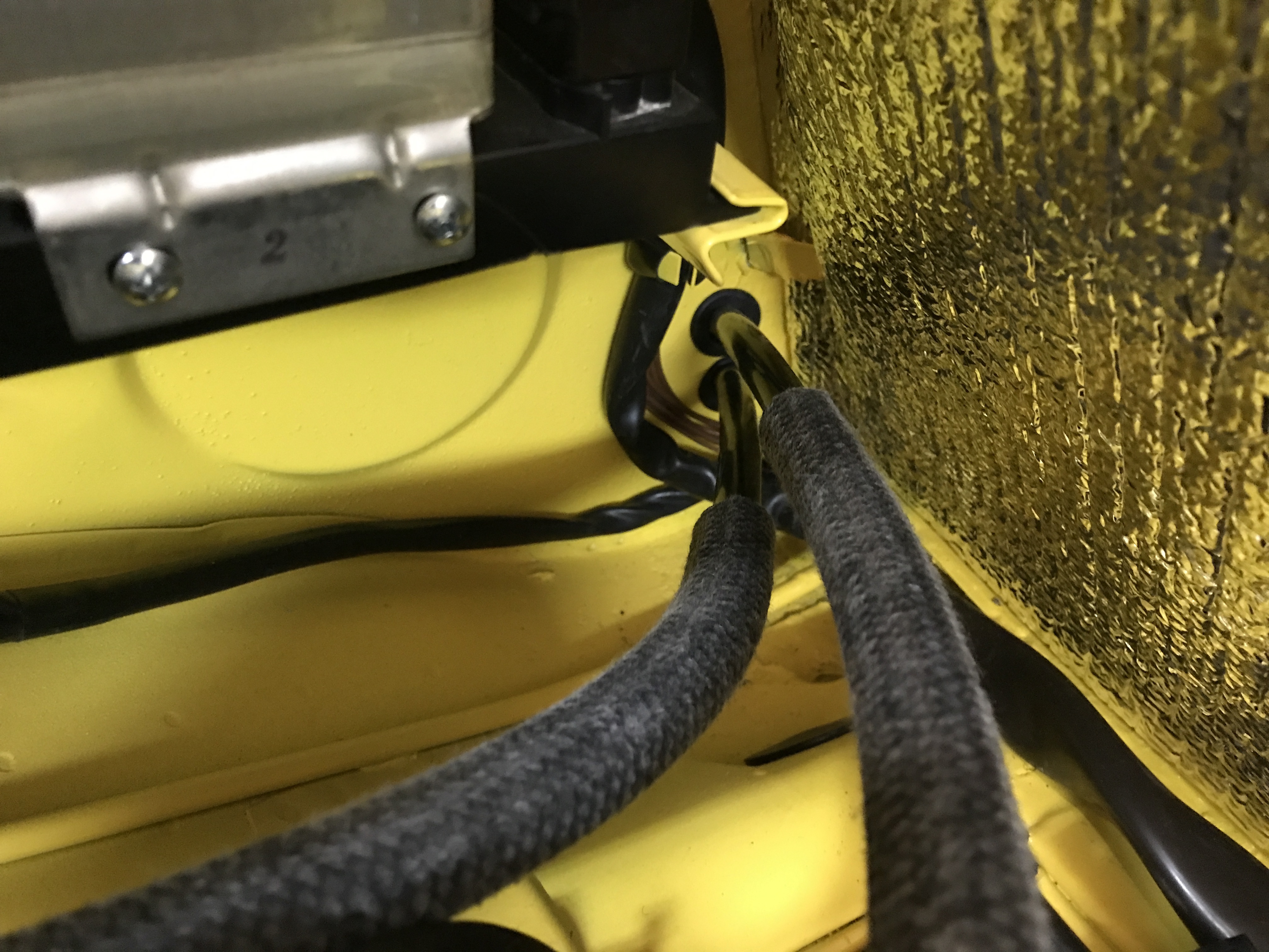

bkrantz
post Dec 24 2021, 06:28 PM
Post #4478
Posts: 8,530
Joined: 3-August 19
From: SW Colorado
Member No.: 23,343
Other stuff to connect: the stock alternator cable and my modified 12-pin cable.

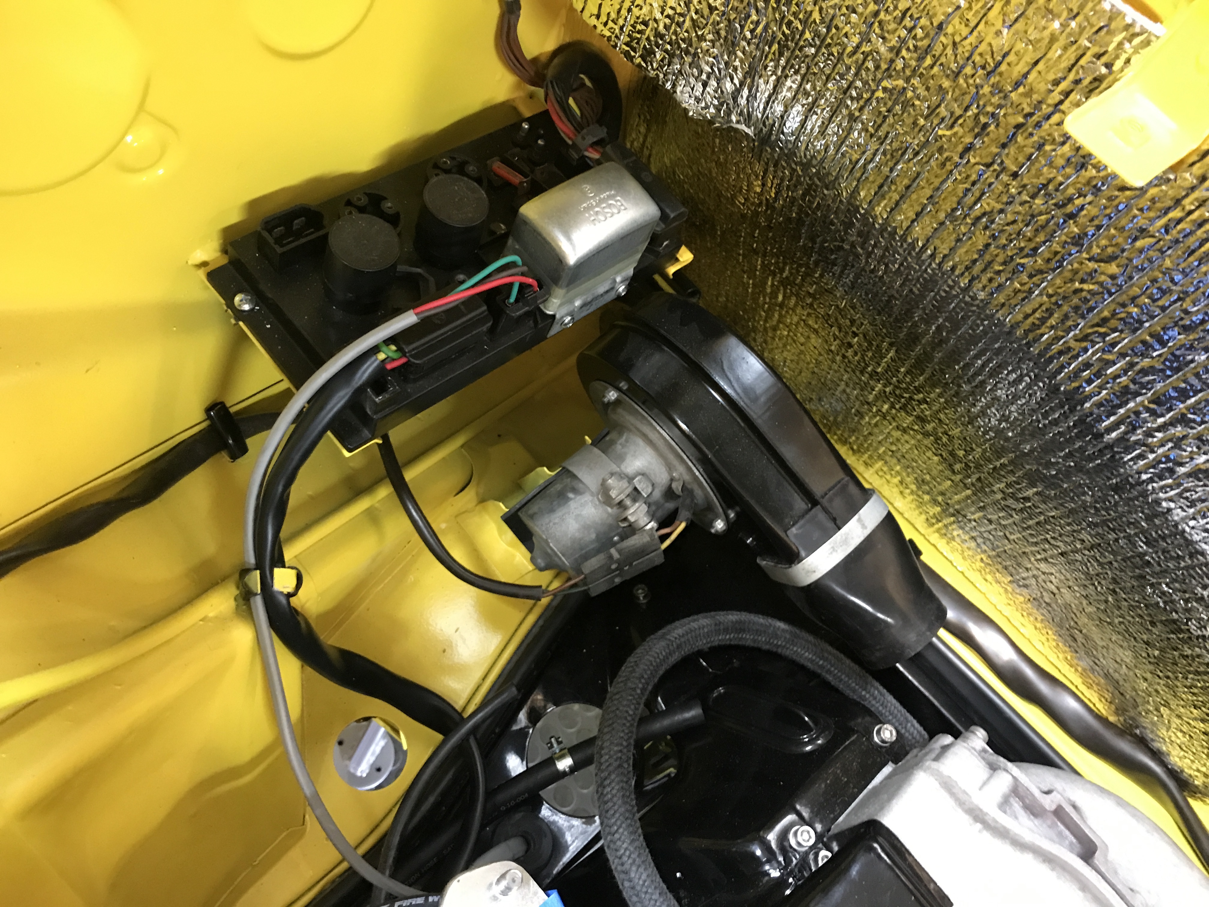

bkrantz
post Dec 24 2021, 06:29 PM
Post #4479
Posts: 8,530
Joined: 3-August 19
From: SW Colorado
Member No.: 23,343
I also connected the gas tank evaporation system hoses. I think I got the right flow direction (out of the charcoal canister).

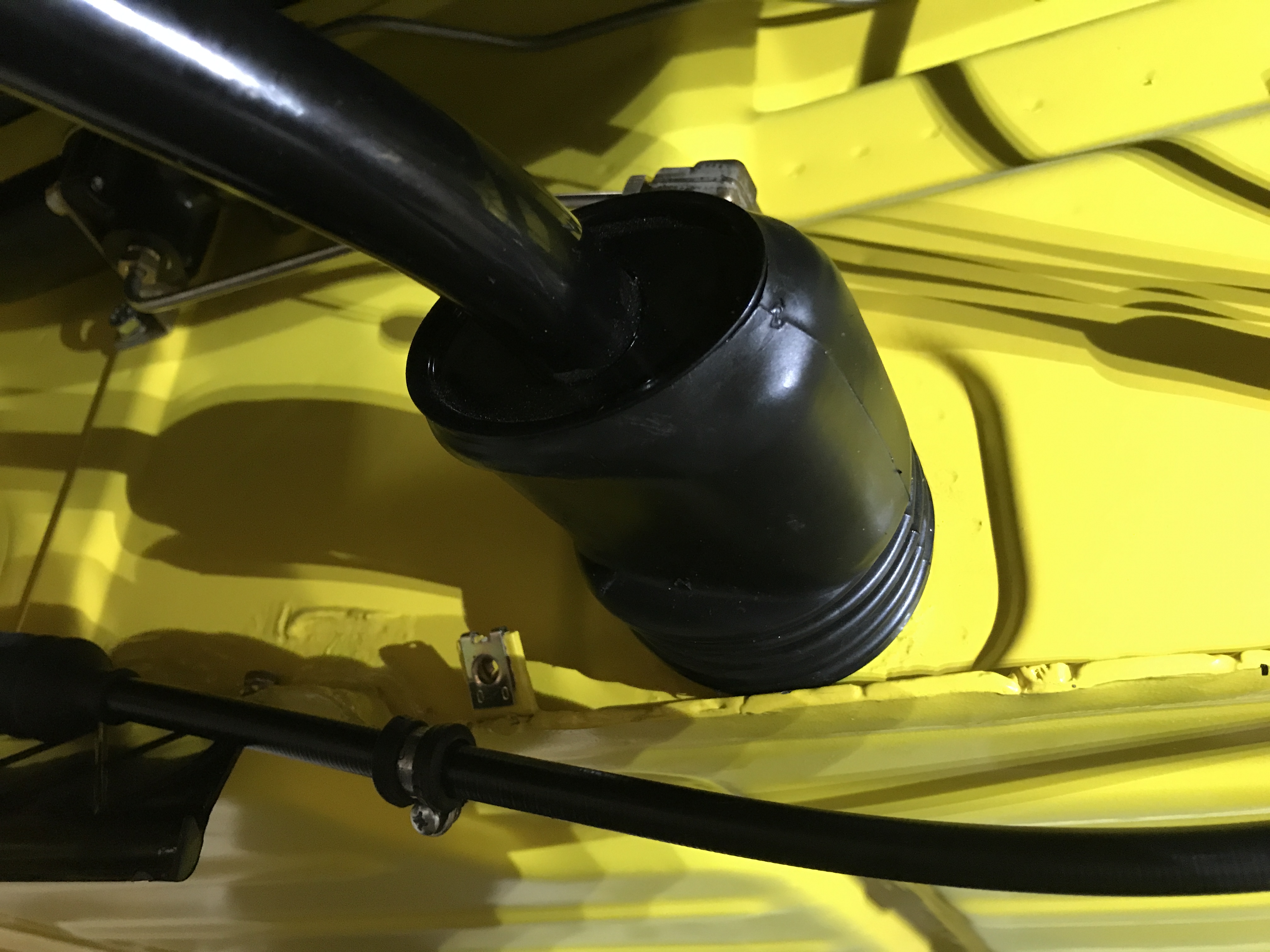

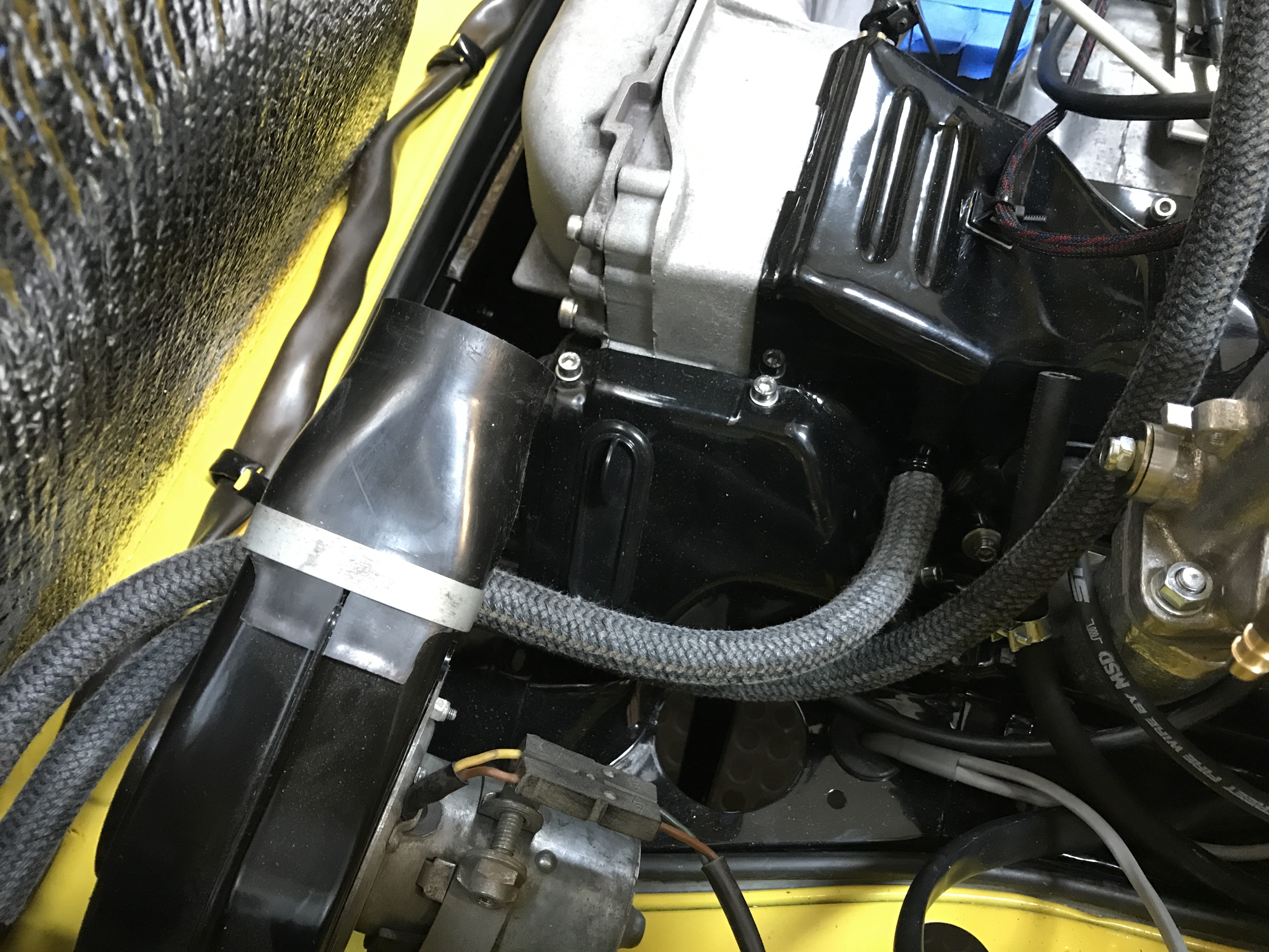

bkrantz
post Dec 24 2021, 06:30 PM
Post #4480
Posts: 8,530
Joined: 3-August 19
From: SW Colorado
Member No.: 23,343
The line that goes to the front connects to the port on the sheet metal, to provide "high" pressure air. I will route the other line to the left side air filter.
